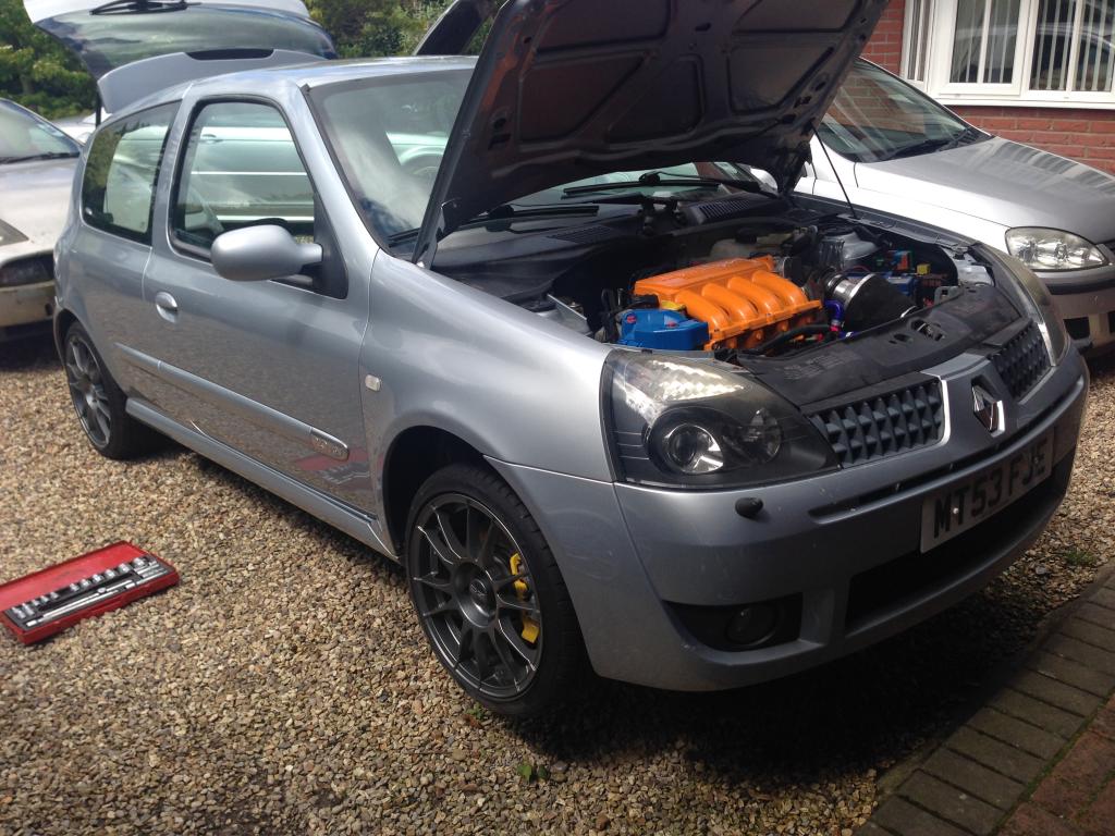

Finchspeed 172 PH2 trackday car

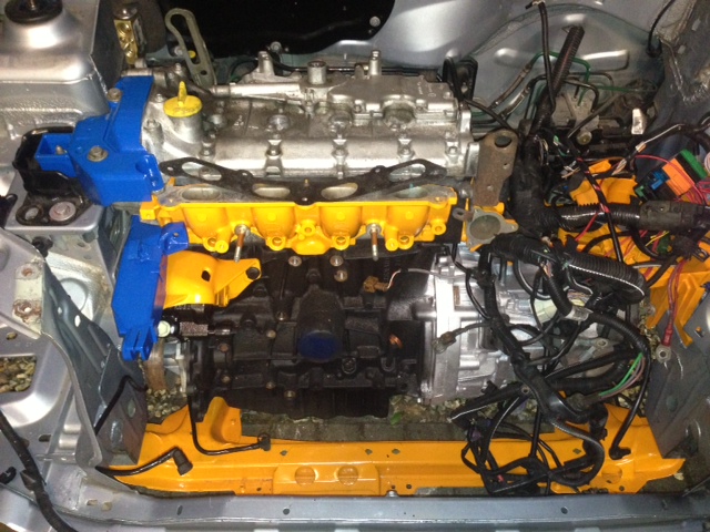

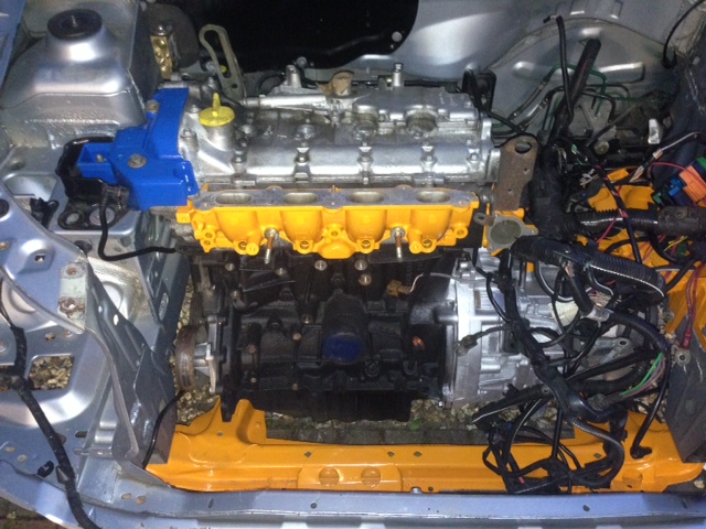

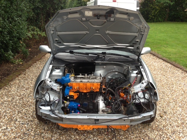

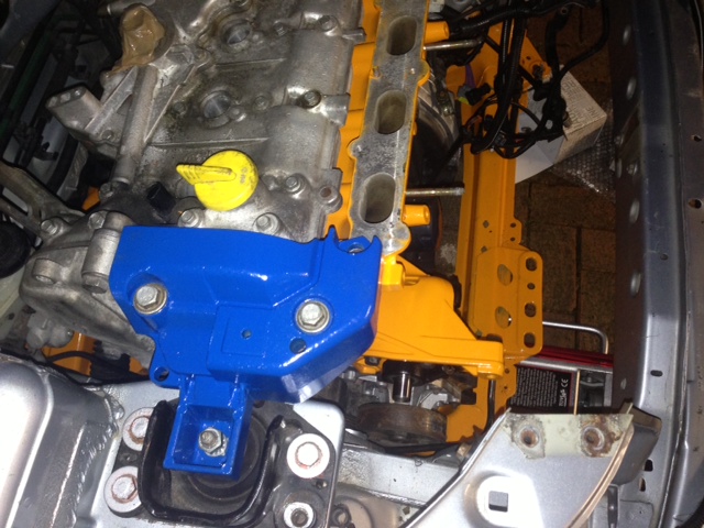

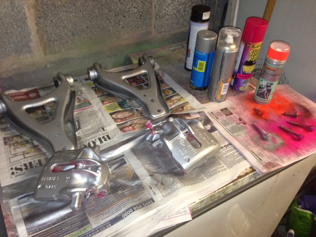

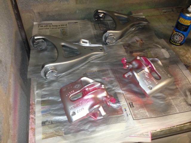

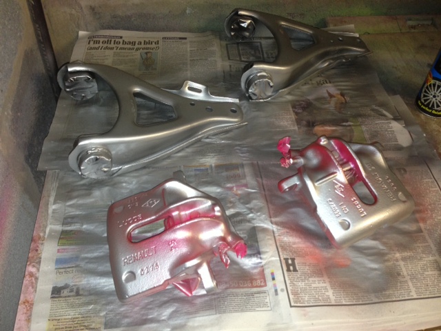

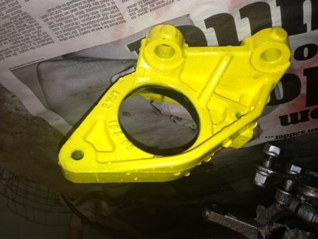

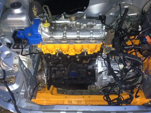

Abit of painting for now until i can get them powdercaoated agian !

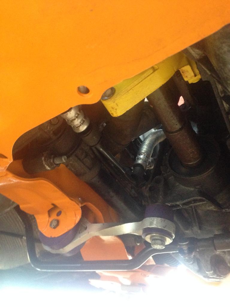

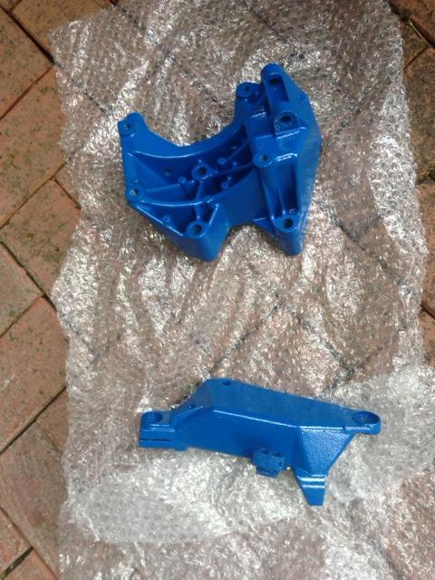

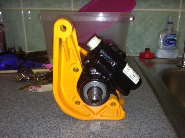

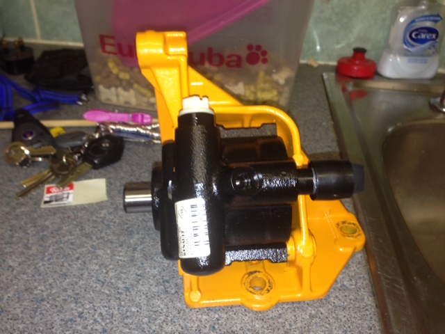

Brand new Renault Power steering Pump fitted to my powder coated bracket

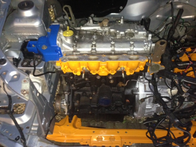

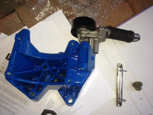

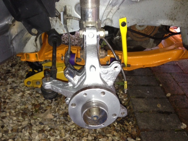

Afew bits i got powder coated from a place in work

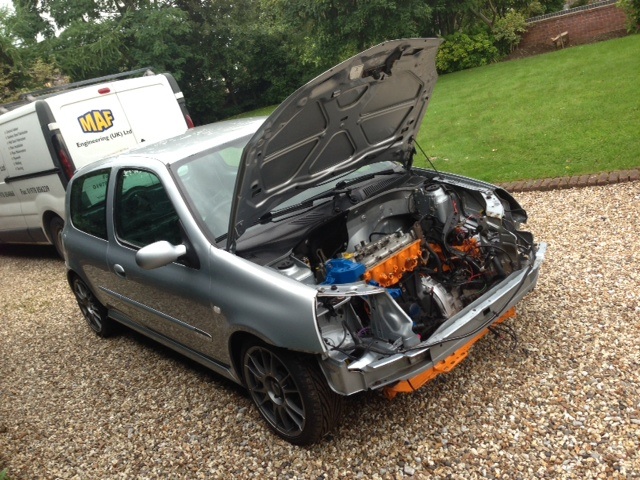

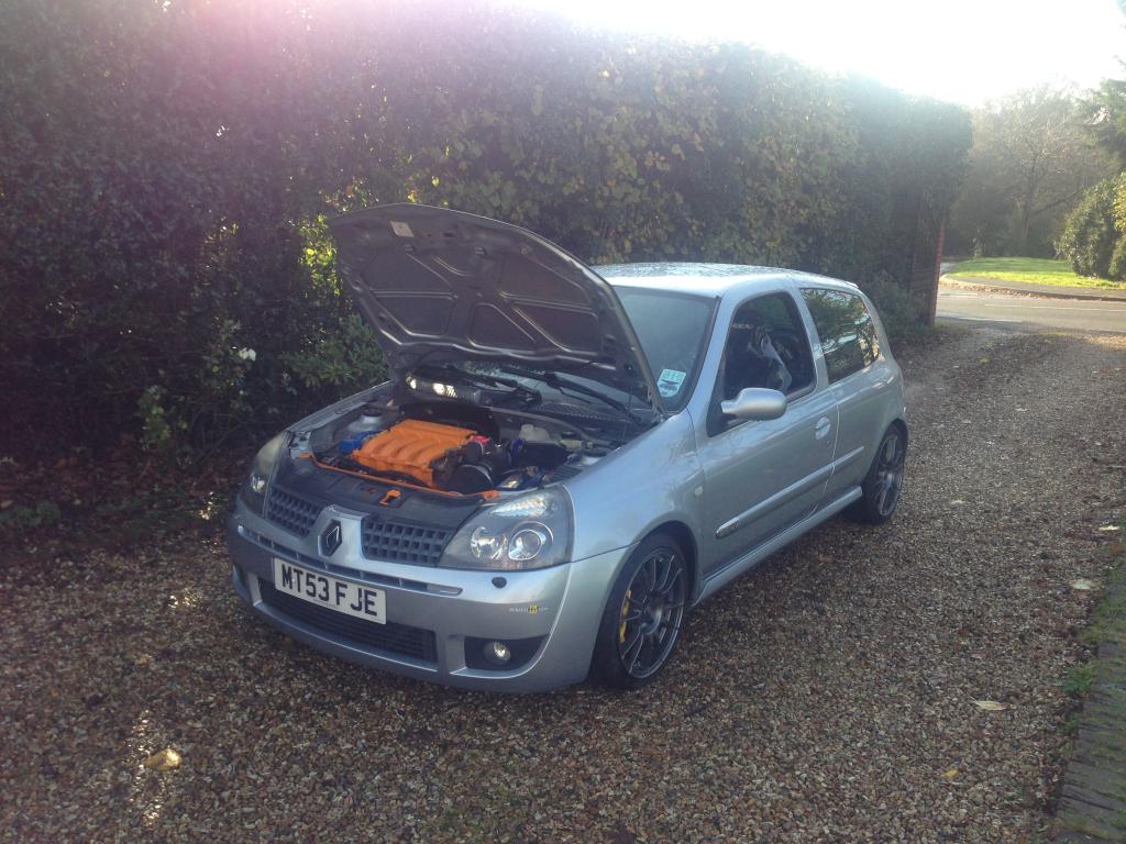

Afew pics of bits fitted

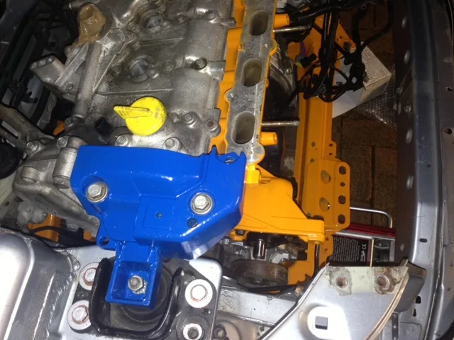

Abit of colour

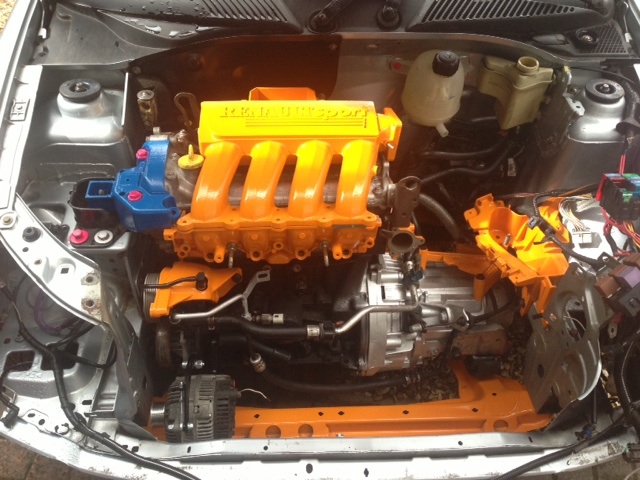

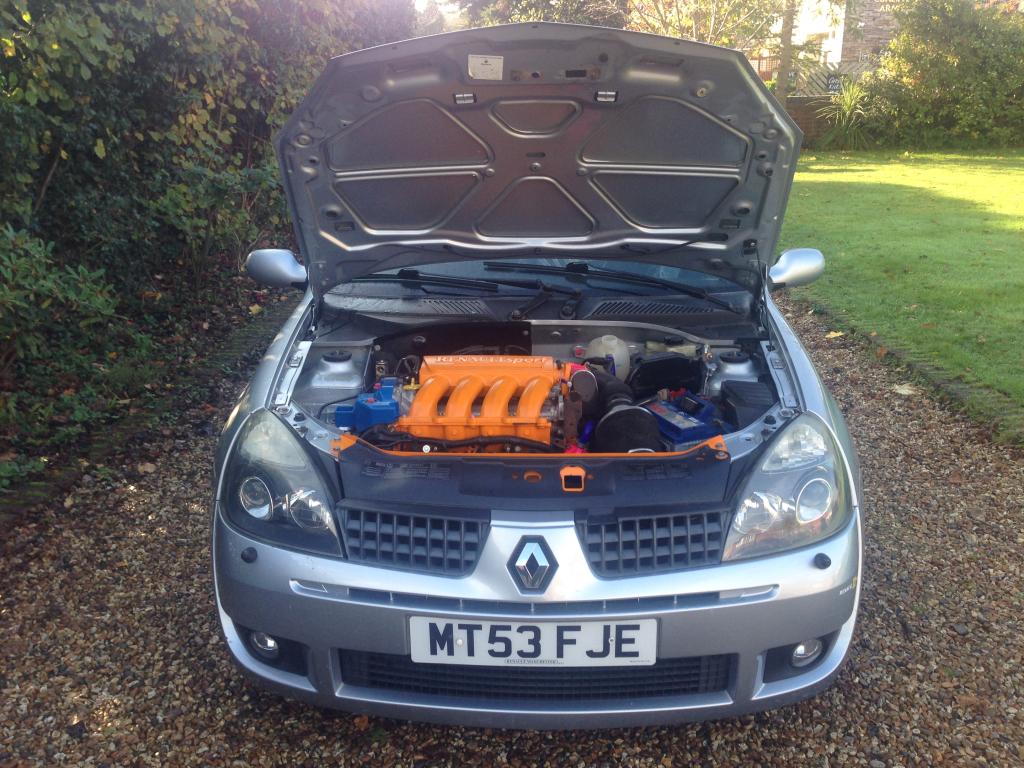

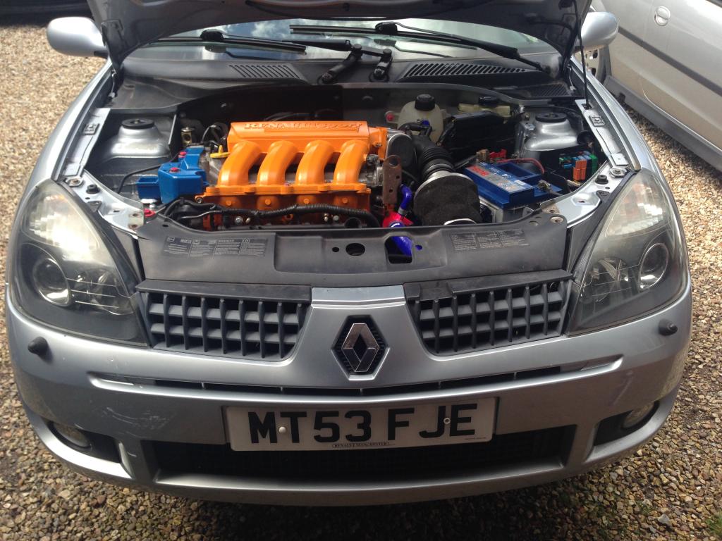

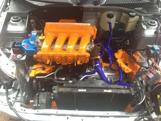

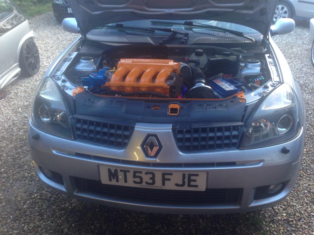

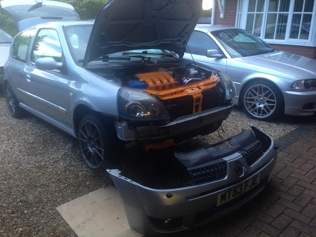

Inlet manifold and expansion tank ans PAS now re-installed , brand new renault pas pump , brand new Renault water pump , new Renault cambelt kit and de-phaser pulley and pure Motorsport air con delete kit .
Forge silicone hose kit fitted up

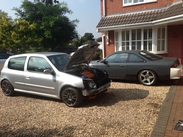

my other project which has taken all of my time up !
Nissan 200sx turbo , Garrett GTX2867 turbo , it makes 380 bhp at actuator which is 1.2 bar and the turbo is capable of 2.2 bar :-)
Is there any plan with the colour scheme of the engine bay or is it what mood you are in? :p
Coming along nicely though!
No real colour scheme.
The pink was just some paint i had left and was bored :-)
Its only a track car so i dont even know why ive bothered powder coating.

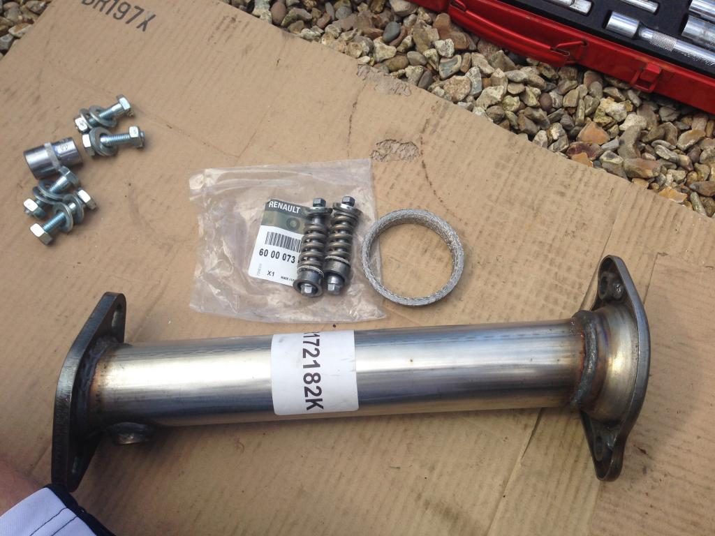

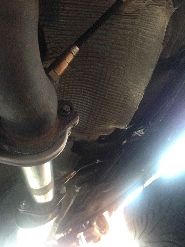

got a 172 / 182 decat so fitted this

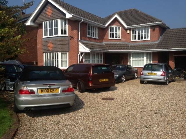

Currently debating whether to keep the car or break it or finish it off and use it on track for abit then sell on as a whole or break it then.
I'm looking to buy a house next year so some of the toys need to go !
I currently have a 400bhp Nissan 200sx turbo
BMW 330ci M sport convertible
Vauxhall Astra Van with a C20XE conversion
An Racing Blue Clio 182 !
I think the BMW and Van are the first to go
