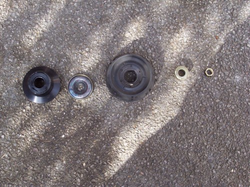

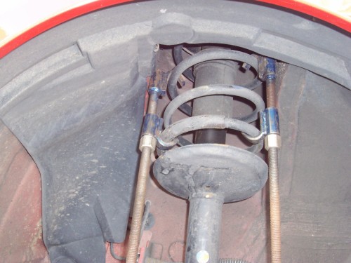

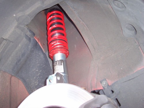

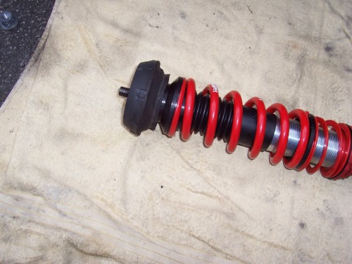

a few pics of when i did my 182...
and like i said you need parts of the old suspension top mount...
maybe the old mk1 172's are different.
as you can see i used spring compressors, as it makes the job easier, and is far safer. You undo the top nut whilst its under compression!!!
