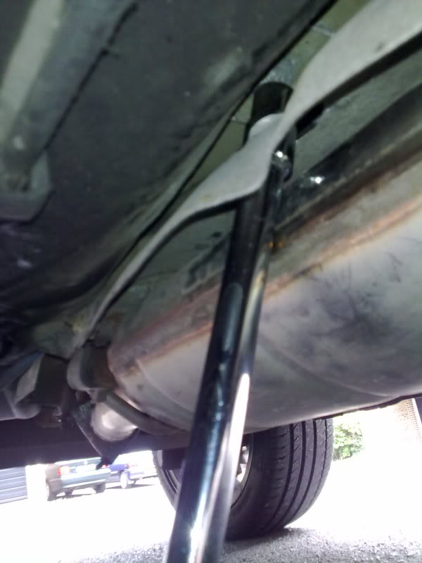

Yeah deffo the bolt, i can get the ratchet head on there, but it wont move over enough to let me get on it.
I'll post a crap picture hang on
Angle you can see here, i cant get the thing straight on so in turn cant undo the bolt :mad:
Is the camera facing towards the back or the front of the car?
Have you got a different cat fitted as my cat doesn't look like that lol?
It's the front seats your removing yeh?
Thats facing to rear of the car and yes my cat is a Janspeed one which i think may be the problem lol
and yes front seats mate
In fact i've just figured it out lol.
Your exhaust has a centre section where as mine is just a pipe :o
Can you not get someone to pull the exhaust while you do it? Maybe slacken off the mounts at the rear too, that will help
that's the centre box fouling your LONG socket extension....
Use a smaller extension, or a wobbler socket to get the correct leverage :)
Or try pushing your exhaust, you should be able to get on the nut it will just be a little awkward.. once you've cracked it they are only finger tight!
Ah ok sorry im not up on exhaust lingo!
I have no smaller extension, only smaller one i have is too small :(
I can move it, but it wont budge more than a quarter of an inch and i need at least an inch to play with :(
lol, so you can't put the scoket onto the wobbler then the extension?. If you not too far away i'm happy to try and push the exhaust out the way!
It takes less than 10 mins to swap each seat over... can you not borrow a different socket extension off a friend?
I fitted my recaros bout a month ago and that bolt made me rage. Like yours you cant even get a good fit to unscrew it, and on top of that the bottom half was rusted
ended up using a spanner and worked it out doing quarter turns at a time. Took ages but I got there
