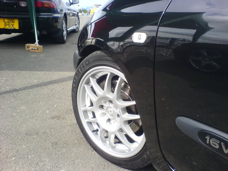

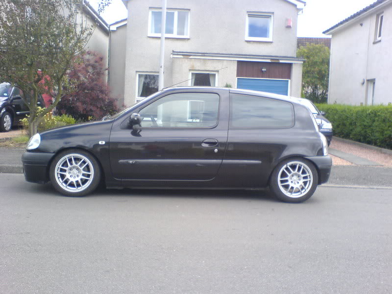

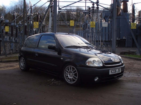

not a 172 but i'll give you my opinion.
Adv:
Corners like a baby!
Looks cool as slammed!
Doesn't scrub with 4 ppl in it even though it's still slammed!
Will make your car so much more driveable, if you like driving hard do it!
Dis:
ball joints and bearings wear quicker
harder to get over speed bumps! :(
Pics:
will post later on
adv's same as above
dis advs same as above but mine scrubs
overall, value for money!
