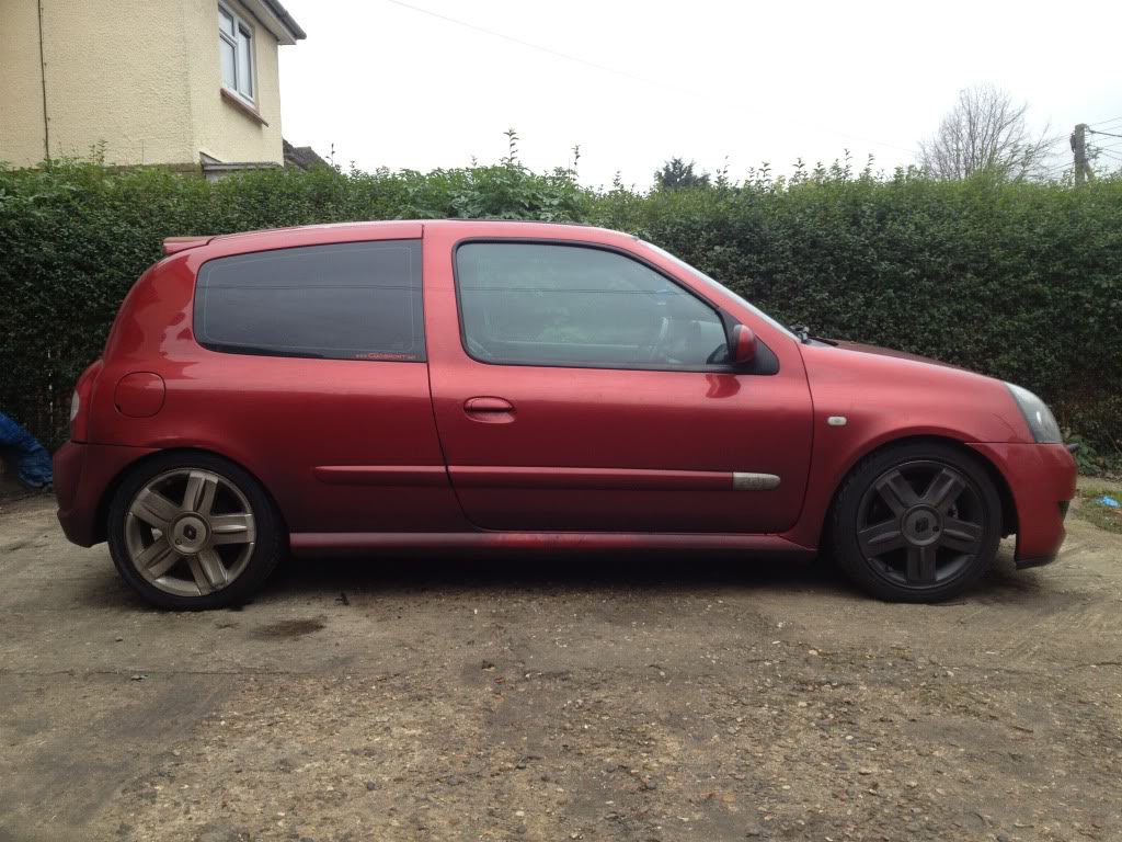

Stay silver on the wheels.
Too late! However I've still not finished them, Lacking time!

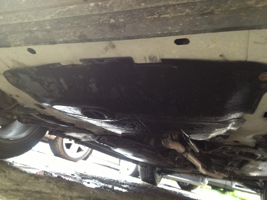

Firstly, Fitted undertay, Non-sports never have them, which I always thought was s**t.

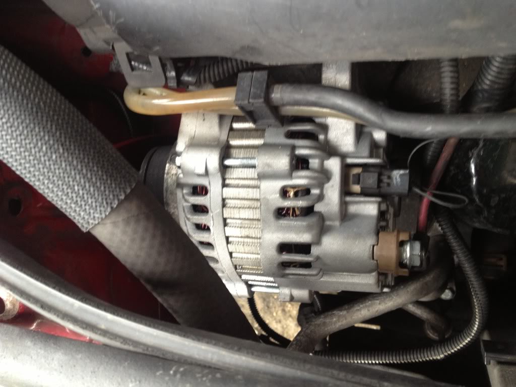

Had a slight issue with charging, so new alternator, and new terminal (heavily corroded), Along with new aux belt kit.

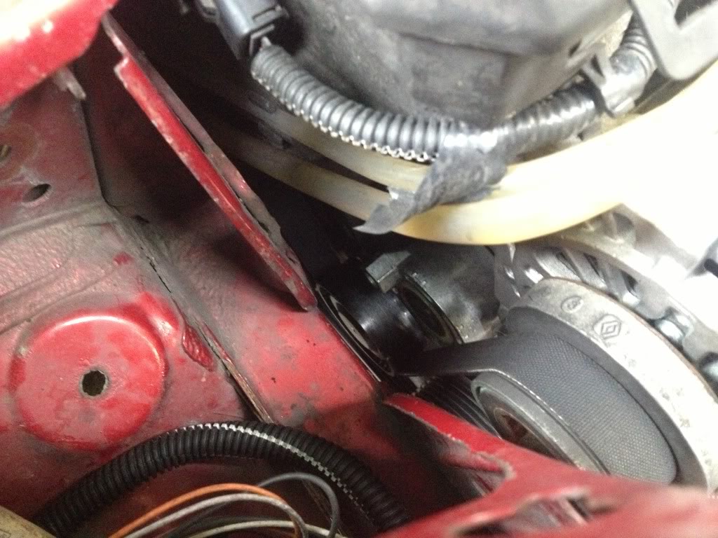

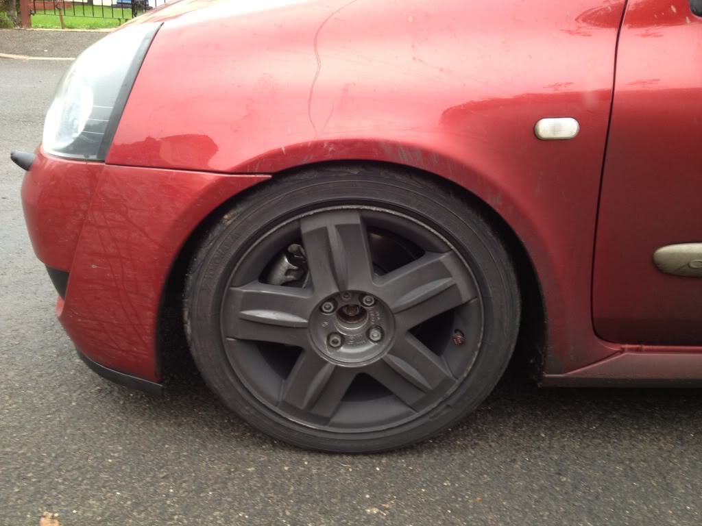

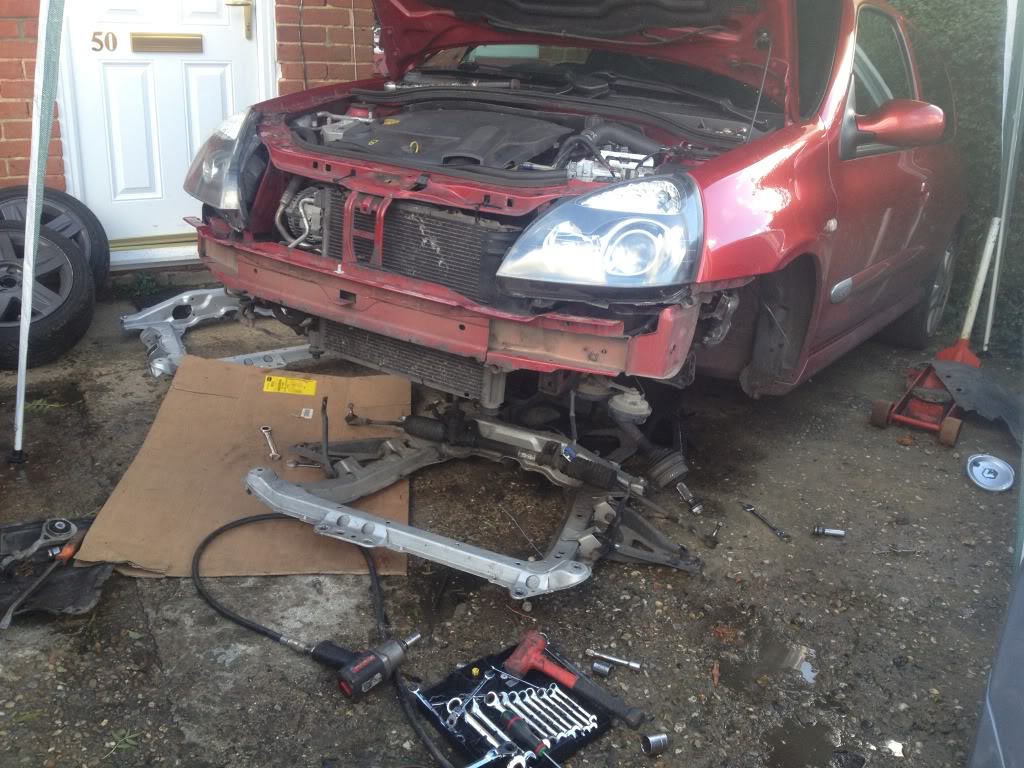

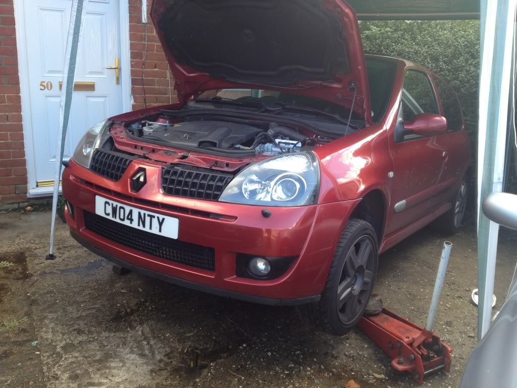

Ever since fitting the wide track, I'd noticed the drivers wheel to sit further back in the arch, tracked this down to be the subframe. Decided, after work one day to change it...
Stripped, only took about half an hour
Finished it quickly, wheels now sit correctly...

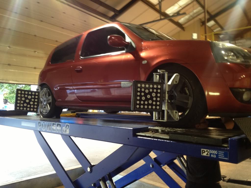

After having it all apart, and now the wheels sat correctly, took it to get it tracked... Now drives spot on.

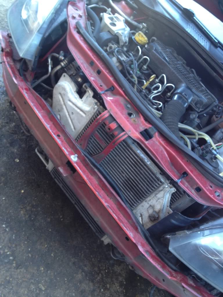

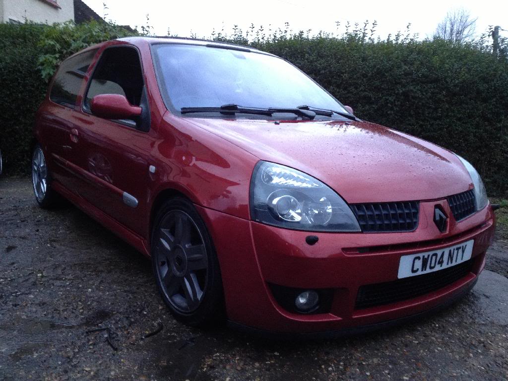

Fitted an 80 intercooler, Mainly to stop the boost leak I've had for ages, has made it maybe 1mph faster, Mostly due to no boost leak!

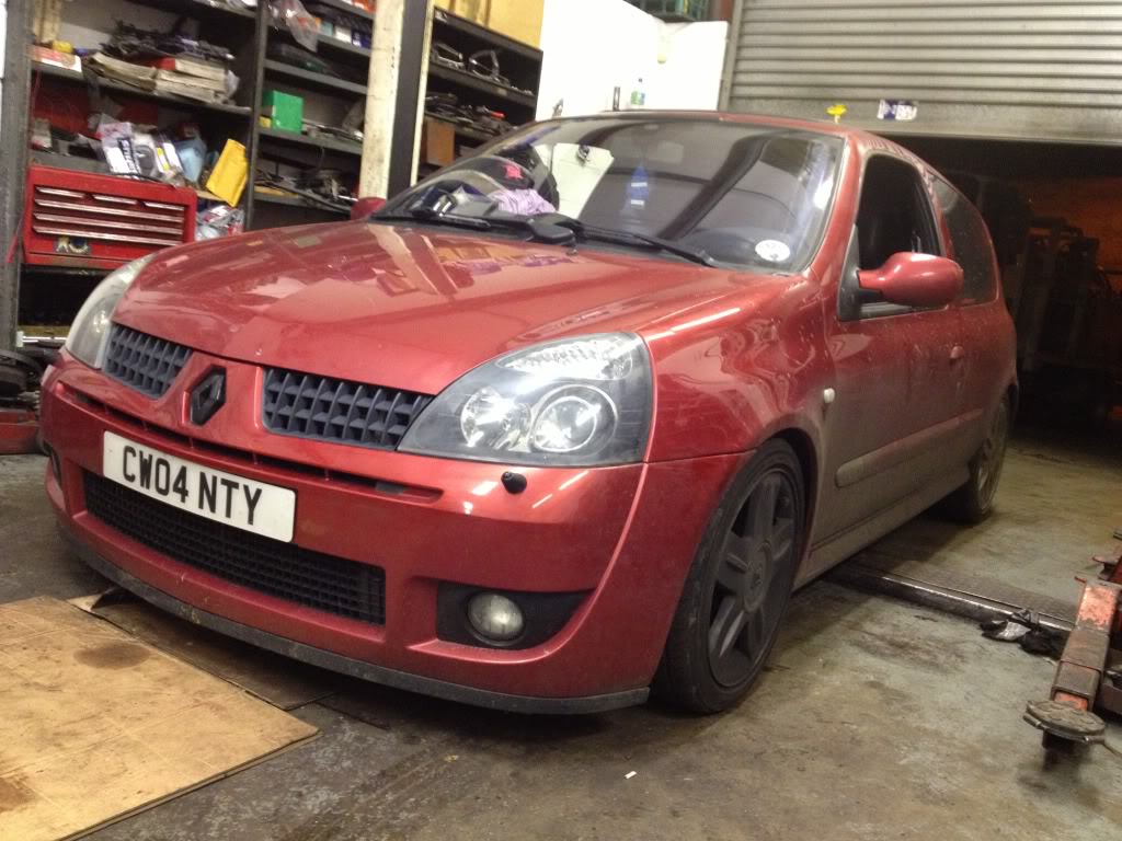

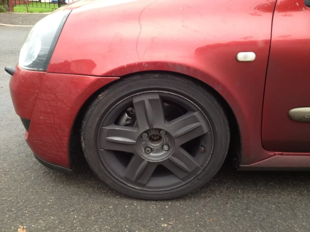

Today, Coilover time!

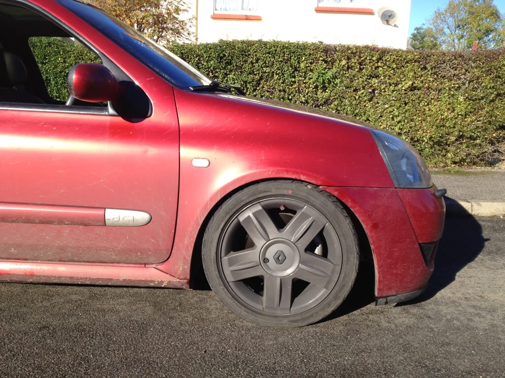

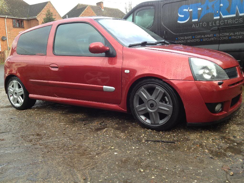

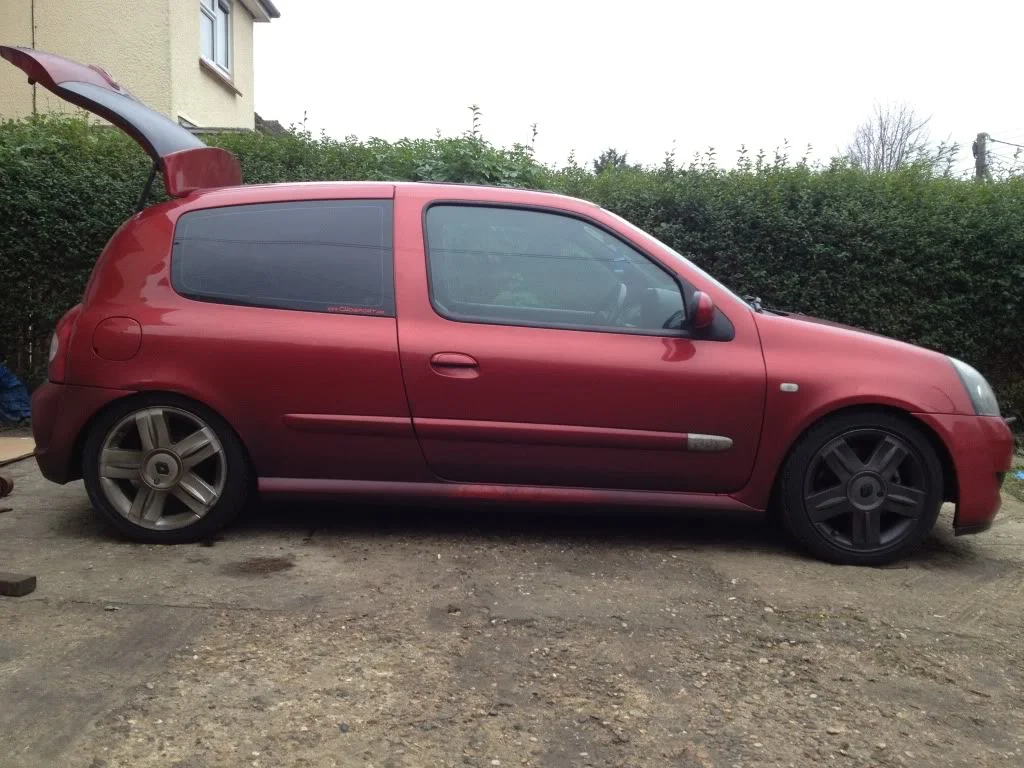

Before height....

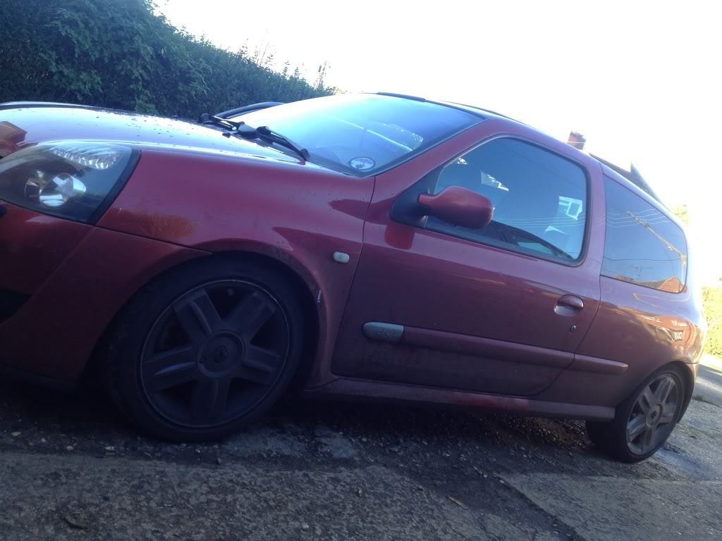

After, Front only, This is about as low as these will go, not low enough tbh!

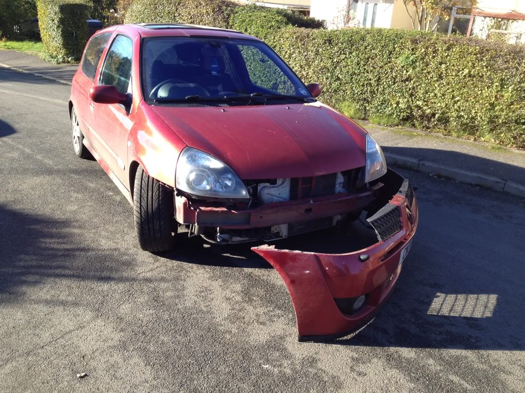

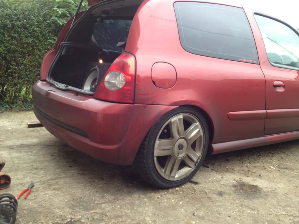

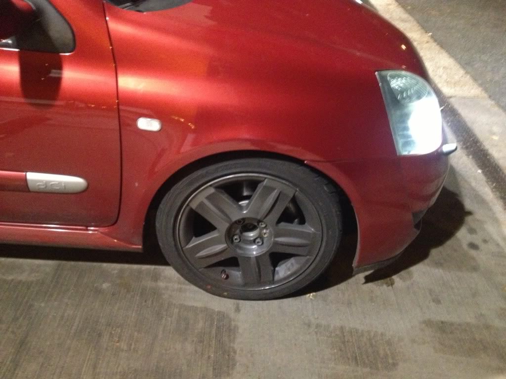

Wound it up a little, reversed off the drive, heard the bumper scrape and thought it was a bit louder than normal, Jumped out the car, errupted in laughter.
Returned it to shocks and springs for a few days until I get some camber bolts to rectify it, as the GAZ don't have the same amount of camber, causing the wheels to rub on the wings, Plus I need it to be lower!

That bumper picture made me laugh.
It made me and Paris laugh very hard. Quick release bumper!

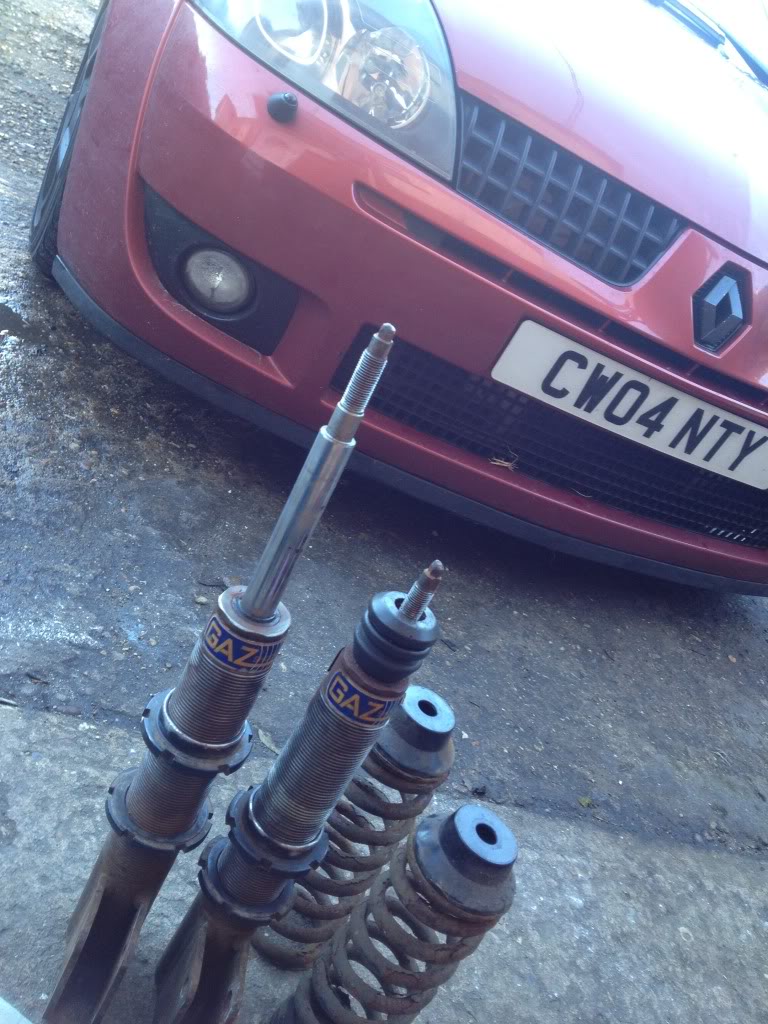

So, Started the day like this...
Coilovers fitted on the rear first..
Then refitted the front coilovers....

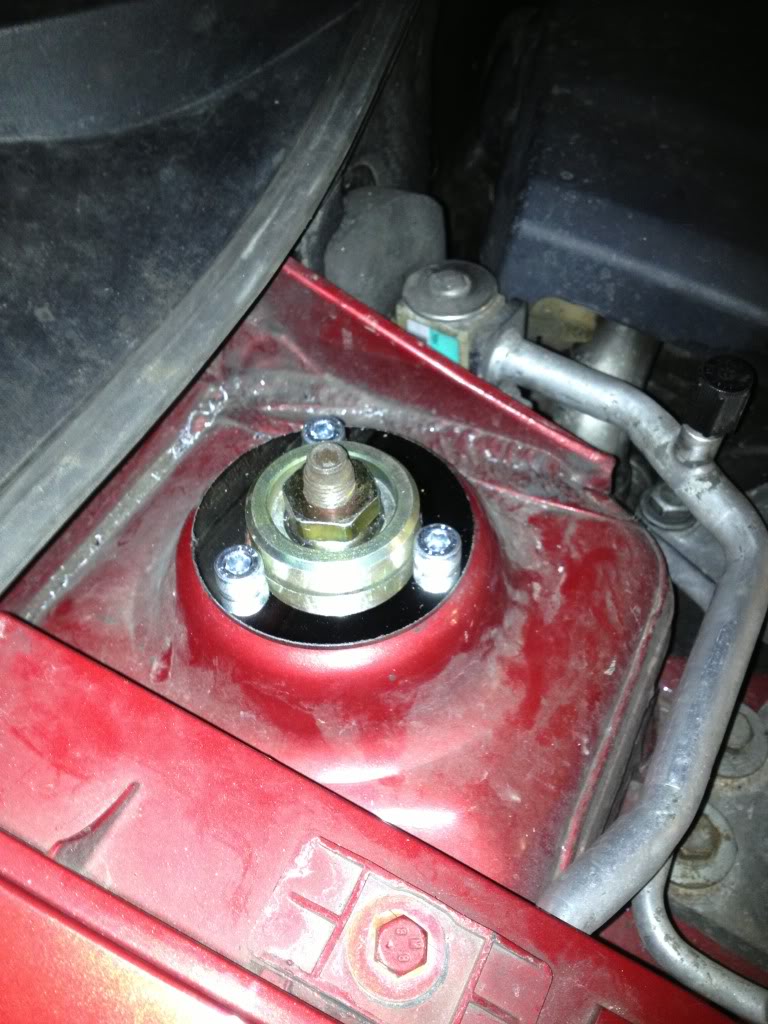

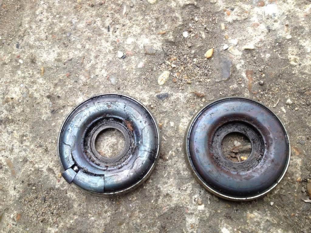

While I had it all apart, changed the top mount bearing for a used spare one I had, as I've smashed a fourth one in 6months. Solid mounts coming soon.

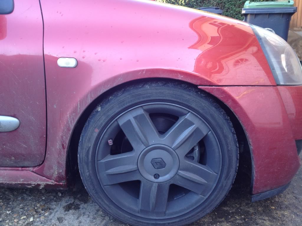

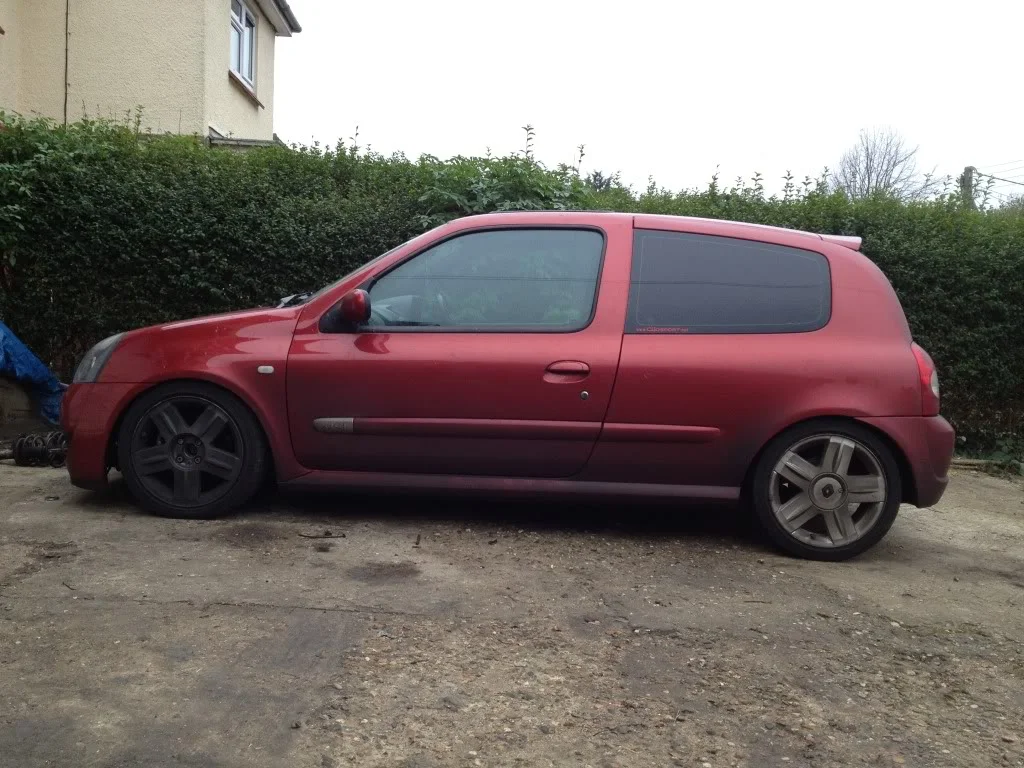

Still not as low as I'd like really, but its as low as it can go really. Just need to do the tracking tomorrow and bent the bumper bracket as it rubs.
Still don't love it either, another reason for going this low, as I don't care if it gets fucked now!

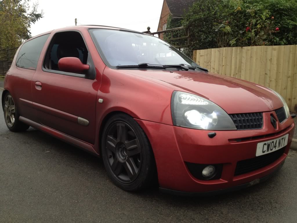

Took the coilovers off, Was too harsh for my daily use and it just annoyed me tbh. So now back on the old shocks and springs and the coilovers are up for sale once they have been refurbed.

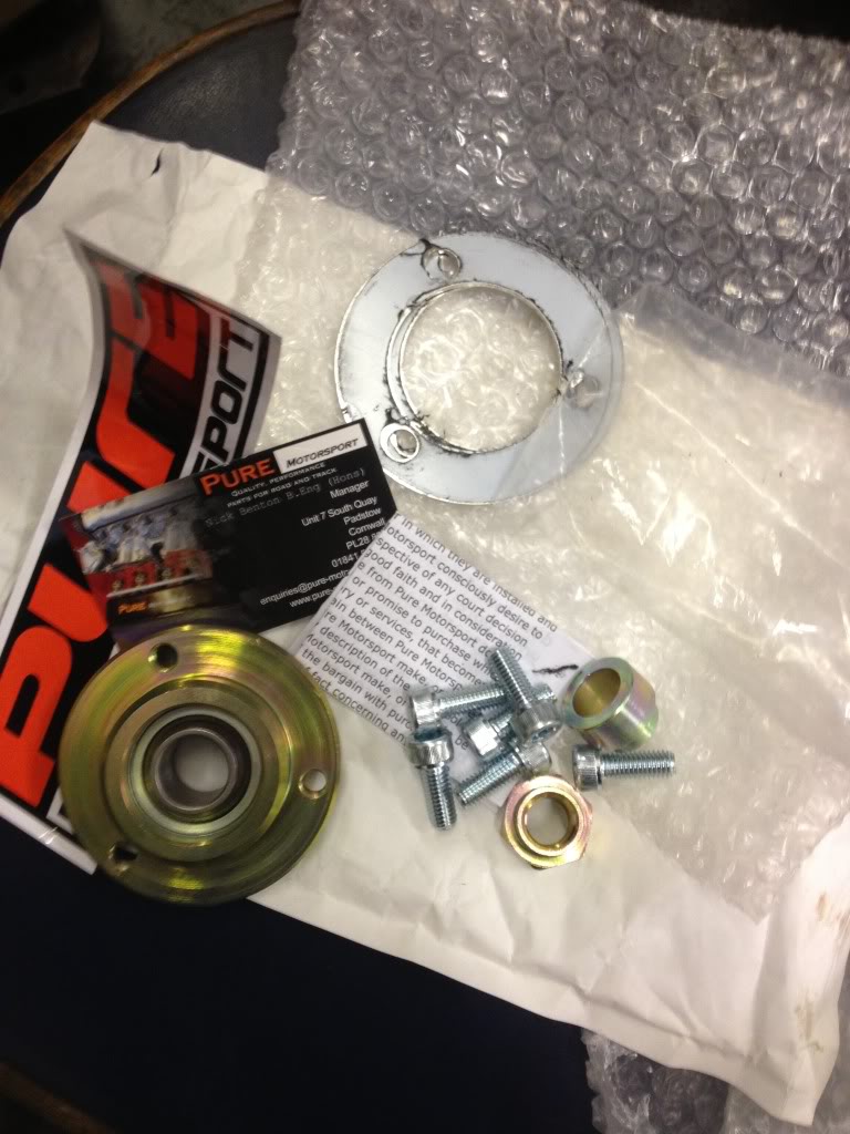

In other, better news, these turned up the other day...
Fitted to shocks..
Then, after a bit of f**king around drilling, fitted to the car..
Can feel some more smaller bumps, but steering is improved for sure, Mostly glad to know I won't be smashing the standard bearings every six months though.

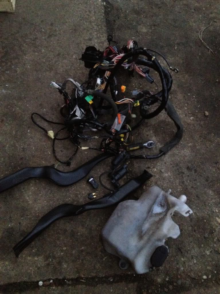

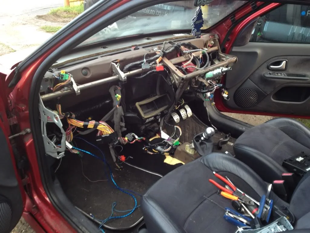

Changed the dash loom again, now everything works (Auto headlights didn't work as the loom I fitted was missing it), Also picked up twin pump washer bottle and a couple of other bits.
Actually had the seats and carpet out too but no pics of that as I just wanted to get on with it.

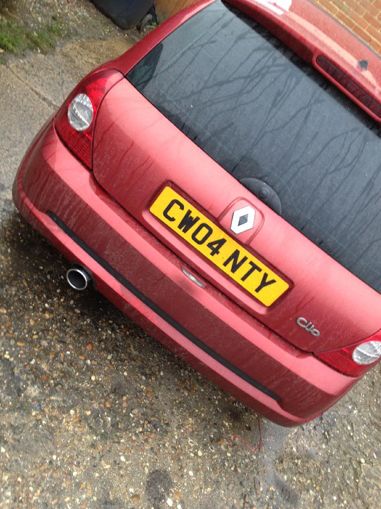

New 3" exhaust tip turned up, this will be recessed into the bumper, using a 182 exhaust surround.

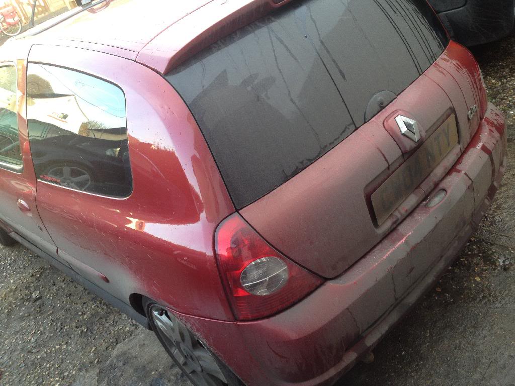

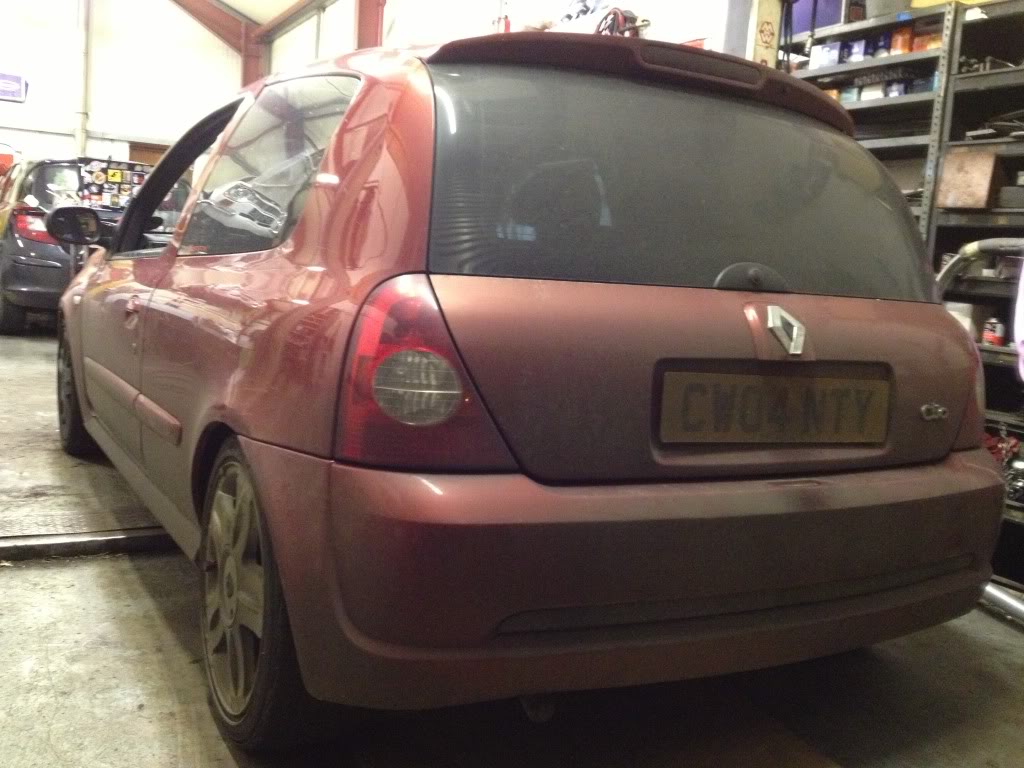

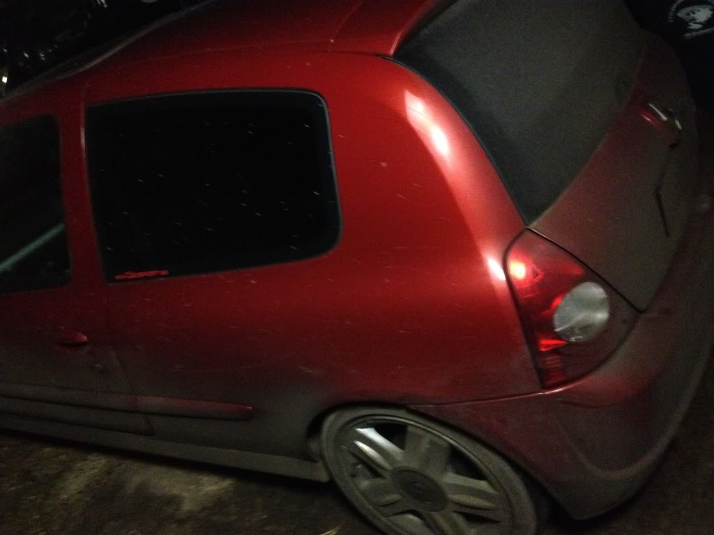

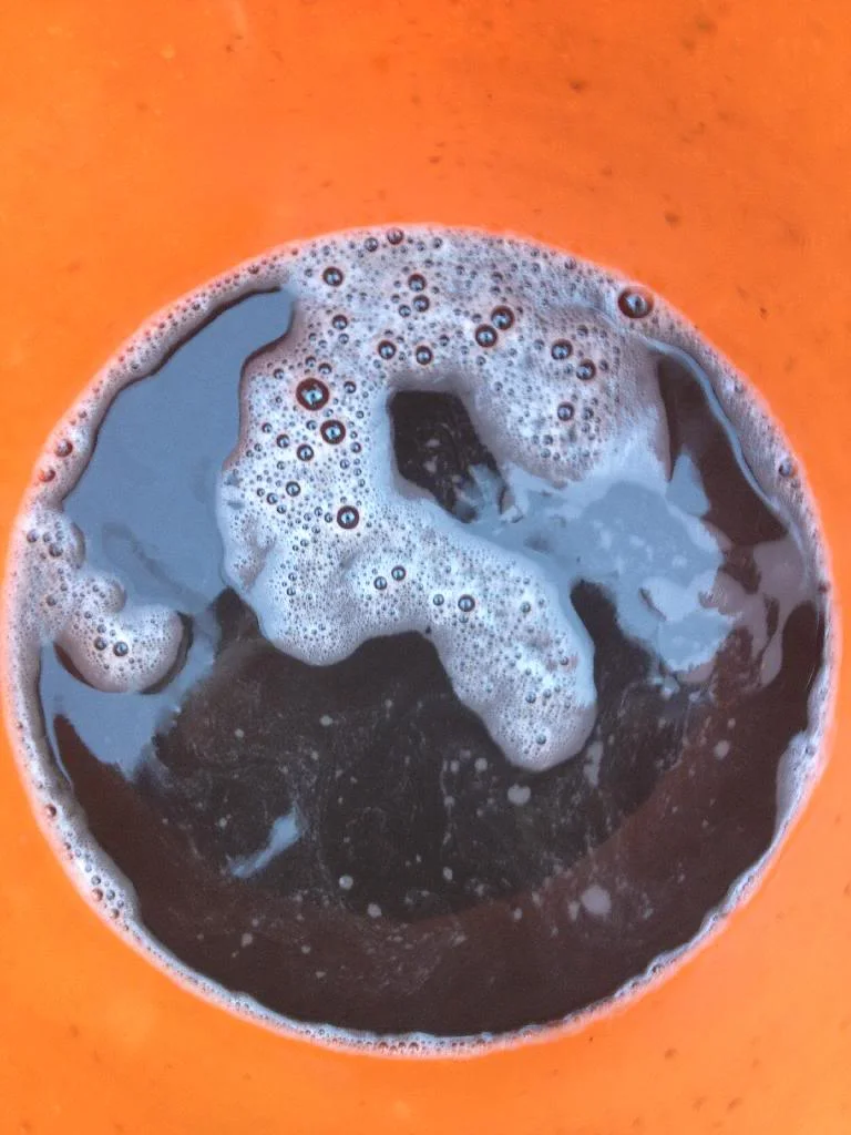

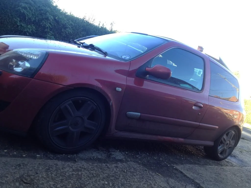

I washed the car poorly last weekend, since then its had a lot of use, and a lot of dirty back lanes, so was in a bit of a state...
Colour of the water from just the upper panels. Wheels were removed, arches jet washed and wheels cleaned & sealed. Also fitted both front arch liners at long last.

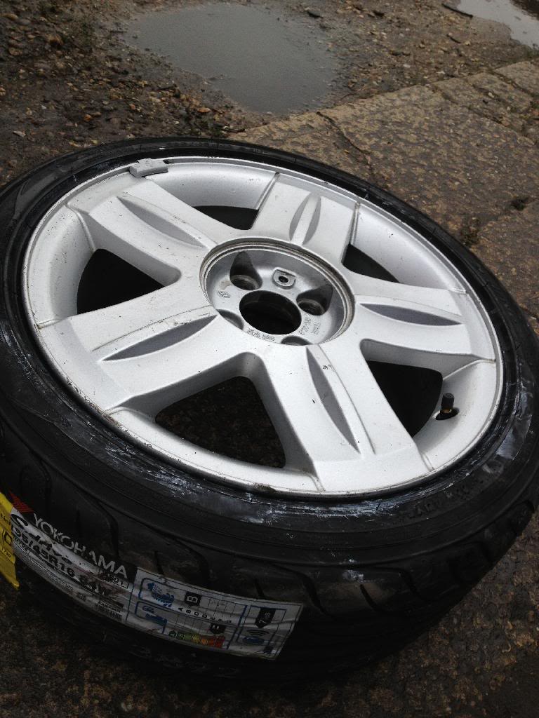

Also fitted my new rear tyres while the wheels were off..
Nice and clean, although now its easier to see I haven't got around to painting the rear wheels, Will get on this ASAP.

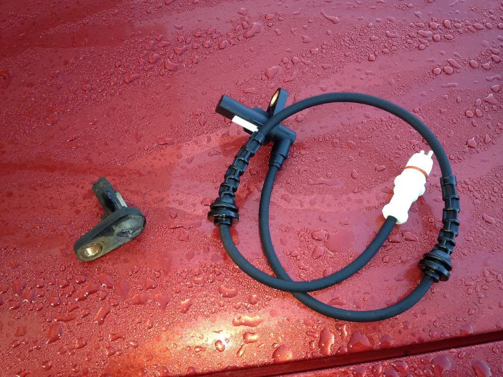

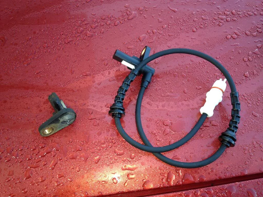

Firstly, changed the N/S ABS sensor after I smashed it changing a CV boot the other day. Also plummbed up headlight washers (fitted tank etc a week or two ago)

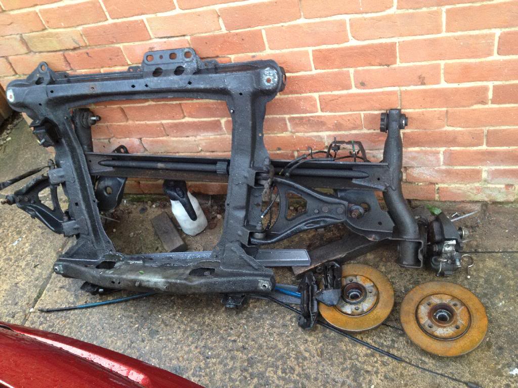

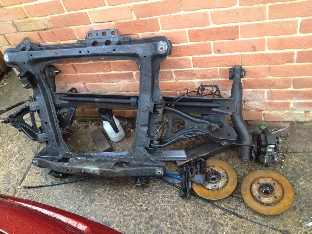

Last night I had a few bits delivered to me from another CS Member, Subframe, 182 Cup Wishbones, Complete disc rear beam inc handbrake cables, discs, pads etc, Renaultsport Sill Trims and a couple of other bits.

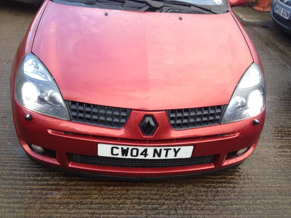

Programmed Headlight washers into the UCH, I added the wiring (from bulkhead to bottle) when I fitted the bottle etc, It was already on the dash loom!

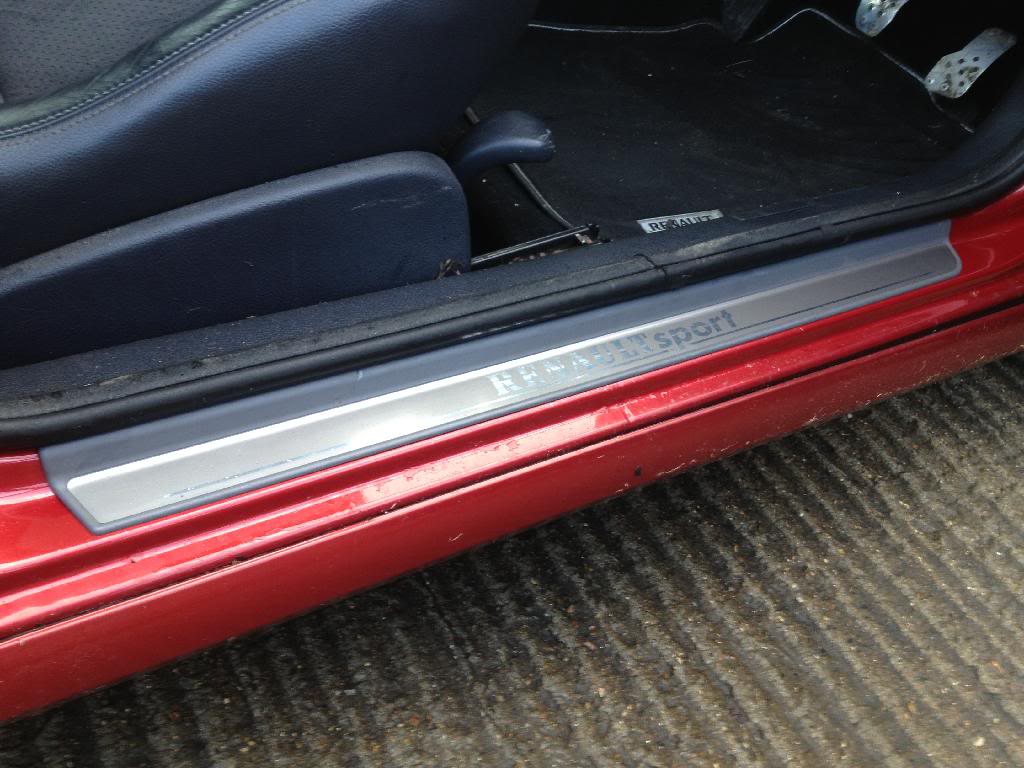

Renaultsport Sill Trims fitted!
I do now also have working Cruise Control, Just need to program the Dials, which is being harder than expected.
Also Today was its MOT, was worried about a couple of things, but flew through, no advisories or anything!

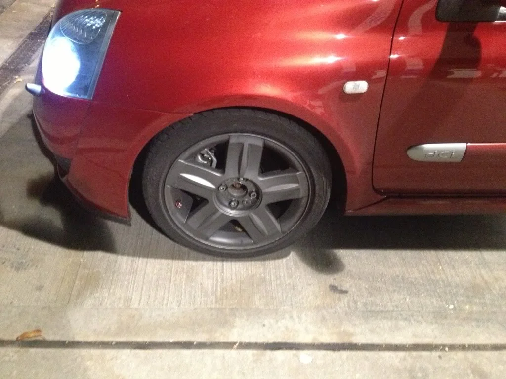

Next plans are to finally refurb and respray the rear wheels, fit the bits I recently bought, smooth rear wiper panel, and then get it in for respray, although some saving to be done first!
Leave the wheels silver!
And honestly fella it sits perfect as it is - you should be happy with it!
You've said that before lol, I like the grey, I do also the silver I admit but we'll see.
I am quite happy with it, Needs a few more bits before I'm perfectly happy with it, but its a huge change from the standard car I started with in January.

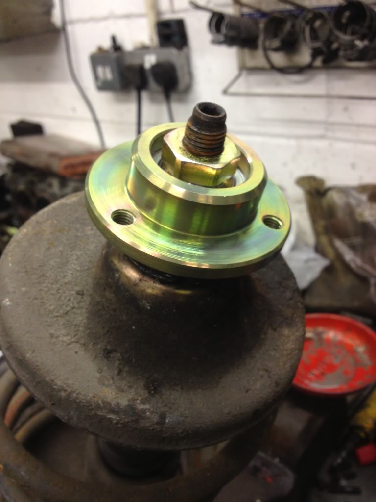

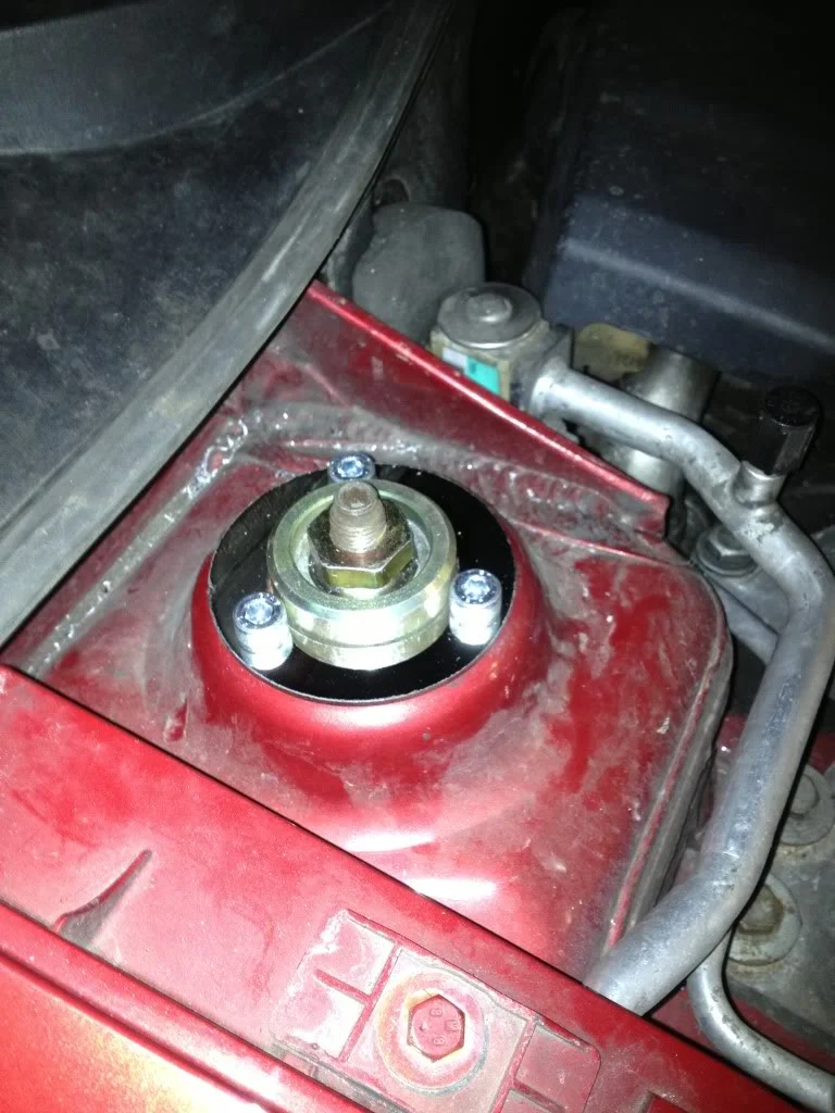

With your top mounts, I thought the plate was meant to sit under the strut not on top?
I still have that exhaust surround for you pal sorry. I can send it this weekend?
Nope that's how they are meant to be, silver bit tidys them up, putting it under the strut would make the car slightly higher too.

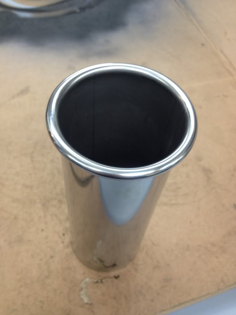

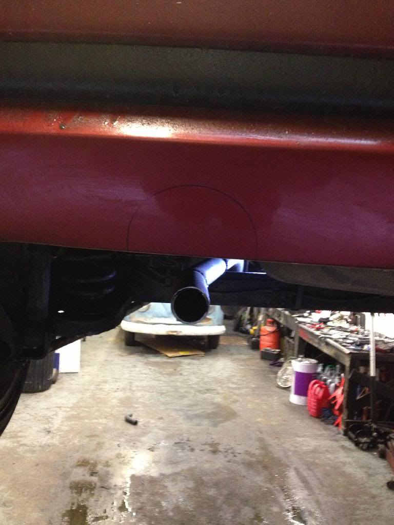

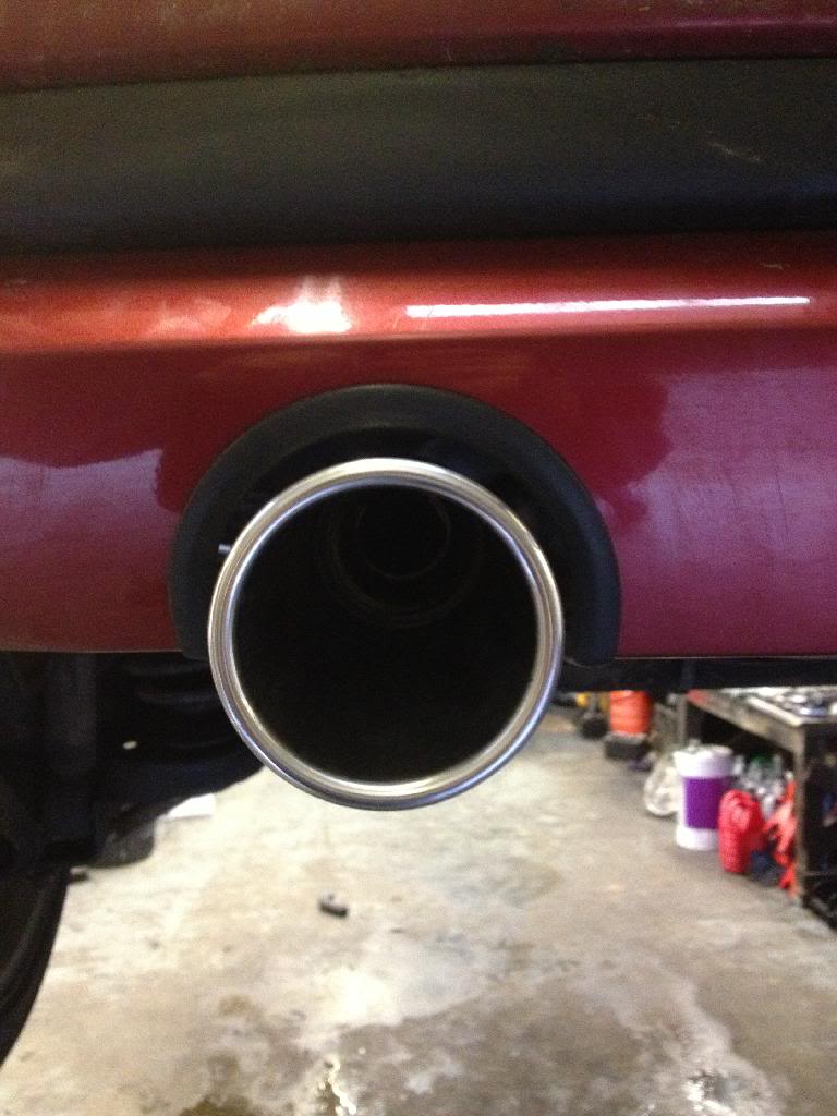

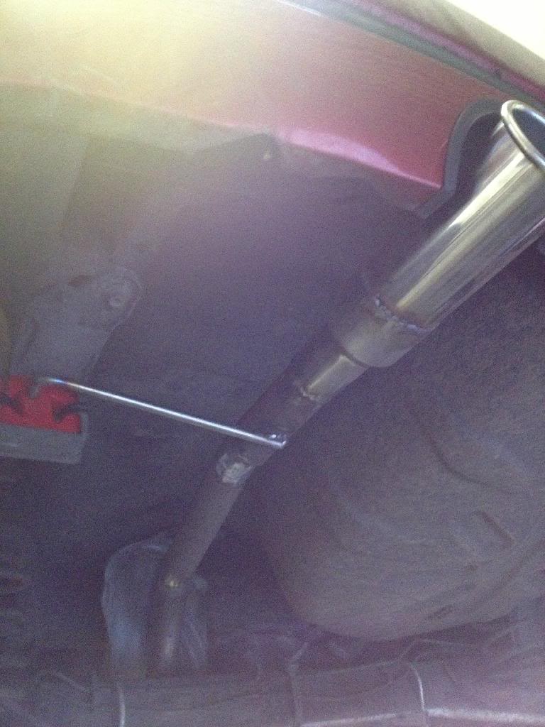

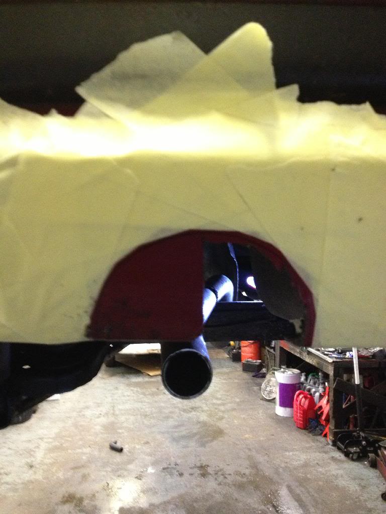

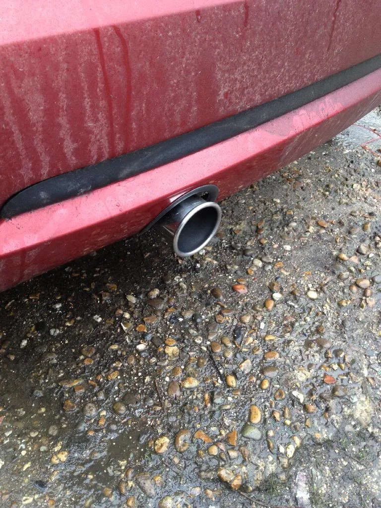

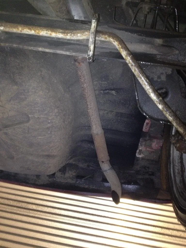

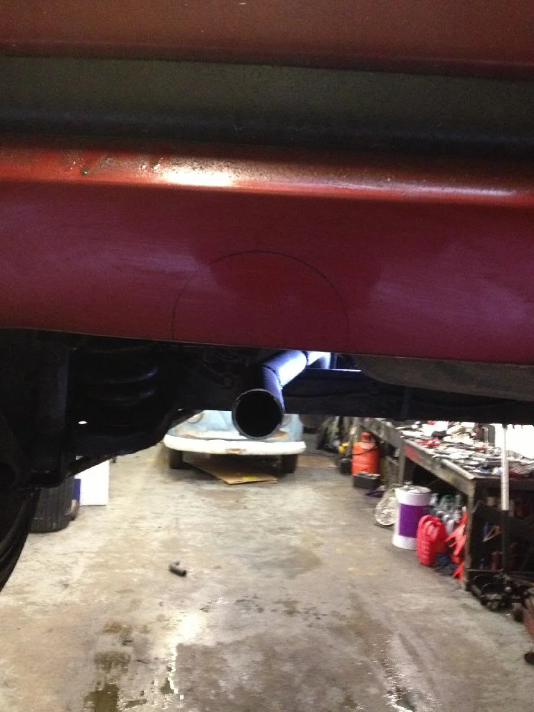

As I posted a while ago, I bought a huge 3inch exhaust tip, Well finally got to fit it all today!
First up, what the old setup was like, Bodged together quickly when I cut the backbox off a few months ago.
Cut the old downward pointing tip off, then marked the bumper using a 182 exhaust trim
Masked up and half cut out
Then welded on the adaptor, three inch tip and hanger (poly mount used!)
Finished tip
Its good enough for me, Its perhaps a little too far to the right, but was the best way to do it as far as routing goes.

Looks good Alex, outwards rolled tips suit the Clio but rarely seen
Does look awesome, I'm not a huge fan of inward rolled, I don't think it would have suited it in this case either.
haha looks like mine :D . same tip and adaptor to old exhuast pipe, accept i havent got a trim :(

I need to make a cut out in my bumper, how did you go about cutting it?
Got the trim in place (bare in mind it wont fit up flush until you cut the bottom out of the bumper) marked it up, cut it out with an airsaw and then filled it until it fitted perfectly. I'll probs need to modify it to fit the carbon surround I have coming as the plastic standard one flexes.
Hope that helps.
