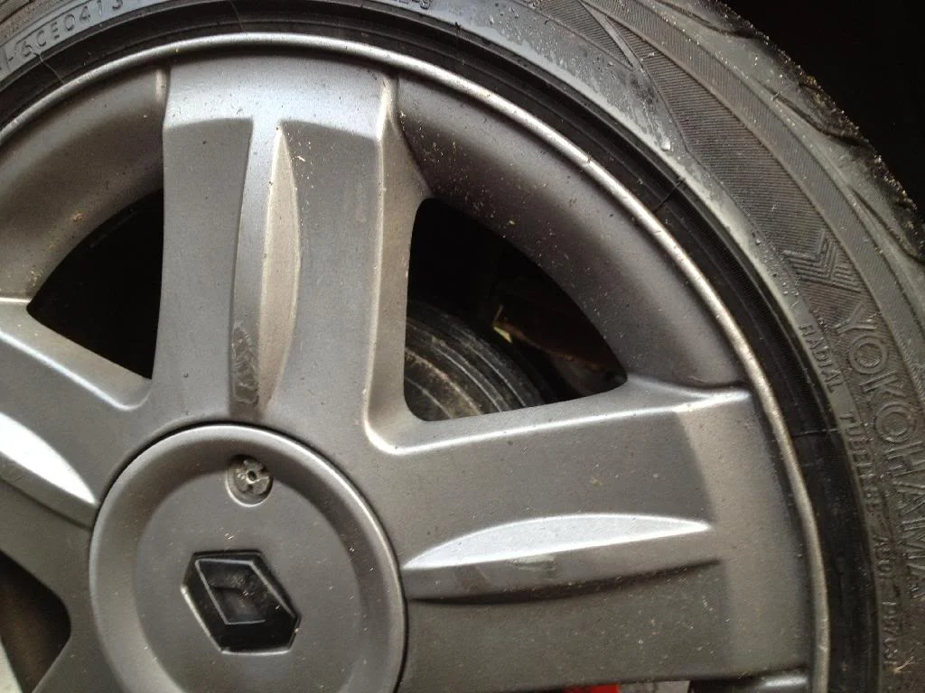

Great thread. Just read through it.
Im on team silver wheels though.
Look 10x better than that anthracite / dark gray. :)
  Many.
Cheers very much buddy. Yeah I'm now decided on Silver wheels, One of the grey will become a spare (although planning to repaint first) and the other I'll keep as a spare somewhere. Need to find another Silver wheel!

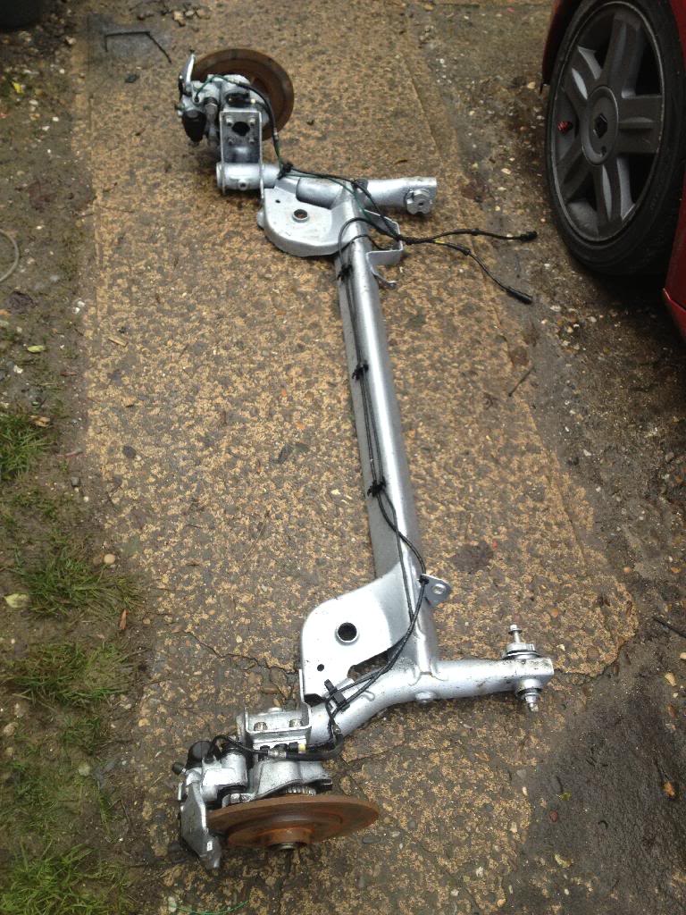

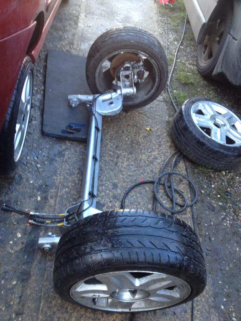

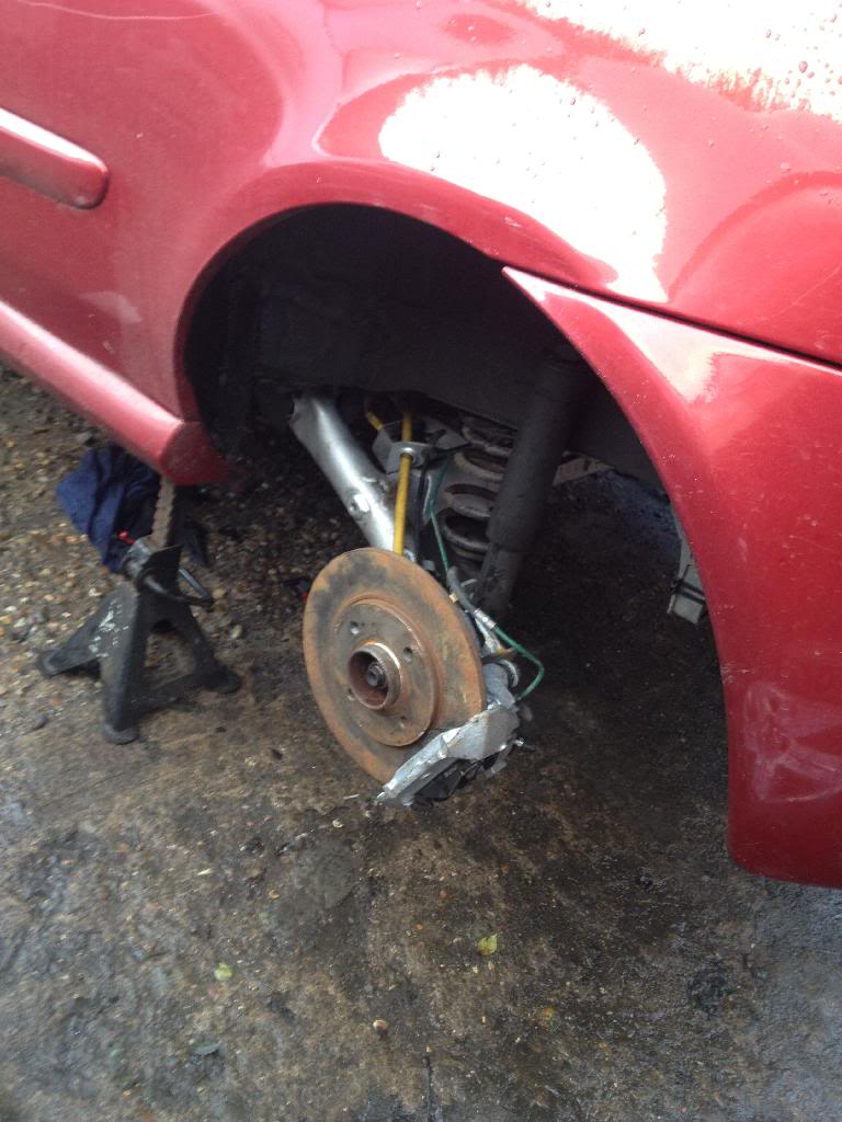

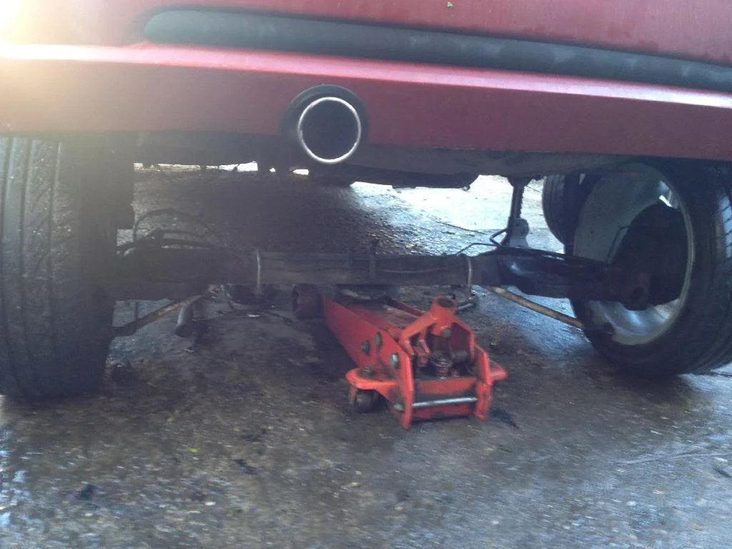

I looked at the rear beam again, and then looked at my car, followed by a huge grin on my face. Decided to fit it, there and then.
So......
Bye bye to these!

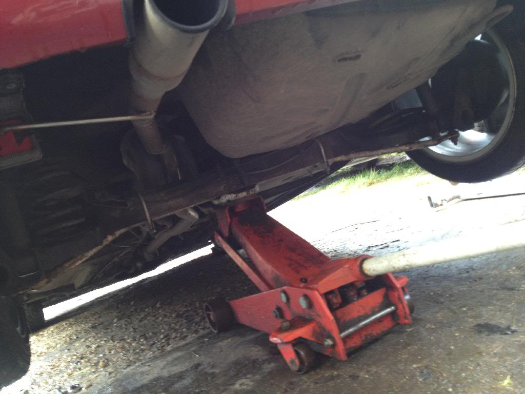

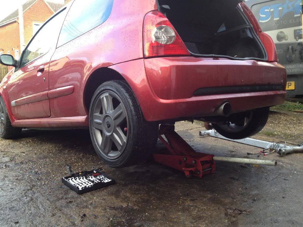

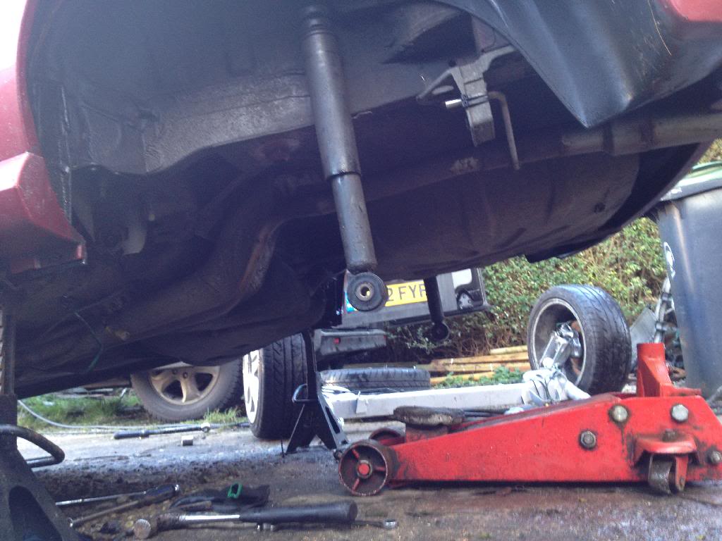

Springs and shocks dropped, handbrake cables removed, ABS sensor wiring removed, Pivot bolts removed, and then the brake lines
And gone!

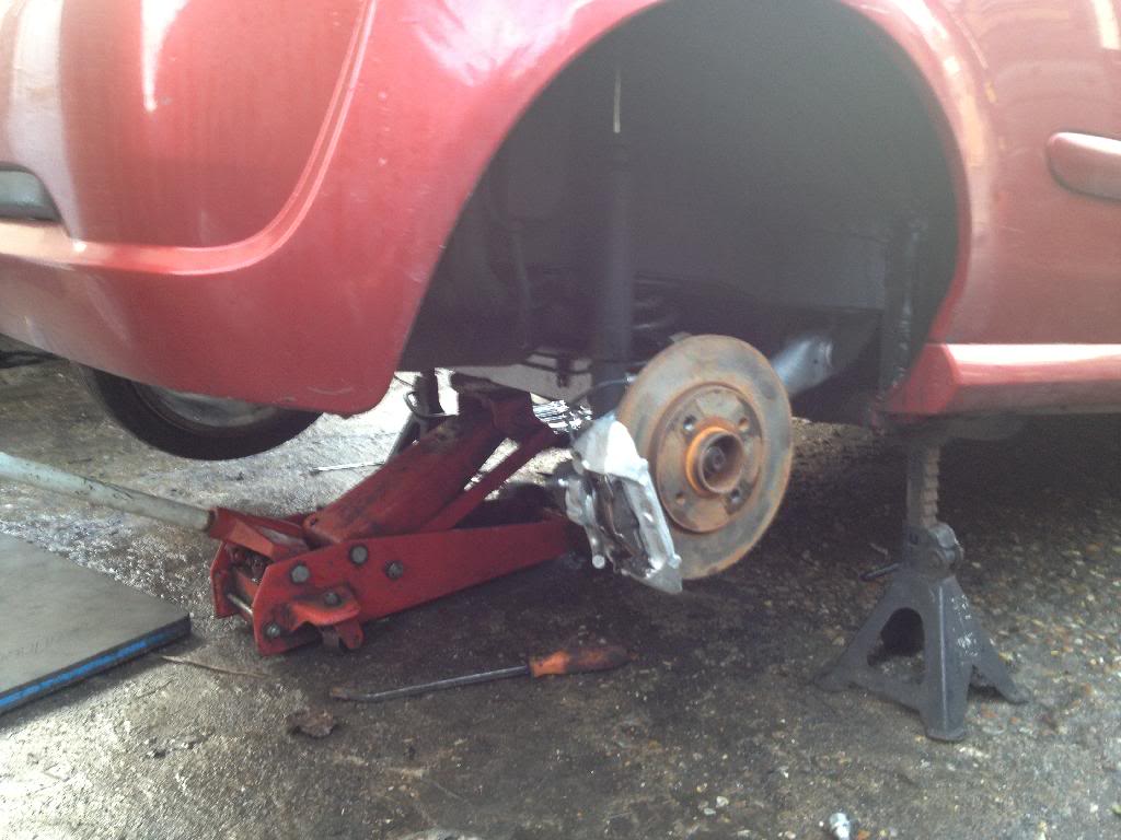

Fitted braided lines to the beam, and a pair of wheels so I could just roll it in
Pivot bolts in, brake pipes connected, Springs refitted, shock bolted up
Done!

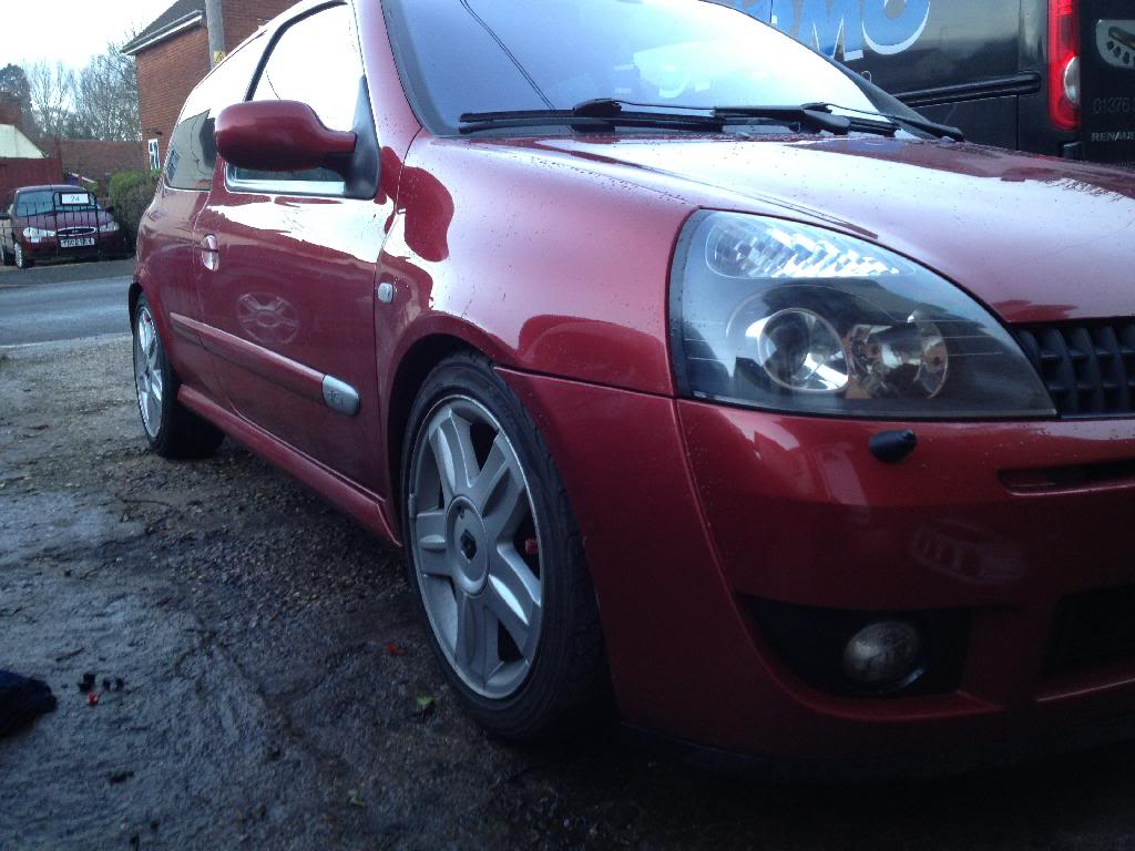

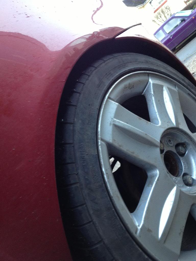

Fitment is sooo much better, but thats also due to 10mm hub spacers I got off Dmallet ages ago!

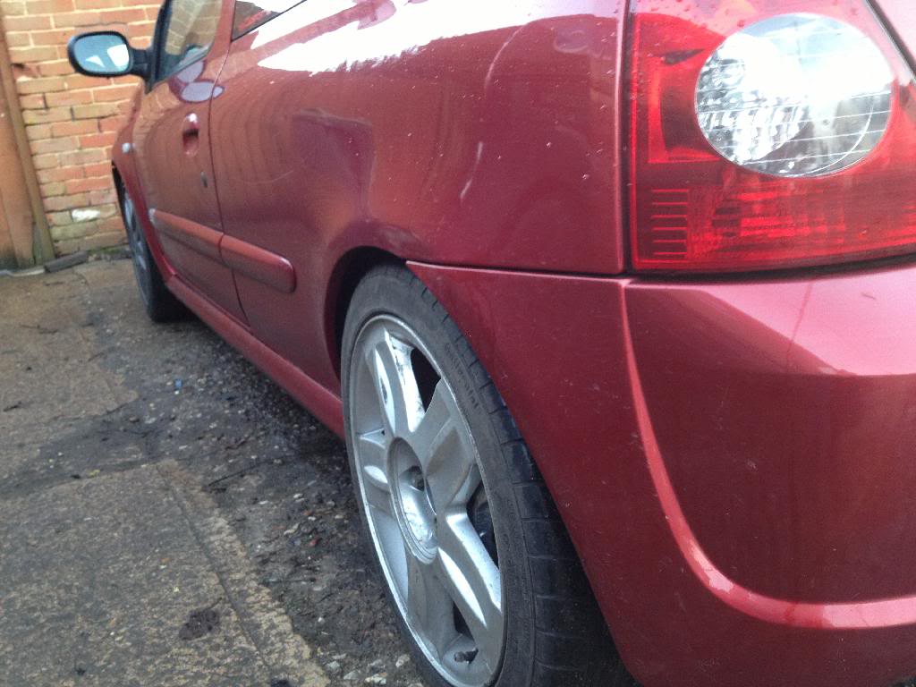

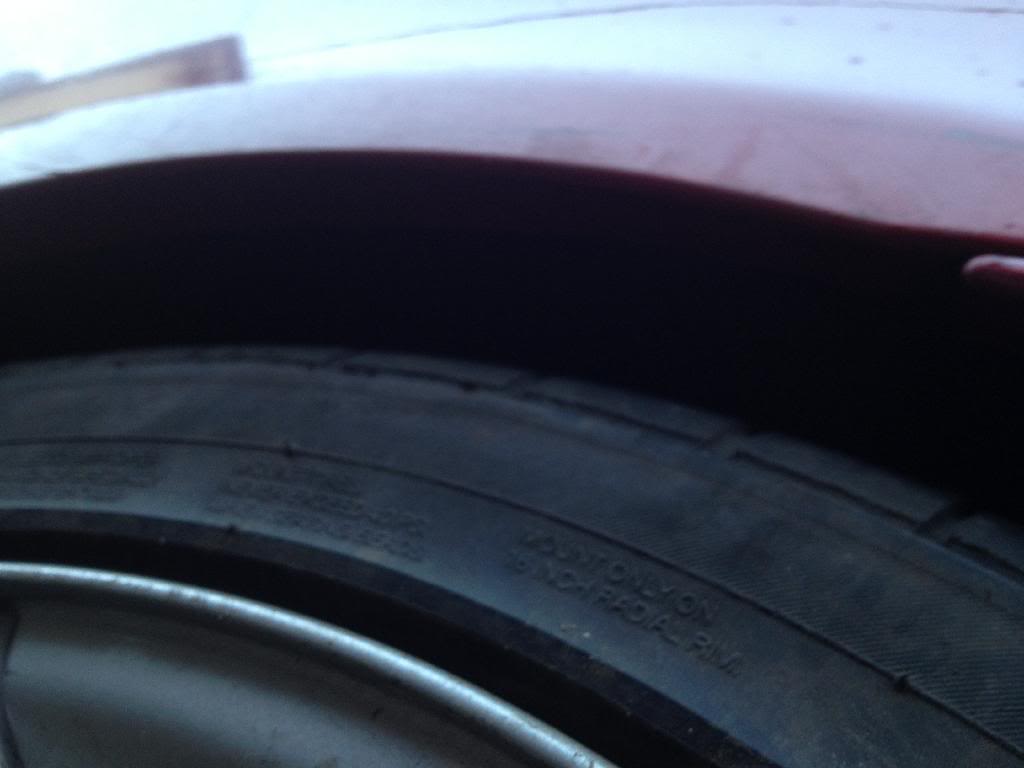

This picture is terrible, but you can just about make out the arch lip, which being a non-sport, isn't rolled, so I'm borrowing an arch roller off a mate to roll them slightly, not looking to go completely flat with them, just a little roll, much like a sport.
Only problem is now, the front needs more spacing and it already has 25mm fronts!
On the test drive, the brakes are sharper, most likely because there was some air in the rear system before, and bleeding has removed that, I could do with bleeding the fronts again now. As I obviously haven't changed the MC or servo yet, I'll see how it goes with this MC and then perhaps change some point soon.
All in all, a good Boxing days work, Gearbox removed from the Iceburg 172 and now this.

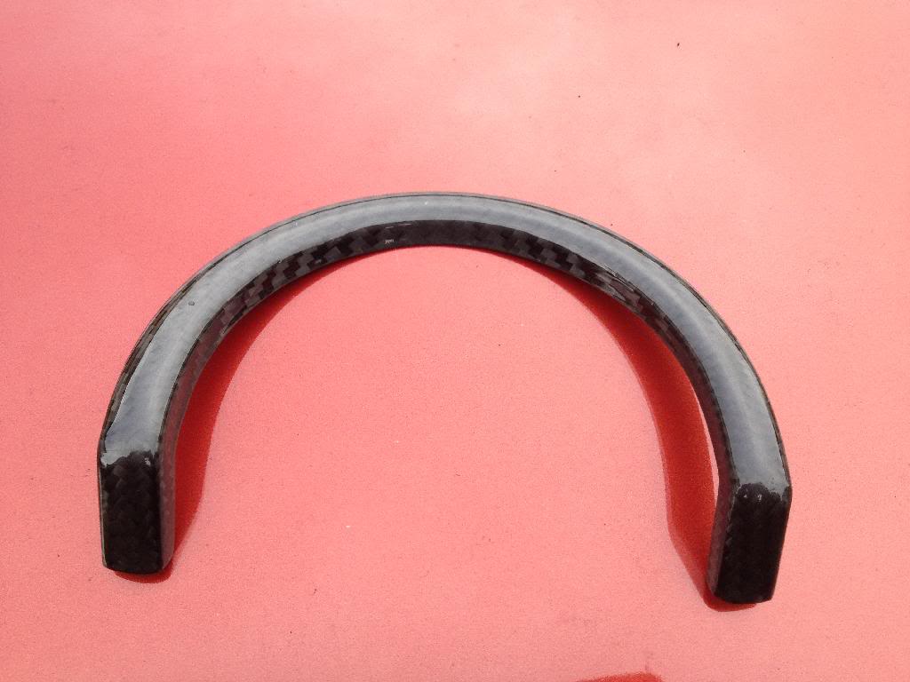

Streamline Carbon fibre exhaust trim turned up yesterday, to replace ParisPeach 's 182 trim which I stole (and still haven't given back, How can I if I haven't seen him?! lol) Need to stick it on, Any suggestions anybody?

Sports have a slight roll on the rear arches from factory. Hence why no sport will have rubbing issues with that amount of spacer.
I don't plan to go flat with them, just a half roll, much like the sports.

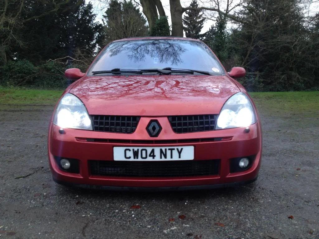

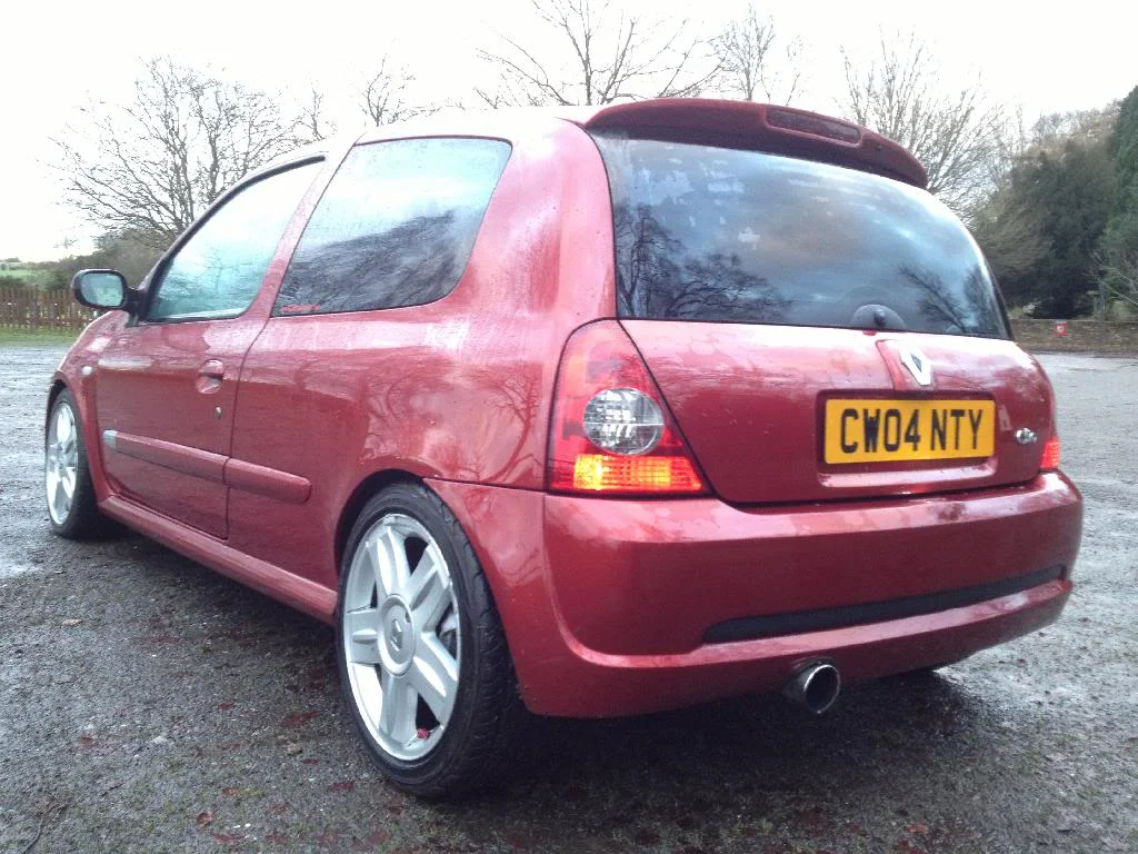

Seem to be posting here everyday at the min! I must love it again?!

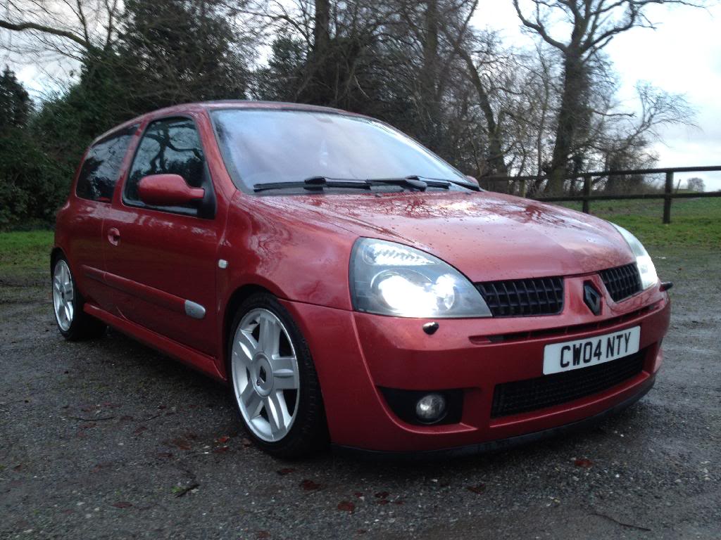

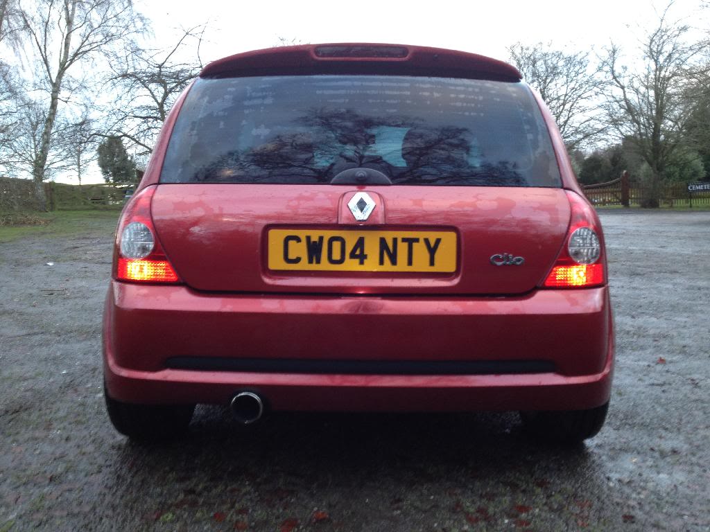

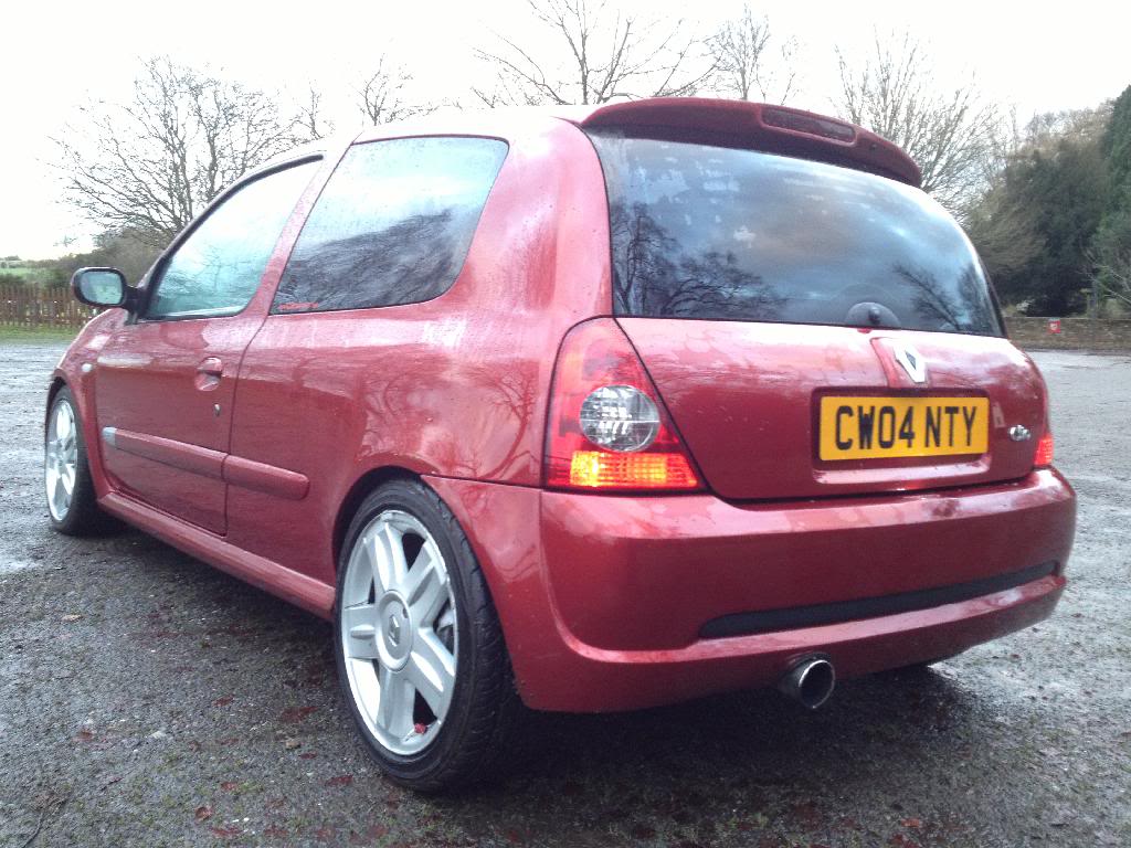

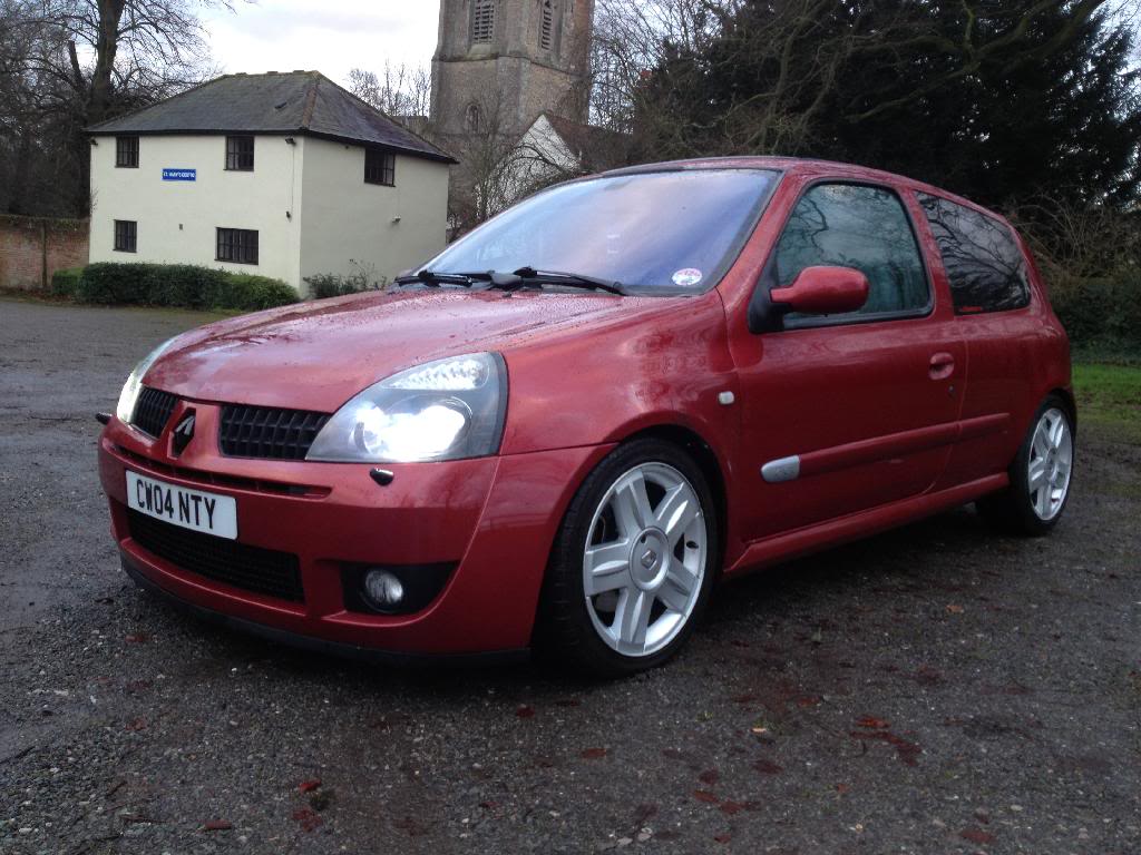

Yesterday, I failed to get pics, but I changed the subframe and wishbones (182 Cup stuff), So now run some extra caster, and have finally sorted the front gearbox mount, not that I have pics. Took it to get tracked up this morning too.

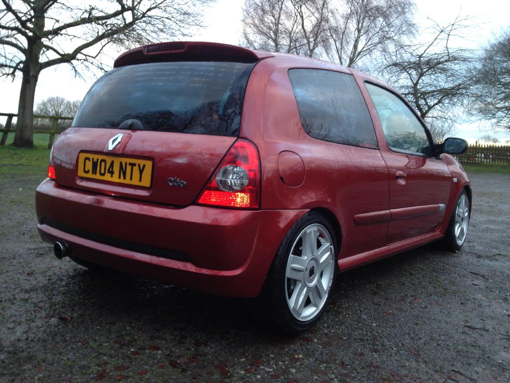

Then beside playing GTA today, I washed it once the weather improved, Last wash of 2013, and it wasn't a good one, its cold and I'm lazy!
But I did go get some pics, as its mostly done on the outside.

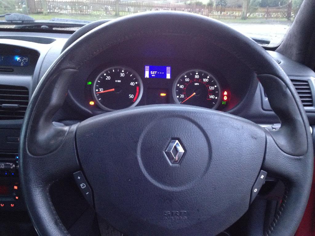

What seems like ages ago now, I fitted Cruise Control, I love it! ABS light is on due to not sorting out the rear sensors yet since swapping to disc

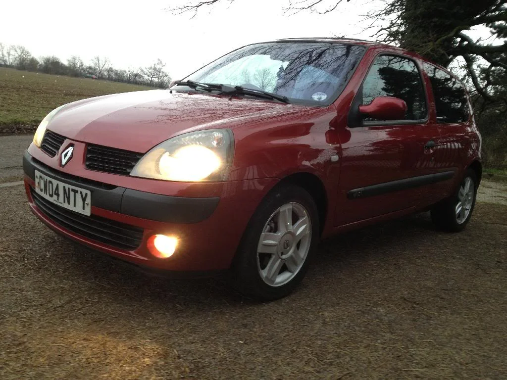

Come a long way since this... Hard to believe this was less than 12months ago (was still standard until April!)
Plans for 2014 are respray (paintwork is terrible, been keyed etc), remap or engine conversion (1.9/2.0 DCi) and to tidy it up a bit more, we'll see.

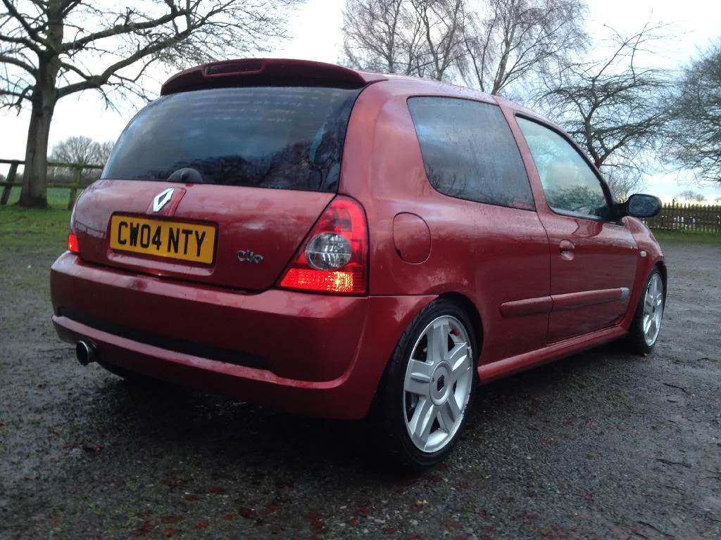

And too keep the wheels silver ;) Gotta love a bit of daily posting!
Looks so different on the last pic!
Having four silver wheels on it, it does look much better, much fresher. Need to sort tyres now though!
And yeah, I can't believe how much its changed tbh.

Don't know tbh, I had to program the dials for the Cruise Control, but there was very little options, seat belt warning, clock or not, cruise control and a couple of others IIRC, nothing about mileage etc, Guess you do that another way. Plugs are different too btw. Only one way to find out!

Looking good! Wish I made mine a sport rep now! What size spacers are you running on the rear?
I never intended to make it a sport rep but glad I did, I love it. It has a disc rear beam now, which is slightly wider than a drum beam anyway, plus 10mm Hub spacers.
