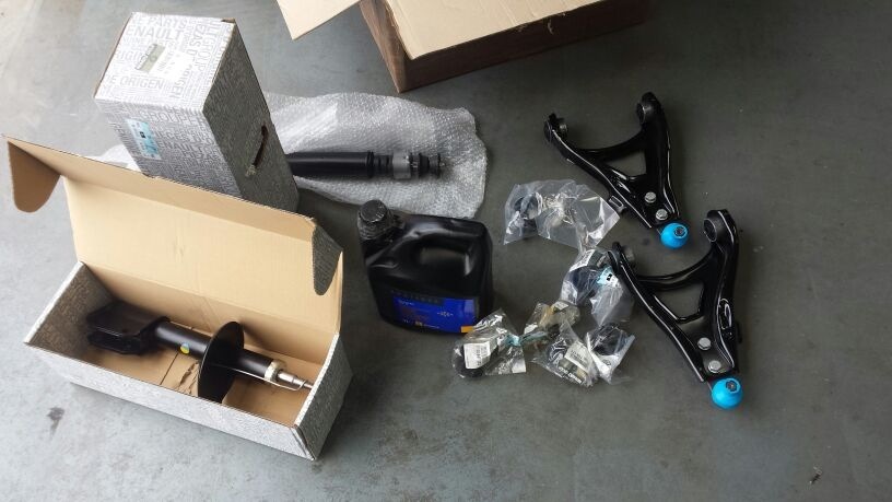

George check the mounting holes are drilled symetrically on both front shocks or you will end up like i did. No camber one side and loads on the other.

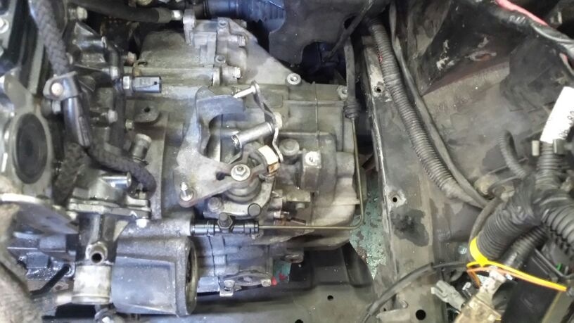

And my Quaiffed 02m box in it's final resting place:
Not too long until it's finished now - just waiting on some drive shafts. Then a remap to make adjustments for the new boost pipes and intercooler.

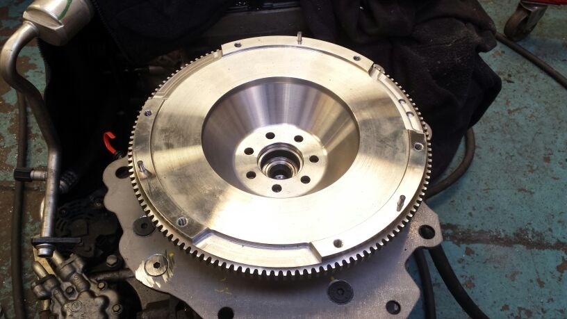

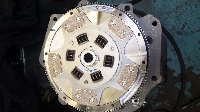

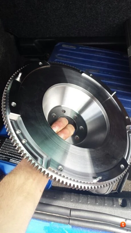

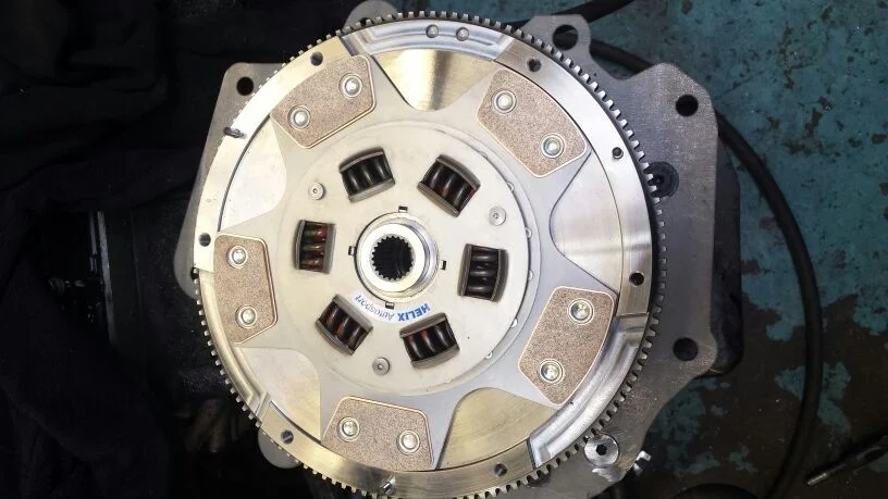

Saw this last time I was at Andy's mate, looks ace! flywheel is a piece of art!
Thanks mate, I agree!
That clutch is p0rn, mate!
It's pretty isn't it :D

02m? As in VAG yeah?

Correct :D
