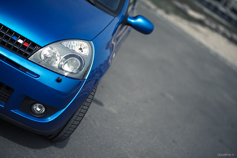

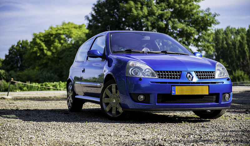

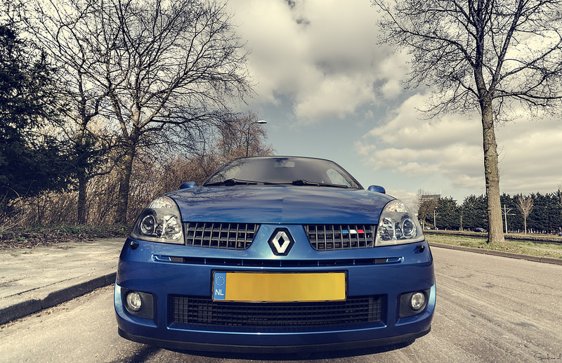

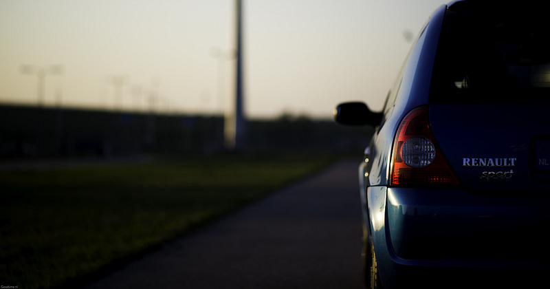

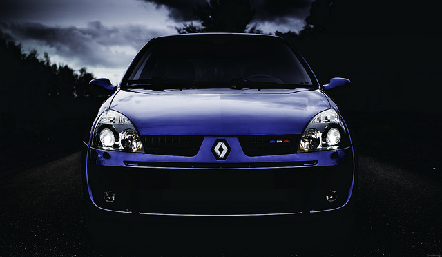

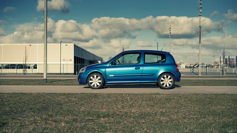

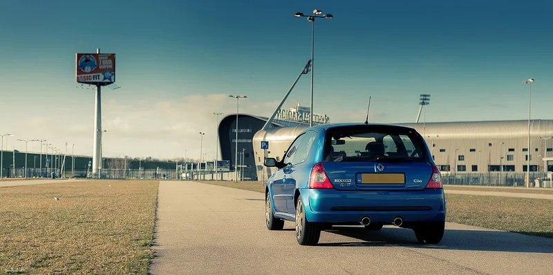

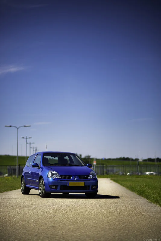

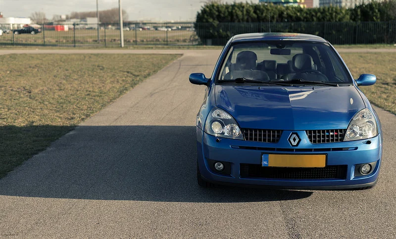

Hi everyones this is my Clio RS 182, 153000km on the clock (around 93/94000miles)
Only 63 clio RS 182 has been imported in NL... Now there is round 50/55 still on the road (crash car or exported).
My car is remapped, ktec silencer (the intermidiaire and the decat' has been change for the original renault version) The rest is OEM...

Brilliant photos! Car looks to be in fantastic condition :up:
  Clio II RS 182
Foreigners photos are always loads better.

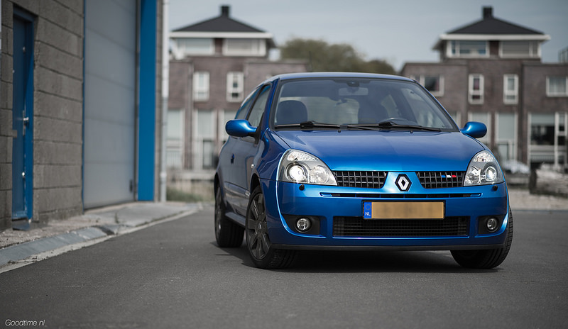

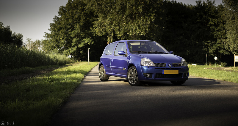

Thanks a lot guys :wink:

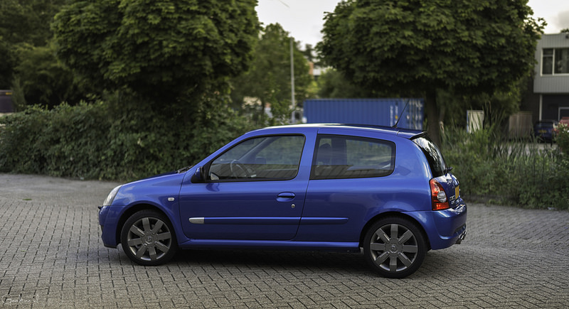

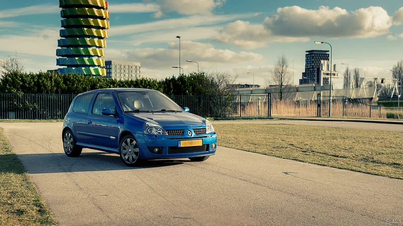

This is some older pictures...
The little French Beast by GreG, sur Flickr
(before the new headlights)

Looks great.

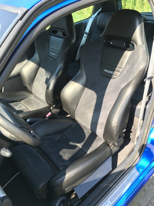

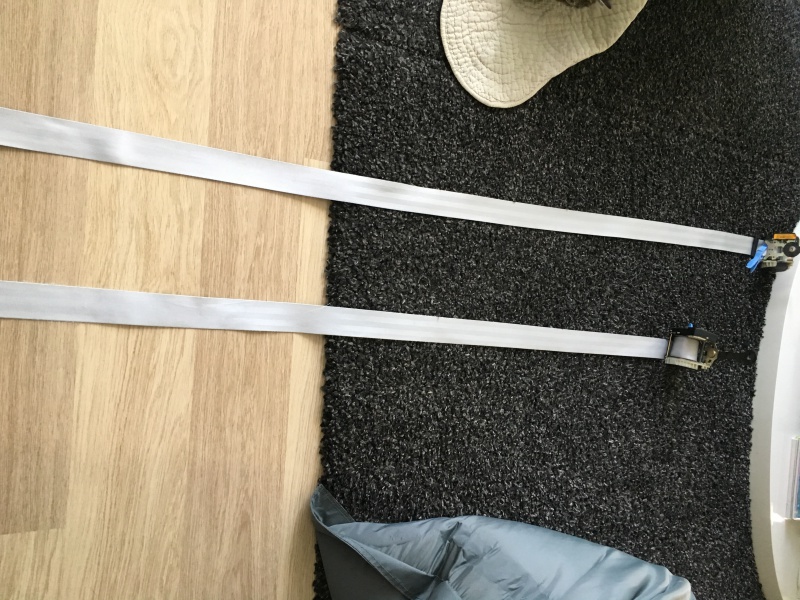

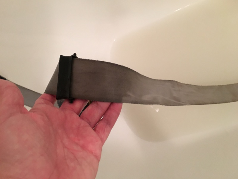

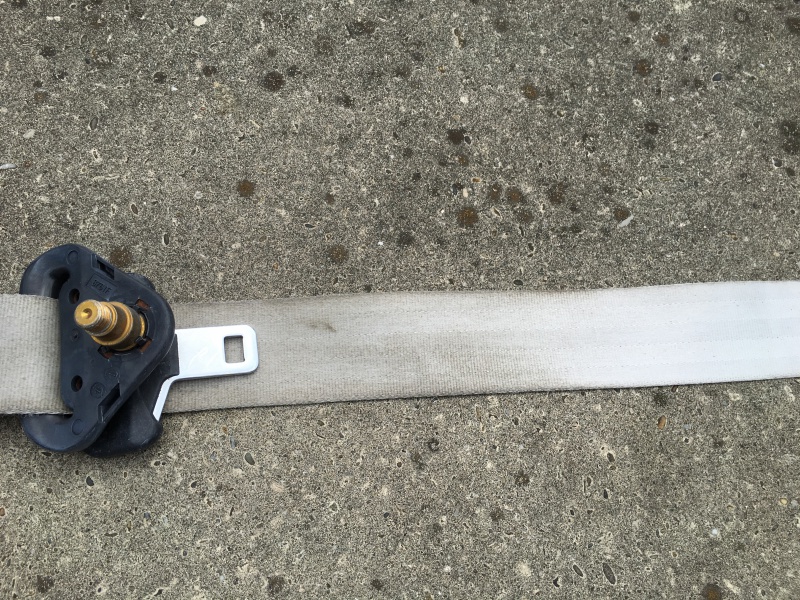

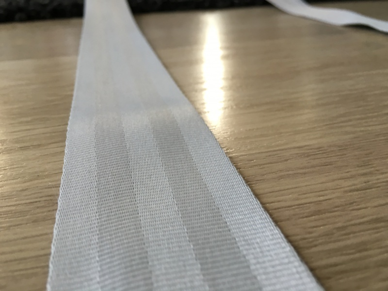

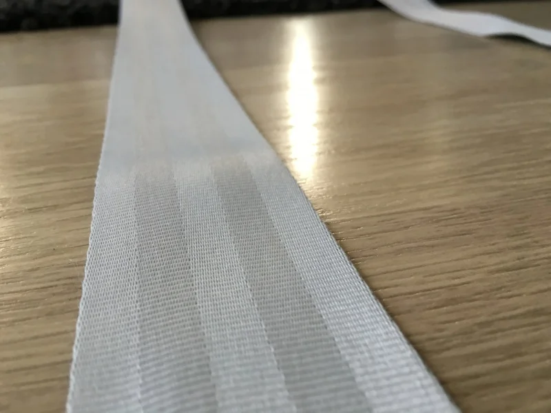

Looks good, how did you clean the Belts?
First you have to know, it's a long and hard "work". (In total around 2hours)
So I started to clean them with my high pressure washing machine, the result was really not good...
So I have put them in my bath during around 45min with a liquid detergent, and a very hot water (I added around 4 liters of 80 degrees water (with my Kettle))
/!\ care to keep the belt system out of the water /!\
To finish the work I used a hard brush with marseille soap (typically French soap)
/!\ be careful to rub in the direction of the fiber /!\
If possible dry in the sun
Hope it will help you, and sorry for my bad English, I'm French.
Greg
leeds2592
  Bean 182 + E70 X5
Yep vanish gold in a bucket with the belts stretched as far out as possible will do the same thing, but way less work!
Nevertheless your car looks great. Love the sharp pics!
I did it like this as well.
Left both the fronts in a bucket of vanish overnight, gave them a quick scrub the next day and blasted them with the jet wash. Came out tons better!

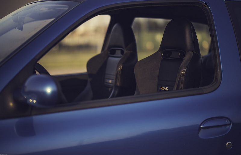

Car looks great and the seats look very smart indeed :up:
