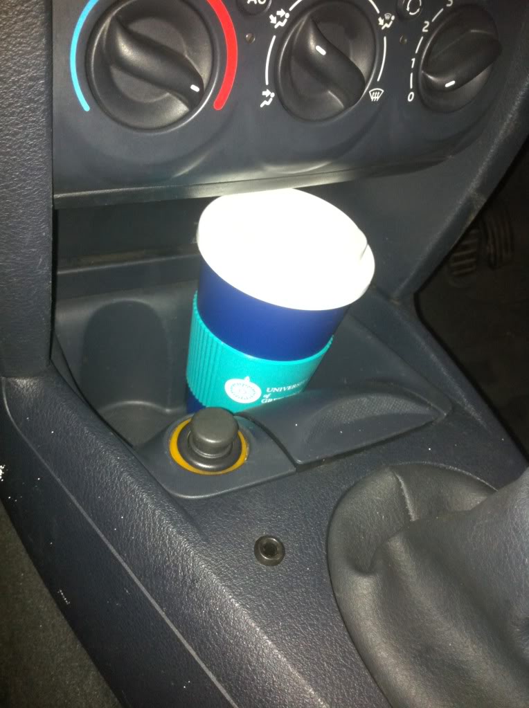

WOW I found a cup that fits just about! £4.50

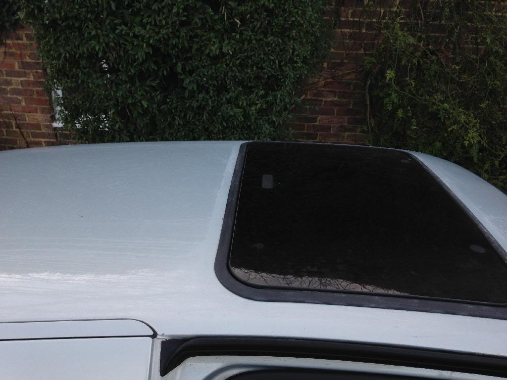

Had a mishap with repairing the sunroof.....it rained all night when it was fresh so the sealant went everywhere. At least the leak onto my seat has now stopped and it's just the seatbelt which gets soaking now.

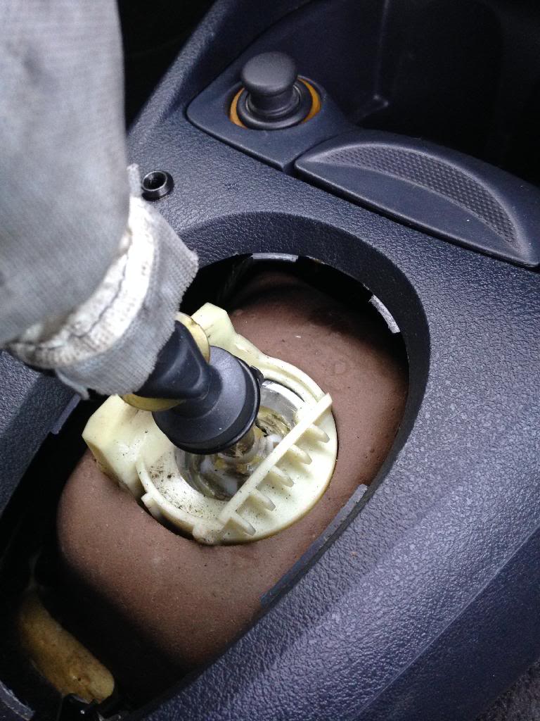

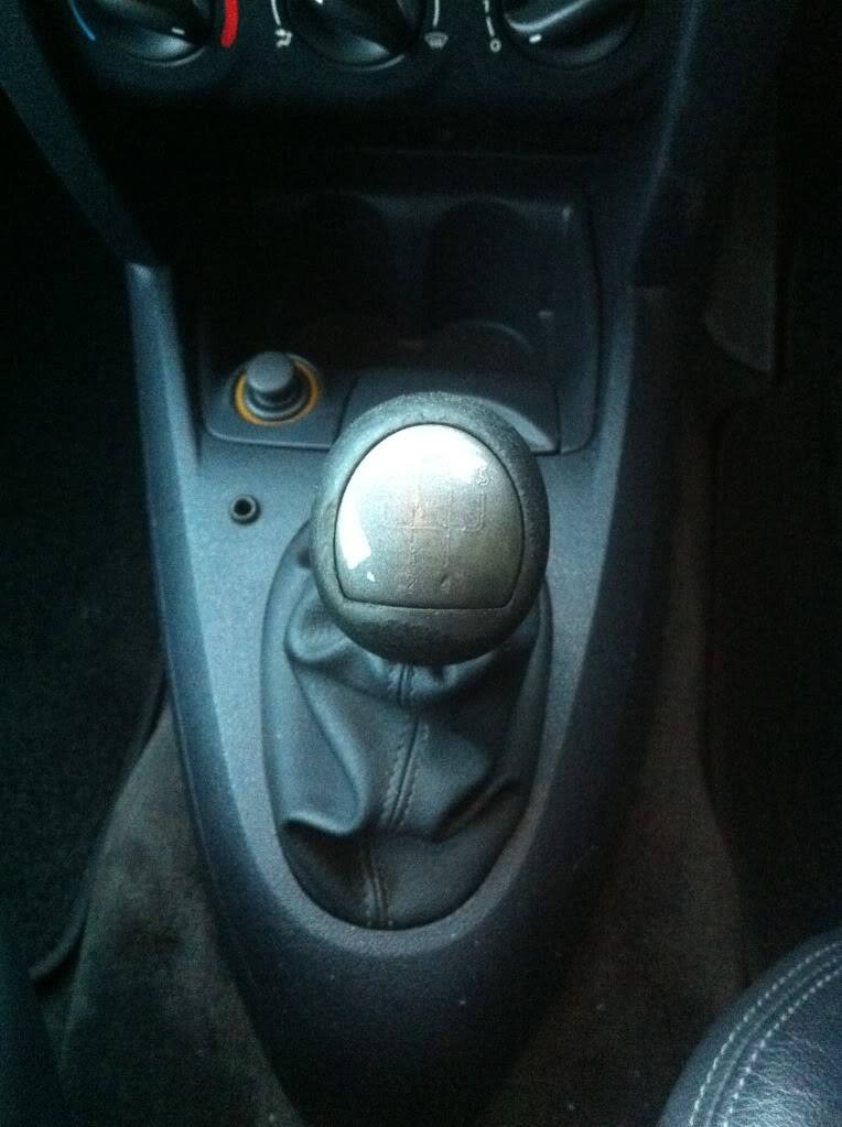

The yanoo stiff shift is great and was a straight swap with the 182. I changed the whole unit including the metal bar.

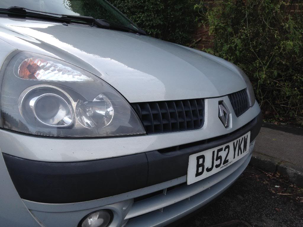

RS grill stolen from the old 182. I probably wouldn't have done this if I didn't have it laying around. Looks okay I suppose but I'm still not convinced it fits the non sport looks.

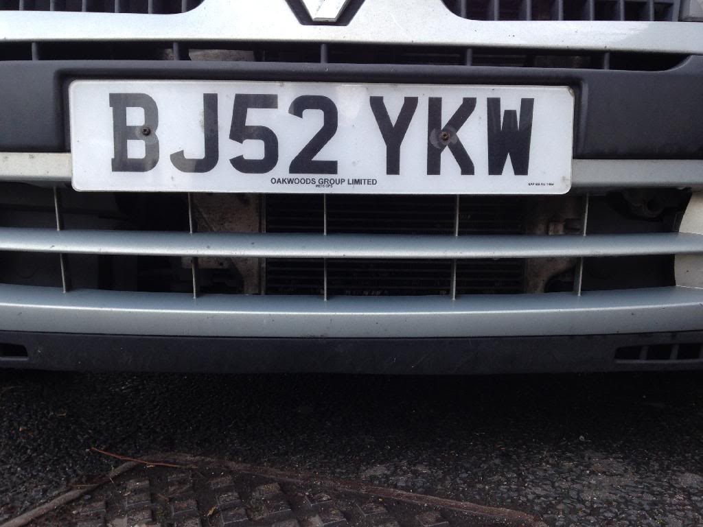

DCI 80 intercooler. Has made it a bit torquier and boost fractionally lower. Got for increased efficiency mainly and potentially remap if funds allow (unlikely)

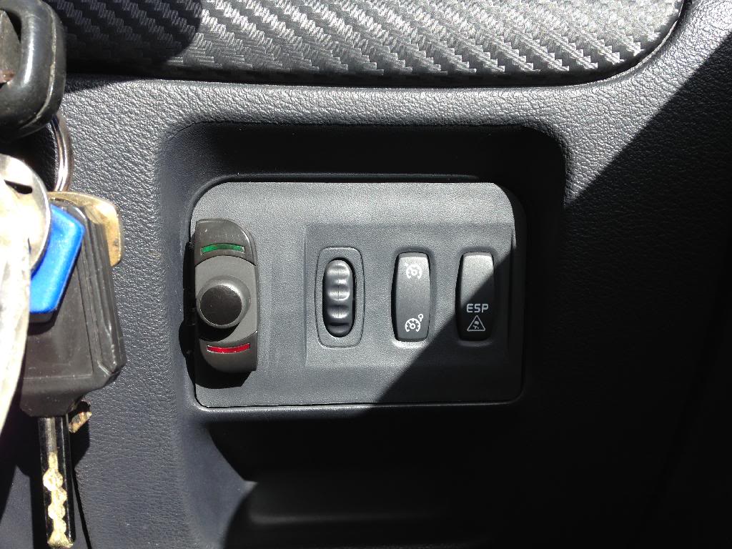

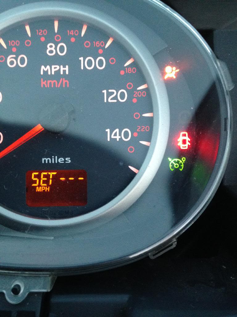

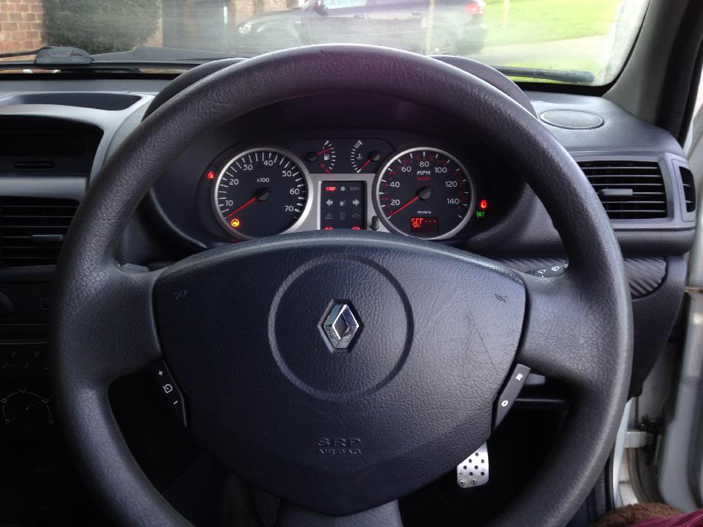

Cruise control, took ages of mulling over the wiring diagrams but I got it sorted in the end. It seems to be jerky though sometimes as if the ecu only has set levels of injection when cruise is functioning instead of continuous when using the pedal. Airbag cut isn't perfect but it's good enough. Still it's a lifesaver on the motorway.
Sneaky sport pedals

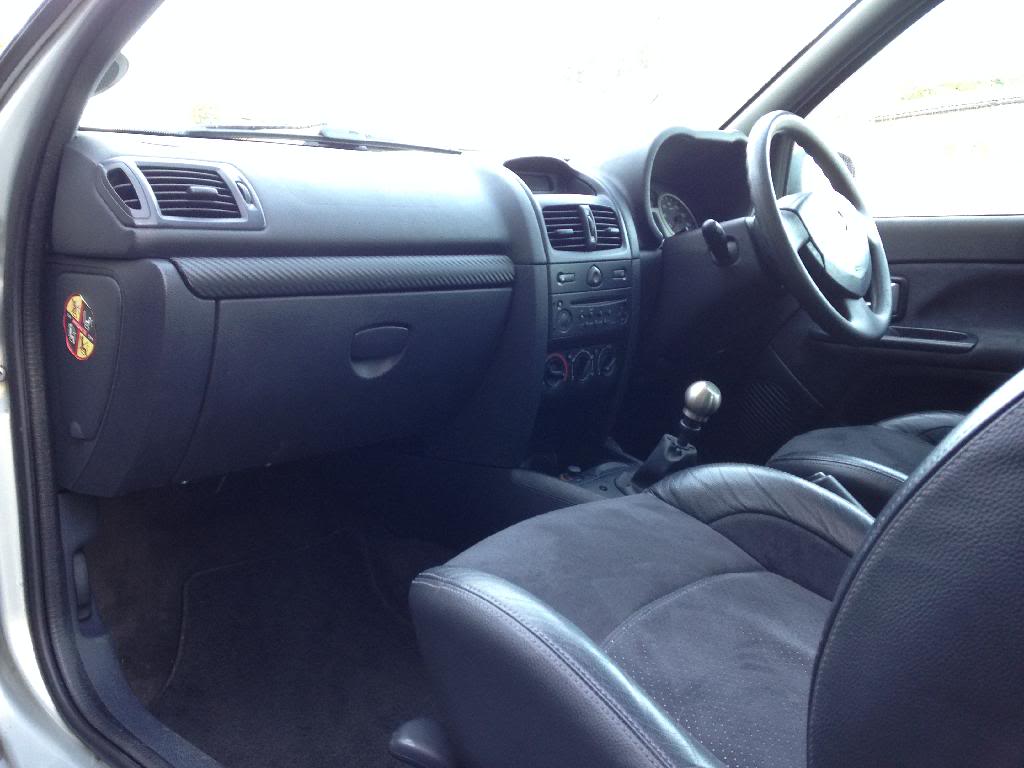

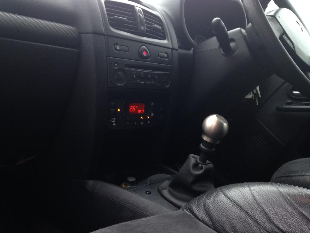

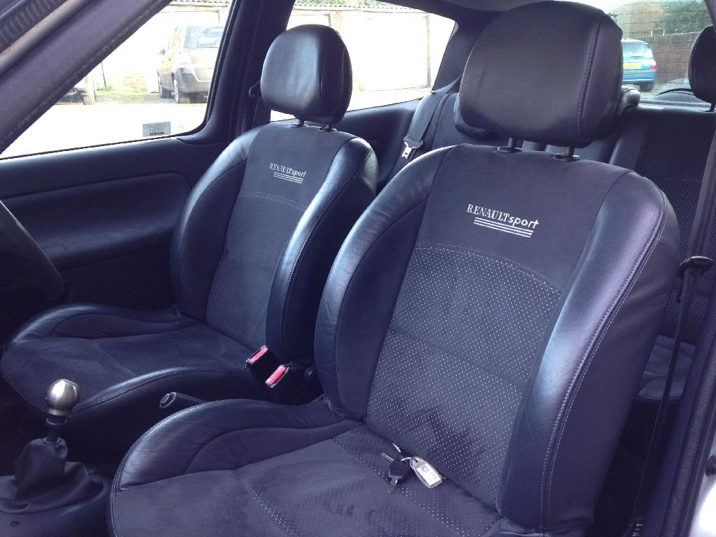

Couple of interior shots

Imminently I'll be mounting the 80 intercooler on a proper 80 radiator with a/c set up. Haven't been able to do this yet as the rad pipes differ. I'll also be retrofitting climate control in the next few weeks. Have worked out what all the wires are for and given it a test run outside the car. Will be wiring it into the existing fuse box so it's as good as factory. At the same time the lower dash will be changed to give the heated/cooled glove box function from the 182.

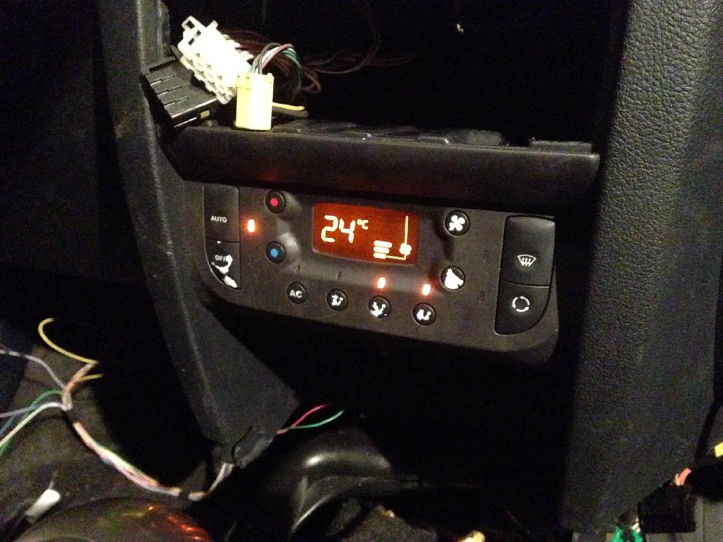

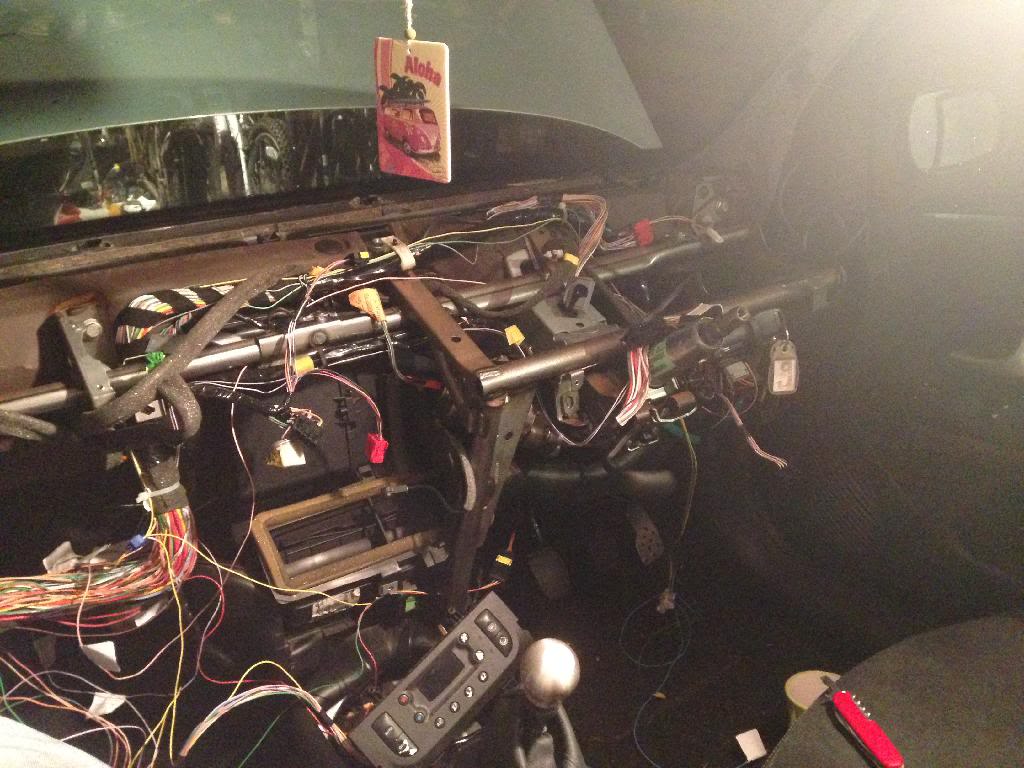

Thought I'd share this with the forum.
Climate control is up and pretested before putting in the car.

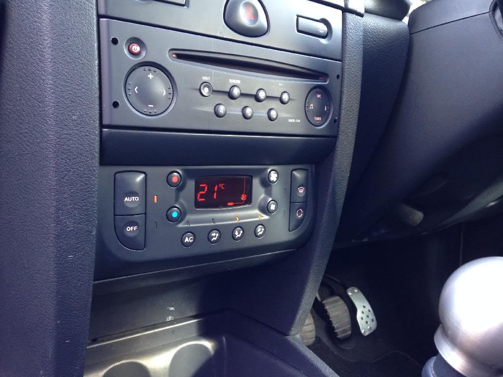

Fitted the new climate panel today which looks a ton better and is in great condition.
Had a couple of teething problems with the climate control. Having mended a broken climate pack it then busted again because the resistor got too hot (I hadn't located it on the heatsink properly). I've sorted that now.
Finally connected it up to the ecu and the headlight switch so the illumination works properly.
Problem is that the climate requires an external temperature input which can't be supplied by the current clock/temp display. I've got the 182 display so will be putting that in with the wiring tomorrow but know the yellow block on the radio connector is different so need to know which terminals do what. Until this is done there is no adjustment of the temperature as the module doesn't know the temperature of the air coming into the heater box.

AlexW it's an output of the clock display "central communication unit" which cars with the red and grey plug clock unit don't have. The 182 unit has 1 plug with 24 connections.
As suspected now I've wired in the new display the radio functions don't show up on the dash and the steering wheel controls no longer work. Unsure of the differences in the units out and inputs on the radio and display.
Climate is now working perfectly after sorting the external temperature sensor and plugging the roof fan into the right plug! (der there are two in the roof of the same shape). It had been blowing out just lukewarm air what ever the temp was set to.

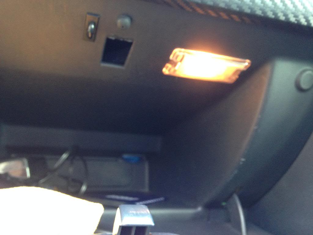

With the new dash it's possible to utilise the heated and cooled glovebox and hook up the glovebox light so I've done that.

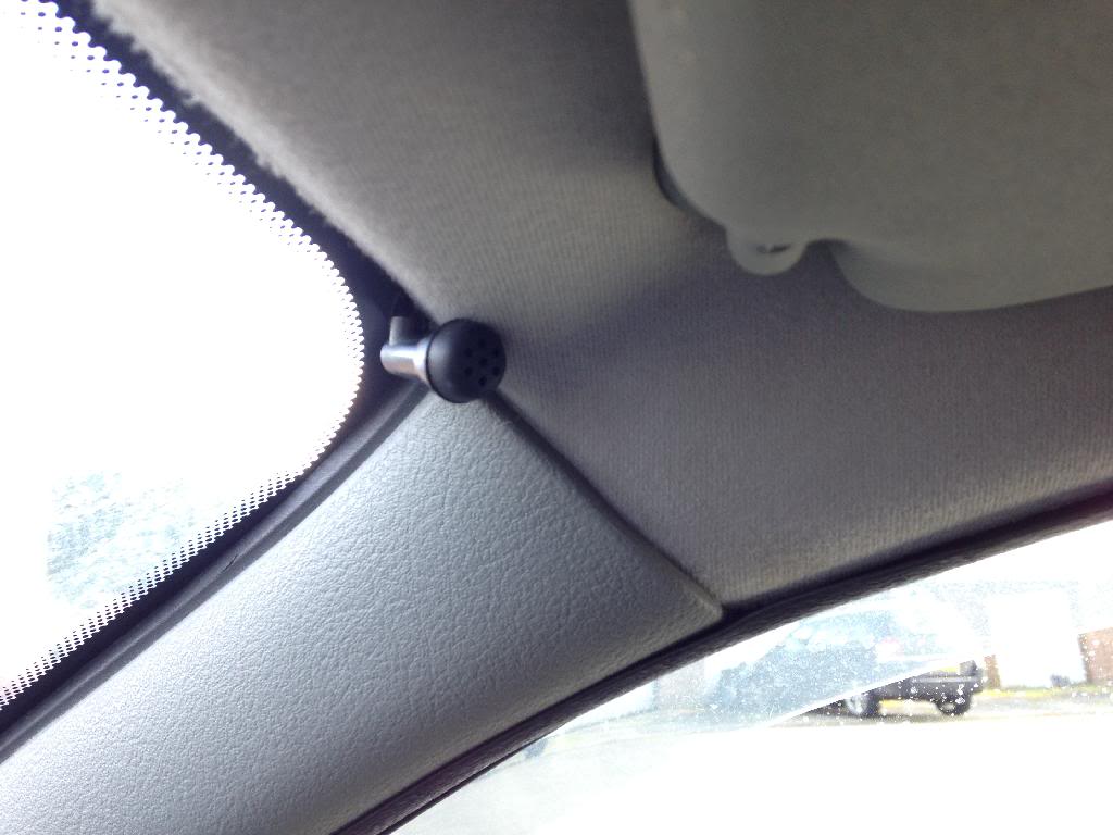

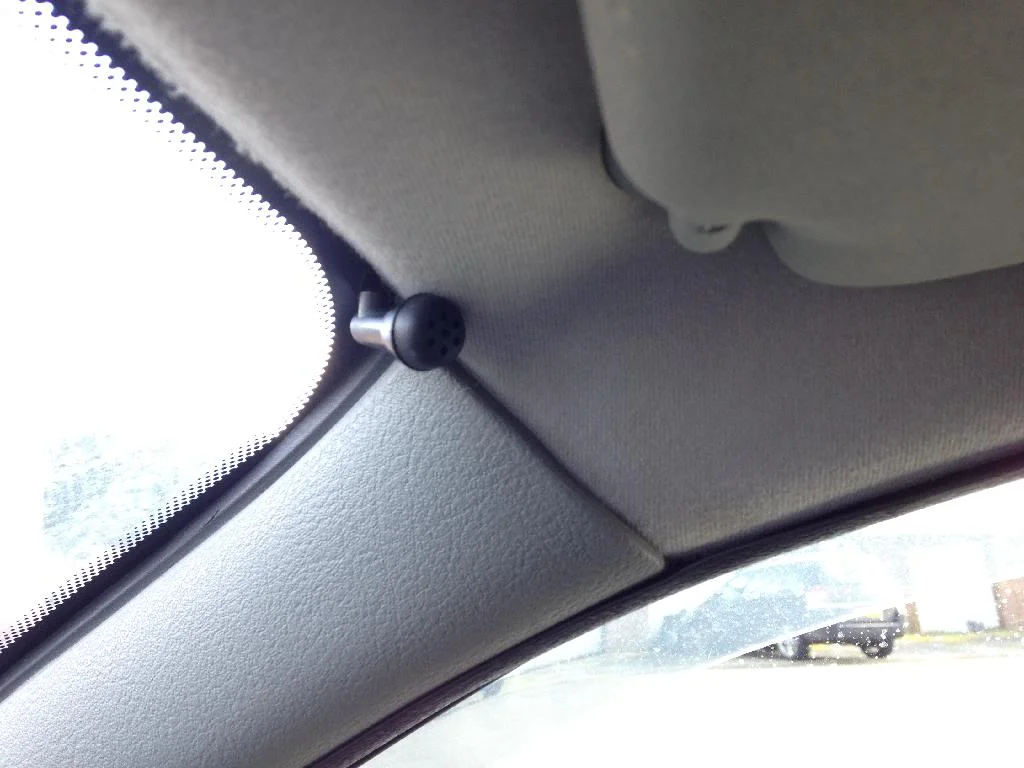

Also I finally got round to mounting the parrot back in a discrete place after removing the non-cruise panel.
SORTED!

How odd. I'm not entirely sure then unless I'm reading the diagrams wrong. The 182 had the external temperature input wire going into the clock display which is the only place the temp sensor wires go.
It's 1125 on this diagram and listed as central communication module unit. When I looked in the clio electrical manual published by Renault they didn't list any temp outputs on the grey or red plugs.
https://www.dropbox.com/s/hhs54i1mqmmah8p/419 - control panel.pdf
So much better with the top fan plugged in!!!

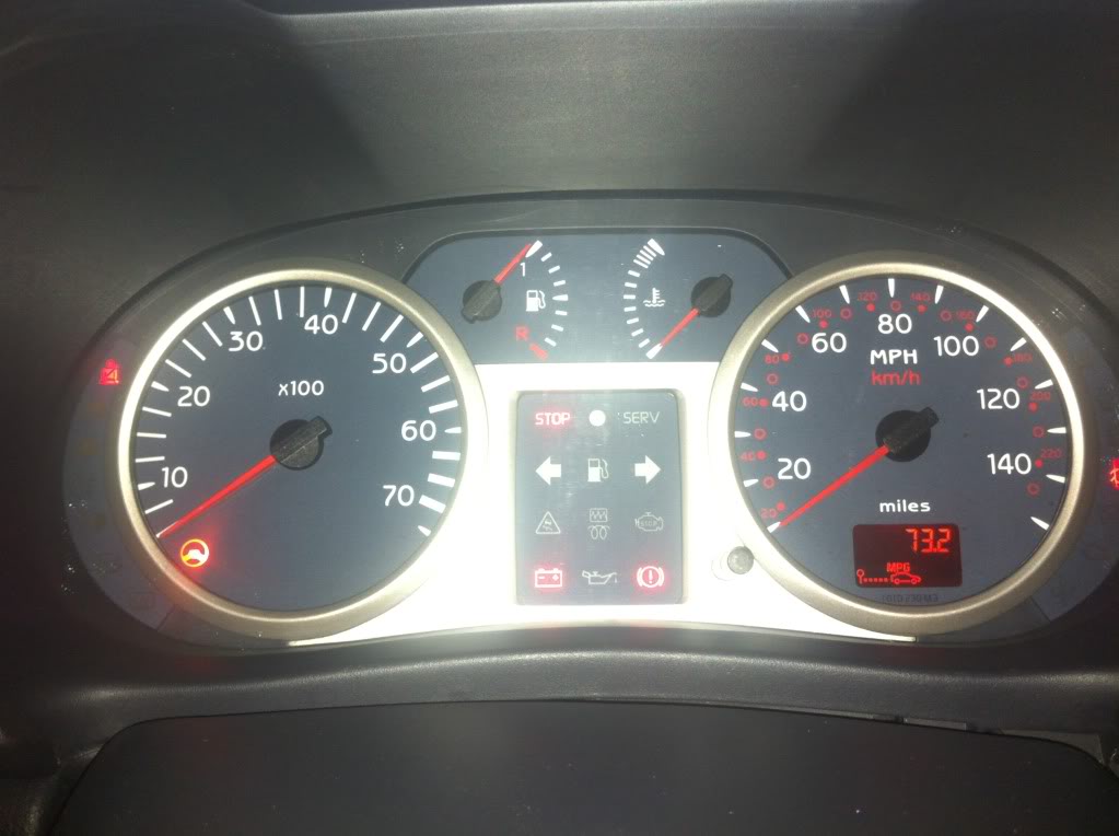

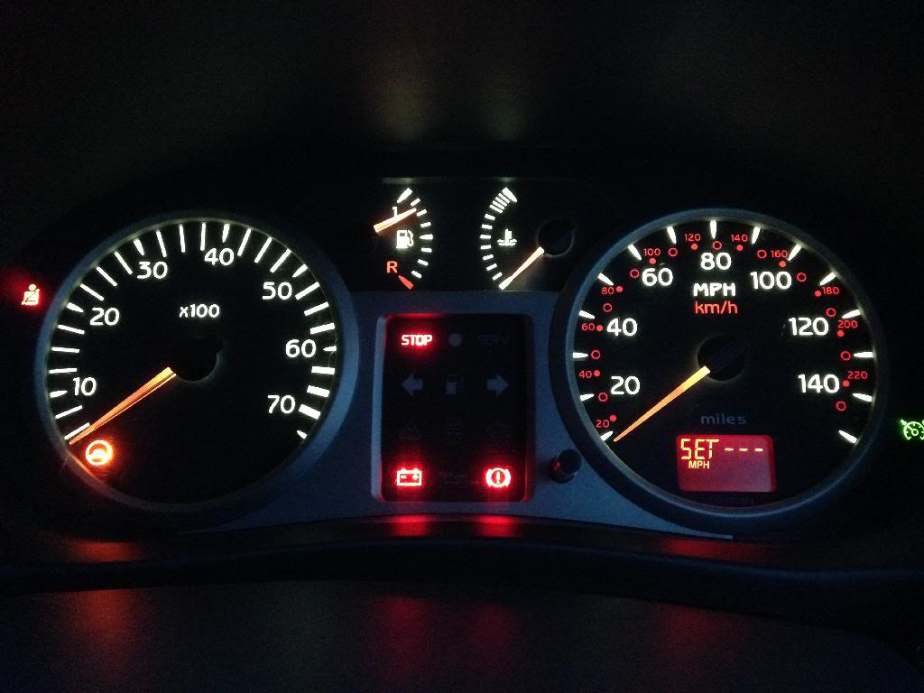

After 3 weeks delivery time my SMDs for the dash were delivered from japan (the cheapest on ebay!)
I burnt my finger on the soldering iron 3 times and did some messy soldering but an hour later I was driving an Audi. The display is red, it came out funny in the photo all over exposed. The white isn't as offensive as it looks!
