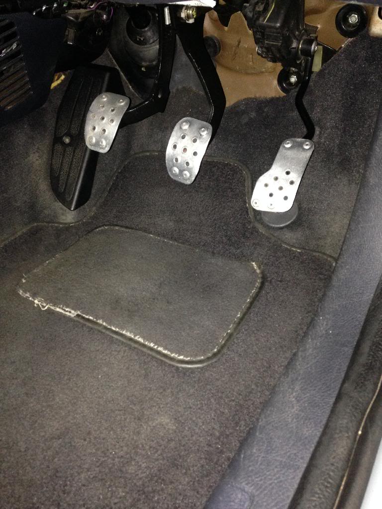

Changed the rest of the pedals for sport pedals. Only took twenty minutes or so which was nice. Also fitted rear mudflaps but a pic await!

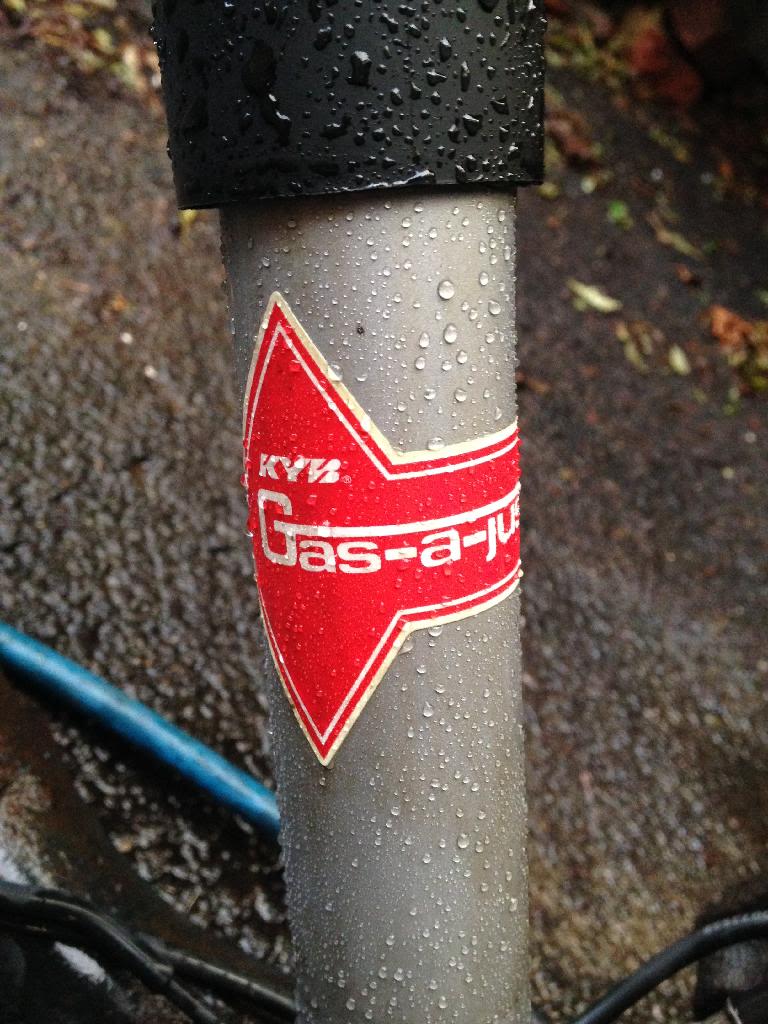

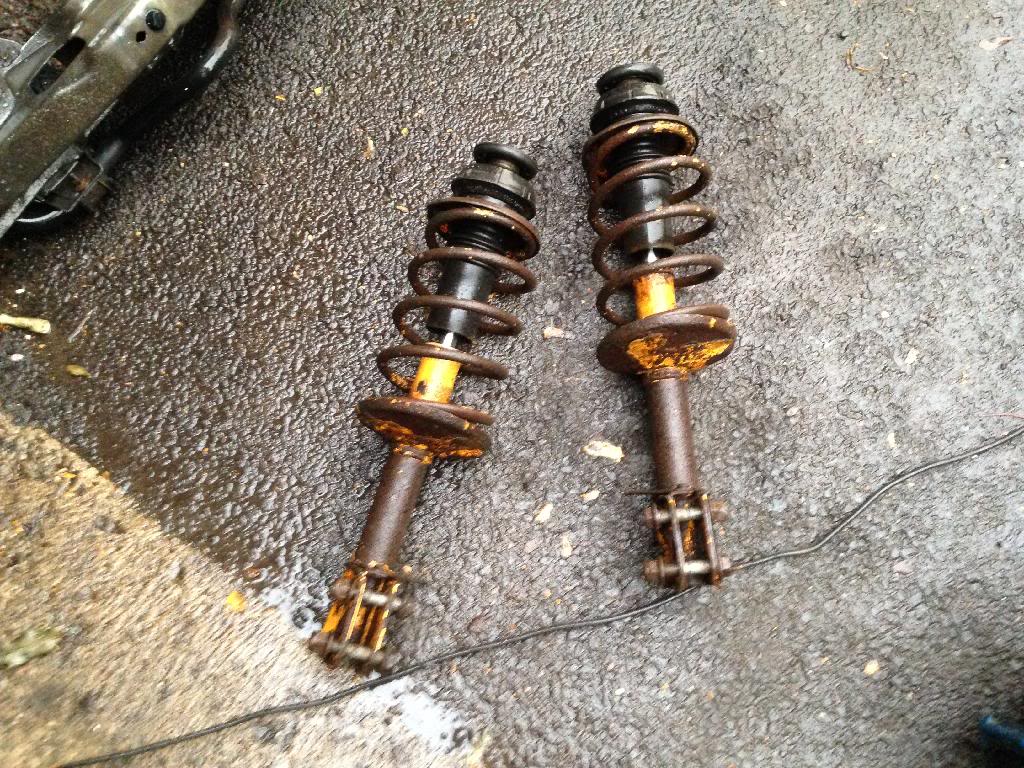

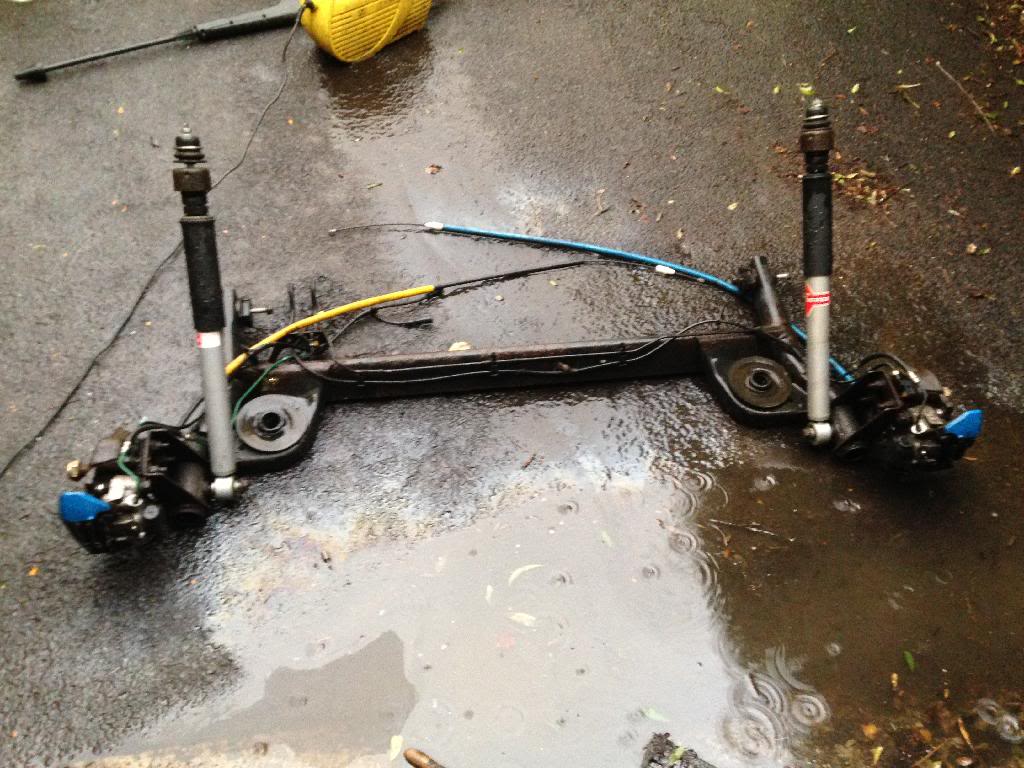

Front dampers appear to be koni (past their best for sure) and the rear are a make I've never heard of. Seems to be fully polybushed at the front as well which is a nice bonus!

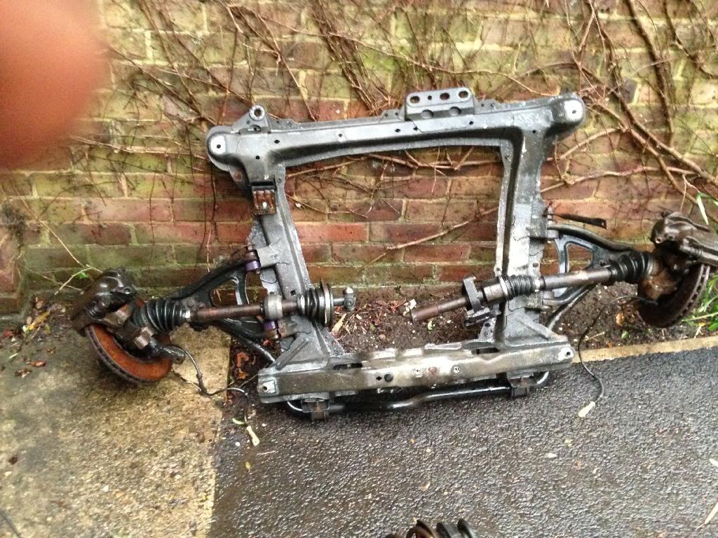

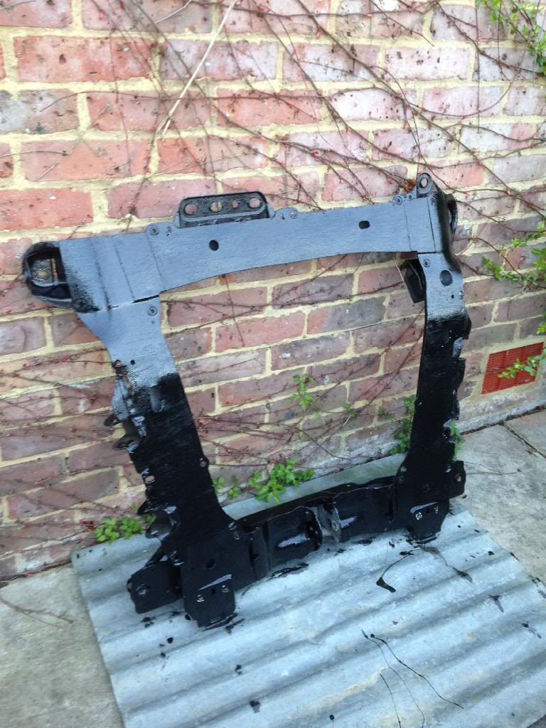

So today I had a couple of hours spare so started stripping the front subframe ready for paint. Thought I'd have a look at the front shocks only to find this when I took some of the old paint off!
Today I ordered some 182 non cup front struts, full set of springs and new lower ball joints. Front is going to be done piece by piece to make sure everything put on the car is in top working order.
In 2 minds about painting the subframe to protect against rust or whether I should just clean it up and leave it be. Calipers will be freed up and maybe get new seals on but time and money will tell.

At least give the subframe a coat of hammerite IMO, moreso if you're cleaning it up. Make sure the sliders are free on the calipers at least.
Shocks impressive lol
I'd keep the rear shocks IMO.

Yeah might do it black so it doesn't look too non-standard. The idea is to keep it looking as oem as possible.

Rear shocks leaking I think, sound pretty squelchy. Bloomin' great

They will be oil filled, so sometimes do sound squelchy, its more about how they compress and return.

They do seem to have semi decent damping abilities but leaking fluid from around the top.

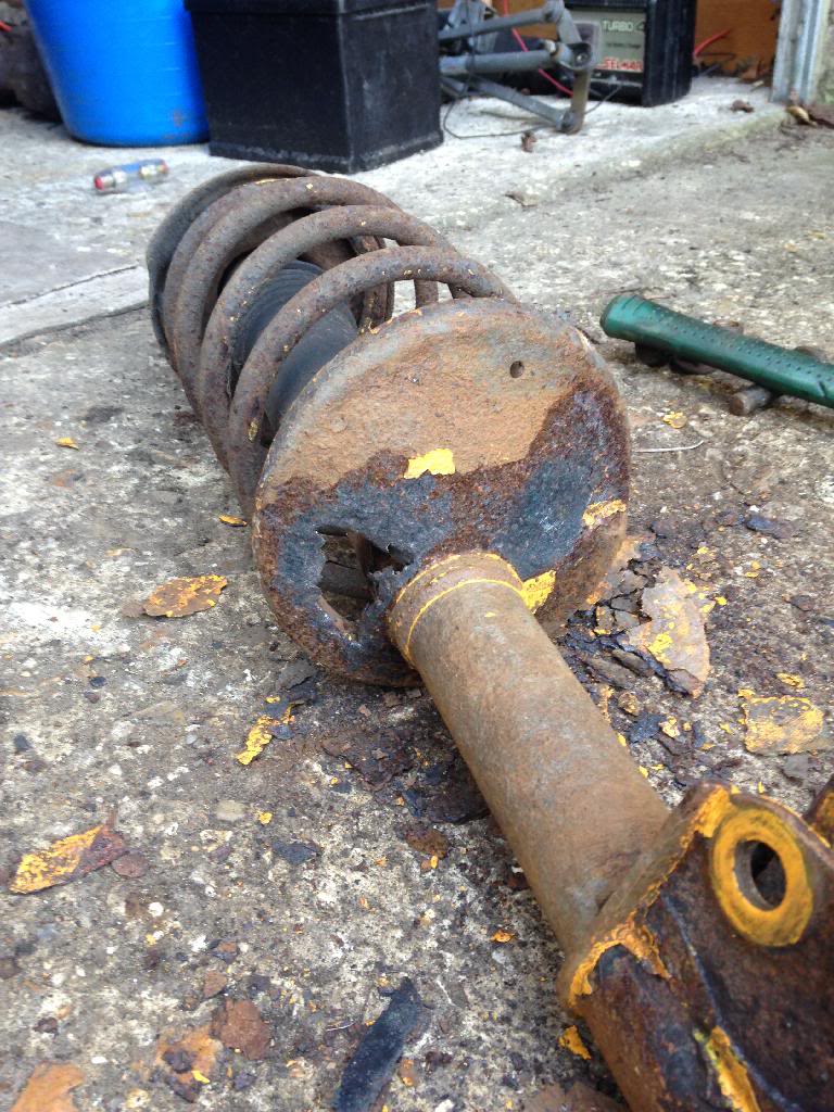

Does look better in rust, needless to say these shocks did not pass the hammer test.

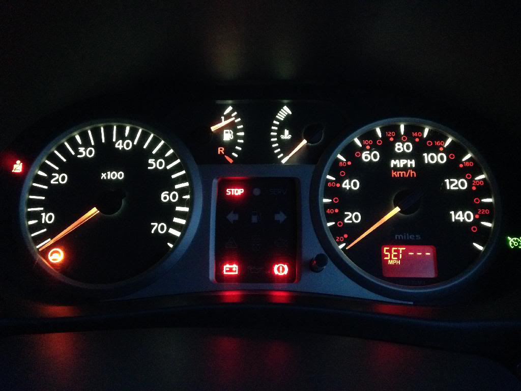

I made a cruise control guide and put it in the guides section on the forum. Check you haven't got the pre-wiring first though like in this thread http://www.cliosport.net/forum/showthread.php?521679-Cruise-control-on-a-RS-172-or-a-dCi-(DIY)
Now the cruise is activated on clip it's much smoother than before.
Clocks were plug and play yep. Mileage stored in the clocks if you're worried about it reading a little wrong. Keeping good records doesn't reduce the credibility.

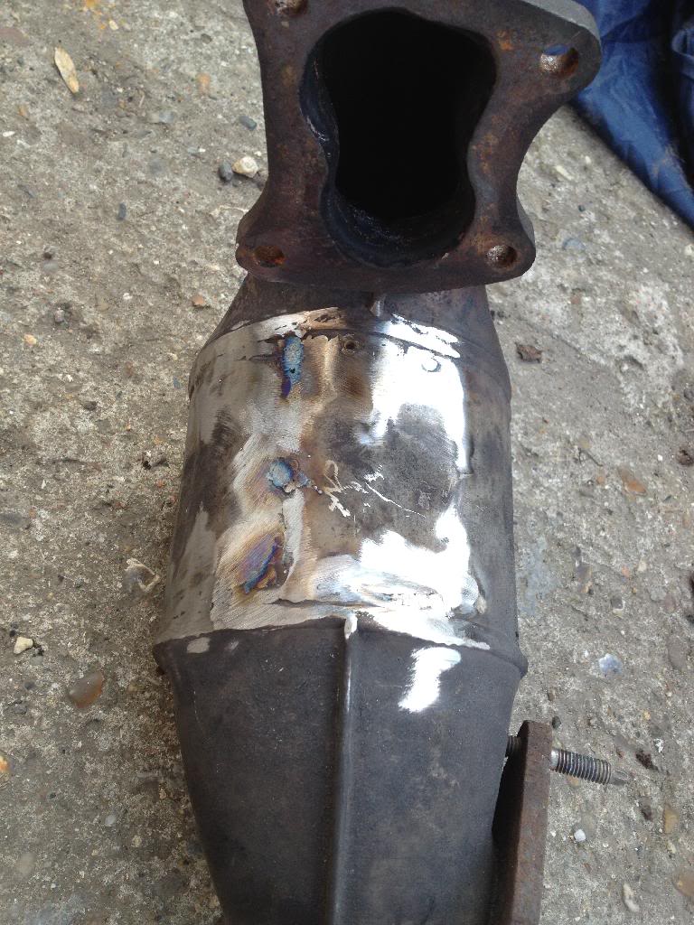

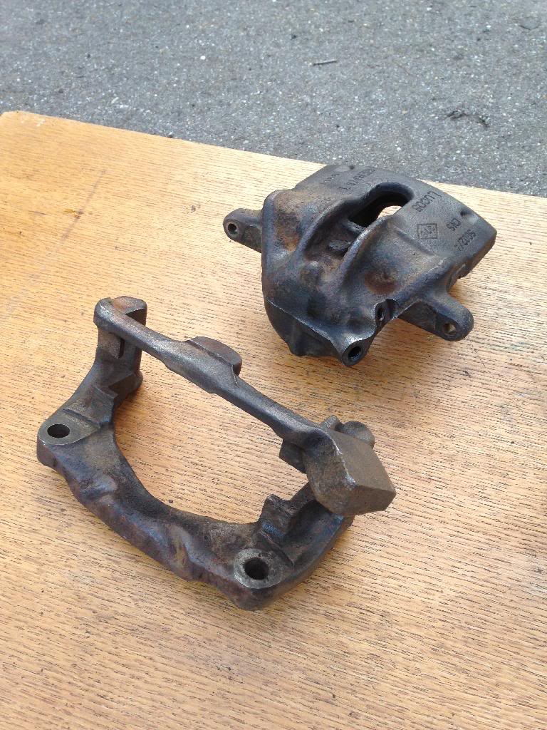

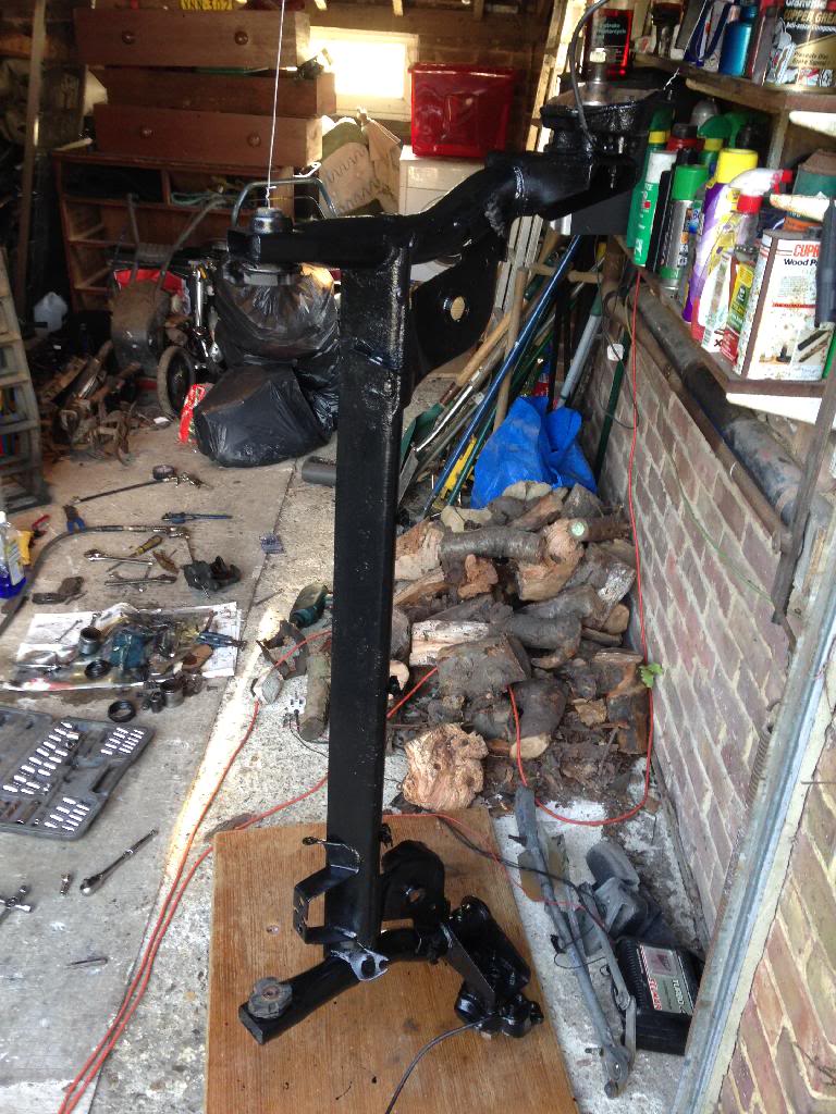

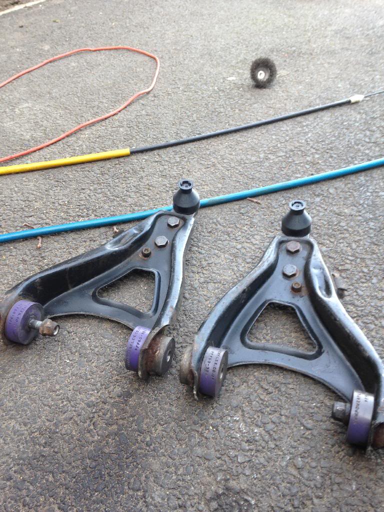

Starting with what's been ordered. Genuine new front shocks and a cat. I will be decatting the car at the same time as having the subframe off.

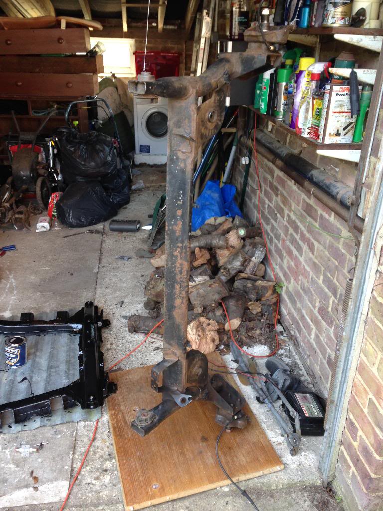

Managed to get a little bit done today in preparation for the conversion.

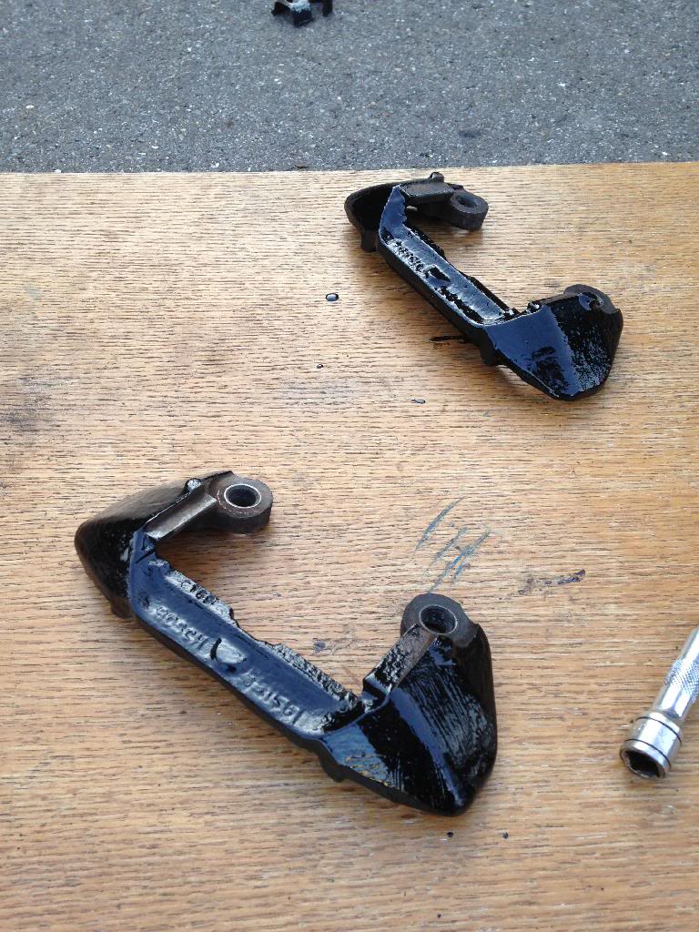

Painted the subframe, rear axle and the rear pad carriers. It's all going black so it looks standard.
Replaced the lower ball joints

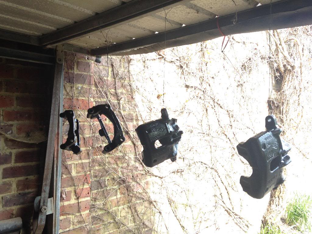

Started to refurb the front calipers which was quickly stopped when the second caliper snapped off it's bleed nipple. Now need a new passengers caliper.
That's it for today.
Comments welcome :)

Re: DCI 65 pov spec commuter OEM+
Coming on well buddy.
I sprayed my subframe etc, much easier than painting it like that.
Cup wishbones too? It'll be nearly as good as mine :p
I decatted the black one today, I can do it super quick now.

you all need a proper de cat pipe like me ;) sounds like a subaru on full throttle. hopefully when ive put the new rear quarter on mine, i will hve time to visit fred to get the rest of my exhuast measured for a full 2.5'' all the way back.

Mine are both legal (since they keep changing the fecking laws anyway) :D, I like the way mine sounds.
I'd like to change the exhaust etc, but I don't think its really worth it.

i had a de cat pipe made to look like a standard cat but 2.5 inch pipe inside with a better swan neck from the flange off the turbo. and had a threaded hole put on it for an EGT probe ( mapping purposes )
we will get away with it anyhow. its in the most b*****d awquard( sp ) place to check lol
and if its mapped properly then hardly no smoke. ( sutt test not emmisions so god knows why they thought an EGR would help ! )
got bord of the noise of just a straight through and hollow cat. subaru noise is nice. actually loud :p specially when i took it for a test drive with no airbox on haha

Ghetto cat is fine, Mine is deffo a lot faster (and clearly makes more power/torque confirmed by two RR days) with it.

My two 65's both have the figure of 8 flange as you describe it, ala...

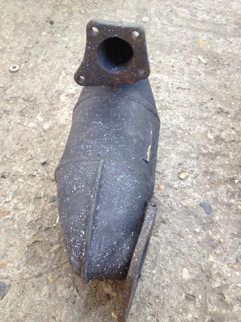

I have a decatted cat from a single small hole Clio, but no idea what engine it fits?
Graham, yours isn't like this is it?...
If it is, you can have that.

think the very early dci's ran a single hole cat.
later must of been figure of 8. probs a design flaw due to the wastegate ....

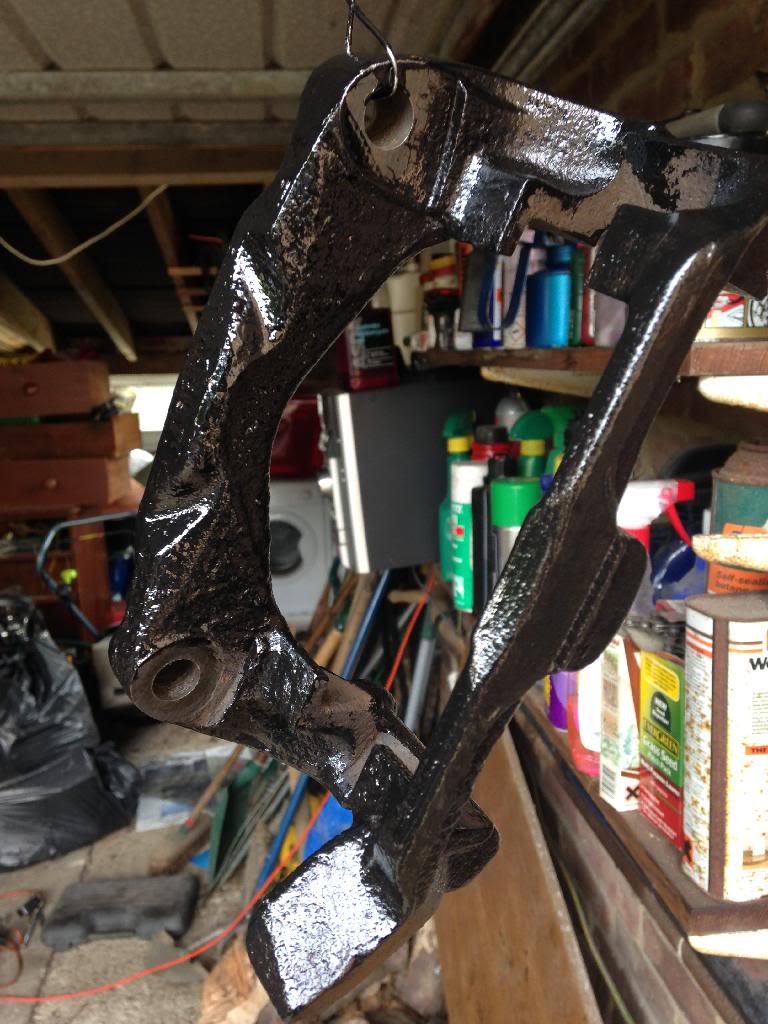

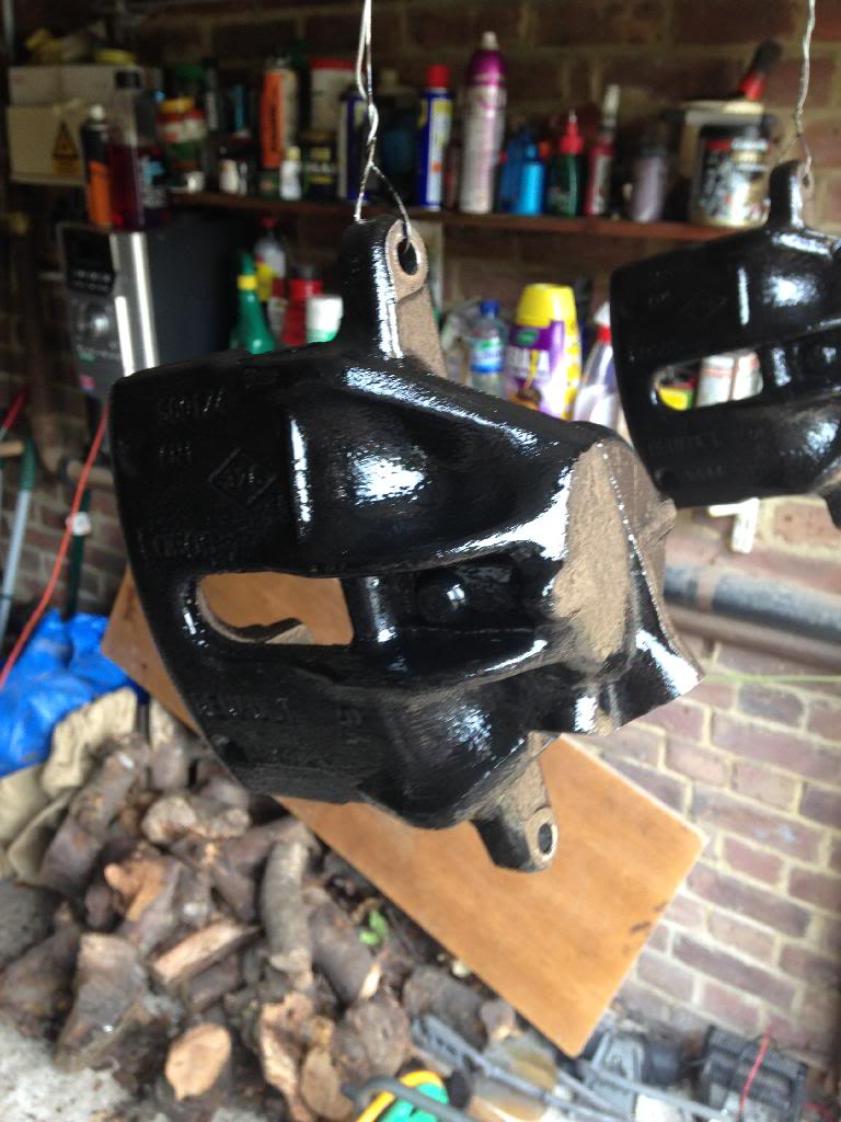

Got hold of a different n/s caliper without a shagged bleed nipple.
An hour away from revision for "lunch" and they're all painted up nicely. Tonight I should be able to get the new seals in so they're ready to go.
