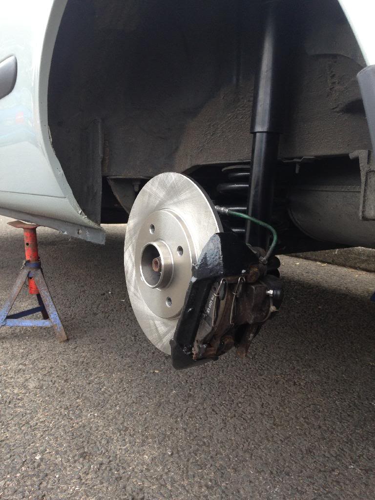

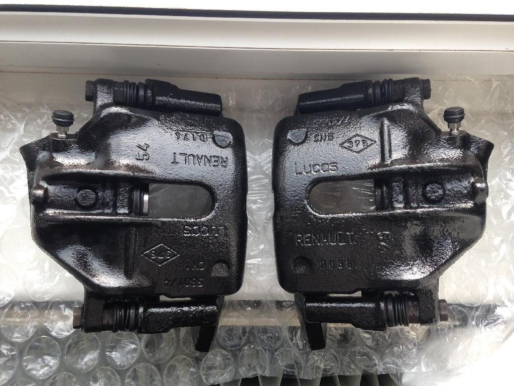

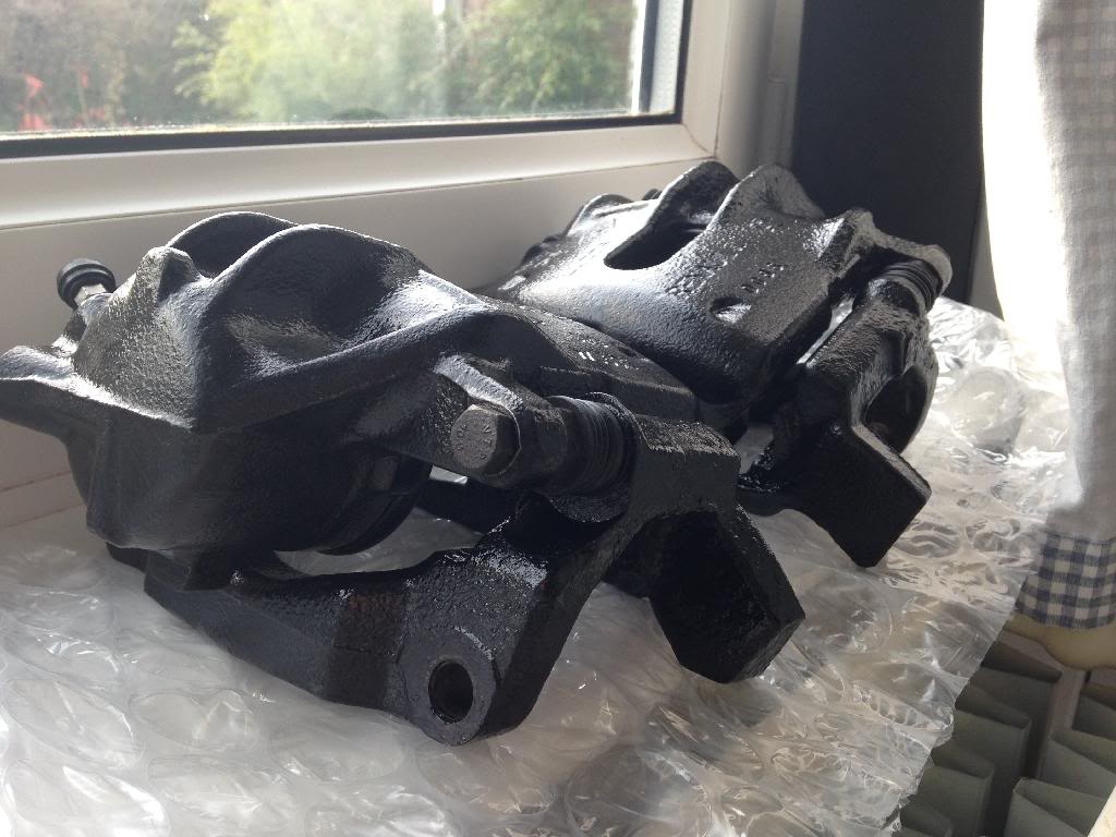

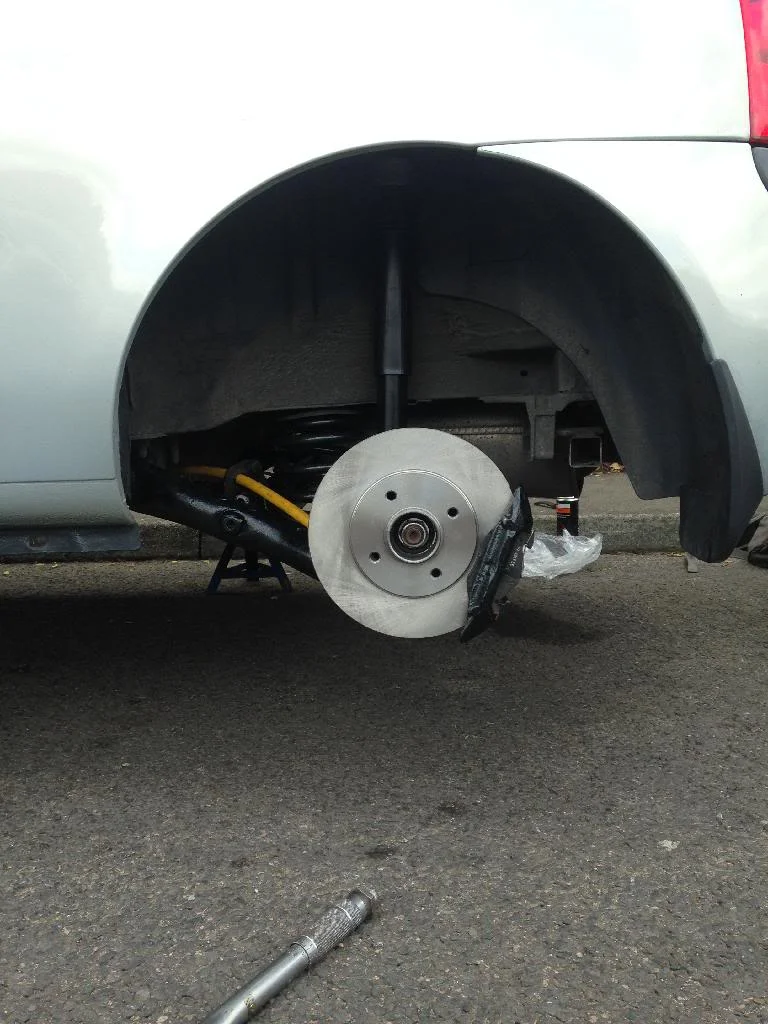

I got stuck on question 2 so rebuilt the calipers. Nipples and rear lines turned up.
Tada!

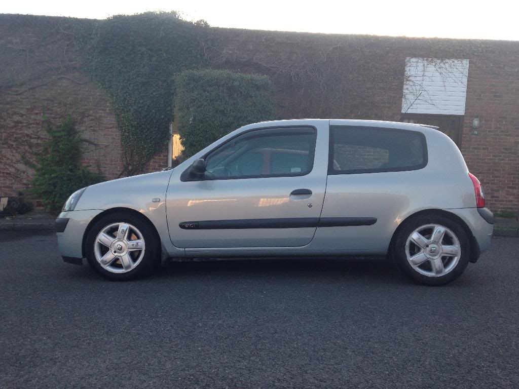

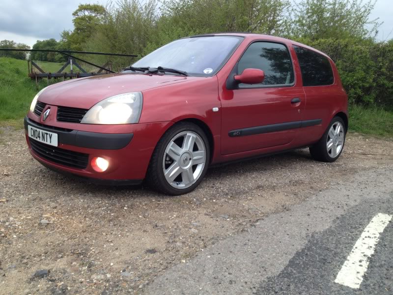

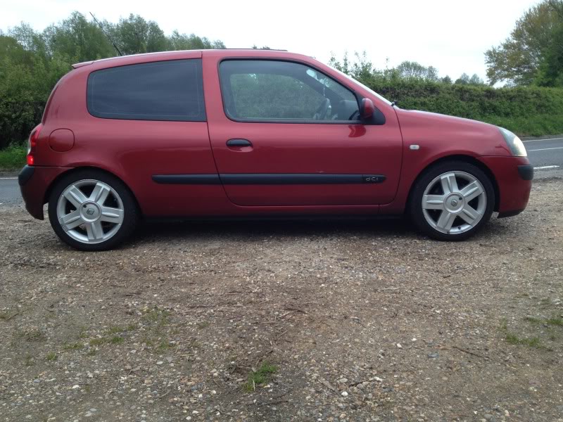

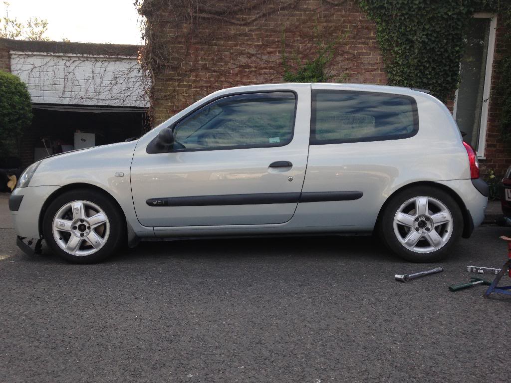

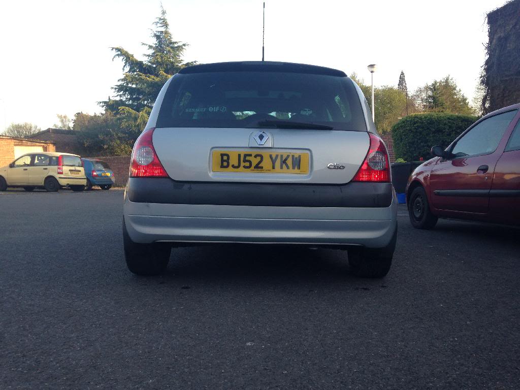

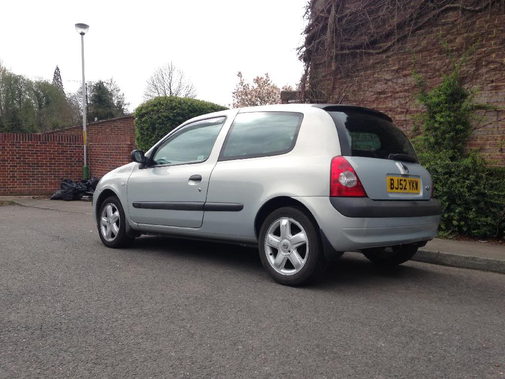

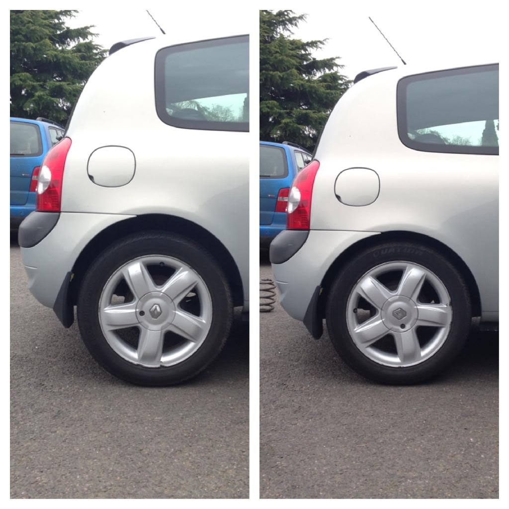

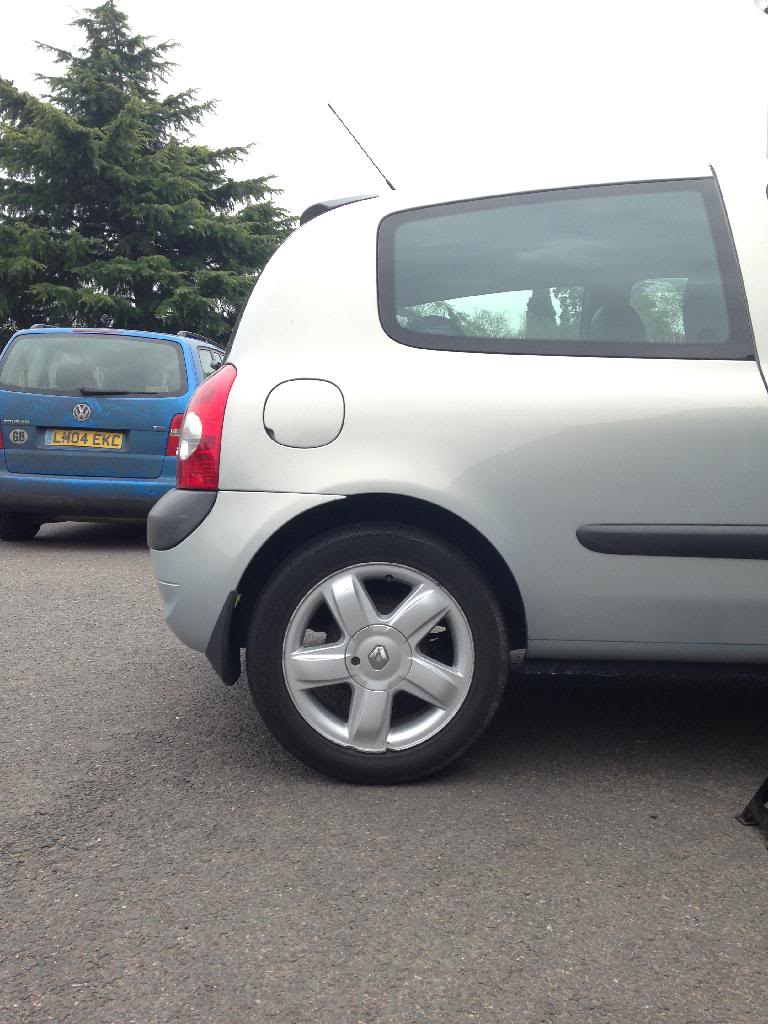

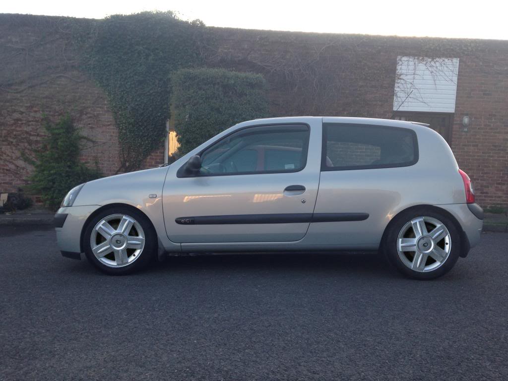

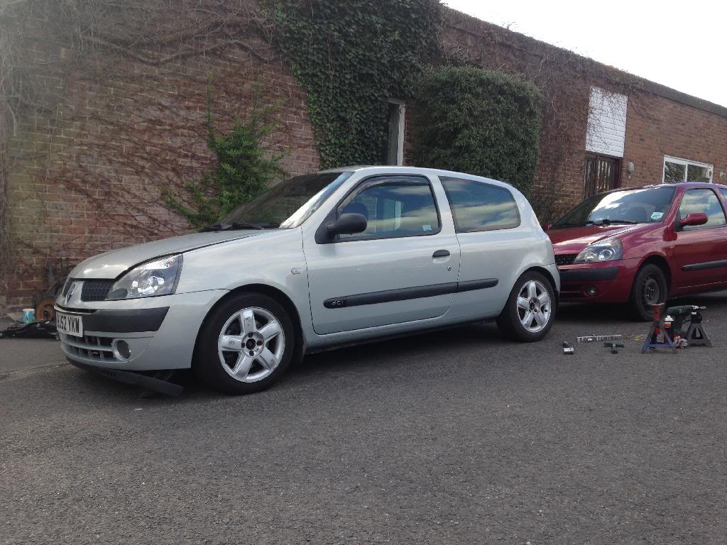

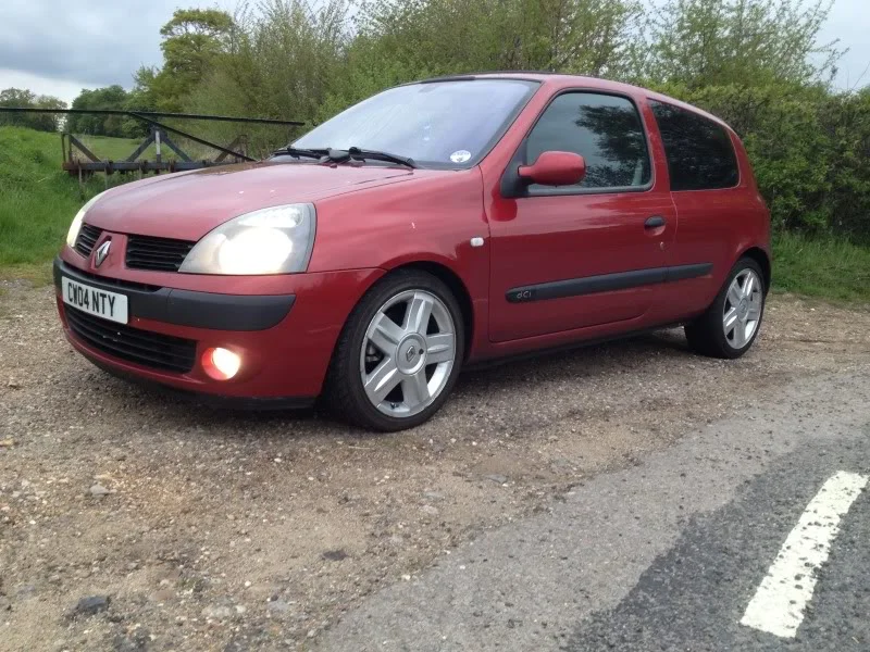

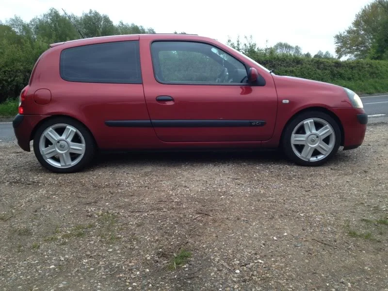

More presents came today in the form of springs. I went for eibach prolines as they came up for sale and the first set I bought fell through as they were misadvertised.
Sportlines are a little lower ya but the red is a little more in your face. Looking like it could have come out the factory that way is what I'm after.

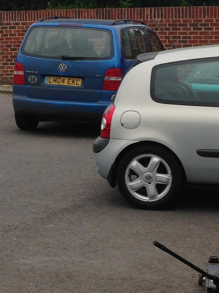

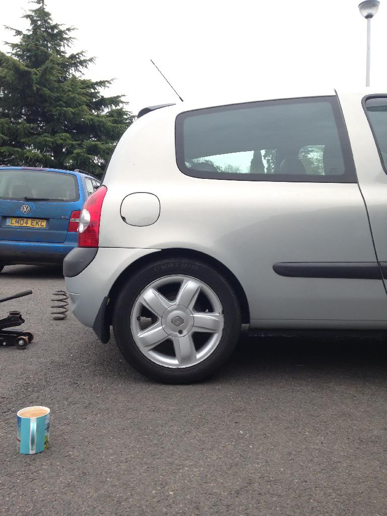

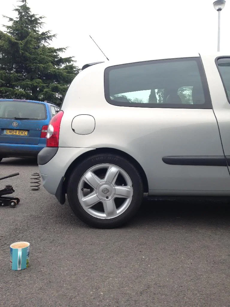

Anywho, thought I'd see what kind of lows they give so put the rears on quickly to have a look. Dropped the rear by 35mm. When I was jacking it down I wondered how much lower it could go!
Before
After
Comparison
Distance
All I'm waiting on now are the rear discs and cat which are taking a while to get here for some reason.
  Many.
Re: DCI 65 pov spec commuter OEM+
Looks good, Went lower than I thought, but figured its due to going to sport height, then lower than a sport, If that makes sense.
Yeah it was lower than I thought too. Am going to try and get the front on tomorrow afternoon/saturday morning. The decat will have to wait a little longer than planned.

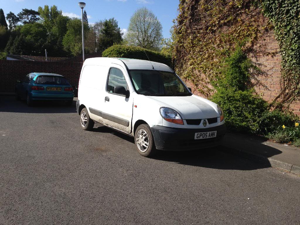

You'll need to do a fair amount of sorting out for the kangoo then.

Ahh that's no so bad then. You're telling me. It's going to involve a lot of piling stuff up to the ceiling!

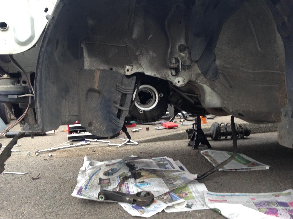

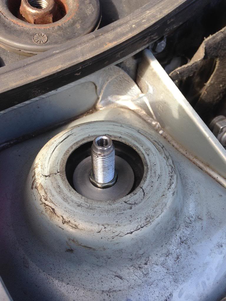

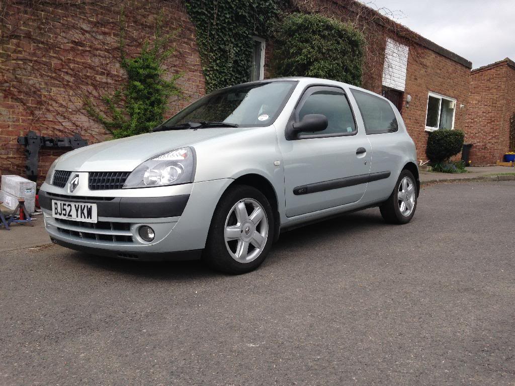

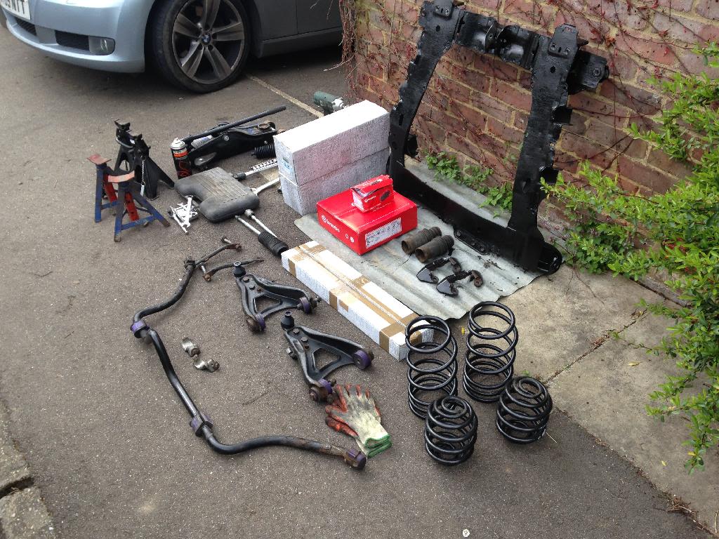

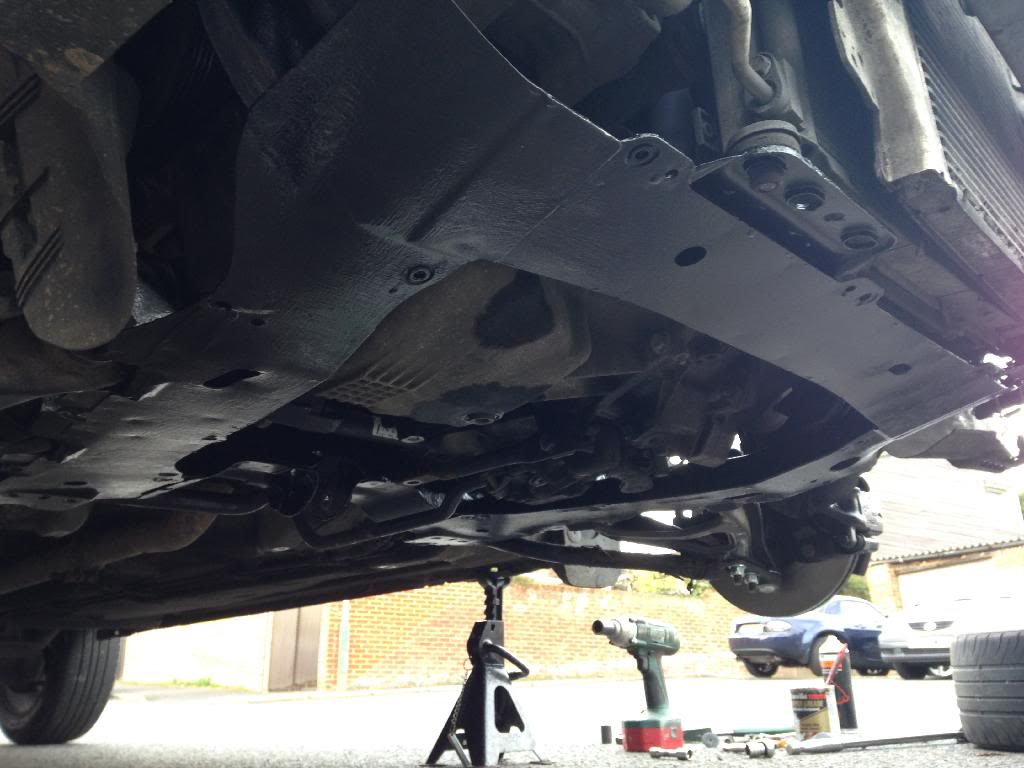

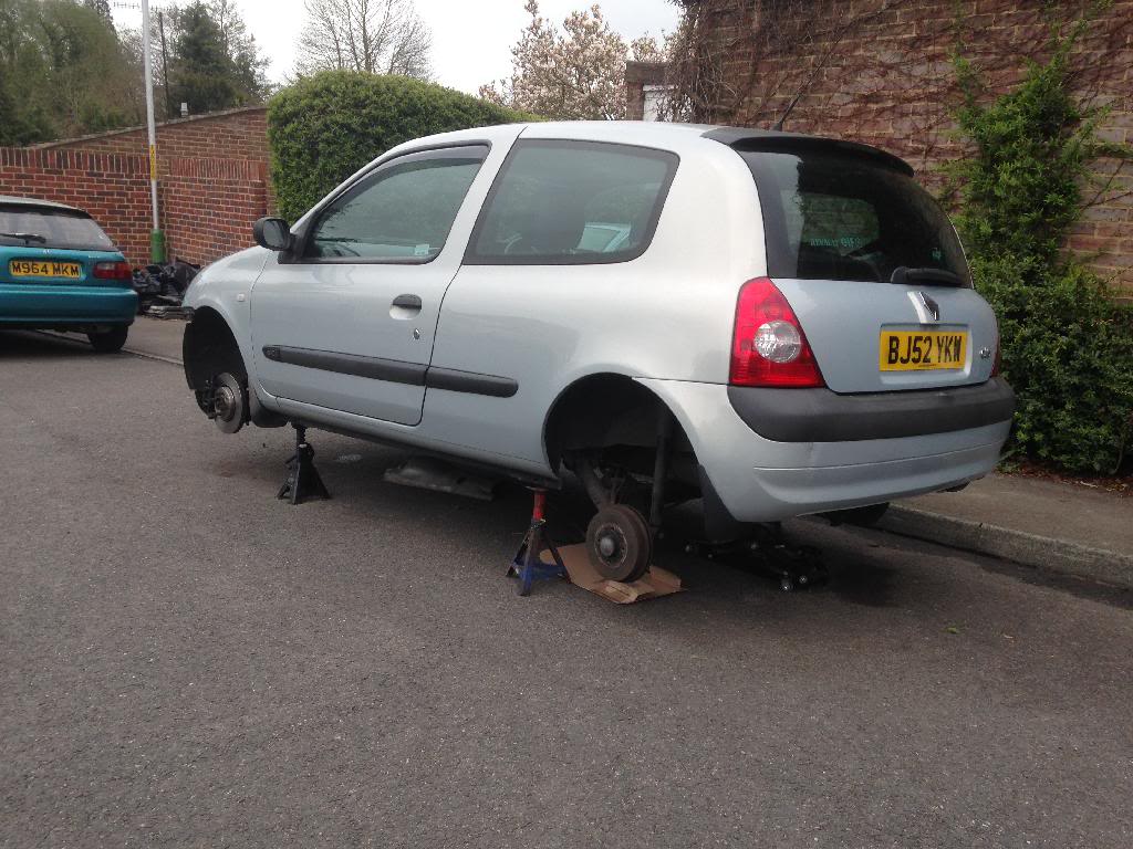

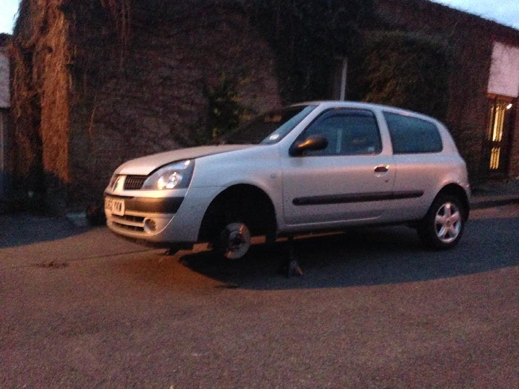

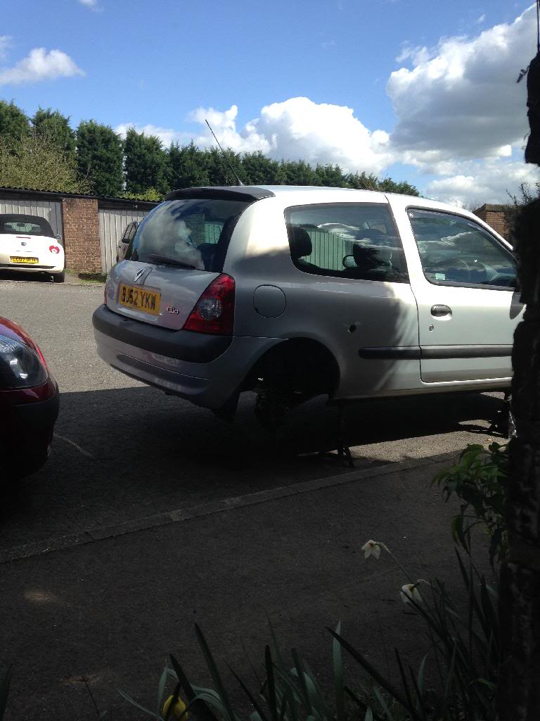

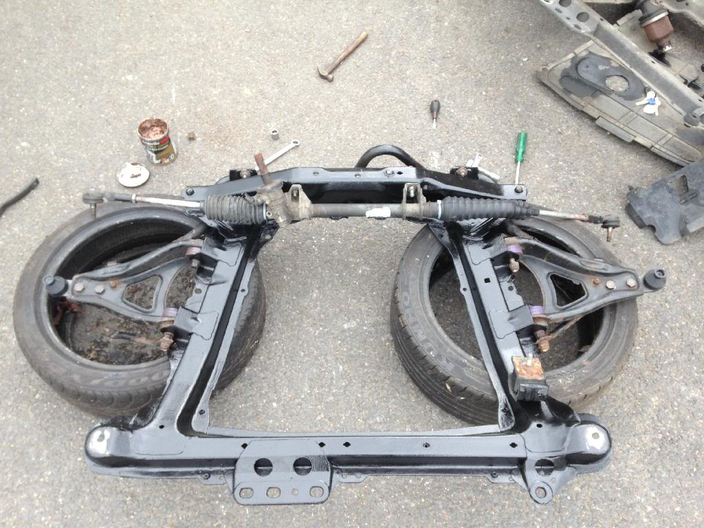

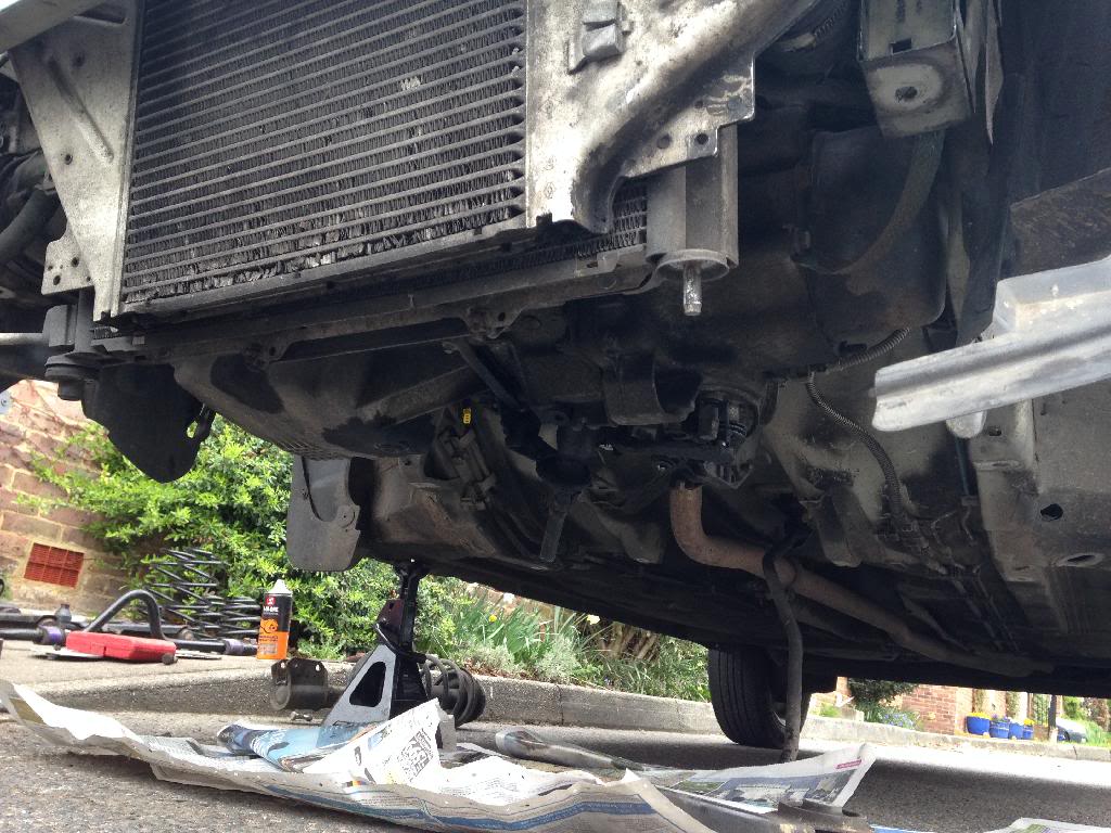

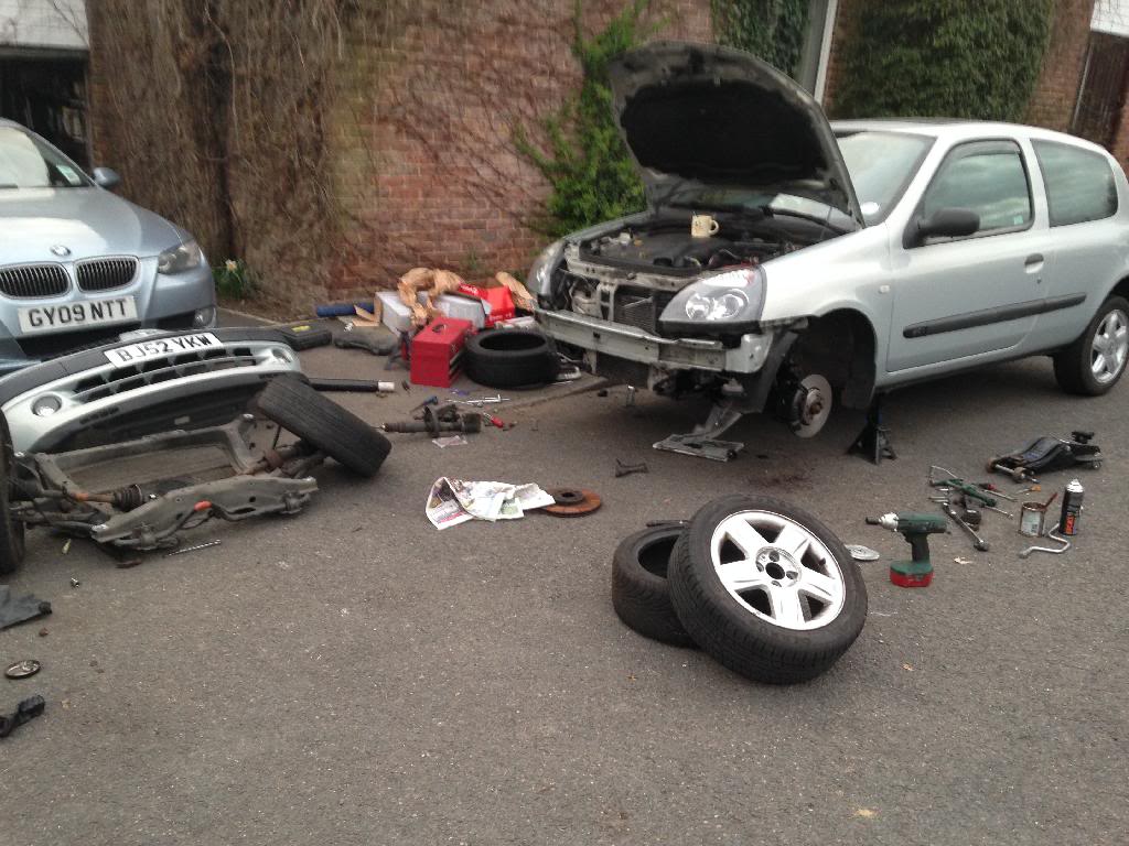

It's at least 1 update a day at the moment. Started to do the wide track conversion on the front today.
This is how the car was before I started

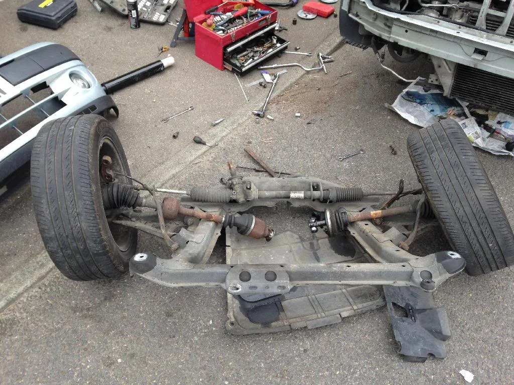

These bits to fit
Made really good progress and got the subframe off in just under 2 hours. HMS Derv Destroyer you are welcome to this if you still need one.

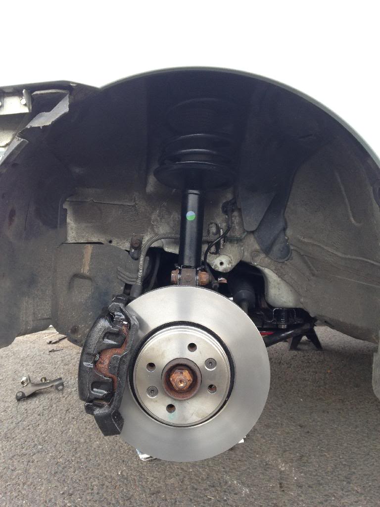

Built up the new subframe. Put the rack on with new inner tie rods and my 10k old tie rods ends.
Decided to put the hubs on sepately this time. Need a clip for one of the outer CV joints as it's got a little leak and found out the o/s driveshaft won't work because there is nowhere for the bearing carrier to mount. Sorting out a 172 cup drive shaft as I'm typing this :)
the front 2 captive nut cages failed when taking the frame off but luckily I had 2 spare from my 182 build this time last year.

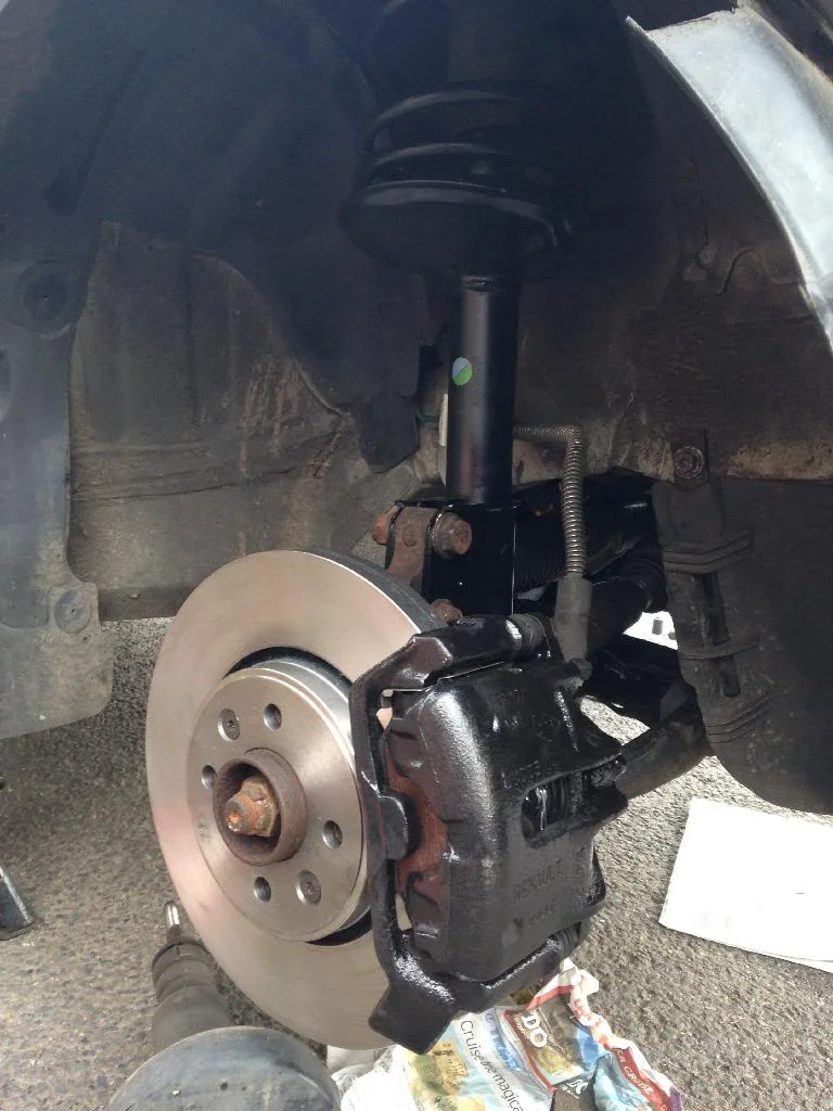

Discs, pads and calipers on
Made a bit of mess
and left it like this tonight ready for finishing when I get hold of the driveshaft
Want to drive it NOWWW
Dr HMS Derv Destroyer

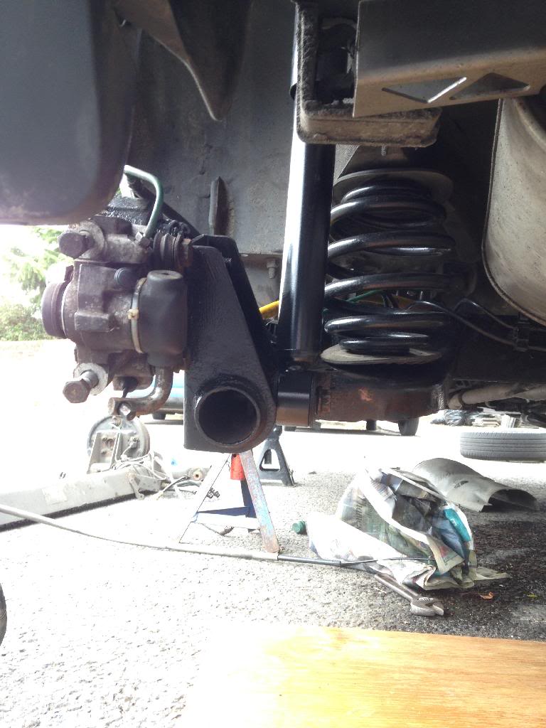

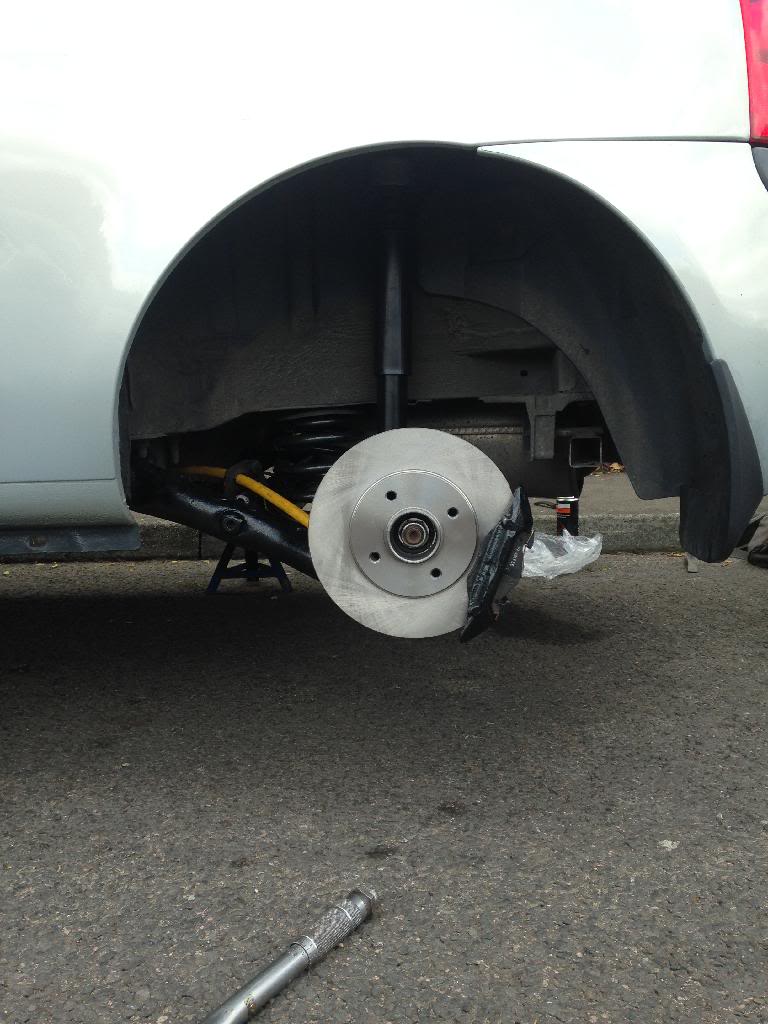

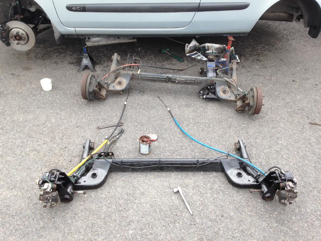

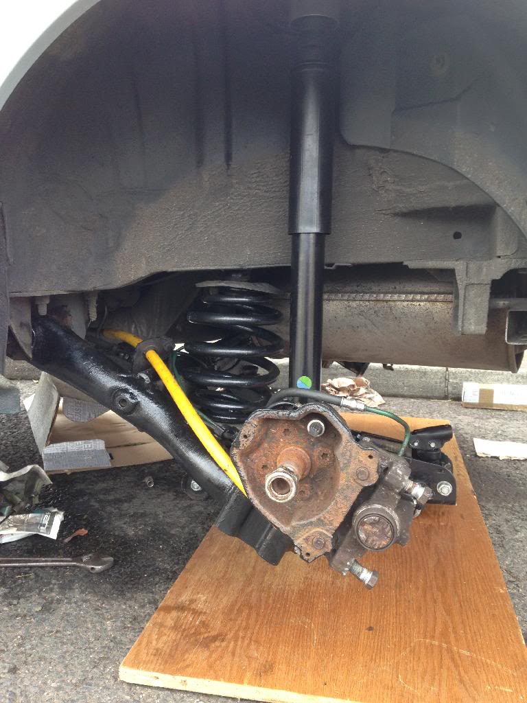

Todays update starts yesterday.

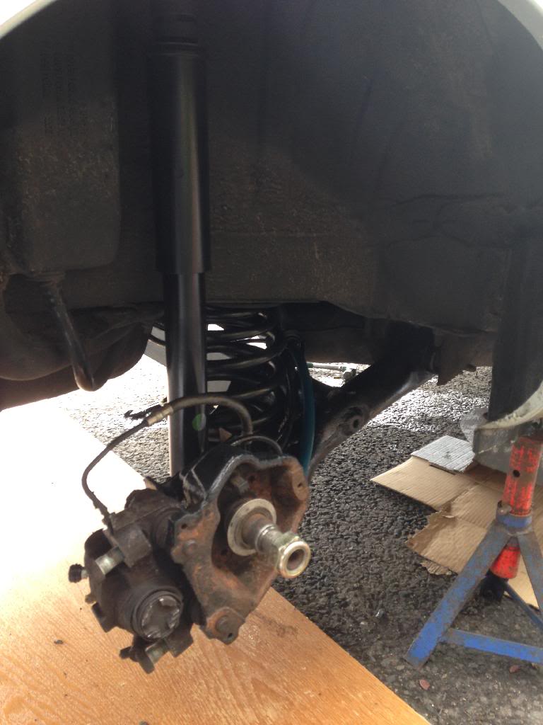

Before the south east meet I started to take the rear axle off but hit a snag with the right bolt. For anyone that knows the design it's the one where you have to drop the tank to get it out. That bolt was seized solid in the rubber bush and the bush was spinning in the axle. Due to the position there was noway of getting anything to hit the bolt with. I used a hack saw blade to cut one of the ends off but it was so awkward and painful this morning I spent my last pounds and bought a dremel which still took half an hour to get this stupid bolt apart.
Last night I got a 172 cup driveshaft from AlexW because there is nowhere for the bearing carrier on the normal 1*2 driveshaft. Just need to put a new CV clip on so I've got a couple in the post along with the proper crimping tool.
Built up the replacement axle, the ABS sensors plugged straight into my loom so I hope they work!
Got the axle on, making sure those bolts had plenty of copper slip on. New dampers and eibach proline springs.

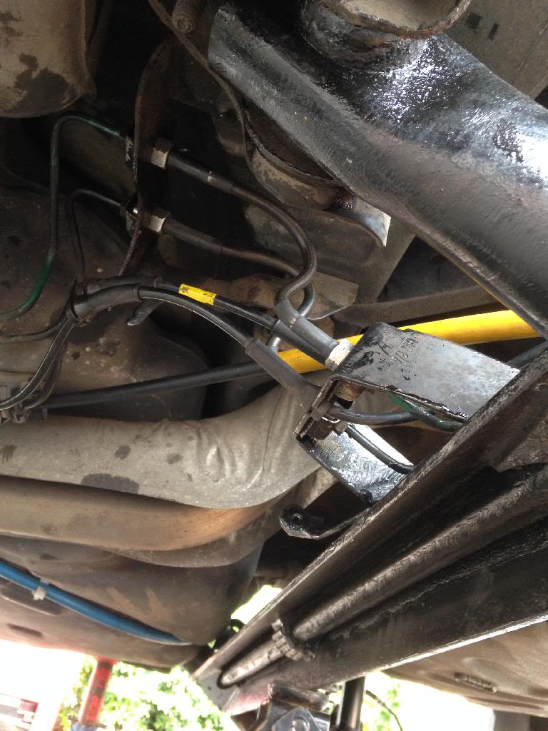

Braided lines

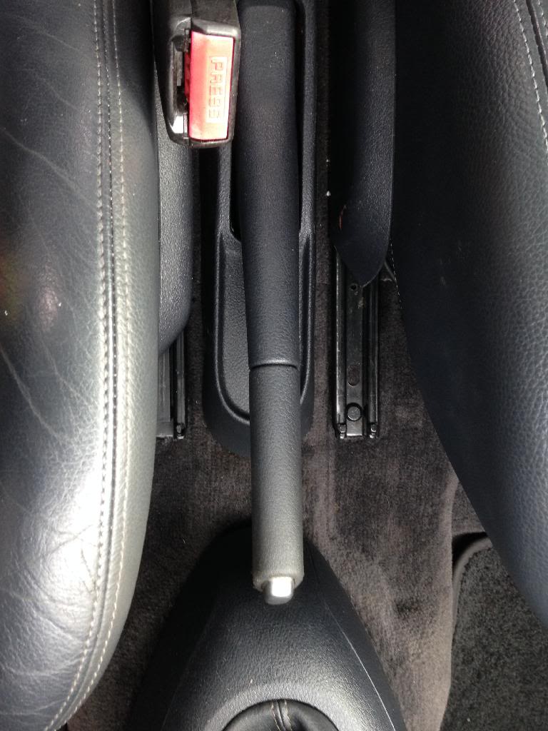

1 little extra mod was fitting my 182 handbrake mechanism which I've means the interior is complete 182 bar the steering wheel/airbag and sun visors (just need wiring up)
Did a couple of other jobs too like bleed the brakes, refit the dogbone, tighten the arb etc
Jobs left to do aren't many now.
Coming on well buddy.
I would have jubliee clipped the CV boots, I much prefer that.
ABS sensors plug in, but its wrong left to right (Double check!), so it'll cause it to pulse the wrong wheel. Get it sorted.
Get that sub axle clean too.
I would have done that today if I had a car to go and buy some. Shouldn't have sold the bike ha. Pretty sure the jubilee clips hit on the hub if I remember correctly, maybe that was another car I did the boots on.
Is it? I'll have to have a check as I thought they were the right way round. Another job wahh

Yeah, if its round the wrong way, I'd repin it at the front (unpluggs around the subframe supports), If you don't feel you can do it, I'll do it for ya.

I think I know where you mean from when I ripped the 182 apart. Should be able to take the whole of that loom section off if I remember right.

Once this one is done I'll have the Kangoo to sort......joy

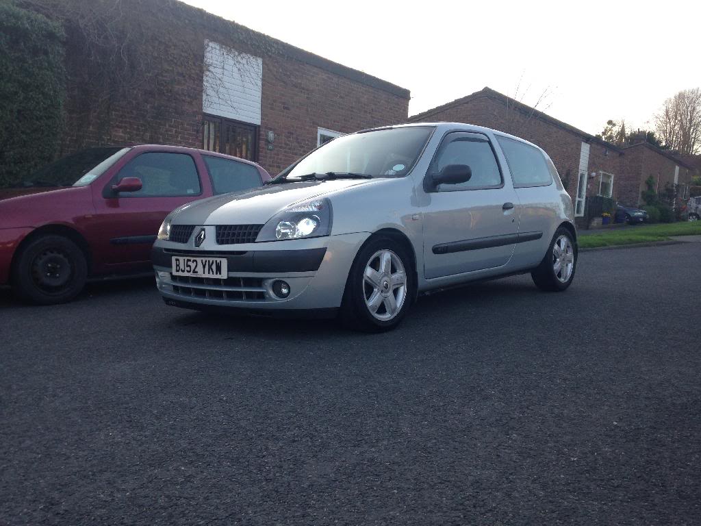

IT'S FINALLY FINISHED (sort of)
So my rear wheel bearings didn't turn up today in the post which I was less than happy about. Car was sitting like this and every time I made a tea I could see it looking sorry for it's self.
@AlexW I checked the ABS plugs and they are the right way round. Are you sure yours weren't also as I know you had an ABS issue.
A 12 mile bike ride later I was back home with some euro car parts bearings. Got them pressed in and the rear fitted up and down on the ground.
The photos are before I did the driveshaft boot clips and hence the scruffy bumper fitting etc.
Christ the hub nuts were tight. Not even @TomSmith123's weight could move it. I jest I jumped on the breaker bar and it moved in the end. Nice chap at the local garage lent me his cv clip pliers as my ones didn't turn up in the post in time.
Reassembled, accidentally poored half the gearbox oil on the floor so I'll need to get a little more of that tomorrow.
There is a little wiring noise when driving along but I've only driven it up the road. I suspect a wheel bearing as they've obviously sat for ages.
Brakes need bleeding with the engine running because of the servo/abs pump. Then I should be sorted for some miles on Thursday morning.
She's stiff!
More photos tomorrow when it's completely finished as it's too dark to take any now.

Driven the car for about 200 miles now and it's just amazing. Feels like a new car, I'm not exaggerating, the steering reacts immediately and is so planted. Would recommend a refresh to anyone :)
This weekend I've done just over 200 miles which was fun although raised a couple of small niggles. There is a really light vibration which is speed related. I think it might be the jubilee clip on the n/s driveshaft so will change it for a normal type clip. If not it can only be the wheel bearing o/s wheel bearing. The speedo is driving me crazy being so out. AlexW brought me down a 44 tooth ABS pump the other day to swap over but I'm going to swap the ABS rings to 26 on the driveshafts and rear discs as my girlfriends ABS pump broke today and is going mental so needs replacing. Black DCI was quick so now desperate for a remap!
Other than those bits I'm really enjoying the car, can't wait to get the decat on and cruise control back :)
I've just written up a quick guide and submitted it (attached). Thoughts on that welcome

Red DCI, got that to pass the MOT which was nice considering it's had a hard 155k. 2 new lower ball joints and one of my old drums for the bearing. The headlight aim was out and the chap suggested I tried to repair the headlight adjuster (have done now) but I didn't have time then so I tore the bumper off my car, swapped the headlight over, got it to pass and drove home without one. Couple of people waiting for their cars were a little confused as I was in a suit tearing cars apart.
Silver DCI 2 (Lauren's) is broken at the moment. Pretty sure it needs a new battery among a few other small things that I will sort for her birthday.
Silver DCI (mine) Fitted a new dogbone as my old one was kaput. Also got the lower gearbox mount but yet to fit that yet.
Driven the car for 700 miles now since the conversion so I've had a little time to pick holes in it. Need to do the tracking again as it's just a tiny bit off, still need to do that clip on the CV and I'm still waiting for the cat to turn up so I can rip it apart. Worst of all is I have this small knocking when going over bumps in the road, similar as described in another recent thread (http://www.cliosport.net/forum/show...with-new-mounts-and-now-I-have-a-knock-!-HELP). Would like to get this sorted.
In other news I am picking up some 172 alloys on Monday. Unsure if I will like them or not as I think they can look too big and non-oem without a sport body kit, will have to wait and see. Here's a quick PS I did.
Before
After (terrible PS)
Last but not least, got the £100 kangoo, 100% had petrol run through it, need to assess the damage in a month or so.

I think 172 wheels will look awesome. I really liked mine like that before it had sport kit etc. I'll dig out a pic when I get home.
  Many.
Pics....
I truely miss the looks of my car here, although I do think it looks even cooler now.
Do it, it'll look even better with yours having wide track.
