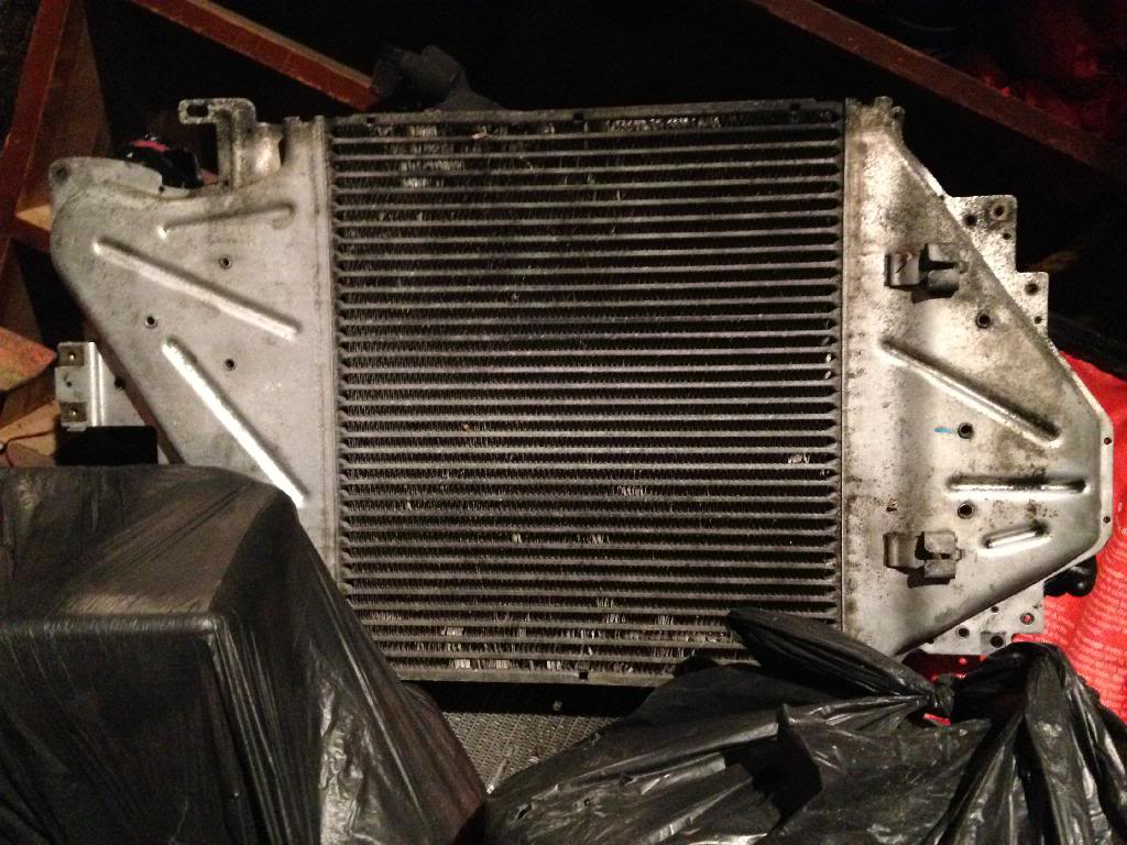

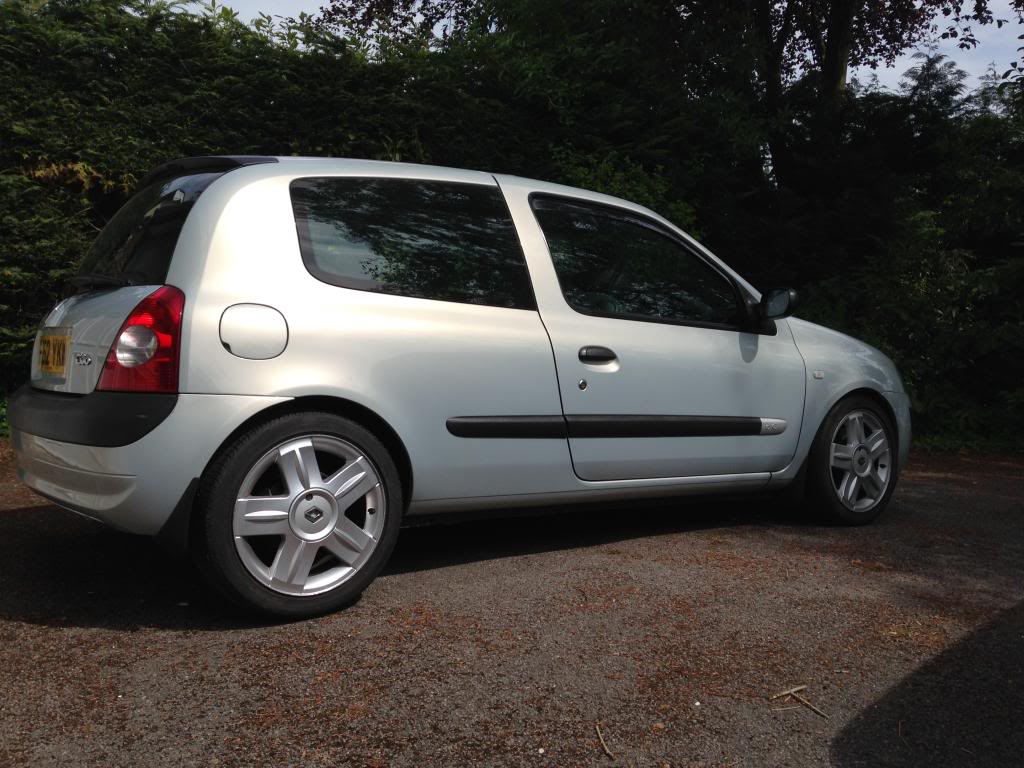

First pick up was a DCI 80 intercooler and pipework. Not sure what to do with this. I was going to put it on the red dci but am unsure at the moment so we'll have to see.

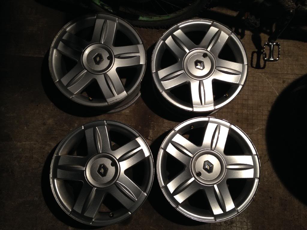

Also got some 172 alloys for £80 which I was really chuffed with. Came with 3 tyres around 3mm but as I'm OCD I'll probably get a matching set of part worn p zeros like I had on my old car.
GrahamS
Re: DCI 65 pov spec commuter OEM+

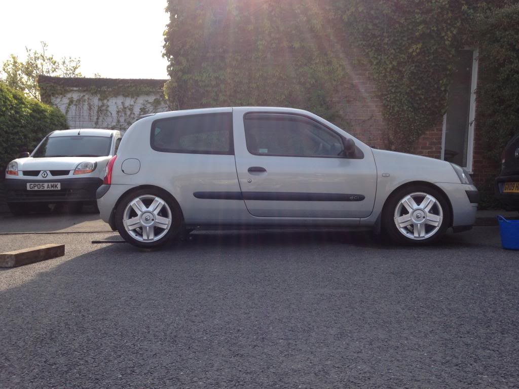

Clearly the 172 alloys don't have tyres on but today I put on on for the sake of getting the right lighting for PS. Still think they're pretty huge for the car. Definitely have a little more poke (7mm) precisely from the rim and sit 17mm closer to the strut.
Thoughts welcome as always!
I'm inclined to keep them as I can see where my project is going but don't think they're quite right on the car yet. Aiming for something like this in the end but not for well over a year (stolen from someone else)

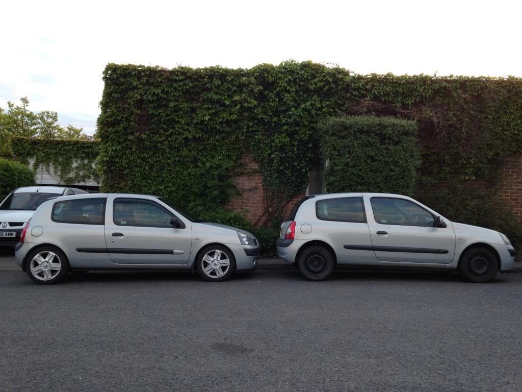

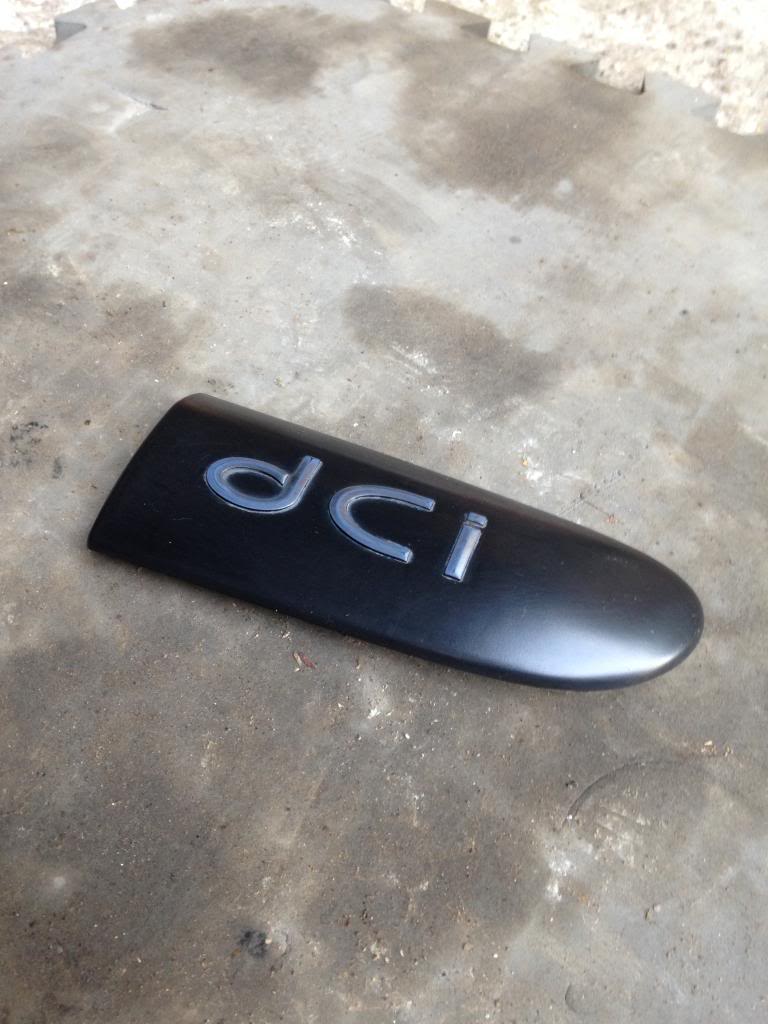

Little update.
Cliosport sticker. First person to spot me gets a tenner donated to Shelter, bet I won't be spotted though!
In the week I got 4 bridgestone turanza er300 with 5mm or more on each for £100. Put them on the wheels and now they're on the car. There is a funny hollow running noise now. Possibly excentuated a ropey wheel bearing on the o/s. The only side which isn't brand new. Don't look too bad though. I'm sure they will grow on me in time :)
Next thing on the list is probably a little colour coding of side strips, handles and wingmirrors. Not sure how much it will be to have all these little bits painted up though.

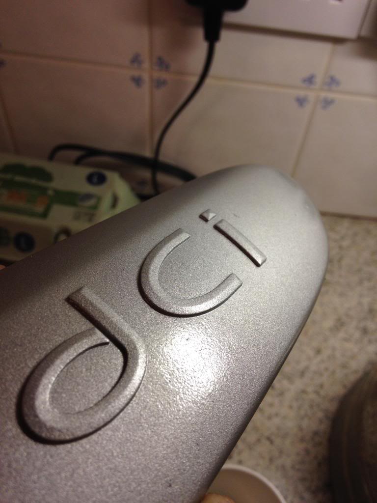

Finished my exams for a week or so today so got a little bit done to the car as a reward.
Sprayed the other bullet as the other one looked rather nice.

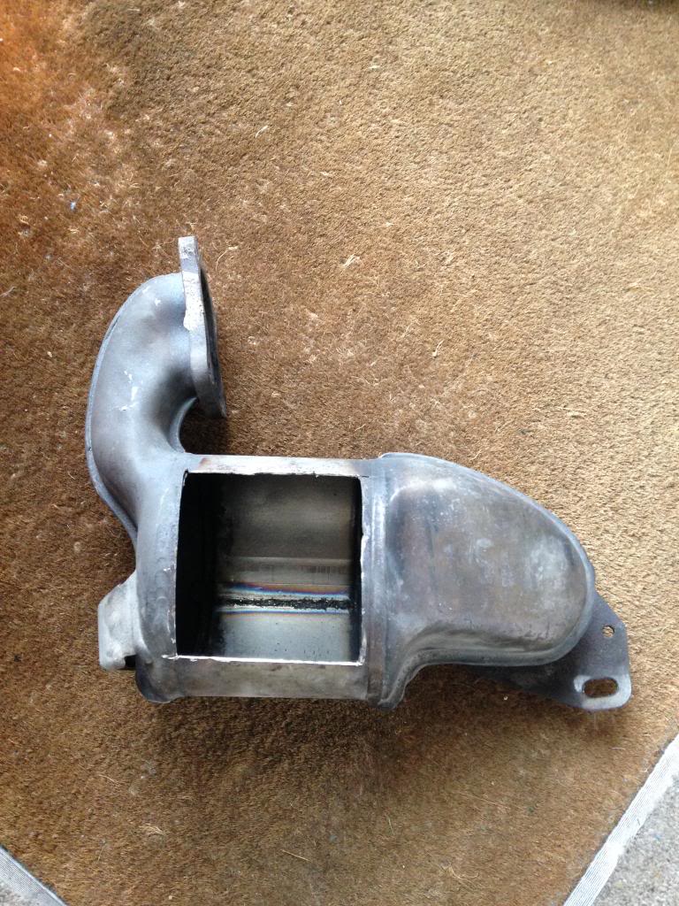

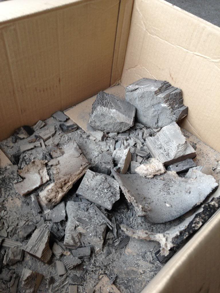

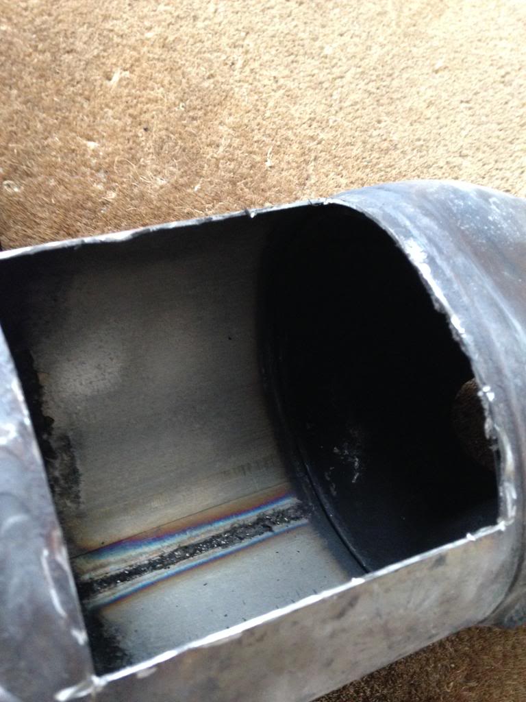

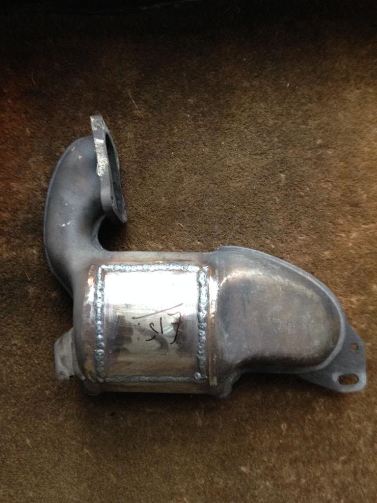

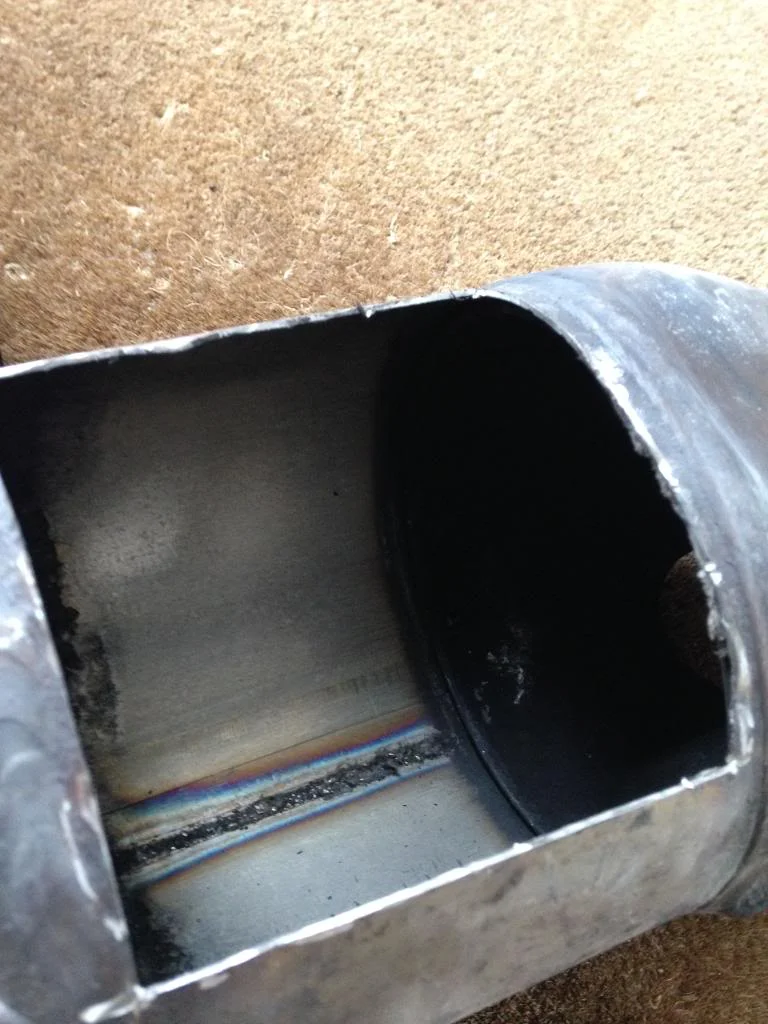

Main mod today was the decat. Bought a spare from ebay to sort out before fitting. Cut a square out with the dremel and smashed out the inners. Swaped the inners with my neighbour for a rather old 5l can of autoglym wax. Had it welded up by Laddingford Engineering. He said he would have had it done quicker if my car was German. Nice and easy to fit, took about 90 minutes.
No exhaust note difference. Can hear the turbo a fair bit more in the car. Spools quicker, revs quicker and the car is definitely quicker, chuffed!

Back box off and then all hell breaks loose! They sound grumpy as feck with a straight through.
Mines slightly annoying on the motorway with a straight pipe and a proper decat pipe tho.

Decat looks good though! Same improvments that I noticed. You've heard mine with straight through etc.

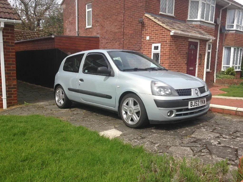

Gave Claude a thorough external clean yesterday as he hasn't been waxed for 6 months and was in dire need of some attention. Plastics were turning grey and there was a serious amount of tar on the arches. Finally managed to clay the majority of the silicone on the roof which had run when it rained.

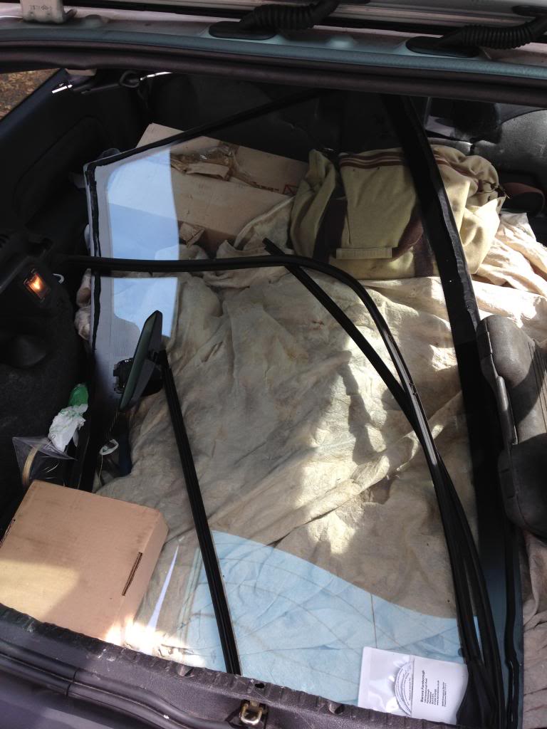

Today Ren and I went to Worthing to remove a rain sensor screen. Bought a cheese wire kit from ebay which was really good and took the screen out rather quickly. Very paranoid the whole way home about cracking it but we survived. Should be getting it fitted this week if I can find someone to do it for cheap enough.

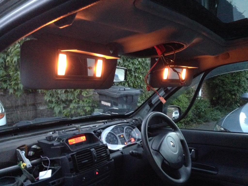

Screen being fitted tomorrow. Couple of mild concerns. I've gone into the UCH and under read configurations it shows Rain Sensor not active of course. When I've gone to change it it only gives me the option to change arabia speed limit (or something like that) or whether there is variable wipe speed on intermittent. Thoughts on that if possible please. The rain sensor serial line is in place. UCH is N2 but if it displays it's turned off it gives me the impression I should be able to turn it on.
Other update, finally sorted the feed to the sun visors so now it's glamour friendly.
