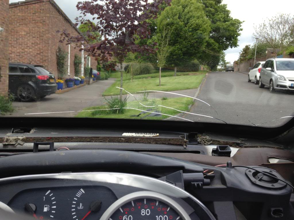

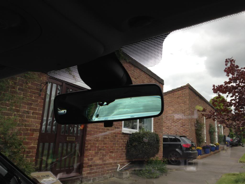

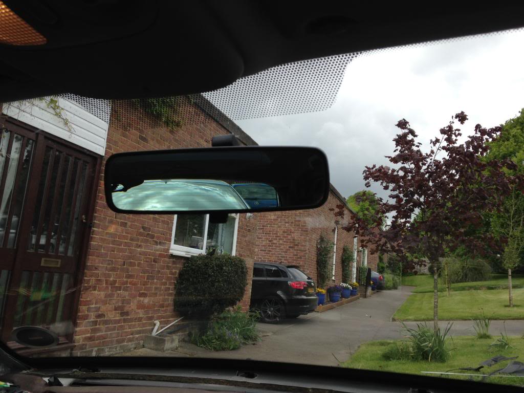

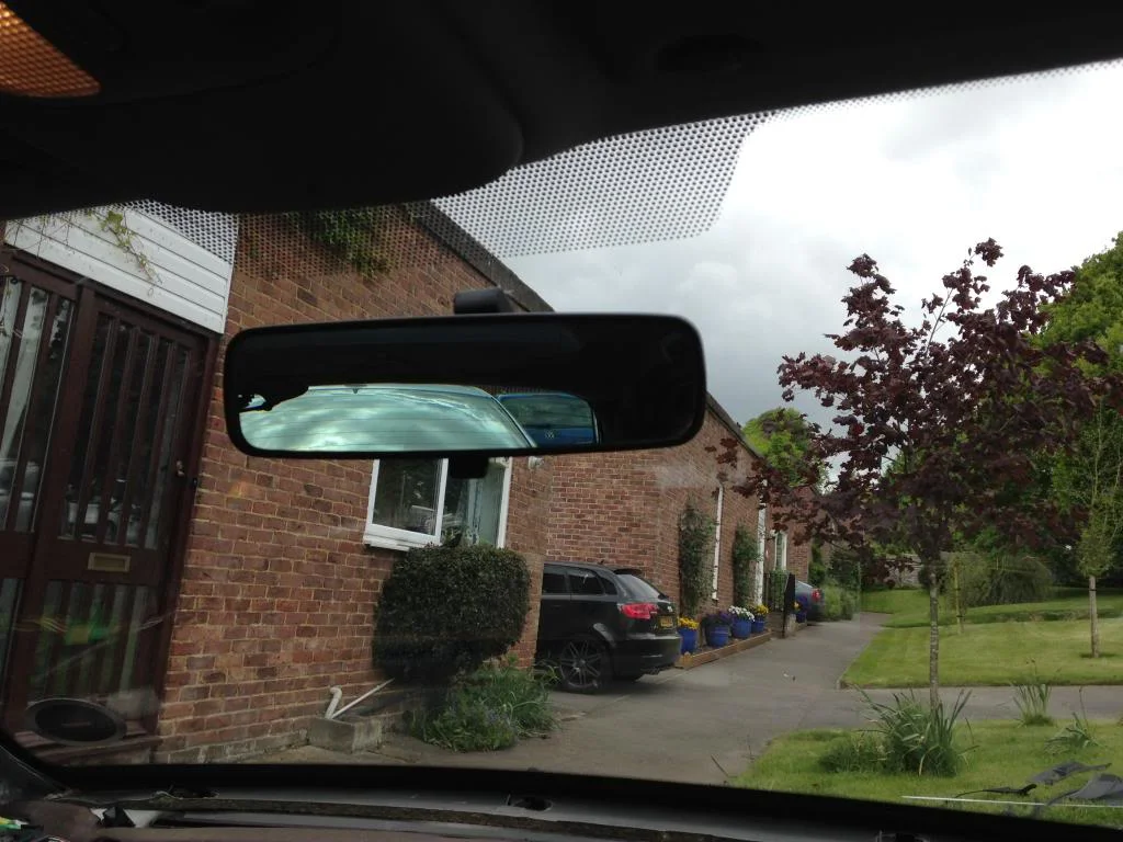

Screen now fitted, ta da

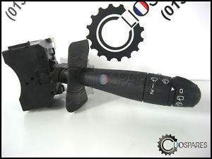

Still haven't got the stalk but it's on its way. Pluged into clip it still only gives the option for variable intermittent instead of rain sensor so I'll have to wait for the stalk to turn up before looking into it anymore.
In other news; I should be picking up a colour coded spoiler tomorrow afternoon. Who knew it would be so difficult to come across one.

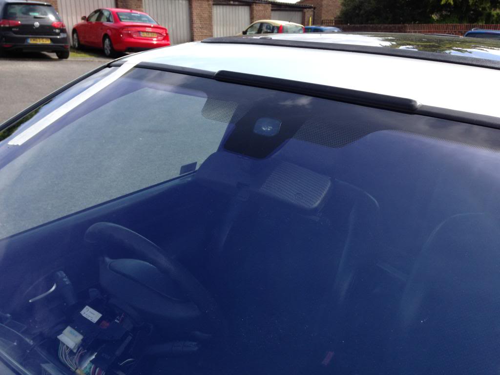

What gel you used for the sensor? I need to repack mine as it's getting s**t at sensing rain.

Looking good. I didn't think you had to change the stalk, since you can go from Auto to Intermitten on the same stalk.
Have you actually got a stalk coming? I have a couple from sports, so all auto wipers etc, freebie.
Screen looks good though :)

Nah the sport / auto ones in sure are
off
auto
speed one
full speed
sayung that I'm sure intermittent might be auto after all.

Yeah, auto/intermitten use the same position. Only way it could be a different stalk is the varible wipe intermitten/sentivity, but I can't imagine Renault made two stalks, that effectly do the same job. Switch to Pos one and then differing resistance...

@AlexW crap, completely forgot you had a stalk. One is in the post though. At the moment I've got this type. As you've both said, stalks are the same for intermittent and auto. Unsure if the stalk will cue this though. Likely needing an N3 or some serious clip talent.
@HMS Derv Destroyer hope my auto data defectiveness helped in the end. On clip under rain sensor monitor when my stalk is on the first setting it says the stalk is not what would be the "Auto/variable" setting so the stalk must be causing at least 1 problem.

Ahh! I assumed you had a varible intermitten stalk!
I reckon it'll work with the proper stalk then.

Stalk should be hear tomorrow, need to turn the UCH off variable intermittent as it thinks it's on ultra quick intermittent at the moment which is annoying. There isn't the option at the moment Alex, it just says whether it's programed in or not. Most odd but I'm sure there's a way around it, otherwise I'm going to be stealing Ren's N3 secretly. 1 touch passenger window is there but also isn't an option when programming.

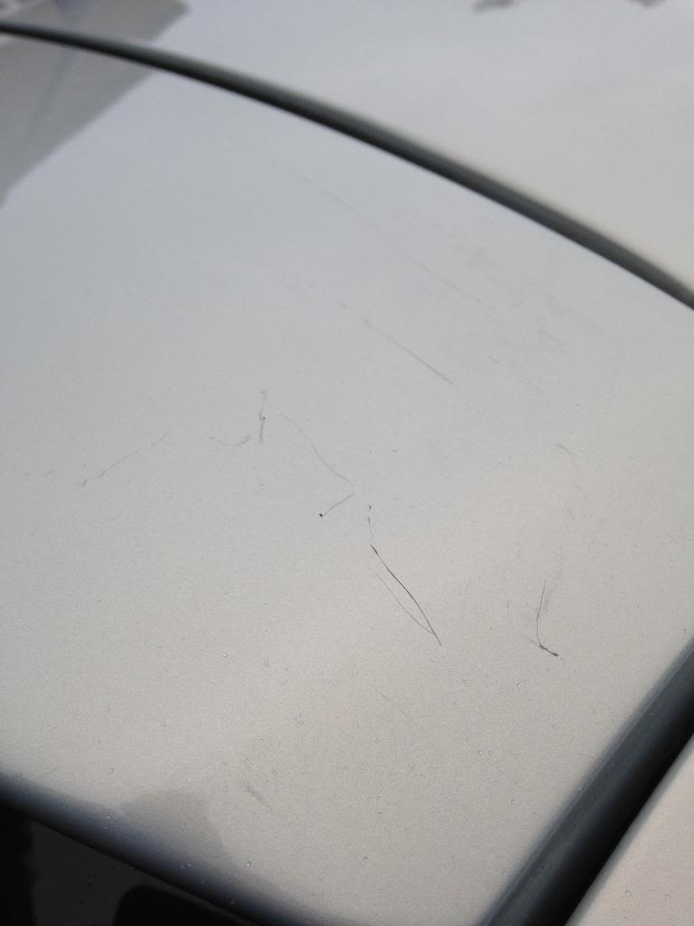

Anyway, todays update is the spoiler. Load more scratches than I wanted but I've tried to clay and tcut as much of it as possible.

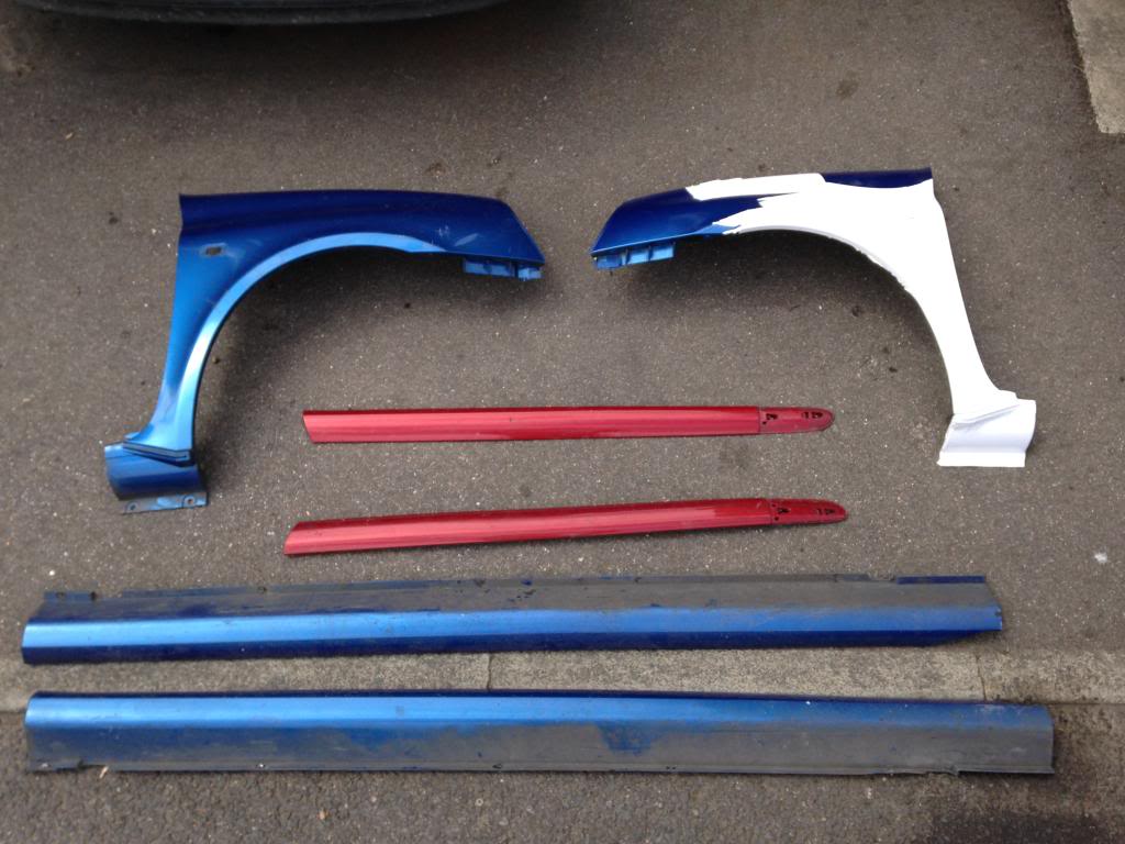

I have a rear bumper that needs paint, so cheap, along with skirts you can have for free. Might even have the clips to hold them on.
I may have a pair of wings too, all cheap as its Cup blue, so nobody wants it.

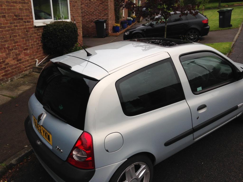

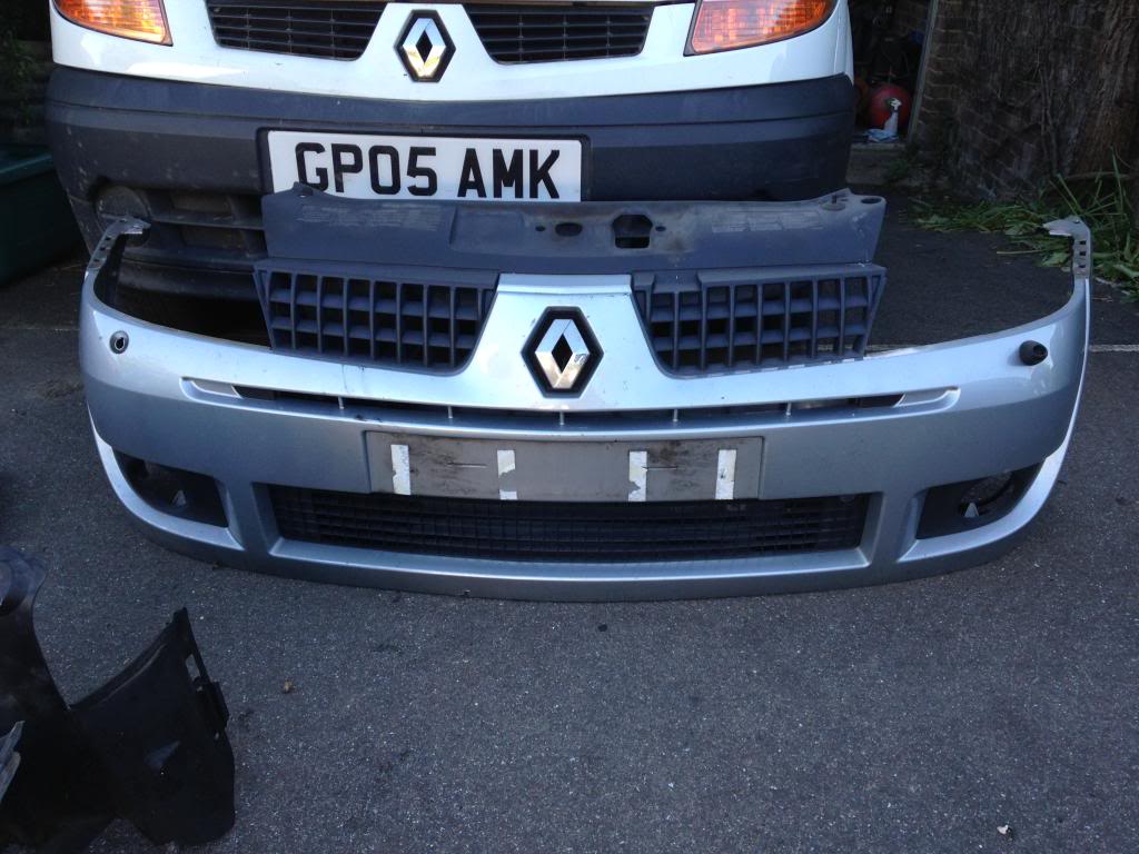

Bought a sport rear bumper last night and took it to the The Bodyshop in Sevenoaks. Run by my friends brother who always does lovely work and will have it done in the week hopefully. £80. He's going to order enough paint for the whole sport kit so when I need it all doing it'll be ready to go. Took my fuelcap to get a decent match with the 1/4s
Whilst I was there he mentioned he'd bought a car with a blown headgasket that just so happened to be the same colour as my car but ph3 so had some tasty colour coded bits. I yoinked the wing mirror caps and may take the slightly less damaged spoiler next week. Cheap parts on the rest of it if anyone wants stuff (front end is gone) as it's going to be scrapped. N3 uch etc
Just need to sell some stuff to fund this a little more now! It's so close.

This is a completely pathetic update but one none the less.

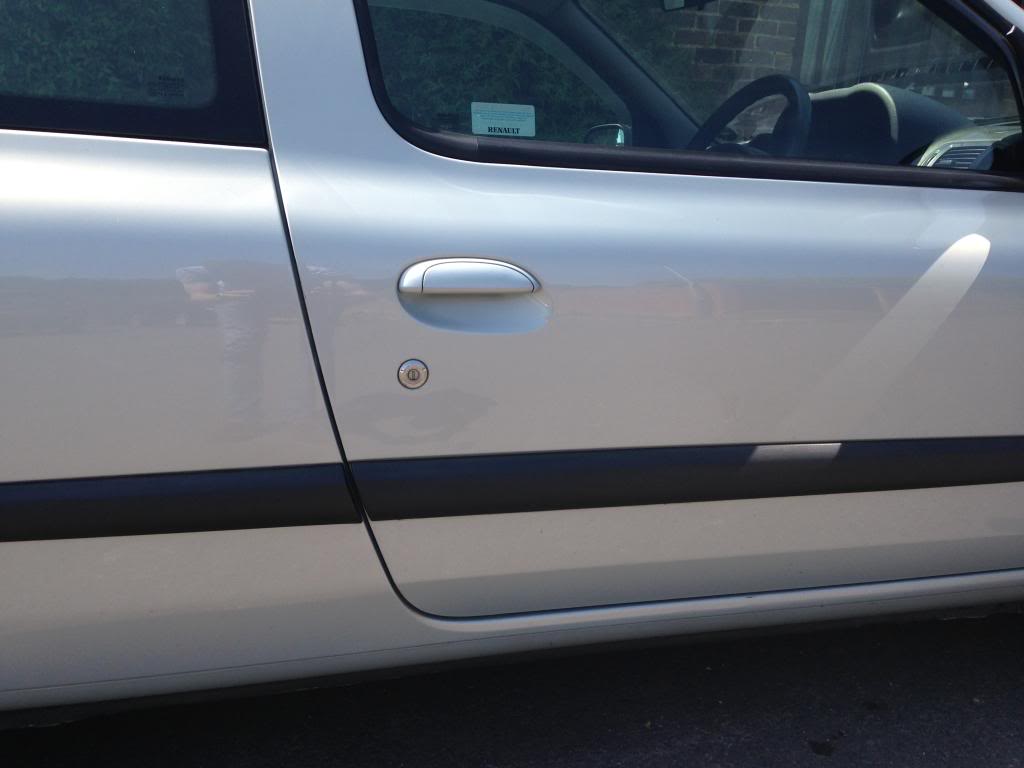

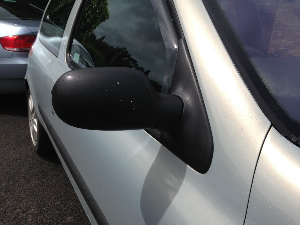

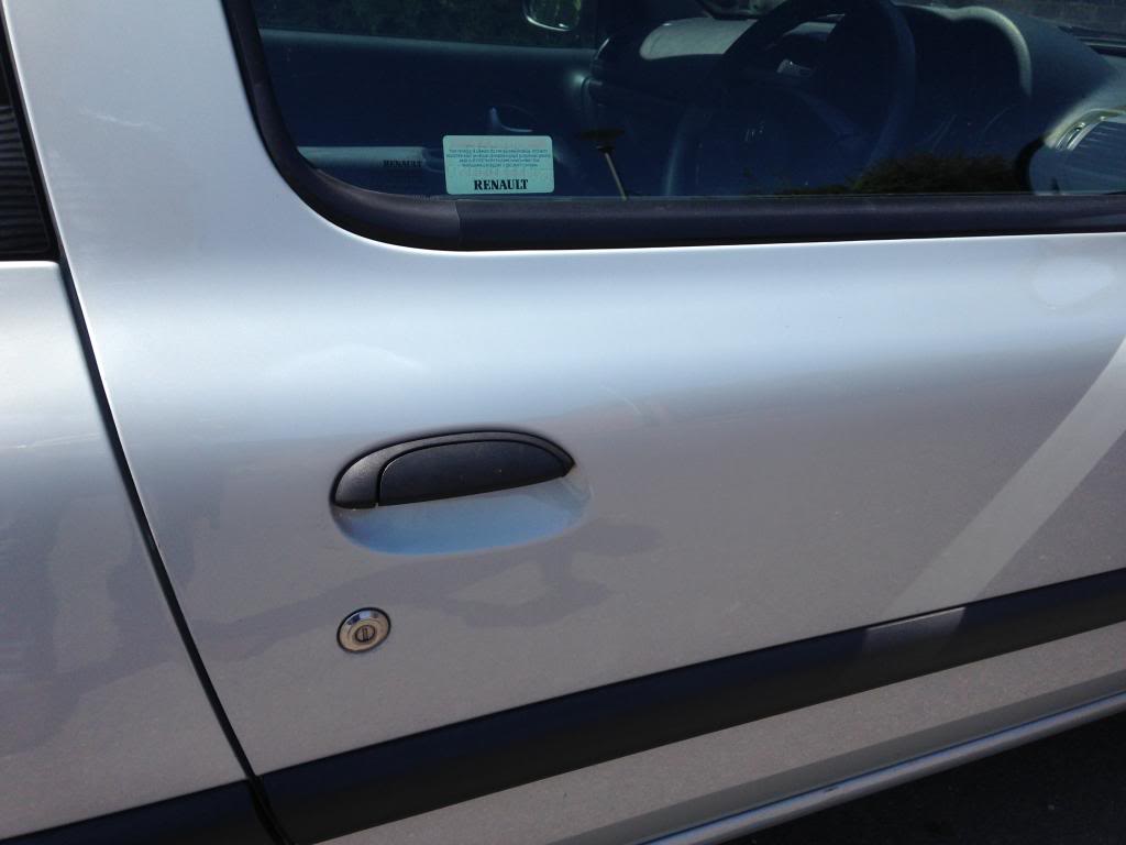

Got a set of scenic handles which are the correct colour code. Have a set of 4 so 2 going cheapy if anyone fancies doing a similar thing. Fitted them in my lunch break.
Rear bumper in paint currently so will have that on sometime next week.
Yesterday I went for a nice drive in the new forest so took a terrible snap.

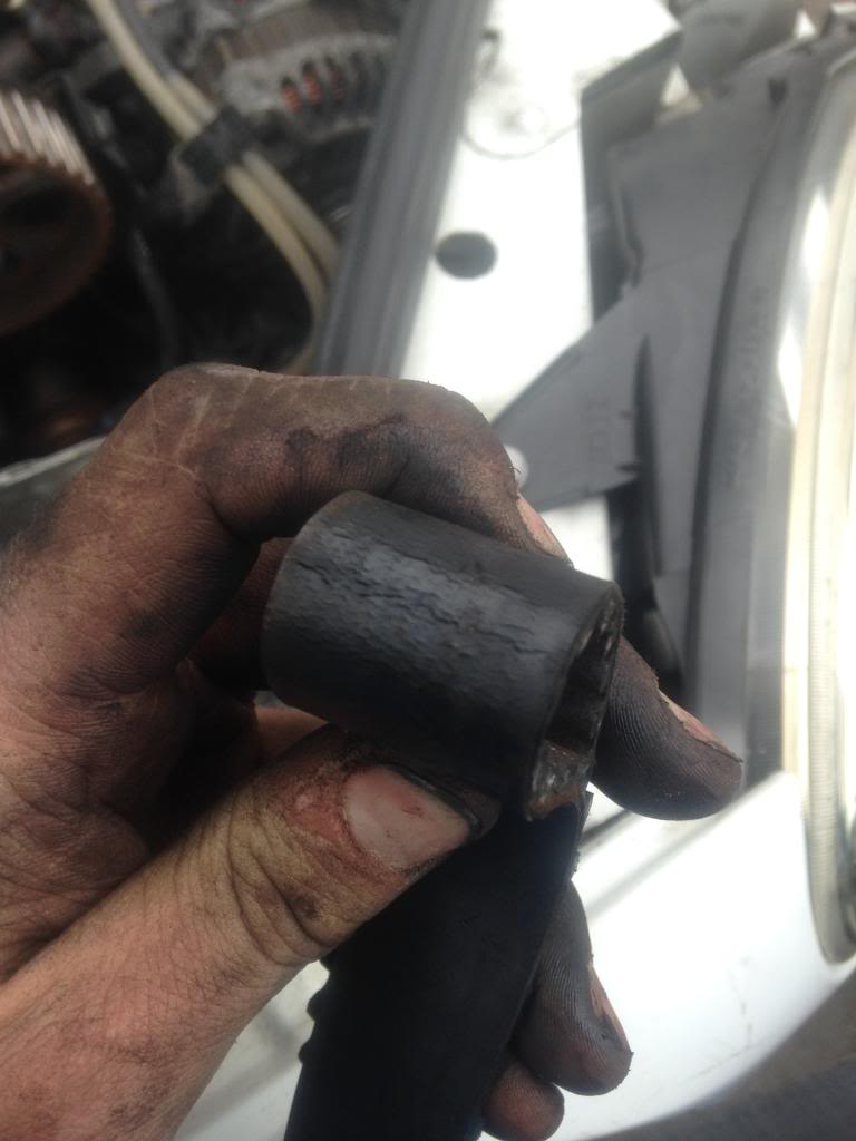

Also got a new radiator hose so will be fitting the 80 rad at somepoint soon. Just need to sort the AC condenser which turns out is a really difficult part to come by second hand.

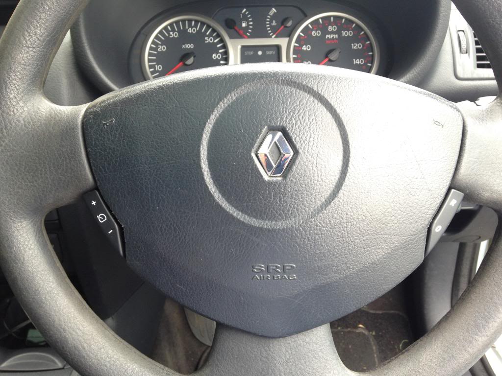

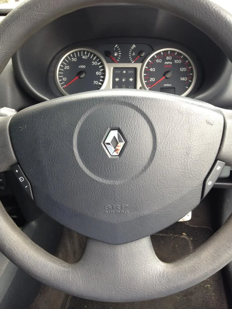

Last but not least I've bought myself a sport airbag so I no longer have these horrible cut marks around my cruise switches. Have been looking for a new steering wheel and all the standard sport ones are in tatters. Having seen a mates twingo I noticed the steering wheel in his was the same as mine so now I'm on the look out for a Twingo 133 steering wheel.

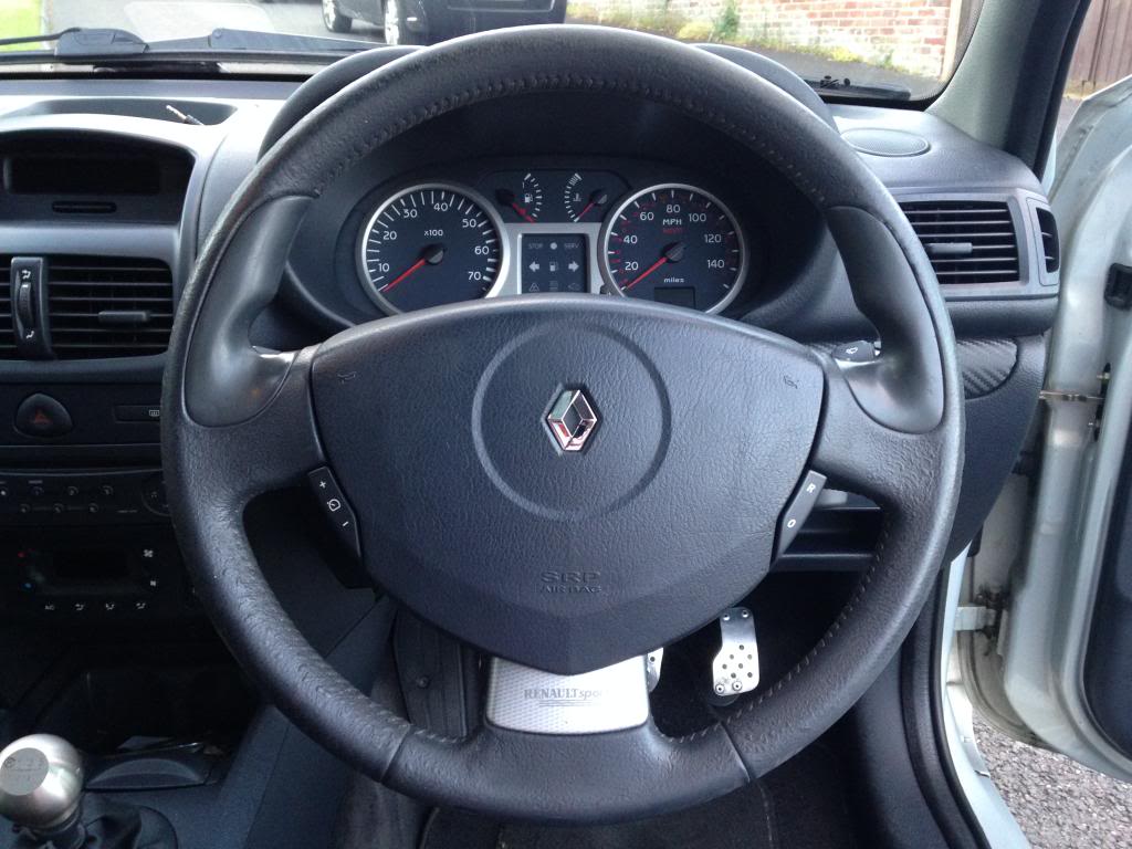

I am absolutely bored stiff so have done some even more boring jobs than yesterday.
Airbag came and on the parcel was written "Glass do not drop" which made me laugh. Is a lot nicer to look at compared to the old one.

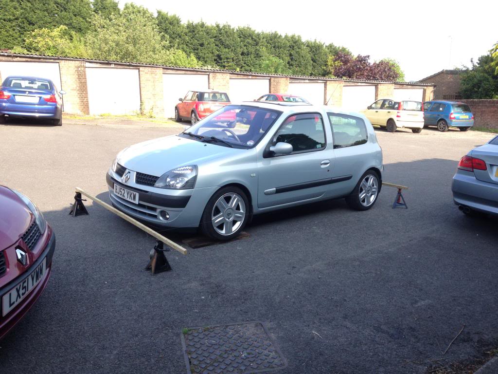

Did that one job which I absolutely hate doing but is so worth it. The steering wheel was always left when going straight even though I'd done a quick stringing session after the wide track conversion. Spent a lot longer doing it today, wood under the wheels to release the preload on the tyres when adjusting made it substantially easier to get spot on.
  Many.
Airbag is mucho better.
Are the Twingo and Scenic definitely the same spline fitment?
I bow to you doing your tracking like that, I'd much rather pay for mine to be done. Even using the dunlop gauges my mate has, I just CBA!
GrahamS
I have absolutely no idea! The twingo wheel in the more basic spec ones is definitely a clio wheel with a more fancy airbag design.
Tracking like that is not fun. I almost have up. Steering wheel is probably less than a degree off bang straight now though. Was at least 30 before. Much better for cruising on the motorway. Really need some turntables though and a steering wheel clamp (currently my father)

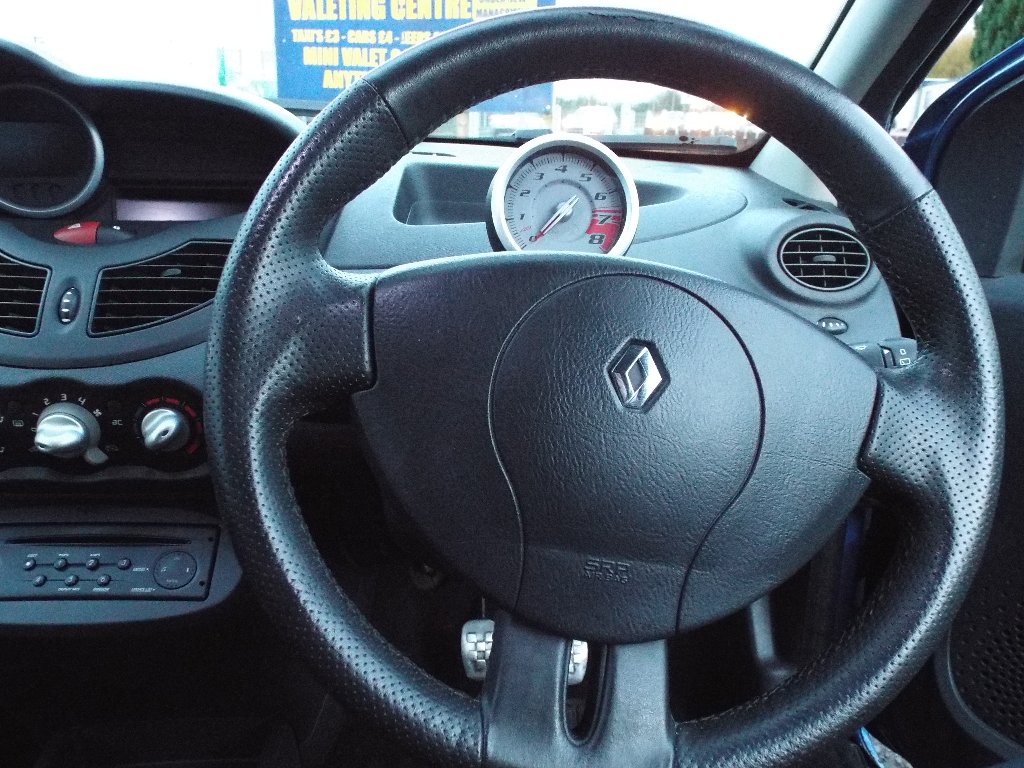

I caved and bought a normal 182 wheel from ebay. Apparently it's a good condition one. When it was first listed I asked the seller what she wanted for it but she wanted £100. Good job I won it for £37 then isn't it.

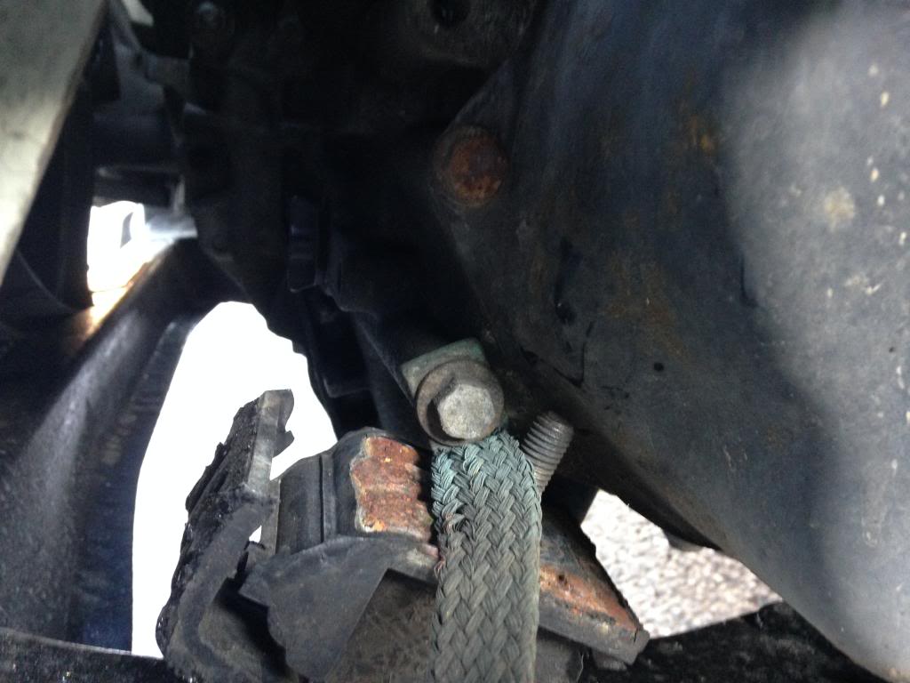

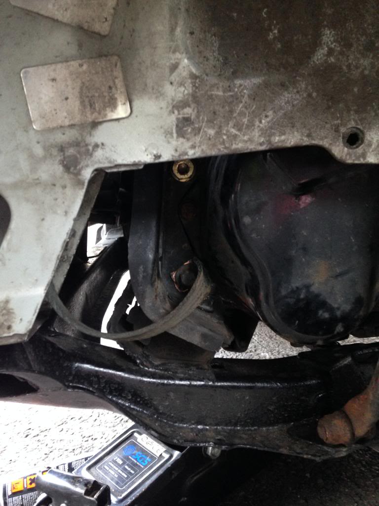

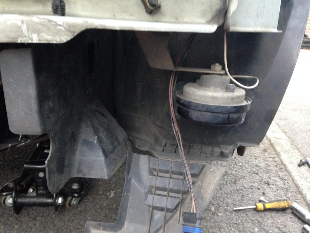

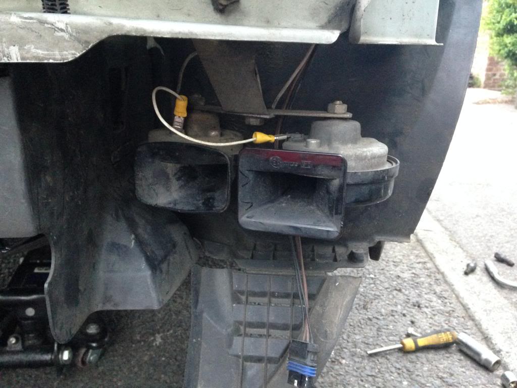

Free time this evening and found this in my room. Completely forgotten about it. Sport gearbox mount. Threads on the gearbox were completely clogged up with grime so it took ages to clean them out and gradually wind in the bolts. Good results though and combined with the recently new dogbone there is very little back and forwards movement. Earth was looking a little unhappy before!
Then got horny, realised the nonsport only has a high pitched baby clio horn. Now it's a man.

These are gen ren and free, I'm a pure OEM *****. I'm going to do exactly the same at the weekend. By by aircon rad (temporarily)
Air horns are for playing songs!

Lol at you buying a 182 wheel.
My non-sport has twin tone horns, its just because yours is a poverty Ph2 rather than my epic Ph3 lol.
Gearbox mount is a large improvement, with a new top engine mount, and a sport dogbone (less movement than a non-sport) and it'll be epic.

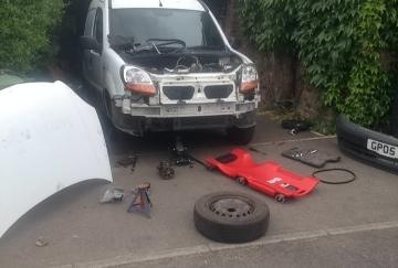

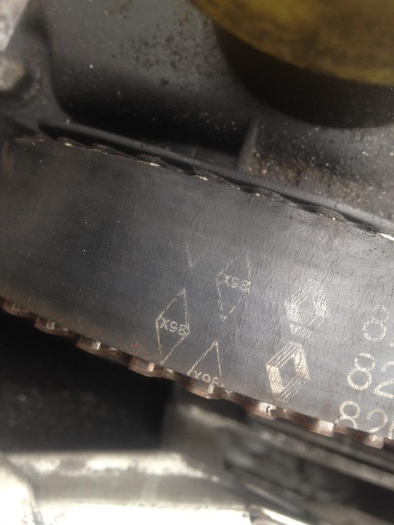

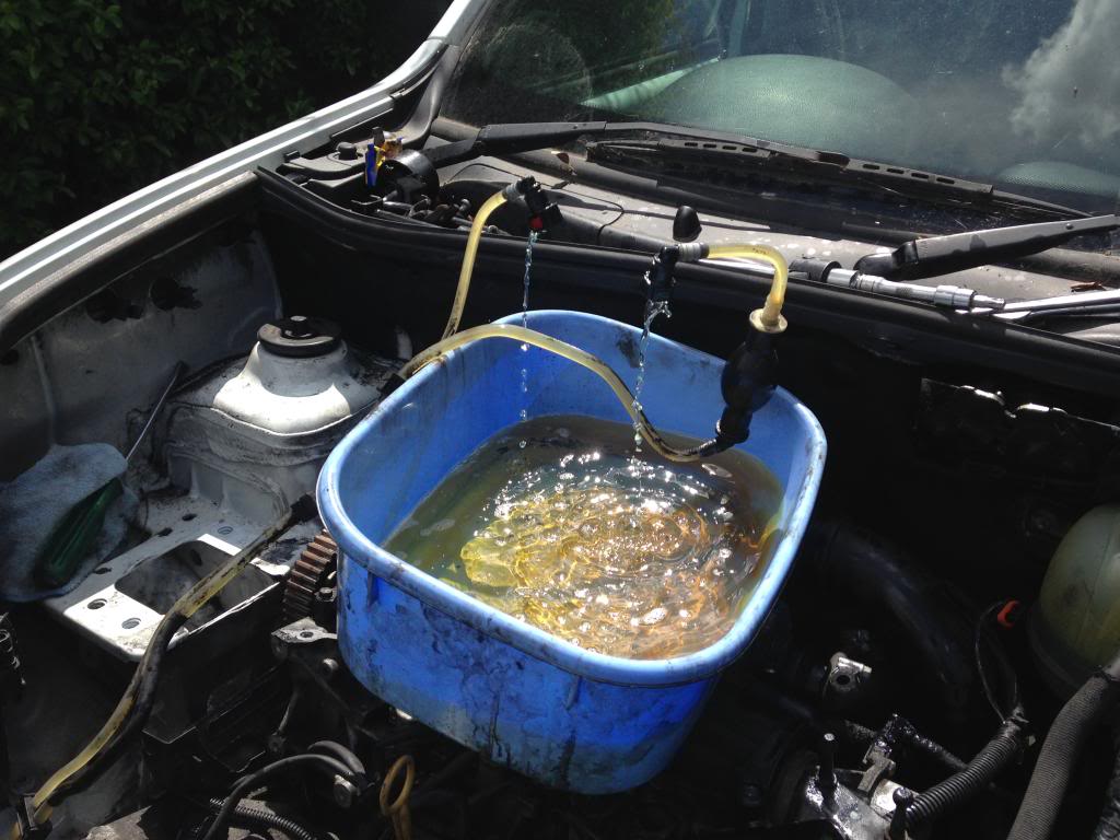

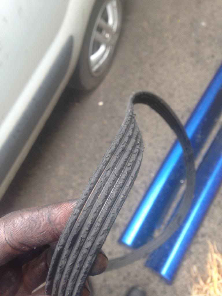

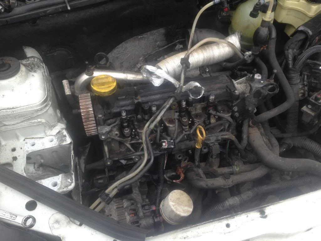

Started on the Kangoo today which I really can't be bothered to do but needs to get moving. Started to take the injectors out and then my t45 turned into a mush.
Took the fuel filter off, couldn't see any metal in there which was odd. I drained the fuel and have left it to settle. Not sure if it will separate into diesel and petrol but I'll have to see. Cambelt looks like it's never been changed in the 130k of it's life and was perishing. The timing tools didn't slide in like normal. They were very very close but not quite there so I've put that down to the belt stretching. Aux belt was also a bit tired. It started to rain so that's it for the moment.
  Many.
Lol! I've seen belts like that far too often. People got lucky.

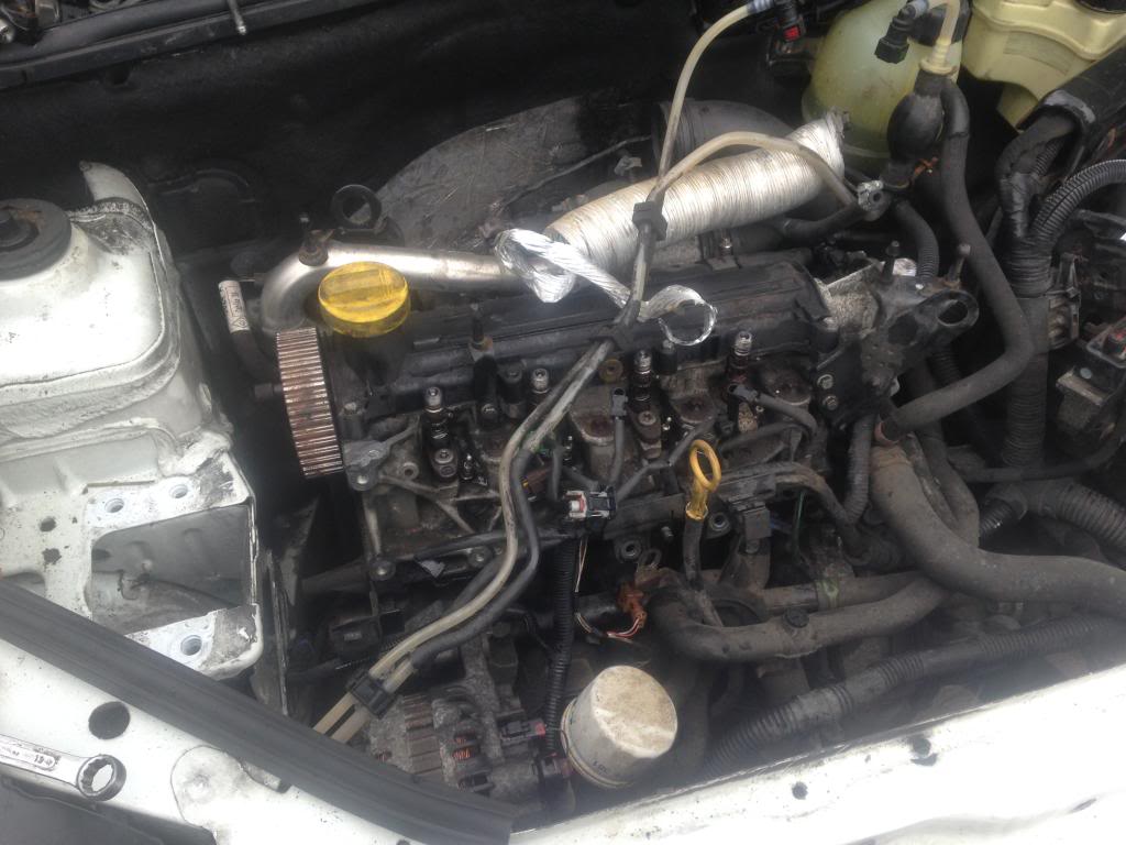

Did a couple of things today. Removed the fuel and injectors from the Kangoo and got a sport wheel for the Clio. I'm less than pleased with it as I was under the impression it was in good condition. Damn. Anyway I've popped it on and it will have to do until I can afford a refurb.
