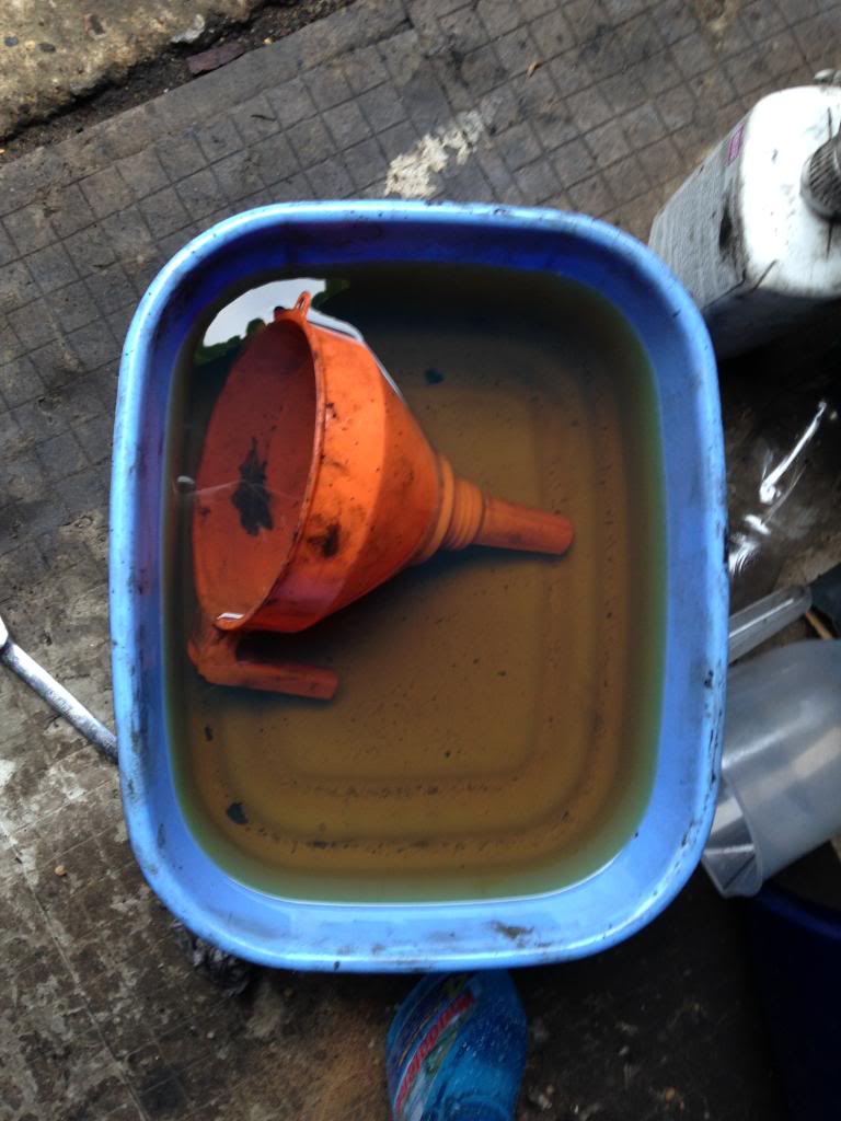

the state of that crap coming out the lines LOL

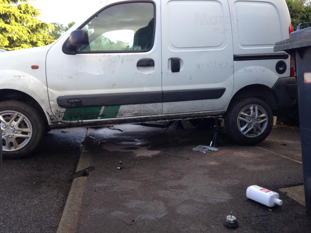

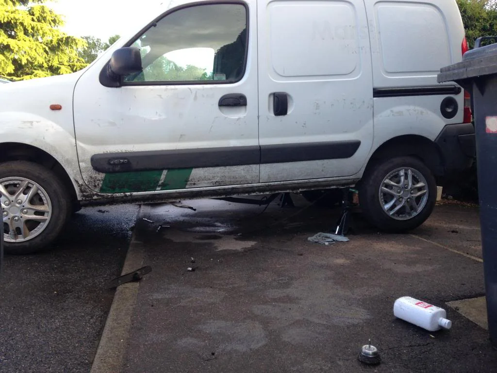

lookd worse than the kangoo up here im fixing, some idiot has put ' red neck ' diesel in which i can only assume has varnish in..... its gone all gel :headno:
GrahamS
Ohh yes that's what I was going to mention, the colour of the fuel that came out was really varied. There was some blue stuff at first and then diesel coloured stuff and then some other orange looking fuel. Really odd. Would like to think I'll have it running by Monday evening but who knows what I might come up against next with it! took over 25litres out though using the above method. Put air down the red line and the pressure drove it out the green one :)

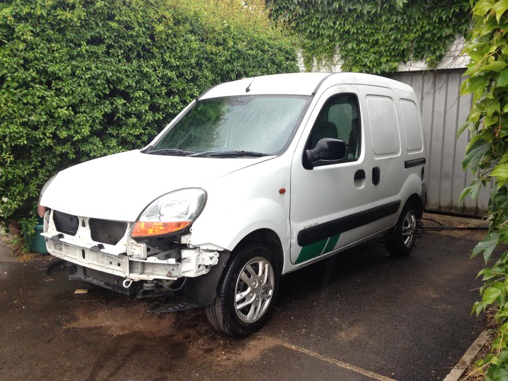

Today was mainly a Kangoo day. Will be done by tomorrow lunch if everything goes to plan. Injectors here now. Went to Halfrauds today and got a drill attachment with a polishing pad and some megs ultimate compound. Sampled it on the bonnet and the clio headlight. Seemed to turn out pretty good so I should be able to get ride of all the rubbish sign writing.

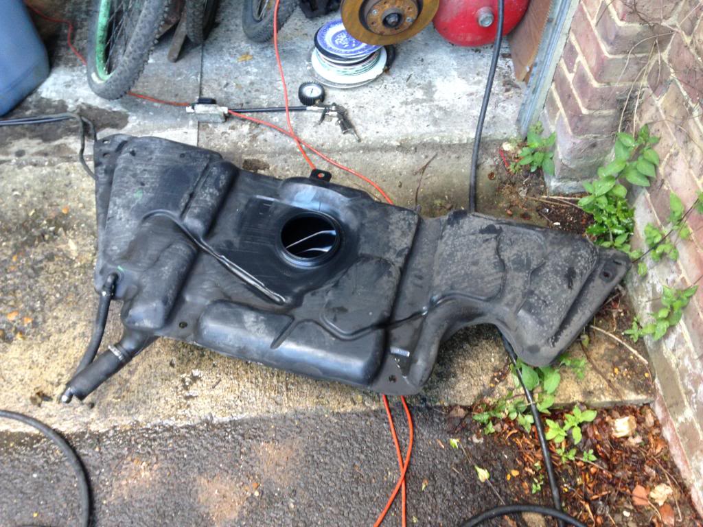

Bit of advice please @AlexW @HMS Derv Destroyer
I've taken the tank out, emptied it, sprayed the whole inside with brake cleaner and wiped round it with a micro fibre. Done that twice. Brake cleaner and blew out all the fuel lines and sender too. You think that should be okay? Brake cleaner completely evaporated.
This is the colour of the last bit of fuel that came out

LOL he's use to old Di's where you can see theyre fucked. you wont tel on these ( appart from swollen nozzles ) from to high temps.
2 or three flushes will sort it mate. better to go overboard than it shitting itself momments after rebuilding it.

Thanks for the help chaps. Washed out the tank for ages and left it to dry in the sun yesterday. Also had to take apart the fuel sender as there was a huge amount of sediment in the bottom. EGR was also caked up
Put it all back together today and she runs!!! Massive cloud of black smoke at first. Bit lumpy, possibly due to air in the system, needs new glow plugs or it's relearning the ECU adaptives. Only jobs left are to fit the aux belt and polish it up. All in a £500 van which isn't too bad I don't think.

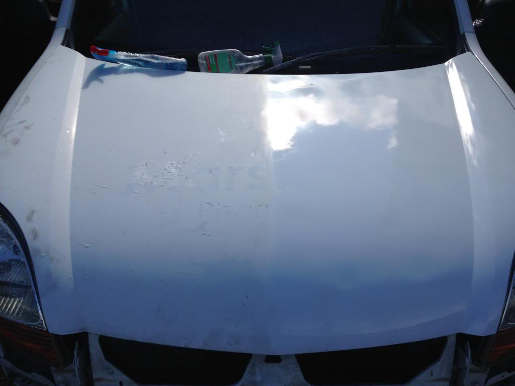

Getting the glue off from the old sign writing is crap job so any product you can recommend it greatly appreciated. Paint brush cleaner doesn't work as quick as I want.

Looks good, and glad its running. I was going to say to you, make sure you clean the sender unit out. Popped it out on my Black one this morning and that was quite covered in gunk.
Not sure what to suggest for sign writing, its a job I hate doing when we sell our work vans.

I'll let my dad do the sign writing, good retirement project :D

Standard paint thinners will have the sticky stuff off peice of piss

What a laugh , lack of power lol maybe if you started with a 100 bhp dci in the first place you would be having more fun lol ;) petrol ,or paint thinners on the glue residue does the trick .

Glue? what glue?

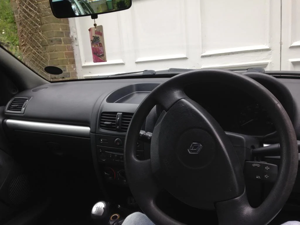

Couple of bits done today. Not on my car but Lauren's.

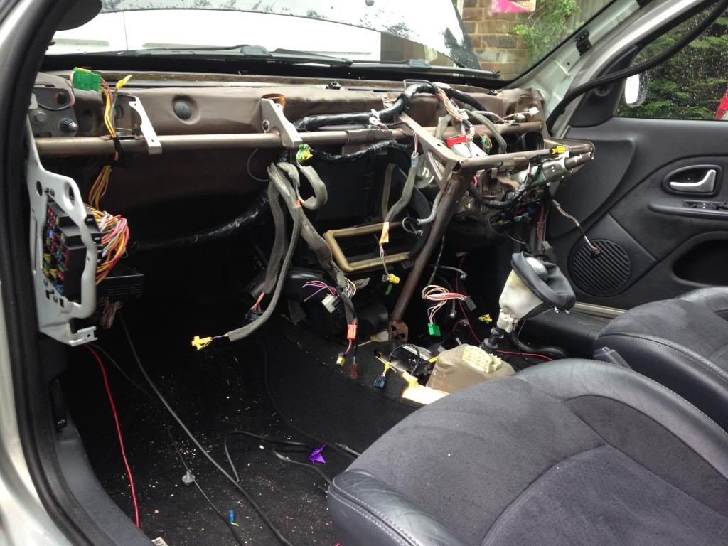

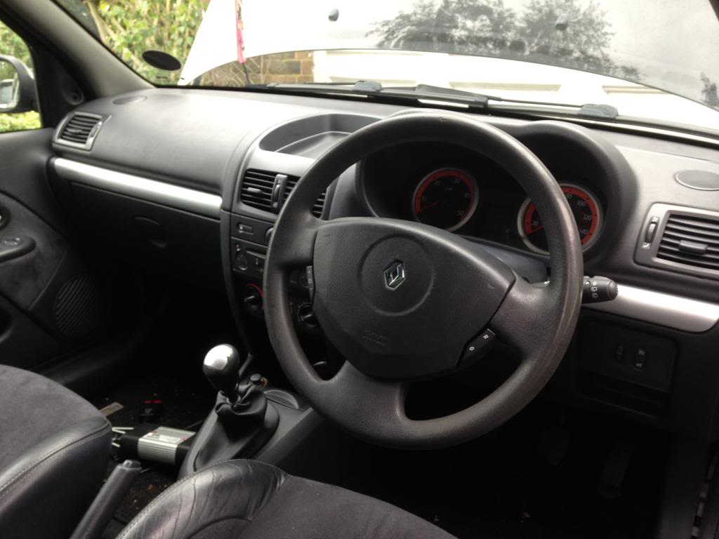

Retrofitted cruise control to hers, fitted silver surround clocks, variable intermittant wipers and some hub caps (finally)

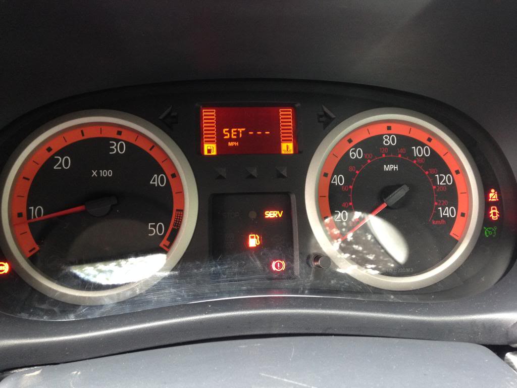

Cruise control works absolutely fine but it's not showing up on the display. AlexW how did you sort this? I haven't got a green light in the bottom right or set--- on the display. Been into clip and changed the instrument panel config to cruise control and done the ecu. Parameters show all the buttons and switches working. It's just the display.
5 hours all in, was happy with that.

You need the right way of doing the dials, as its Ph3 (so digi) you need to disconnect battery etc. I'll find time to give you a call and explain it, its quite a pain, and took me a few attempts.

Oh definitely. It also took much less time and went very smoothly. Could very easily make retrofit kits for this which I'm considering. I might redo mine at somepoint just to make it look a little more of an OEM install. Mine looks like a phone junction box compared to this one!
I think I found the problem; believe there are 3 types of clocks for the ph3
There's x65 STD GB BdG which (black surround) only have clock and trip
The ones I bought for this conversion (silver surround, orange revs) x65 GB GAS Sensation, which allow trip computer
And your ones @AlexW (silver surround, blue revs) which are X65 ADAC GB HdG GAS, the hole hog
My clocks in the ph2 are ADAC so I'm going to buy some ADAC ph3 clocks and try from there.
edit: did your green light show up before you got set to show up on the dash? I might chuck some ph3 adac clocks on from another clio just to check first.

Its because the clocks aren't programmed, mine was the same. And because you're trying to do it wrong.
Program your clocks and it'll work no problem. Nothing on the dash works until its programmed.
GrahamS
To perform a configuration dashboard, follow the essential steps below:
1 - Make a multiplex network test and ensure compliance. If the multiplex network is not
compliant (see MR multiplexing). 2 -. Disconnect then reconnect the battery 3 - Connect the diagnostic tool. 4 - Make a "test computers." 5 - Select "Network MUX" and confirm. CAUTION: Do not turn the ignition as indicated and confirm. 6 - Exit the result of MUX network. 7 - Select "Case Interconnection." 8 - Select "Command Mode". 9 - Select "Setup". 10 - Select CF 719 "type dashboard." 11 - Follow the progress of the procedure. 12 - Turn the ignition switch as shown to validate configurations. 13 - Cut and then turn the ignition before the select command CF 719 "type dashboard" to check if the settings have been accepted. 14 - Ensuring the absence of default picture : Here, there is just the small print procedure on a piece of paper and move to a nice little for renault you do the procedure

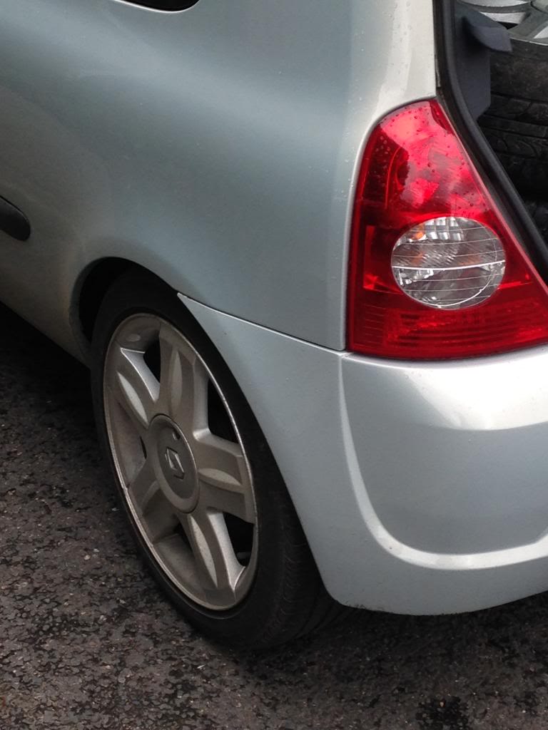

Clio is a little meh at the moment. Had the rear bumper done but....... I'll let everyone else judge that. Got 15" ph3 alloys, top dash, dash display, gear gaiter, wiper, tweeters, colour coded spoiler and parcel shelf as well. Will fit the top dash to Laurens car soon as it's pov spec.
