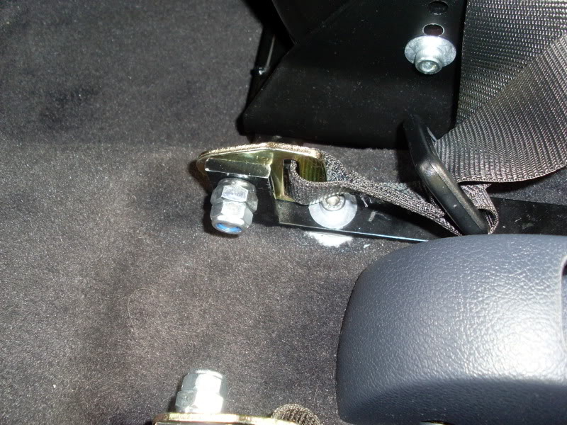

ive currently got harnesses in the 172, one side is clipped to the little hook under the seat that is fixed to the floor and the other side of the harness is screwed through the subframe hole attachement and held tight with a bolt and nut.
would this be suitable to pass an mot?
i have one where the seatbelt clip bolts to the subframe,
and the other where the end of the seatbelt bolts to the bottom om of the b piller,
would that pass??

yes i think they will, they have to be secure to the car so can see no reason why not.
my drivers rear 2 bolts are into the original rear seat belt fixings and the front ones are bolted through the floor where the old std seat fixings are, with spreader plates under the car
yeah the seats are bolted to the floor, custom x-low subframes using the 4 original bolt hole fixings.
the other thing im unsure of is the other side of the harness is only clipped on the the hook underneath the seat, and that hook is bolted to chassis floor.

as an mot tester would you say i am ok to clip the harness to that hook bolted to the chassis under the seat?

The hooks are there for harness attachment so your all good there.
and as long as one bolt of the harness go's to the main part of the car ie the pillar standard fix point and one to the seat subframe you'll pass.
the reason they are set like this in the first place is in severe accidents the seat will twist a therefore pull you away from steering wheel and dash board and towards the door.
