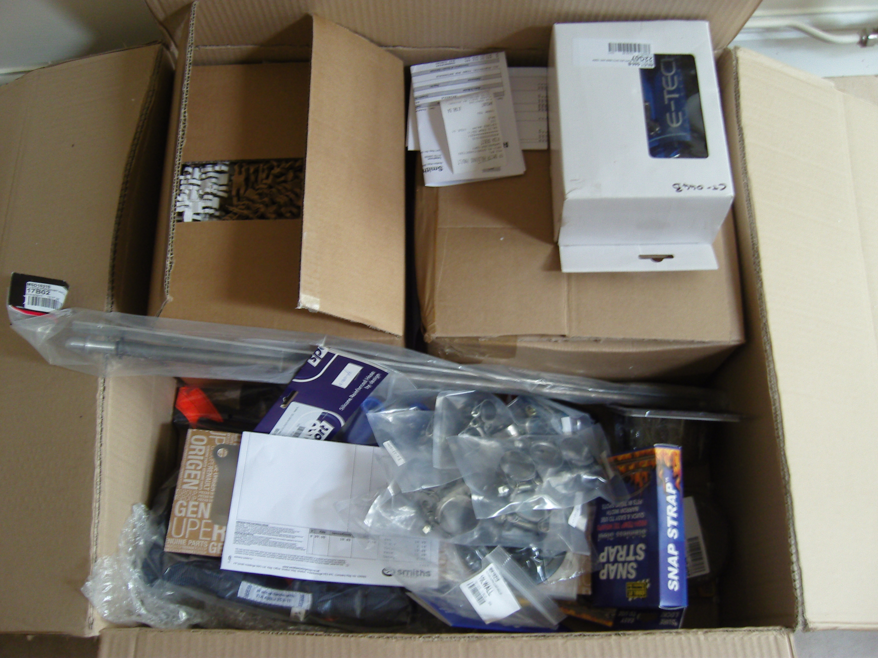

So another box of bits arrived :)

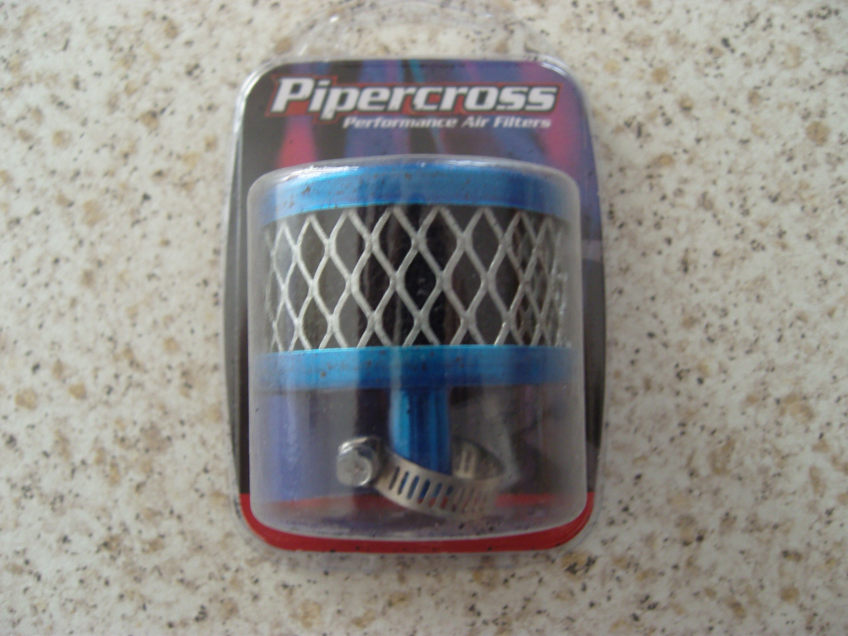

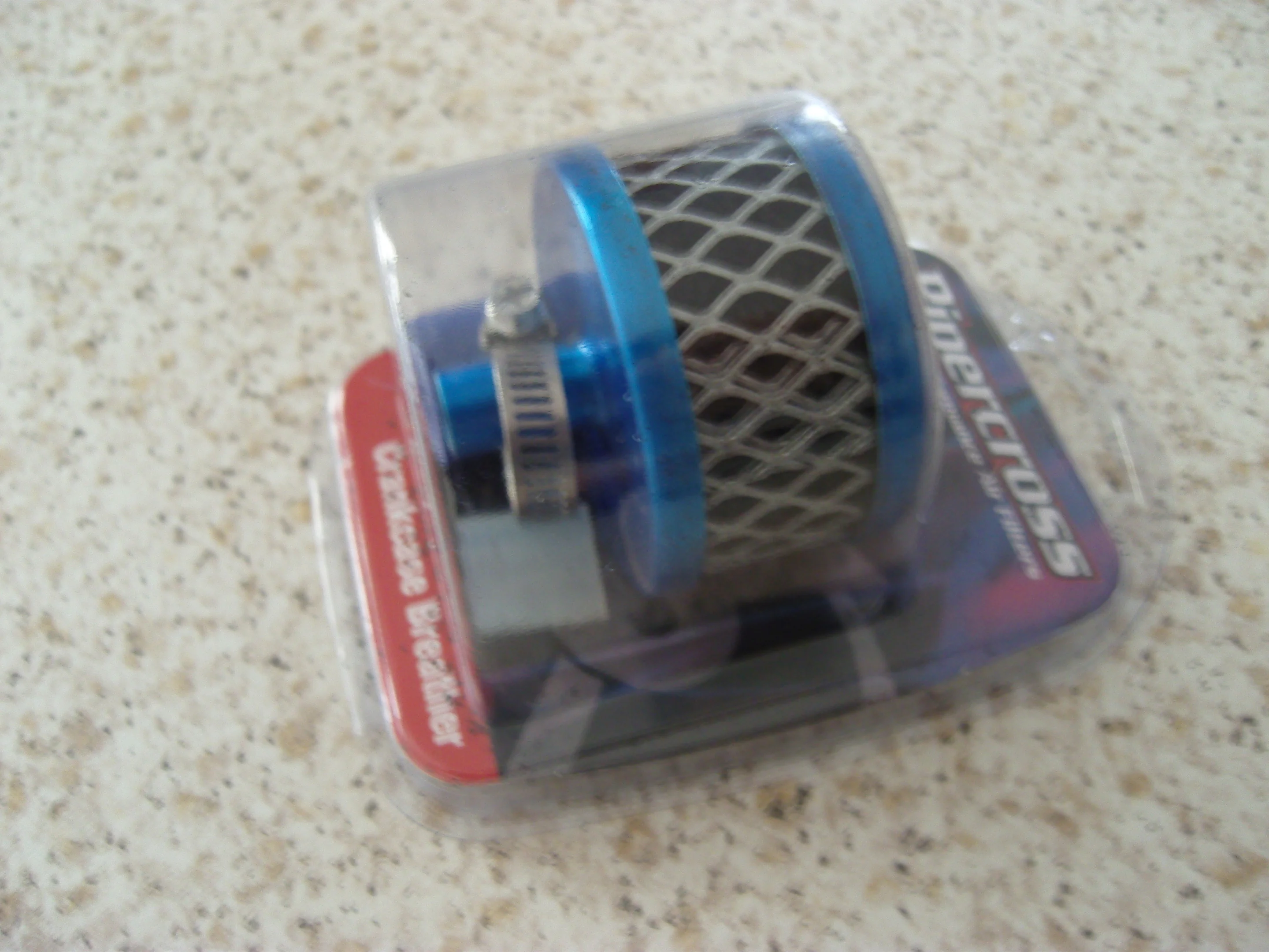

A nice breather that I will find somewhere to put :)

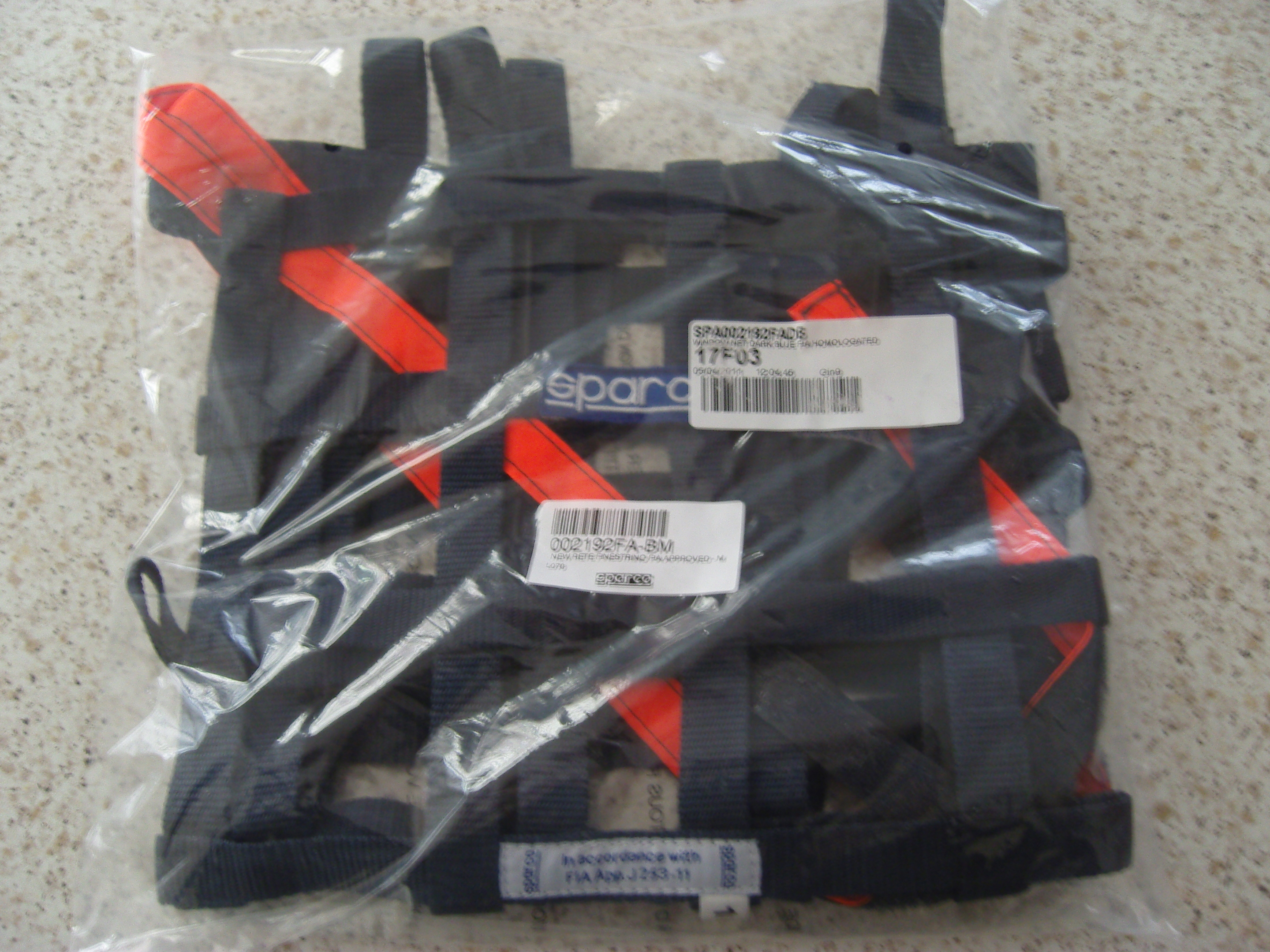

My Door Net in Blue :)

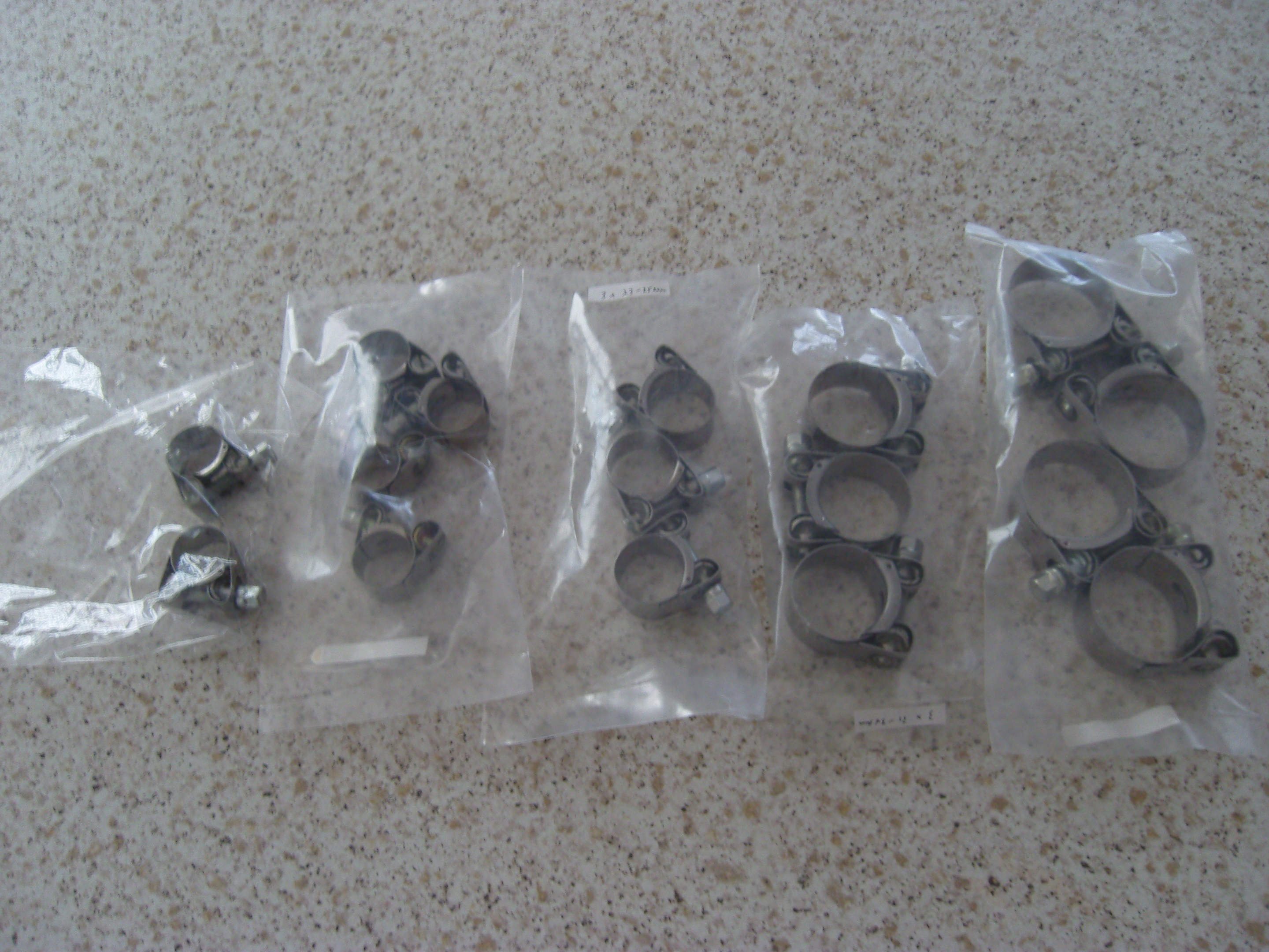

And the fitting kit

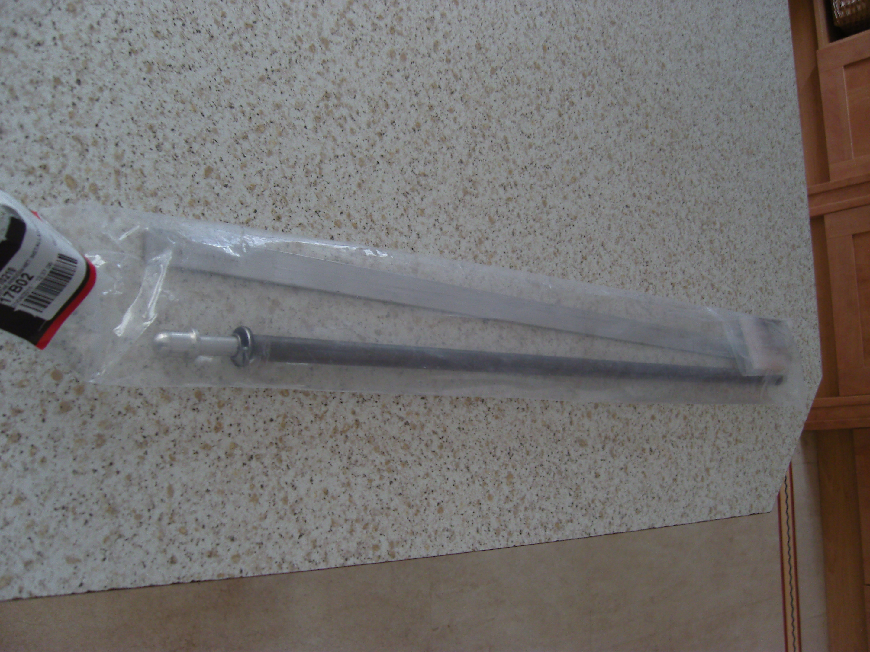

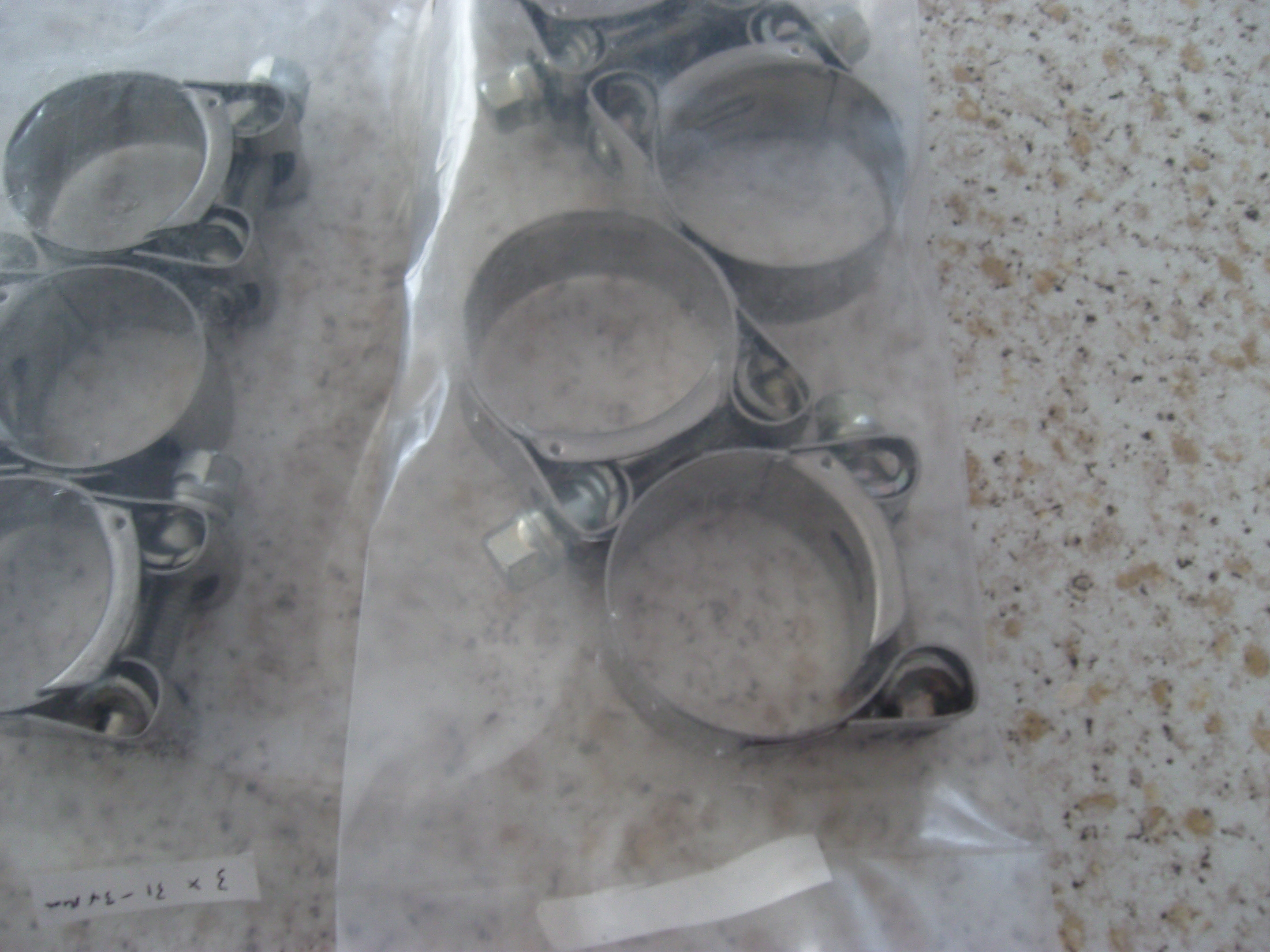

Mikalor Clips (not cheap)

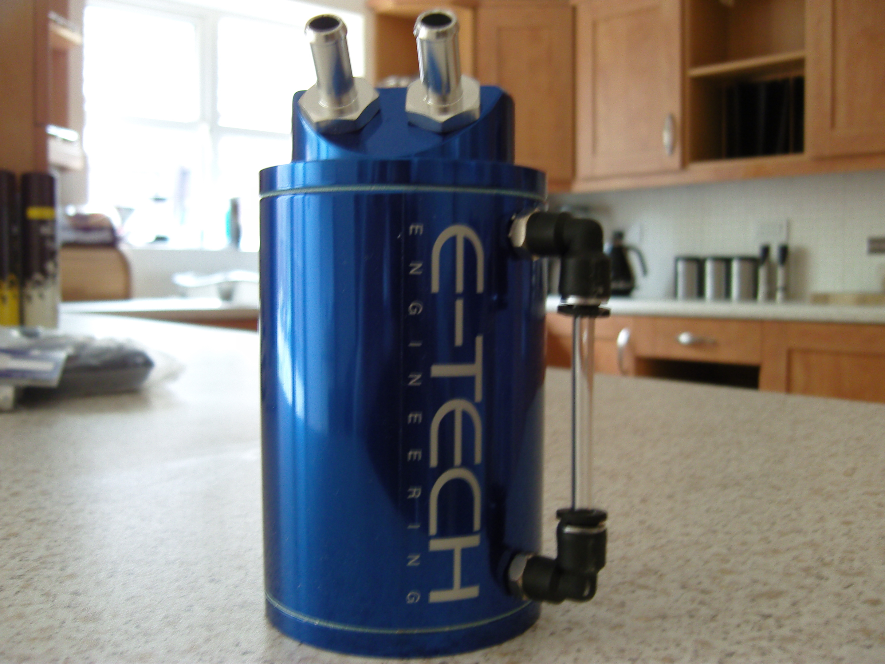

And my very nice Oil catch tank

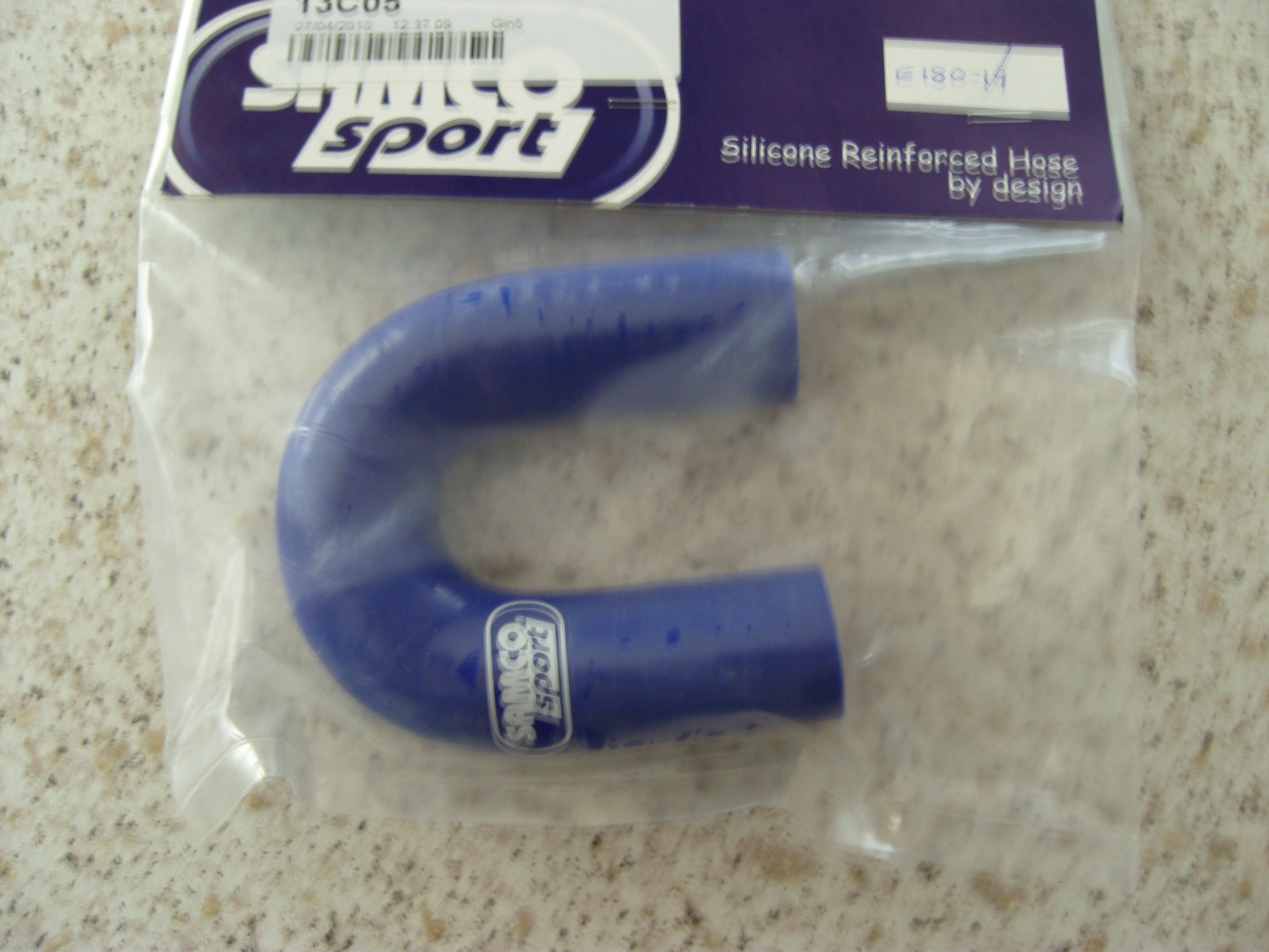

The Samco elbow as i removed my heater and pipes.

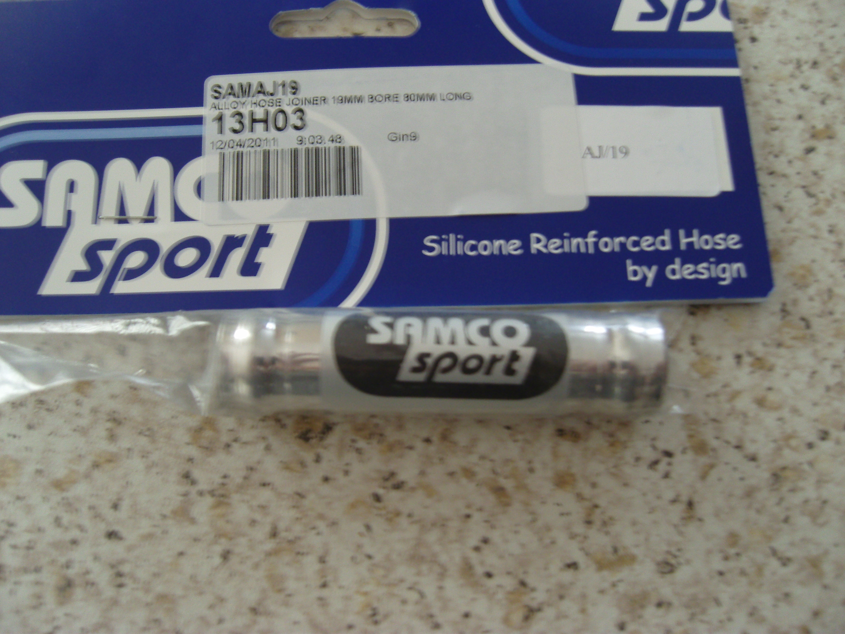

And the joiner pipe in ally

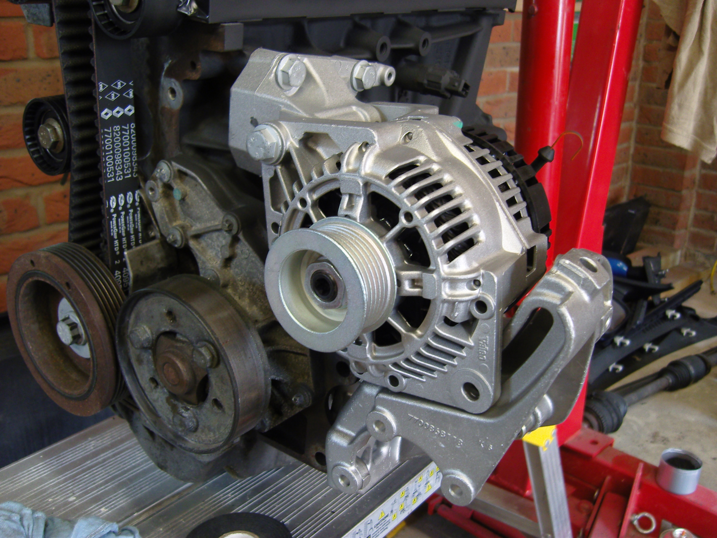

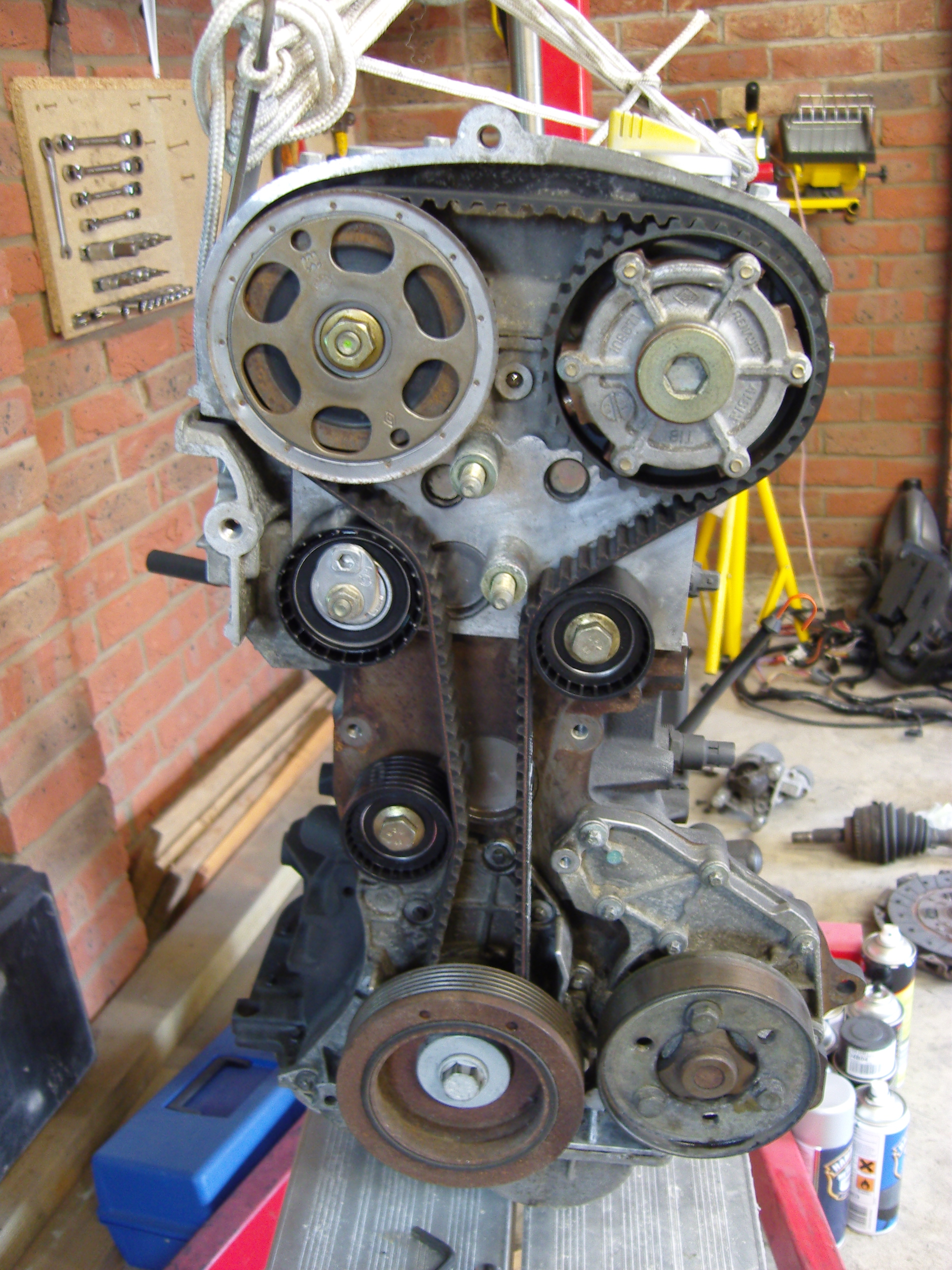

Then I decided to fit my new timing belt and my air con delete kit.
And the Air Con Kit
With it fitted

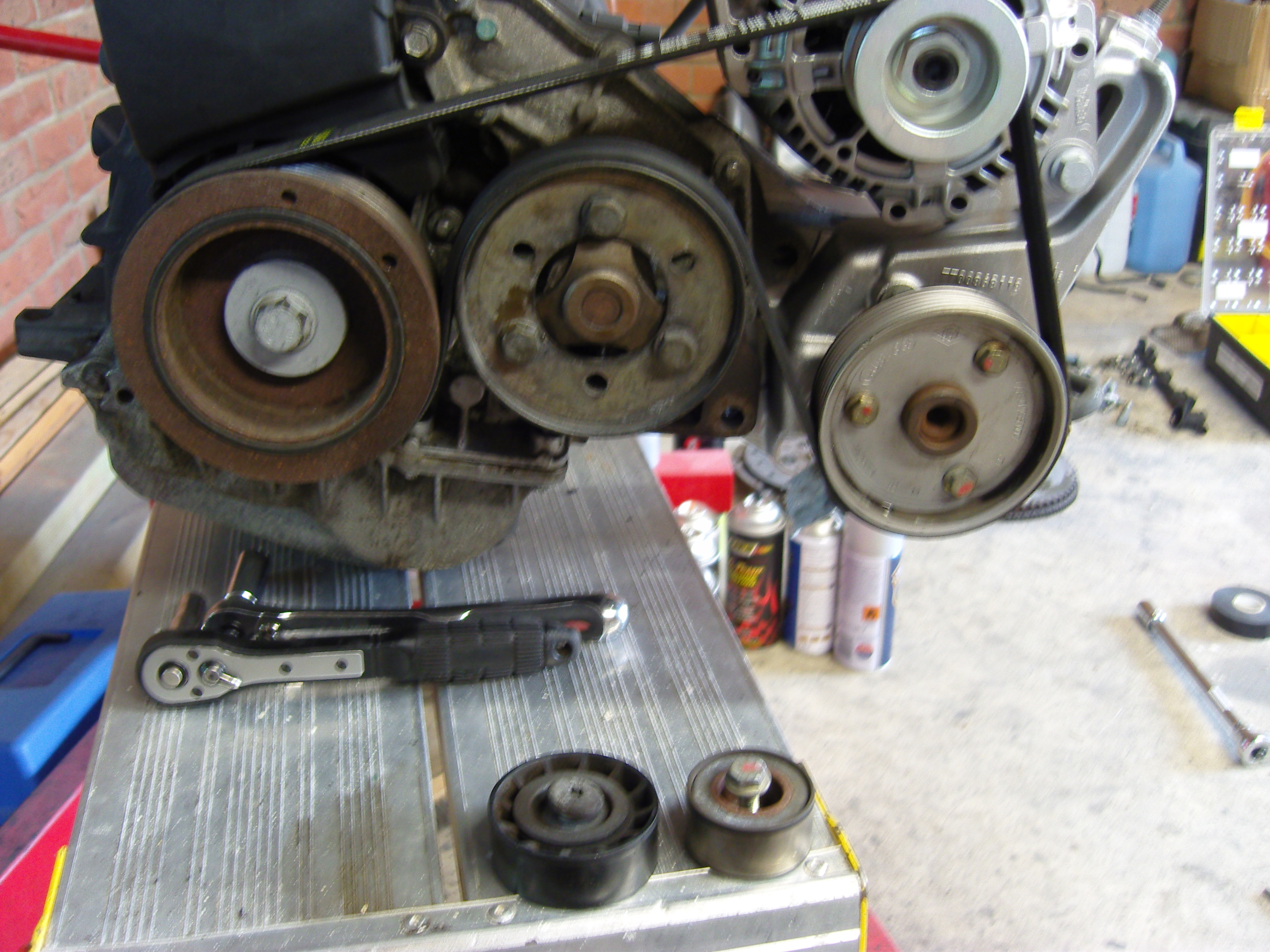

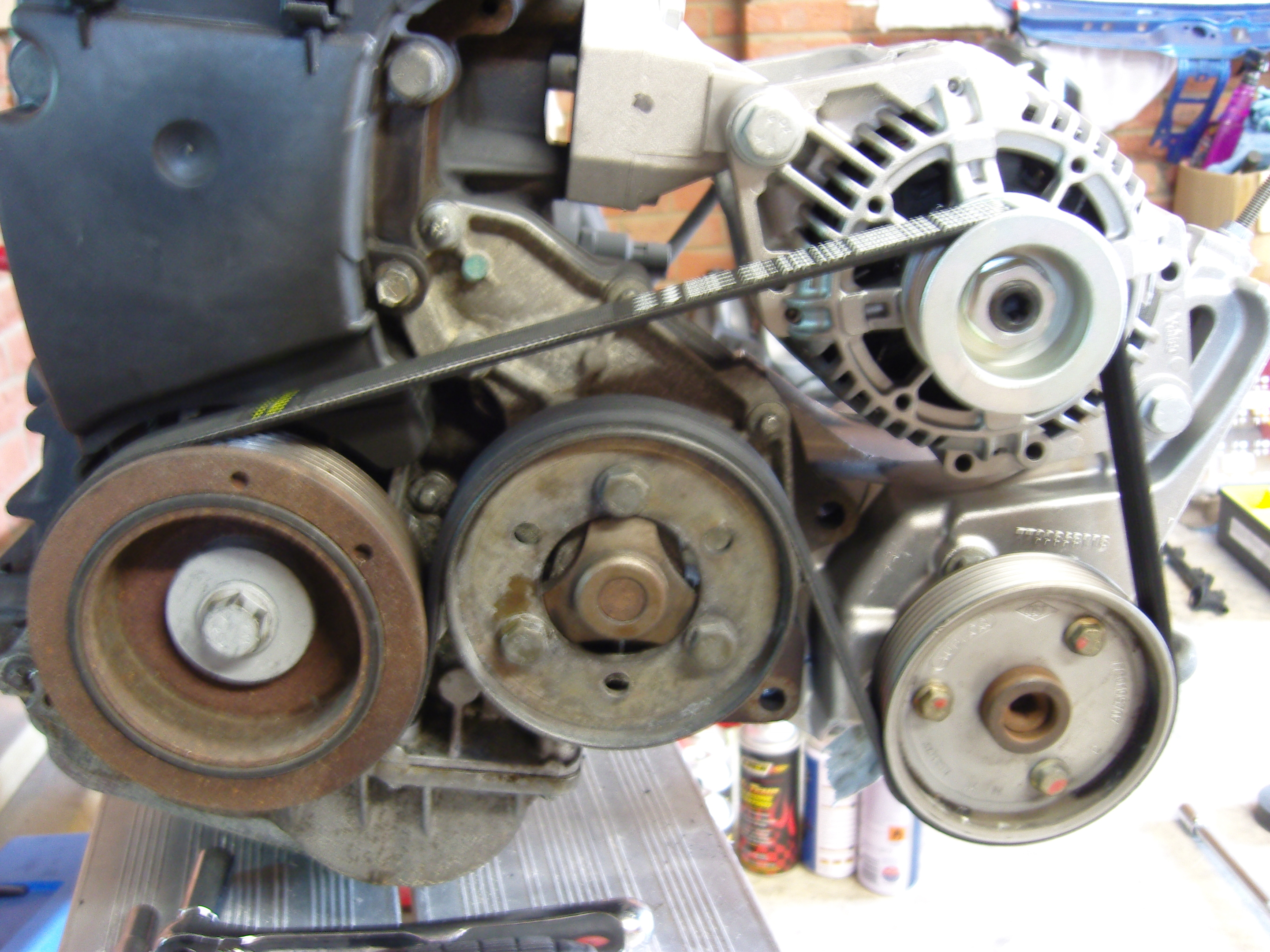

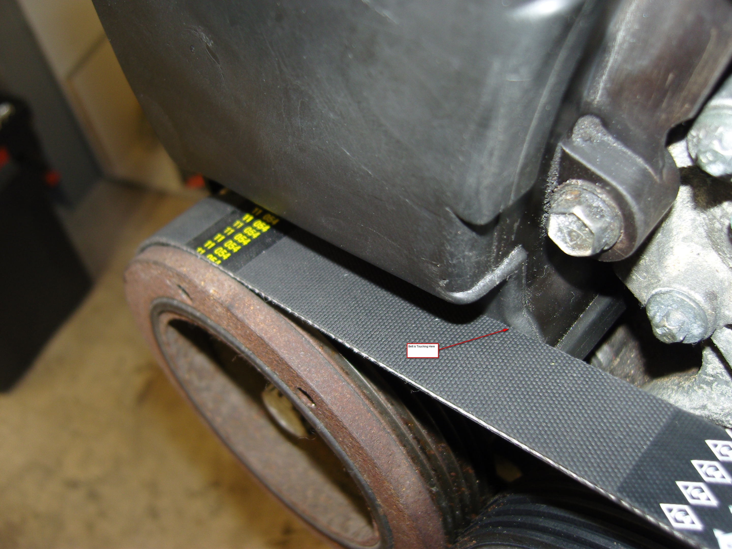

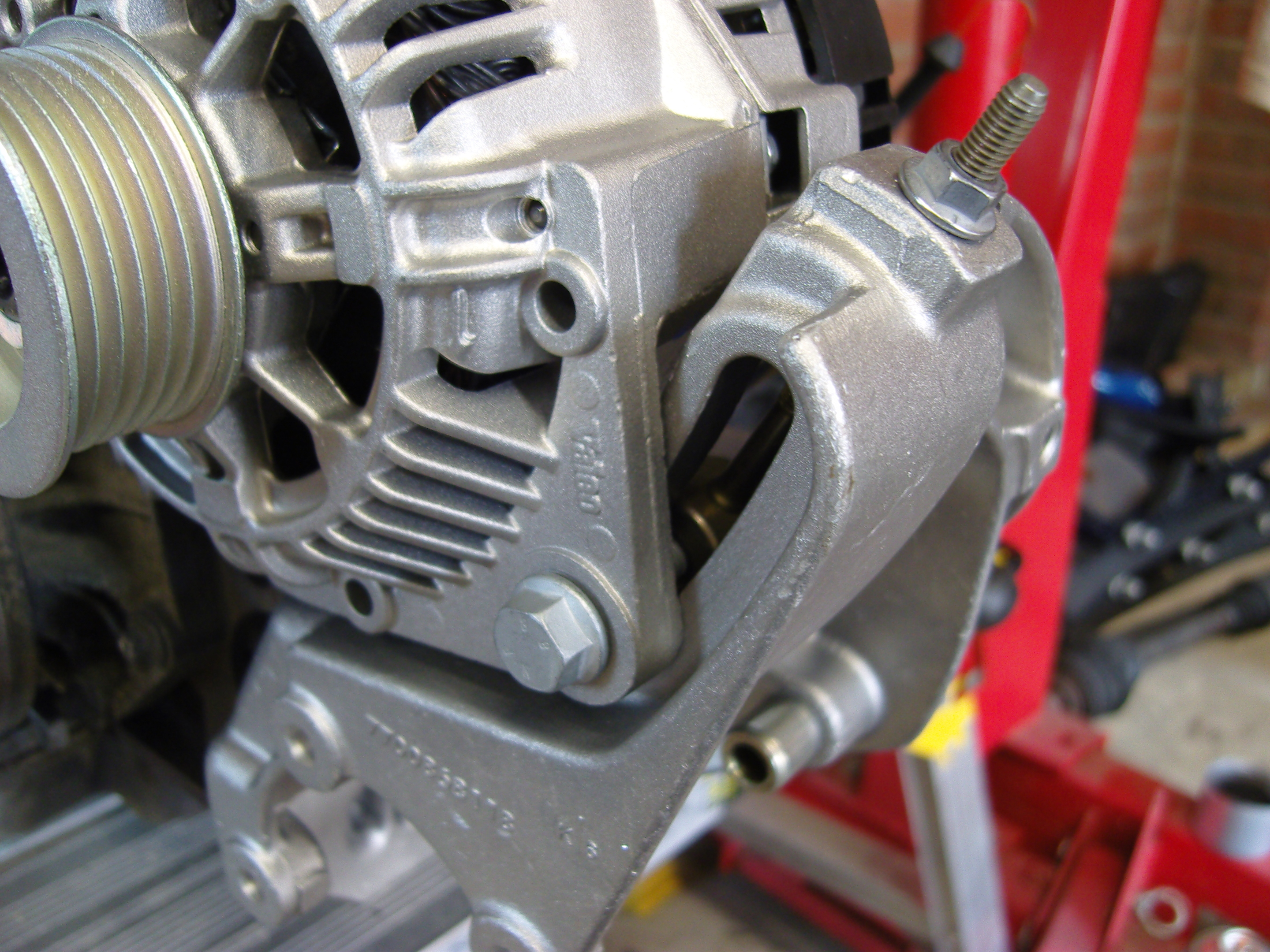

And the left over pulleys? Is that right? Have I routed it right?
In this pic you can see the aux belt catches on the timing belt plastic cover?? what have I done wrong here as it all looks right to me!

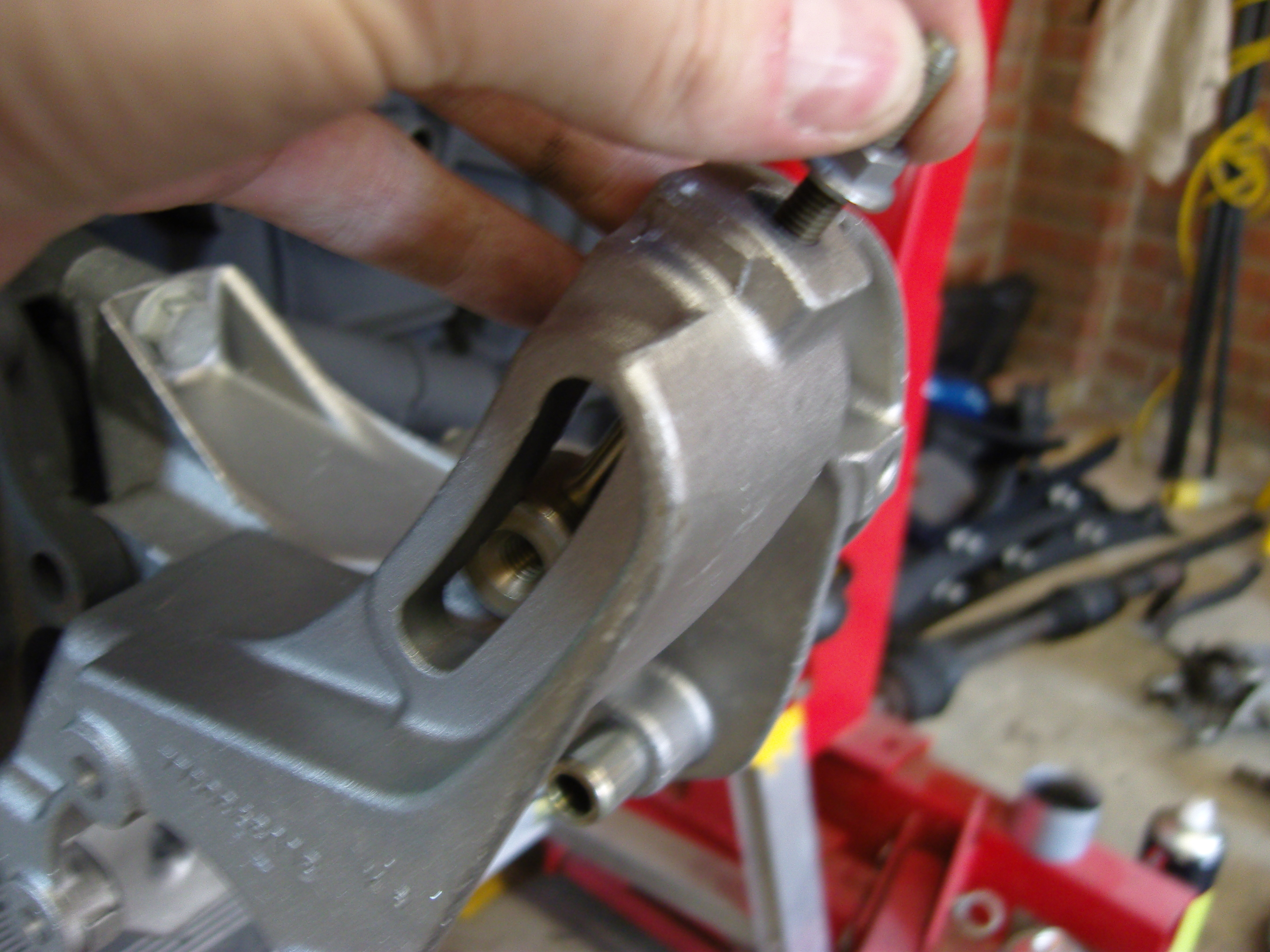

Also there is a bolt missing from the power steering pump on the right there seems to be a long (ish) bolt but I could not find it and it was not part of the kit. The three bolts in the front that hold the pump to the big alternator bracket are on though.

That catch tank looks great! Looks expensive :)
I think you have a belt with too many ribs!

Oh yeah and I wanted one of those door next, the net isn't that expensive but the fitting kit is well expensive! So I sacked it off!

You know I did think that but as I had chucked the old belt I could not match them up. I will take a trip to Renault and compare them.

Here is the tank link
http://www.demon-tweeks.co.uk/Search.do?method=delegate&n=1609&g=2935&s=oil+catch+tank
Only £60
i also looked at these from schroth back when i ordered my harnesses, however i thought there was no need at all if i was running Polycarbonate windows, how come you have decided to go fro them chap as they will seriously reduce visibility in a race situation
Lack of experience :S
I thought you had to have one to stop your arm coming out the window. I guess with a plastic window it aint gonna smash is it doh.

Ok I just nipped in the garage and changed it and that worked. Now the belt runs flat along the bottom. How tight do I need to make that belt by the way now its on a mnaual adjuster?
Love forums on a Sunday morning LOL sad git I know.
I just kind of use the force. I tighten it a bit and if it doesn't squeak I leave it...
I recall Matt saying they used to run some of their cars the wrong way round the pump but I guess you need to file a bit off the cover or use a thinner belt to stop the rubbing.
I was told that if you try and twist the belt in the middle of its longest part (longest distance between two pulleys, think along the bottom) you should be able to twist it approx 90 degrees. That's how I do it on my cup and it works fine.
Polycarb windows,you don't need a curtain.I hope the catch tank is a 2ltr one,you won't pass scrutineering if it isn't.
