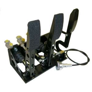

Is there a logical reason to put the battery inside the car and not in the engine bay? Surely in the bay uses less wire/weight
if you go pedal box, make sure you go Tilton or AP racing, not that OBP tat sold on ebay! but realistically, its not worth it, the cup racers don't need them and it is just another big head ache to get around.
get some treadplate shaped to the floor of the foot well and raise ur feet 35mm, jobs a good-un.
Funny that is exactly what Matt said when I mentioned getting a pedal box.
Cup racers don't use pedal boxes because they are built to a cost and they do short races. This Clio is being built for Britcar races, so that is anything from 2-24 hours, a completely different remit.
A pedal box will allow much greater control, particularly useful if it starts raining in the middle of a race, or if you find yourself racing at the Nurburgring, it might be raining on one half of the circuit :D
Some good points and knowing me like I do I will get one just for the bling value ;)
