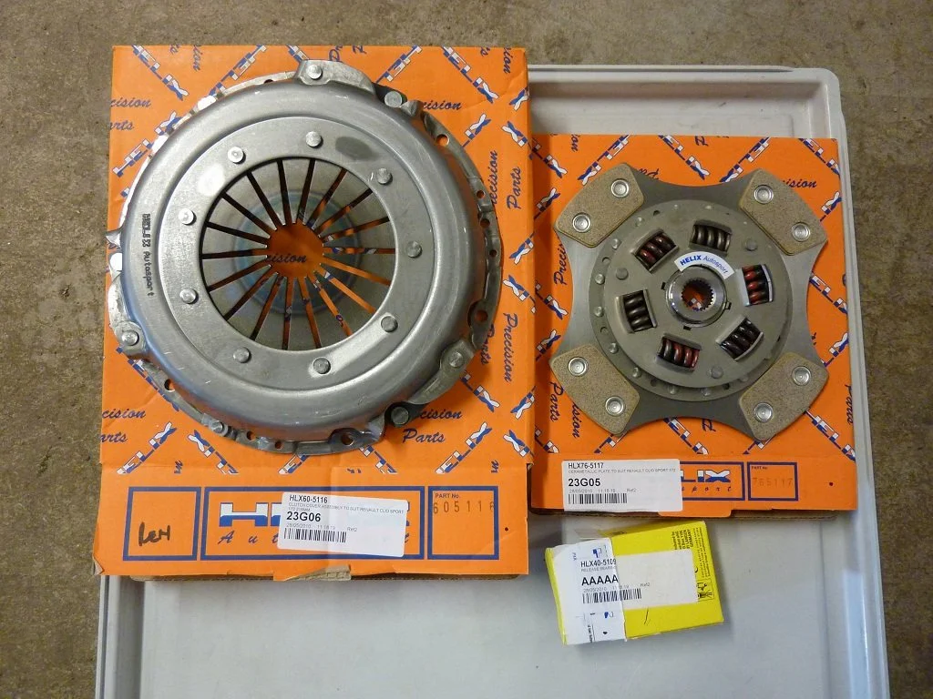

I run the race setup below. Organic plate is 70-5117 instead of 76-5117

Ya right.... If you had seen my 800km old pressureplate that broke in to pieces slashing the whole gearbox I think you would dissagree. Valeo confirmed structural faliure and paid for brand new gearbox and an everything else. Helix pressureplate is constructed in a much more rigid way so the same faliure would not happen.

This is from the Helix website by the way.
Clio 2 2.0 ltr 16v RS 182
2001-05
Application Type ø Cover Plate Bearing Spline
Road N 215 60-5112 70-5117 40-5109 22x 26T
Race/Rally N 215 60-5116 76-5117 40-5109 22x 26T
