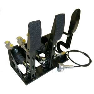

Which is adjustable via the pedals? Sorry having a dense night :)
If you look at the knob in the pic,you will see it's attached to a cable that goes to the brakes,behind the pedal you will see two reservoirs,the balance bar is located in the middle of these two and will apply more pressure to either front or rear at a twist of a dial,not like these other things you see in cars.

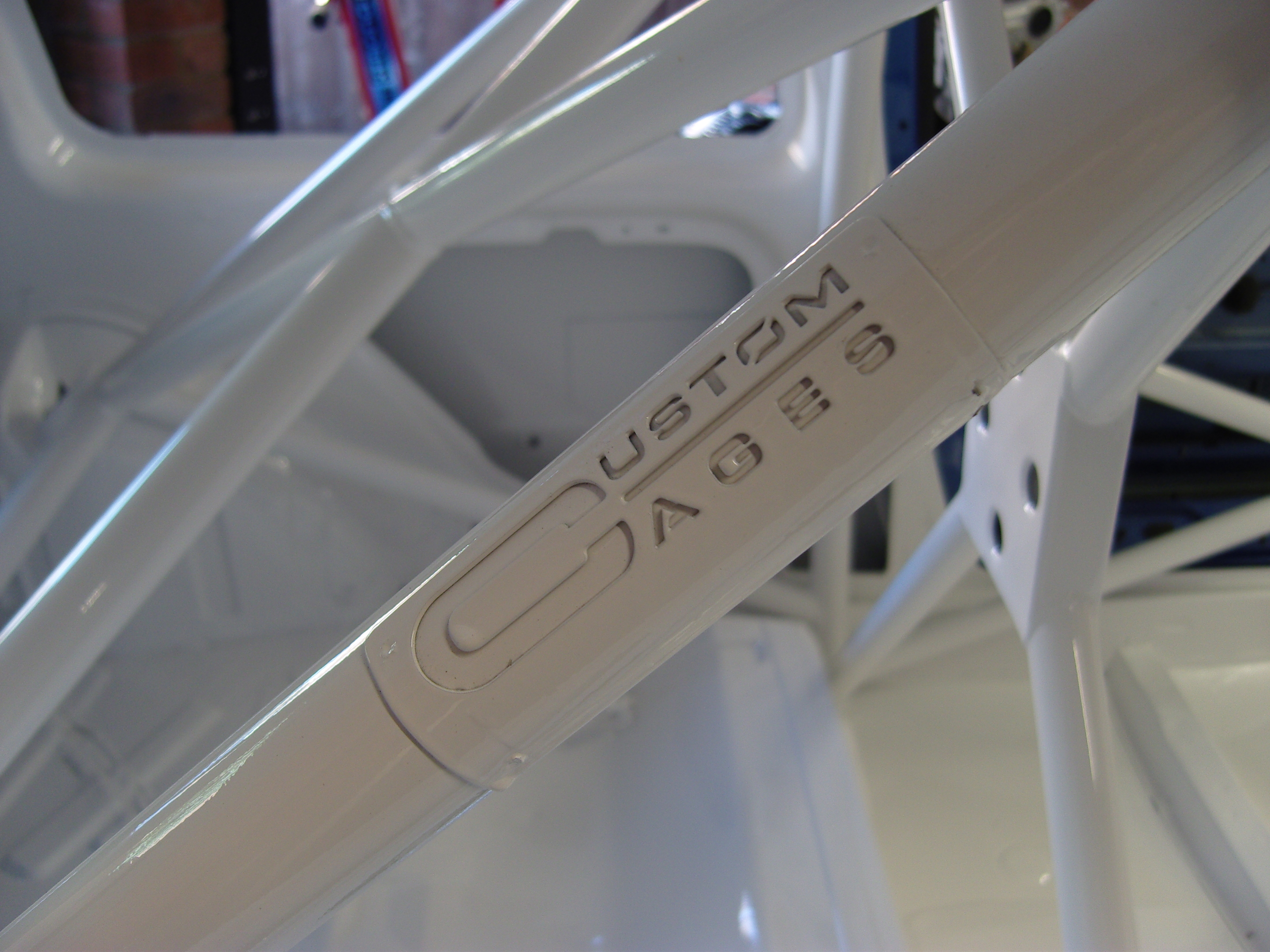

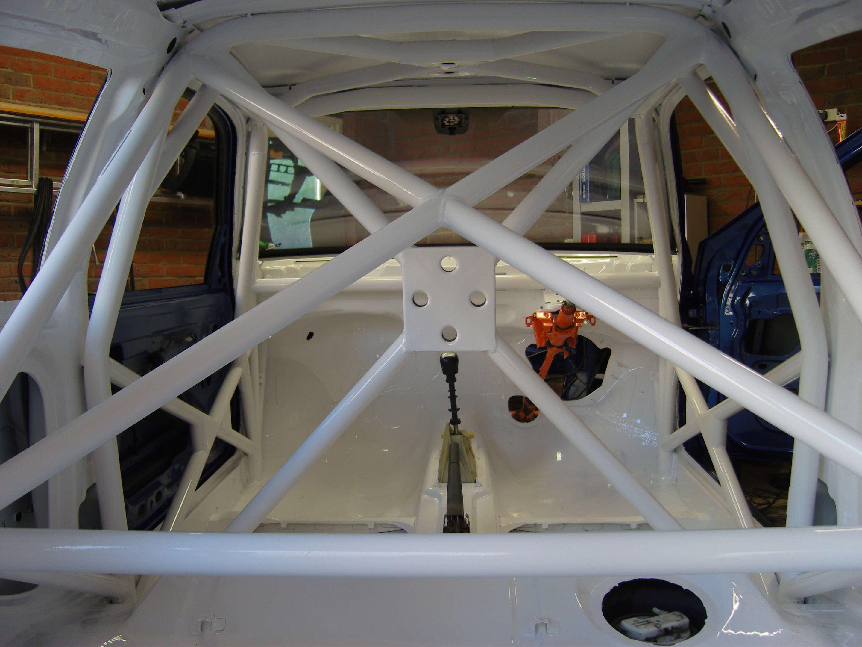

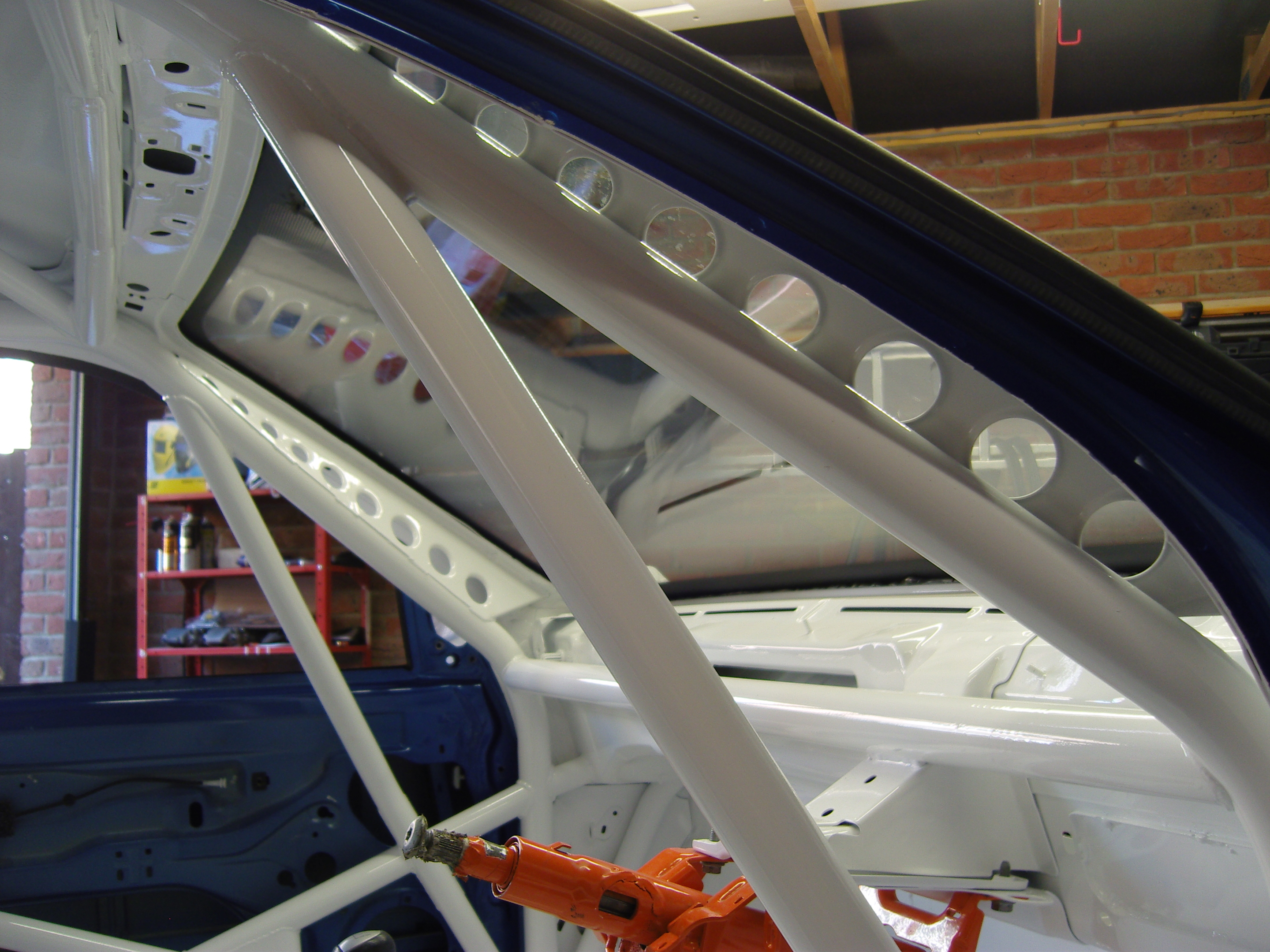

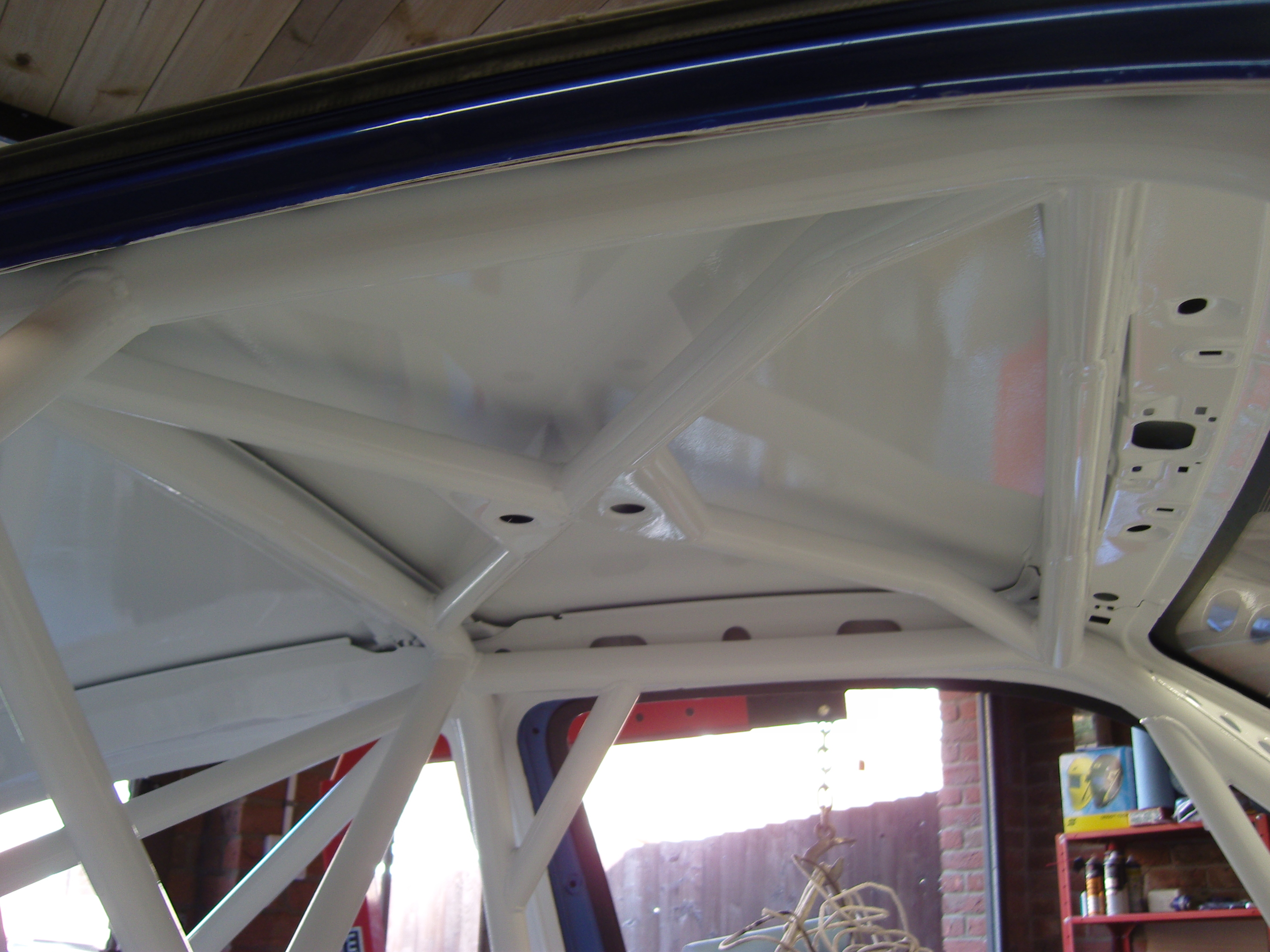

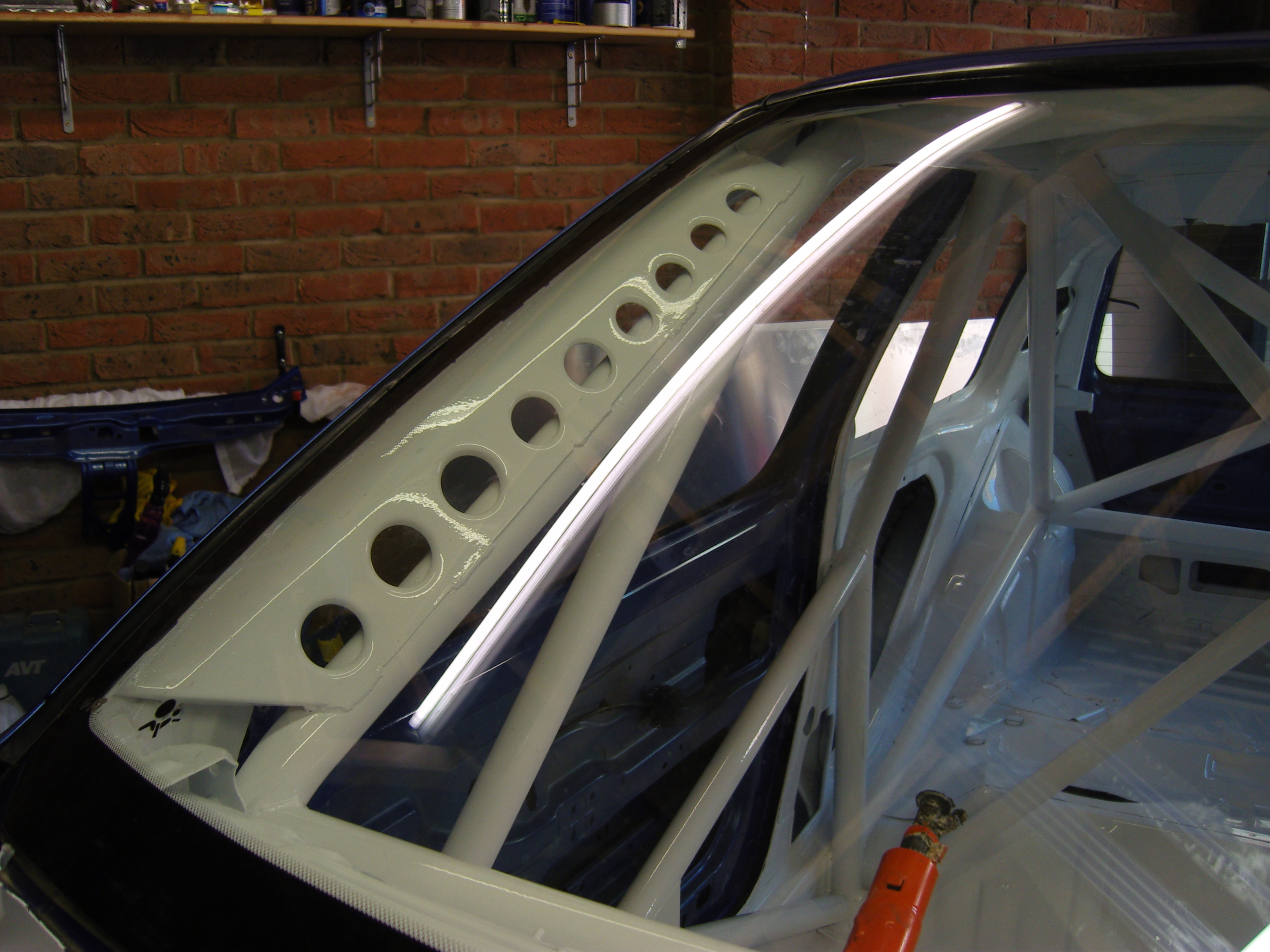

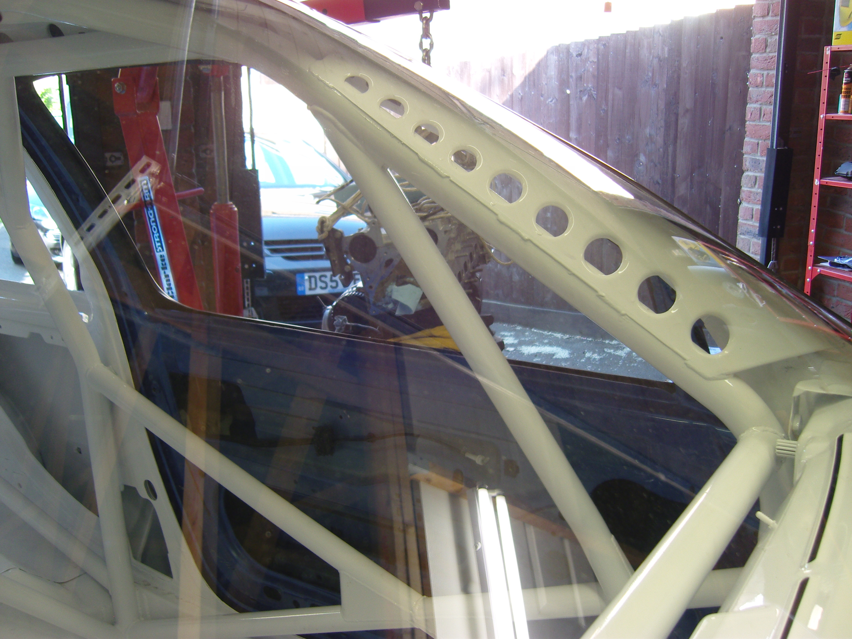

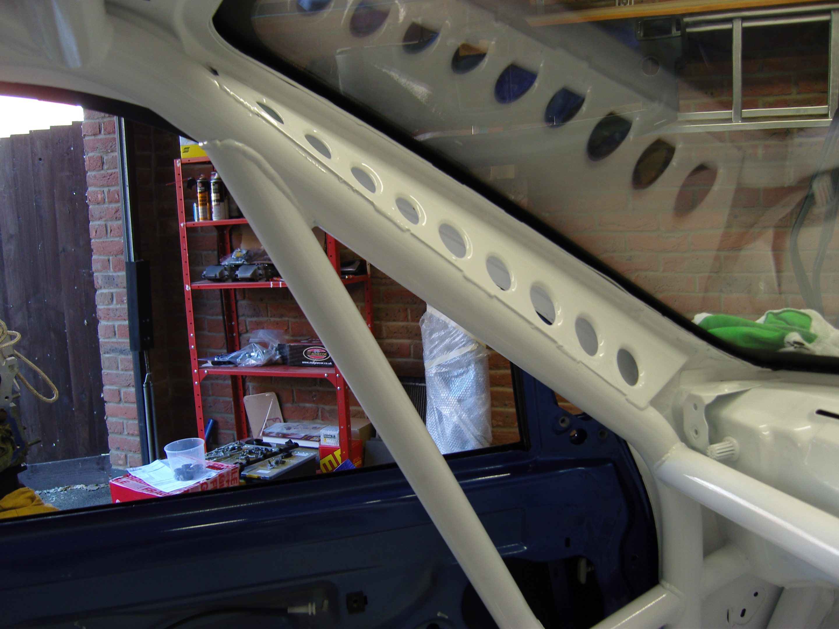

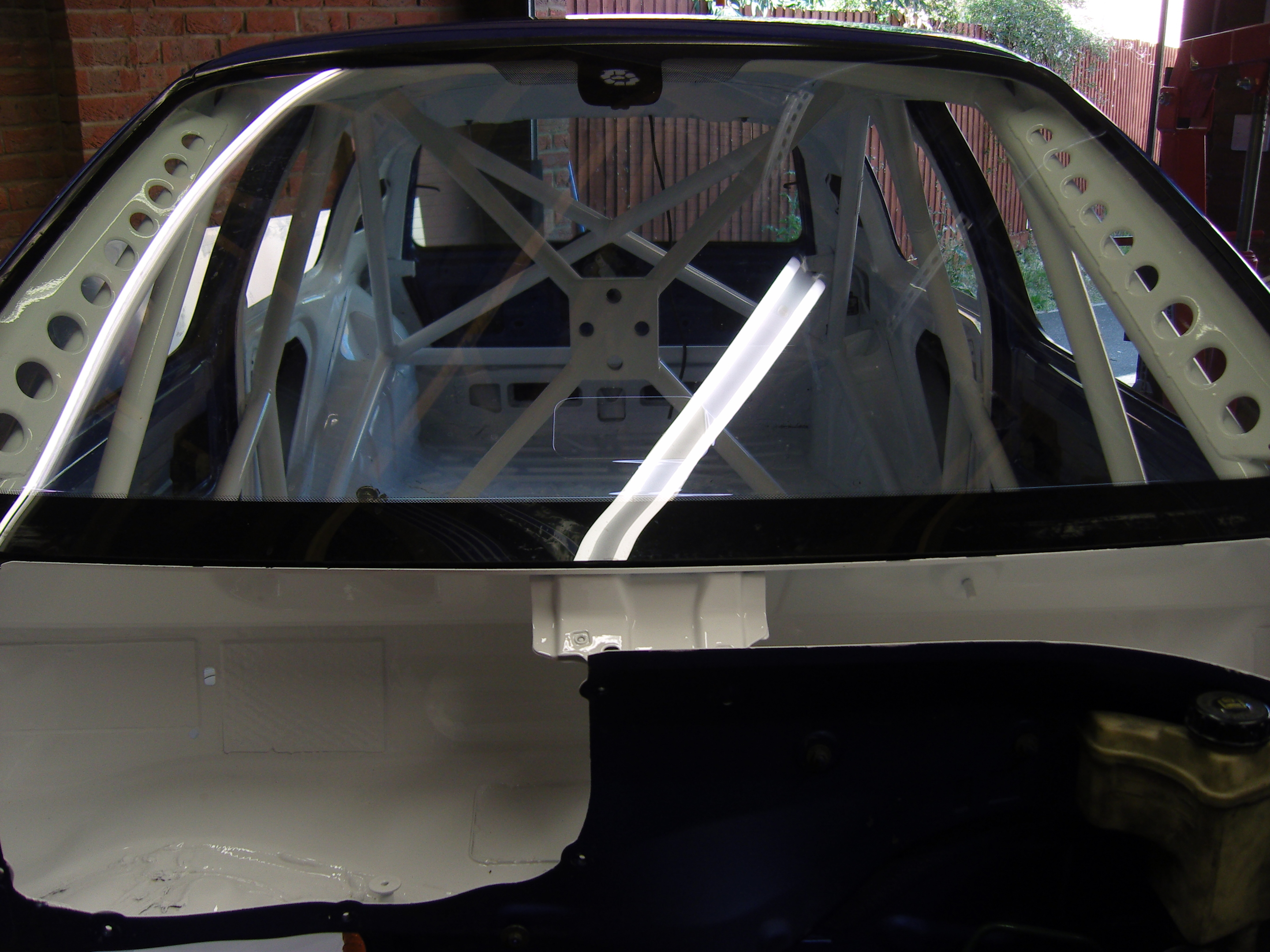

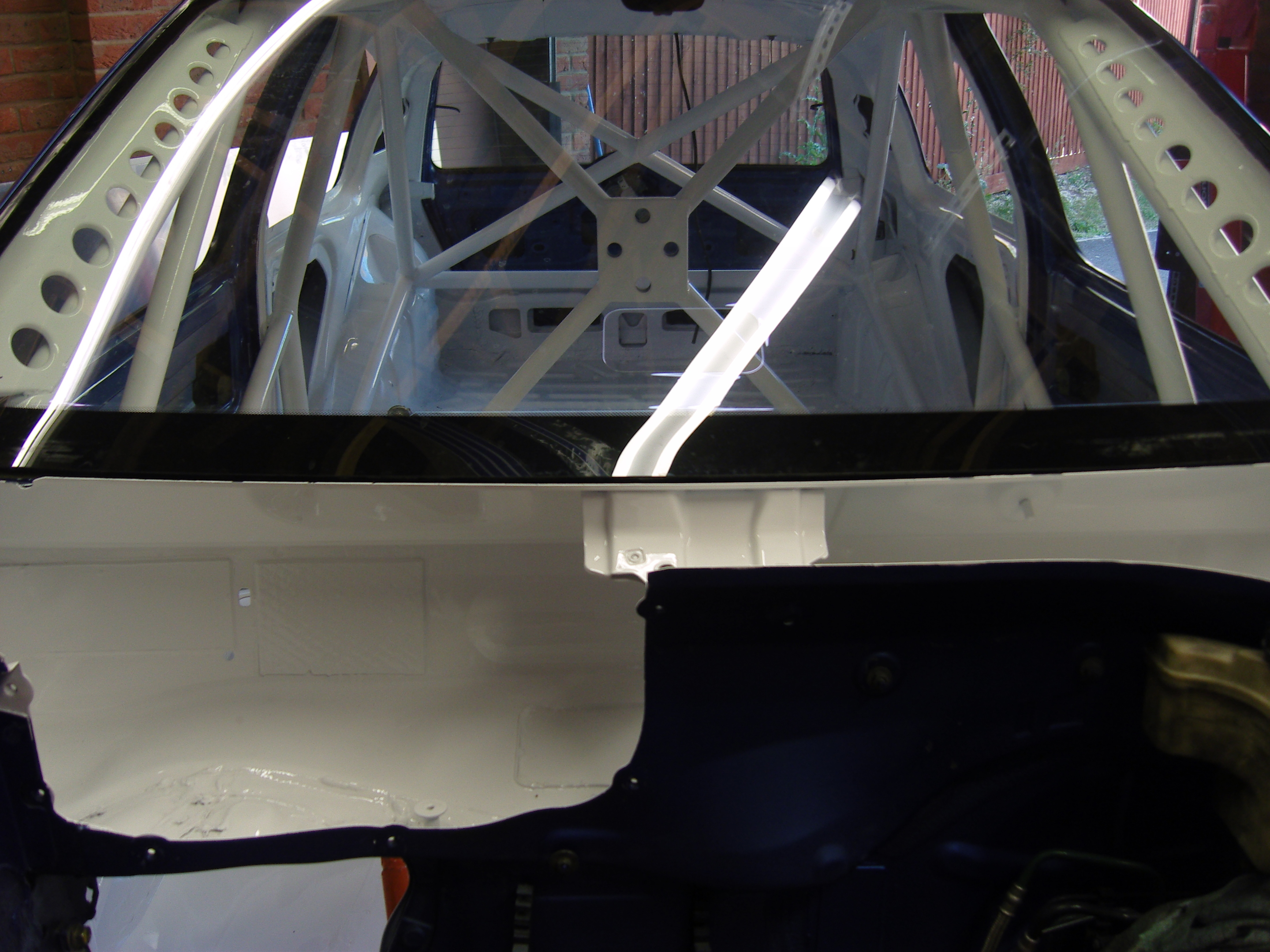

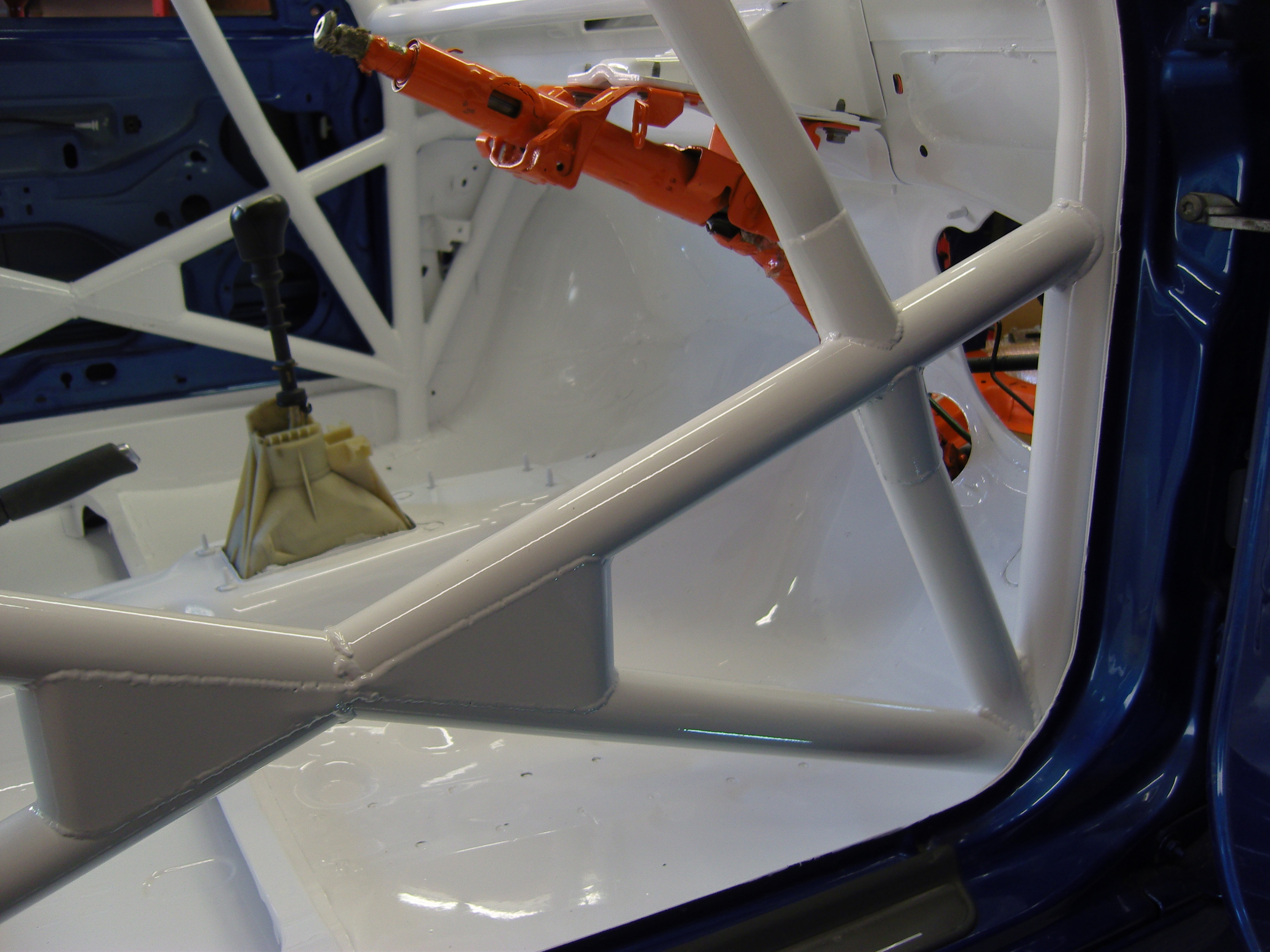

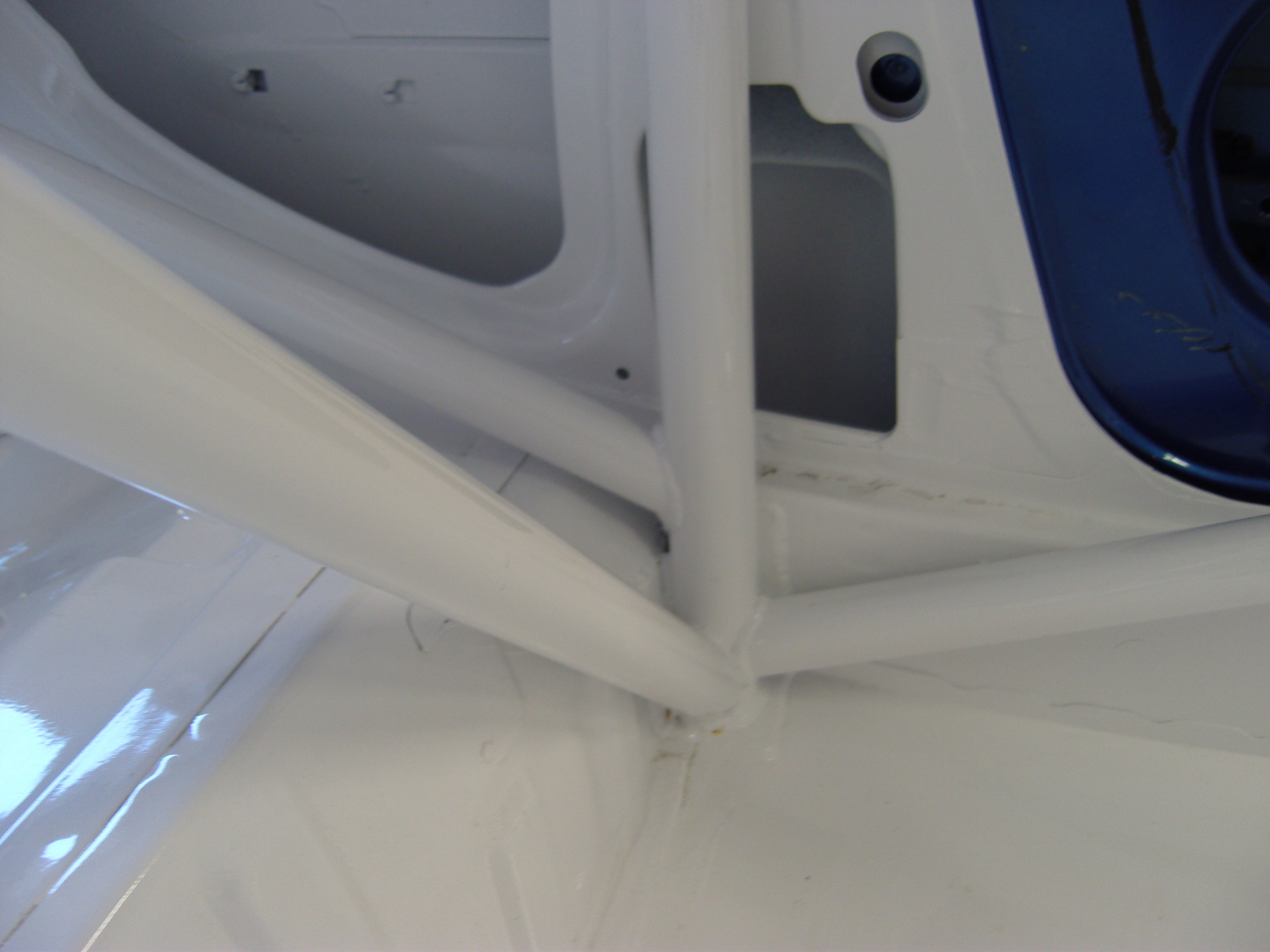

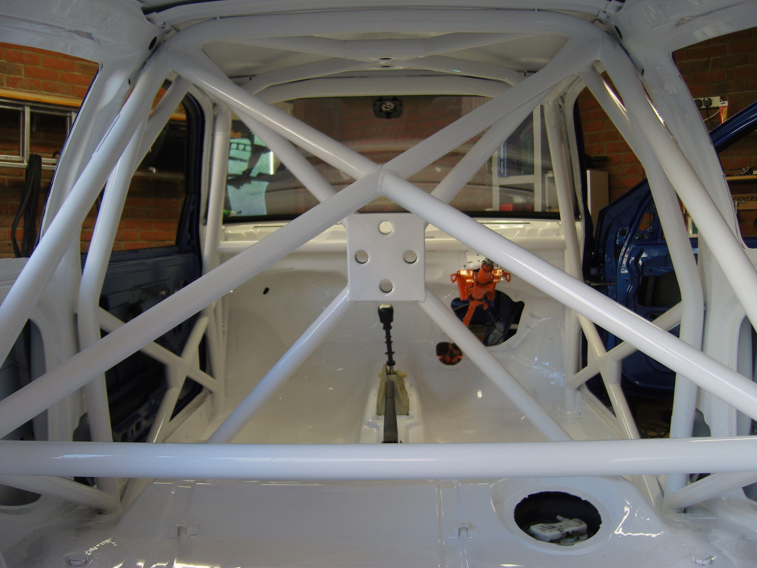

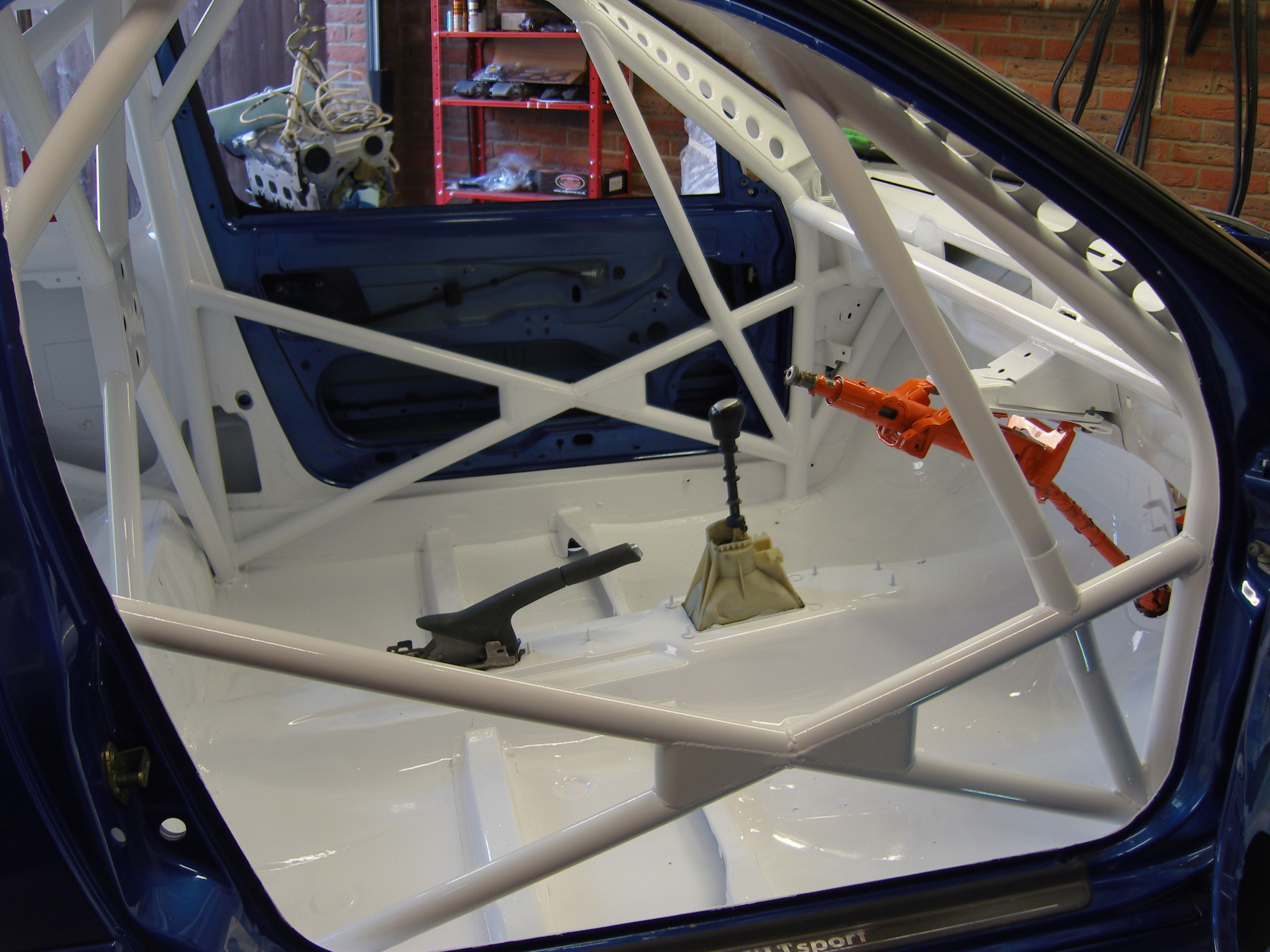

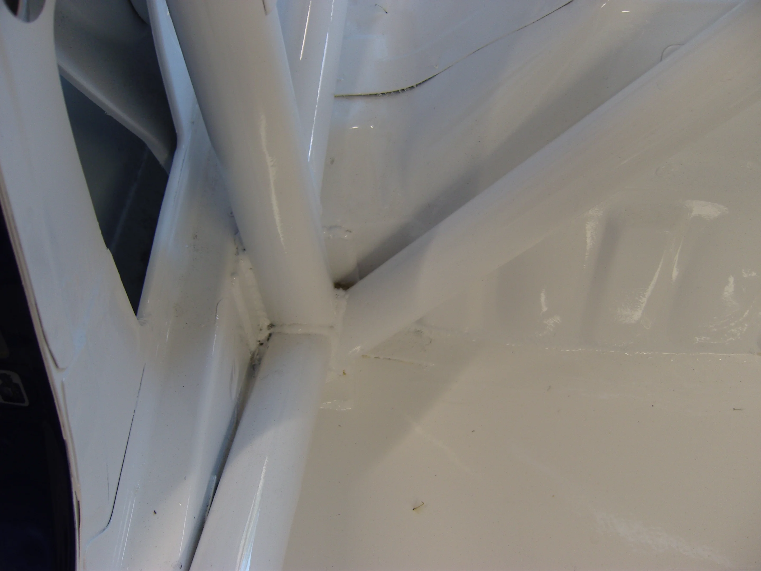

Here are some quick pictures of the cage and the paint job they did. I am very pleased :approve:
More pics to follow as I now have an awfull lot to do :)

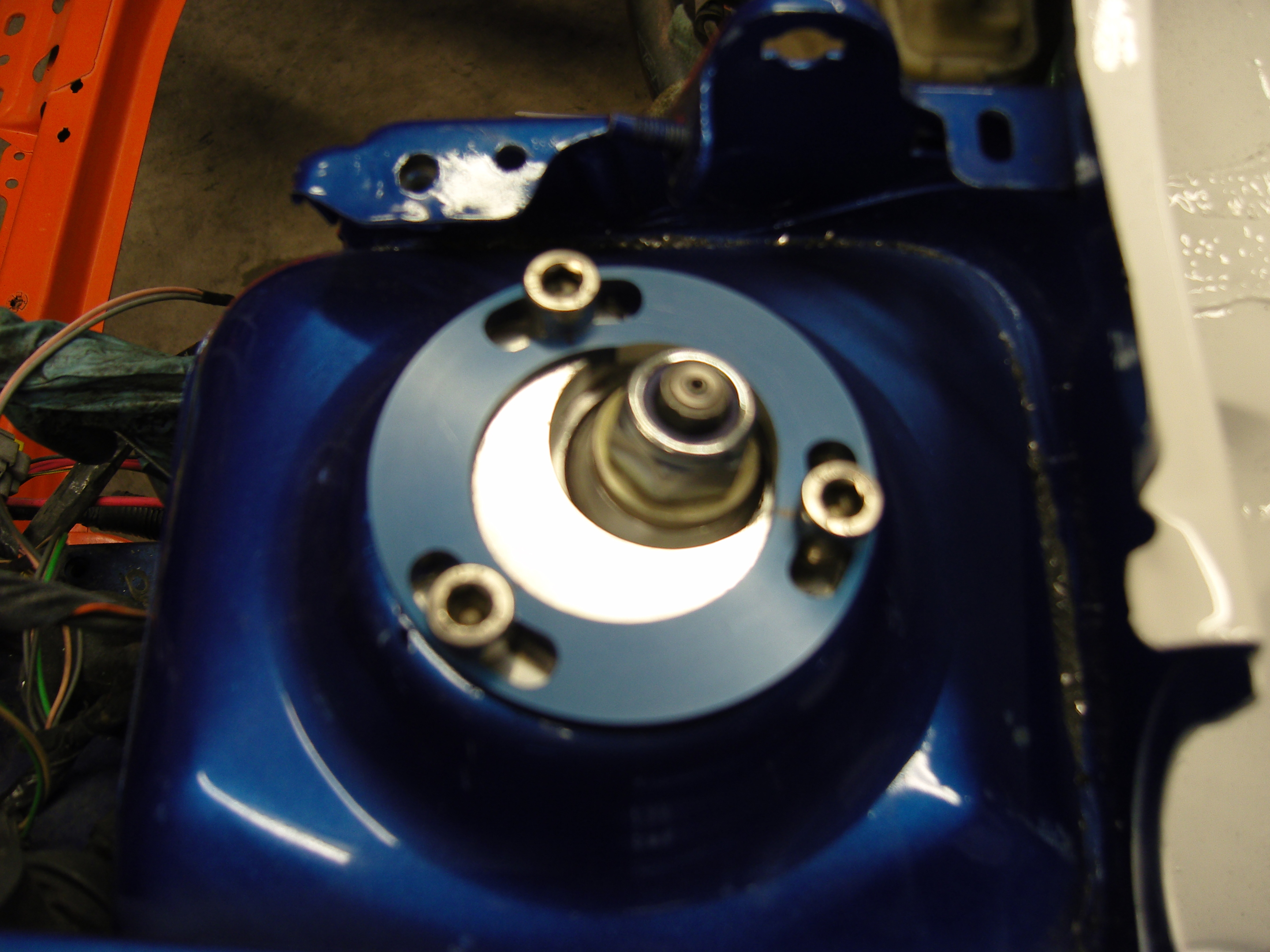

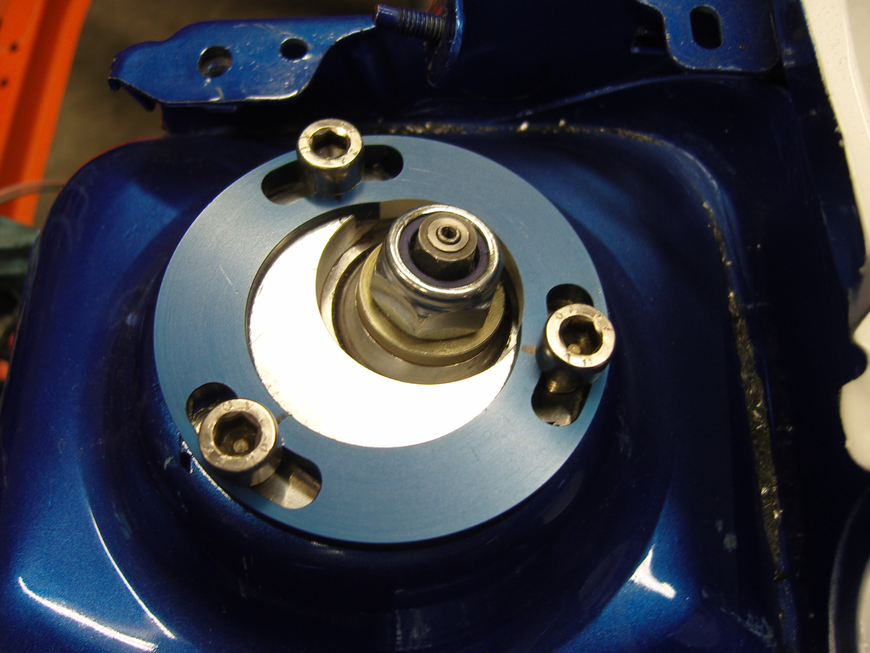

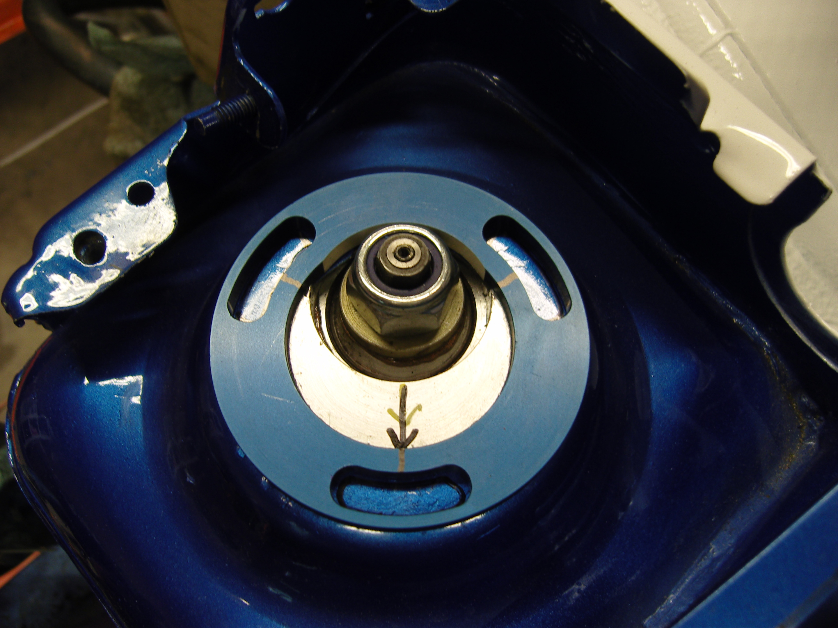

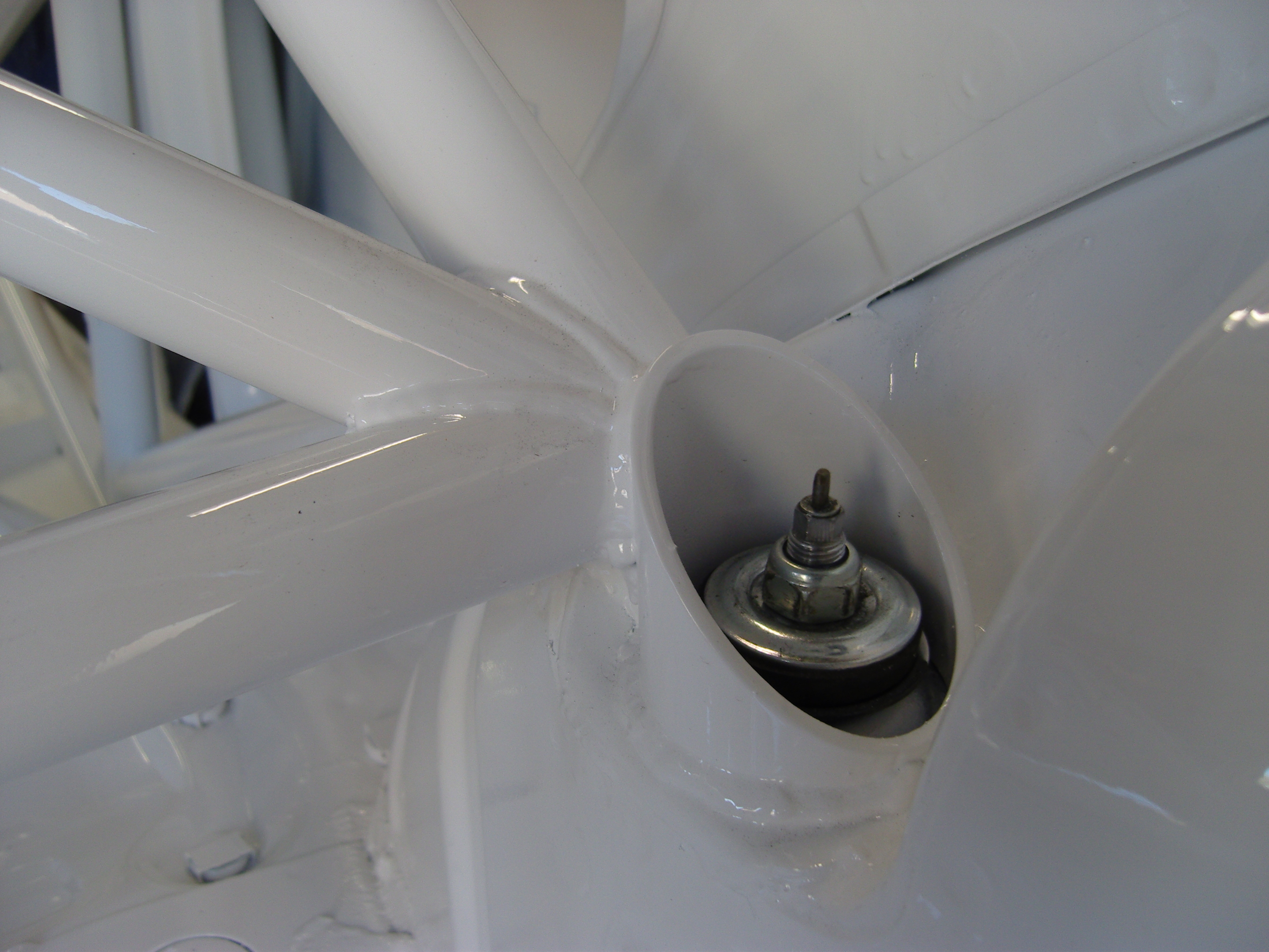

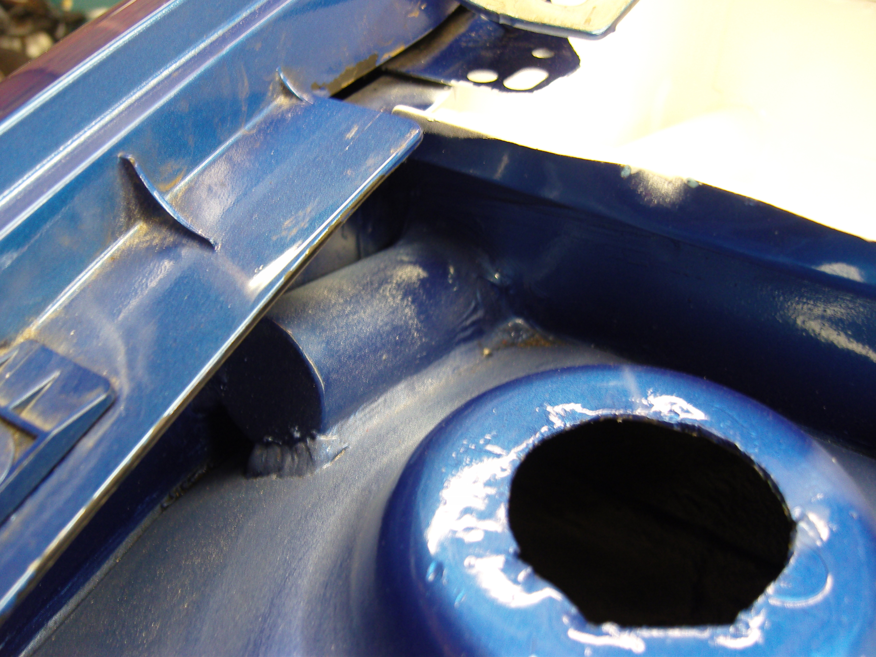

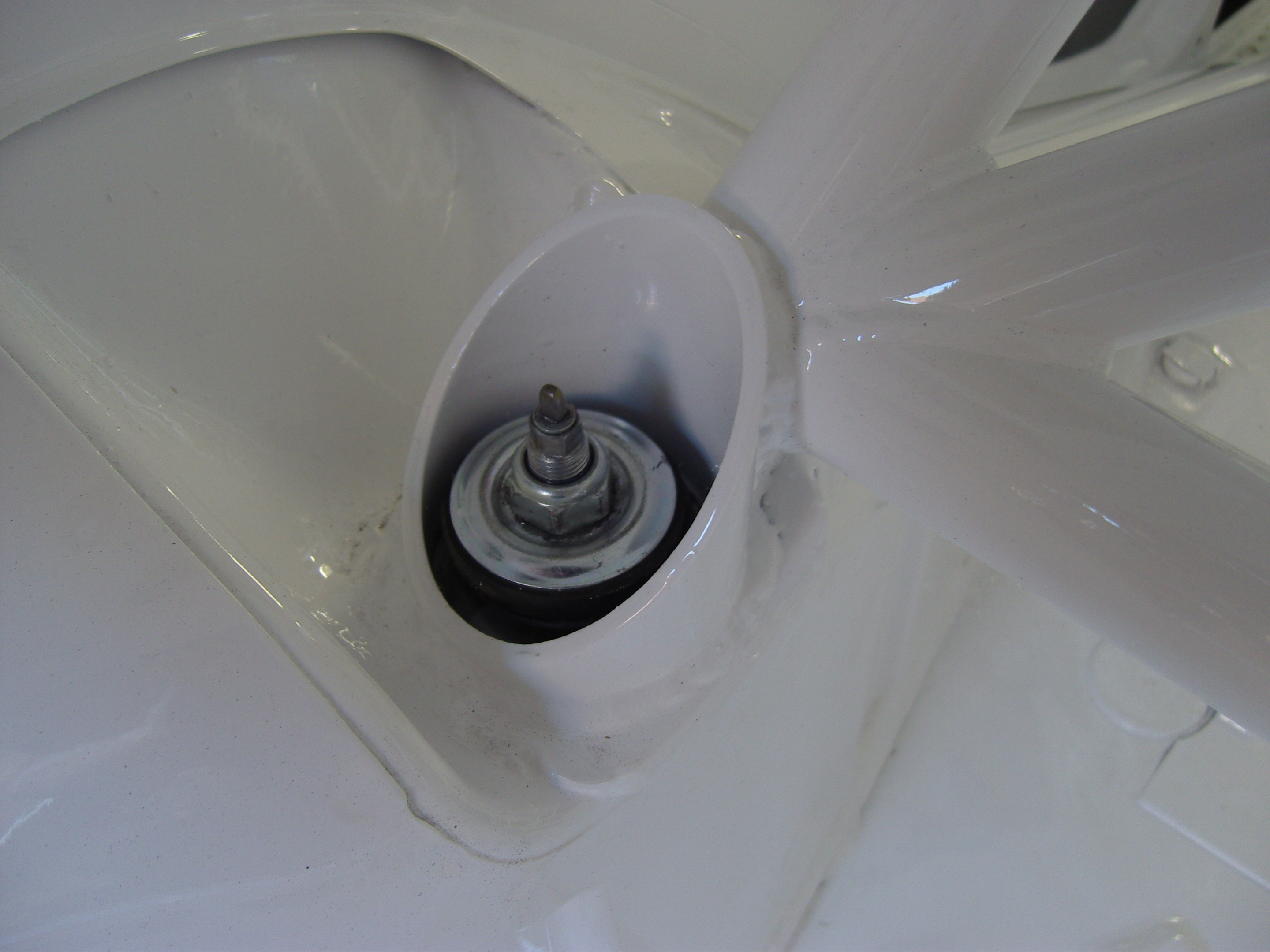

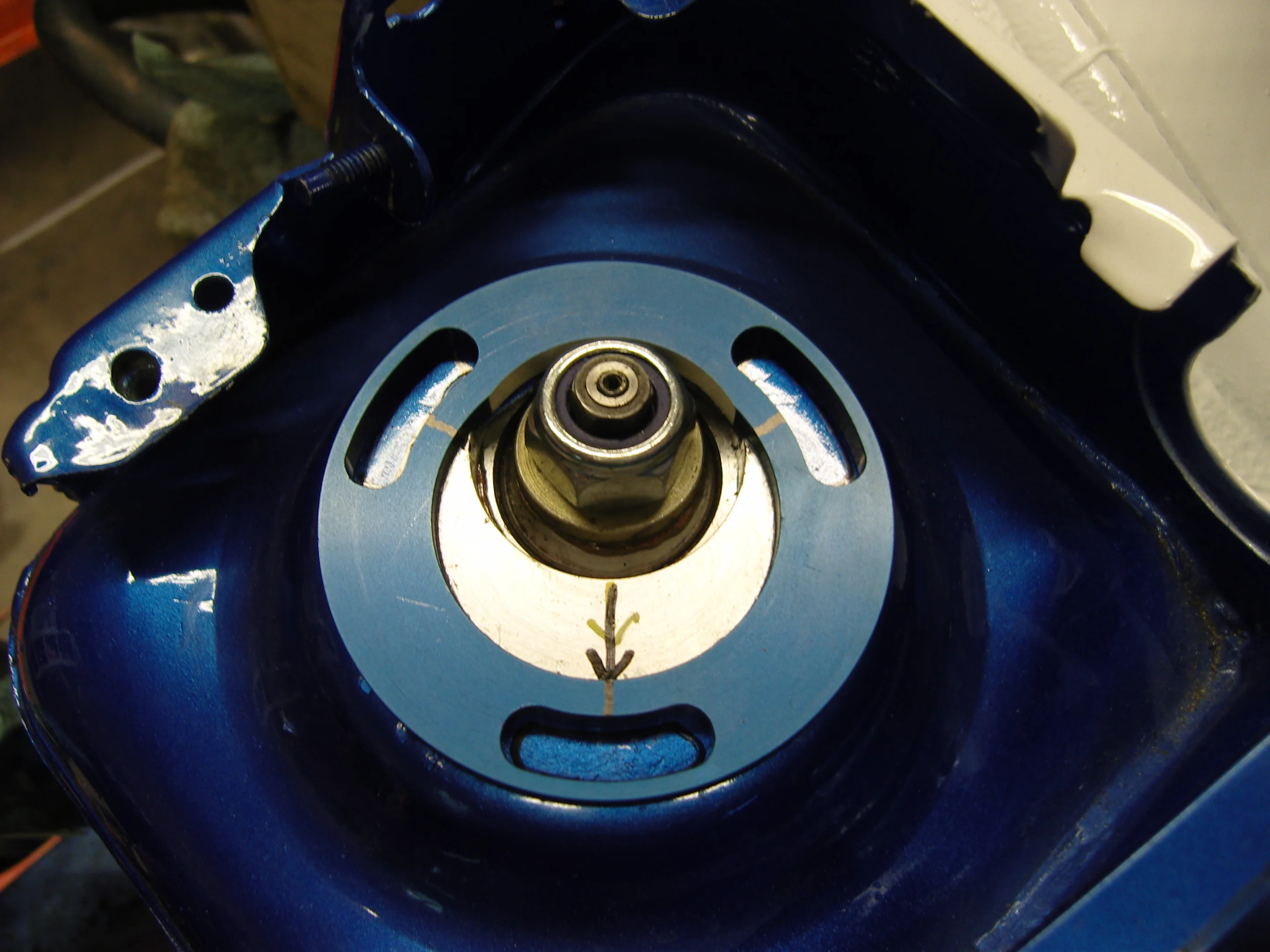

First I finally fitted my top mounts after getting my special brackets back. You can also see in this shot the roll cage to the suspension tower.
Very happy with the top mounts. Although when I went to fit the bottom of the KW the bottom holes were not big enough for the standard bolt LOL This caused much head scratching between me and Matt and also a drive over to see him where we decided just to make them larger. The hole spacing was also out. Got em fitted now. Pics to follow :)

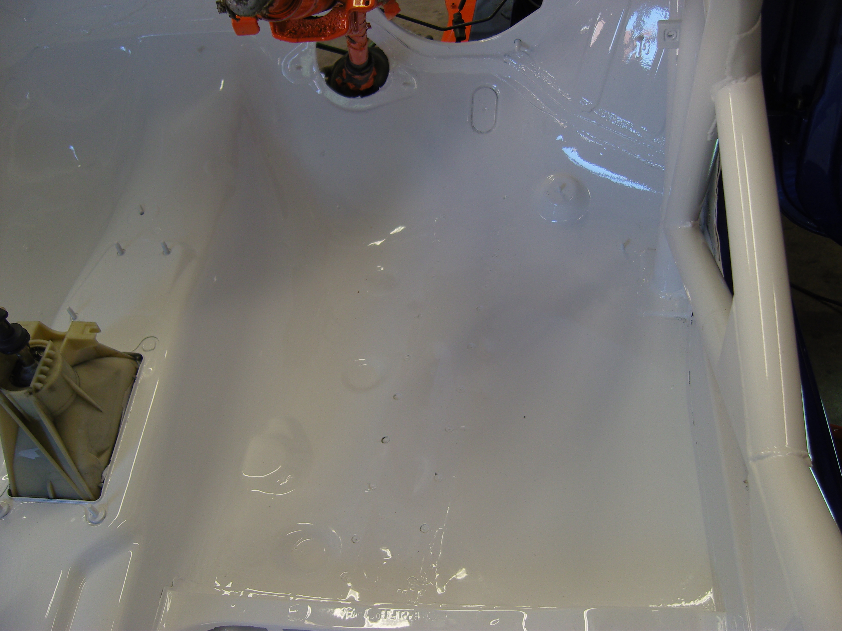

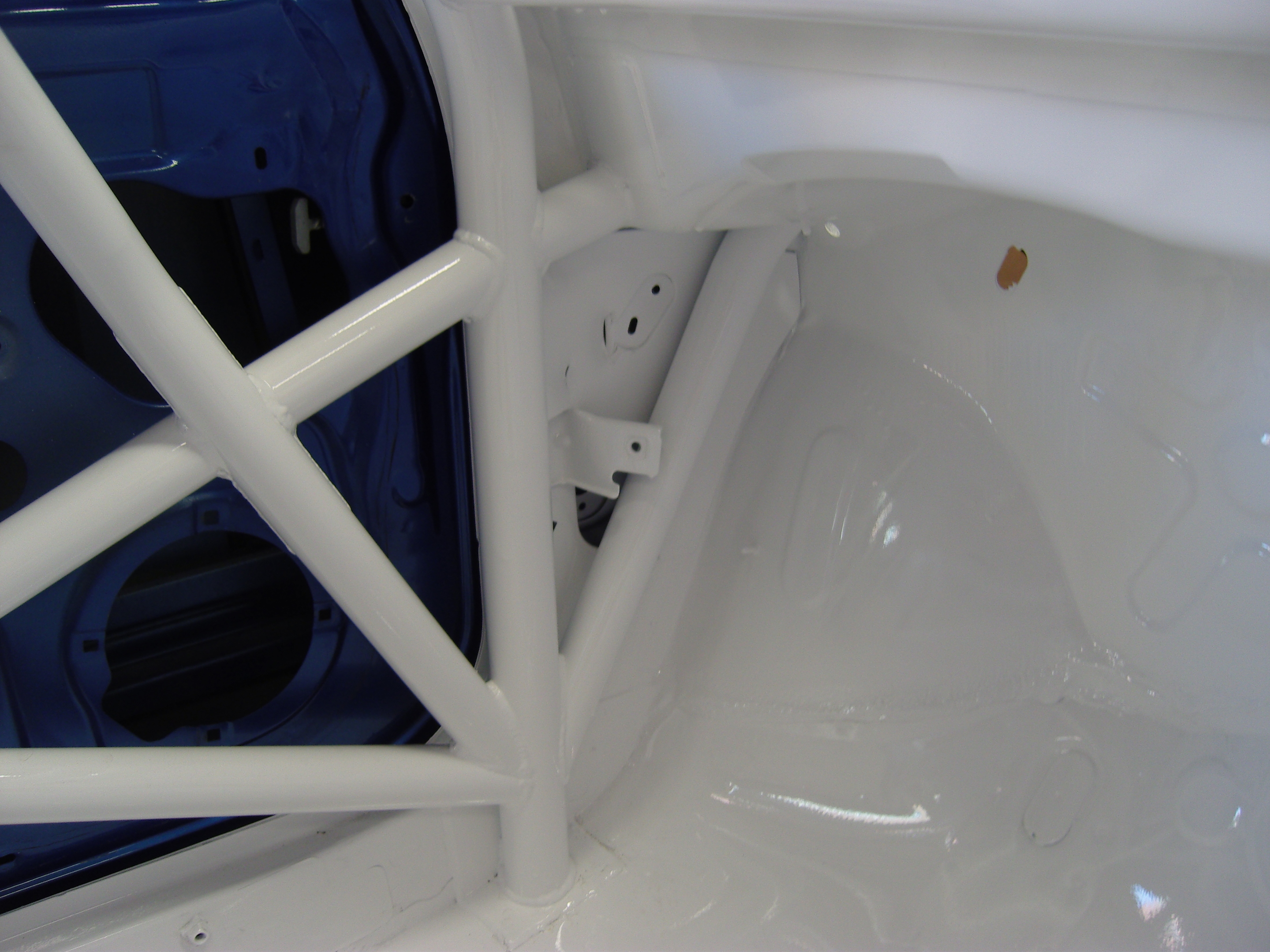

Yeh so can I :) £3256 for cage and paint but they also took all the brackets out and the floor ones too and then welded all the holes up. I like that they painted the front area where the air con used to be, looks nice in white. I have been drooling over it to be honest, very good quality workmanship.
Looks very nice,it's just trying not to scratch it too much now while you put everything back in:(.I said they do a top quality job,but lots of dollar.
Can see where your moneys gone there..that cage looks amazing
second both of these....
thats a f*ck load of work, just removing all the bits and bobs inside is a long job....
awesome mate, expect a pm regarding the window shortly
very nice mark. White looks ace, but i'd be tip toeing in and out of it ;) Those top mounts look really good too.

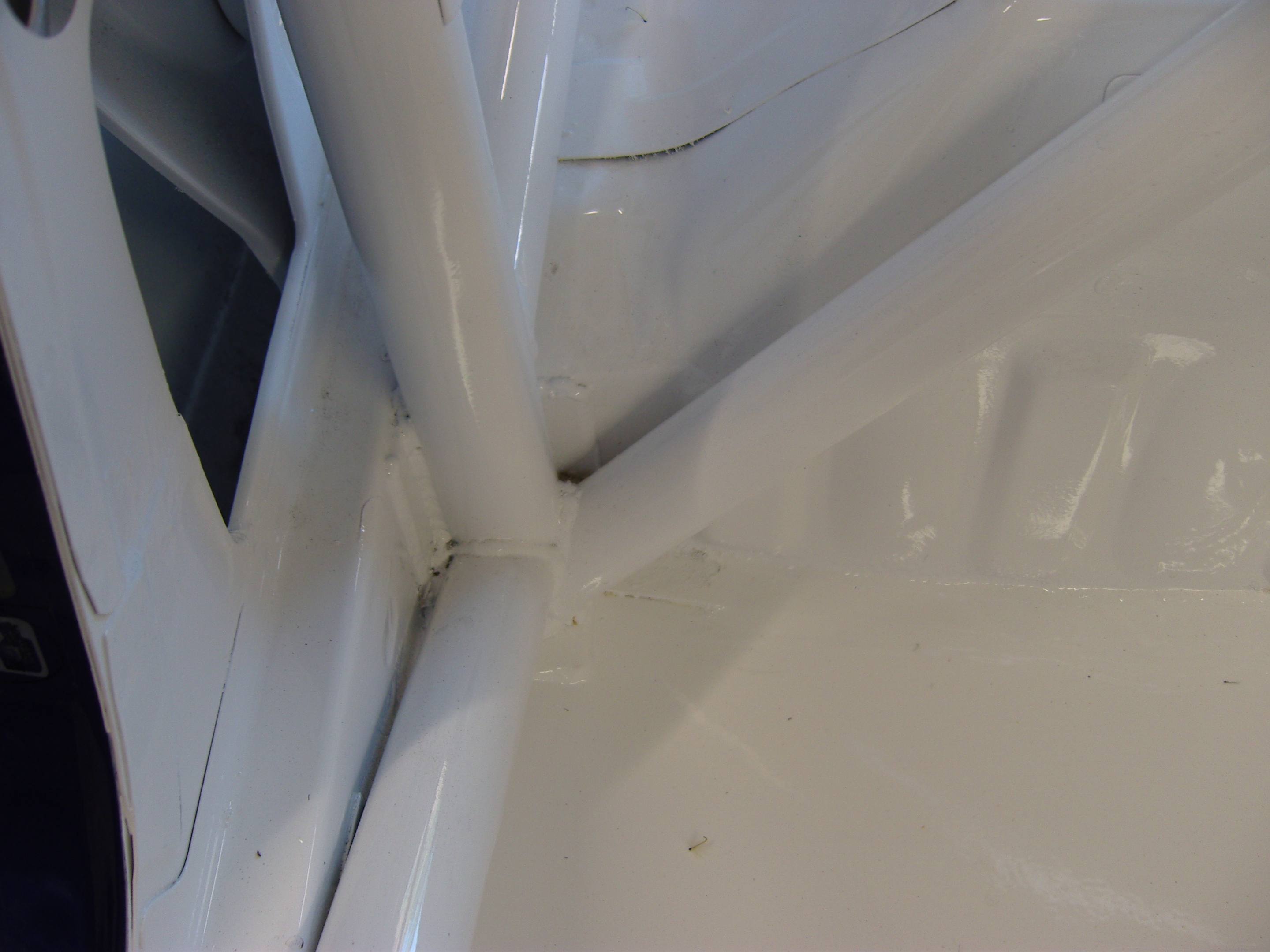

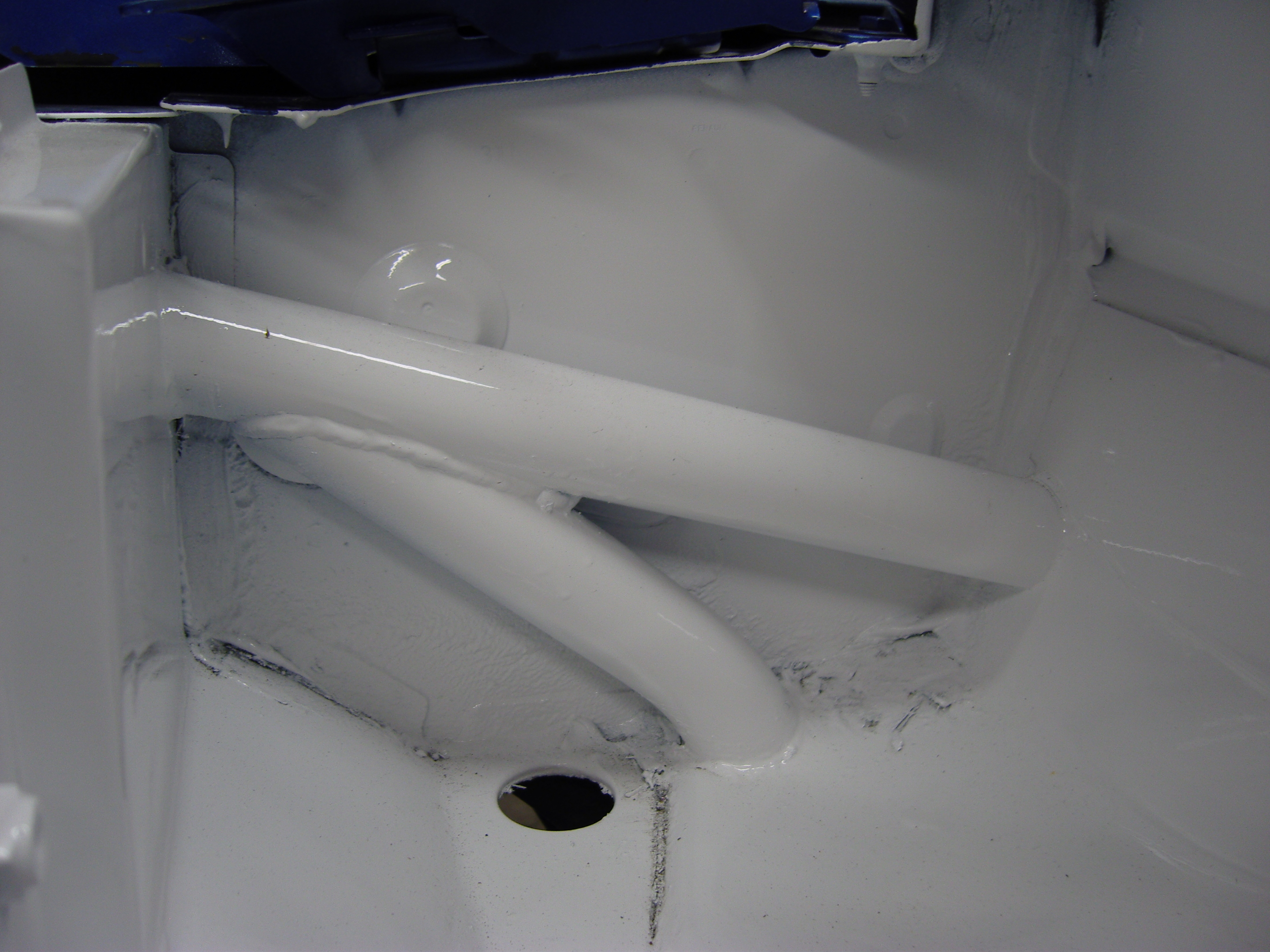

i cut mine back and tidied them up but these are totally removed,
you removed yours tony? it looks like they are only welded on in 3 bits? correct?
I had a look from underneath and it looks like they cut the whole lot out and then put a new plate back in.

Cage looks very impressive but looks twice as much steel as most fia cages I've seen. Is all the metal work absolutely necessary? Must weigh a ton.
