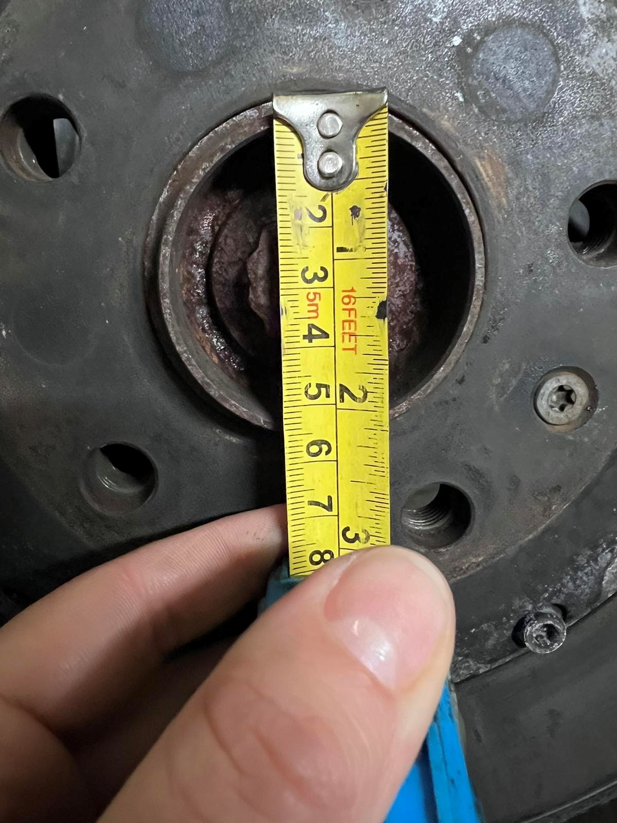

So, she informs me, the disc is 325x30mm - and CB of 56mm kindly illustrated here:
I need to get replacement discs tomorrow, so can anyone help me find them. I'm sure she can go to 345mm on the caliper, but they all seem to be 68mm CB?

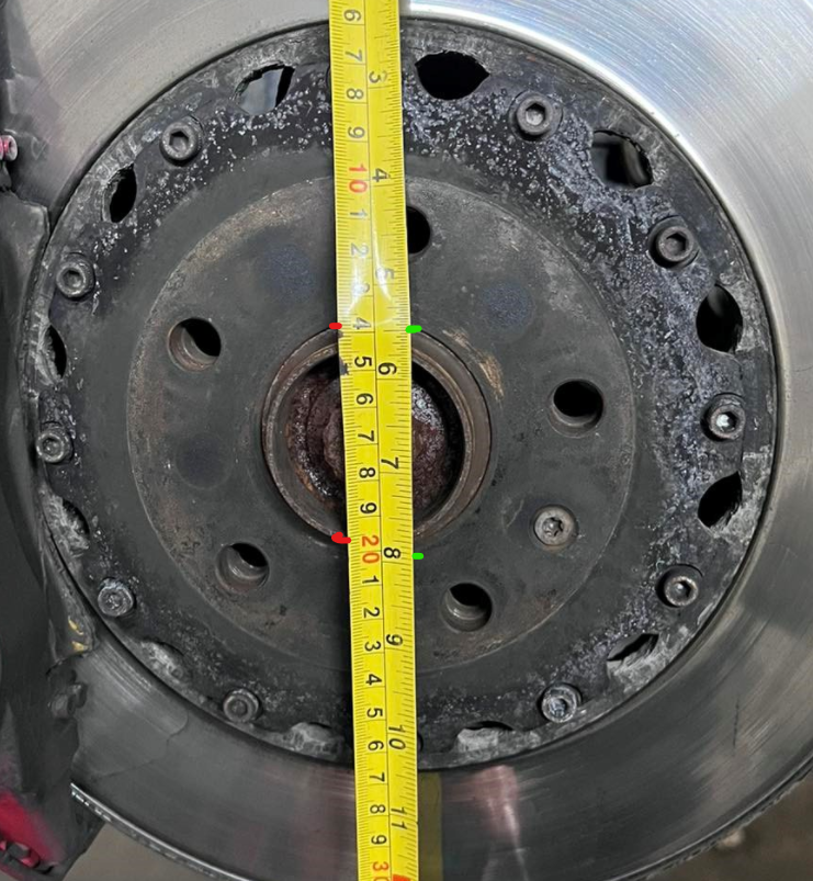

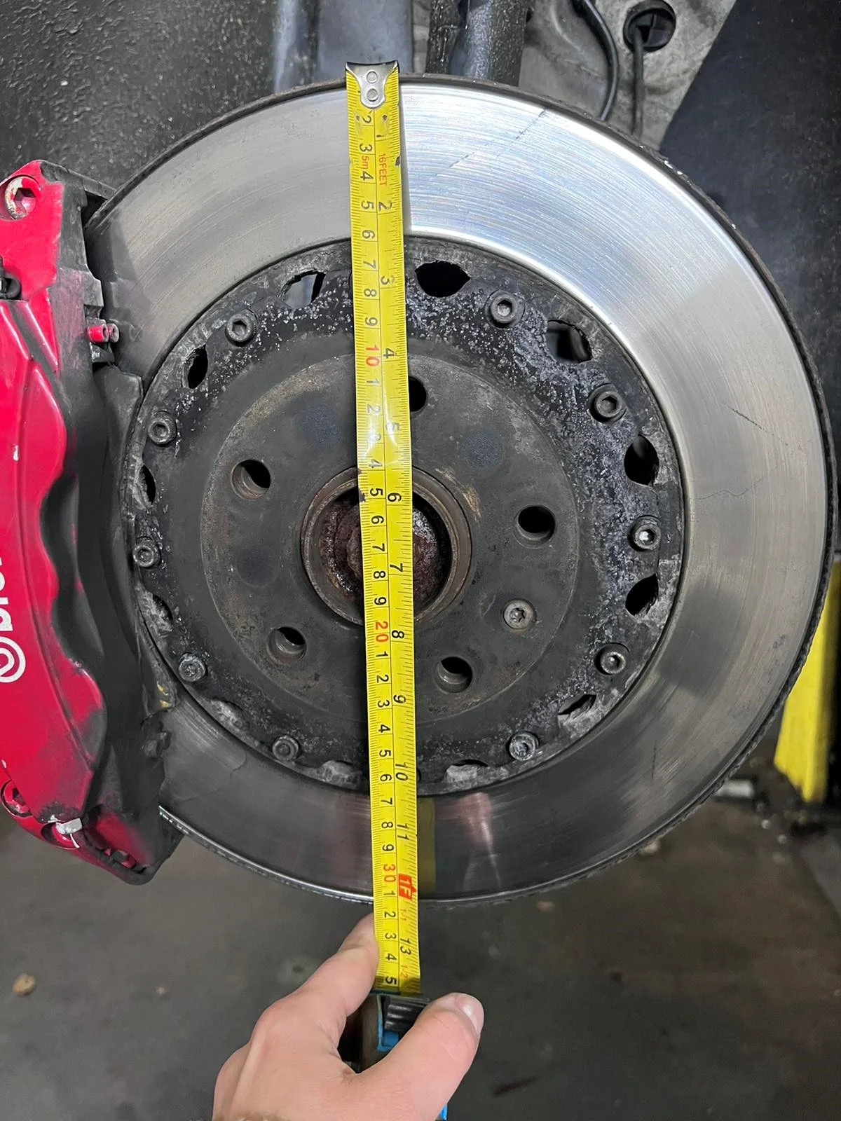

313mm floating, -now she sent me the picture
Non floating accepted

Without more pics it's hard to sayt but the MK5 GTI was 312mm discs as well. None of them are 56mm bore, they're about 60-65mm as there's a step machines into the lip to stop the spigot snapping off with a wheel on it ;)

However I don't think she is measuring it right.

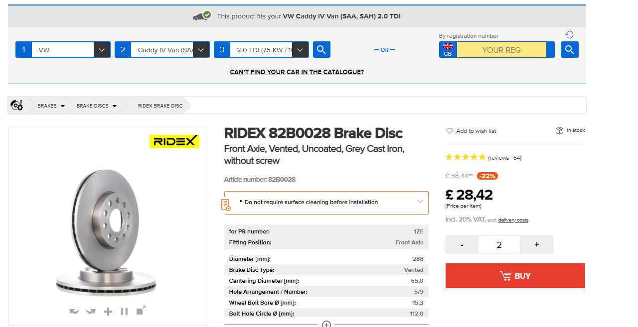

Get on autodoc and pop her reg in they often give disk dimensions which seem to be mostly center bore 65mm for the caddy. Although it will be the wrong disk for her caddy (due to the brembo conversion) they probably used the standard caddy hub.....
Oggy997
  997, e208, I.D. Buzz
Yes can see that, tape measure at slight camera angle isn't mm accurate through 🤣 but you are right it can't be nearly 10mm out!
Can you pop her reg into autodoc and see what the standard bore is?
You actually guessed the right car, Caddy IV, 2.0TDi, SAA
DF66WXN - 65mm centering diameter

It's not 65mm though!
I've bought a micrometer, worst case shes jacking it up tomorrow

No idea what's going on there then because your pictures certainly don't look like the disk has a 65mm bore!!

Ok, so Im going for 65mm, are we saying 288 or 312mm for the discs.
I think 288mm might be more likely if you flatten the hub bit and take disc to disc

Apparently from a TTRS which is 300-340mm.

Found them, a bit late in the day.
Forge Motorsport 6 pots with FM EBC Yellow Stuff pads.
Yellowstuff pads are cheaper than the Forge variants, but Forge don't list the part number on their site for the yellowstuff, so I have to order or call them on 3rd Jan. Other suppliers may be open, but no good without that part number!
Discs are 330x32mm

Are you 100% sure they are 330mm on there?

The guy who modified it said they’re forge 6 pots and linked them, they only do two sizes, 330/356mm.

I forgot to update, they were the correct discs. why the previous owner made the callipers say brembo when they aren’t I’ll never know
