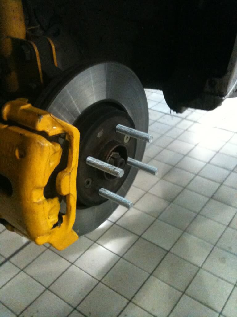

Hub spacers on the rear

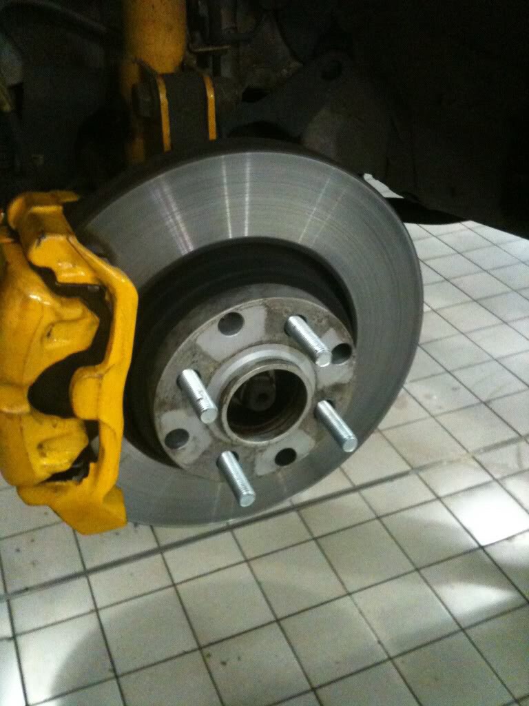

Bolt to hub spacers on the front
Don't do bolt to hub spacers on the front , you'll have to remove all the wheels one by one to check its torque after a track outing . Plus i have heard of an instance where a wheel came off on track when the bolts holding the spacer came loose . Fit the type I have , only 4 nuts to check after an outing on track and no wheel removal . Win win from my perspective .

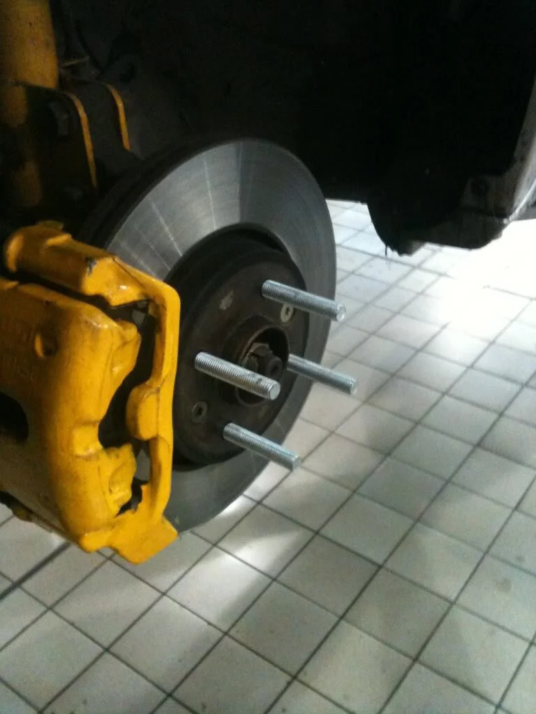

Without spacer

They look interesting,
Are these just tightened into the standard threaded bolt holes ? Interested to know how to get these tight without crushing the thread if so?
or are they fed through the back of the disc ?
what width are the spacers?, the ones i have seen online seem to be 15mm or 16mm. Just wondering if I am then gonna cause the reverse issue of have the outside of the tyre rubbing the outer wheel arch ?
where did you get the kit from out of interest ?
