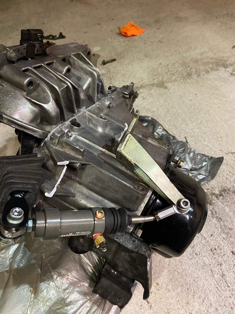

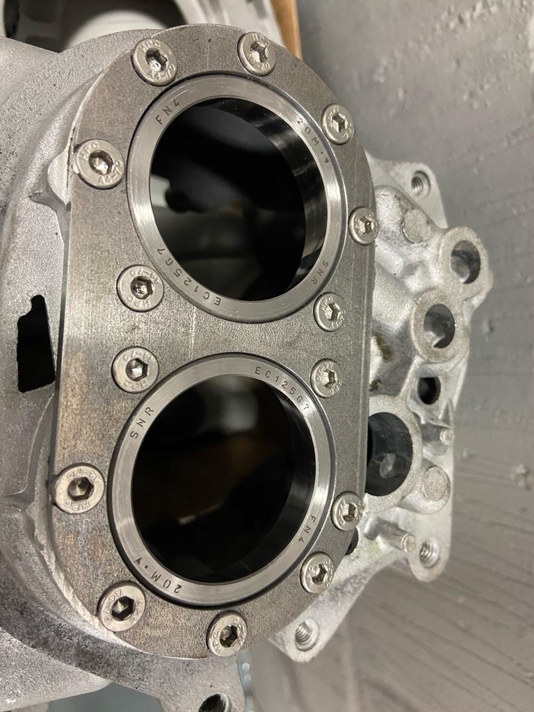

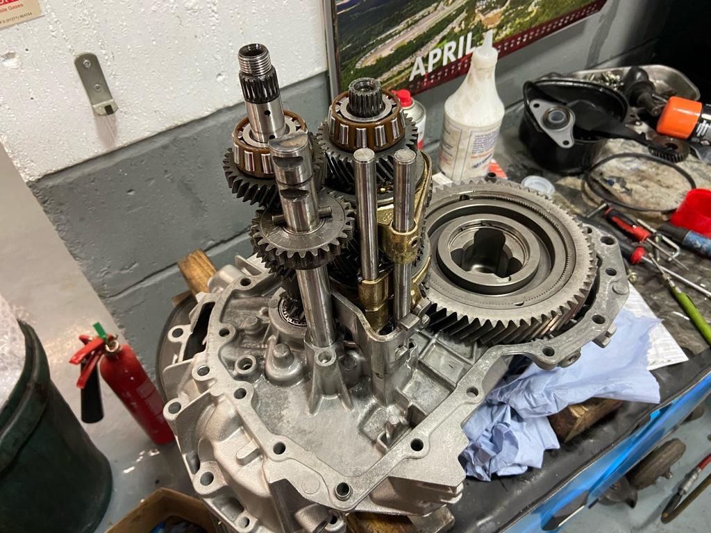

Been a bit quiet lately, had a bit of a nightmare...

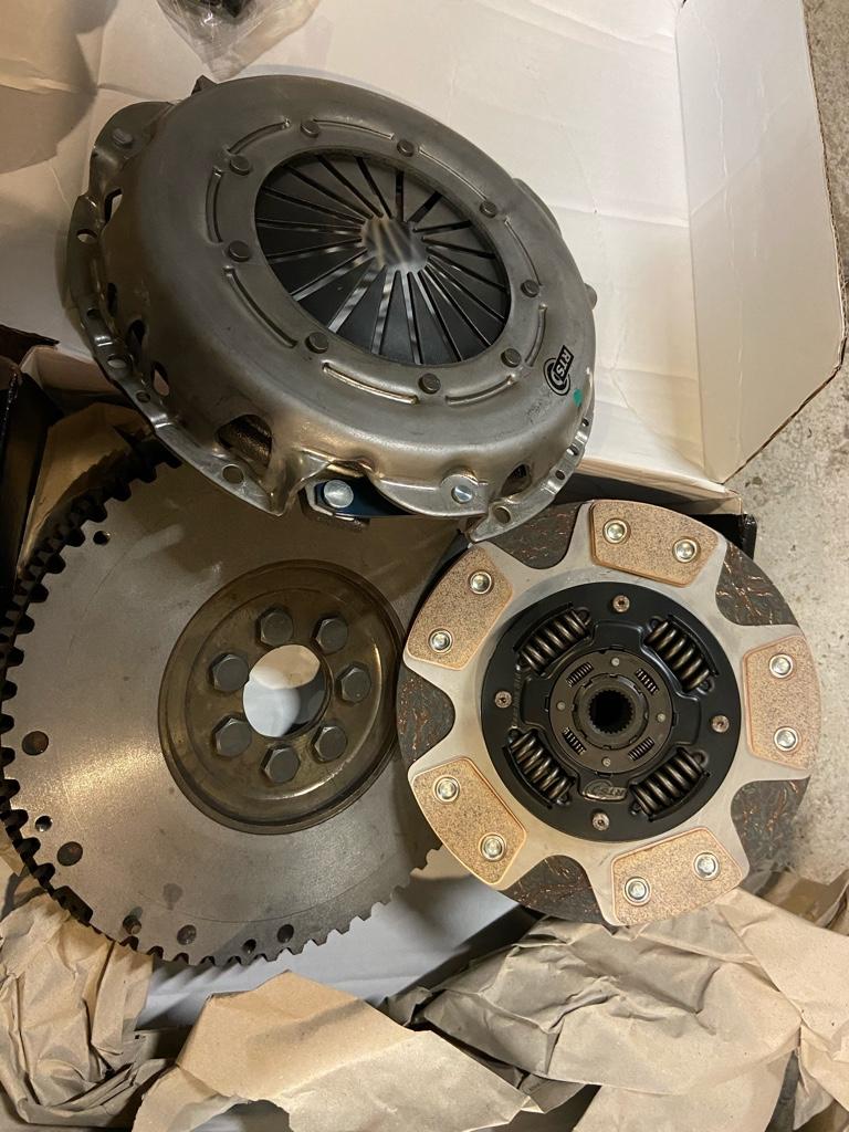

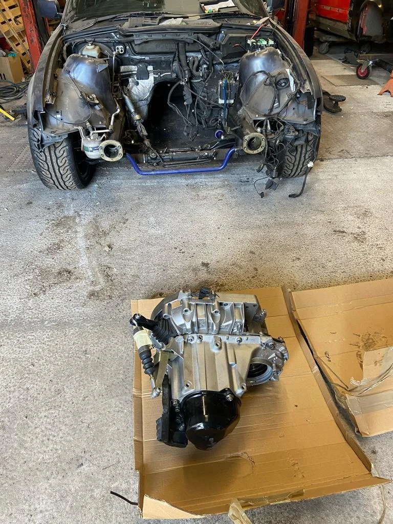

Removed my gearbox to replace the clutch, whilst at it I gave the LSD an overhaul. Replaced some worn shims and gear. All went well until I went up to fit the box one evening on my own, have done this many times as it’s my job. But this time I managed to loose my balance when pulling over my transmission jack and dropped the box from head height to the floor!
[emoji30][emoji30][emoji30][emoji30][emoji30][emoji30][emoji30][emoji30][emoji3064][emoji3064][emoji3064][emoji3064][emoji3064][emoji3064][emoji3064][emoji3064]

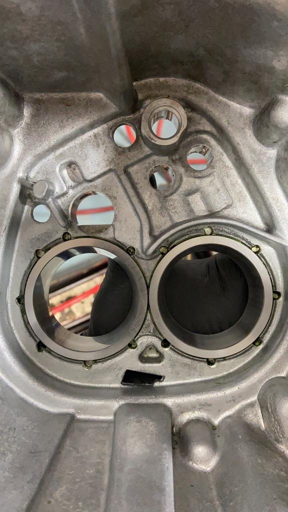

Ah well upgrade time... So I contacted Nick at pure who had an 089 casing which uses taper bearings on both shafts which can be pre loaded to perfect settings, I also had the reinforcement plate machined and added to the casing to stop cracking with the power I run. My accident ended up costing me £600 with extra bearings etc but I feel much happier with it all now, feels great.
Did 150miles today to bed the new clutch in!

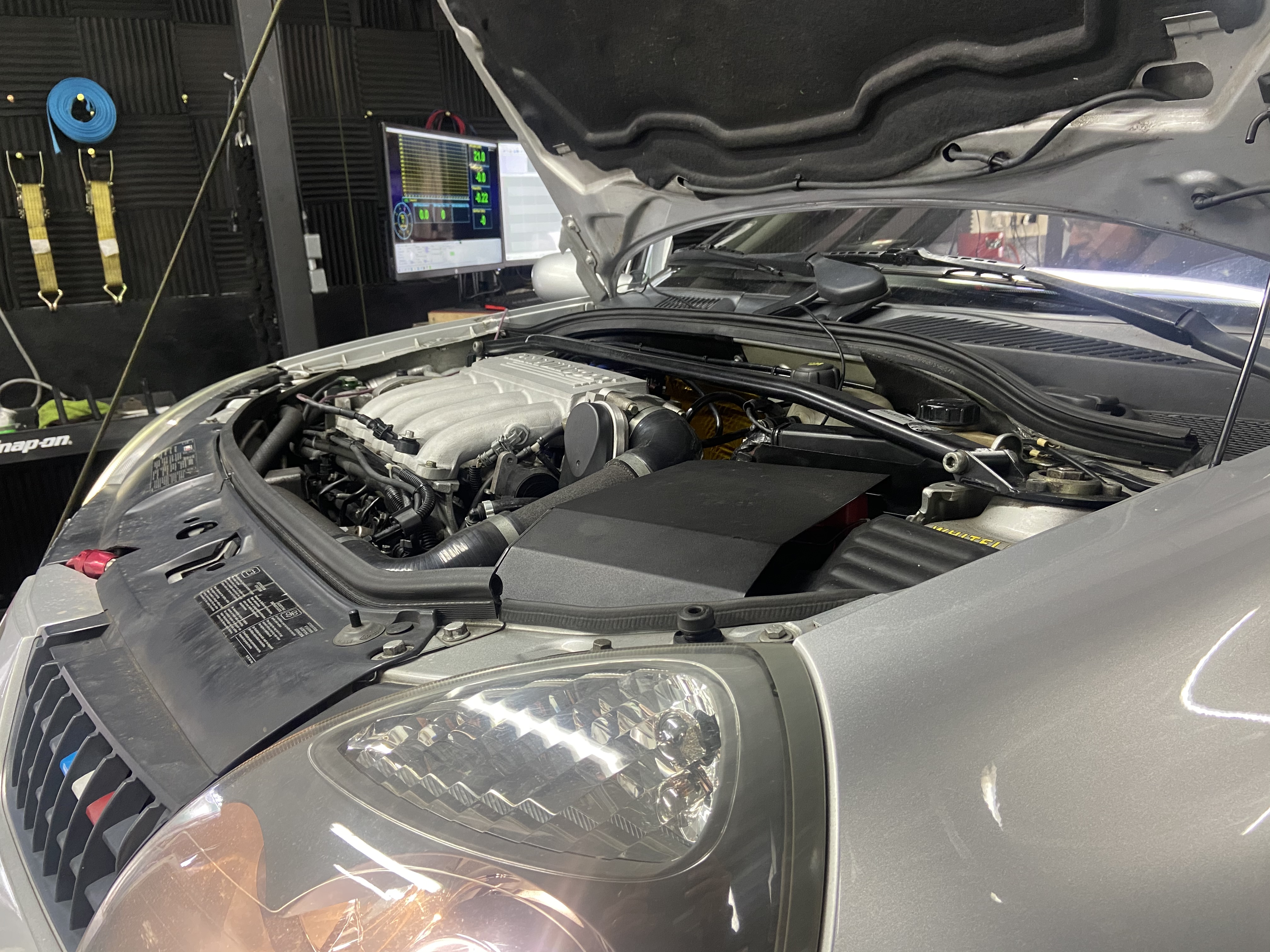

New manifold must be flowing better as I’m seeing my boost hitting 16.7psi which is silly, so now that needs a tweek!! 15.5 was the norm... AFR all seem okay regardless but not risking it as castle Combe is booked for the 28th hoping I can get it to Andy before [emoji51][emoji51]

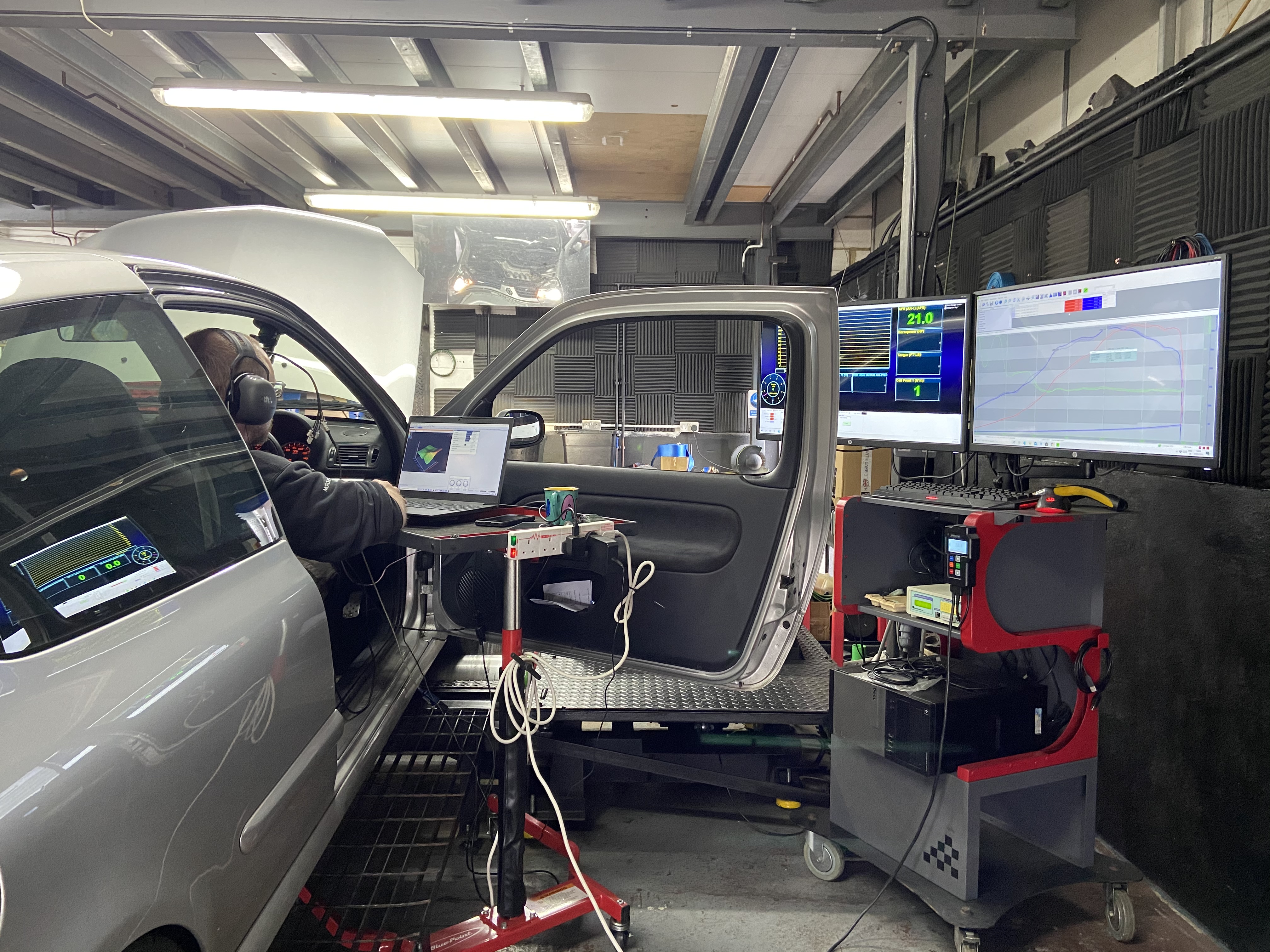

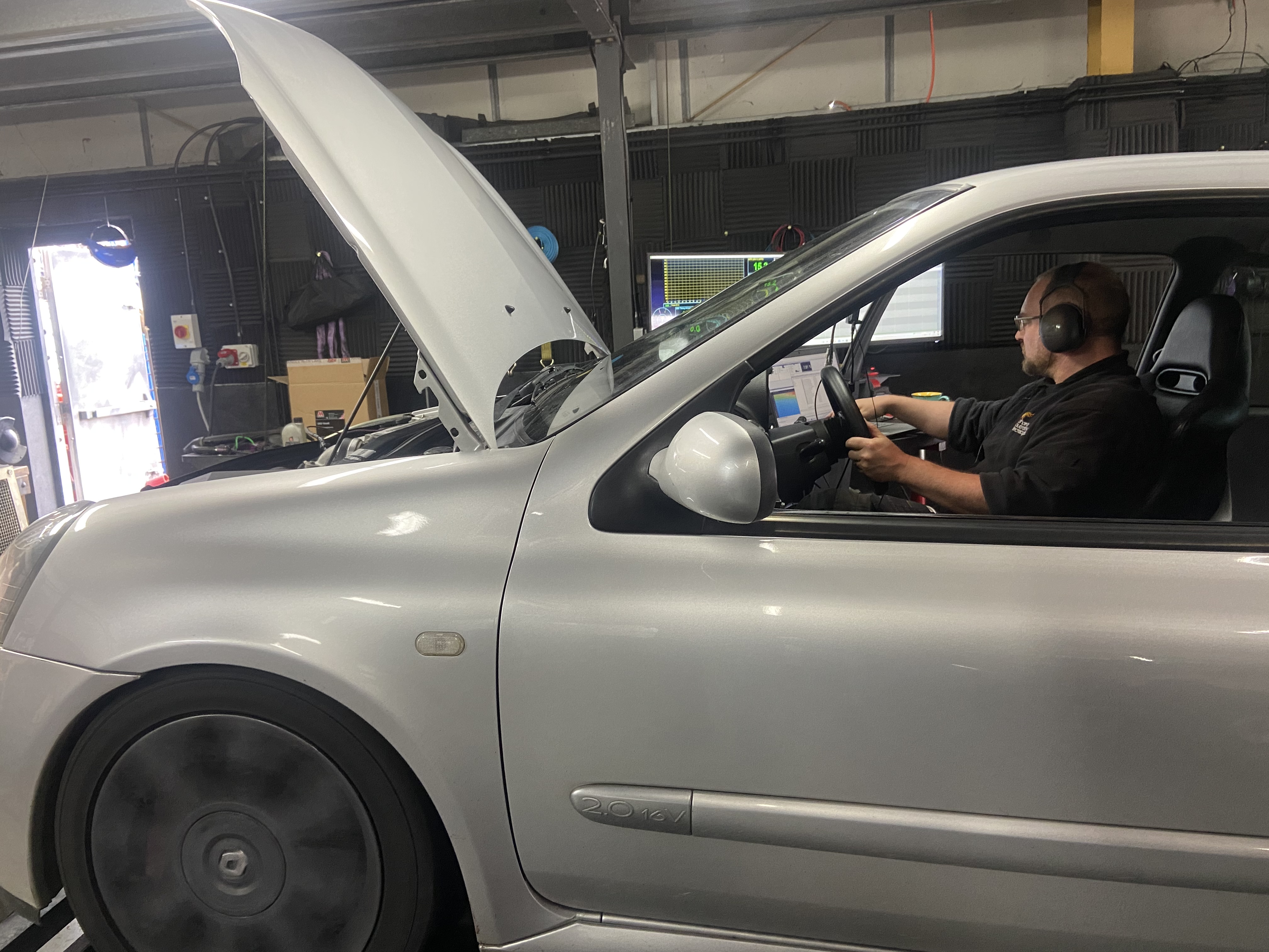

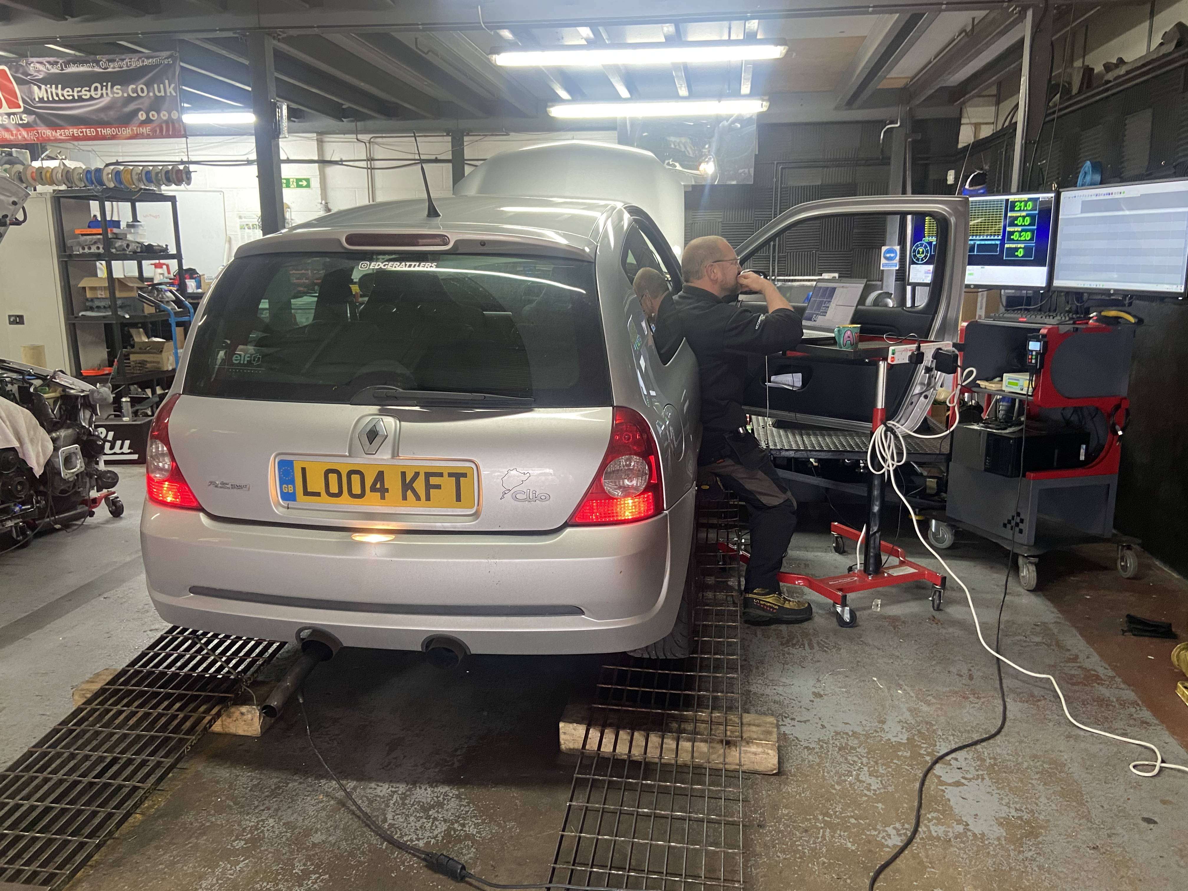

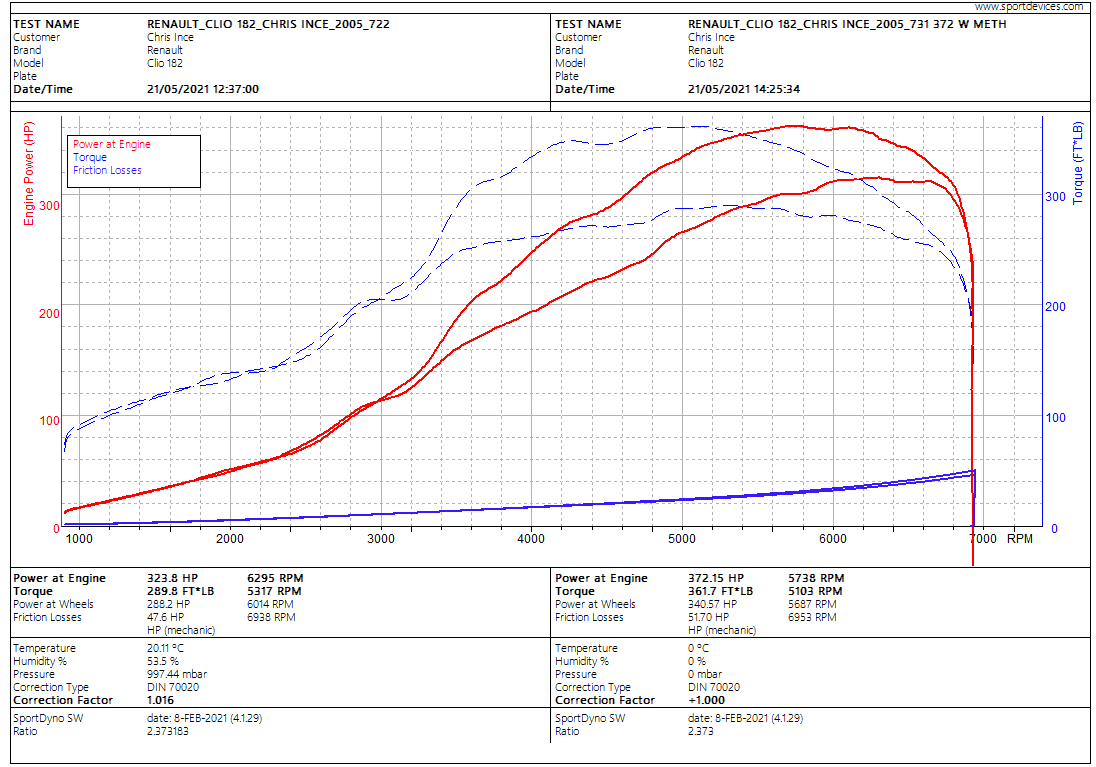

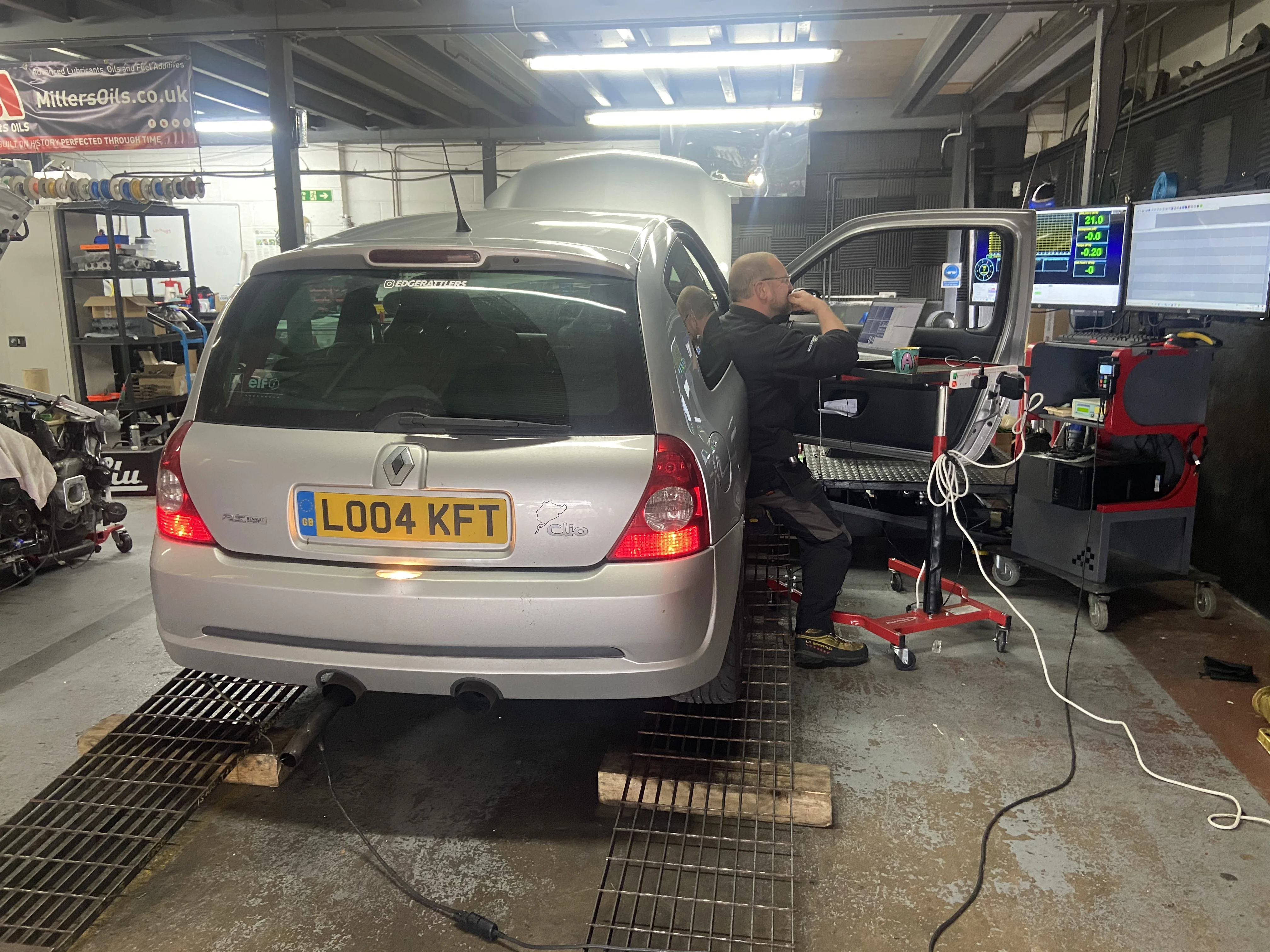

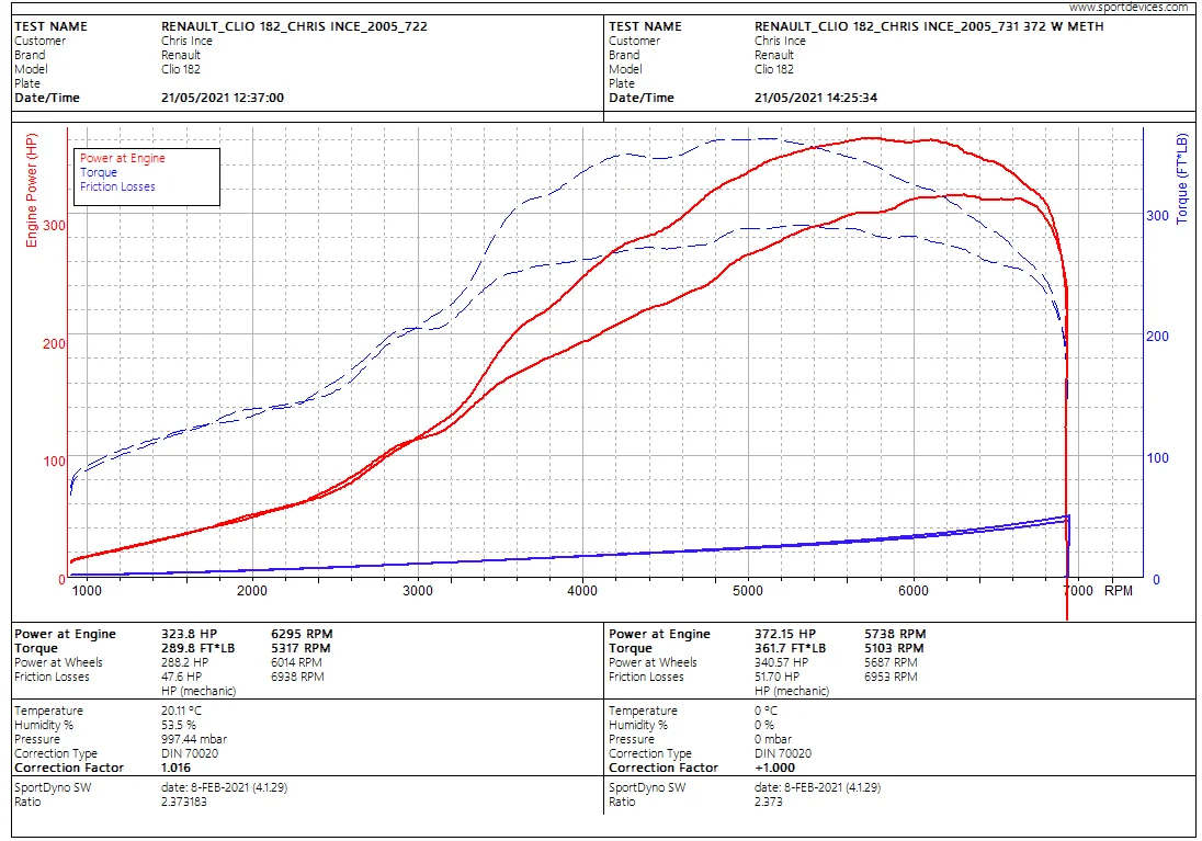

Popped up to see Andy at Phoenix to get my mapping checked after putting my vband manifold and turbo housing on.. I had to turn the boost down manually on the actuator as I was worried about high boost readings.
anyway after some low end throttle tweaks we began some runs and saw with my actuator tweaks it was lower on power which was expected.
after some mapping we got it back to around 350hp and 340lbft.. and with a flick of the meth switch it sits happily at 372hp and 366lbft @ about 16-17psi which is basically nothing for the power and it really makes it with ease!
we could see 400hp with a puff more boost but 350 without meth and 372 with meth is where I’d like it to stay, it’s still very progressive and for me easy to deal with so all good!
Graph is power when arrived v’s power when mapped...

What box are you using, is it the 089?
Yes mate it’s the 089. Also thanks [emoji106][emoji106]
How do you find the box? I’ve got the standard 130 from the 182 in mine and it just seems like all I do is change gear. Is yours a bit longer?
It’s the exact same ratios as the 130.. it has my LSD crown wheel and gear clusters in, just the Input shaft from the 089, bearings and shim etc.
In an ideal world I’d like a 6th gear but at this moment in time the 02M conversion isn’t perfect enough!
