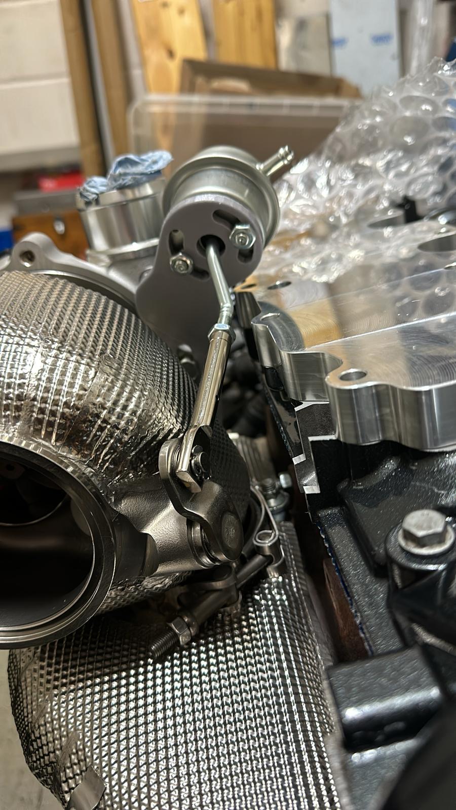

Last weekend I had a map check by Andy, as I was getting some 22psi boost spikes, should be 16-17ish.. anyway was worth the trip and my concerns were justified, I’ve not been driving hard for this reason or any track work!
turns out my 8psi spring in the actuator had weakened off resulting in some boost control issues, I need to run a 12psi really but we have re worked the boost control accordingly and it’s a solid 16-17psi again.. fuelling perfectly all along so no drama. Feels awesome again, very strong and not hitting boost limit within the ECU which basically closes the throttle when reached for safety! Slightly back the power off until I get a new spring.. sits at 340hp currently and 360lbft!
The 200 bottom end with Meg 265 pistons and rods with Clio 182 head is a great setup, no more over complicated Aux belt setup, easier timing belt replacement in the future, the 6 speed NDO is awesome.. really notice better fuel economy cruising in 6th at 2.5-3k rather than 4.5k.. love it!! Hoping to get some track time in before the year is out. One of the vids shows loading and lots of fuelling setting up boost.. carbon burning off inside the exhaust 😬😬

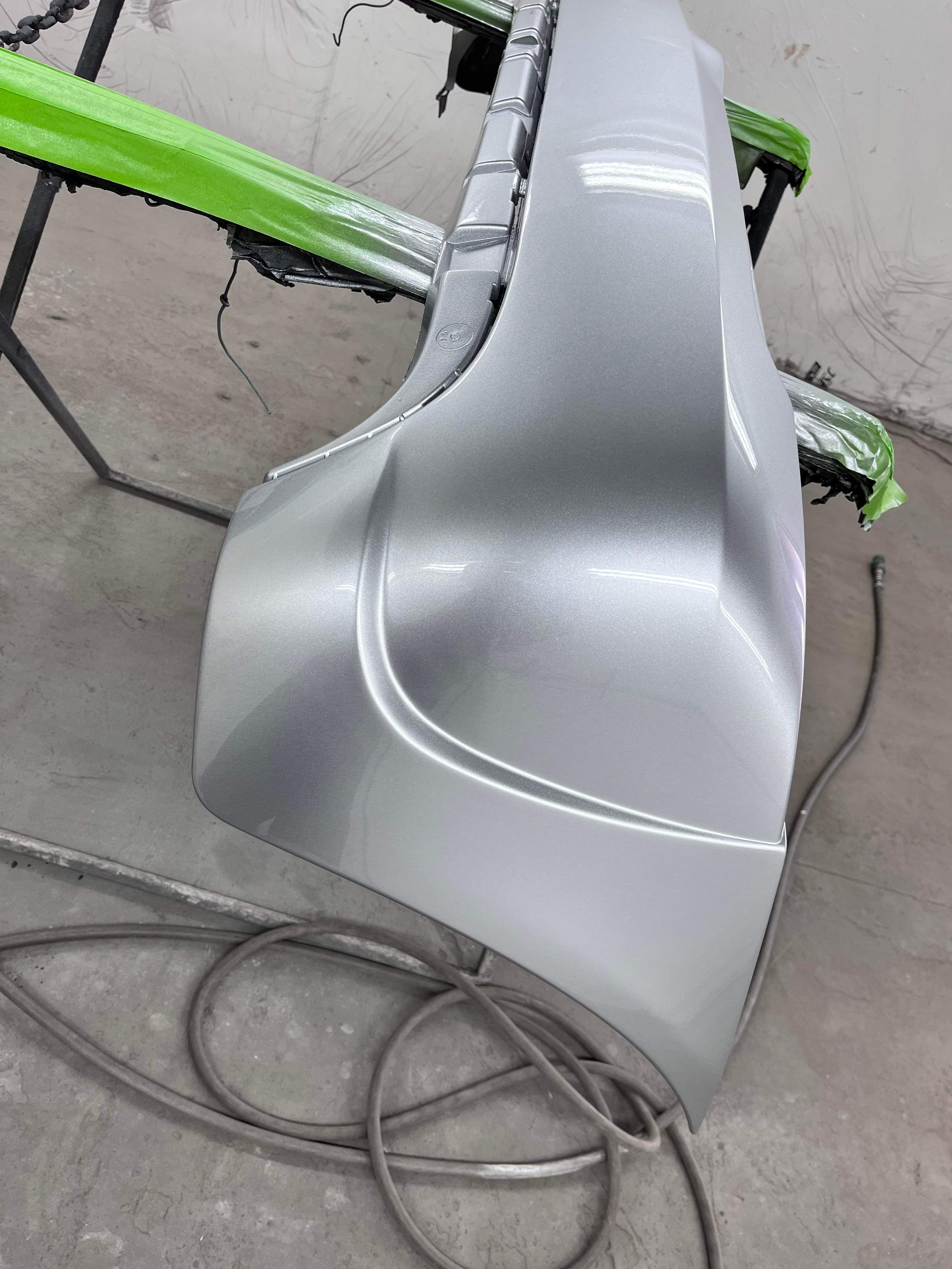

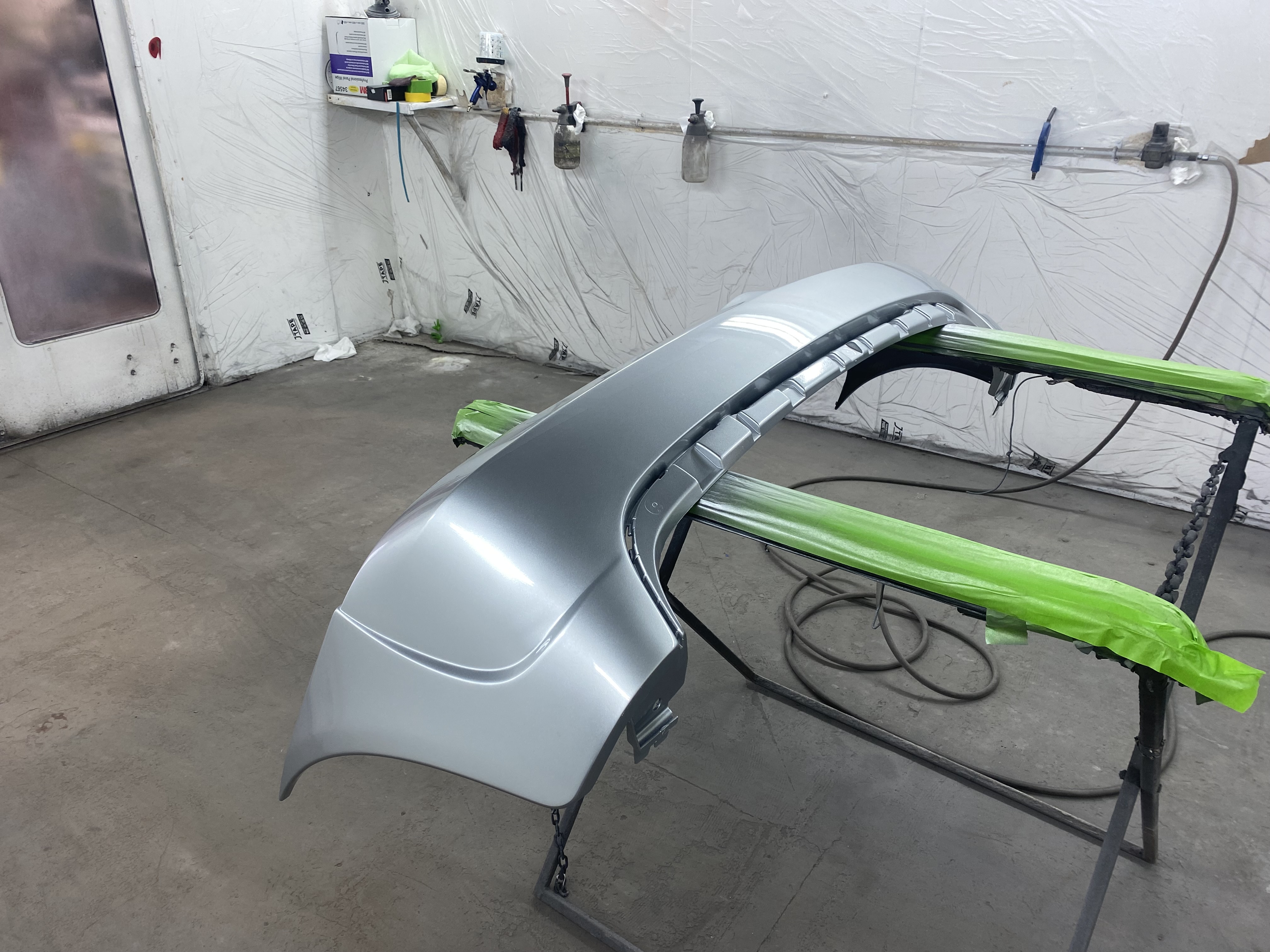

Will see how this pans out soon, should look spot on with a 197 rear diffuser.. I’m not generally into mods but this should be subtle and with the slash cut tips hidden away should look good!

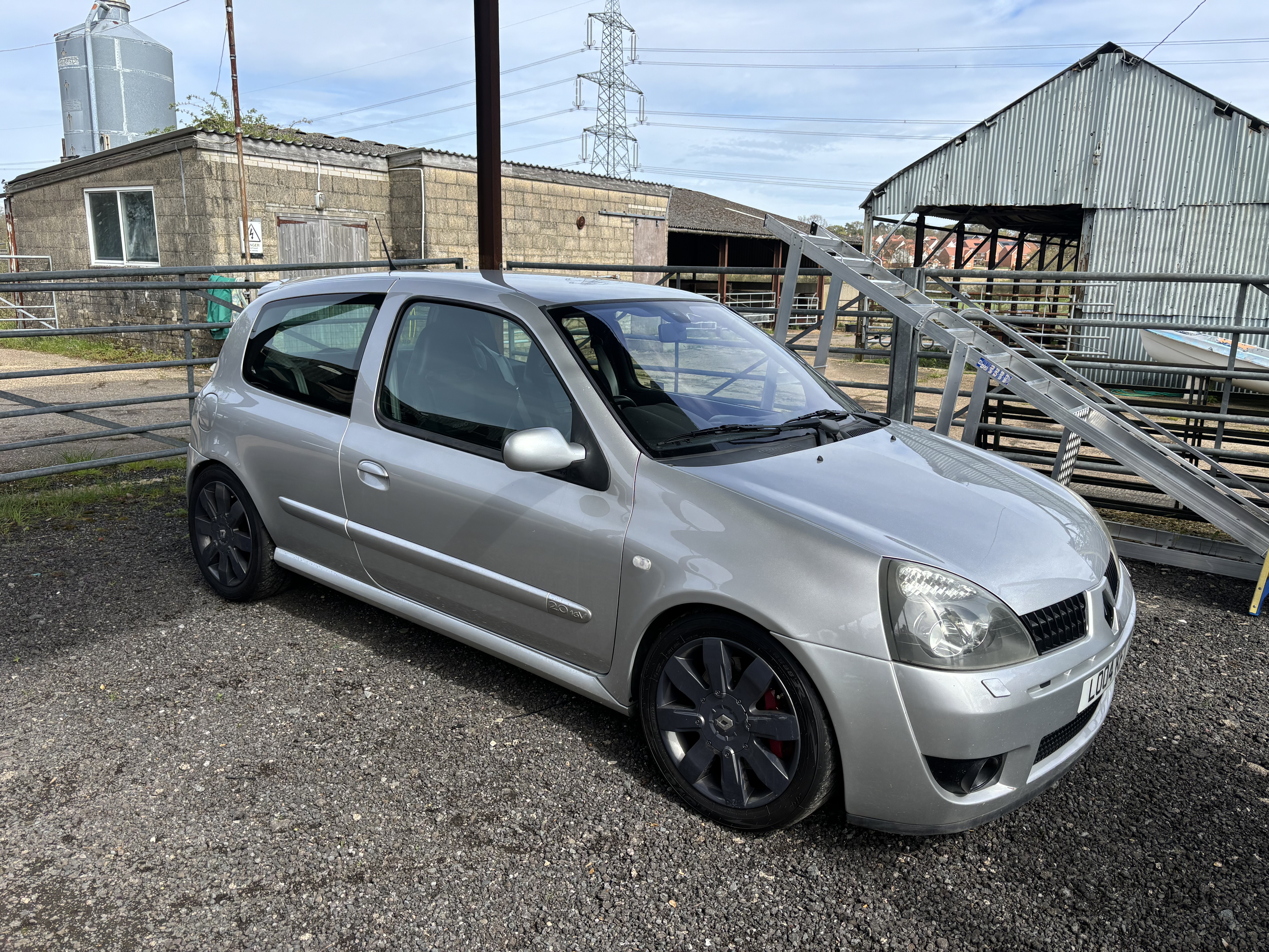

*for sale* 12k…
Not your average Clio turbo. I have owned this car for a very long time and will be sad to see it go but I fancy a new project.
If it sells it sells, if not I’ll keep it but have been thinking about it for a while.
I’ve seen some utterly horrendous builds lately and they are selling with engine lights on, exhaust manifolds falling off, shocking workmanship etc.. so if you want a perfect one with everything done to a high standard. Look no further!
Mileage is 88k I’m the second owner since 16k miles

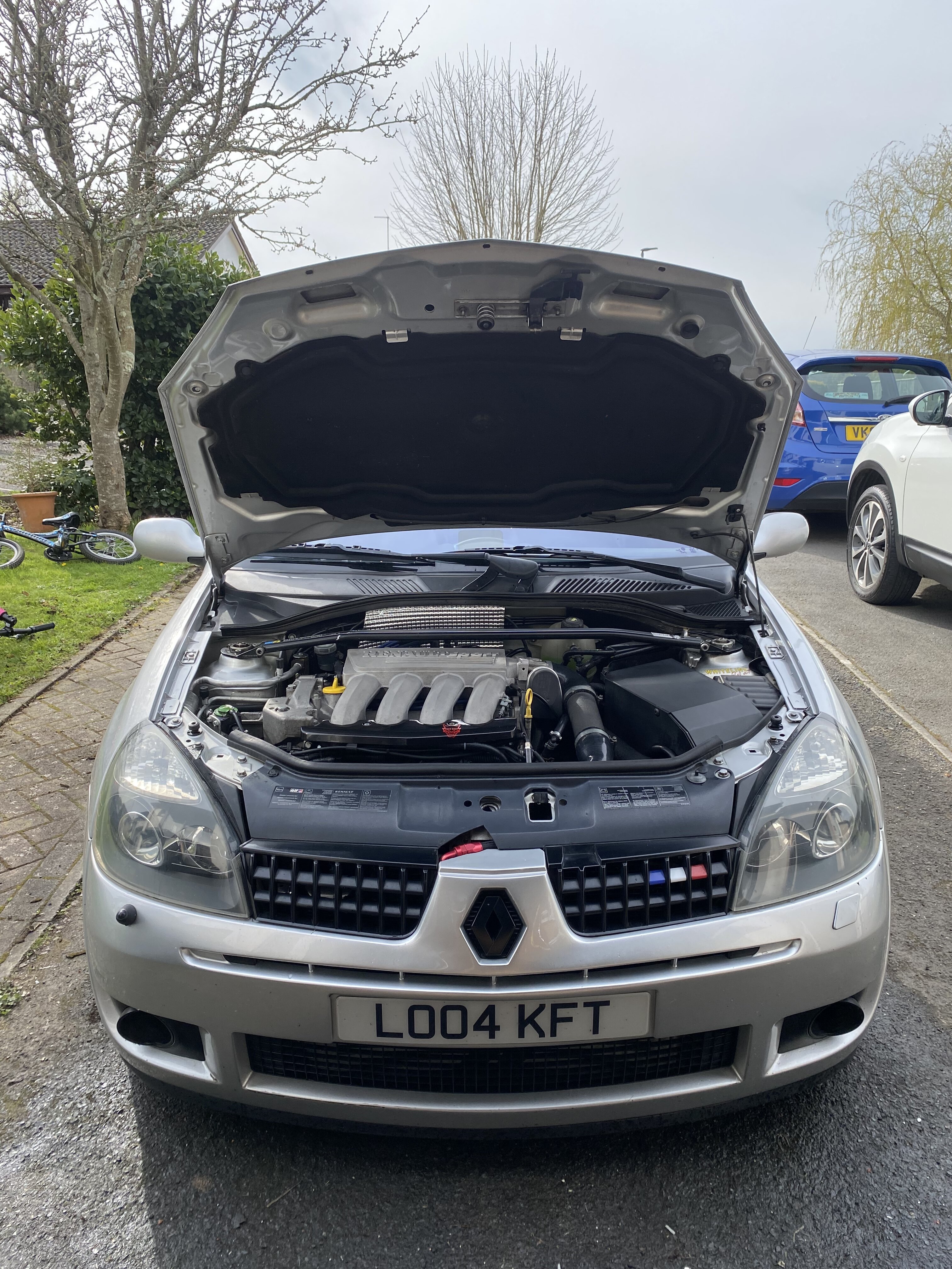

Engine bay:
9.1:1 compression ratio
Clio 200 block
Megane 265 pistons with valve pockets
Megane 265 rods with bearing notches
ACL race bearings
ARP rod bolts
New standard mains
Clio 182 head with supertech inconel valves, shimmed valve springs for correct spring weight, tensioner relocated to 197 position to run 197 timing belt kit.
Vibratechnics mounts,
GTX2860R gen 2 turbo, ceramic ball bearing, billet 11blade impeller, inconel turbine wheel.
Stainless steel custom tubular ‘log’ manifold with v band flange (no loose t25 fasters)
Pure motorsport exhaust with custom down pipe (by the same people who make Pure’s exhausts)
Decat and sports cat supplied
Deka 630cc injectors
PH1 fuel rail with reg
Radium fuel pulse damper
Swirl pot setup with external pump
Gen90 ECU
Billet SMF flywheel and R26R sachs performance clutch
AEM water meth kit (for extra cooling)
Mocal oil cooler with thermostatic plate
Mishimoto race intercooler, very thick!
Custom boost hoses
Huge AEM water meth tank in boot
Custom Pro alloy radiator 50mm thick
NDO Megane 225 6speed box fully rebuilt with all new bearings and a new Quaife LSD
custom pure motorsport drive shafts
Runs 197 pulley setup with 182 air conditioning still functional
AP RACING clutch master cylinder
Lots and lots of Mapping done by both EFI parts and Andy @Phoenix automotive technologies who is the GEN90 man to get as OEM as possible driving
