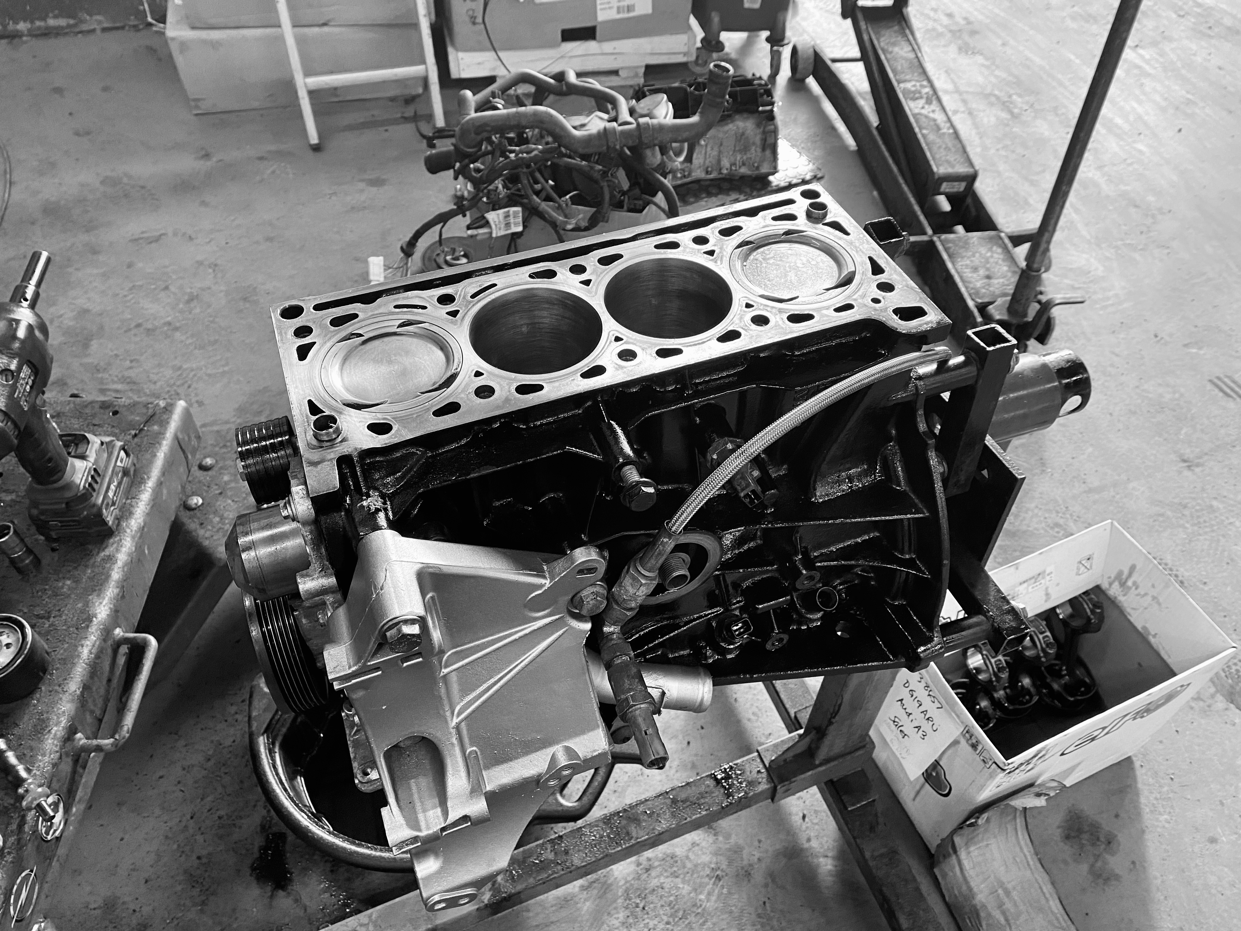

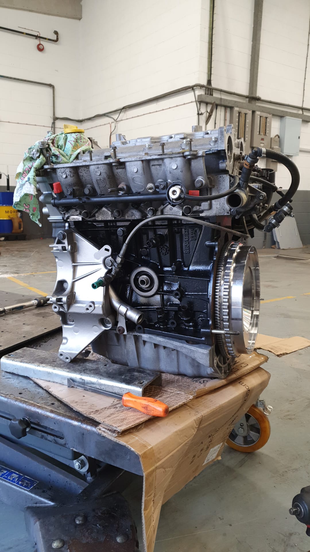

Engine:
Clio 182 block and head, Megane 265 pistons and rods with valve cutouts, grooves for bearings machined into big ends
NPR NE piston rings
Bores honed
ACL race bearings
ARP rod studs and nuts
OEM head gasket (.65)
Supertec inconel valves
Head faced and valve stem seals replaced
9:1 comp ratio

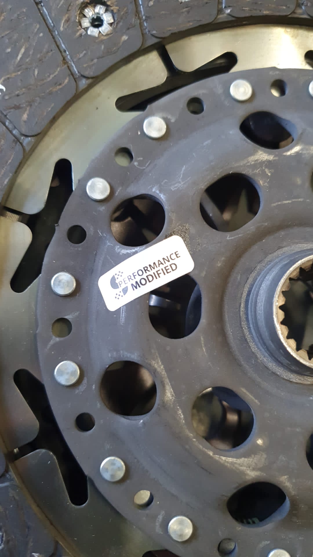

Forgot to add the AP racing clutch master cylinder and PMS wilwood hydraulic slave

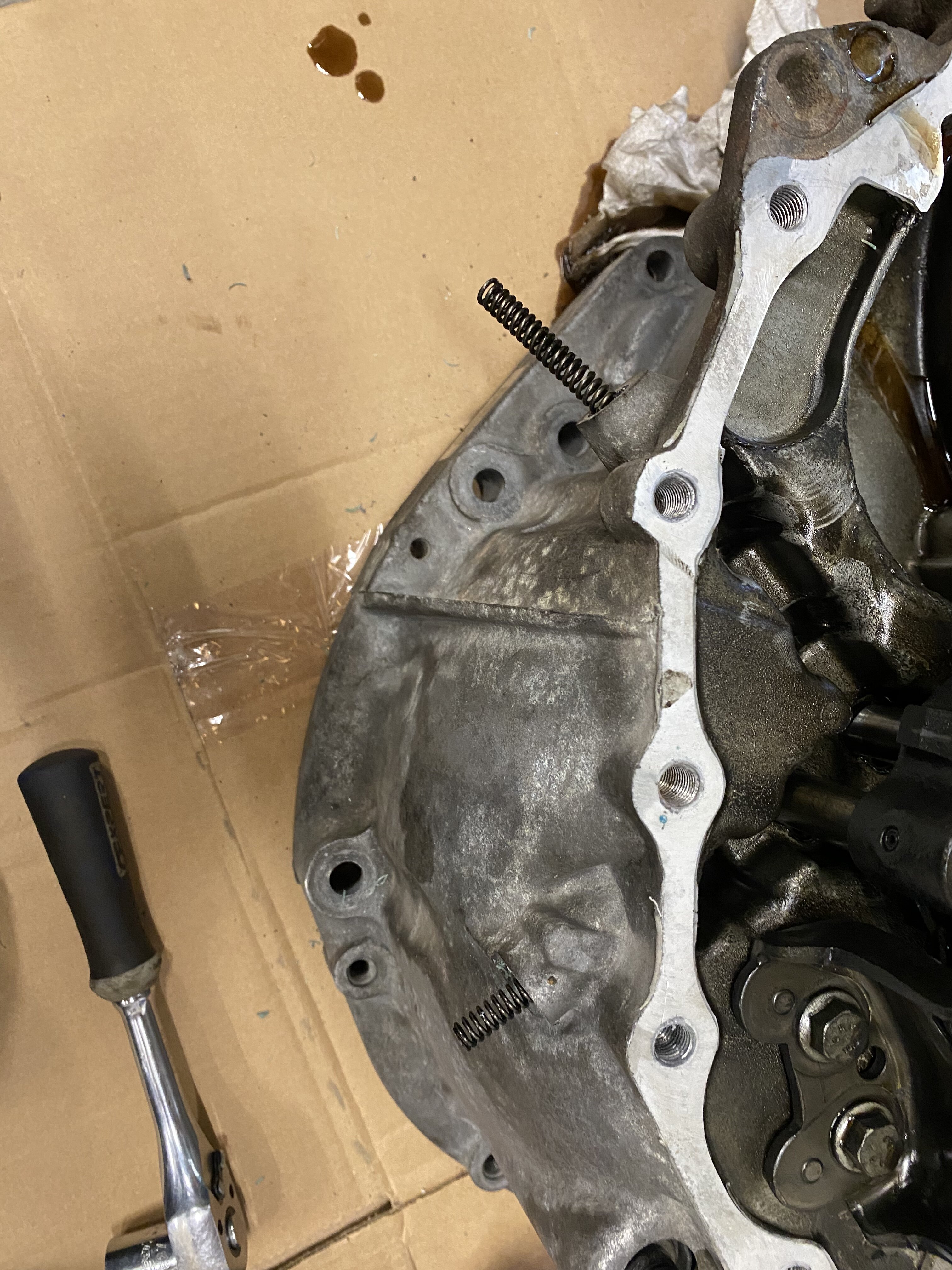

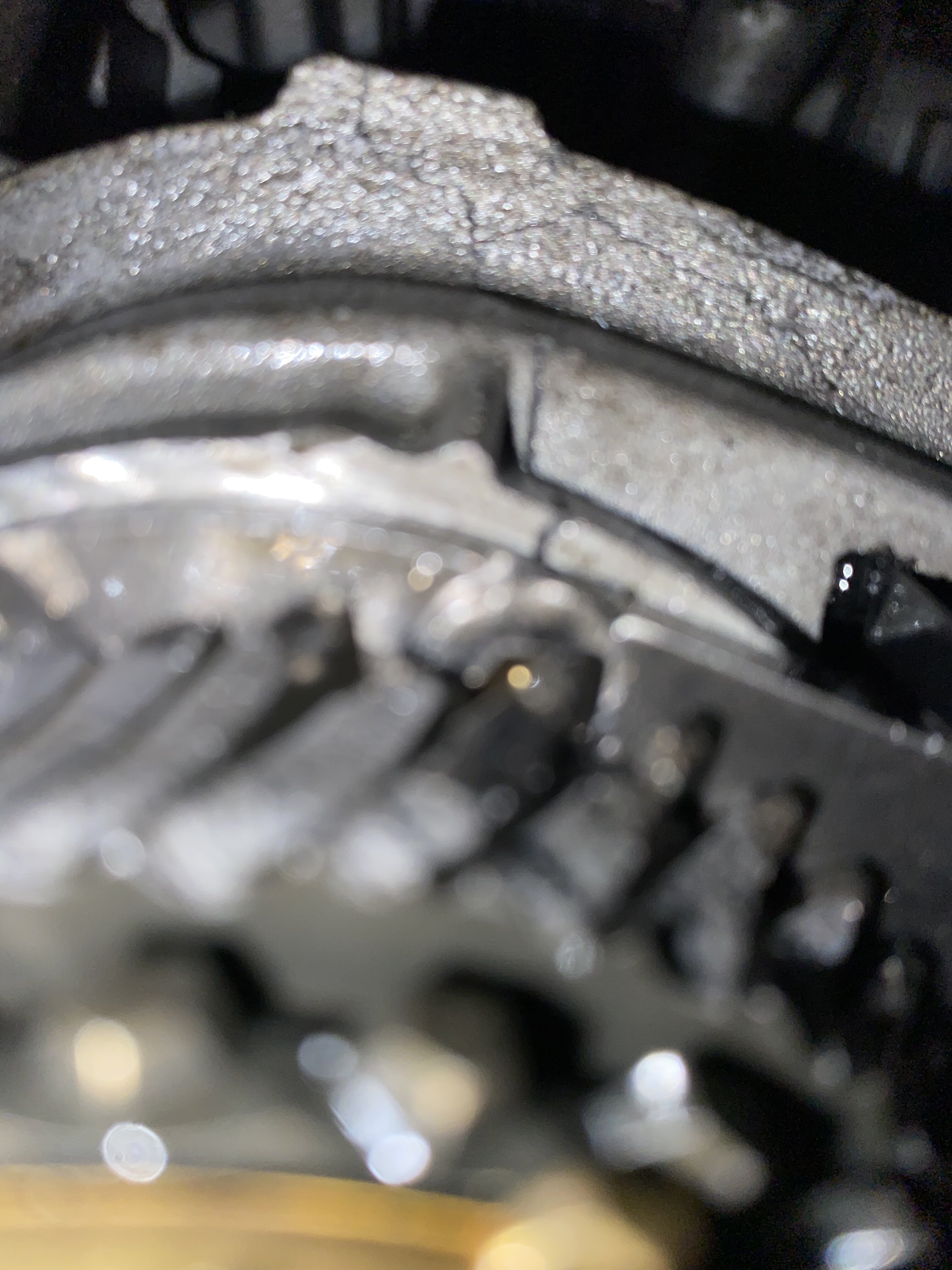

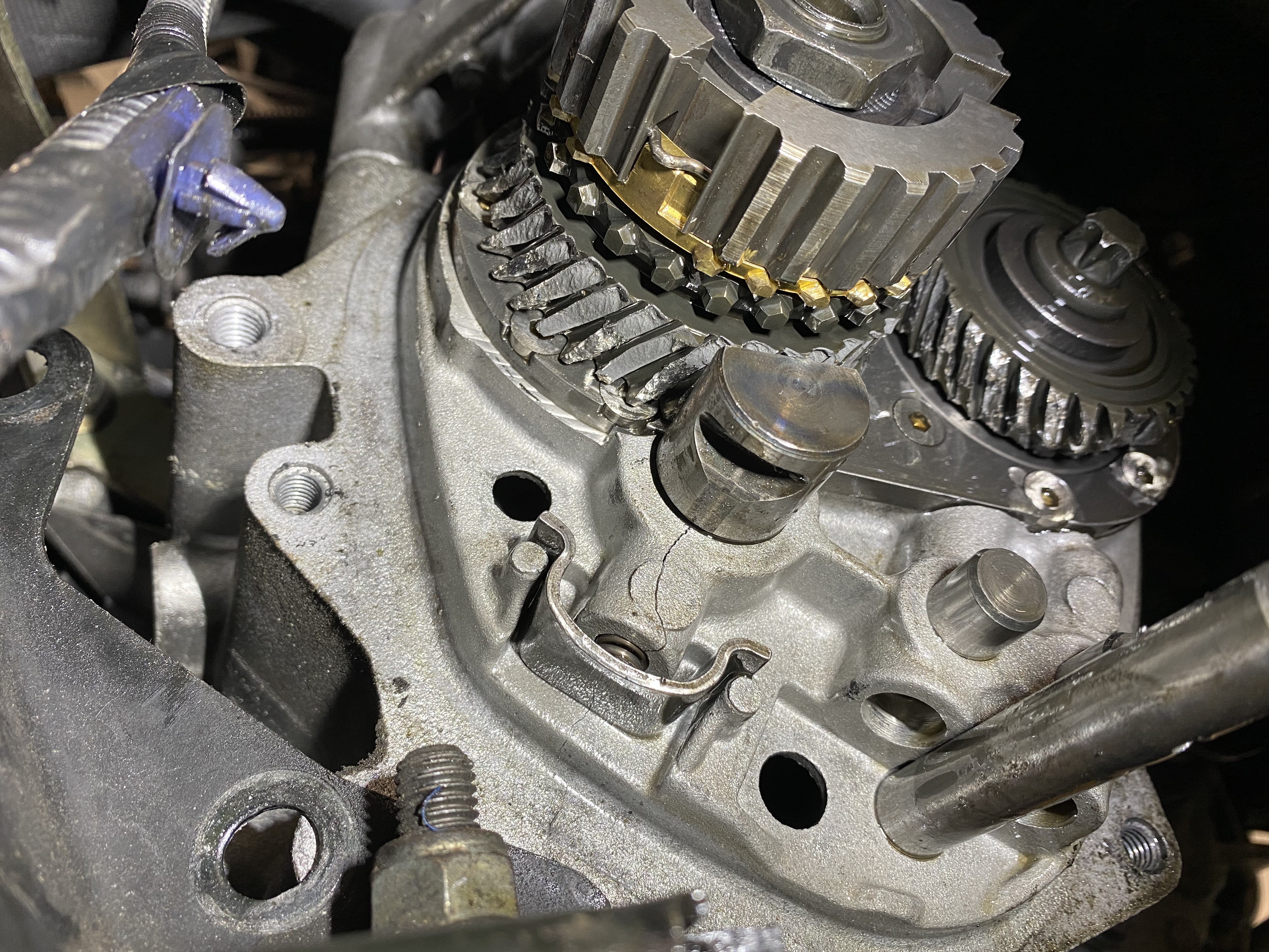

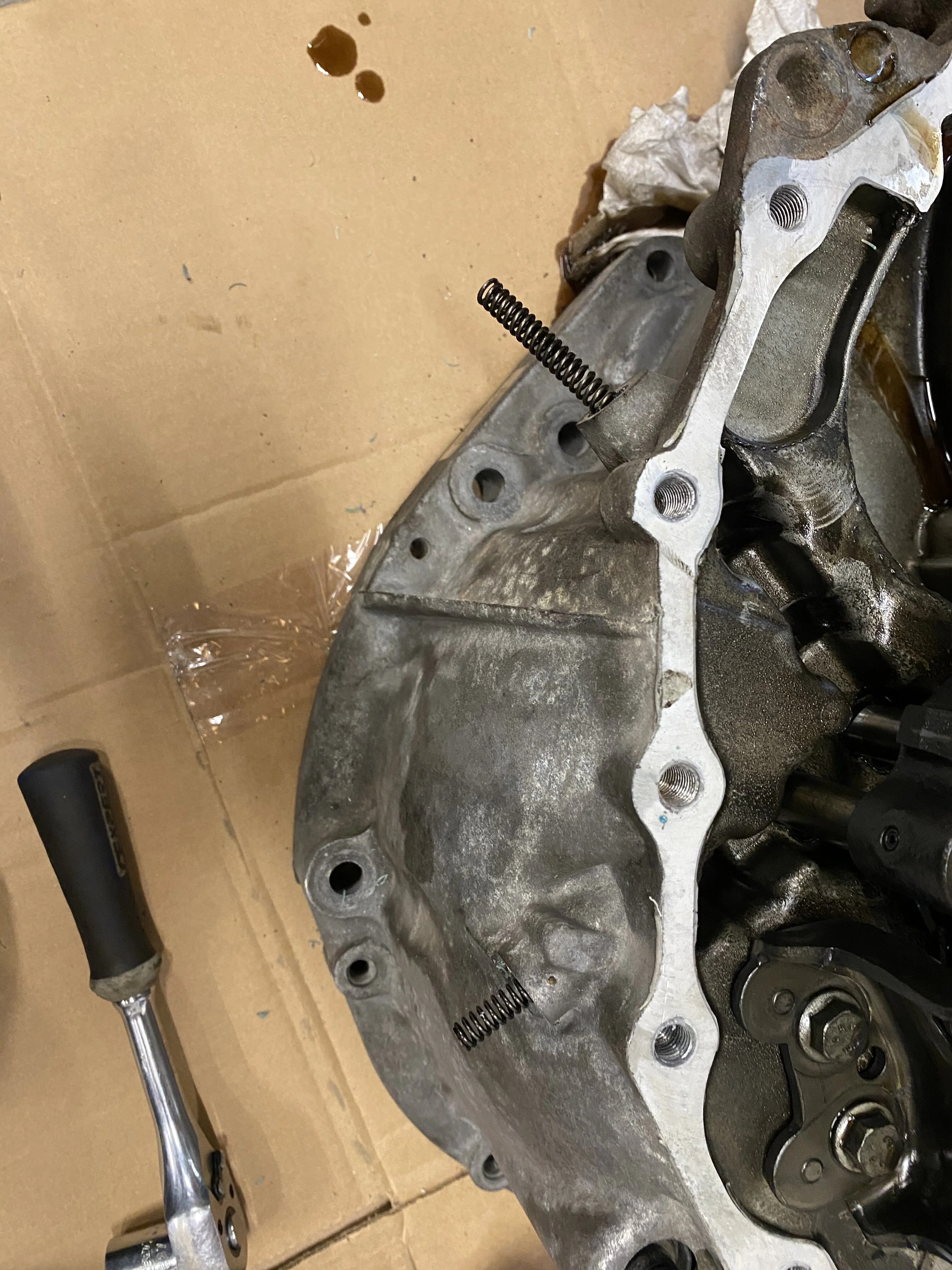

Unfortunately the JC5 089 had enough of 360lbft of torque (wimp)
any way it’s salvageable with a new end casing which cracked and a 5th gear set which is in serious need of the dentist….
anyway, Project NDO is on the way.. to do it right I’m going to be putting all of my Meg 265 internal parts into a very low mileage Clio 200 block to be able to mount the NDO properly and run the billet r26r flywheel and Sachs clutch setup.. it’s well underway, just collecting parts at the mo. Have a shifter, Box, block. Need to order up the Flywheel, clutch and quaife LSD from pure and he’s mailing me up the shafts when I send him the patterns.
Glad I didn’t take this to Germany this year as the 5th gear went basically driving it!

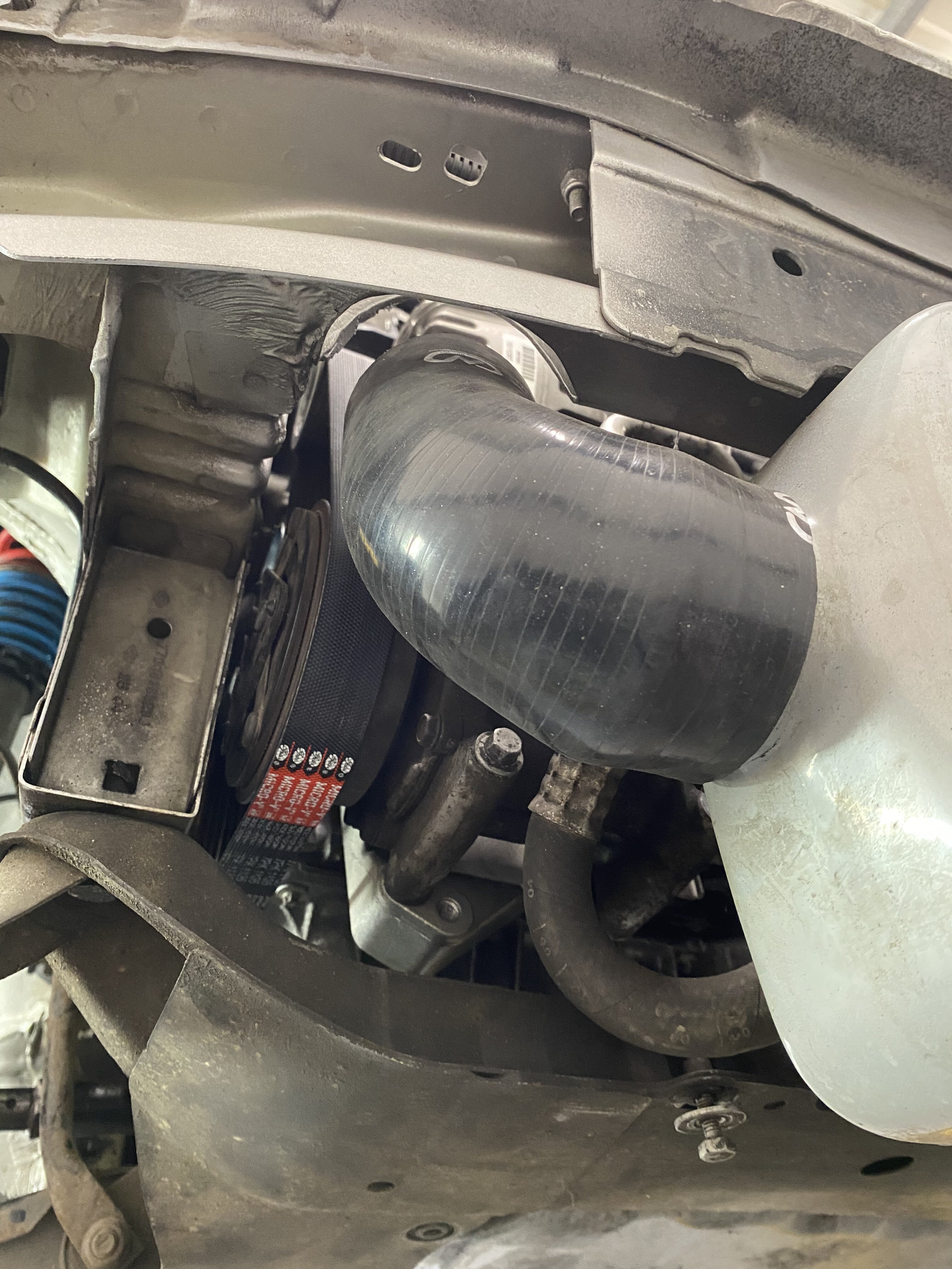

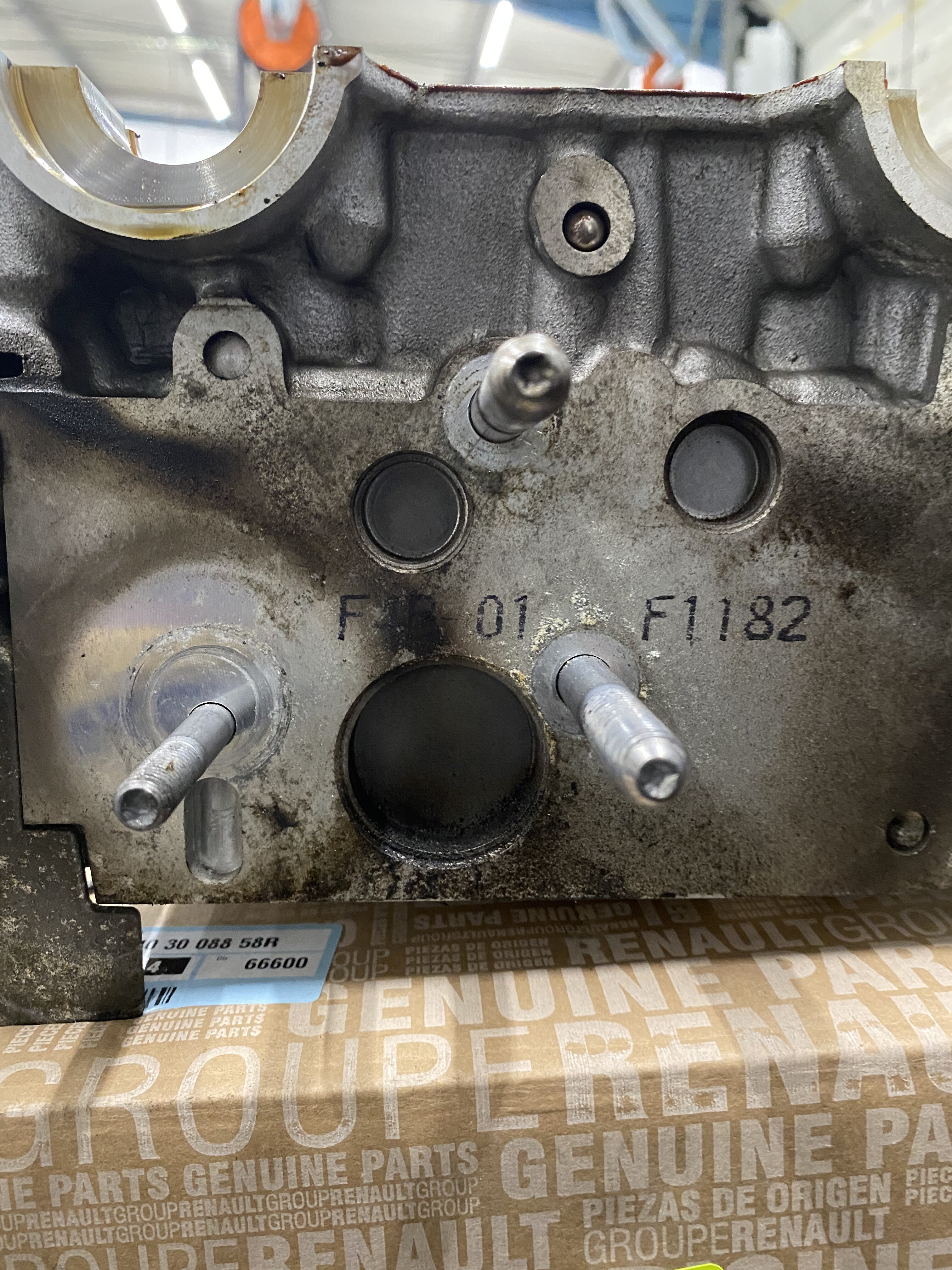

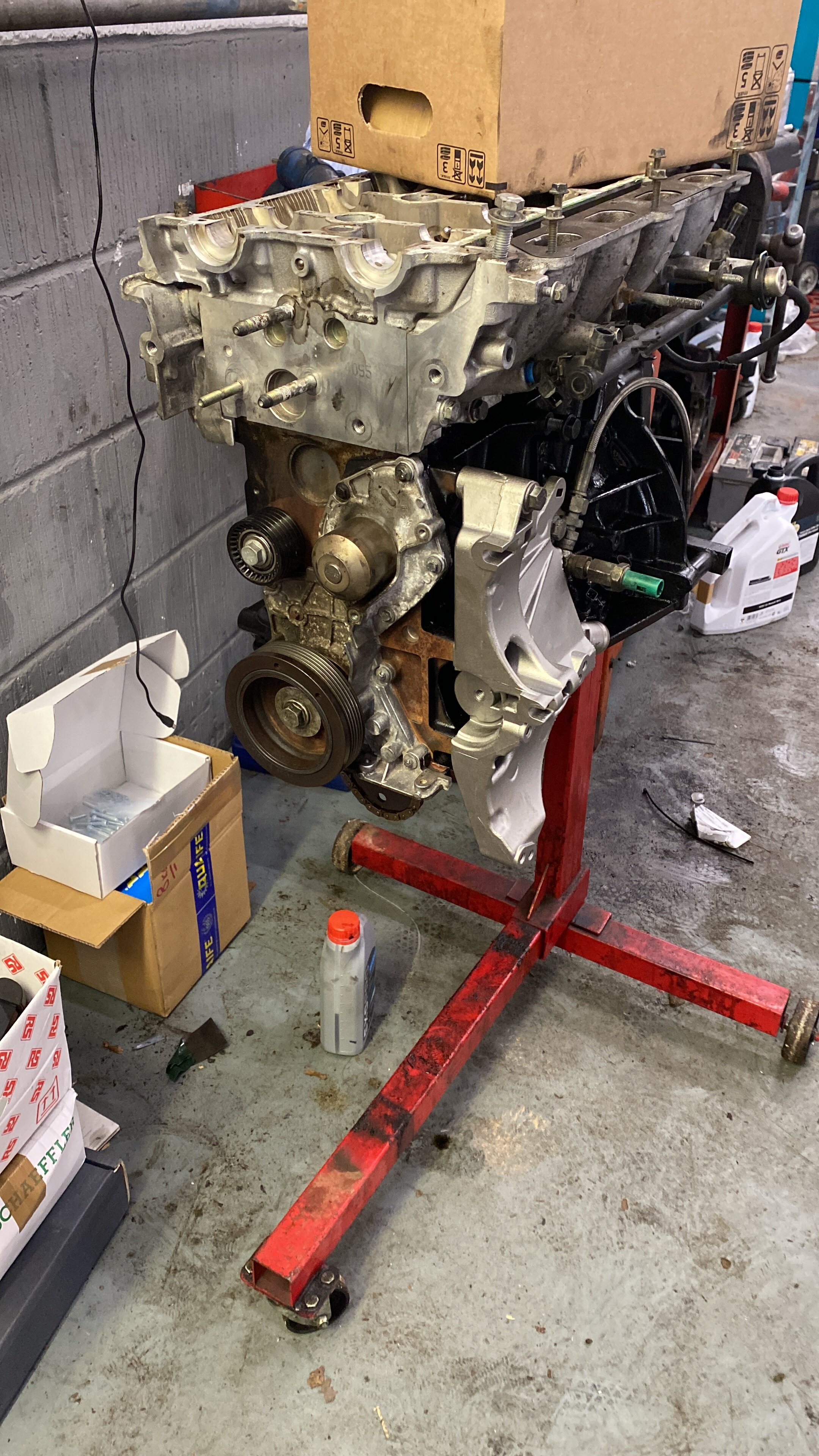

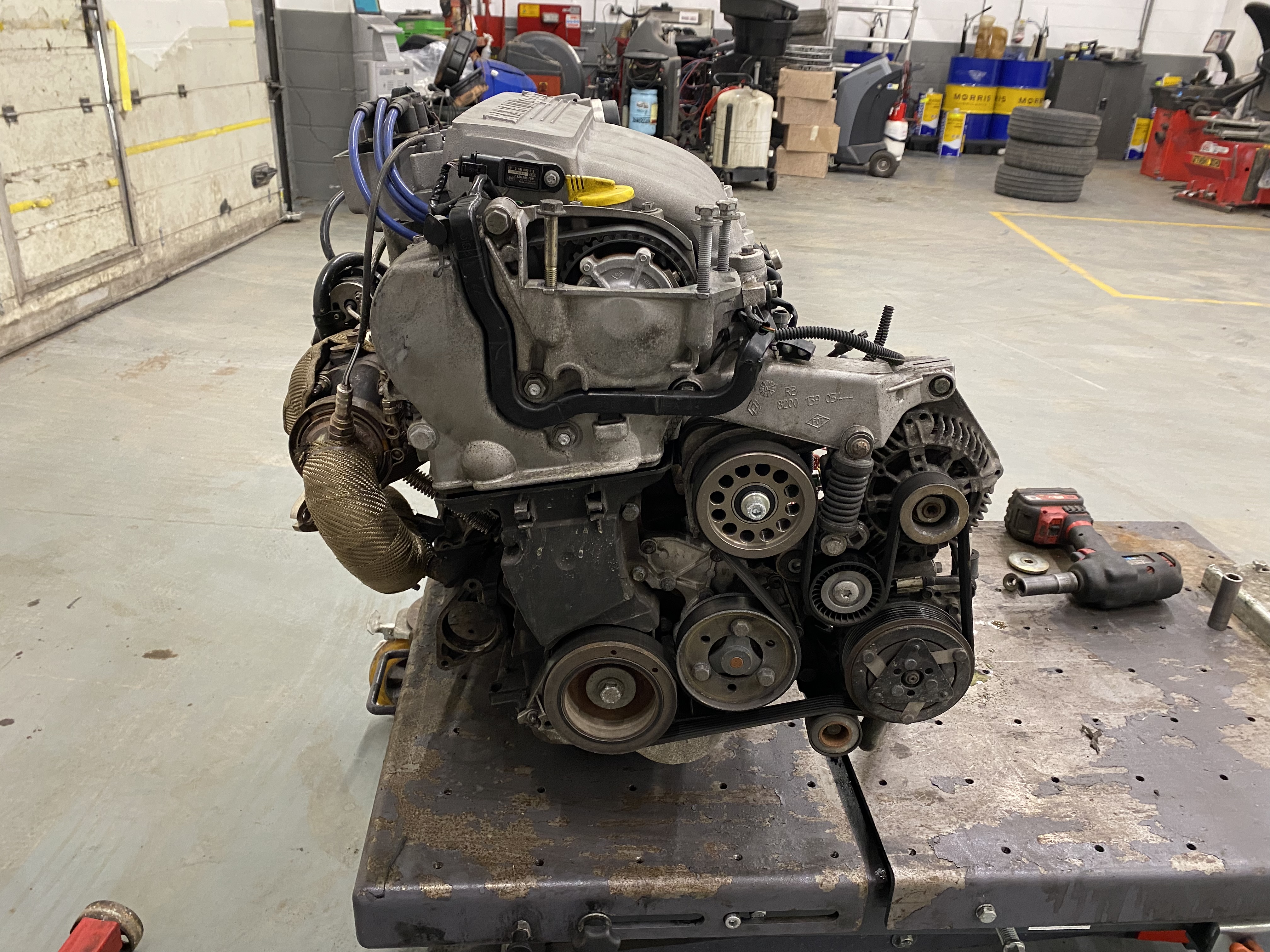

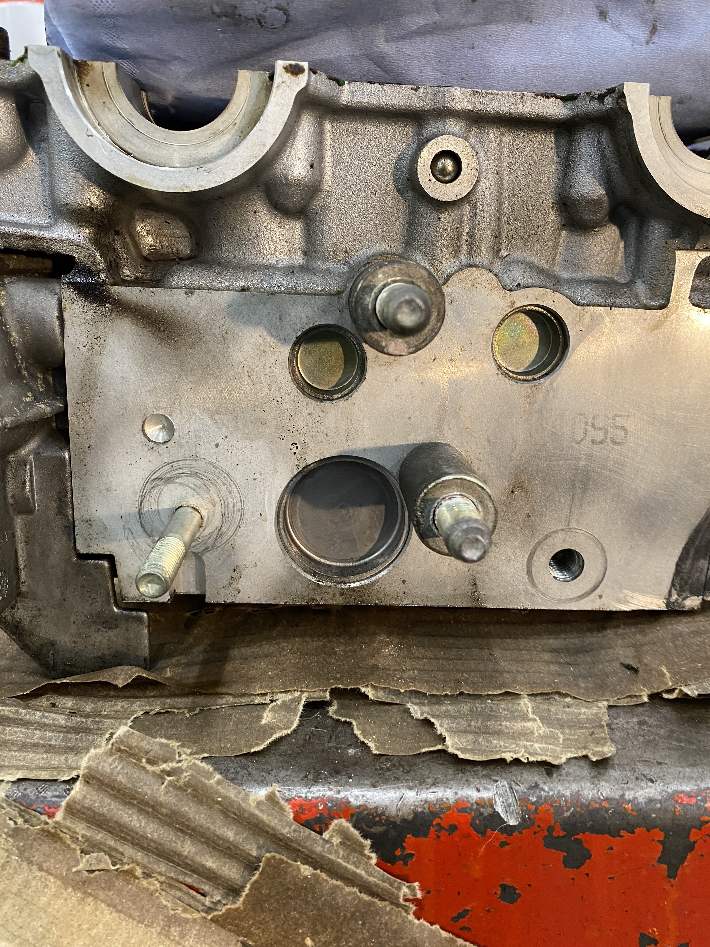

Few things to think about, the main one being the reposition of pulleys on the timing belt, as using the 182 head on the 197 block.. if anyone has done similar feel free to share.
Also alternator, AC pump setup… will be all the 197/225 bracket, alternator tensioner. But thinking about the AC pump, may be able to run the 182 one somehow. Again thoughts on this if any?

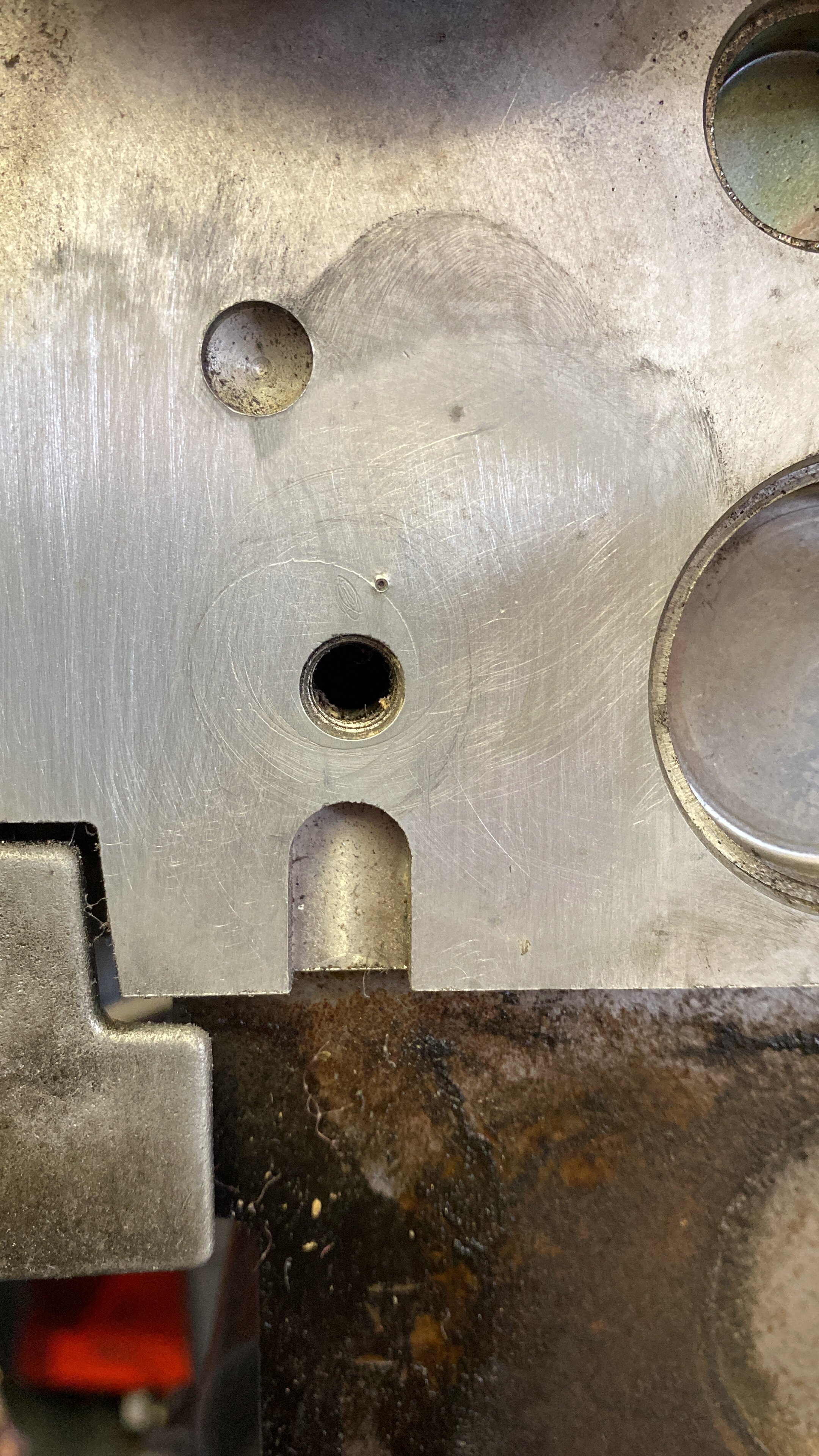

You can potentially convert the 182 head to run with the 197 belt setup by simply removing the idler pulley below the inlet camshaft mate. That’s the pulley you have to add to run a 197 head on a 1*2 block, so I can’t see why reversing the idea wouldn’t work.
You may need to run a bolt in the thread of where the pulley was though to stop any potential oil leaks. It shouldn’t do, but it’s drilled all the way through to a head bolt from memory.
1*2 bottom pulley is smaller than the 197 item as well, so no need to worry about water pump speeds as that is driven by the cambelt on a 197. A lot of people run the 1*2 bottom pulley as a ‘upgrade’ with it being smaller - less rotational mass. Cup racers ran this setup.
I like this! It’ll probably be fairly obvious when I have them side by side.. thanks mate!
totally overlooked the fact the water pump setups are different. It only struck me once I’d striped the block! 🙄
Maybe the belt will be too long? Since the tensioner is lower on 182 head.
I've got this problem with tensioner position when going to 197 head and tap the idler in the same position as 182. Then was a pain to find a good diameter pulley.
That idler tap is towards the head bolt, so there can be bit of oil in time.

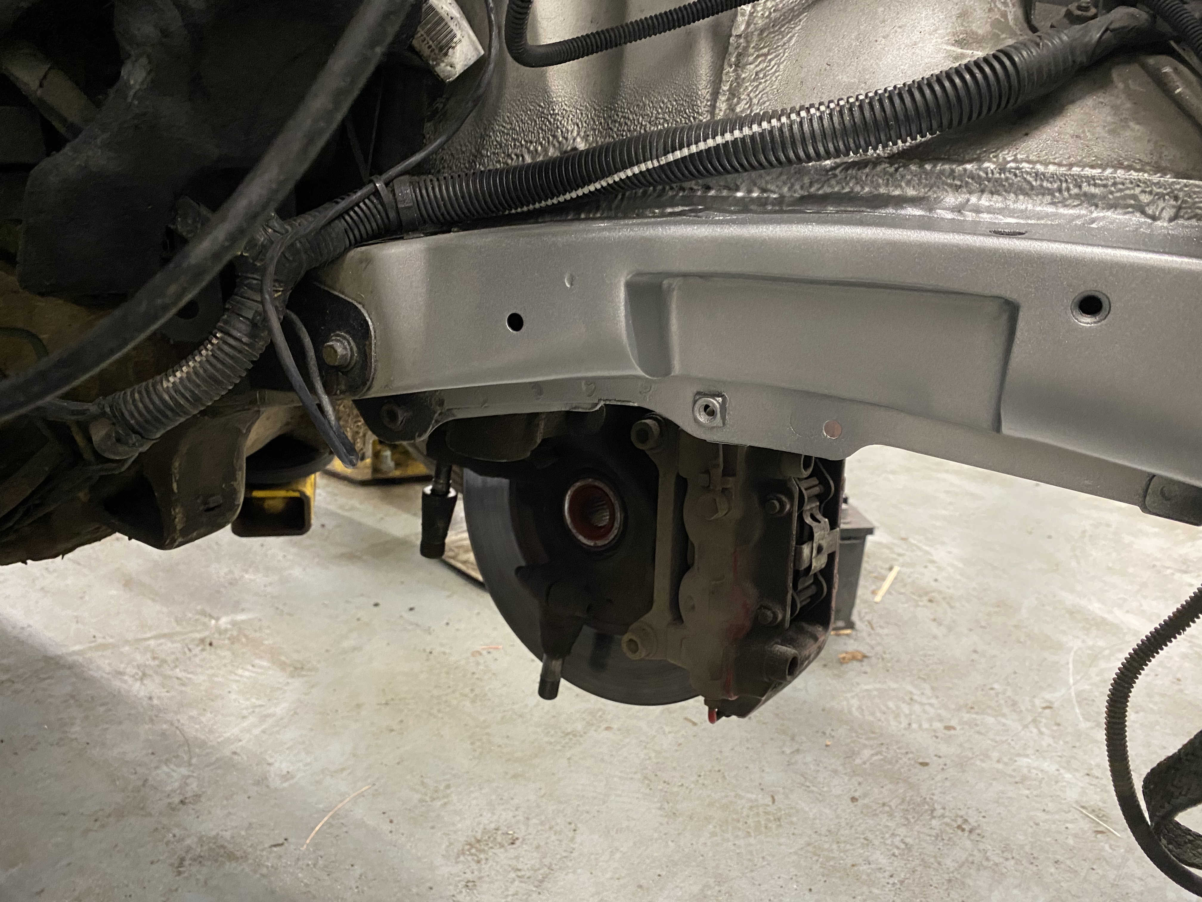

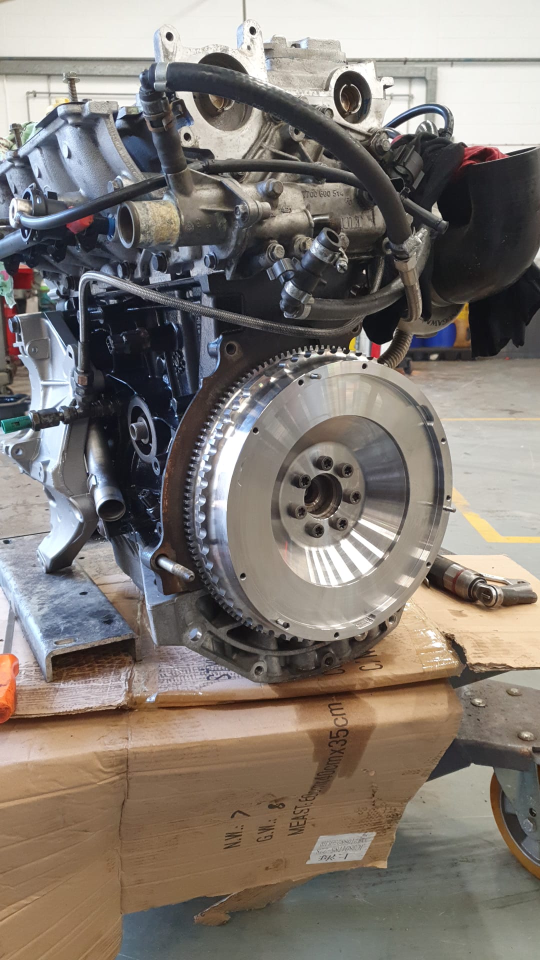

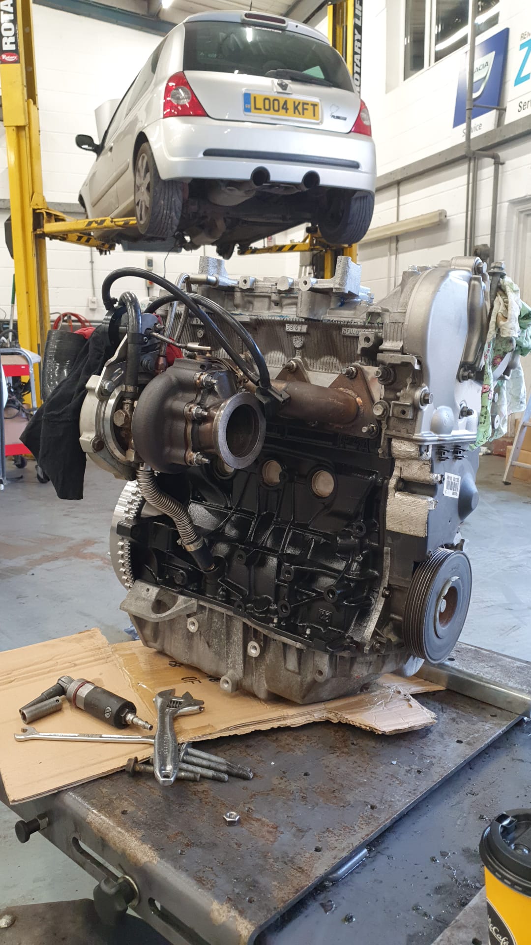

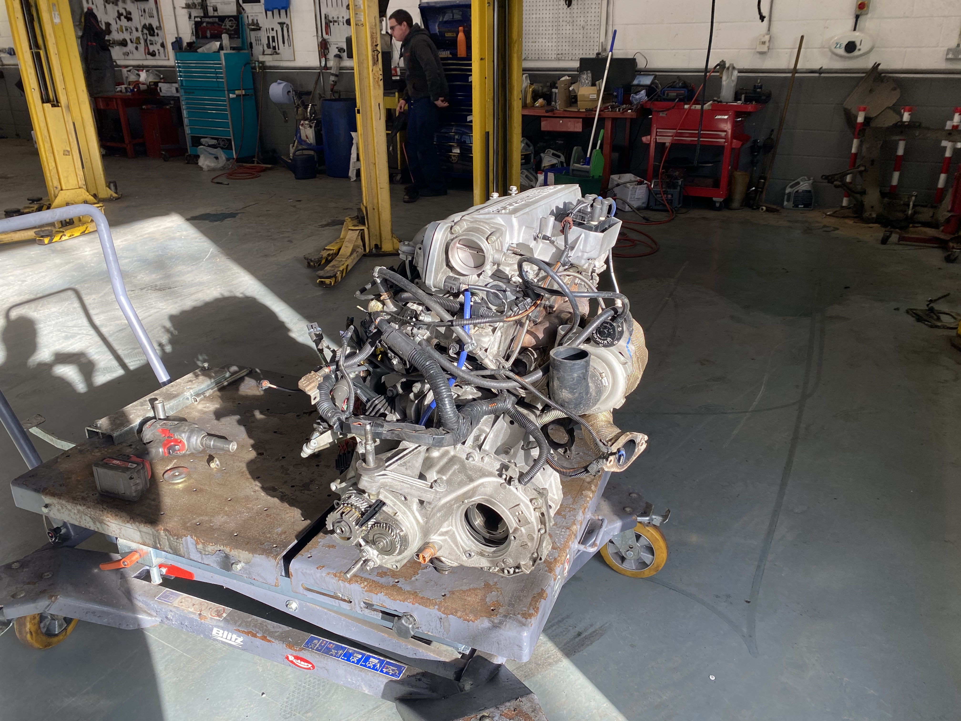

Lots been happening, bit of head scratching! So far (between work) I’ve notched the chassis leg, built the 197 block up with my Meg 265 pistons and rods. New rings, new ACL bearings, new ARP rod bolts. 182 head modified to accept the 197 belt, had to plug the old tensioner stud and move it up and to the right slightly for the tensioner to work. Block drilled for oil return.
fitted my 225 Meg 6 speed shifter, new heat shield whilst I’m at it.

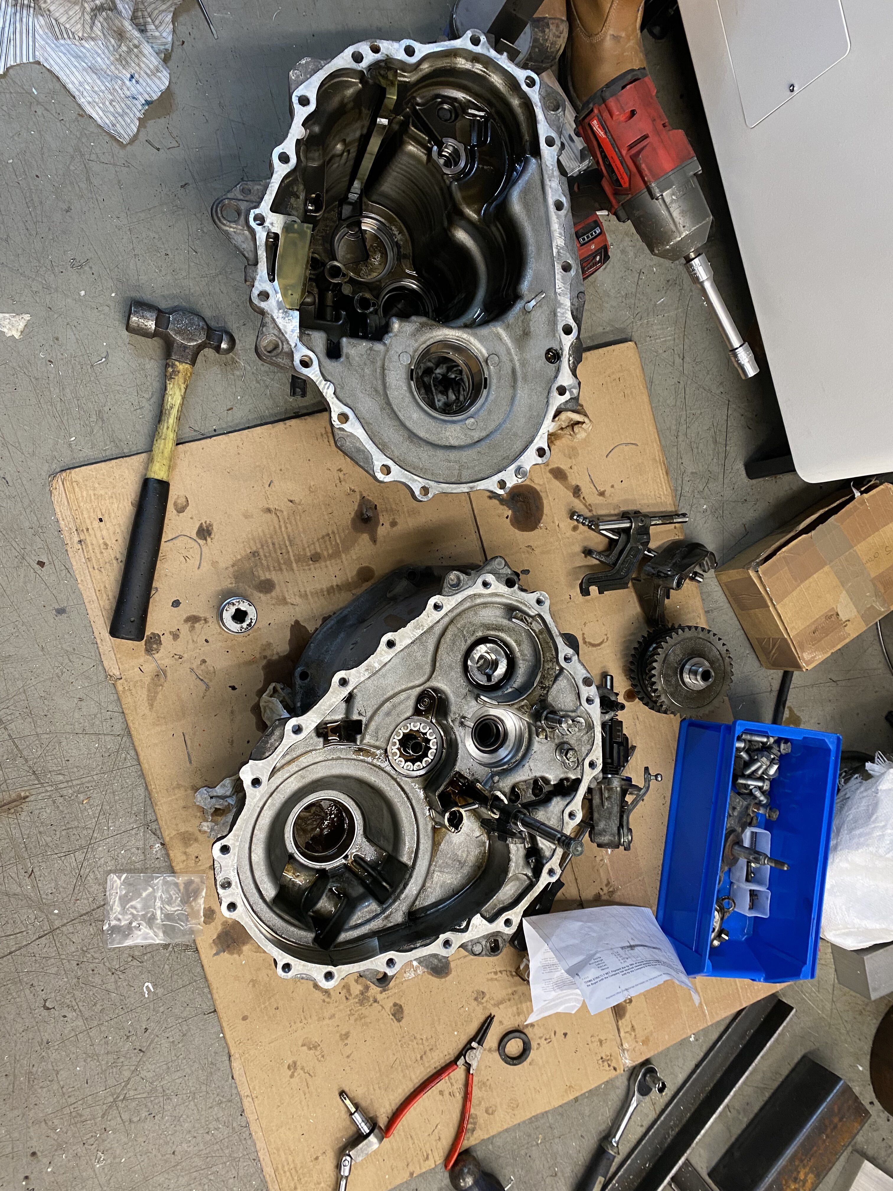

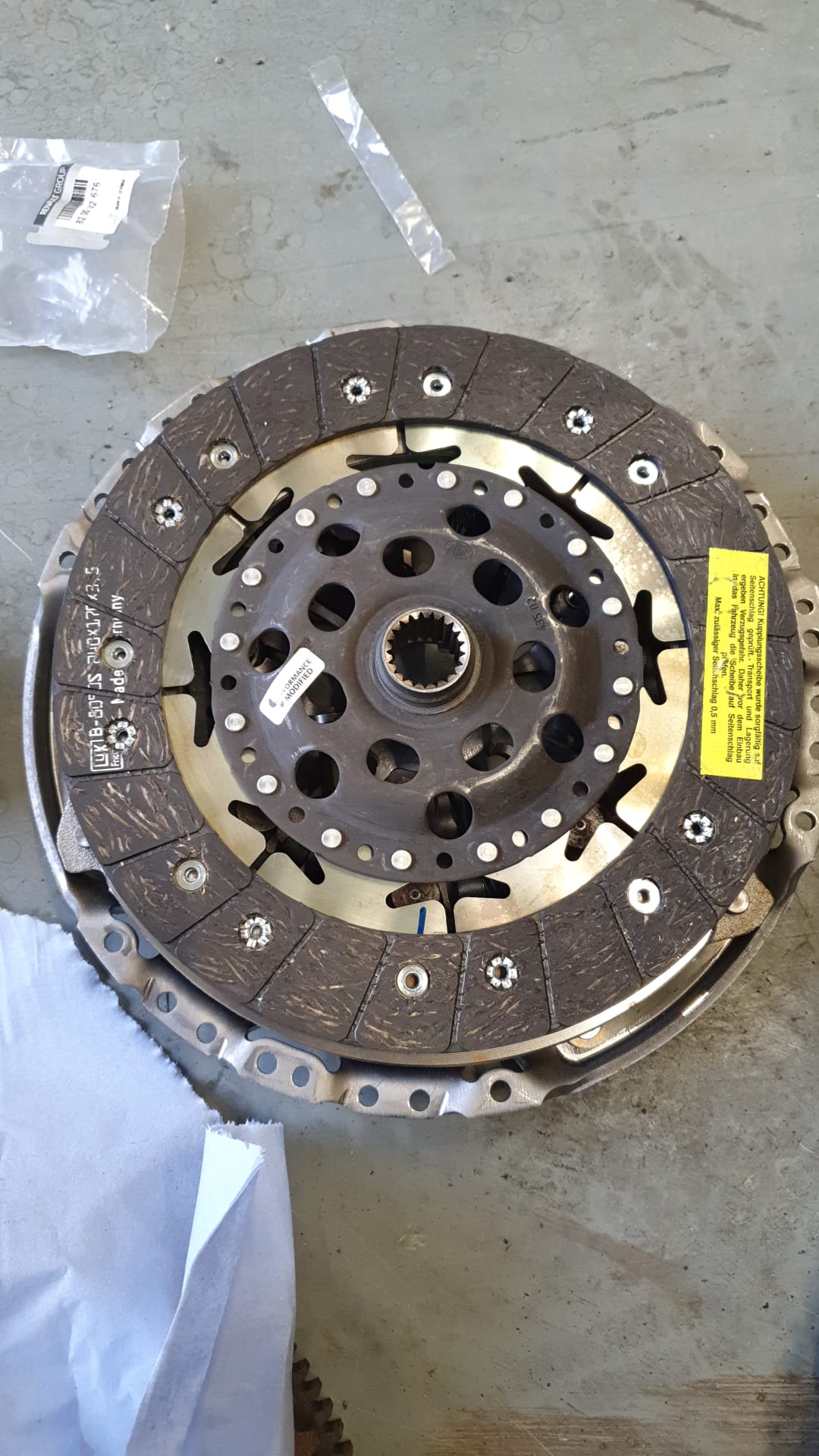

started on the NDO box earlier, it’s currently all split apart to check for parts, just need diff bearings as they are a bit of a sod to remove and fit to the quaife without damaging and it’s peace of mind.
that’s it for now, hopefully will have the engine in by the end of next week!

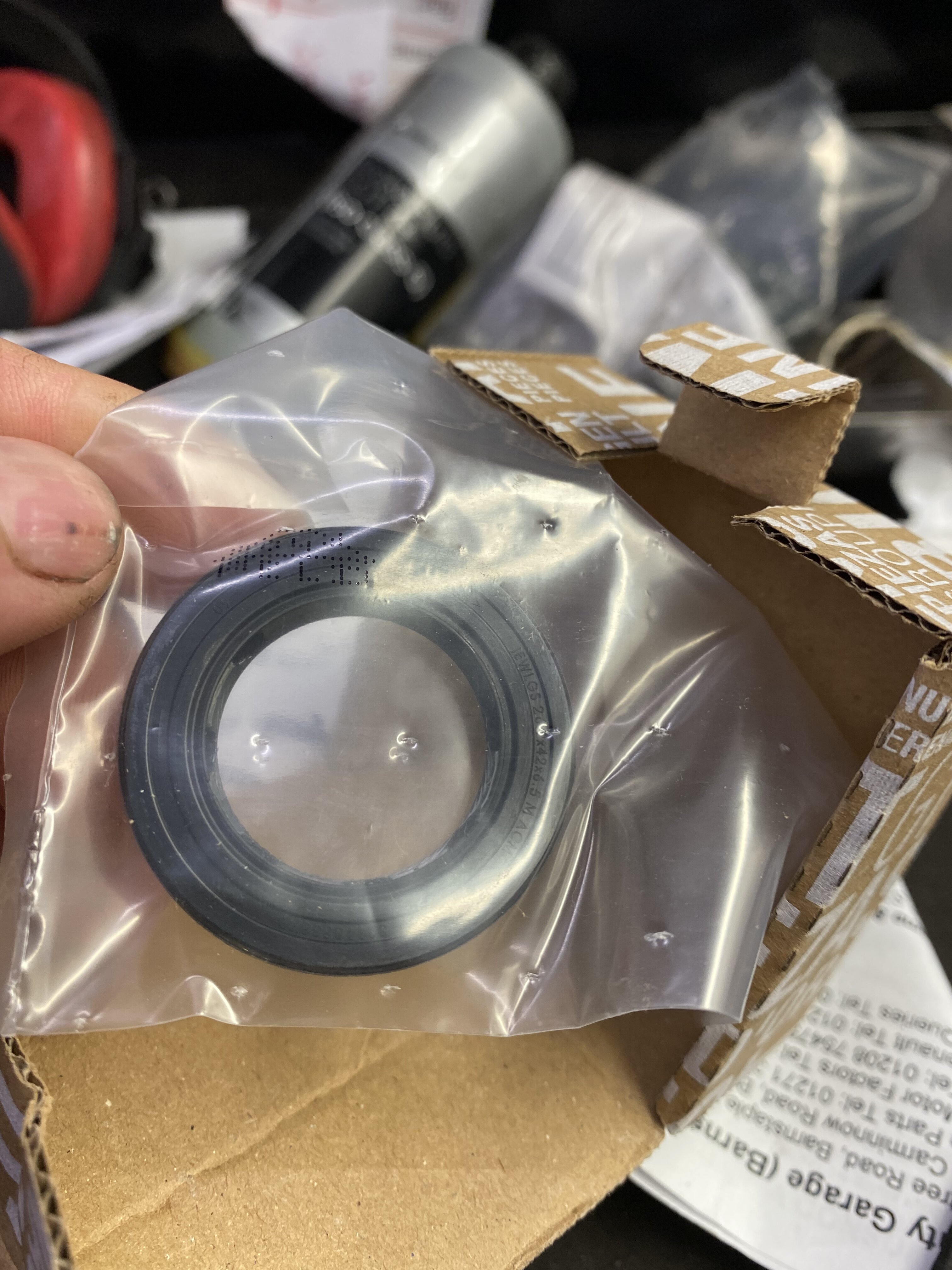

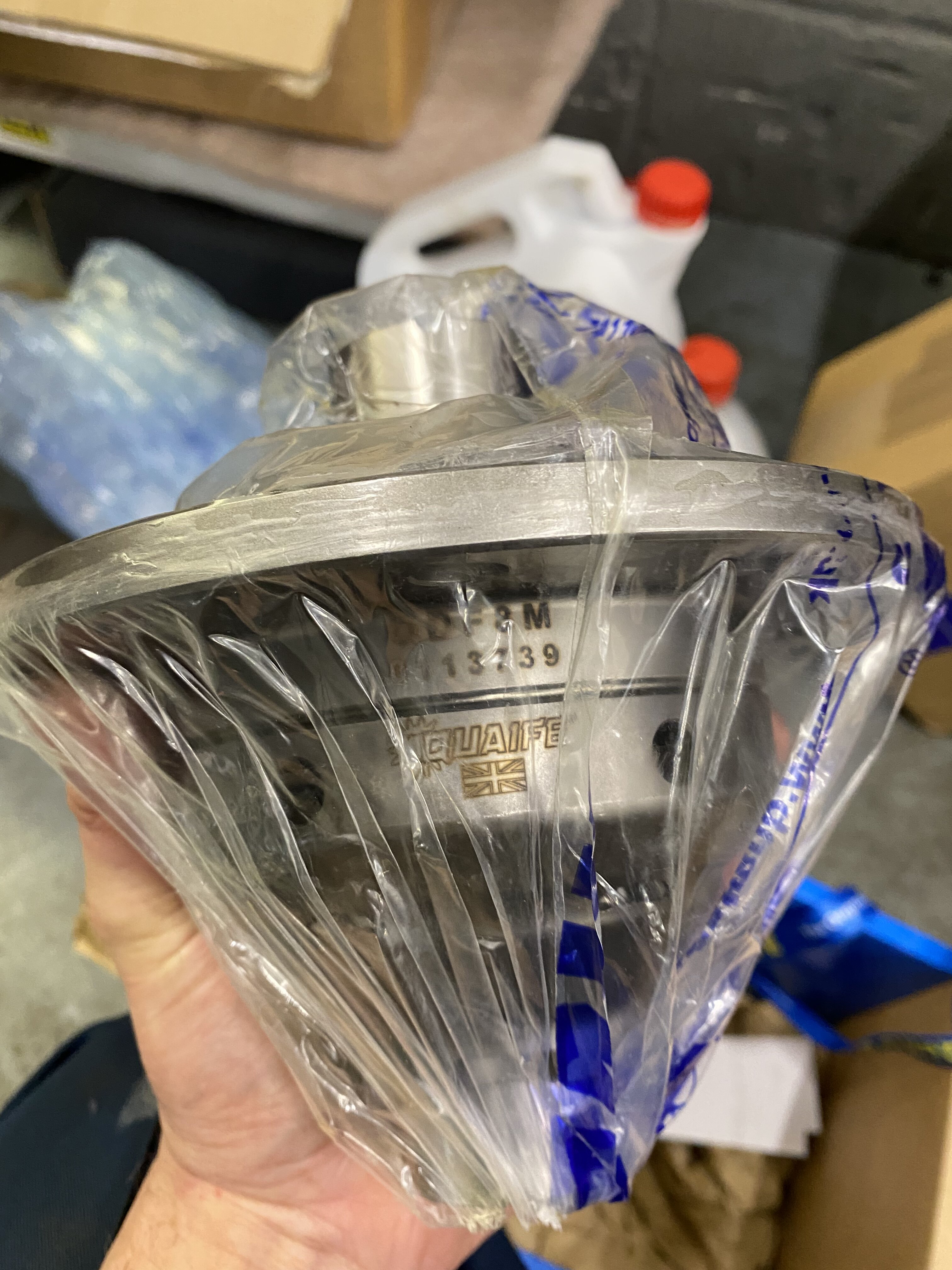

Thanks mate, it’s a bit overkill to be fair but it’s got plenty of room now, and I used some thick steal whilst keeping a fair bit of the original material

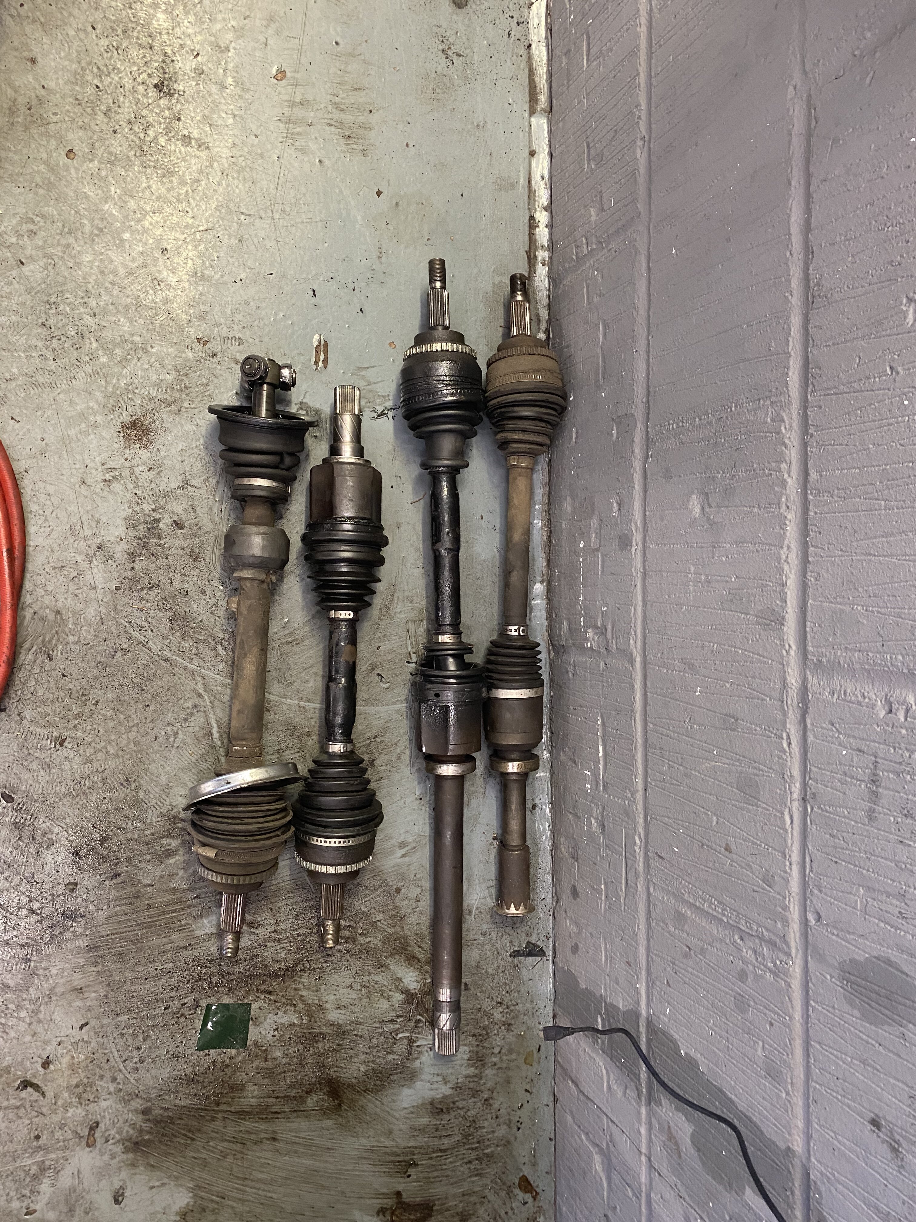

Box is built, new diff bearings, quaife installed, seals etc.. engine is back in on two mounts… dig one to be fabricated. All good so far.
also managed to find some mock up shafts for mock up to be sent away to pure.
gear selection is mange tout!

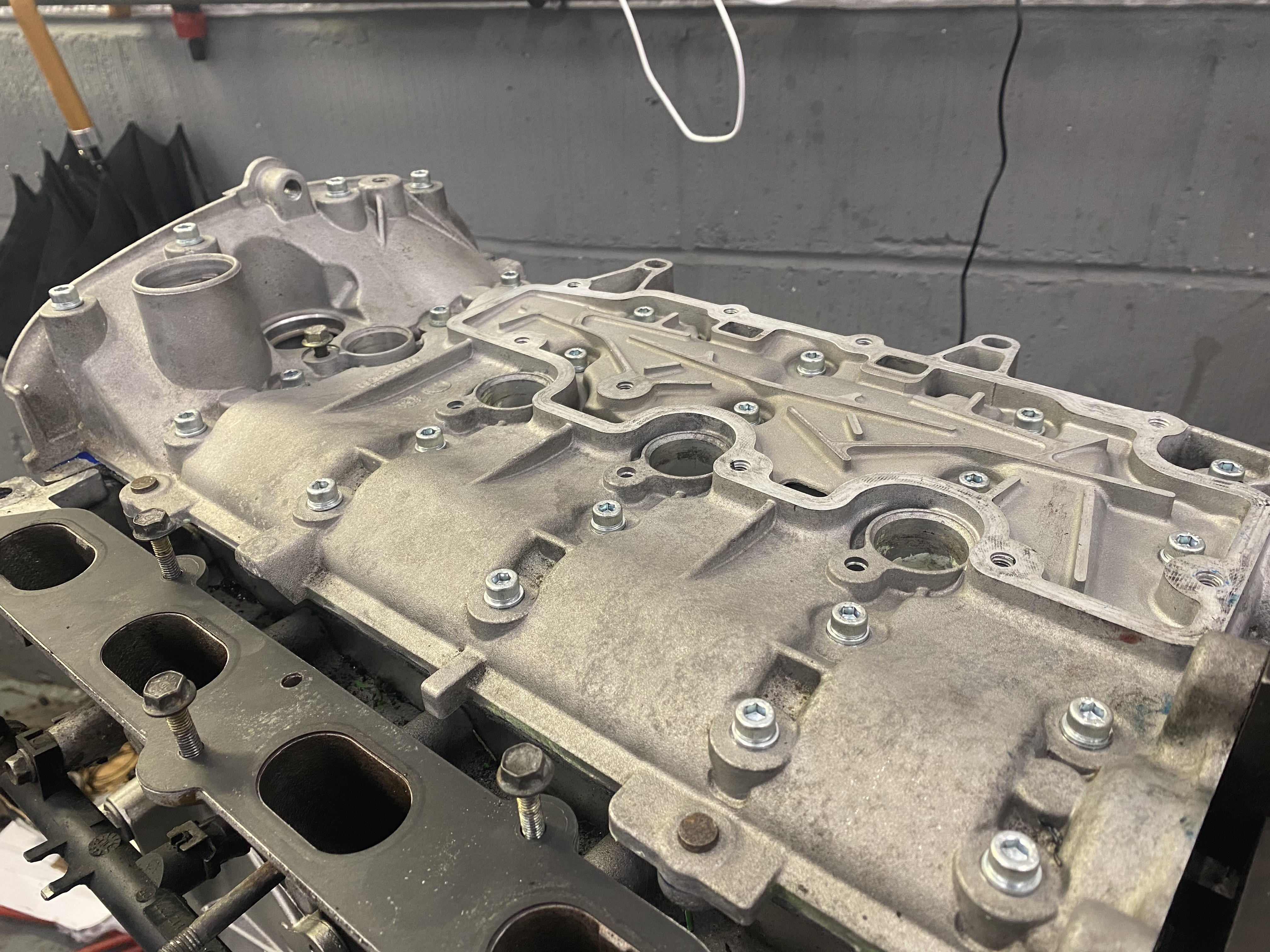

Well it runs.. engine is in.
mock up shafts made ad will be sent off next week. Other than that I have a boost pipe to make because of the 197 alternator/AC bracket. Which although has caused a few issues it’s a much simpler setup than the 182 accessories!
want to see a vid?
Boost pipe problem solved, bends all cut ready for tig welding! Bit extreme but needs to fit nicely, can’t be doing with rubbing and lashed up pipe work!

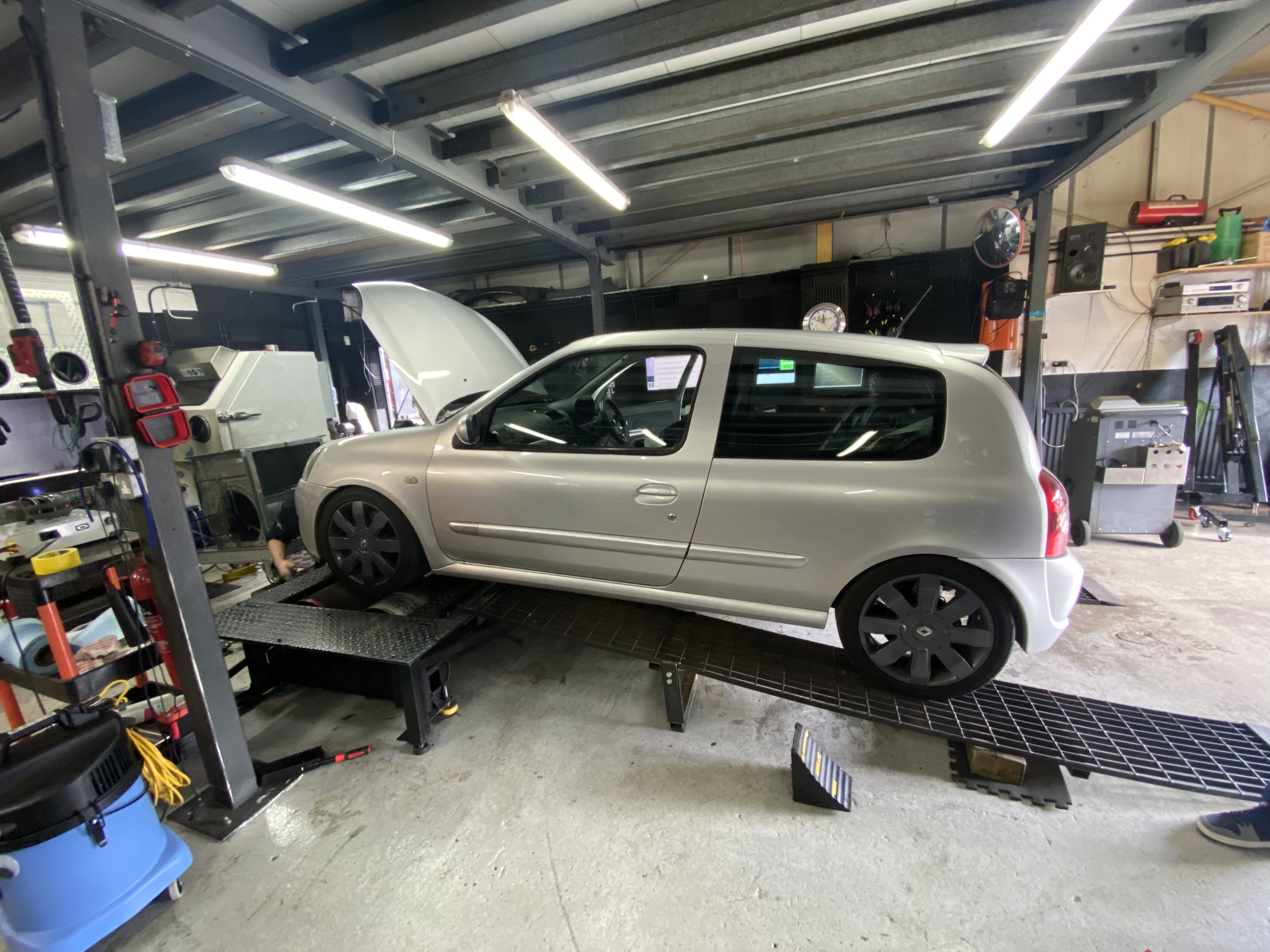

Update, been a while!! I like to post changes on here just as much for anyone interested and for myself really, like service history this thread!
Last weekend I had a map check by Andy, as I was getting some 22psi boost spikes, should be 16-17ish.. anyway was worth the trip and my concerns were justified, I’ve not been driving hard for this reason or any track work!
turns out my 8psi spring in the actuator had weakened off resulting in some boost control issues, I need to run a 12psi really but we have re worked the boost control accordingly and it’s a solid 16-17psi again.. fuelling perfectly all along so no drama. Feels awesome again, very strong and not hitting boost limit within the ECU which basically closes the throttle when reached for safety! Slightly back the power off until I get a new spring.. sits at 340hp currently and 360lbft!
The 200 bottom end with Meg 265 pistons and rods with Clio 182 head is a great setup, no more over complicated Aux belt setup, easier timing belt replacement in the future, the 6 speed NDO is awesome.. really notice better fuel economy cruising in 6th at 2.5-3k rather than 4.5k.. love it!! Hoping to get some track time in before the year is out. One of the vids shows loading and lots of fuelling setting up boost.. carbon burning off inside the exhaust 😬😬
