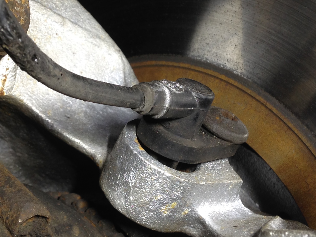

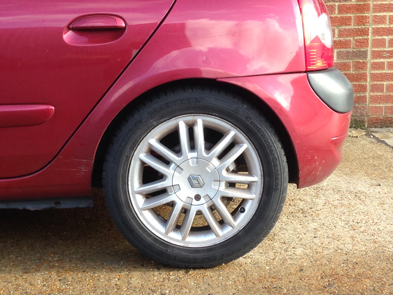

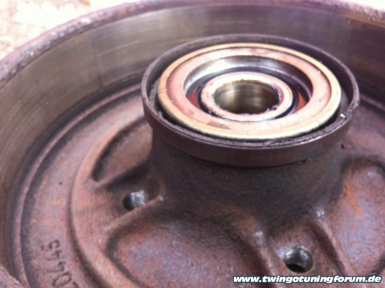

First thing should be to compare partnumbers of the ABS Block with magnetic sensor Ring to ABS Block with metal theeth Ring
GrahamS
@william.. you’re wrong I’m afraid. Non sports came with both 26 and 44 tooth ABS systems. The change occurred in about 2003. For cars with 44 tooth ABS systems you need standard front sensors and dci100/1.6 sensors for the rear beam, I.e sensors without ESP. For 26 tooth cars you can use standard 172 sensors. You cannot simply change the module as the pipework is different. Likewise you also can’t swap between rings, the speed multiplier is hard coded in the ABS module firmware.
Krarl
Thanks William I did have the magnetic ring on the old drums I remember.
I'm now looking for dCi 100 (or even 1.6 16v) rear abs sensors that I'm told will solve the problem.
They're almost not available as I've been trying with cash in hand for over 3 months !
I think I have 1 dCi 100 rear ABS sensor mate :)
  Clio RS
But if he had magnetic ring, as per my optinion its not posible to have discs at the rear, because its not possible to install a magnetic ring and a magnetic ring sensor.
The complete ABS Controler for the magnetic system does have an other output. Also the Main engine loom. We should keep in mind the ABS Control unite is direct on the Bus system. And not connected wire by wire.
That the non sports came with 26 and 44tooth at the rear is new for me. I Thougt they all have 26 as a maximum.
How ever i Think due to fact its magnetic rear system, it will not work. Major Item is the breake Balance system, wich is now not regulated. Its fixed
  Clio RS
All abs systems work from magnetic pulses both front and rear on the clio and for both 26 and 44 tooth models
Ok, thats true, but!
He has an third systems which works with an magnetic ring without tooth!
The thing is, Steel tooht ring systems are activated by an external voltage from the control unit. The Sensor is Pole pin with an coil surrounded and connected with an permanent magnet. When the steel ring rotates, there can be an alterntaing voltage be measured when the coil is activated by the external voltage. The number of thooth has to be implemented in the software as an indication for the radiations.
When the Ring is magnetic, that means a permanet magnet, this magnet creates an square wave Voltage in the passive coil of the sensor. This sensor dont need to be activated.
If you mix up his passiv measuring ciurcuit, with an sensor which needs to have an perment voltage, and with a tooth ring, it will not work, because of the ABS Control Unit wants to have this passive sensor and there is no permanet voltage availabe at the sensor which he requires.
Also the measuring prinziple is different, and last but not least, the Magnetic Ring ABS System wants to have an square wave Voltage, with other amplitude and frequency than each of this tooth rings can create.
Once again, if there was an Magnetic ring installed before, an steel Tooth ring will not work dosnt matter how many thooth.
The complete control Unit needs to be changed, and i dont know if this can be done so easily
  Clio RS
Here is an Example for an Magneting ring
Thanks @william.. for the input, these things are waay beyond my understandings of car electronics!

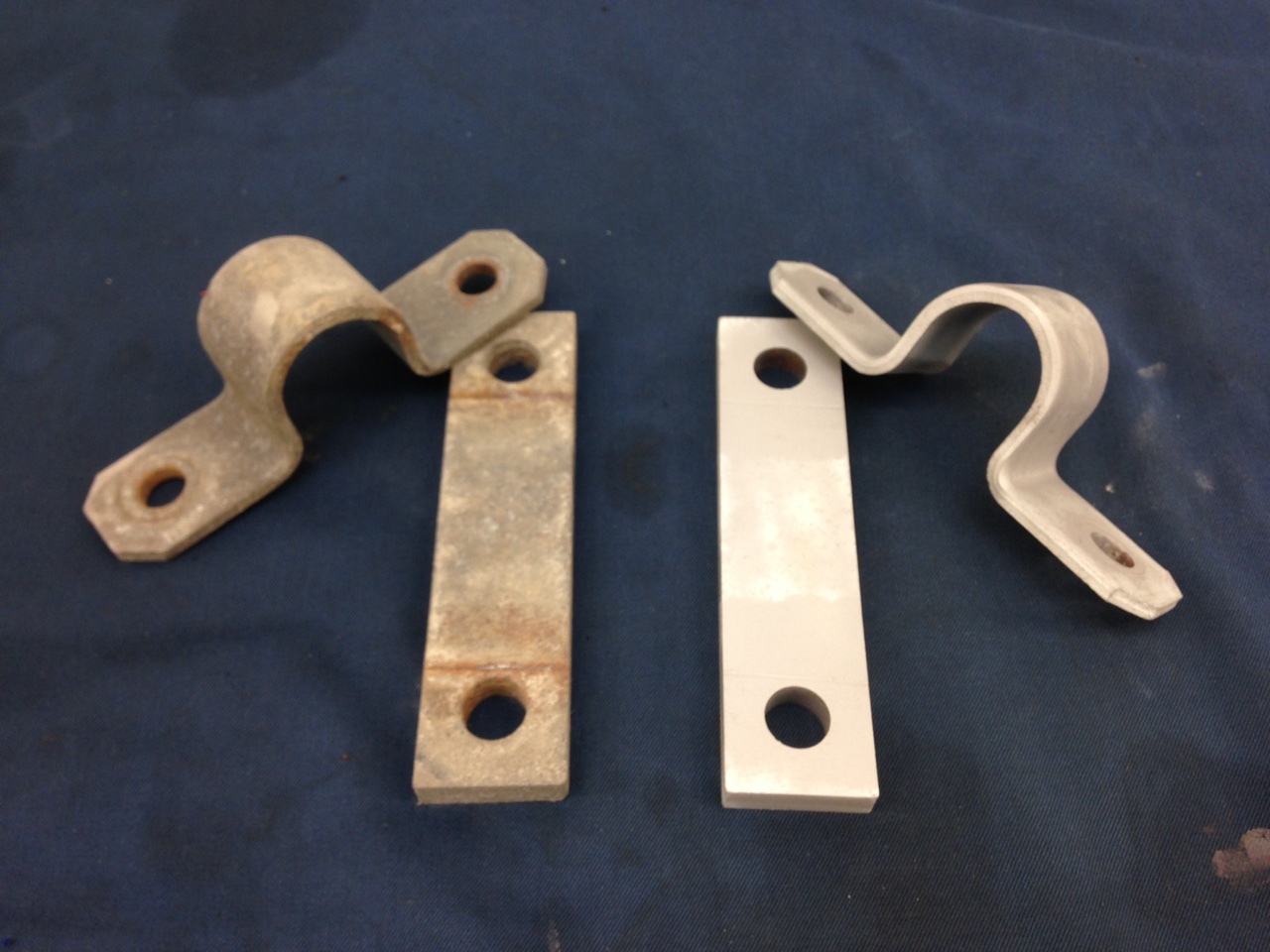

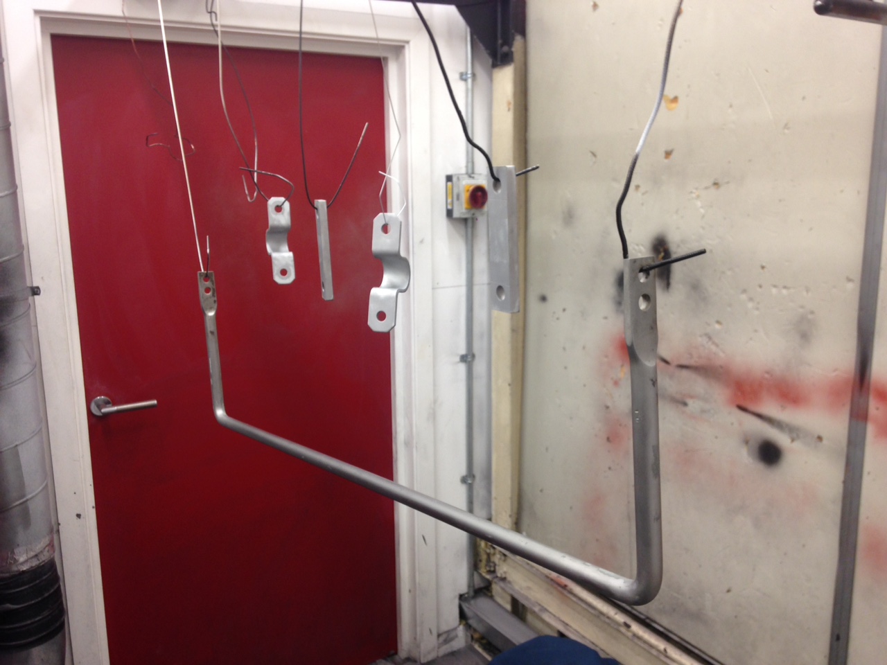

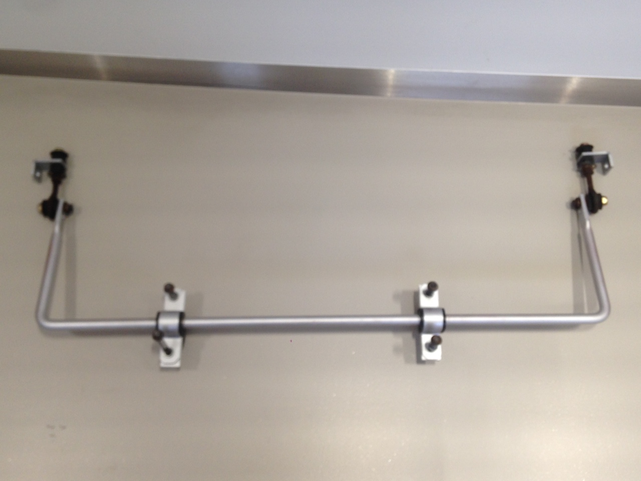

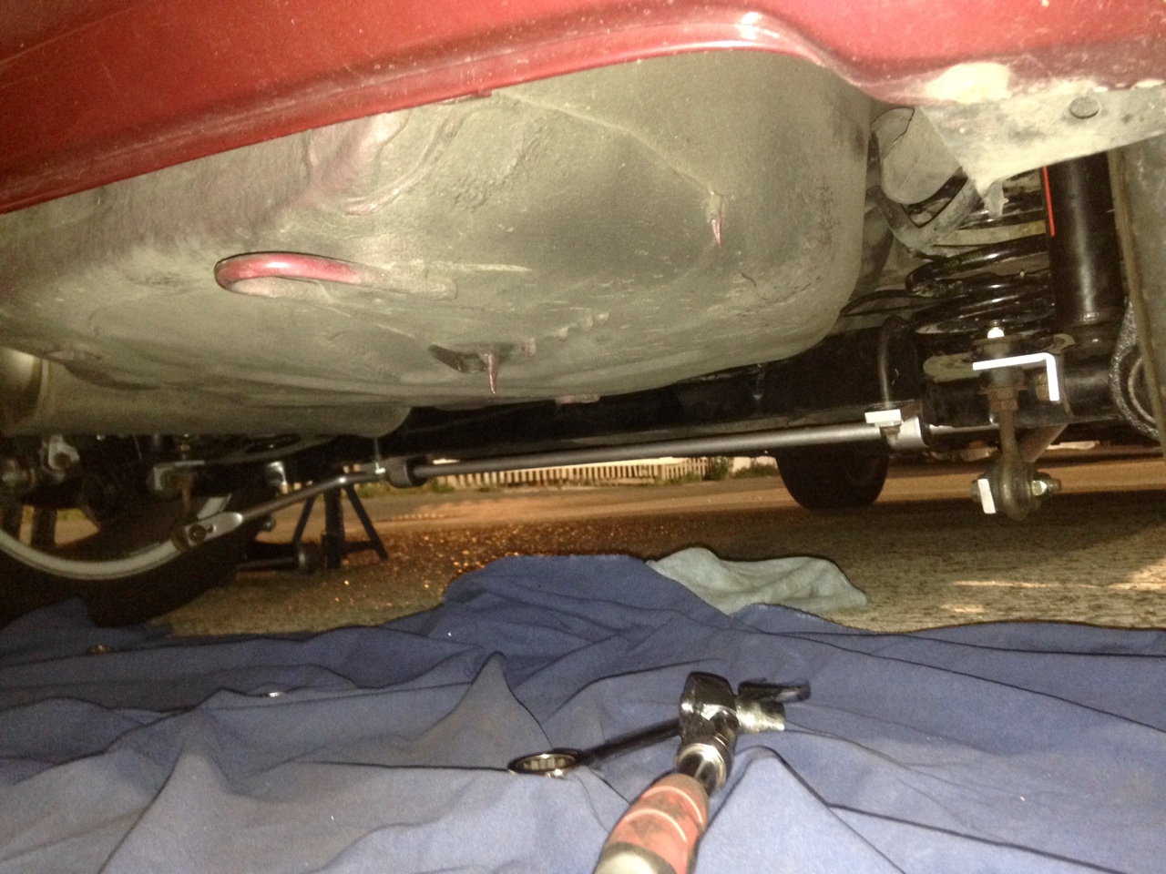

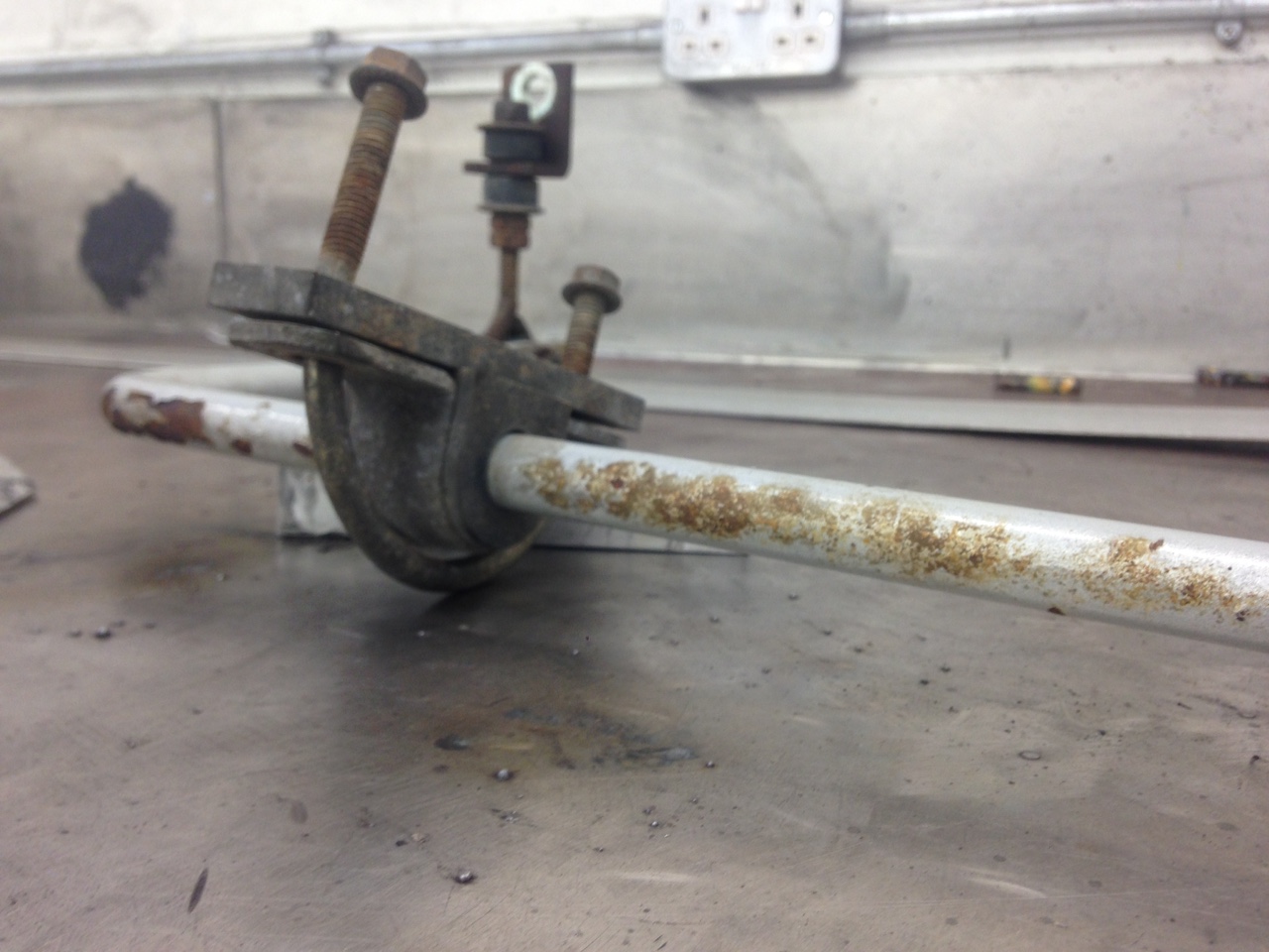

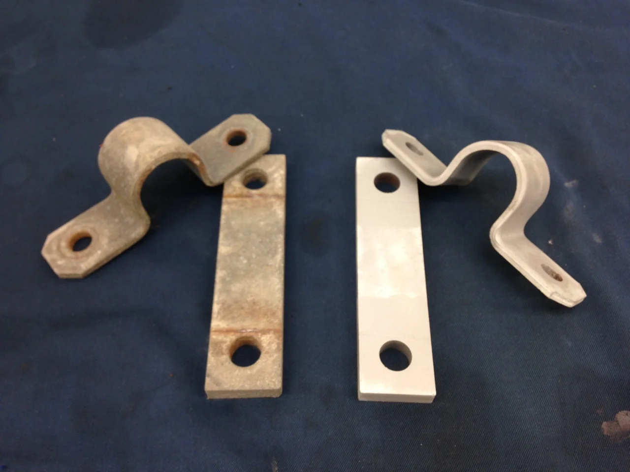

Got a whiteline 19mm ARB from Mark Corsa on FB. Black bushings, the good ones from what I've read, and in fairly good condition.

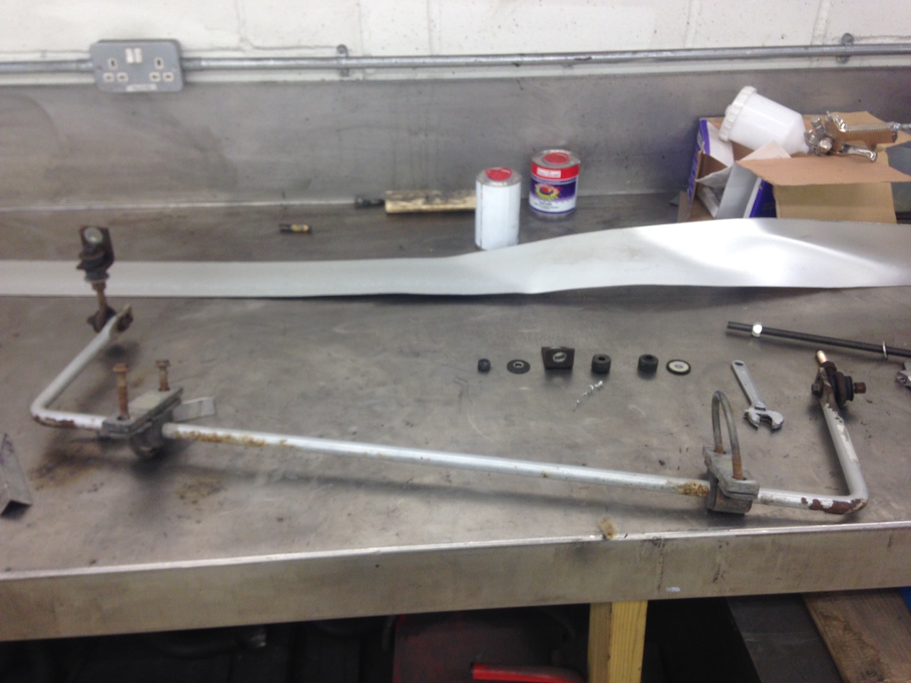

I took it apart and gave it a quick resto job, usual sandblast and paint, heatshrink on the ubolts to prevent corrosion, grease in the bushings and all new nylocs and washers.
bish bash bosh on it goes !
I'm not really happy on how it fits. Those U bolts should really replicate the shape of the axle instead of being just U shaped.
Oh well, I know nothing!

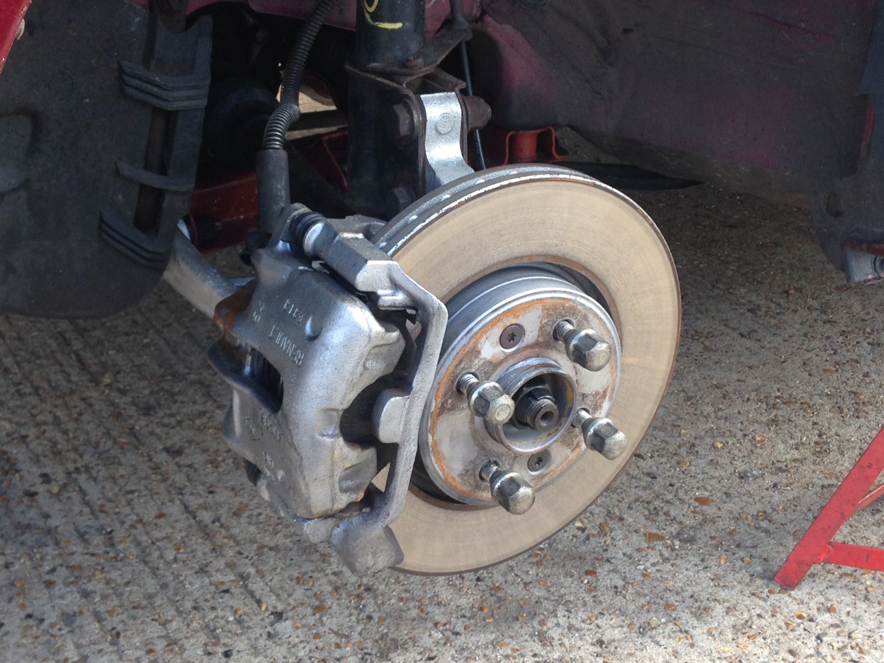

First thing was to quieten down the brake pads. The brakes work fine, but at As most of the items in the conversion they're old, but have loads of meat left and are Genuine Renault stuff which shouldn't be bad.
The once nicely painted caliper is already a dusty mess.
I'm actually happy about that, means that the pads are actually wearing and doing their job.
All I did is smear with copper slip all the surfaces that need it. Works for now.

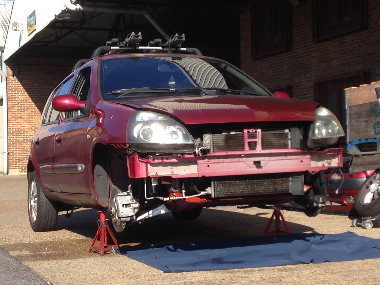

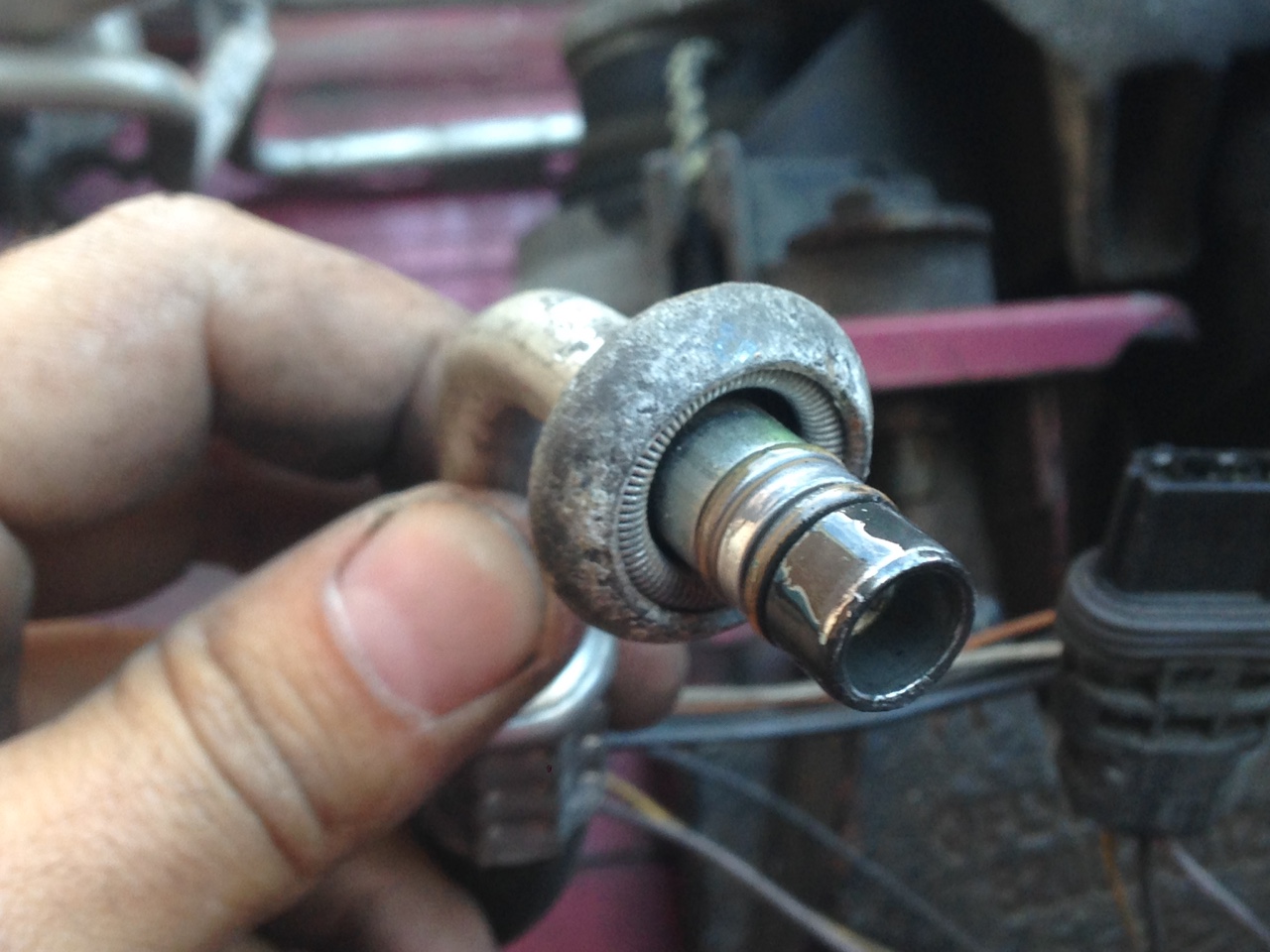

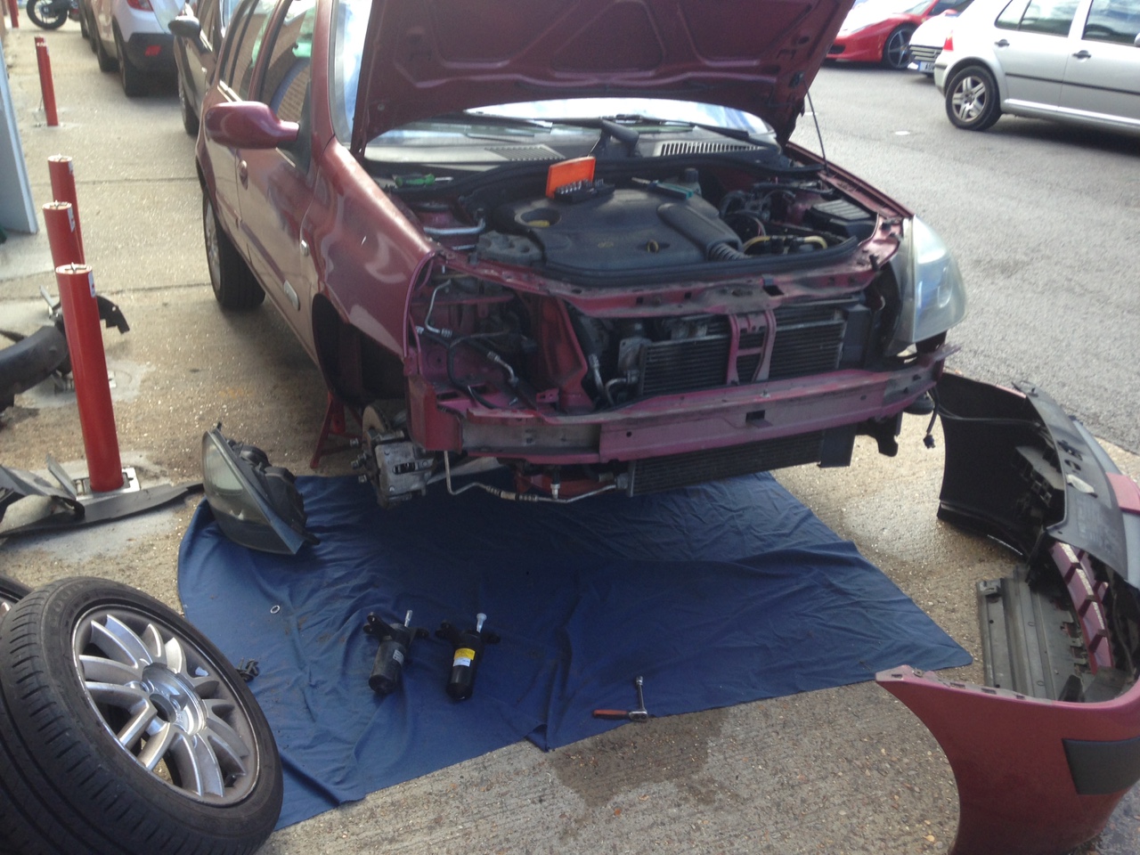

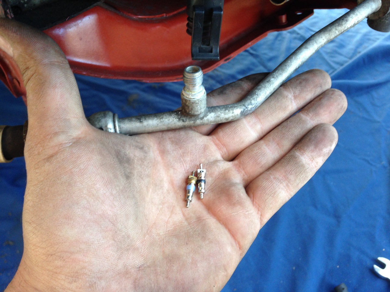

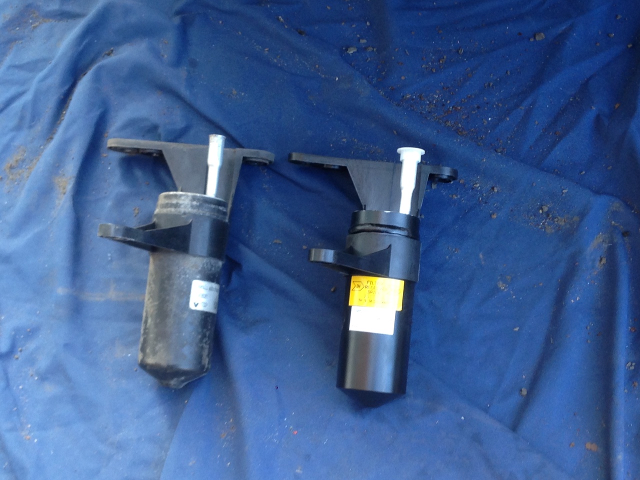

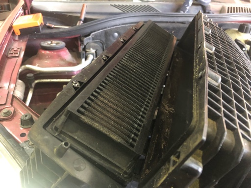

Second on the list was the AirCon receiver dryer that probably was never replaced.
Bumper off, I took the opportunity to clean some greasy areas that are not normally exposed, also took off and cleaned the arch liners as well as the wheel arches themselves, tons of dirt out, good job Renault for the plastic wings! There would be nothing left of them with that much dirt at the bottom..

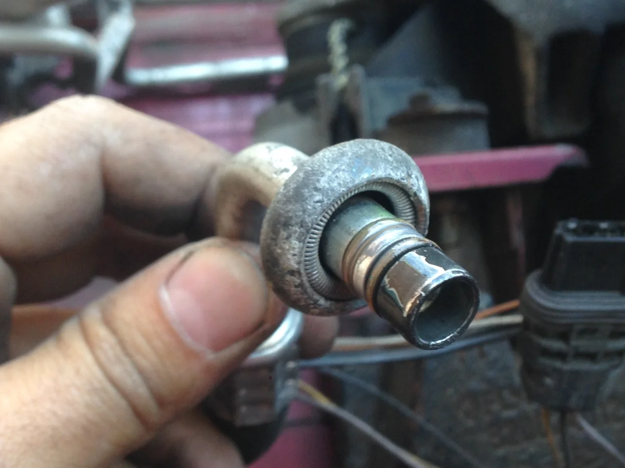

The low pressure side had a fitting I've never seen before.
New orings and shrader valves (did the top ones too)

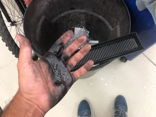

I've also put in a new Bosch fuel filter, 15k miles from when the Renault one went in a year ago. No pictures of that, but I'll look in the filter like a did last year.

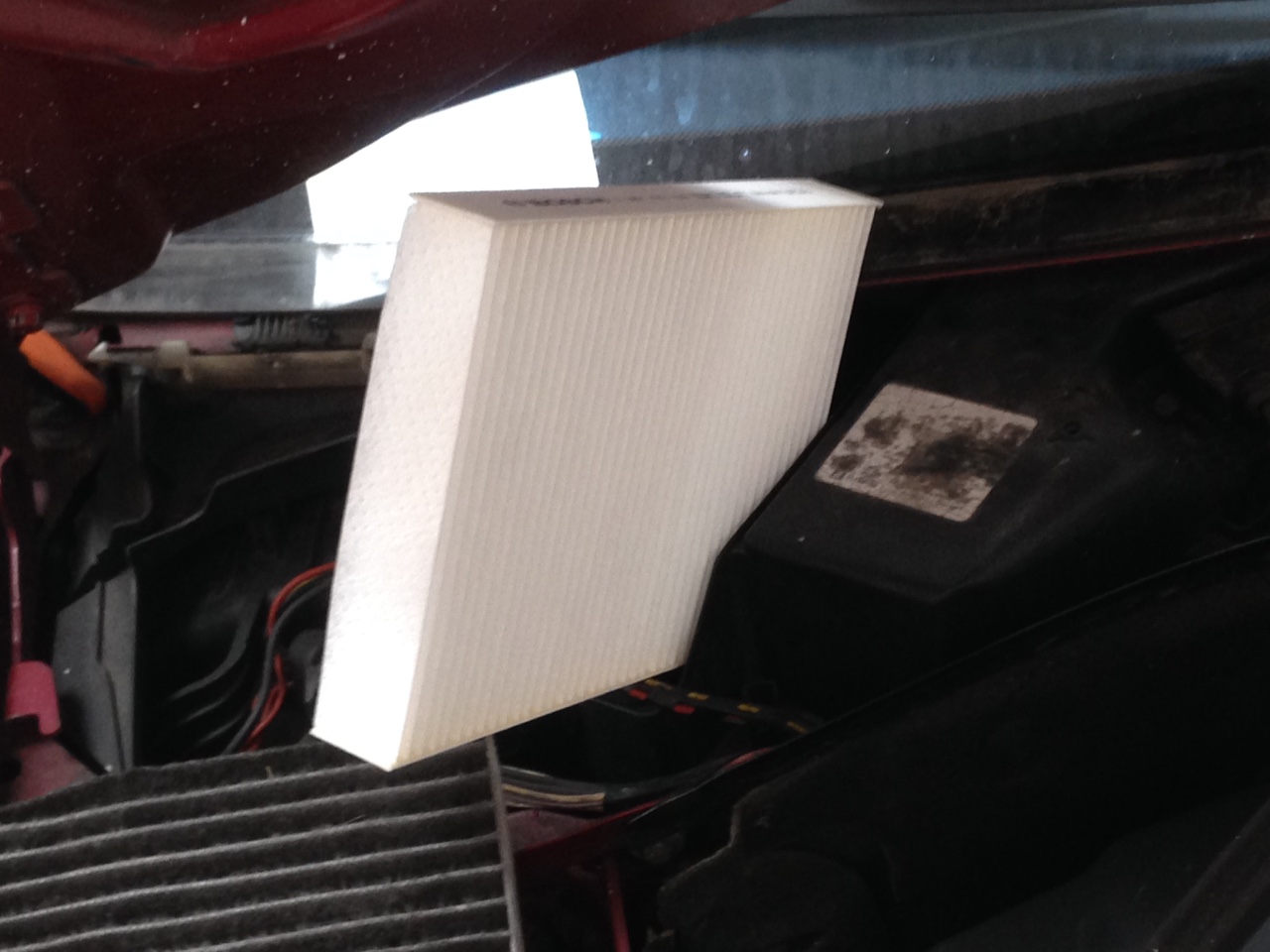

A/C still to be regassed, I've also got a new cabin filter and a spray that claims to kill bacteria in the hvac system..

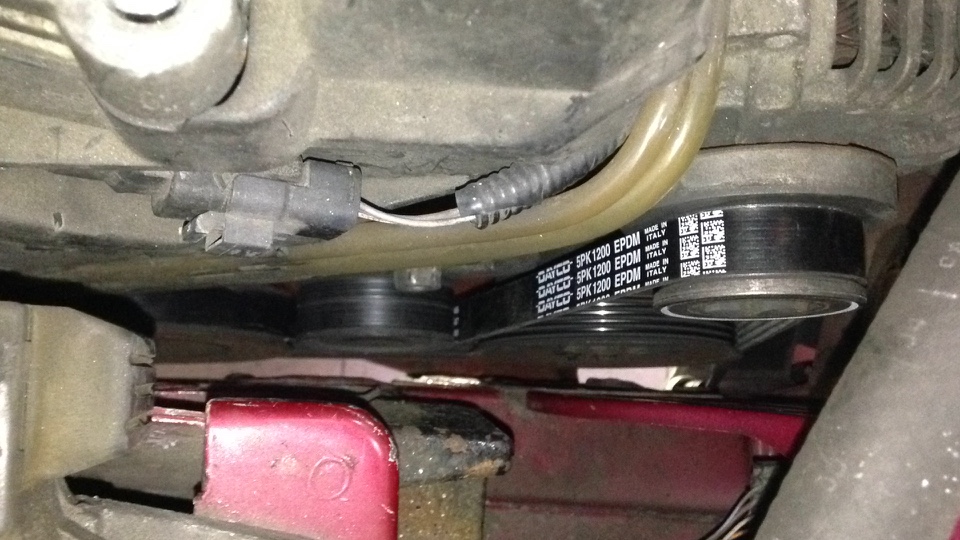

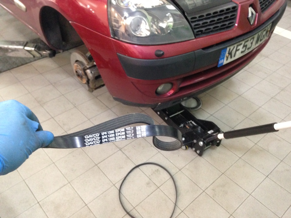

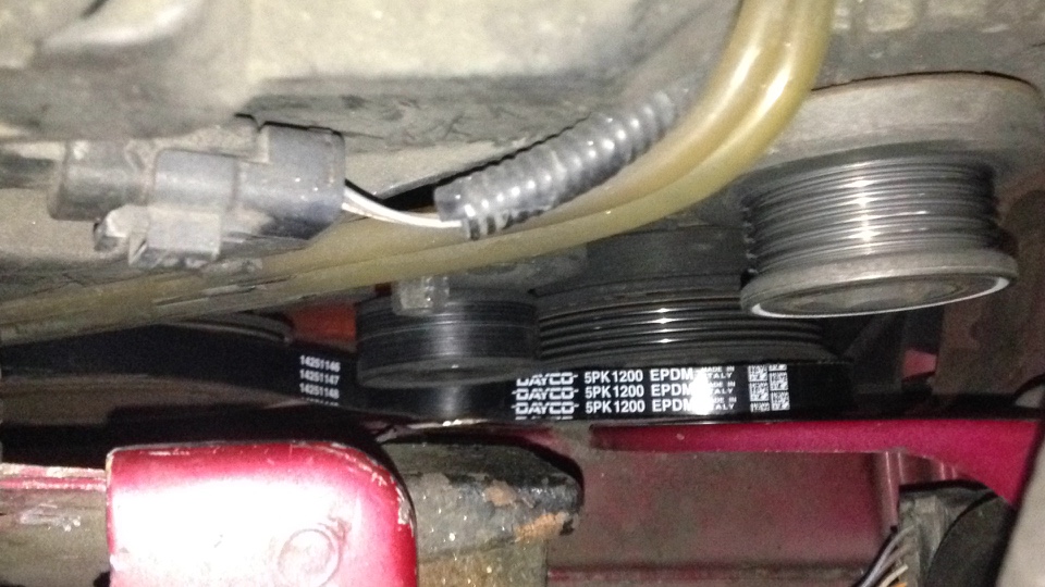

Oh I've just bought another drive belt.

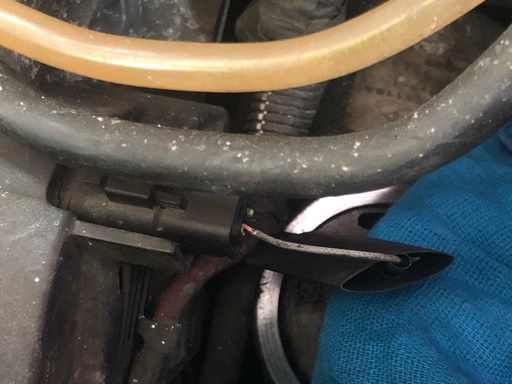

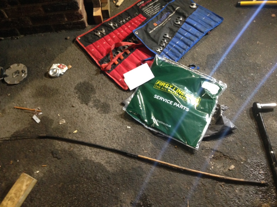

Wednesday a new glow plug relay went in. I decided to just whack one in without any sort of diagnosis on my smokey cold starts.
It's either injectors or leaky turbo, but hey the pre-heating circuit as all new now!

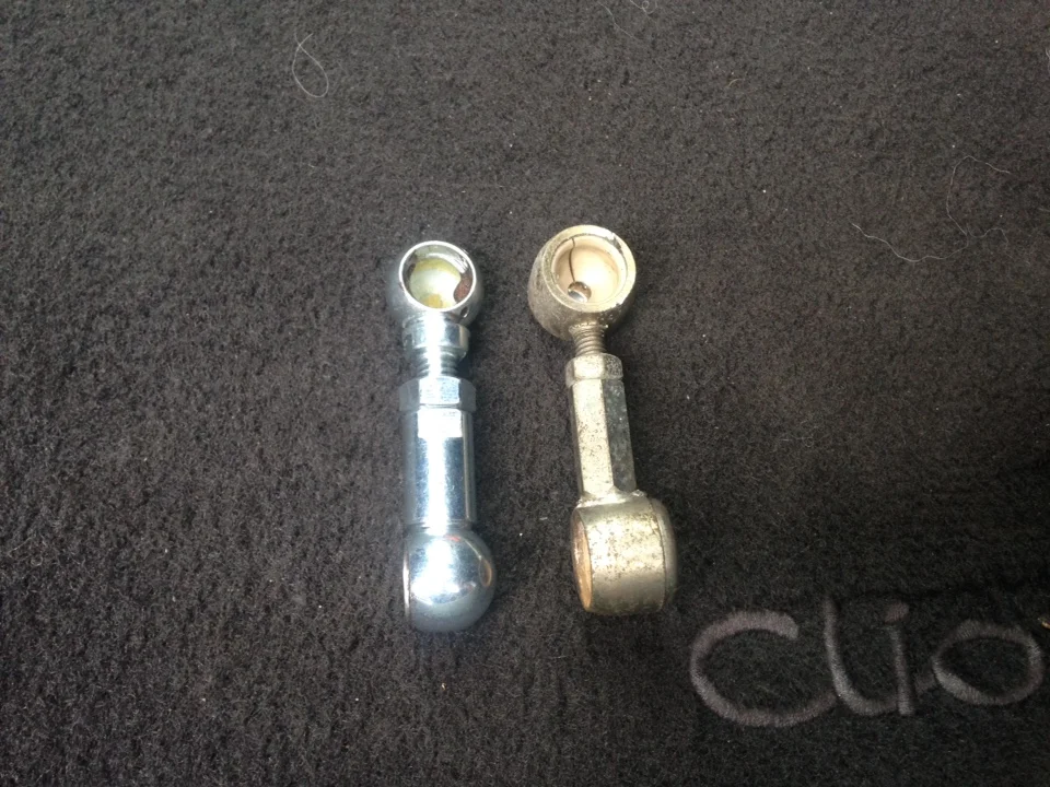

Second was a little fix for which I have to thank the ClioSport forum.
My heater was often getting jammed on full hot or even full cold sometimes. I found on this forum how to rectify the problem, and all that was needed was a cable tie.
I swapped the two motors just because who knows..

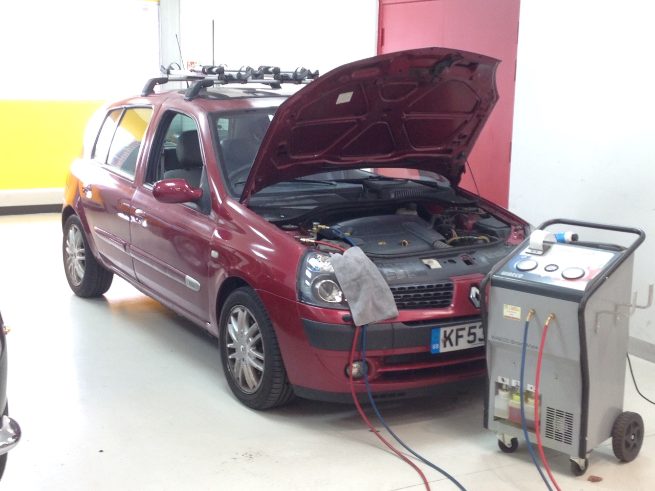

Today I wanted to bring the AirCon back to life, polish the headlights AGAIN, find out why I had a brake warning light on and do a proper geometry after the eyeball tracking adjustment three weeks ago.

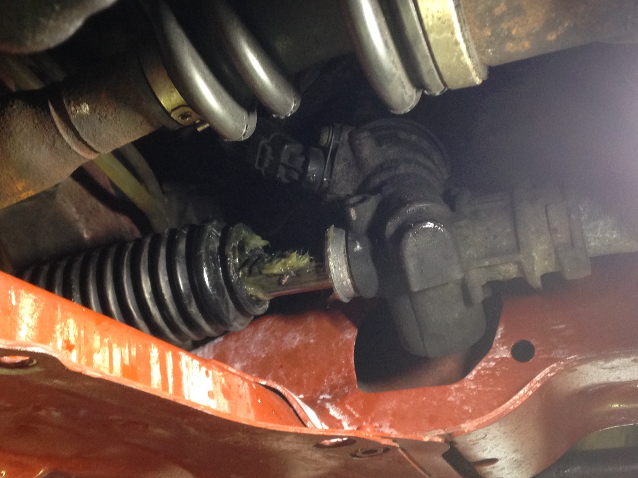

I also have a weird creaking sound coming from somewhere between the rack and the steering column.
I decided to grease the steering rack with some new grease, I was hopeful..
The creaking is still there.. the steering joint is tight and fully seated, more investigation needed I guess !

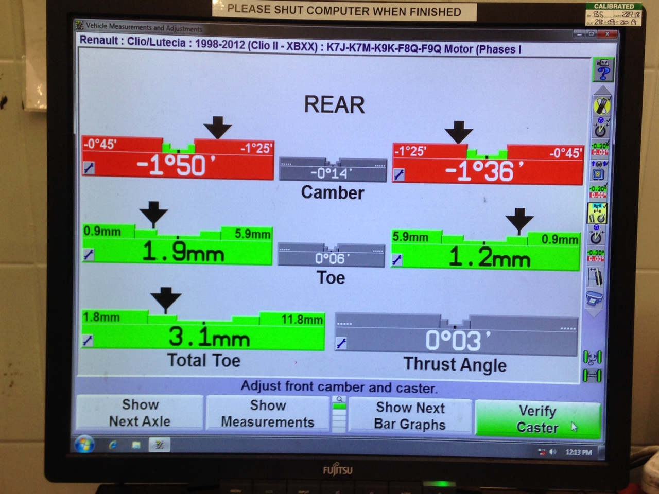

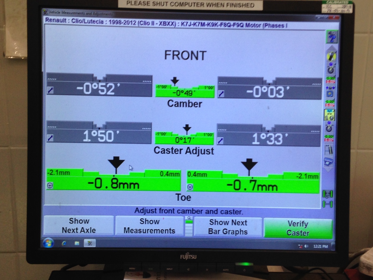

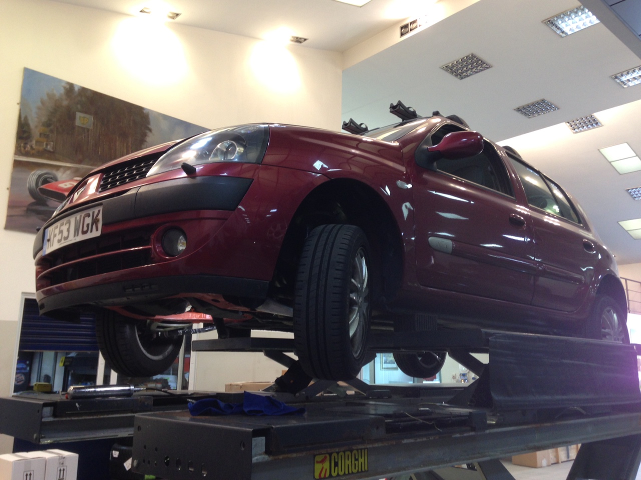

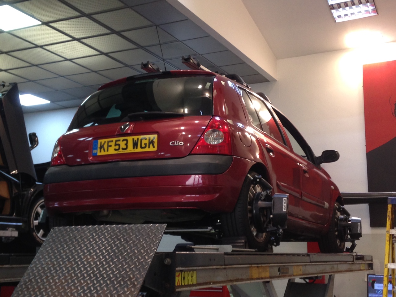

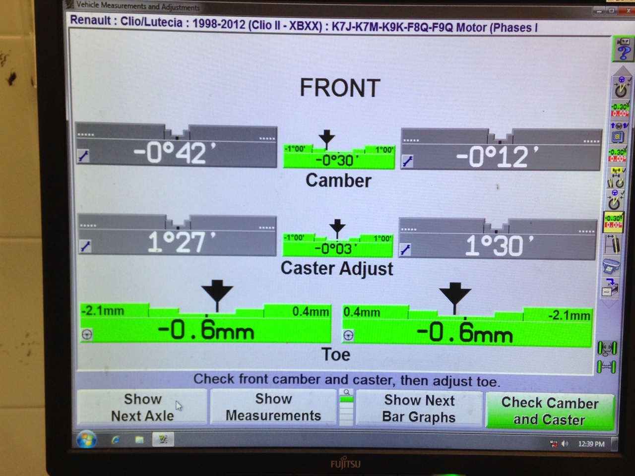

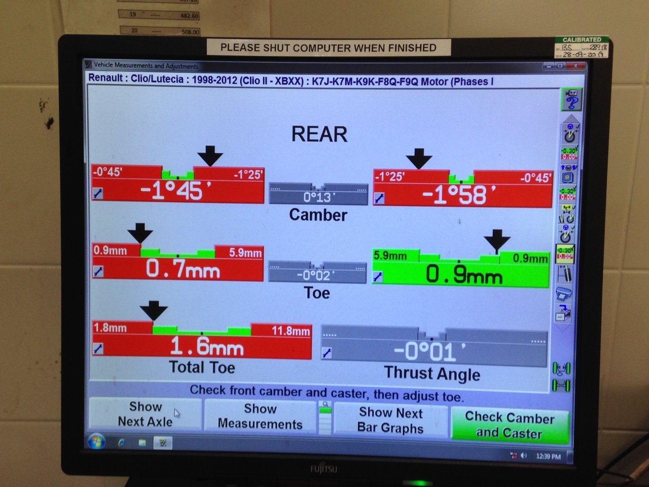

While I was on the scissor lift I chucked some sensors on the wheels and did a front toe adjustment. I wanted to get the rear axle spot on too, but after looking at the figures I decided it wasn't worth it.
This is the front axle, the graph is intentionally exaggerated, it's fine.
While adjusting the tracking I realized why my dashboard was a Christmas tree of brake warning lights..
Then it was time to regas the A/C, fit a new cabin filter and test an odor eliminator..

I also need to find some dCi 100/1.6 rear sensors, as I do like my abs !

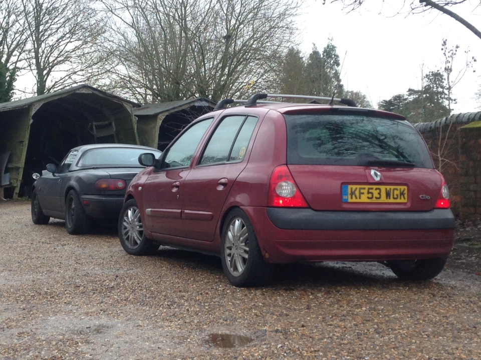

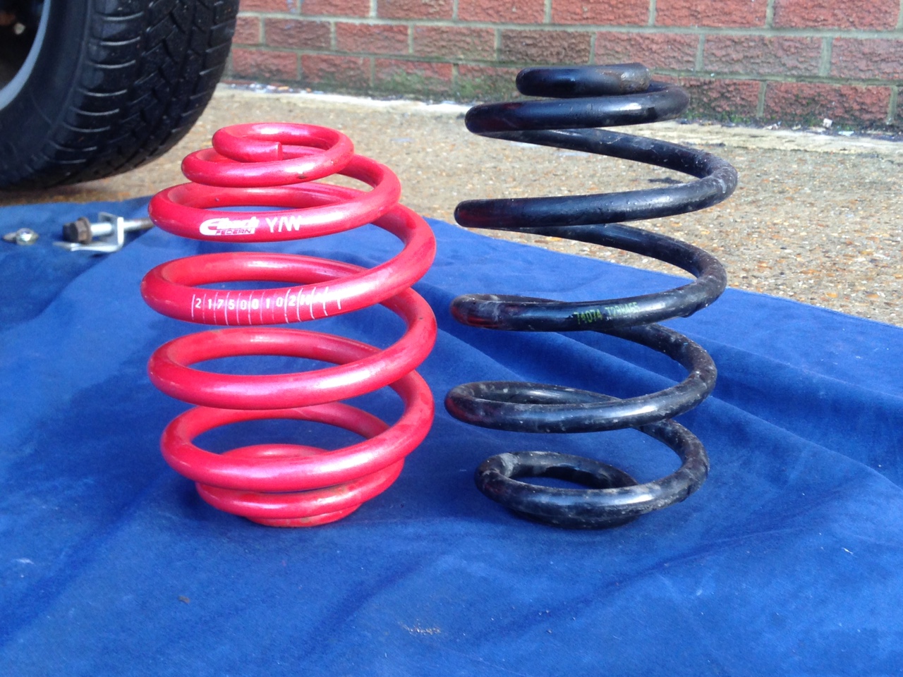

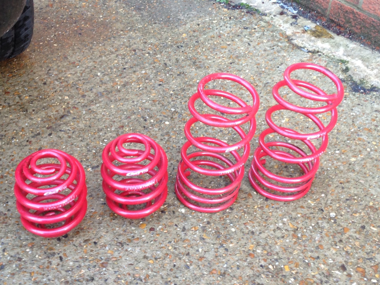

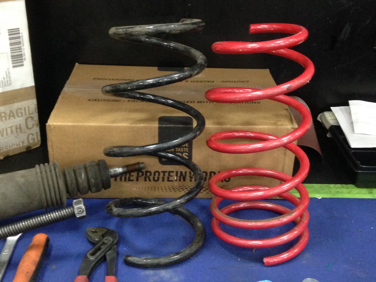

Last week I found some eibach sportlines from a guy on fb that was breaking a 182.
Jumped on them and today they finally got fitted.

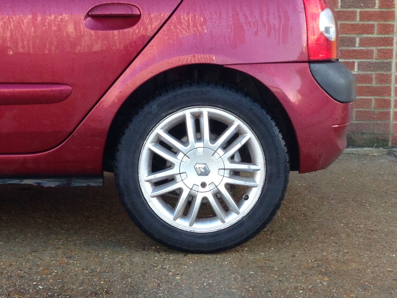

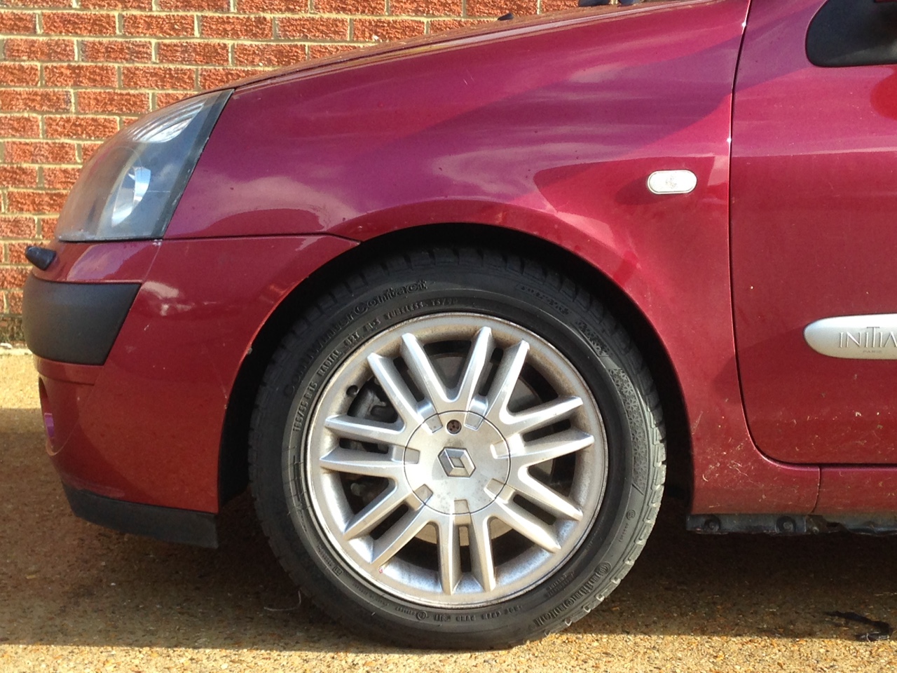

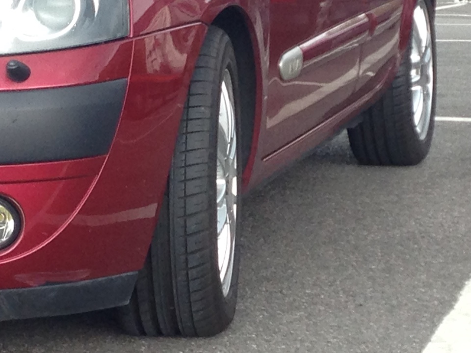

I took pictures of the whole car and of front and rear axle purely to see the difference in looks.
Front
Rear
Compared to the standard 172/182 springs only the rears are noticeably lower, the fronts have different springrate.

Then a new toe adjustment, might need camber bolts at the front if I want to get it bang on. Rear camber looks quite aggressive !

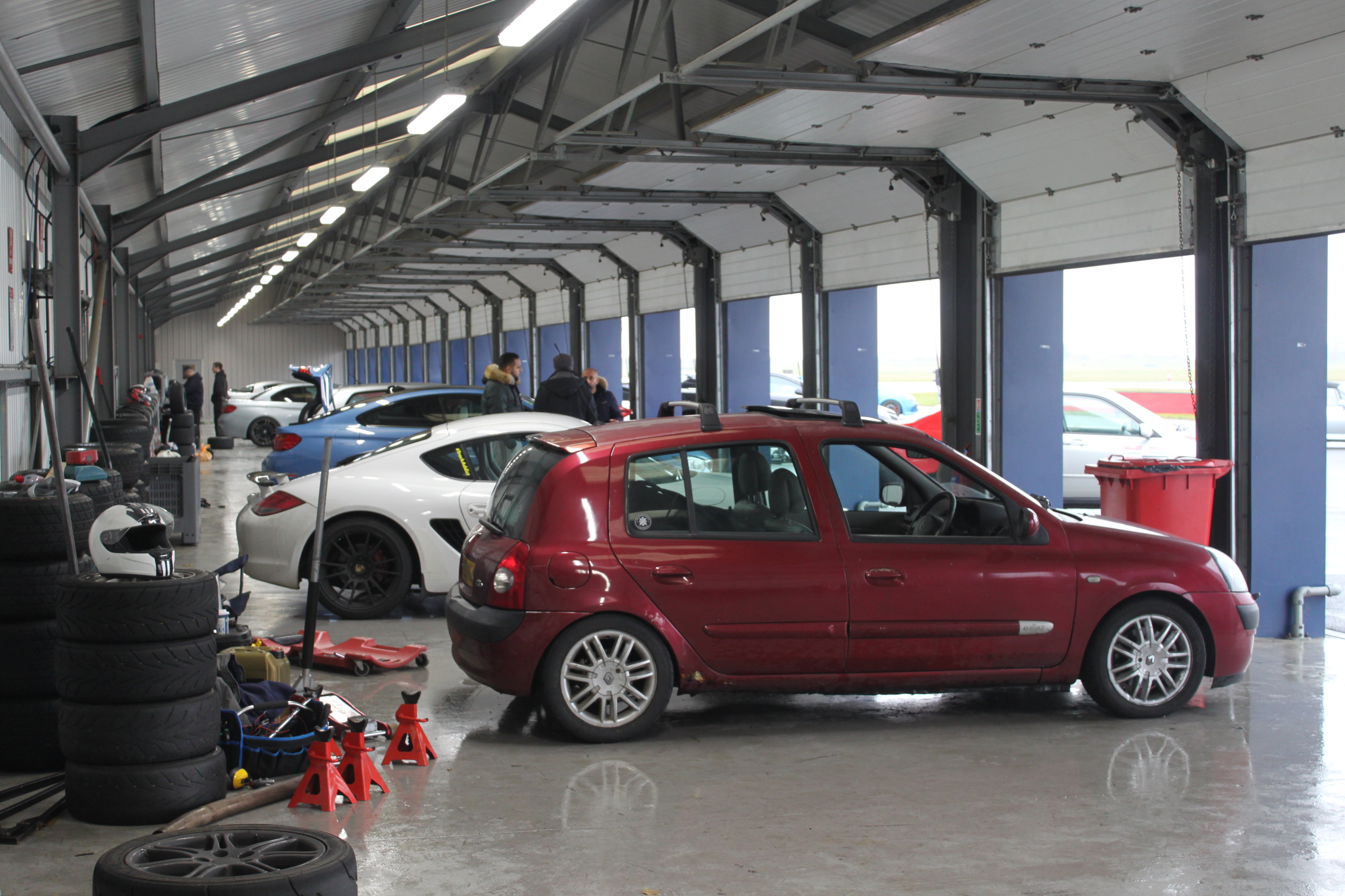

Instead, a couple of weeks ago, Mr. @GrahamS hits me up with an open pit lane ad Bedford, probably the last of the season, for £99...
I used to do as many trackdays as I could back home with my Civic, always loved it and always felt like that's the thing to do if you like driving fast.
Here though, there's rent to pay, and feels silly to spend all that money when there's nobody buying food for you, that's all it is for me.
£99 though... on a Saturday as well....
Let's call this the last one before sewing the wallet shut!!

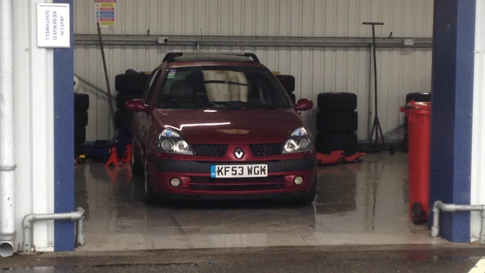

Scrap winter prep, the mission was to get the rusty 80hp daily in race mode.
One thing for it --> semislicks. Got myself two A048R fronts, and slapped some mildly flatspotted NS2R at the back.
I thought about shedding some weight, but wanted to see how lively she could be in the wet (forecast was bad the whole time) so would have done it on the day.
Couple of spares packed and ready she was.

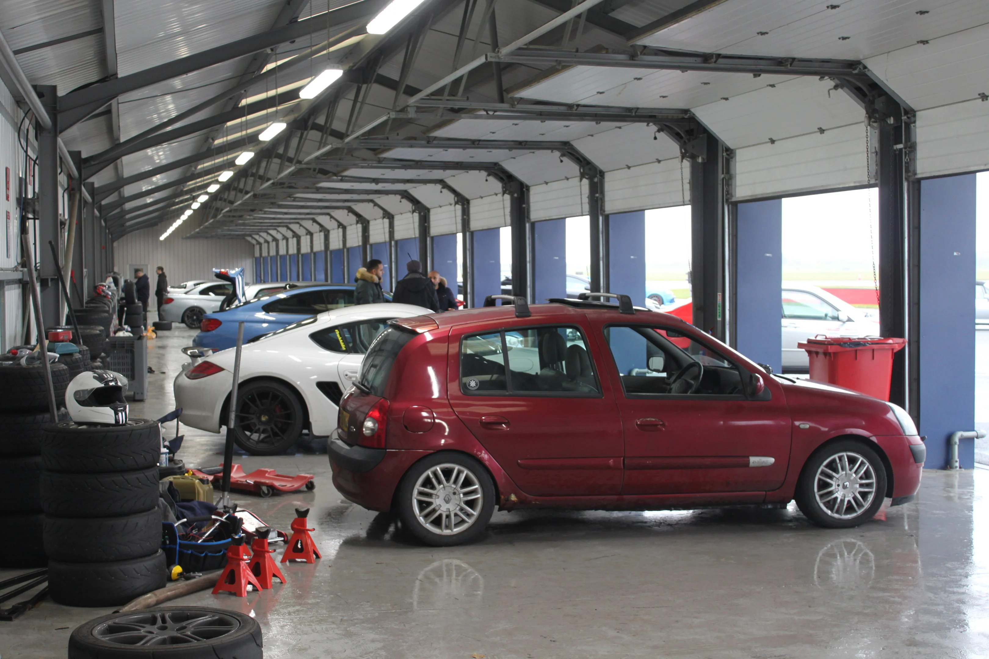

The day went smoothly, I drove most of the time and also gave a mate the chance to experience a bit of track driving, which was interesting as I've never tried to "coach" anyone while driving, and I'm obviously a rookie myself.
All good until a bad spin generated a somewhat weird noise from the gearbox area that scared me at first.
Turned out to be an arch liner rubbing a driveshaft and the passenger side front wheel falling off, nothing major. I only found this out at the end of the day, so decided in the meantime to leave my trusty workhorse alone for the afternoon and enjoy some quick laps with Graham and a friend with a quick JDM MX5 NA.
Thank god I came in, another half a lap and I would have lost a wheel.
(The only time I have not used my torque wrench..)
All in all a top day, I love trackdays and I'm up for it even with a silly 80hp diesel, it's all about driving on the edge for me, and you have far more chance of doing it with an underpowered little car than with a gt3, unless you know what you're doing behind the wheel, and most of us don't, but I should just speak for myself.

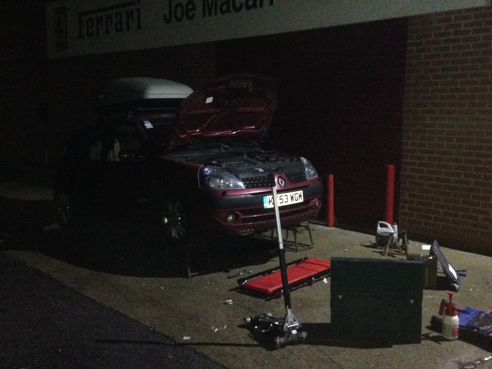

A couple of pics of my late nights on the ramps.

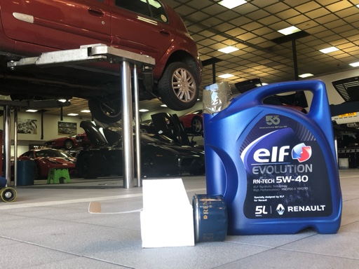

Oil change night this one, along with front end spanner check and coolant top up, all good here.
Oil change was a 1000miles under due, but considering the track abuse I though it was the right time. Genuine elf and genuine filter as always.

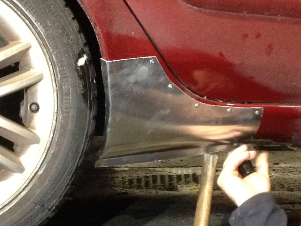

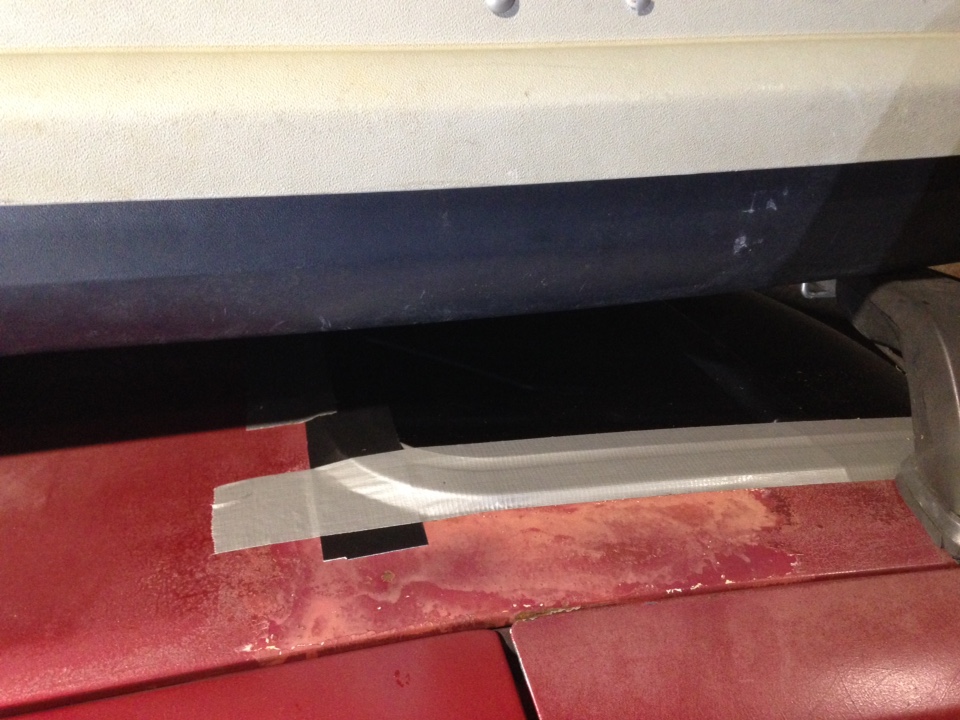

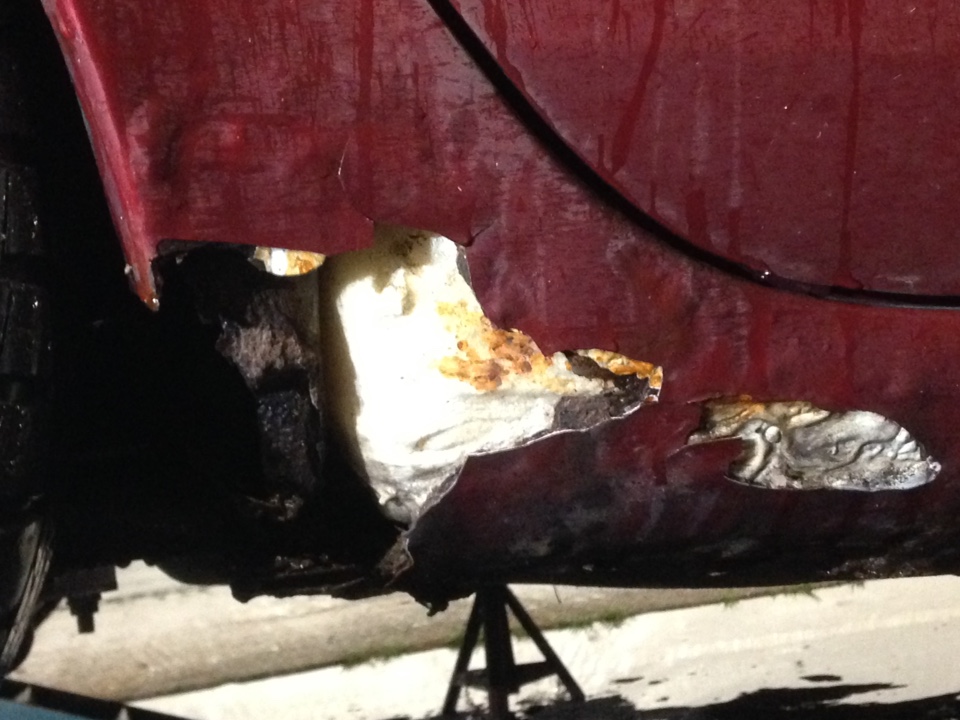

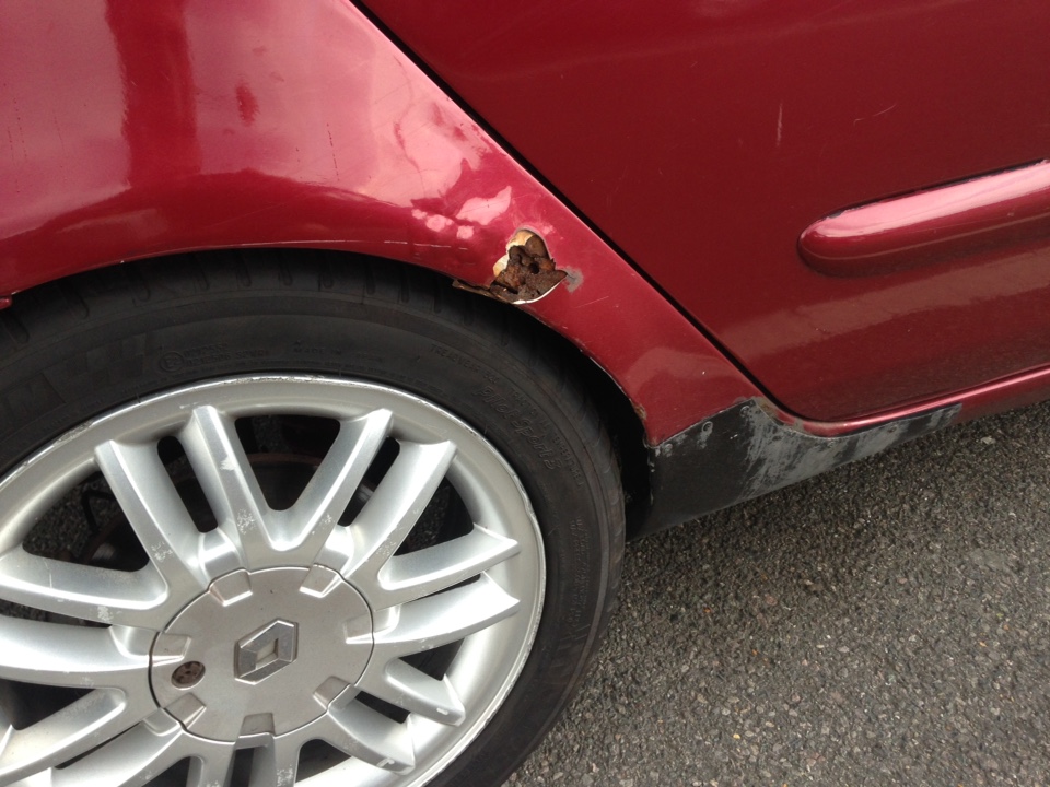

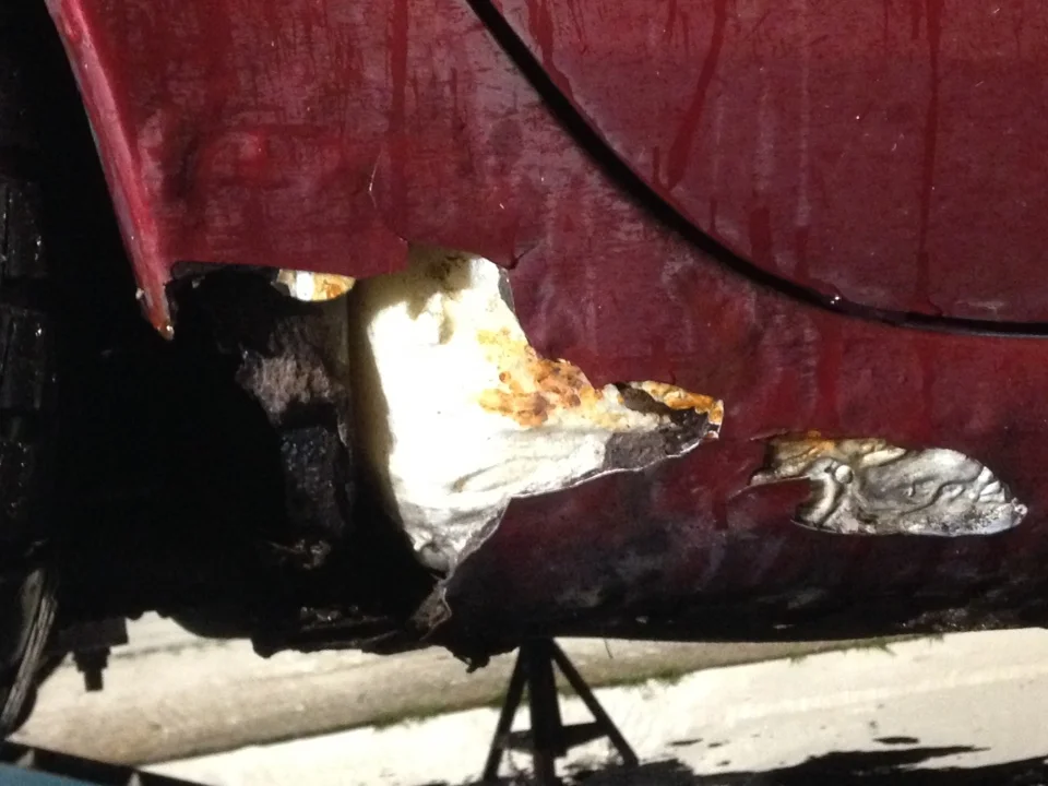

The following night was bodywork time. While on the track I showed a friend how horrible the rust was on my car, and a slight tap with my canvas Vans turned the already destroyed sill into a tunnel.
You can now see the expanding foam used back in the day when this car was cheaply repaired to go back for sale, nice job Bob the builder !
please do admire the racing patch, lightweight aluminium obviously, that I made to temporarily patch the hole. This is purely so border control doesn't pull me over like it did in the past questioning the roadworthiness of the car.
I will properly fix this, I haven't got the money now.

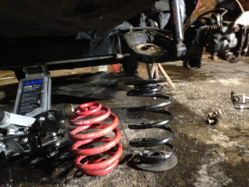

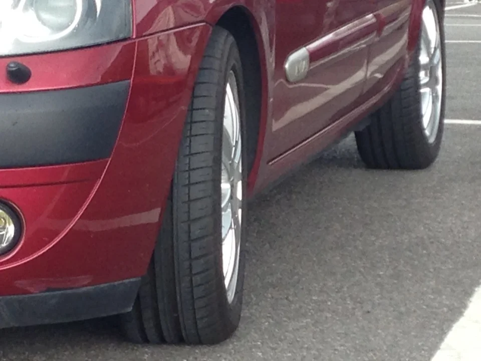

Spring swap next, the eibachs are already quite low with no weight on the car, I assumed they were just too much for carrying passengers long distance. I took a risk and installed the standard 172 springs which are roughly the same as the standard dCi ones but have thicker coils. They handled the weight fine.
I also had to grind some of the arch lip, most of it is body filler from when Bob the builder fixed the damage from the accident in 07.

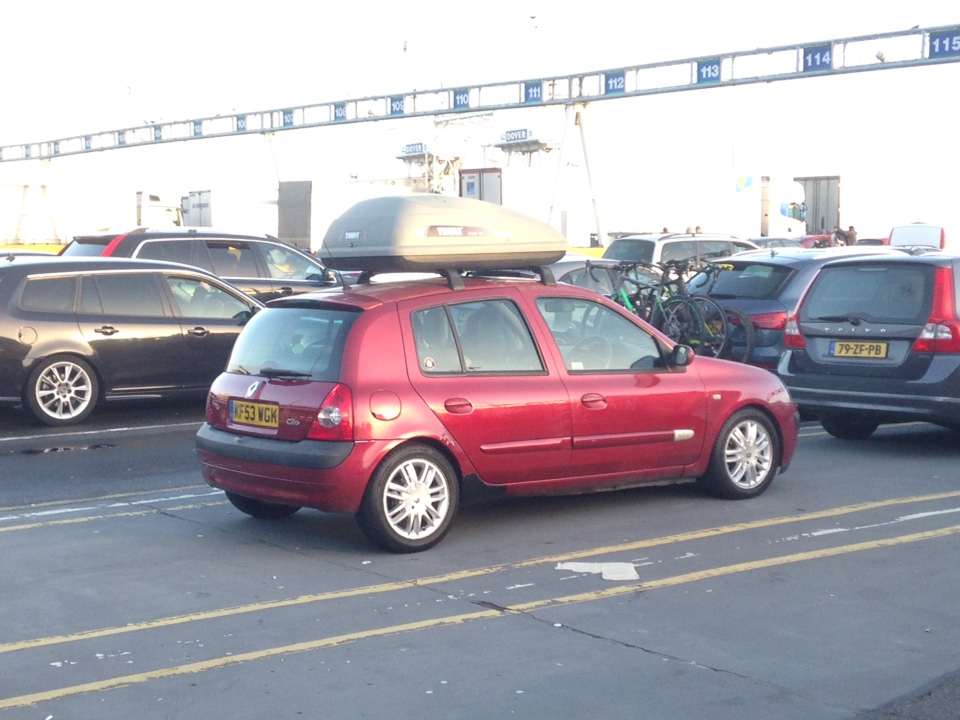

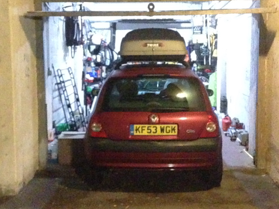

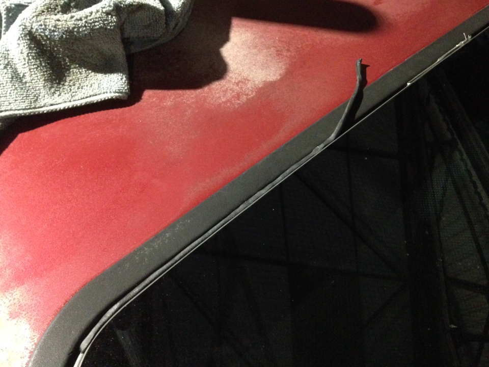

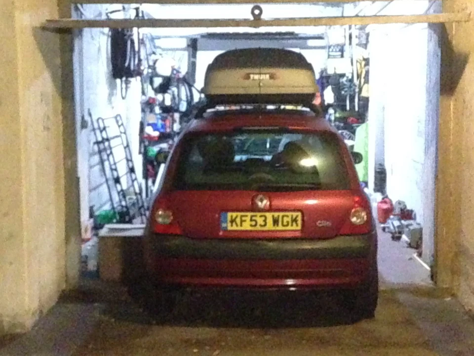

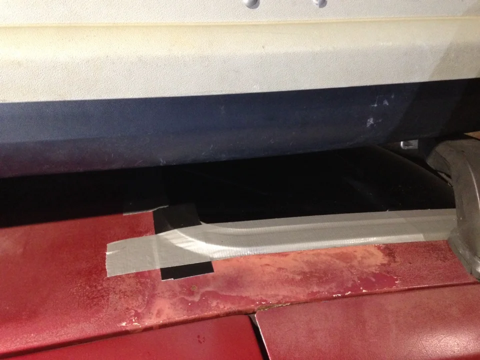

Thule box on, winter continentals back in service and we're ready for the trip!
The dodgy tape job is unfortunately needed even with the new sunroof seal, this is the new improved version, worked as good as it looks shyt.
I even washed the car, what's gone into me !?!?
The trip was an interesting experience. Drove to Luxembourg via Bruxelles on the way out to drop a passenger, then woke up the next morning at 4 to drive all the way to Rome with two friends that live in Lux.

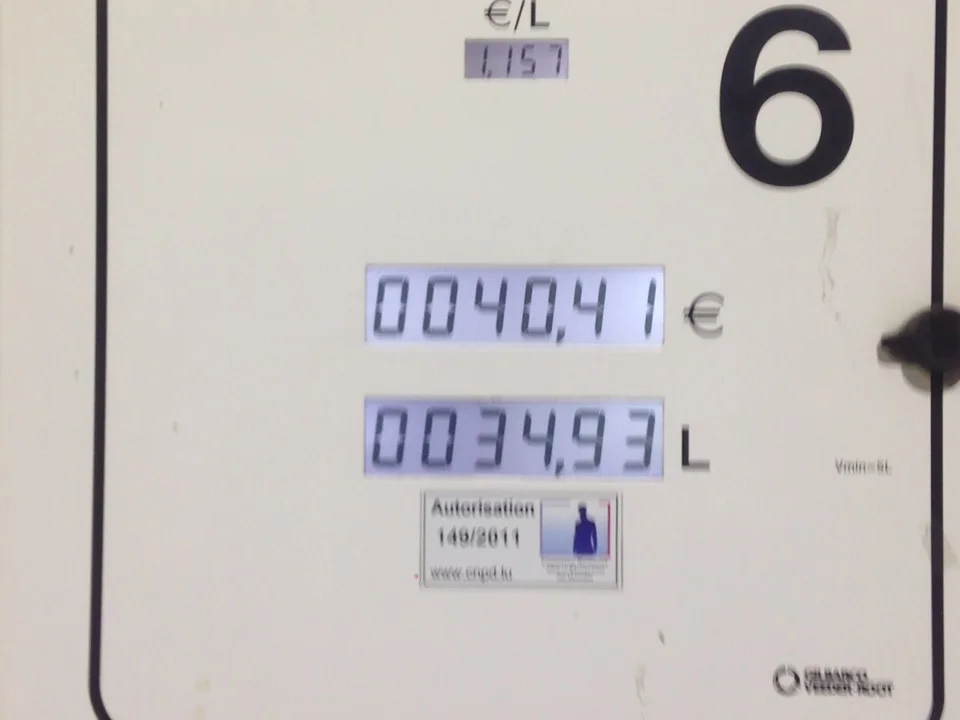

Love fueling up there..

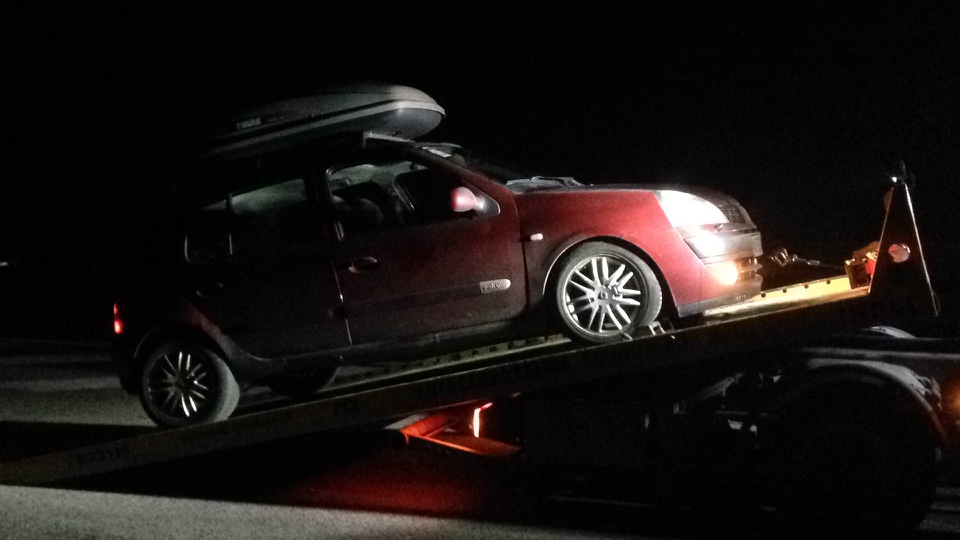

Set off for the alps on the 26th.

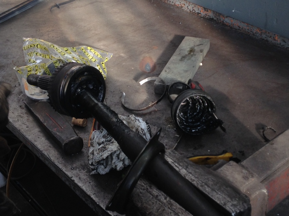

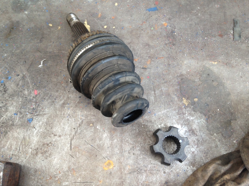

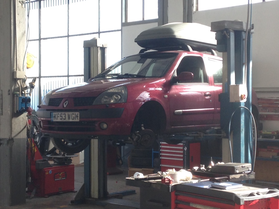

made it 150 miles until the vibration turns into steering wheel shake, and while pulling away for another check in a lay by, I lost all drive and officially broke down for the first time in my life.
Broken NS cv joint, the gearbox was fine, or at least that wasn't the problem.
This fault manifested itself for the first time on the way out in Belgium with a slight vibration, and only turned into steering wheel shake twice during the 1200 mile outbound trip towards Italy.
It all made sense when it finally broke, as I remembered one of the cv boots had a pinhole in it, I simply forgot about it, and paid the price.
It's impressive how long it held up with virtually no grease in it.
So?
Called the Italian AA, slept for a night in Grosseto, no 172 driveshafts or cv joints to be seen, part stores all closed.
Circlip still alive, not the problem
But
The brilliant Moroccan mechanic managed to find a Scenic driveshaft that looked almost the same and crucially was the same length.
Slapped that in, good to go.
520€ all in. Ouch.

Not happy to pay 500€ for a driveshaft job, but could have been a lot worse, considering I had to be recovered at night on a bank holiday and wasn't a member of the car club, so can't really complain.
Back on the road, still some vibrations coming from "somewhere down there" but I wasn't worried.

Two days in the clutch pedal goes to the floor and stays there.
Nice.

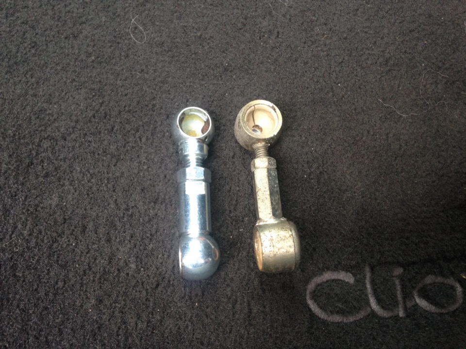

I though the cable had come off the fork on the bell housing, as two nights before I tried to change the top gearbox mount and had to put everything back together (wrong part..) so maybe it was just me hitting it.
It wasn't, the stupid ball joint linkage on the pedal was worn out, an uprated replacement part was sent in less than 24h.
I hate working under the dashboard, this was a painful job.
The replacement linkage comes with safety pins that are almost impossible to insert once the ball joints are in, my colleague finished it off, I just wasn't good enough.
So here we are, left me stranded twice in the space of a month.. she remembered she's a Renault I reckon.
Today I changed the drive belt. It's only 15k miles old but was starting to squeak on cold weather and I can't have that, makes me look like a proper idiot.
New one was £5 on eBay, Dayco this time instead of Gates.
Another b**ch of a job, luckily I could use the ramp at work.
All in.

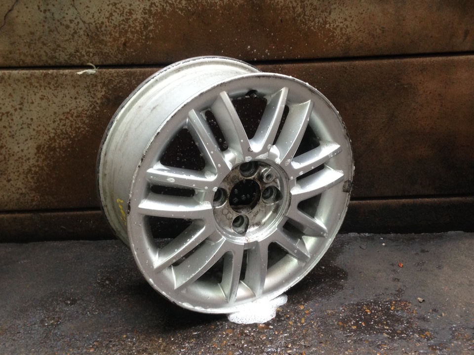

Bought a 5th jade alloy, couldn't resist. Now the spare won't clash with the other wheels. Lovely.

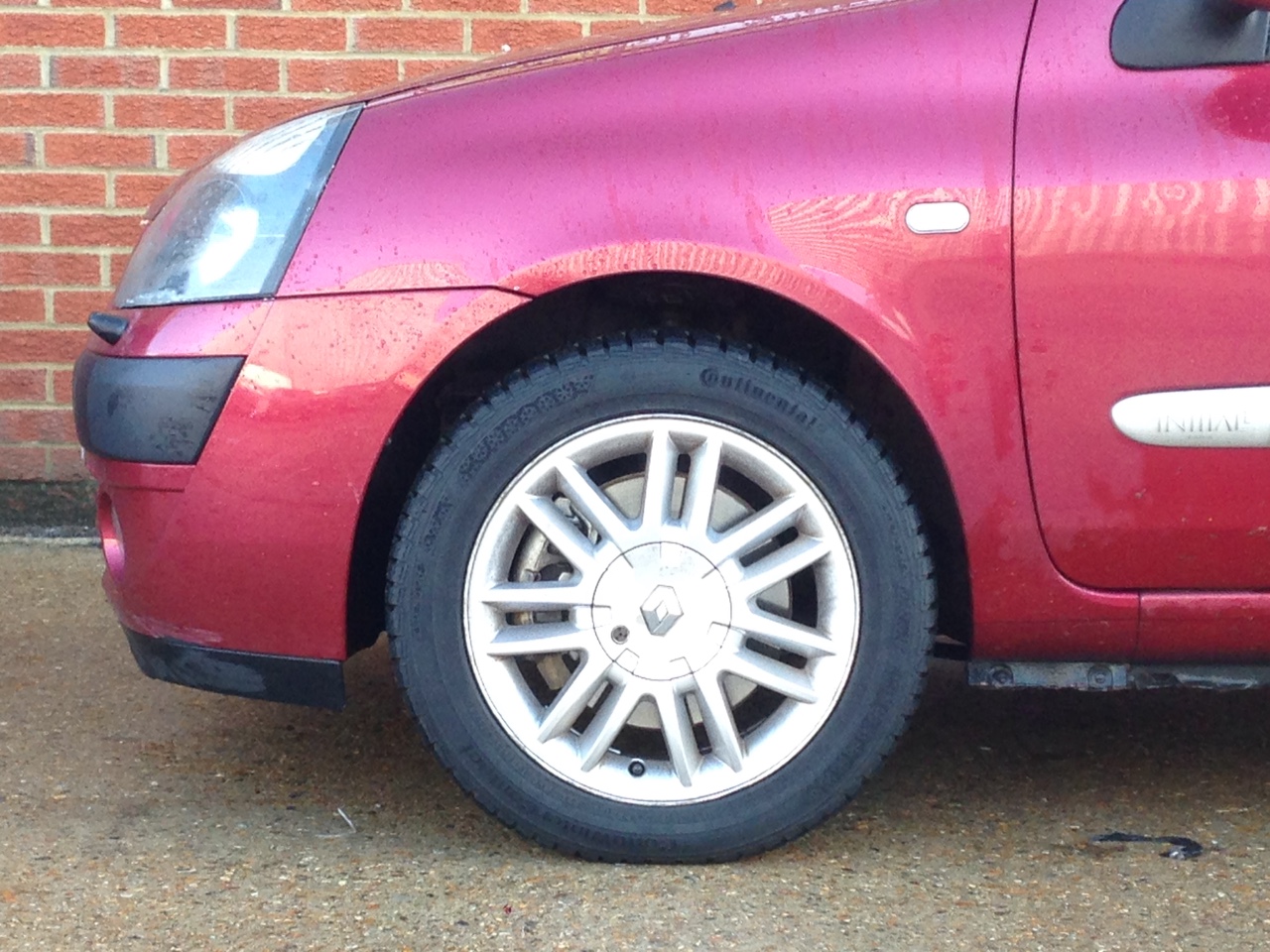

The latest upgrade is a set of Pilot Sport 3 in 195/50 R15, probably the best rubber for the mk2 Clio.
When I bought the car I needed tires so I went straight for the standard size, 185/55 R15, without realizing that I'm not in Italy anymore, and I could have gone for the much more popular (and performance oriented) 195/50.
Back home you literally go to jail if you change your wheel or tire size to anything that's not in the V5.
So, last week I found a set of these bad boys for a little over £100 and today I fitted them.
I'm happy now with proper rubber on, just need to find a 5th one to go on the spare, and hopefully sell my 185/55 GoodYears.

-the bodywork is a mess, the whole driver side of the car needs serious help and the roof is disgusting.
Bits of body filler have started to fall off the wheel arch that was hit back in 2007, showing copious amount of rust underneath, no surprise. Need to find two good driver side doors and a whole sill/rear quarter panel, and get the whole thing painted.

After a quick trickle charge everything came back online no problem, air con works, tires held air.. we’re in business !

We passed, but unless I fix the driver sill is likely to be the last one..

Bought a cleaner for the K&N, and look at what came out after a quick air blow !
Also fixed a wire that broke during the oil filter change
