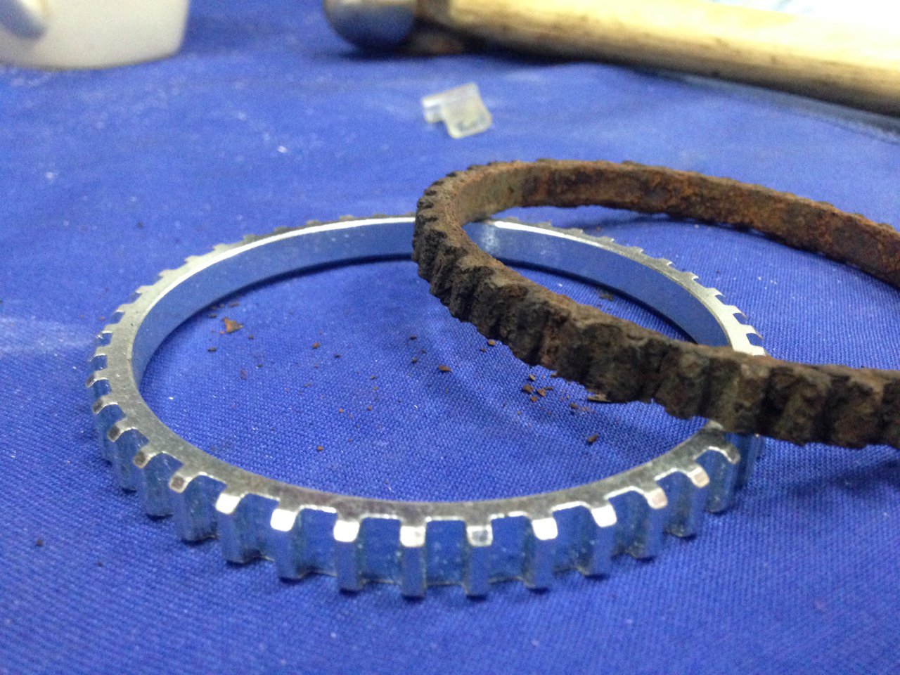

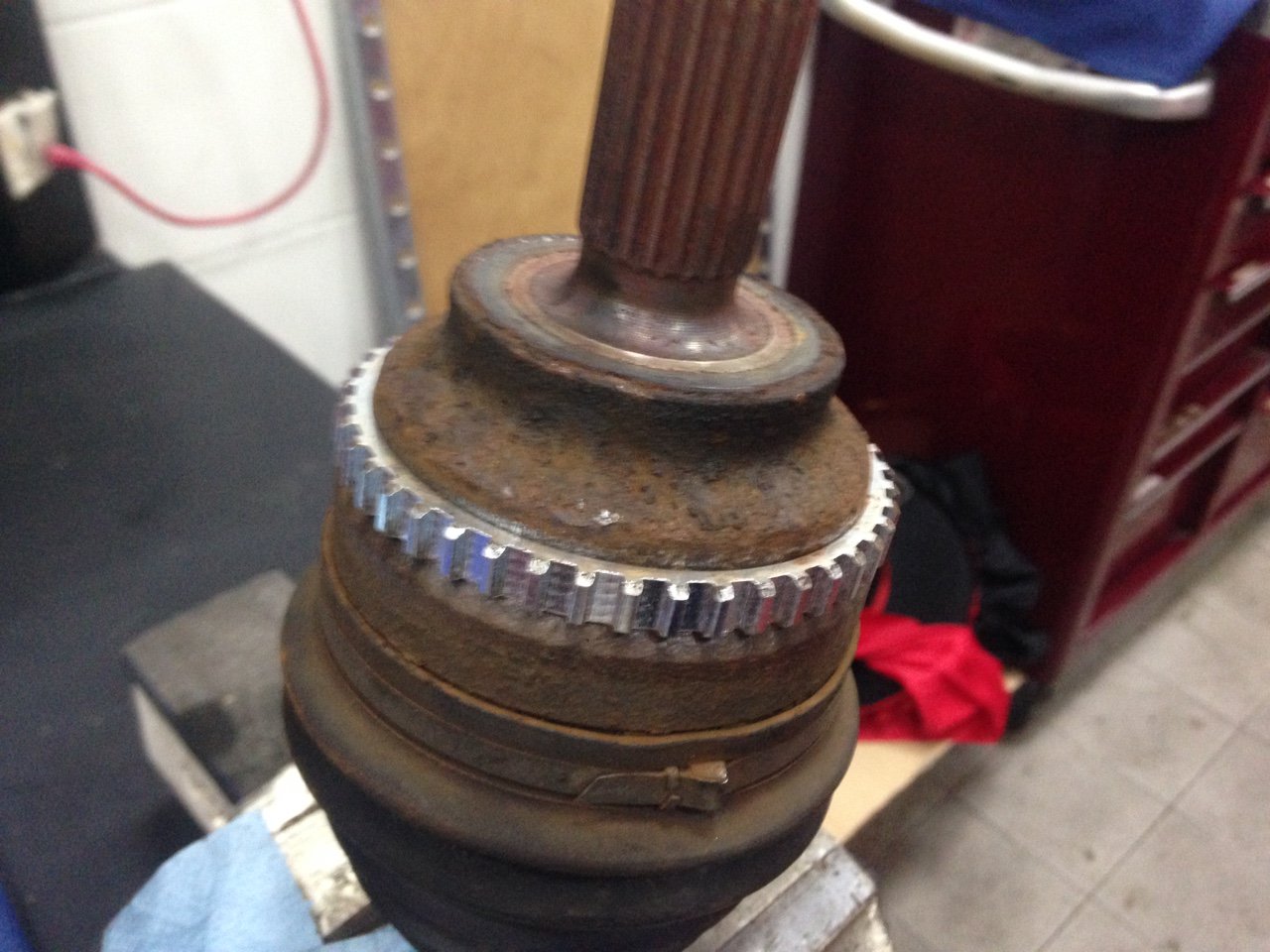

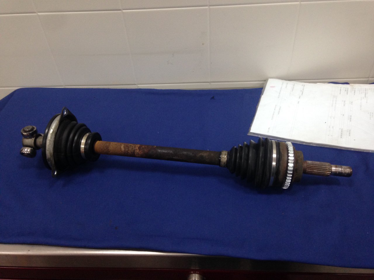

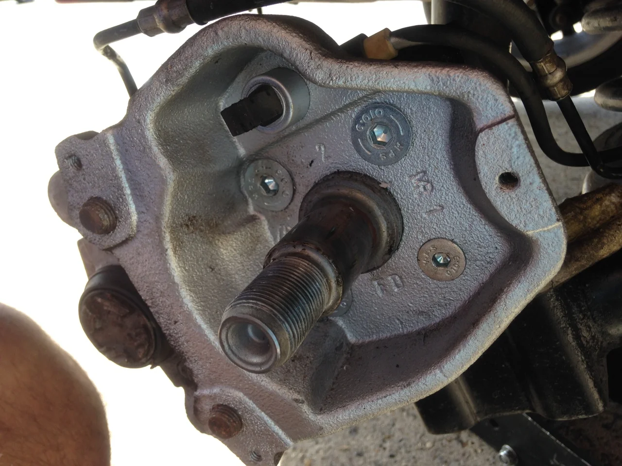

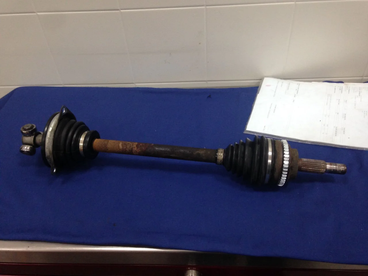

Speaking of driveshafts, today I finally managed to fix my ABS problem, which was the usual broken sensor ring; believe it or not it was one of the first parts I bought in September as soon as I acquired the car, and I've only got round doing the job today, yea.
While I was there I changed the gearbox oil which was the only service tasks left on my checklist.

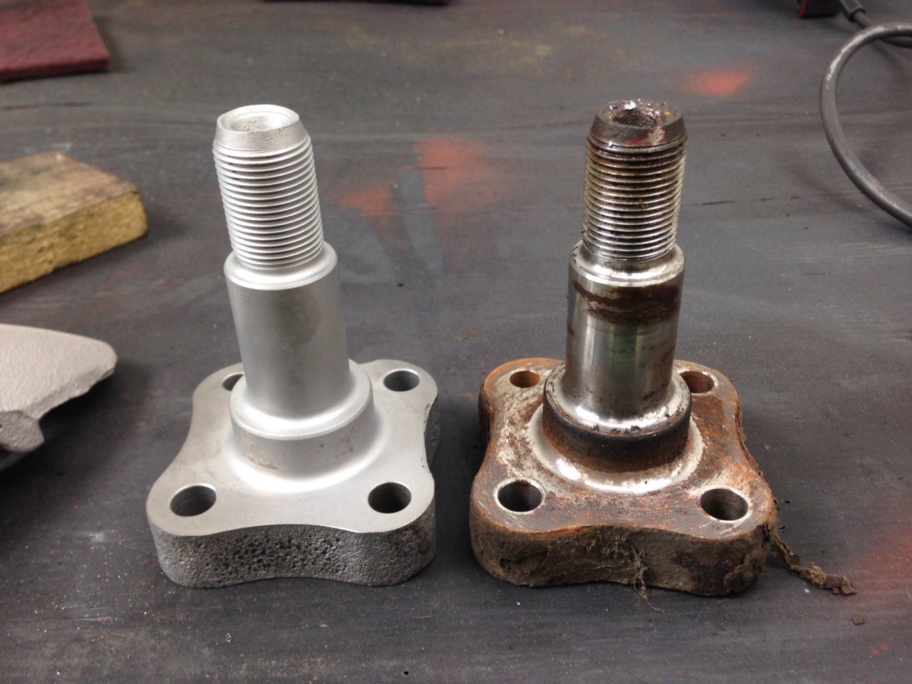

New ring vs old broken one

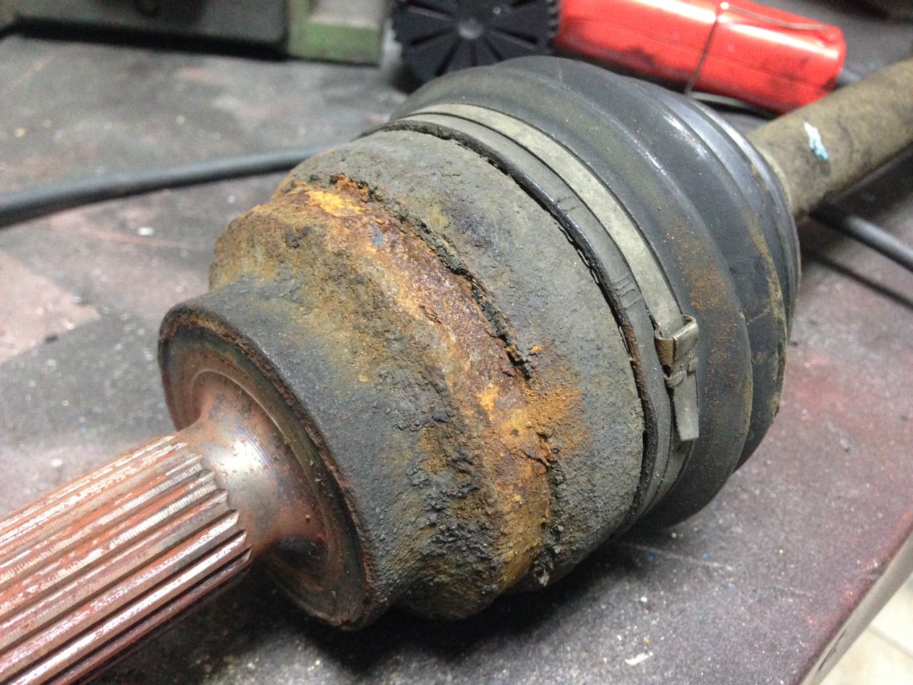

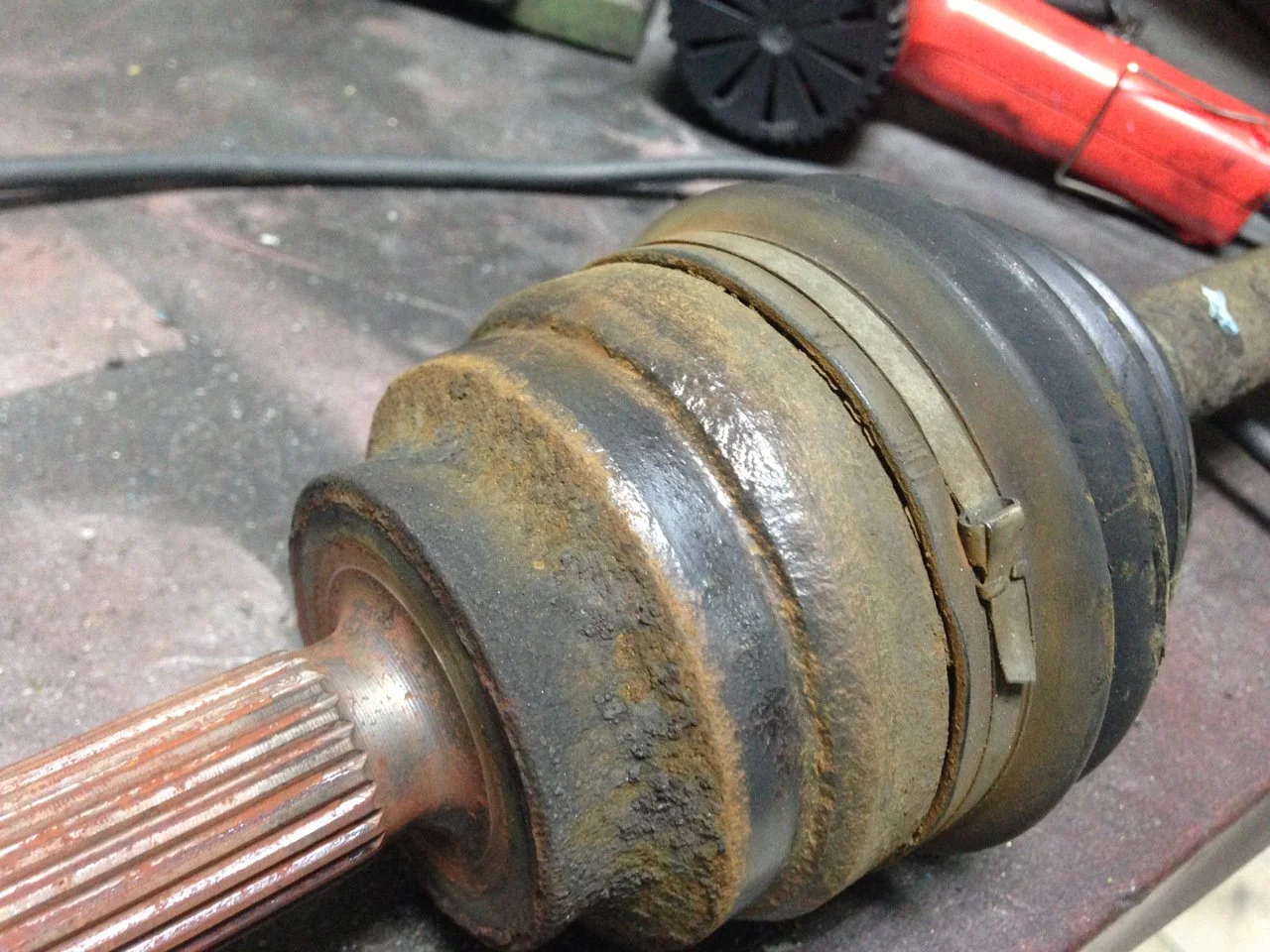

After removing the old ring the driveshaft looked pretty rusty and corroded, wire wheel time
New ring tapped in, some heat helped
The driveshaft deserved a good clean, looks like it had never been removed

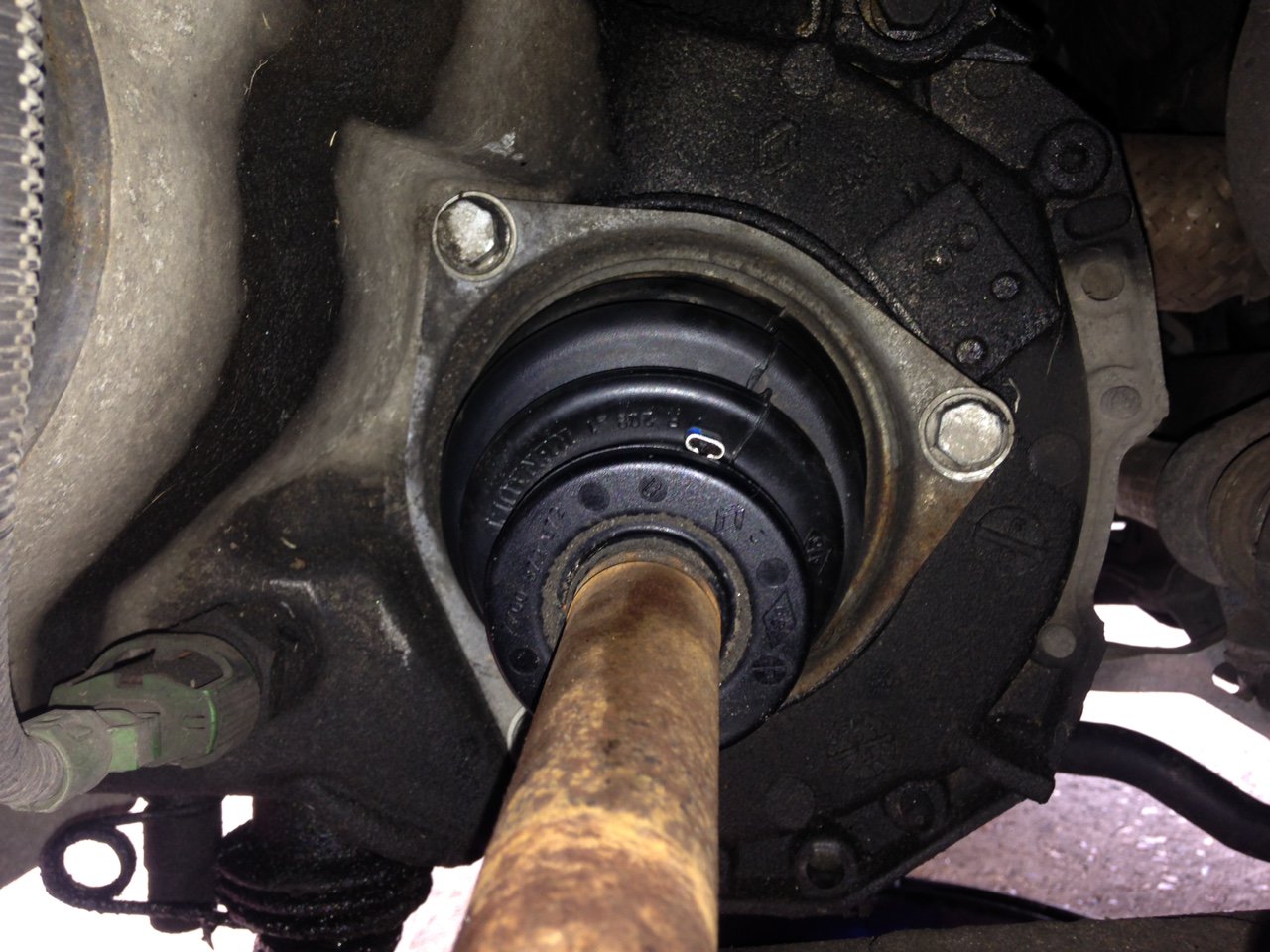

Then it was reassembling time and I had the chance of finally get a torque wrench so I could torque everything properly, these things are crucial specially on cars that cost less that £400 lol
25nm on these three

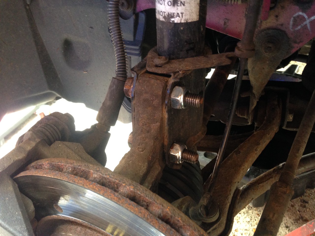

105nm and new nuts on the strut bolts, although I kept the original nuts but used new ones, we'll see if I get killed or these new ones will hold up.

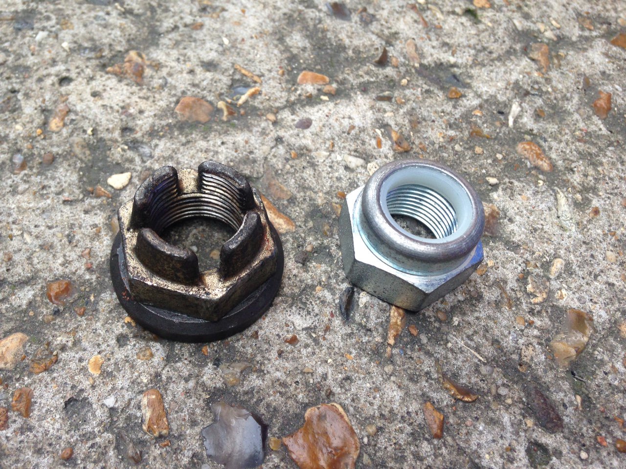

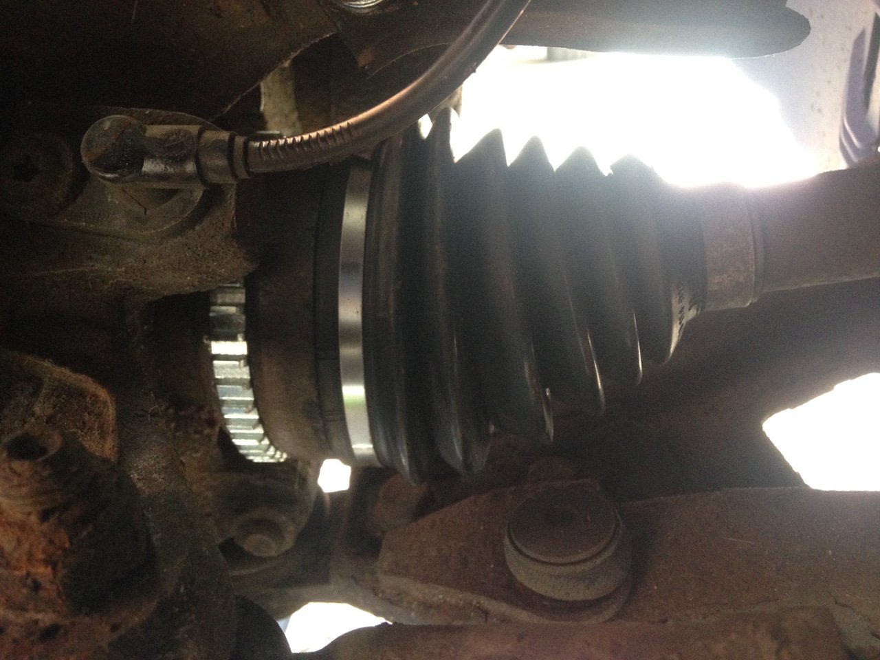

Then driveshaft nut. In this case I did not trust the new nyloc, I reused the old one, looks a lot tougher. 280nm
Happy looking cv joint

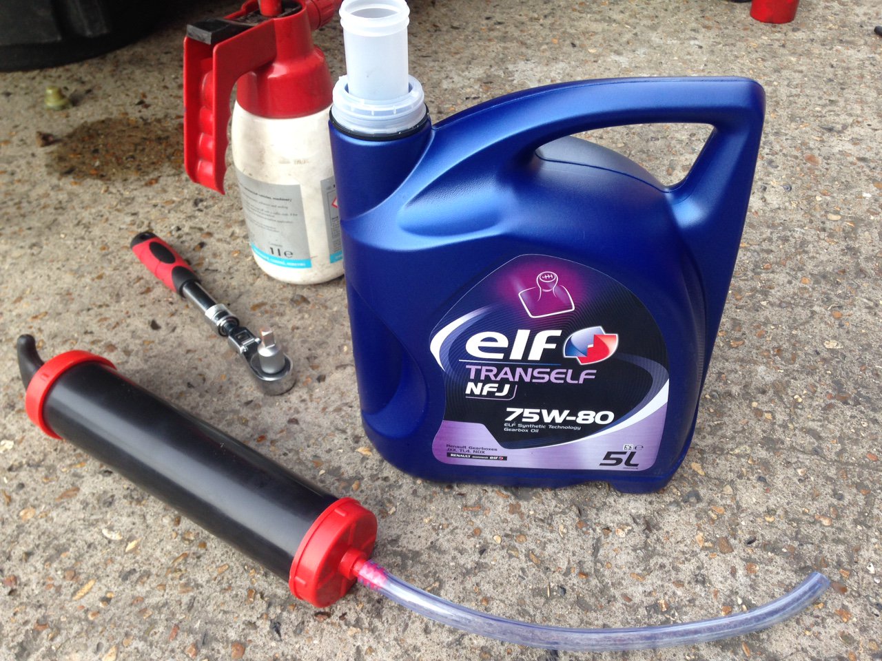

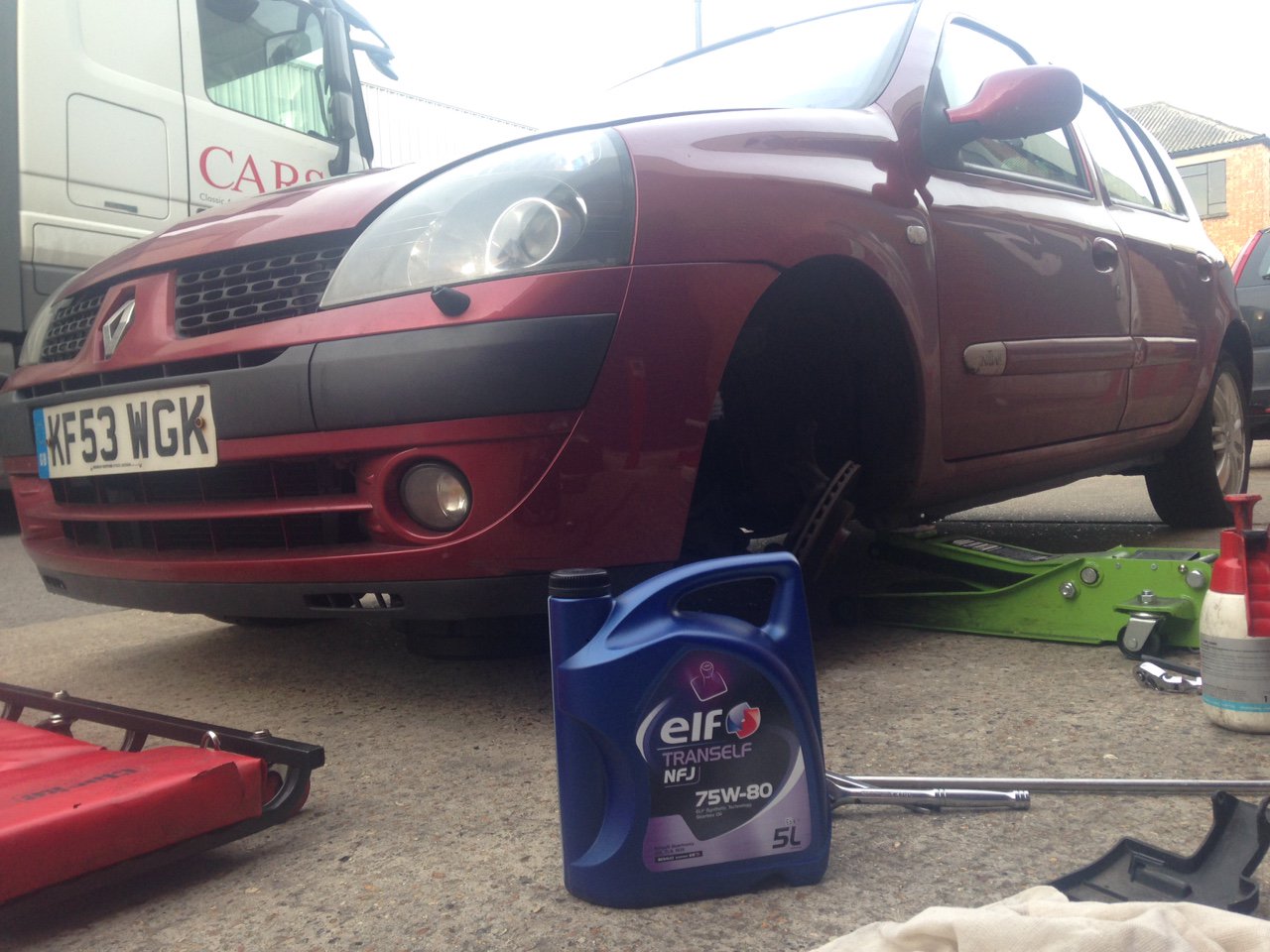

Then it was gearbox oil time, this is what I used, let me know if it's junk!

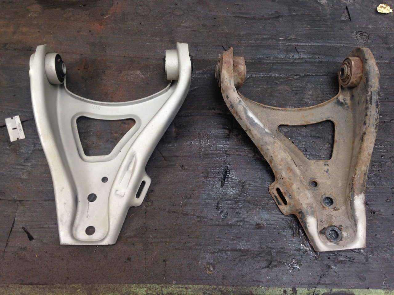

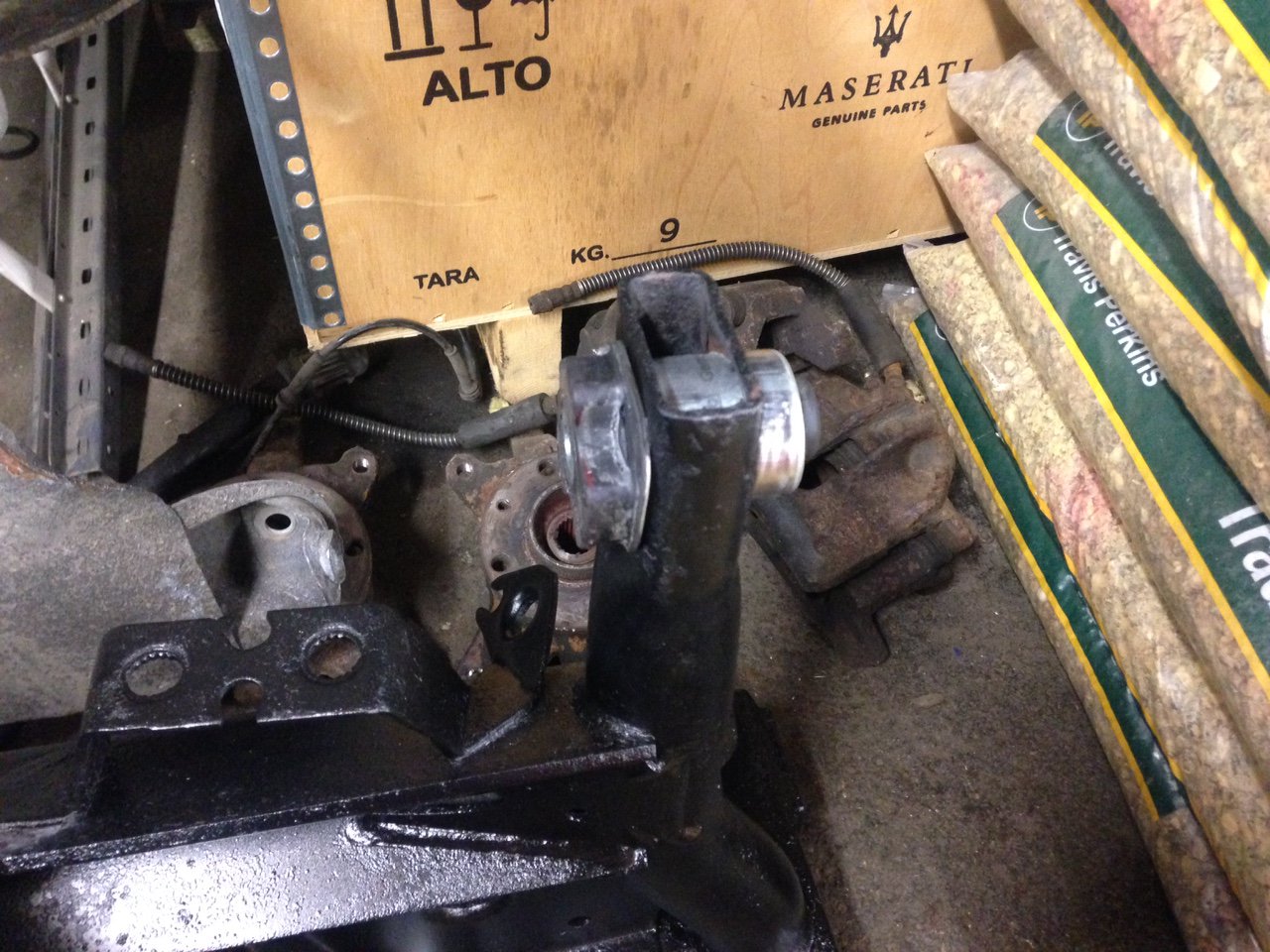

I didn't do a whole lot on the bits I acquired last week, the stuff is very corroded so I'm just doing a little bit of aqua blasting during lunch time every day, so far the rear caliper mounts look like this
The axle got new bushings although I'm not convinced on how they fit.

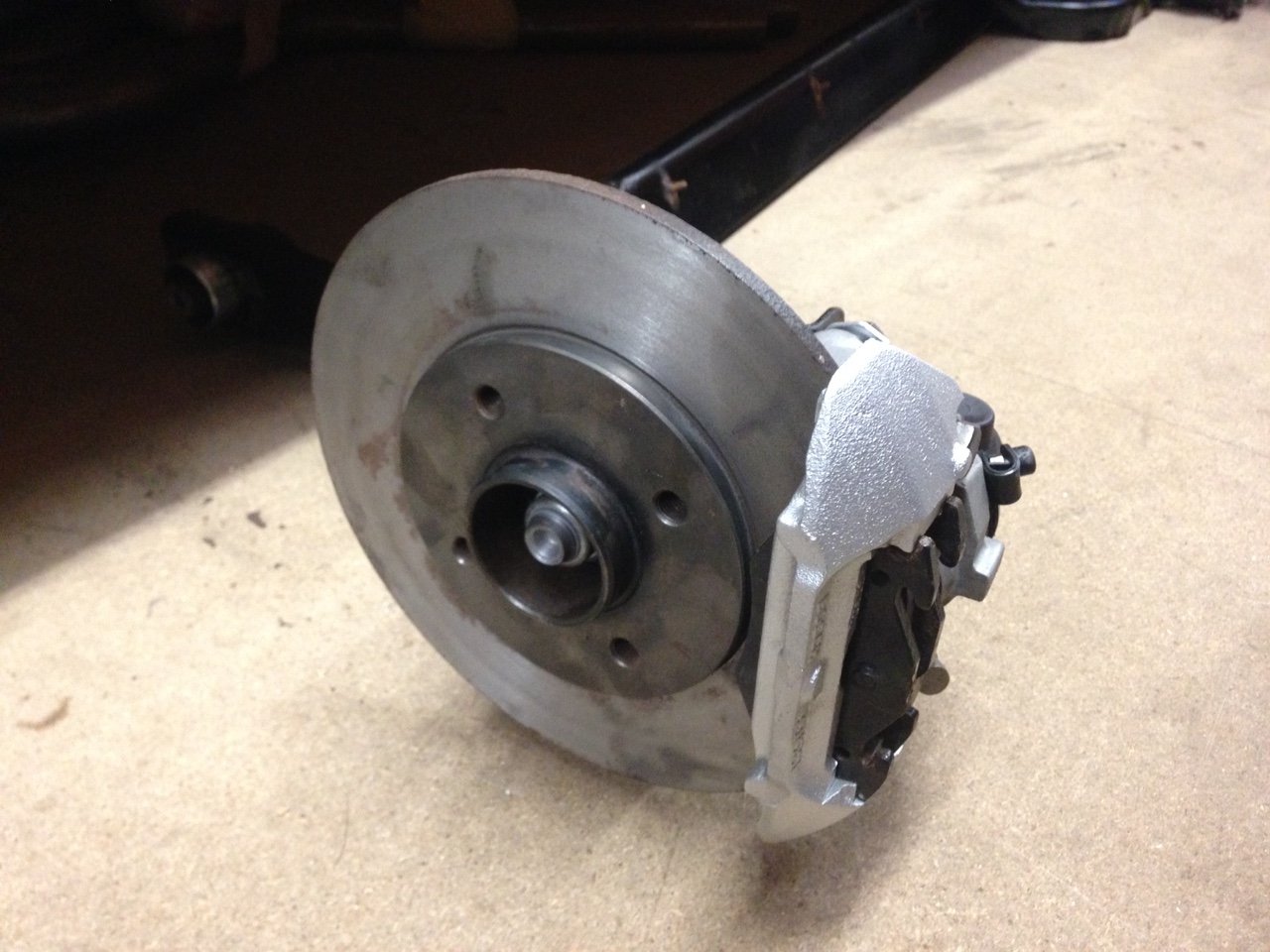

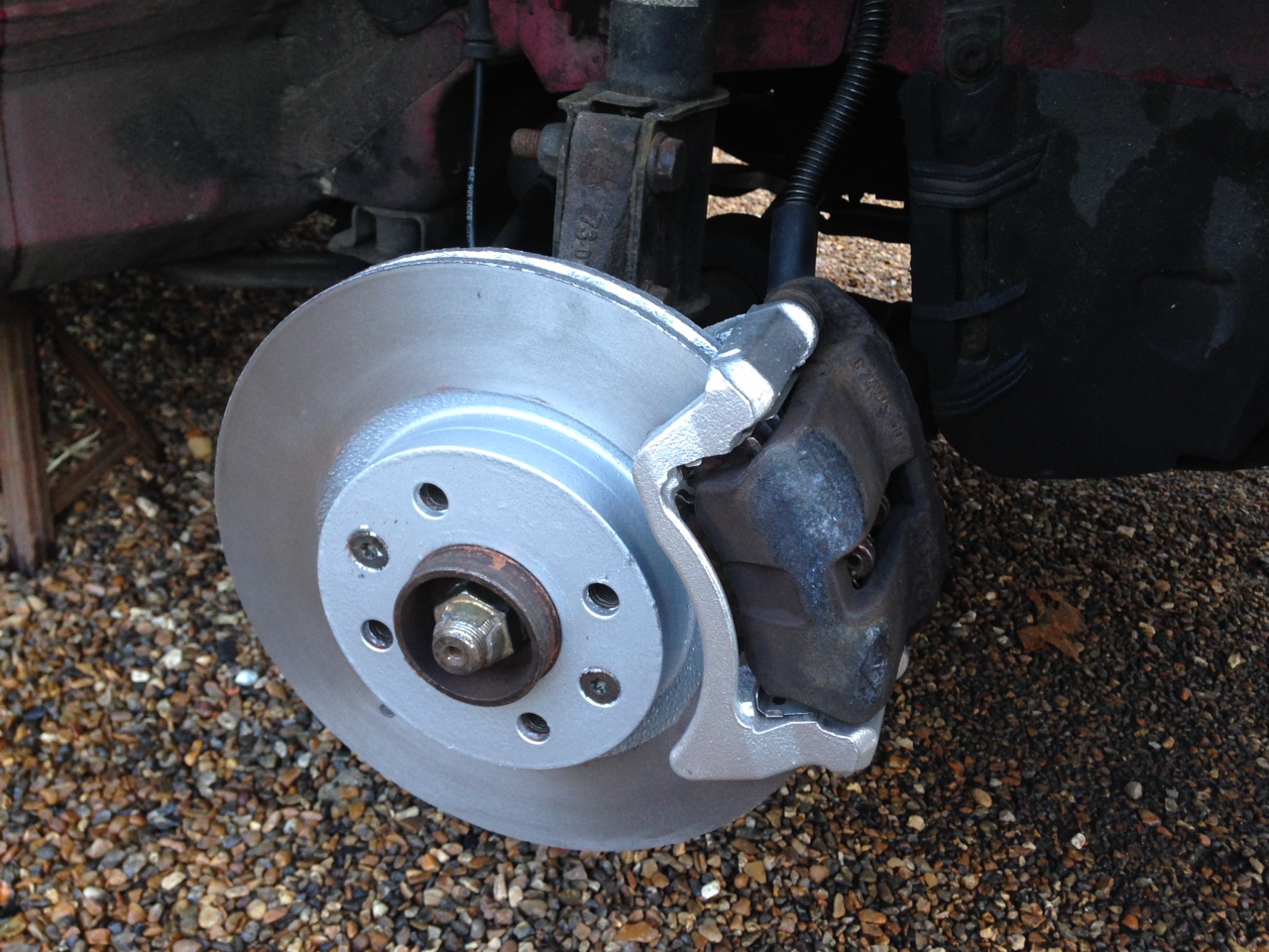

And these are the machines rear discs with painted calipers

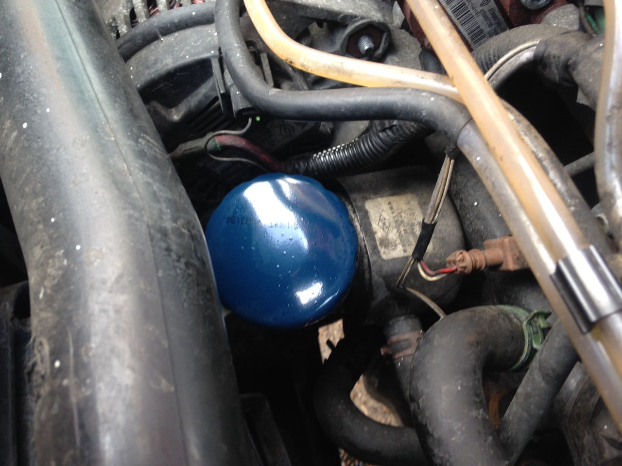

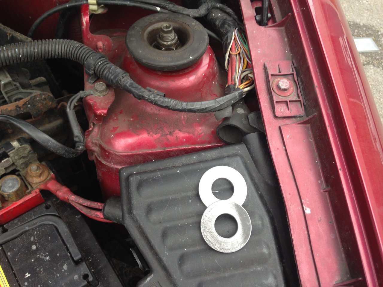

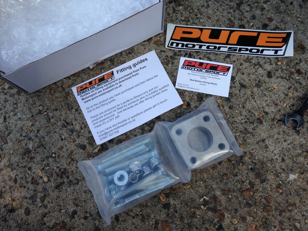

First on the list was a replica of those washers that I've seen on sale on eBay. They claim to reduce top mount play and by looking at them I've always been doubtful.
Well, I'm either stupid but you tell me what this is supposed to do. Anyway, we made it following instructions and using measurements found on this forum, I think in doing it wrong, any thoughts ??

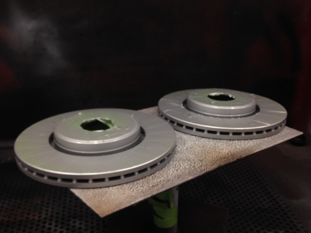

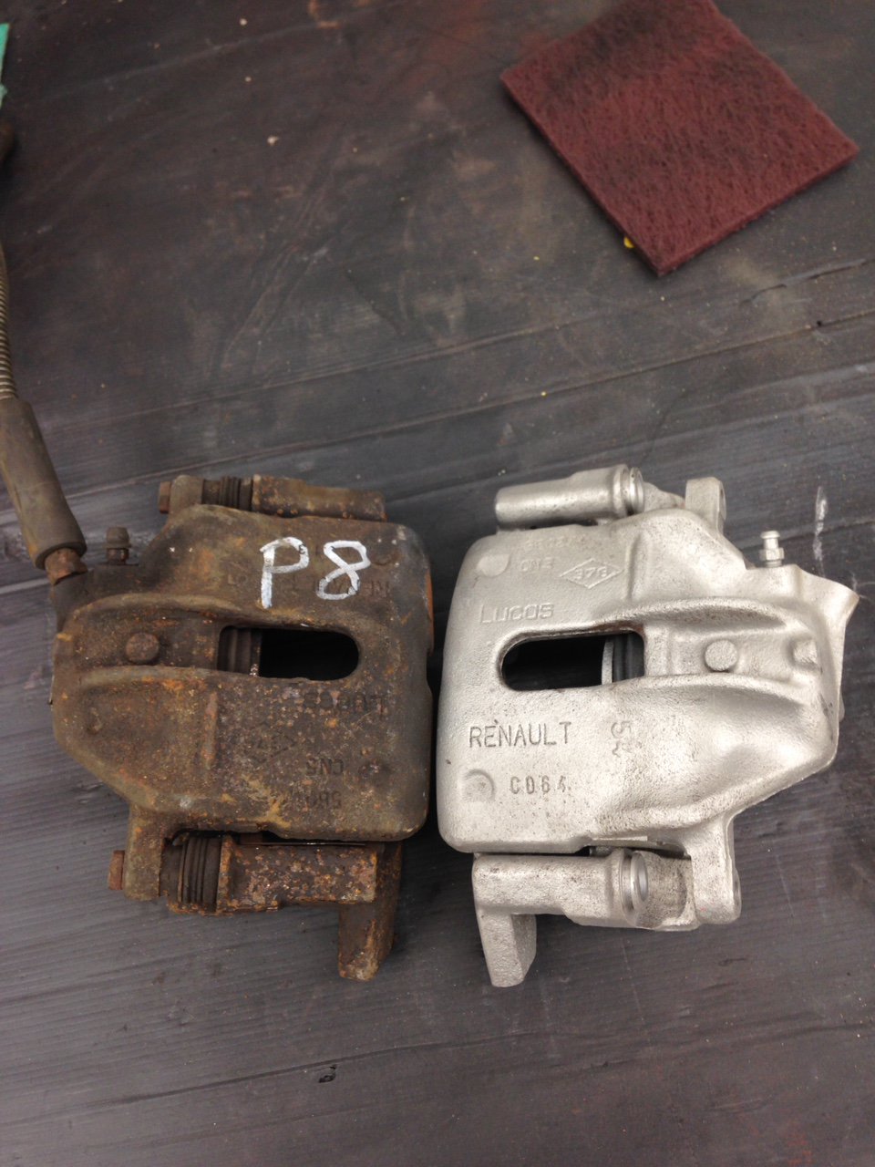

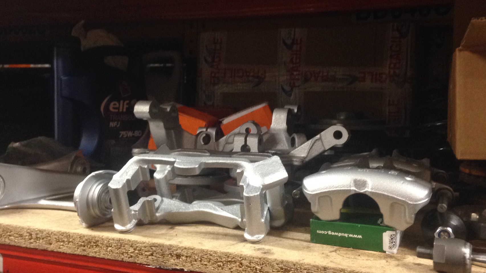

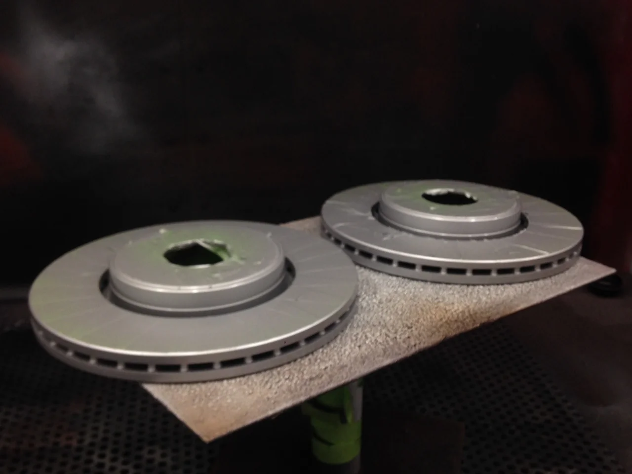

Then a little update on the sport stuff: these are the rear calipers after sand blasting, you can see the difference. I've got a rebuild kit for each one:

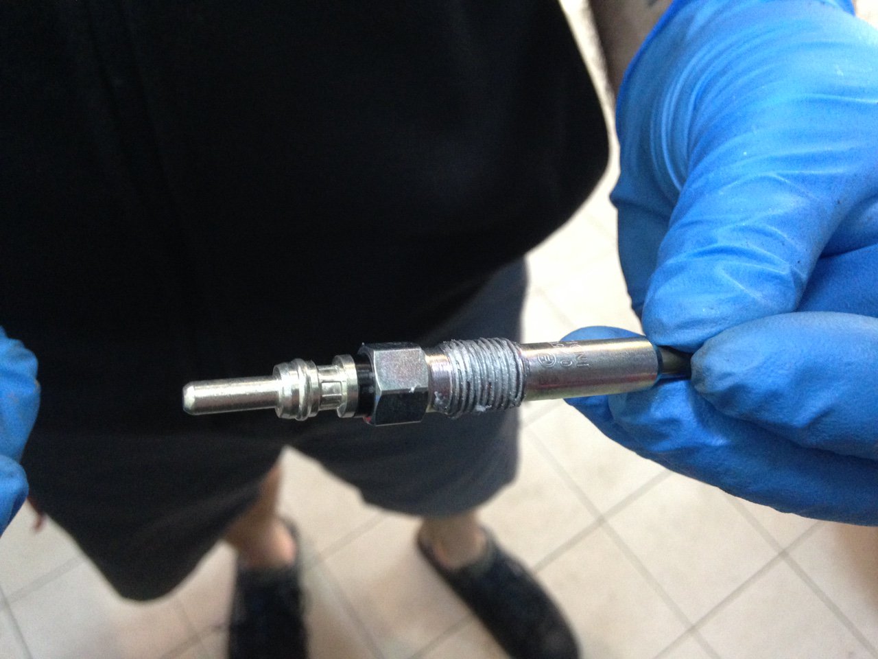

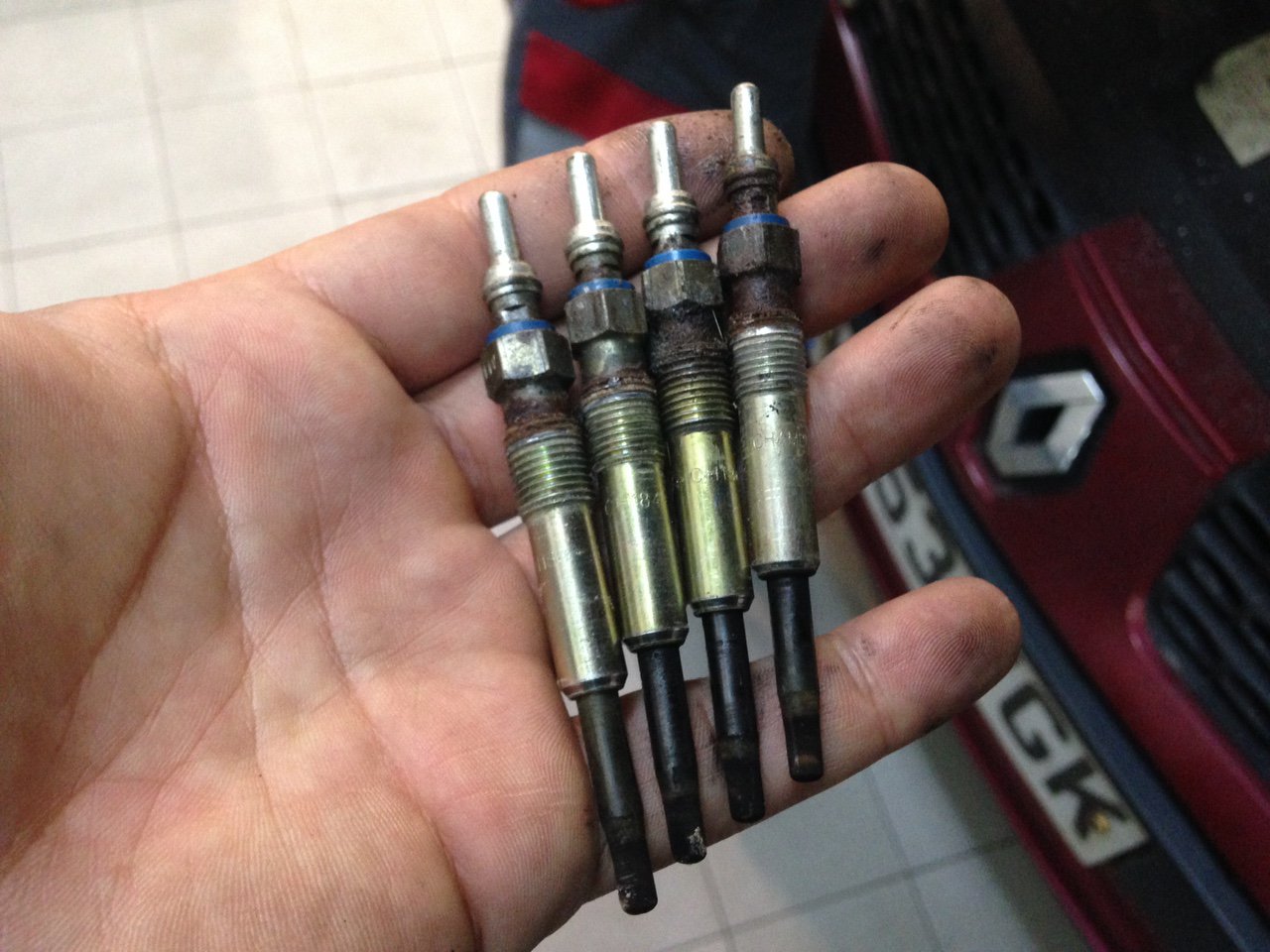

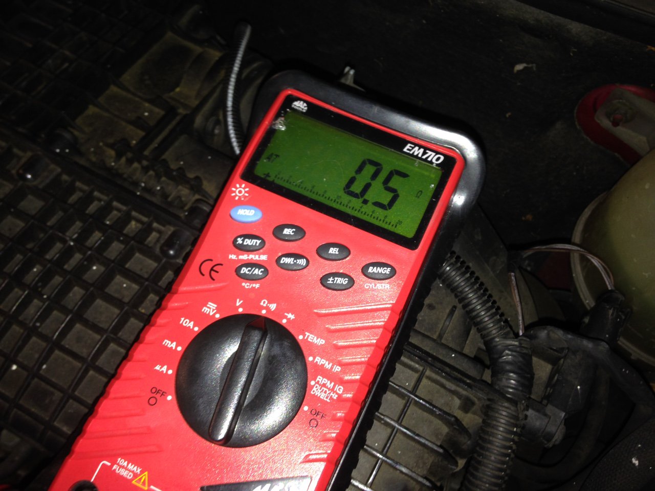

I then tried to fight a cold start problem by fitting brand new Bosch glow plugs found on eBay at £24!!
Two of the old ones were found completely dead and only one of the left ones gave an understandable resistance reading.
New ones in and tested, all good;
although the car still coughs when started after some hours of sitting, I've got almost no doubts now, one or more injectors are leaking internally. They're pricey to rebuild.

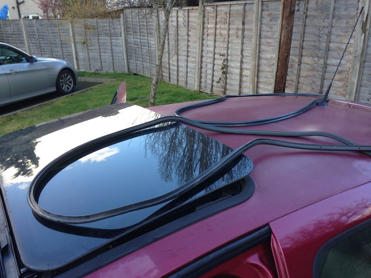

Next on the list was the sunroof glass seal that was causing an horrible rattling noise while driving on bumpy roads. Amazingly my sunroof doesn't leak (yet) so I haven't touched the commonly faulty frame seal, will do that when I'm painting the roof.

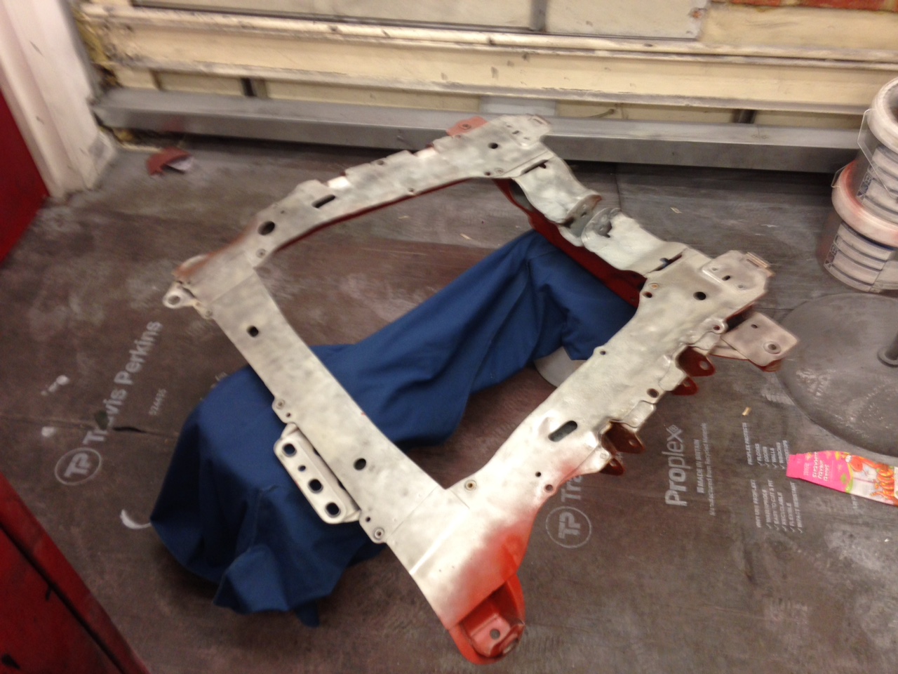

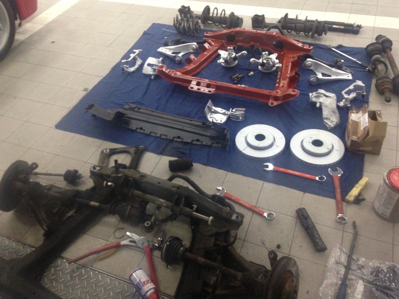

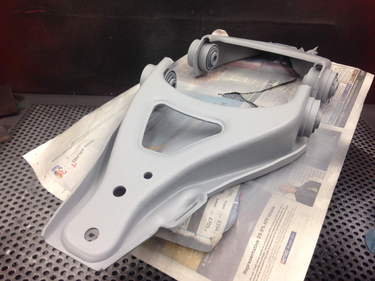

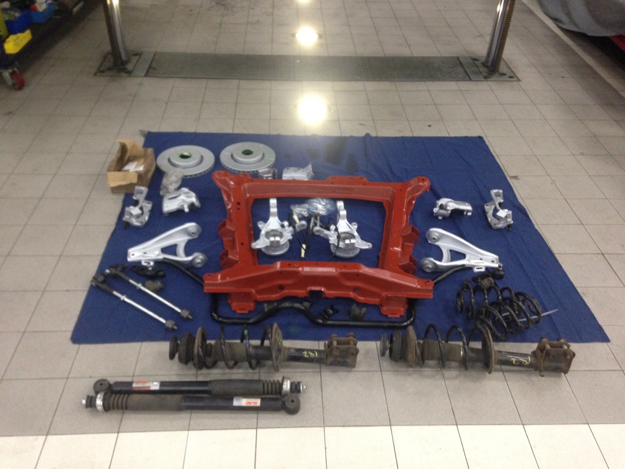

First of all, the progress on the widetrack conversion is slow but we are moving in the right direction. All I have left is to paint a couple of things and rebuild the rear calipers to finish off the axle. When that goes on I'll concentrate on the front.
A couple of shots of sandblasted stuff that I always like..

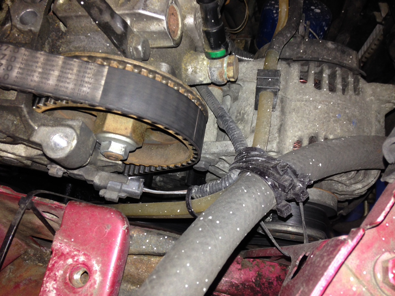

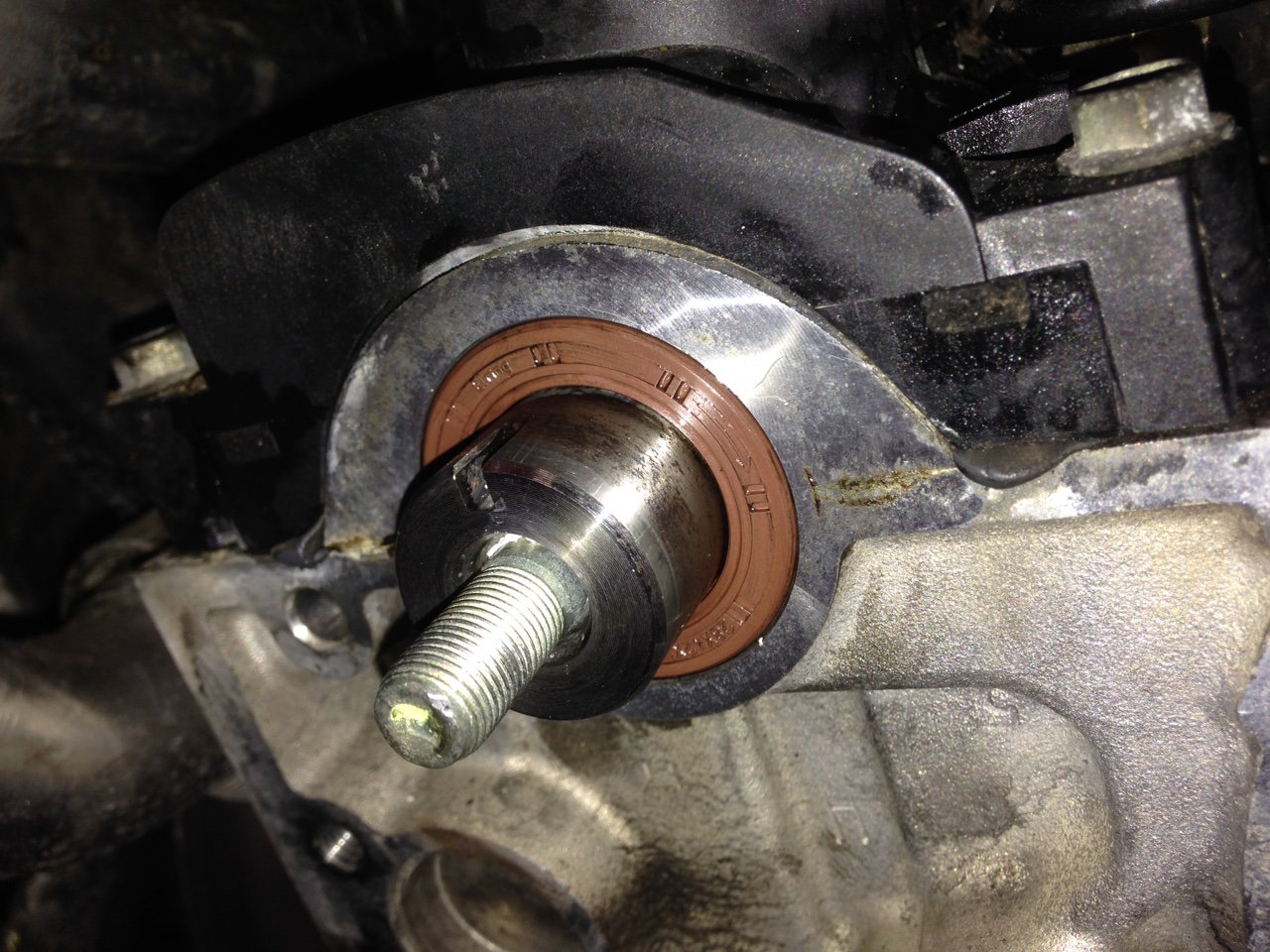

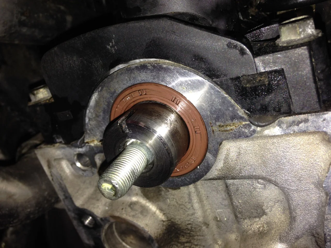

I finally got round doing the timing belt again so that I could fit the lower timing cover, without which none of the other two can be clipped on. I also took the chance to replace the cam seal which I found leaking while doing the job the first time back in September.
This is how the timing side has looked for the past 7 months

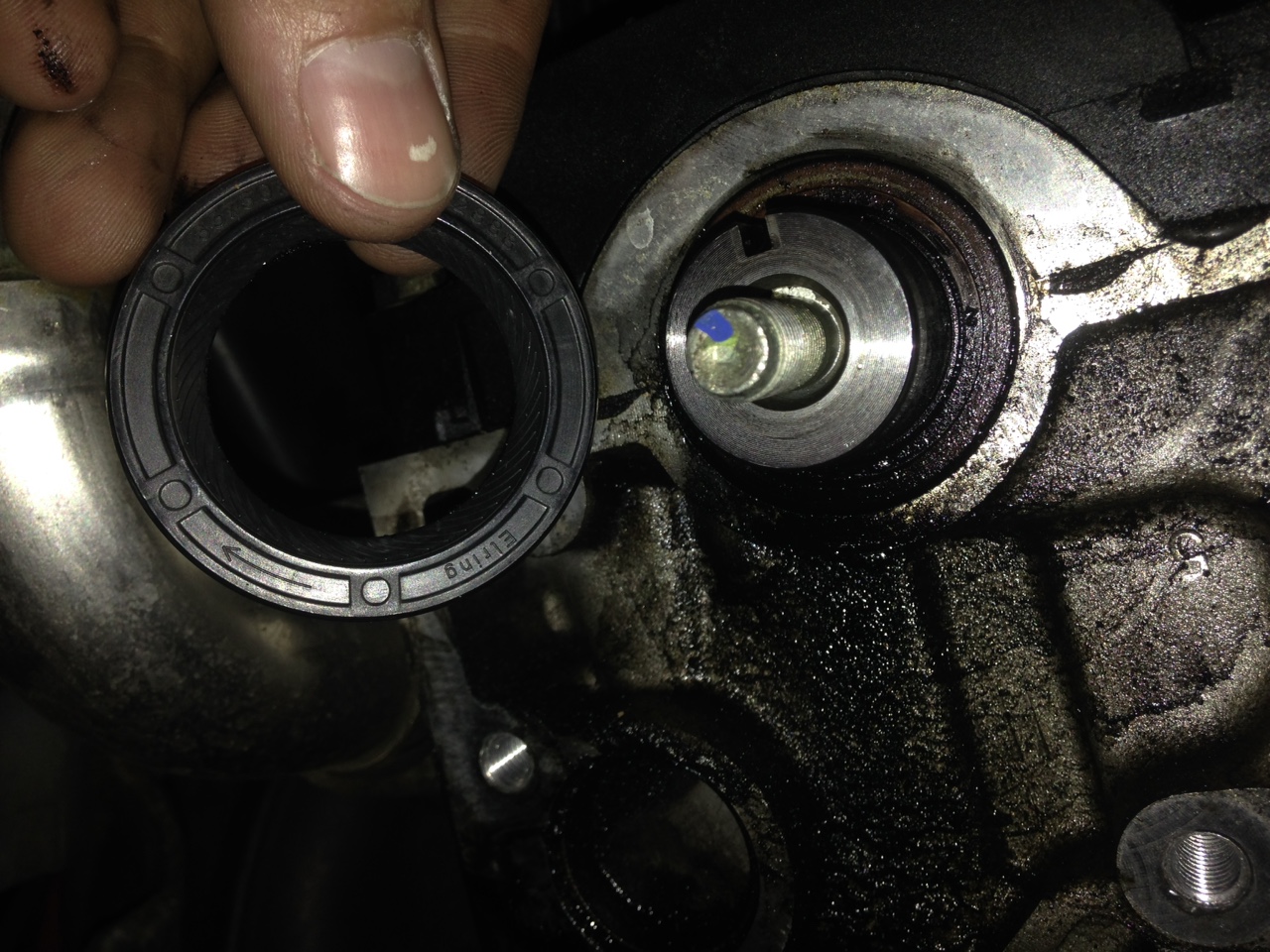

And this is me realizing the seal from GSF was the wrong one.
The manual did specify that there are two different seals around, I felt lucky, I wasn't.
Quick run to ECP that had the right one in stock, on it goes, looking lovely and hopefully dry!!
Job done again and engine bay looking less pikeyish.

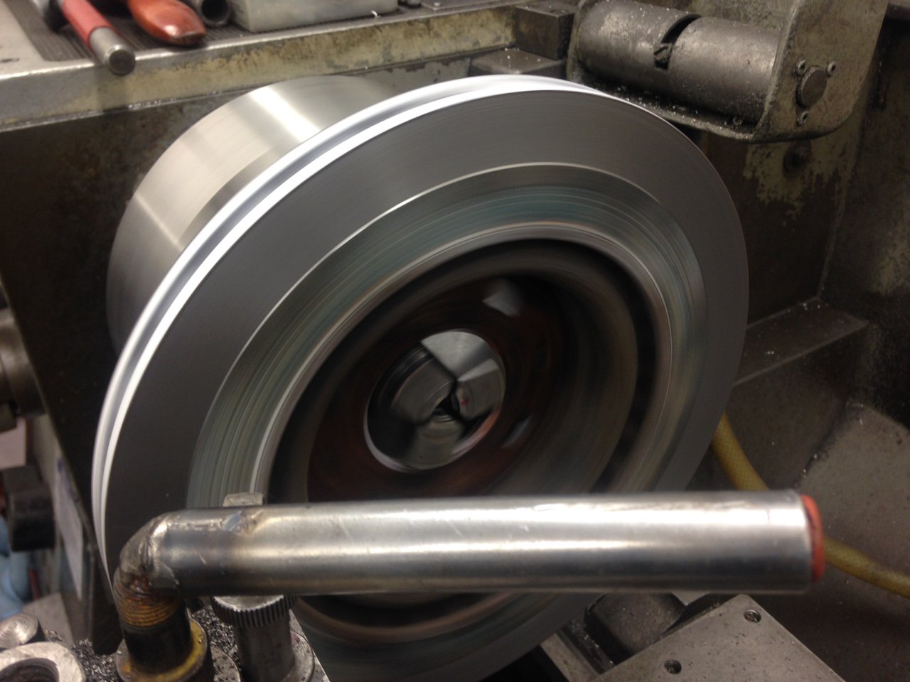

Time for a big fail which was me trying to fix a little brake judder with the old lathe technic that, as we know, is the wrong one.
Discs off, a quick skim (the machinist ensured me they were on straight and true, yea right..)

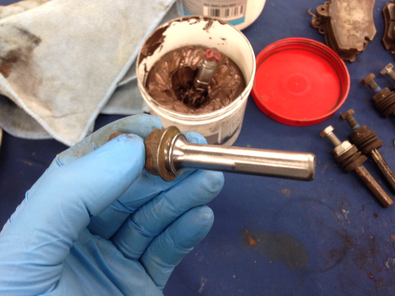

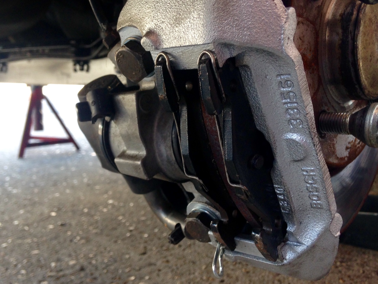

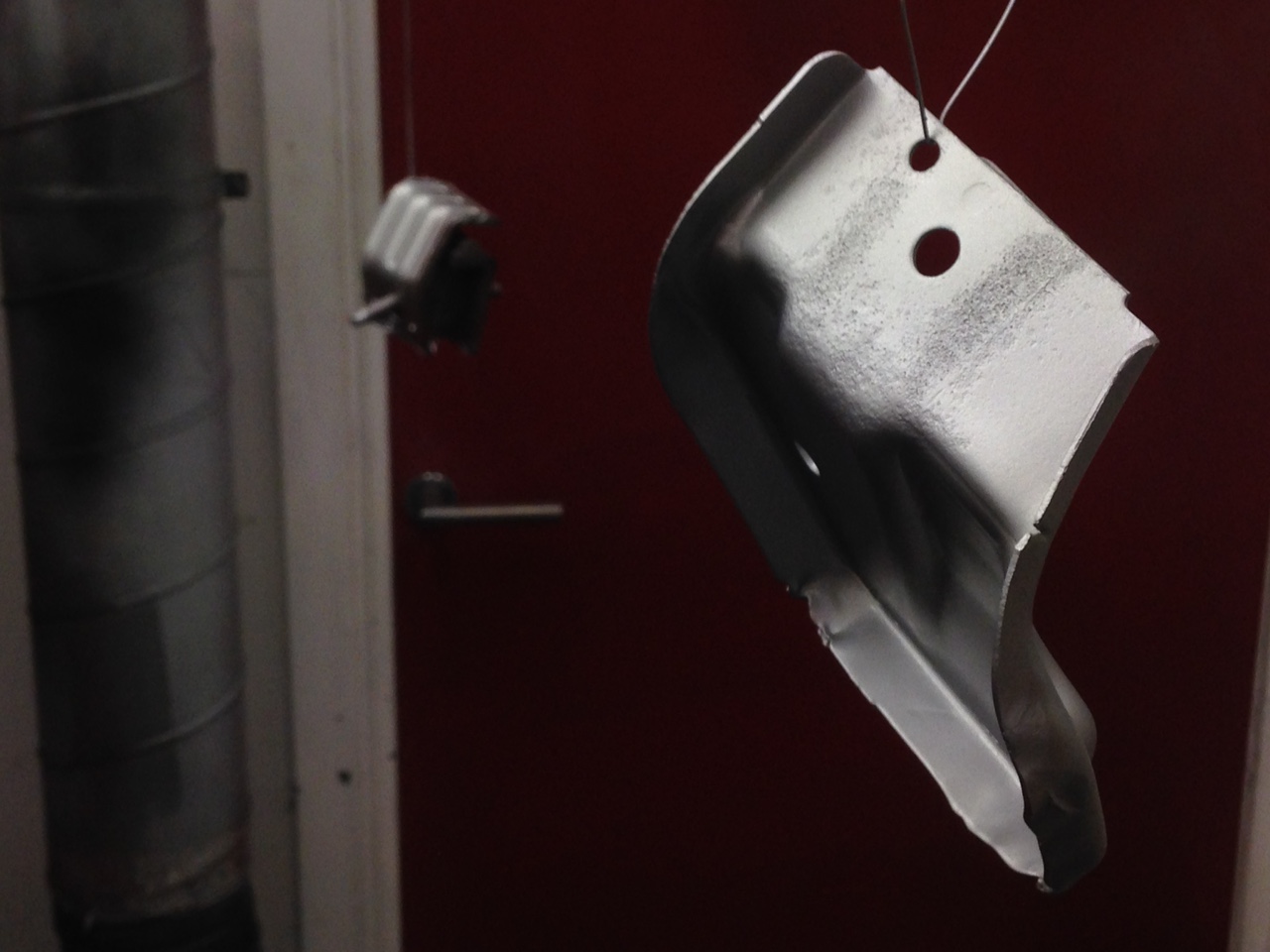

I then sanded the pads again and sandblasted and painted the carriers. Two of the pin boots needed replacing, got some spares off the 182 calipers, a little lube and back on.
They may as well be bent 90 degrees, the worst machine job ever. I blame myself for trusting the wrong people with the wrong tools.
Trip to ECP again, Easter sale on meant discs were only 25£, I later got new pads too. What a waste of money, lesson learned.

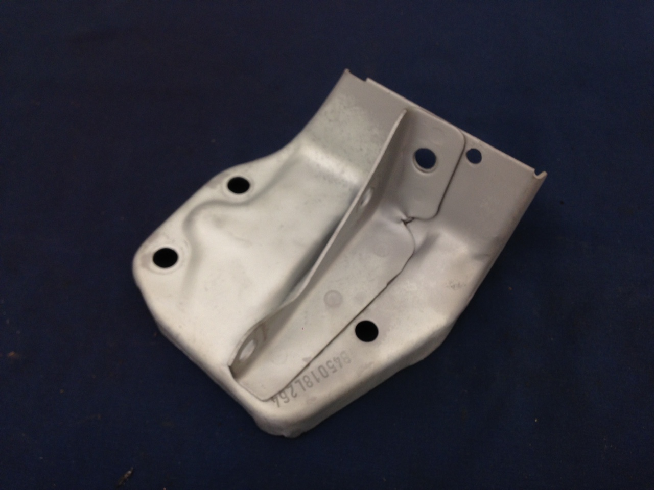

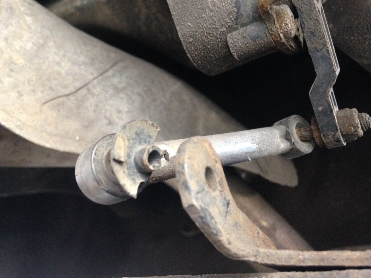

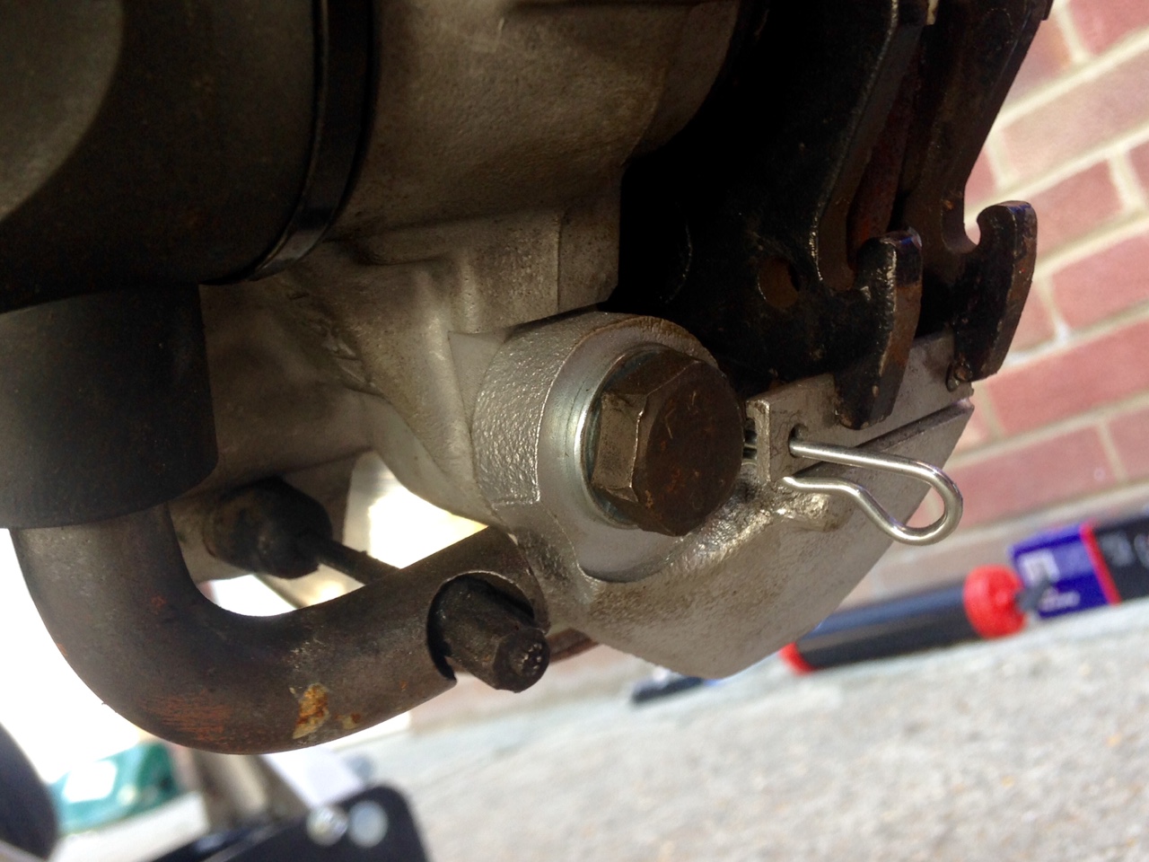

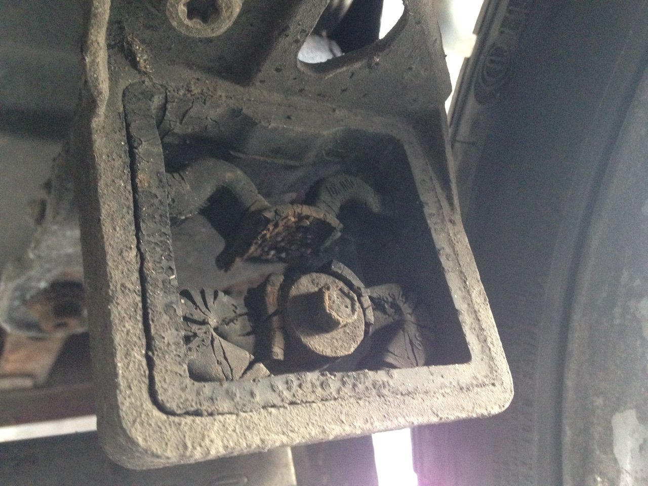

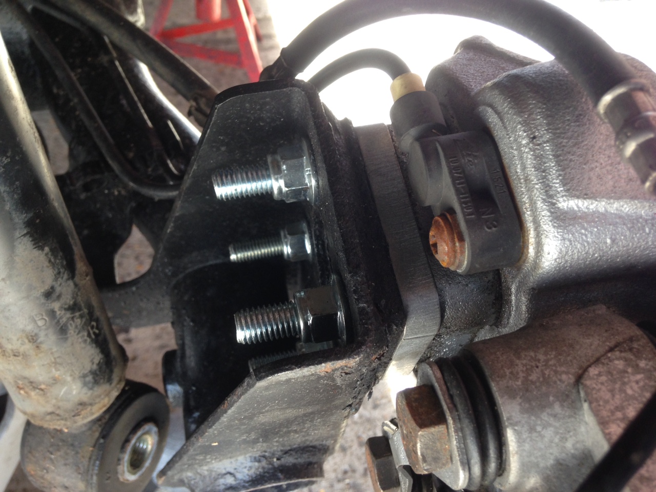

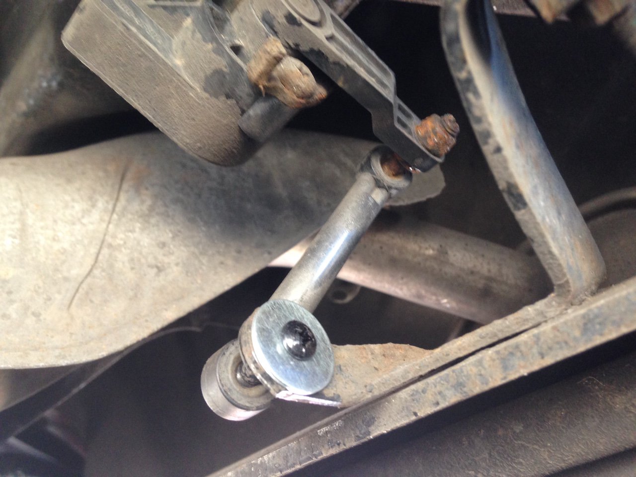

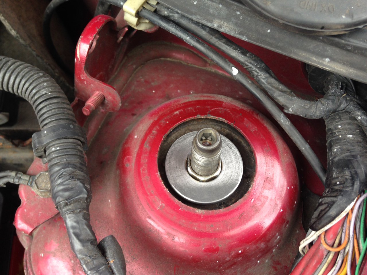

First: while crawling underneath to check my abs connectors, I stumbled across two things.
Number 1:
This saw me going instantly on eBay to check how expensive these sensor are.. very, it turns out!
Scrap that, self tapper, big washer and loctite.. we'll see how long it lasts, I'm also expecting the system to work now, can't wait for the evening to come !
Number 2:
I've ordered a genuine new one, £17.

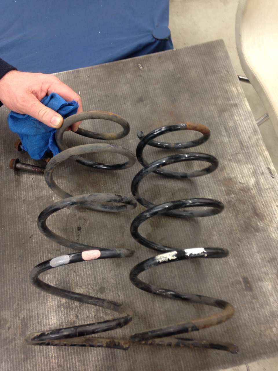

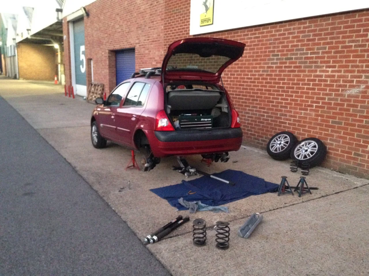

Then, another spring swap. In this season makes sense.
I gave new life to the spring I took off some months ago as I was still having ride height issues. I learned today that springs have a colored stamp on them that will let you work out how hard or long they are. That led me to believe that there is more than one option for springs on the Clio, and that somebody in the past must have swapped a broken one with one the wrong type.
Oh well, it all looks leveled and normal now, 4 fingers in both front wheel arches (that'll change soon)

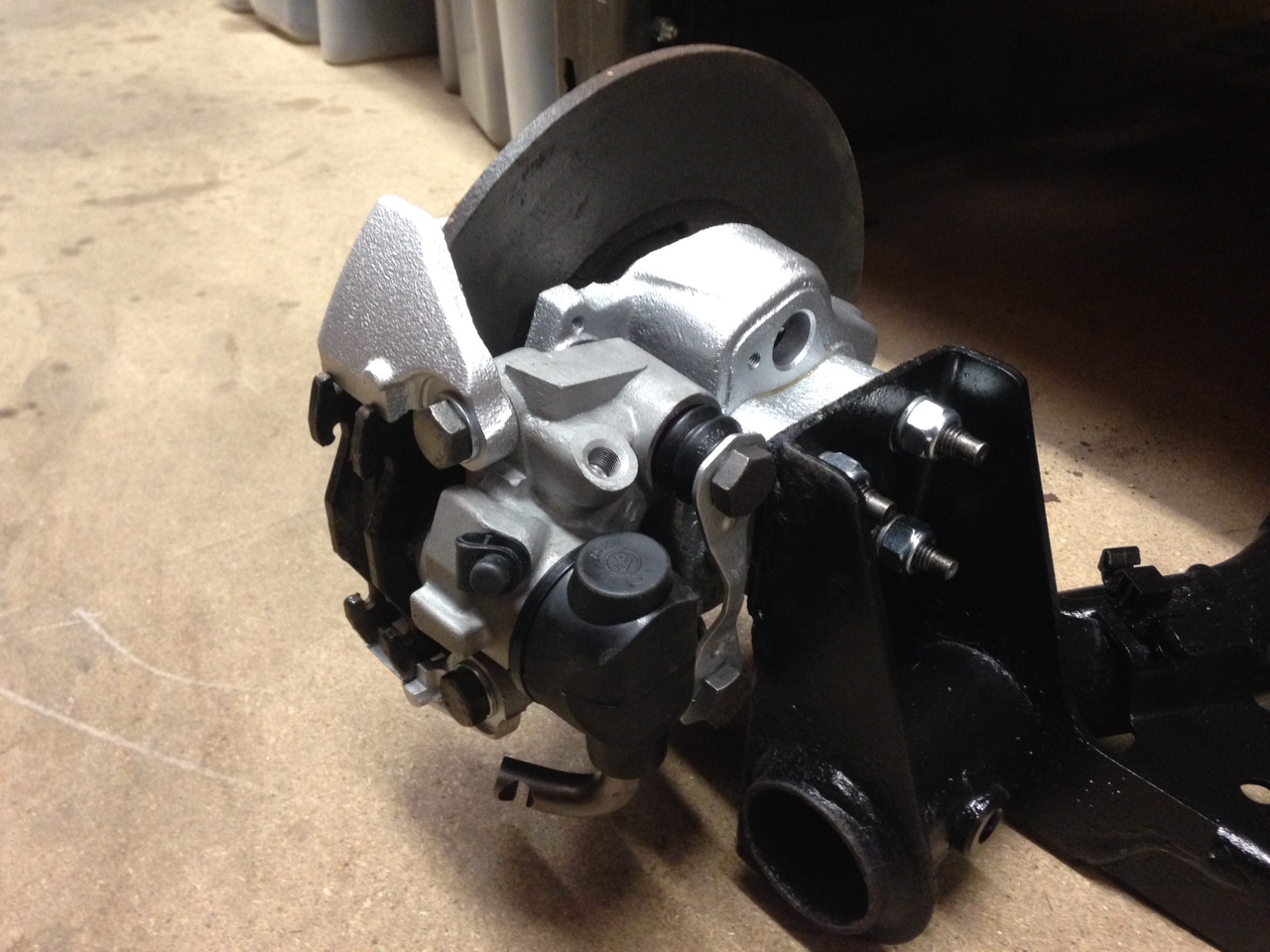

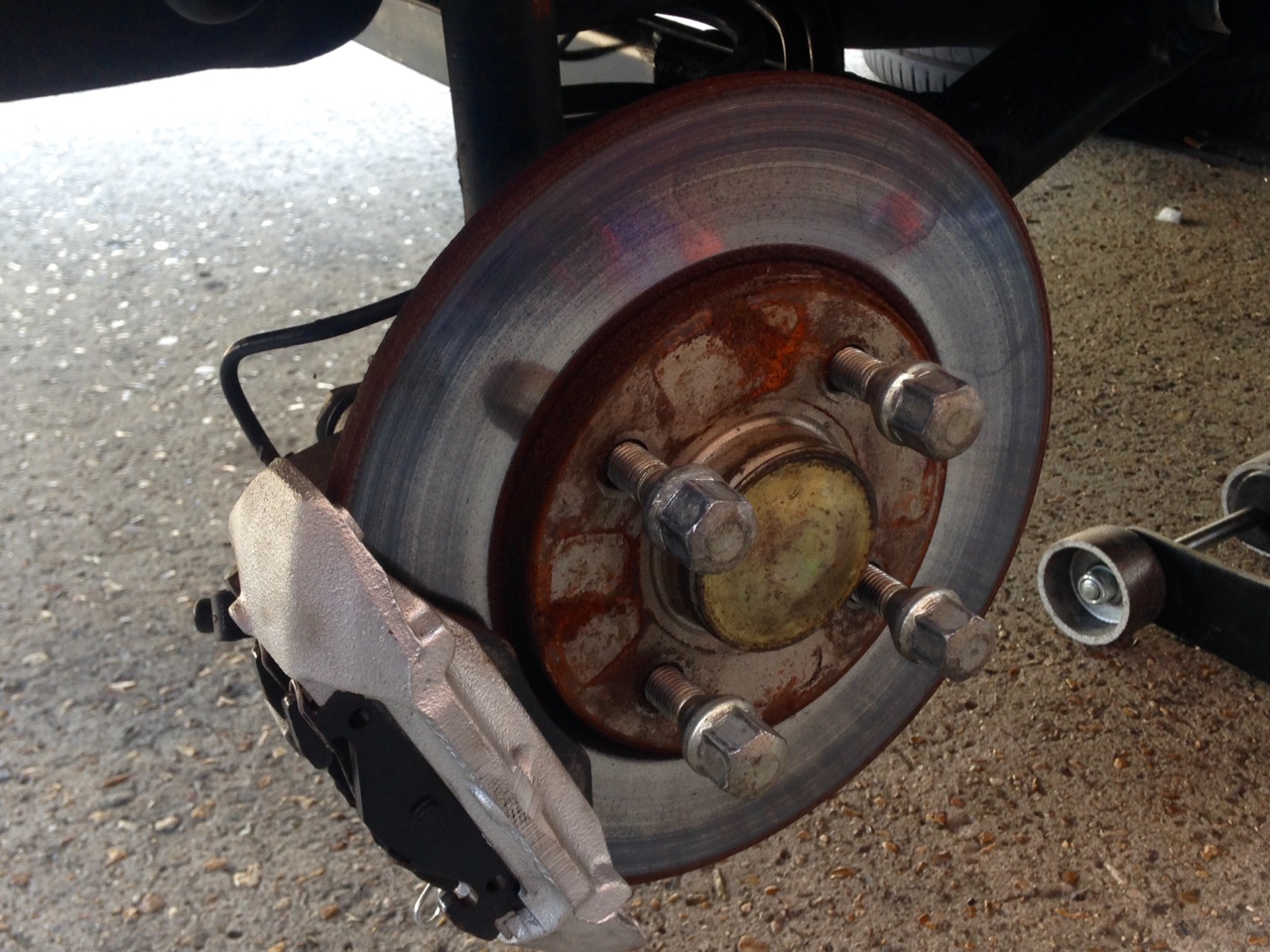

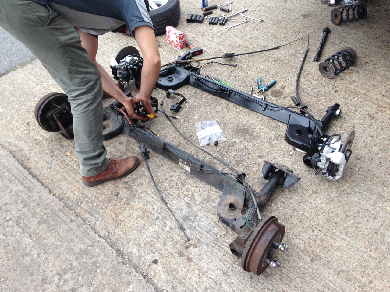

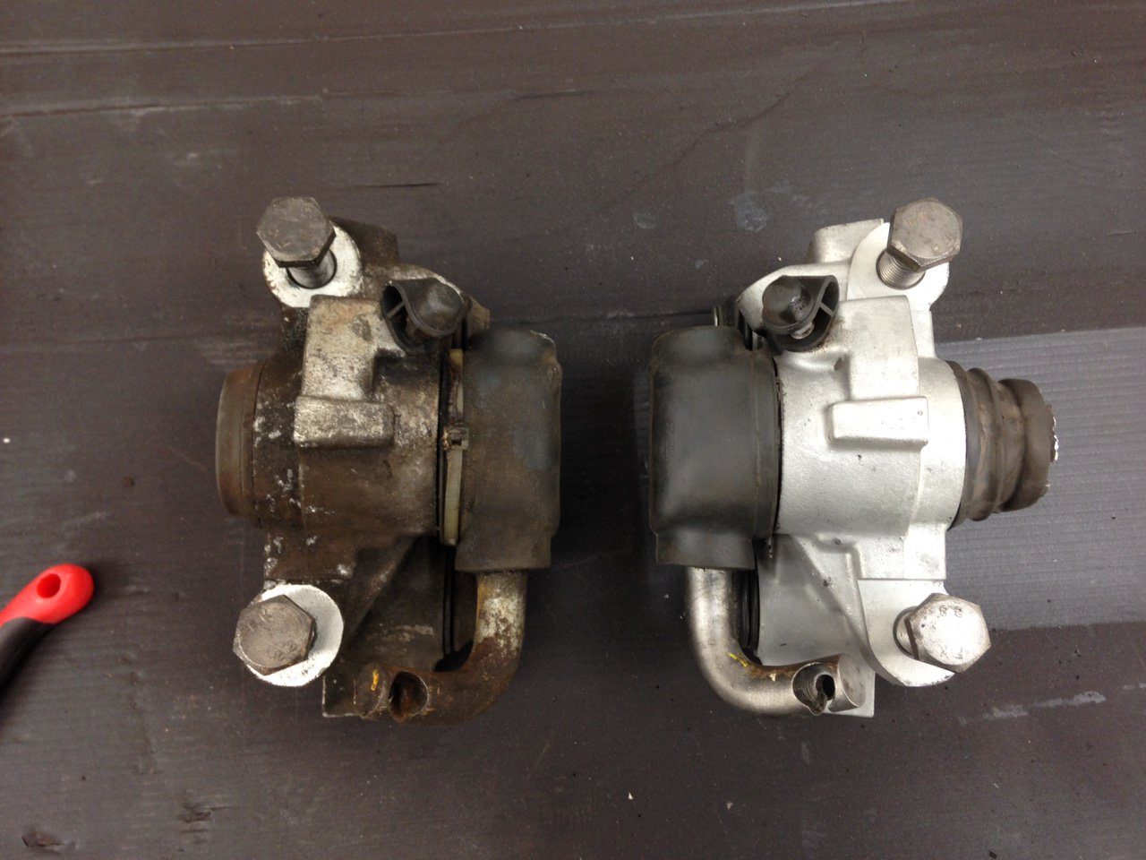

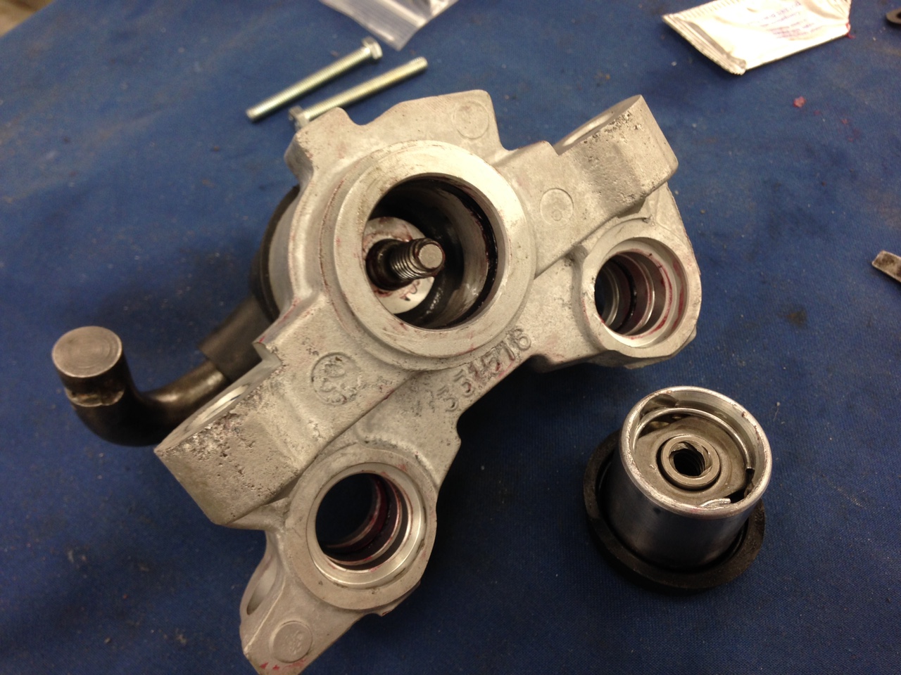

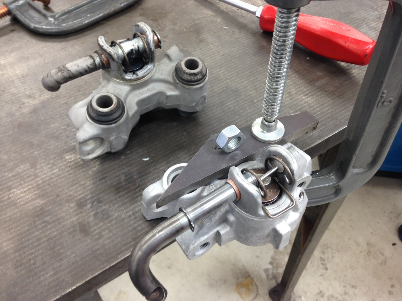

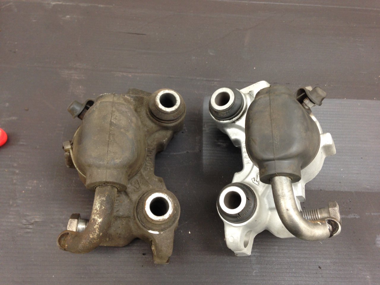

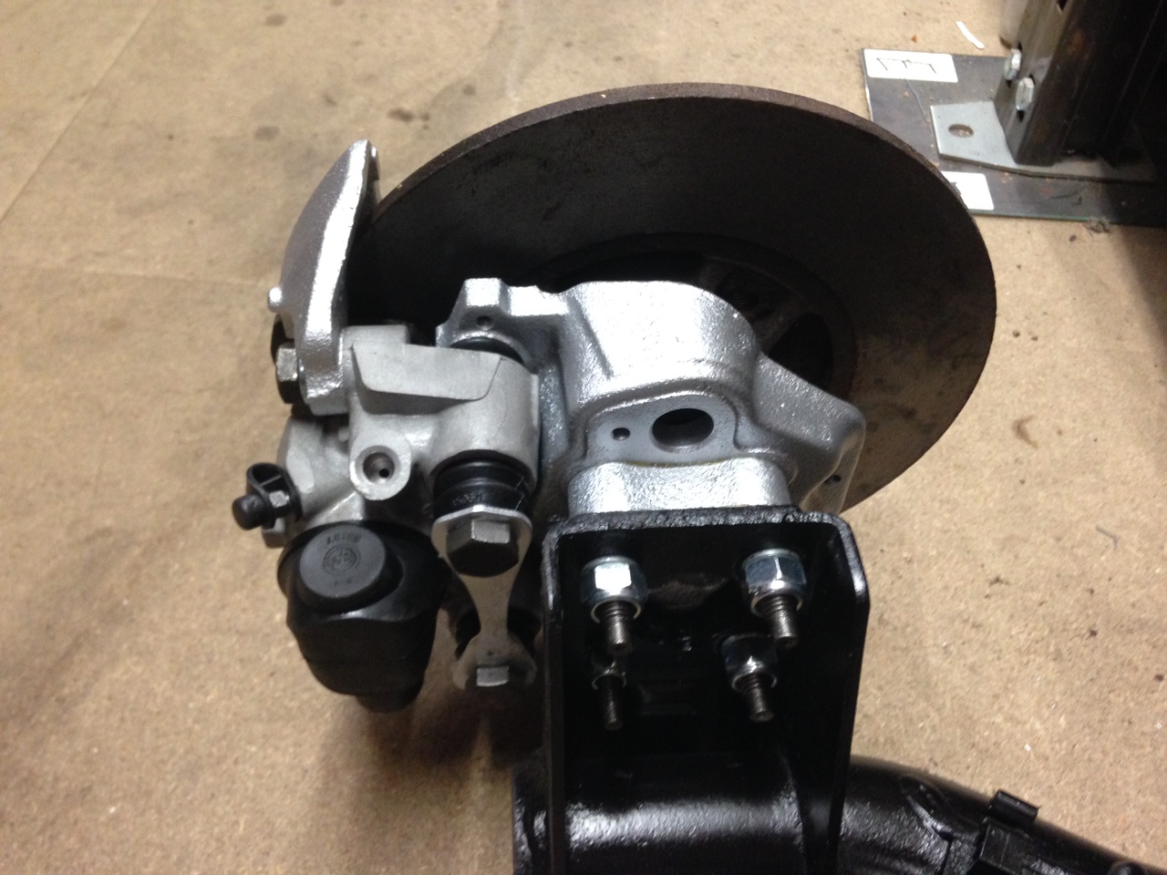

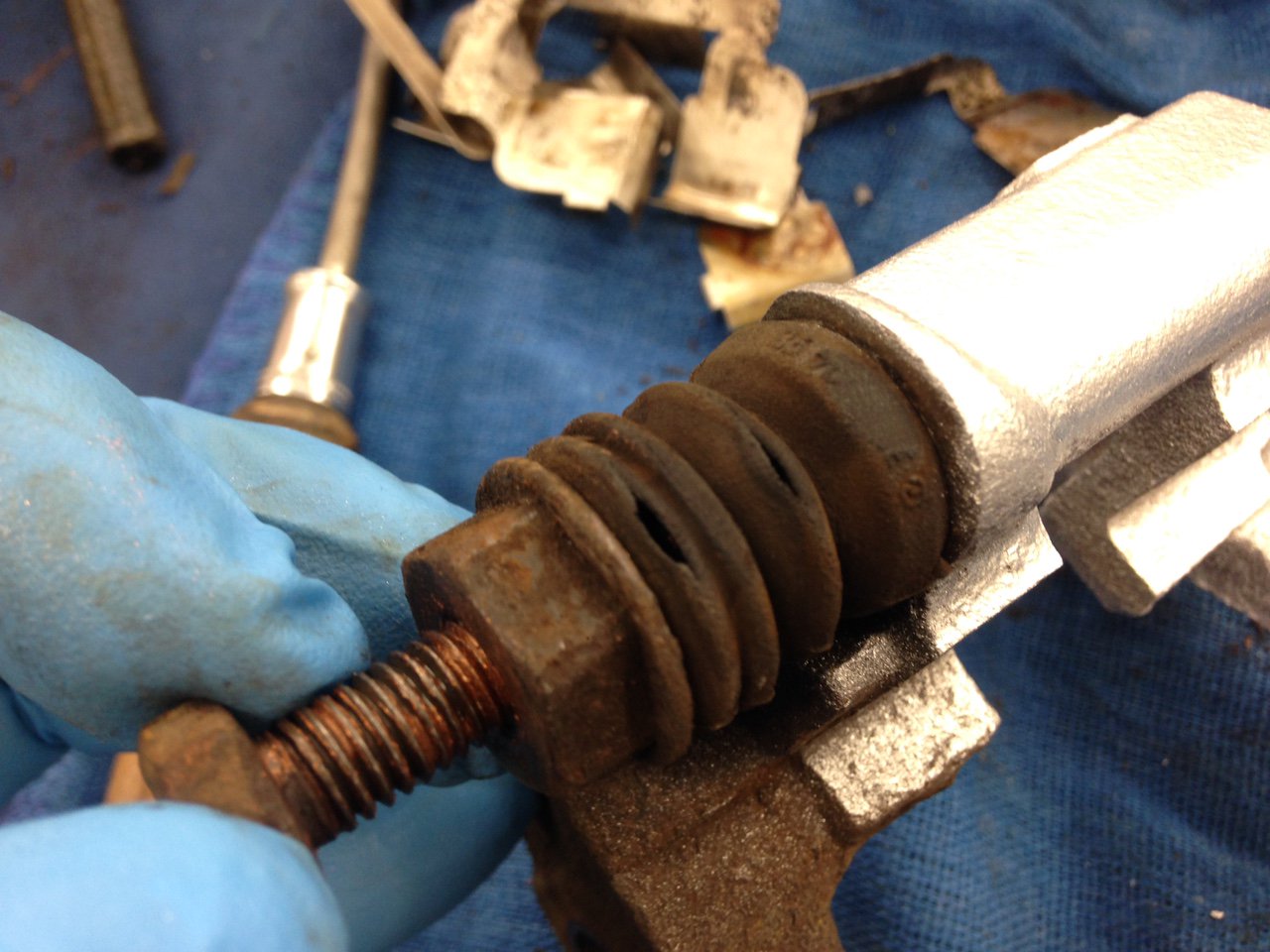

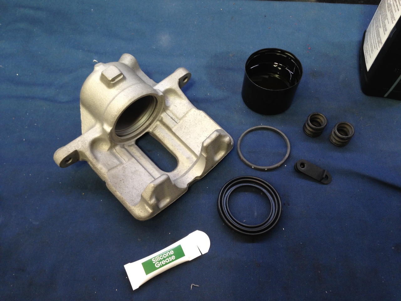

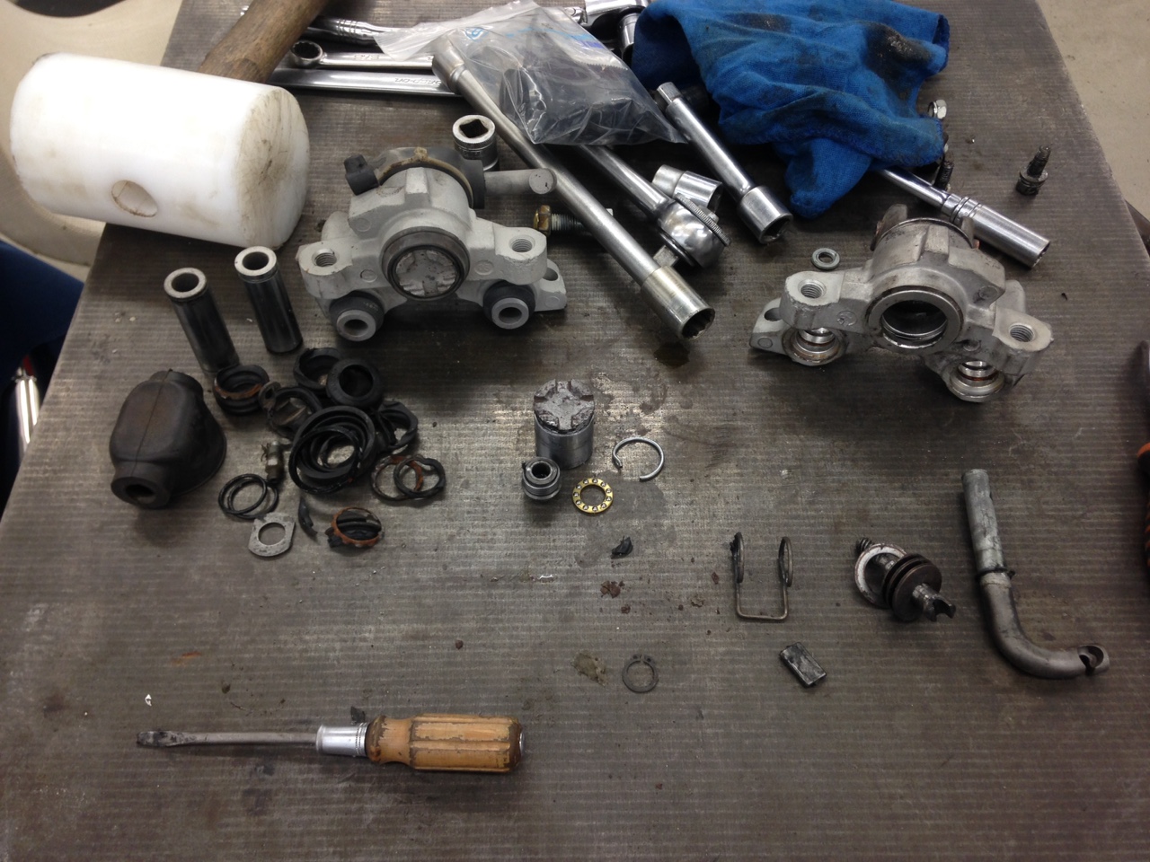

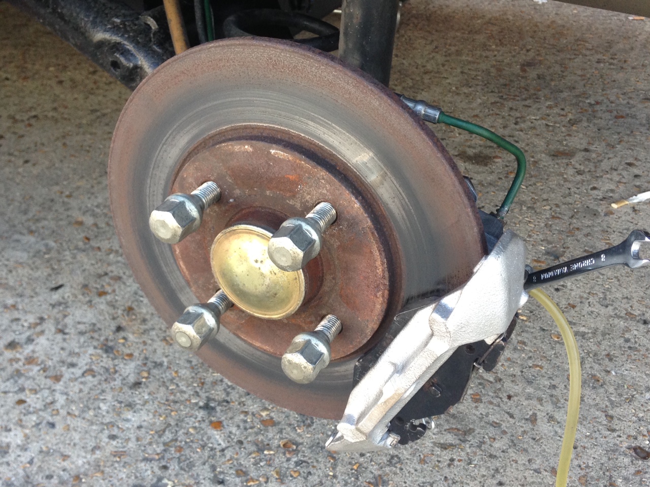

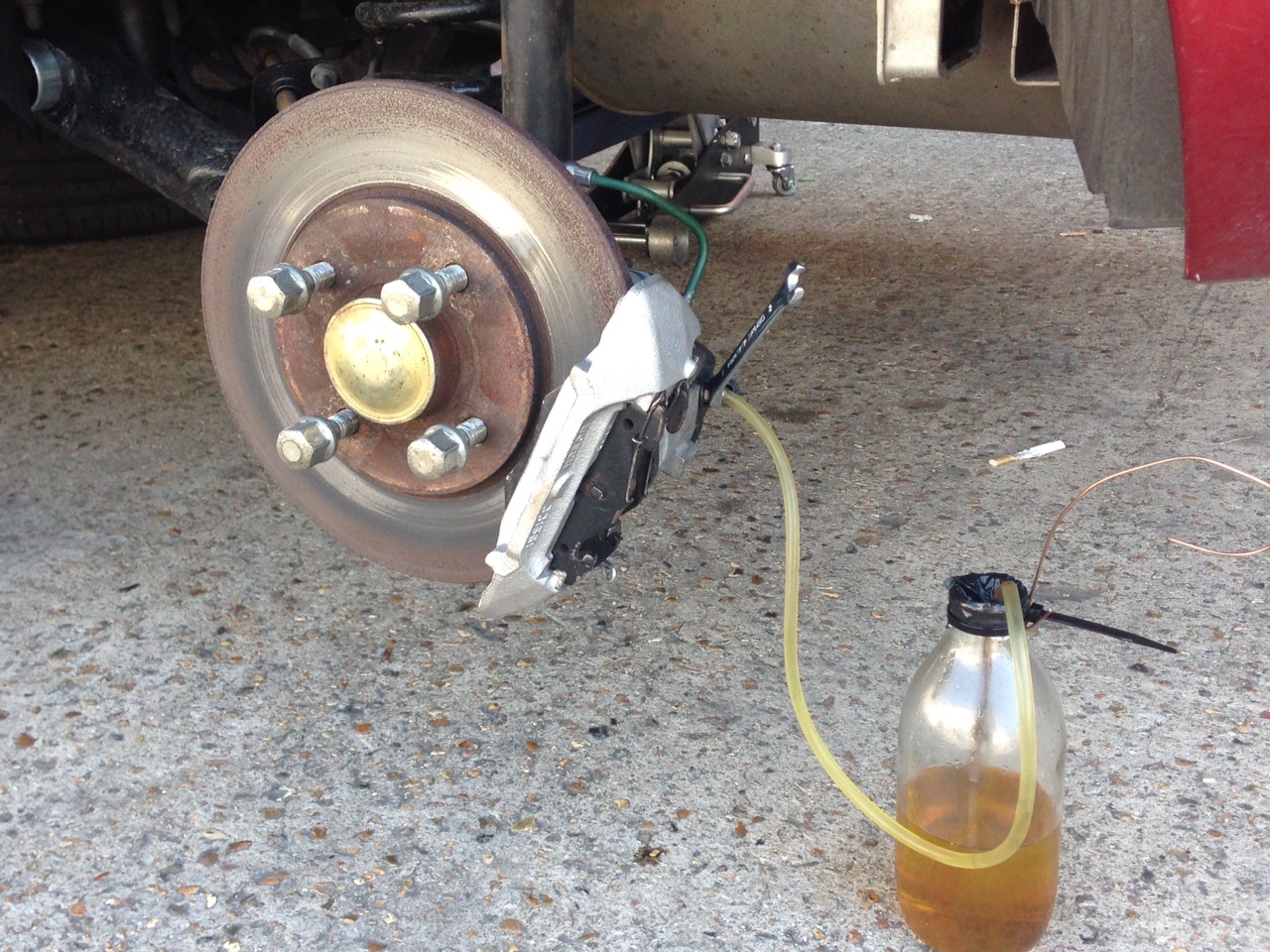

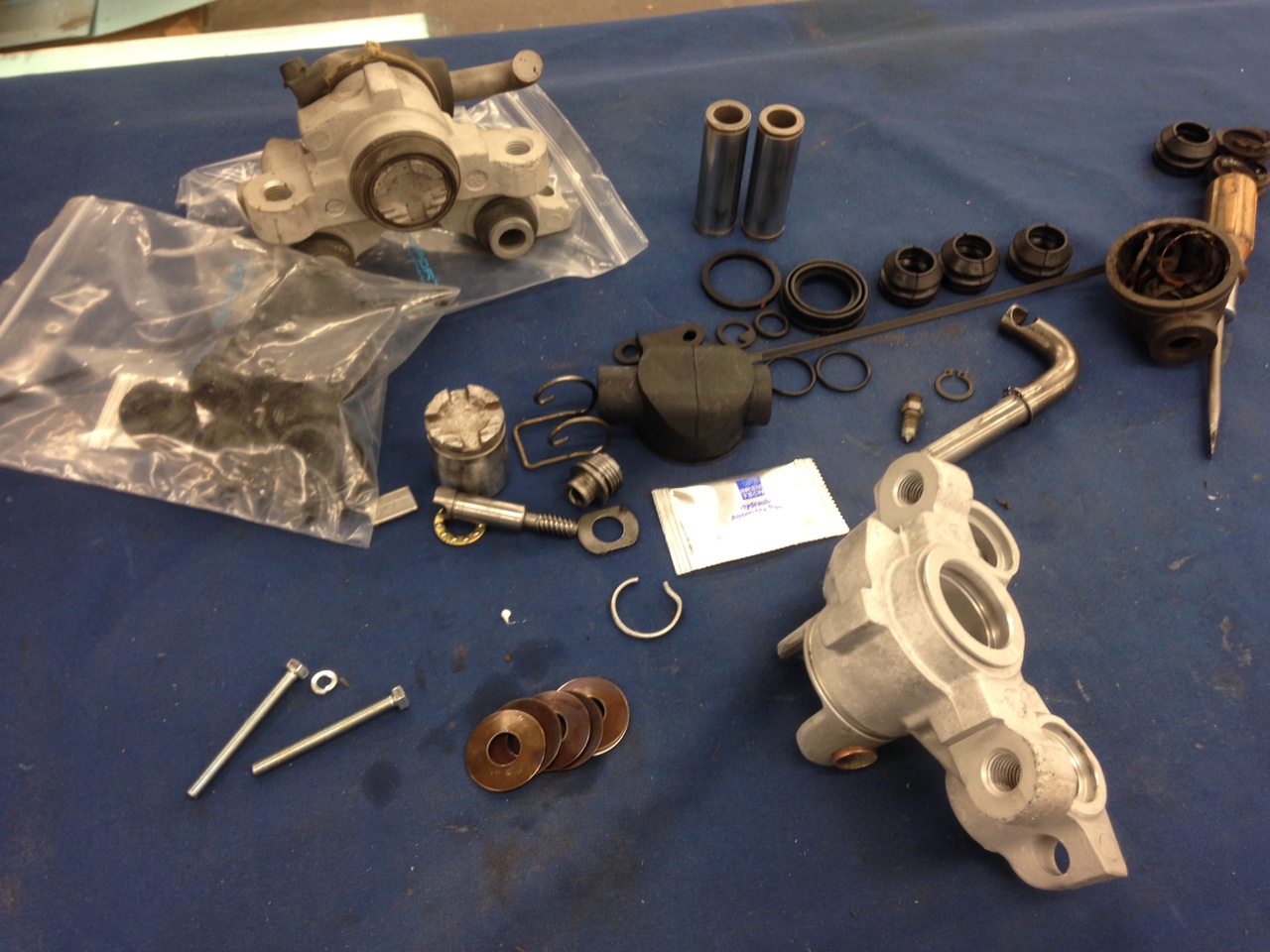

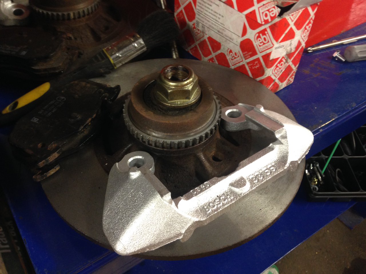

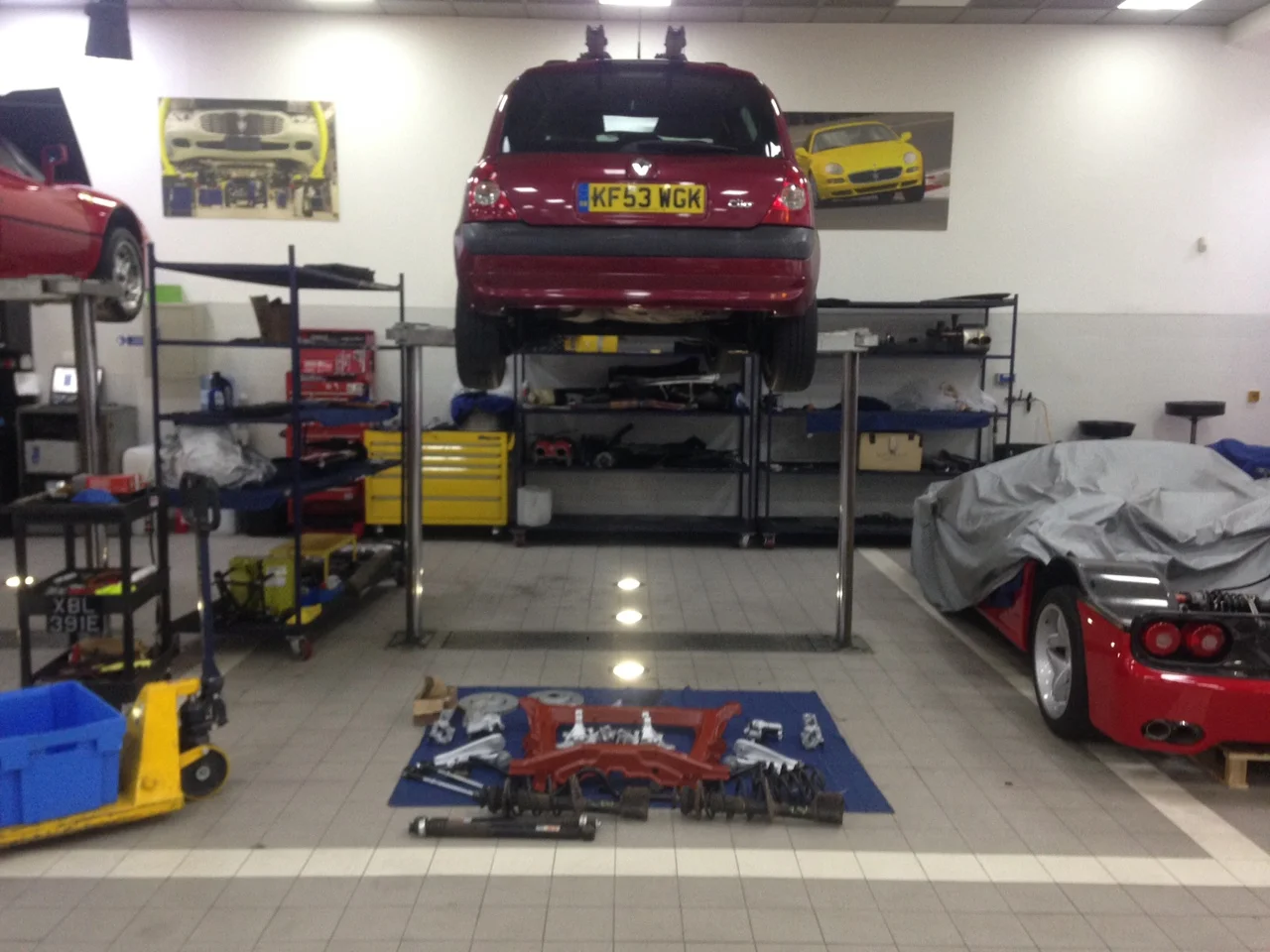

Rear calipers rebuild and axle back together. All I'm missing are the abs sensors which I removed to sandblast and paint the caliper carriers. A decision that I'm regretting big time, as they are very expensive and rare to find, and mines are in bits...
Check out this mad jig set up to reassemble the handbrake mechanism.
Big C clamp hold the bit of steel, welded a nut on it and used a big flathead to compress the spring so that a second person can then drive the lever in position..
No idea how you could do this in your garage.

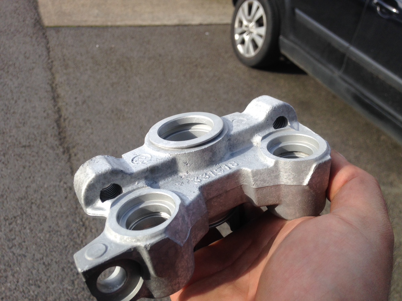

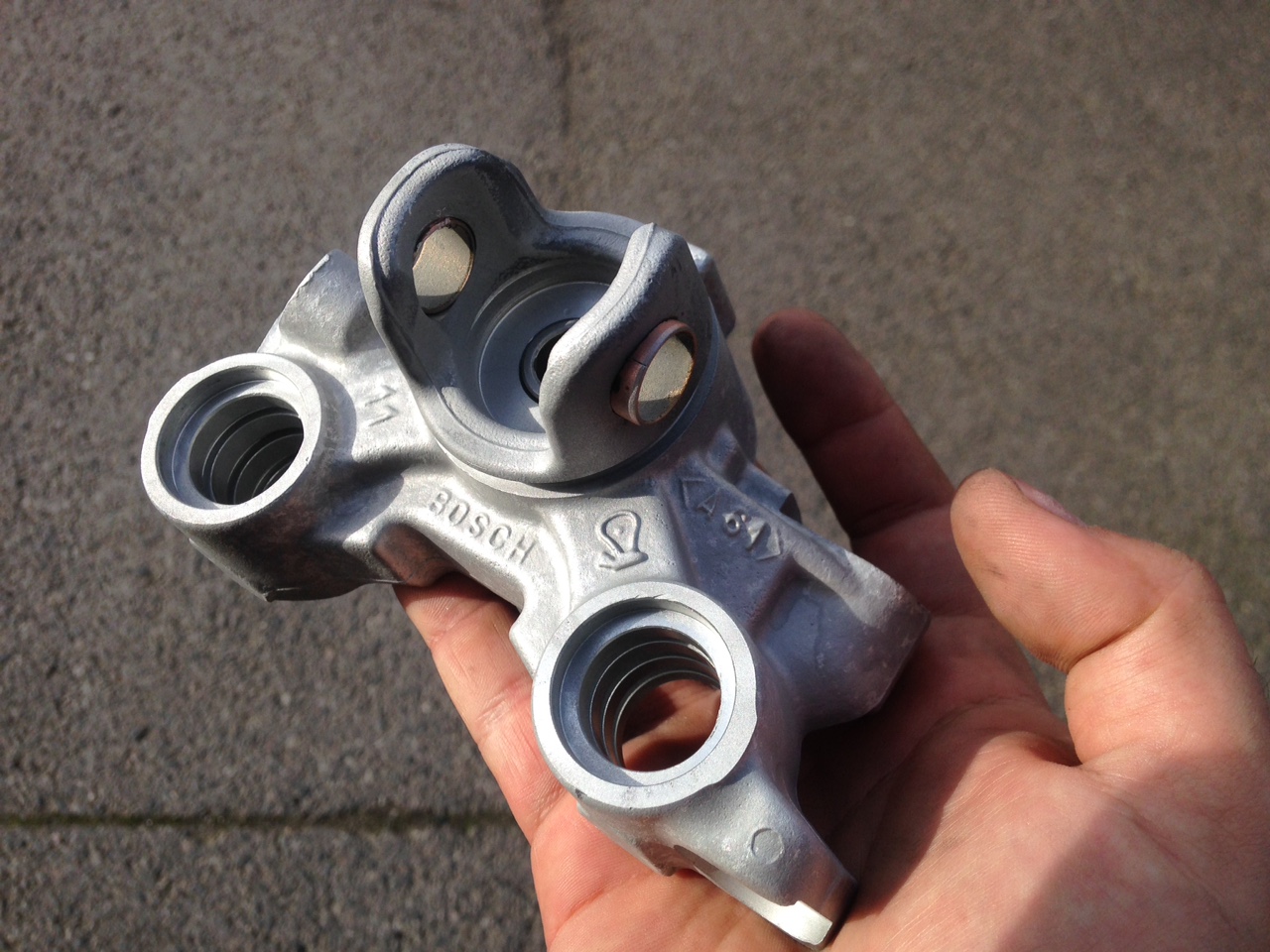

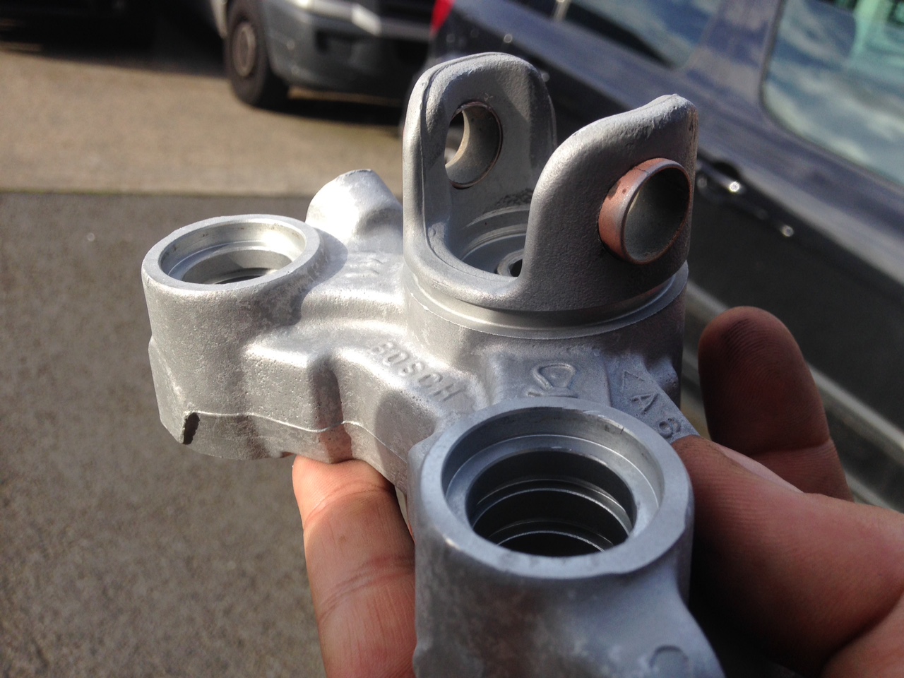

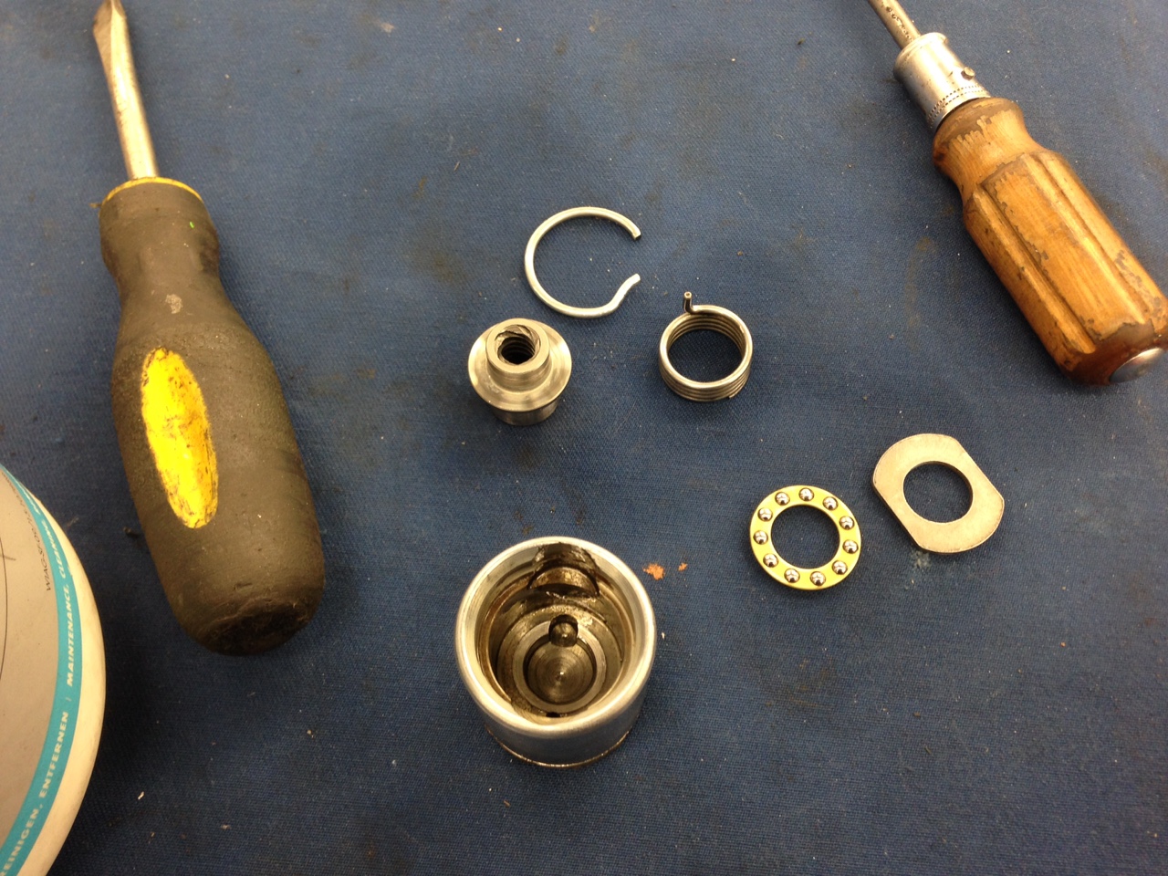

This is what's inside the rear caliper pistons
And everything back on the axle

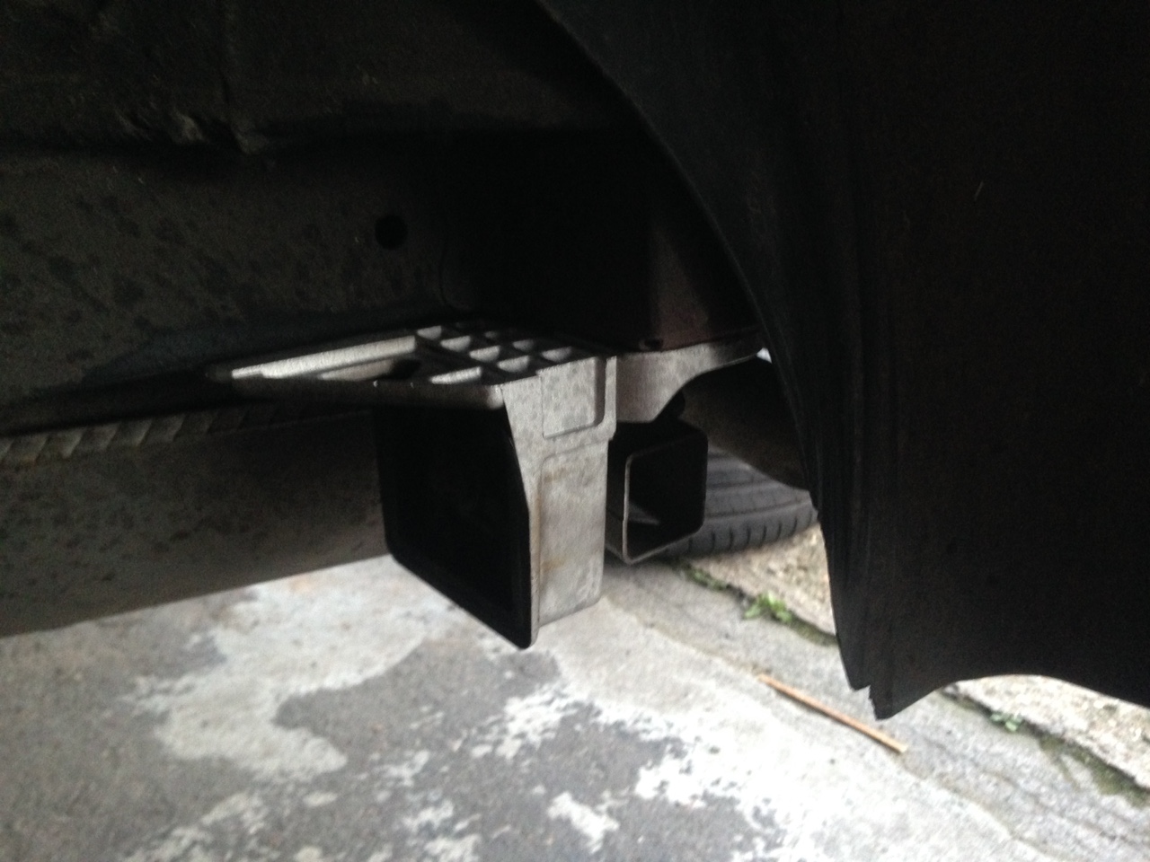

A shot of the new exhaust hanger. Genuine you know

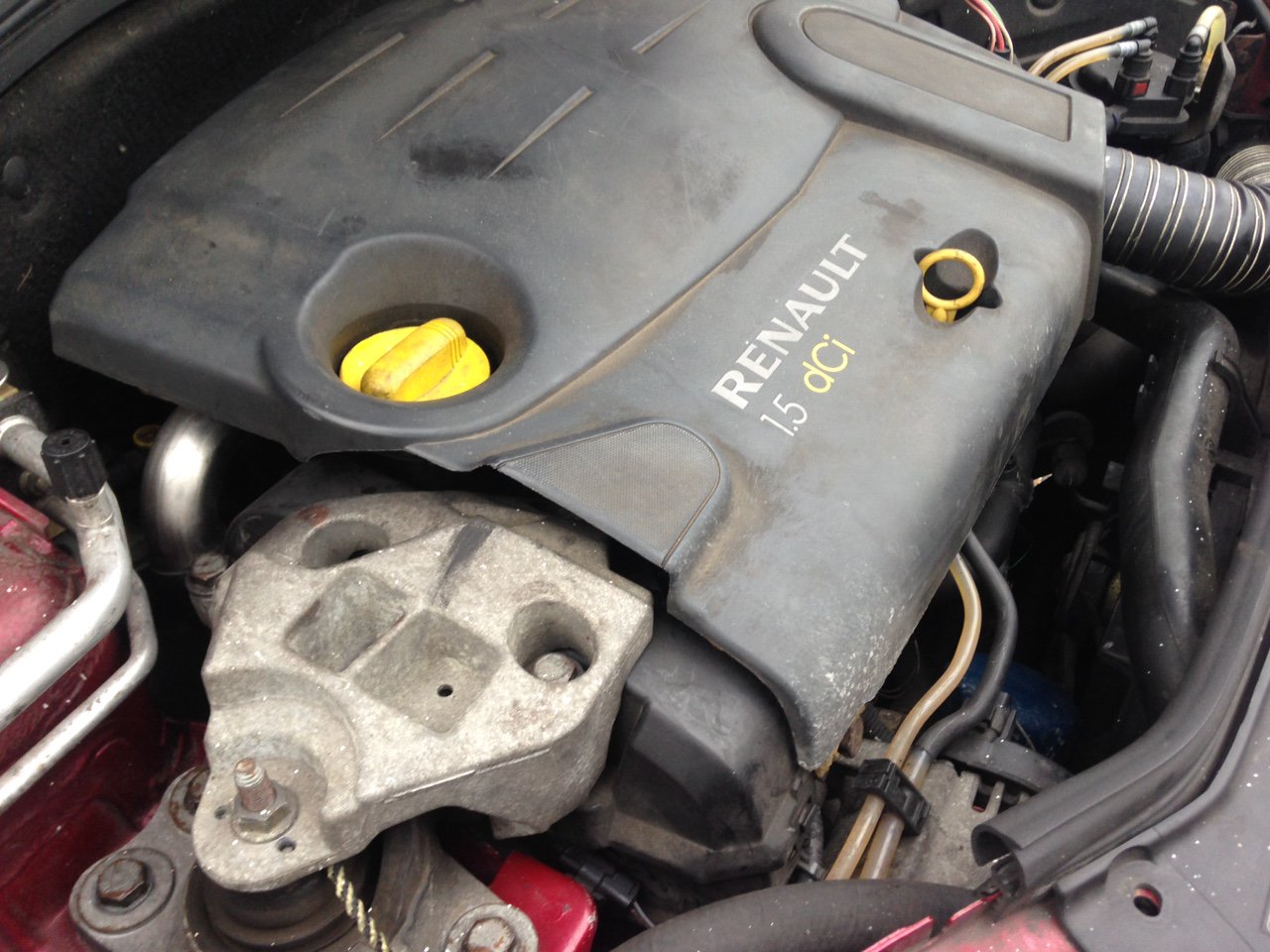

Aaaaaand a somewhat big news: I had the car remapped!
I went to a place called London remaps, part of the quantum group.
They say it now has 105 hp and to be honest... it doesn't feel like it.
I'll go there again to see what's what. Any experiences on this topic ??

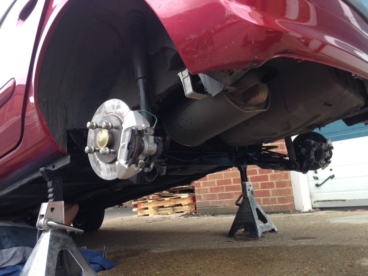

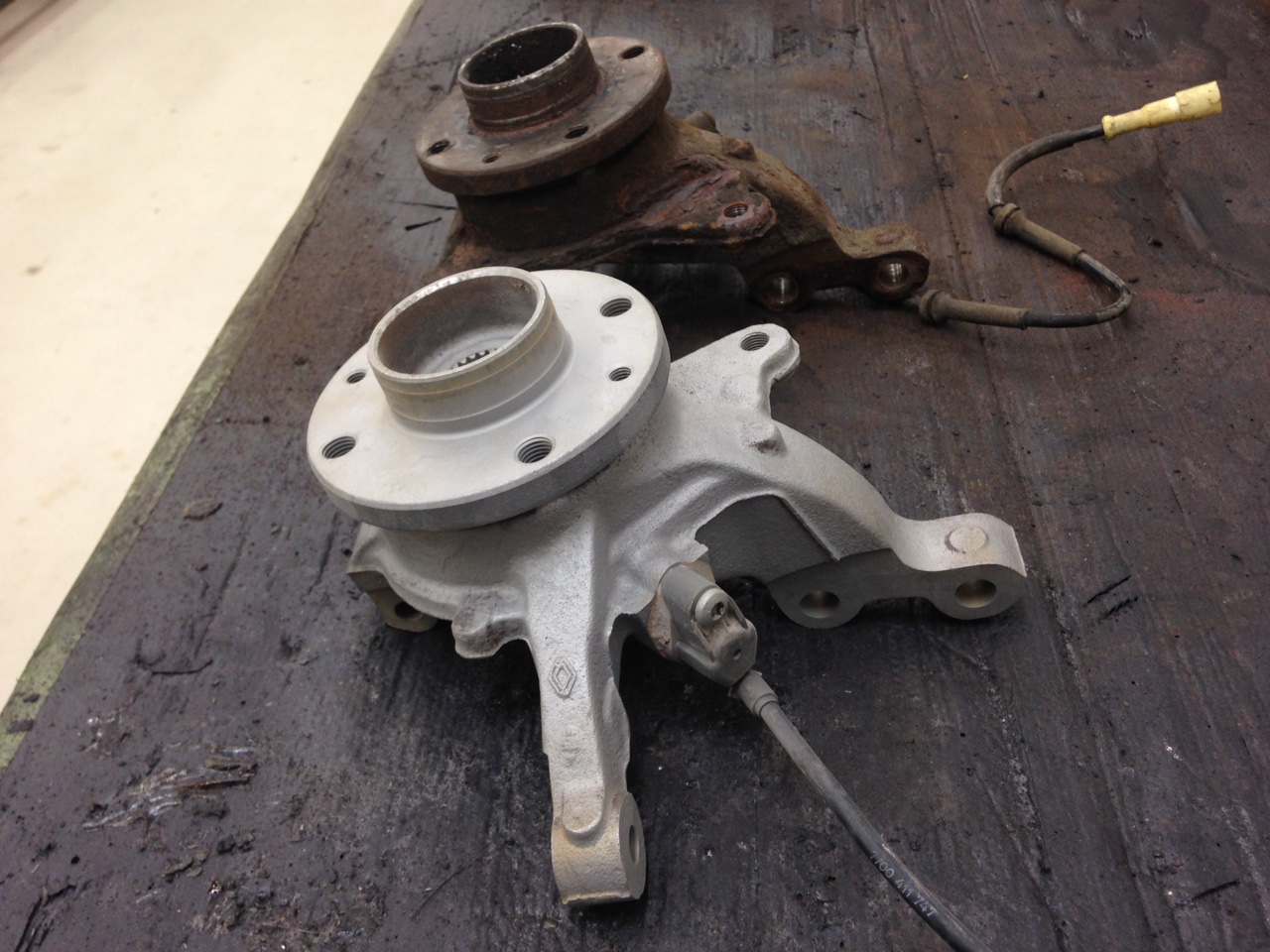

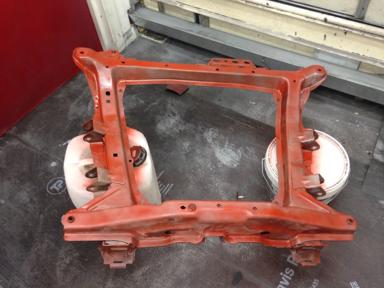

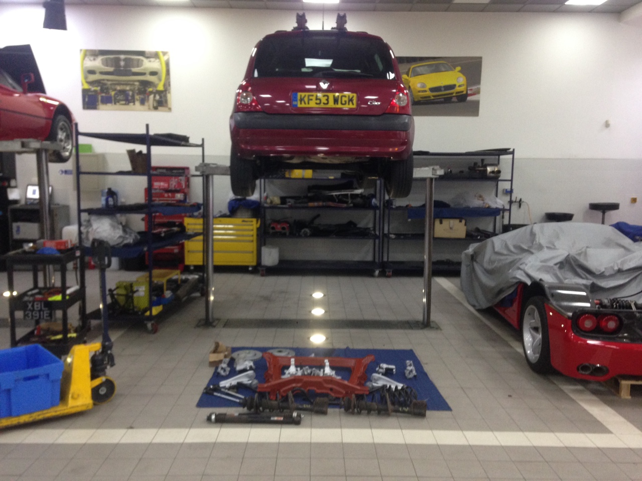

172 axle is in.
I wish I'd just painted the outer bit of the caliper because is all you can see !!

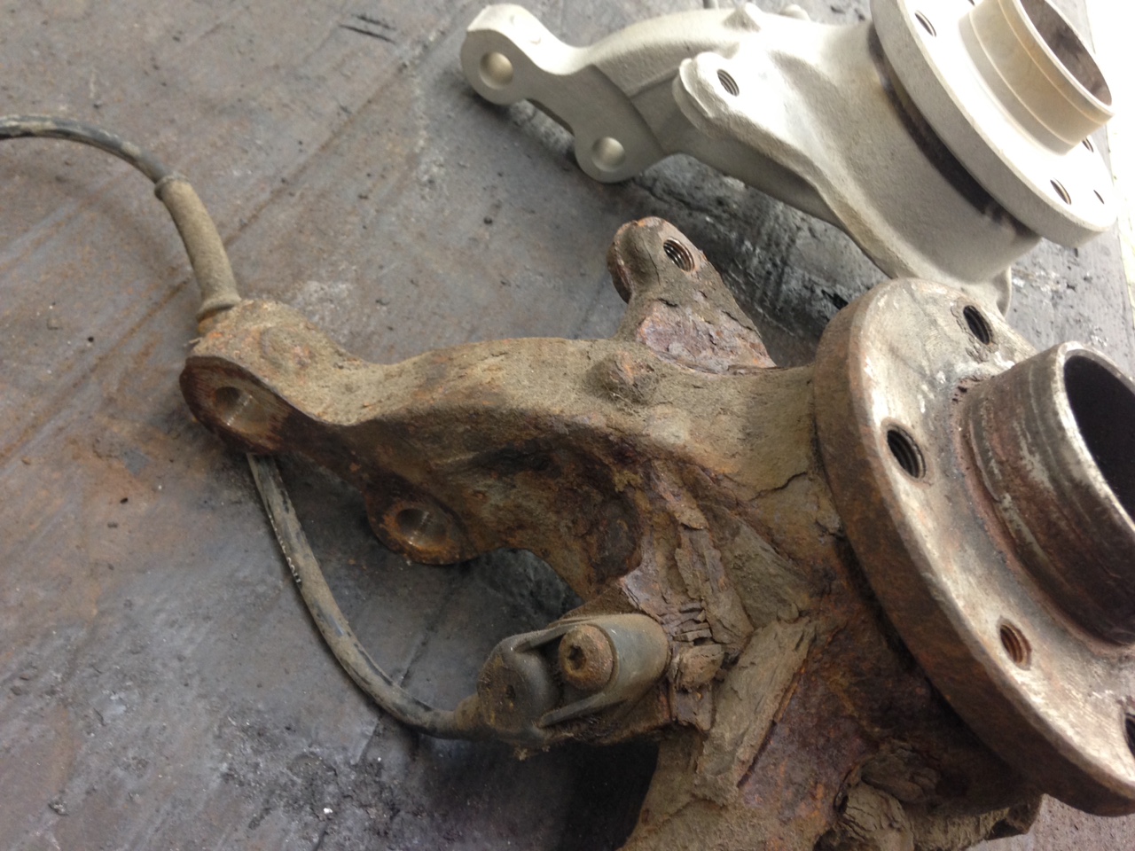

Anyway, I decided I needed to get a move on so I bought some used abs sensors and caliper brackets from Steve at SSS autos, helpful as usual, and today I said to myself that the axle had to be fitted, no matter what god had to say about it.

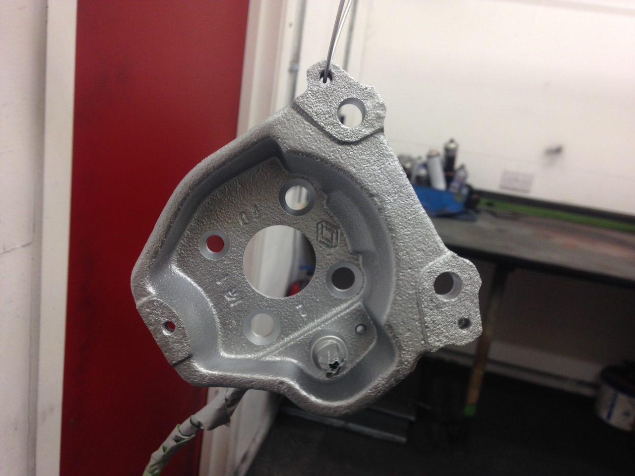

So sandblast, prime and paint the caliper carriers, and get them on the axle pronto !!

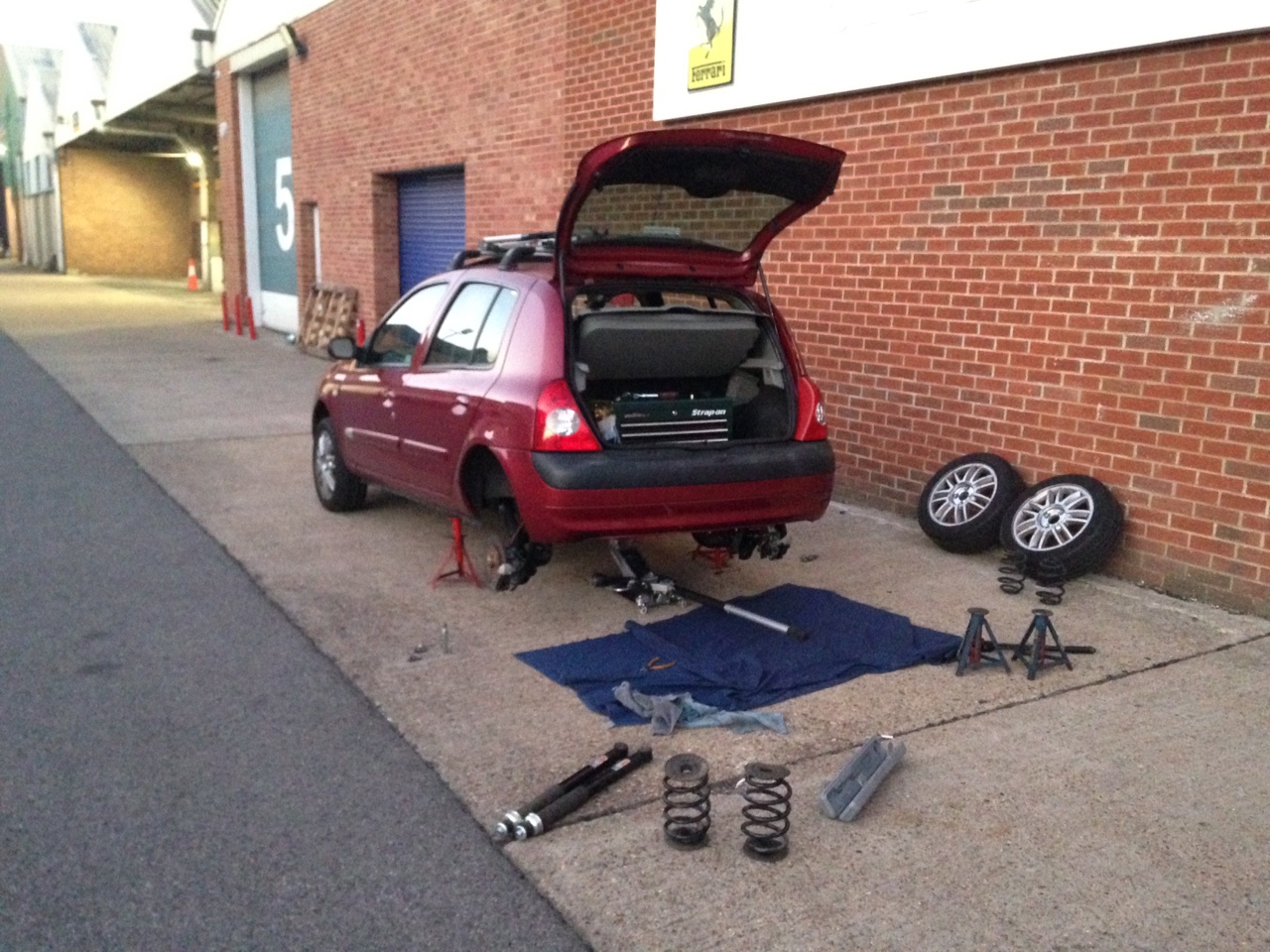

Then there's a solid two hours of swearing, rushing and praying to get the old axle out but if finally gave up.
In goes the new one. We re pinned the connector at the abs ecu to try and make the 182 sensors work..
The new axle is the same width. The wider track is from the wheel mounting surfaces and stun axles being thicker.
Looks quite the same though..
And that's that. Front suspension next.

I certainly wouldn't be remapping. The injectors and pumps are so bad on these cars it's a guaranteed failure point down the line. My last one did really well and died at 150k. This current one with 105k on is flashing all the time for low fuel pressure.

The remap is useless anyway, or at least mine is !

As regards to remap, going to 105 should of made a difference. The 80s easy map to 120hp.... that's on a good condition fuelsytem tho.
And if it's a generic remap ( no rolling road ) I suspect you've been sold a crock of s**t map that over time can ruin the engine
That's why I'm thinking of going back to get the original map loaded.. or maybe spend the equivalent of another Clio to get a proper remap !!

The discs I had turned out to be rubbish, as expected. I'll never again consider a lathe good enough to machine brake discs, lesson learned.
Steve at SSS hooked me up again with a decent set of discs then I then proceeded to install on the spot, not bothering with those useless clips, more on this later.
Since then I had the feeling that the NSR disc wasn't actually been "cleaned" by the pad (discs had some surface corrosion on them) and that led to believe that the caliper is either sticking or there's air in the system. Pedal seems solid..
So, today I bled the brakes using my trusty one man pressure bleeder that has been sitting in a box since November. The box had had enough and there's only remains of it now.
In action, I followed the sequence described in the manual. FL>FR>RL>RR. Strange if you ask me, normally is from the furthest away to the nearest wheel.
See what I mean about those discs? This is the rear right, doing its job:
And look at the other one after two weeks of hammering on the brakes
After circulating a good 1.5 liters of fresh fluid through the system I declared it fully bled.
Only a tiny bit of air came off that very corner.
Did it work? Well, the disc didn't show any sign of improvement , I think there's something wrong in the way I rebuilt the caliper, or the pads are rubbish.
Oh, remember those clips? I found out what they do
They go under that hooky looking thing on the pad and then jam onto the caliper, keeping the pad on the disc.
Make sense now.
And look at my new improved locking tab retainer..
Yup, it's an R clip that's too big, but it's doing the job! I almost lost one of those silly little bars last week!

Made some tiny steps today towards the completion of this never ending wide track saga.. GrahamS could probably build a v6 powered rear engine beast with cruise and climate control starting from a 8v expression with hubcaps in the time that is taking me to get mine done.. and I have all the equipment at work !!
The thing is, I could have just put all these parts on the car as I've acquired them, but the thing is, with access to all this machinery and basically free paint and consumables, I just thought I'd make the most of it while I can. But because of my work position I don't really have spare time at lunch or during breaks. I'm always available, hence the slow progress.
Enough of this nonsense, what did I get done today?
Well, I fell into a trap, and I went... a little stancy..
I bought a stub axle spacer kit from Pure Motorsport. Totally useless now, specially considering the still standard ride height, but everything will make sense once the car will finally sit on sports springs and dampers.
The kit is really nice, the spacers are super neat and the hardware is just as good, it's also made with Allen heads, the stupid torx can burn in hell finally..
I took the chance of testing the suspect stuck LR caliper and swap the discs left right as I'm having some wear issues. Maybe I just need new components, we'll see.
I also had to add spring washers to the nuts on the axle mounts that worked themselves loose after a trip to Belgium two weeks ago. I could hear the axle clunking while cornering. Not ideal.
Will have to realign the damn thing again.
Looks pretty much the same, the only way to really tell is to look from the back, needs to come down a little to really give it justice.
This is poser level stuff like the boot spoiler. It was only £30, makes me feel less guilty.

The front calipers are now completely bare and rebuilt with new seals and polished pistons. They'll be silver like the rears as soon as I find a free can of silver vht..
The front hub carriers have been finally stripped of everything and almost completely blasted. They had some proper corrosion buildup on them, I spent days on the sandblasted and wire wheel.. they'll be silver too as soon as the new wheel bearings will arrive.
The wishbones are ready and waiting for new ball joints
One of the things left is looking at the driveshafts which will be sanded painted and regreased, plus new abs rings while we're there.

Changed the oil again today. 120k.
Look at how pathetic a mint 6000 kms v6 looks next to my rocket !

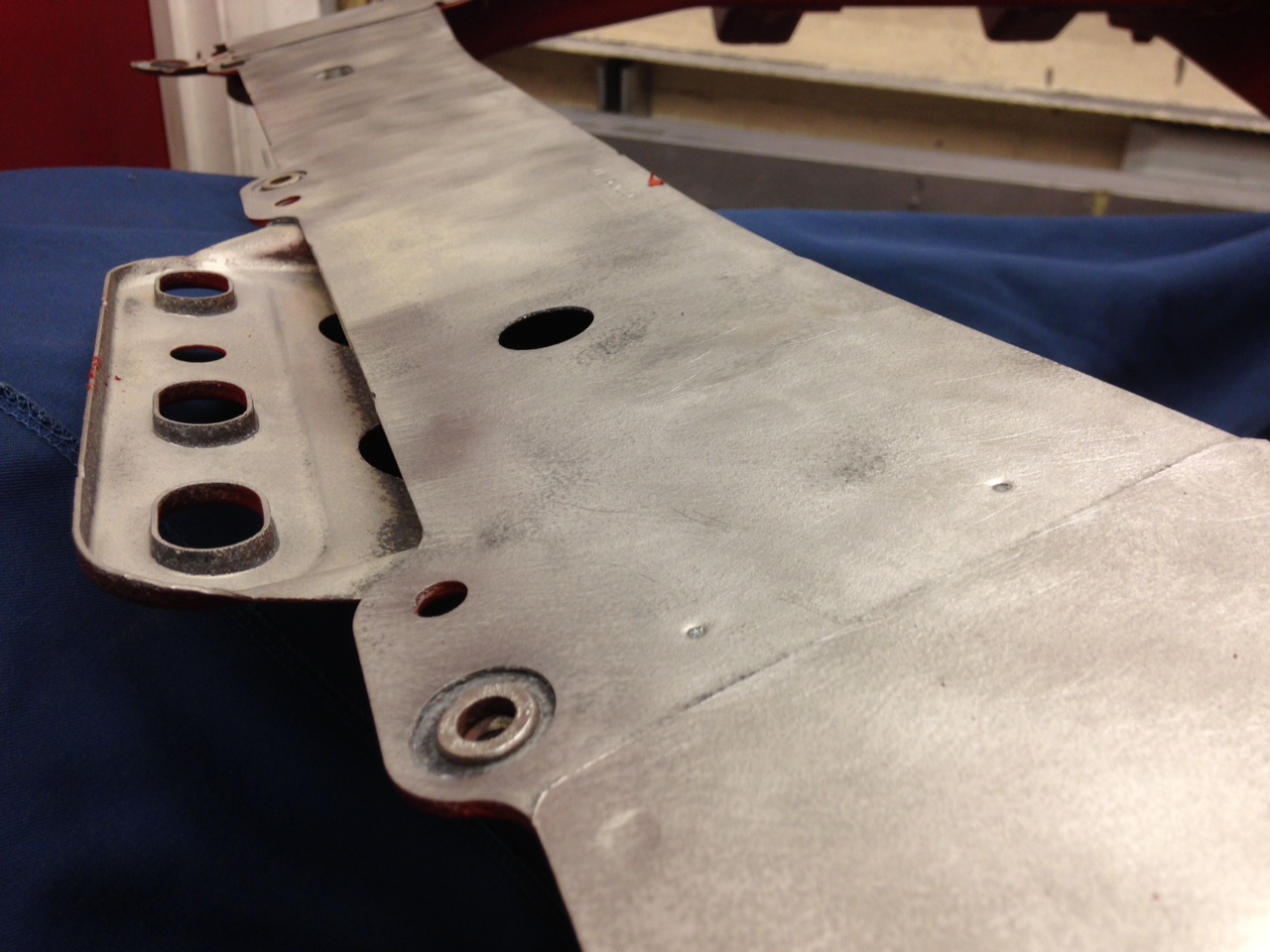

-blast and paint 4th engine/gearbox mount
-blast and paint subframe, I went for red oxide .. poser, again. 80hp diesel hatchback.

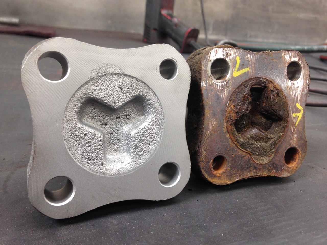

-received 172 cup driver side shaft, hopefully will be cleaned and greased like the pass side one.

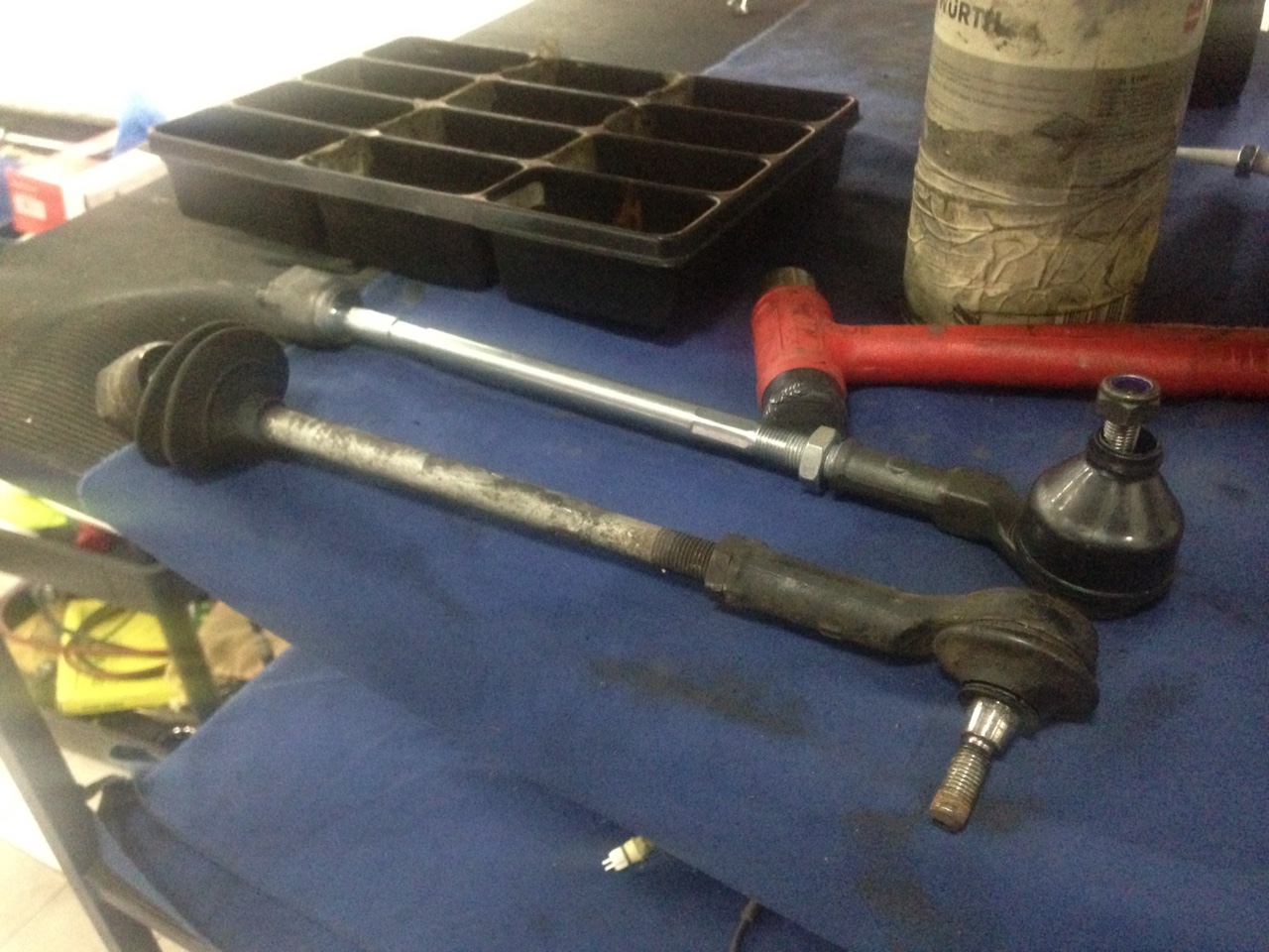

-new inner and outer tie rods for my SMI rack, hopefully they'll fit !
-new steering rack boots

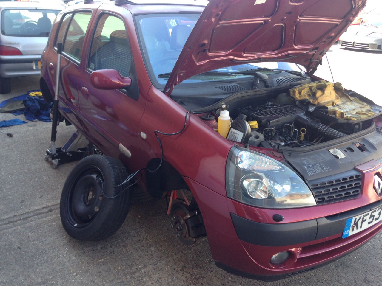

Finally, the big job is (almost) done, and what a job!
No words can express how much I respect whoever has done this before me, probably on a driveway with axlestands, you are heroes!
I'm lucky enough to work with cars and sometimes manage to earn enough "bonus points" (10 hours overtime = 0.25 bonus points..) to be able to use a ramp for my silly projects, and this time I made full use of it and I'm thankful I had it.
I had from 9 to 3pm, took a quick snap of the car with his original suspension still on. The 172 axle at the back still sitting on standard dCi springs and shocks.
On the ramp!
I apologize for the lack of pictures but, as usual with doing stuff at work, I had a really short time frame and once reached the point of non return I had to get it done!
Also I never had clean hands, and can't afford a new phone!
Here's the point of non return:

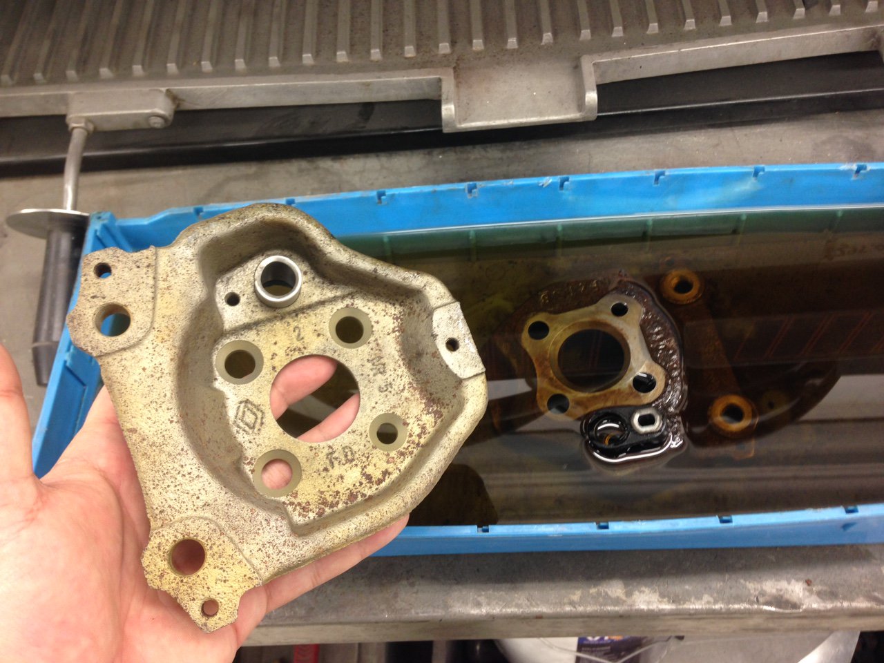

The once rusty corroded pile of old 172 bits is now a nice selection of finely painted and overhauled components, waiting to be fitted to this gem of a motorcar:
The hubs have been sandblasted, painted in wheel silver (slightly tougher than your standard paint) and given new wheel bearings.
I got new abs sensors that turned out to be the same as the 172 ones that were on the hubs to start with! Thankfully the standard ones are all plastic and can be freed off the hubs to be reused, good luck getting a set of 172 ones off.
The subframe has been also blasted and painted in red oxide that I just covered with layers and layers of clear lacquer.
The calipers also sandblasted, rebuilt, pistons polished, and carriers cleaned and greased.
Everything was painted in silver VHT first, then stripped again and coated with proper (and flipping expensive) silver caliper paint.
Discs were almost new, I just cleaned them and painted the bare metal bits. Pads are almost new too, standard Renault ferodos.
The steering rack got new boots and new inner and outer tie rods. The manual says to replace the fiber spacers too, I didn't have them.
The wishbones had good bushings so I just blasted and painted them, bottom ball joints are brand new and required some massaging to clear the driveshafts.

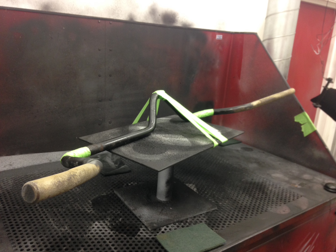

I partially painted the anti roll bar purely to get rid of some corrosion on the ends. I greased the bushings and installed it with sanded and painted clamps both on the subframe and wishbones.
I also sanded and painted the 2nd gearbox mount that I was eager to try on, as I've always been having engine movement issues with this car.
I haven't touched the driveshafts and I took a risk. One has a hose clamp on that suggests a shady past. We'll see how long they last.
I cleaned, greased and reused most of the factory hardware as it's way tougher than the Wurth stuff we have at work. I just added washers on all the nuts and replaced all the nylocs.
Everything fitted, the only hiccups were the usual subframe captive nuts that I guess just wait for you when you're tackling a job like this. Both the driver side one failed on me, thankfully I was able to squeeze a spanner on the rear one and a ratchet on the little front one. Then one of the bottom ball joint mocked us: physically different from the other one where the pinchbolt goes through. It was touching the abs ring of the driveshaft, we just ground it down old style, no time!
I had to rush the whole time, two spanners quickly become a mountain of tools driving me mad. The boss also popped in and started asking a million work questions and I had less and less time to get the damn car done! I stopped and thought more than once to just put it on a dolly and finish it later, I had moments of confusion purely because of the rush and I almost cried when a fountain of brake fluid destroyed most of my hard work with the spray cans;

The car looks the same! If anything looks taller on those standard 172 springs. I guess with a 16inch rim would look better, but the stockers are staying people, this is a 80hp sleeper after all.
The front track is miles wider, that can be noticed at first glance. The brakes are almost invisible behind the many spokes of the "jade" style alloys. Oh well, is the performance that we're after.
The car dives better; the rear is still on standard suspension apart from the axle, and I've got a rear arb on the way too. Will look into lowering springs if I find a set at a decent price.
The 2nd gearbox mount is a revelation. Surely makes for more vibrations to reach the cabin from the Diesel engine, but it has partially solved my engine movement problems. Now I know which direction to take !

172 rear springs and dampers are also on, the sport conversion can be considered completed now.
