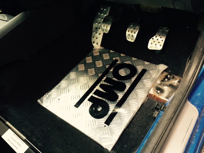

i just live with it tbh. I had looked into like a plate of some sort to make it look a bit neater.

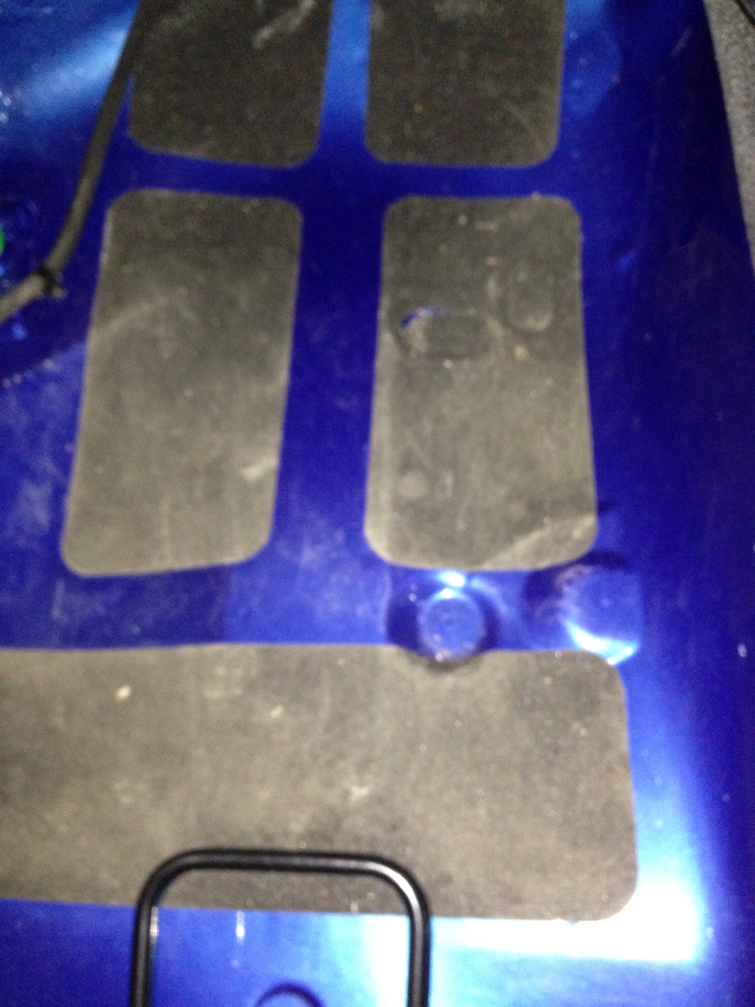

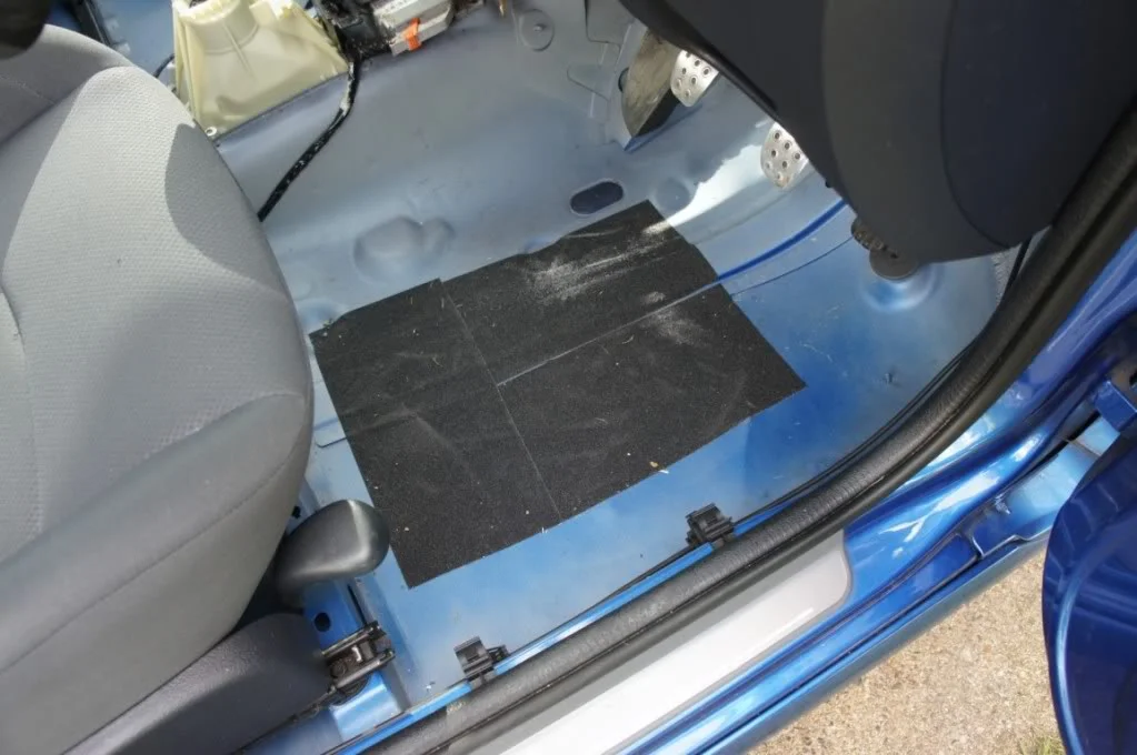

I've just got strategically placed grip tape in mine. I also kept the strengthening rib in there as its there to help prevent your ankles snapping in the event of a heavy frontal impact.

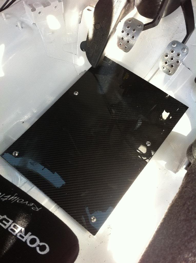

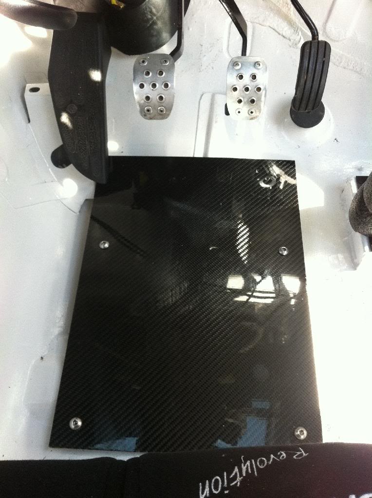

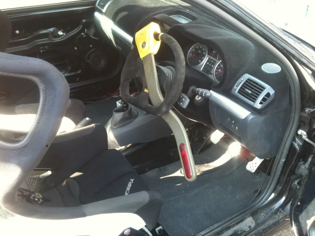

Carbon floor with a few spacers and M6 dome head bolts, I have gripper tape on the part under the brake and acc pedal, clutch area free.
Greeny.

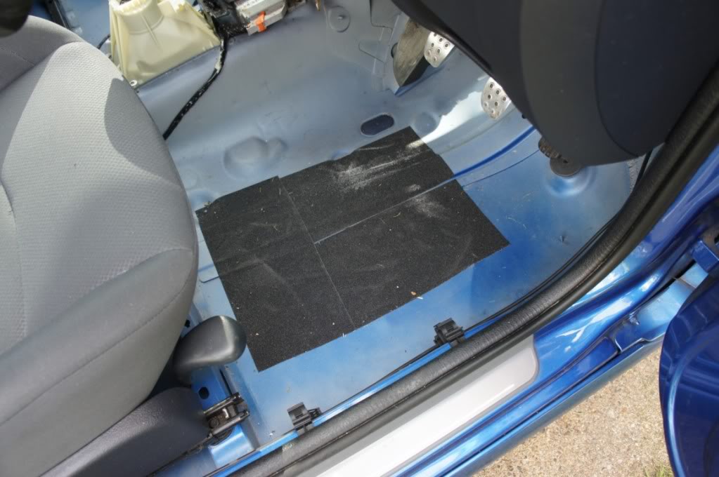

I just bought generic grip tape from eBay, its ok and cheap, does the job but it's starting to rip it with little use due to the lack of a proper flat surface to stick it to I would imagine.

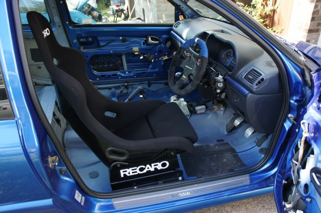

My Escort F2 car has a piece of alloy sheet that is bent to form a little step up an then forms a perfectly level floor, with grip tape applied to it.
It's worth noting that once you take the carpets etc out, the floor might actually end up feeling a bit low. I noticed that in my rally car when I first got it, so am fitting a foot rest to lift the floor a bit. Depends how thick the carpets and sound deadening are though!

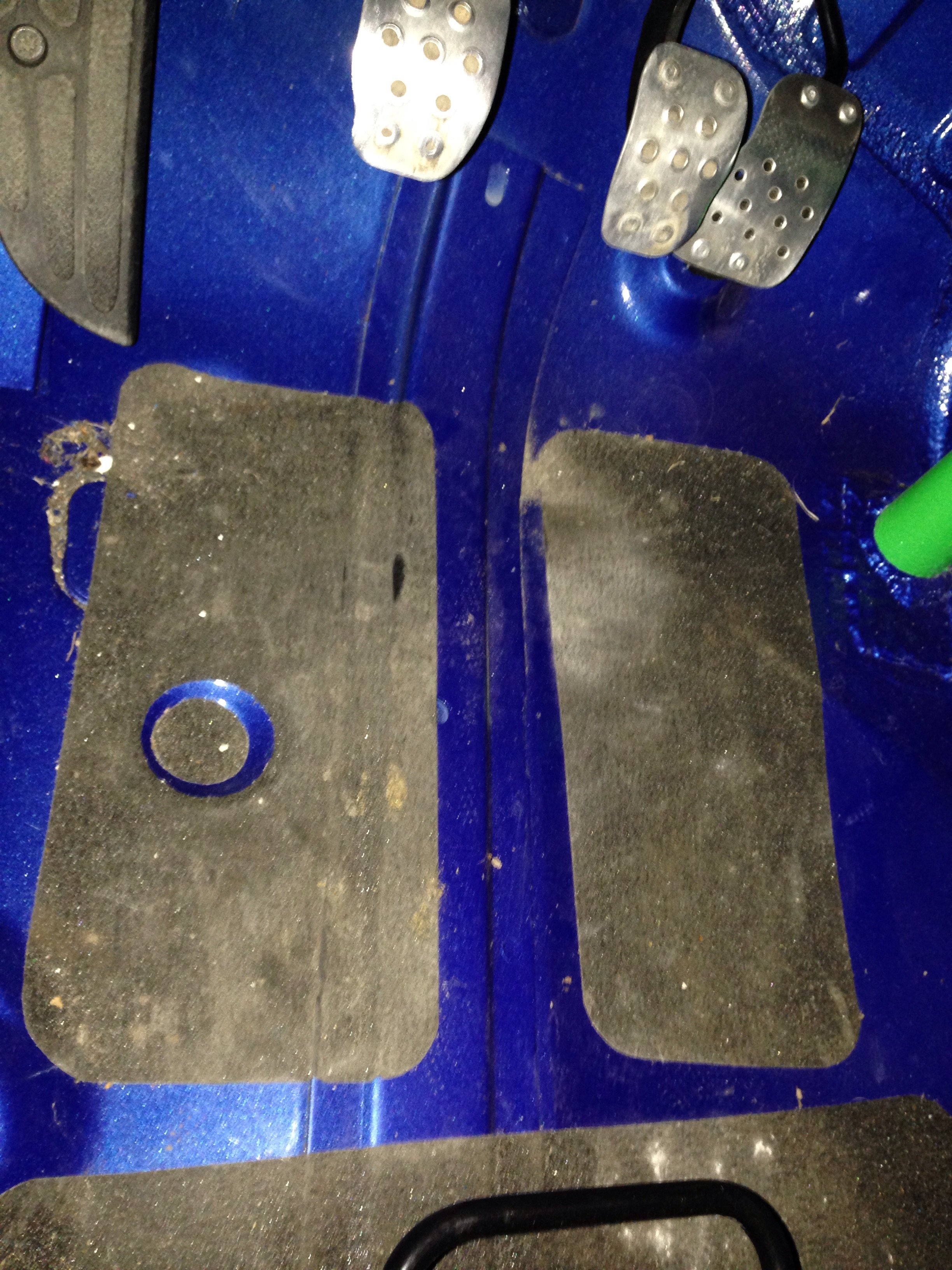

NorthloopCup

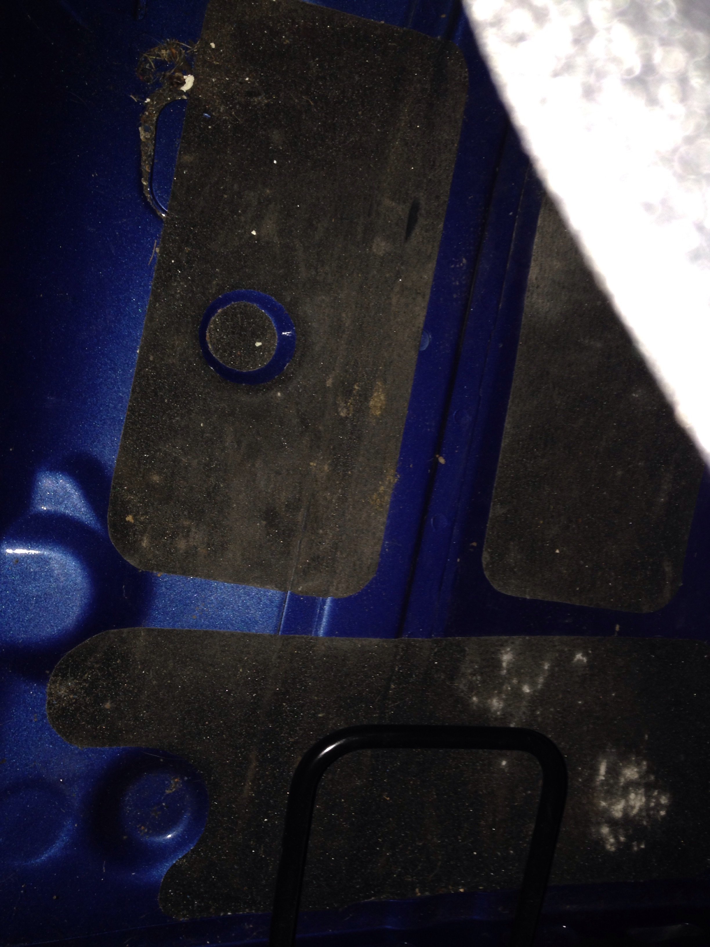

Mine with strategic grip tape - it's been fitted a good while now and it's also seen plenty of use. No ripping!
Excuse the s**t pictures! It's dark in the garage and difficult to picture!
Use a hairdryer to form it around the creases is my advice.
