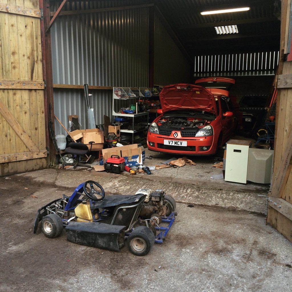

Here are a few more pictures of the car as it's down with andy just now for a few wee tweeks etc!

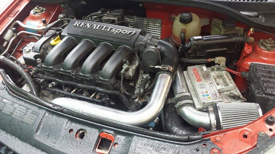

The pipe work has been changed to a solid silver pipe which I think looks really good!

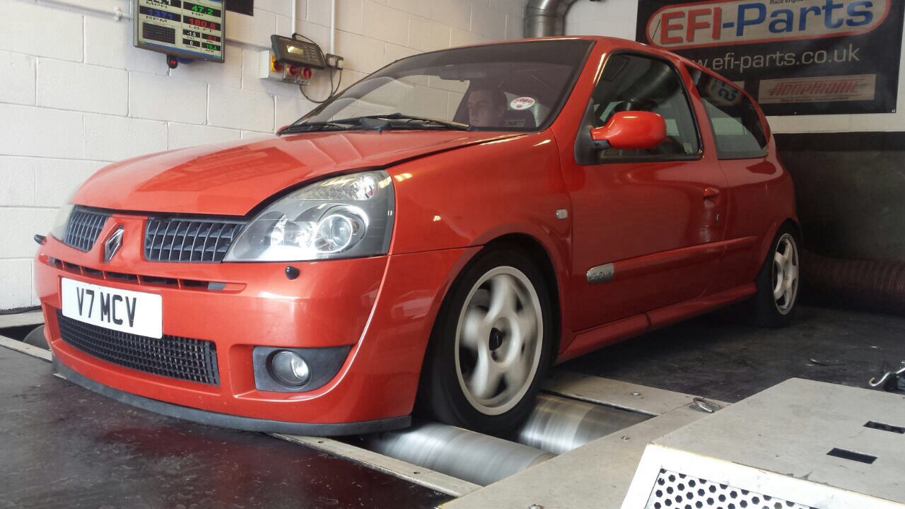

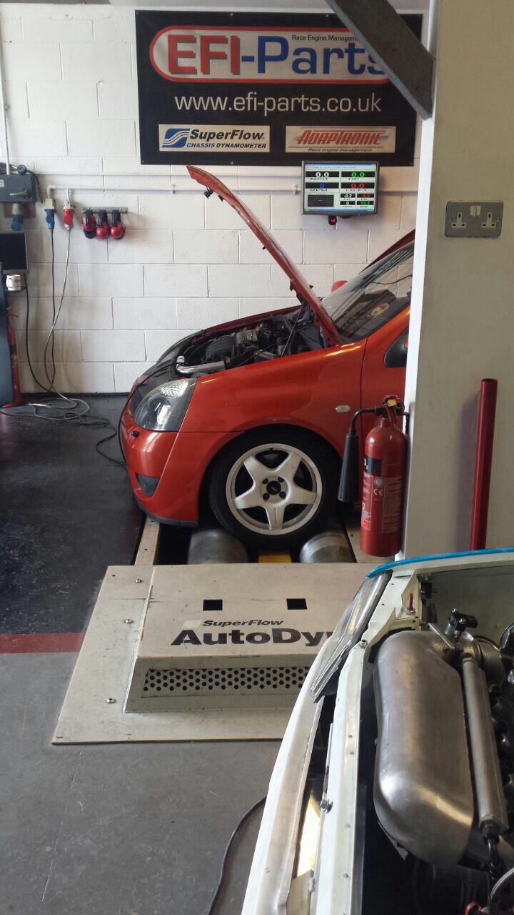

Getting the map redone by chris@efi
And my favourite picture that andy sent me
Cannot wait to get the car back!

Slight flat spot when coming on boost, dead spot at the top of the accelerator and generally just a new map as andy changed mappers since I had my car done so naturally the new mapper wants to redo the whole map to his standards!

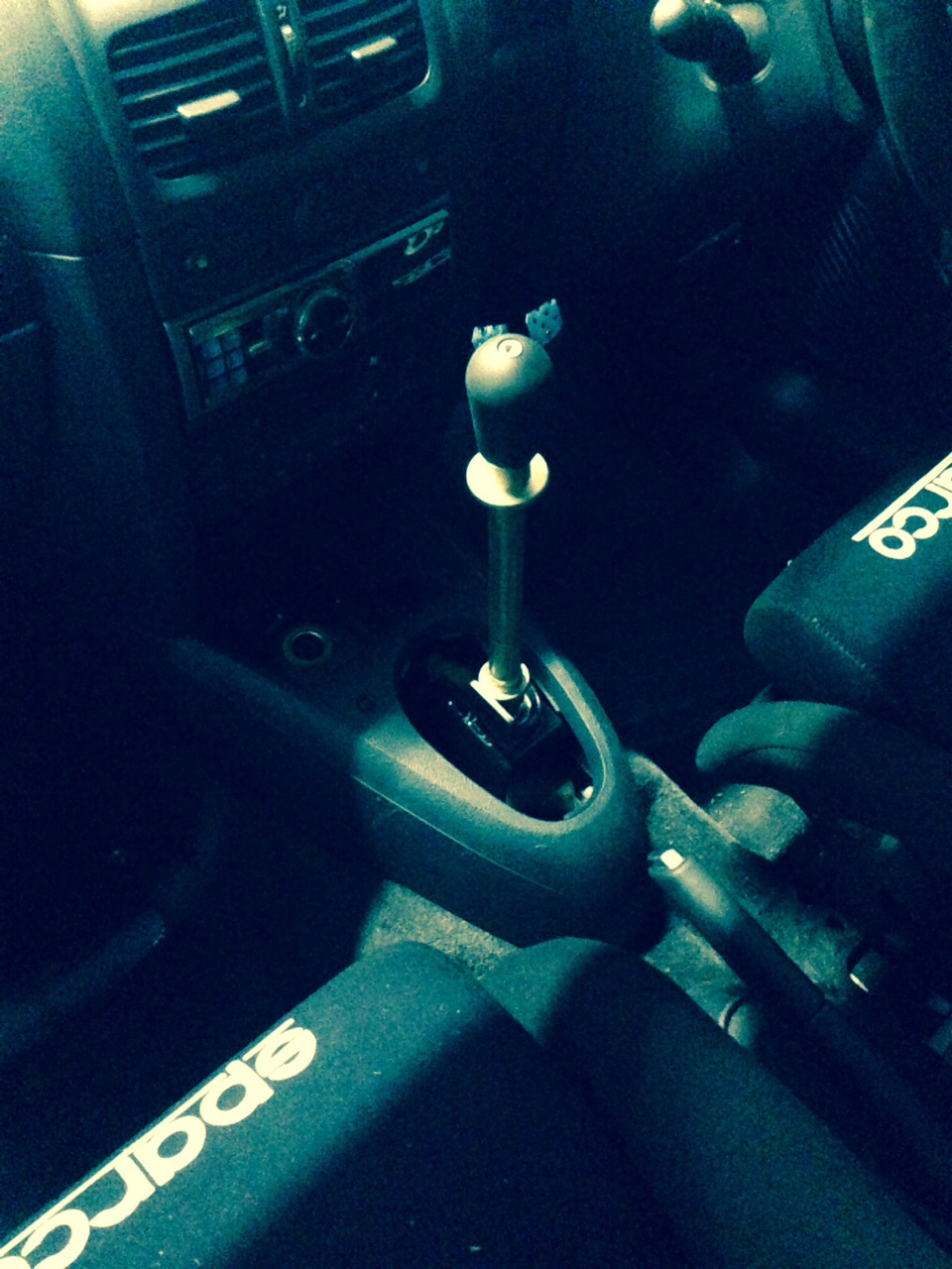

After having a shot of Andy's car with the PMS shifter I had to have one so got Andy to order one up for me. When it arrived I fitted it the next day. Really awesome piece of kit! I still need to make a surround for it, will probably make an alcantara one.

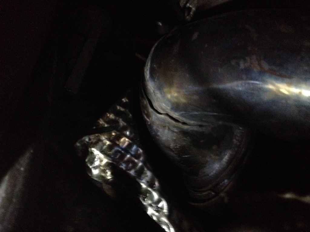

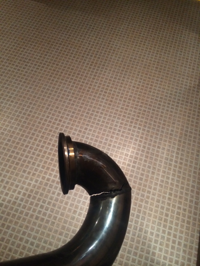

When under the car I noticed that the exhaust link pipe was loose so I looked up and saw this
Which is very frustrating as the car has barely done any mileage and I wanted to take it for a quick spin the check the shifter out!. But on the plus side andy is going to sort it out for me!

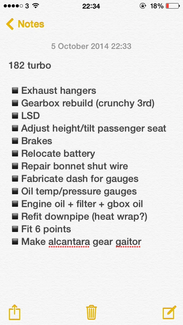

Got some plans and bits and bobs to do over winter whilst the cars off the road.

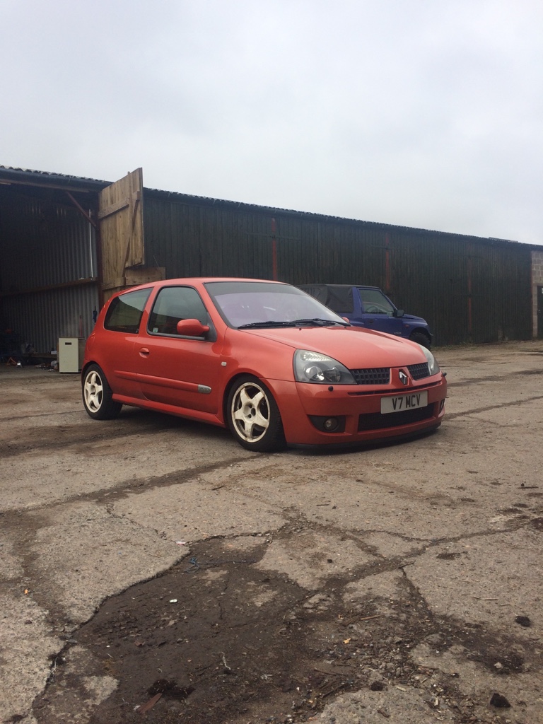

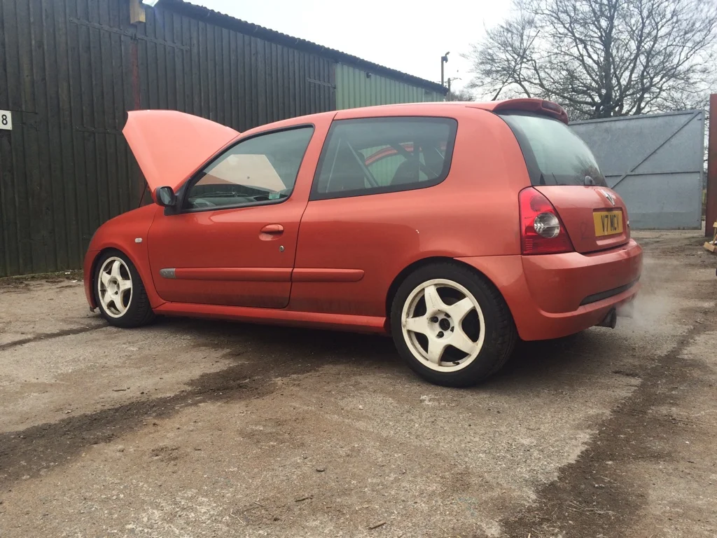

Can't really do a update with no pictures to here is a picture of how it looks just now!
