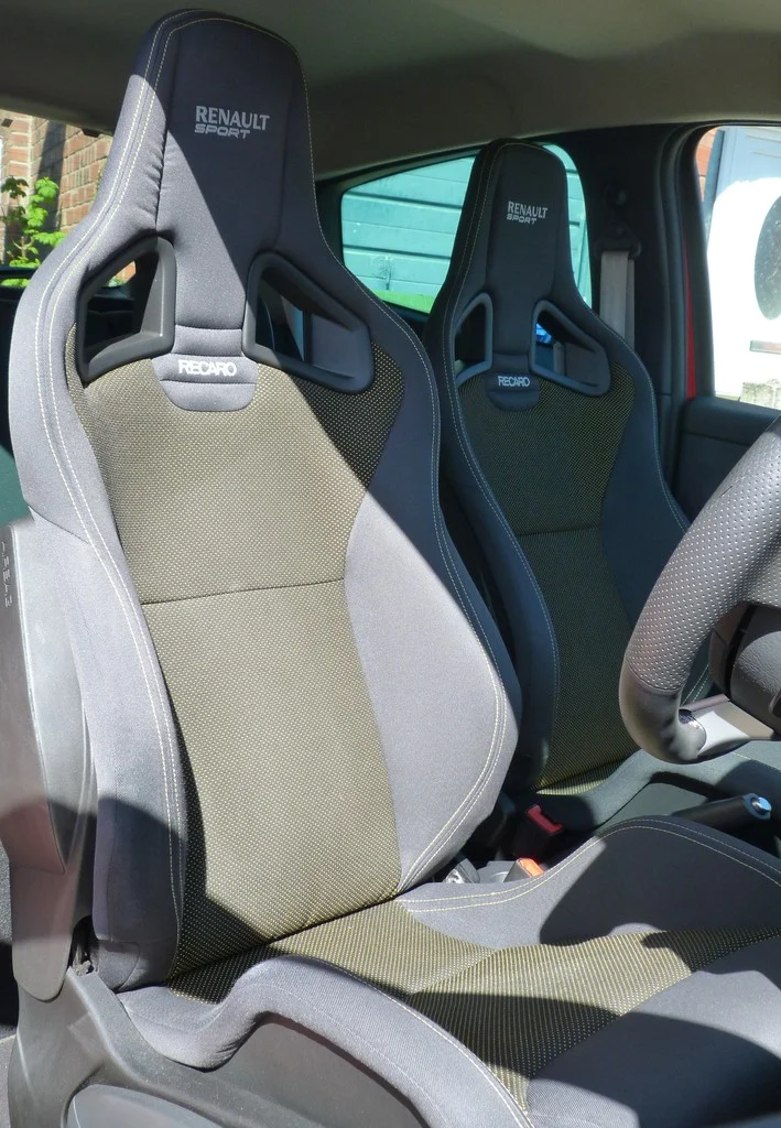

- Recaro seats

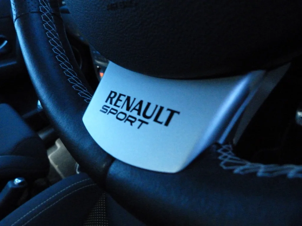

- RenaultSport steering wheel insert

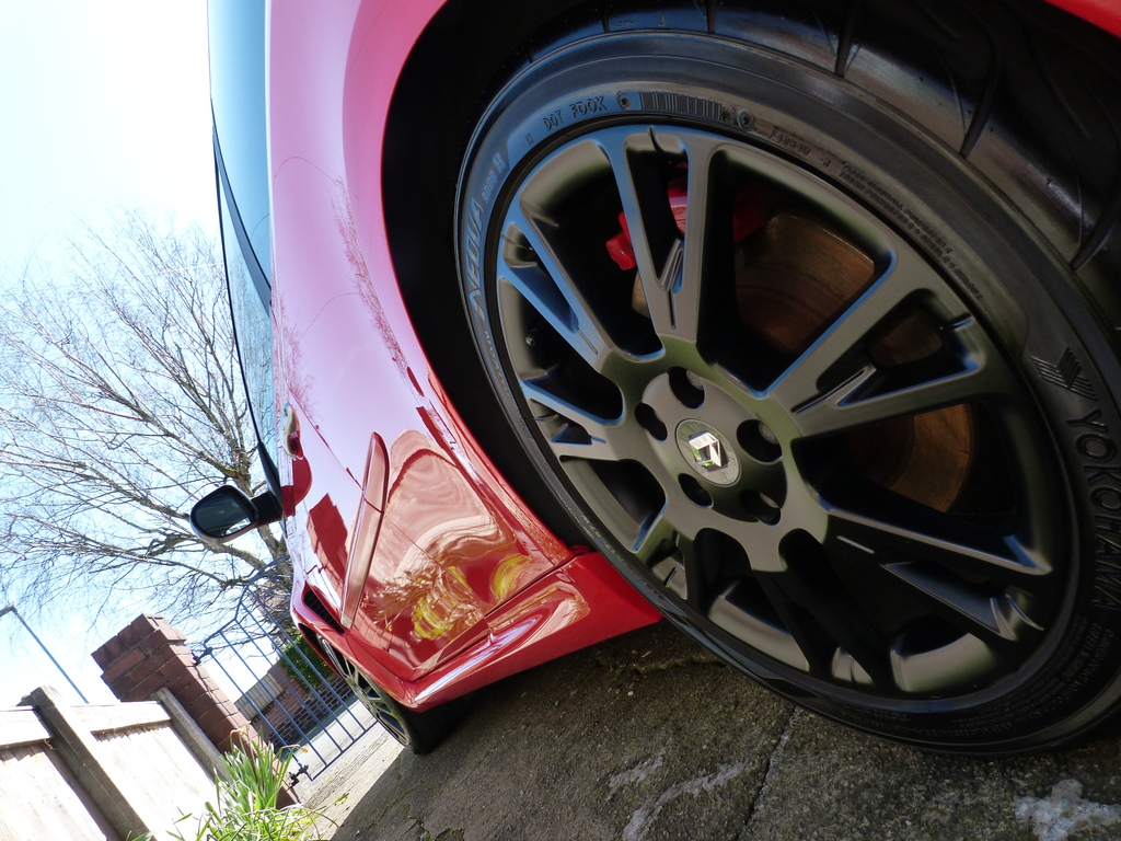

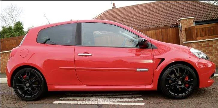

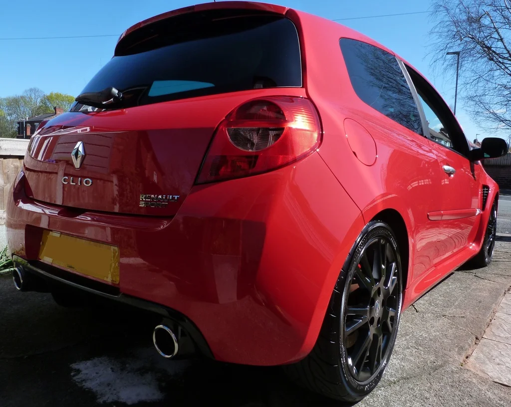

Some more pictures from this morning, after a good clean & glaze with Poorboy's Black Hole
Looking good as usual. Red & black works so well.
We're defo over due a trip to the evo triangle, We need to sort out drive down and a few laps at GYG while were there.
Ultra red is fast becoming my favourite 200 colour.
Awesome mate.
