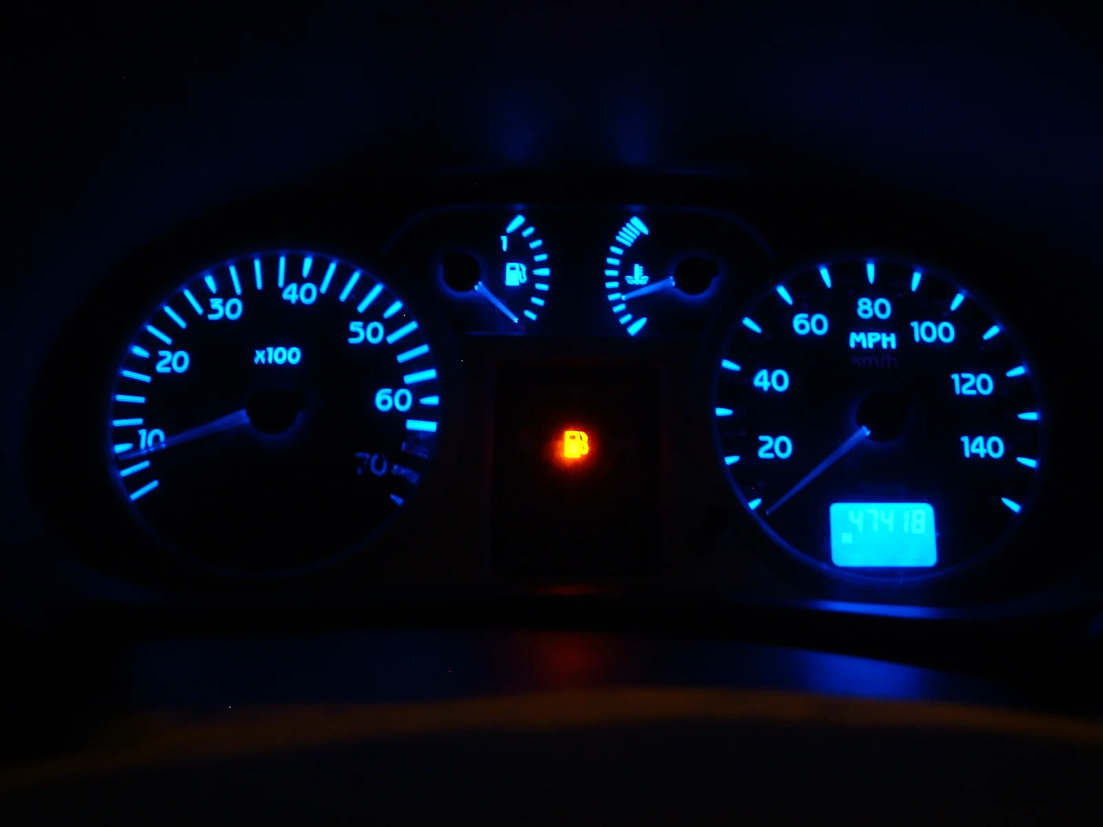

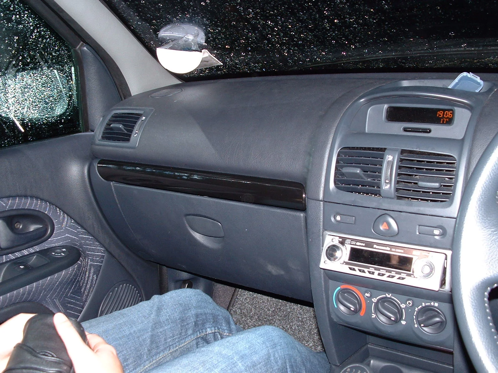

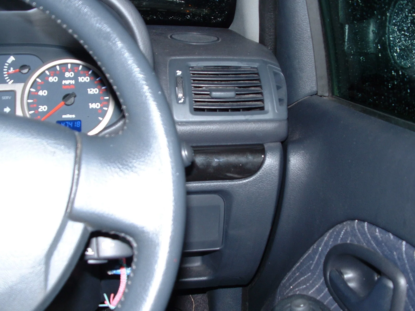

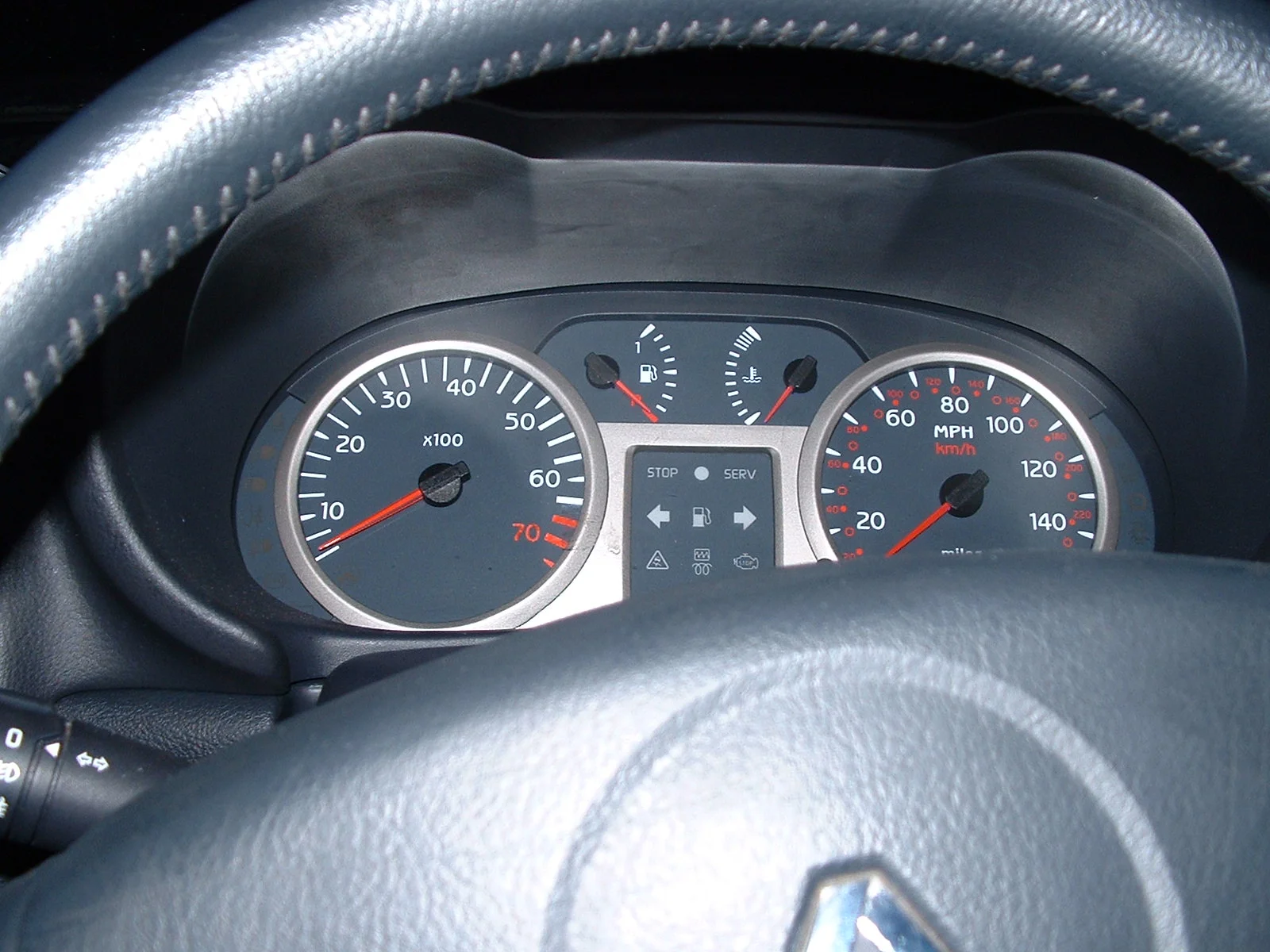

Just finished doing my dash, soldered blue LED's in and painted the last two bars of my rev counter red but trhe light shines through so ignore that as ill be scraping it off!! Painted the dash inserts in pearl black like my car, tell me what you think!

Quite easy actually, bit fiddly for my fat hands though! the rev counter looks mint when the lights arent on, shine through the red when they are though so you can tell it's painted :(
Love the speedo. Did u buy the conversion kit of ebay?? Any tips on how to do it also?
LOL someone needs a new tax disk holder + some petrol, but looks fuking quality wish i could do mine or get someone to do it for me!

Take the dash top off, remove speedo, undo the 8 torq screws on the back and remove front casing, use flat blade to wiggle the needles off and remove rear half which is the fuse board. On that theres 10 SMD lights in certain places which need to have the solder heated and then pull them off. New ones just solder in place making sure the polarity is right!
If you buy the kit from ebay it comes with intsructions, not the best in the world but they are instructions i guess
Easy peasy!!

Thank you guys, inserts prefer to the dials! In the dark the dials and in the light the inserts but if everyone likes then im happy!
