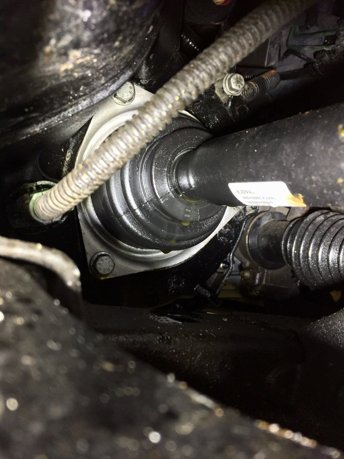

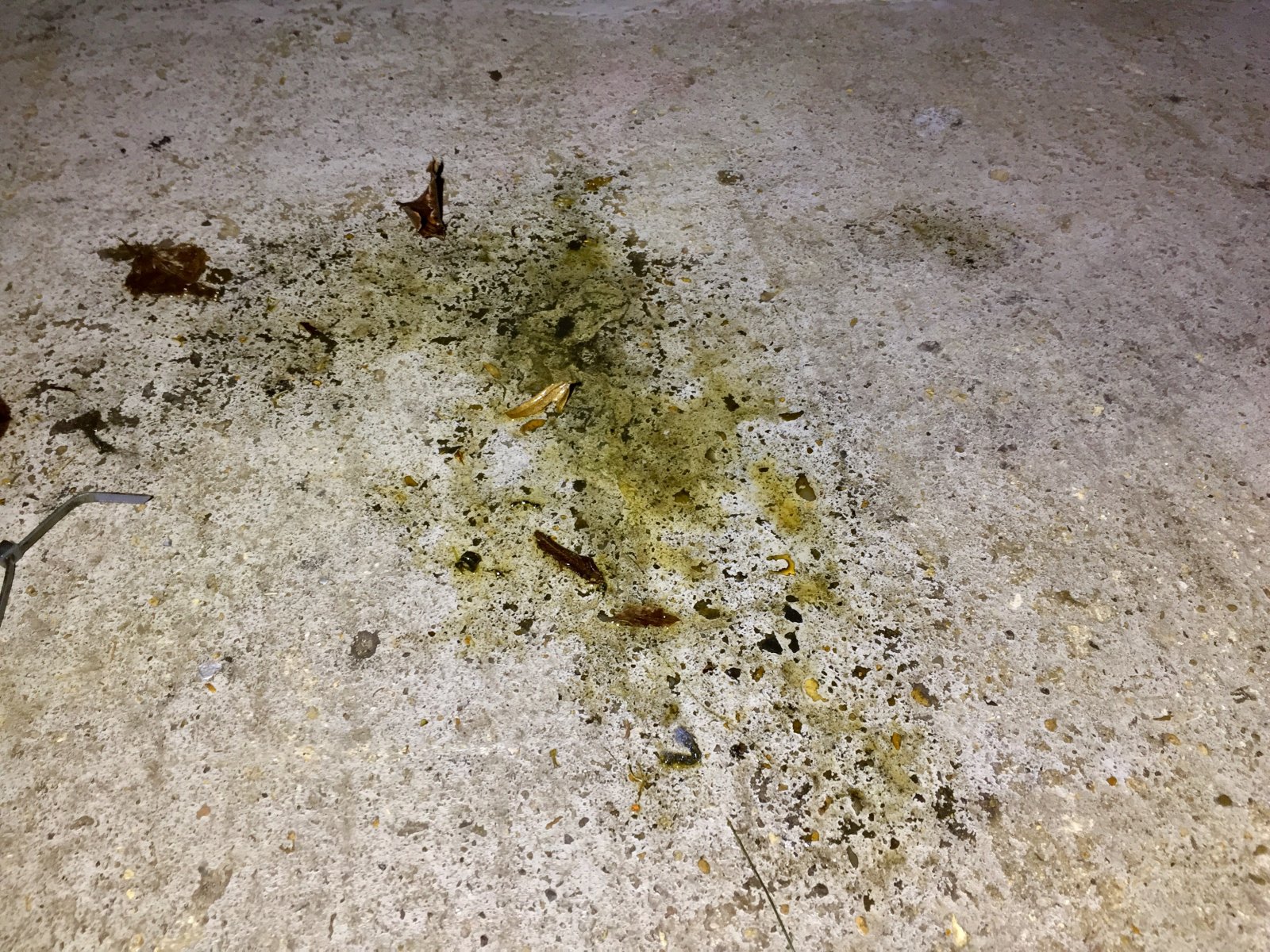

New driveshaft is leaking more than the old new that I replaced after going to the Ring.
Gen Renault part is in the footwell now.

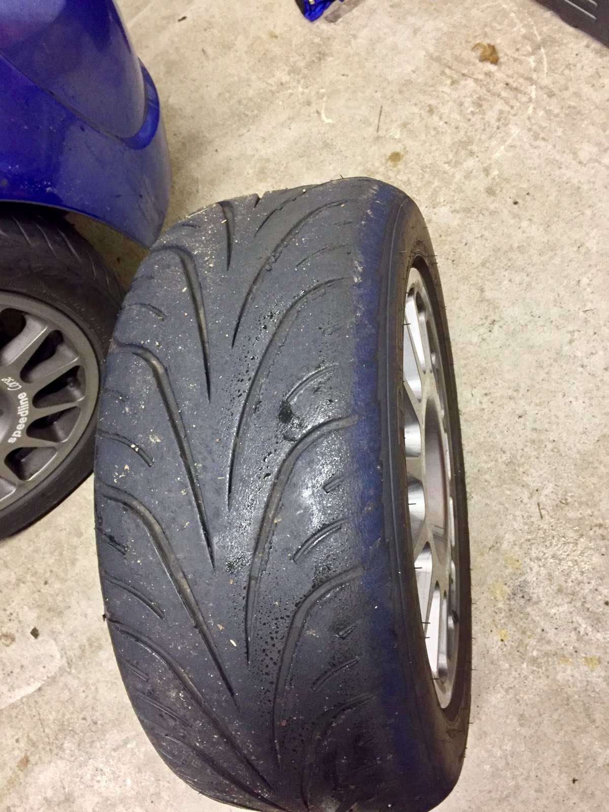

Tyres took so pounding and heating from Gerard's at Mallory park too lol

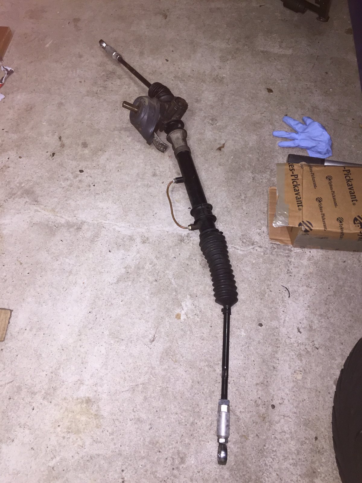

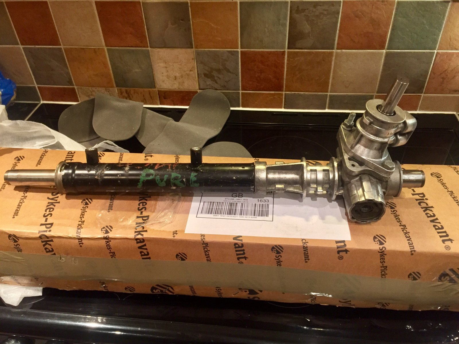

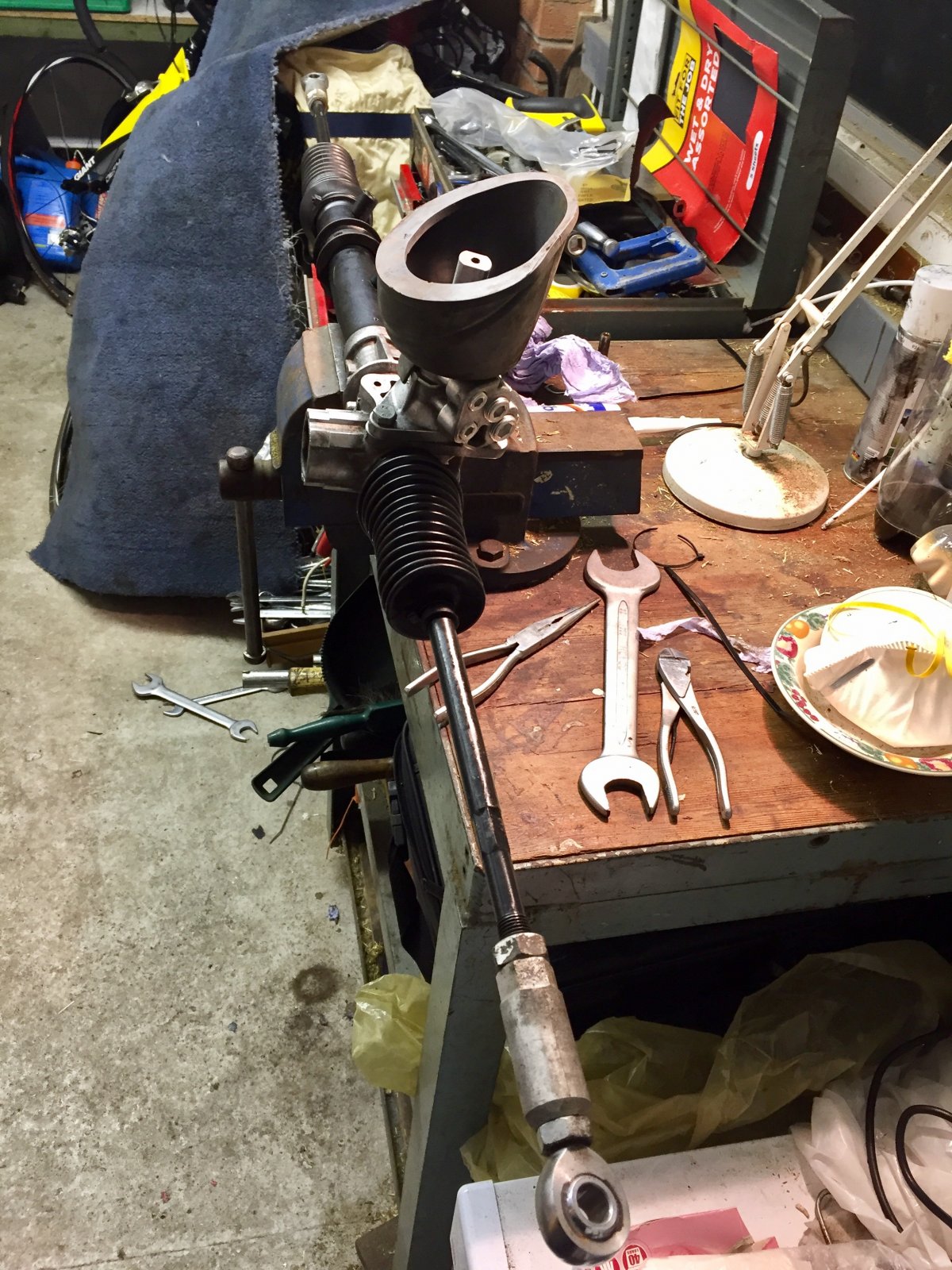

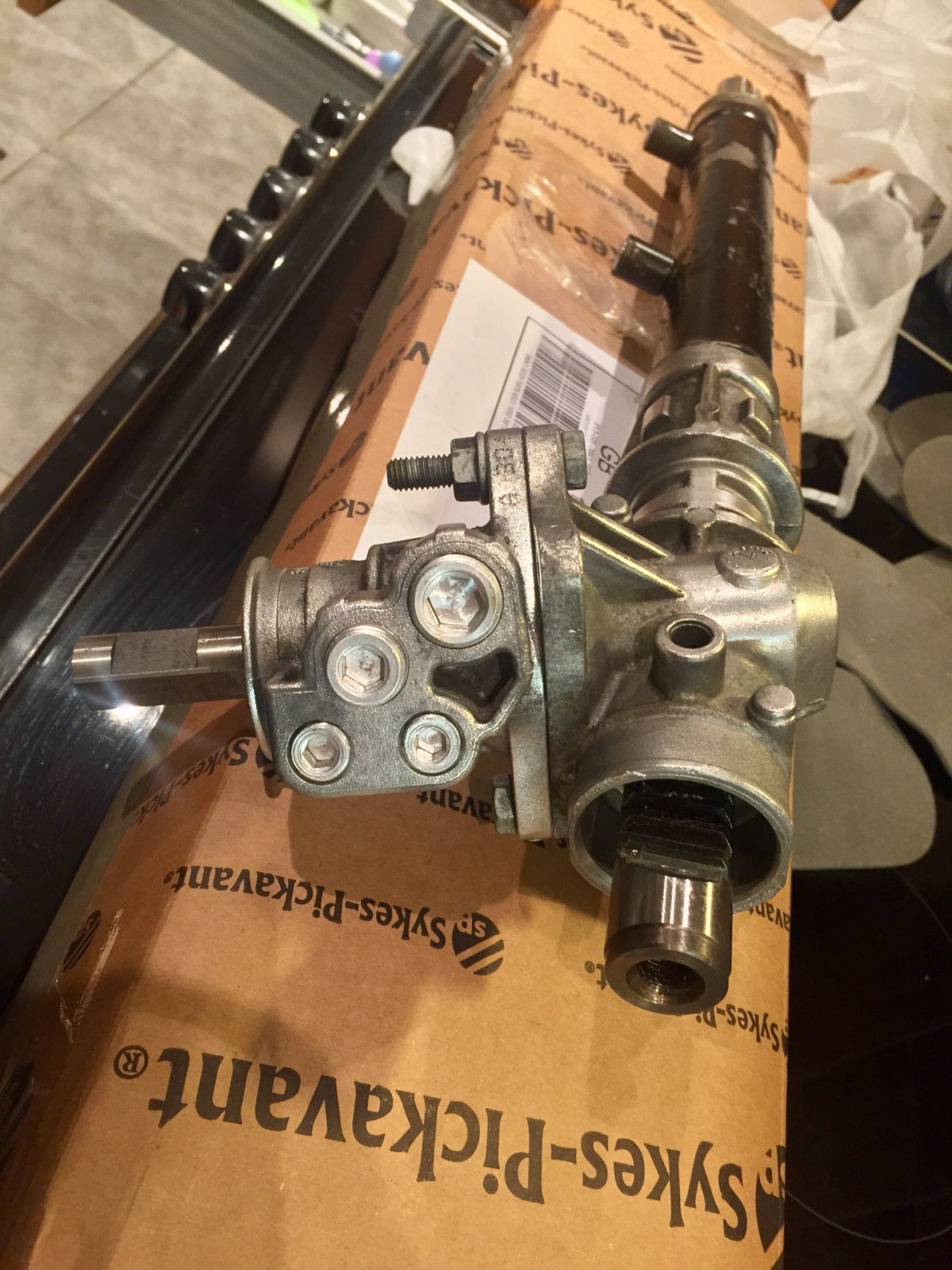

Whilst I'm changing the drive shaft the rack looked piece of cake to change so ordered a PMS quick rack. Been wanting one of these for ages. Can't wait to try it feel like a big kid. :laughing:
So Pure rack
Pulled the old one out the drivers side wheel arch. Didn't need to drop the subframe

Really like to know how the quick rack is to drive compared the stock one.

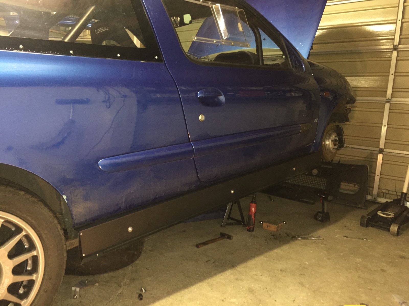

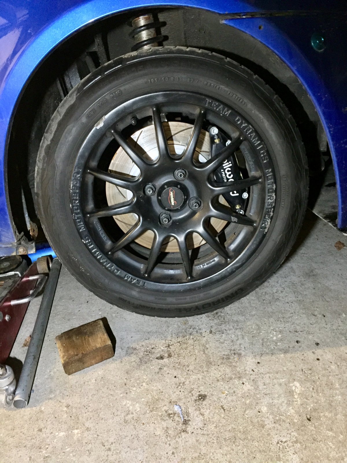

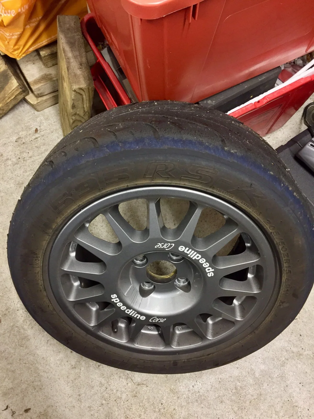

Finally got the Clio in the garage to carry out some work :smile:

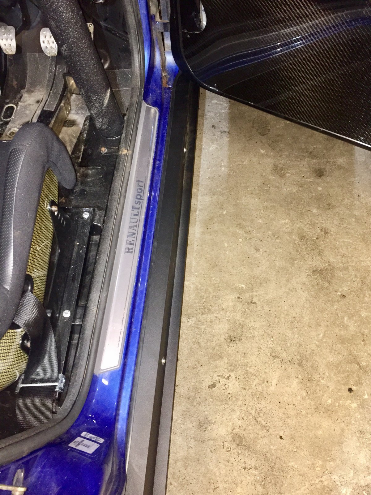

First off check some wheels cleared my brakes that I aquired
Put track rods and gaiters on new PMS rack and fitted that.
I had a woopsie moment with my side skirts so ordered some BYC skirts instead.
Started fitting them and got one side complete

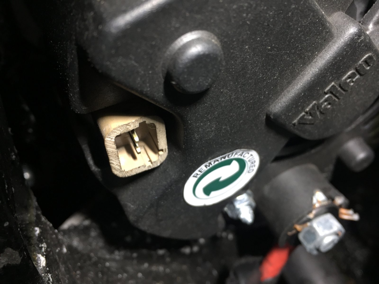

Also found my alternator plug had snapped along with my power terminal for the alternator. Guess this was my starting issue at Mallory and guess it's the vibrations from my PMS mounts.

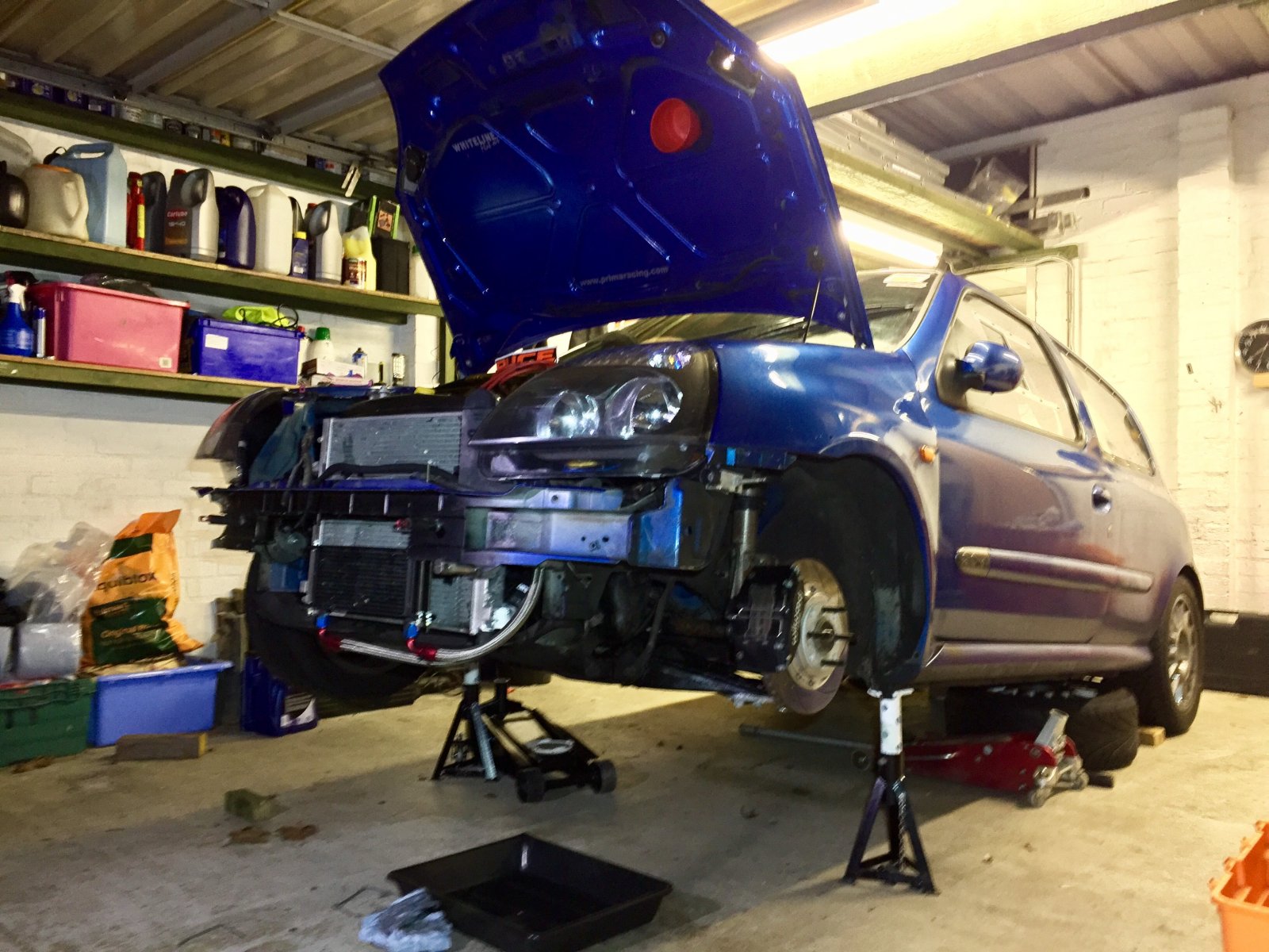

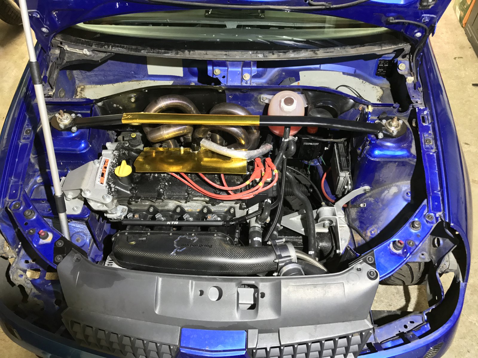

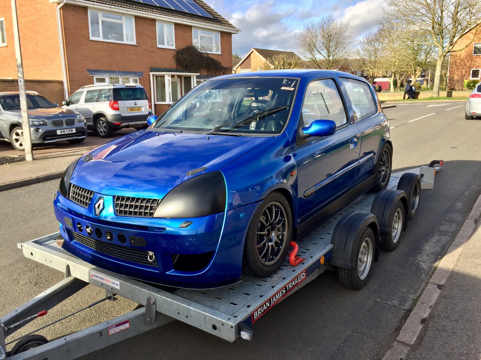

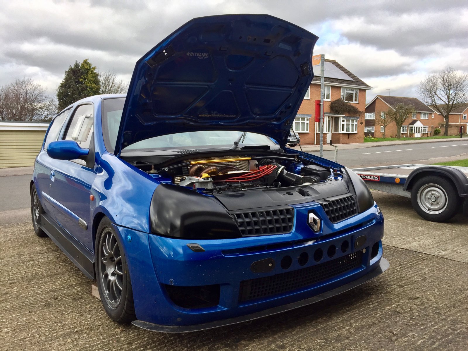

Dragged the Clio out today for oil check and nut and bolt check for Mallory on Sunday.
Few changes most visible other than the quick rack fitted, new front 595 tyres and lost the passenger seat.

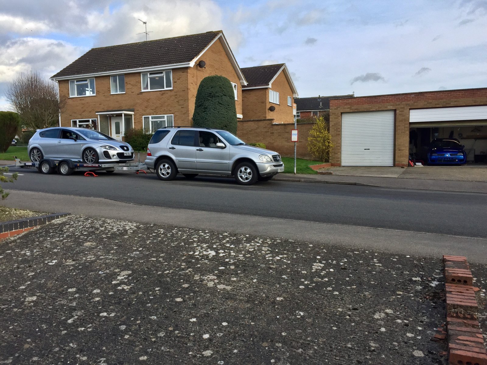

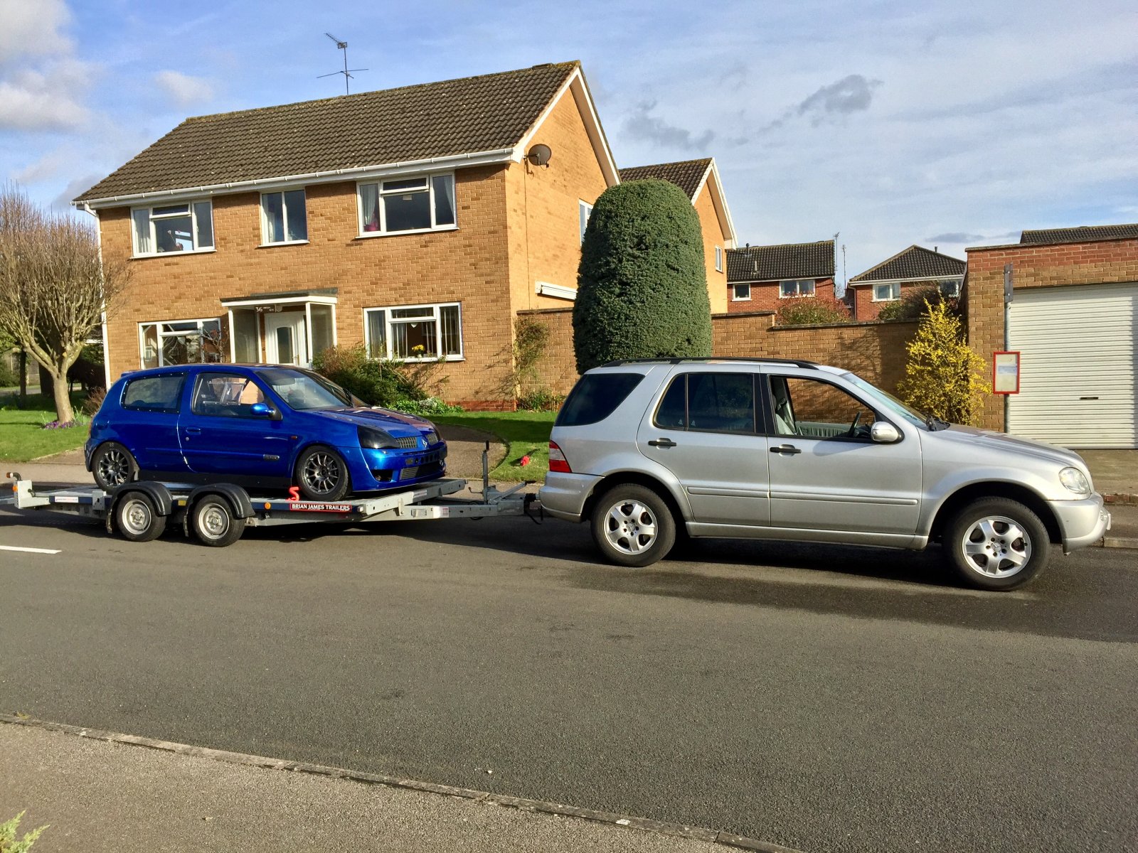

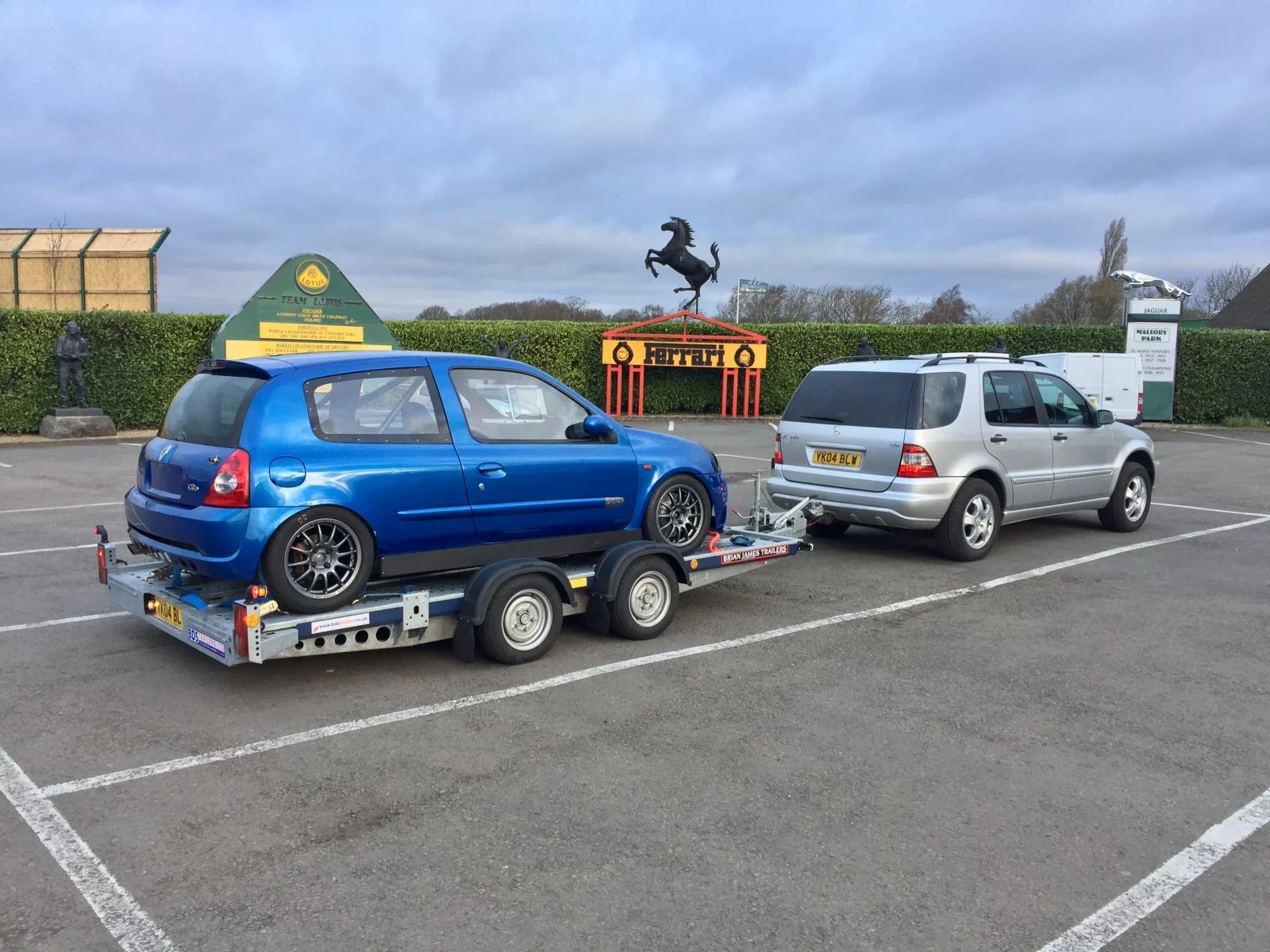

Once the Clio was done it was time to check over my ML and new trailer thentest the Clio went on with the bumper on.
Threw my daily on too

How is the quick rack to drive compare OEM one ?
Is it that much difference?

Thanks bud, it's epic to drive which is the main aim.
Cars not road legal so only took it around the block but can feel a difference, I'm at Mallory on Sunday so will see how it compares to September and report back.

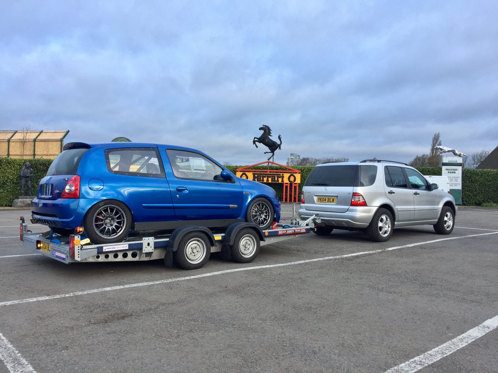

Had an awesome day at Mallory. Was abusing the car all day and it took it all day.
Was so much grip and able to carry a lot of speed. Was maxing out 4th down both straights.
The quick rack was amazing. Had to relearn the track but after a few sessions it was spot on!
Only issue I had was when I went to load it on the trailer. Immobiliser kicked in, fuel pump won't prime and it refused to start!!
Had to push it on the trailer in the end!

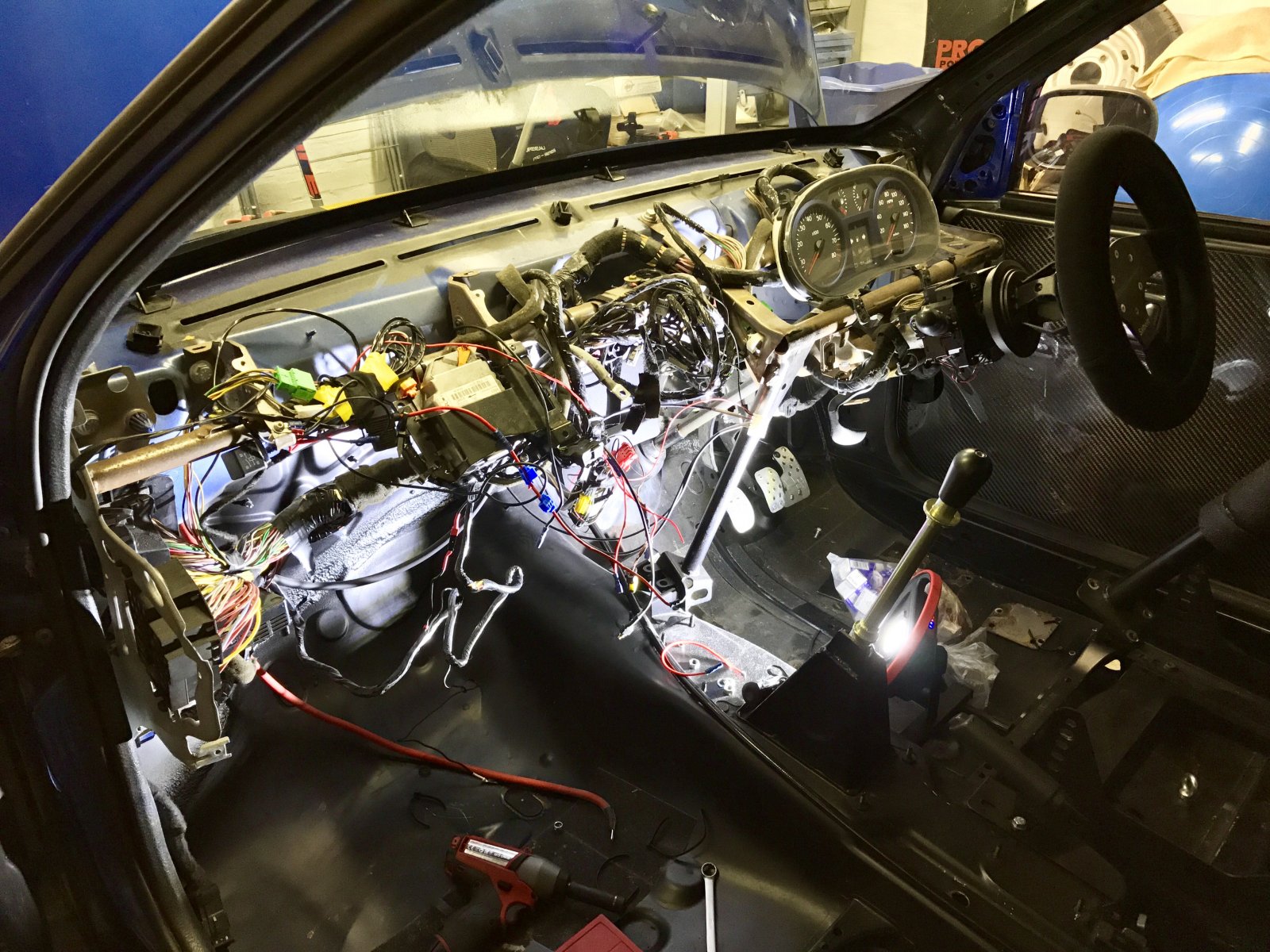

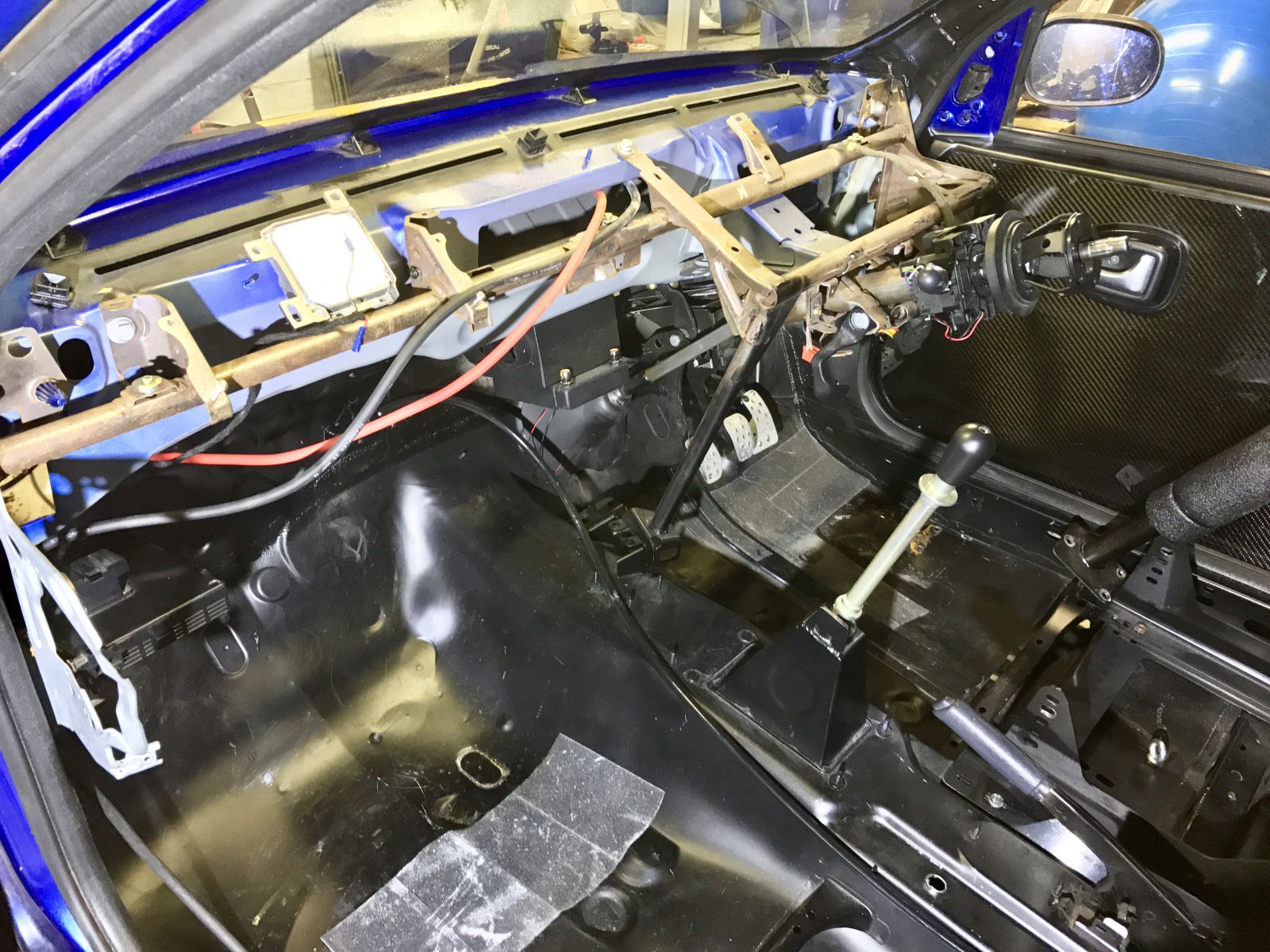

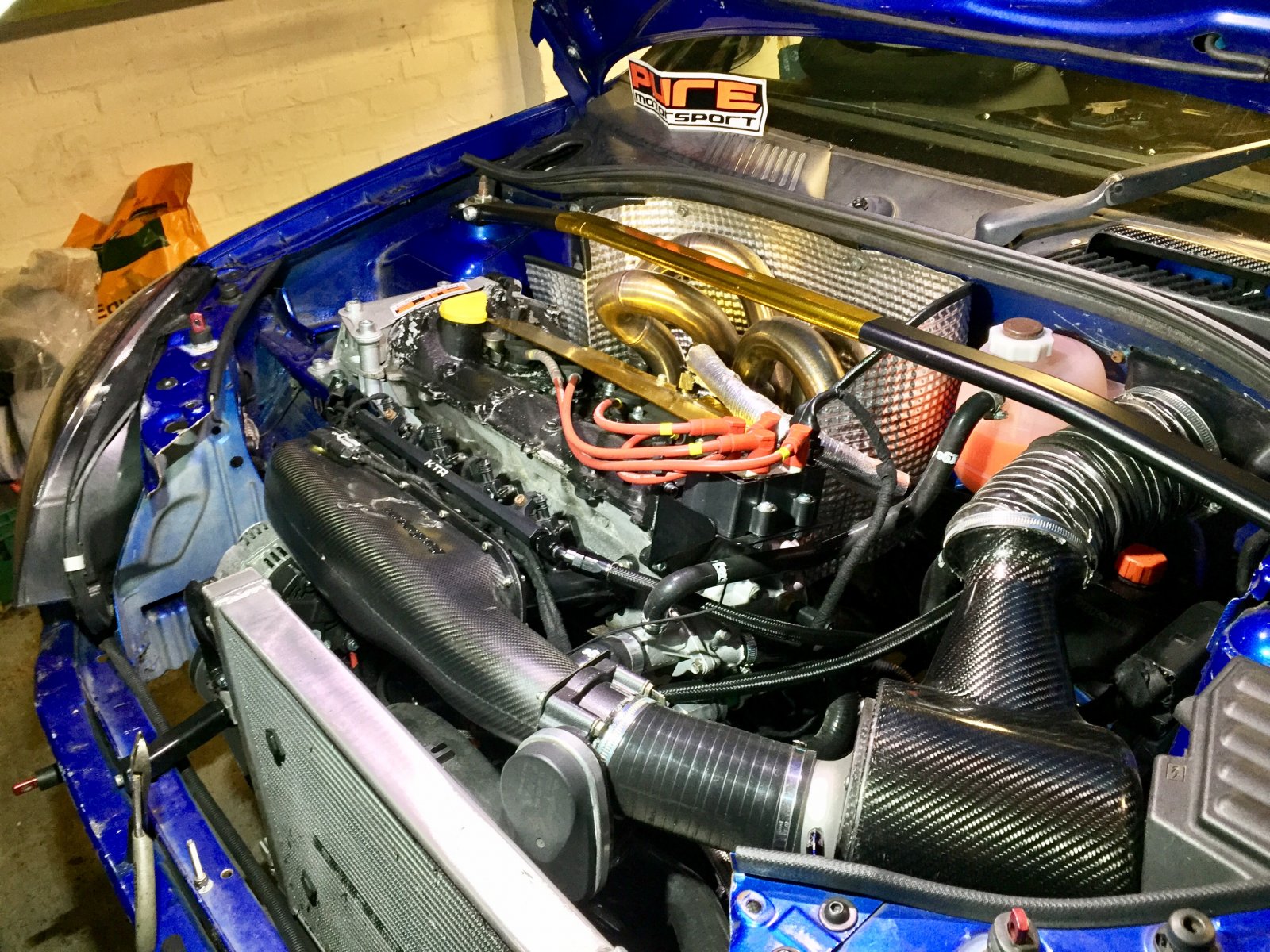

Well as the weather was so nice I decided to look at the Clio.

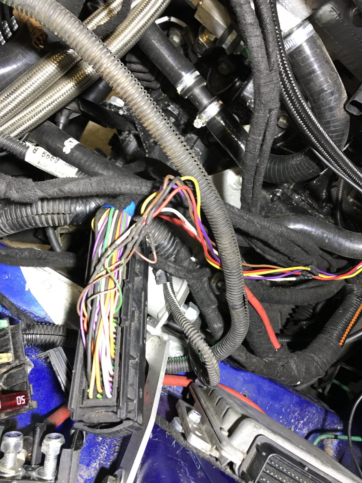

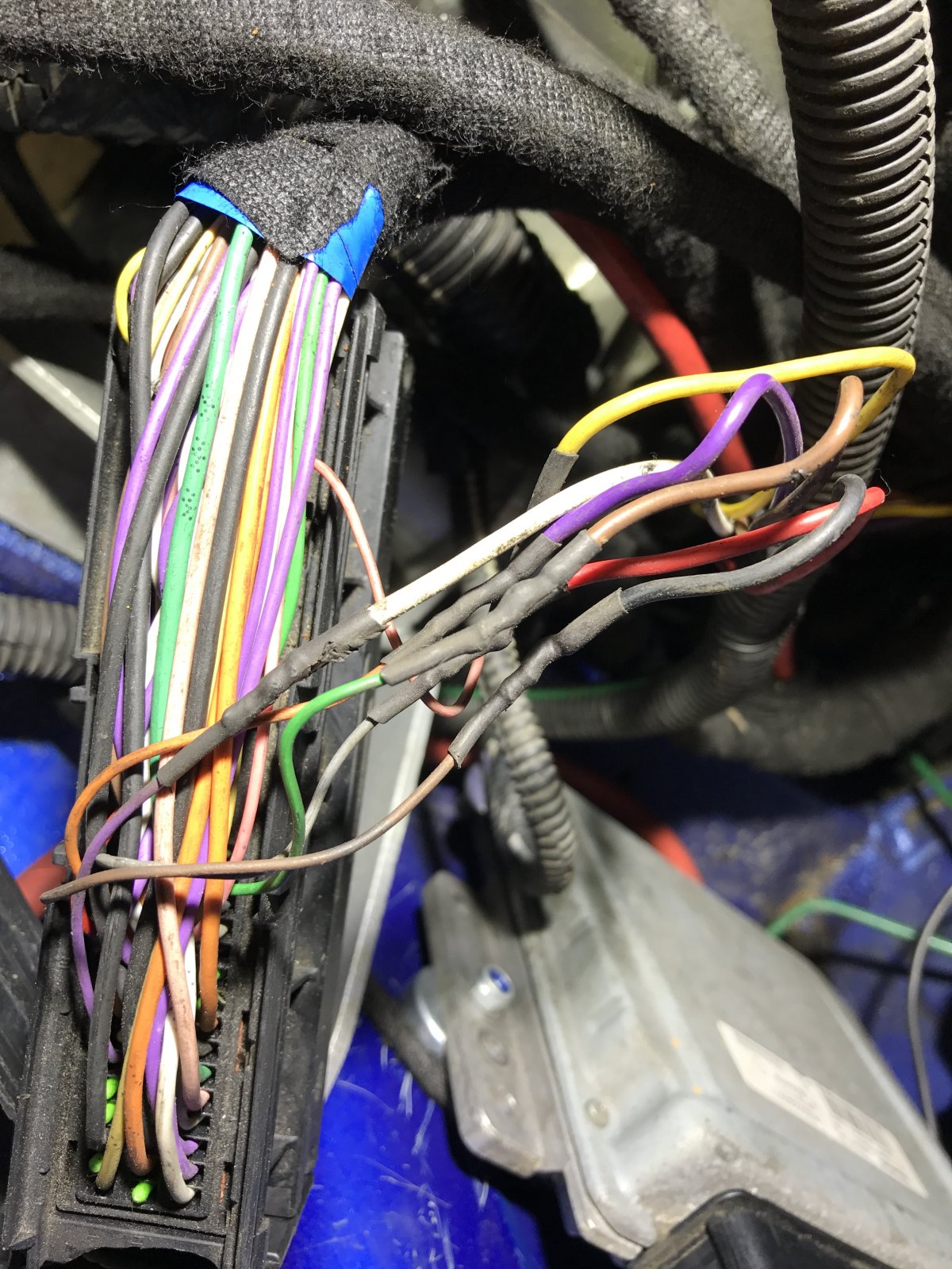

Ended up removing the whole engine loom and started taking the interior apart to remove that loom. Also got out my spare set of looms and went through them ready to put on.
As I started going through the old engine loom I found the throttle pedal had been wired directly to the ecu.
Chambers_RS
  Clio 172 Cup&Leon K1
Is there enough slack in the loom to pull it over to where your ECU is ? I remember mine being quite tight !
An idea to get yours out the way @Fletcher
I had to undress the loom and retape it all to get it the ecu there and have the wiring nice and tidy. But I had it all apart to make it tidy for fitting the RS2 inlet as well. Easily done tho

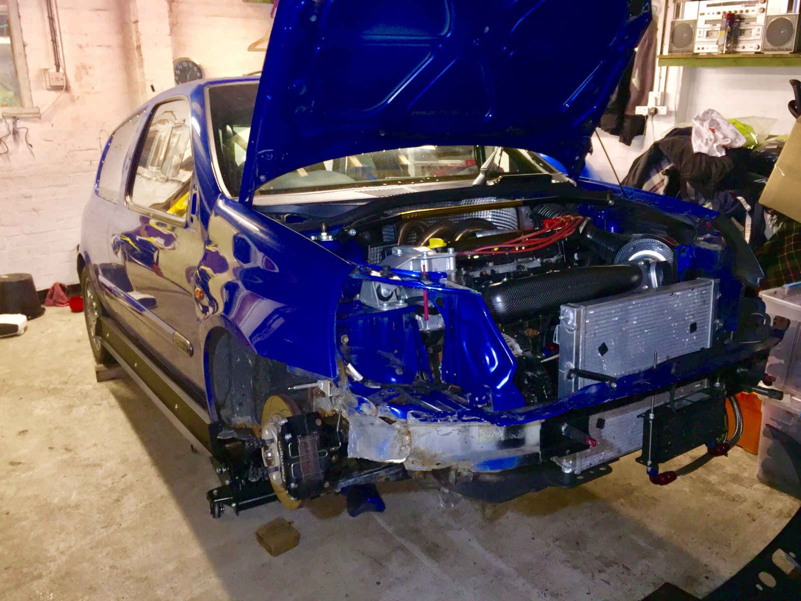

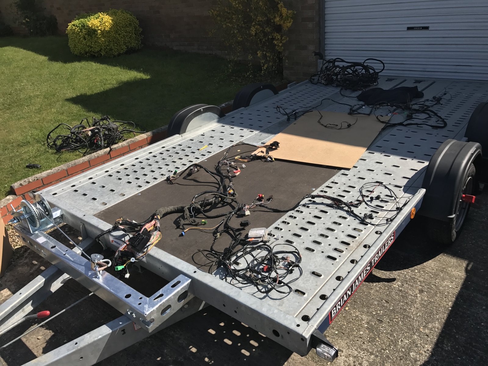

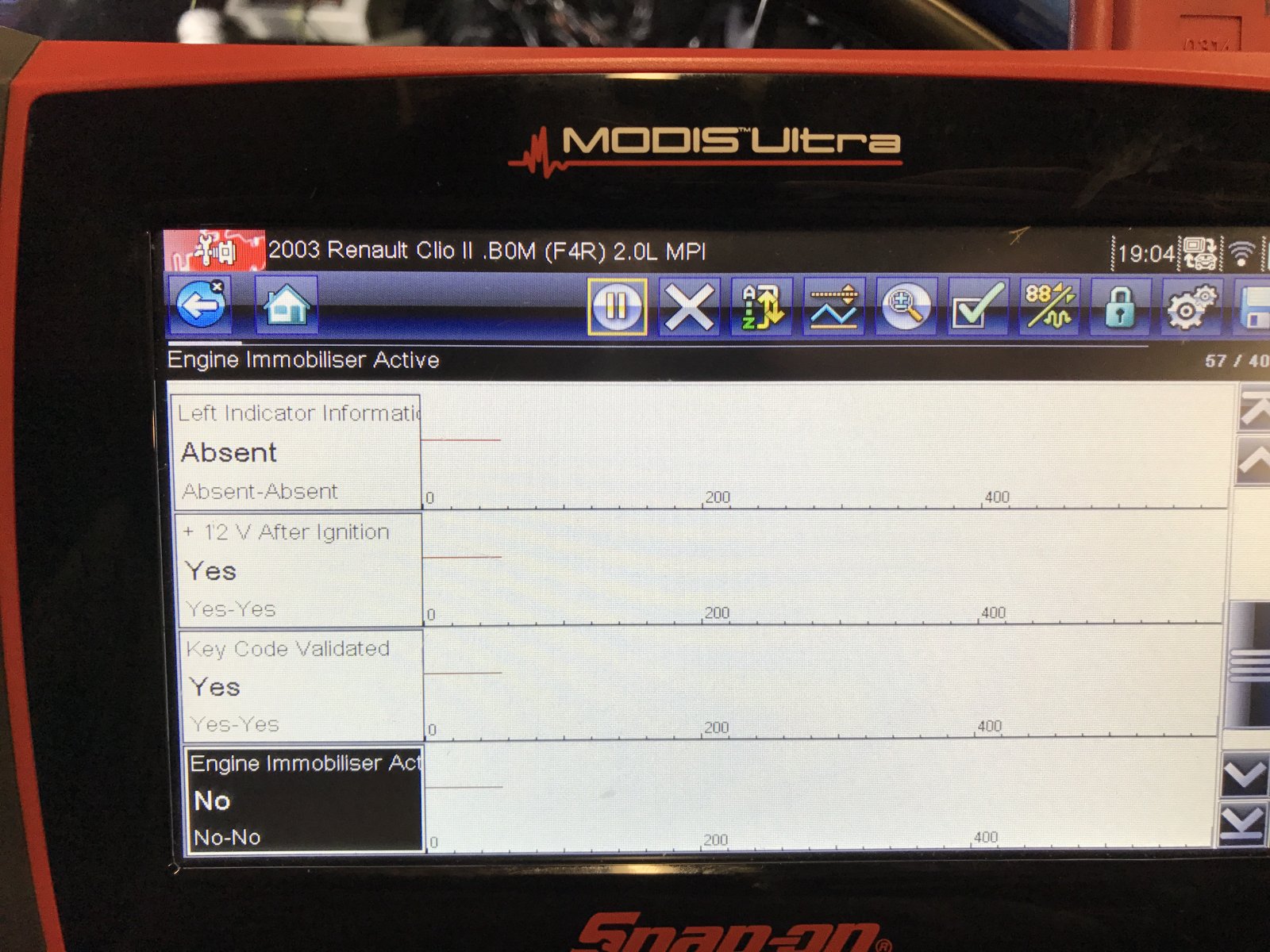

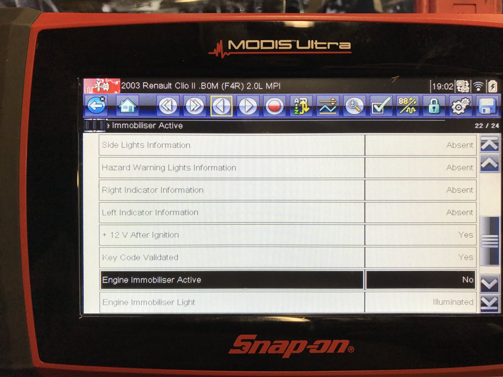

Since Mallory the Clio has been messing me about and not starting and finding wiring issues I decided I needed to rip the complete loom out and throw another one in that I knew was good.
Few pictures of progress
Whilst it was like this I ordered a new gauge

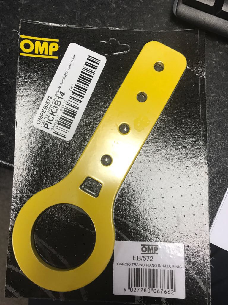

And tow eye as mine went missing at Mallory lol
Any new loom in and connected hoping problem solved. But no.
Solid red immobiliser light, no fuel pump priming and guessing no spark 😢
Plugged my snap-on machine into it
Anyone got any ideas, I'm losing the will 😂
Chambers_RS
So no progress with my immobiliser faulty I got a spare ECU, UCH, key and decoder ring.
Fitted it all and the immobiliser started working as normal, red light didn't stay on car turned over over as normal and did stay and try to run. It didn't as it's a standard map/ECU.
Fitted my ECU, UCH and key etc and the immobiliser light stays solid and car won't turn over properly :expressionless:
Is something knackered???? Driving me mad lol

Sent my ECUs to Chris at EFI on Tuesday and received them back today :smile:
Absolute mega service considering Chris said it would take a couple of days to get round too.
He swap my map across to my spare ECU which was an early PH2 ECU with old software on, so he kindly transferred the later software onto it aswell as resetting my immobiliser code :smile:
Can't recommend Chris at EFI enough, hopefully I'll be able to fit the ECU set and have no more problems.
