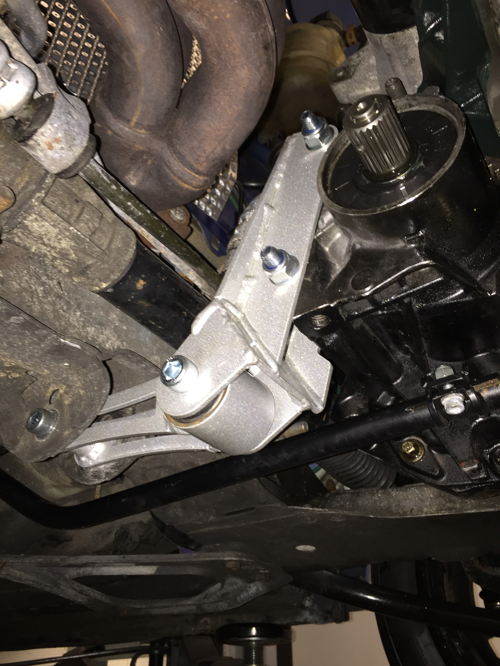

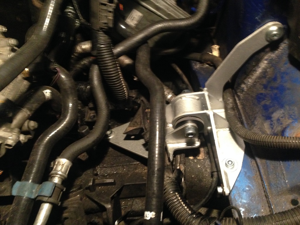

Anyone got a pic of the Pms dogbone mount fitted to a phase 2 can't get my head round it lol
Although I haven't looked under the car yet lol

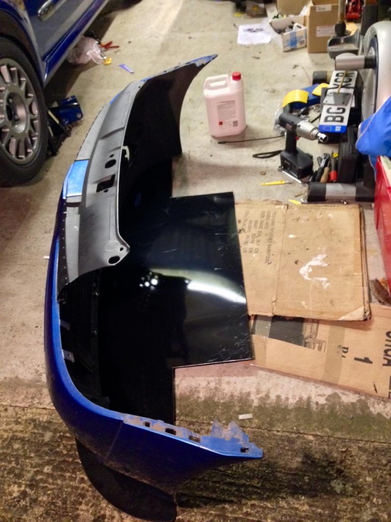

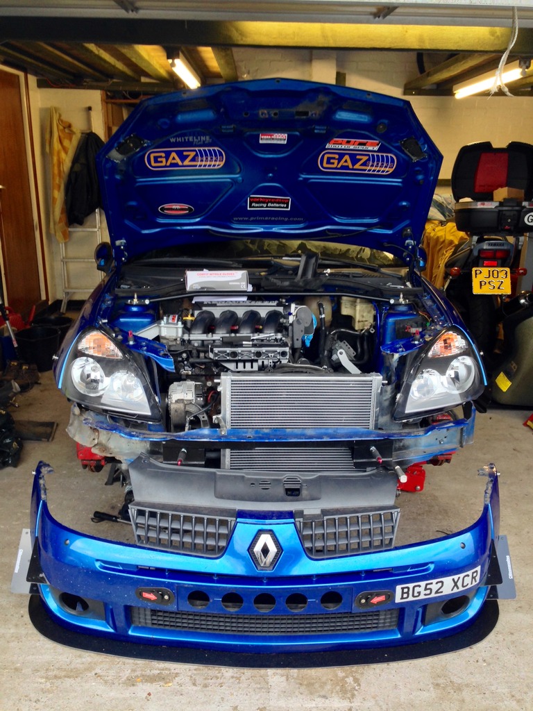

I have the same CMComposites front splitter. Where did you drill through and secure at the subframe?
I drilled to holes at the back of it, either side of the subframe when fitted and just used cable ties to stop it flapping around. Need it to be quickly removable lol

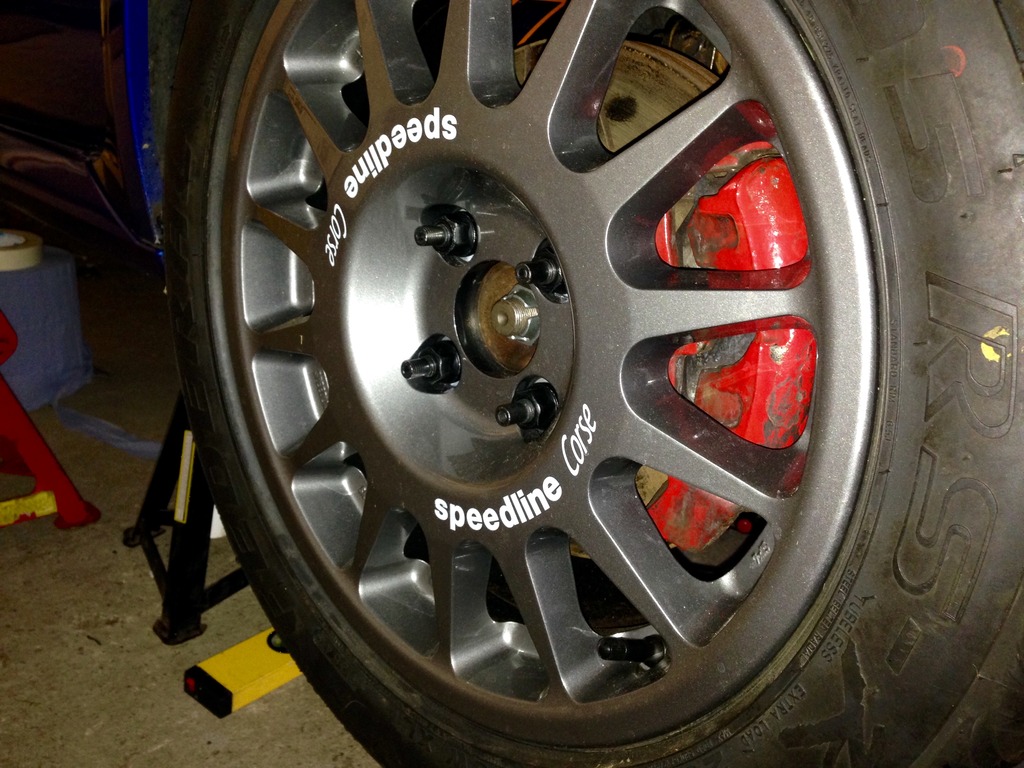

Ahh I need some brakes for the front.
Gotta go under 15in speedlines
Only ones I can find that I like are the jamsport hispec kit with the AP bells and rotors.
Any ideas on others? Want them to be lighter than the brembo 197 aswell.

Will the hispec kit fit under 15inch speedlines do you know?
That's why I was looking at the jamsport kit.

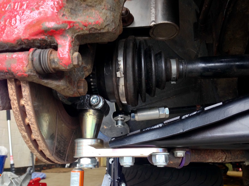

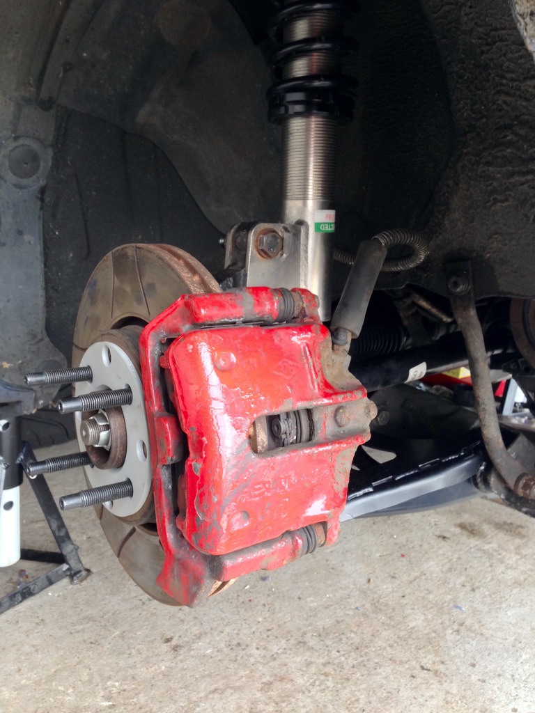

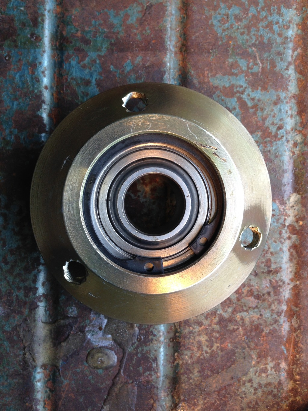

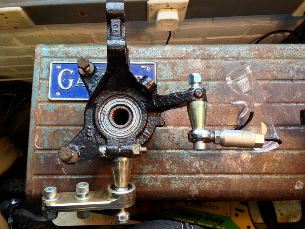

Finially fitted the new RC hubs.

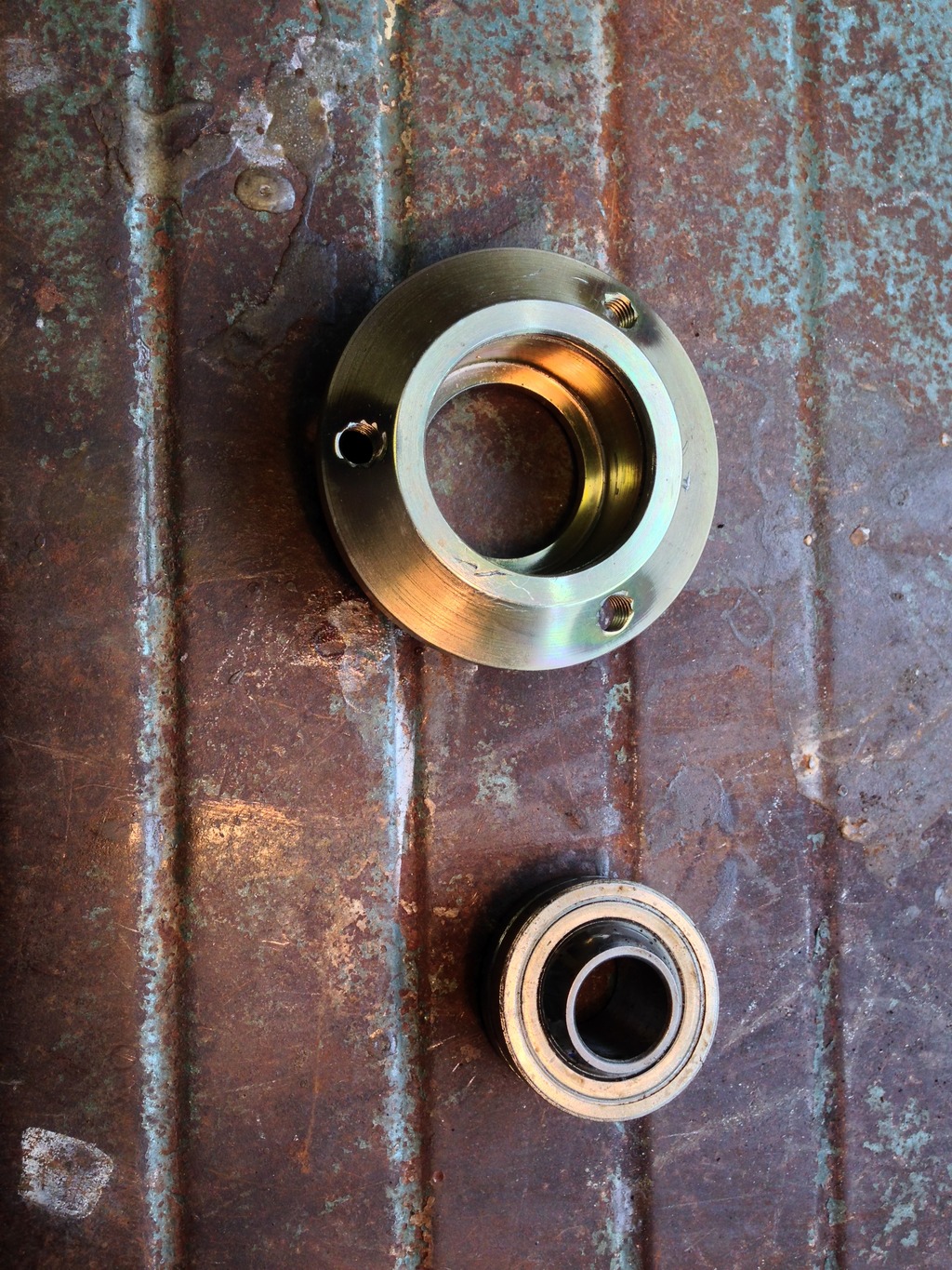

Fitted the pre-loaded bearings from Pms into the solid top mount
Old bearing pressed out
New pre-loaded bearing in
Engine mounts on and all torqued up
New purchase
GrahamS

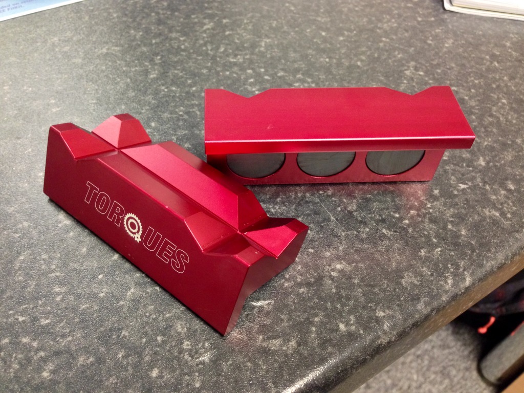

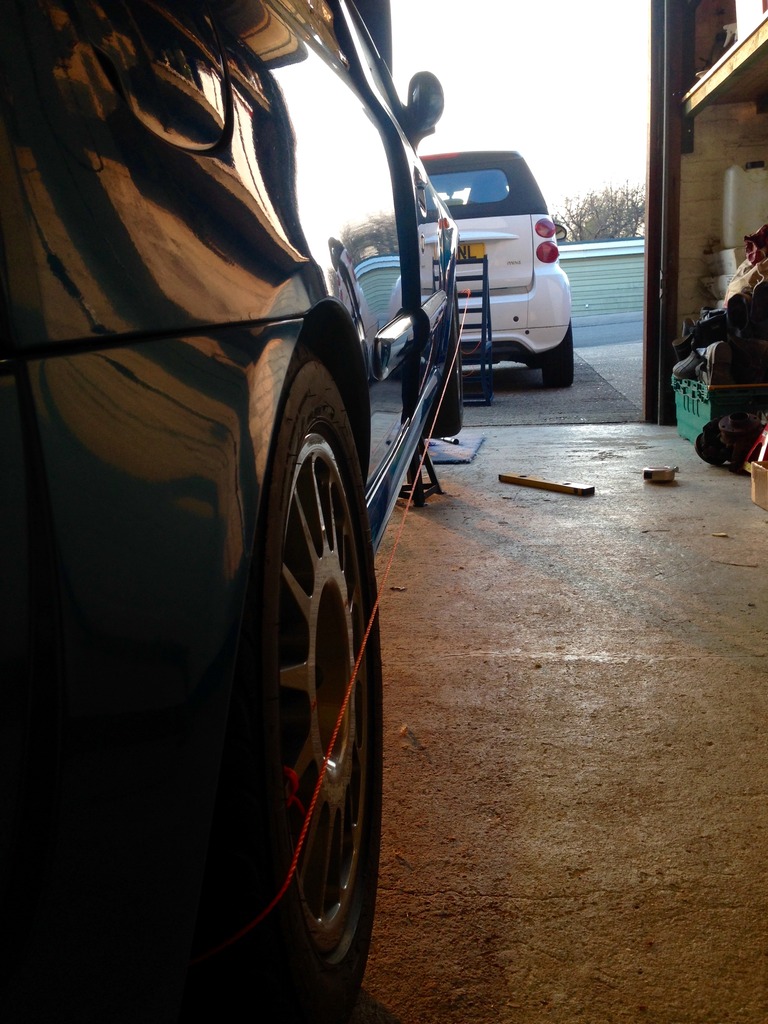

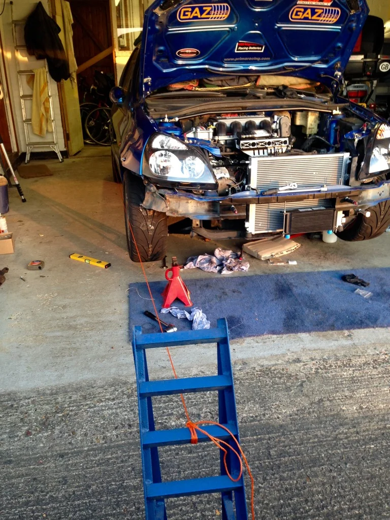

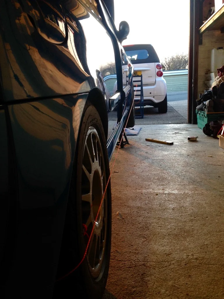

Those vice inserts are very cool.
Do you not find the string is a little thick to get an accurate measure? I normally use fishing line with the car on the ground. I'm sure you've done all that really though!

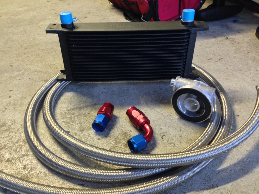

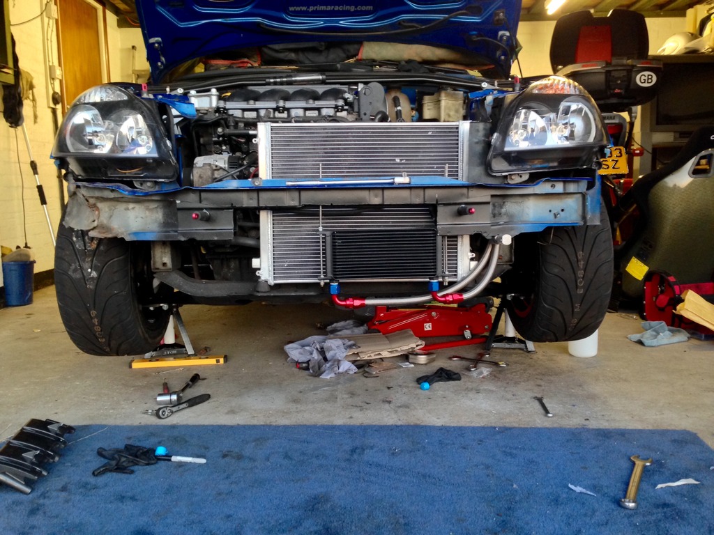

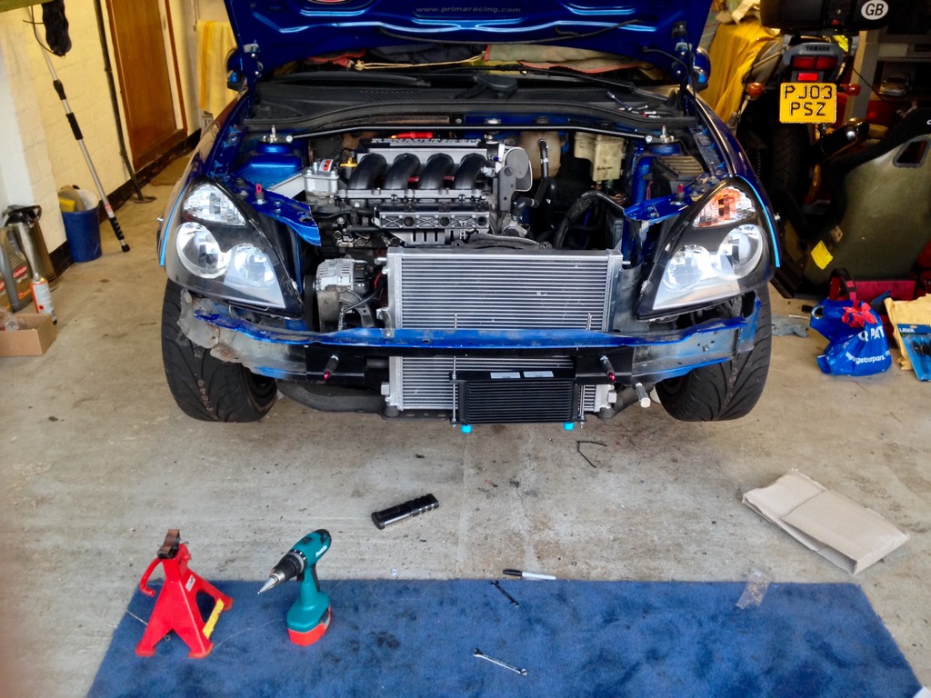

Is that just a generic oil cooler and you make the lines yourself or part of a kit?
Chambers_RS
  Clio 172 Cup&Leon K1
Yeah they're pretty cool, should save me from getting stabbed by the braided hose lol
Tbh I only used string to get the car moveable and to get it somewhere to be tracked properly.

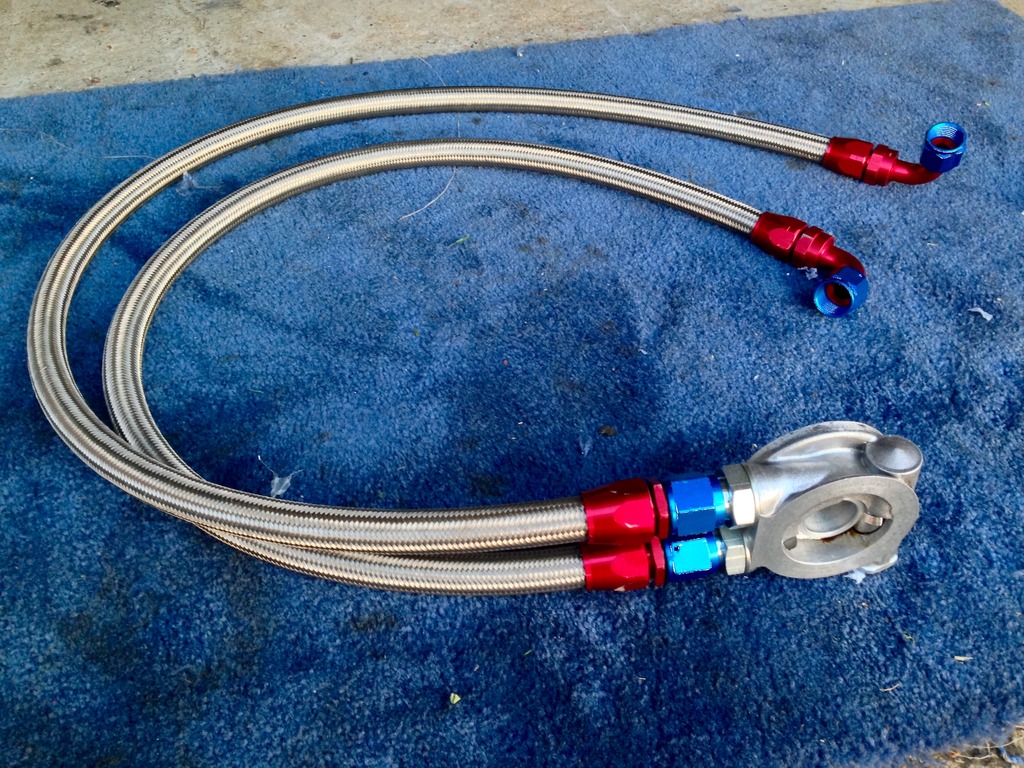

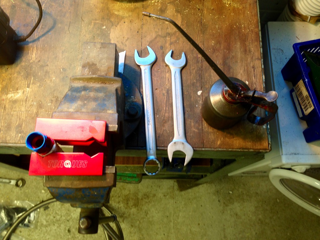

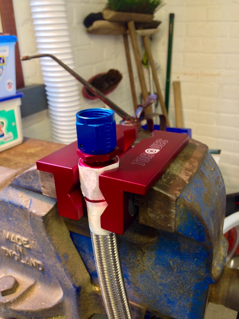

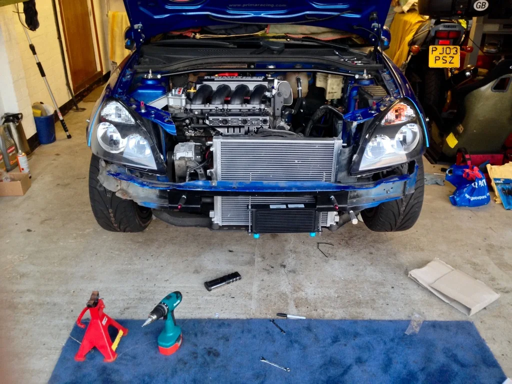

Finished off the oil cooler setup.
Hoses made up.
Tools used
These jaws where well handy
Oil cooler with lines

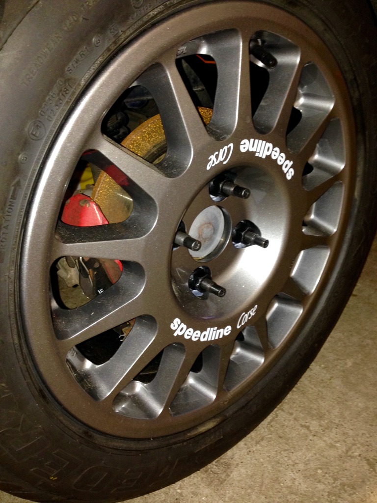

Wheel stud and nut kit fitted
Rear with 3mm spacer
Front with 5mm spacer

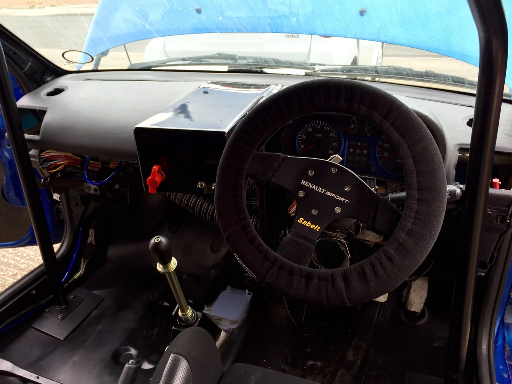

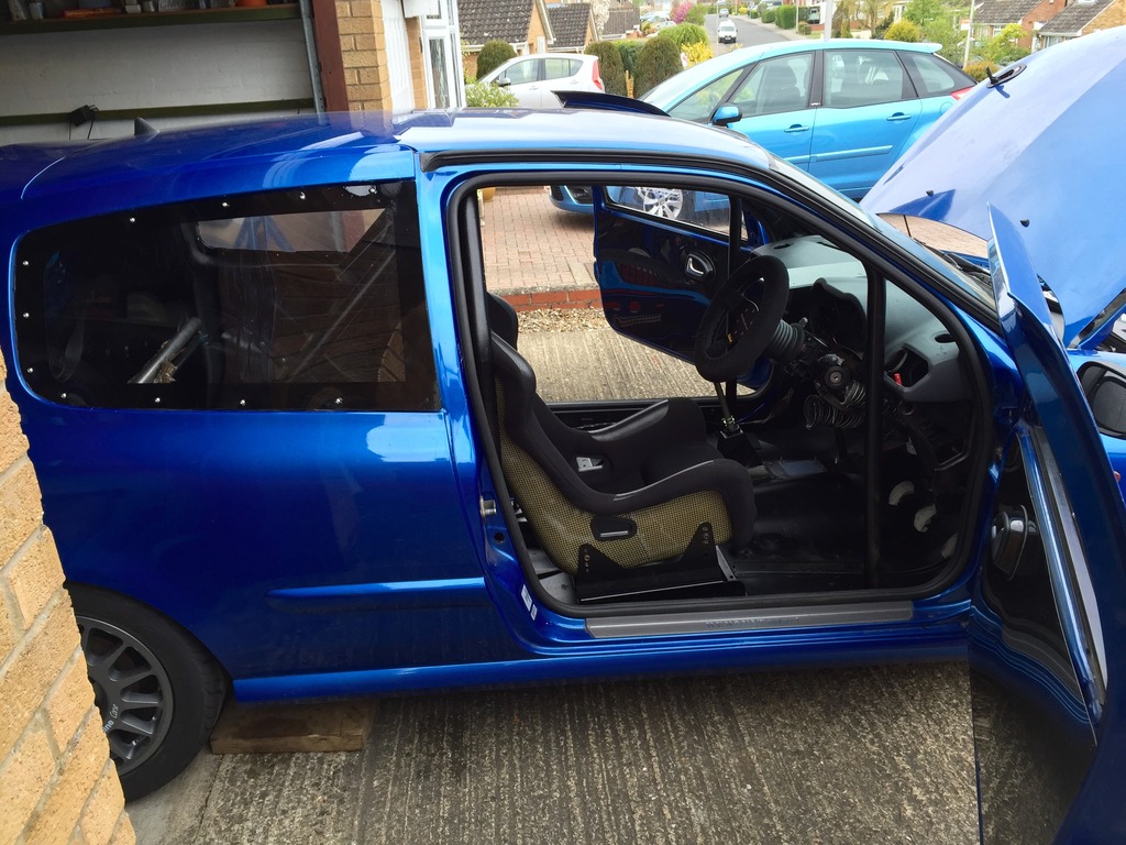

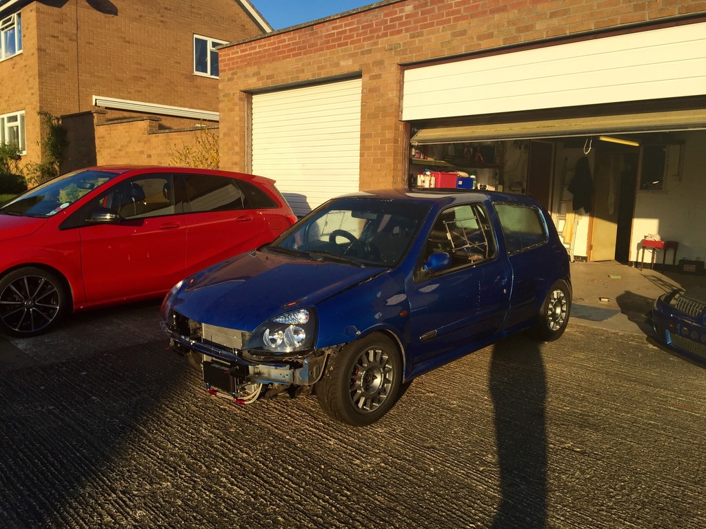

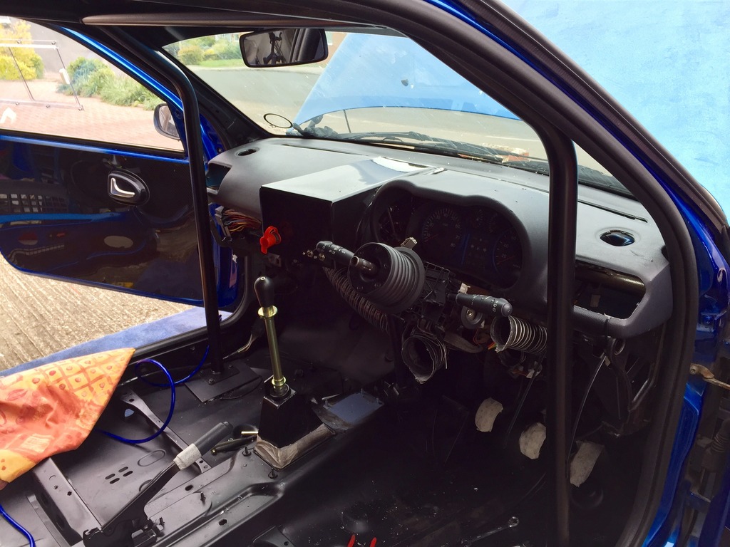

Clio's looking more like a car now.

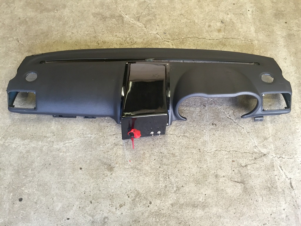

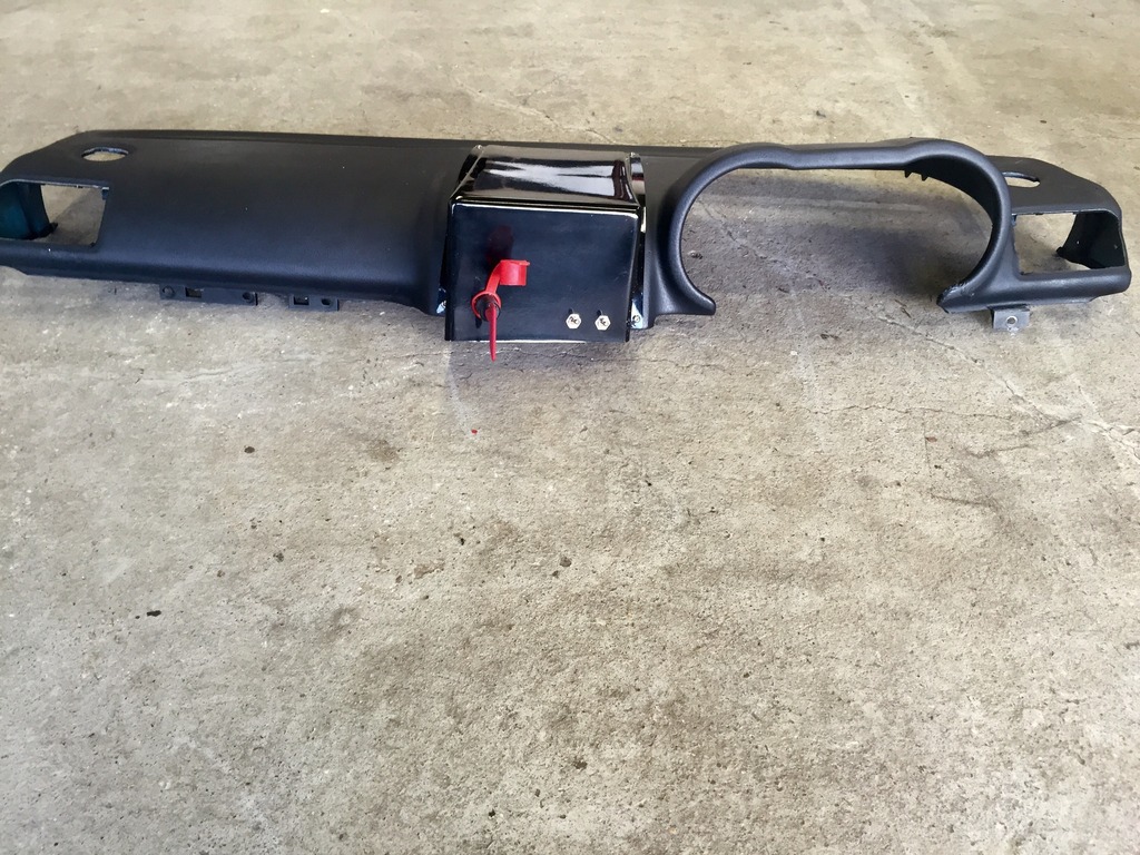

Sorted the dash out
And lobbed it in. Was a right fight and was rather floppy so had to make some brackets to support it.

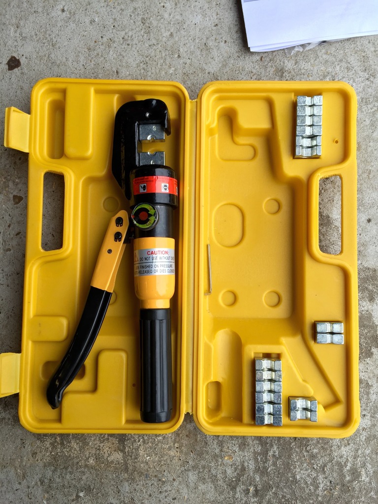

I brought these hydraulic cable crimping tool to wired up the battery.
Also relocated the OBD port and airbag ecu (not that I have airbags but I don't wanna cut up the loom just yet)

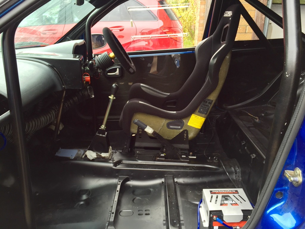

Got the drivers seat in and the engine all back together
With the car out side and wired up thought I'd go for a run in it round the block, turned the key and it won't start. 😧 not sure why yet, engine turns a quarter and stops then there's a loud clicking noise so hoping starter or something simple.

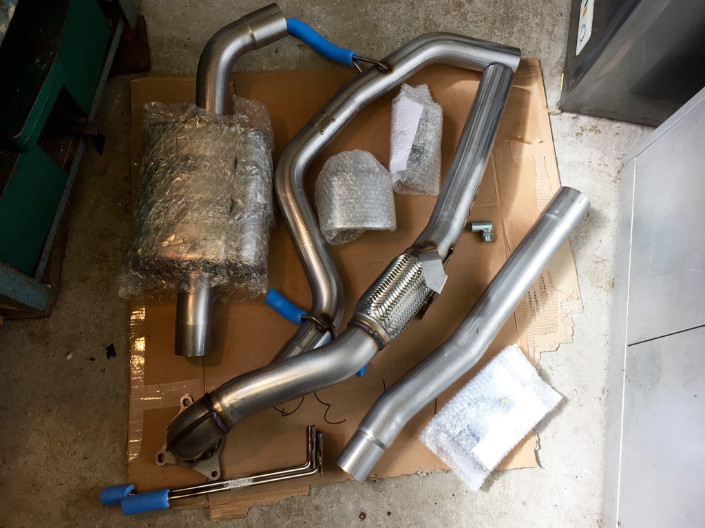

Spent most the day on the clio so today I'm gunna put he exhaust on the K1 :smile:

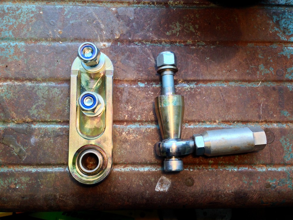

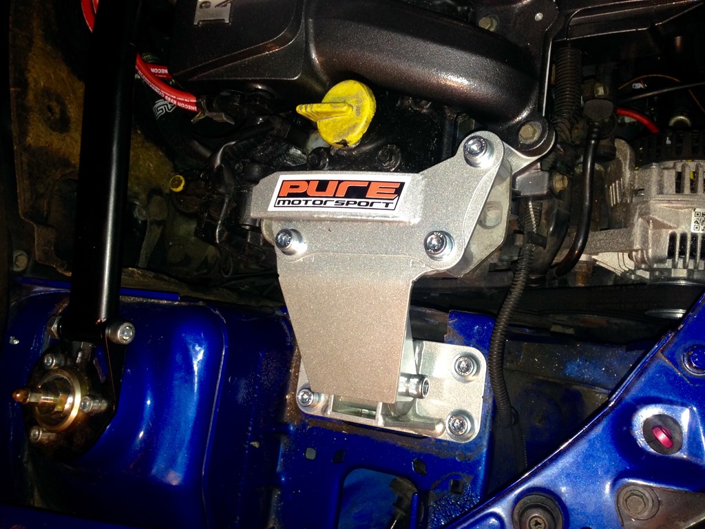

This is mine.
Took a while to get my head around the fitting, but once we got it, it was a straight forward fit

This is mine.
Thanks, I did finally get it on, figuring out how that fitted was the hardest bit about fitting the PMS kit lol. Should have that pic in there instructions lol.

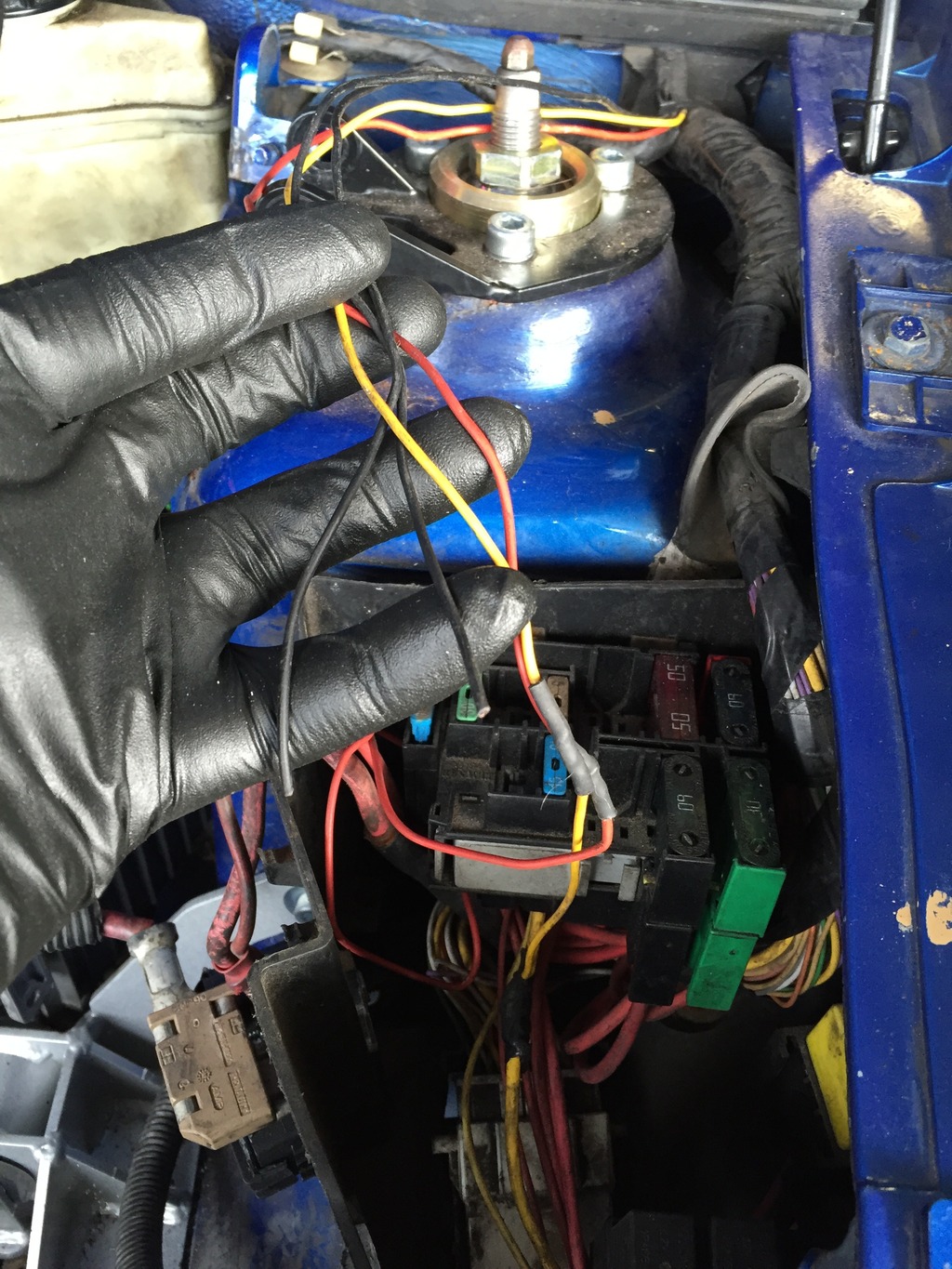

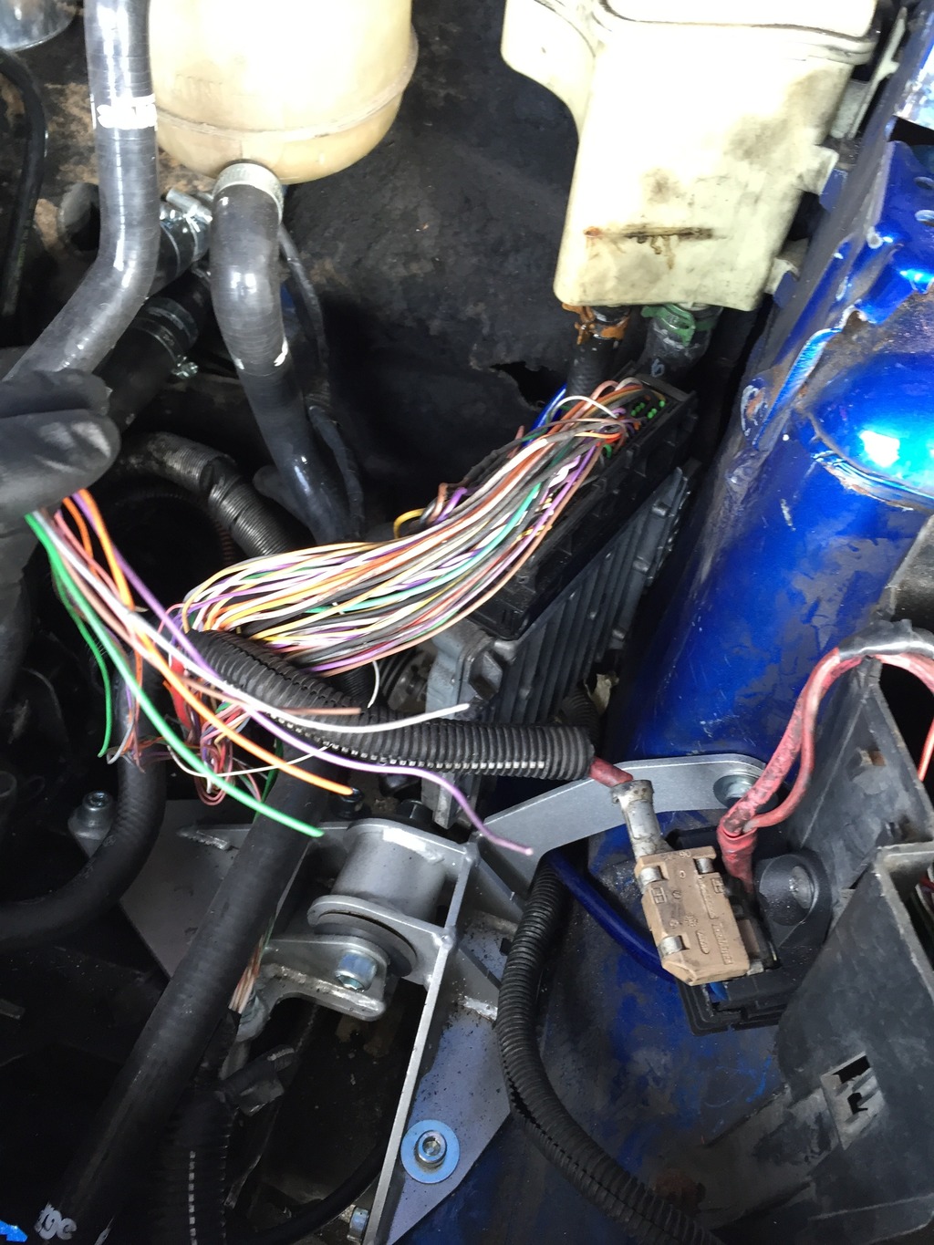

Having issues with the car starting.
I've checked all power points and the battery which are 12.6v. When cranking the battery drops to 11.6v.

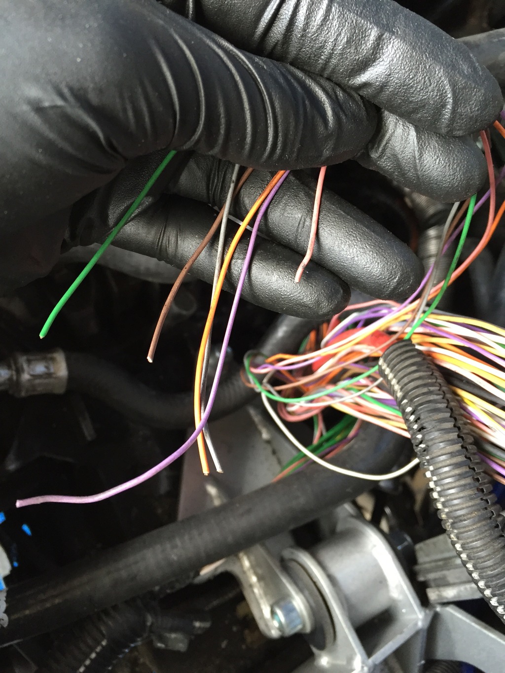

I've cleaned all the earth points and had the starter off, bench tested it and it fires and spins freely. I've even wedged the starter between the block and manifold connected the loom and it fires and spins again. But when it's bolted to the box it's just clicking and turning the crank in bits. I've changed the crank sensor and checked the loom which seems ok bar a few wires.
There's these wires near the ecu that aren't connected
And the black wires here
The wires aren't connected to anywhere and I can't find a port missing a wire or the other end of the wires, hopeful as its a cup it doesn't need these but I'm unsure.
Engine turns over fine as well
Any help will be appreciated.
