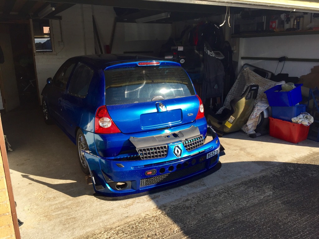

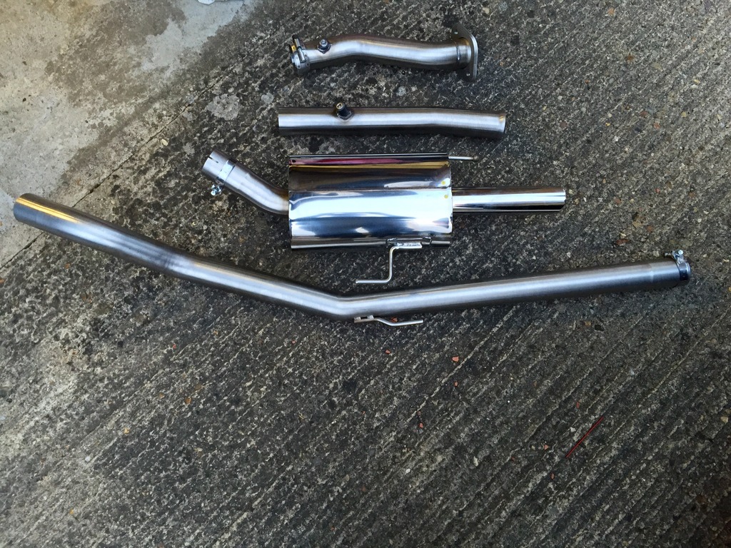

It's not a stealth exhaust, it's the recessed system. not sure how much as the previous owner has cut and sleeved part of the exhaust. Made it easier to get off and I'll supply a new sleeve. I'll get some pics

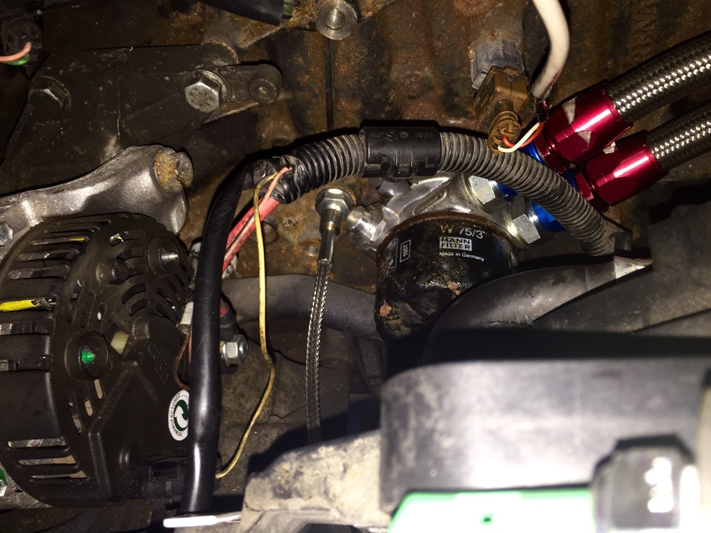

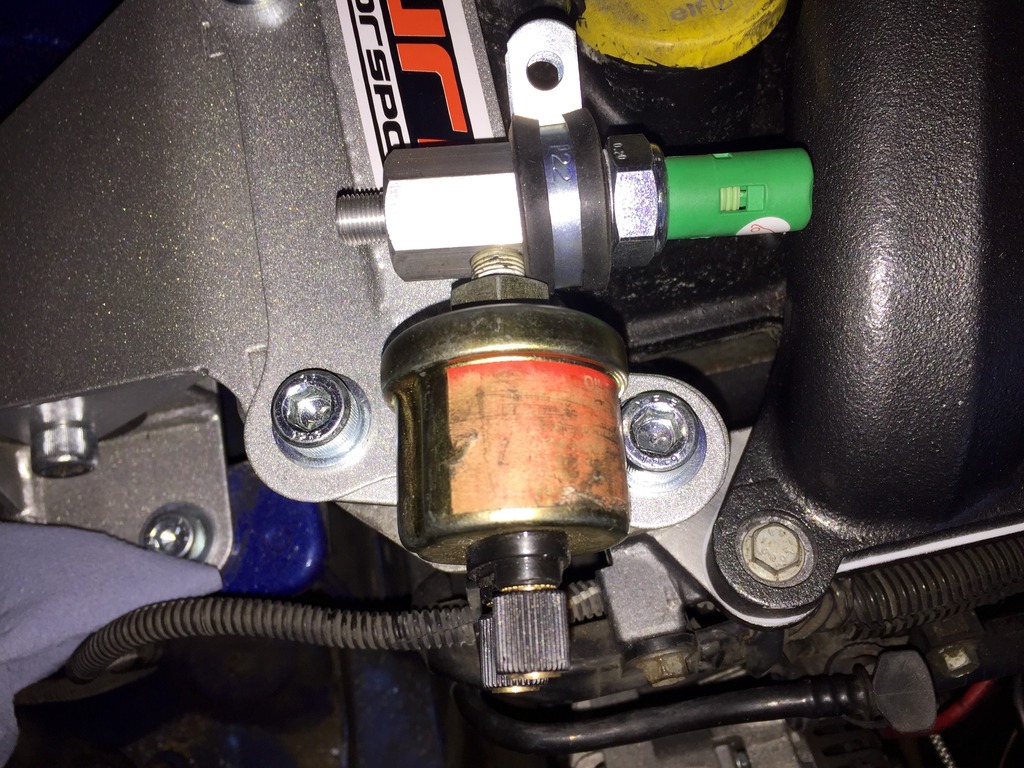

Few bits done over the weekend. Best bit I got it running :smile:

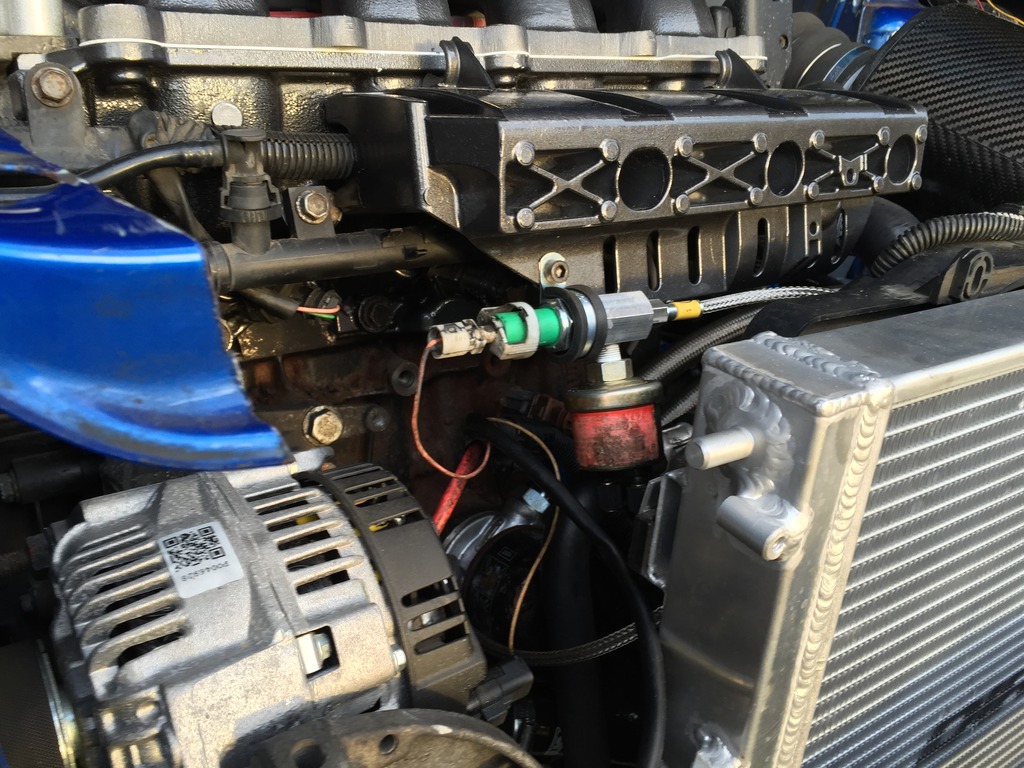

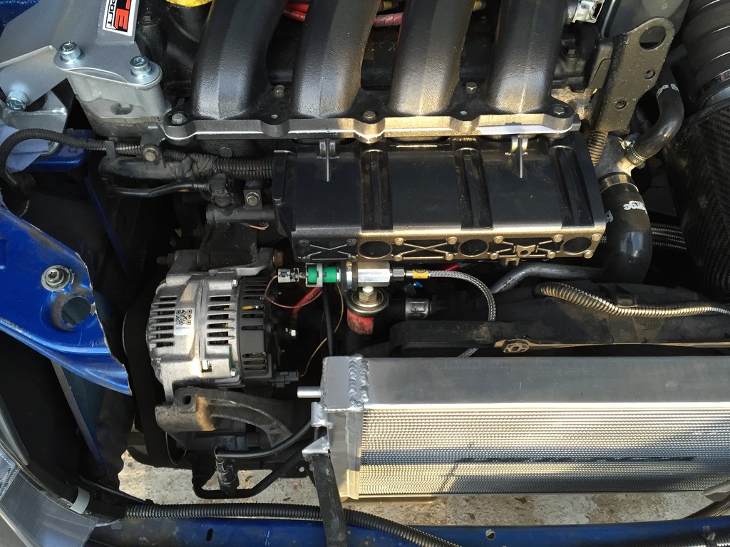

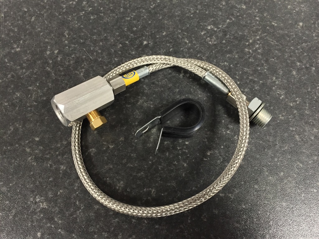

Fitted the oil pressure switch for me gauges.
Just need to finalise the location of it.

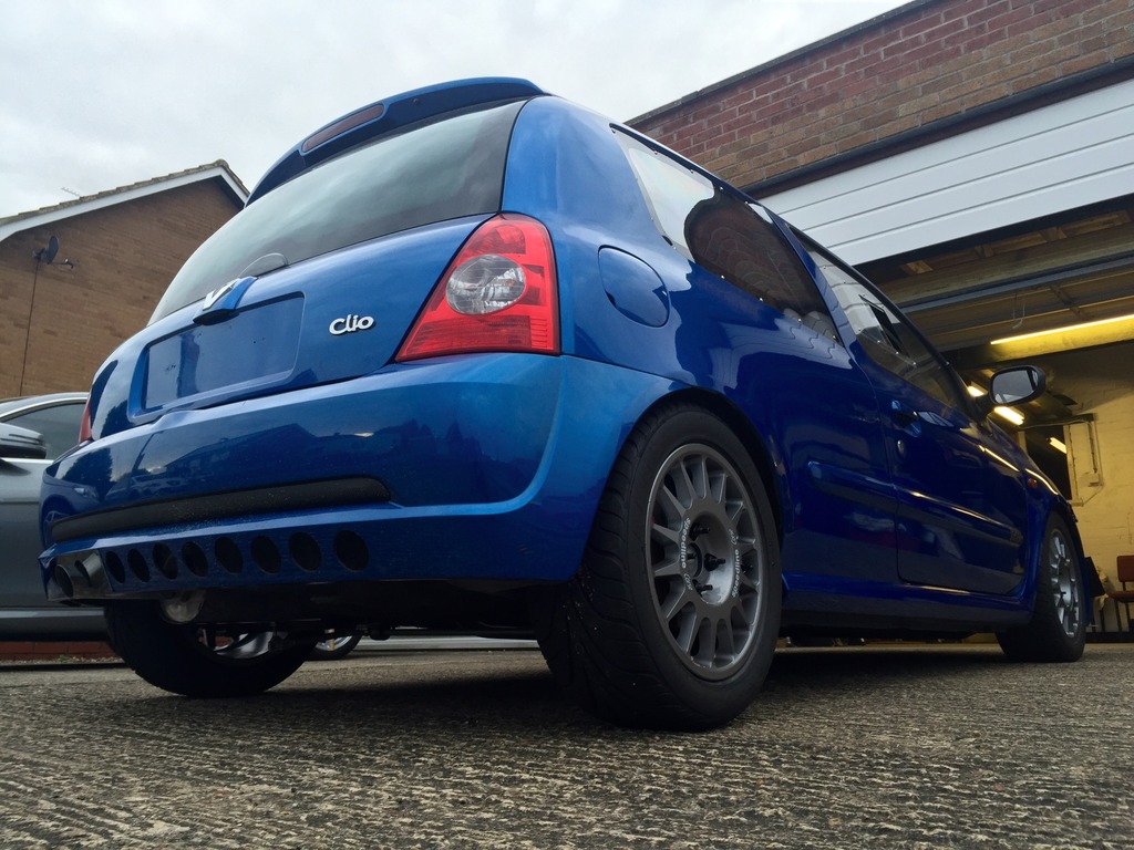

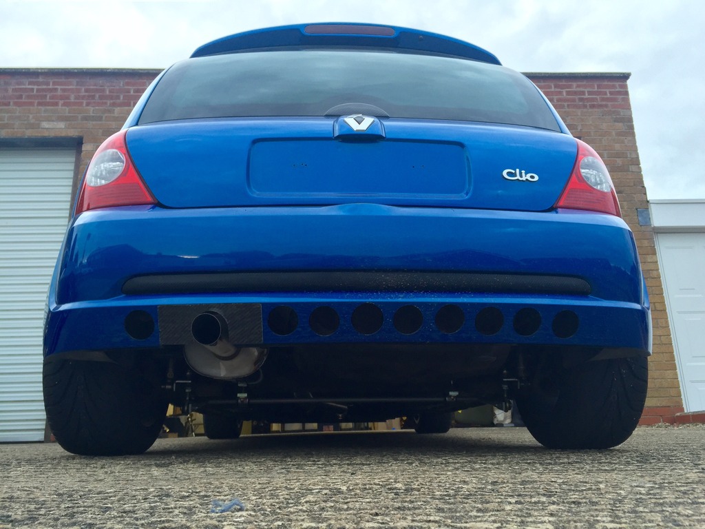

PMS Exhaust fitted too
The hanger is abit some for the prima racing mount tho.

Oil pressure switch in its location.

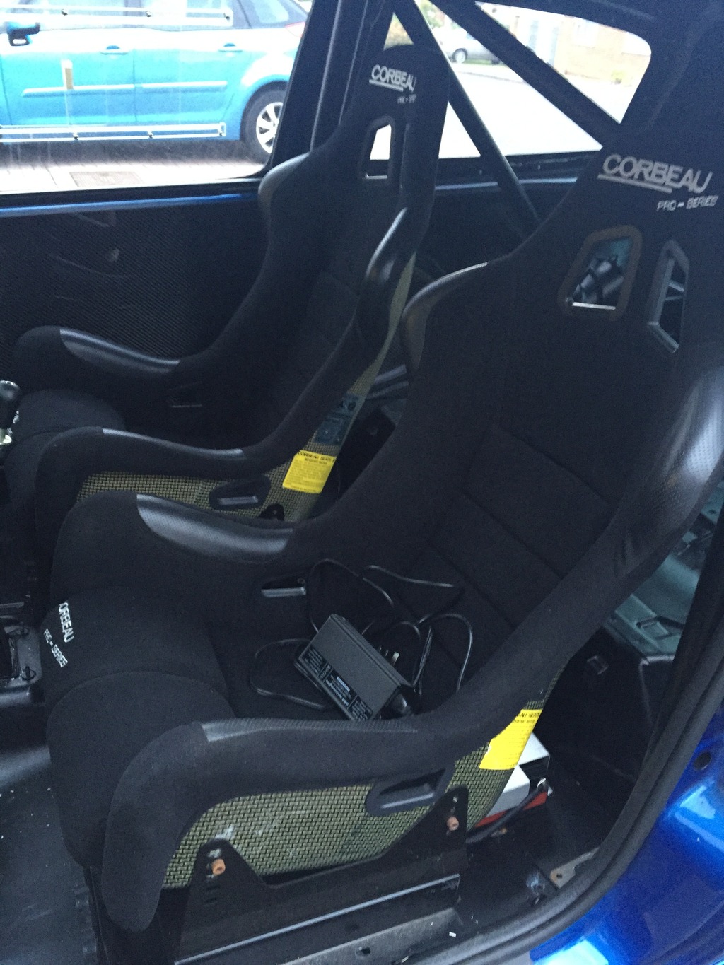

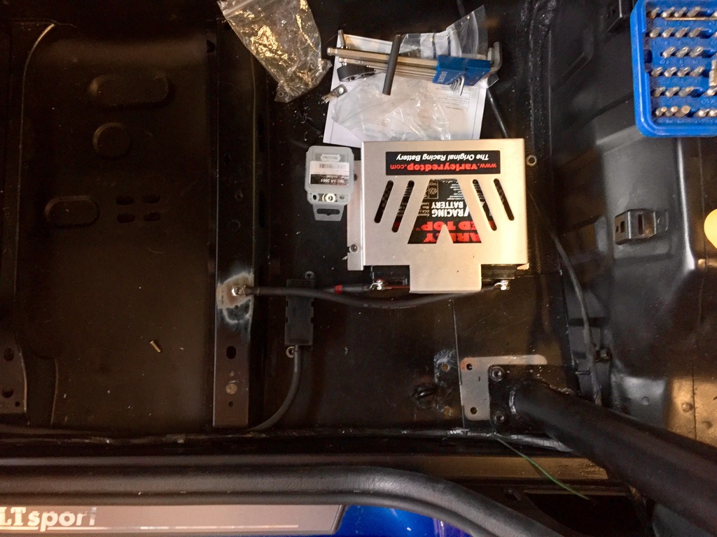

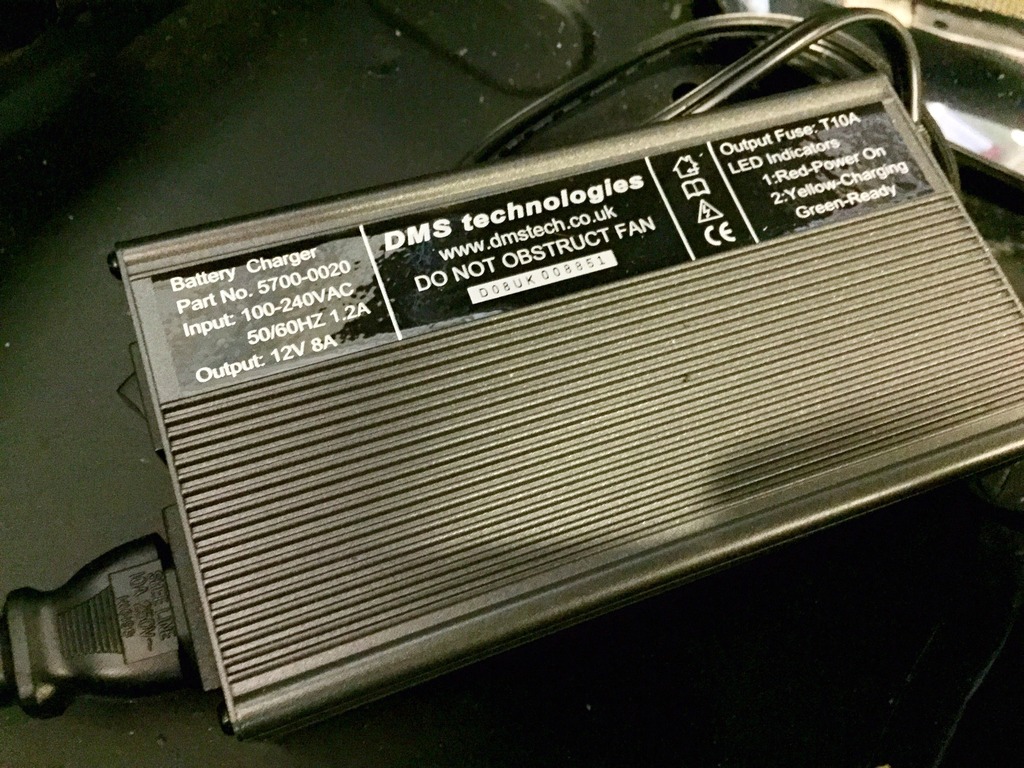

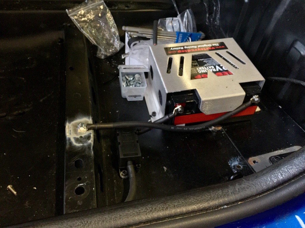

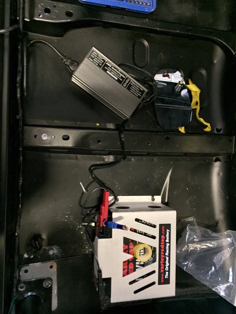

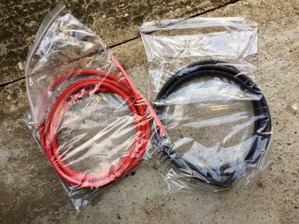

Ordered some powervamp battery cable and a redtop charger.
Hopefully this will solve my starting issue.
Charger in operation also can see the cage is lose, as I'm moving it further back slightly.

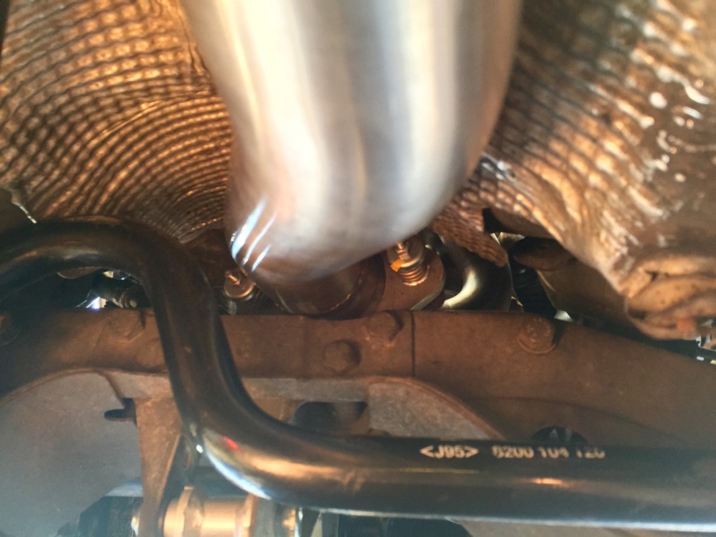

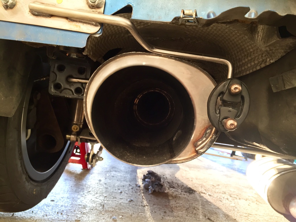

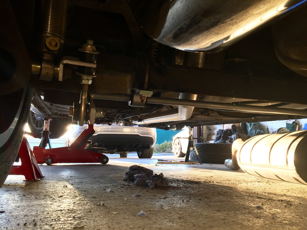

Hi mate, any chance you can tell me the distance of the end of the backbox silencer to the bracket bolted on the rear for the exhaust? I need something similar to align my Ktec recessed and only have 40mm to play with. Did you have to cut your bumper again?
Cheers.
The distance to the aluminium mount or the extra mount that PMS have added?

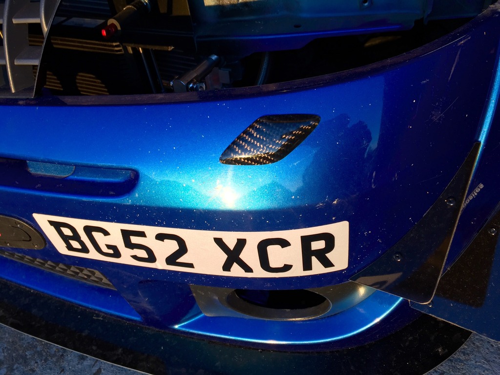

Yeah had to recut the bumper. Currently making a carbon panel to tidy it up
Akay
  Clubman Cooper S

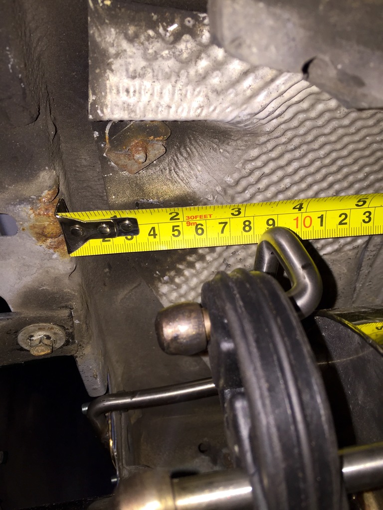

Sorry, the distance from the back of the backbox (not the tailpipe), to the metal on the car that the extra PMS mount bolts on to.
Car is absolutely awesome by the way, I wish I had the seemingly unlimited funds that you do :tongueout: some real quality kit and workmanship going on here!

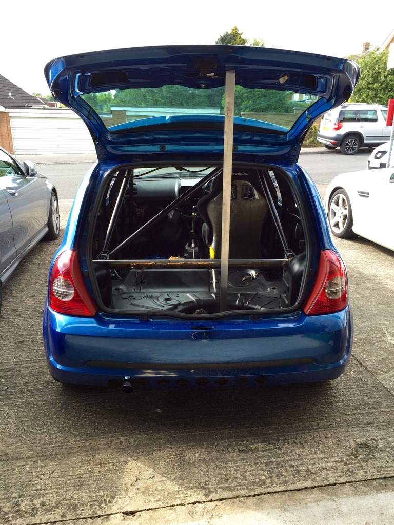

Here you go bud
It's just over 90mm from the back box it's self to the metal part the extra mount bolts too.
Hope that's right and helps.
The ktec exhaust I took off mine was a lot bigger and heavier than this PMS system.

Thanks matey, as I thought the Ktec backbox sits further forward :(

Yeah thought the same.

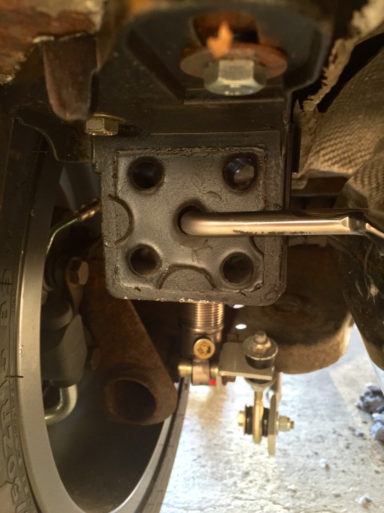

I'd just make the bracket solid. So it bolts to the car and then just weld the bracket directly to the back box rather using a rubber mount
I originally used spacers to move that rear bracket further away from the back box as it knocked on braking/acceleration. PMS kindly cut the bracket down making it about 10mm shorter. Im guessing its due to the 182 manifold pushing the exhaust system further towards the rear bumper. fyi
Any picture of you mount sonny, I have the exact same problem you had stated above

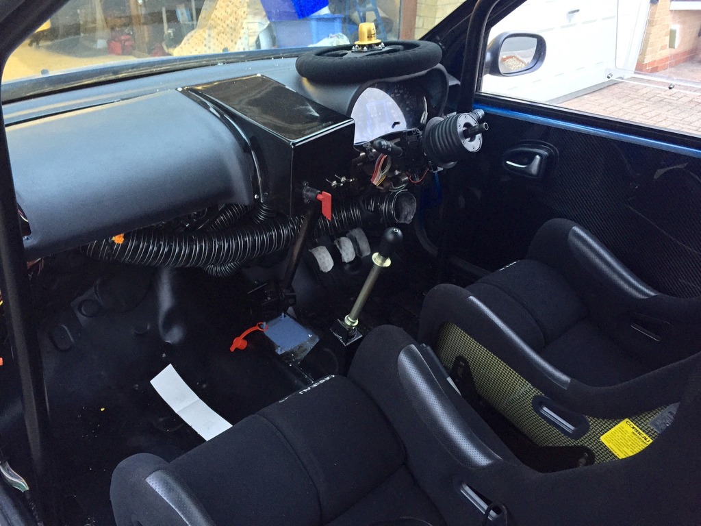

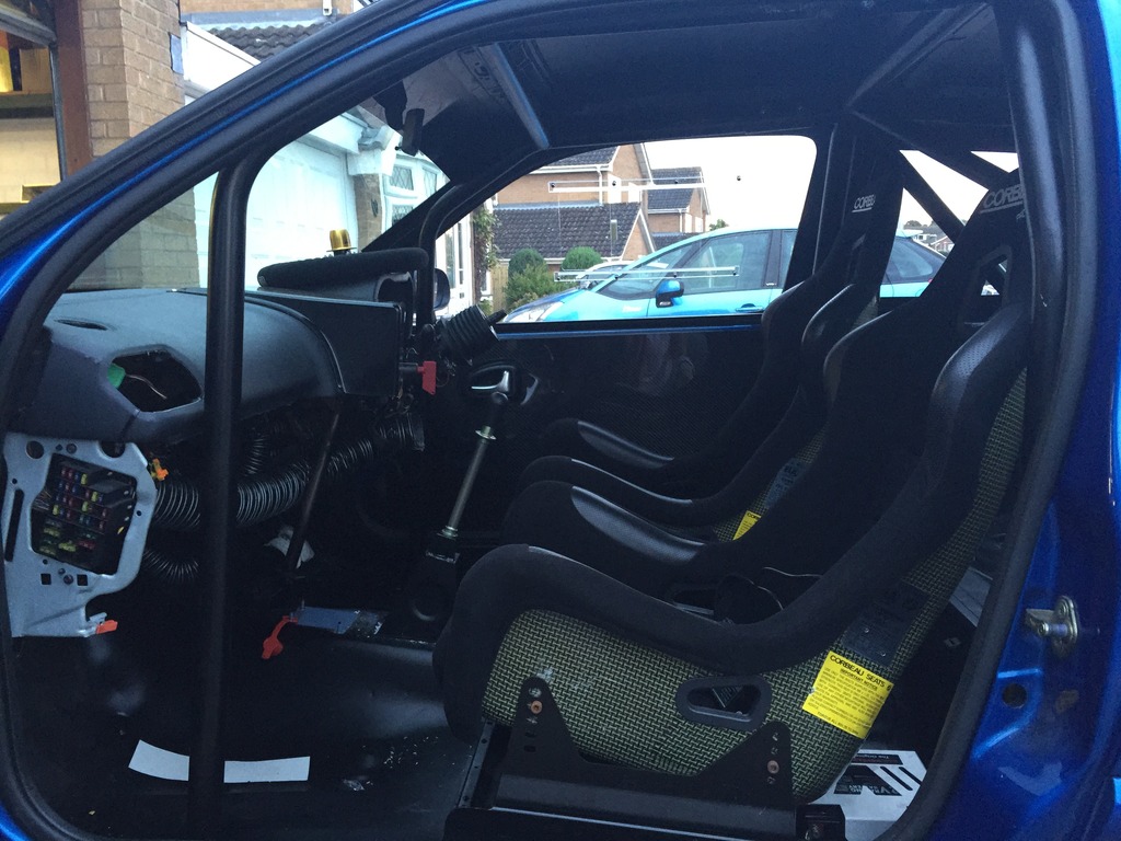

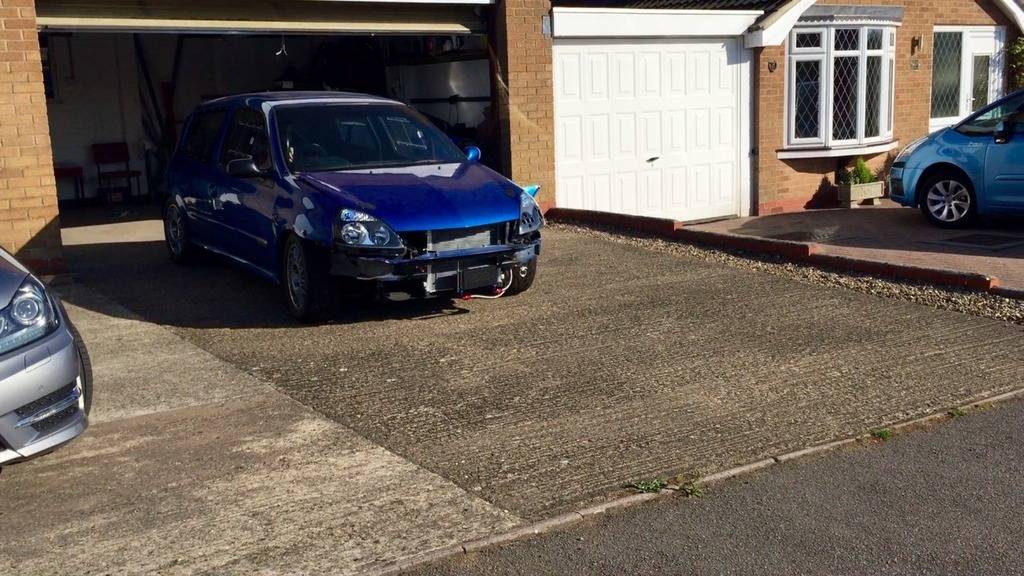

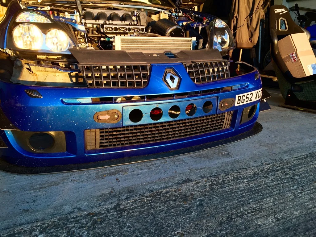

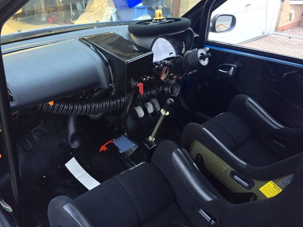

Put the front bumper back on last night and placed the passenger seat in place to make it look more like a car
Can't decide whether to pull the box and lump out for a refresh now or use and abuse it for a little while. I really want a standalone and custom loom making but struggling to find someone near who's willing to do it.
