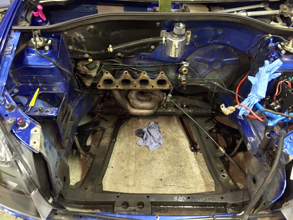

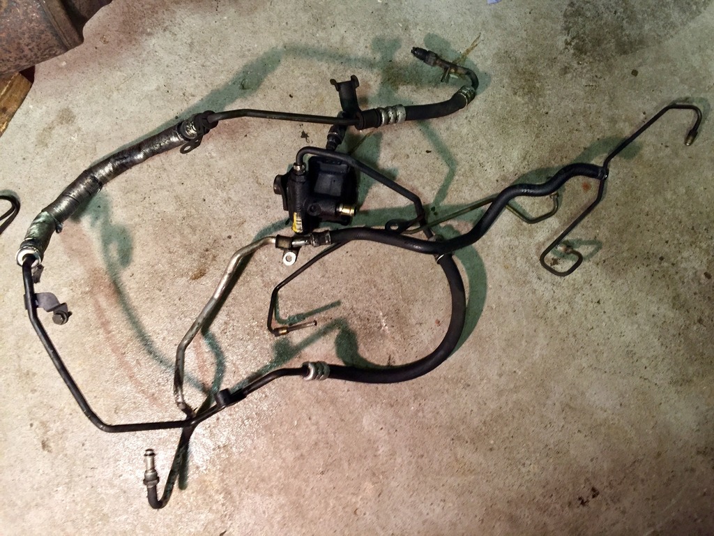

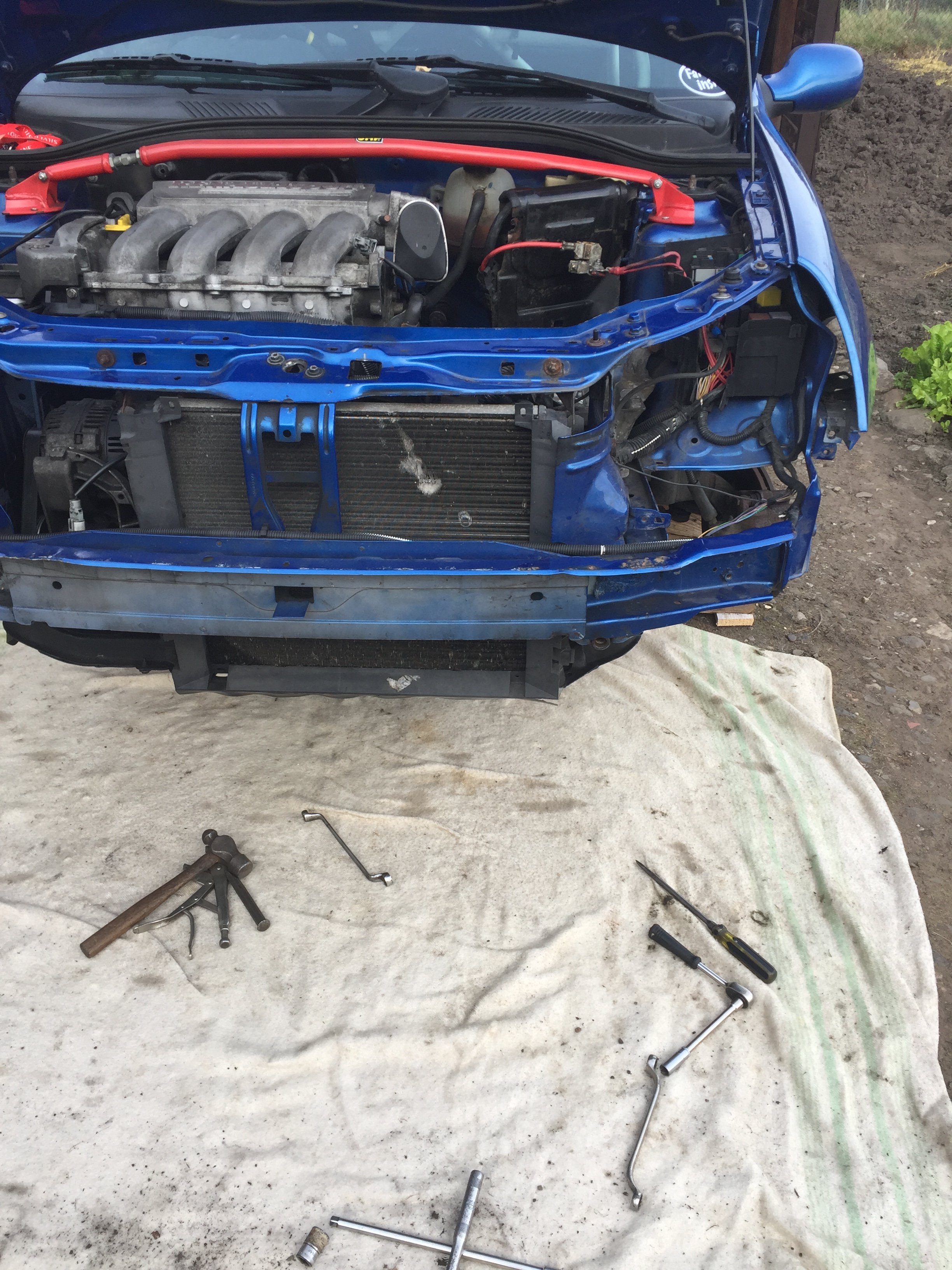

Removed the pas gubbings yesterday night
And removed some of the gunk from the bay too
NorthloopCup
Can't lock the engine up as it seems mine is slightly out
So can't get the crank pulley off. Any other way?
After this fail I needed some inspiration
Battery impact gun for the bottom pulley bolt, but it needs to be a good 'un.
Alternatively you could put a few old flywheel bolts in the end of the crank, slide a lever bar in between them, then get someone else to loosen the crank pulley bolt.
I'll be honest though, I normally loosen them off with just the crank pin in place.
It's the exhaust cam nut that you need ALL the locking tools in place for as they are a proper tight c**t.

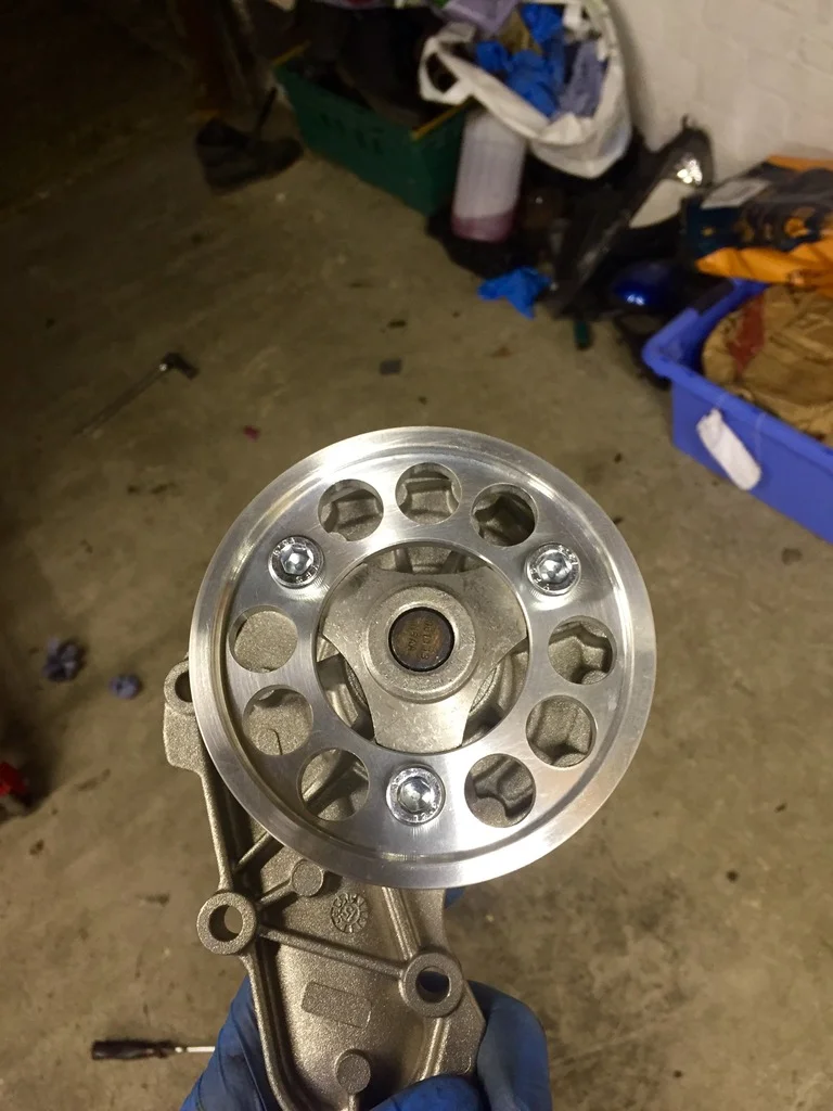

Well it's more than likely staying but motorvation is low to get anything done.

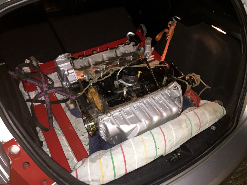

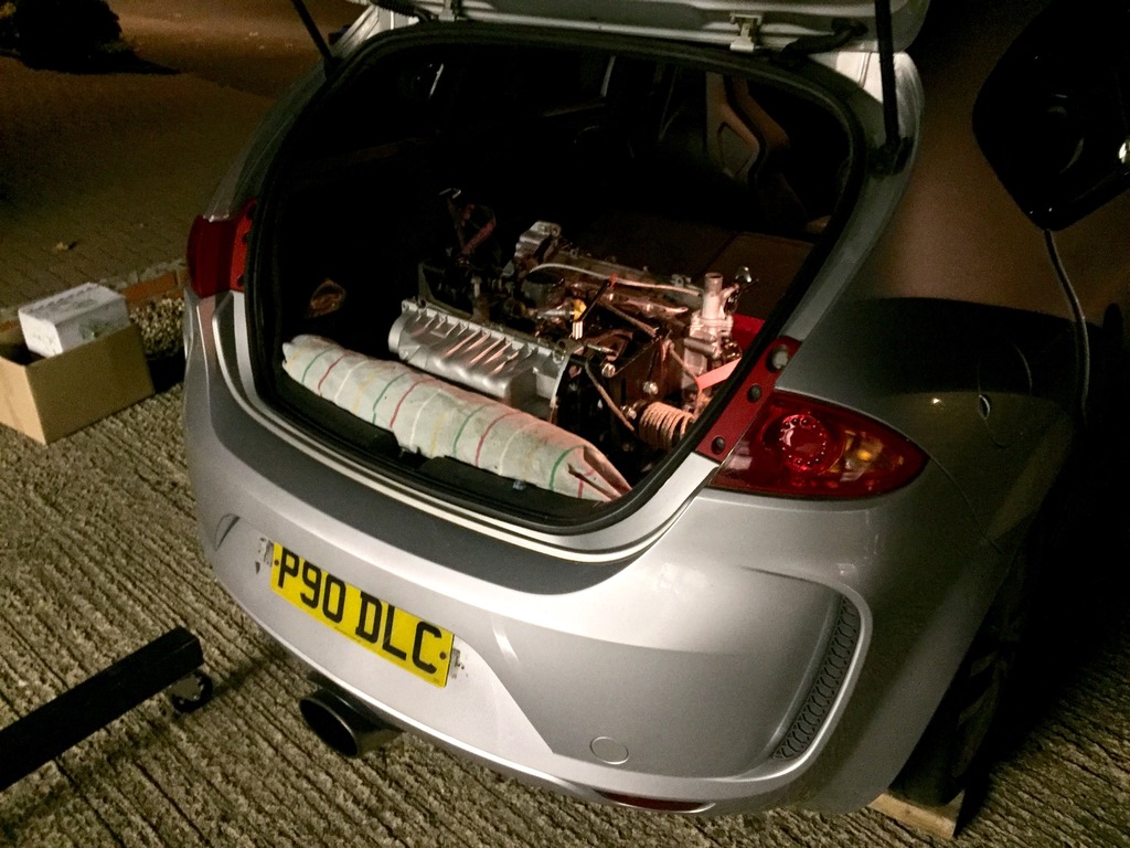

Only thing I've done is take the engine for a new belt, dephaser and timing altered.
Took the engine in the boot of my Leon lol
