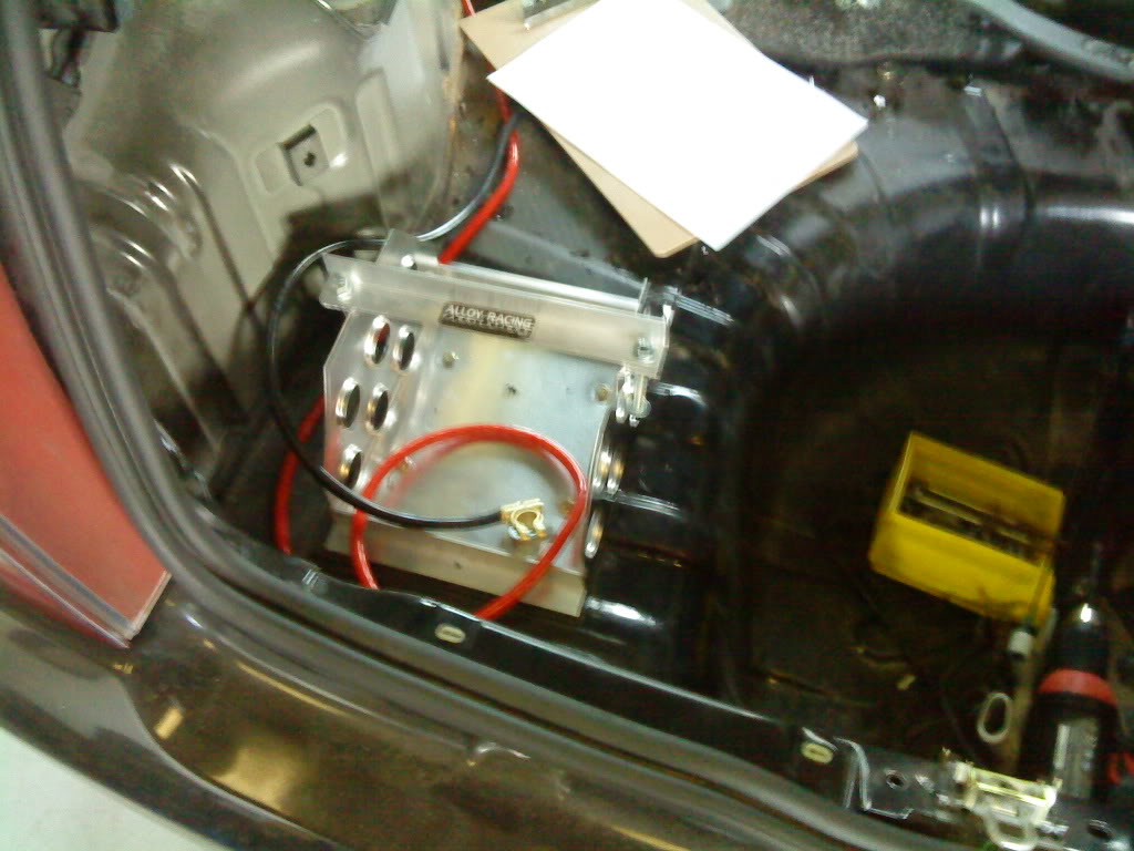

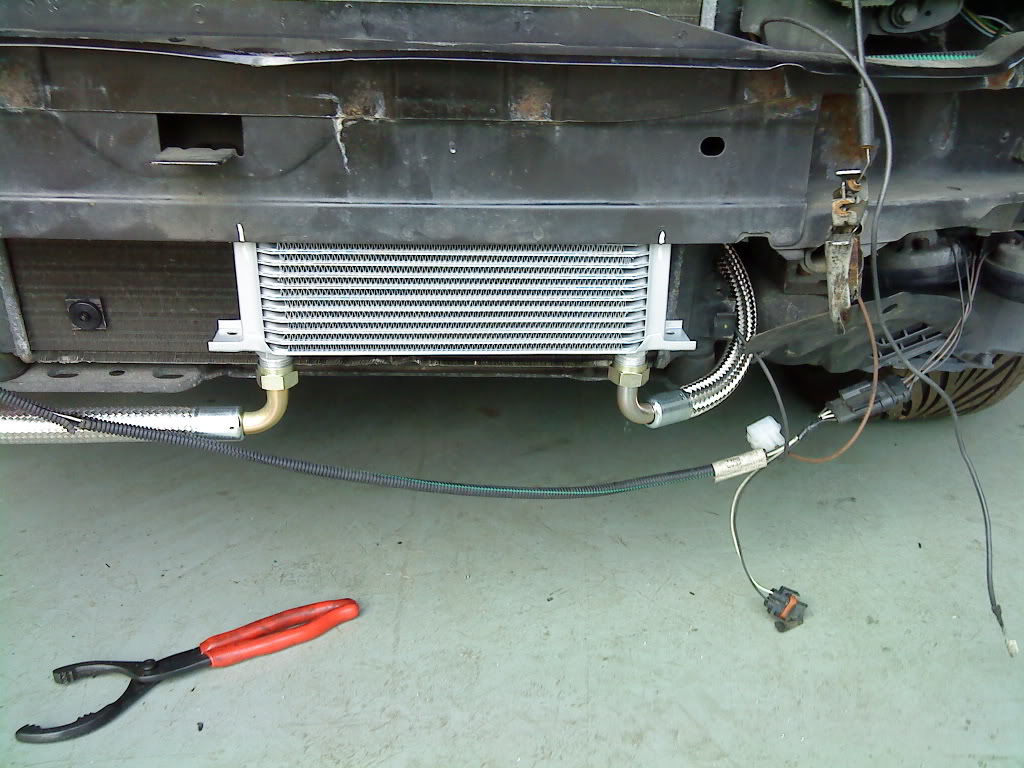

While I'm here, might aswell bung a couple of pics of the battery tray and oil cooler I fitted.
Plumbed in and fixed to the cross member.
I've bolted it over the tar in the boot for now but when I have the car back and some time I'm going to get all the tar out of the car. It looks like its on the piss in the phot but it's just a dodgy shot.

Have you got any pics of the car all cleaned and such, i don't think ive seen any!
EDIT: Before all the work was started i mean.

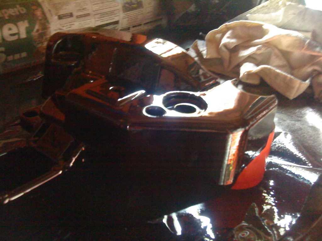

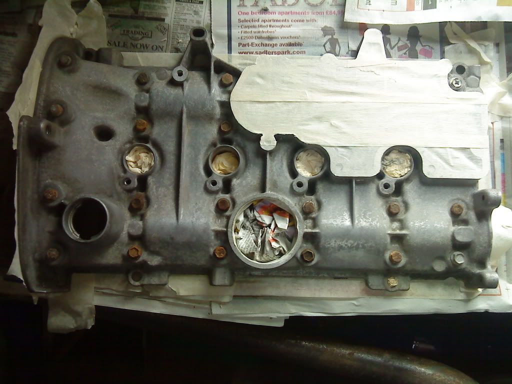

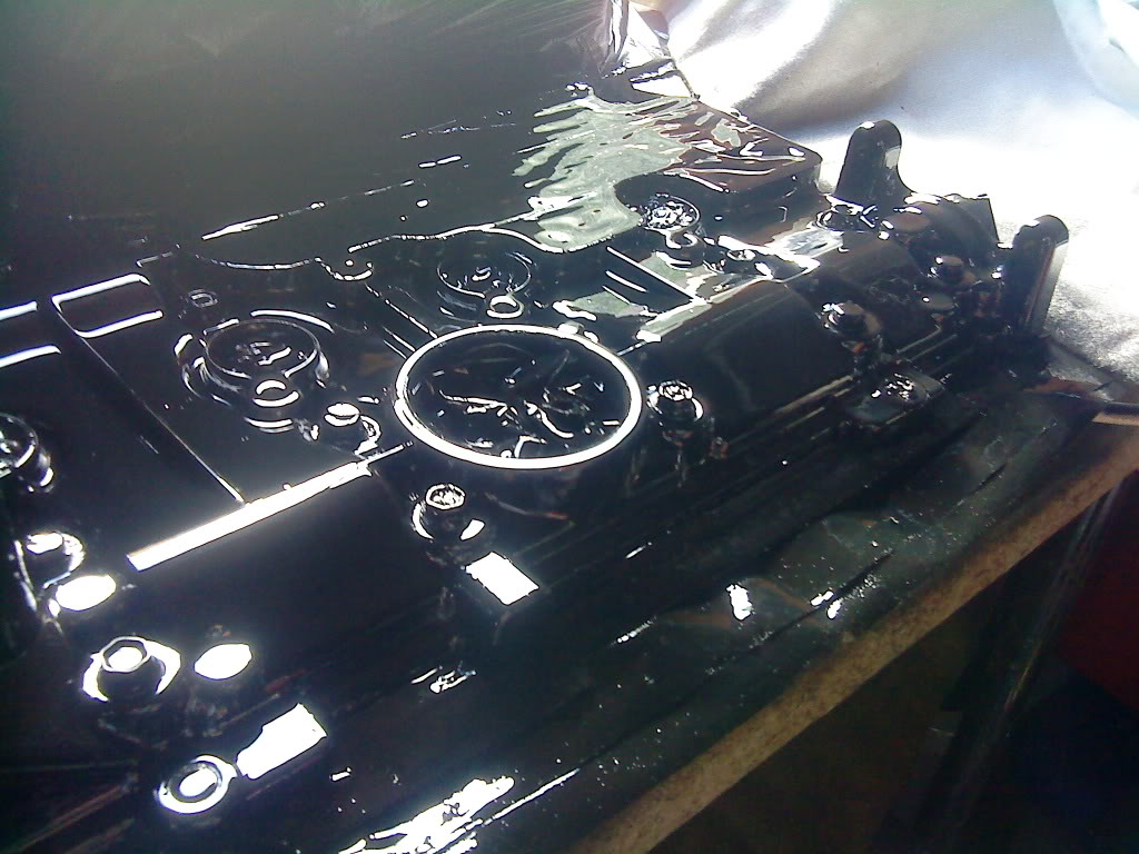

Gave the cam cover and engine mount a good degrease earlier, masked up the breather area and raided my bolt tub for some that were the same size as the ones used on the car so the torque figures wouldn't be affected by the paint. Took ages to mask and cut out for the breather area!!
Then gave them some good thick coats of crackle black. These were taken just after I'd sprayed them so will take some more in the morning when the paint has had time to dry and wrinkle up!!

excuse the stupid question, but that crackle effect paint,, is it an actual type of paint, or just the way in which you apply normal paint?
M
mini-valver
Its a VHT temp paint mate, I'll get a picture of the tin. You apply it in thick coats, leaving 5-10 mins between them. I gave it a s**t load of paint because the cover itself had bits of oxidation I couldnt get fully off as its awkward to sand so built the paint up to make it smooth before it drys wrinkly.
