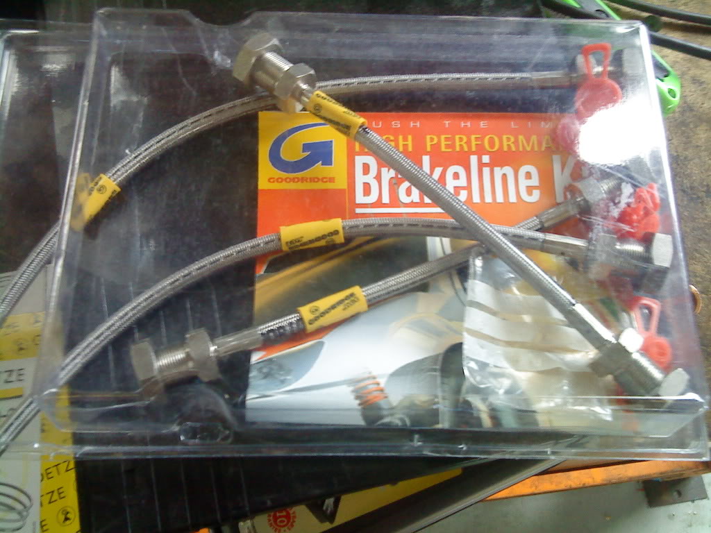

Went to pick these little buggers up this morning (BIG BIG thanks to Steve and Andy at Birchdown for sorting these!!)

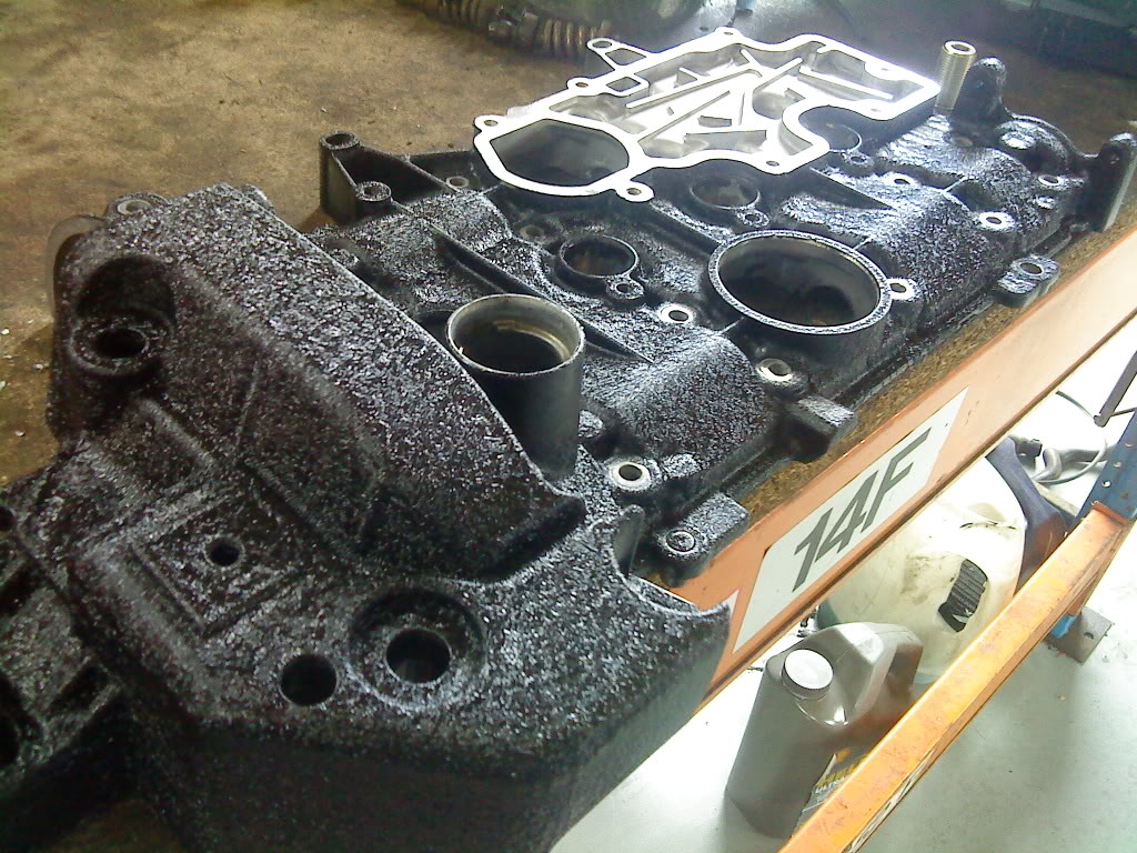

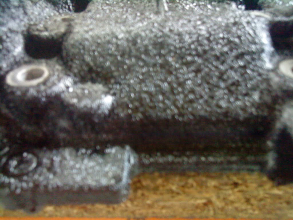

Got them in and starter to bolt the head back on, cams went in and put the covers on which I painted in wrinkle paint. I put a bit too much on TBH as I had no idea what sort of finish I was gonna get! Looks odd in photos but when they're on the car they look sweet!

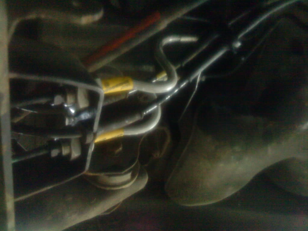

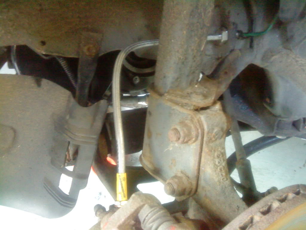

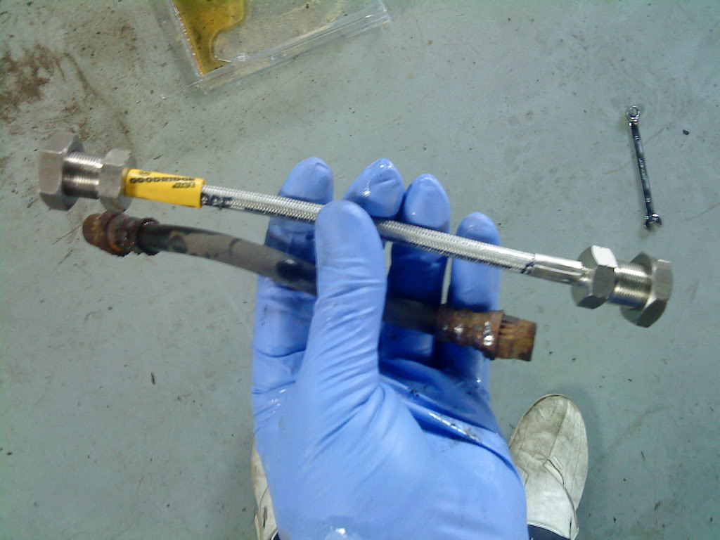

While he was doing bits under the bonnet I thought I'd fit my braided lines....
Easy to fit, just need to bleed them up now!

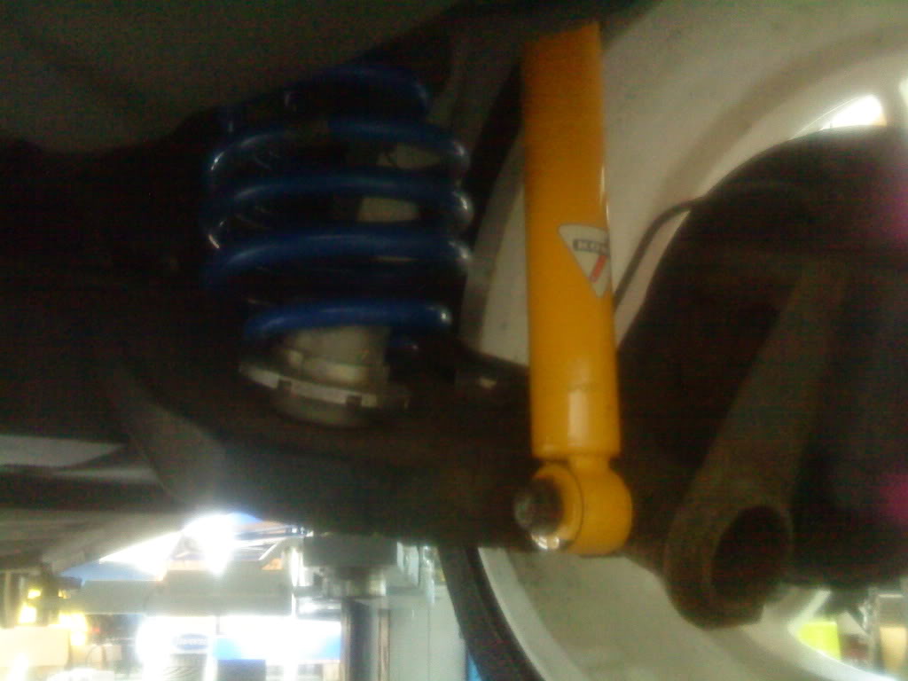

Pics of the fitted dampers and FK springs too... The car sat up at the back before, will sort the fornt set-up when I have some more money! The car is on a ramp here and the platform is wound up high to keep the spring in place, it'll be lowered to suit the front height once it's on the ground.

Good work Dave!! :star: :star: :star: :star: :star:
Odd pic of your engine though, looks like it's been in a mild fire! :eek:
(i touched wood after i typed that, as fire is about the only setback you haven't had over the last few days!)
It's wrinkle paint! It looks like a big fingerprint, the pictures are crap, lol!
