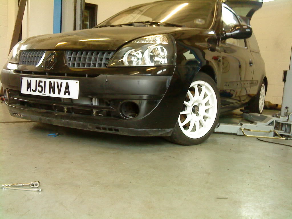

Reet, few more pics of the car. Got to AWT early, Ben was inside scratching his head about why the ecu wouldnt connect so he went over to the guy that supplys them to sort it out.

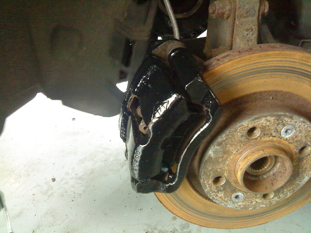

First, gave the brakes a tidy up and quick paint, will clean the arches etc after FCS when I have some time....

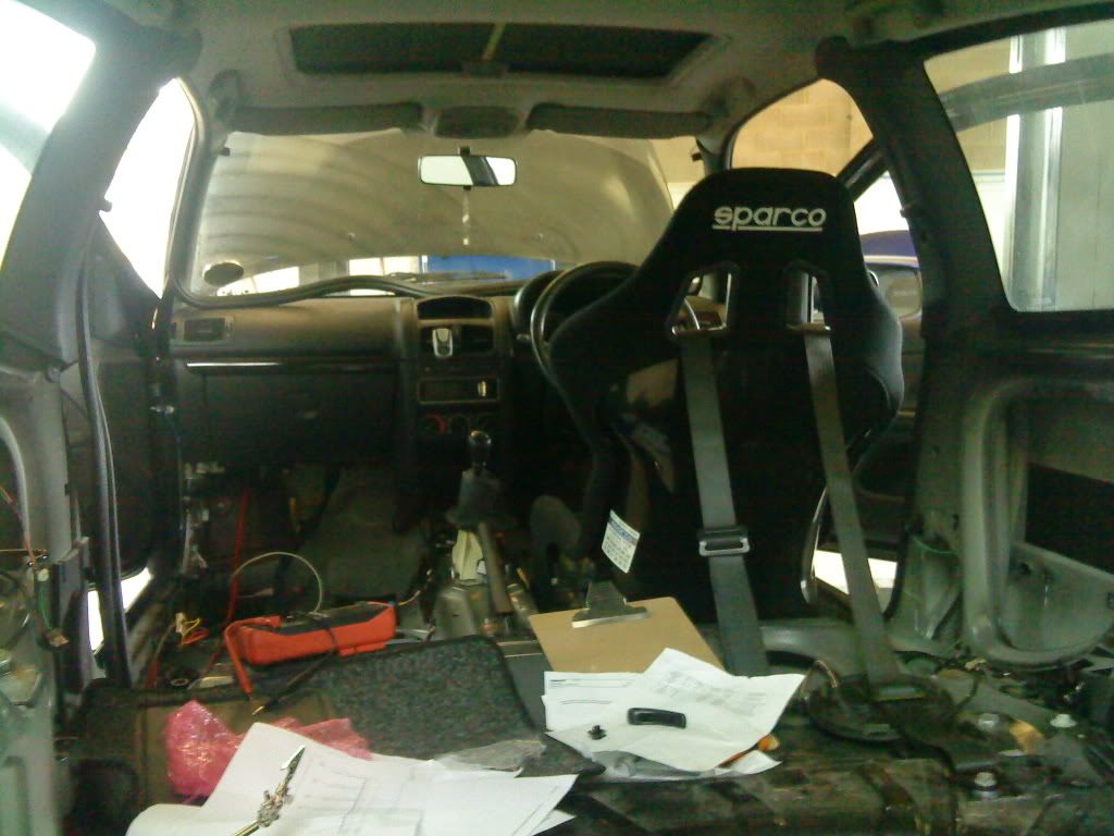

Randomn one of the inside with the ECU and loom in the passenger well, Im going to make a box for it to sit it as far under the seat as my subframe will let me!

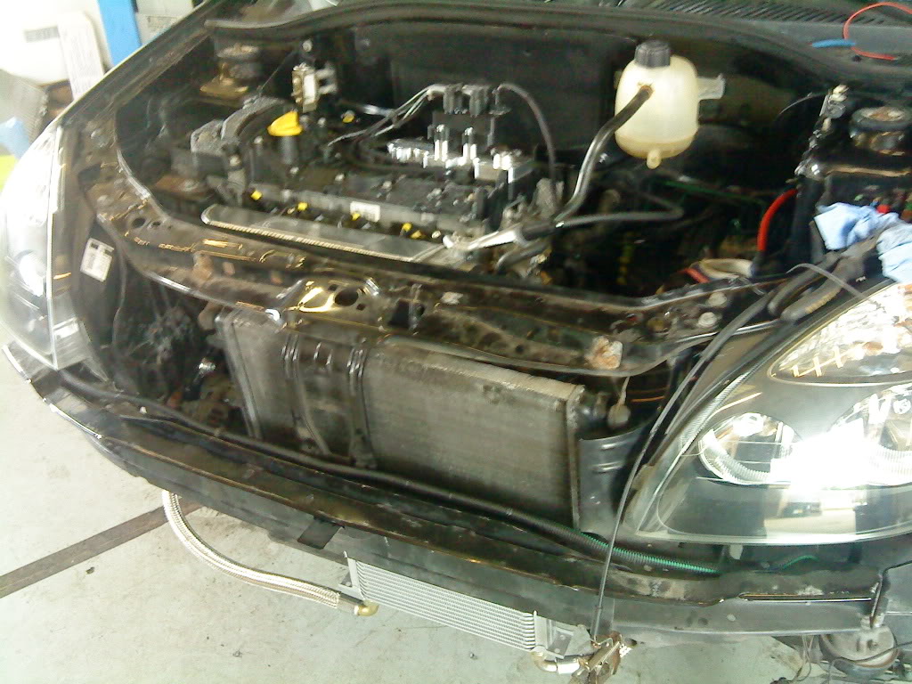

Slam panel, radiator with the 2 little fans (needed to remove the stonking standard one for space), coolant hoses and expeanion bottle fitted. At this point, I'd put the driveshafts, dogbone and gear linkage back together aswell with the help of Trung, Ben's mechanic...

How it stands now, waiting for mapping and for me to try and blag someone to do my sidestrips before saturday!
