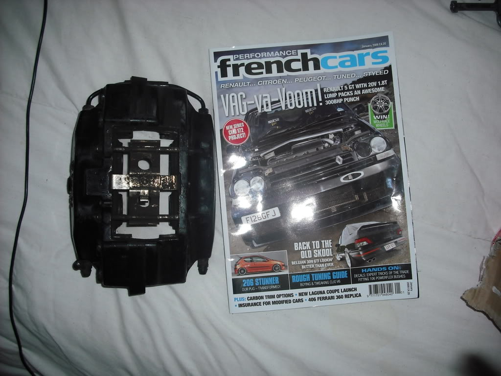

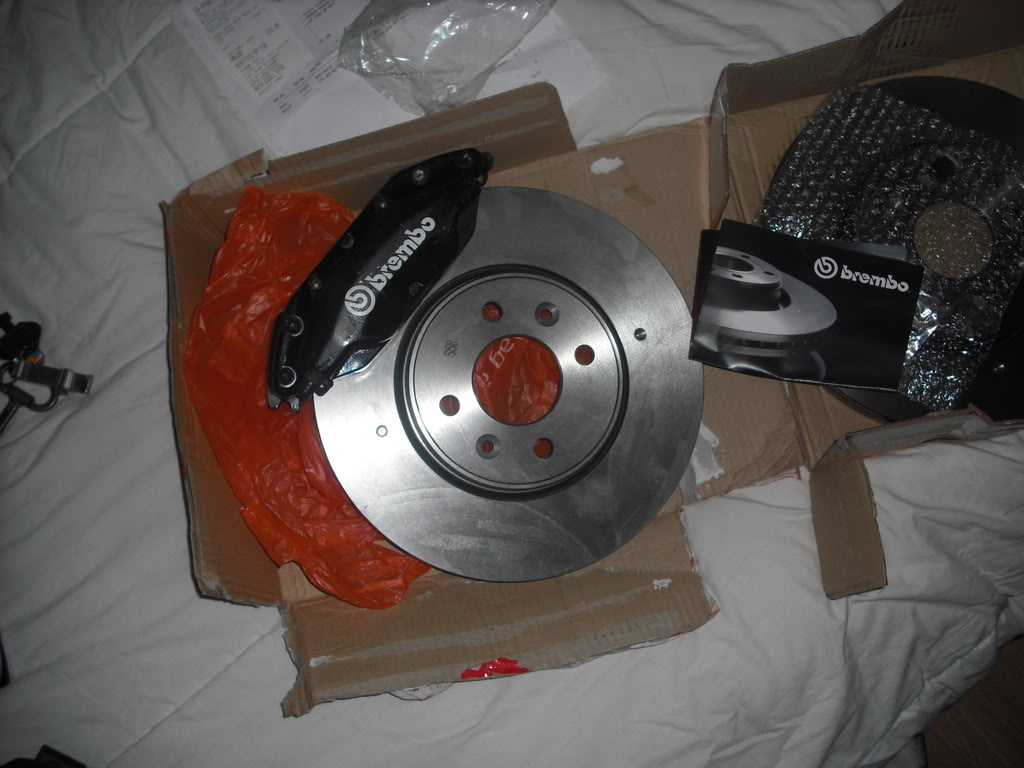

Got some Brembo High carbons today from GSF (£75 ish, cant remember exactly) and ordered some pads as they didnt have any for the 406 Coupe V^ Brembo's, got them home and offered the caliper up to them. Pimp!
I'm Dry fitting the brakes so I can remove and refurb them when I know 100% everything fits, pretty sure I need 15mm spacers but I wont know until I have everything on properly!

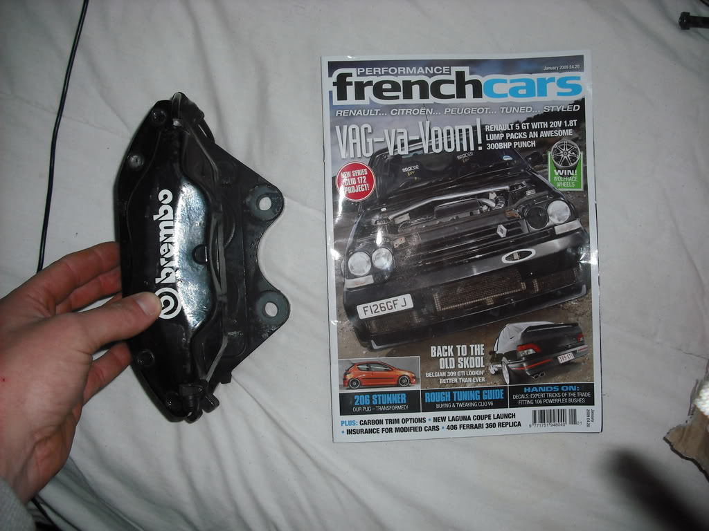

Got a few "Scale" snaps so you can see how big these f**kers are :evil:-

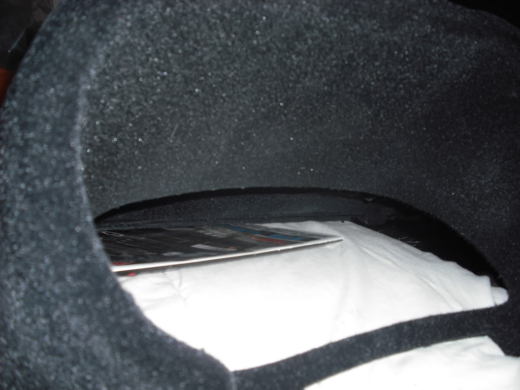

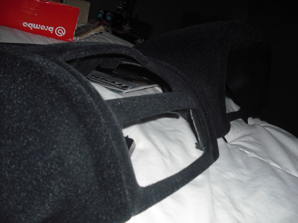

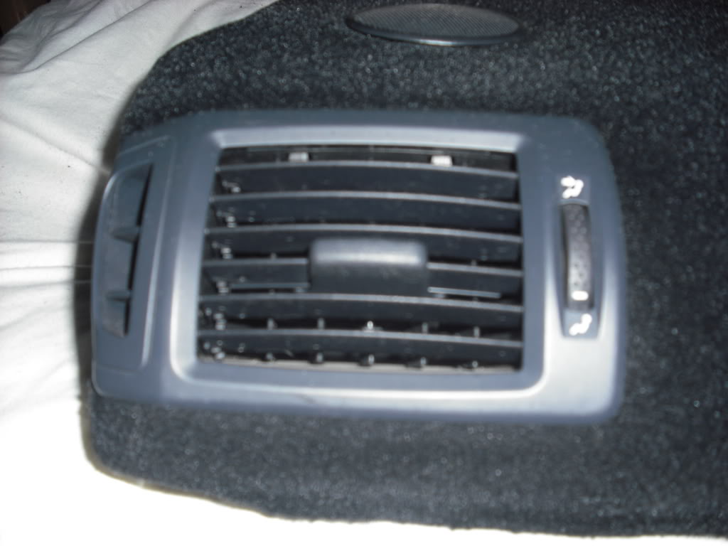

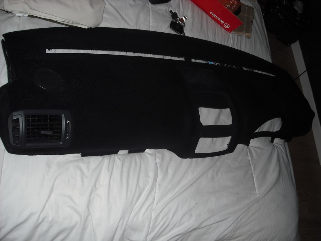

Got as far as taking them outside, realised it was far too cold and 3 anyway so thought f**k it, tommorrow's job. So come back inside and put the vents in my dash.
Andy from Flock it did it for me and i'm rally impressed, theres not one imperfection that I can see and the flock feels really thick as a pose to some of the dash's I've seen.
Few pics....
I've decided to get the bottom half done too so I'm sending that of and making some weight saving mods behind the dash. I'll actually do something tommorow.... Promise ;)
I really really like that dash :o
That caliper is HUGE! Nearly as big as the one I have sitting in my living room, and thats for a 400bhp car :eek:

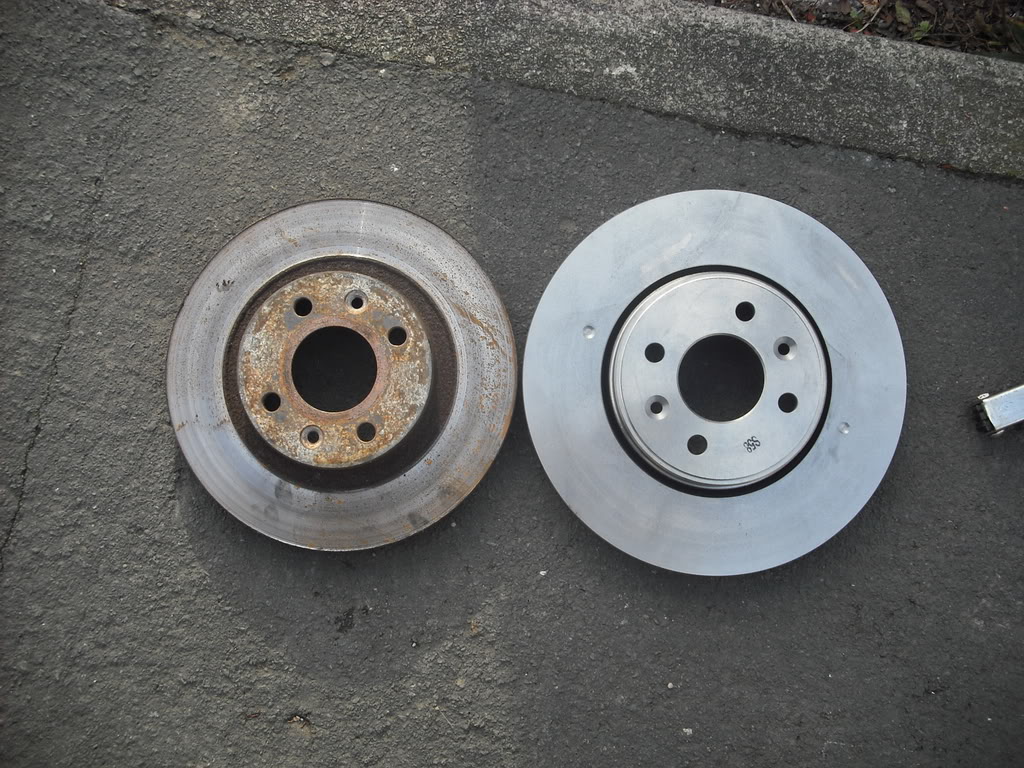

Matched them up to the ones in the catalogue and they were the same as some jaguar £22 the set. (4)

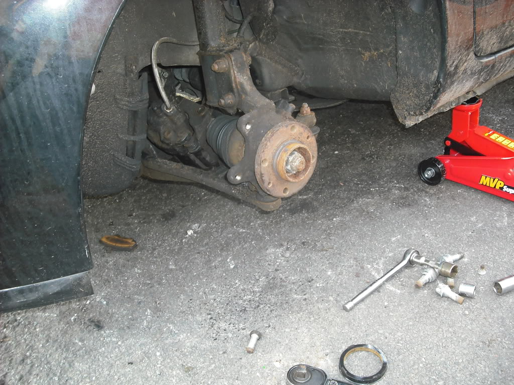

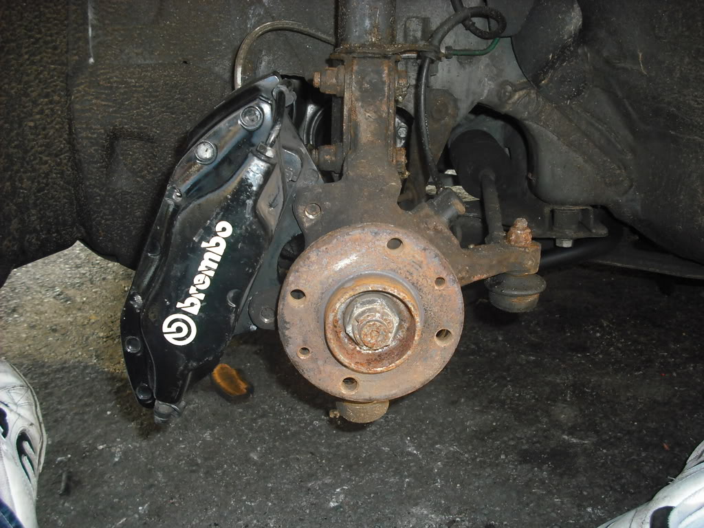

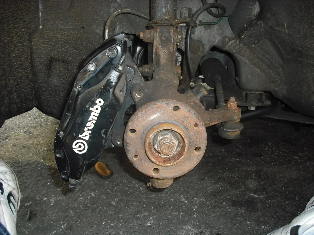

They've been on, and I got jiggy with the tape measure. Need 4 3 1/2mm washers and some 11mm spacers.
Old brakes come off, needed replacing anyway.
Then just double checked it was going to fit the hub as I had a really bad feeling after all this, I'd need a bracket :o. Good job I'm always wrong TBH....

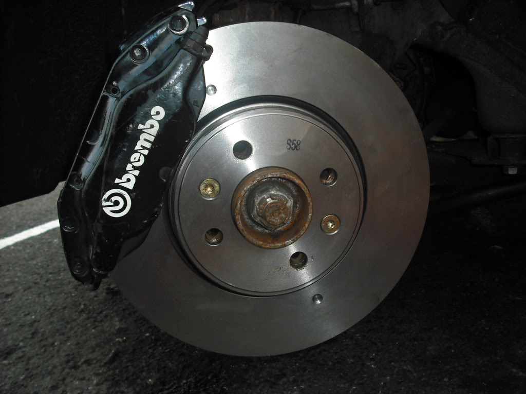

Copper greased the hub, fitted the disc and dry fitted the calipers and got the centred using a selection of washers...
Middo is gonna lend me some 10mm spacers to stick on, if I've got ample clearance of about 2mm, I'll use those. Only worry is, will spacers be fine on track??
Refurb the calipers over the next few days. Need some pennies for a wheel refurb too but that can wait.
