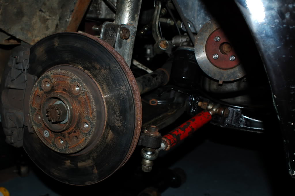

Anyone know what that setup of suspension is called?
Yes, assuming you mean the rear its still just called "mcpherson strut", but it has a two piece trailing arm made from two rose jointed arms and also has a track control arm setup to give better control.
Front is just bog standard mac strut.

So pretty standard setup then?
Is it just a matter of having 2 rods instead of an arm - reducing unsprung weight? Why would that give better control.

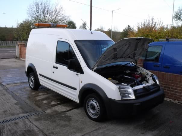

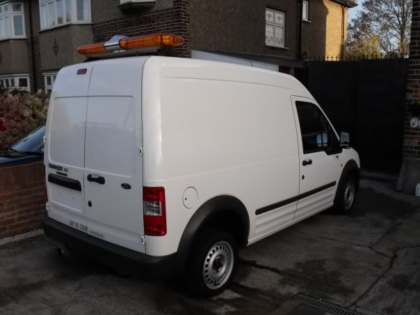

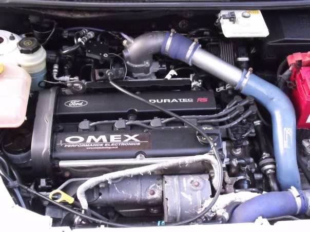

My connect van I build.
300bhp. Quafie diff. Omex engine management. I loved that thing.
No its not a pretty standard setup TBH mate.
Its got 3 arms in total not two.
Two rosejointed arms in place of one TCA mean that he can adjust rear toe and they are very light, and then the trailing arm that is connected as well takes the loads forwards and back to allow the trailing arm not to have to control all that force, which again helps them get away with being light.
And because he is doing toe control on the two piece TCA, it means he doesnt have to run a seperate arm for that as well like I have on my mid engied RWD nova for example which still runs a conventional single arm with balljoint rather than the twin rose jointed arm:
