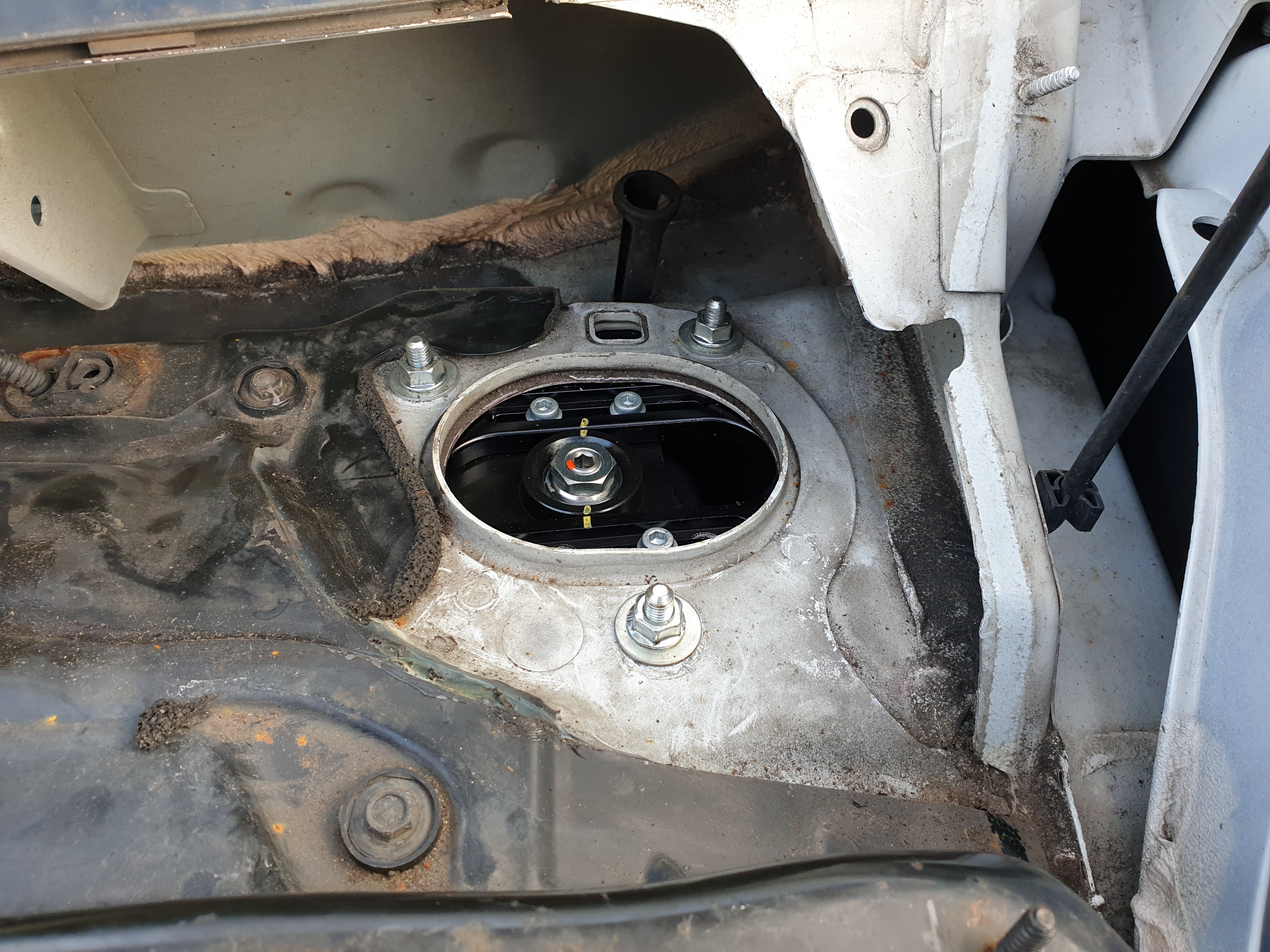

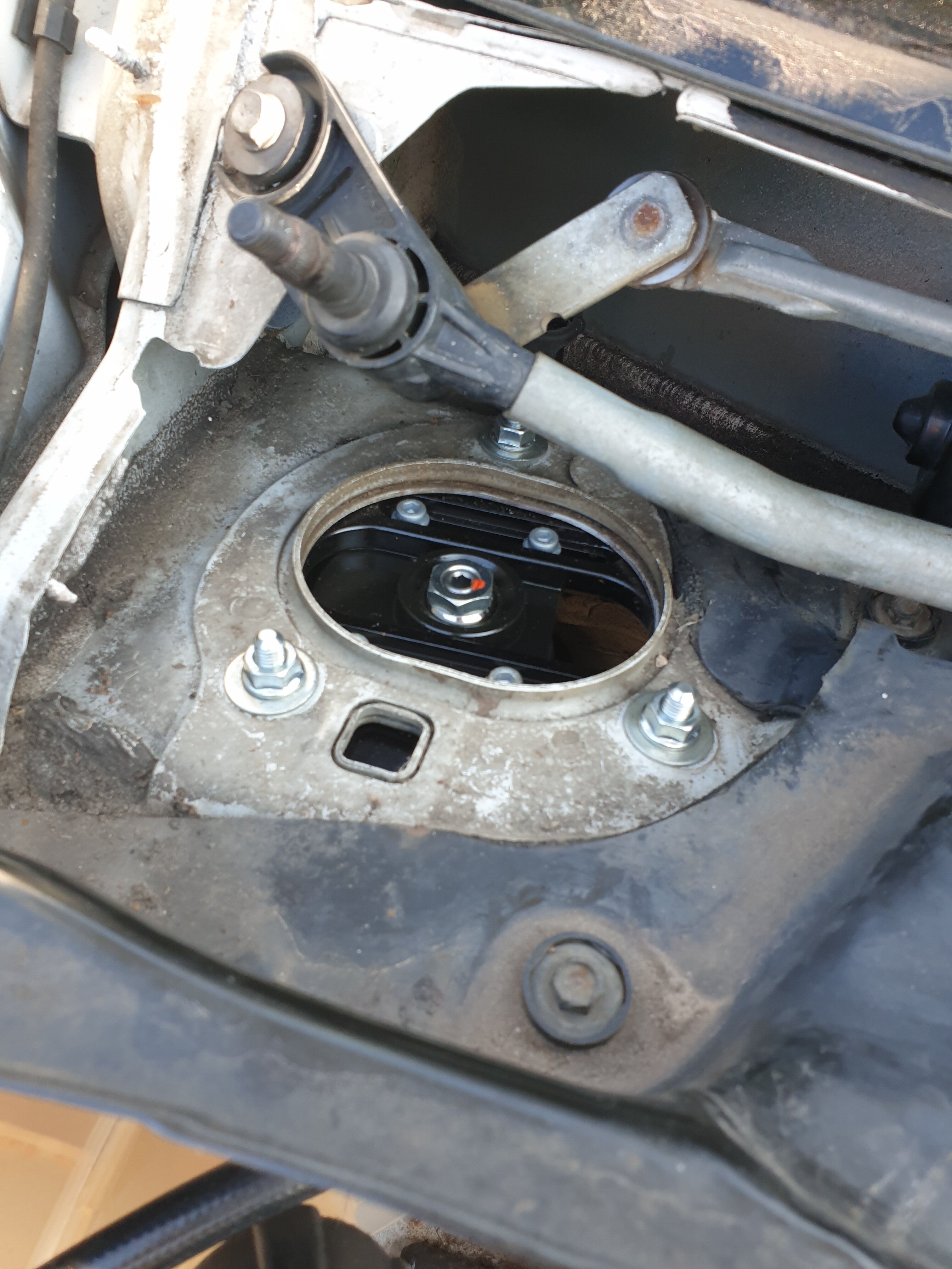

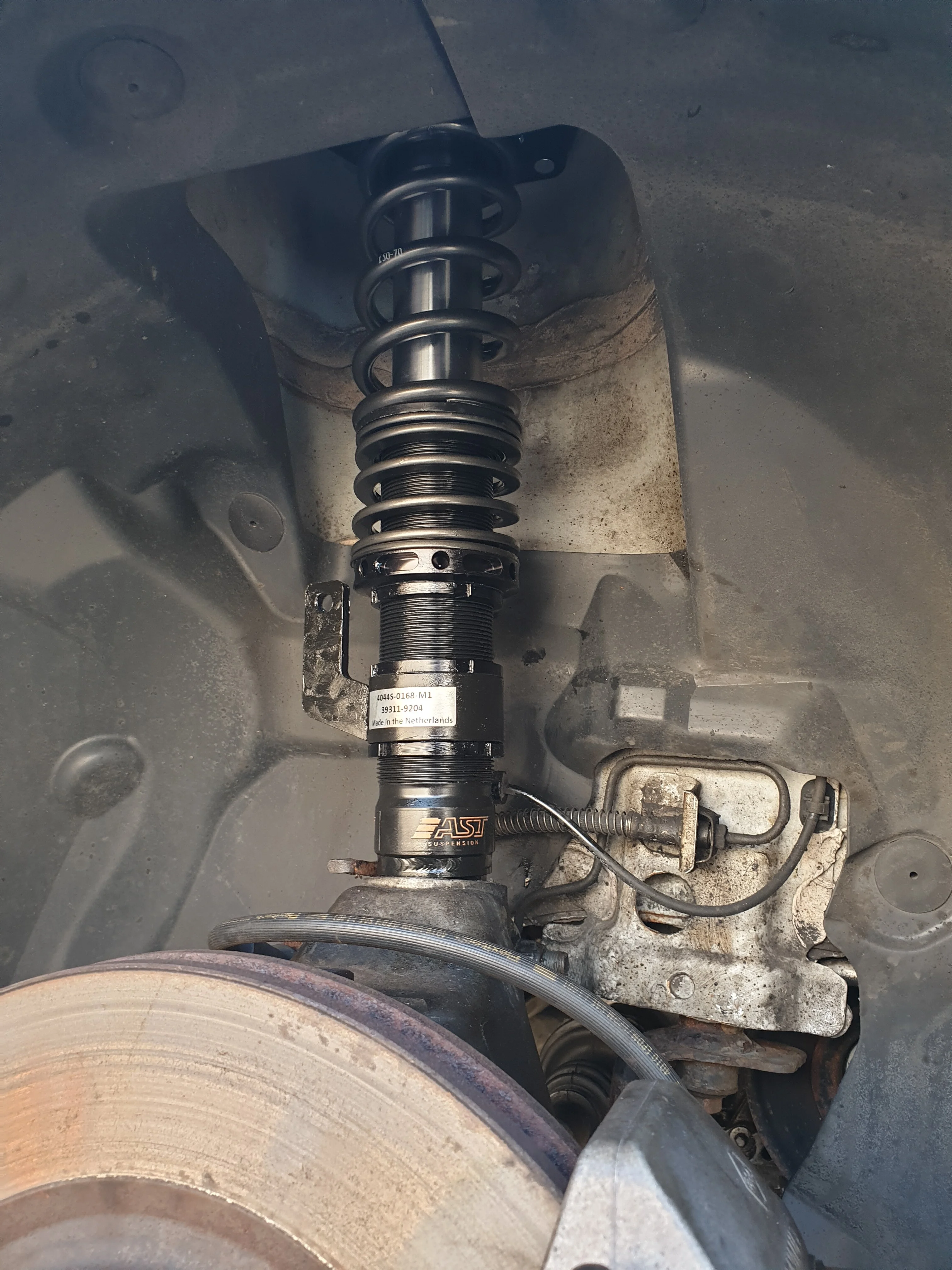

Front Ast's are fitted. I took an educated guess that megane 2 rs top mounts would bolt straight up and it absolutely paid off.

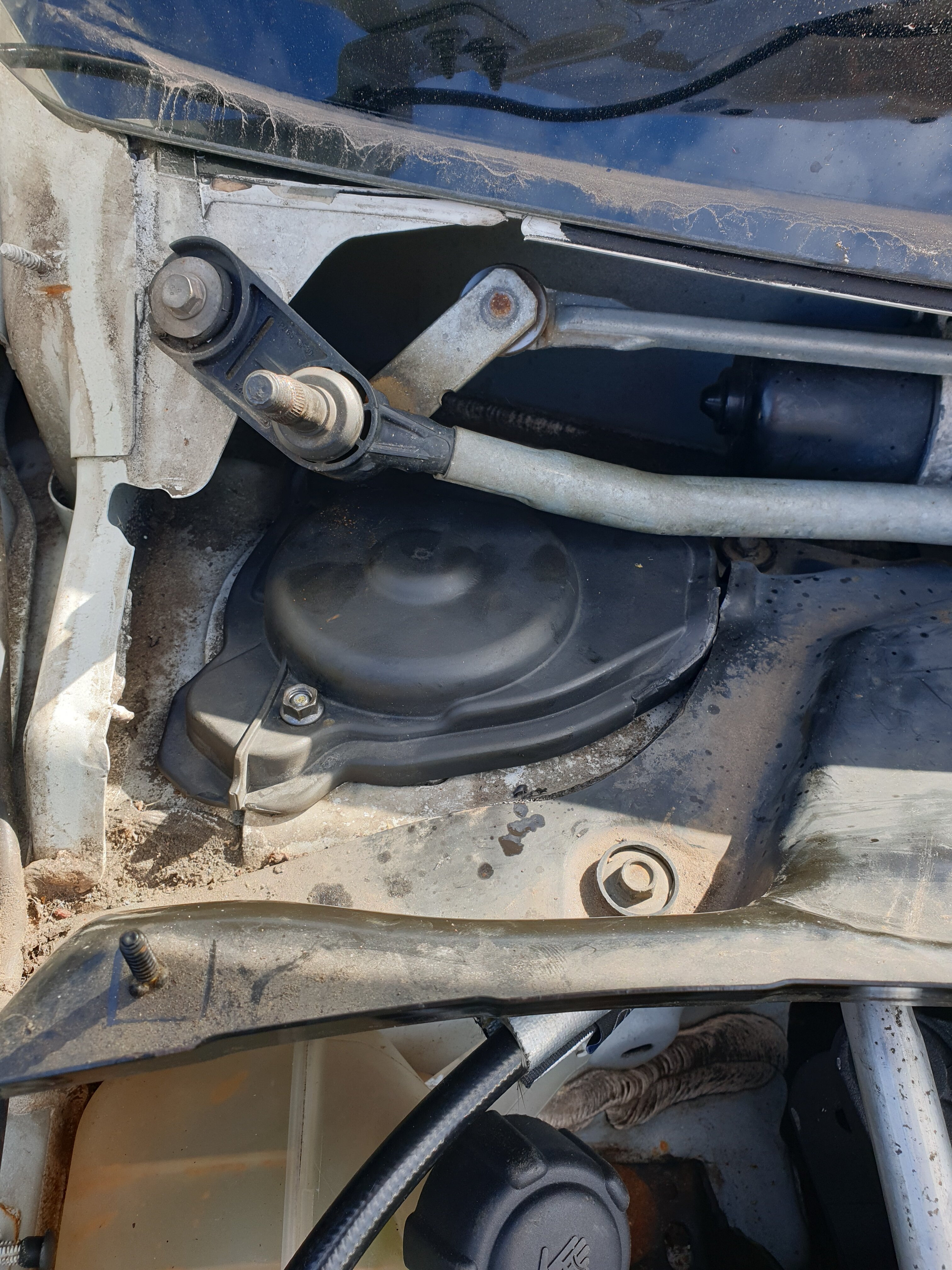

One issue i had noticed with the Kangoo is that the strut tops get covered in water, as they are under the scuttle panel which has loads of holes in. The oem ones were quite rusty, and not wanting these to follow suit as it might stand about a bit in winter, i needed a solution.
After sniffing round the clio3 has a strut top cover. Took another gamble and ordered one. Modified to suit and fits quite well, should keep most of the weather off them.
Coilover fitted. Was very straightforward bolt in no modifications required.

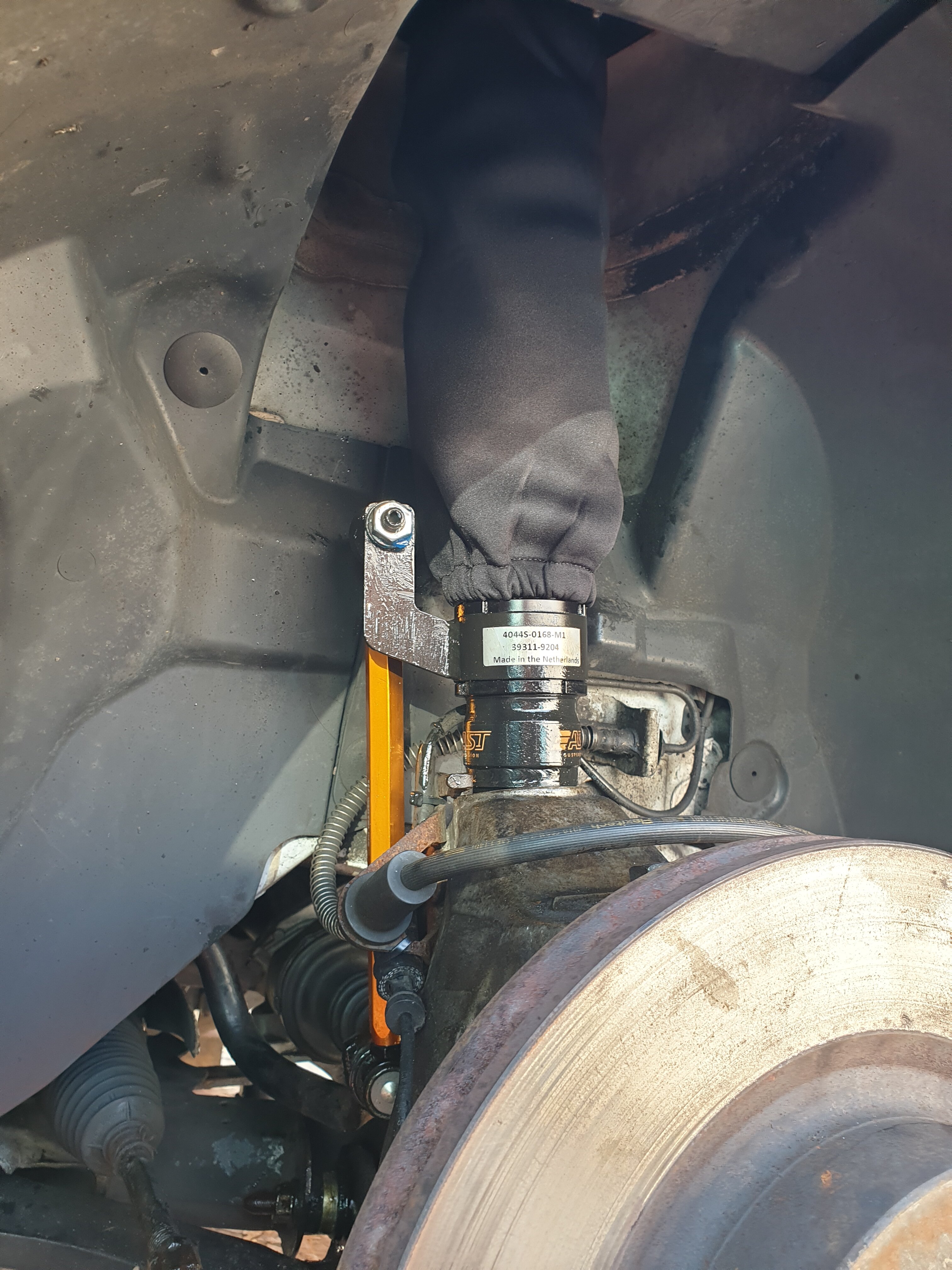

Next step was set the rideheight and camber. I can have this quite low but from a geometry perspective ive tried to keep the track control arms level and in turn that should keep the driveshafts a bit happier.
Had to dig some blocks out as too low to get the jack out initially :cautious: :LOL:
I took the same approach of setting the shocks so they have 1/3 travel for droop and 2/3 travel available for compression. Set camber at -1.5deg using some trigonometry and a spirit level. I also checked driveshaft plunge available at the rideheight, and there is around 12mm per side at least so thats all good.
Whiteline adjustable droplinks fitted. Probably didnt need these as the drop link height is adjustable on the coilover. Fitted anyway, set the arb with zero preload when at the correct rideheight. Tegiwa coilover sleeves fitted and everything coated in xcf50 corrosion block.

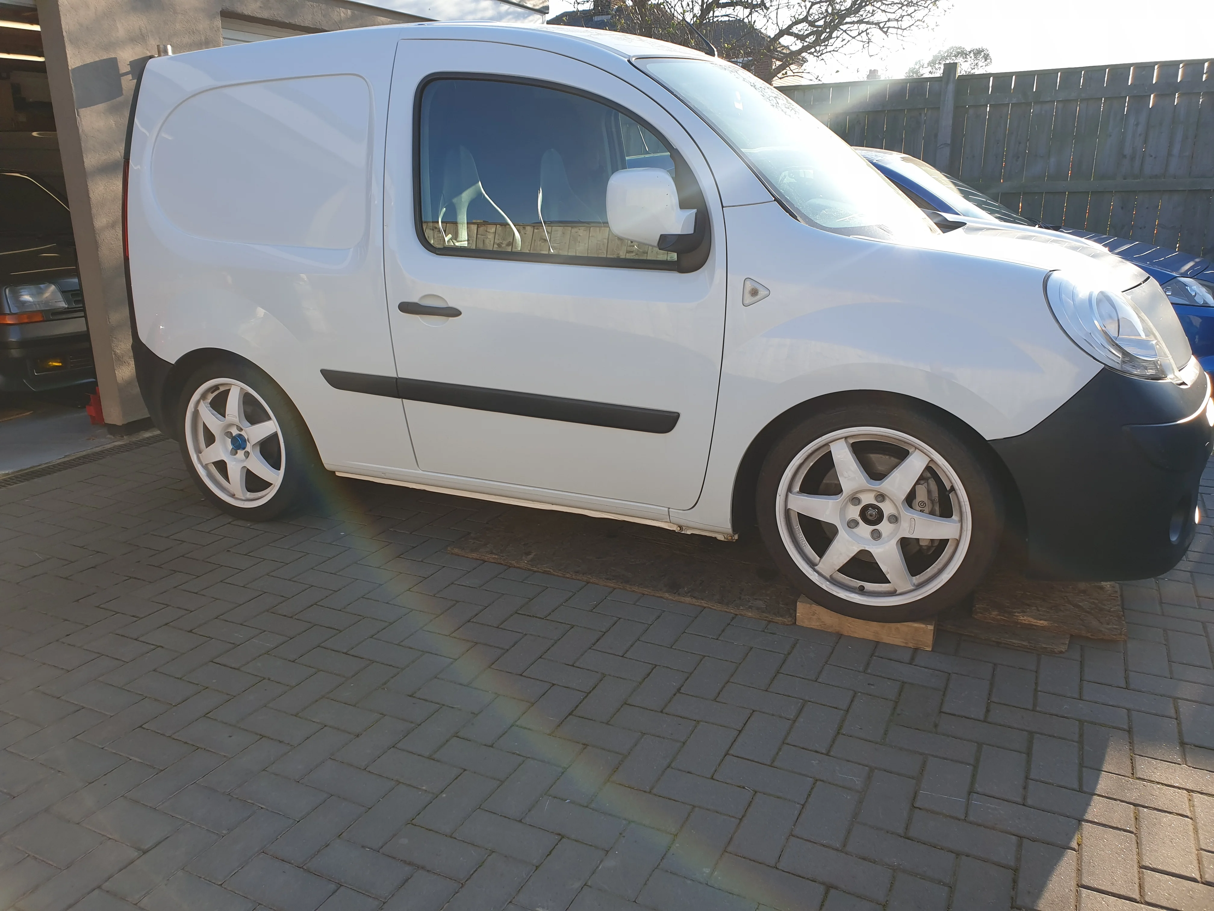

Initial rideheight set and cleaned the wheels as had black hand prints all over after removing several times whilst sorting rideheight. Its around 25mm lower than before and still has a bit of rake, with the shocks in the correct operating range. Rideheight is set level at the moment, might not be optimal from a cornerweight perspective but ok for initial running.
Toe not set up yet as will do it on the local hunter so it does not kill the tyres before i get it set up properly.
Initial test run and the difference is staggering. No more front end lift on boost. Back end still squats but totally acceptable/normal for the power. Turn in feels really sharp and you can feel the lsd working great. It actually feels like a fast megane.
The best thing is that you can actually lay the power down in 3rd gear now without it wheelspinning all over. Its still got a bit of torque steer but 90% improved and you can safely overtake stuff on full throttle without thw worry of it wanting to swap lanes.
The suspension overall feels solid as expected with the top mounts, but very compliant for road use, no crashy ride. In comparison to the bc's i fitted to our old 250 cup, this is leagues ahead.
Ideally it could probably do with more positive castor but that will involve modifying the strut tops to allow more movement. Thats one to leave to the people who set the geo up for me.

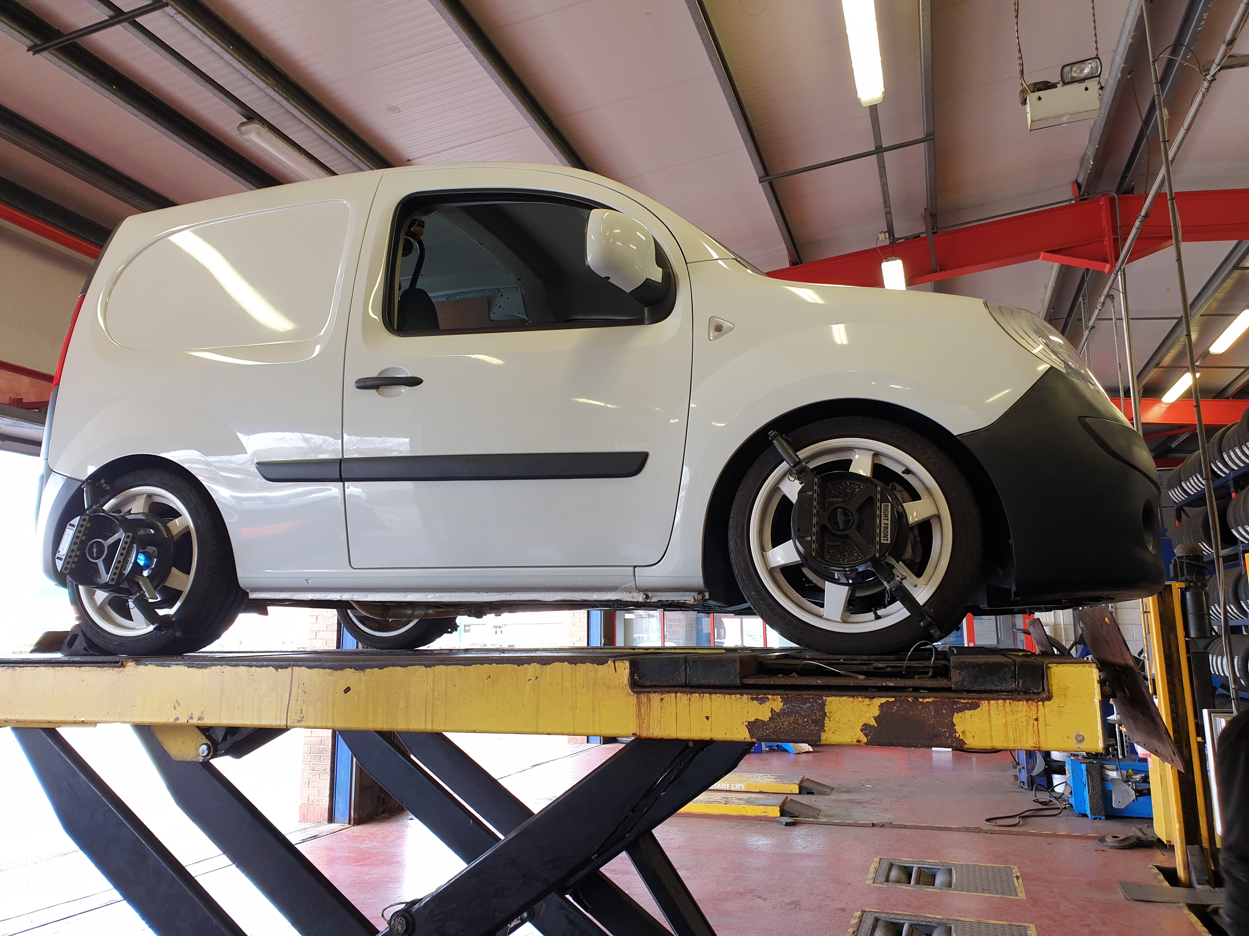

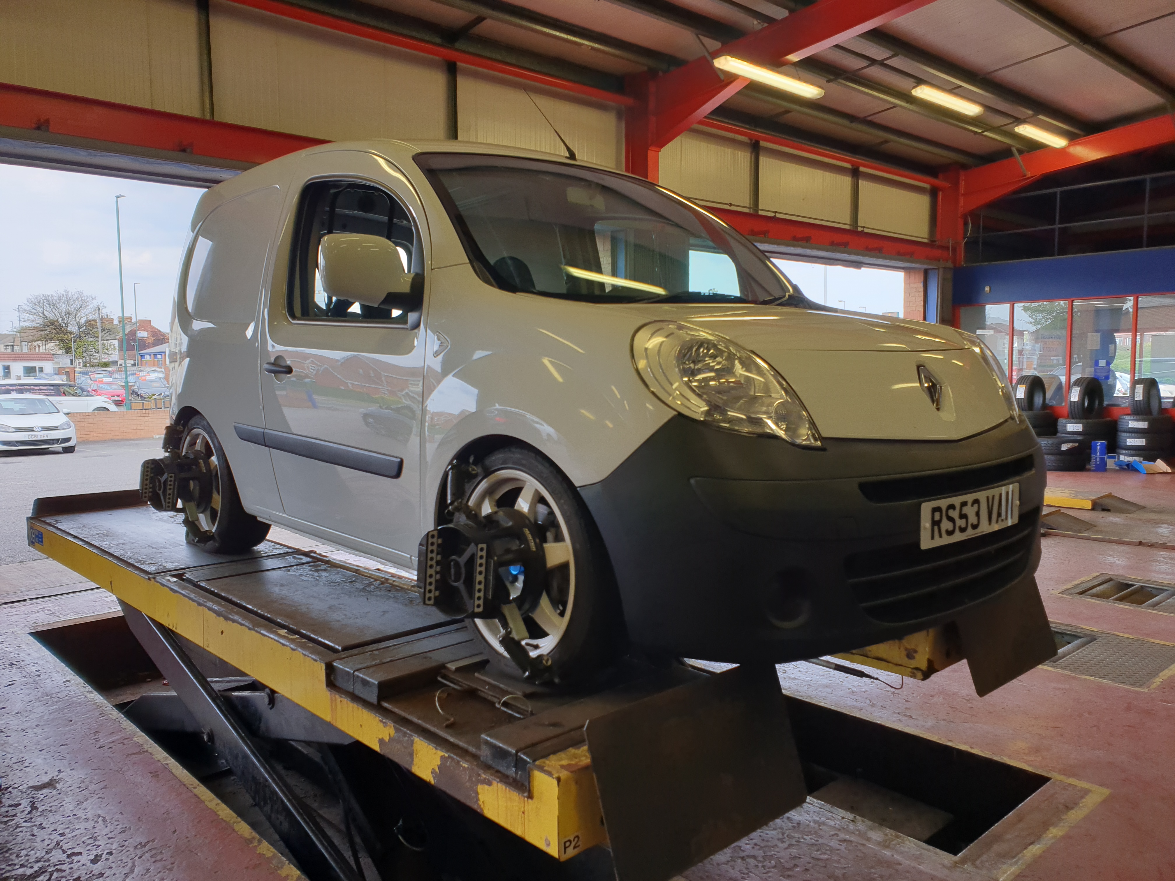

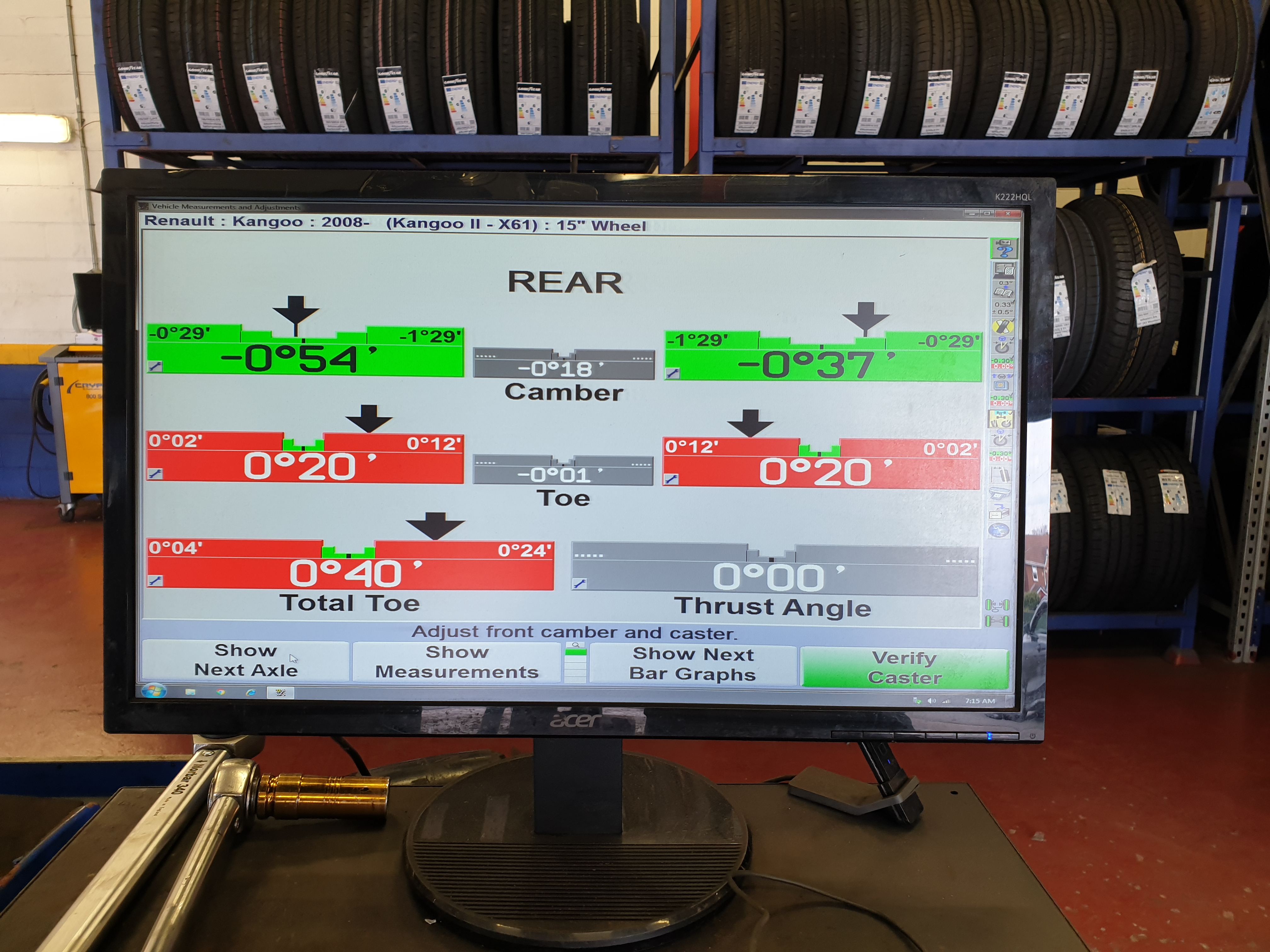

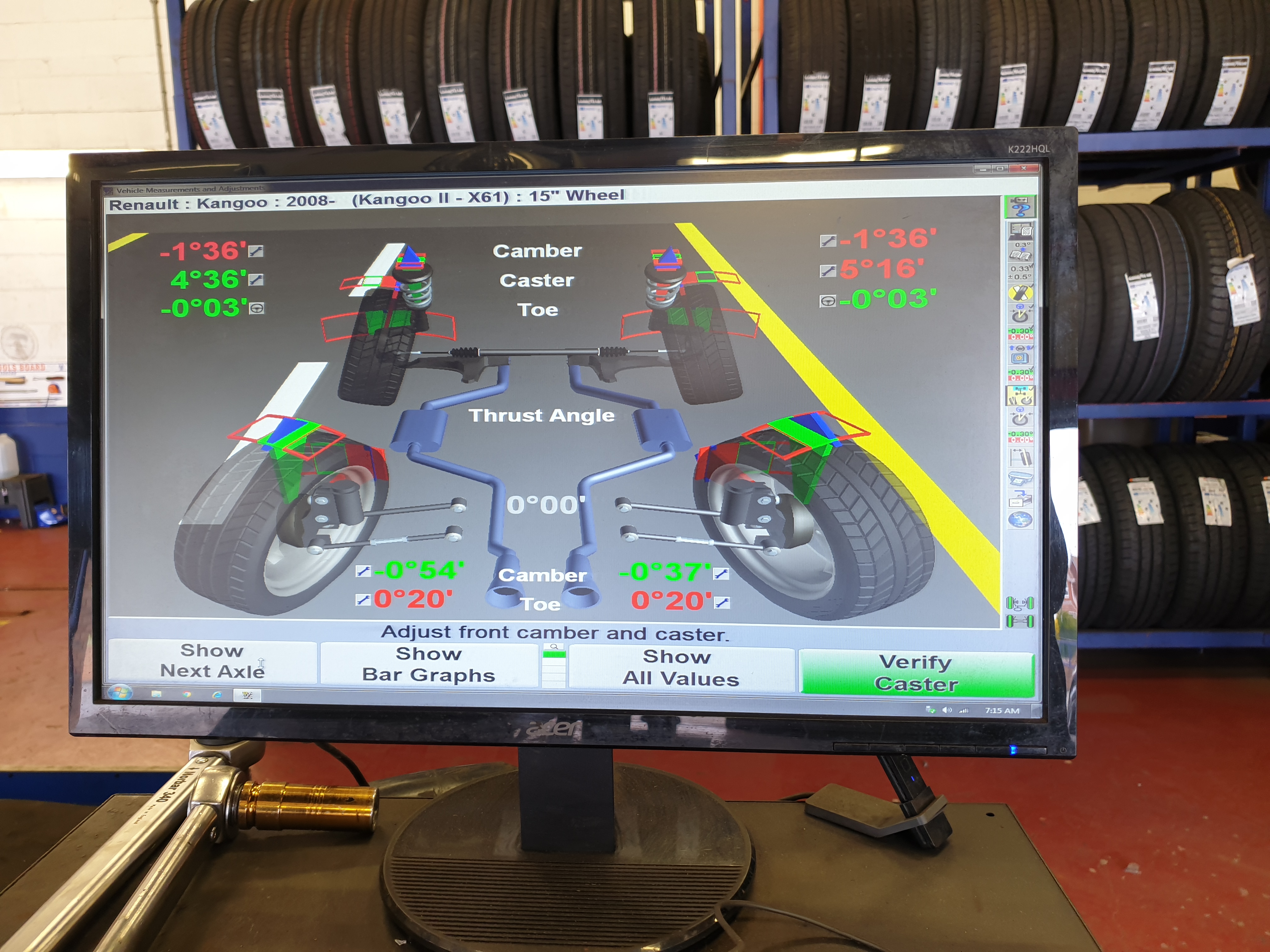

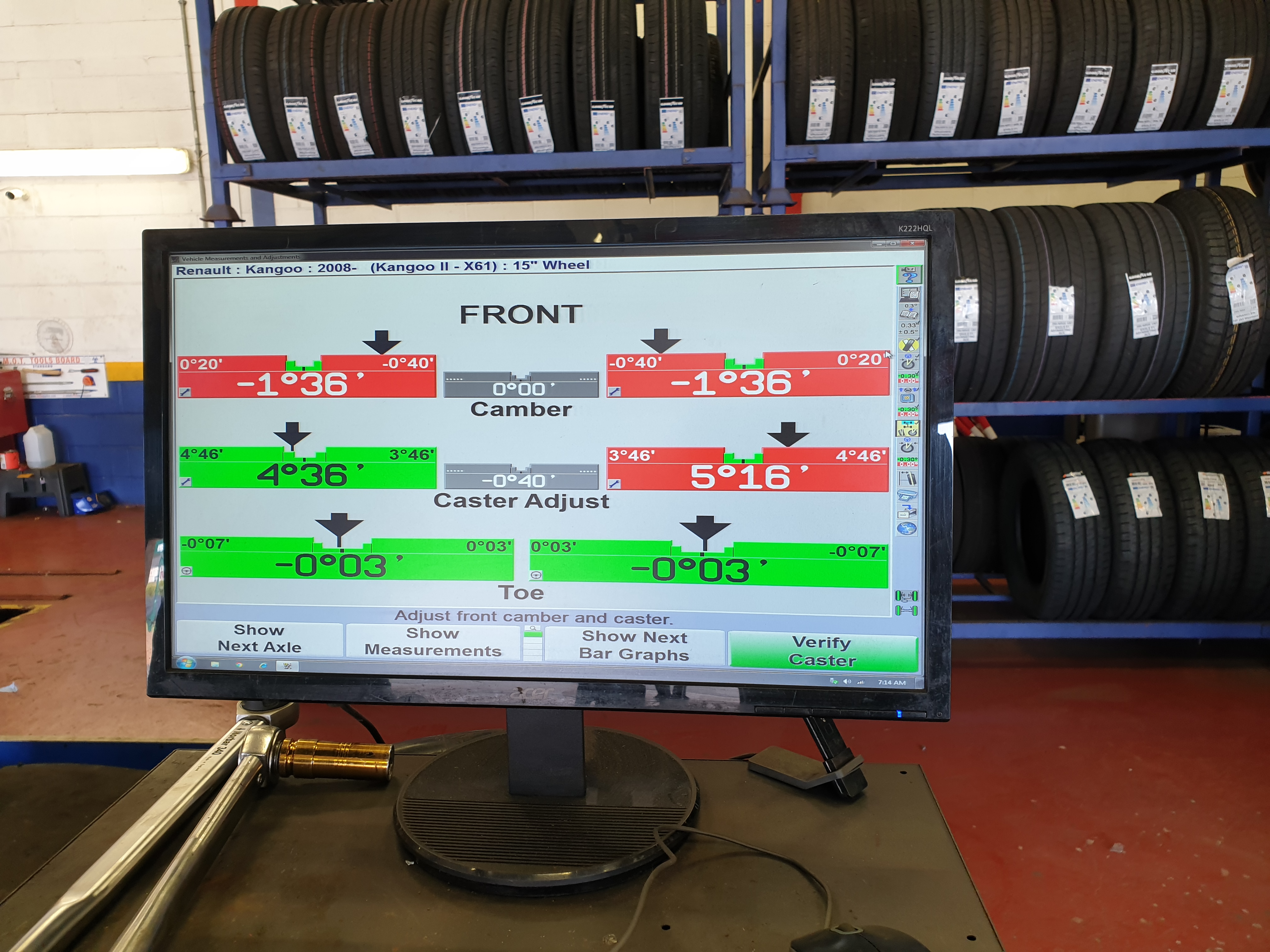

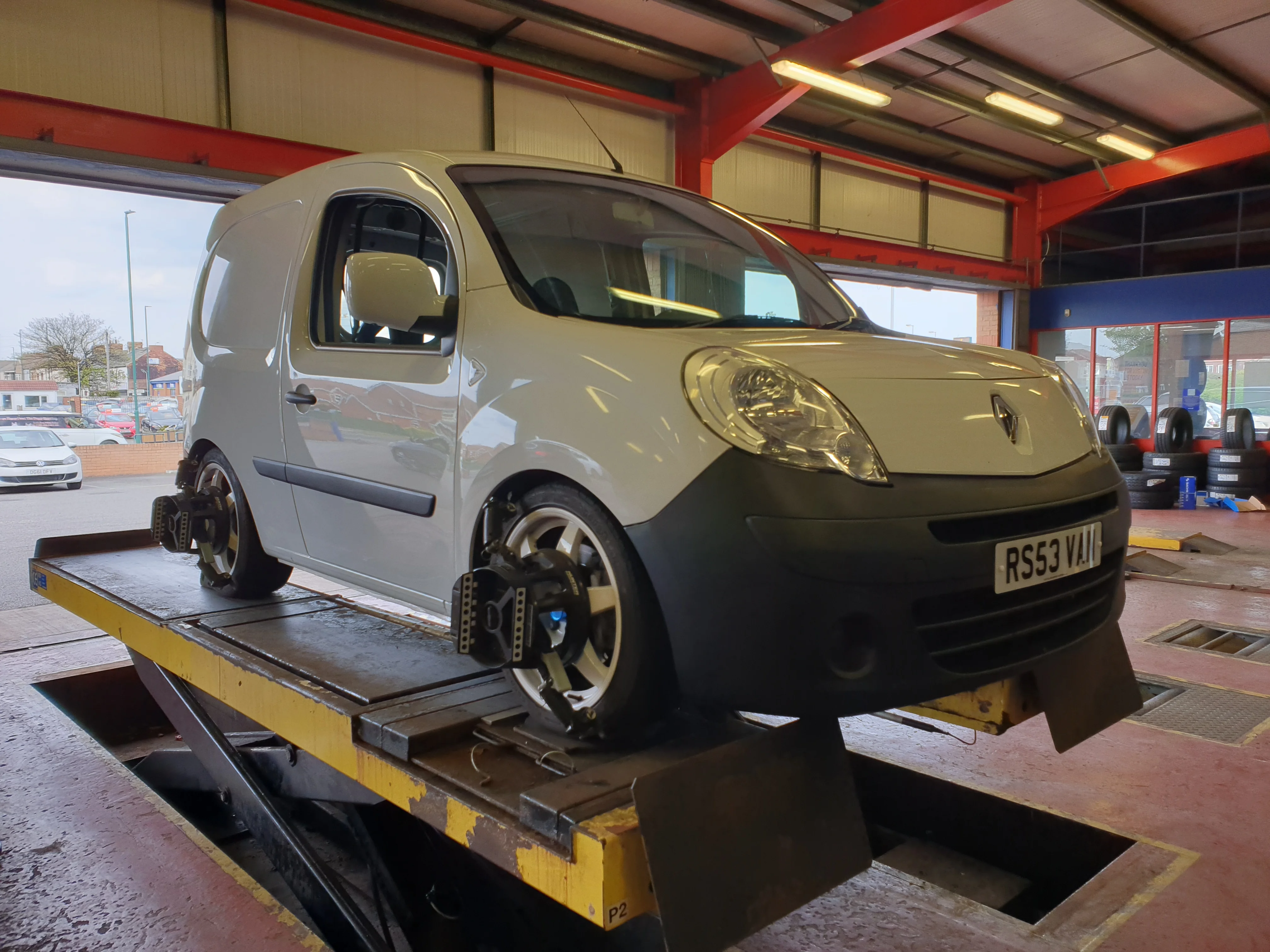

Had the toe set yesterday at my local for mates rates on the hunter anlignment.
Toe was miles out as expected. From memory massive toe in on drivers, toe out on passenger side.
Toe et close to parallel, the setup is not agressive, camber is a little bit less than planned -1.5deg but even so ill take that as i set that prior with a spirit level and some trigonometry.
Rear not bad at all, could do with a slight shim however will need custom shims as massive 60mm bolt spacing and 21mm bolts holding the stubs on.
I can report that for the first time since conversion it pulls straight on boost. The difference in drivability is amazing. All torque steer has gone which ive been fighting since converting it, you can hold the steering wheel with one hand on boost, where before it was hang on for dear life as the lsd would pull it about on any slight bit of camber. First time ive actually properly enjoyed driving it since getting it on the road, and dont need to concentrate on focusing on holding it in a straight line.
Ive been battling torque steer since conversion, with the old suspension setup it was all over the place if hitting camber on the road and lsd scrabbling for traction. It was that bad that it could put you into the next lane if hitting a bump on full throttle so had to be very careful. If it was wheelspinning then it would go straight but that defeats the object.
I renewed all the bushes and steering components up front and fitted r26 22mm arb, toe set parallel which made little difference on the old suspension.
Next step was purchasing the Ast's and fitting them made a 90% improvement although it would still be a bit skitty in certain circumstances and feeling like it was swapping power left to right although not pulling all over the place. I was at the point of pulling the box to get the lsd checked or replaced or getting the van on a chassis jig to see if the shell was straight, as had checked engine and box was mounted straight/level etc. Still can not believe the toe set up has cured all issues and on the plus side the steering has a nice weighted feeling as it used to go light before.
Its been an absolute ball ache to get right but we are 100% moving in the right direction now.

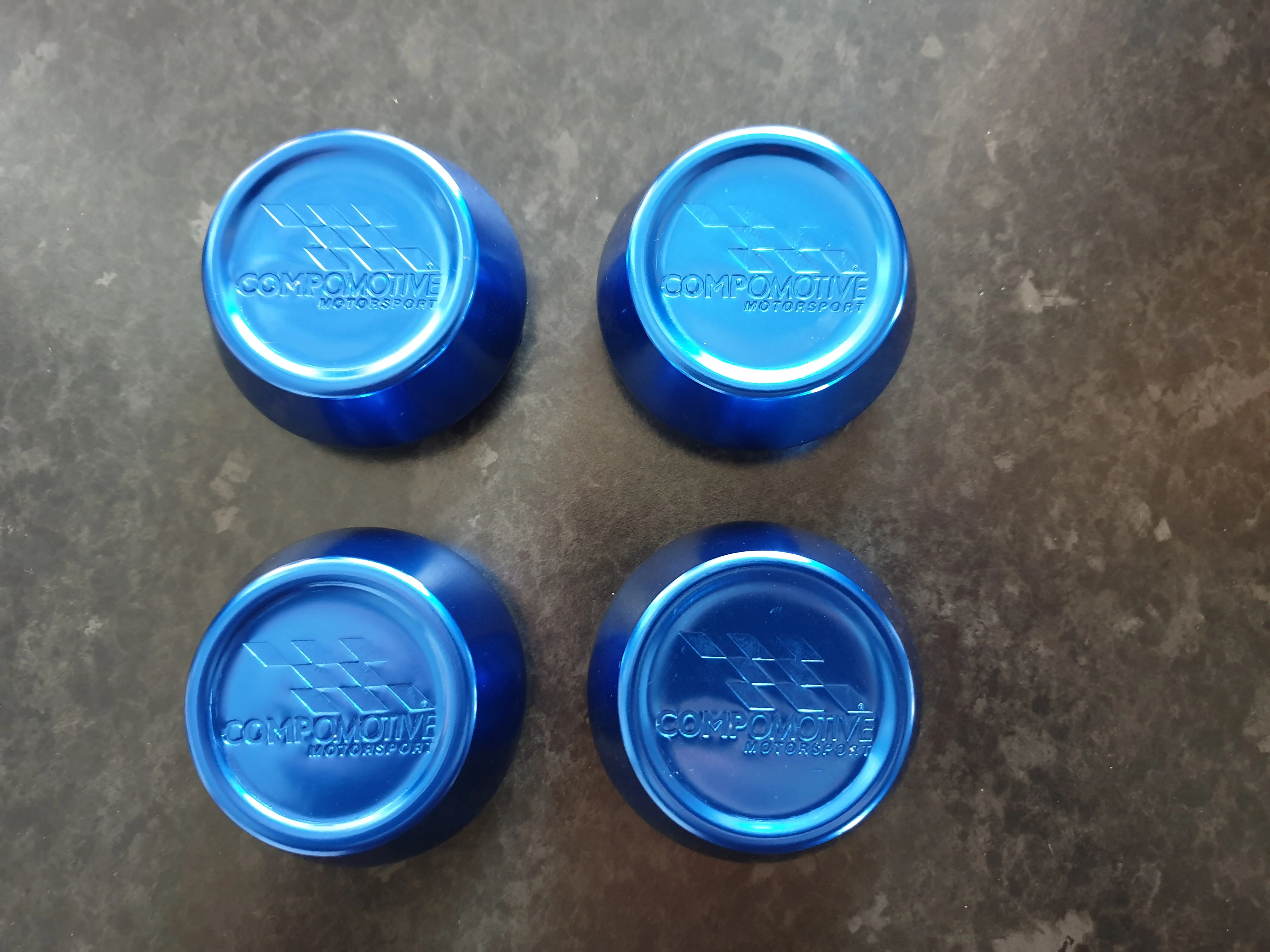

Bought another set of compomotive centre caps to have in stock for when another one goes awol

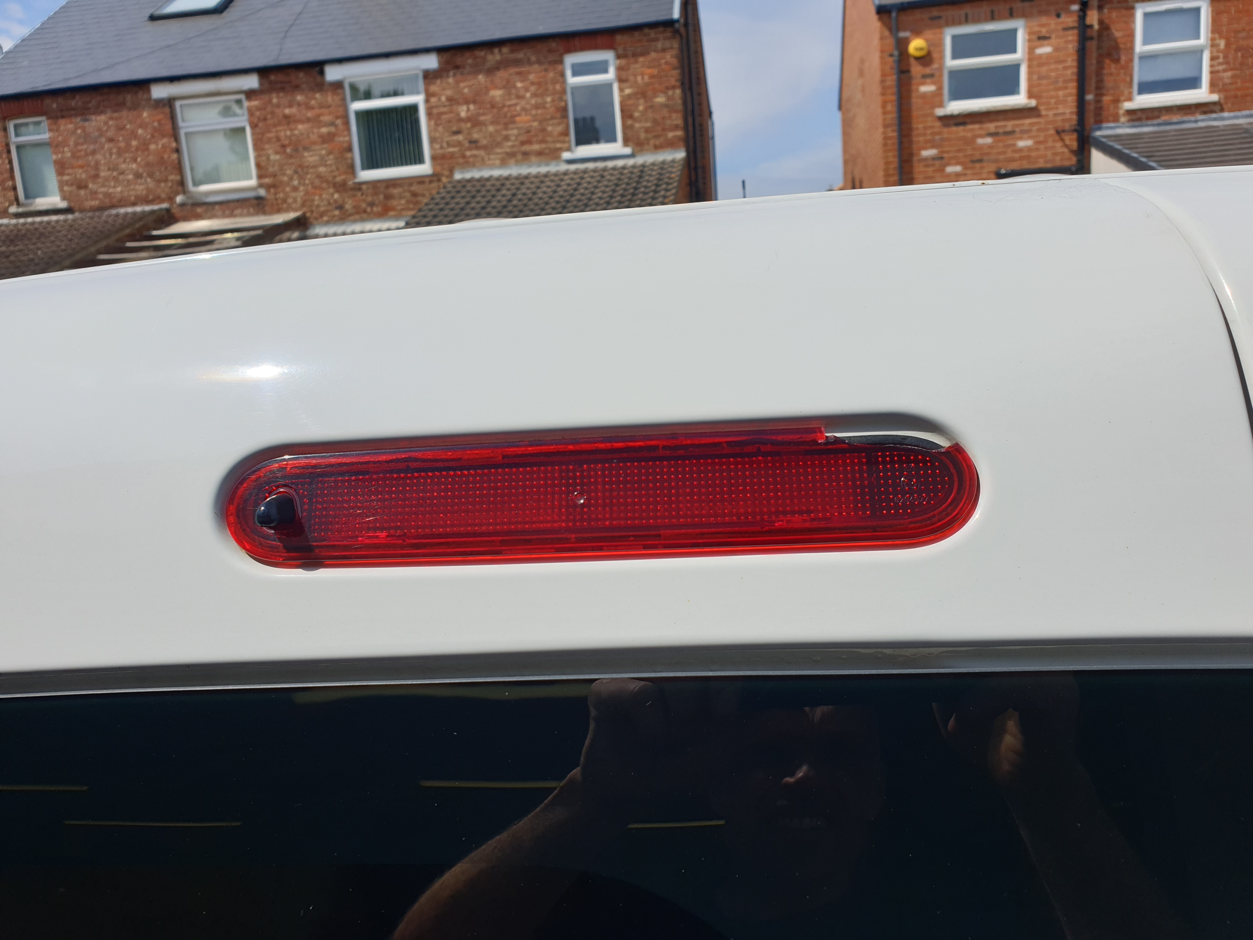

Quick win

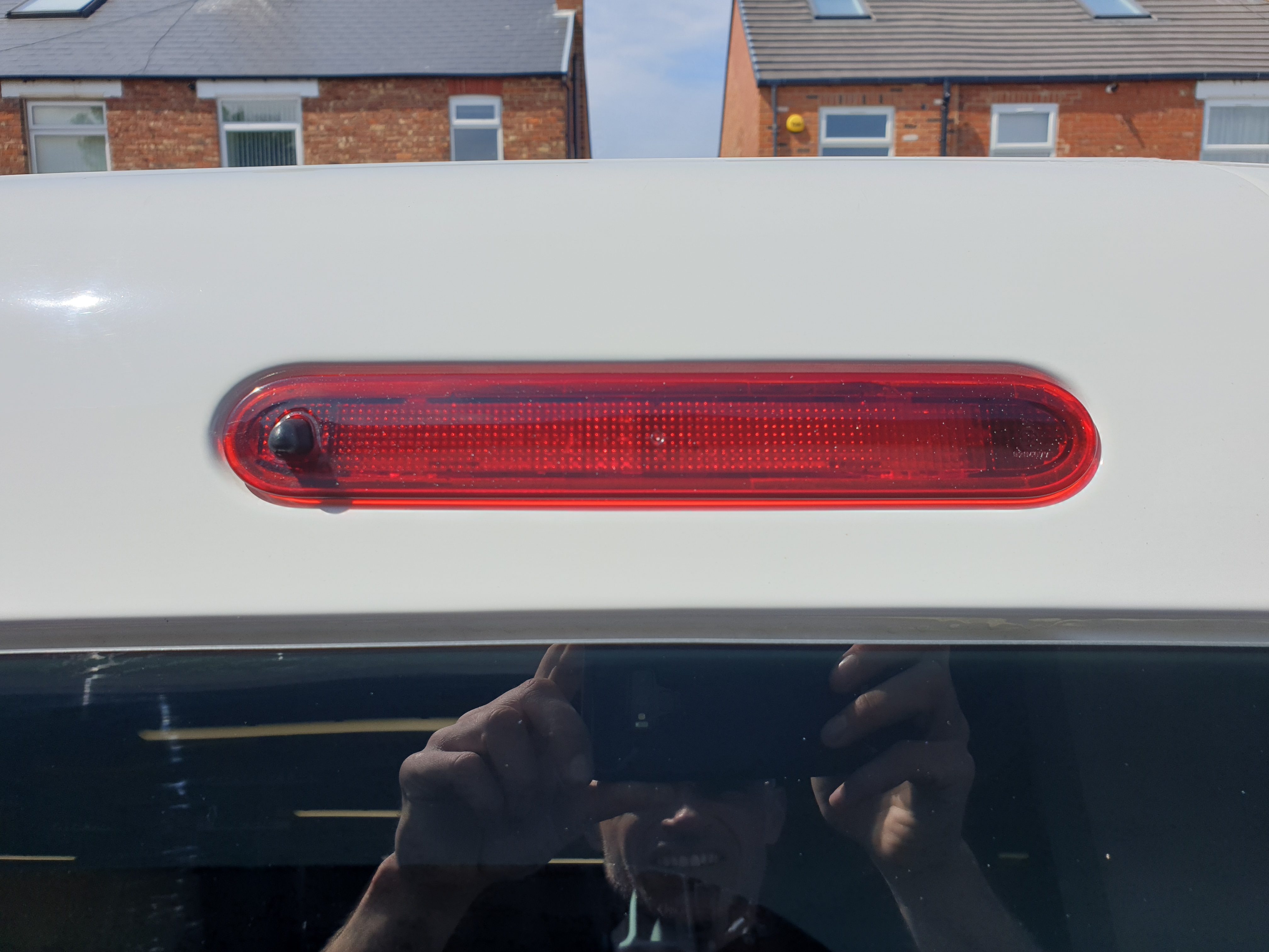

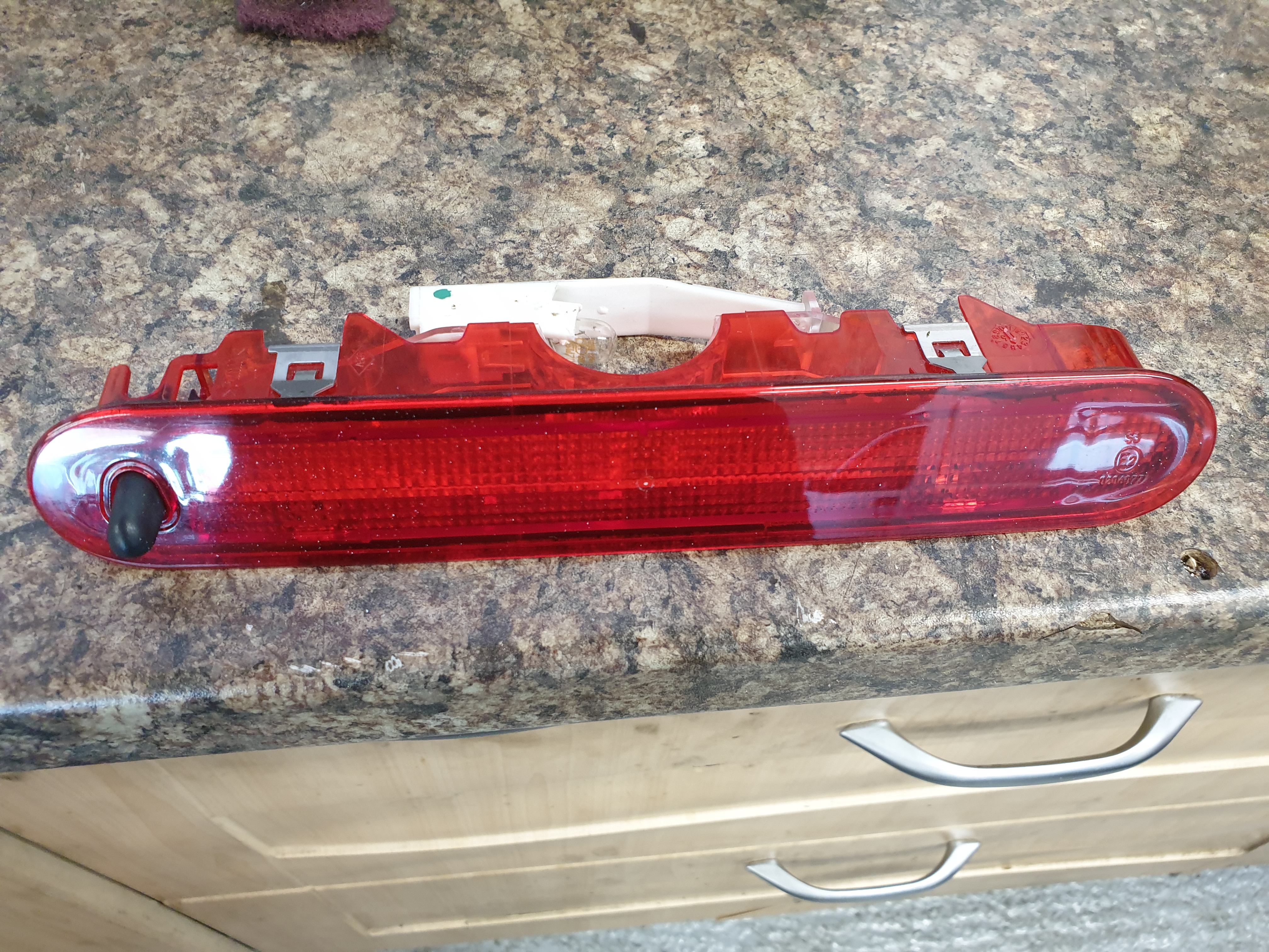

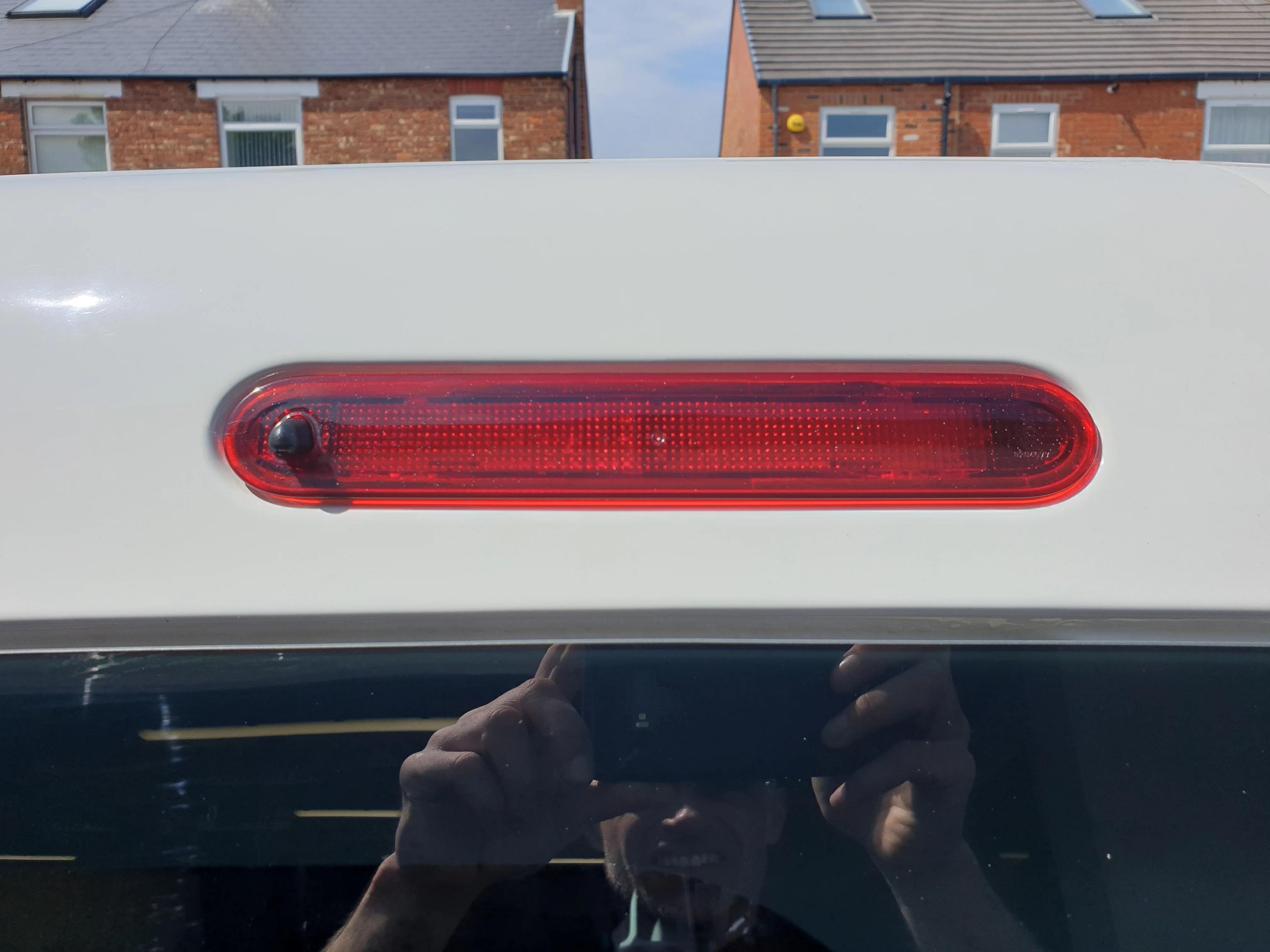

High level brake light had a chunk missing out of the corner. Ive been looking for a replacement for a while but not easy to find as it has a washer jet fitted for rear wiper and most panel vans do not have it, and couldnt be arsed spending £50 on a new one. Anyway a used one turned up on ebay at a reasonable price so purchased it.
Had a bit of overspray on so give it a quick going over with some compound and the da
Old one with chunk missing
New one fitted.

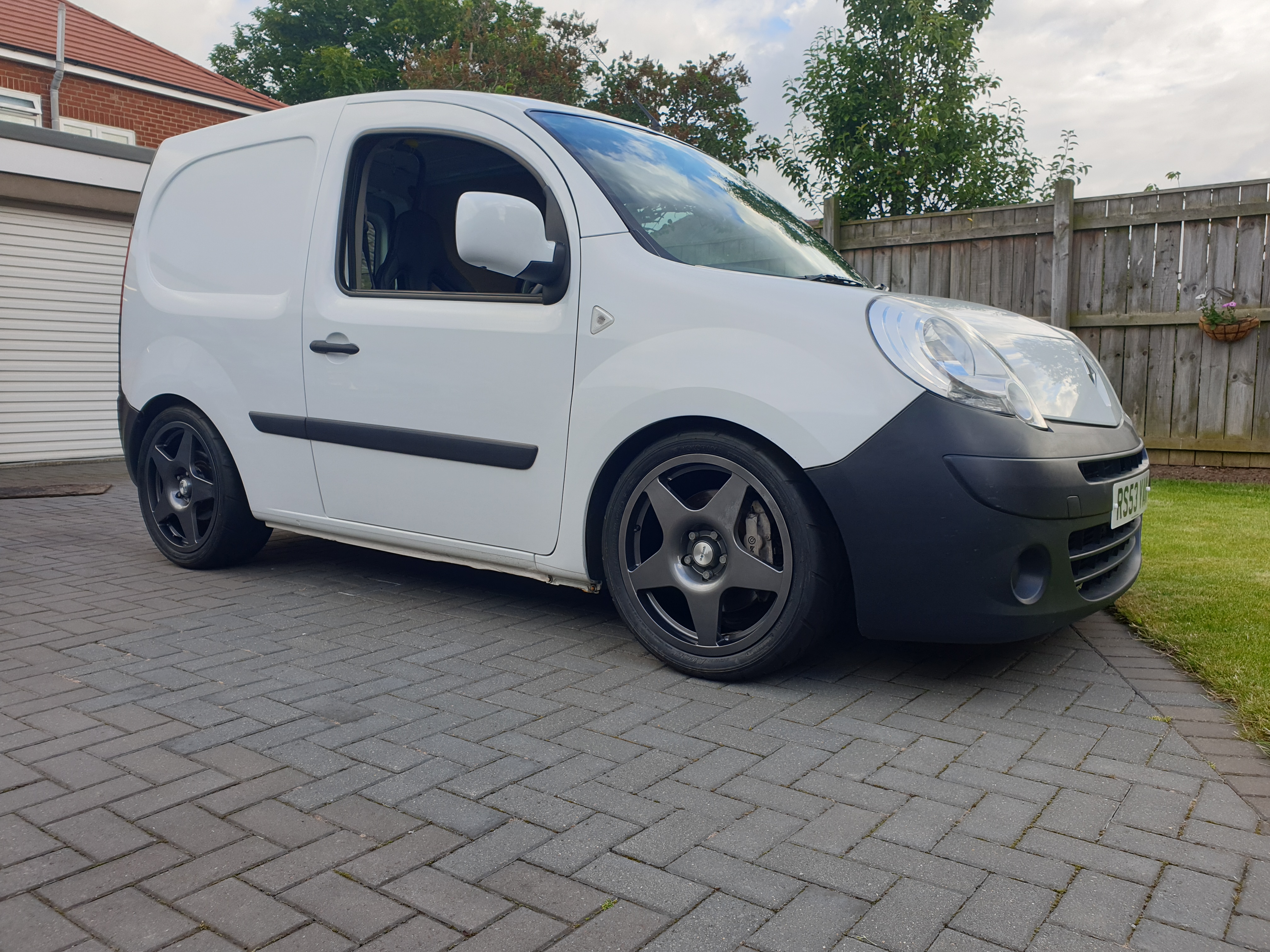

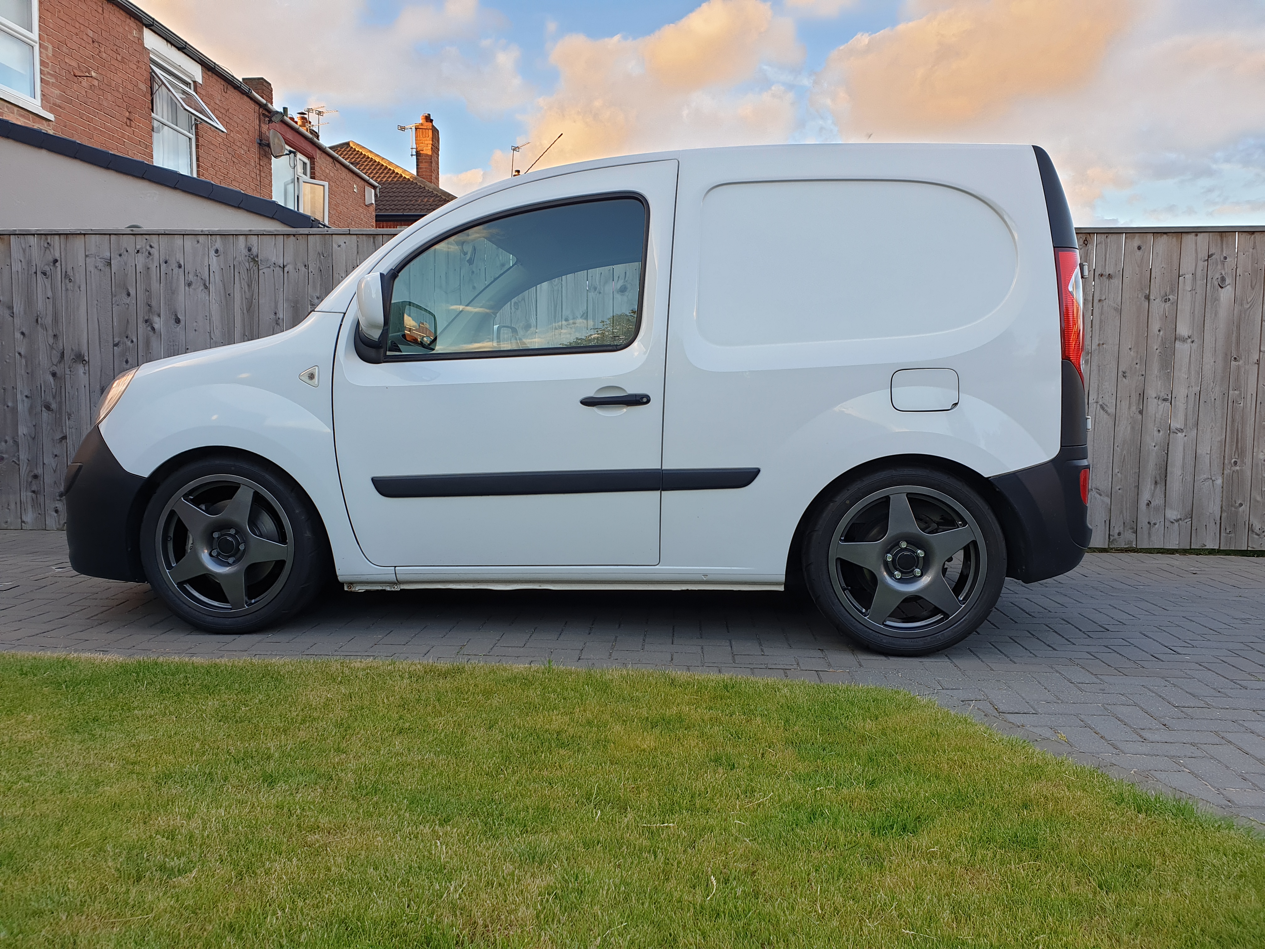

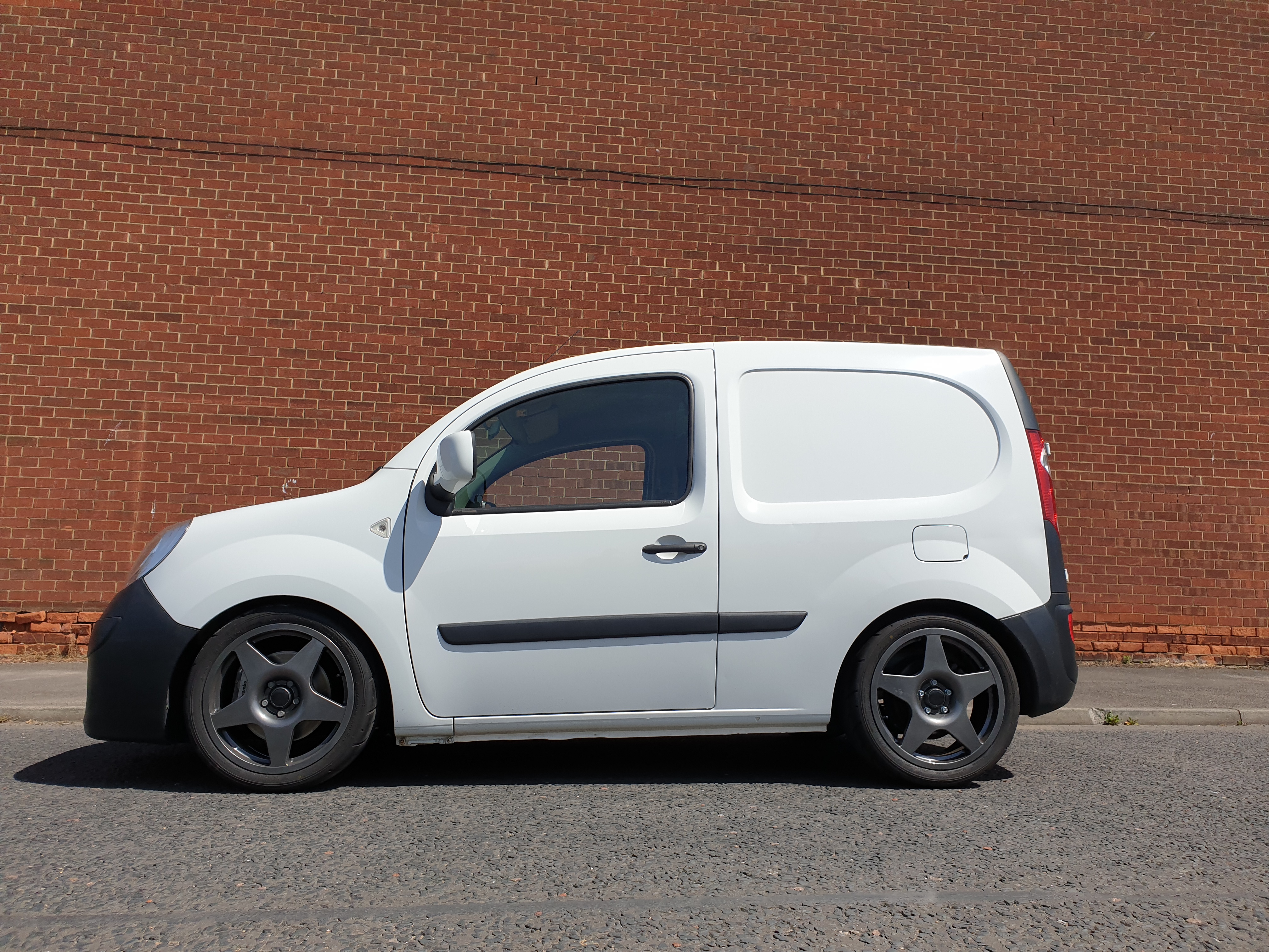

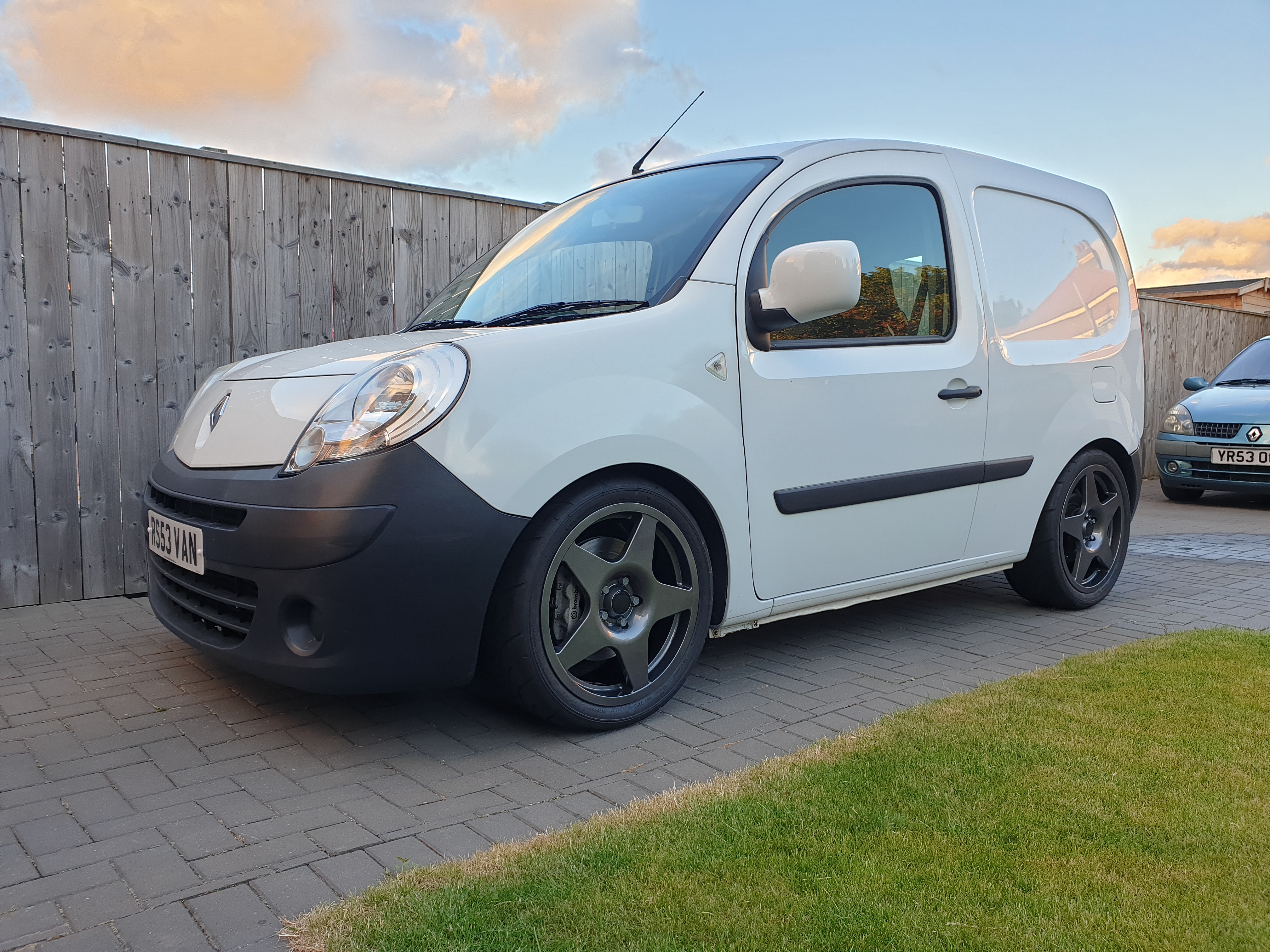

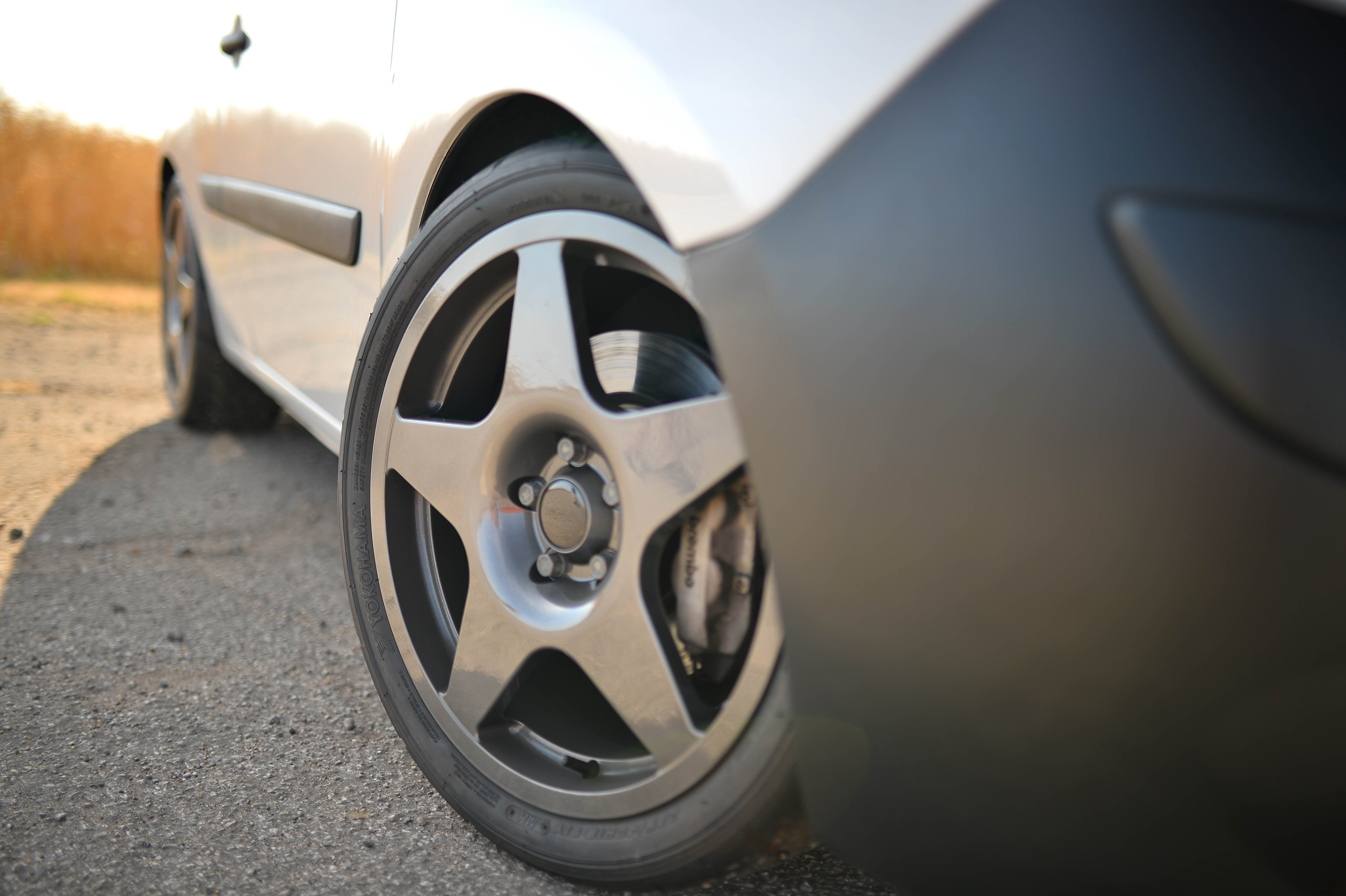

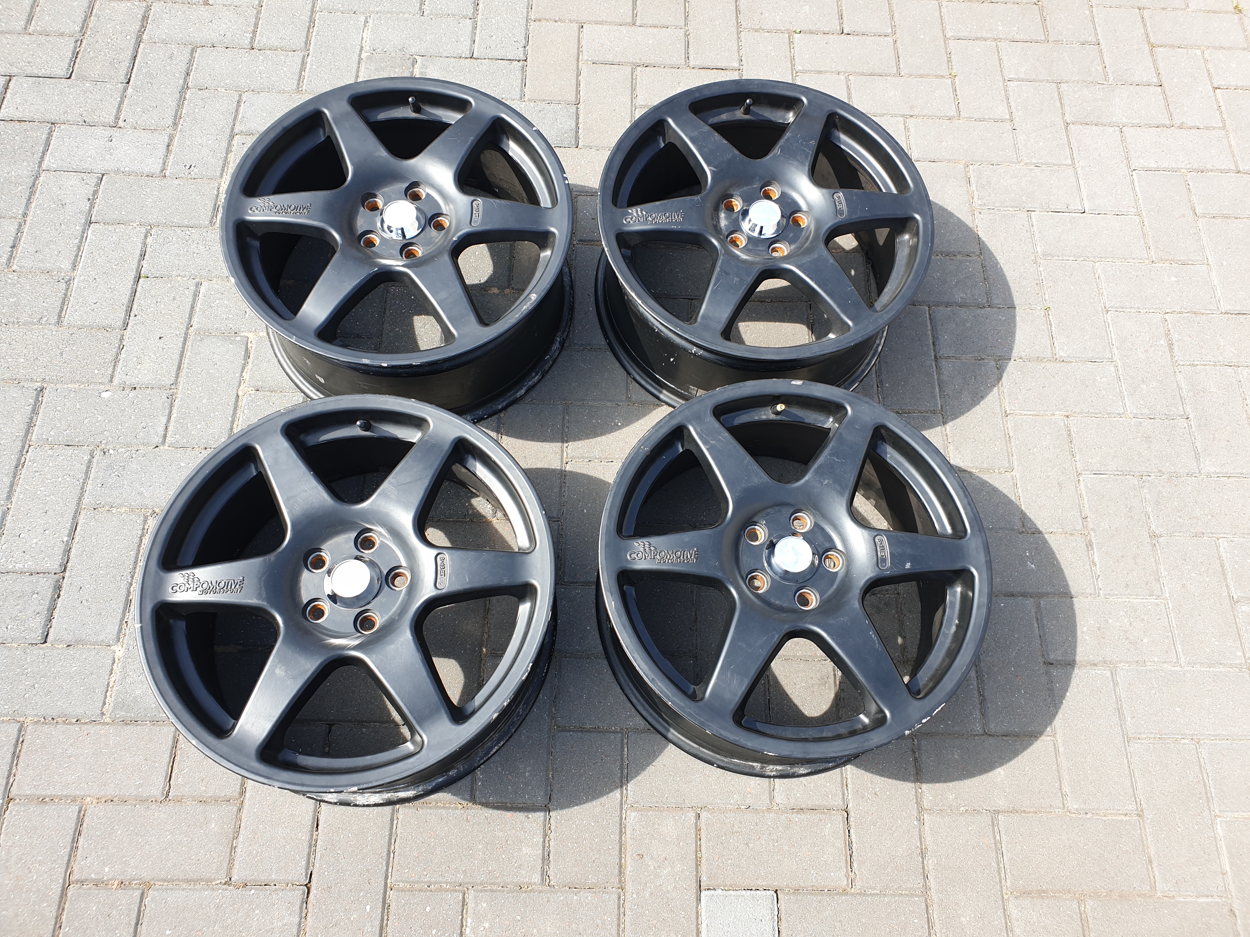

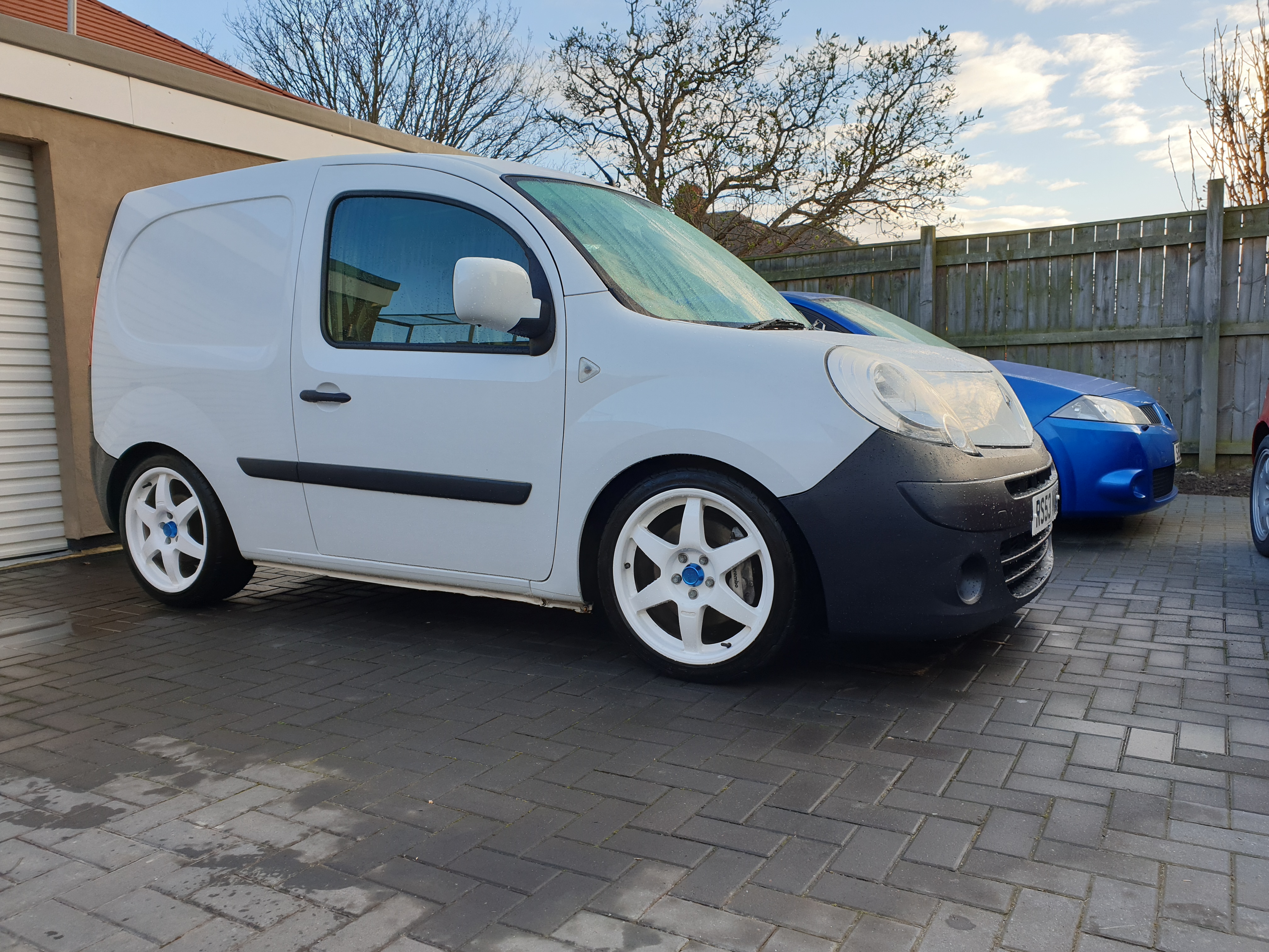

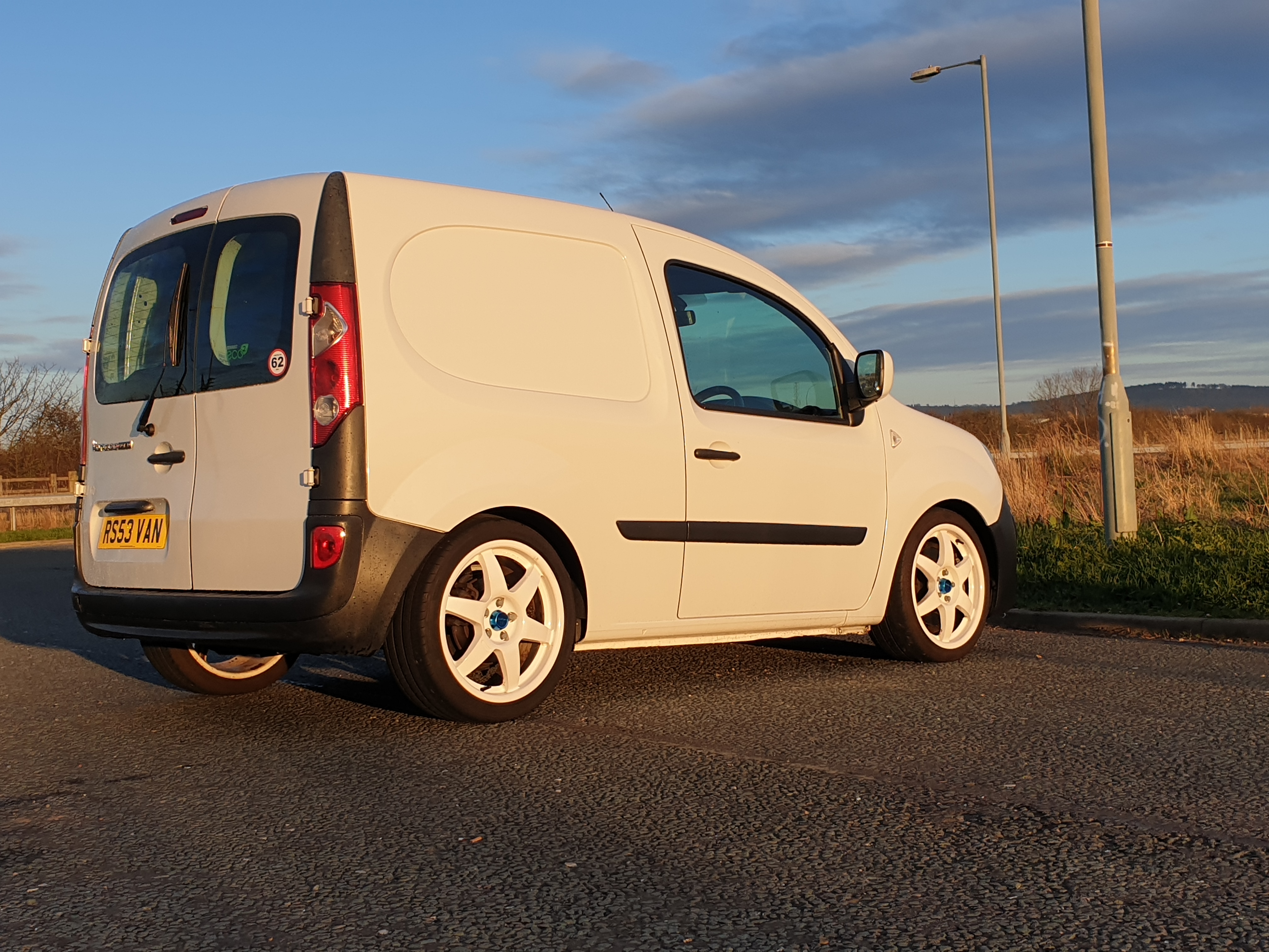

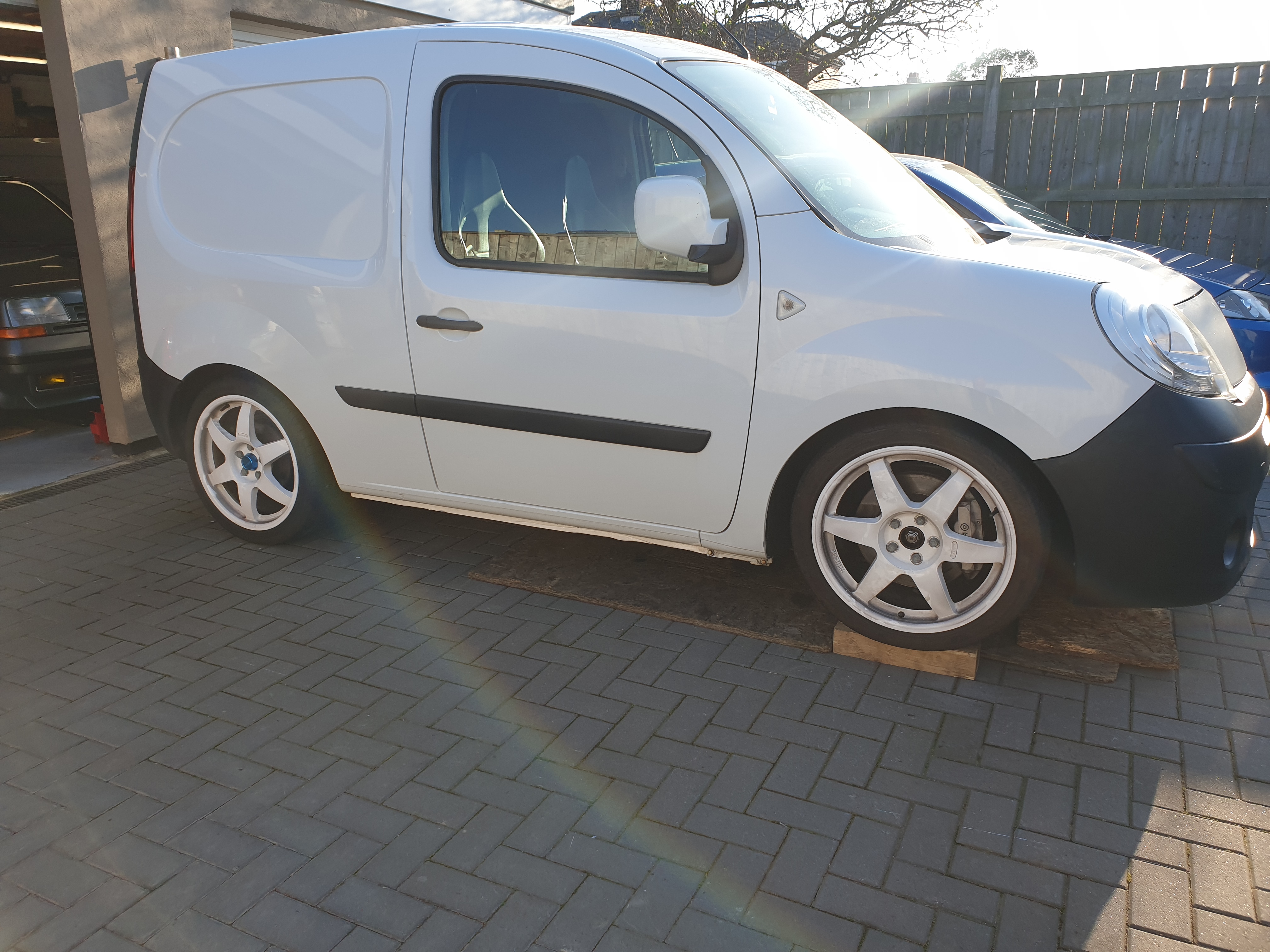

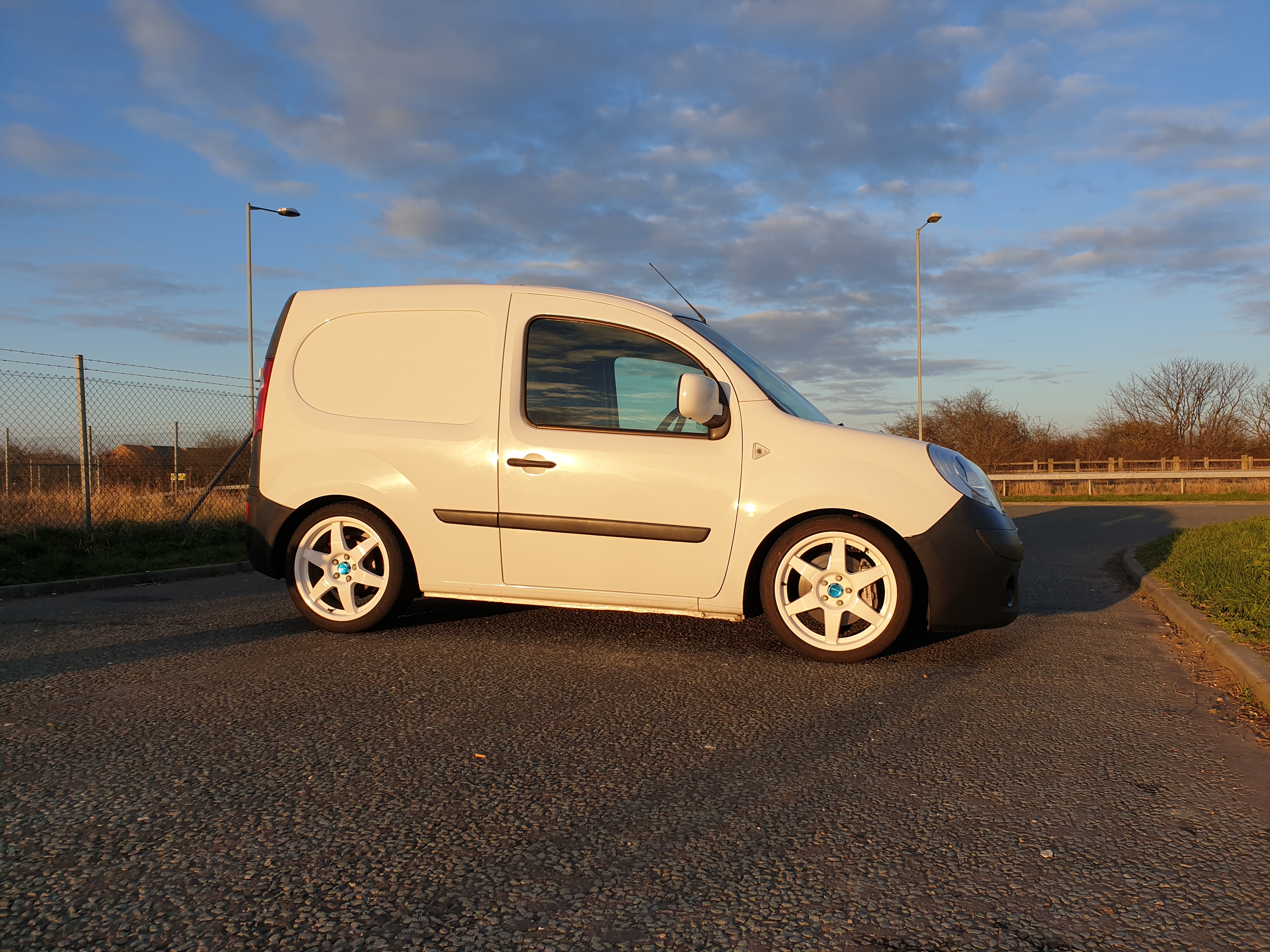

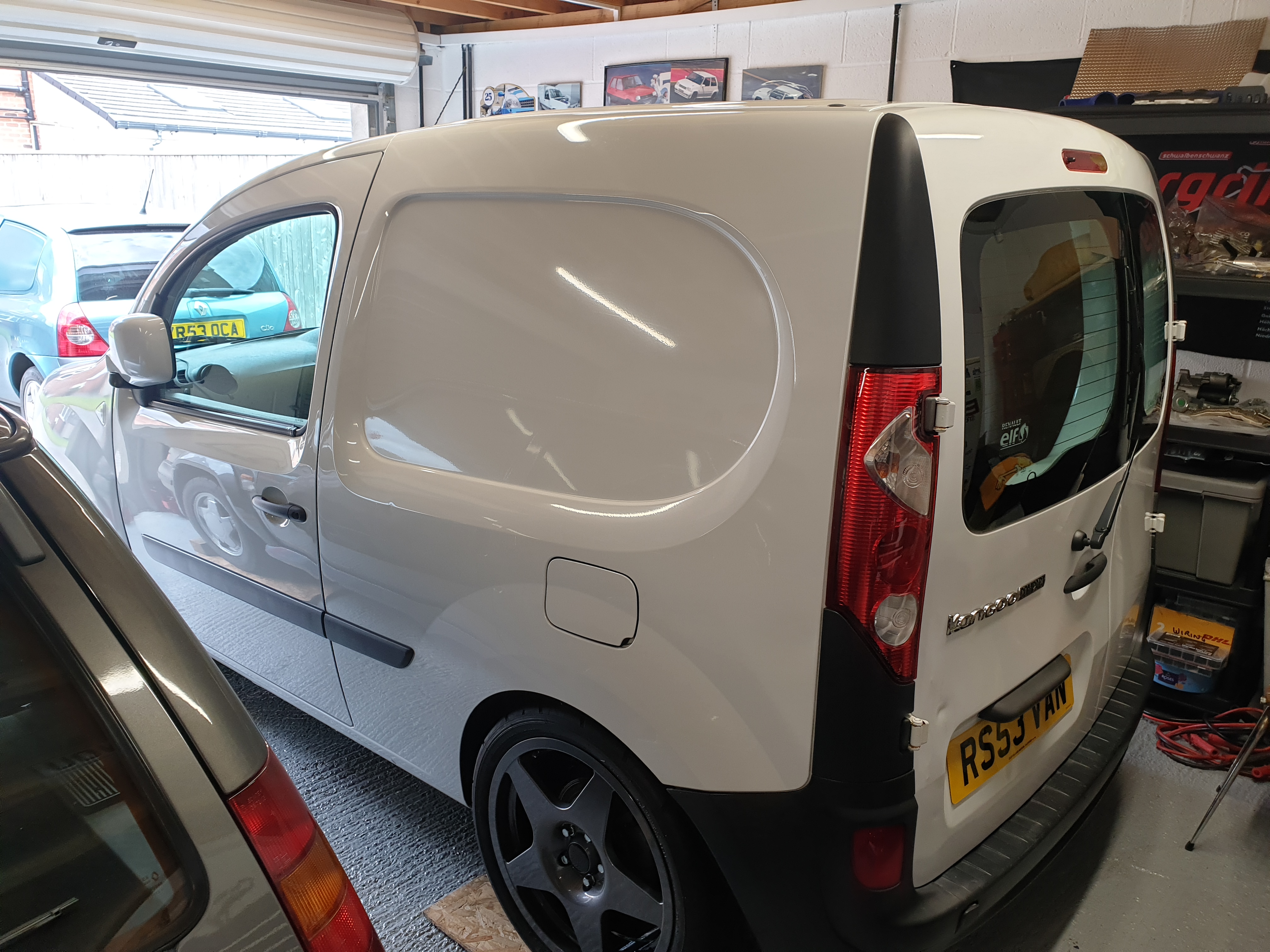

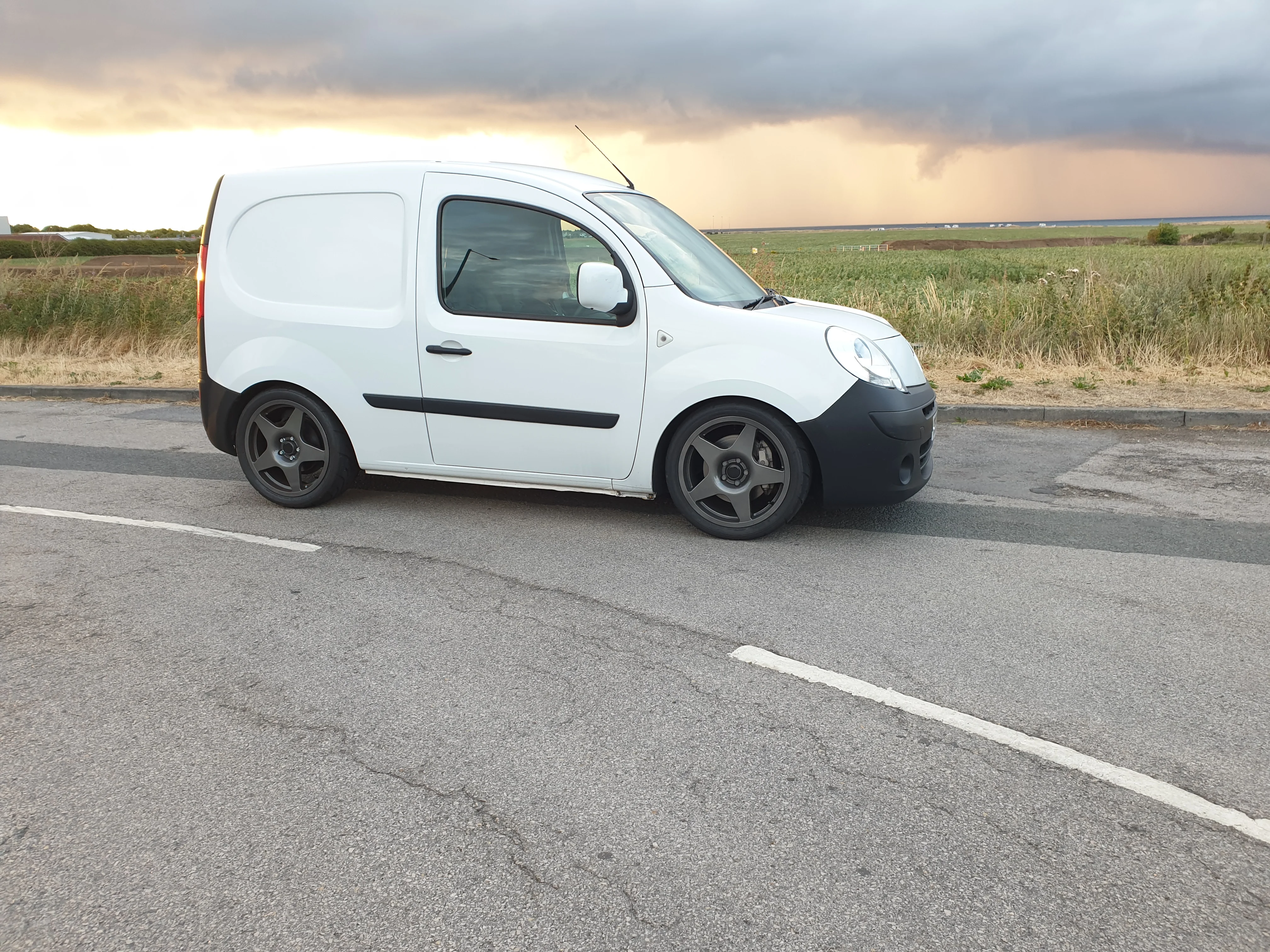

Started with a trial fit of the Technomagnesio champion 201B wheels wearing 235/40/18 Yokohama A048 Medium hard compound semis. Got these refurbed a couple of years ago for the blue meg for track use and not used them and have been sat in wheel bags in the garage.
As the Kangoo needs a lower offset than the meg on the rear for clearance from inner arch a spacer is required. I dont need to run one with the mo6 as its a staggered set with lower et on the rear approx et50, i believe the technos are et60.
I have a pair of 10mm pms slip on spacers in stock which work ok as the hub centre is massive so plenty left to locate the wheel, and clearance is good. Should be epic on a dry track with this combo😁
Liking the look of them fitted now its suitably low. The wheels are like a cross between oldskool flat faced compomotive mo5 and speedline corse 1822, nice motorsport look.

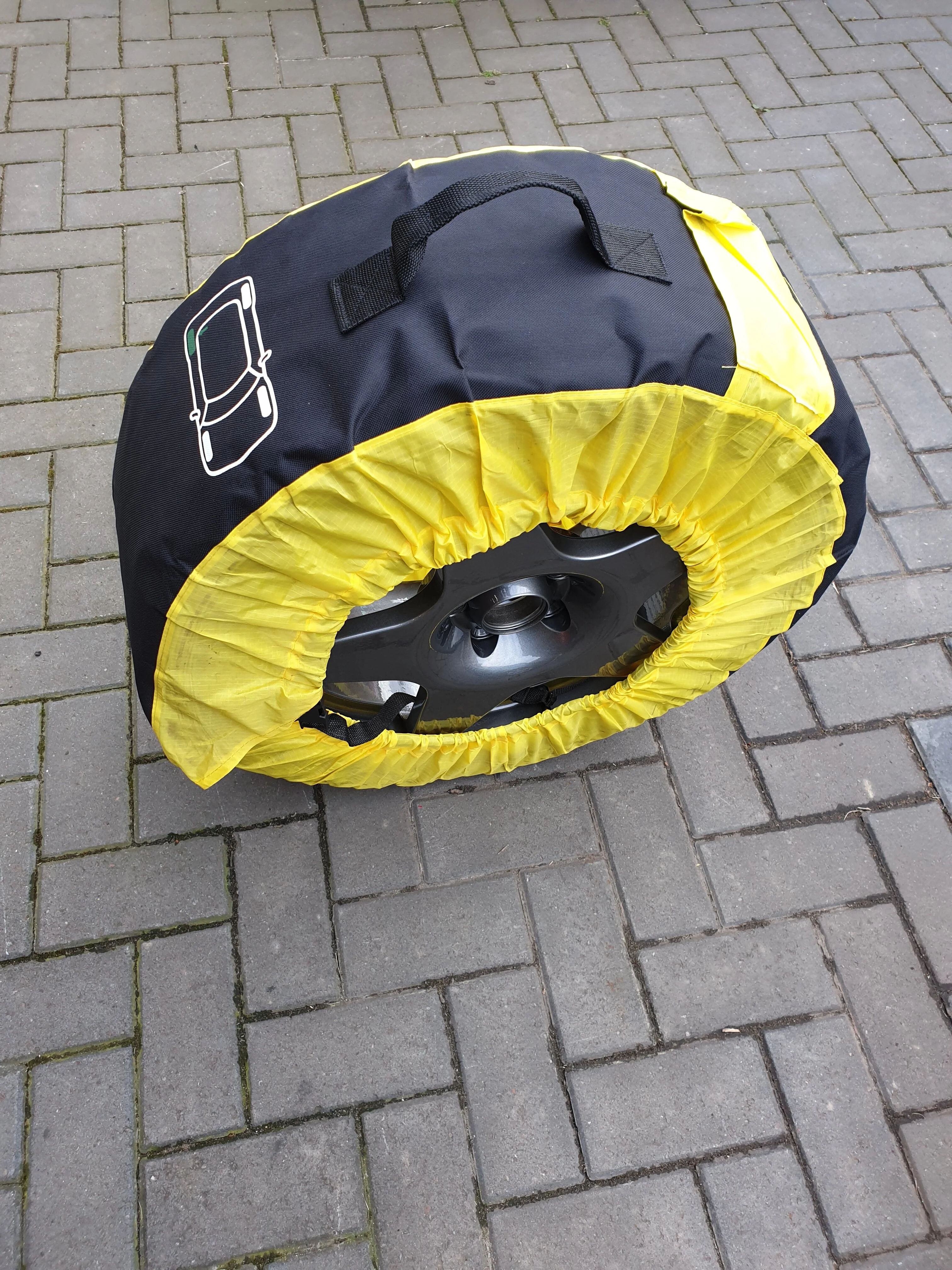

Love reading the updates on this. Also those Renault wheel bags! Where does one come across such things!

Cheers all. I got the wheel bags from rofag via ebay a couple of years back, they were reasonably priced at the time but cant see them for sale anymore. Generic wheel bags that look similar are dirt cheap though £5-10 a set.

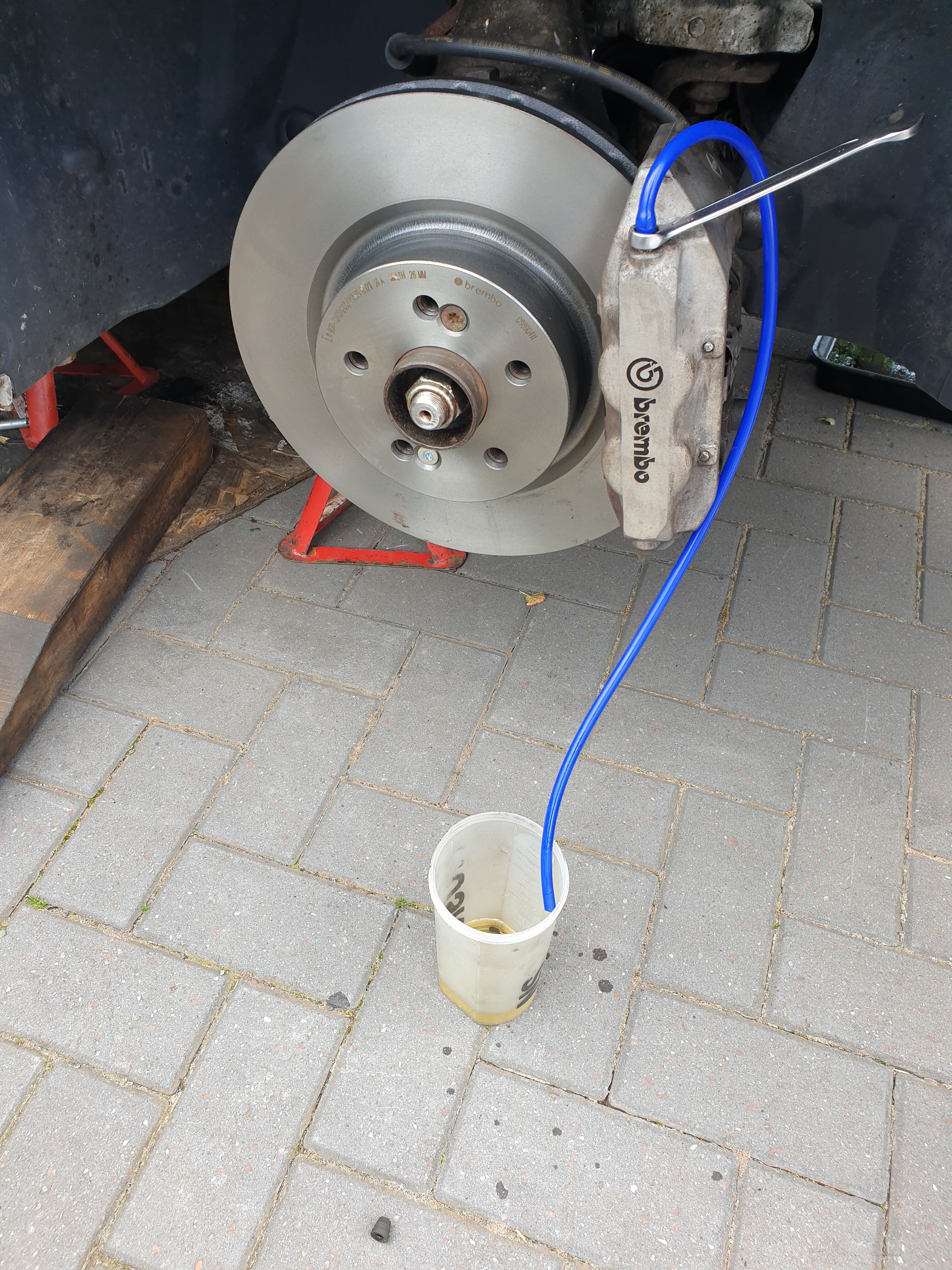

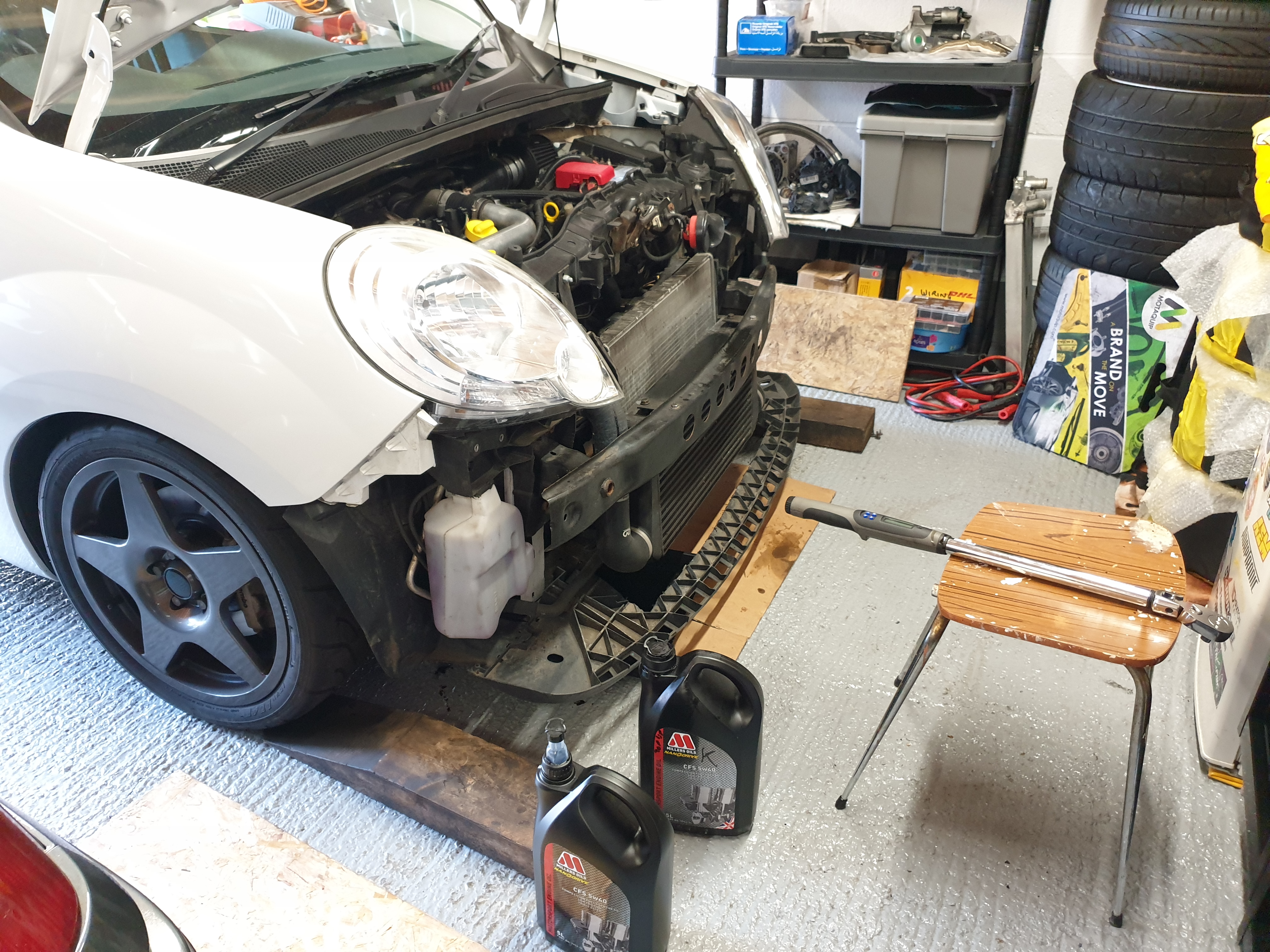

New brembo hc front discs fitted, ferodo ds1.11 front pads, system fully flushed with motul rbf 600 fluid.
Discs come pre painted on the bits that rust in anthricite and look well.
Pressure bled brakes in sequence and the pedal went a bit long for some bizarre reason was no issues prior. Give them another bleed and air came out of the rears and now the pedal feel is wicked. Flushed clutch hydraulics too.

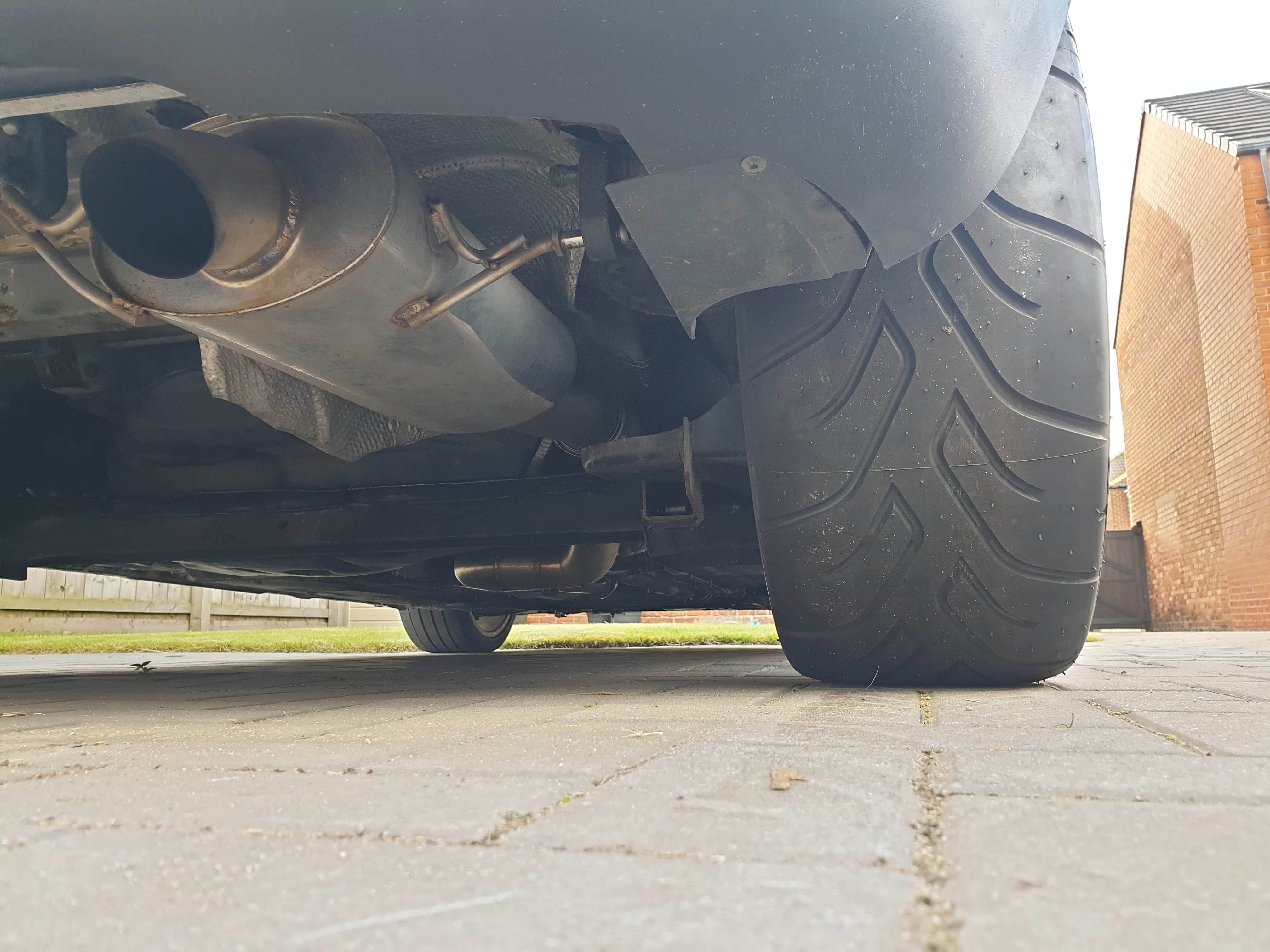

Technomagnesios on now longer bolts have arrived for rears due to 10mm pms spacers. Black ebay special centre caps fitted as only had 2 of the silver ones in last pics. £6 delivered for them, bargain
Took it out this morning to bed the brakes in and once some pad material was on the new discs the stopping power is unreal.
Quick stop by the old woodyard in M/boro whilst brakes cooled a little.
The handling with the Yoko a048s on feels awesome. Solid and planted.

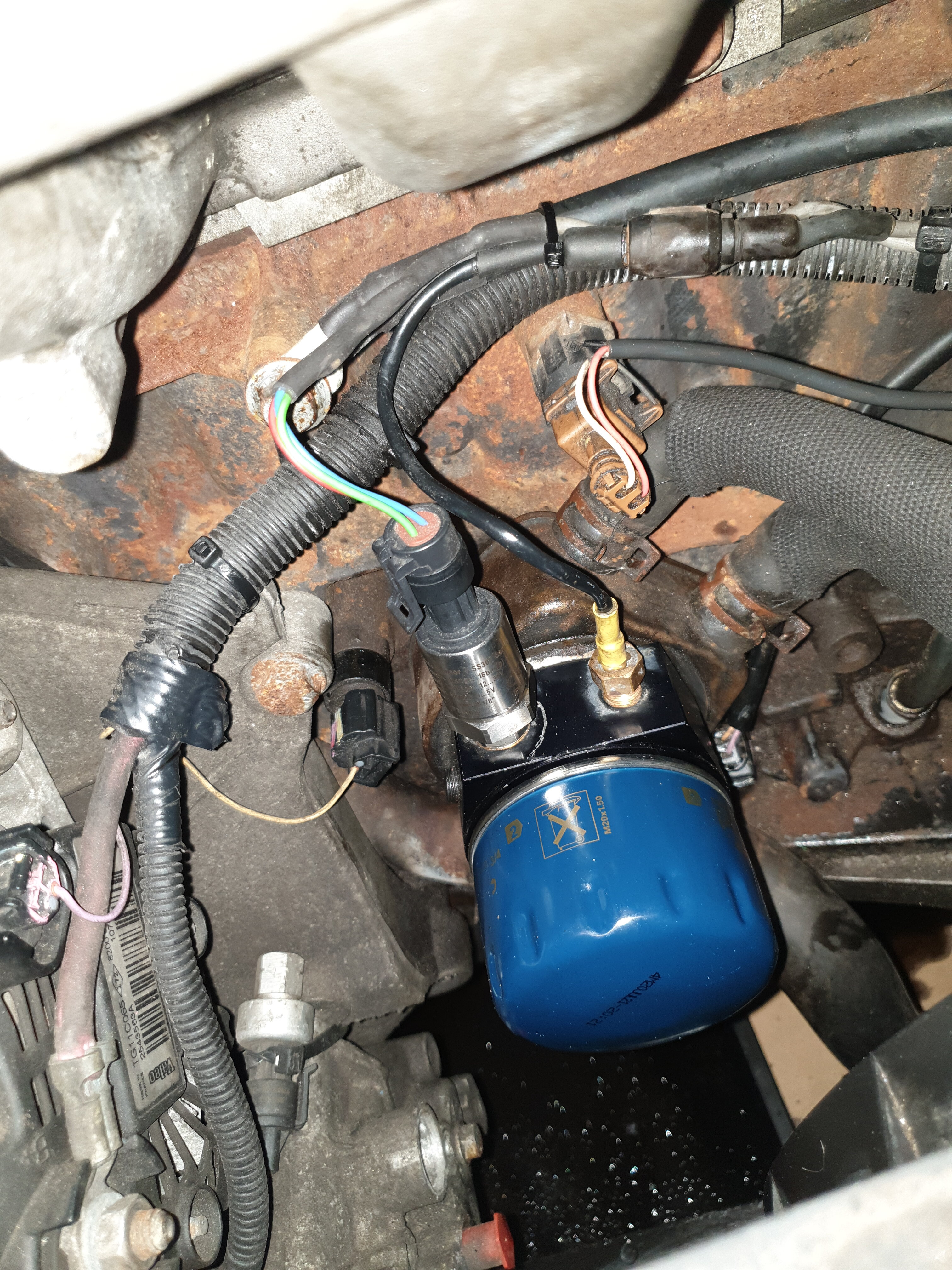

Went back home and changed oil and filter and modine seal. Id been putting this off as access is tight. Pulled front end off and was very easy to be fair. Modine bolt torqued to 44nm as per workshop manual and mocal sandwich plate torqued to 25nm as both were a little loose for my liking when removed.
Dry as a bone now as it had a slight weep in this area. Filled up with Millers Cfs motorsport 5/40.

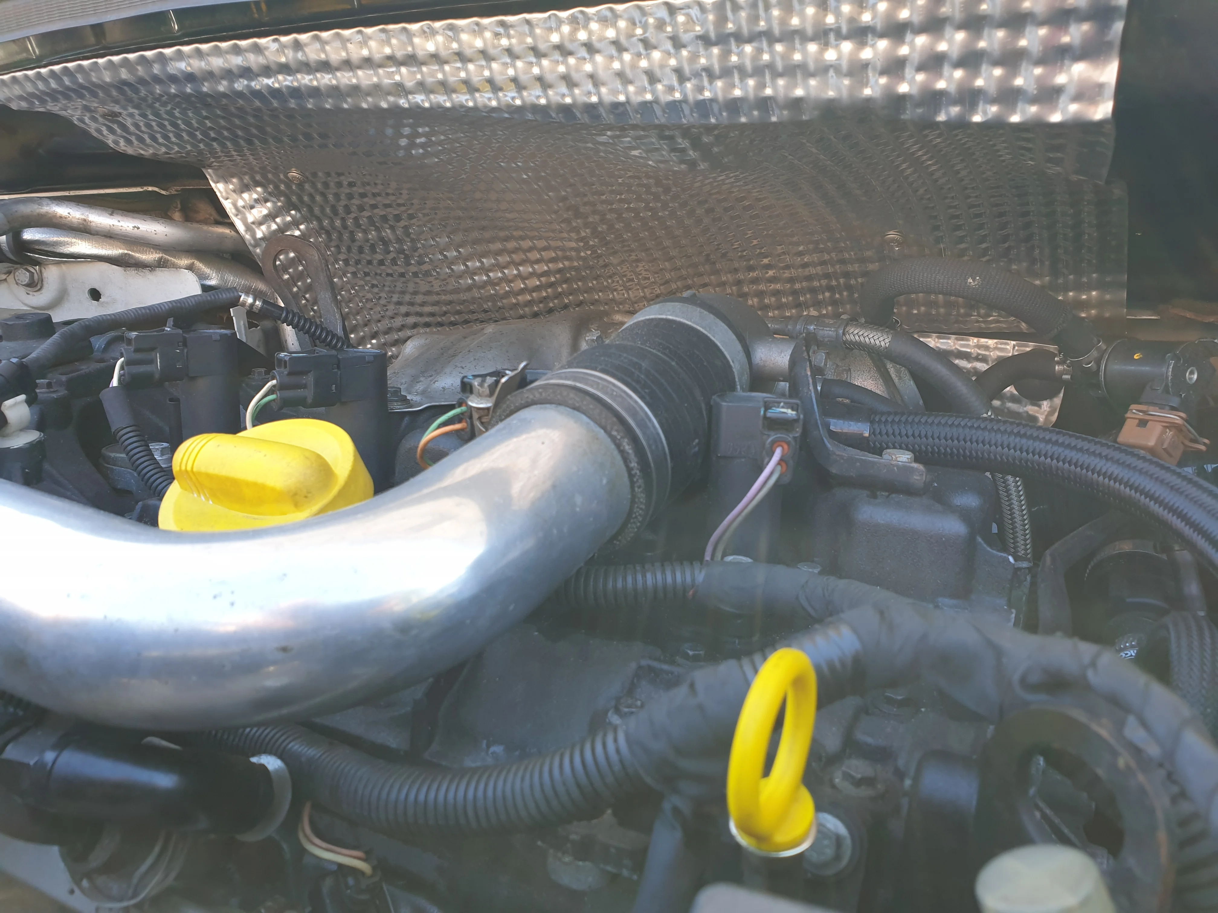

Small jobs left to do, nimbus heat shield above turbo and clean up, couple of hours work then its a case of fill the tank and go. Im actually a bit excited as not done a trackday since 2020 and not used this in anger yet.
Thanks for reading!!
Brigsy
  T.Turbo

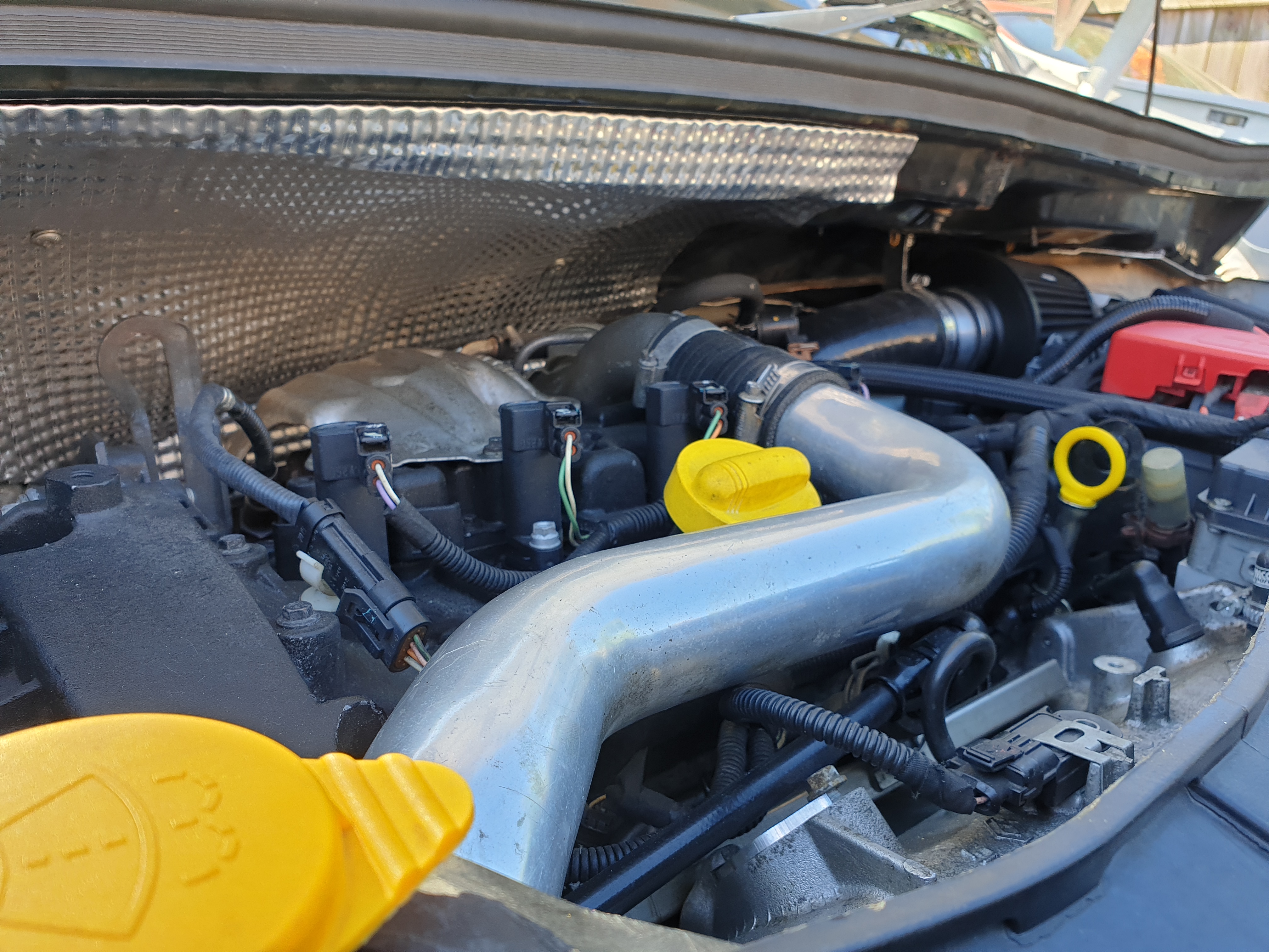

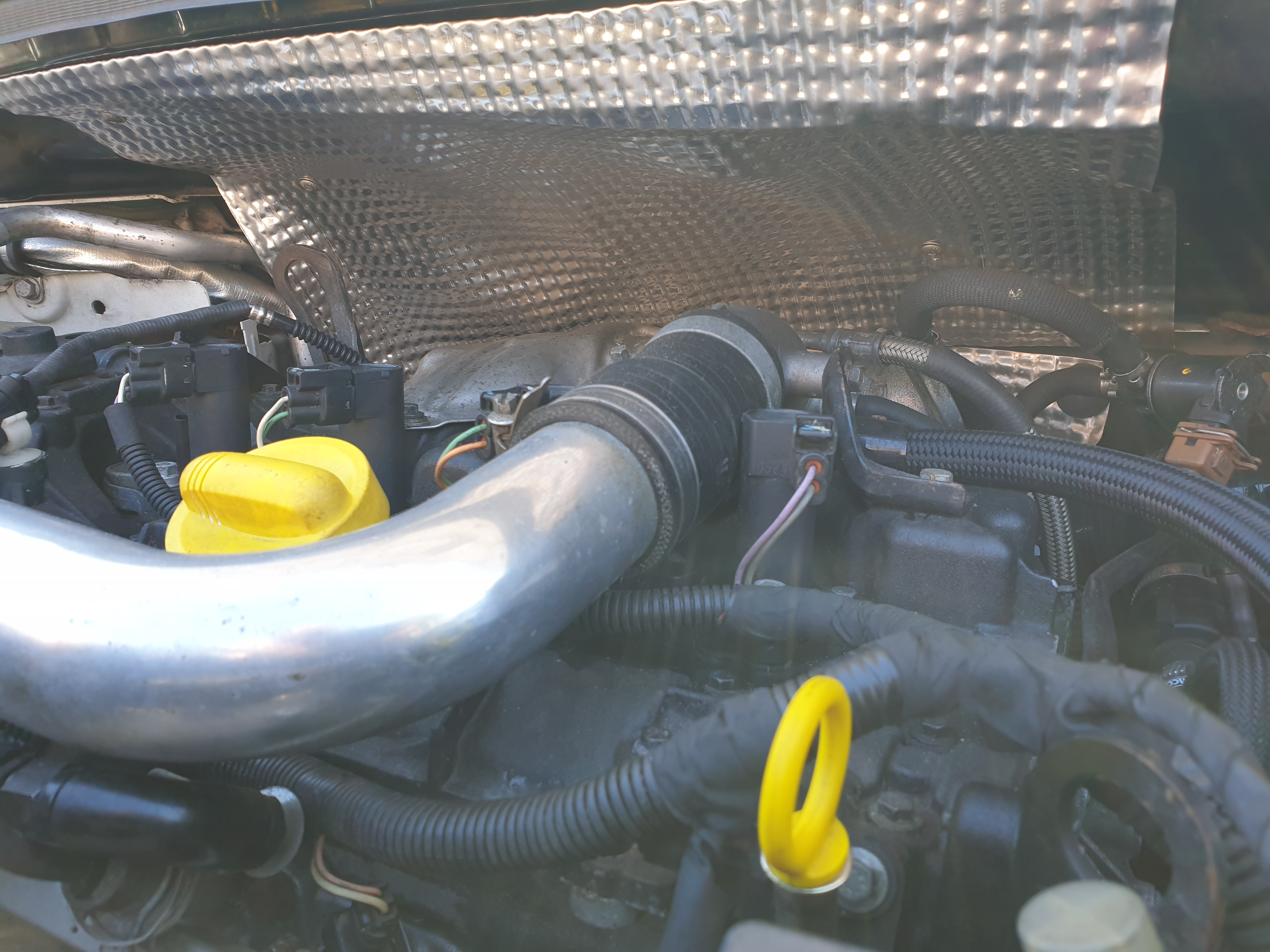

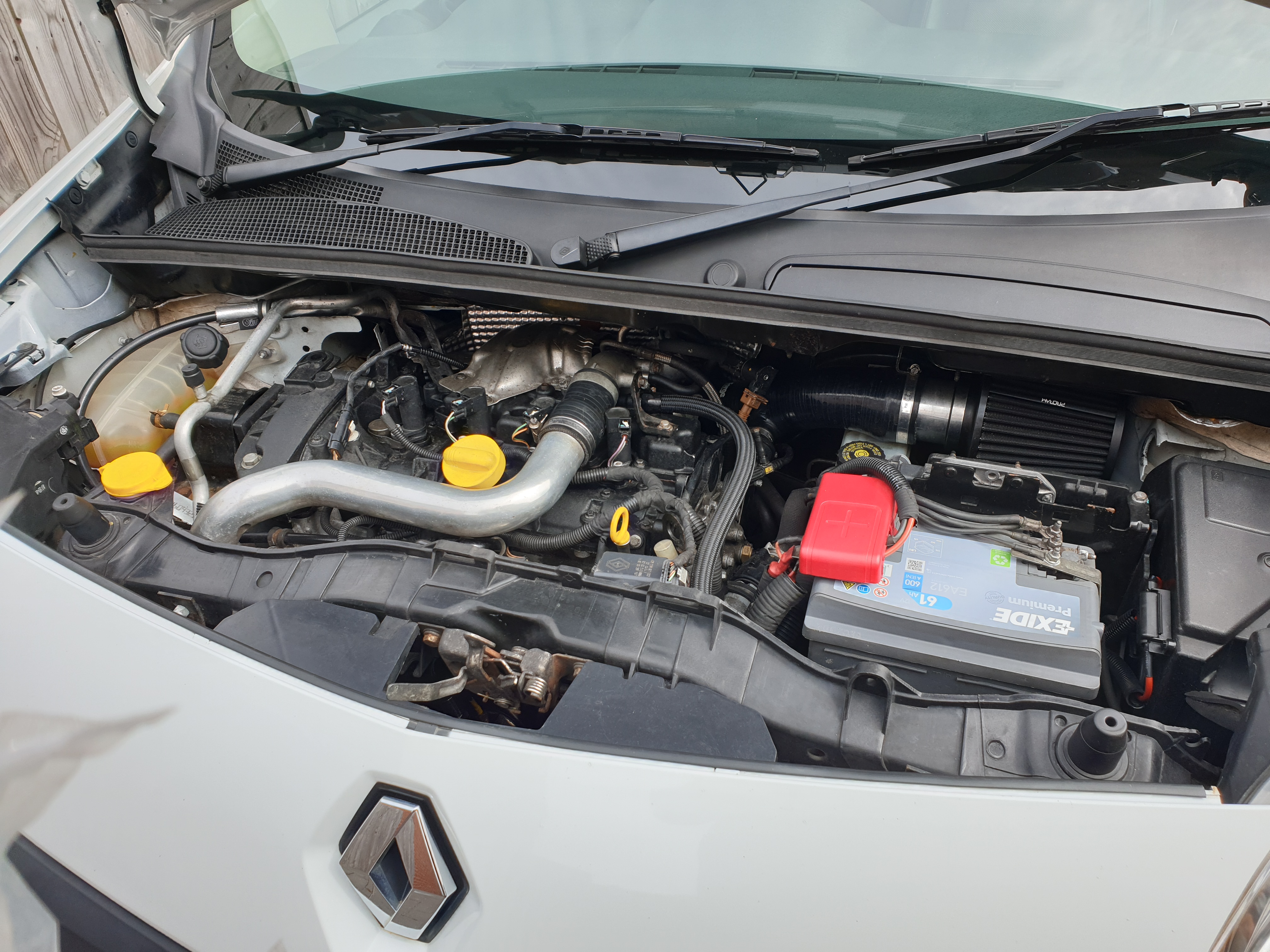

Fitted a nimbus heatshield to the upper scuttle yesterday. It had a crappy bit of carpet sound deadening fitted originally which was looking ropey so took it off when i first done the conversion. Thought it was worthwhile fitting something right above the turbo to reflect some radiant heat.
Scuttle off and some riv nuts to hold it in place, daft hour job before the weather was scorchio. Nimbus is class, so easy to work with, moulded around the contours of the scuttle dead easy with minimum fuss.

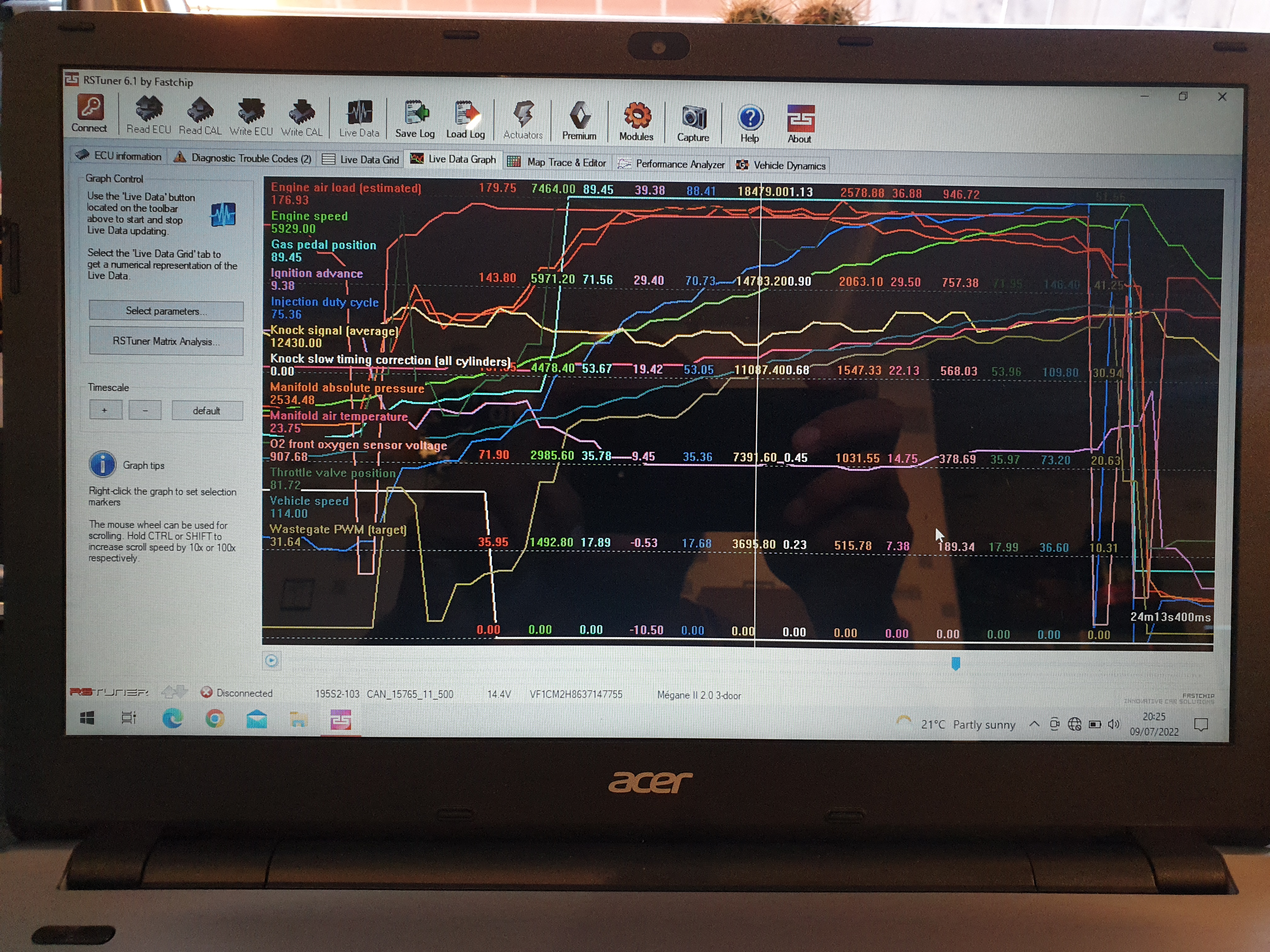

Get laptop out and check datalogs. Coolant temps are stable ish at 98-99deg, not horiffic but up there a little which is to be expected with high ambient temps. Air intake temps are good, excellent really around 30-32deg on boost so a few degrees above ambient.
The bad news is that something was not happy and the datalogs show engine is consistently pulling 3-5deg of ign timing on slow correction. Average cyl knock counts look ok in the mid range but spiking at higher rpm, not too excessive which is either false knock, or engine is unhappy and its doing its best to keep it in one piece. Ive noted its dropped ign to 4deg on boost/higher rpm so safe in that respect, which at this point im worried if it pulls more ign will egts go sky high, im no expert on the matter but im concerned sustained hard use may hurt the engine in the high ambient temp, and id rather not damage it so call it a day at that. I was told off a couple of people to just send it as the ecu is keeping it right, but if it all goes wrong then it'll be dead until i get time to rebuild it.
Still i always classed this as a shakedown and its given me data, and proof that once i get the small issues sorted it should be quite the weapon.

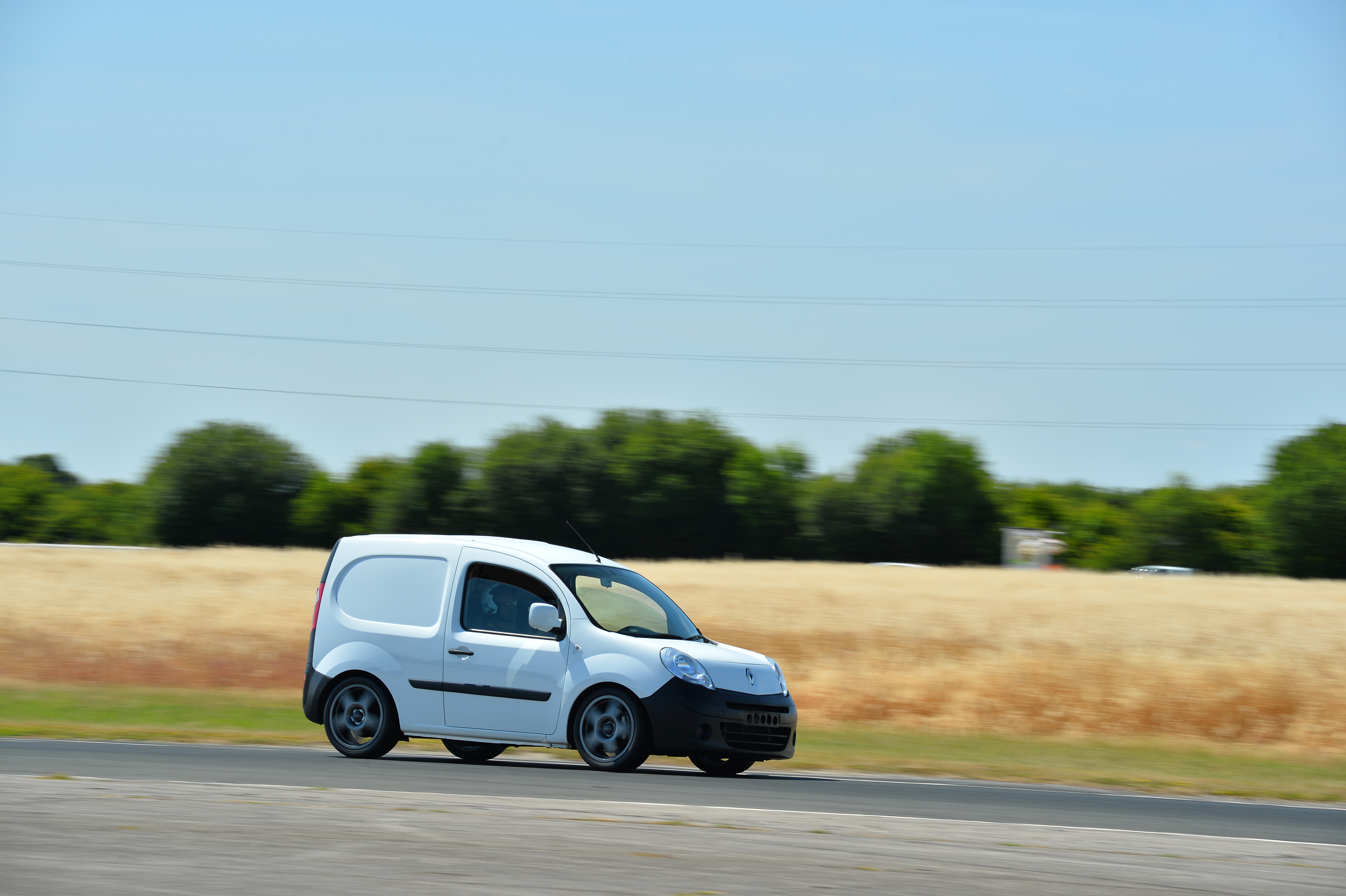

Done a bit of b road blasting in the Kangoo last week as had to pop over to North Yorkshire to pick up some fitted oem Renault mats for it, so took advantage of the good weather and great roads.
The Ast 5100 suspension is phenominal, perfect balance of compliance and handling, combined with 378 hp is absolutely epic. Love it!!

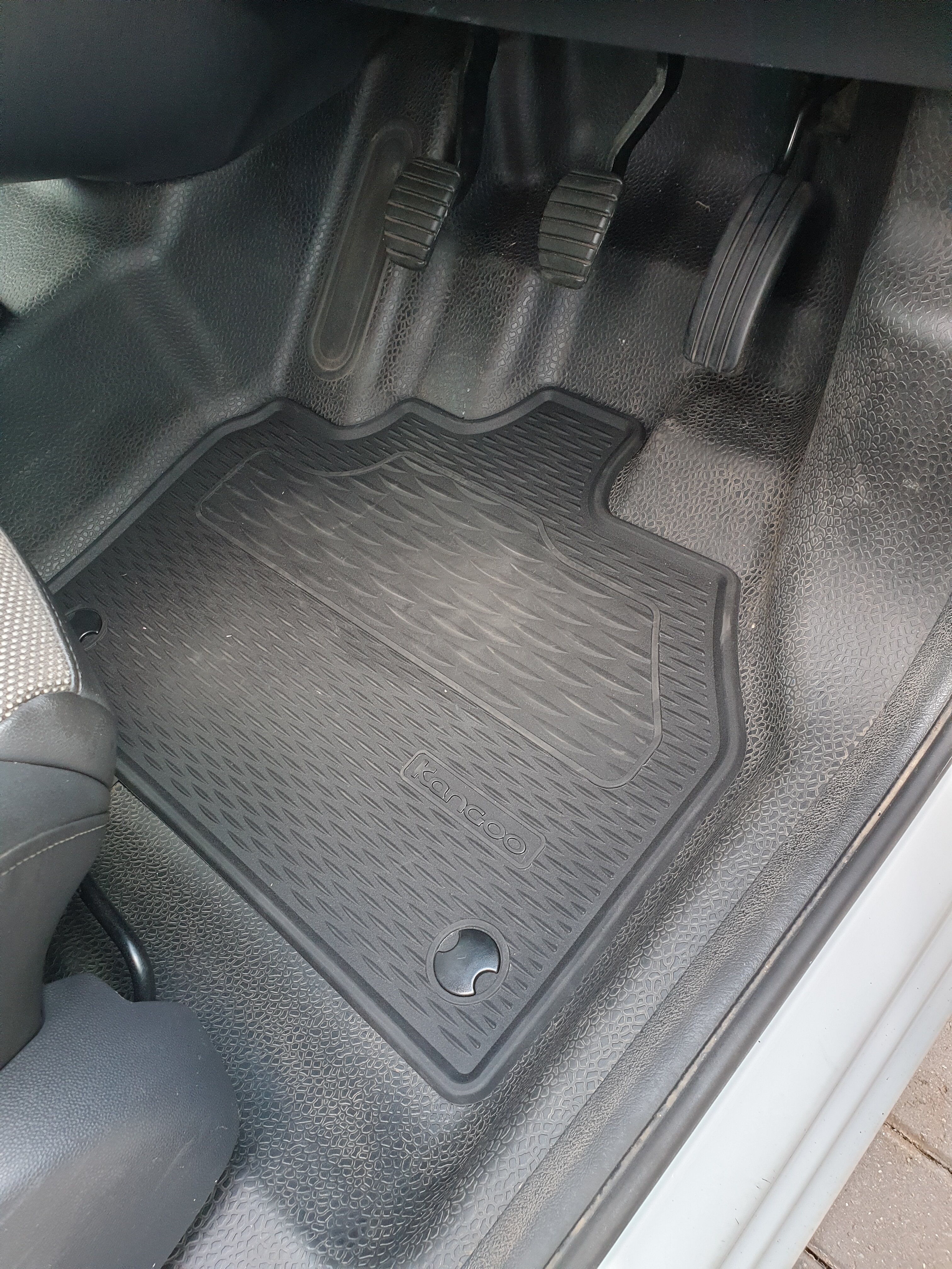

Mats fitted. Clip in so no movement like the old ones.

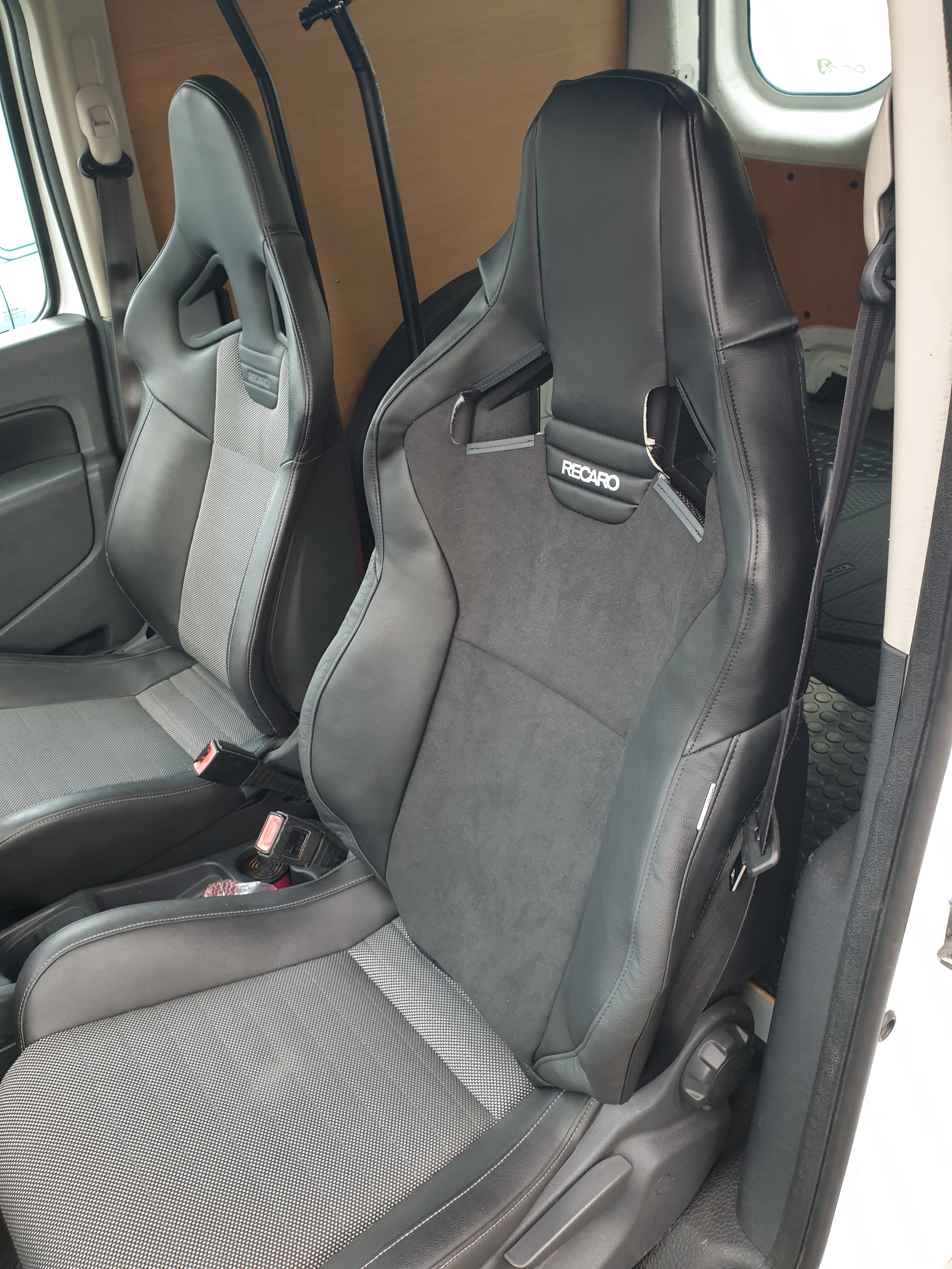

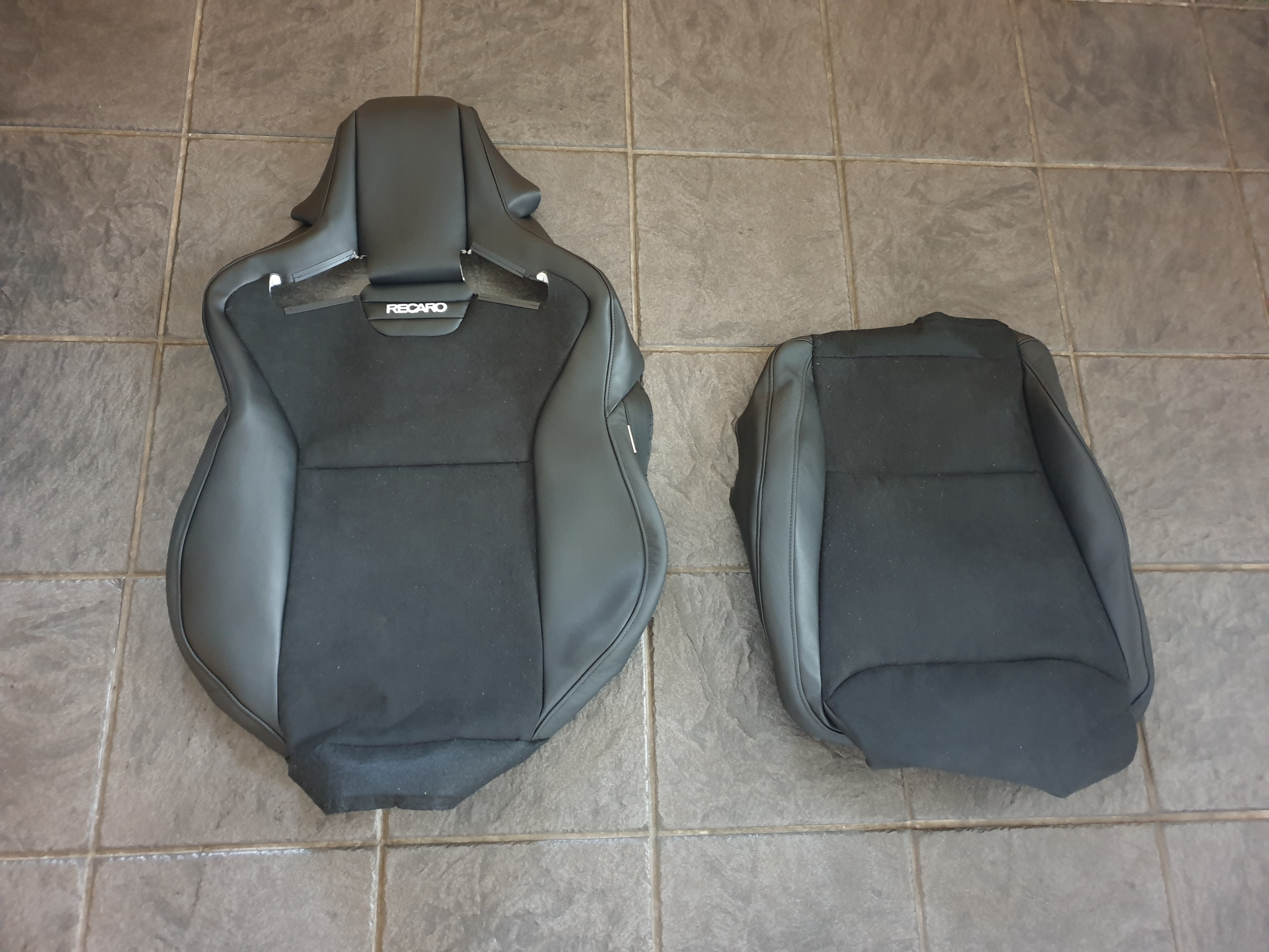

Also bought a set of ambla & dinamica black leather Recaro cs seat covers for the recaros. They were designed to fit the Recaro cross sportster low which i always assumed these were, however the corsa base foam is different and would not fit so bit of a fail on my behalf. Ill eventually get them retrimmed in the same material to suit.
