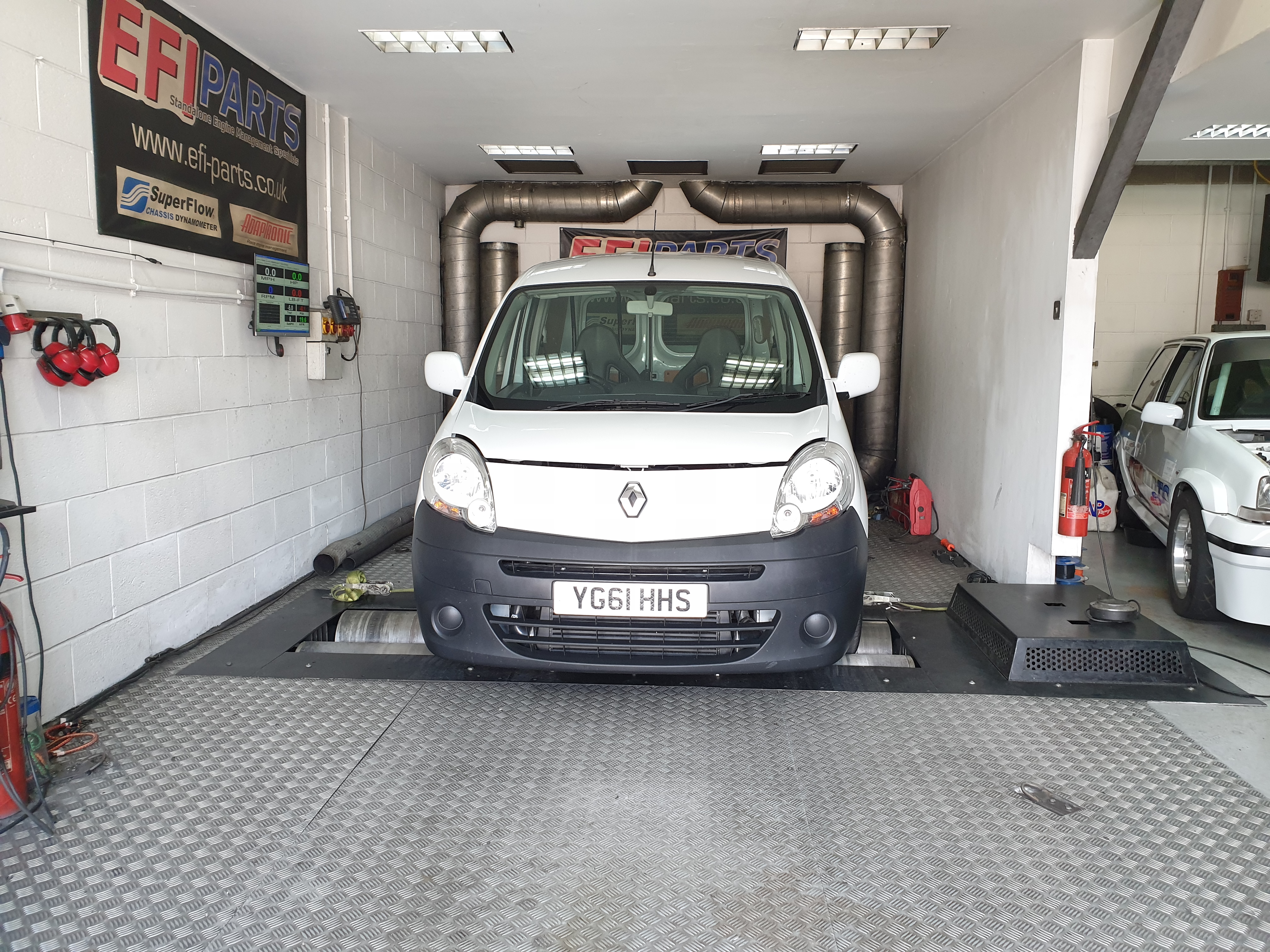

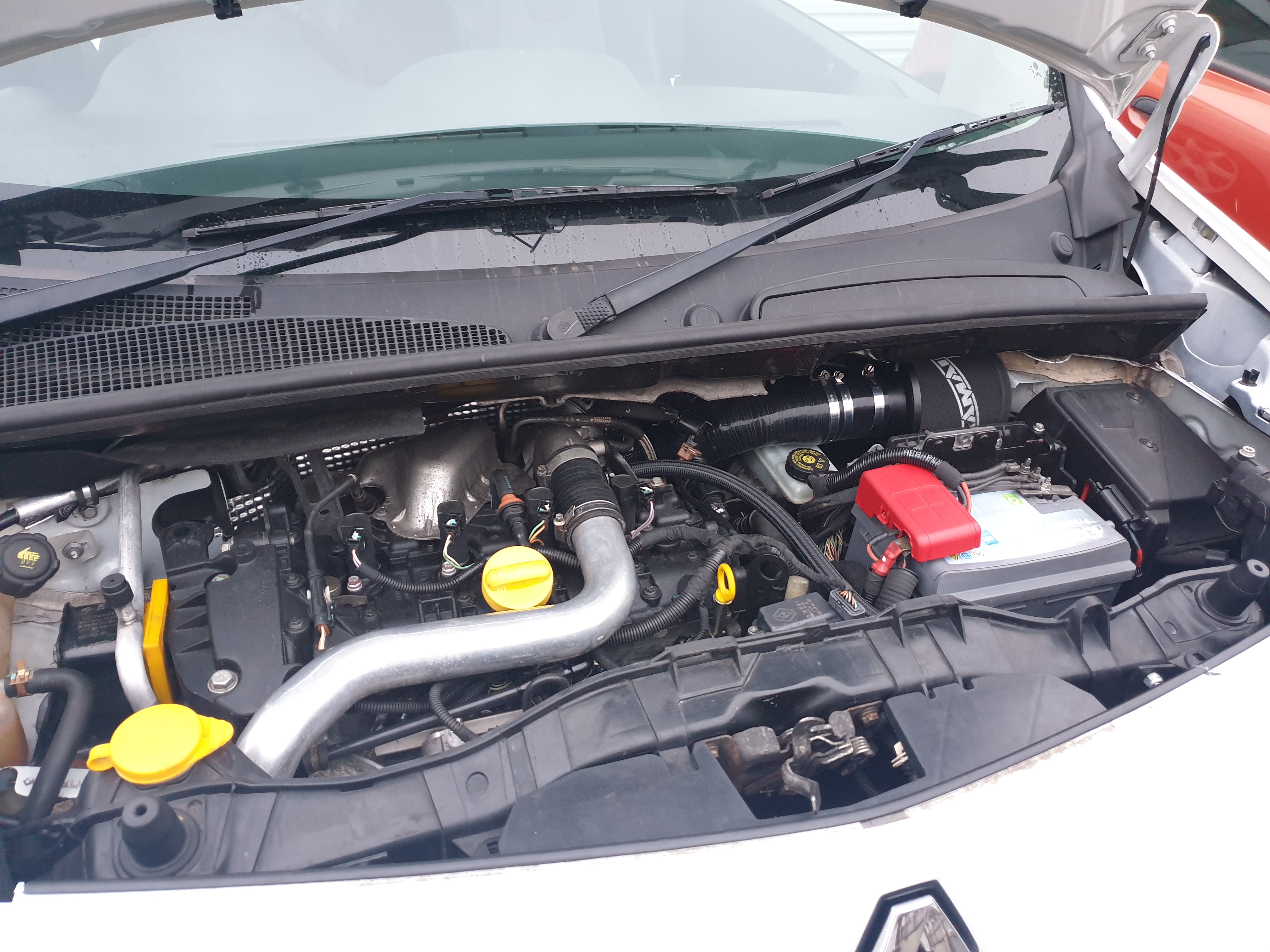

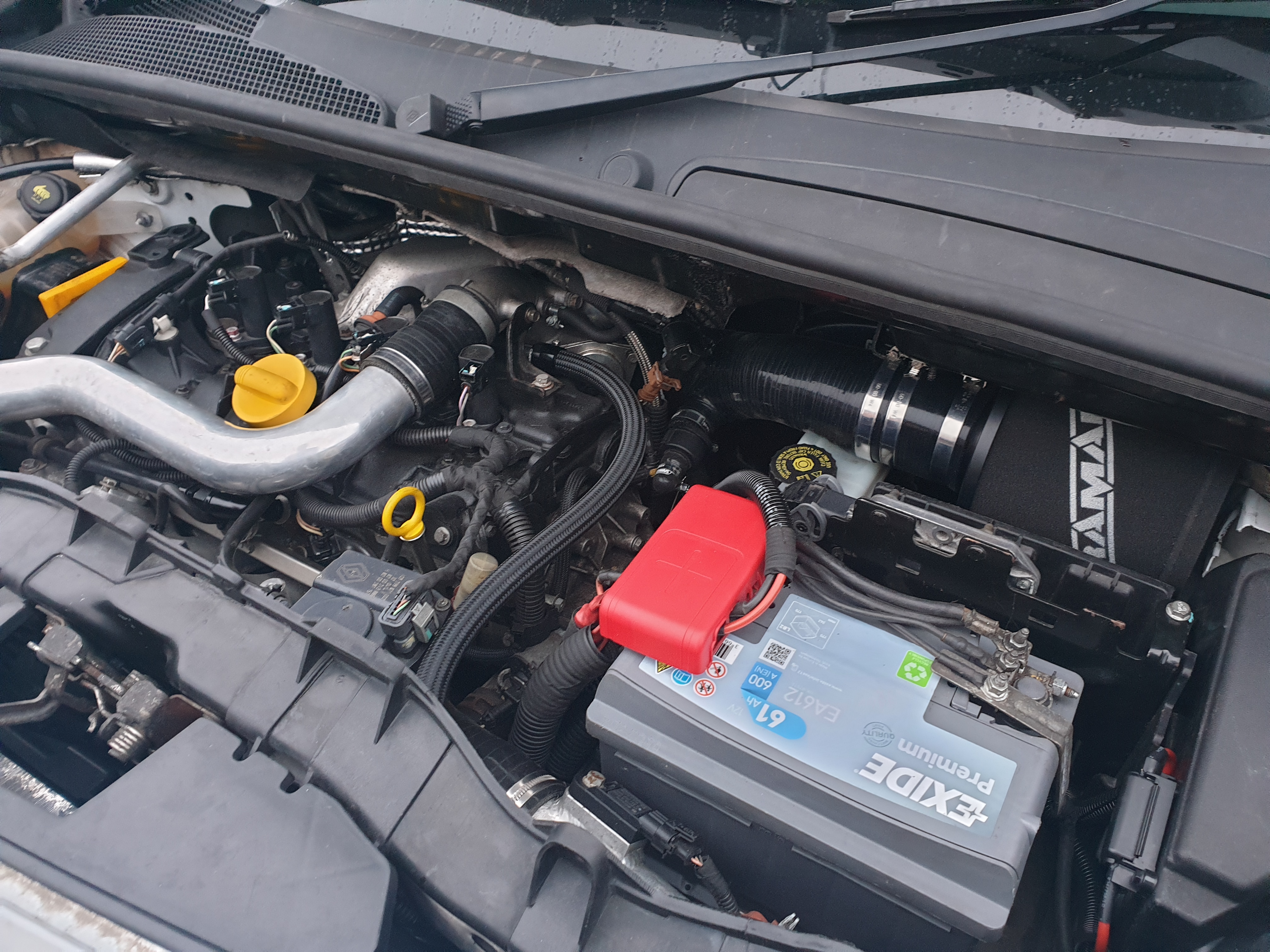

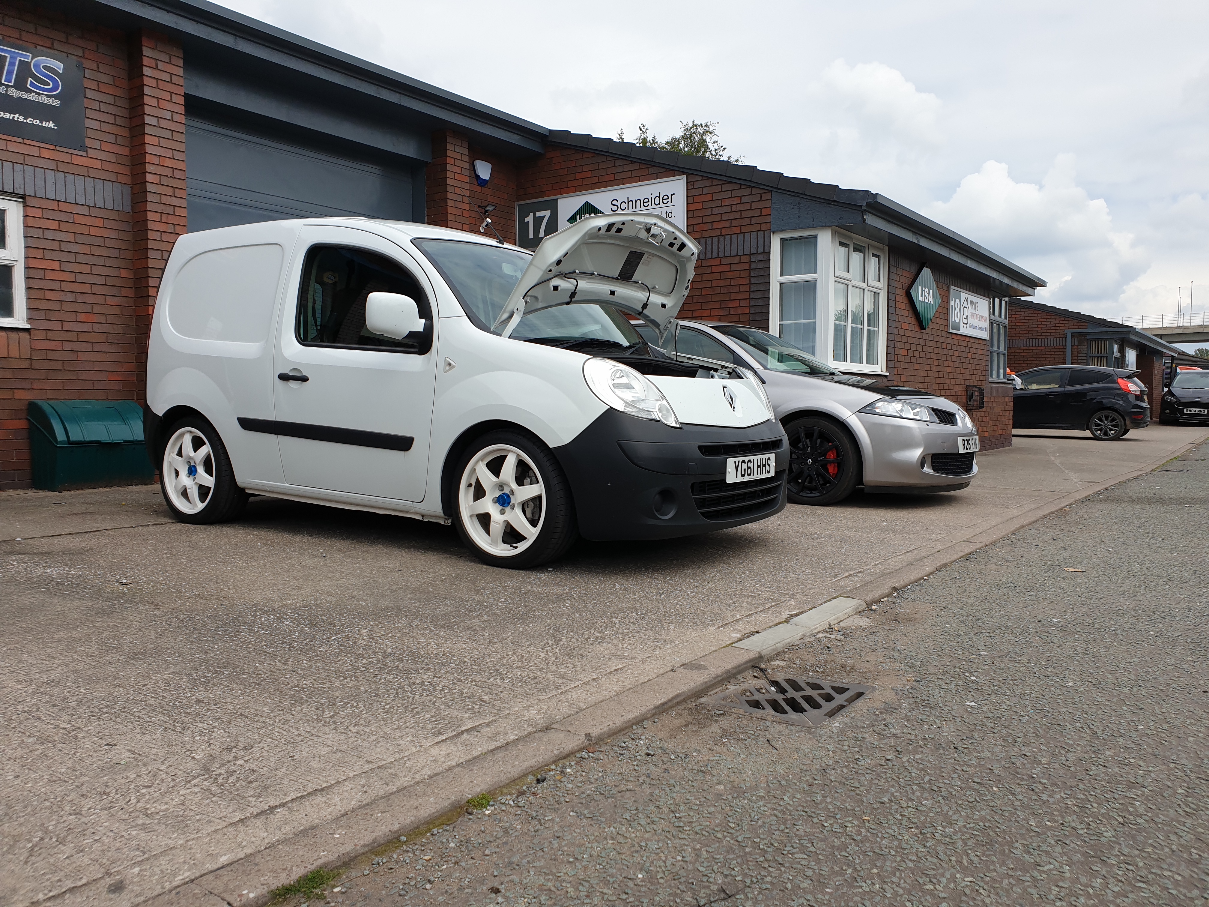

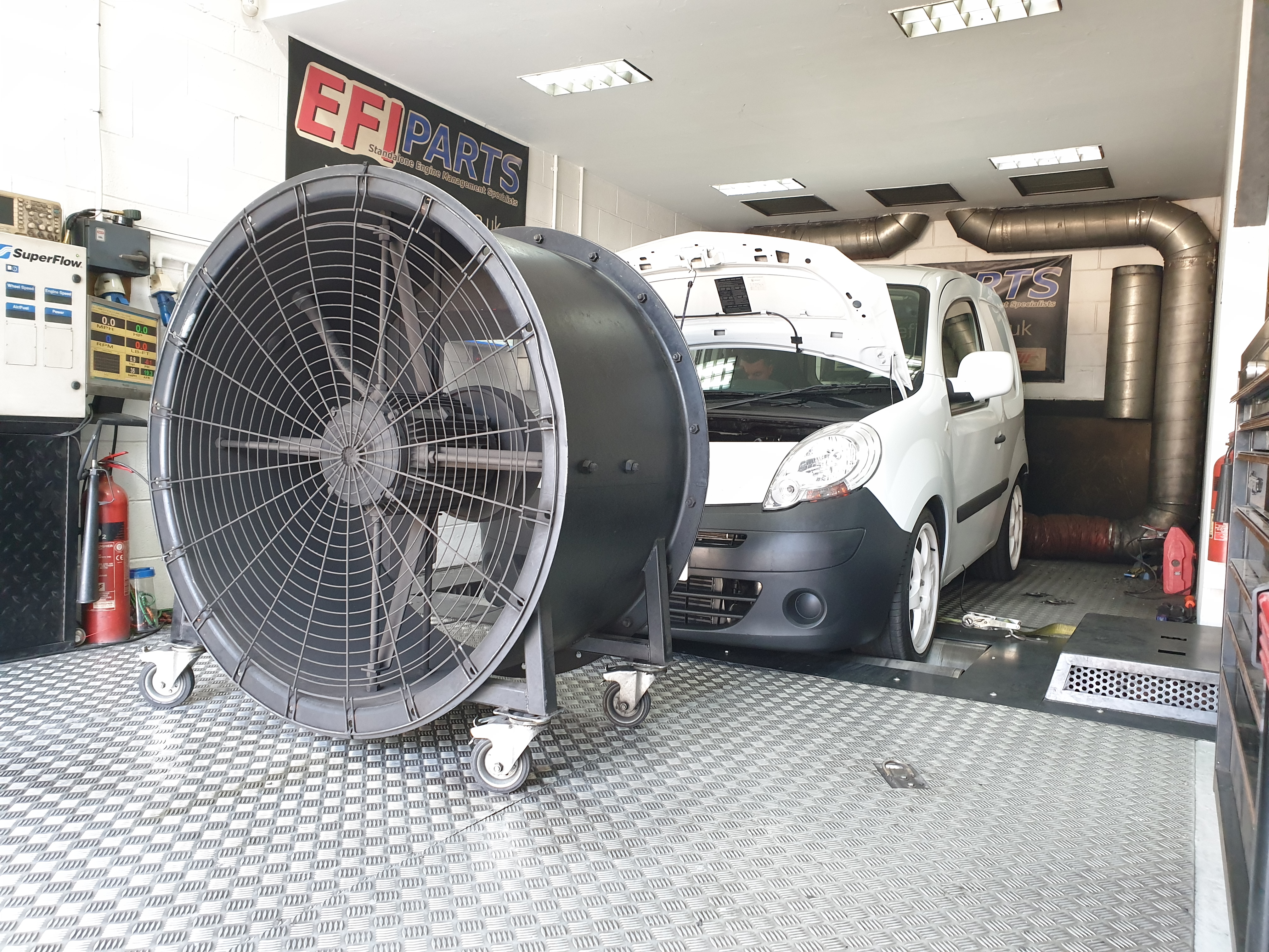

Mapping day yesterday. Had prepared as best as i could and packed a few spares "just incase". Steady drive down to Efi made it there in good time.
Pre checks done, fuelled up and parked waiting to get on the rollers. Moggy arrives for a catch up in his epic nimbus r26r.
Waited for Chris to finish up with another car on the dyno.
Firstly engine ecu was removed to bench read and write a new base map as the ecu was locked from previous map. I fit 250 map sensors and hook up the vac pipe for the rising rate fuel reg on the 250 rail.
Chris fires it up to check the base map, connects the hardware to map via obd. We run into problems at this point as the software does not recognise the Kangoo 2 vin number that is stored on the engine ecu and wont show any ecu data, boost pressure, charge temp, knock count etc.
This was a problem as cant tune it without any data logging. Long and short of it is, when i done the immobiliser sync i changed the engine ecu vin number to the Kangoo one to try and view it on clip (which did not work). The only option was to reload the megane R26 vin number so the software would recognise it, which was a bit of a carry on as the ecu needed to be a virgin immob file and would not write the vin without a bench flash back to virgin.
Luckily i had my laptop with me so found the virgin immob file, bench flashed the chip and resynced the immobiliser with Ren0link. Ecu vin changed and the hardware recognised the vin allowing logging to be done.
Onto the dyno.
Chris asked me what i expected from the setup and what my use will be, i told him i want to drive this hard and track use so can sacrifice a bit of power for safety. He mentioned the 172 cams on stock timing may make the setup a little bit more laggy compared to usual megane, but that could work really well and make more power with less boost than stock 250 cams, and keep the drama out low down in the rpm which is good.
Part throttle mapping first.
Chris starts dialling it in and the power comes up fast and its looking like its working quite well. Safe 300 hp, 350 hp on 2nd run. Intake/Charge temps are really good and the rising rate fuel system is working well.

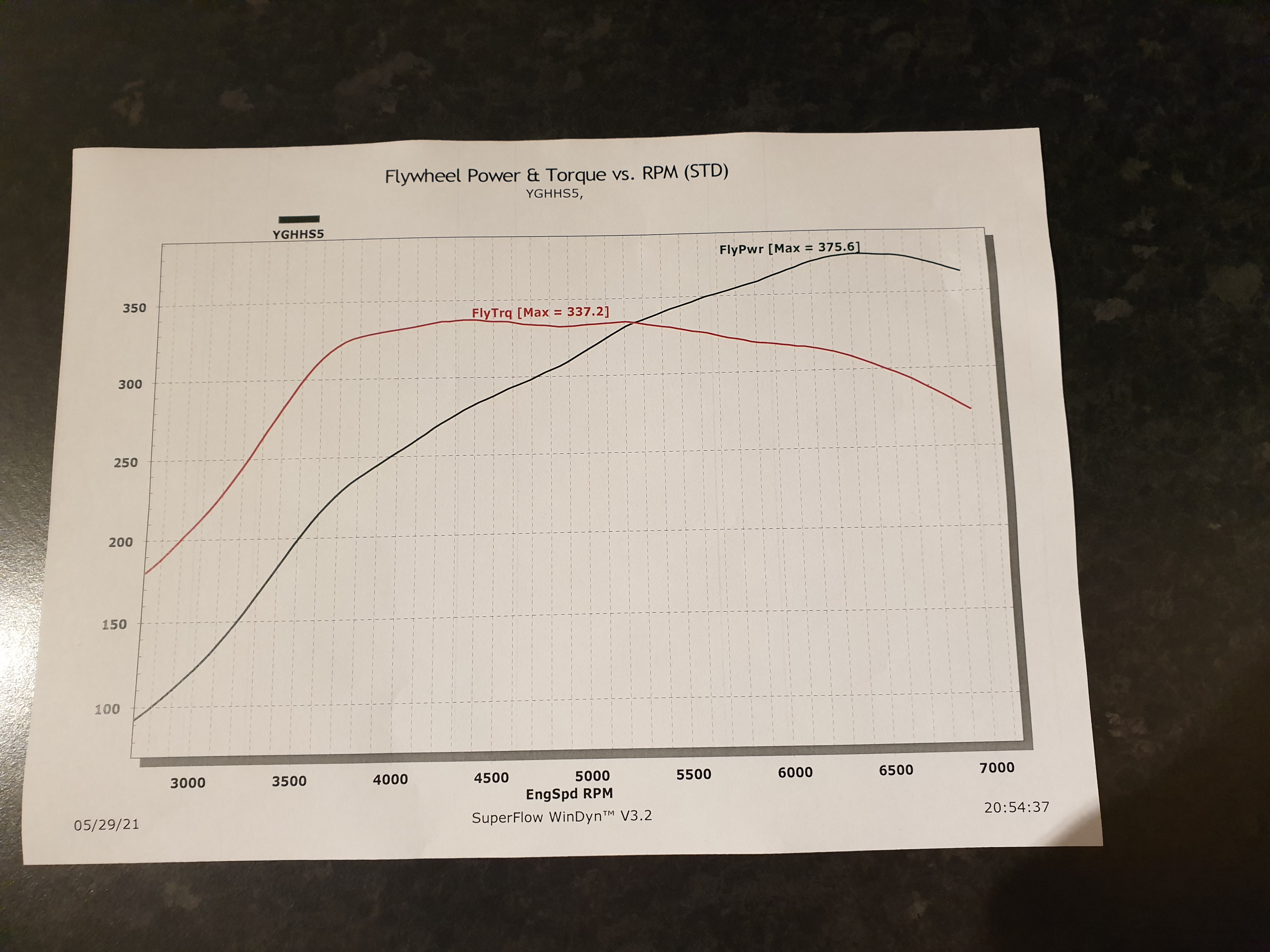

Wound it up a bit more and see 382hp @23psi
Clutch started to slip a little on spool at this point so had to pull boost up to 4000ish rpm and limit torque.
End result 375hp & 337ft/lb. Made up as i was expecting around 340hp and anything over that was a bonus.

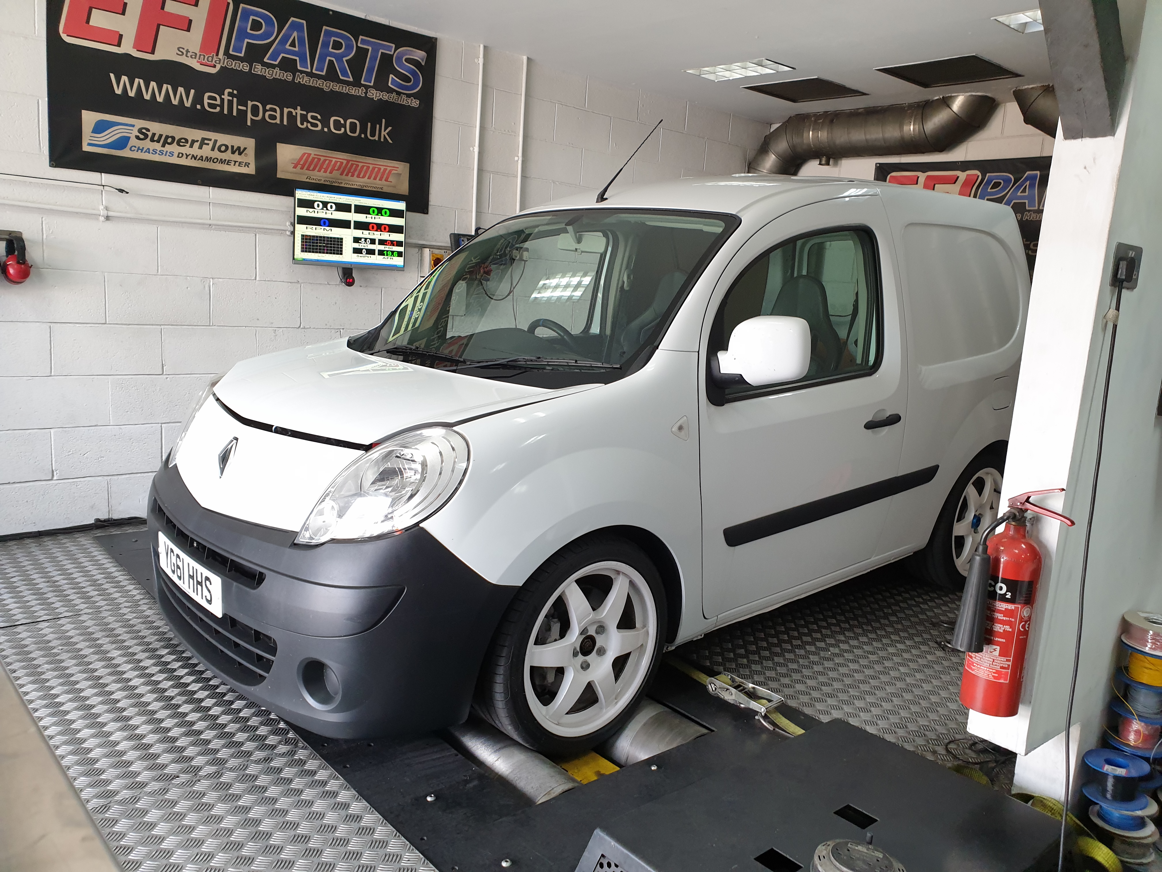

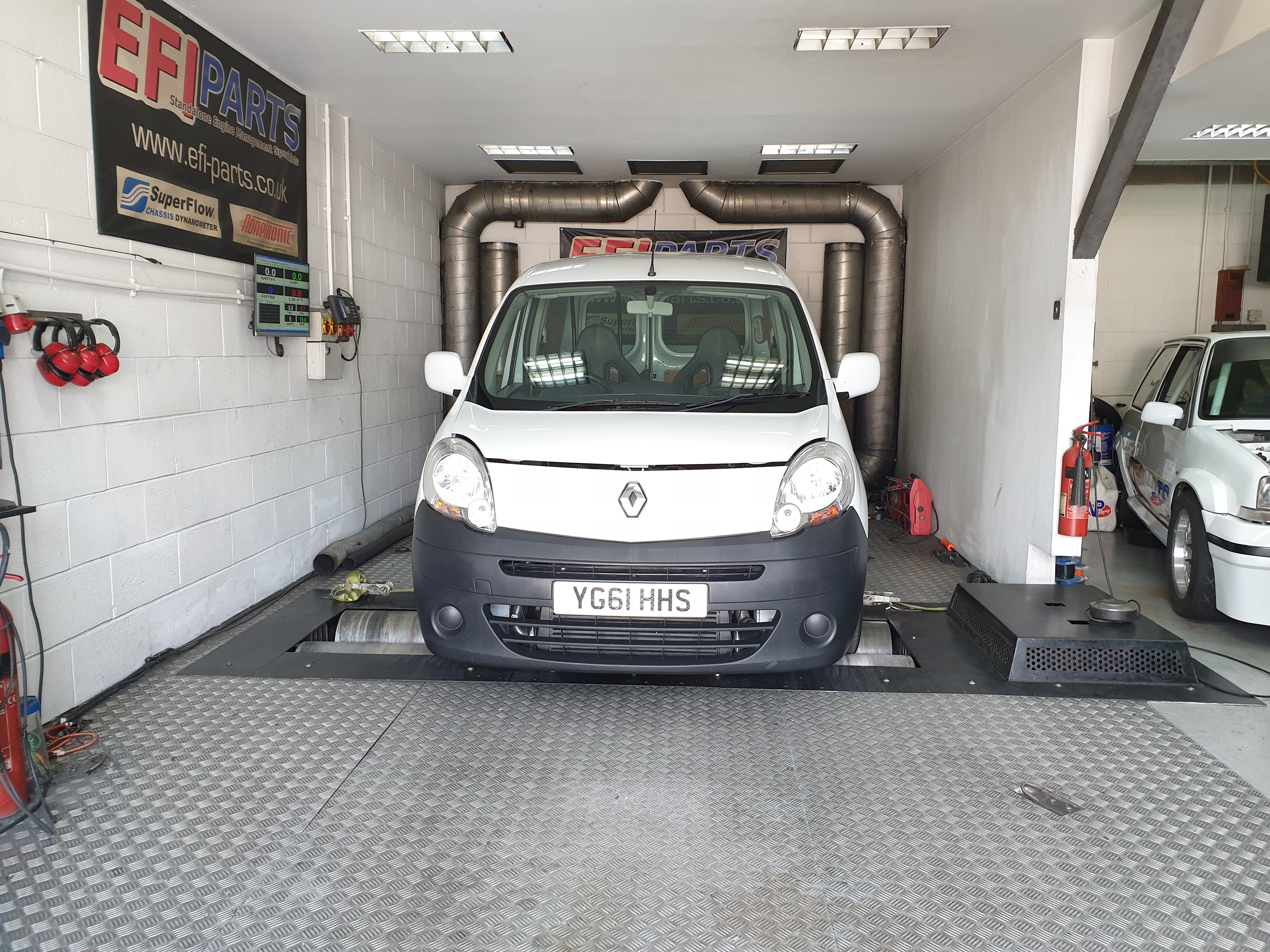

Pre checks done, fuelled up and parked waiting to get on the rollers. Moggy arrives for a catch up in his epic nimbus r26r.View attachment 1541044

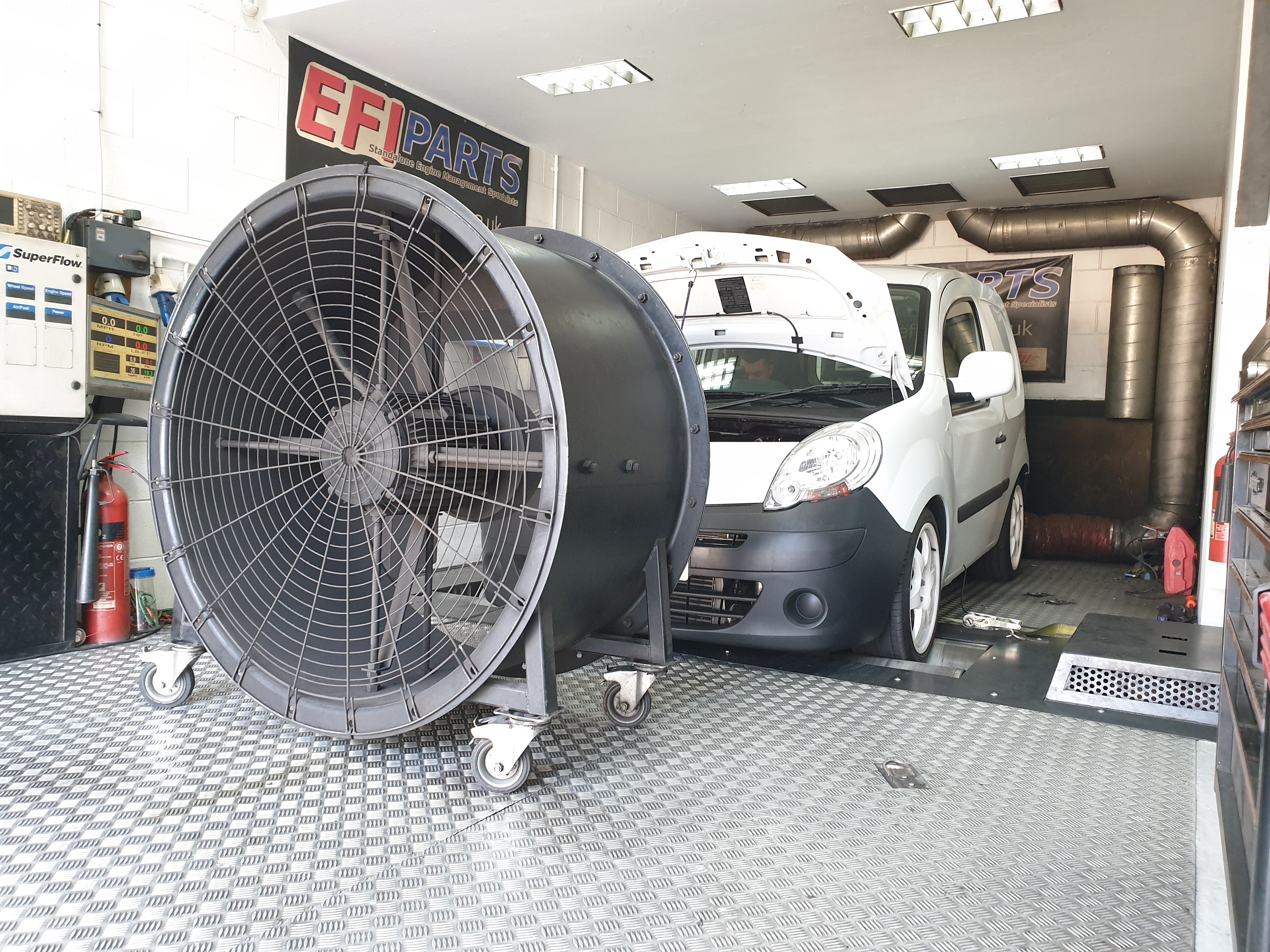

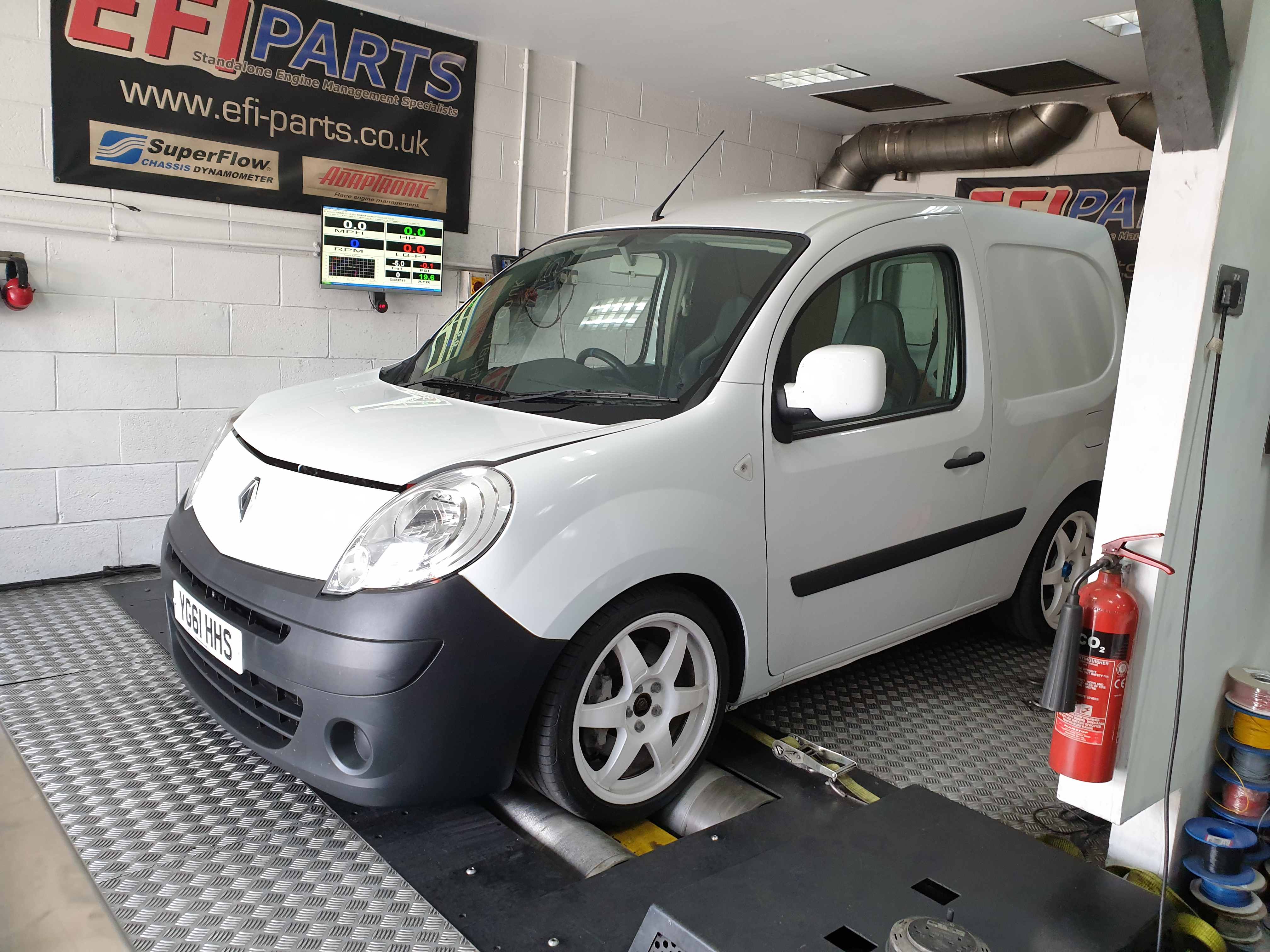

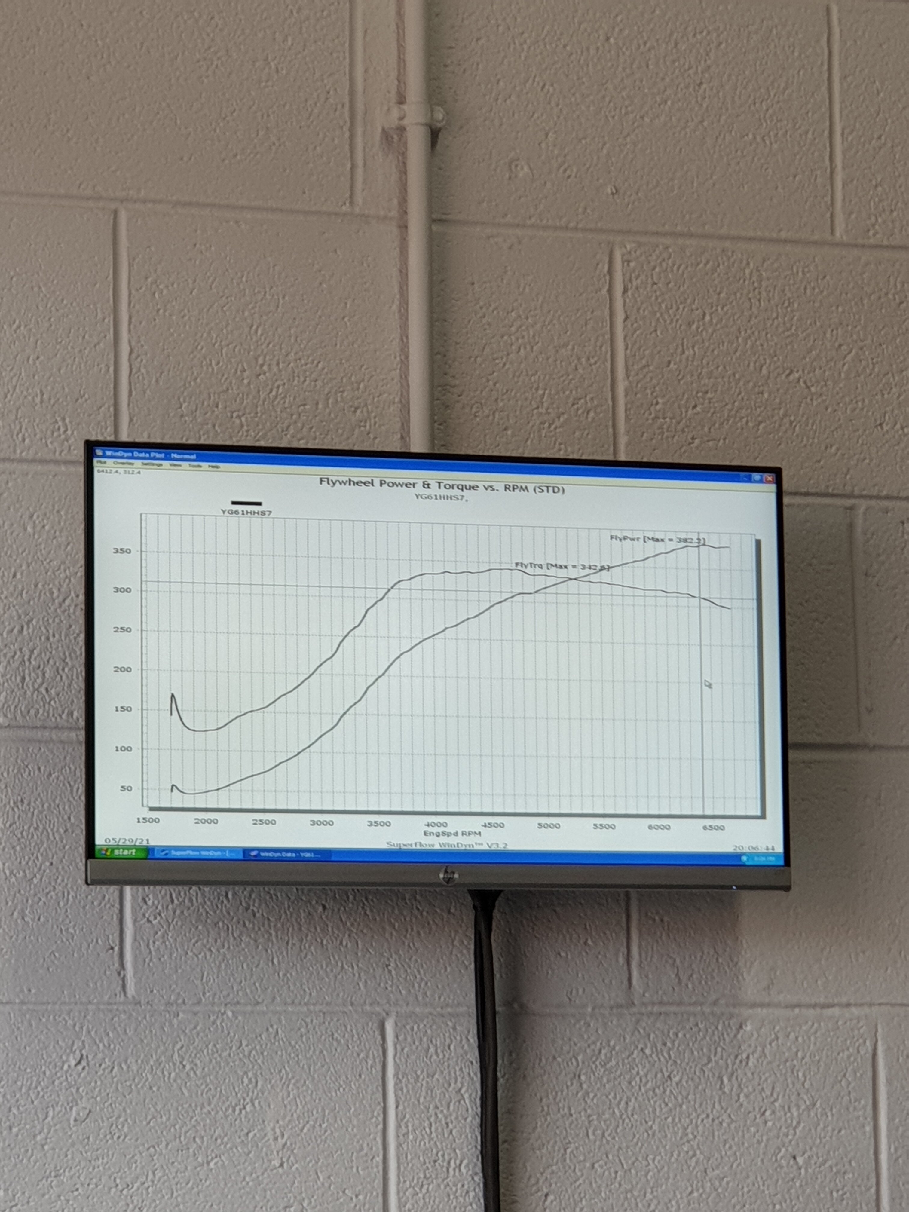

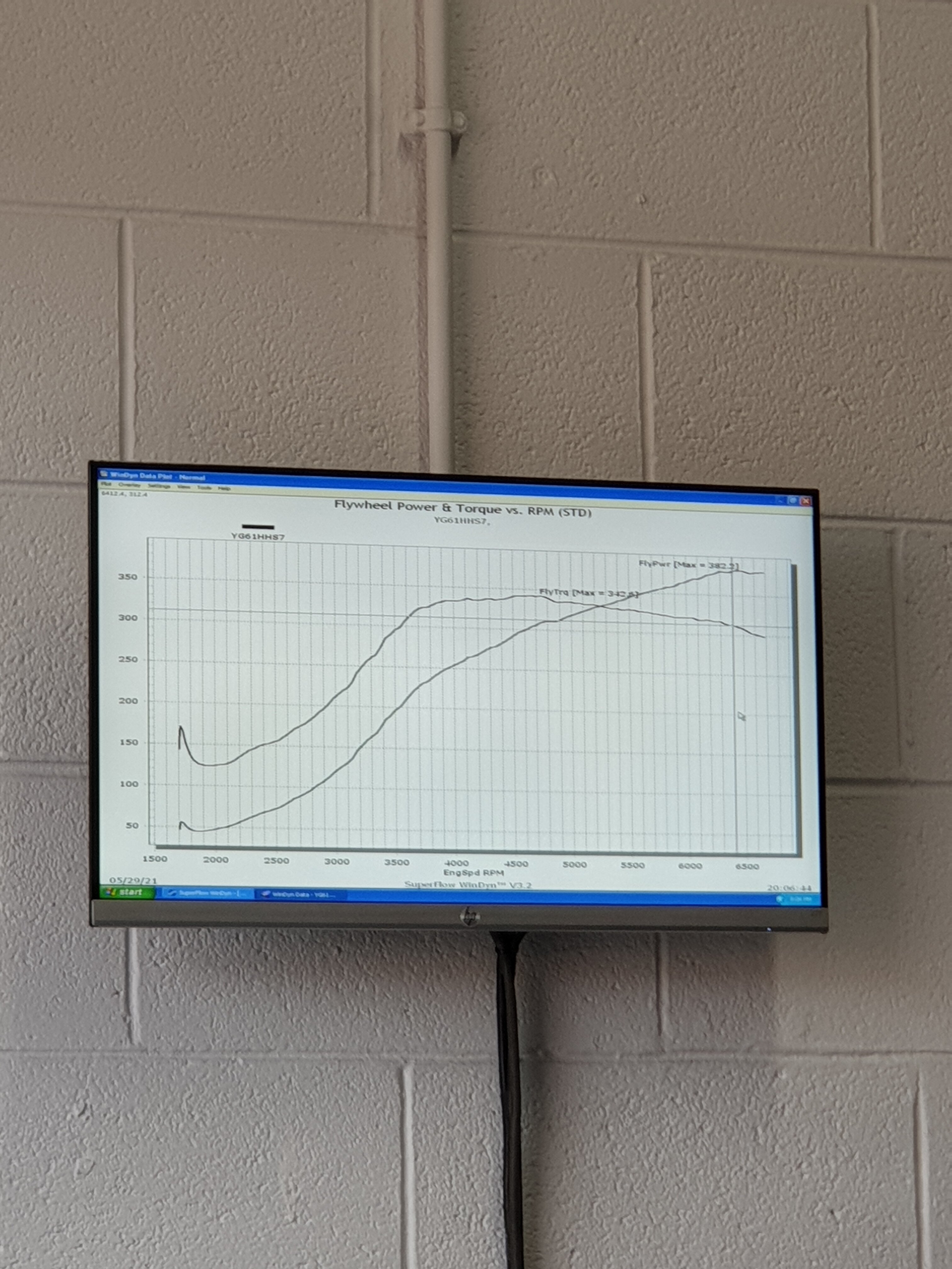

Onto the dyno.View attachment 1541042 View attachment 1541043

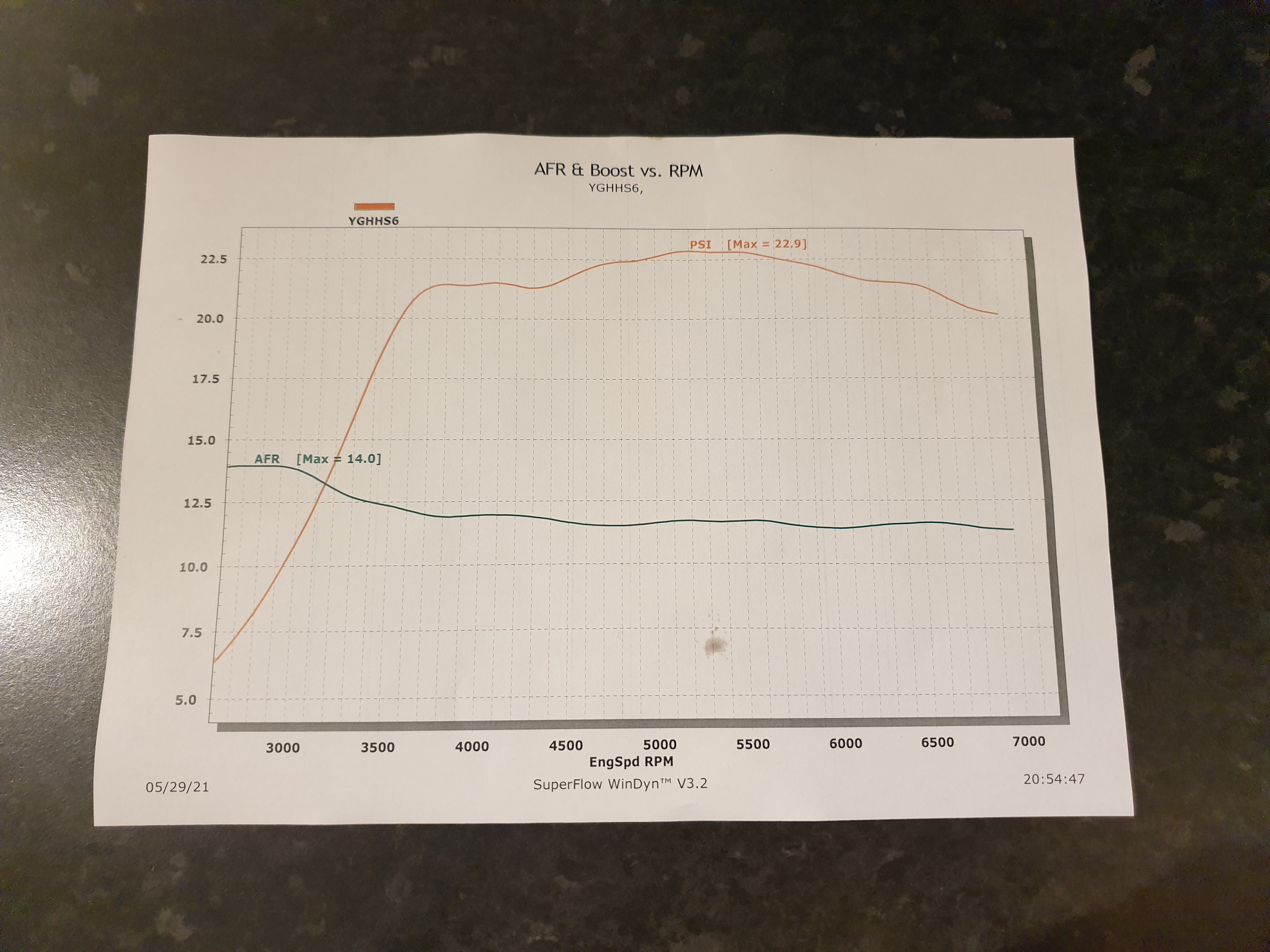

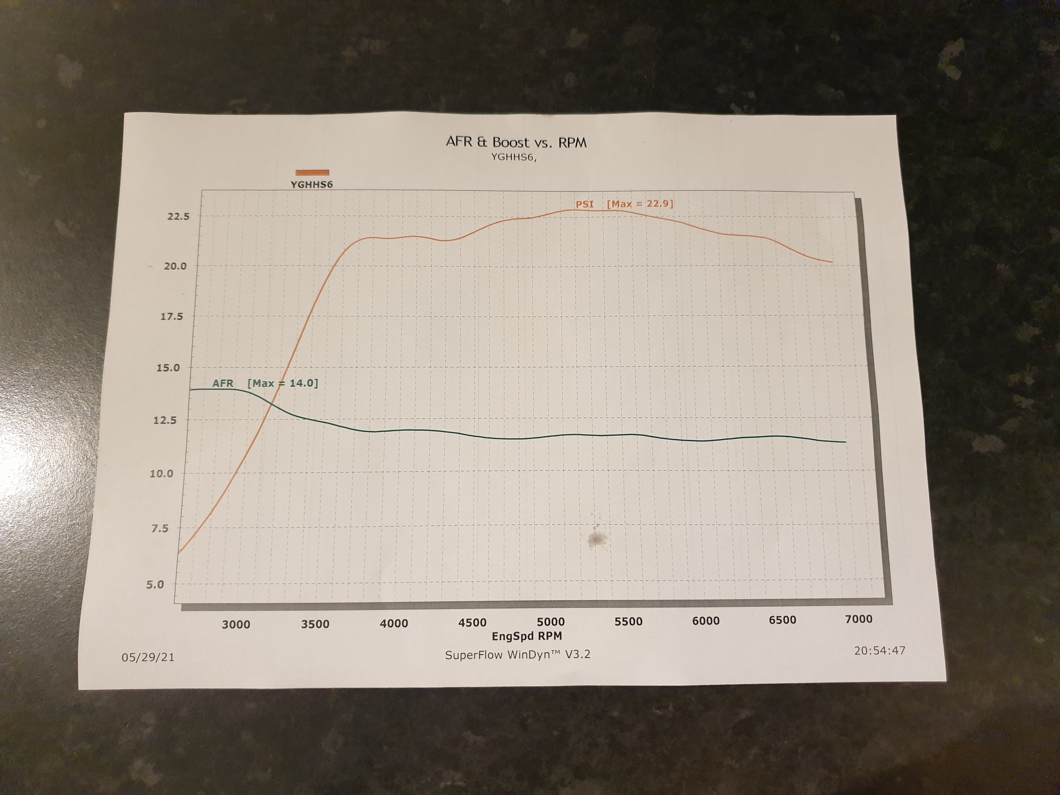

Part throttle mapping first.View attachment 1541041

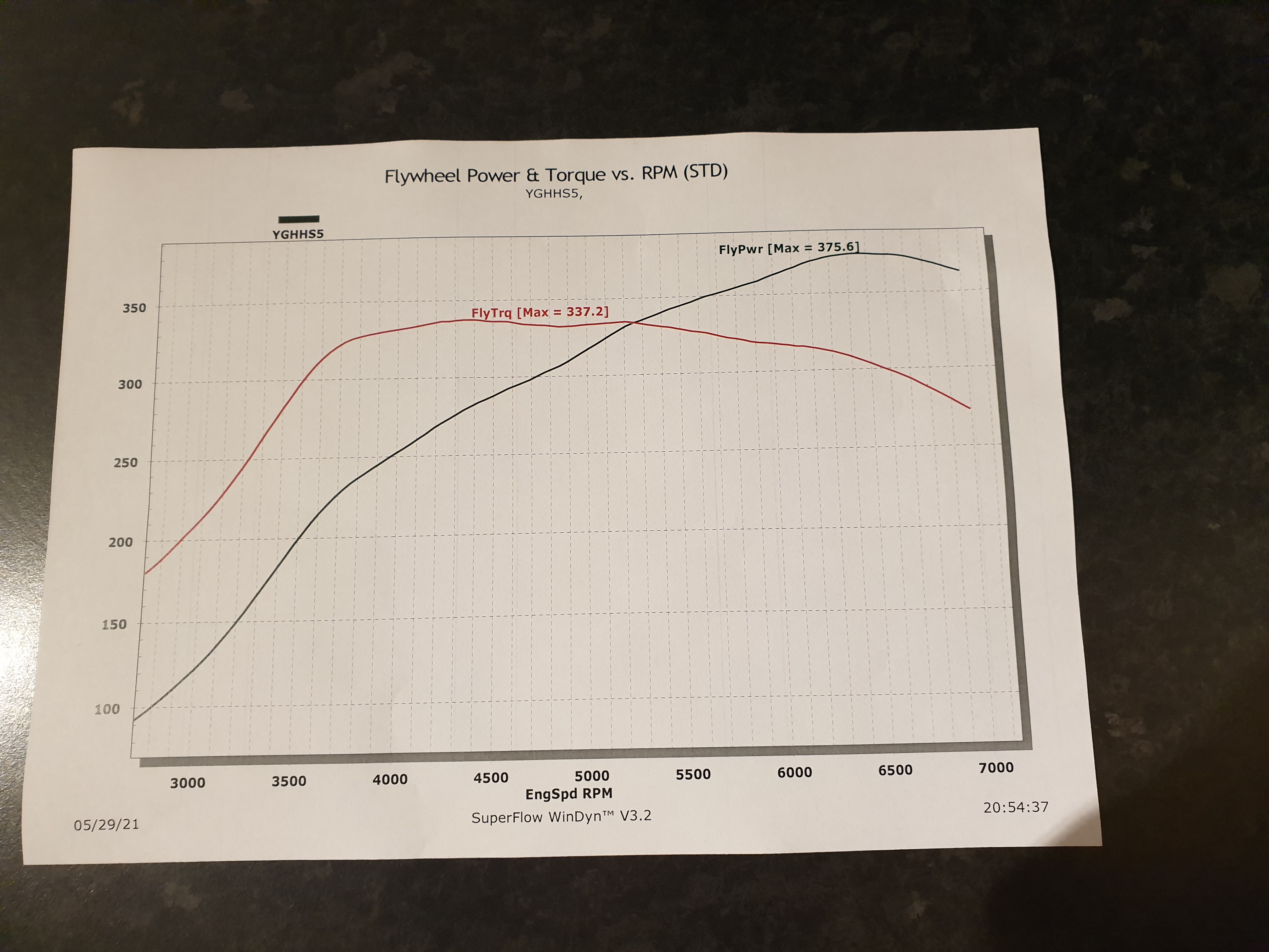

Wound it up a bit more and see 382hp @23psiView attachment 1541039
End result 375hp & 337ft/lb. Made up as i was expecting around 340hp and anything over that was a bonus.View attachment 1541038View attachment 1541037

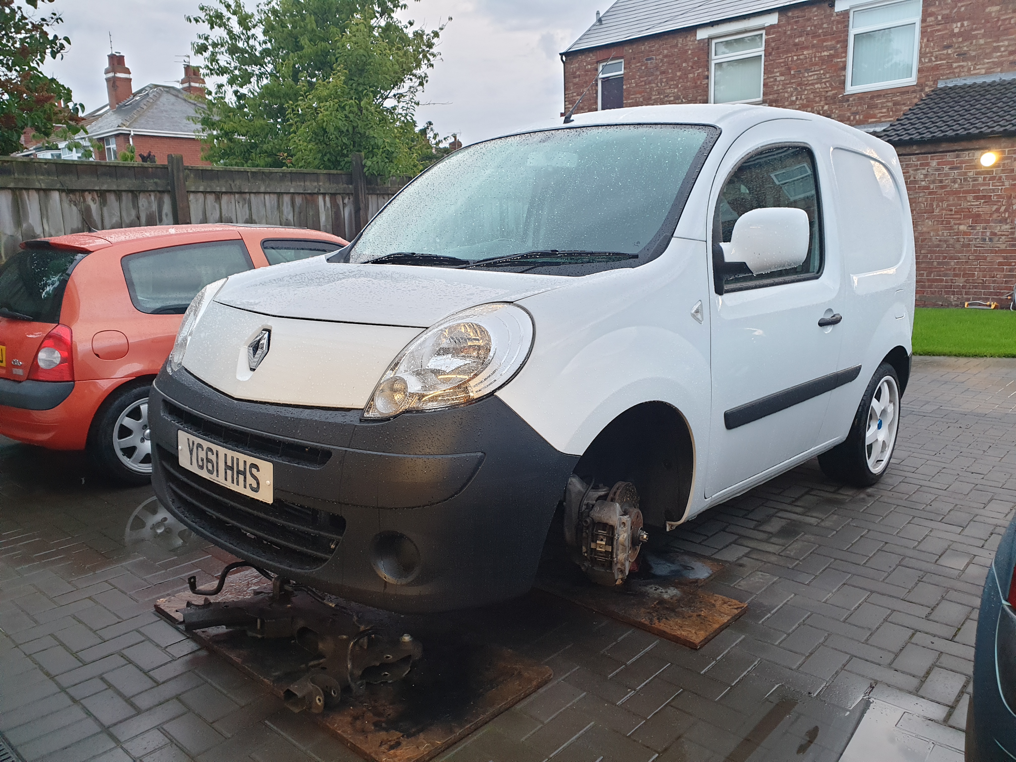

So here we go again! Even though waiting for parts to arrive made a start today. 30 mins to remove subframe, nice and easy. Weather turned shitty so will revisit next weekend.

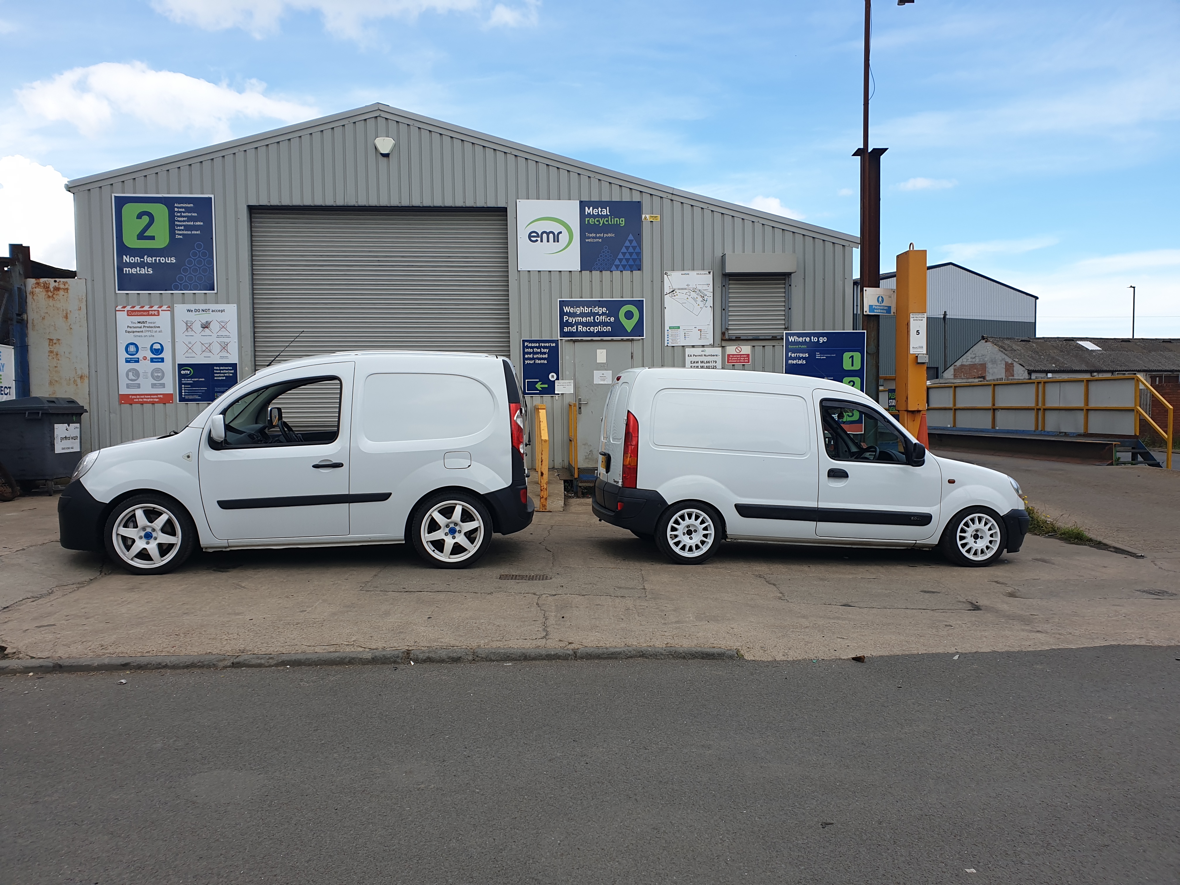

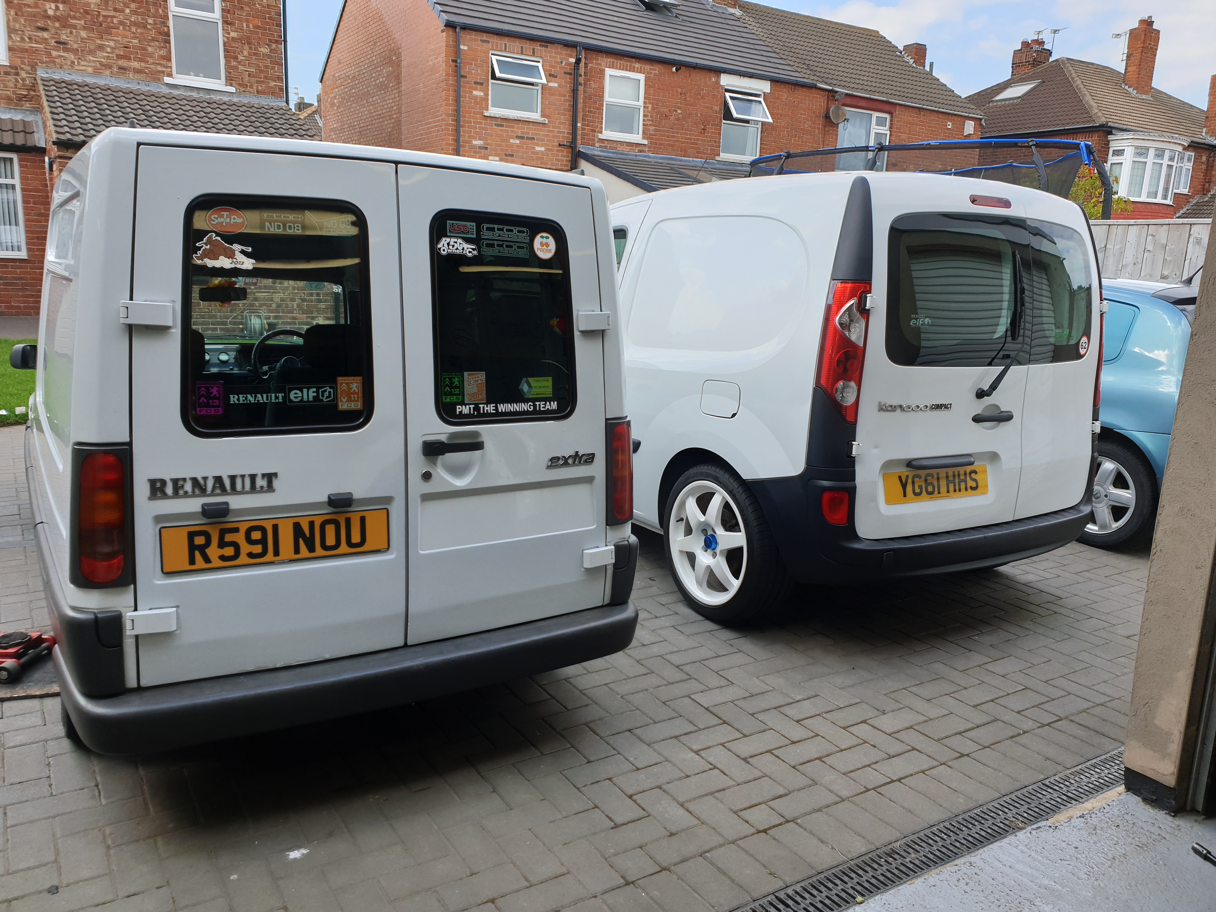

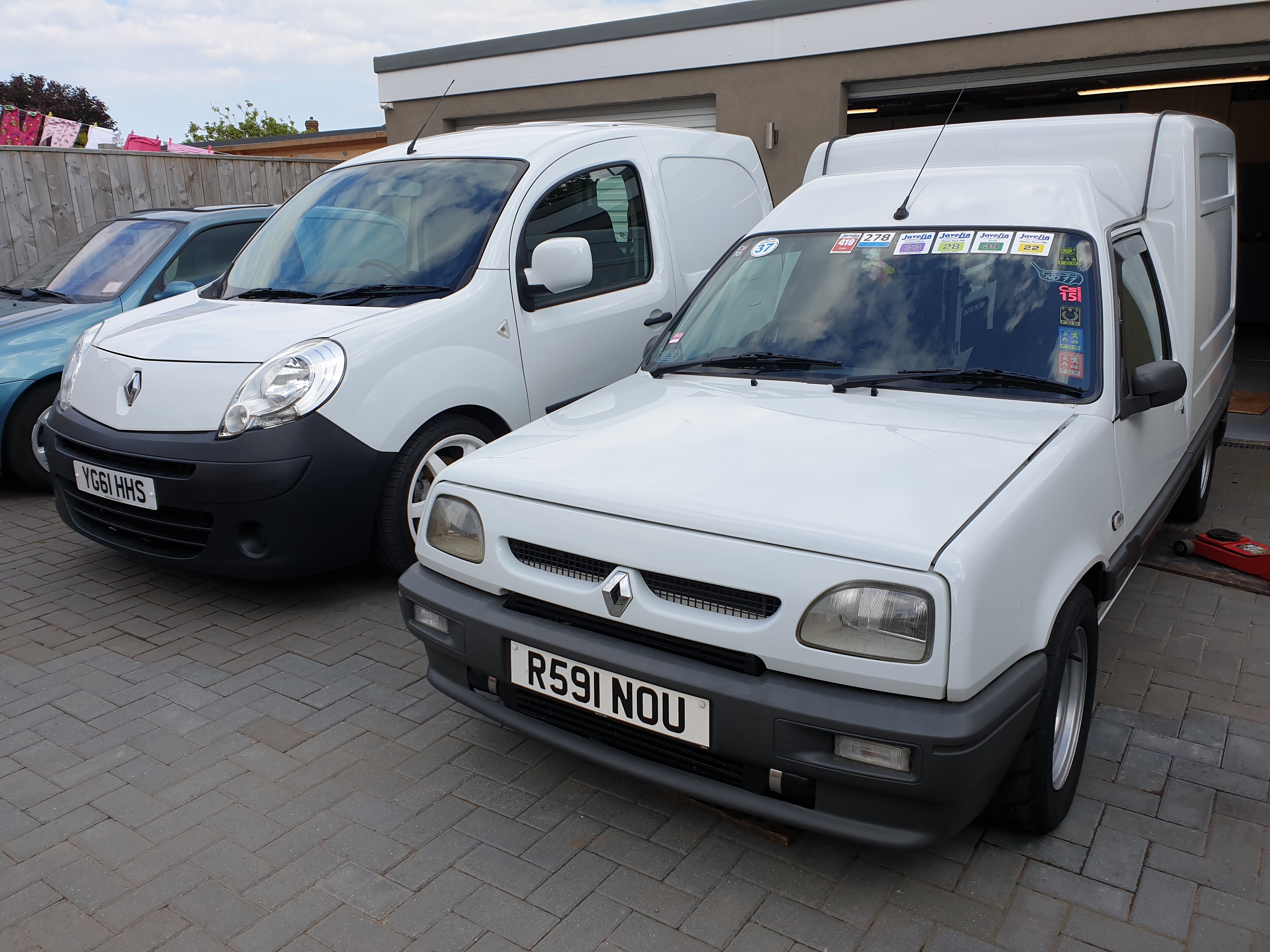

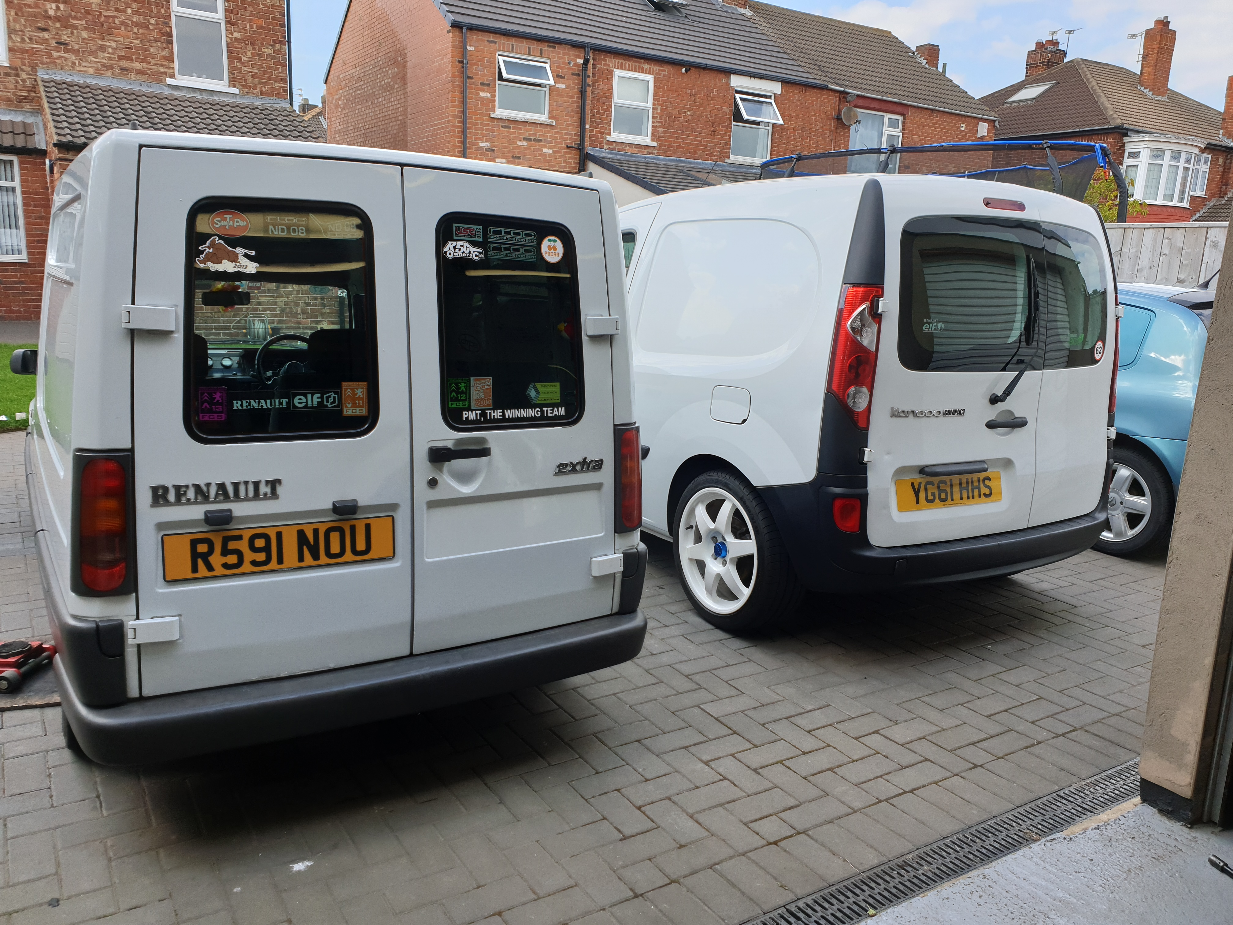

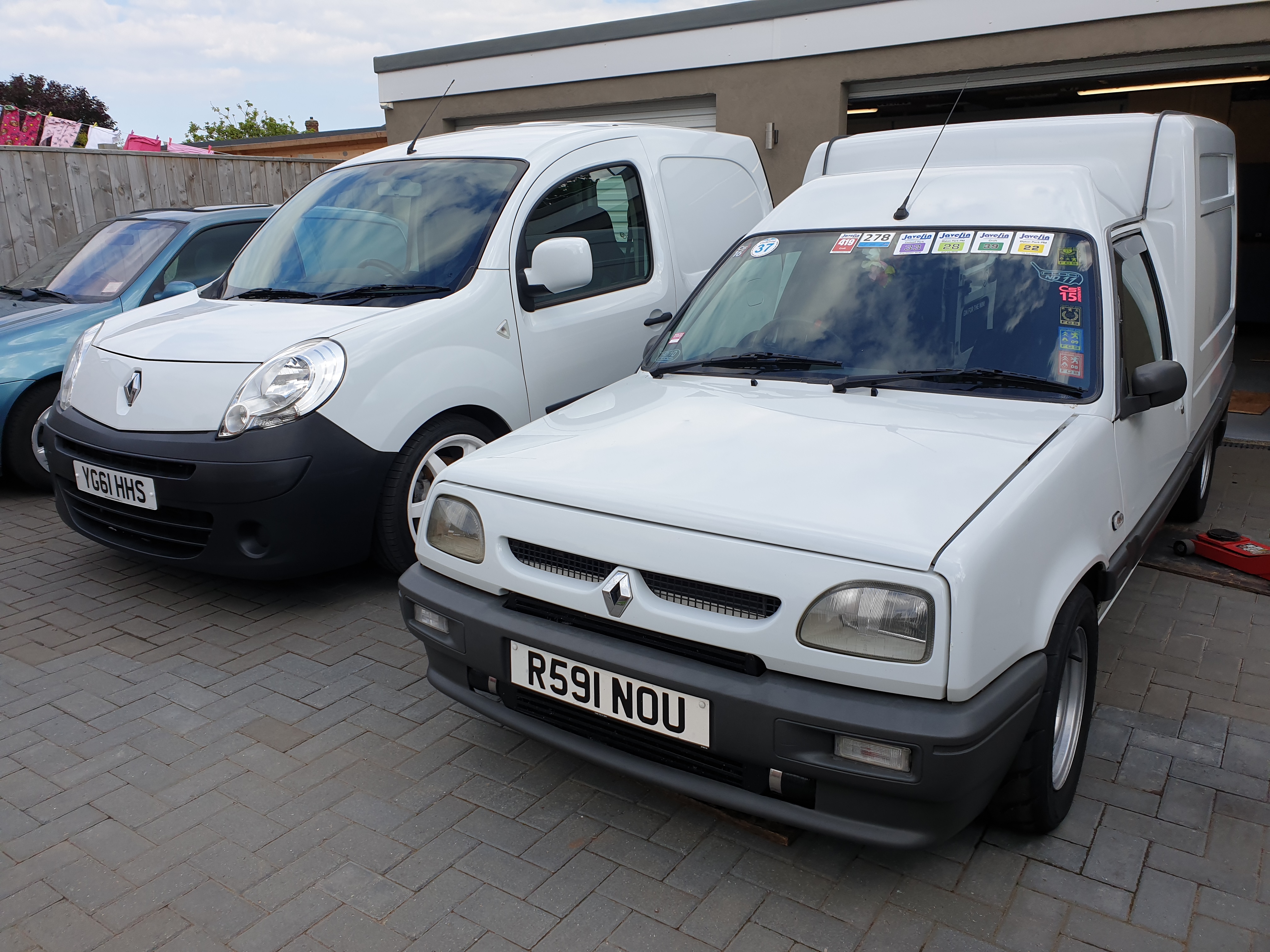

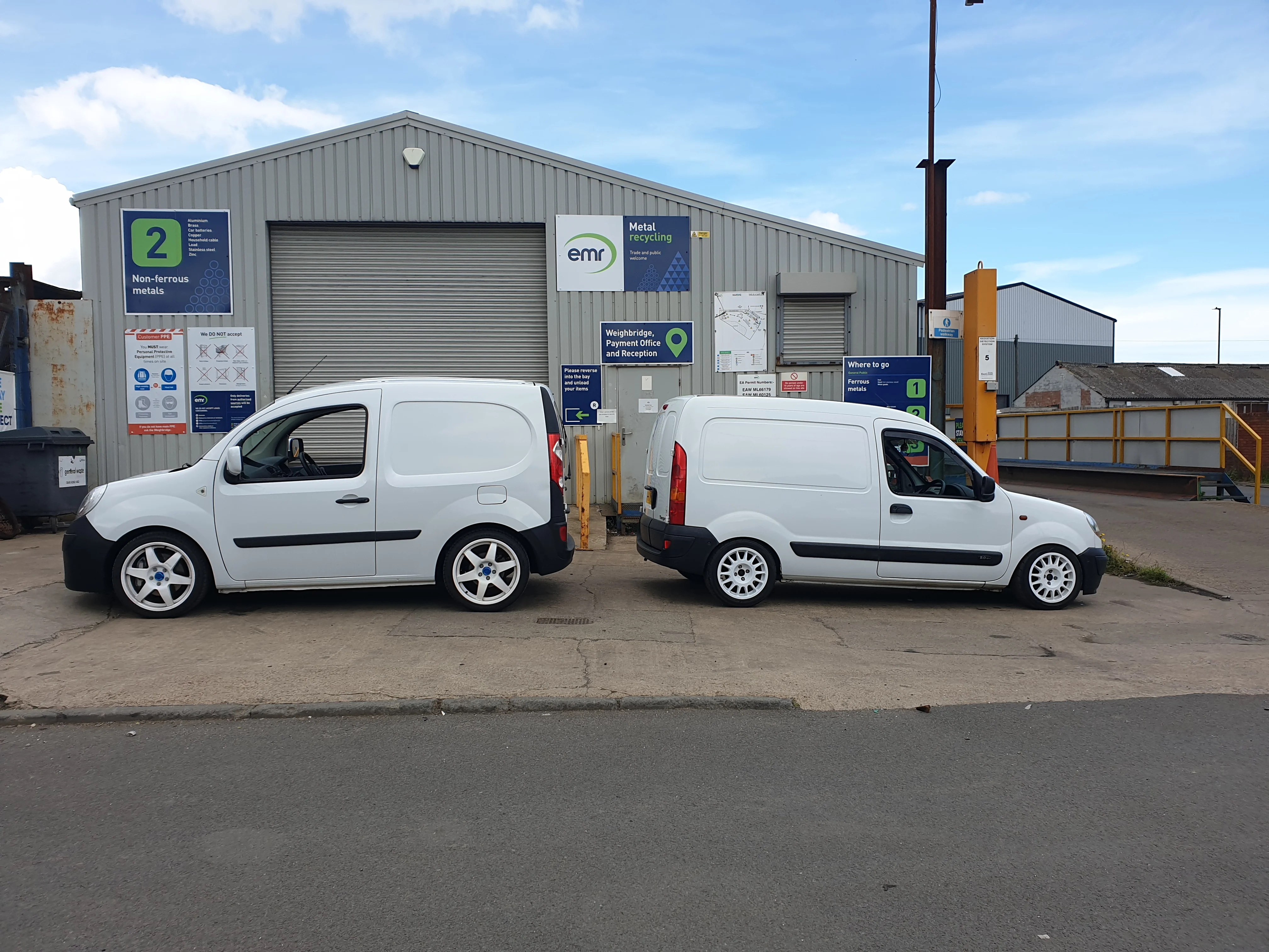

Random pic of it back to back with my old Kangoo 172 outside my mates unit.

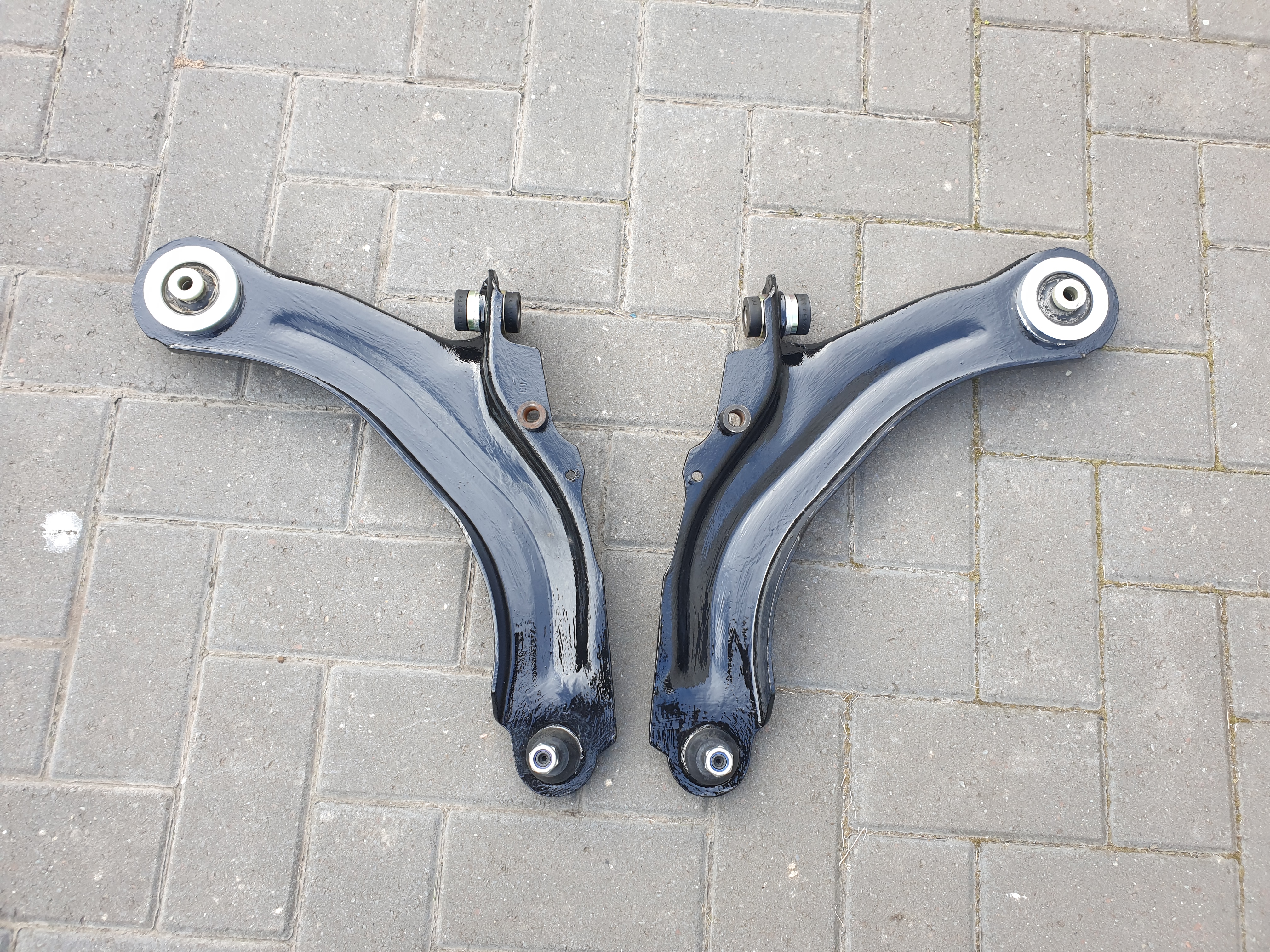

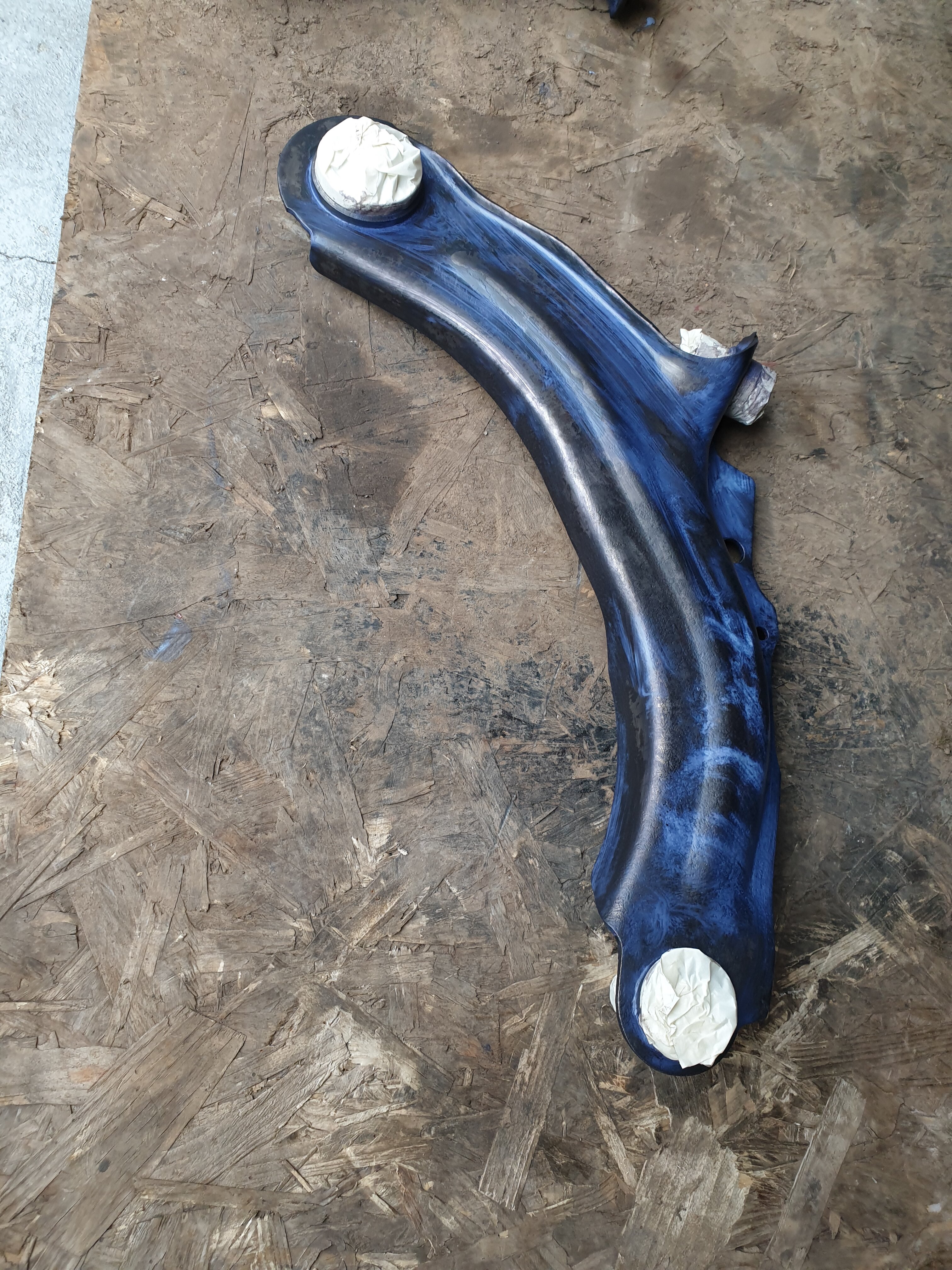

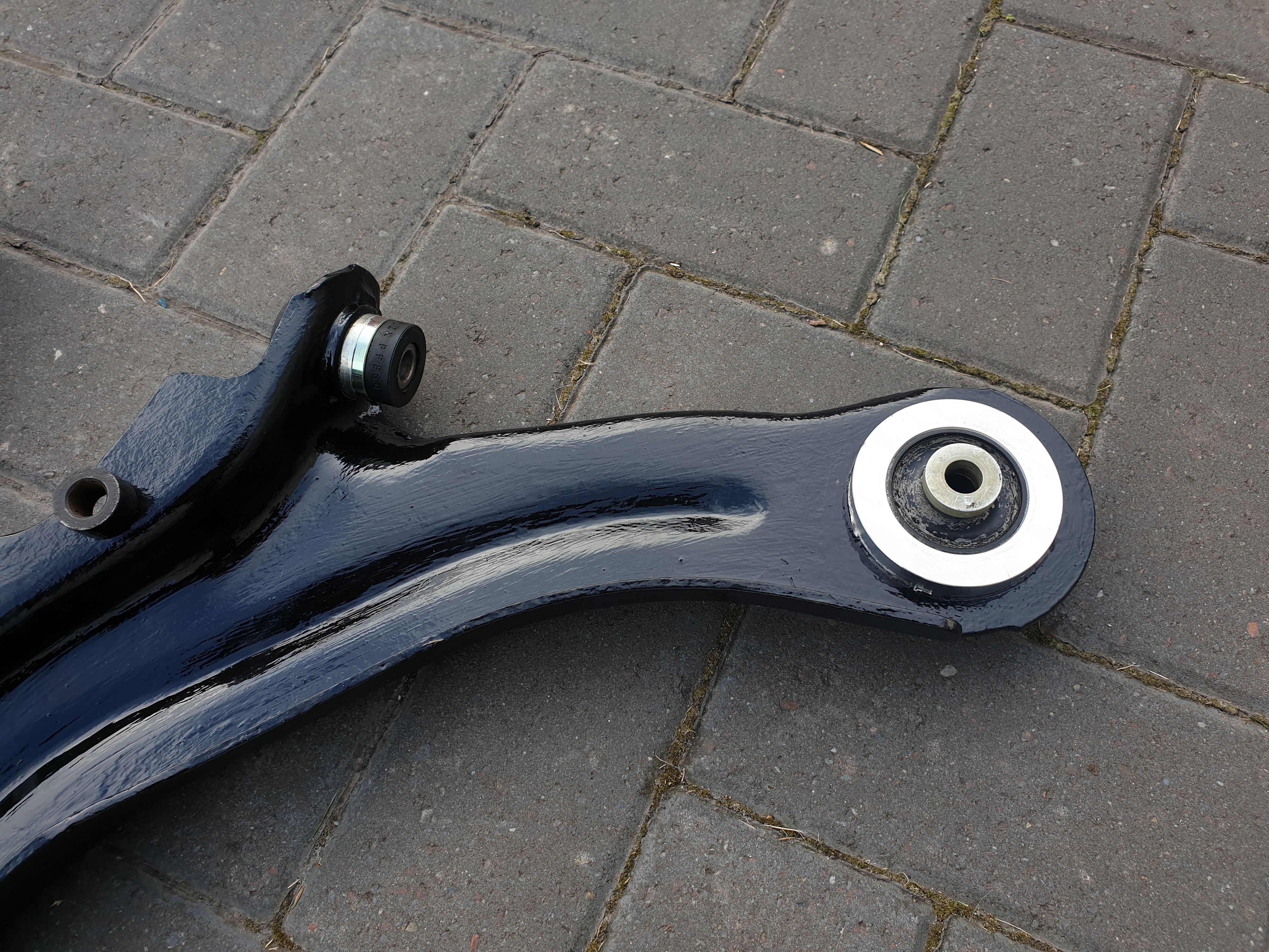

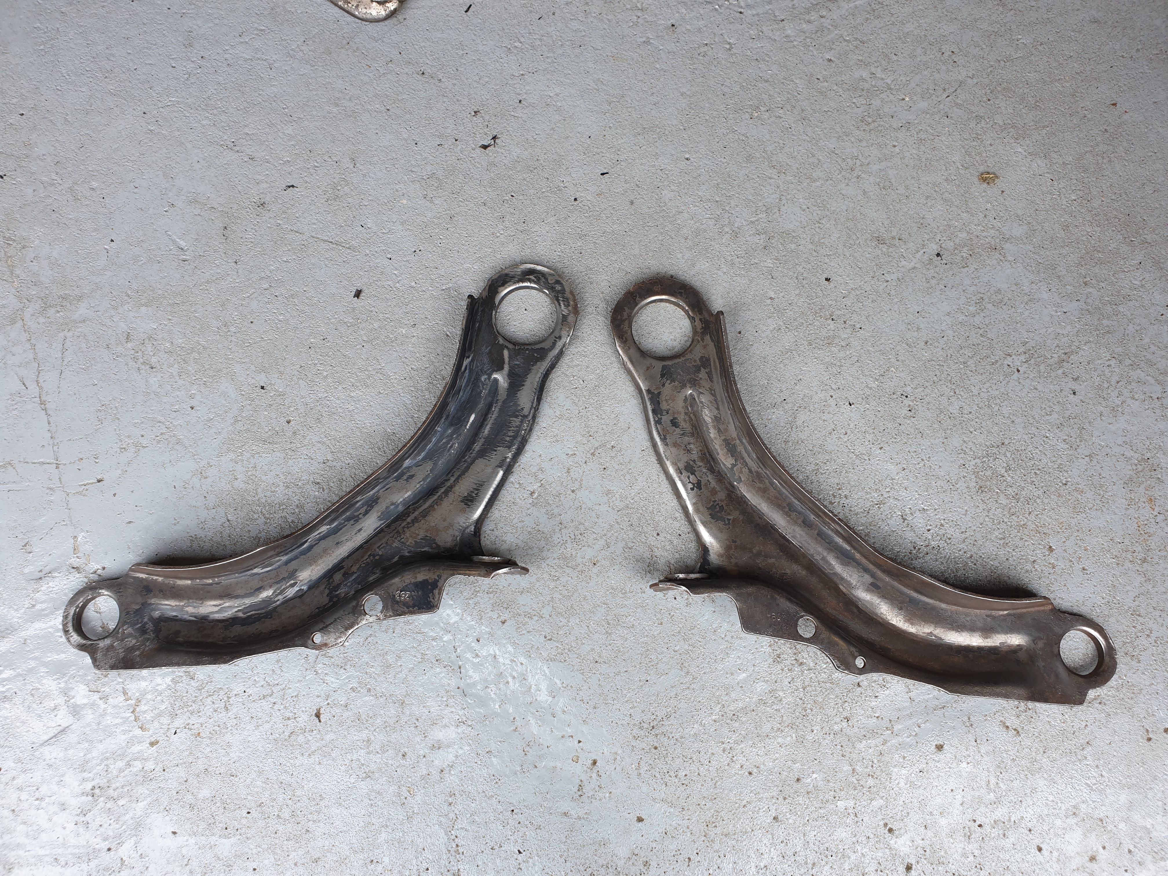

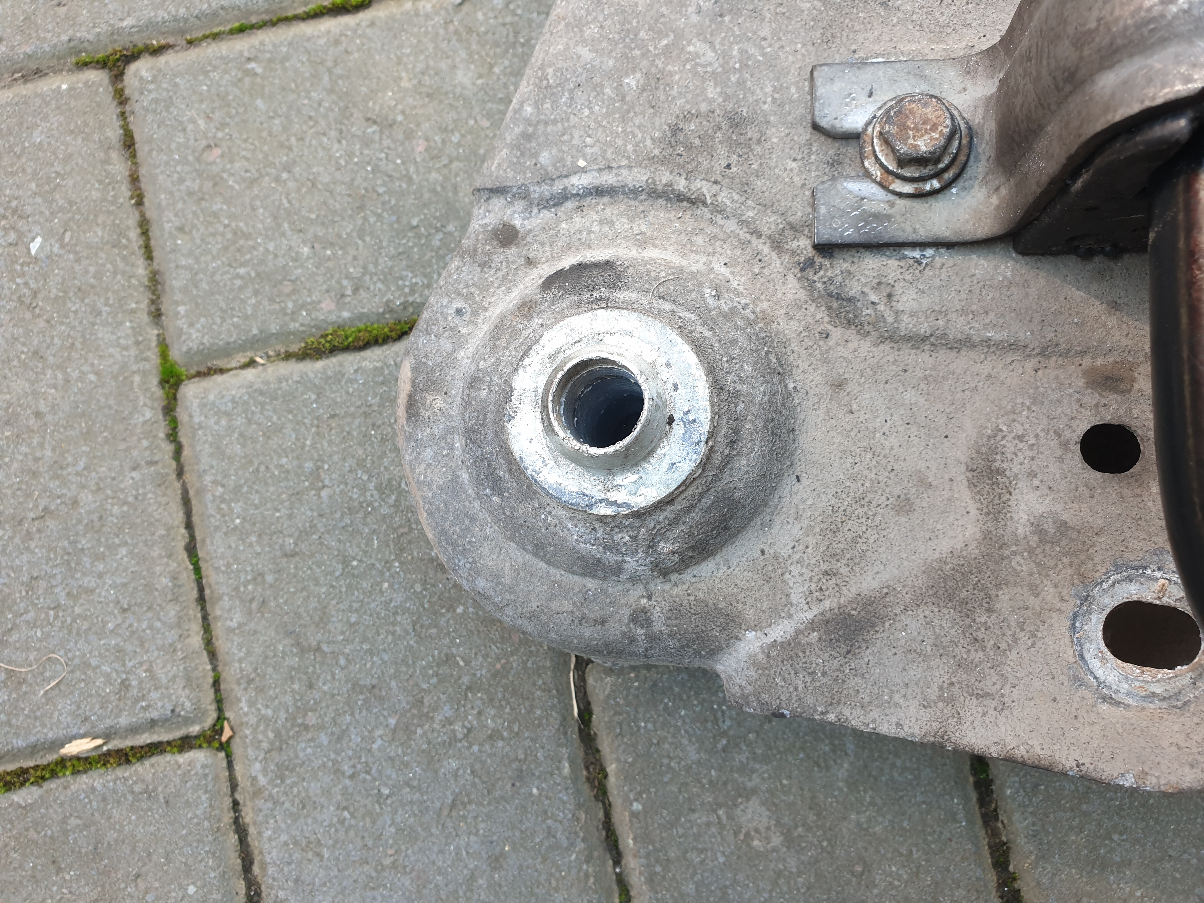

First job was to clean up the track control arms and pop the bushes and balljoints out. 20ton press and knotted wheel on the grinder made short work of this.
New vibratechnics rear solid bushes pressed in, powerflex black up front and new trw balljoints. The rear vibratechnics are a rose joint with rubber boot, look pukka. The main advantage over powerflex rear bushes is they can pivot properly like the oem rear bush allowing proper droop on the front suspension. Best be good as they cost double the price of powerflex.
Coated in hydrate 80
Zinc primer, epoxy mastic and a gloss top coat.

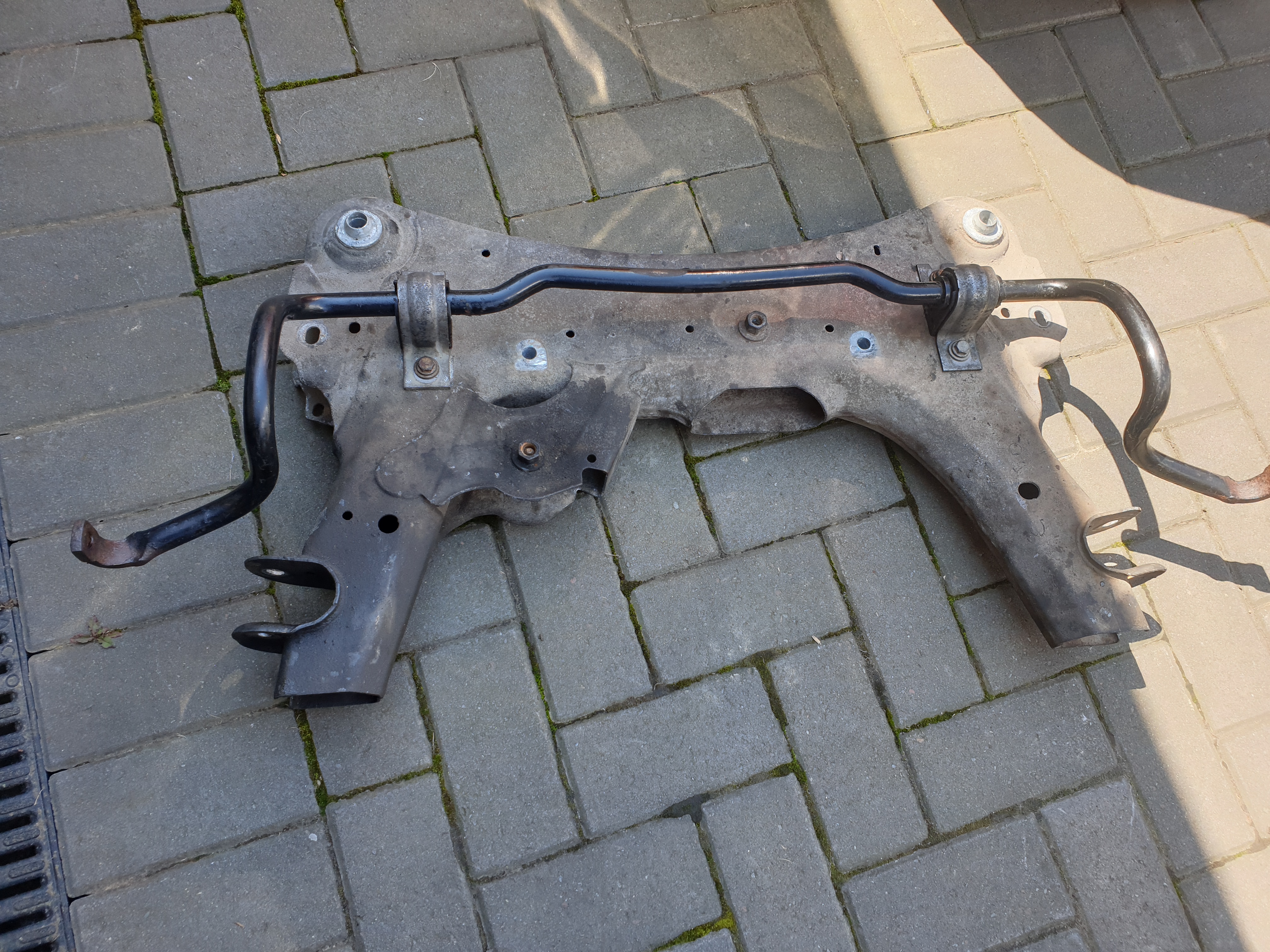

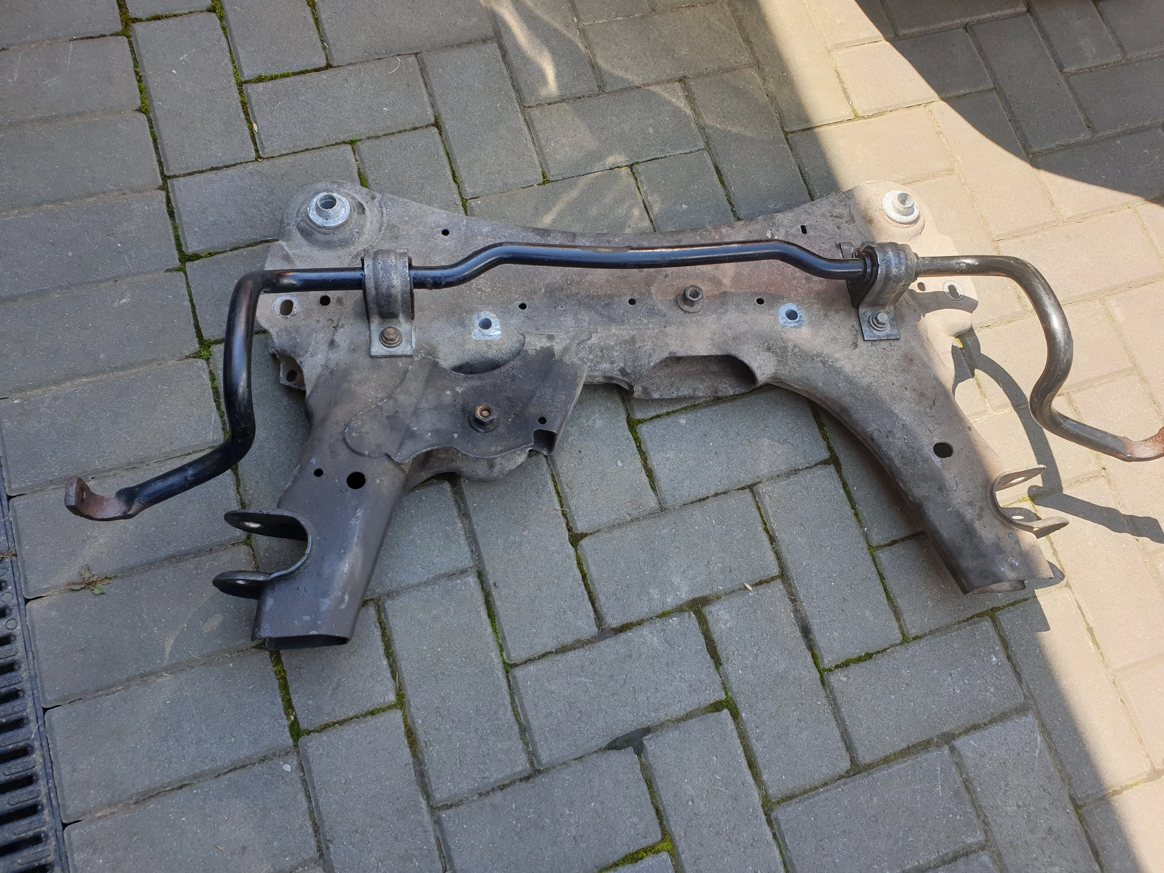

Next job was to upgrade the front arb. Stock Kangoo is 19mm and r26 is 21mm so a decent upgrade. The bars look identical so relatively straightforward swap.

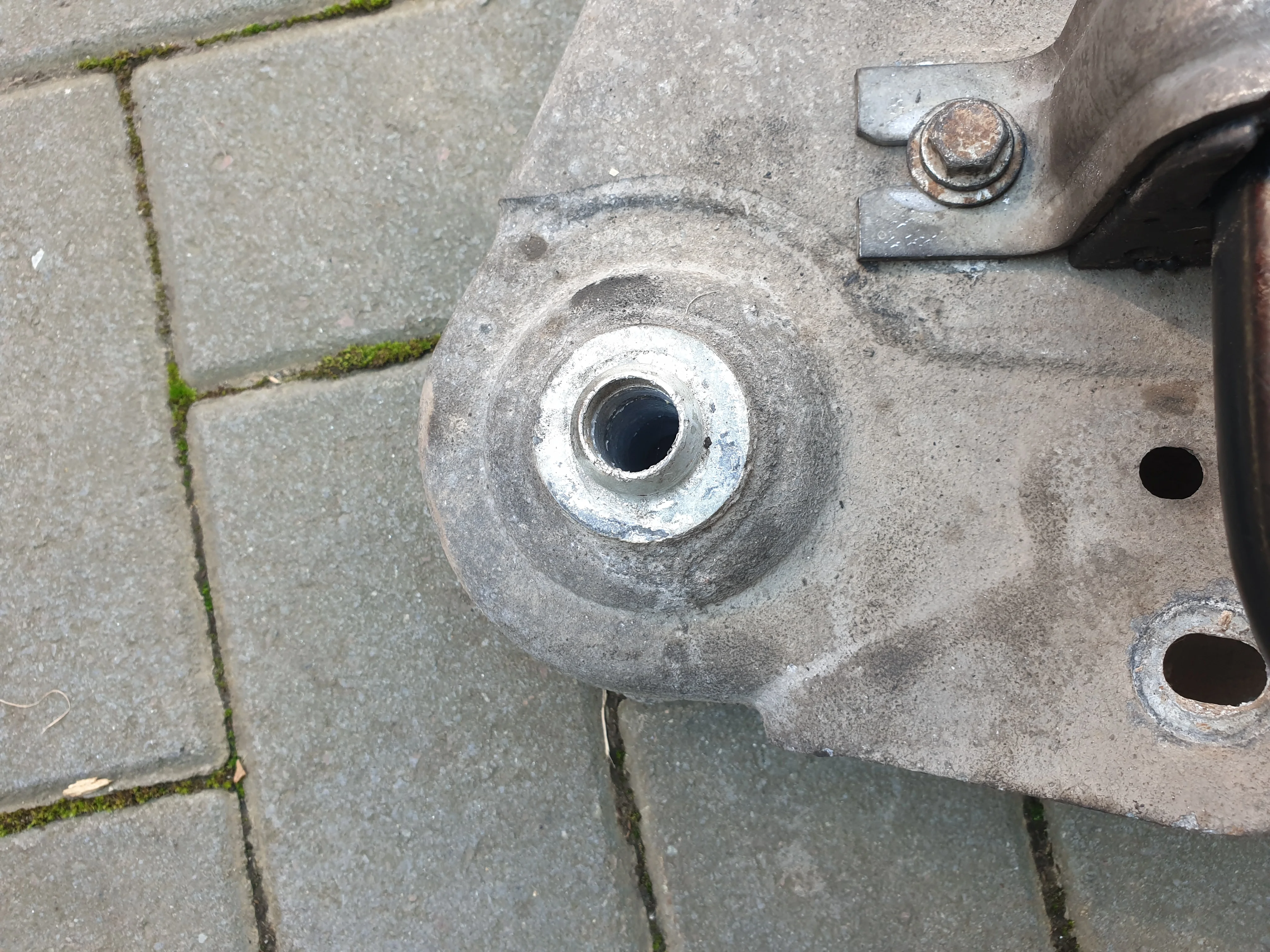

The easy way to do this would have been to use the r26 subframe which bolts straight onto the kangoo. The downside to the megane subframe is that it runs crap bushes in the subframe, and the Kangoo is solid mounted like a clio 197 cup racer subframe, so was worth sticking with it.
Kangoo subframe mounts
Stock arb brackets were no good as for smaller bar and very flimsy, and r26 would not fit as different.
Had a sniff round the renault parts bin and found the megane 3 bushes were for a 21mm bar and looked similar to kangoo. Slight elongate of the holes and straight on.

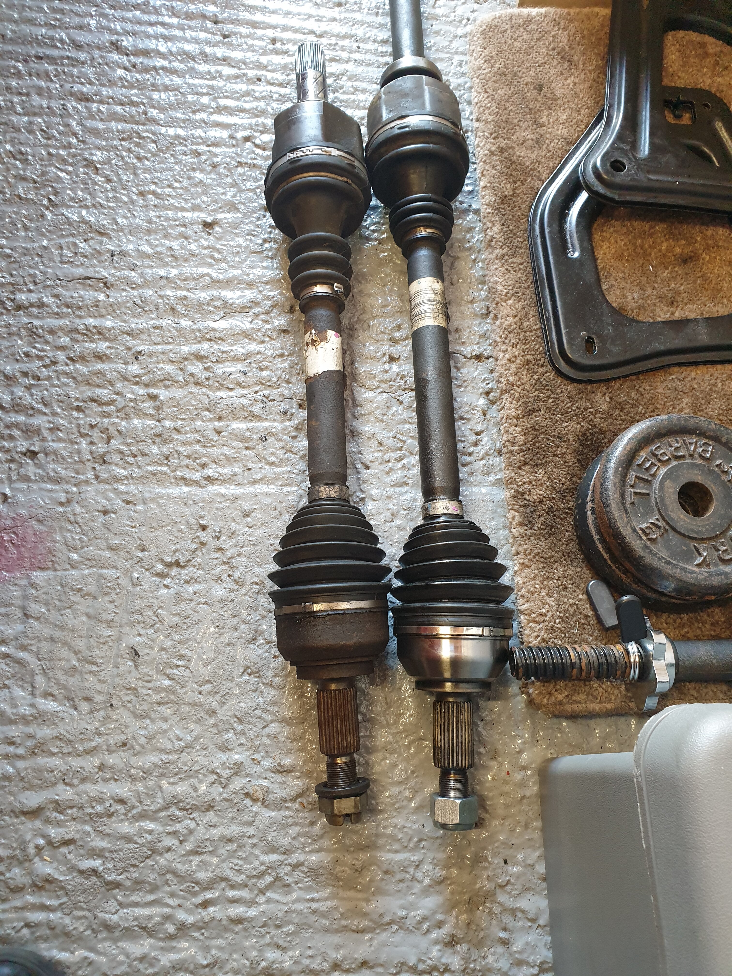

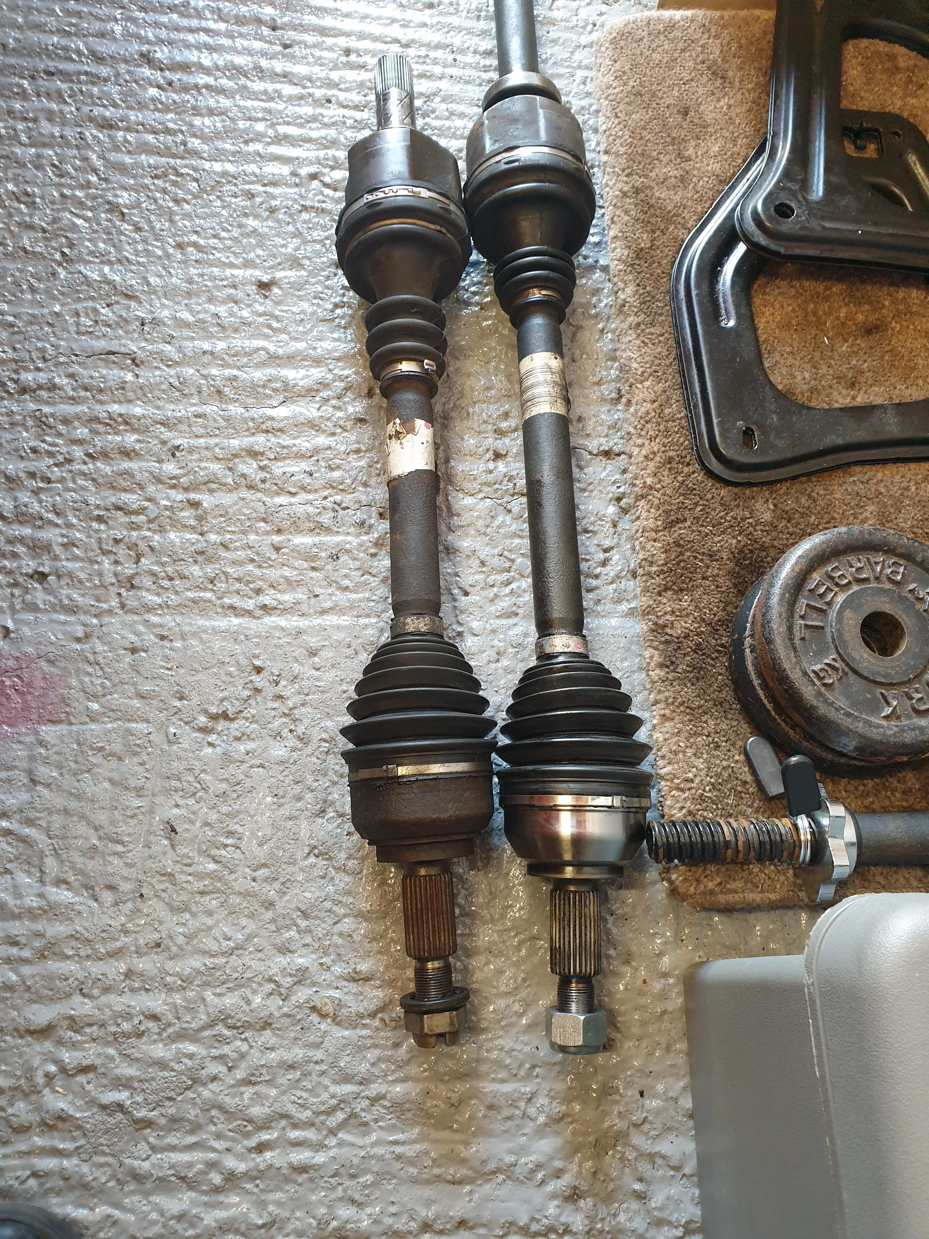

Next job was to change drivers side outer cv as clicking. Easy job just messy.

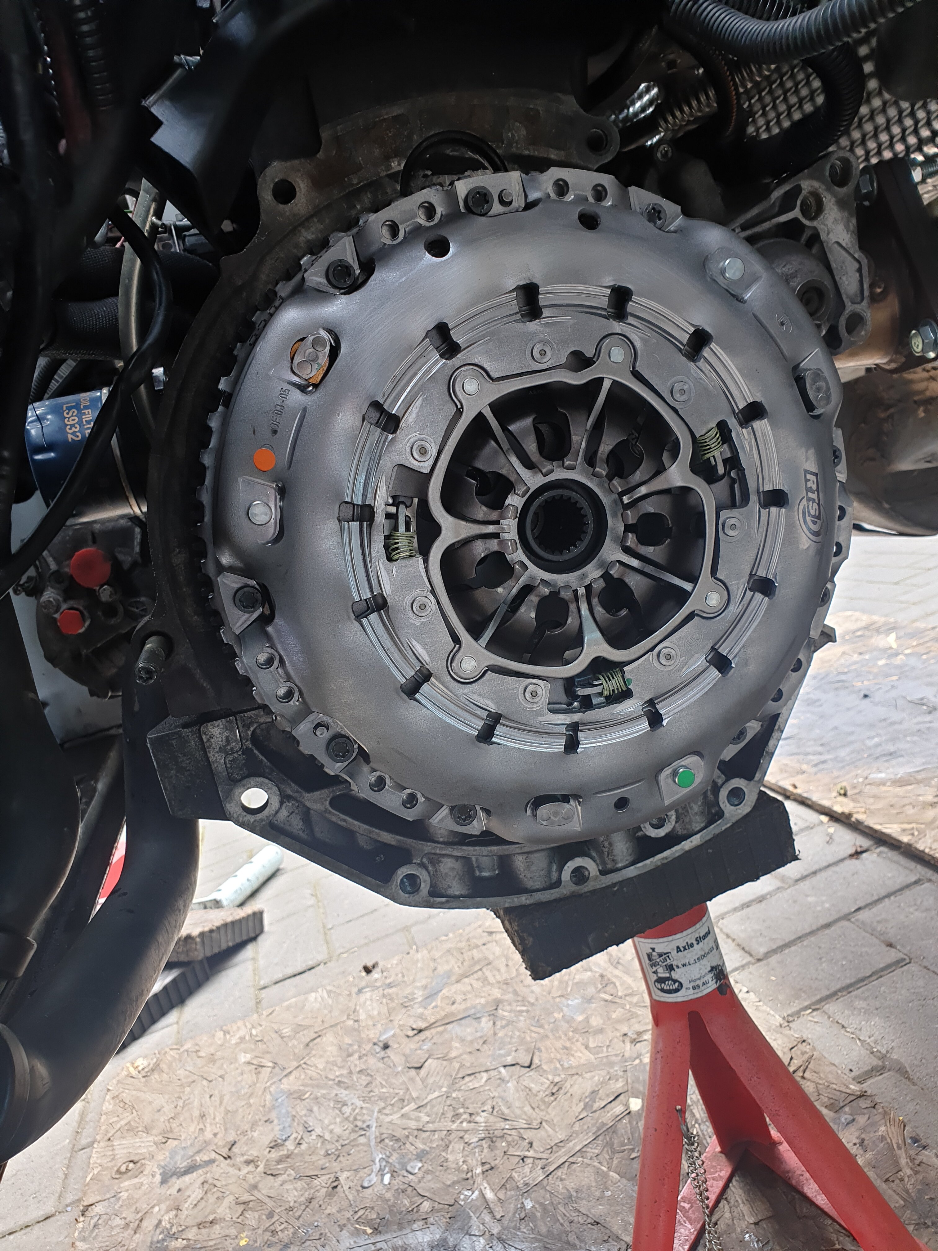

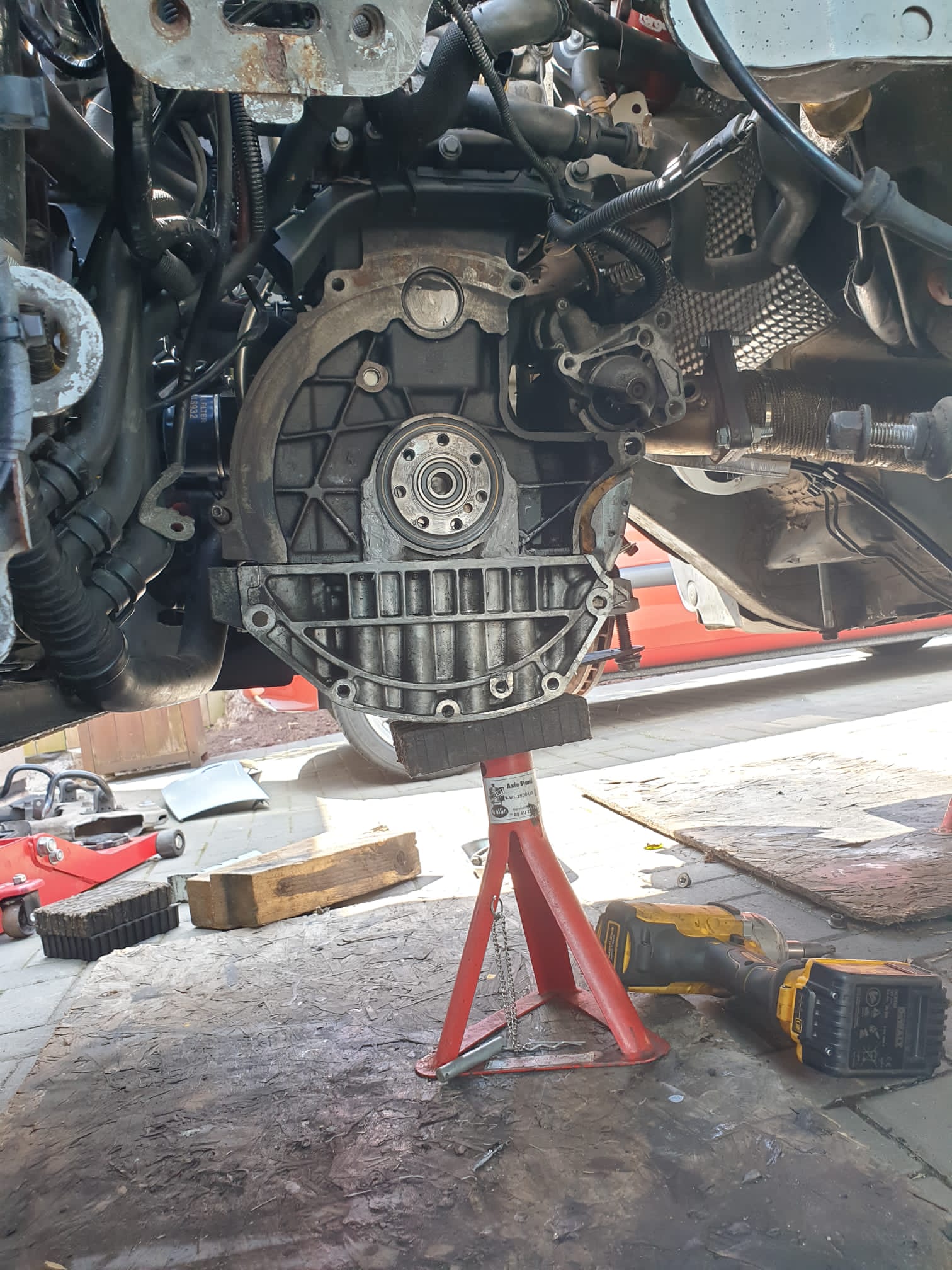

So next job was to pull the box out to replace dmf for new oem and fit the new rts clutch. Its the dual friction type which is tested and good for decent torque.
Pk gearbox a bit of a lump to remove but not too bad. Clutch did not look all that bad but noted that self adjusting mechanism on pressure plate was not set even though it was fine when fitted!?
Dmf was shot play in all directions. I knew this was not the best as had a bit of vibration off it
Crank seal i fitted with the proper tool still nice and dry. Actually cant believe its leak free.
Dmf/Clutch fitted, note self adjusting mechanism set properly.
Box back on, new oem renault slave cylinder fitted. Bled up straight away and a good clutch pedal. Just bolting it back together at the moment should be finished tomorrow, need it running for Friday to pick up a petrol patio cleaner:LOL:

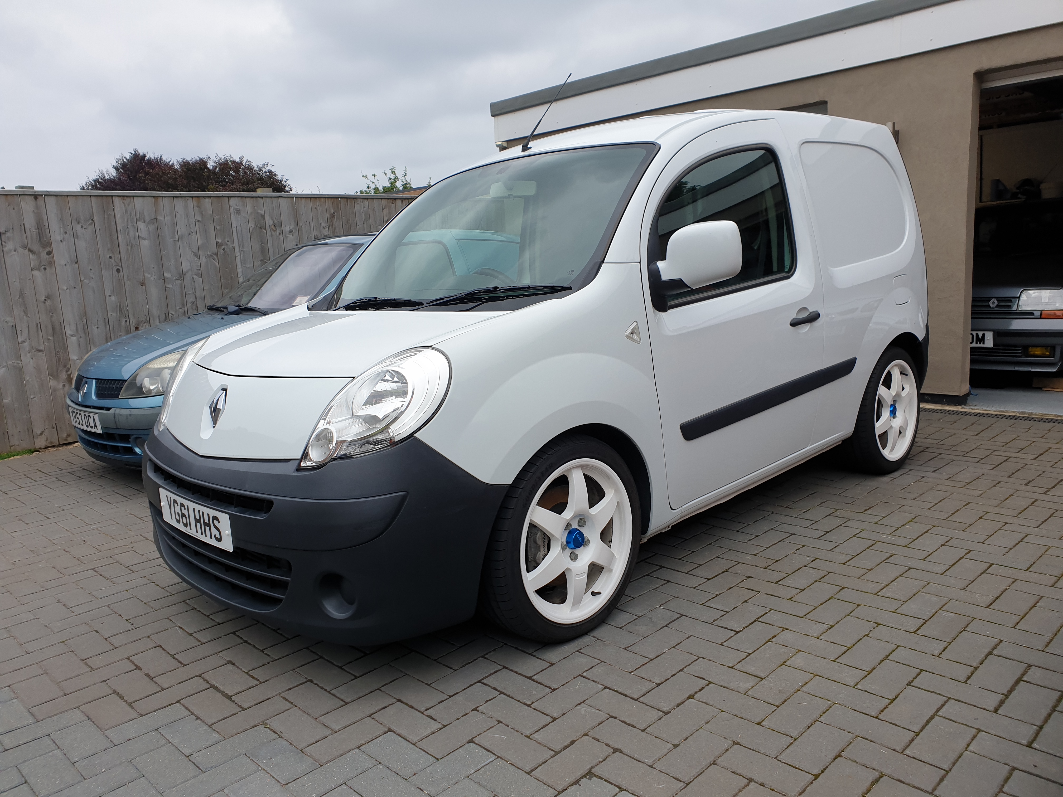

Got it all back together and back on the road. Toe was miles out with new tie rods fitted so got that set and started running in the new clutch setup. Clutch feels good not too snappy and handling feels absolutely on point with refurbished suspension and 21mm arb, its absolutely transformed over version 1. Corners nice and flat.
Cleaned up as it was looking sorry for itself after a few weeks of sitting on the drive
Black induction pipe to replace the red hose
Tank filled up

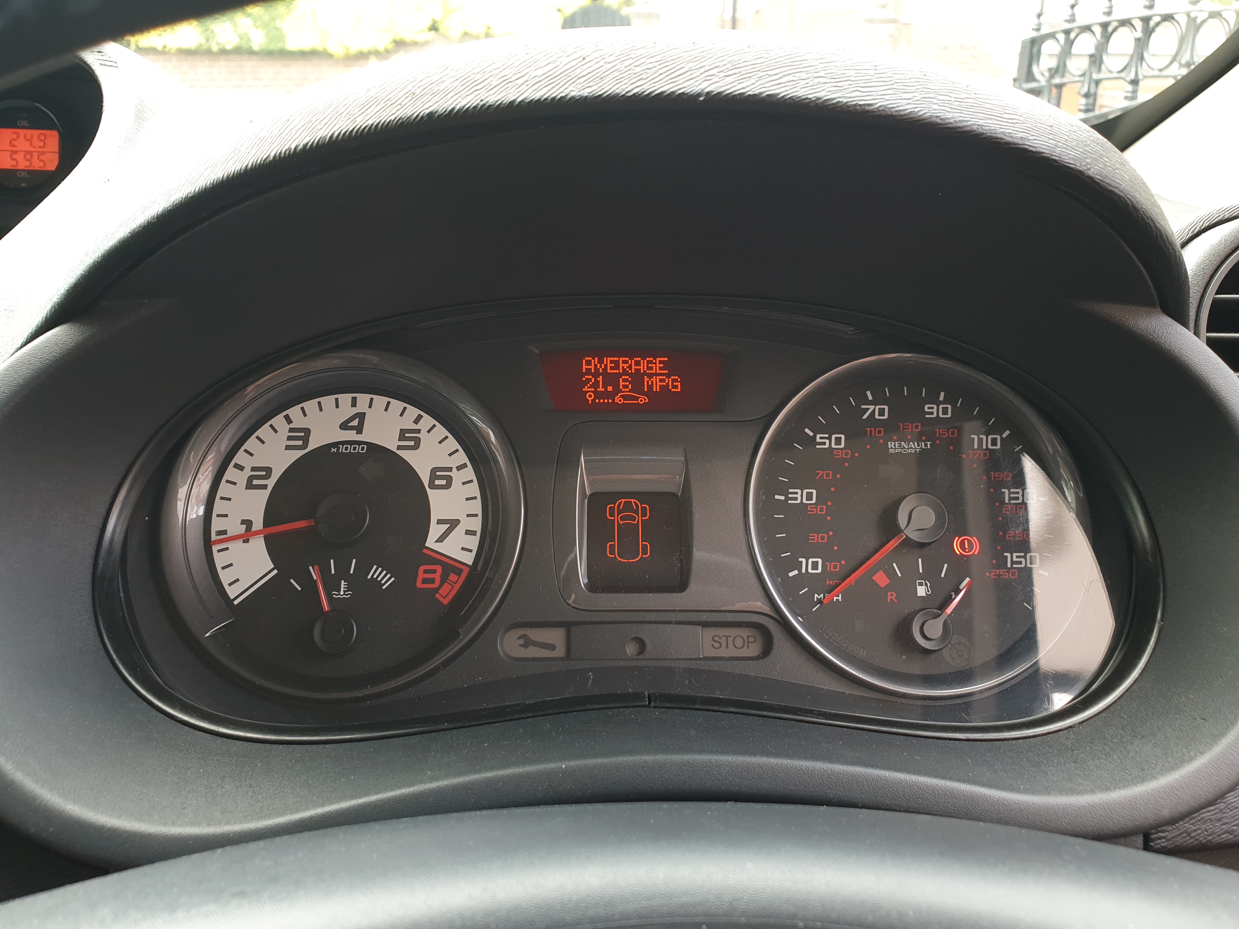

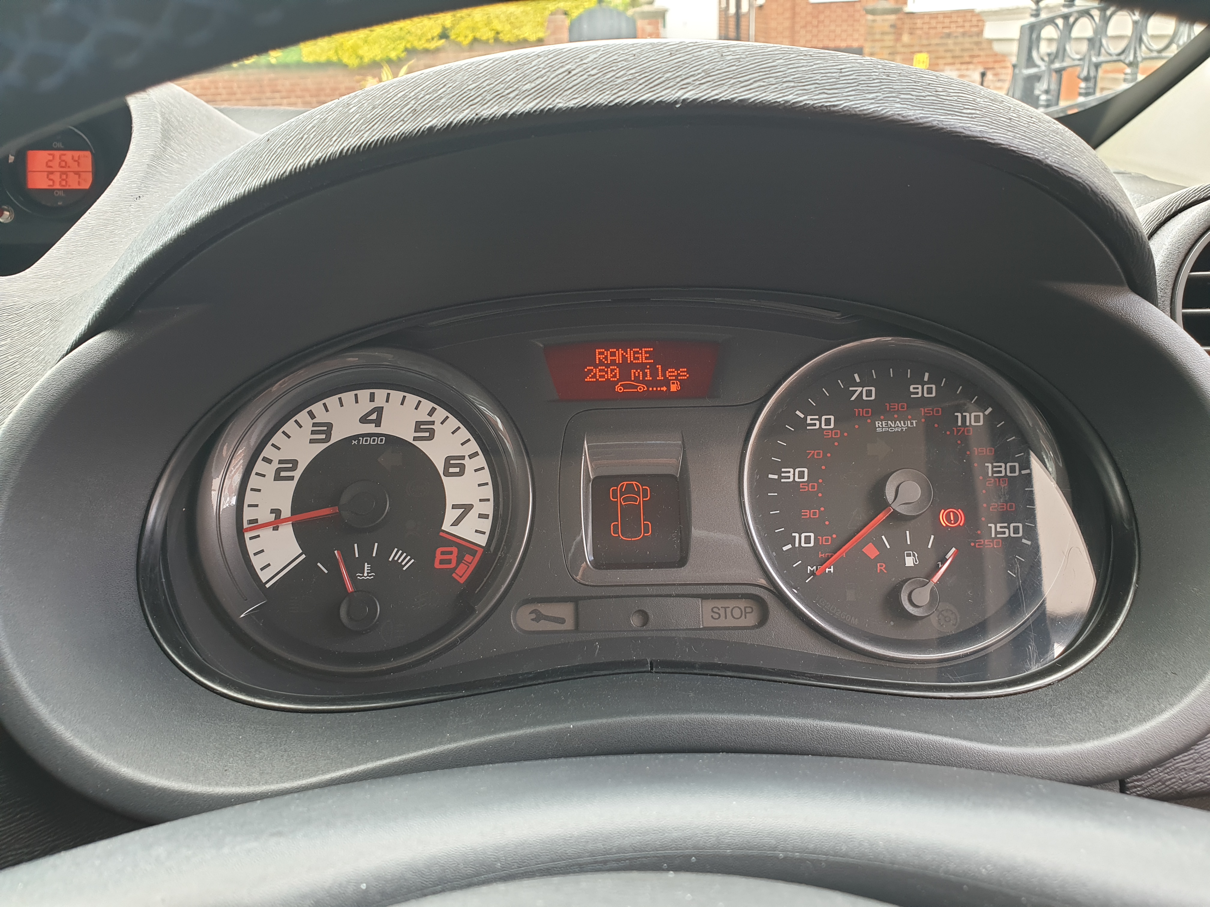

21mpg average around the streets.
Been using it loads this week to get some good mileage on it, no issues to report.

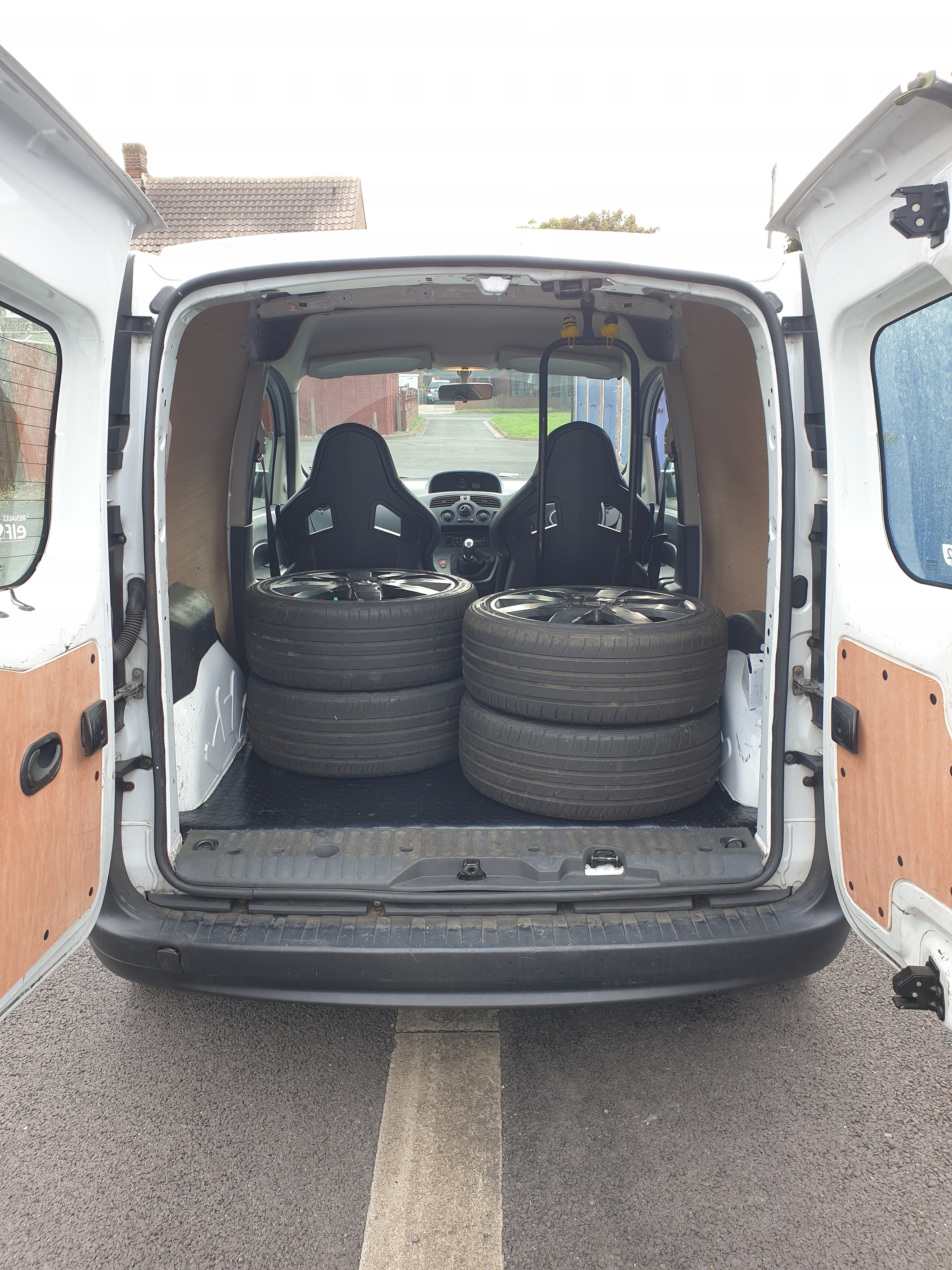

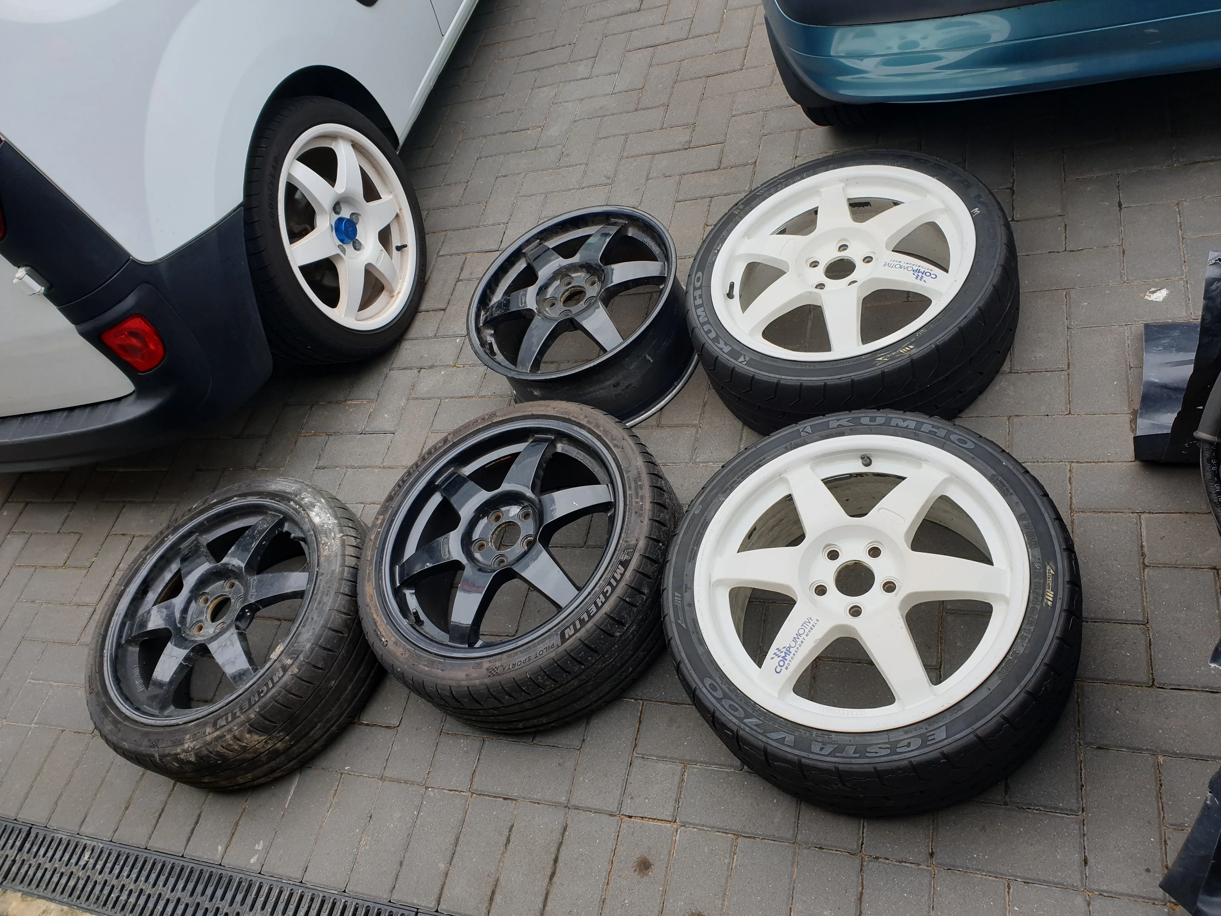

Can just fit a set of 18s in the back at a squeeze :LOL:

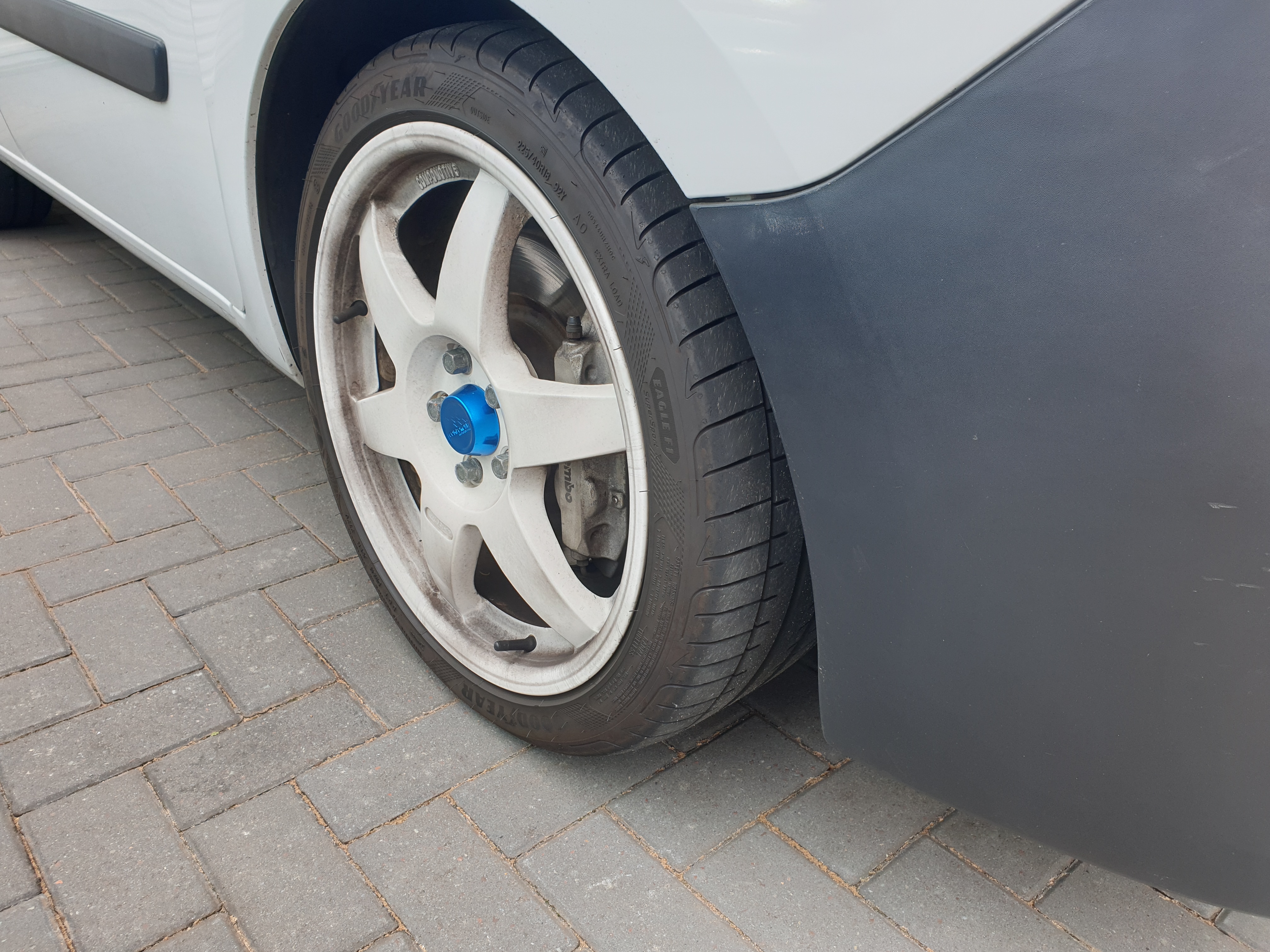

Speaking of wheels, as per my dci thread ive gathered another pair of compomotive 1880 to make another set. They appear to be all from the same batch as all were black originally. Note damaged wheel on the far left, might make a table out of it
Might get them powdercoated anthracite as the white wheels currently look like this unless cleaned once every few days
