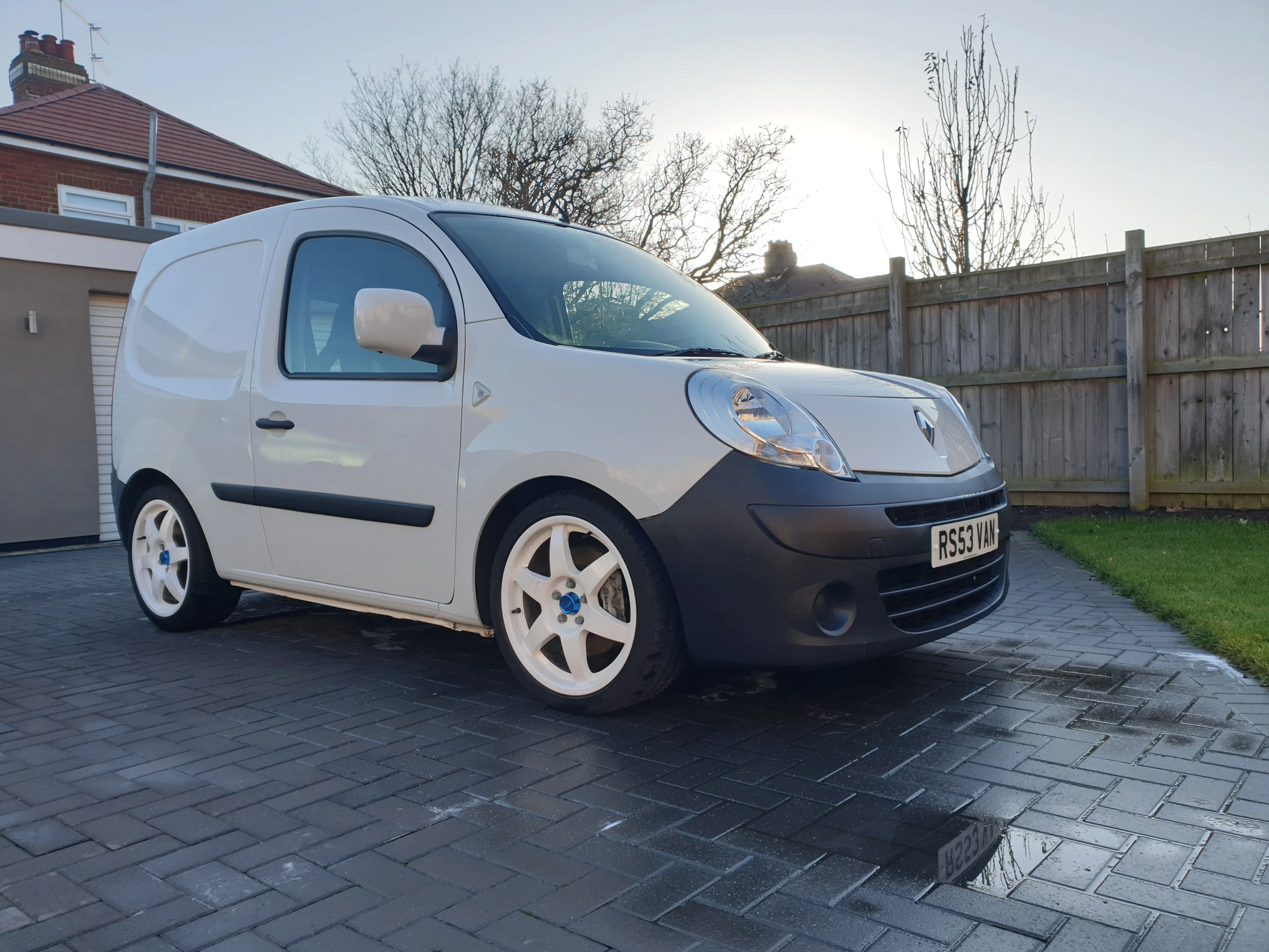

dont shoot me but i think it'll look smart on a set of R26 alloys
I think it would look alright on a set to be fair. I sold my last set sadly. Going to try the turinis on it one day.
Updates

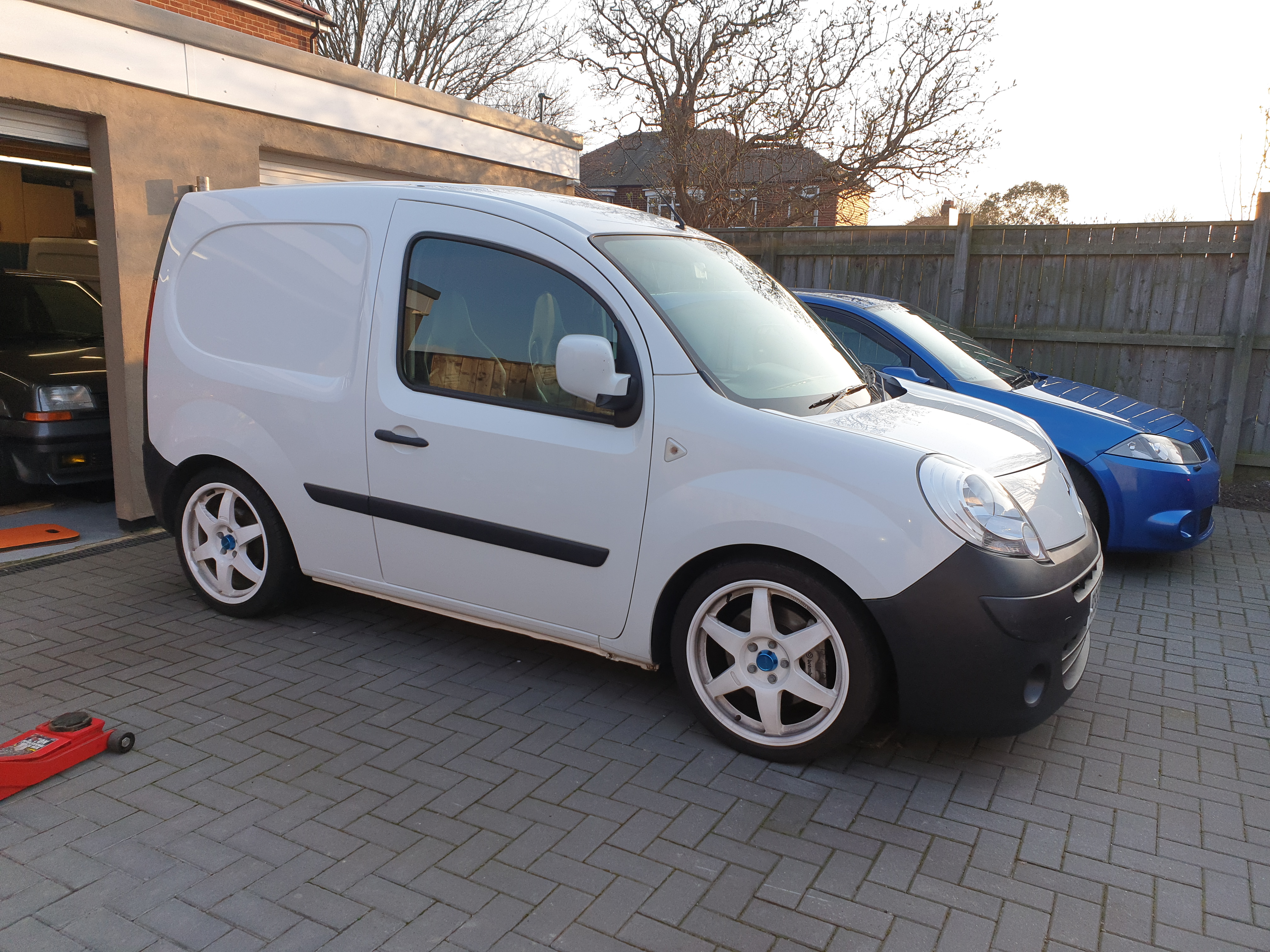

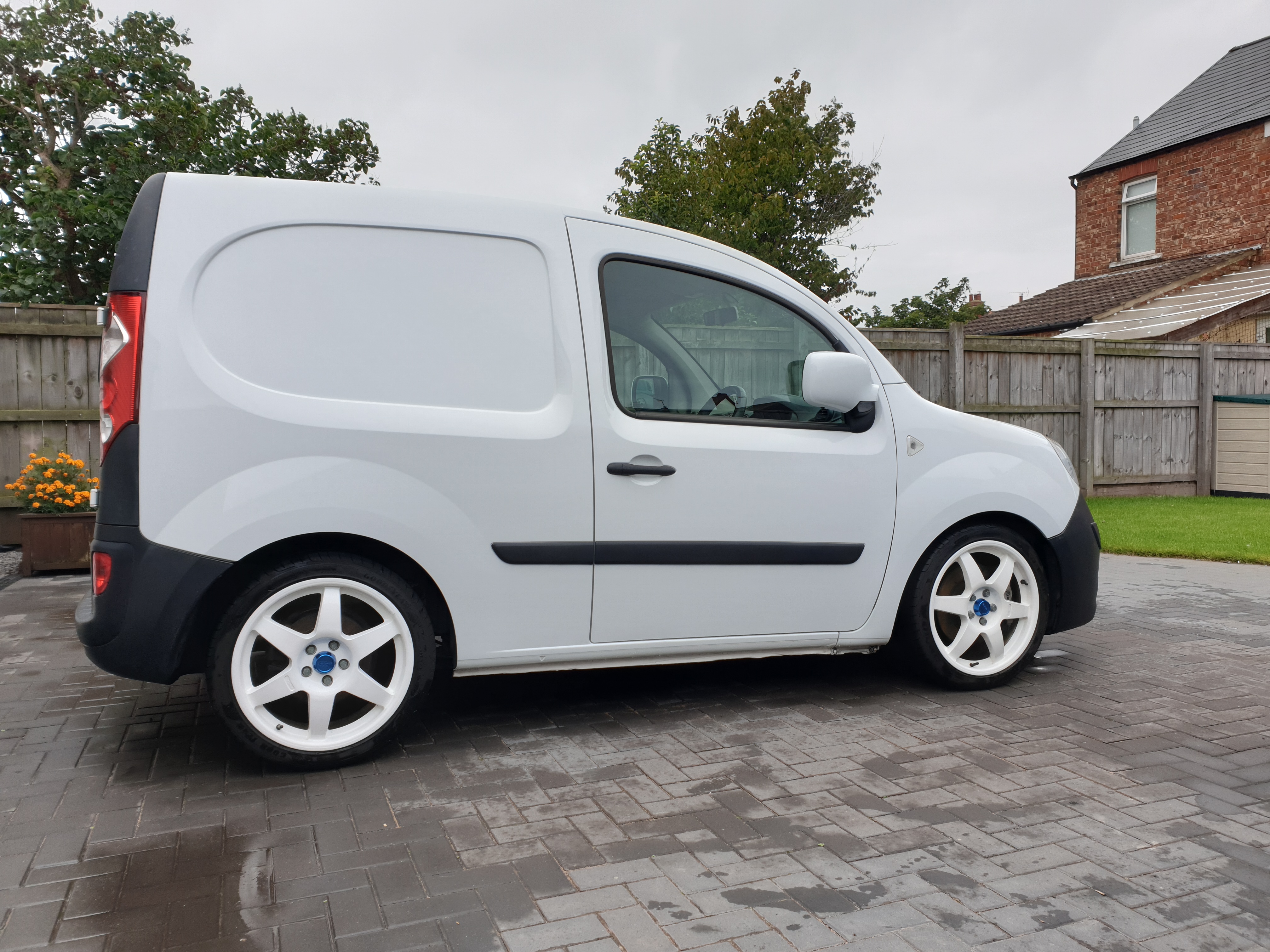

Cleaned it up again. So hard to keep on top of the wheels with regular use always black with brake dust
Upset an x5 owner earlier. Seen it coming up behind pretty fast on a local dual carriageway. I was in 5th just put boot down and pulled away with little effort. Dirty look off the driver when they finally caught up at the next roundabout:LOL: with them proceeding to drive off like a knobber cutting up another car.

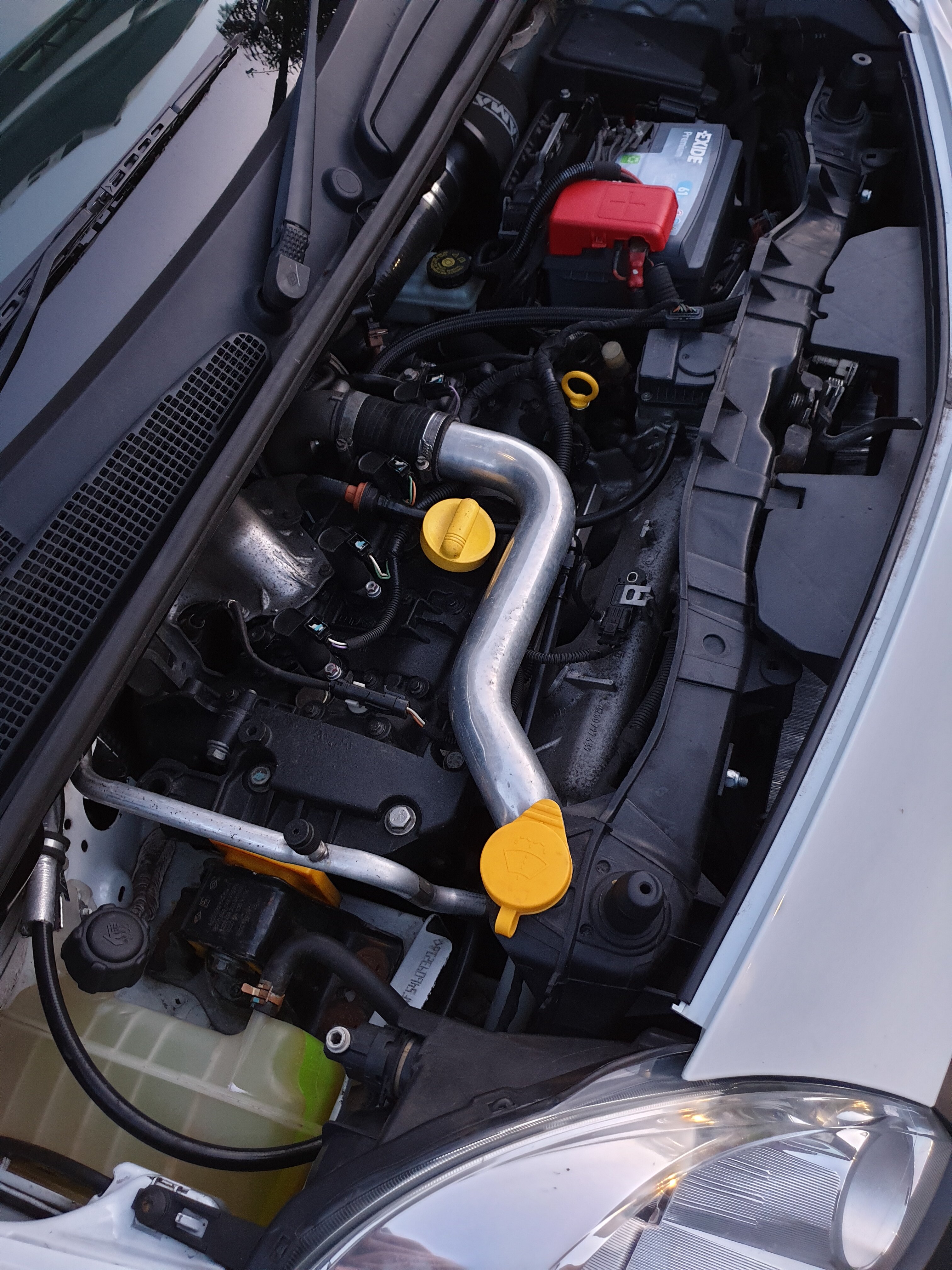

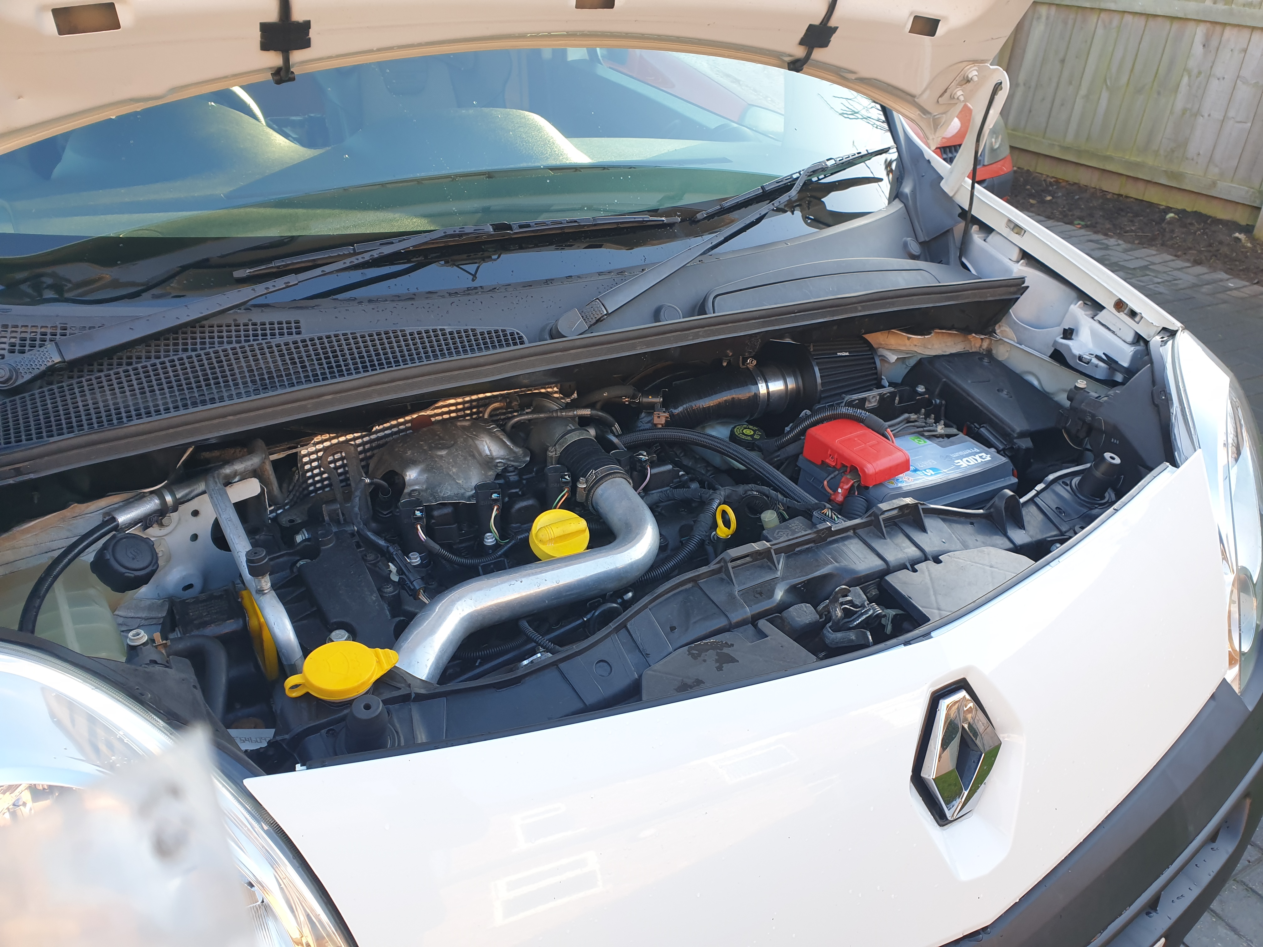

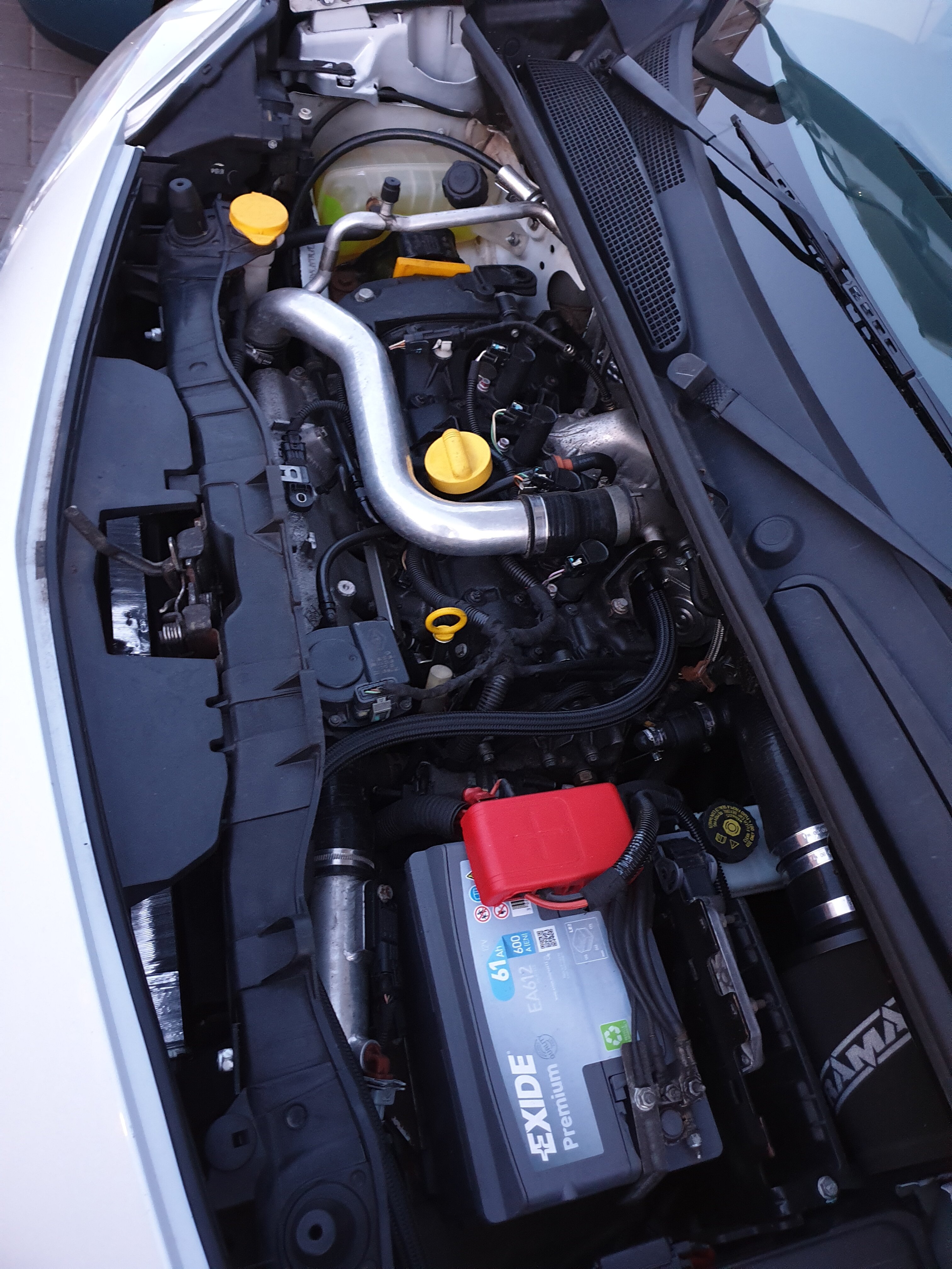

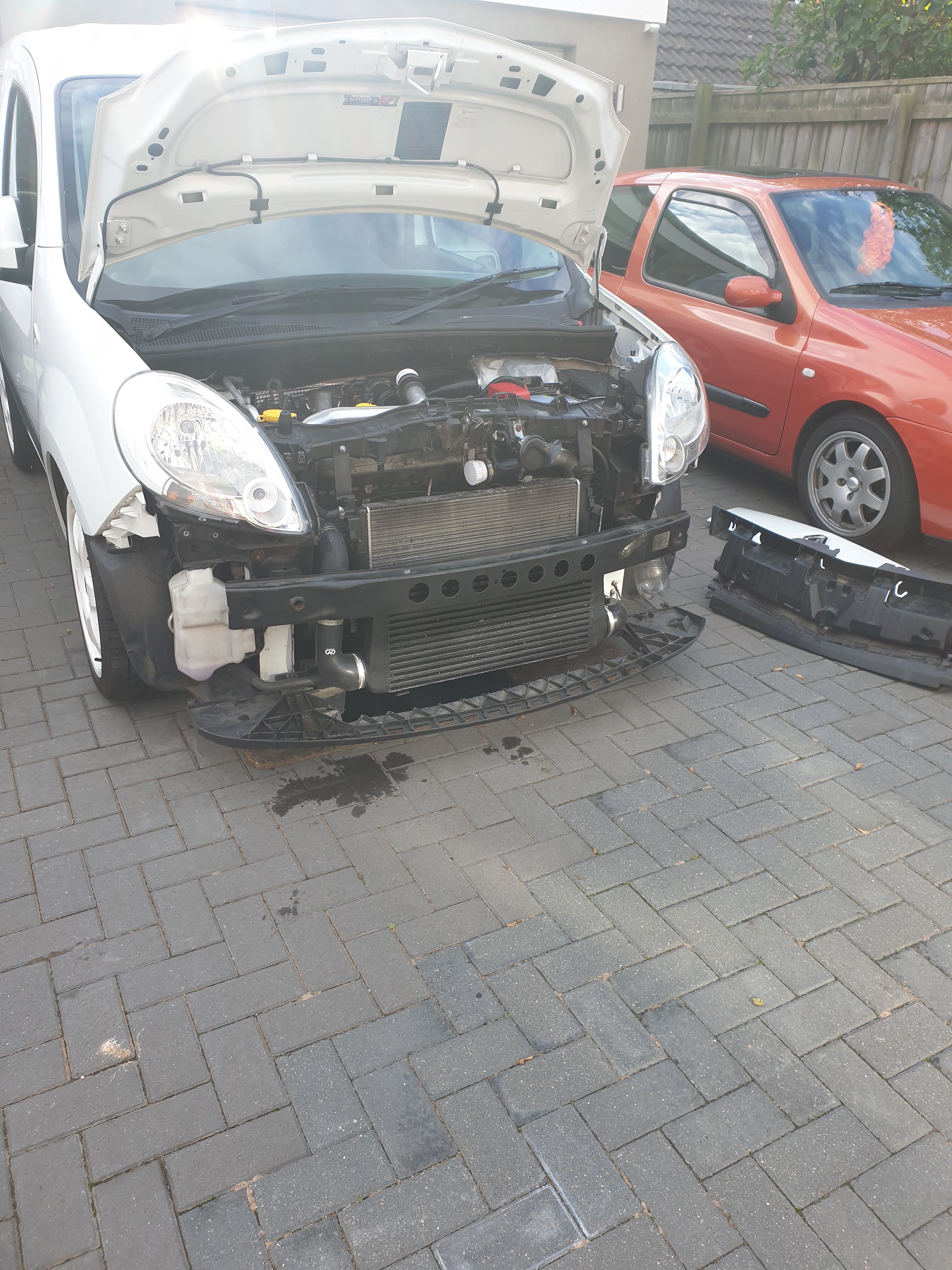

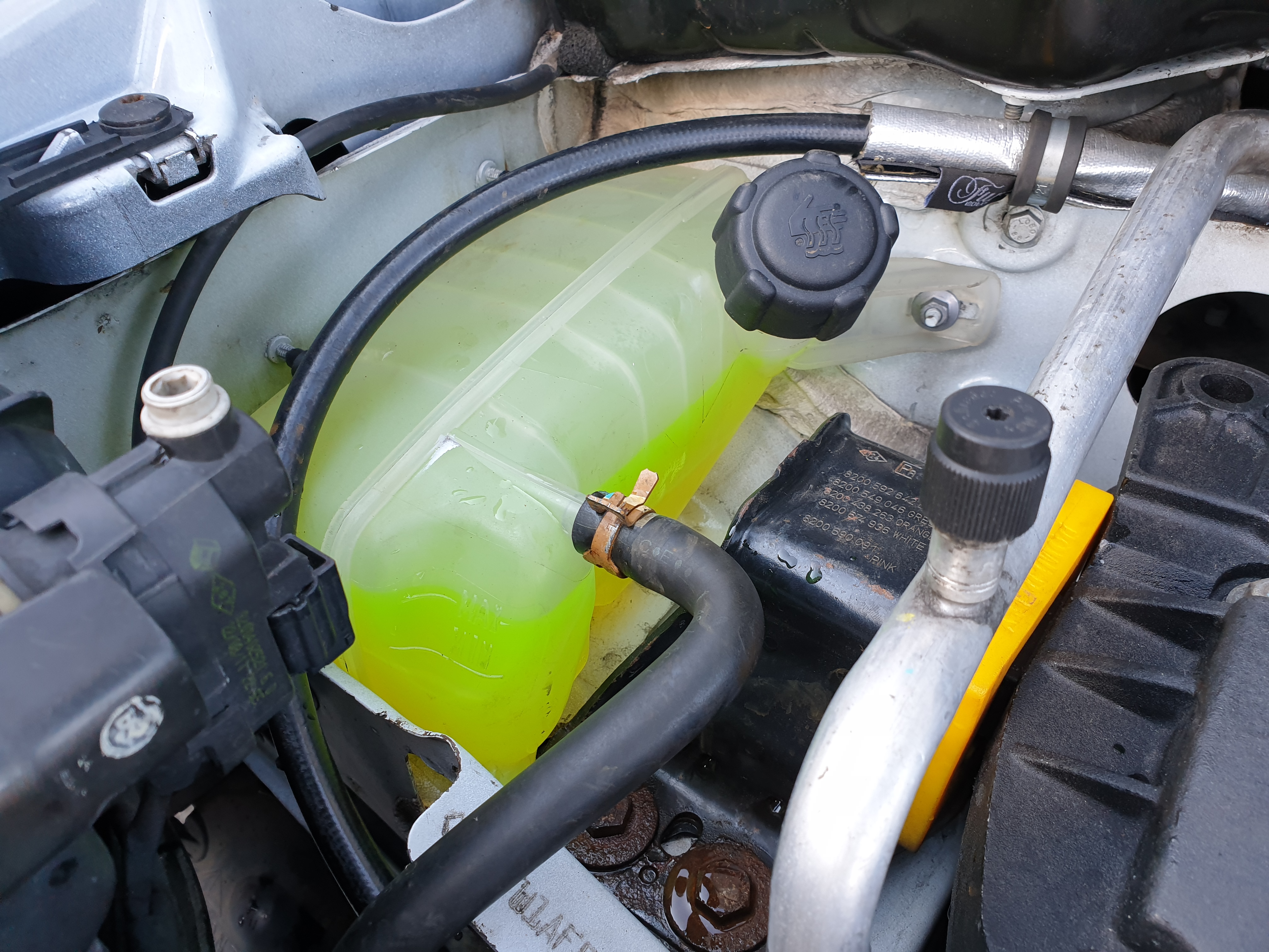

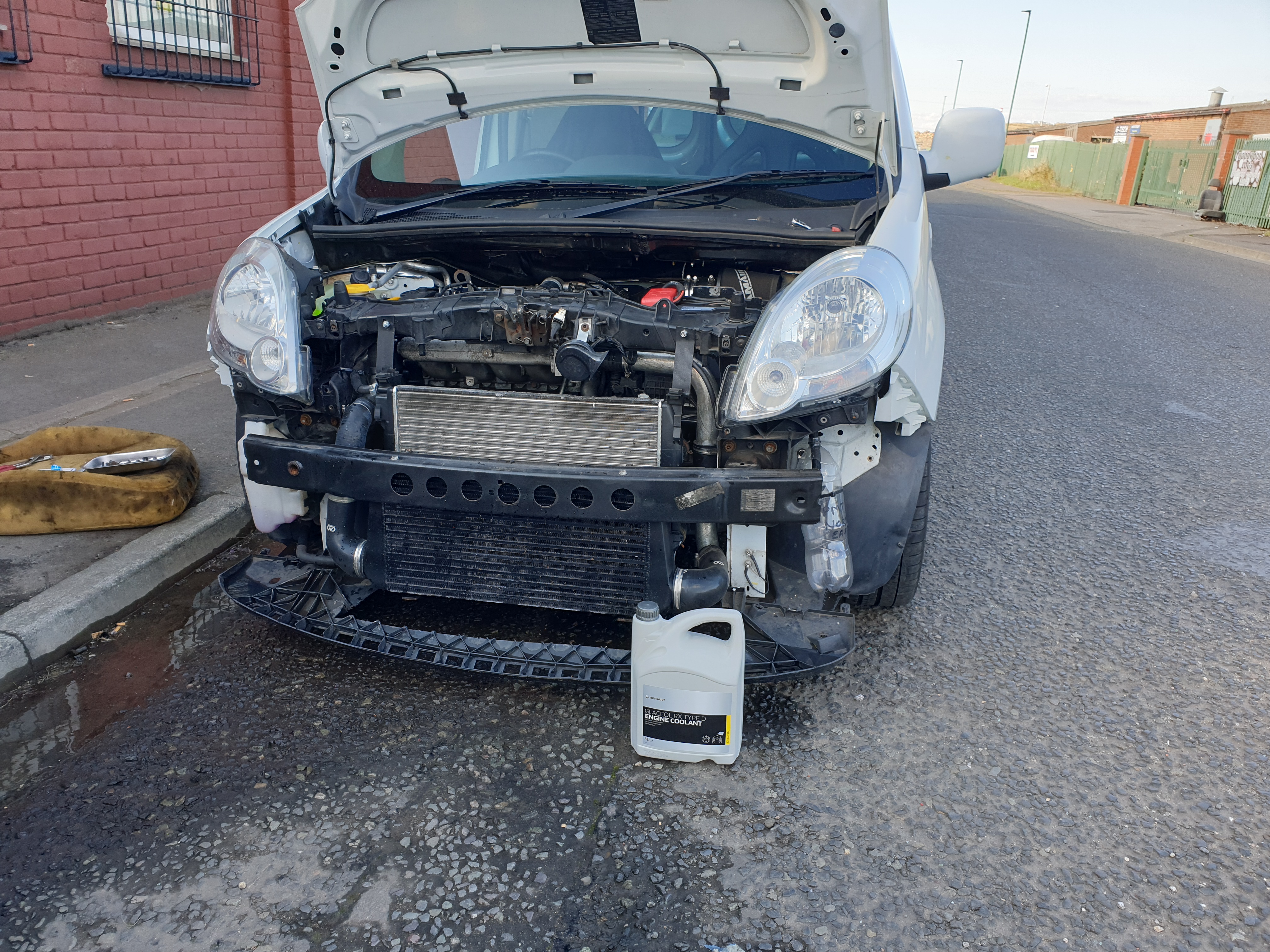

Had a little bit of sediment in the cooling system from where the engine had been ran on water by previous owner. Done a mega flush with a hosepipe 20 mins or so each way until the water was perfectly clear.
Front end off, ten mins work. Give everything a once over and no issues to report.
Filled up with fresh type d and bled. Also fitted a good used genuine renault header tank, to replace the flimsy looking aftermarket tank.
Its had a load of heat cycles and still looks clean so job done.

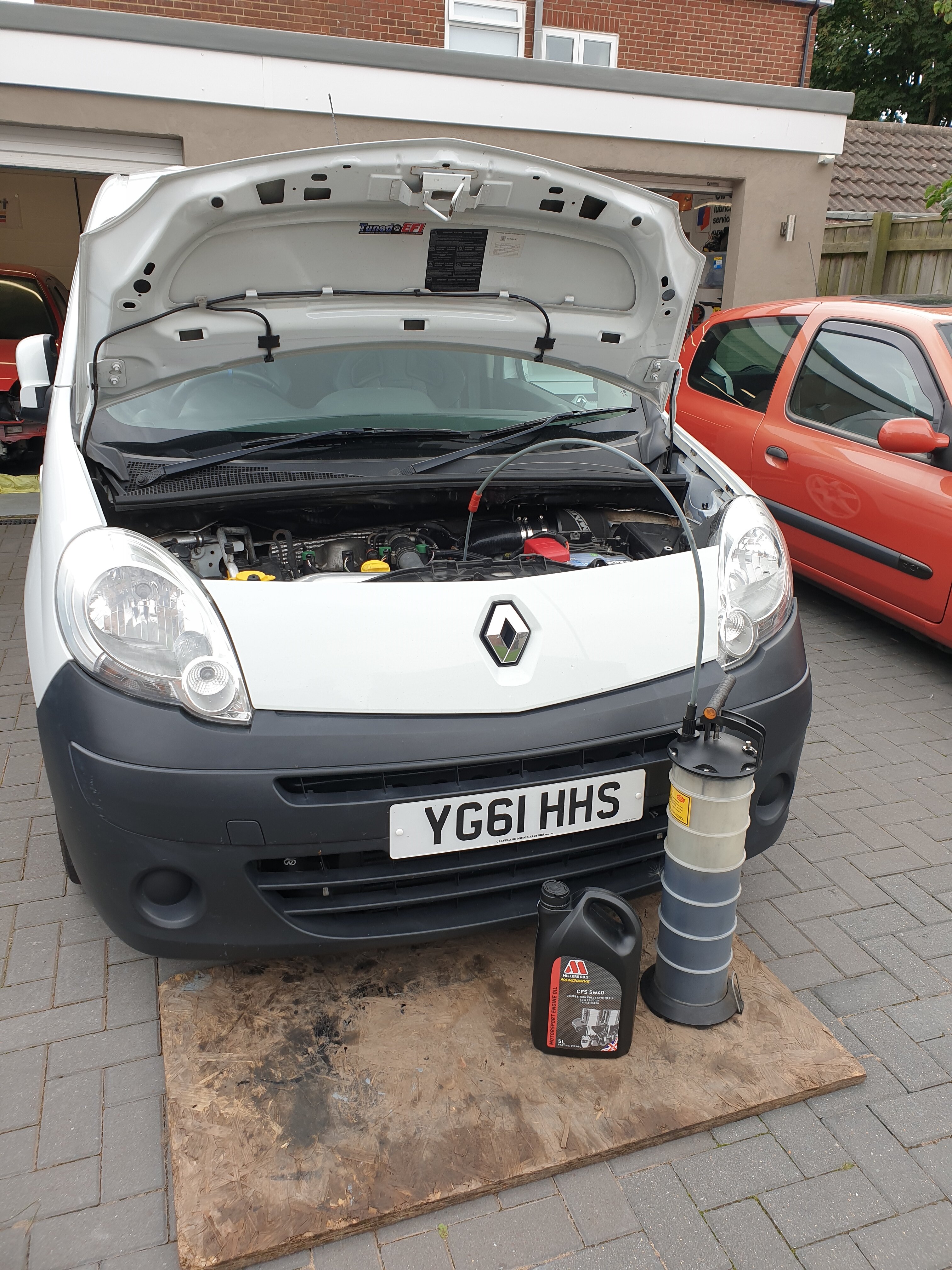

Oil change last weekend as its done a fair few miles since conversion.

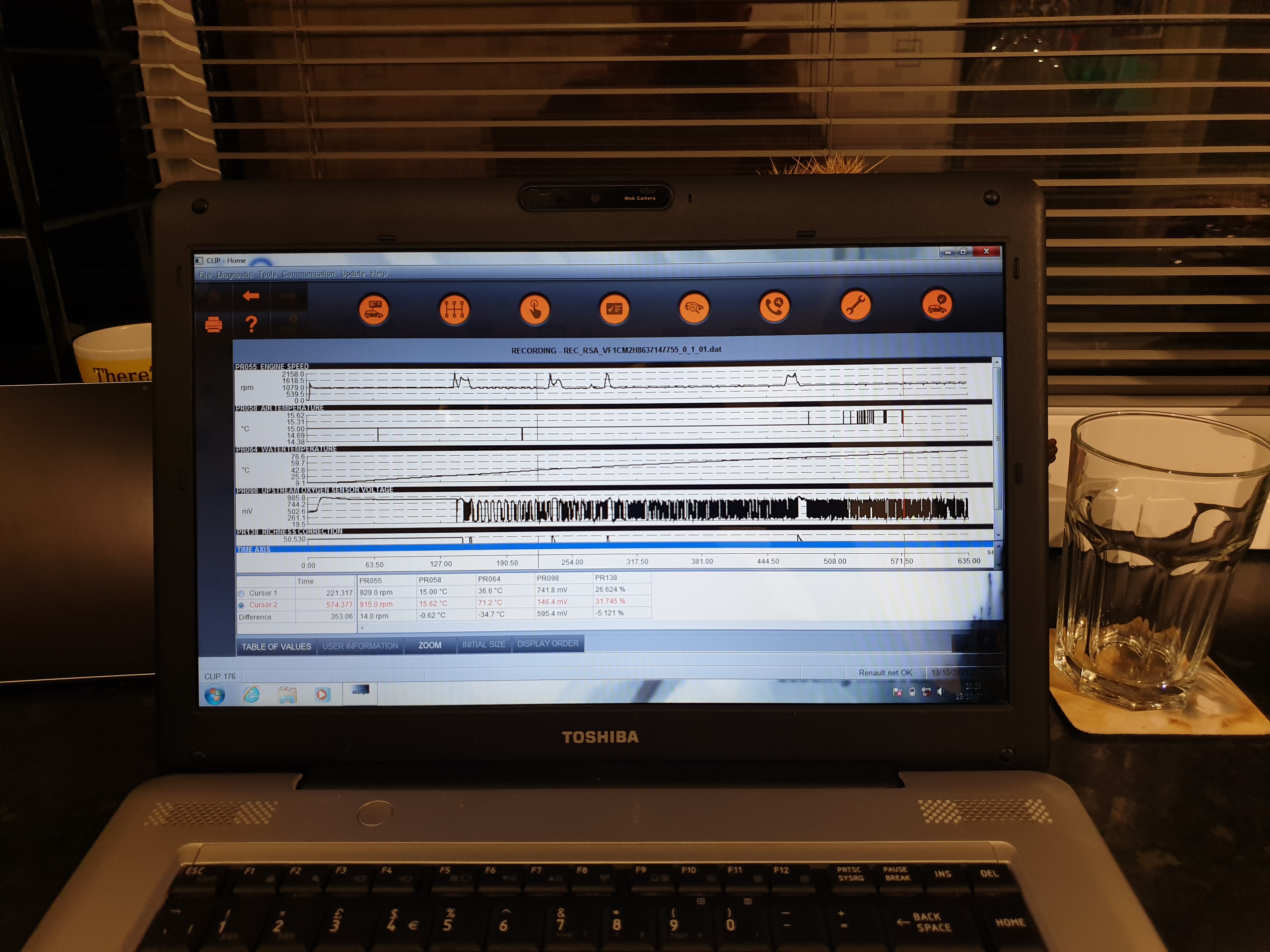

Been chasing an occasional rough start on the Kangoo. Maybe 2x in 20 cold starts it fires up then idles rough and sorts itself out when hot. Typically when its happened i have not had access to diagnostics to log the data and no codes stored.
Fired it up from cold with clip on to log the sensor inputs, typically ran fine.
Upstream lambda looks a bit lazy so have got one on order, also air temp is giving the occasional erratic reading so have replaced that for new oem renault.

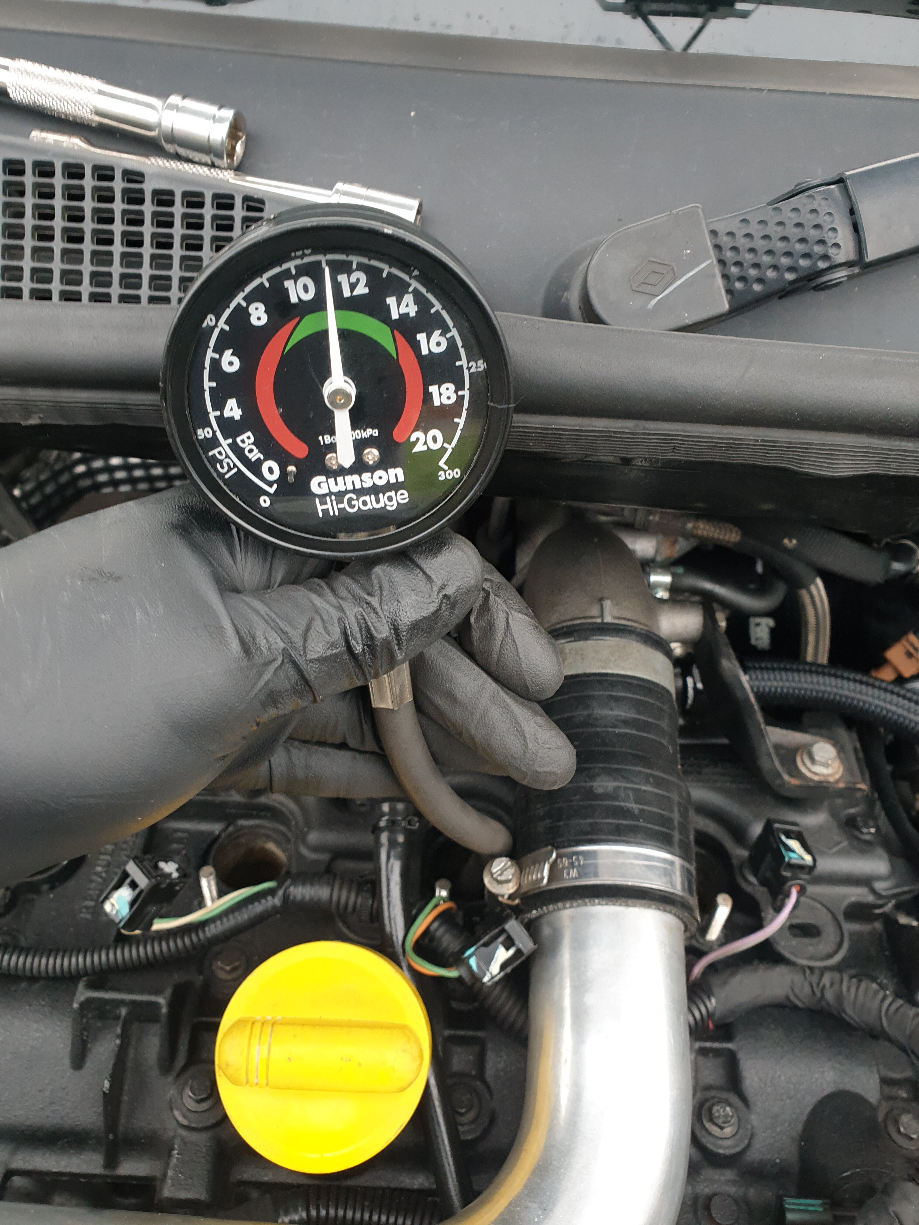

Done a compression test to check the engine health as from reckoning up its done 25-30k miles. All 4 cylinders 160psi so nothing to.worry about in that respect.

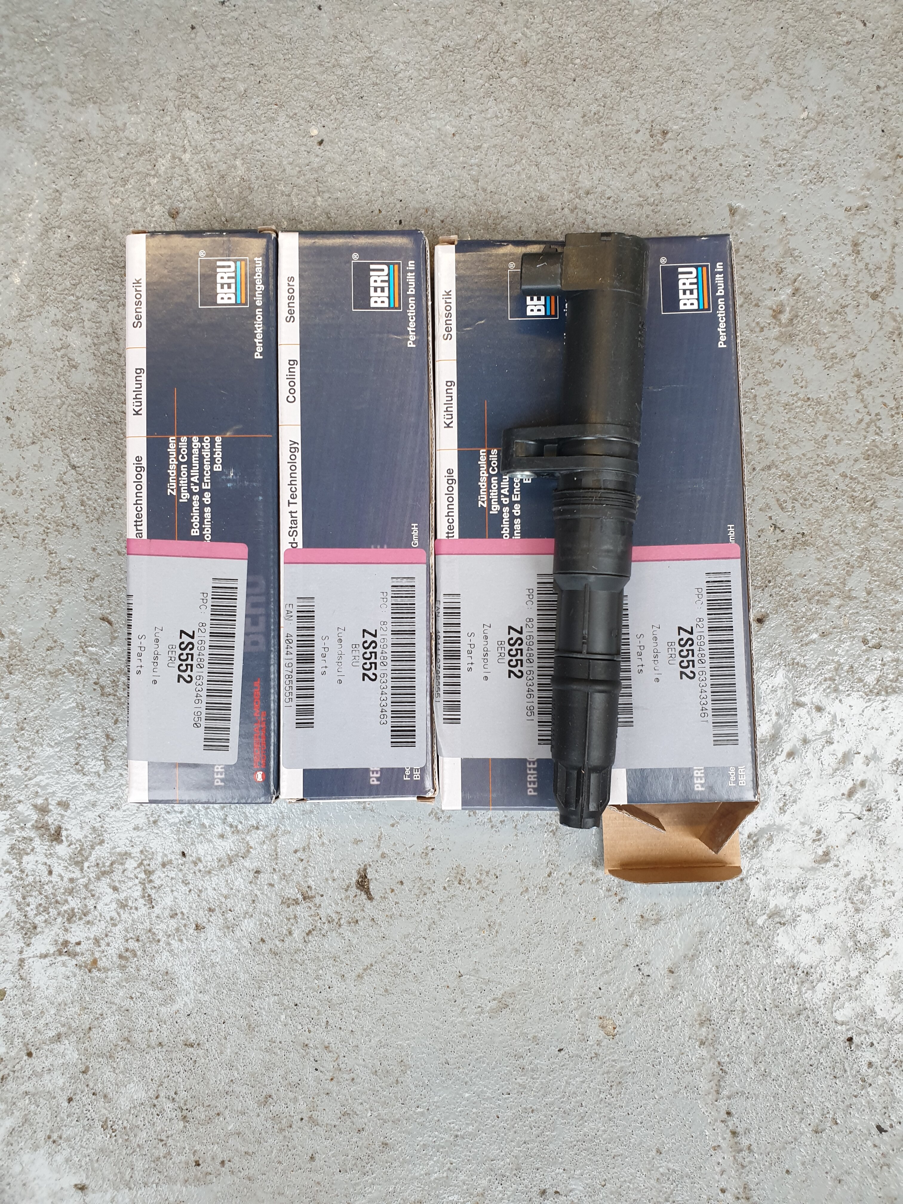

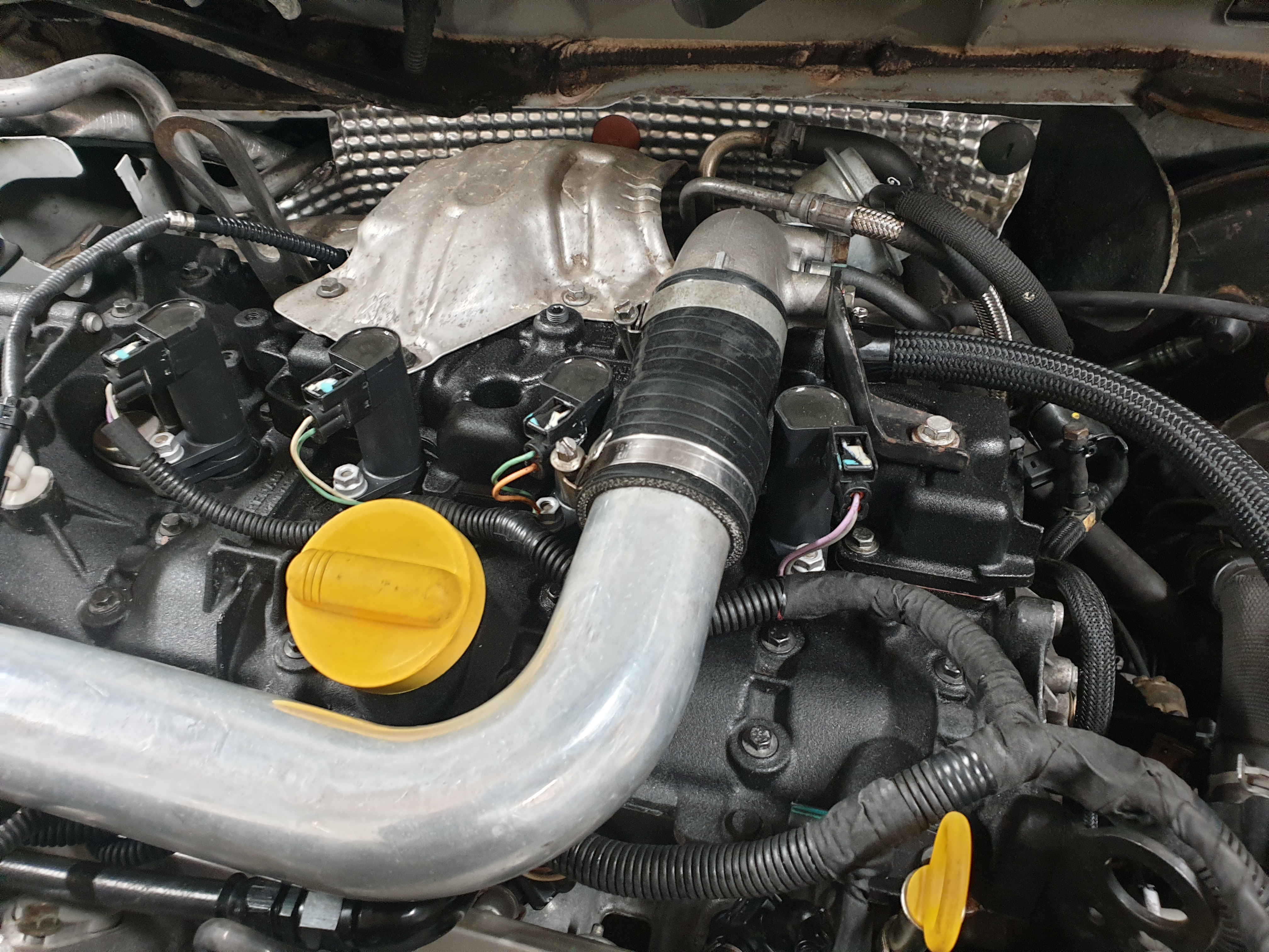

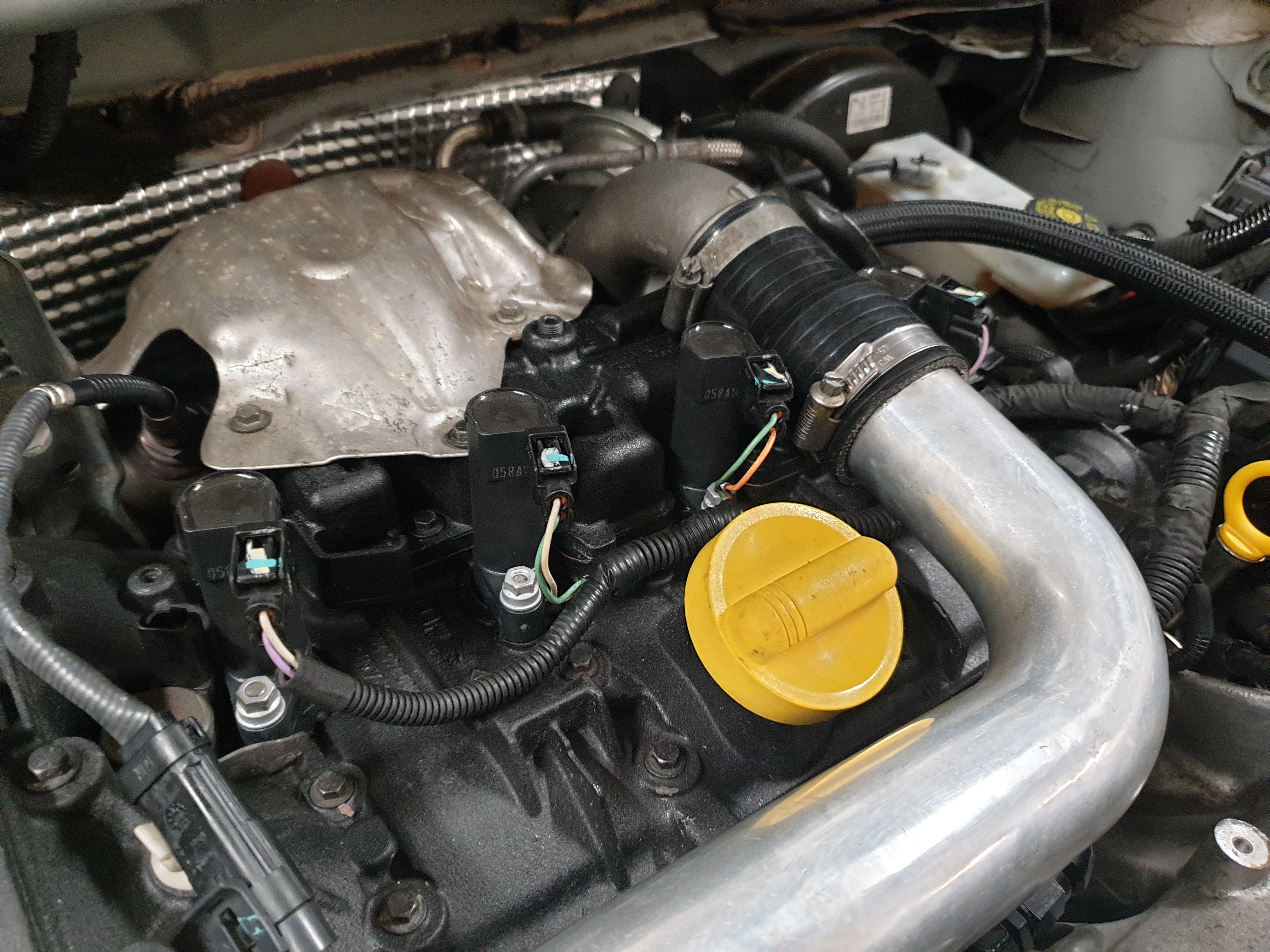

My new beru pencil coils arrived from Autodoc the other day so fitted them. Identical to oem Renault, without the price tag. £15 each compared to £55 each.
Started up and idles great with the new coils in. Just waiting for lambda sensor to arrive and hopefully thats it all sorted.

Well worth doing the ign parts cost nowt from autodoc.

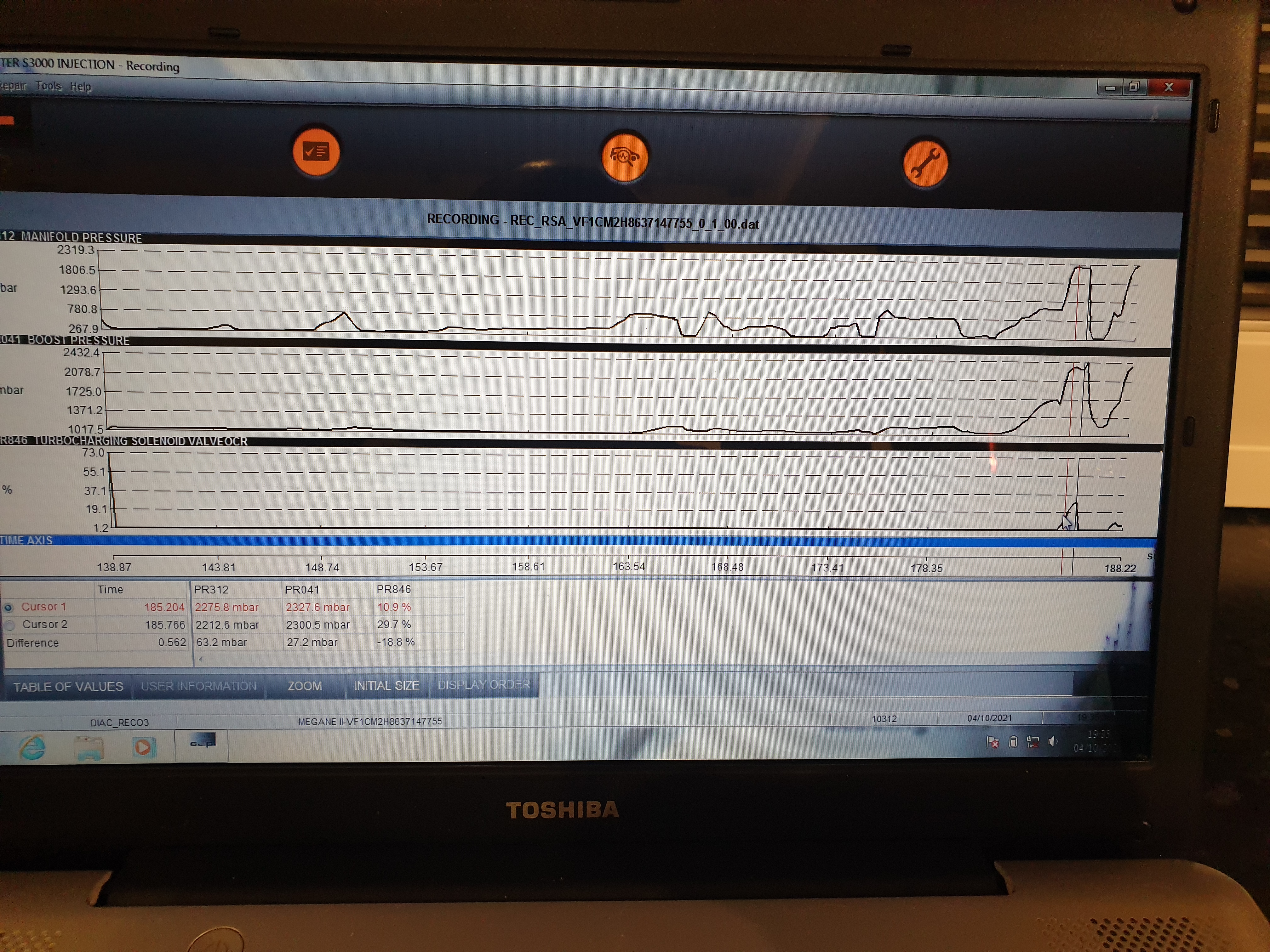

In other news ive been chasing what i thought was a boost leak for the last few weeks.
Just before Trax i noted that it did not feel as lively as just after mapping, it still went well enough and would still light the tyres up on boost in 2nd gear easily though. No warning lights or nothing.
Stuck torque on the obd for a quick and dirty check of what boost pressure the map sensor was reading - boost was quite low, spiking for a split second to around 1.3bar then straight down to 1.1bar. Almost wastegate pressure, when mapped it was set up for around 1.5/1.6bar.
Hooked up clip and done some logging to confirm torque was not telling lies.

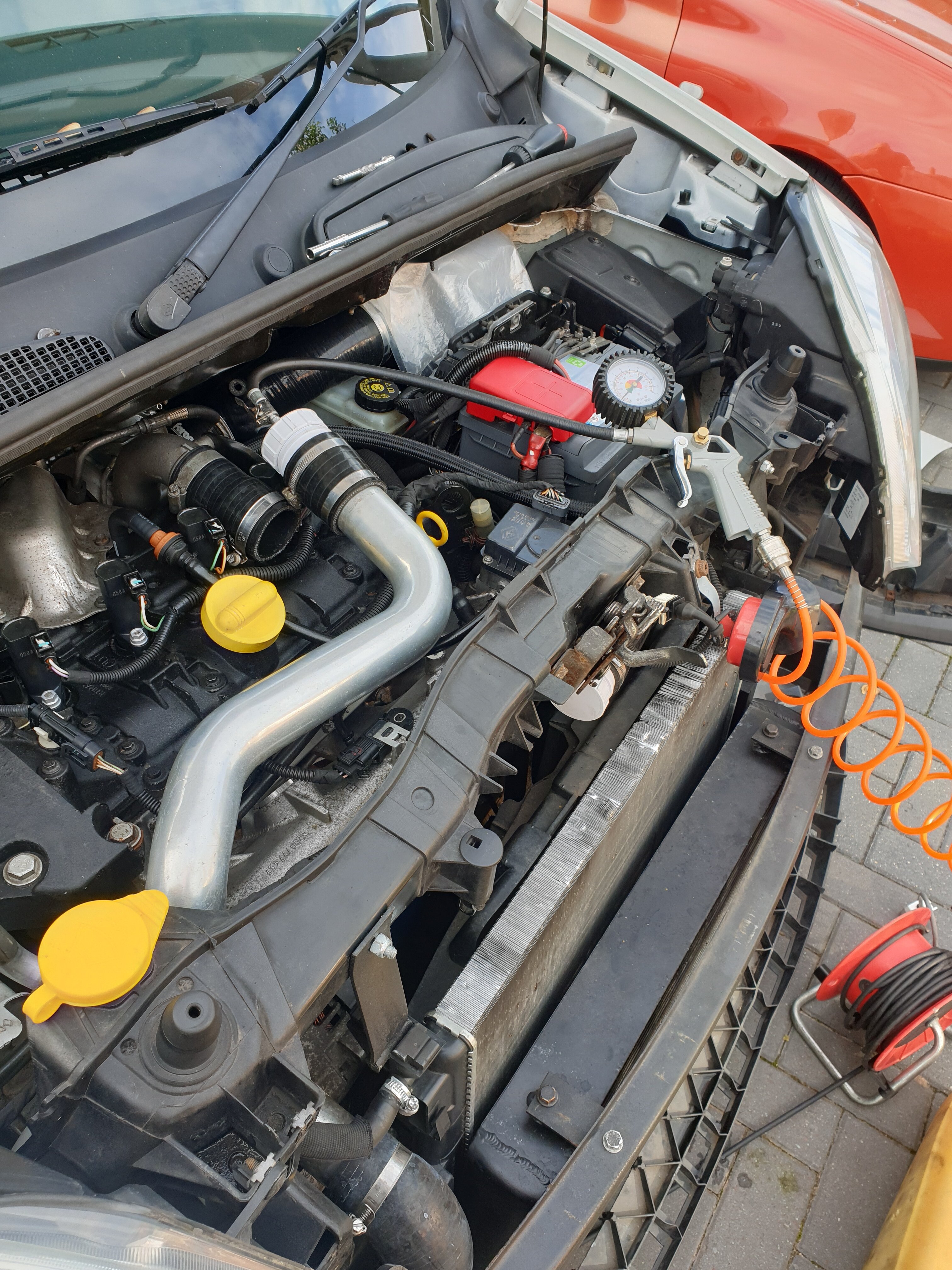

Next step was to pressure up the boost circuit to check for leaks. Had it to around 2bar pressure and leak tested the inlet. No leaks, so comp tested it as above and all good.
I had a feeling this was n75 related or actuator. I run a 250 green dot actuator which are fairly strong but never say never i guess.
I had a new gen ren n75 in stock as bought it just incase before mapping. Fitted it and took it for a test run, straight up to 1.5bar and back to a handful on boost.

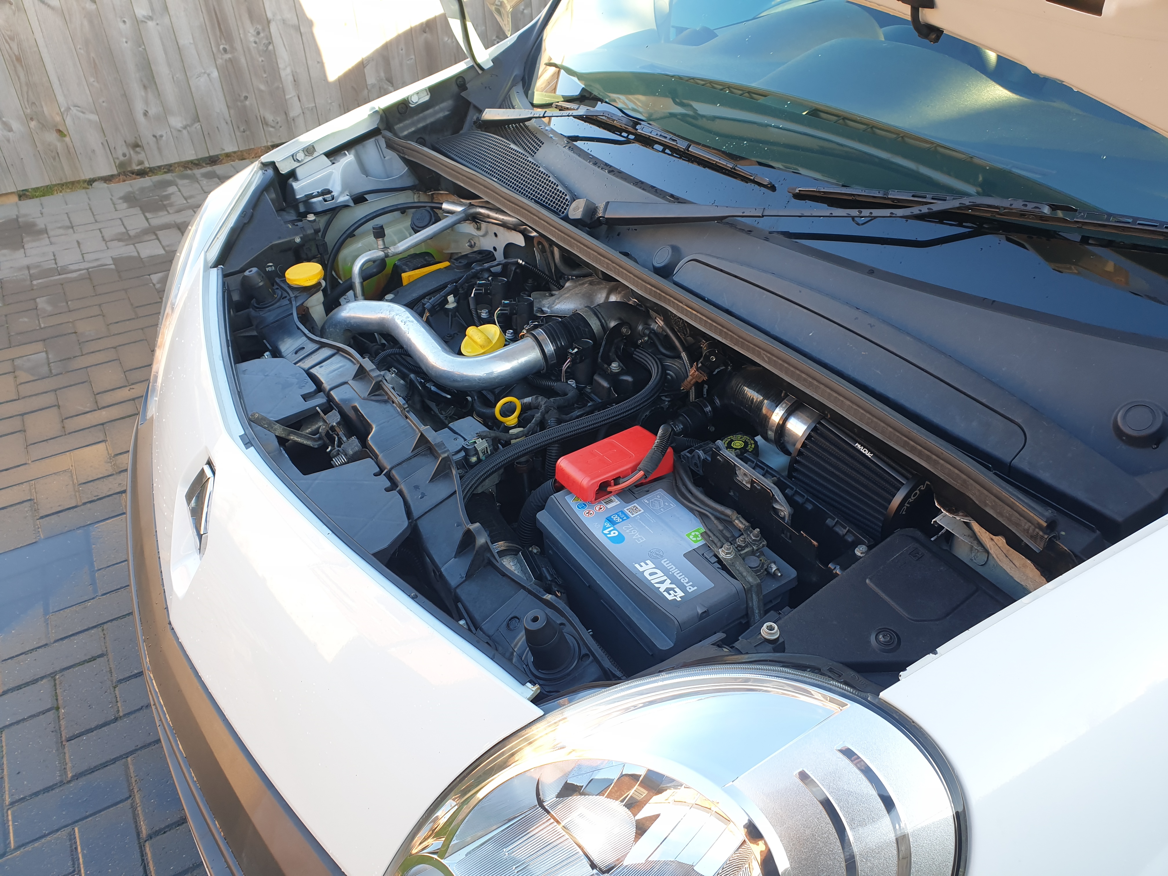

Breather plate was leaking oil as the sealant had failed (as per most f4r) so took the opportunity to fit the correct meg 250 larger volume breather plate compared to the r26 one i fitted previously.
Its knacker tight to fit with turbo on but just managed to slide it in on an angle. Used a gasket instead of sealant this time, see how that fairs.
Also took the opportunity to remove the pcv valve that goes the breather plate, removed the pipe and fitted an 1/8 npt grubscrew and bunged the hole on the inlet with a samco end cap. Thats the last of the emissions crap gone.

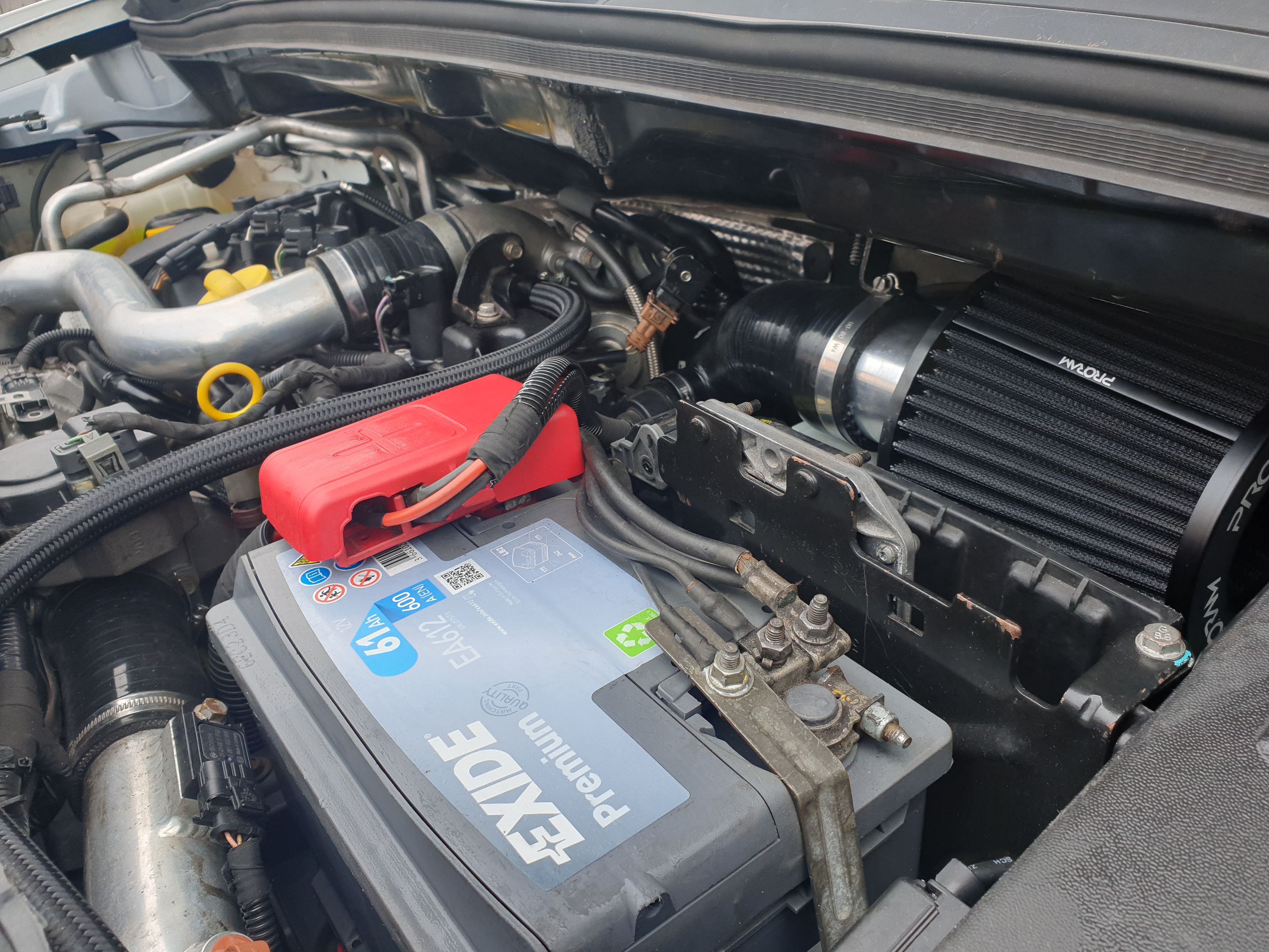

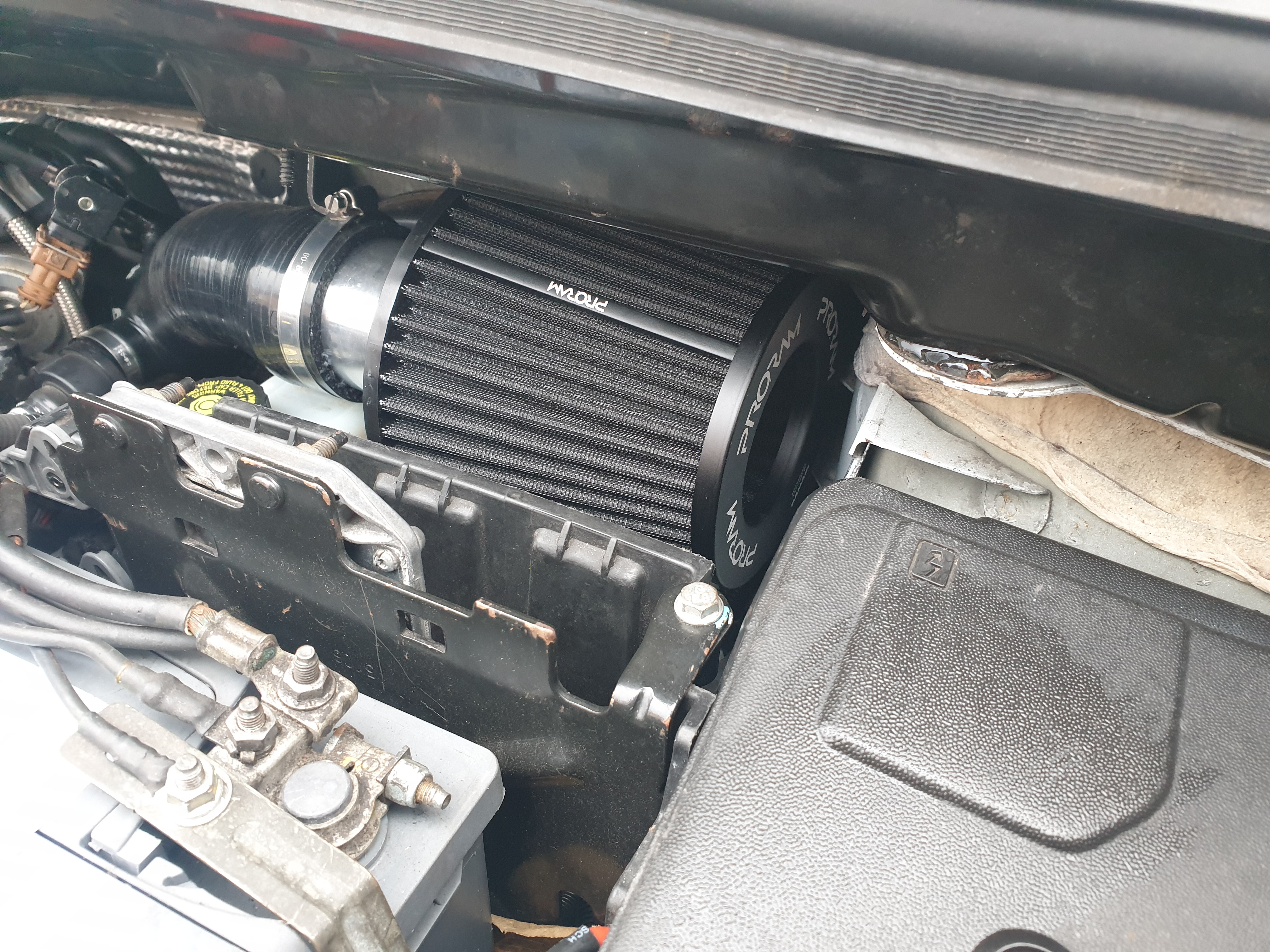

Fitted a new Ramair proram airfilter. I had a foam one fitted previously, but not too keen on them now as seen a couple fail and damage turbos.

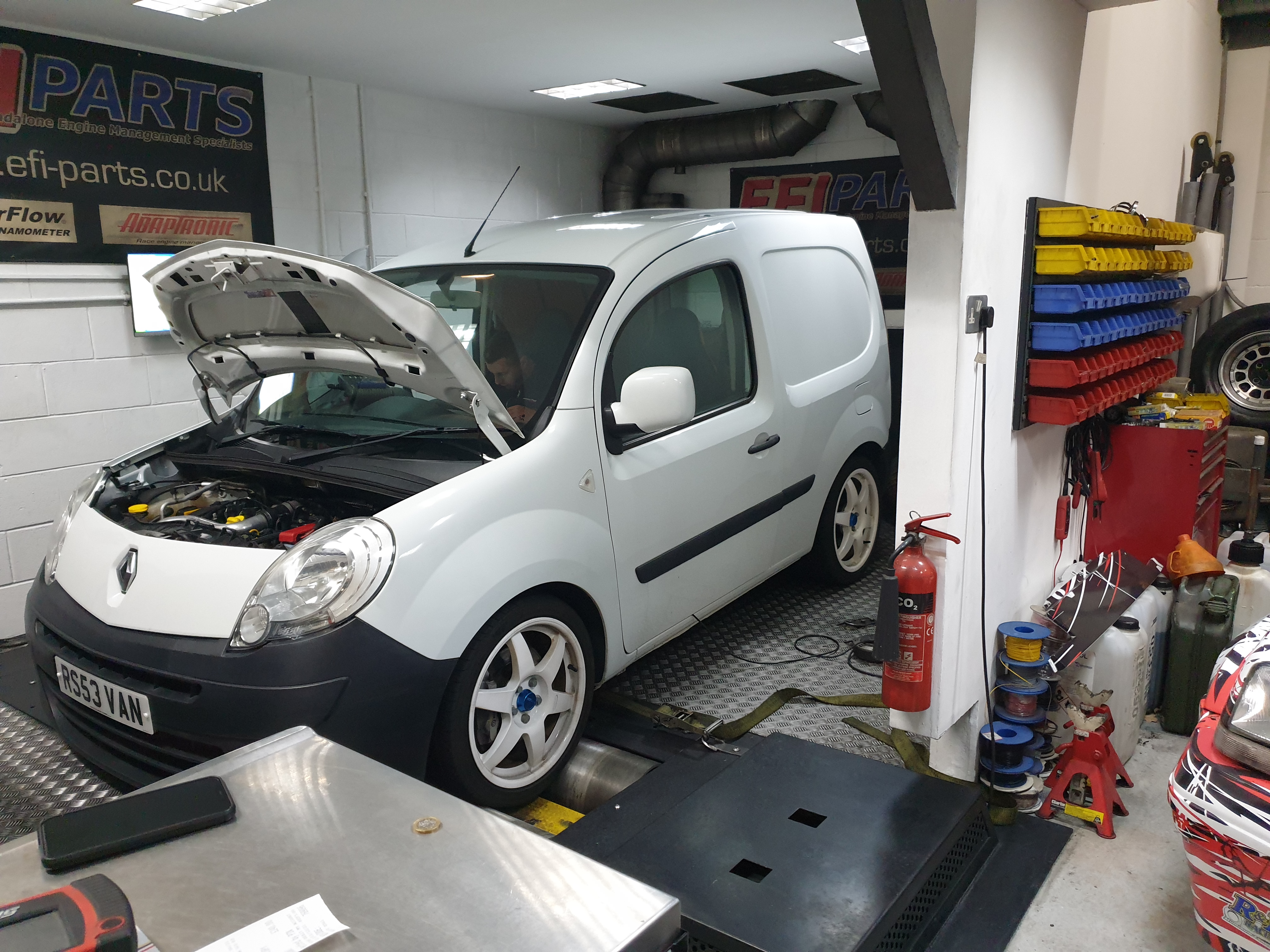

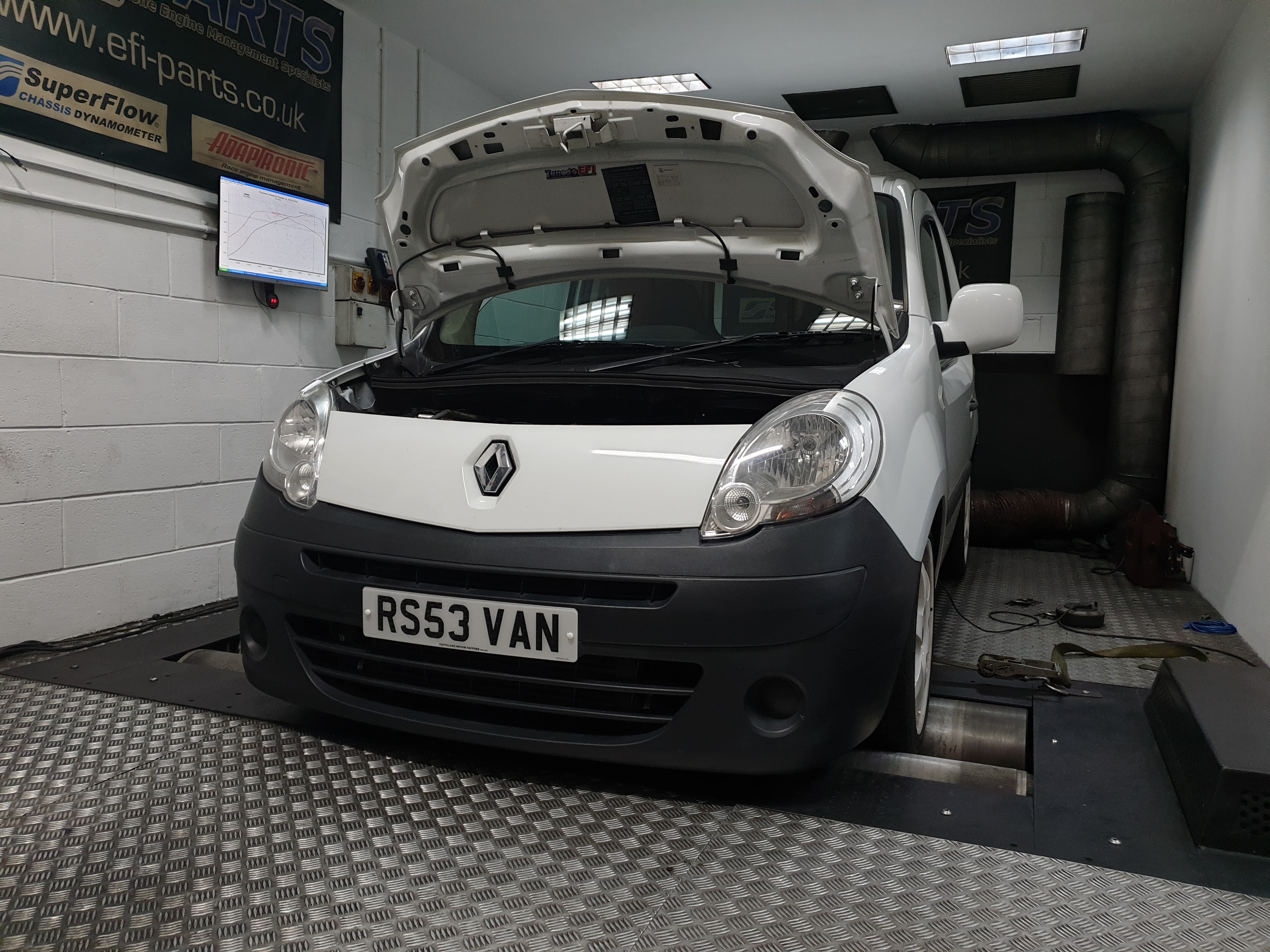

Had the Kangoo in for a map tweak at EfiParts, as changed a few bits since last map, new clutch, new oem n75 valve, air filter etc.
The short story is - clutch basically failed straight after mapping earlier this year, it was slipping on the last power runs and once fixed with uprated clutch it was quick for a short period of time then boost dropped a bit. Que fault finding and replacing a load of bits (Renault life?!) New n75 valve got the boost back up and felt quick on the road again but didnt really log boost.

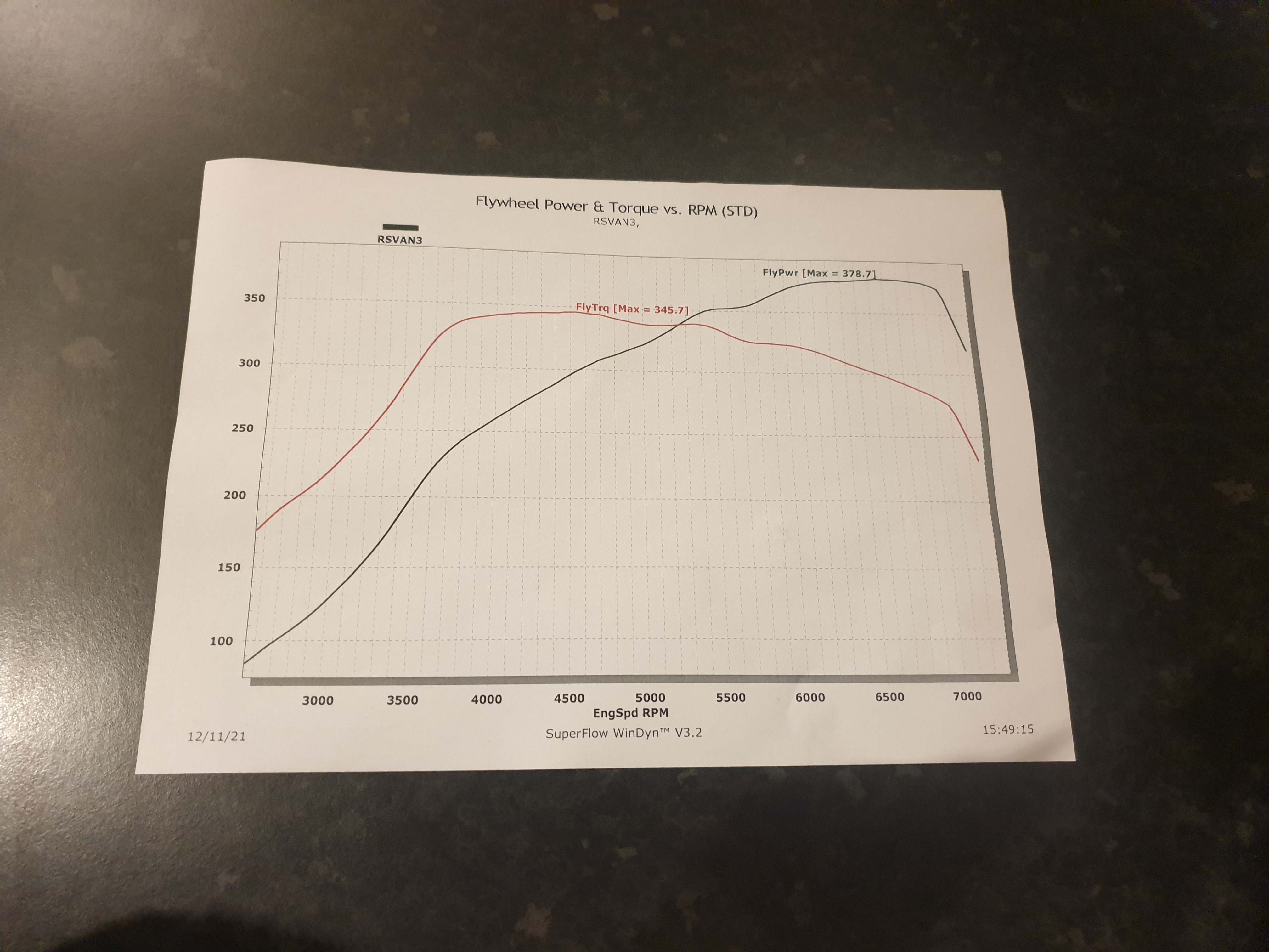

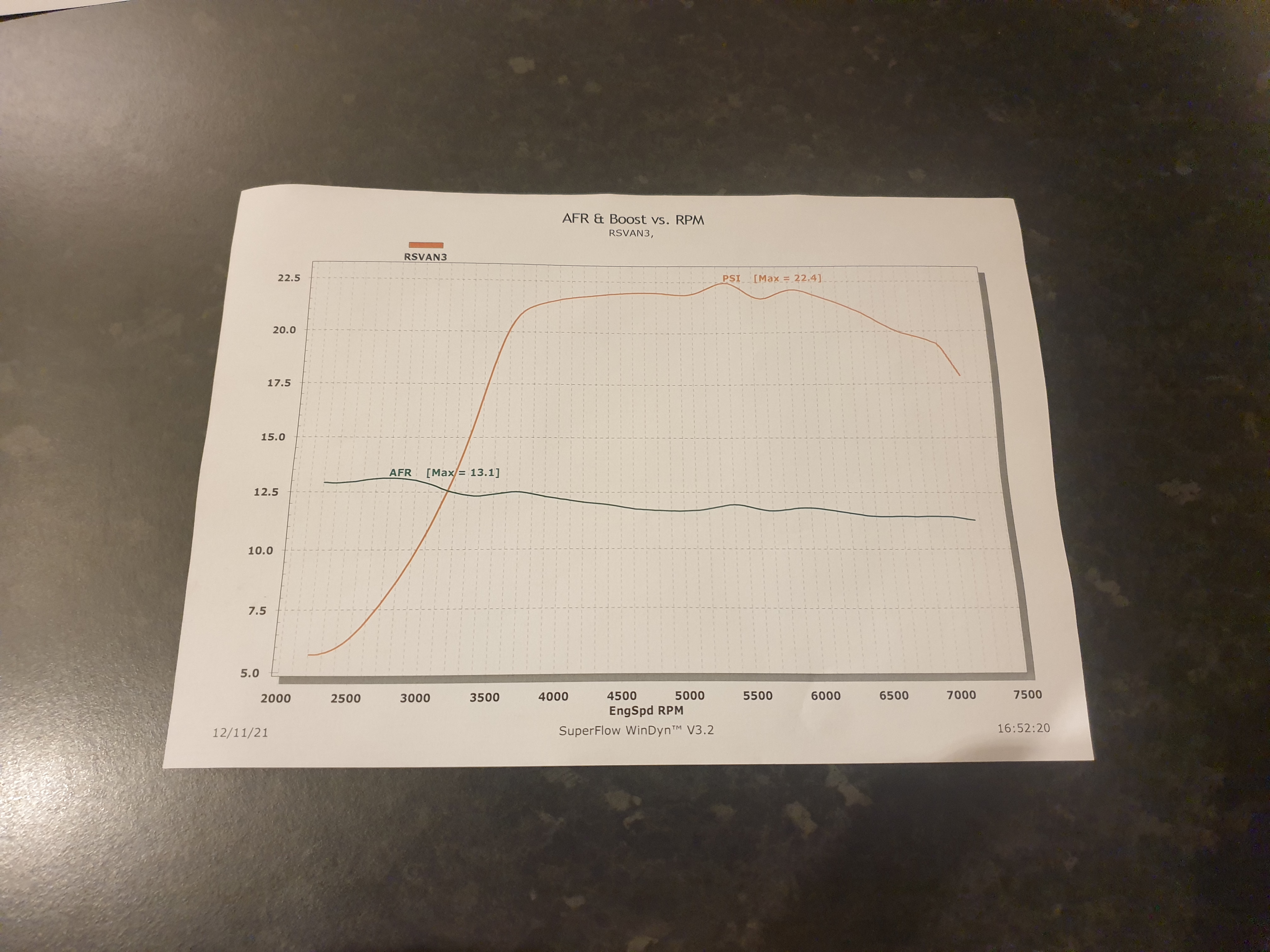

Strapped on the dyno and first run was 335hp ish hp, down on power from last time due to lower boost pressure. Looks like the n75 valves can differ a lot from new, which might not cause too much bother on stock power but quite a difference on a mapped setup with raised boost.
A few more runs and more n75 duty was dialled back in to raise the boost pressure back up to around 22psi resulting in 378hp & 345ft/lb.
Feels mega quick again, and loads smoother power delivery which helps with traction. Great job from Chris as usual, it feels loads better to drive now.

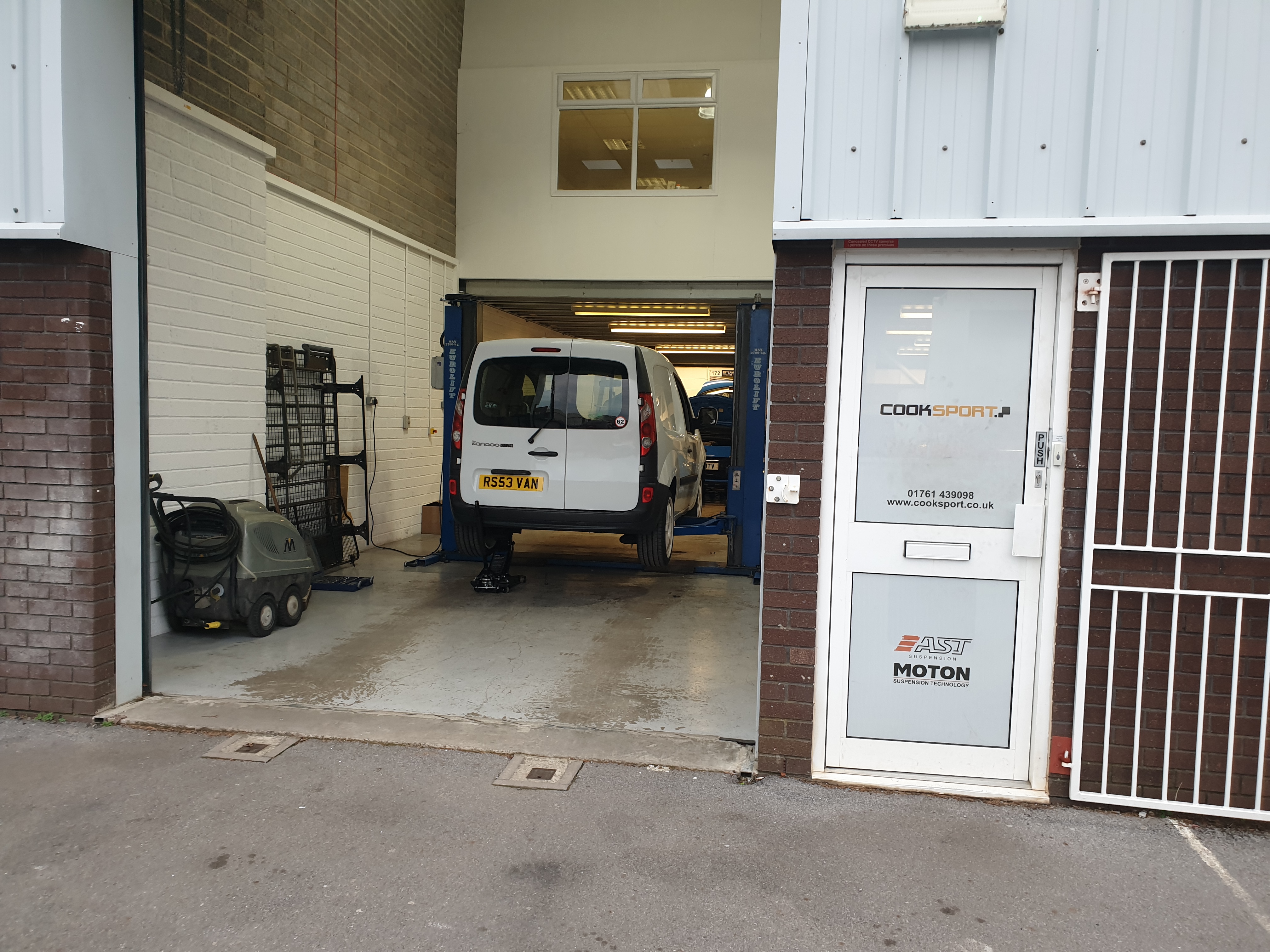

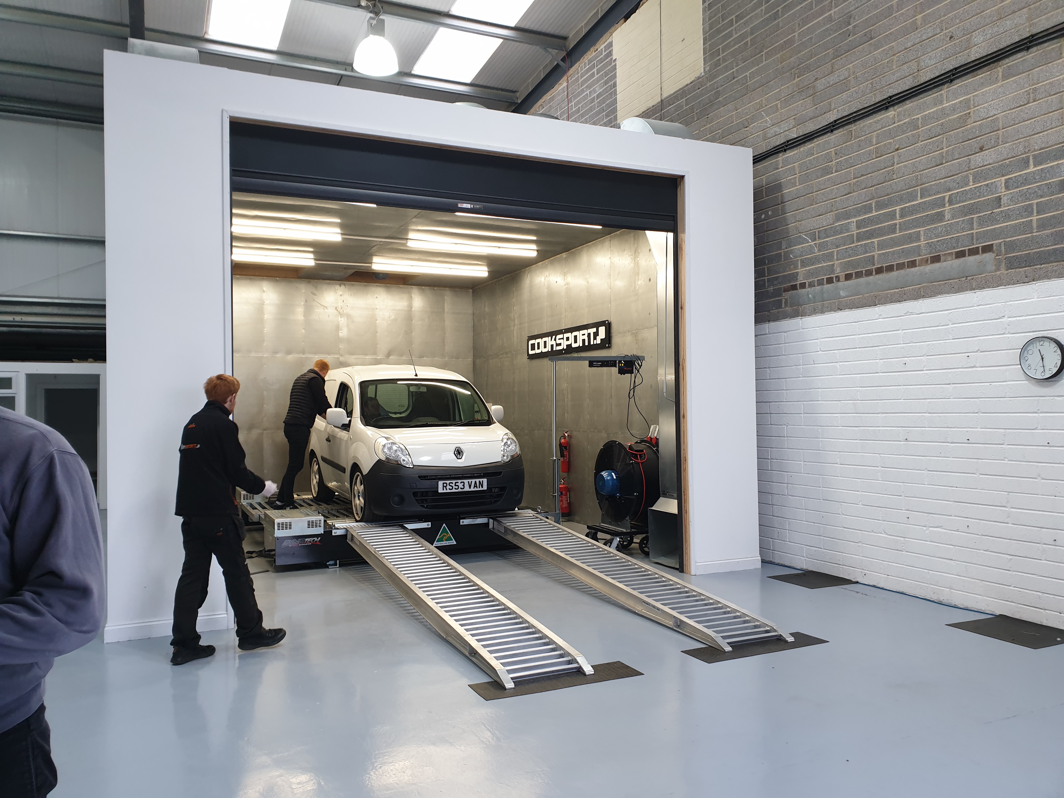

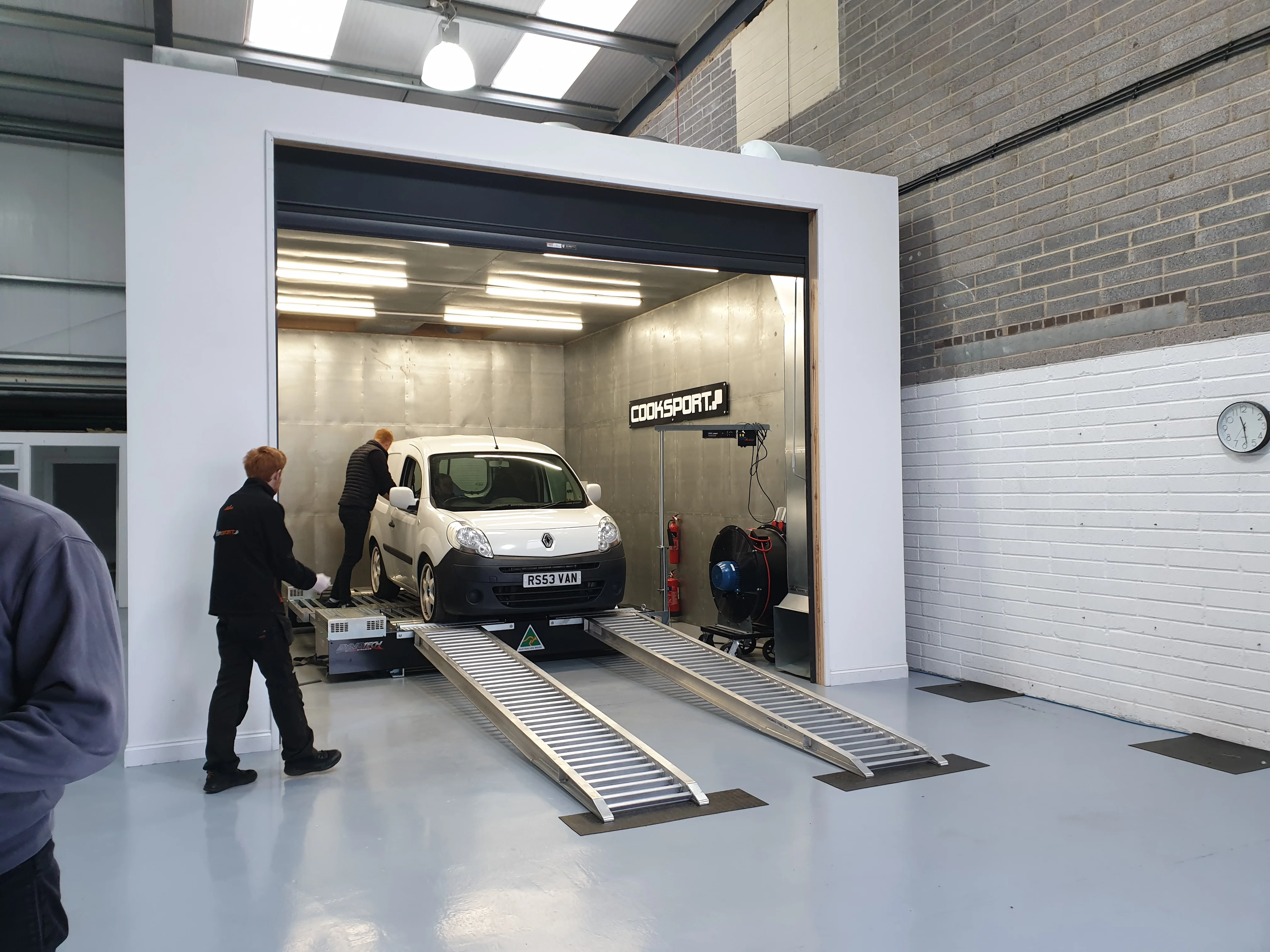

Just before xmas i took it to Cooksport for a rolling road day/catch up with a few good friends. It was a long journey approx 600 mile round trip but no issues at all.
Had a run on the rollers whilst there

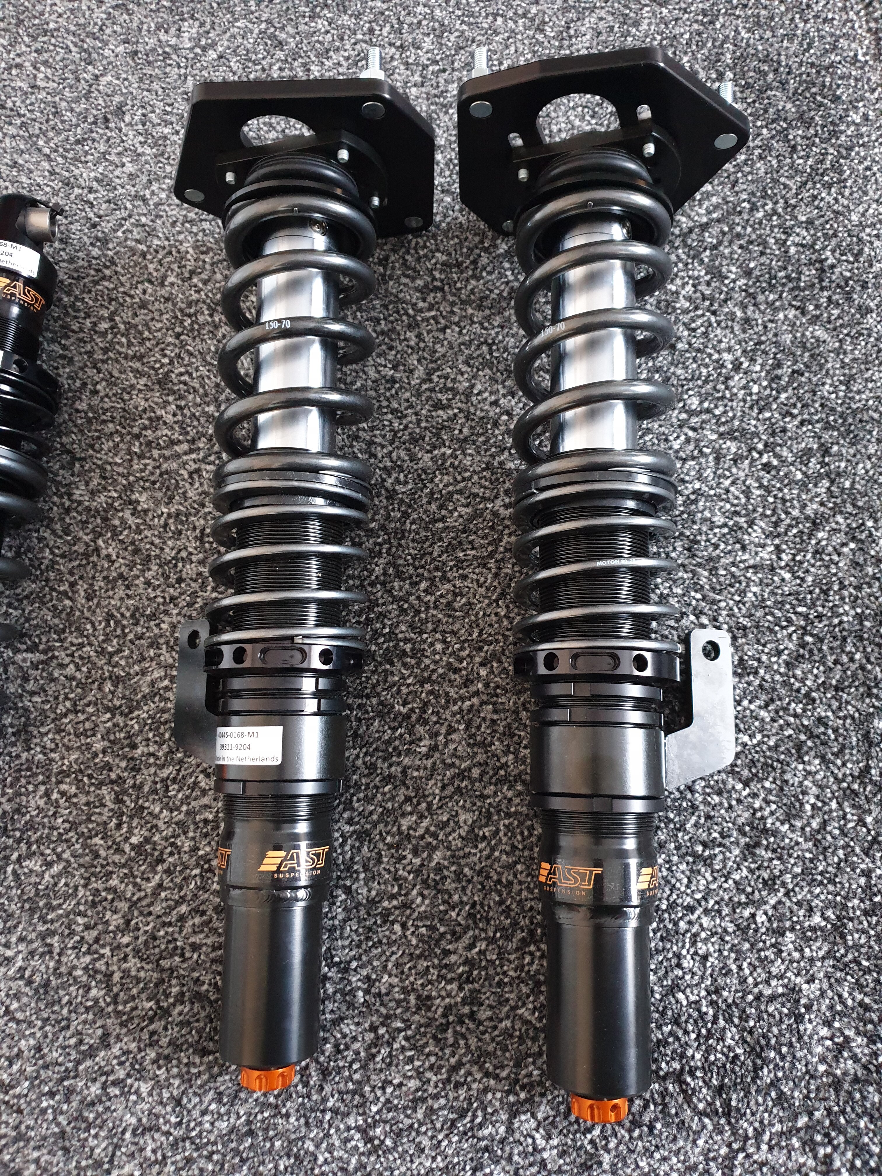

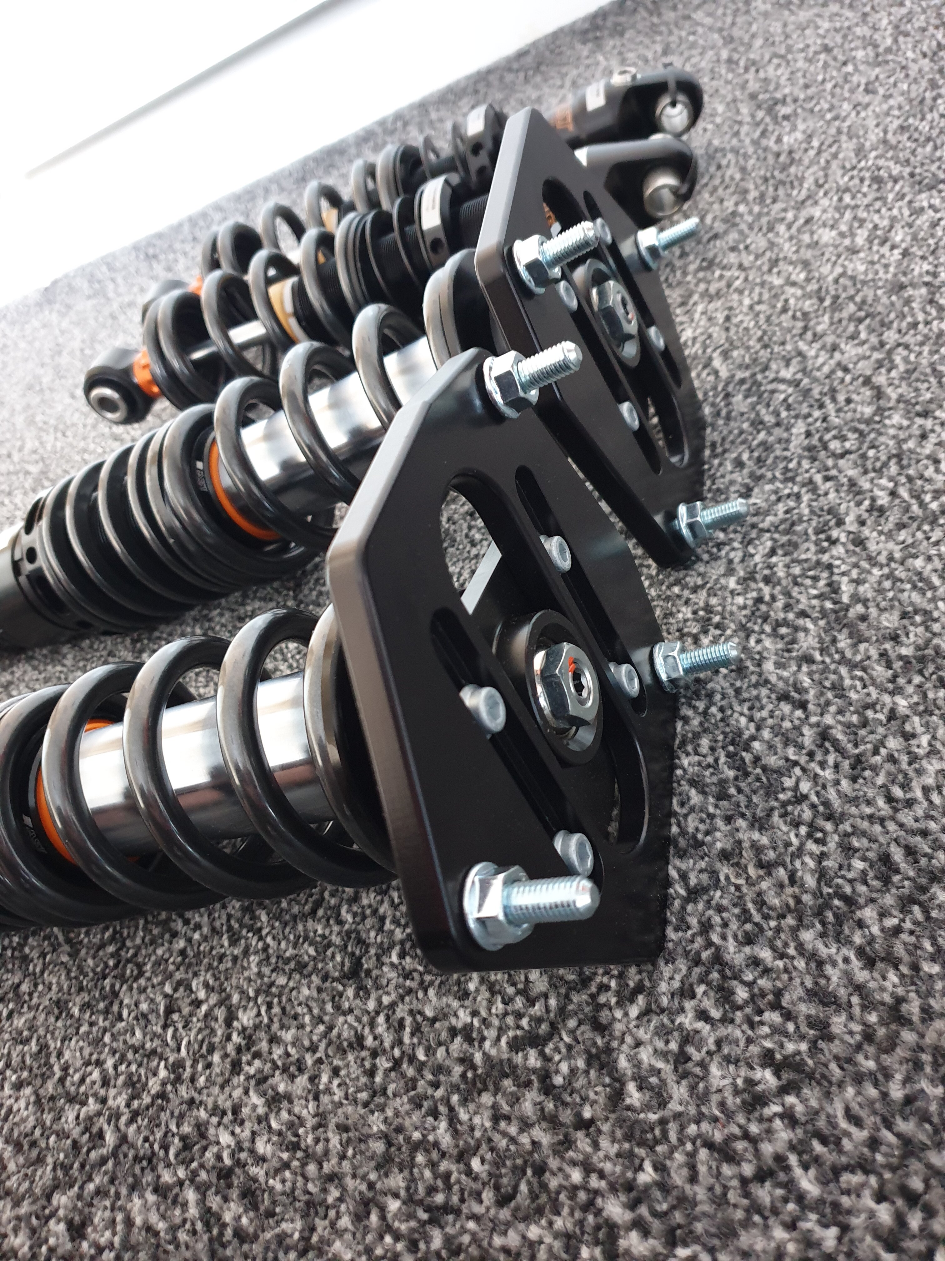

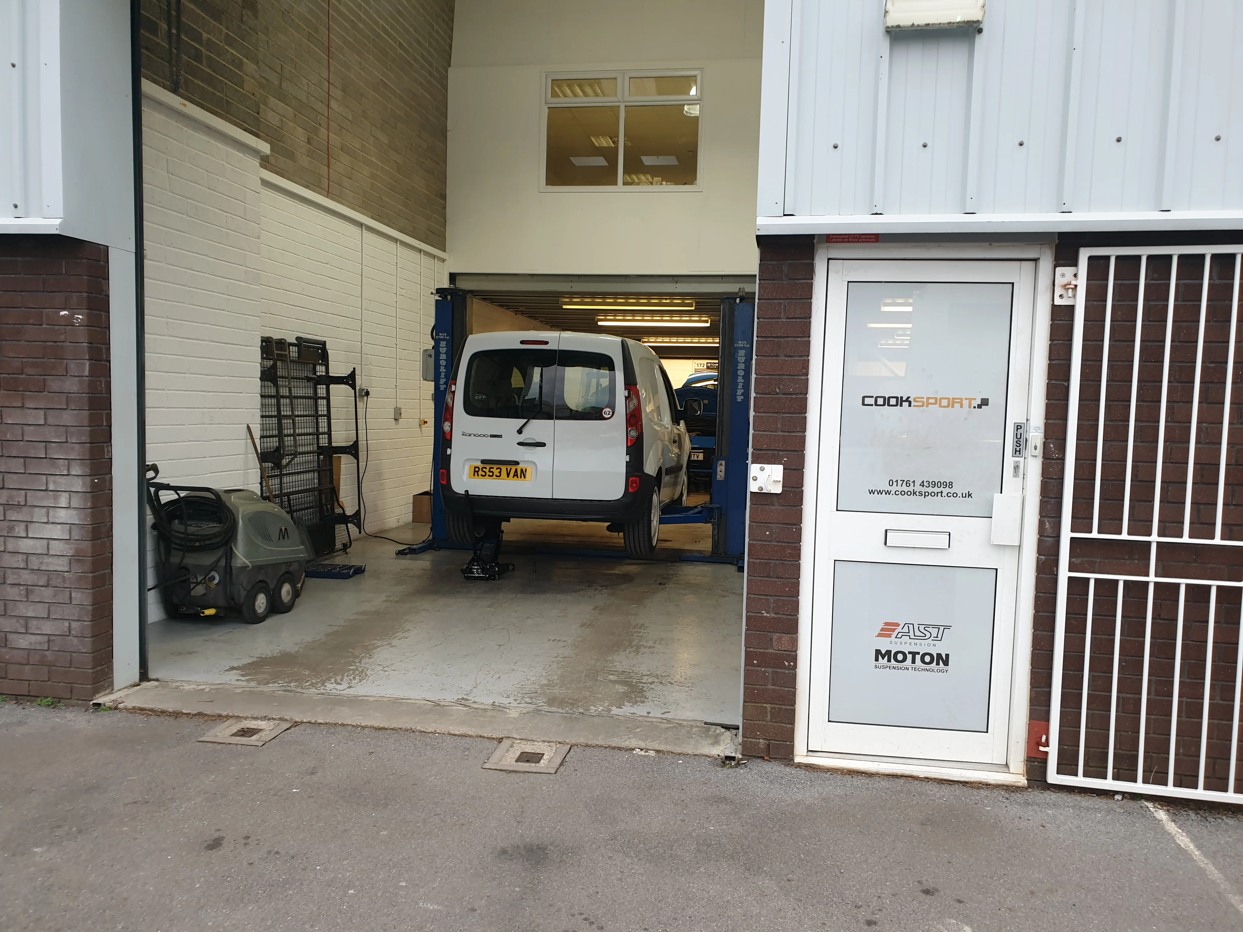

The main reason for the journey was to measure up a custom Ast rear coilover to replace the current separate spring/shocker fitted.
On the lift for measuring up.
A design was made and i put my order in, including front megane 2 rs coilovers/solid mounts. Spring rate of 70NM all round which should be decent for road use.

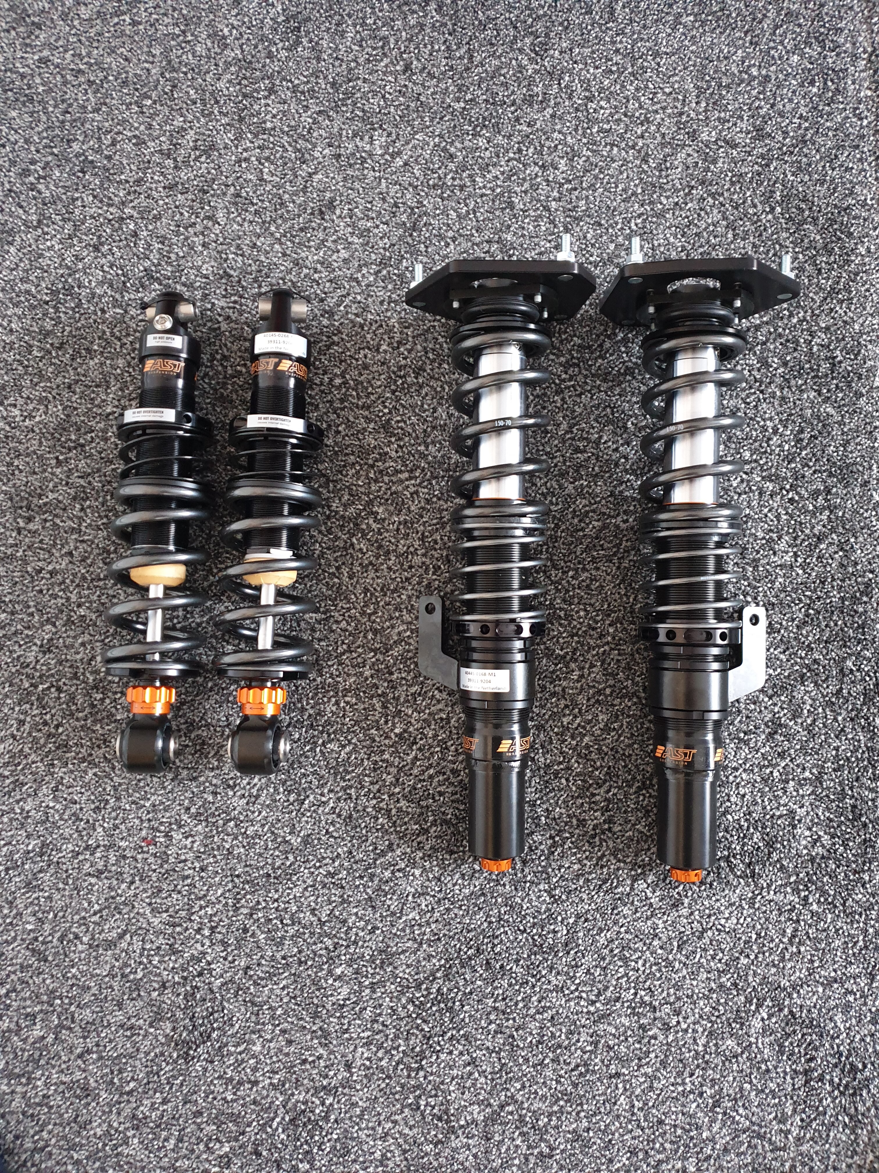

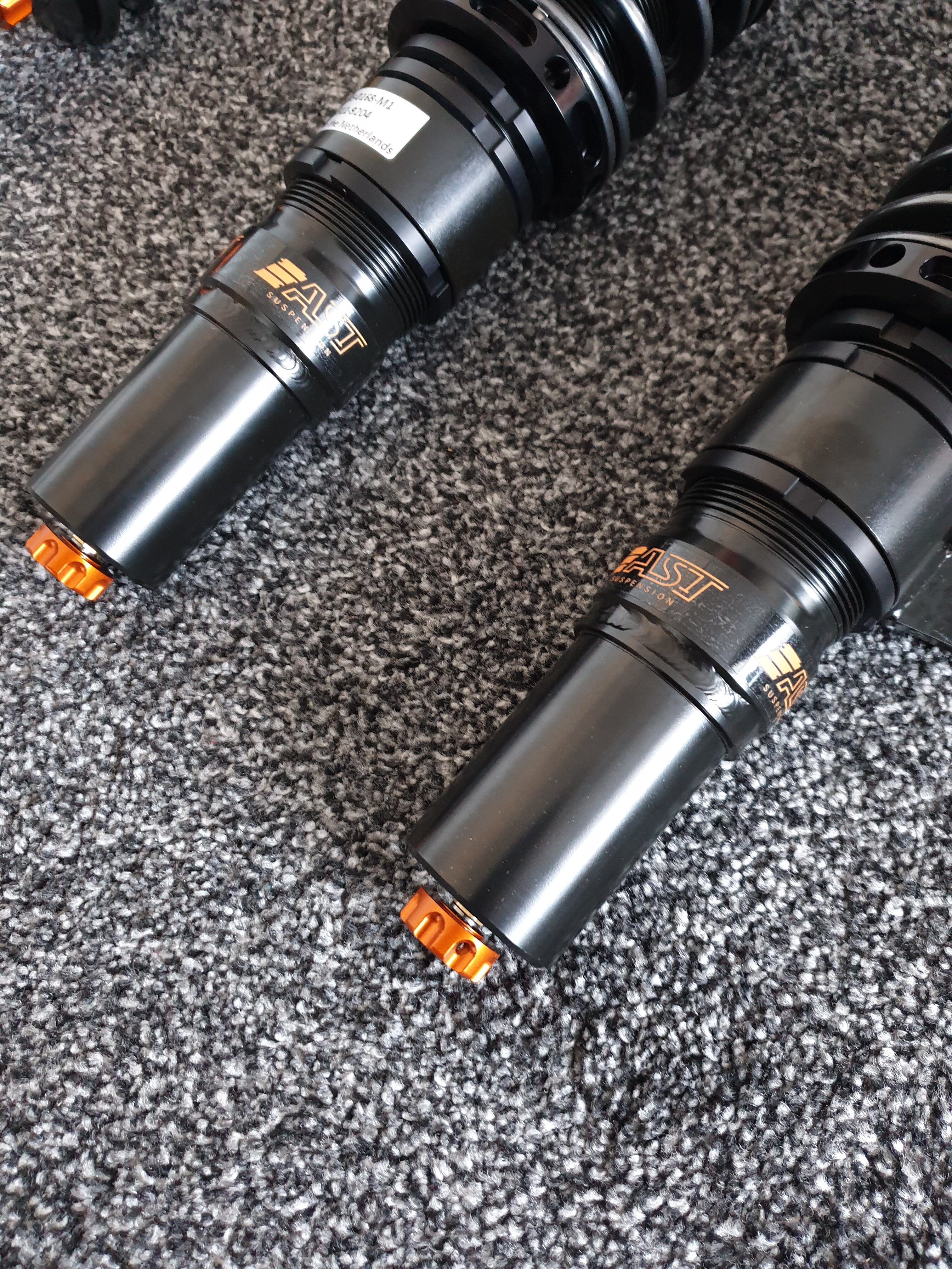

Waited patiently for them to arrive and a nice large box turned up this morning.
Quality looks fantastic. Cant wait to get them fitted and set up for some fast road/track use.

Those look epic!

Long time no update
All has been well with the Kangoo.
Had a run on the rollers whilst there View attachment 1579367
On the lift for measuring up. View attachment 1579368

Are those totally custom for you?

How does the customer coilover work? I’ve got a car where some would be ideal. Do Cooksport do all the measuring then send them off to be made? Or did you have some donor springs and shocks to use as a starter?

Cheers all. Cant wait to get them on and set up.
@Waitey the rears are custom to fit my Kangoo. Cooksport had the rear shocks off to measure it all up, discussed a few options and it was agreed best option was to do away with the inboard springs for the full coilover, to save the hassle of custom rear springs.
Its very basic eye to eye shock in reality so was just a case of them selecting the parts to build it from the Ast catalogue. The fronts are just meg2 rs legs which are plug and play.
@Big Toe Cooksport will be able to make something up to suit your needs. I was not confident enough to measure up myself so was worth the trip to get them to measure it up right. Great service all round.

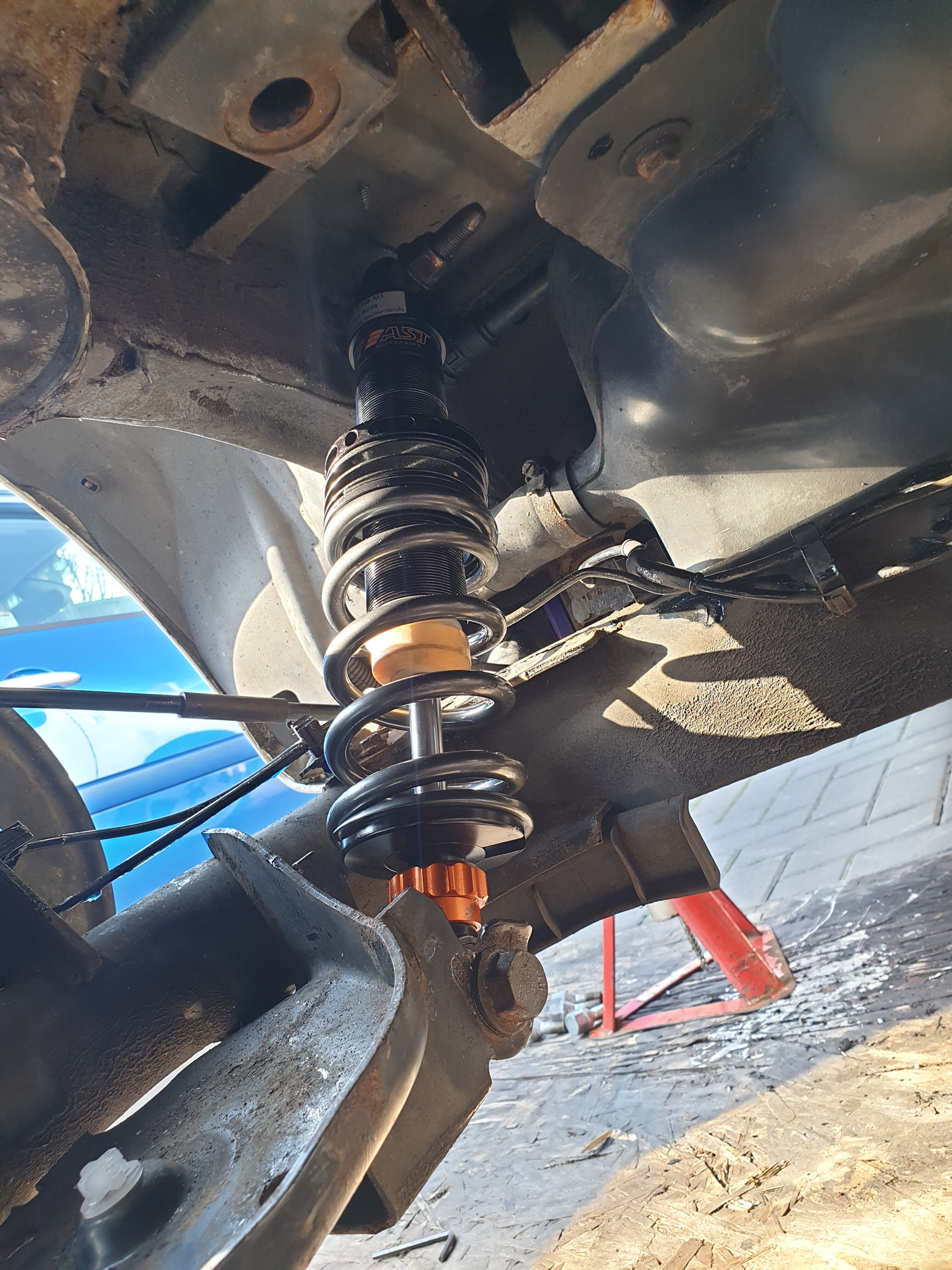

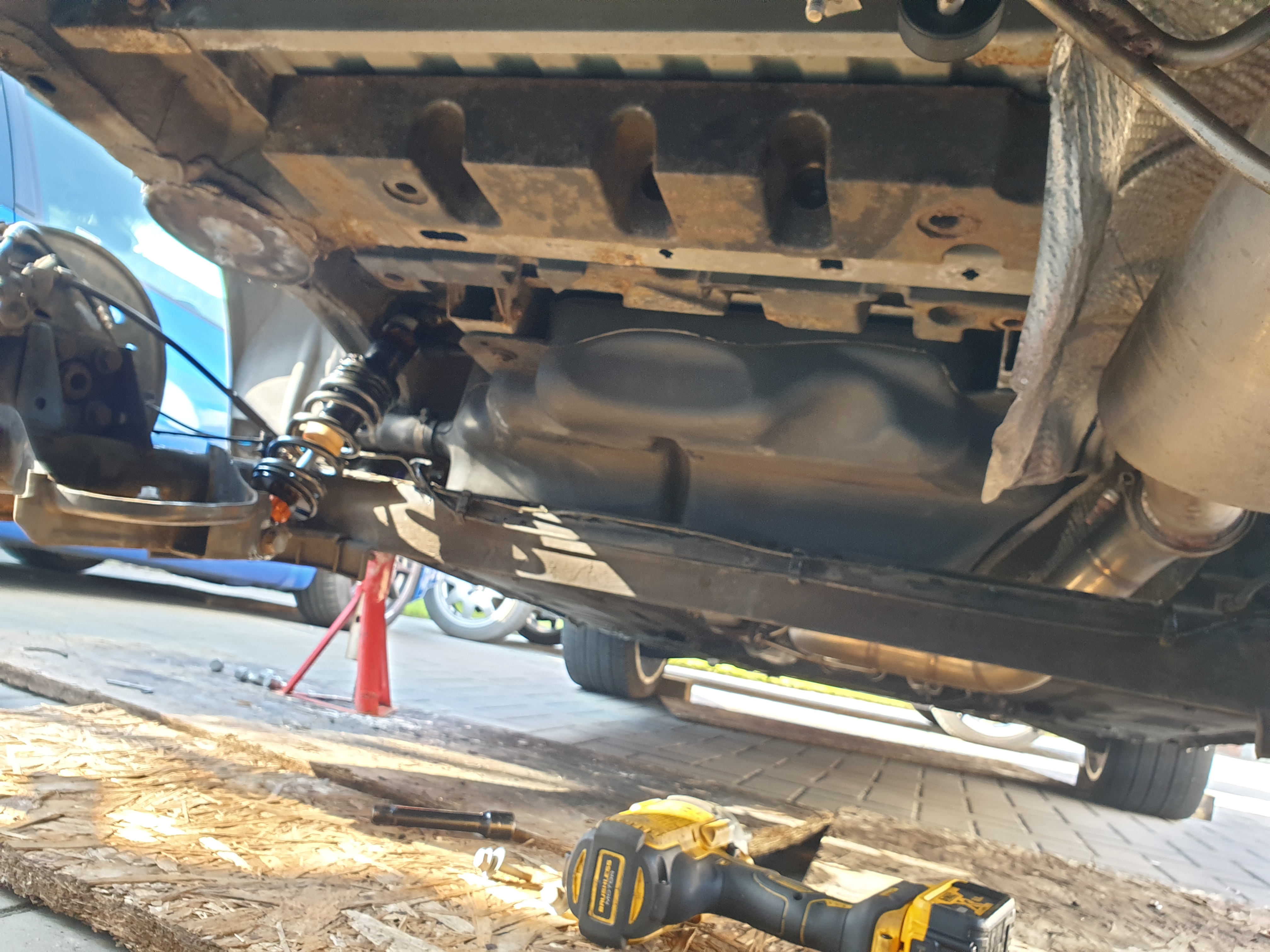

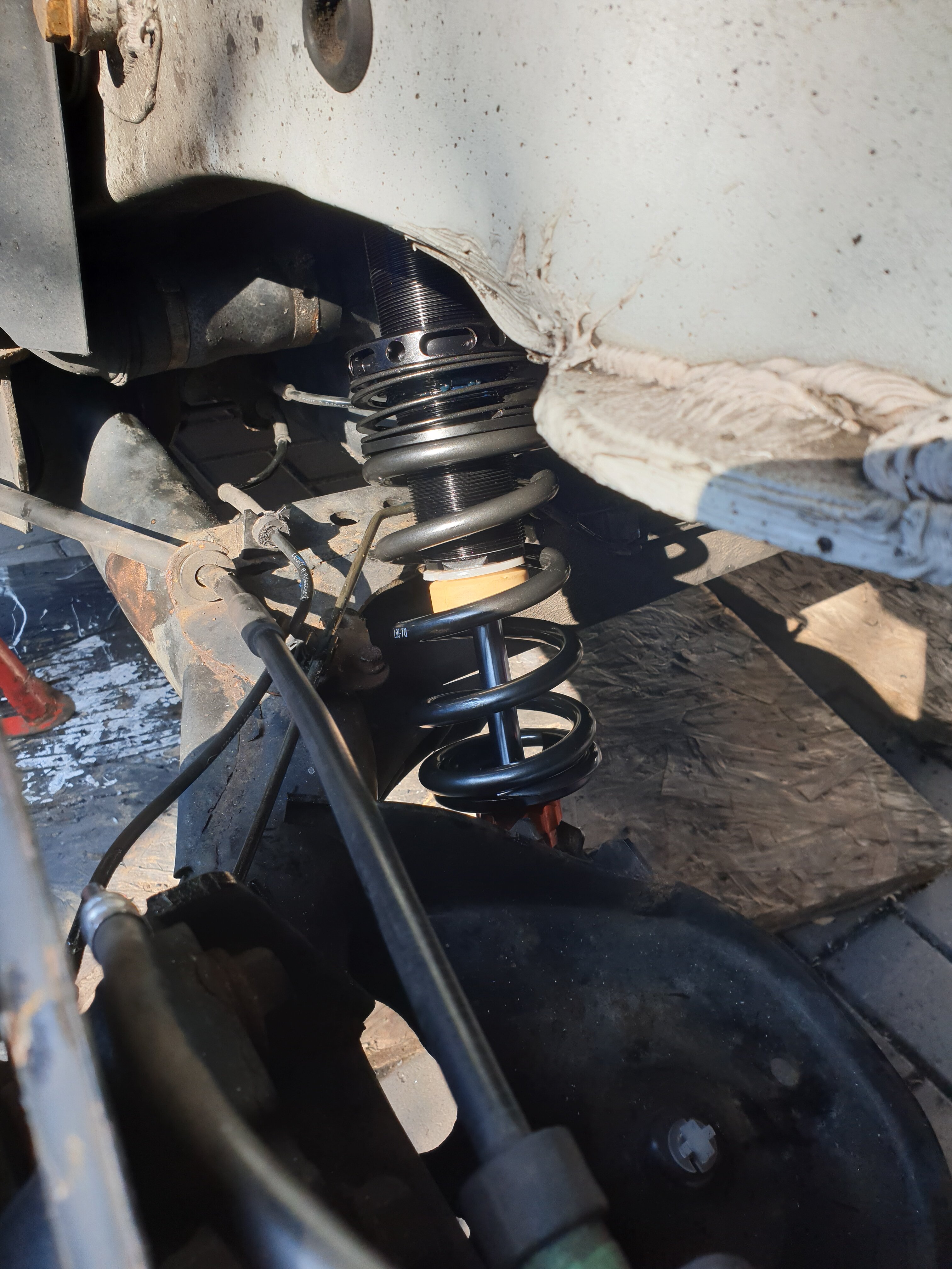

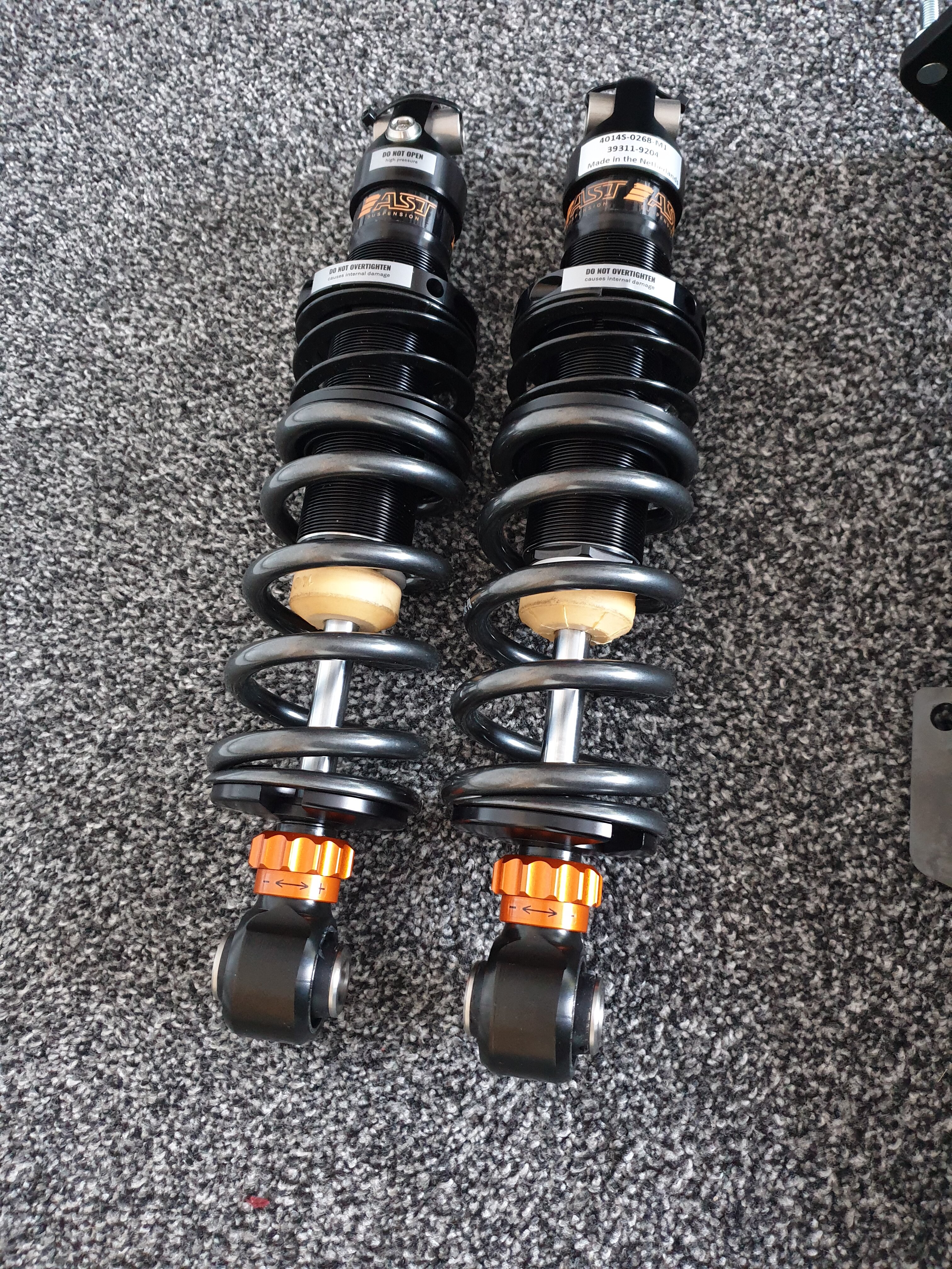

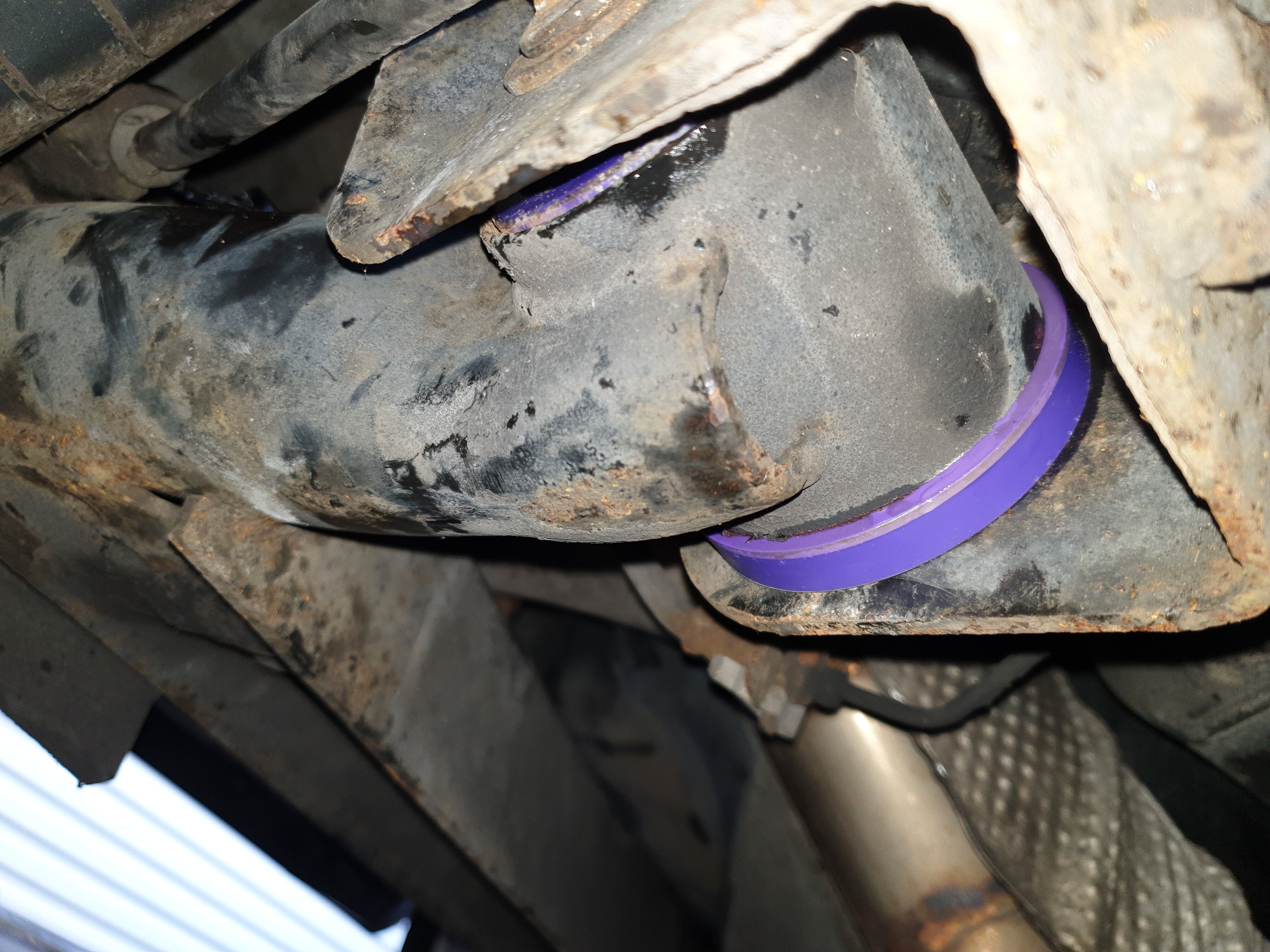

Finally pulled my finger out and started fitting the Ast's, rears first.
Started with bushes as got some powerflex in stock
Done

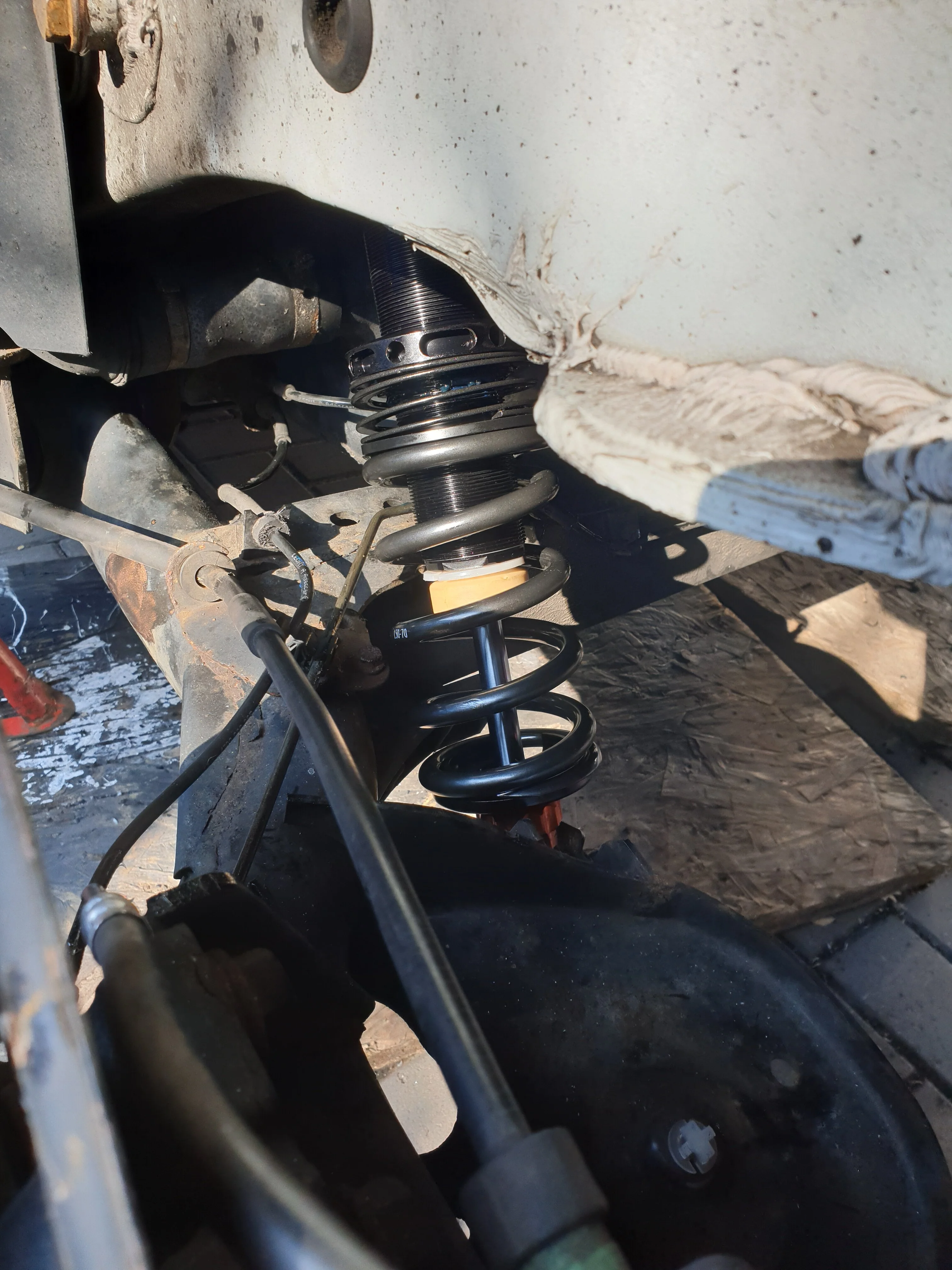

Shocks trial fit and fit well. No issues bolted straight on.
Im no expert on setting up coilovers but ive went with the approach of leaving 1/3 shock travel for droop and 2/3 for compression when on the floor. Ride height slightly lower than before. It will be getting cornerweighted and setup at some point.

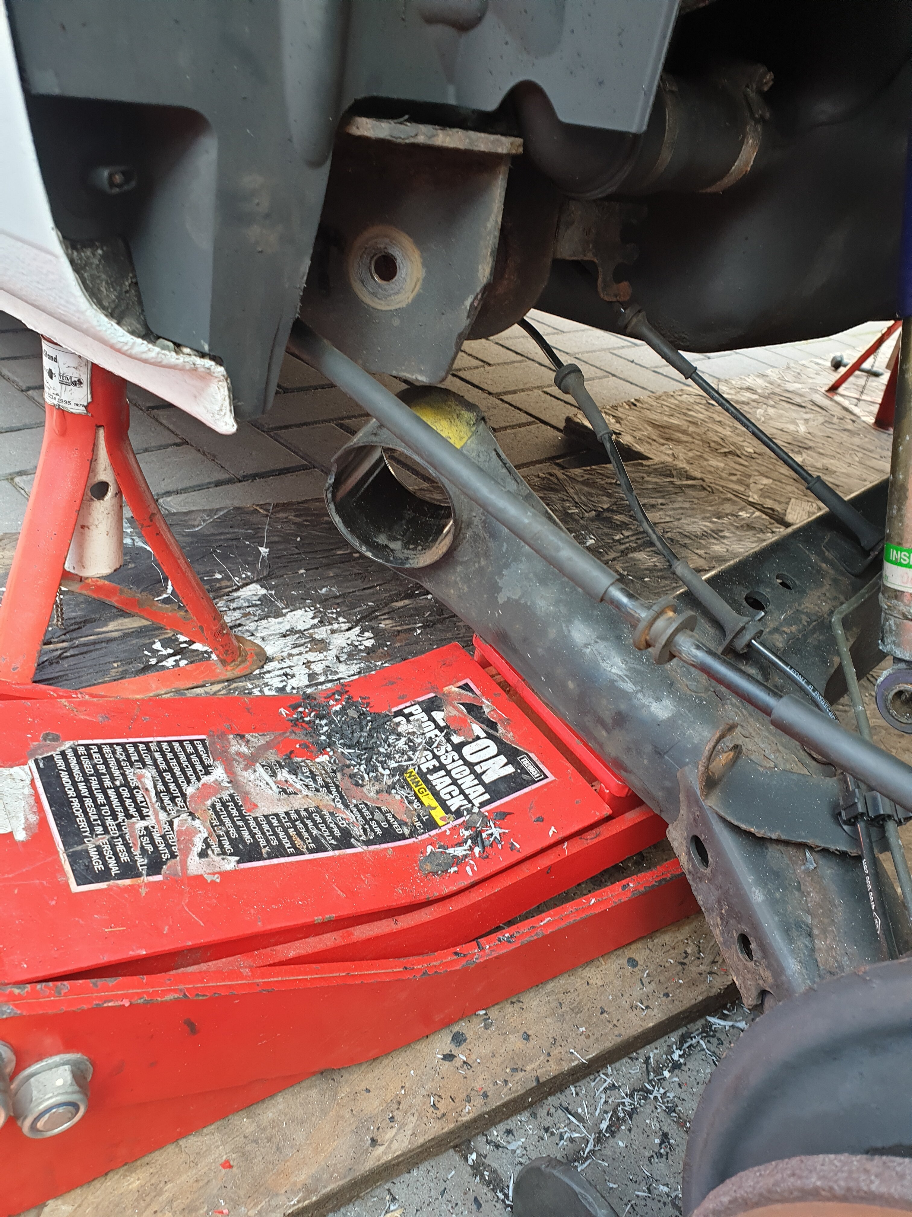

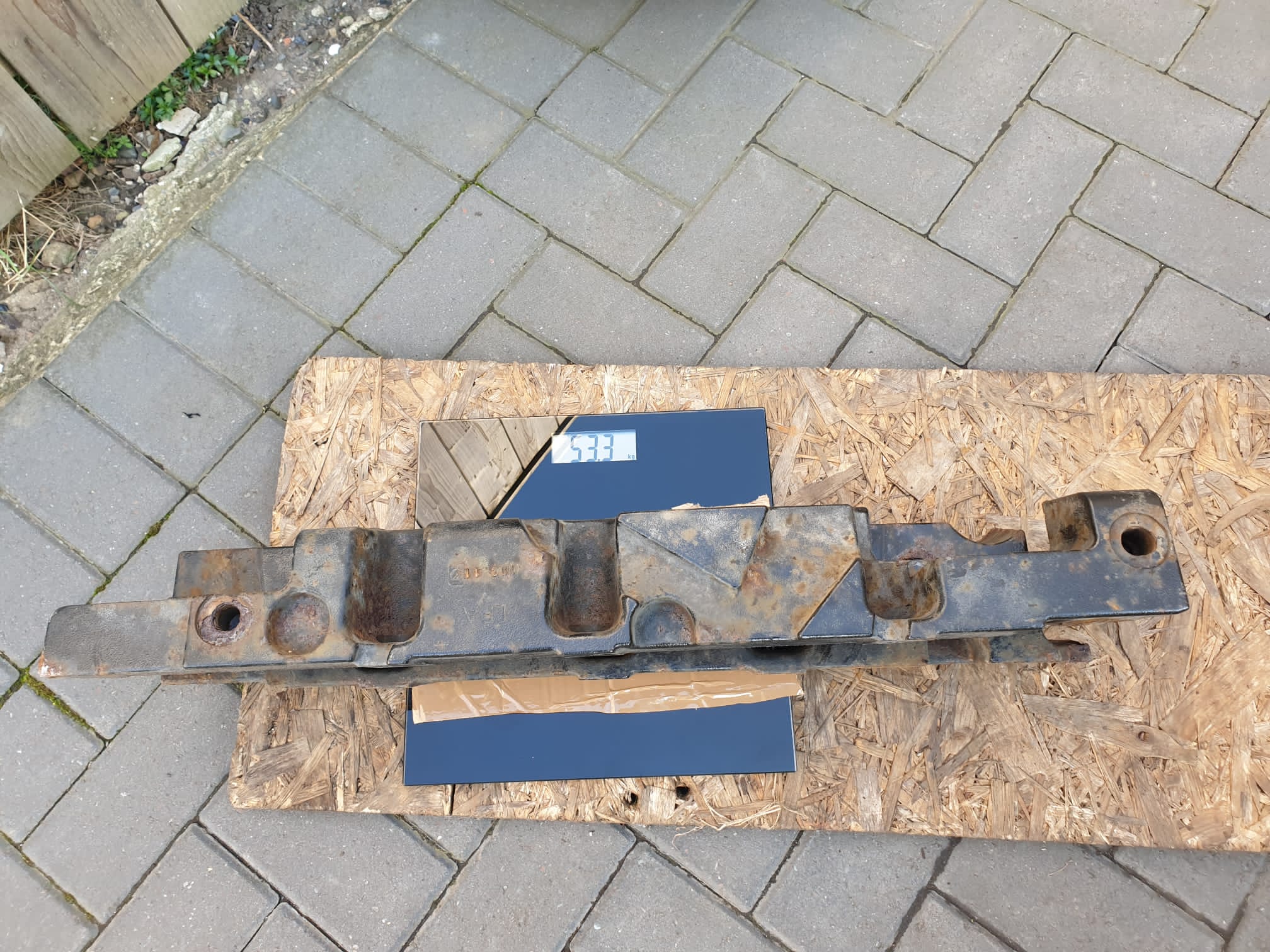

Remember that large ballast weight i talked about ages ago? Pulled it off earlier. I gunned the bolts off and it suddenly dropped with a bang luckily was not in the way. Its in 2 parts removed both bits, as light is fast?
Grabbed the scales to weigh it
53kg!! Thats 8.5stone in old money or 2 bags of cement with change!! Crazy saving.
So from last weigh in it was 1380kg, it should be down to around 1327kg which is quite a result id say.
