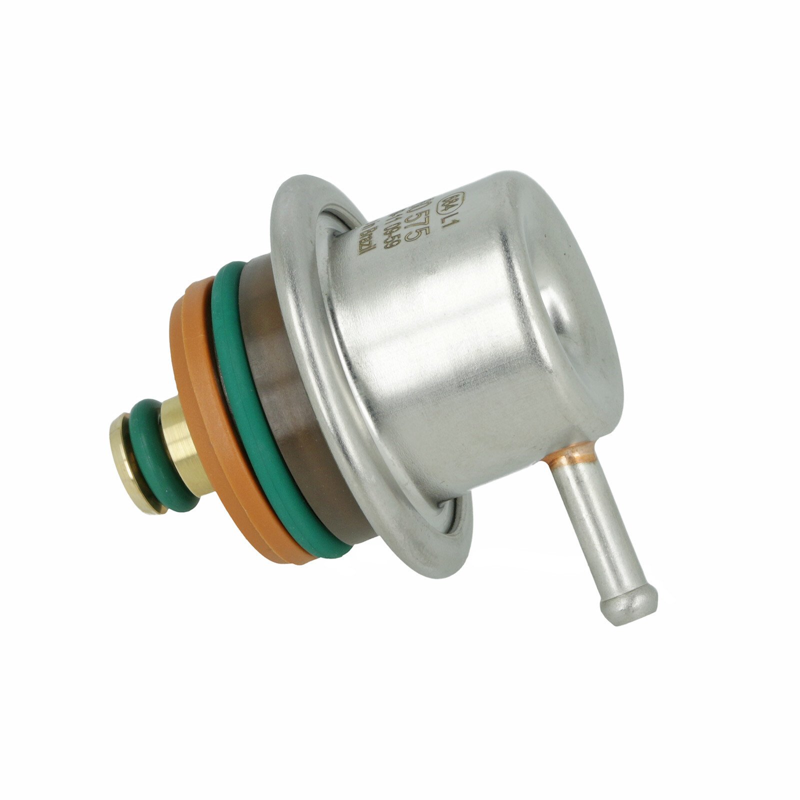

Out of interest, what drove you to increase the fuel pressure and redo the rail? The current PH1 fuel pressure is 3bar (i think) is this not enough for your build?
I was reading some other builds of a similar set up and they were running higher FPR’s. And the fuel rail was a bit of bling really! I still need to sort out the fuel lines to it as I’m still not happy with them, but I’m not doing a full braided lines that are rerouted in the car….yet. I do wonder if it helped me get to 199bhp as I was surprised it made that much
Grandpa Joe
4bar FPR drops straight in and seems to run better/smoother. Or at least it did on mine, and it gives you a bit more headroom with fuelling the top end.
The Phase 2 1*2 have a 3.5bar FPR in the tank but the Ph1 only has 3bar.
It was your pictures and comments that made me get a 4 bar one. That was the other reasoning about it and having an extra capacity for performance if required.
Do you mean you can just buy an off the shelf FPR that is 4 bar and works with the current fuel rail set up? Got a link? I'm changing to 225 injectors so cant hurt to have a slightly increase pressured (especially if everyone else is) but I didn't plan on redoing all the fuel lines... yet.
KitsonRis
I have the PMS fuel pressure regulator housing and the Bosch FPR that is an option to it
Shouldn’t need the housing if you are running the standard Ph1 fuel rail
If your Ph1 fuel rail already has a FPR fitted in it then this is a straight swap.
What is the spec you're running with 225 injectors?
My rail is of that type, so thanks, i will look at adding this to the shopping list.
When you ask what spec I am running with the injectors, do you mean the full list of engine mods?
