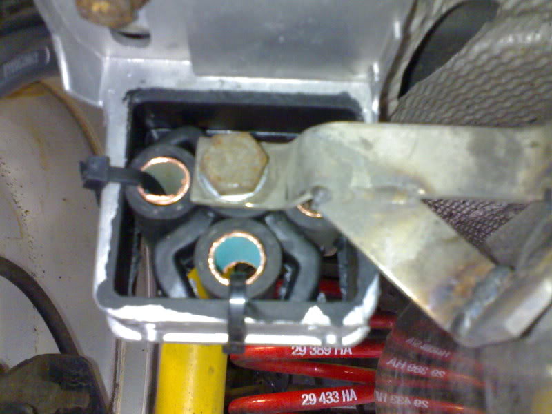

I made this up for my prospeed, new non genuine mount, about £12, little bit of 1/2" copper pipe cut into 3 little bits, and some ruber hose i bought from the local motor factors, much better!

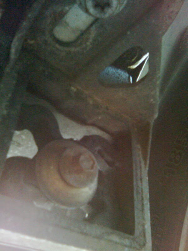

that aluminium mount housing thing that bolts up under the car, do you mean that part is actually hitting the exhaust bracket?
if so look at that aluminium housing where it bolts up, the holes are slotted so you can move it away.

oh sorry ive just sussed what you mean, the actual part that goes through the rubber bush pulls out and allows the exhaust to drop, yep mine did that i'll show you how i sorted it..
