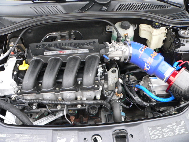

Got my battery moved to boot to allow for a better IK position and straighter inlet route.
Had some harder springs fitted, 225lb front and 300lb rear. Feels much better now sharper turn in but still a surprisingly comfortable ride, youve gotta love ledas. Spring swap was free of charge from leda just had to pay postage.
Went out with Andy and did some road mapping of my OMEX ECU. The mapping was all done at various engine loads and RPM to achieve the correct AFR. You could add and take away fuel useing a laptop. You could also see various sensor readings, an interesteing one was the air intake temp. This showed up the poor positioning of the viper behind the radiator. With a 10degC outside temp the inlet went from 25 upto a max of 36degC based on how hot the coolant was getting which in turn caused the radiator to get hotter. all interesting stuff though. Car feels much smoother now.

AJR - the viper will be setup in a similar way to GDIs demo car, see pic.

AJR - There is a space at that point where the valve on the old air inlet is which goes down into the arch liner. I will probably try and sort out a bit of a heat shield between the engine\radiator and air filter in take. Anything is going to be better then pointing straight at the back of a hot radiator.

Maybe a silly question but, why not put some vents in the bonnet, thus allowing cooler air into the engine?
This would be the best solution but I dont really want a vented bonnet.

if you have a look at the cup racers they use a similar air filter setup.. from behind where the headlight is, with a straight pipe
