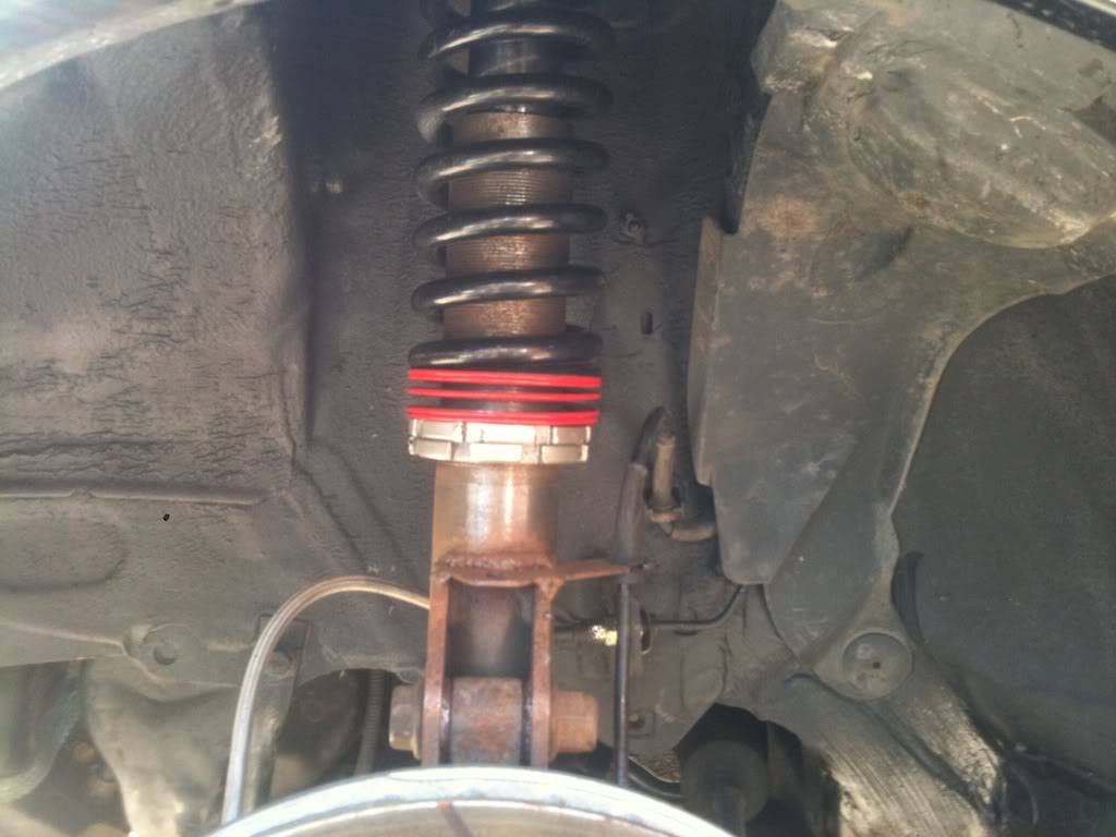

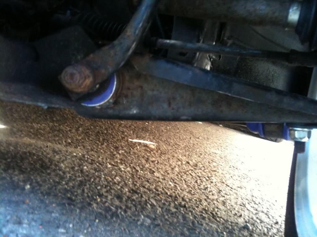

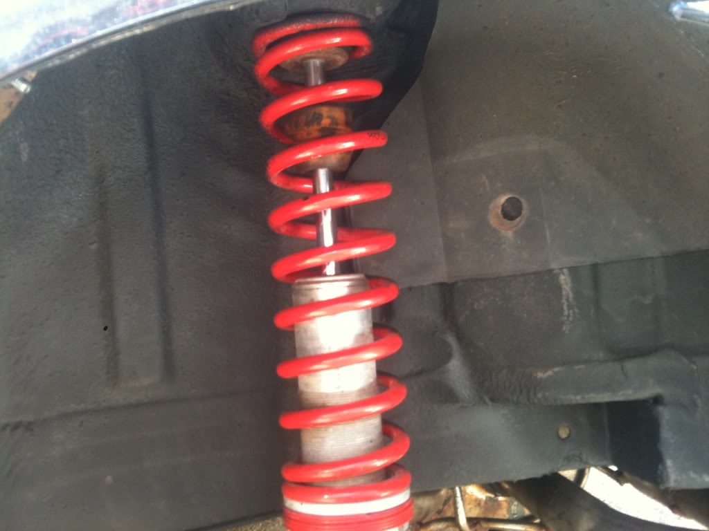

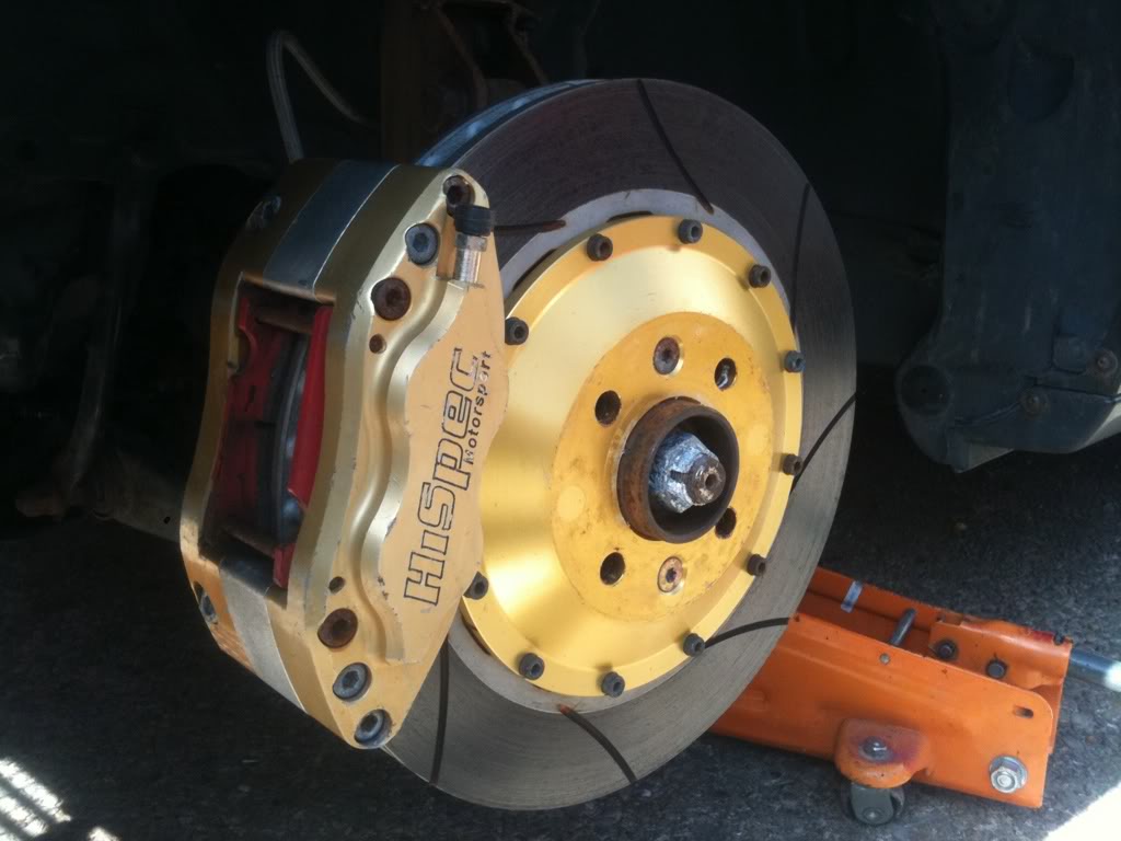

As I was out taking photos off the car I thought id also add a few to show the work that's been done already.

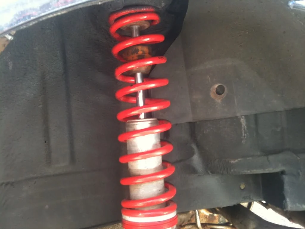

Here's some pics off the suspension also engine bay to show the cup racer strut brace.
Here's some pics to show the whiteline ARB/stainless exhaust and also the underneath that's been completly undersealed.
Here's a pic off the monster brake's fitted.

Where did you get the battery relocation kit from?
Why are you getting rid of the bilsteins?

I bought the battery kit off clio1416 a member on here (cheers sam).
The reason why I'm getting rid off these are.
I'm going to fit the hole cup racer setup including hubs/ball joints so this would mean I have to get lengthened drive shafts, lengthen the track rod ends and possibly modify the subframe to adapt.

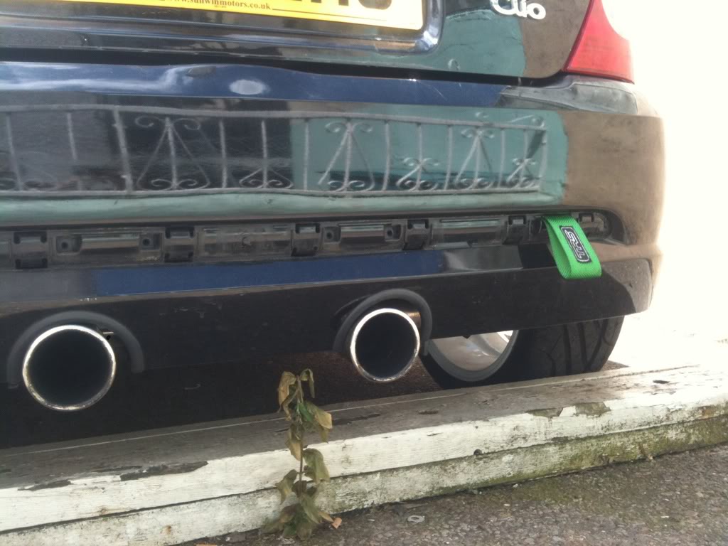

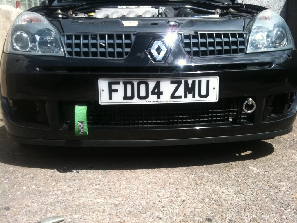

I've now started the green theme to match the livery after a spray job.
As i'm still off work :), I ripped the front/back bumpers off and fitted the green trs tow straps.
Here's a pic front/rear notice the (si tow eye) It will be in the glove box as a back up.
