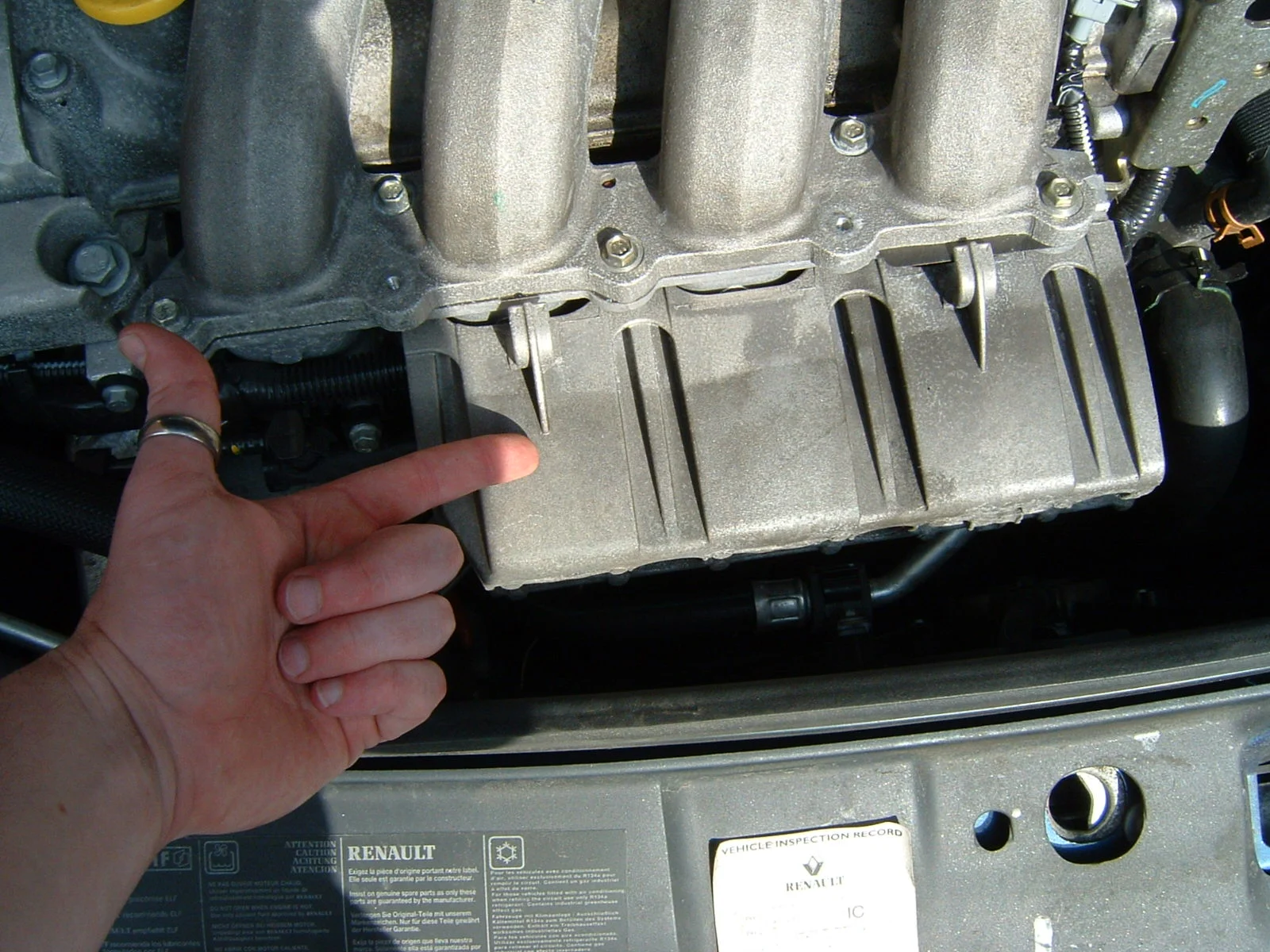

Hi chaps and chapesses,
While fitting my air filter, I noticed the thingy pointed out in the photo was loose. I'm sure it's not supposed to be. Can anyone confirm this ?
If it's supposed to be tight, I can't be bothered with the whole booking it in with Renault thing. It should be easy to tighten - right ?
Problem is that the front grille seems to be in the way of me getting a socket in there, and I've had a look and can't see an easy way of getting it off.

Looks like you are pointing at the fuel rail protector.
pssst .. someone put a ring on your thumb when you weren't looking. ;)
Its a fuel rail cover. Get a 10mm socket and 3" extenstion and put it in the holes to tighten the two bolts. Jobs a good un then
You will find it easier to put the socket and extention in by hand and then attach the wrench part after
