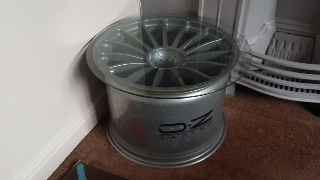

Is this a coffee table ? got any pics of it as I have always wanted an F1 wheel table.
Thanks mate. Thats the plan - Turinis next then a set of cooksports once their back in stock
It is indeed, However i dont really use it as a table but instead it sits in the corner of my room as i like the way it looks. I cant remmeber what its from but the guy did say. An old O.Z Magnesium wheel, paid £20 for it at the car boot

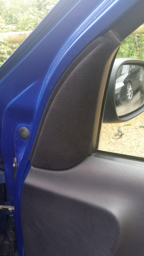

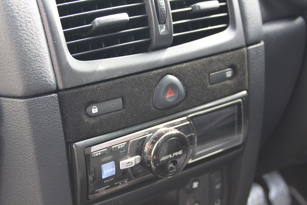

Going a little flocking mad. Have now got A pillars, hazard panel, speaker covers along with handbrake surround, door pulls and mirror covers in the post. Just about to purchase b door pillar covers, dash strips and maybe a few other bits.

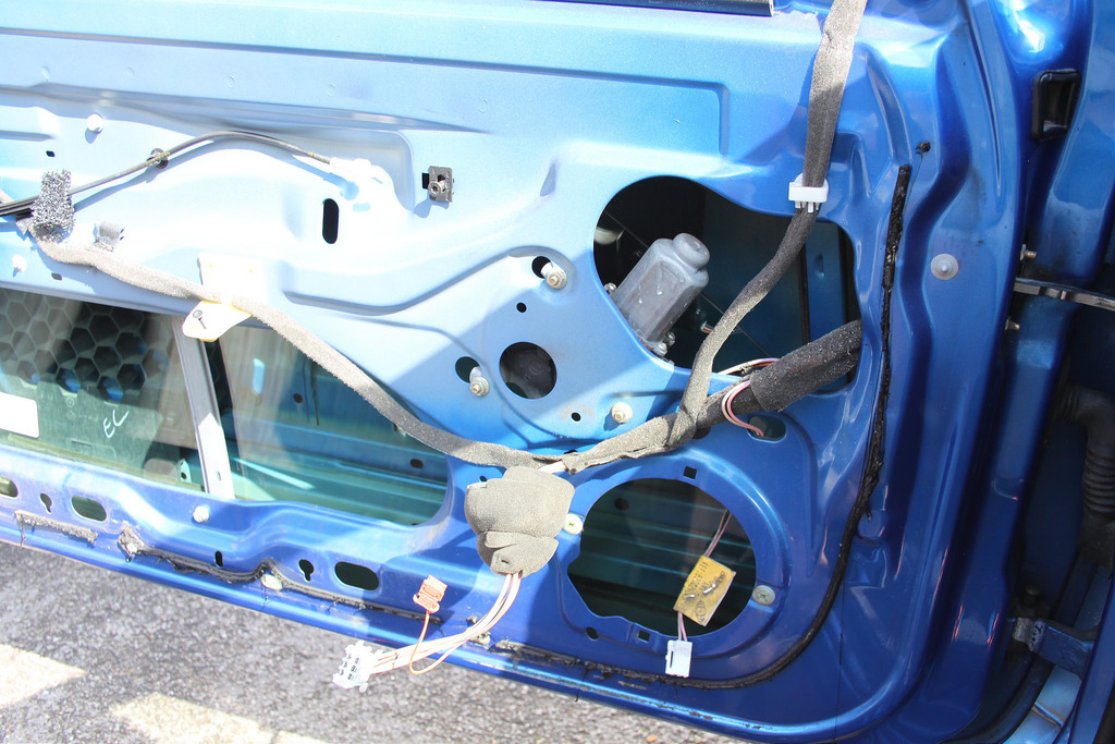

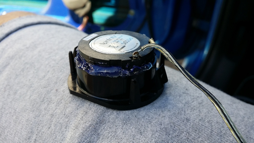

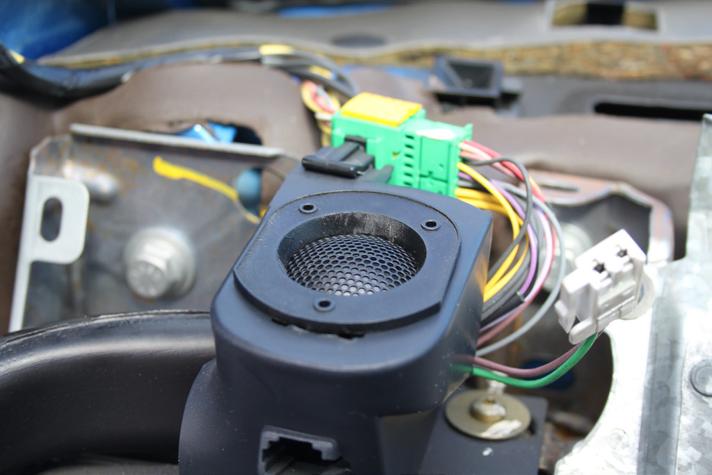

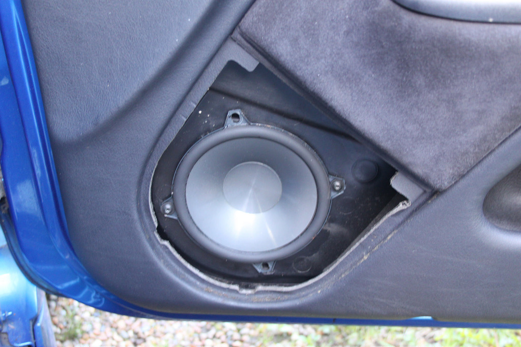

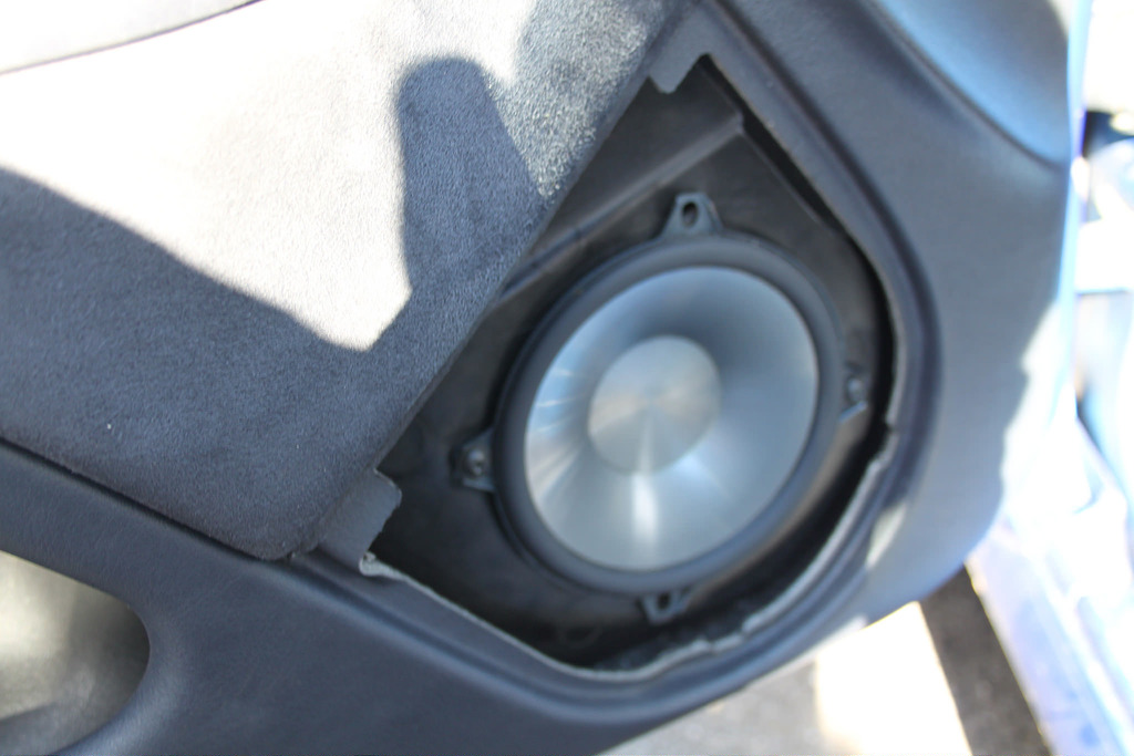

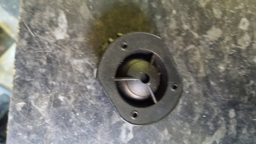

Upgraded by speakers/tweeter and all speaker cable. Bought some Infinity components, tweeters and crossovers and already had some vibe speaker cable. Spend pretty much the whole day doing it but all done now and the sounds is much improved
Also whilst i was there i fitted some sound deadening/anti-rattle to the door skins, it makes SUCH a difference, the tone of the door when closing is depeer and more solid, the sound is more contained and no rattles. Just need to update the rear speakers and fit some more sound deadening to the rears and boot floor/boot.

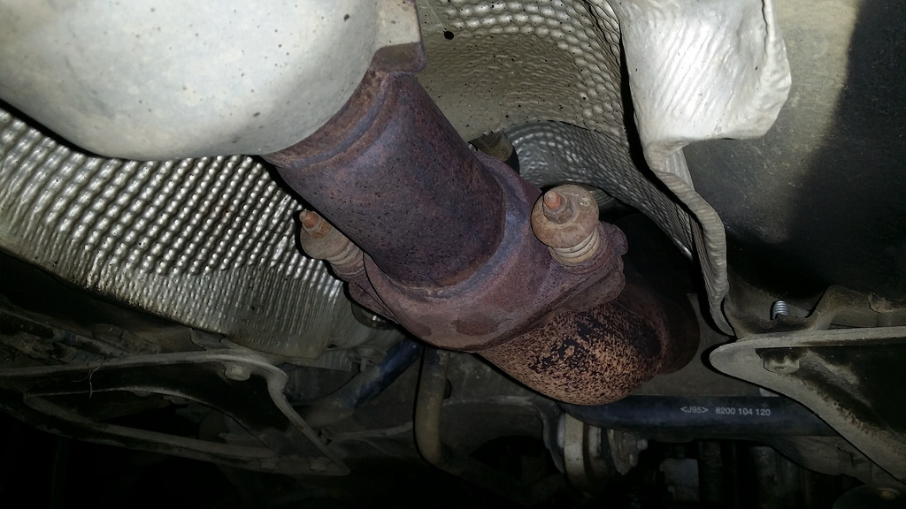

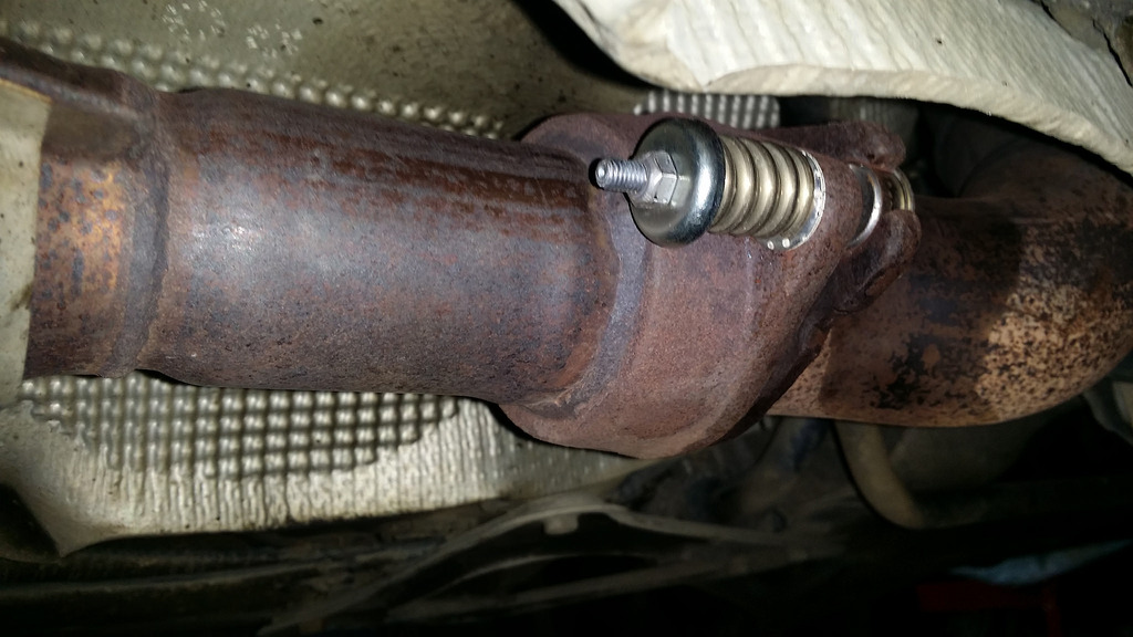

Yesterday i replaced my cat to manifold gasket, it blowed on cold but once warm was fine. Once i removed it it was clear it had been bodged up. 4 washers either side to tighten the gasket. Its not like £19 is much to fix it. All fixed now though.
20150903_113156 by felixta22, on Flickr
20150903_113635 by felixta22, on Flickr
20150903_113708 by felixta22, on Flickr
20150903_120729 by felixta22, on Flickr

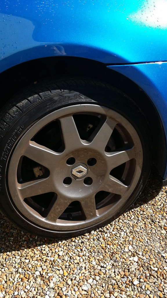

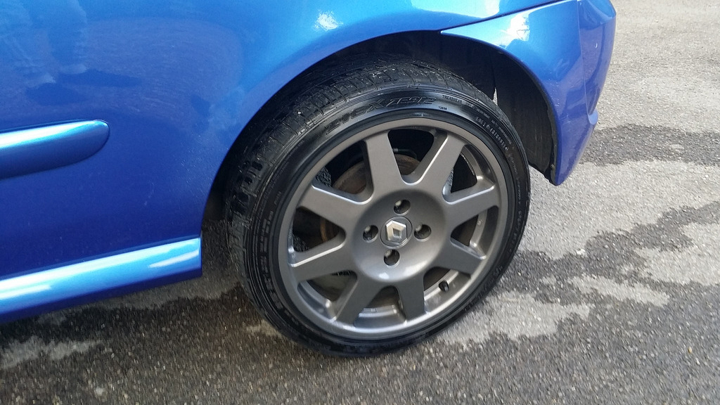

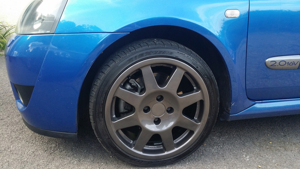

Wheels

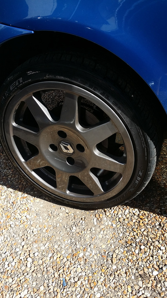

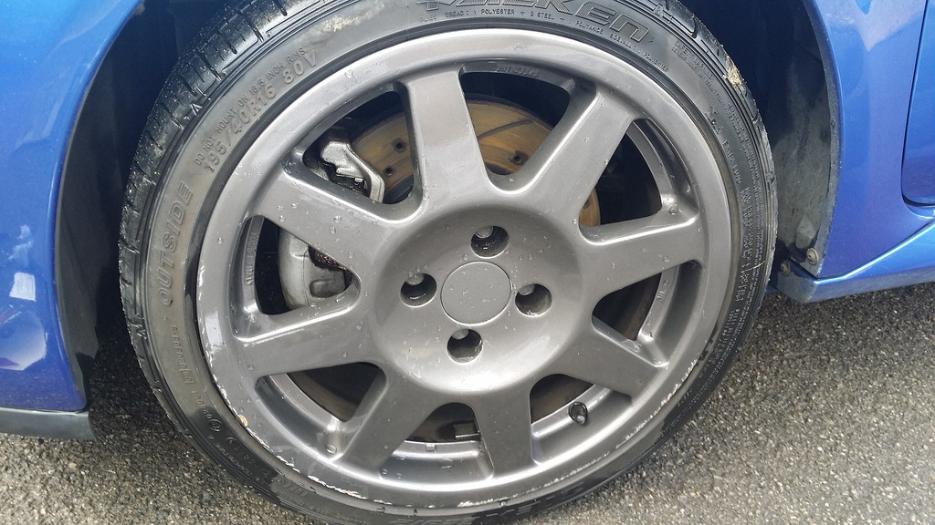

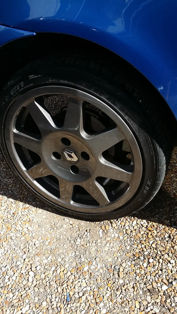

The whole looking for a new set of wheels ended up moving really fast. Bought a set of speedline Safari's off @dwissy, and the legend he is also dropped them off to me as he was passing close buy, cheers again for that mate!
Wheels are really nice, got them fitted and run and drive great. Only issue is the car now looks like its on stilts due to the low profile tyres:monkey:😂, not to worry though as will just swap my old tyres over to these. :tongueout:
Planning to somehow add the renault diamond to the centre caps to make them look a little more OEM but overall am over the moon
20150905_170630 by felixta22, on Flickr
20150905_170634 by felixta22, on Flickr
20150905_170639 by felixta22, on Flickr

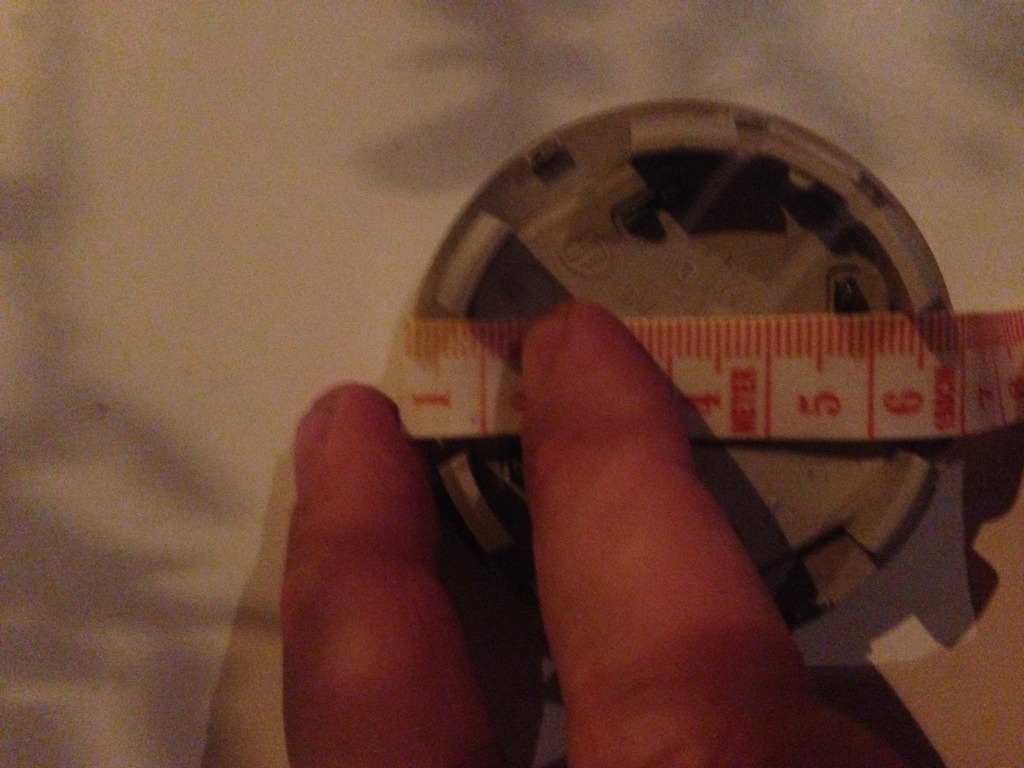

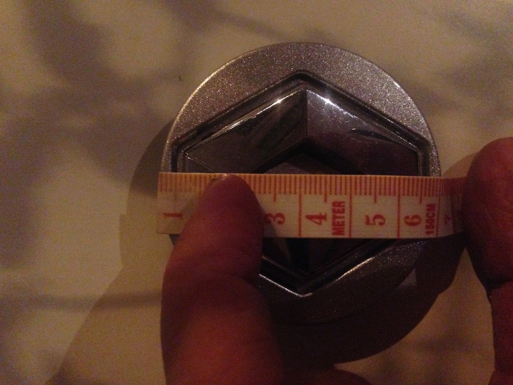

Yeah pretty pleased with them mate, not too sure, I measured them and their 60mm, dunno what size turini ones are but considering there is a lack of renault 60mm centre caps on ebay suggests they aren't the same size. Would appreciate if you could measure tho mate. Yeah was thinking that but then wouldn't get as much for the 182 alloys when I sell them
Awesome, I'll pm you at some point. Also is there a site or know of a site where you got your cross overs and sound deadening?
Just took some pics, I wouldn't 100% them for sure but this is what I came out with front and back and what you're looking at. Need any more horizontal / vertical measurements just ask :blush:

Cheers for the pics mate!, those look like 60mm as well, or maybe 59mm but even so seems like they will work. Need to find a set, theres loads on ebay but their all aftermarket and the renault diamond doesnt come out. Alternativley i can just buy the diamond but dont know how easy it will be to get them perfectly central?

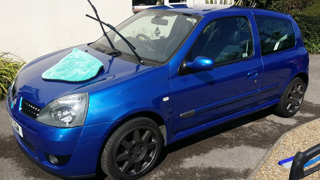

Recieved some Poor boys Black hole glaze and it is amazing, cant believe the wet look and shine it goves off, think its becoming my new favourite item.
As i needed to seal the car for the coming winter months, i invested in some Hydro2, it has a stange application process but pretty easy and seals really well, the beading im getting is aswesome. Hopefully should keep the paint protected for a while. Think i will invest in some hydro2 lite instead next time though.

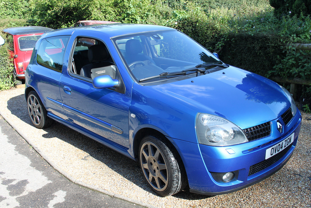

Couple of afters
IMG_1193 by felixta22, on Flickr
IMG_1192 by felixta22, on Flickr

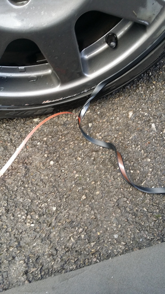

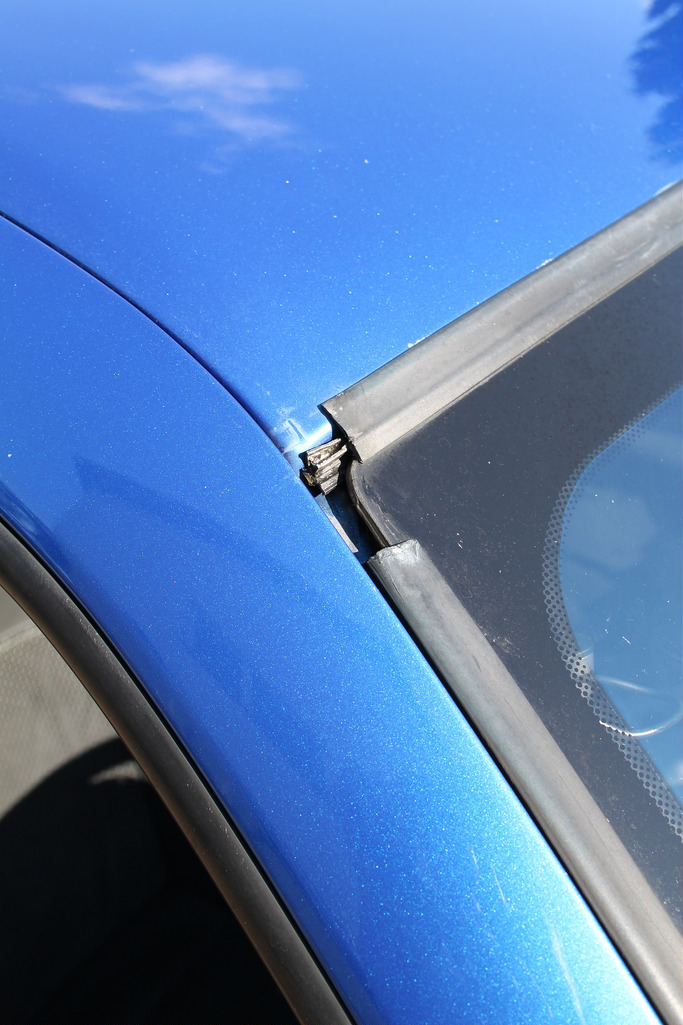

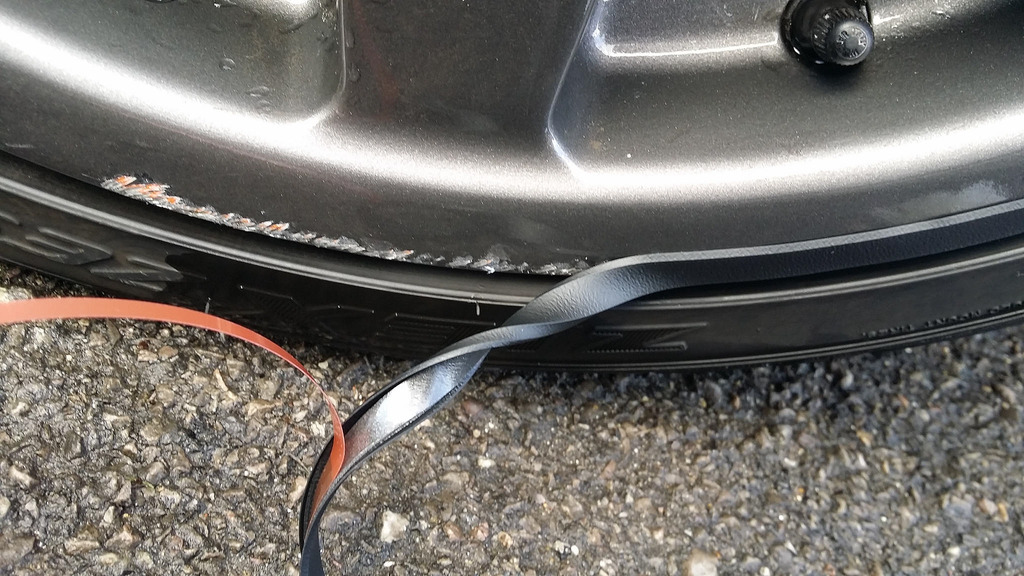

Need to see if i can get a new one of these, it fell off whilst washing
IMG_1191 by felixta22, on Flickr
Looks proper that does! Shiny in the sun but in the shade a proper slick clean blue :cool: did you use a wax or sealant on top? My new favourite thing to do is to waste products and glaze then seal it with a wax then glaze again lol, the last glaze step won't last long at all but whilst it does.. :cool: Once that layer goes I'll be back down to a wax.. Hopefully.
And lol at the part just "falling off" hahaha, typical French cars. Falling apart when stationary :up:

And yeah it just randomly fell on the floor 😂😂 think i may need a whole new side windscreen rubber :unamused:

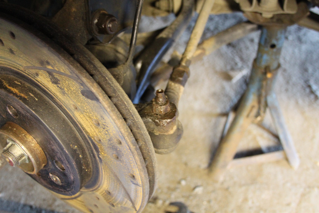

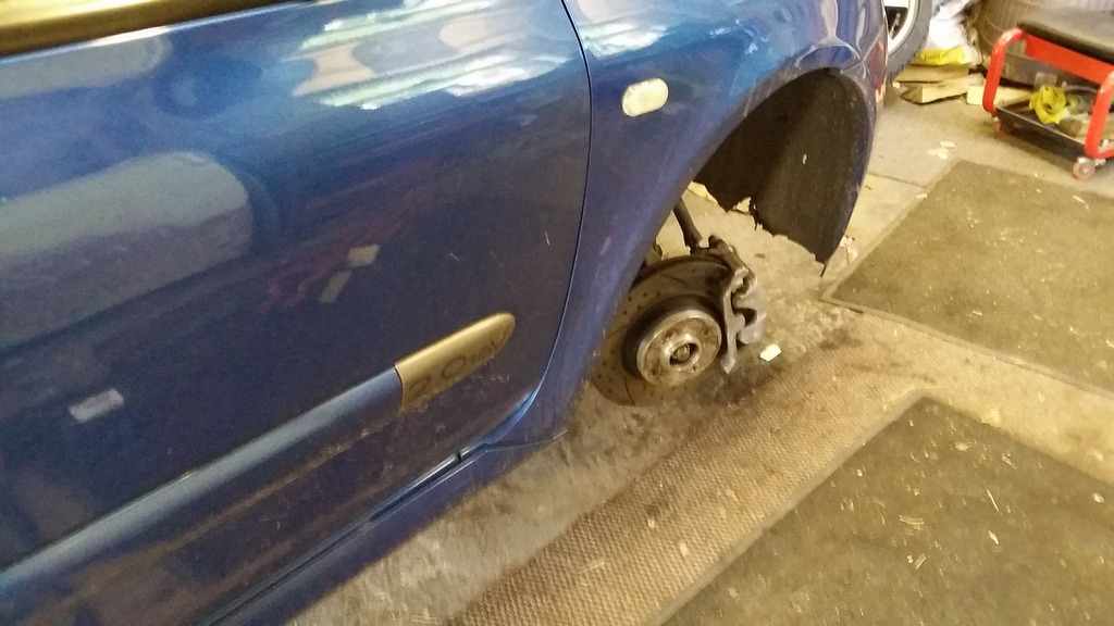

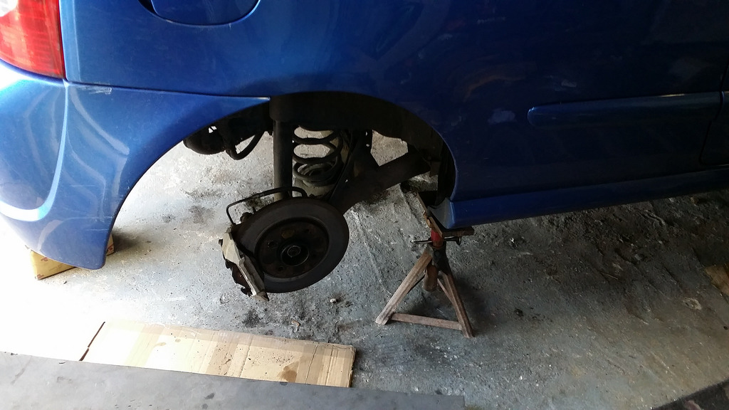

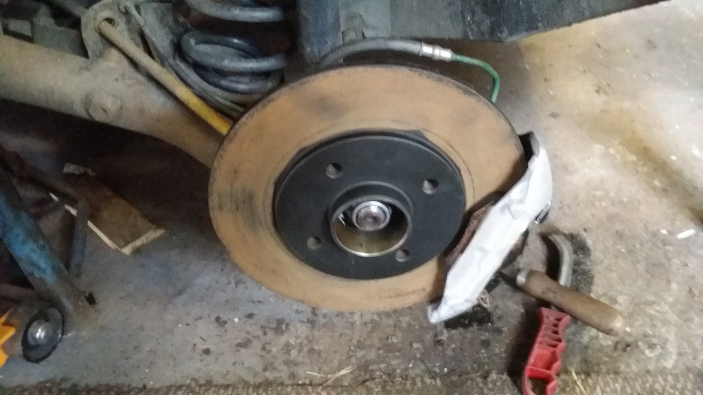

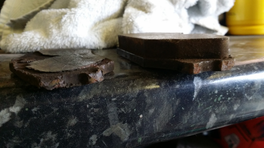

Fitted my new brakes today, had a few issues but overall i got it sorted. I now understand why my brakes were so poor 😂. Need to give it a few miles for the surface rust to come off the discs as they are feeling a little spongy at the moment. Also bought some ATE supegold today from George, so hopefully will fit that this weekend and brakes will be up together.
The car now has:
Fronts - Brembo drilled and grooved discs & Brembo pads
Rear - OEM discs afaik & Brembo pads
20150909_102902 by felixta22, on Flickr
20150909_141737 by felixta22, on Flickr
20150909_151103 by felixta22, on Flickr
20150909_140920 by felixta22, on Flickr
20150909_140927 by felixta22, on Flickr
^^^^ New pad on left obvs 😂

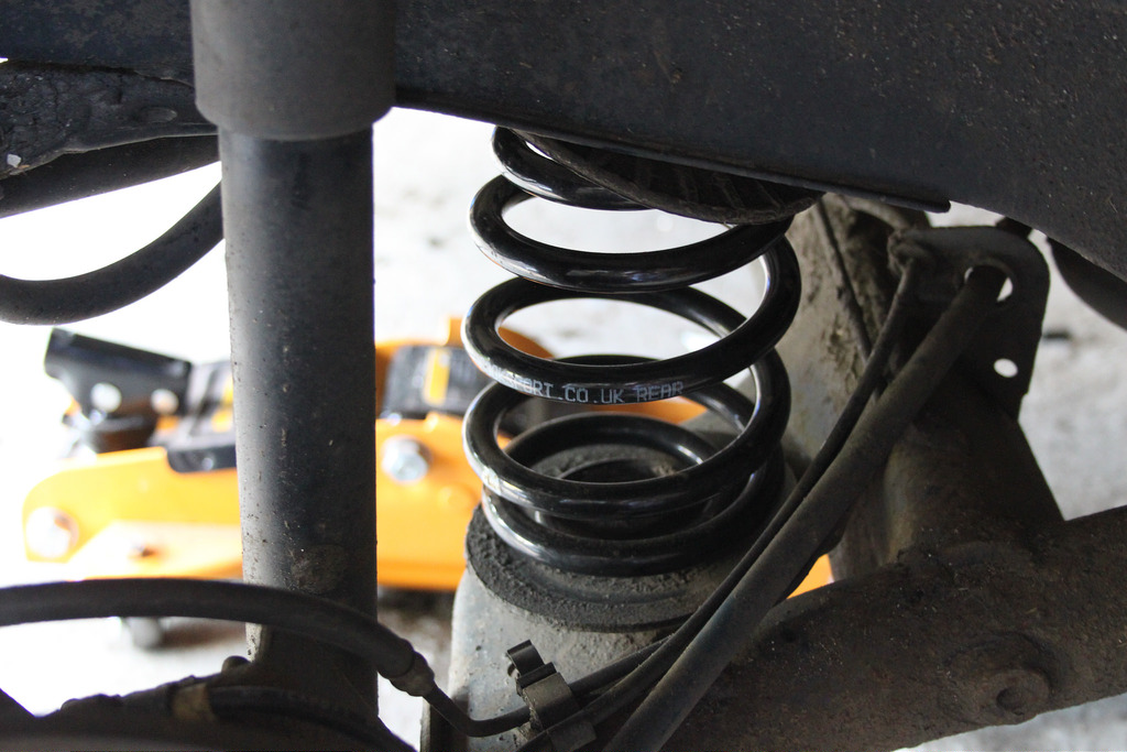

Checked my suspension whilst i had the wheel off, no play in everything which is good i guess, but downt answer why i have play in my steering

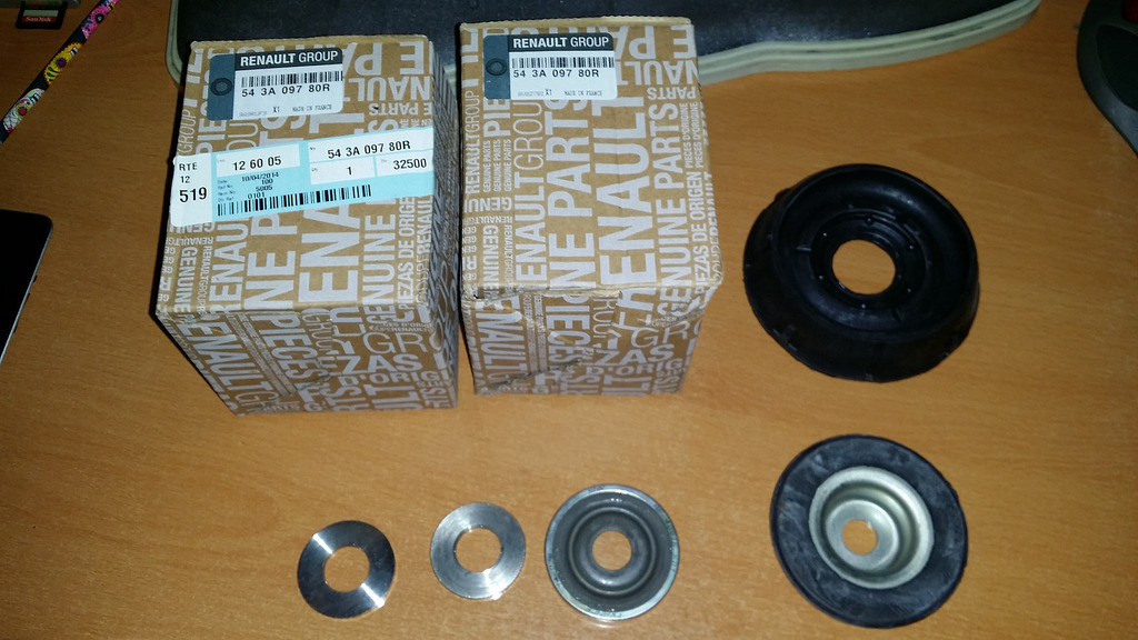

Recieved my new Genuine Renault top mounts this afternoon, mine are knocking on full lock and might as well change them when i do another mod soon. Probably easy to guess but not saying untill they have arrived.

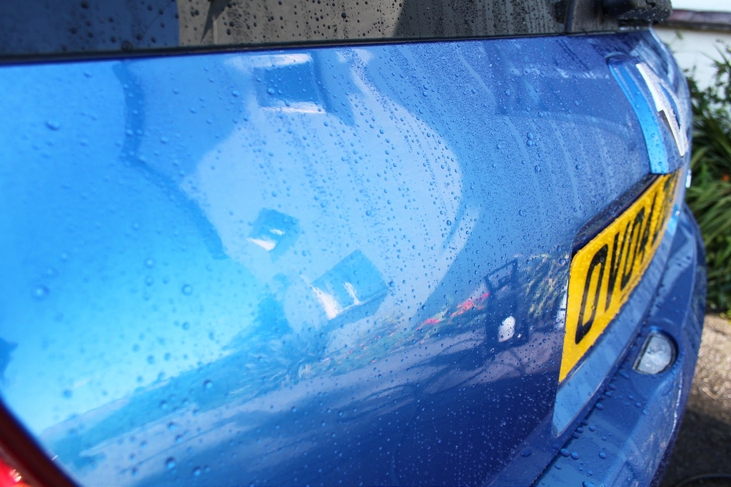

And just whilst im uploading pics, a beading shot from this morning, Loving the Hydro

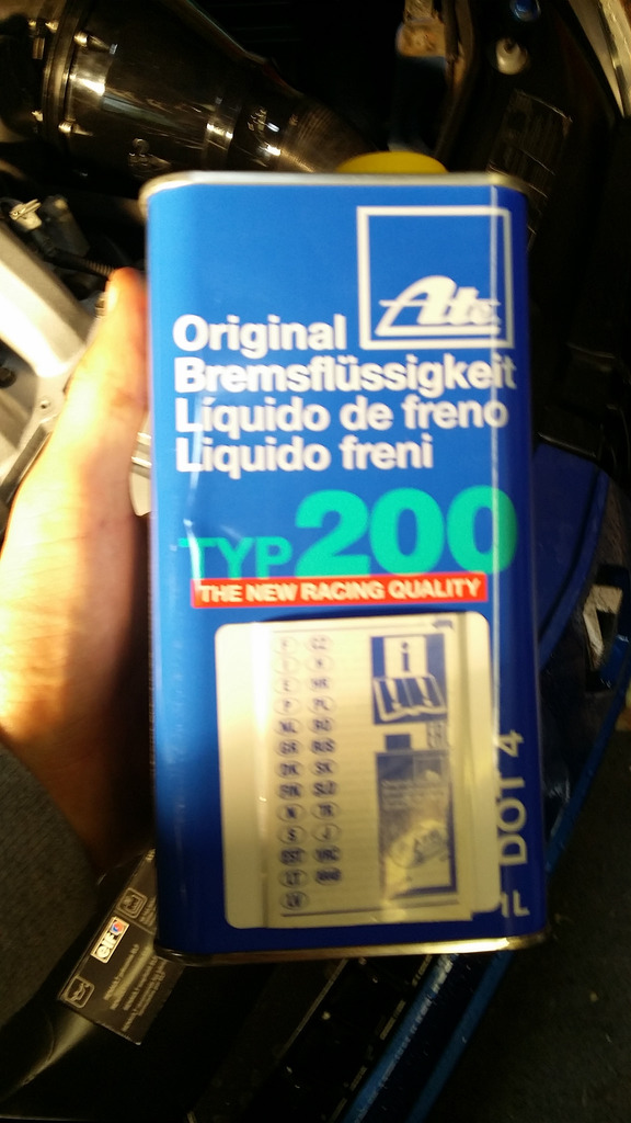

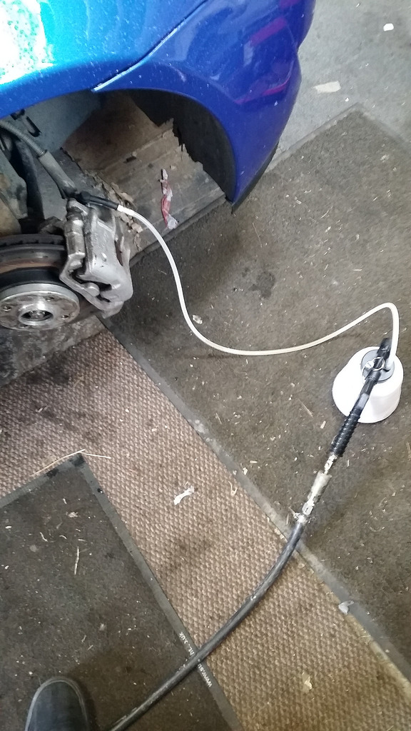

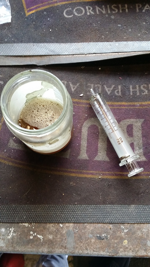

Recieved my order of some ATE supergold of George yesterday. As above, i have recently changed the discs and pads so only made sense to complete the puzzle and do the fluid. Overall the fluid wasnt too bad but might as well change it now as already bought the fluid.
Started with removing the engine cover and using a syringe to take the fluid out of the master cylinder. Made use of my new £12 light as i couldnt see sh*t in the engine bay
20150912_095834 by felixta22, on Flickr
20150912_101411 by felixta22, on Flickr
20150912_100352 by felixta22, on Flickr
Then a couple of pics from the process and the fluid i removed. Luckily all went pretty smoothly, was a little concerned about the bleed nipples but they unscrewed fine.

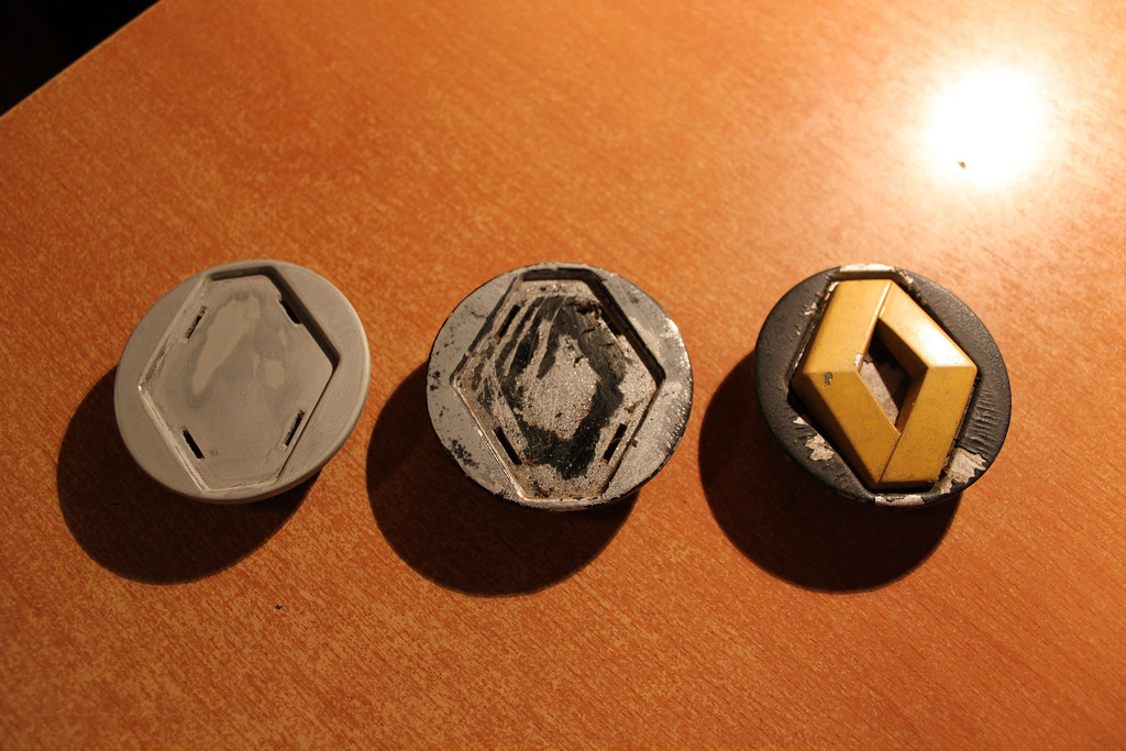

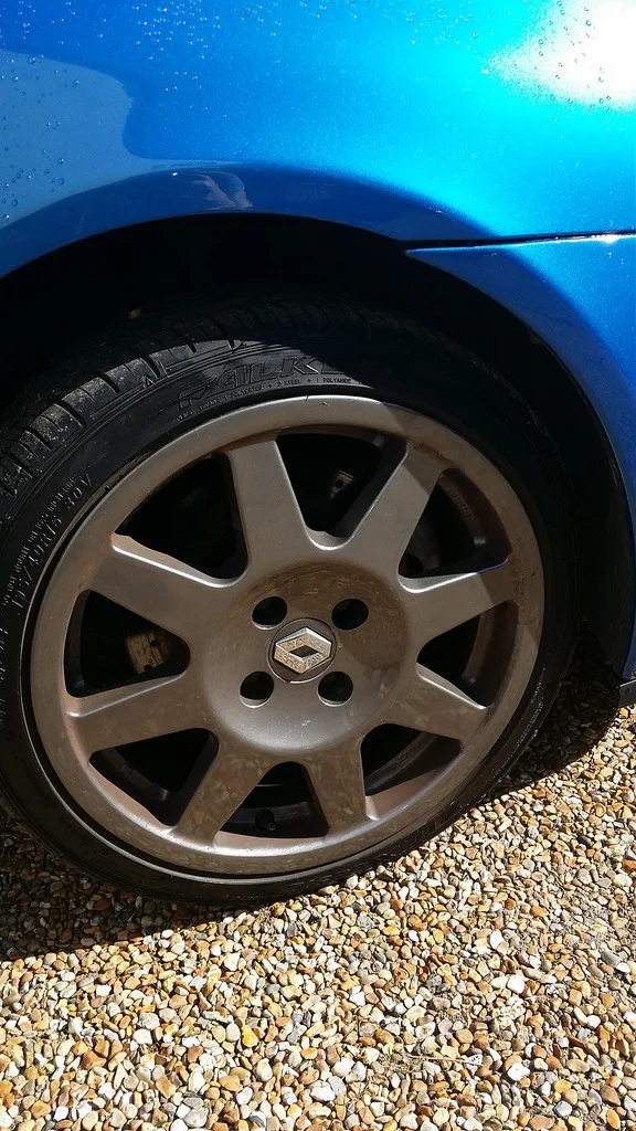

Centre caps
As you may or most probably not read from above, got 3 turini centre caps that i planned to fit onto my new wheels to make them look more oem. The main hurdle was matching the paint, the seller didnt know what colour they were but i for some reason i dont know had a can of Rover metallic grey in the garage which turns out is only VERY slightly darker of a shade than the wheels so i used that. Finished spraying them yesterday but i couldnt secure them to the new wheels so just got the hot glue gun out and stuck them on. They definatley aren't going anywhere and look much imroved to me.
20150912_141113 by felixta22, on Flickr
20150912_141120 by felixta22, on Flickr
20150912_151423 by felixta22, on Flickr

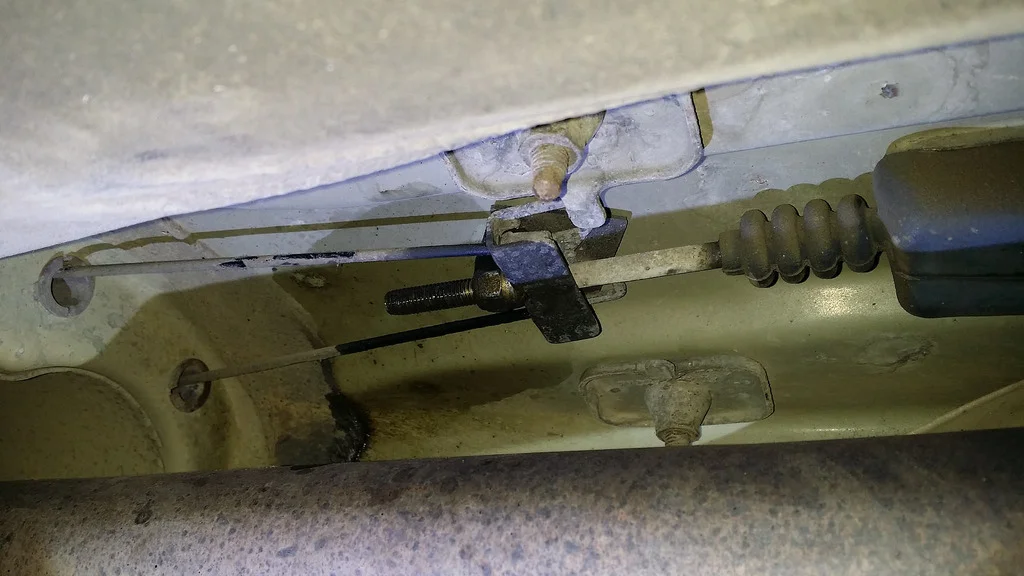

Handbrake

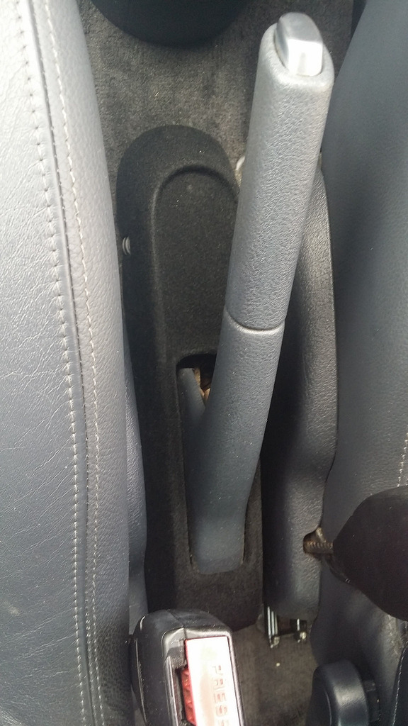

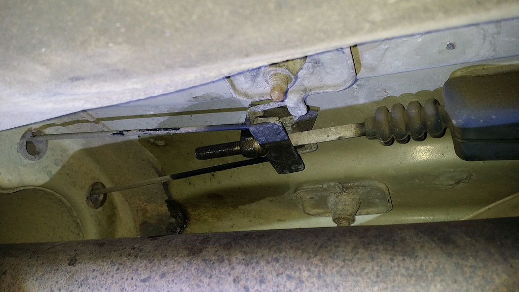

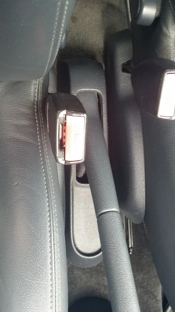

I noticed the other day when i had to stop when going up a steep hill that when i put my handbrake on i still roll down the hill 😂. So i looked into how to tighten it and how much and was told the handbrake should be fully on at 4 clicks, well mine was on at 9 😂. So i tightened that, not very exciting tbh but it is another thing i did to the car.
20150912_132436 by felixta22, on Flickr

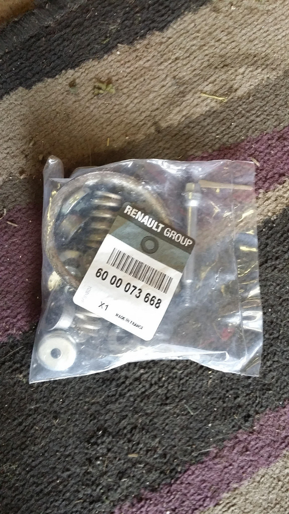

I also started purchasing parts for the cambelt job :unamused:. Recieved my order of some new coolant for when i do the waterpump. In the post and on its was to me also is:

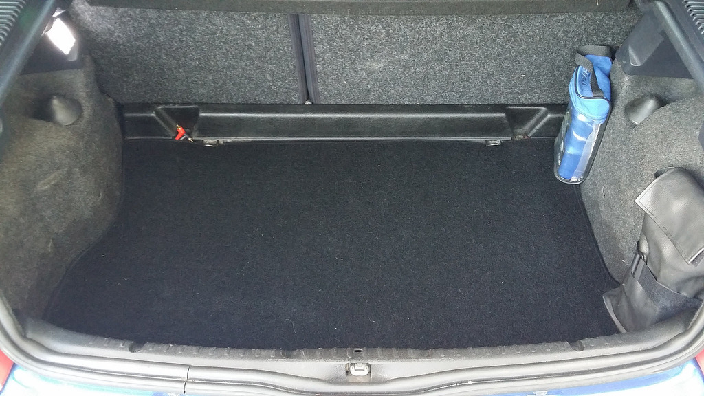

Tomorrows job is to test fit my sub back i the boot, i haven't re-fitted it since i removed it from my 1.2 as i love the boot space too much but i do really miss the extra bass it gives. May invest in a under the seat subwwoofer but cant find a 2nd hand one anywhere.

May need to bleed one of the rears again as brake pedal is a little spongy

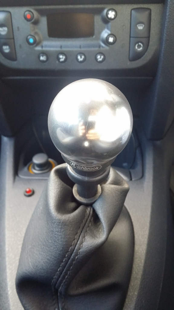

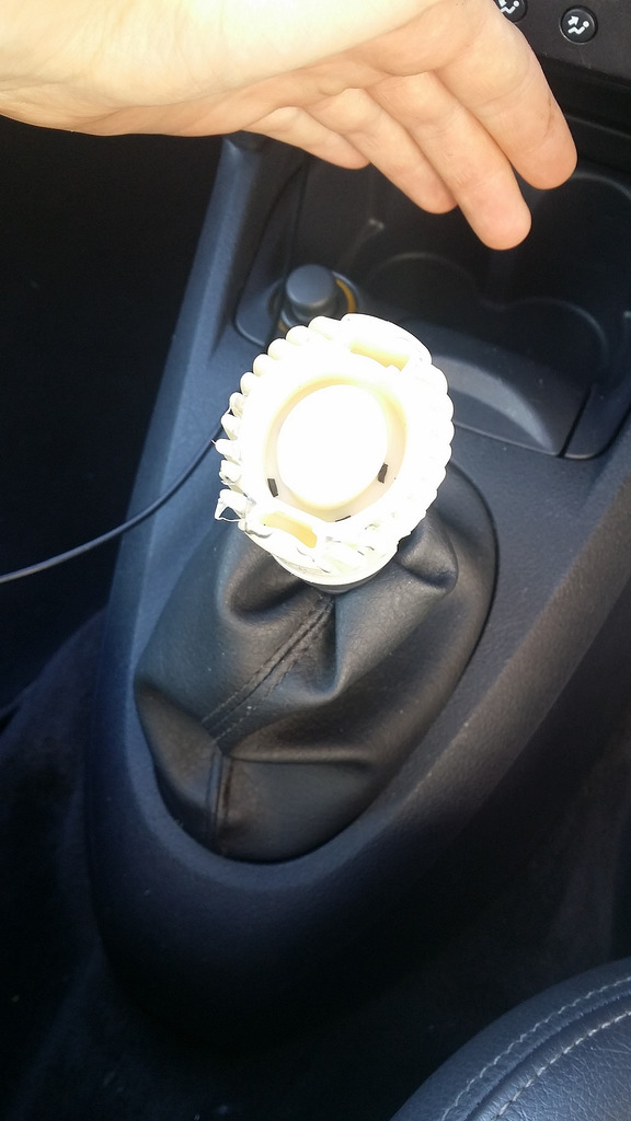

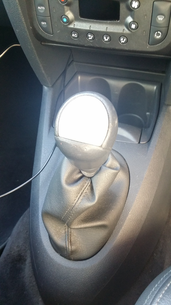

Fitted my new knob, love the way it feels:wink:. So glad i did it now as so much easier as i found the old one a little to big so going into reverse was a bit of a pain. The old one was anightmare to get off, on my old 1.2 it just came straight off but on the 182 i had to bring out the hacksaw. This did mean i ended up hoovering the interior which is always a good thing. Still cant decide whether to spray it black.
Before:
20150919_134711 by felixta22, on Flickr
Half way:
20150919_135007 by felixta22, on Flickr
Le after:
20150919_162929 by felixta22, on Flickr
After which i then proceeded to wash the car as needed to clean my wheels to fit my trims4rims. They were pretty simple to fit and no only did they cover up the curbing but they arent too noticable :tongueout:
@sparklesTHEpony Fitted them mate, simple to do but if you do get a set I would suggest slightly jacking up the wheel when doing so so that you can turn the wheel or with the wheel not on the car as was a little difficult fitting them neatley when working upside down.
More befores:
20150919_161230 by felixta22, on Flickr
half way:
20150919_161529 by felixta22, on Flickr
20150919_161533 by felixta22, on Flickr
Afters, see not that noticable, just need to keep on top of the tyre shine
20150919_162903 by felixta22, on Flickr
20150919_162858 by felixta22, on Flickr

Re-bleed the brakes

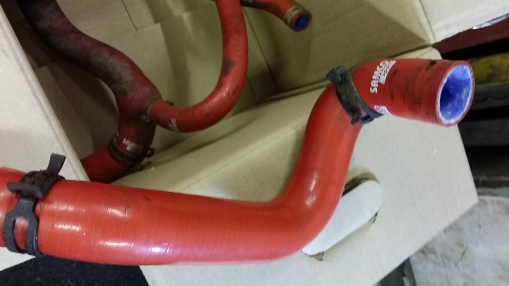

Also just paid for some Samco coolant hoses :grimacing:. Can fit them when i do cambelt as will be draining the coolant for the water pump anyway

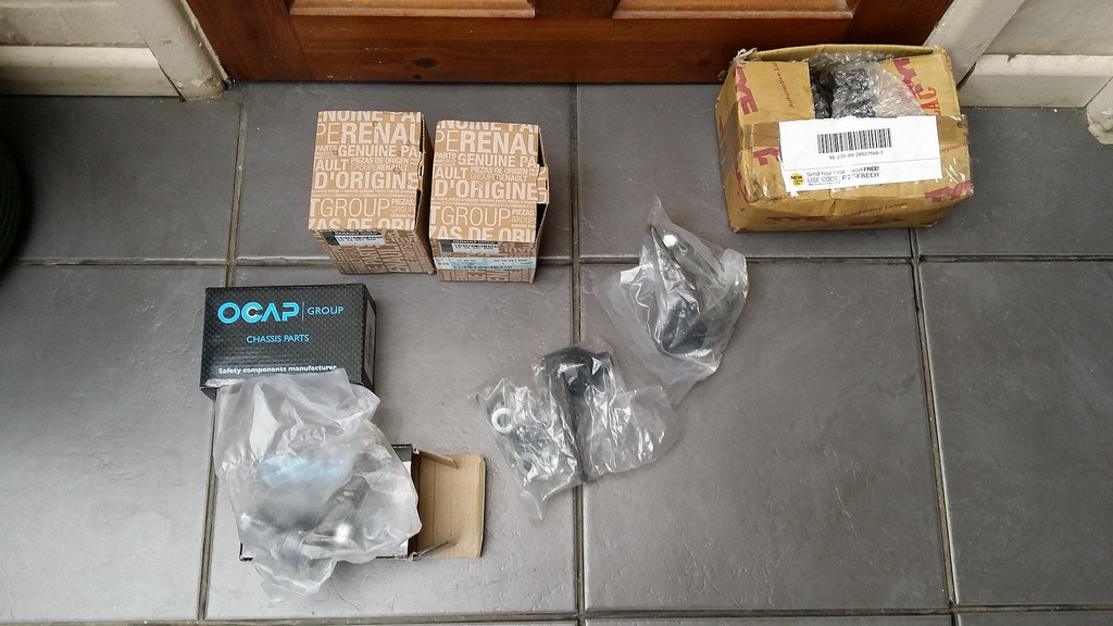

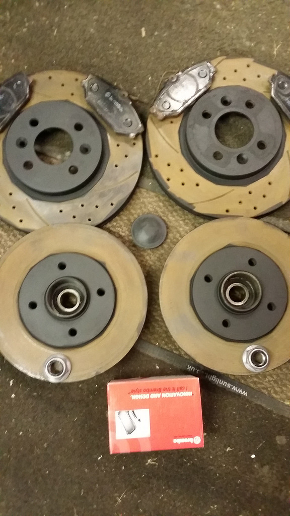

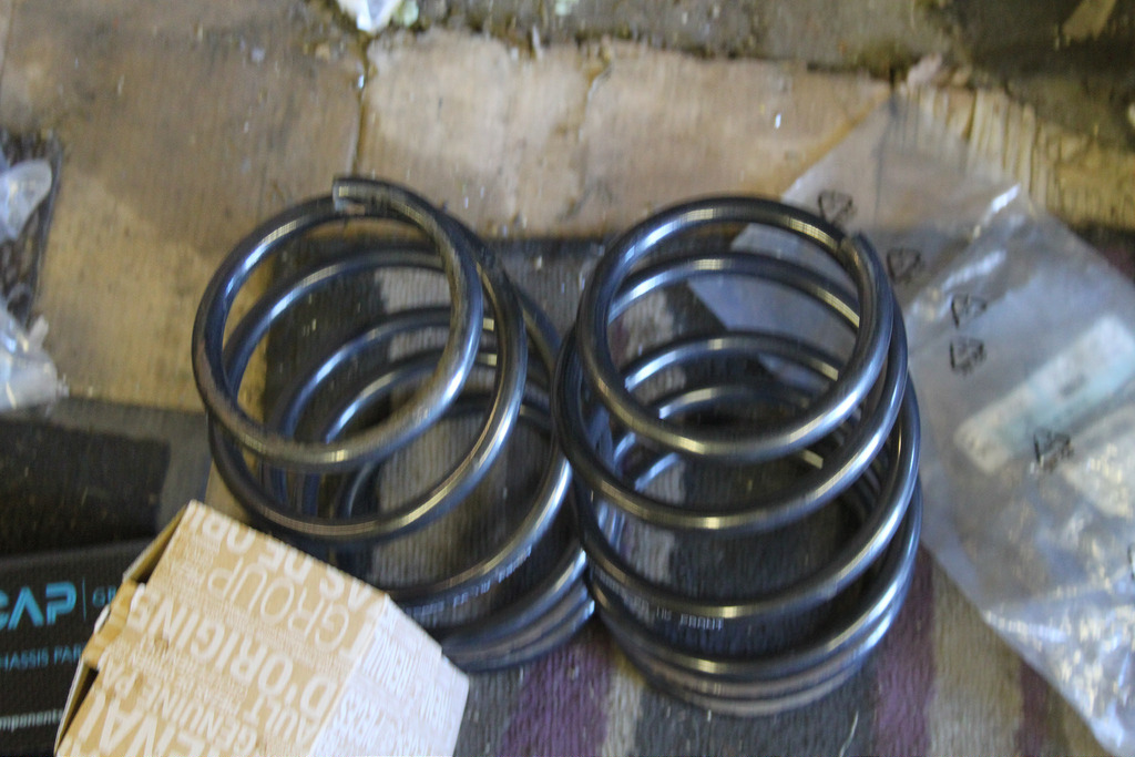

Starting to build up a collection of suspension parts, so far i have New track rod ends, ball joints, Renault top mounts along with Renault steering rack bushes on the way, just need ARB bushes now to complete the refresh. Only waiting on the key element which is the cooksports but Yodel are failing at the simplest tasks as they always do :unamused:
In the box in the top right of the pic is a replacement rear caliper that i can use to scavenge parts off to sort mine out.
20150923_165025 by felixta22, on Flickr

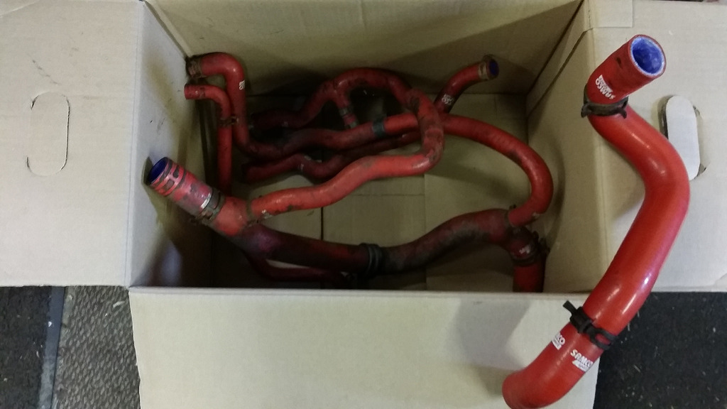

On the other hand i have recieved my Samco coolant hoses :grin::grin: At no point did i plan on investing in a set but managed to pick these up for £20 second hand and whilst im changing my water pump i thought i might as well change the hoses to these. Have started to clean them up and they are coming up great :smile:. Going to be a nice touch to the engine bay.
20150923_160759 by felixta22, on Flickr
20150923_160803 by felixta22, on Flickr
+1 to Yodel suck. Had to collect my parcel from the depot in the next friggin city as they failed to deliver to my house after TWO weeks! Absolute bunch of mothsarffashjknvv2.. Gonna stop before I unleash the serious hate.
Hoses looking awesome and bargain! Some reason I chose the hardest colour to come by and can only get them new at near £200 😢
Will away the completed and fitted look :cool:

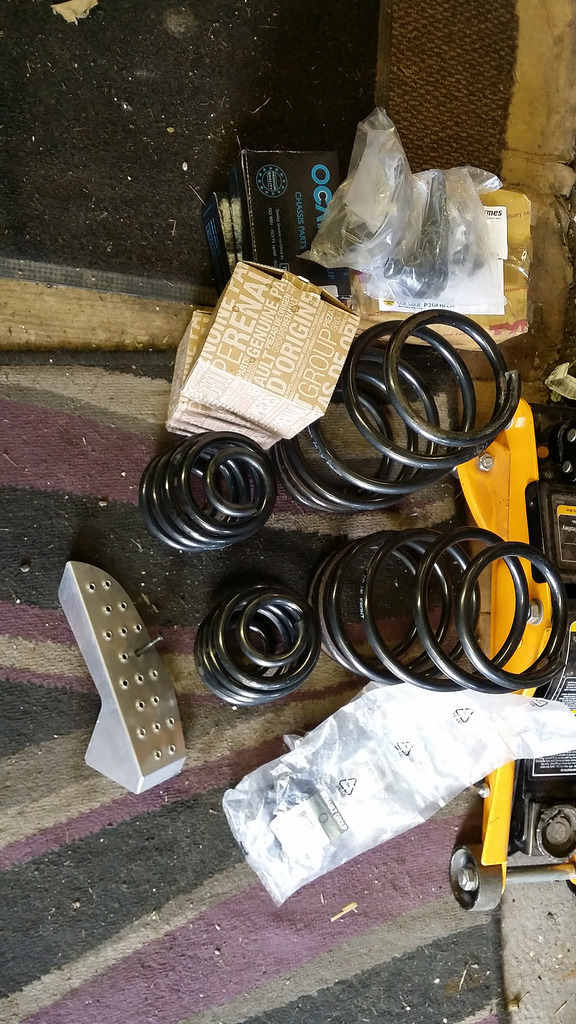

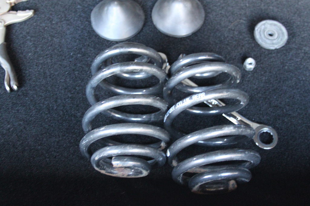

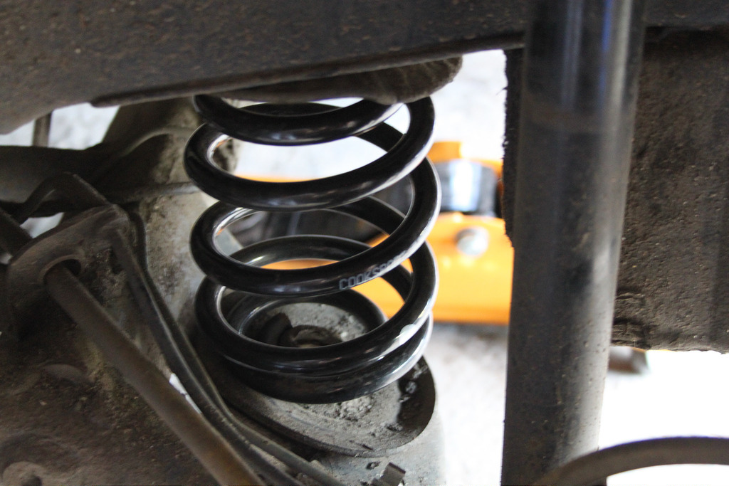

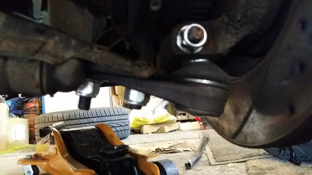

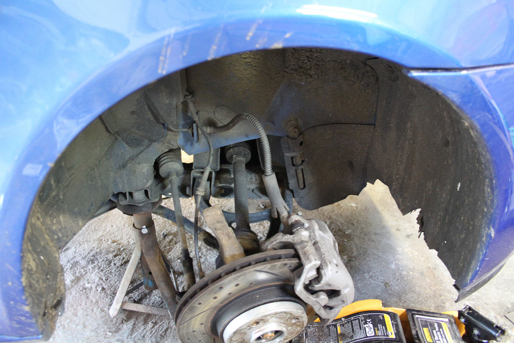

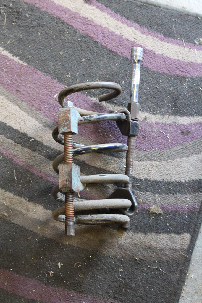

On the weekend i fitted Cooksports, Genuine new top mounts, Track rod ends and ball joints.
Pile of new stuff:
20150926_124622 by felixta22, on Flickr
Onto the fitting, no particular order:
IMG_1278 by felixta22, on Flickr
20150927_093310 by felixta22, on Flickr
20150927_093317 by felixta22, on Flickr

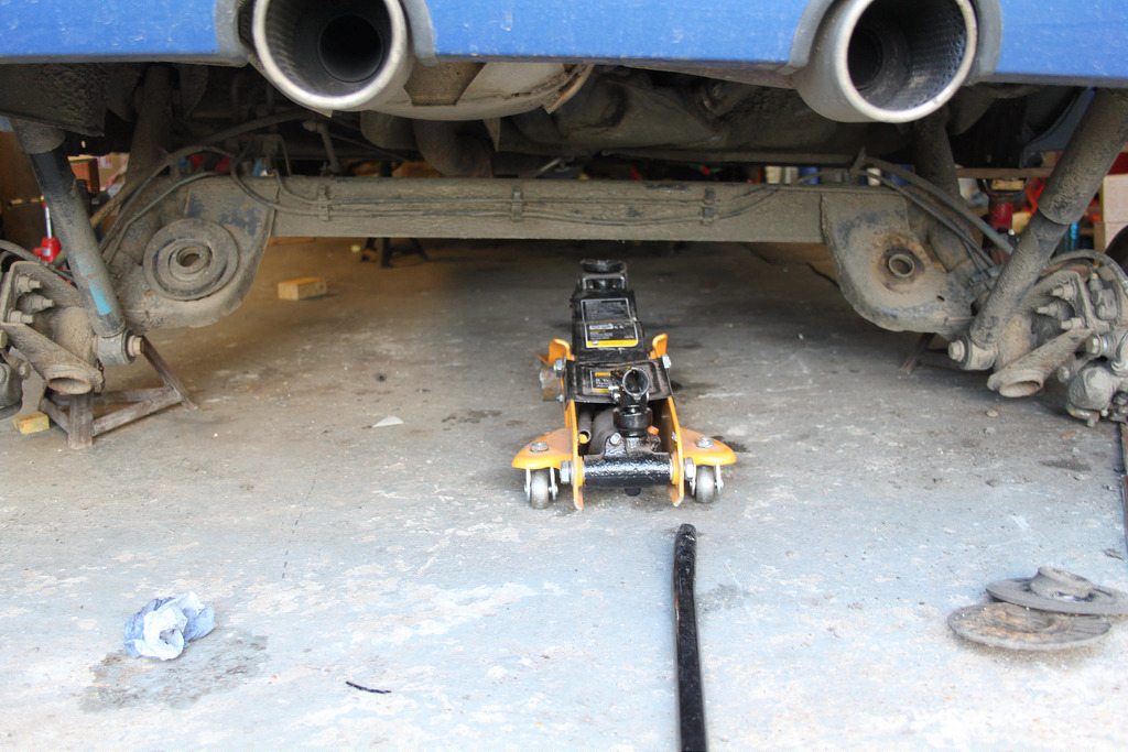

Rears:
20150926_142651 by felixta22, on Flickr
IMG_1266 by felixta22, on Flickr
IMG_1265 by felixta22, on Flickr
IMG_1267 by felixta22, on Flickr
IMG_1268 by felixta22, on Flickr
Fronts, please excuse the messy bench/garage, its on the list to tidy
20150926_142655 by felixta22, on Flickr
IMG_1269 by felixta22, on Flickr
IMG_1270 by felixta22, on Flickr
IMG_1271 by felixta22, on Flickr
IMG_1272 by felixta22, on Flickr

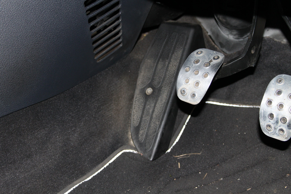

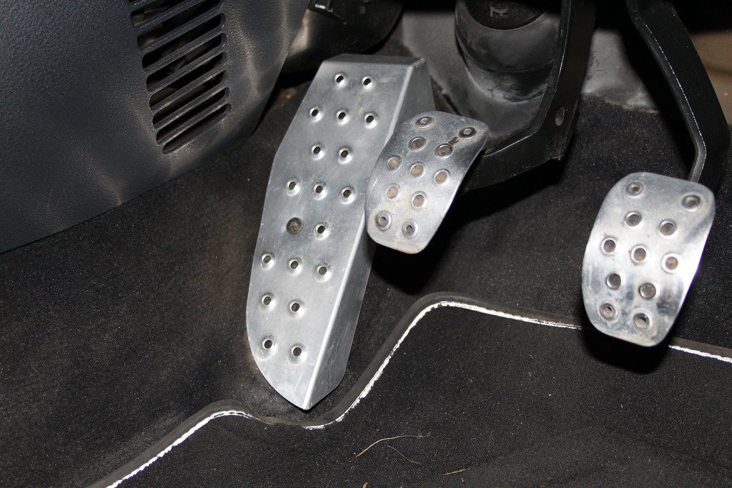

I then stopped taking pics and cracked on, new alloy footrest cover
IMG_1273 by felixta22, on Flickr
IMG_1275 by felixta22, on Flickr
