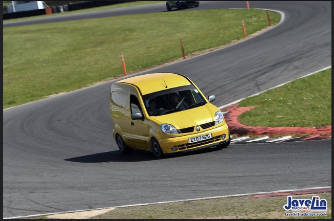

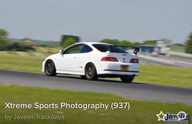

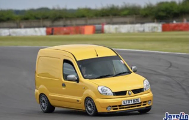

Well track day was awesome a few mates and @Craig172Kangoo only issues I had was ps fluid kept boiling up but it was fecking hot!! But yes look forward to the next!! Couple pics of bro dc5 and dads 850 to

Looks class, i bet its great fun, my old Kangoo used to handle great. Pas wise, as @Daniel said above run the pas fluid on the minimum marker and your issues will be sorted.

@Daniel @Brigsy ill probs give it a go when it was hot it was wining a bit I didn’t kno if it was due to overheating but it was hot on the day cheers for info tho👍👍I’ll deffo try it

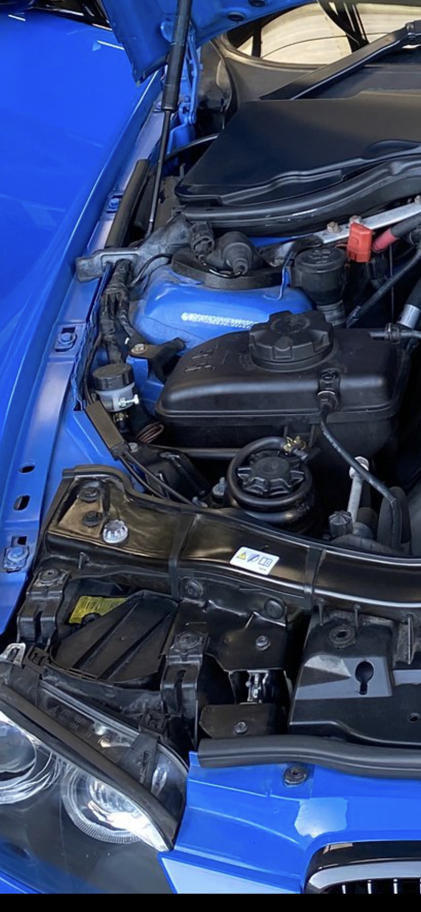

The PAS fluid always overflows on M3’s on track so the common fix is a cheap bike brake fluid reservoir to give some extra room for expansion, can see mine on the left of the bay. Cost about £7 so might be worth a try?
Cheers nice little install I’ll d have you get one did you just t off stock reservoir?
The stock reservoir already has a vent hole in the cap so the 90deg fitting pushes straight into there, it just sprays a fine mist across the engine bay on track previously but obviously didn’t want to block it off completely.
I’ve kept extra length of the rubber hose so I can unscrew the cap if needed, then there’s an existing bolt next to the wing that I’ve fixed the reservoir to. Really common fix on M3s.

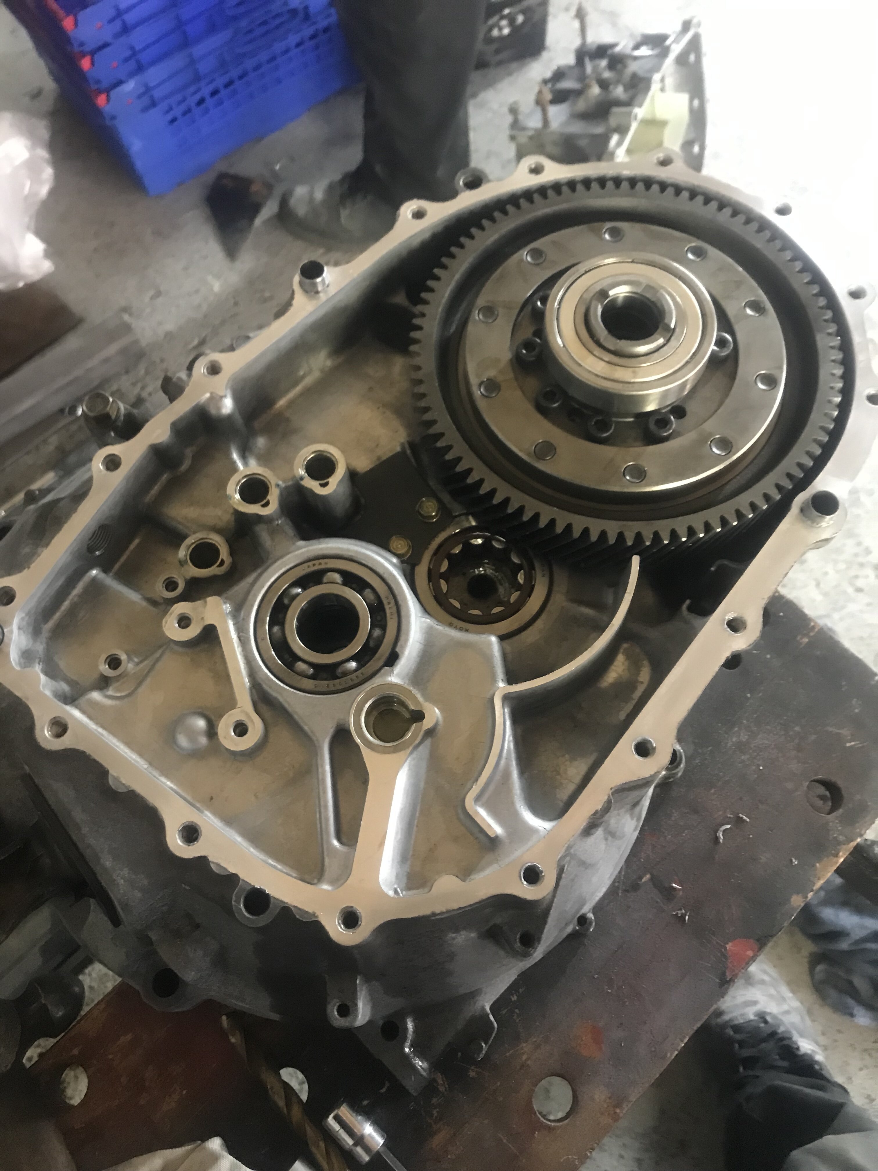

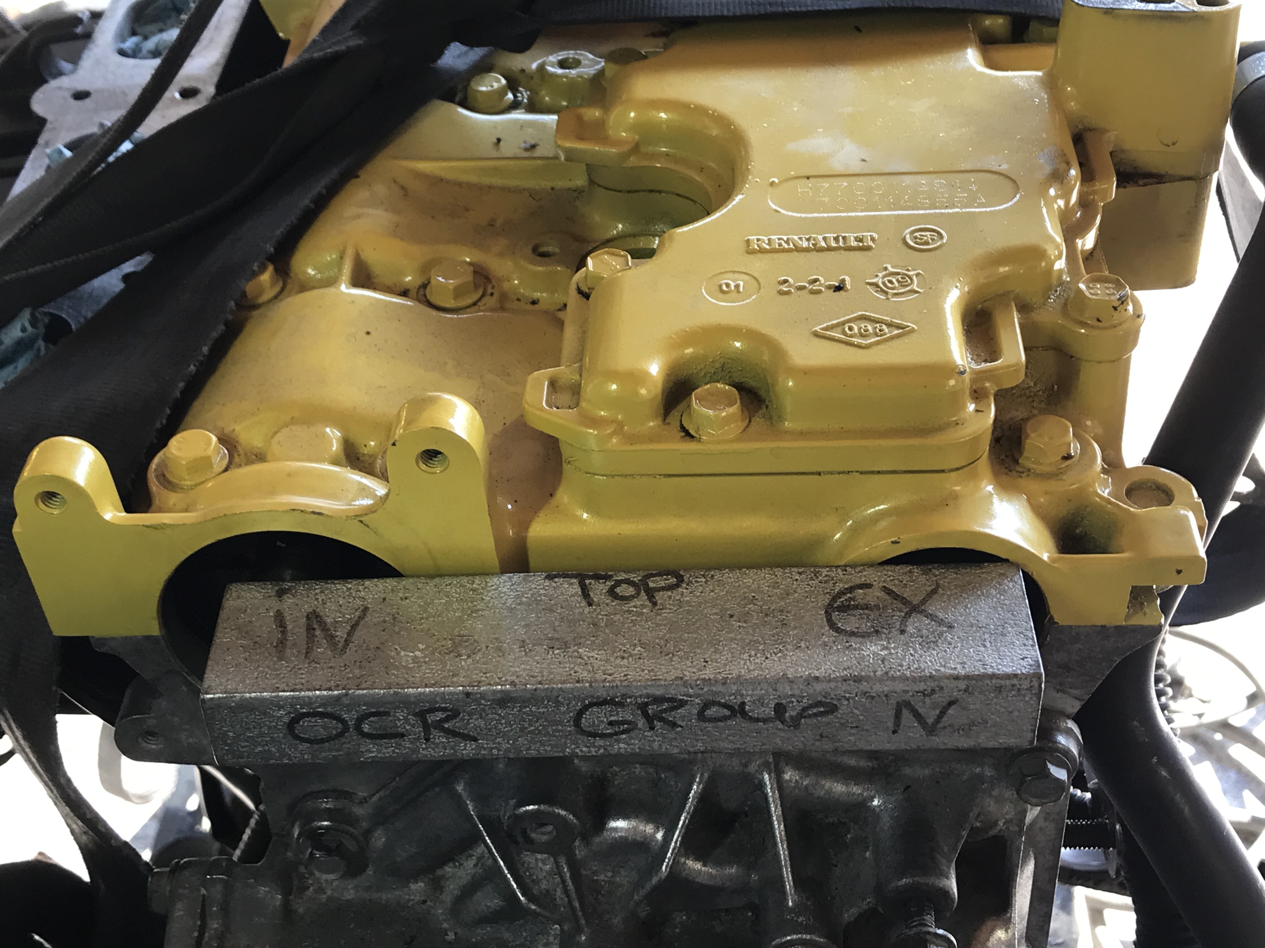

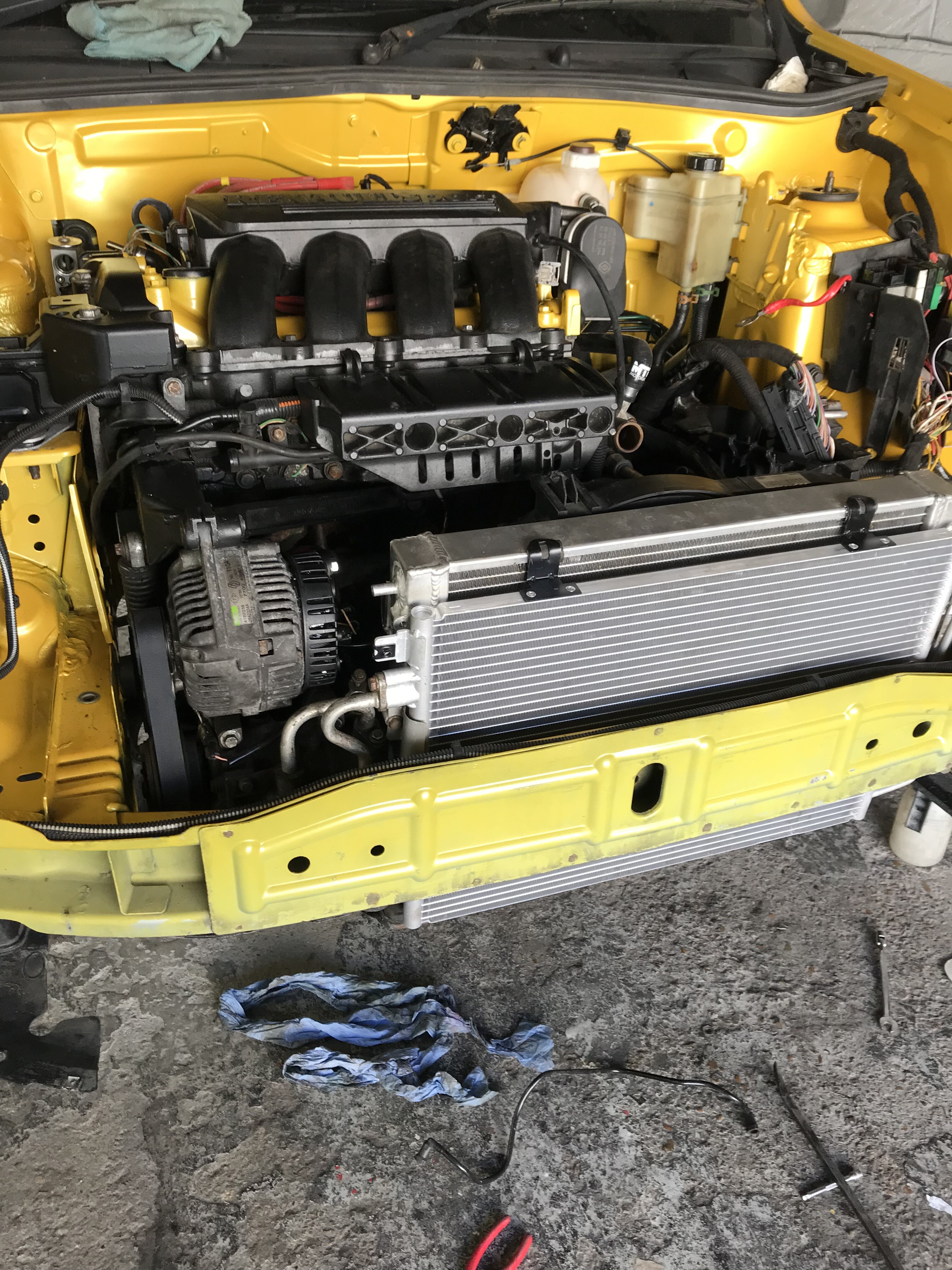

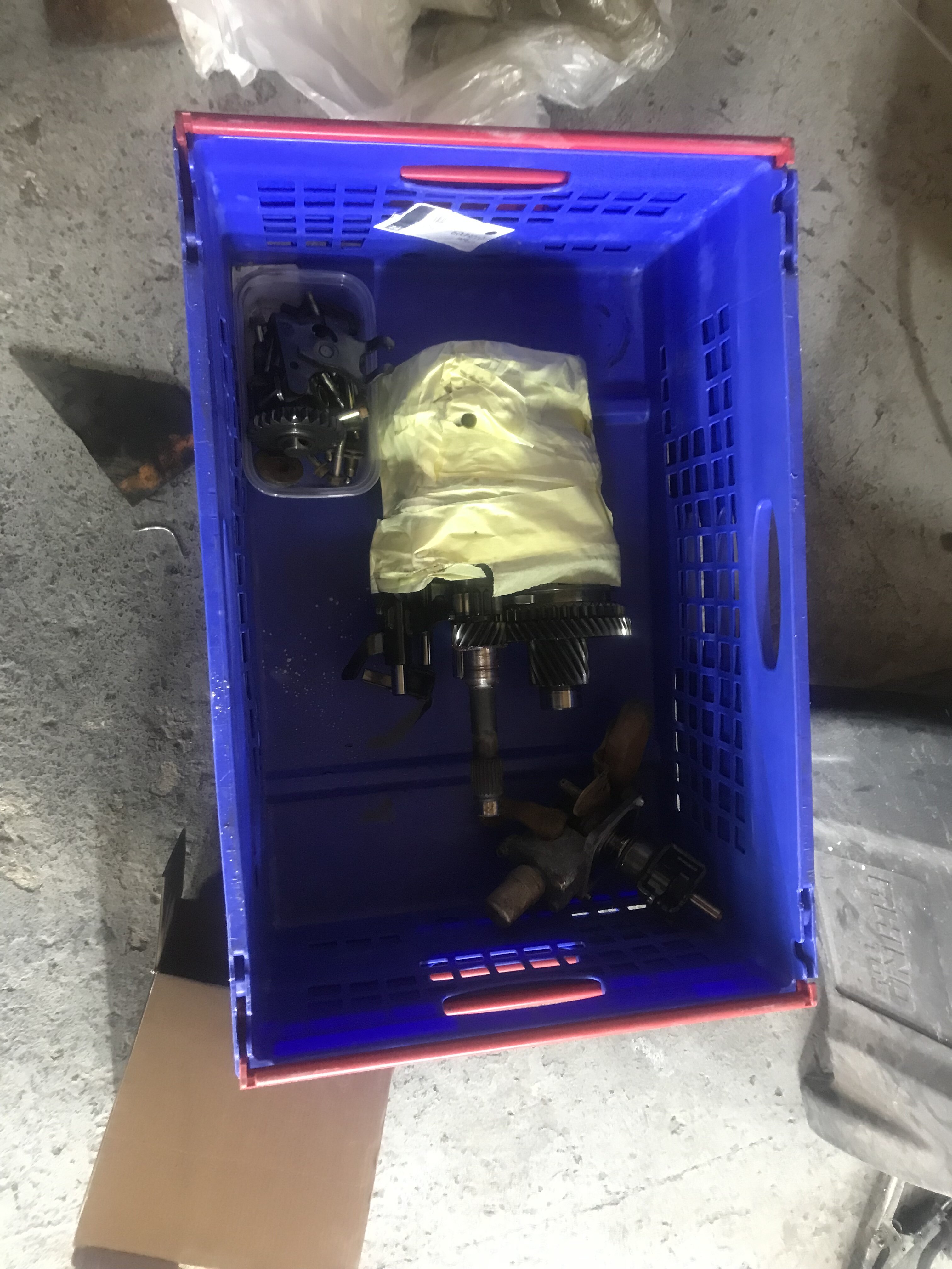

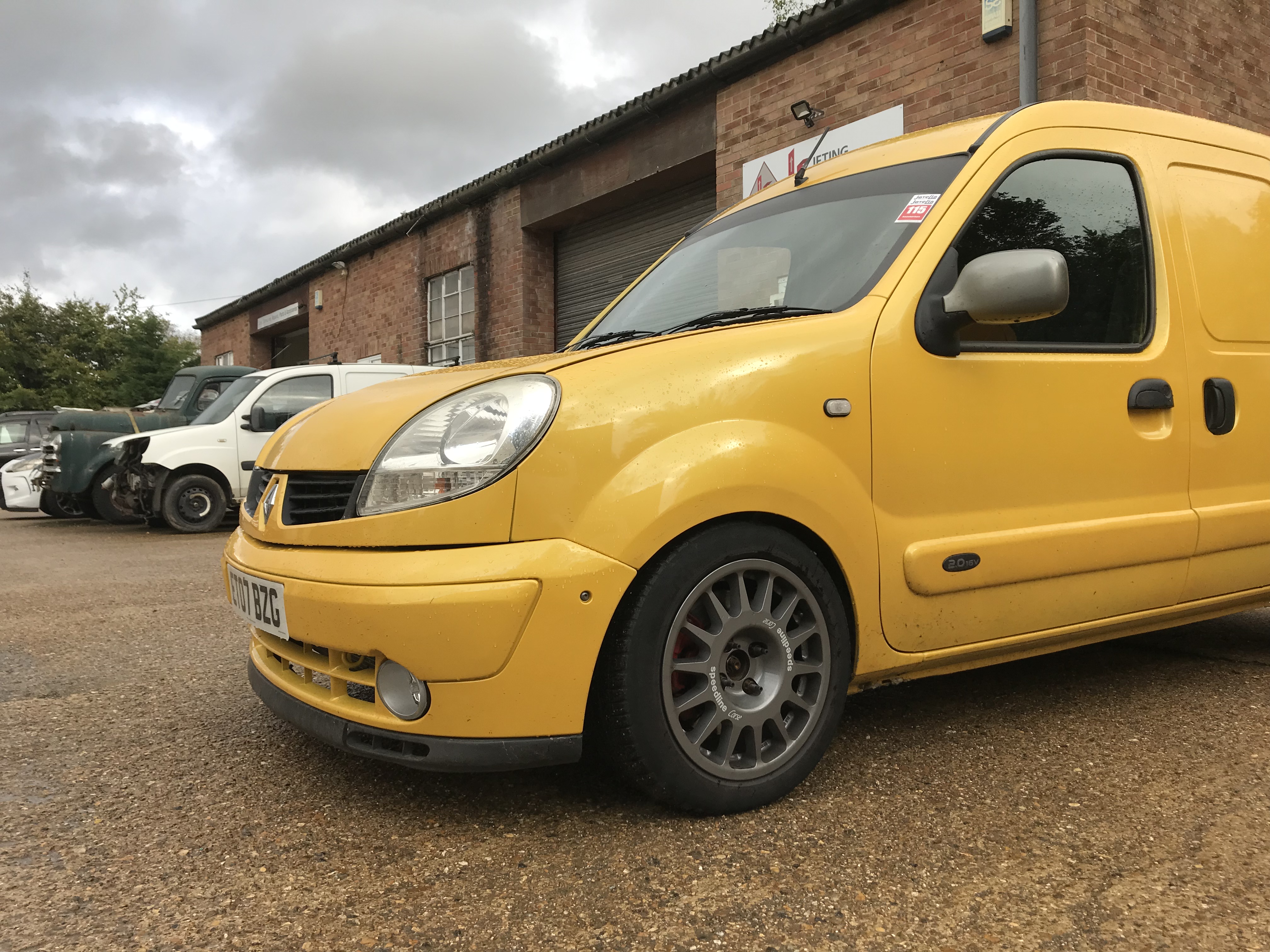

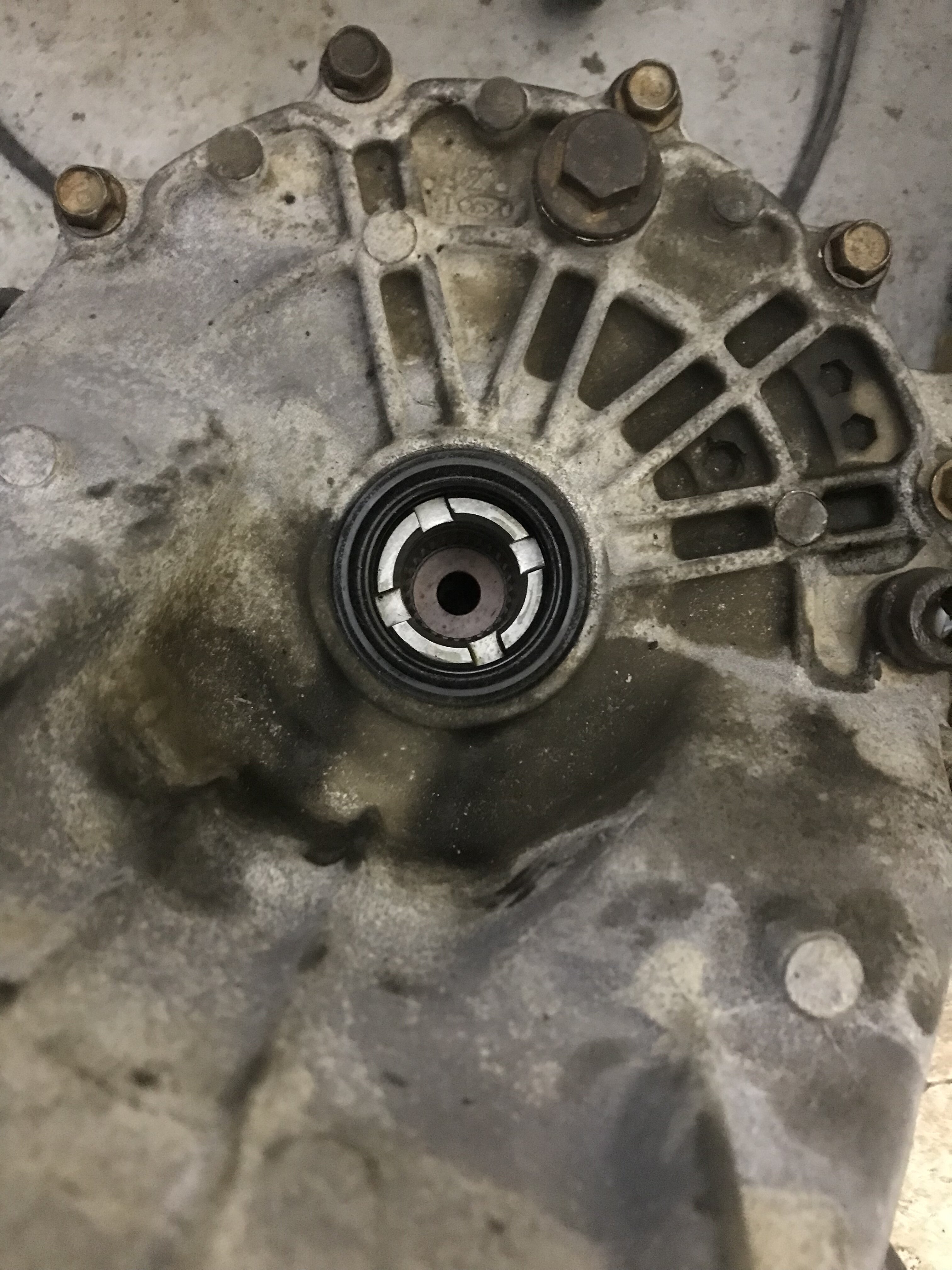

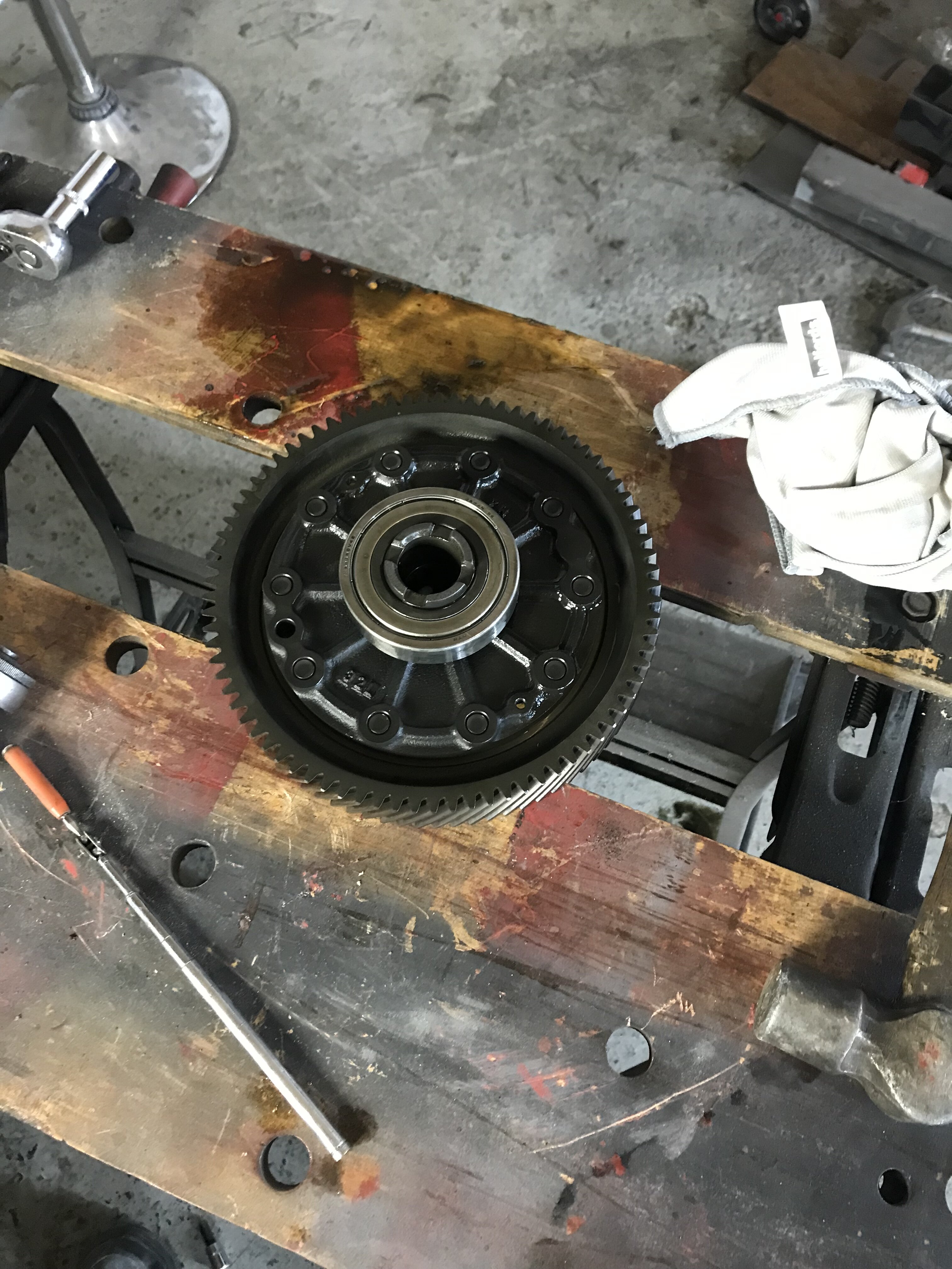

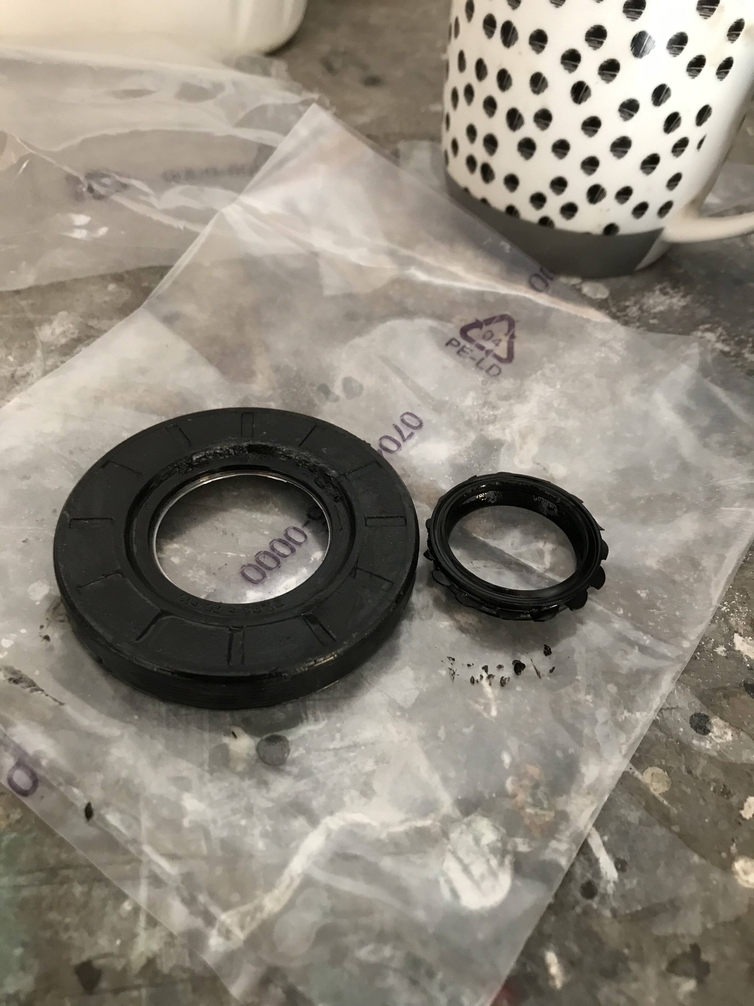

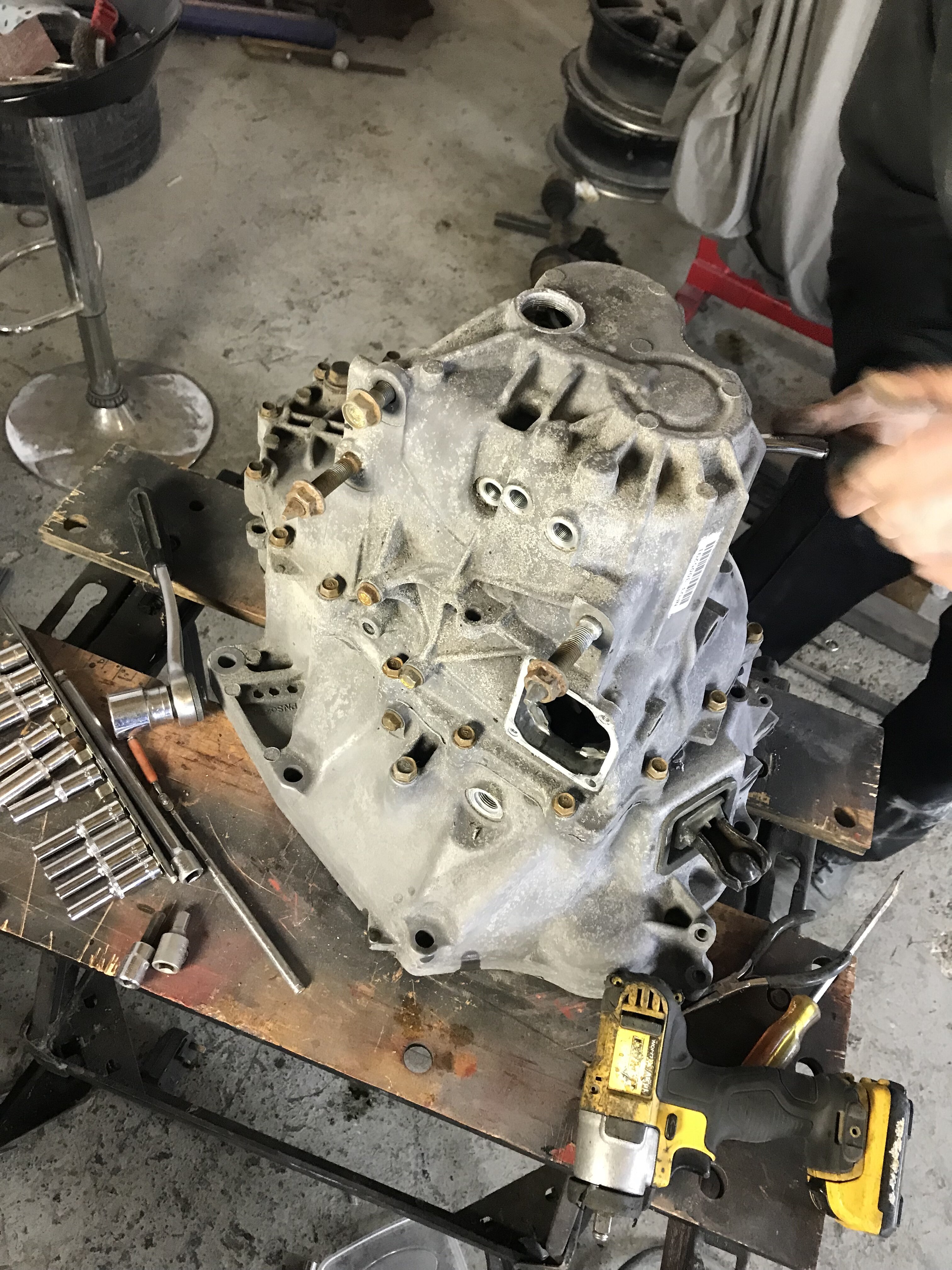

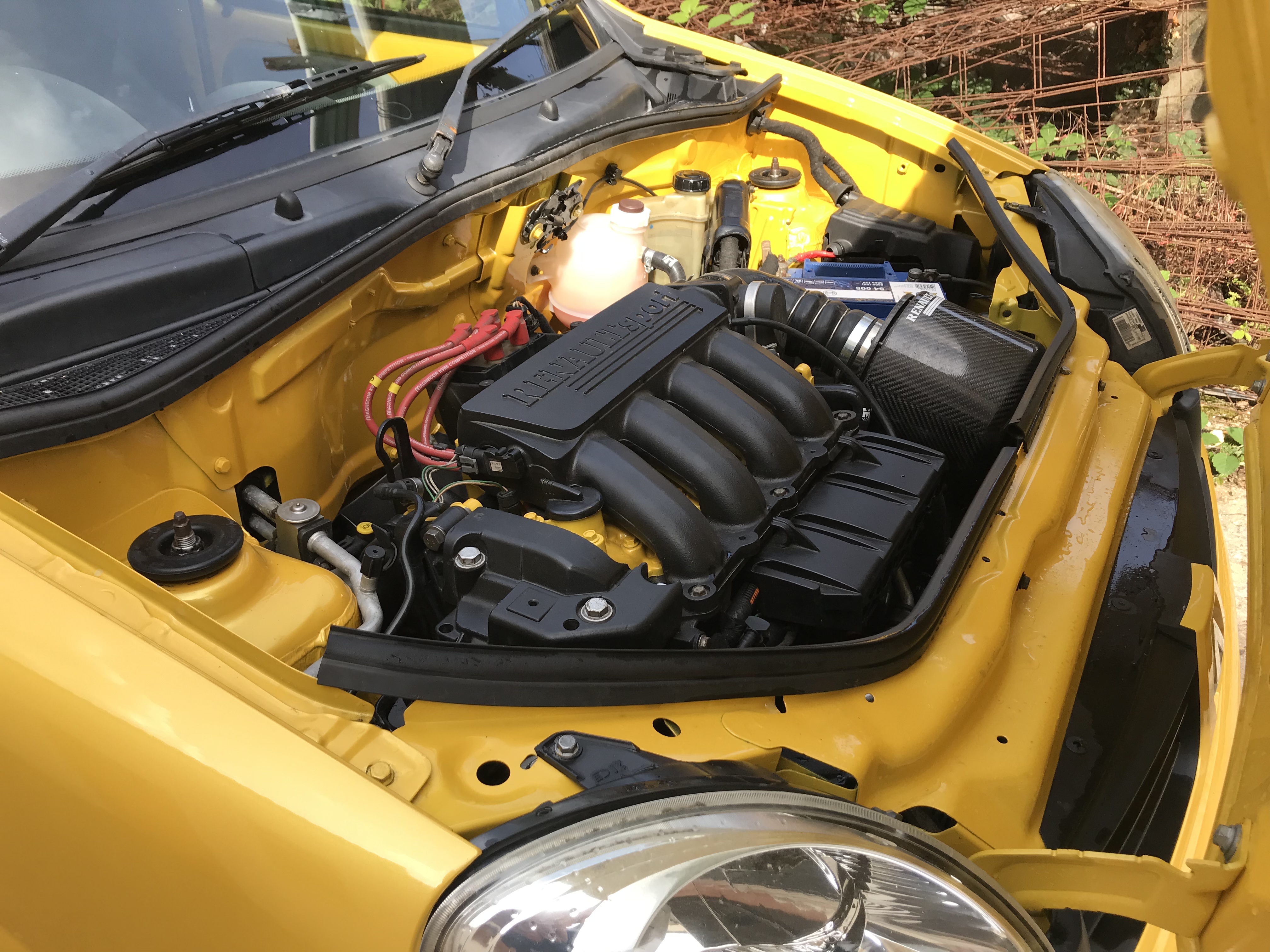

Update finally back in it again it started off as needing a gearbox oil seal.. but I decided to goto town got a new power steering pump as mine stated whining and some redline racing steering fluid I got the alternator reconditioned new gear oil I had a funny starting issue so got a new crank sensor also a new flywheel and clutch and done silicone hoses and finally new ac condenser so spoke to @NorthloopCup and he recommended group n and a light fly wheel and what a difference cheers mate and cheers again to @colesy for fro n tool

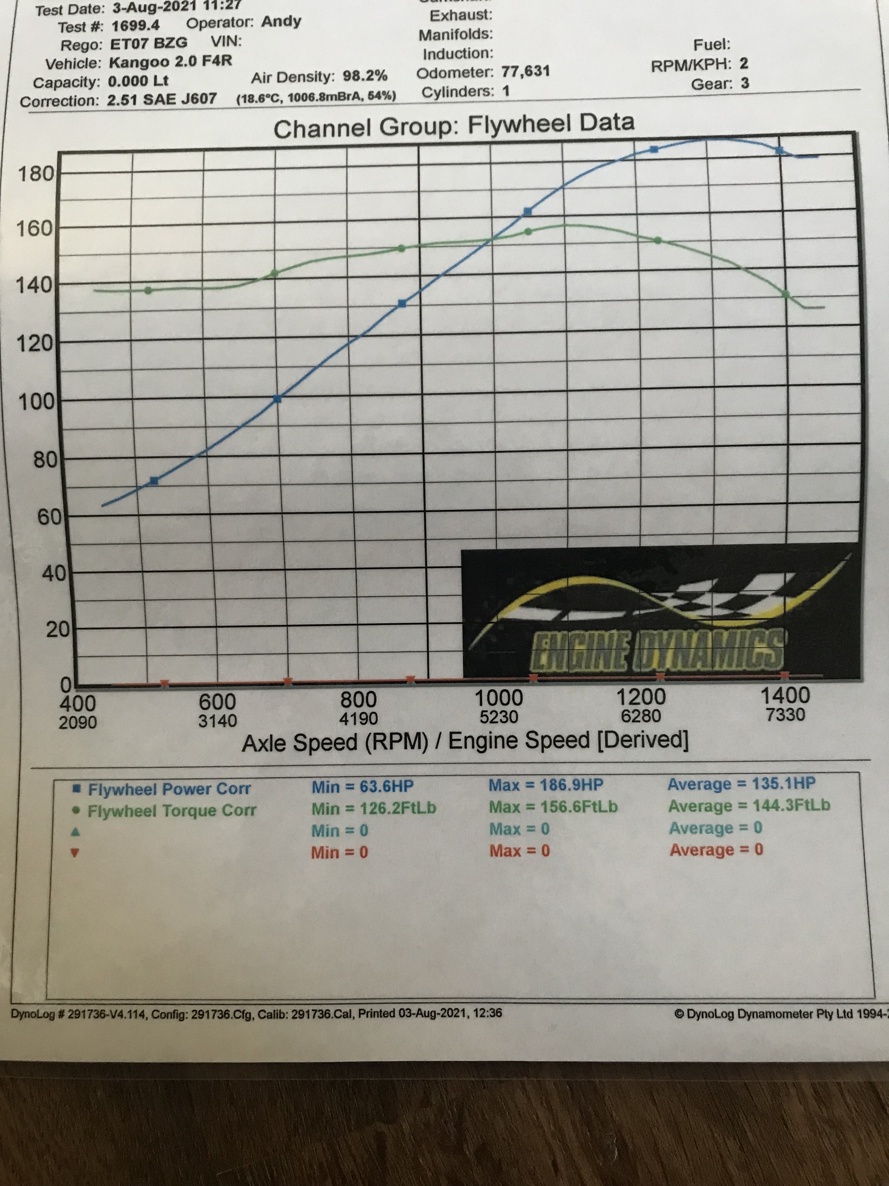

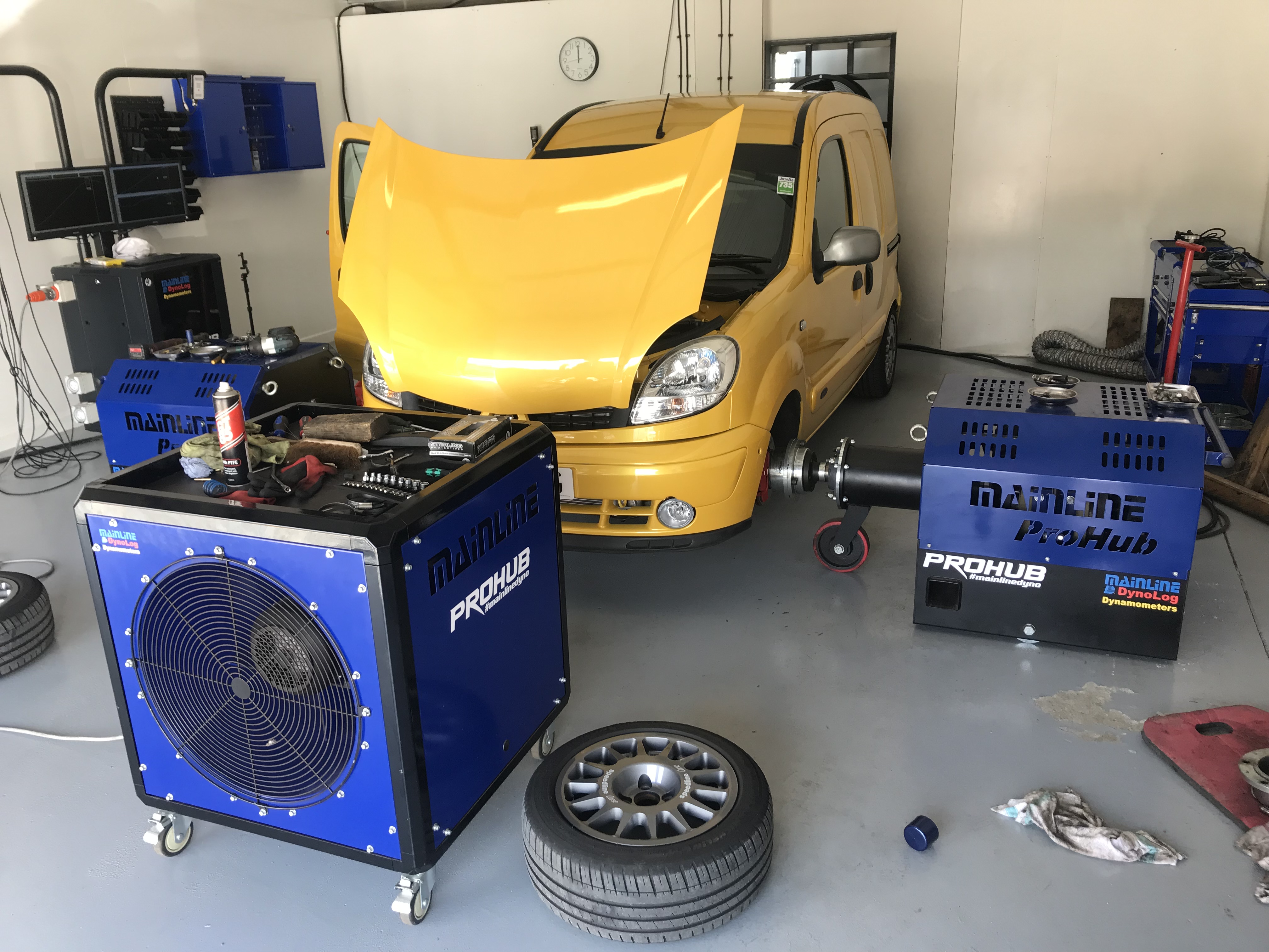

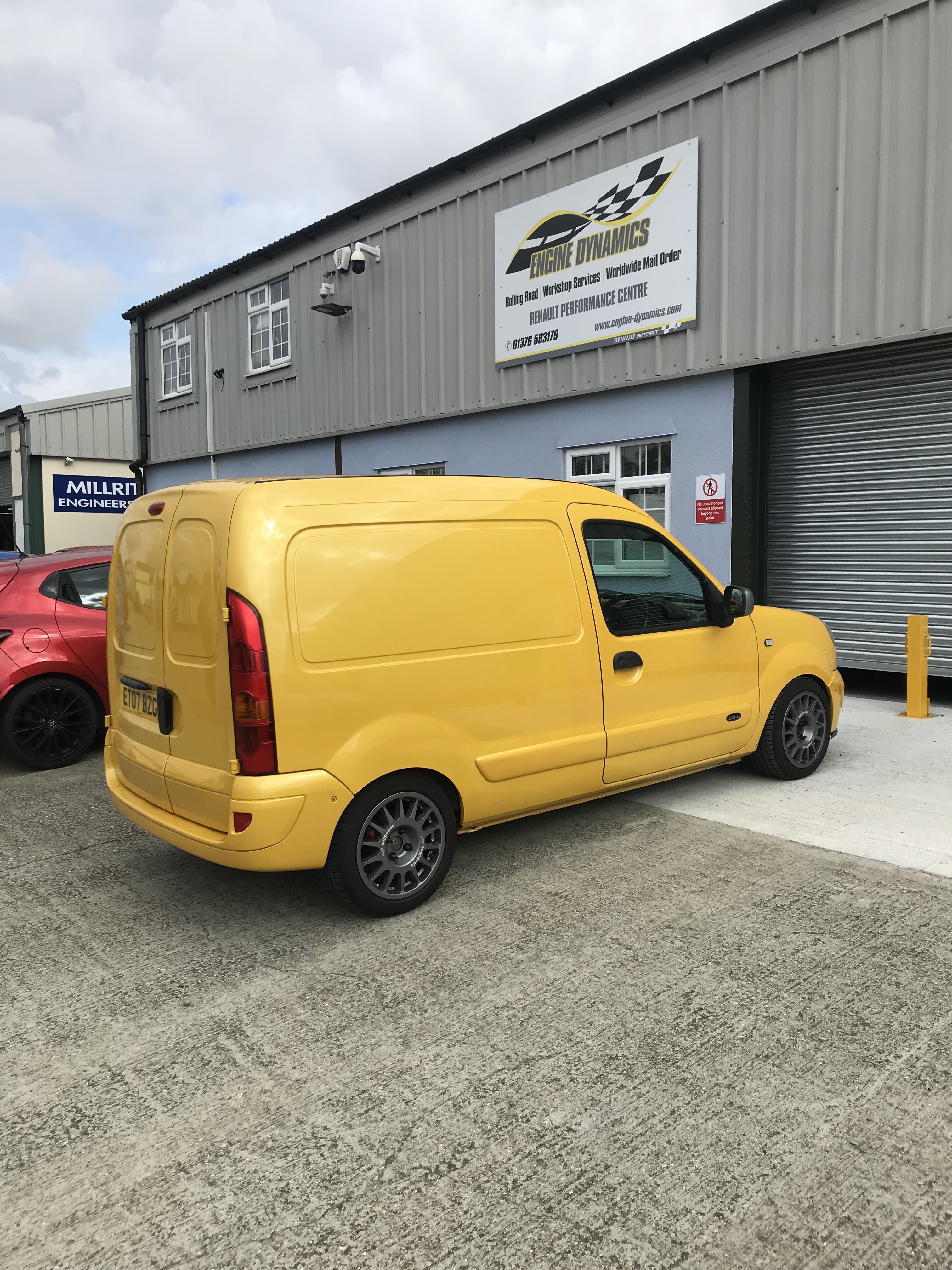

Took van to engine dynamics and made 186.9bhp and 156.6lbft I just can’t believe how much different them bits made its tranformed it immensely

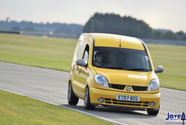

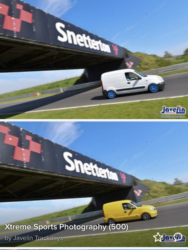

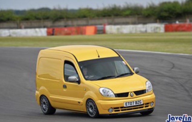

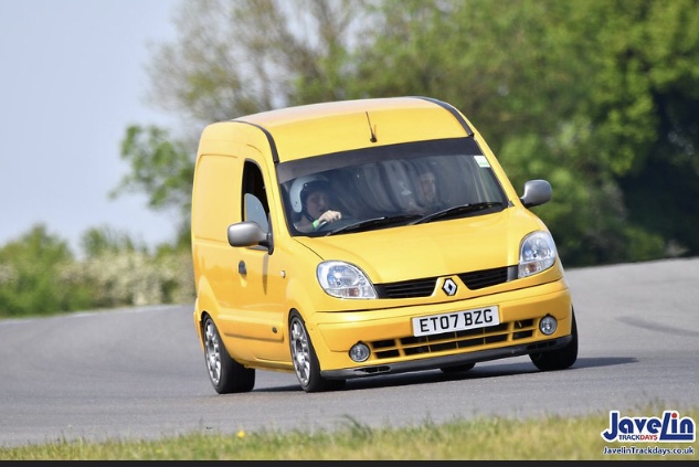

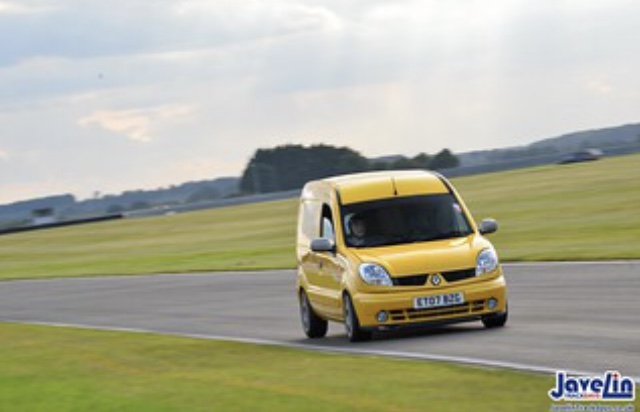

Did another track sesh was a evening and it was great fun!! Van was flawless with group n and light fly ect but obvs with steps forward there’s always one back but I can’t complain as it’s no biggie as it’s just a power steering switch has failed but made a mess 🤦🏼‍♂️ But here’s some pics anyway..

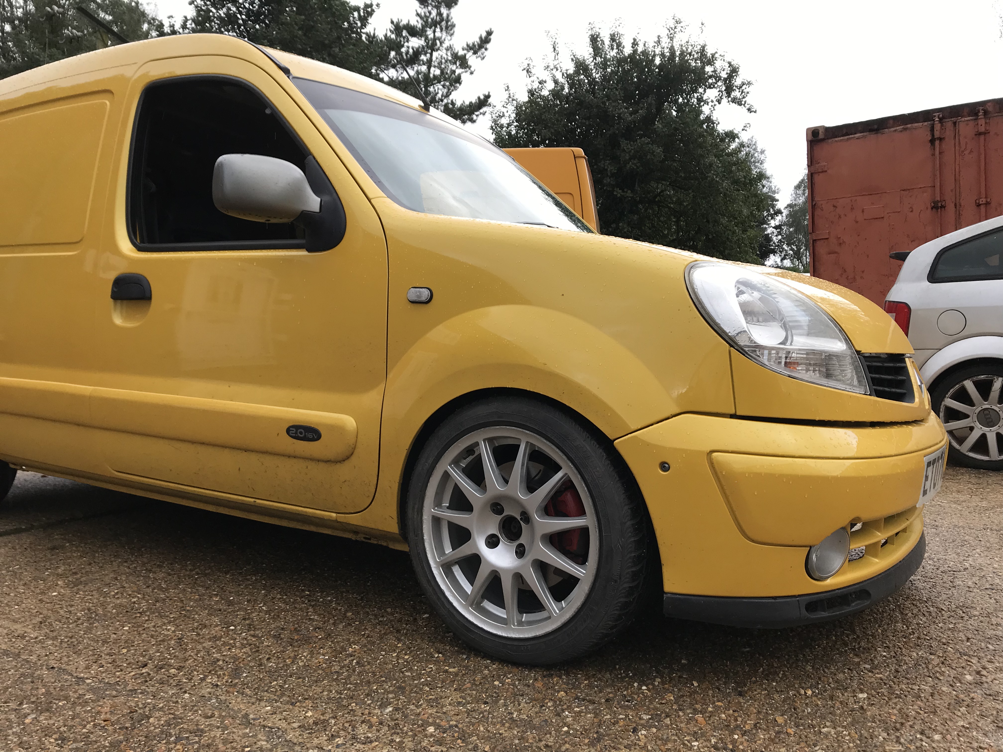

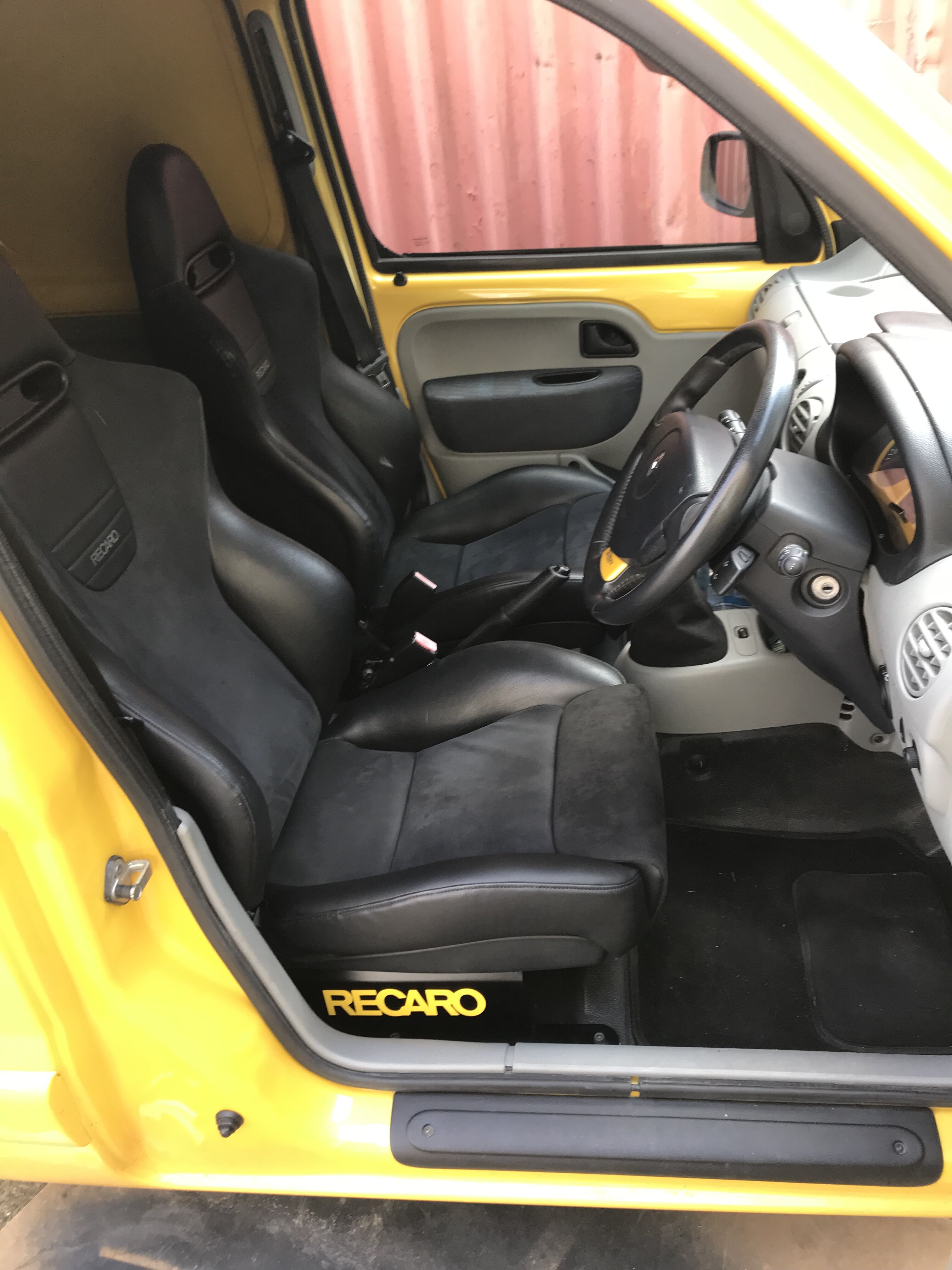

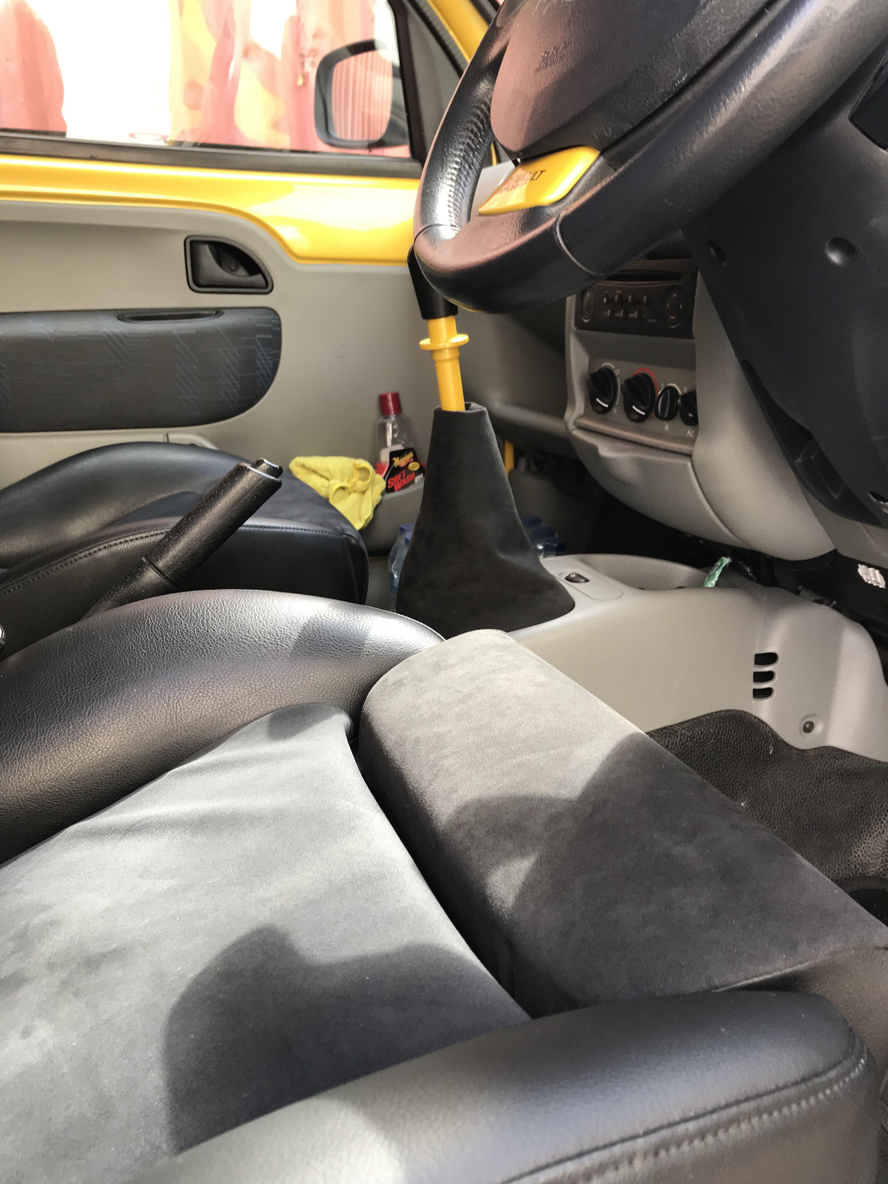

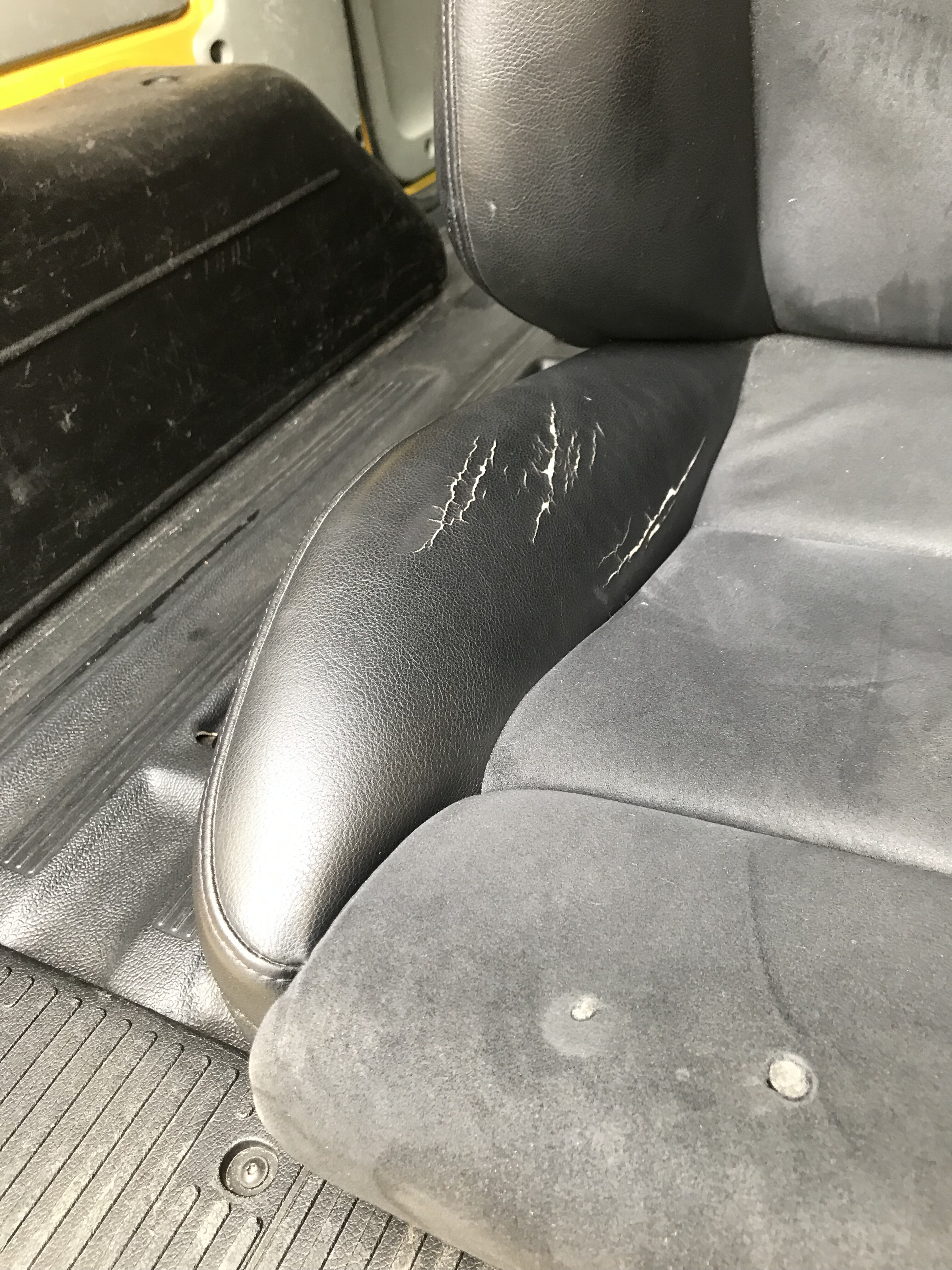

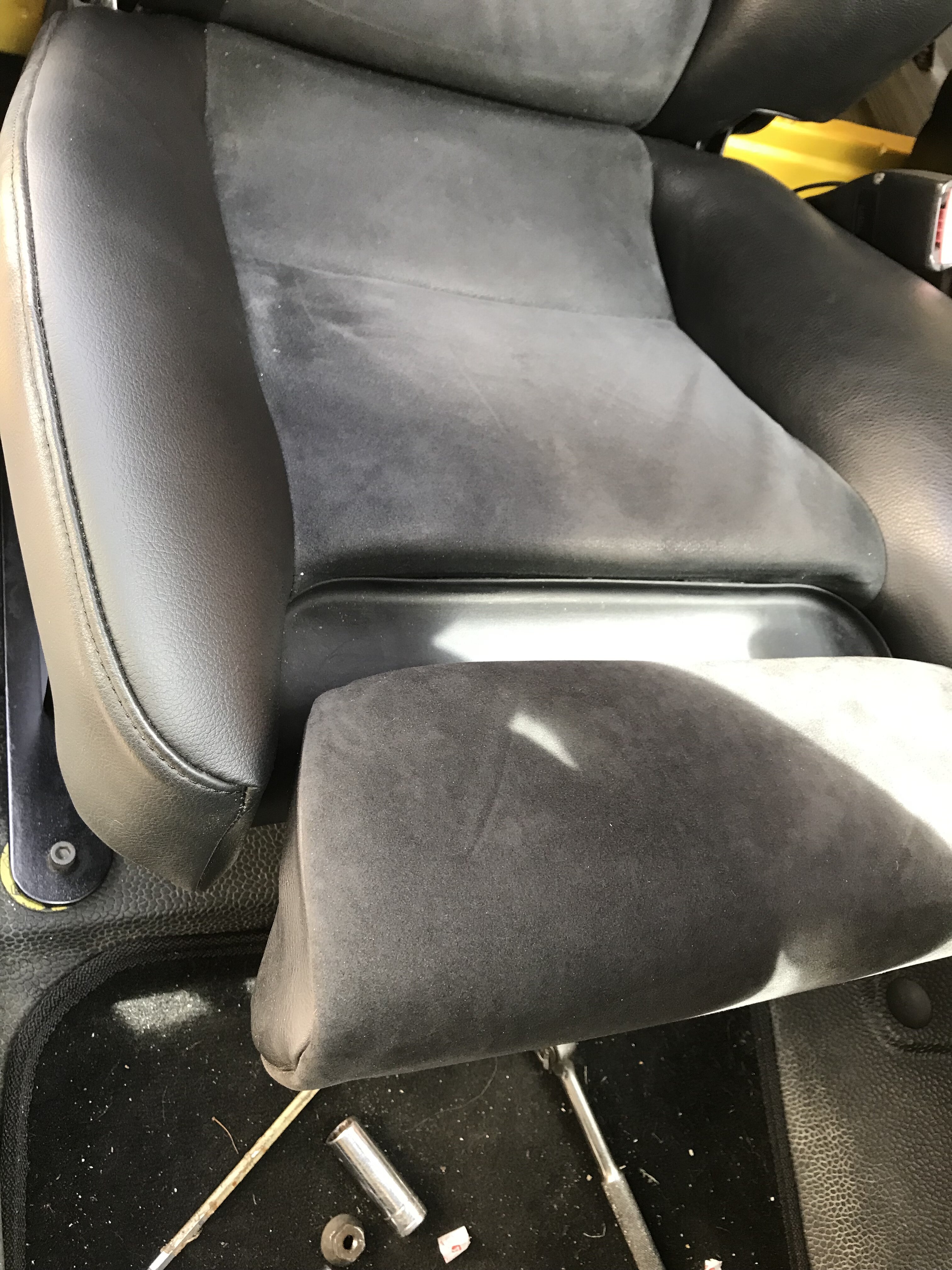

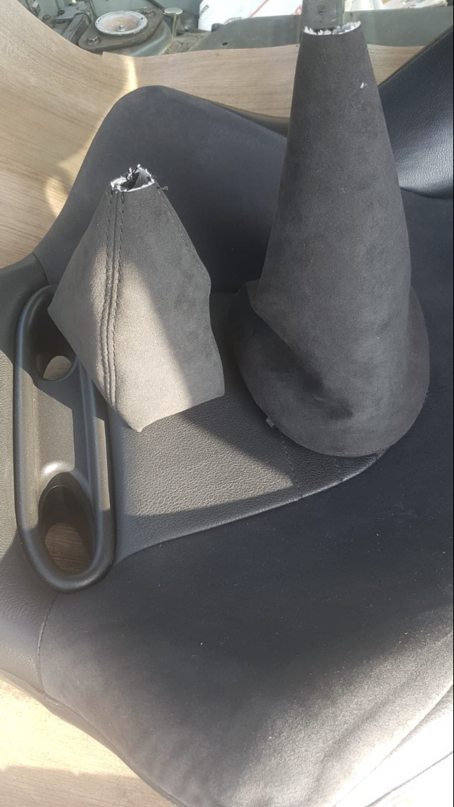

Little update got my drivers seat repaired and gear gaiter done ion kangoo and they did the gaiter in my 850 and doing a t5R steering wheel also picked up a set of cup turinis but can’t decide on silver or grey and today it was doing van duties 😱😂and I finally got my hands on a ph1 flamer👌🏿

I would love a Ph1 flamer! Good job on the seat repair too! Need to get mine if to be sorted
Cheers mate yeh I should have got the whole base (alcantara) bit done as there is a very slight color difference from fade but she matched bolster well 👍
Panda.
  850 T5
Who did your 850 gaitor chap? Mines leather and is shagged/the base is cracked. Would like suede to match the armrest etc and that looks tidy!

I’ll check them out thank you!! The plastic base on mine is fucked anyway so will find a decent second hand one and have it trimmed! Any tips on knob removal? 👀🤣

All my other manuals have broken bases they are brital and shite now!! And That’s always an awkward question 😂😂 I had my center consol out and had a a nice fitting spanner under knob and a pair of mole grips on the stick and try leaver between the two I think was the most successful way I found! it wasnt an easy knob removal I must say 😂😂

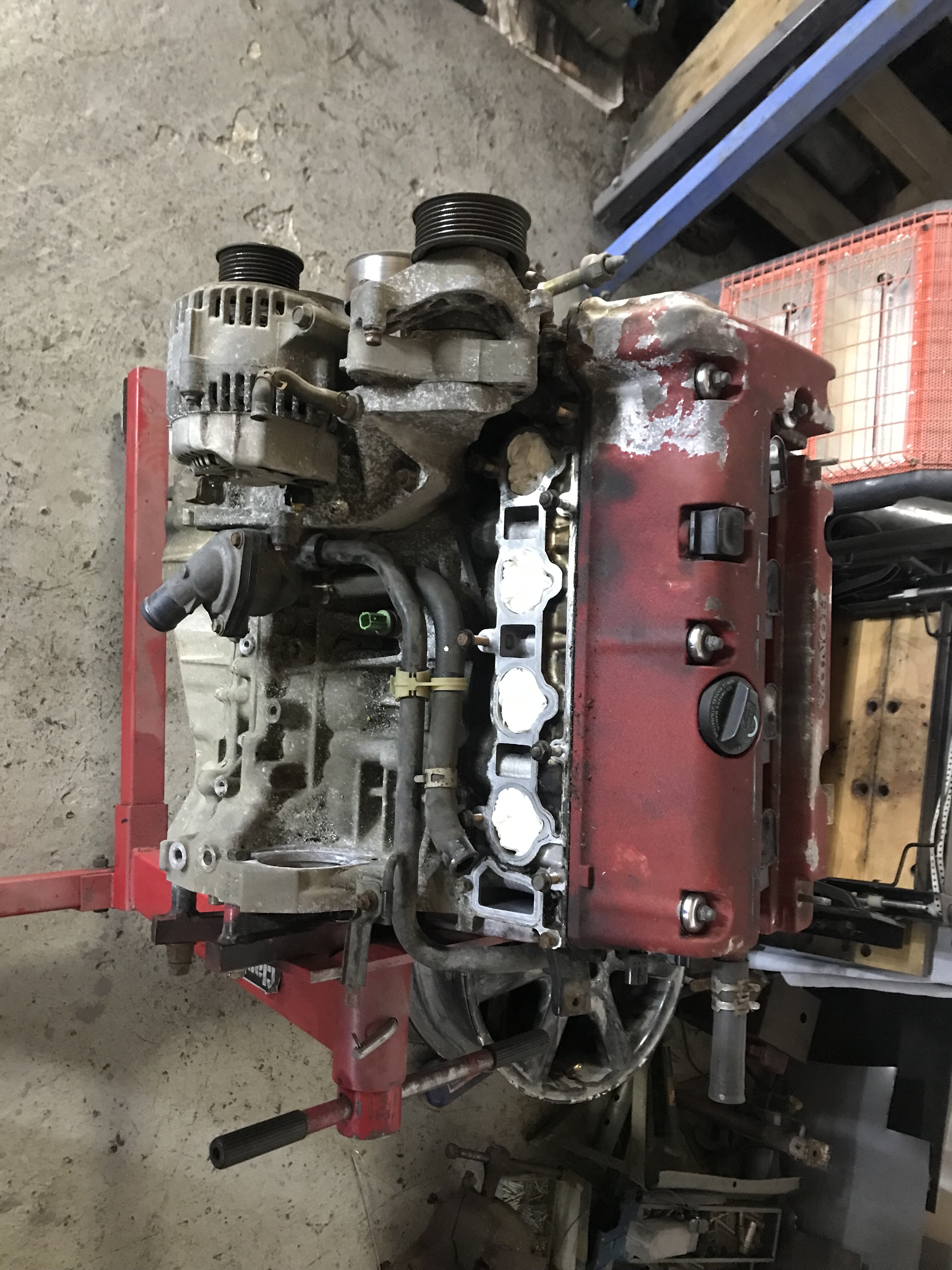

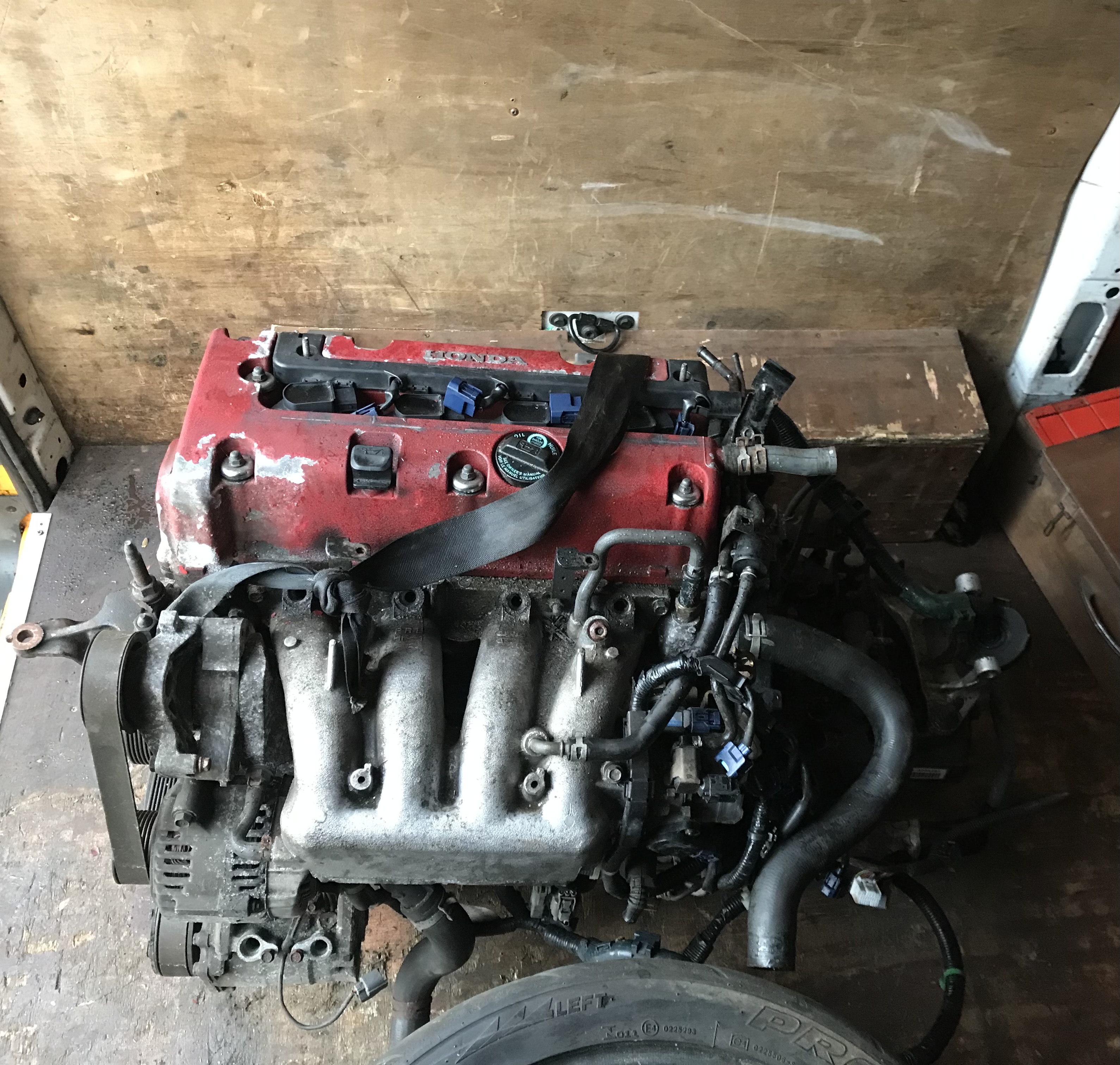

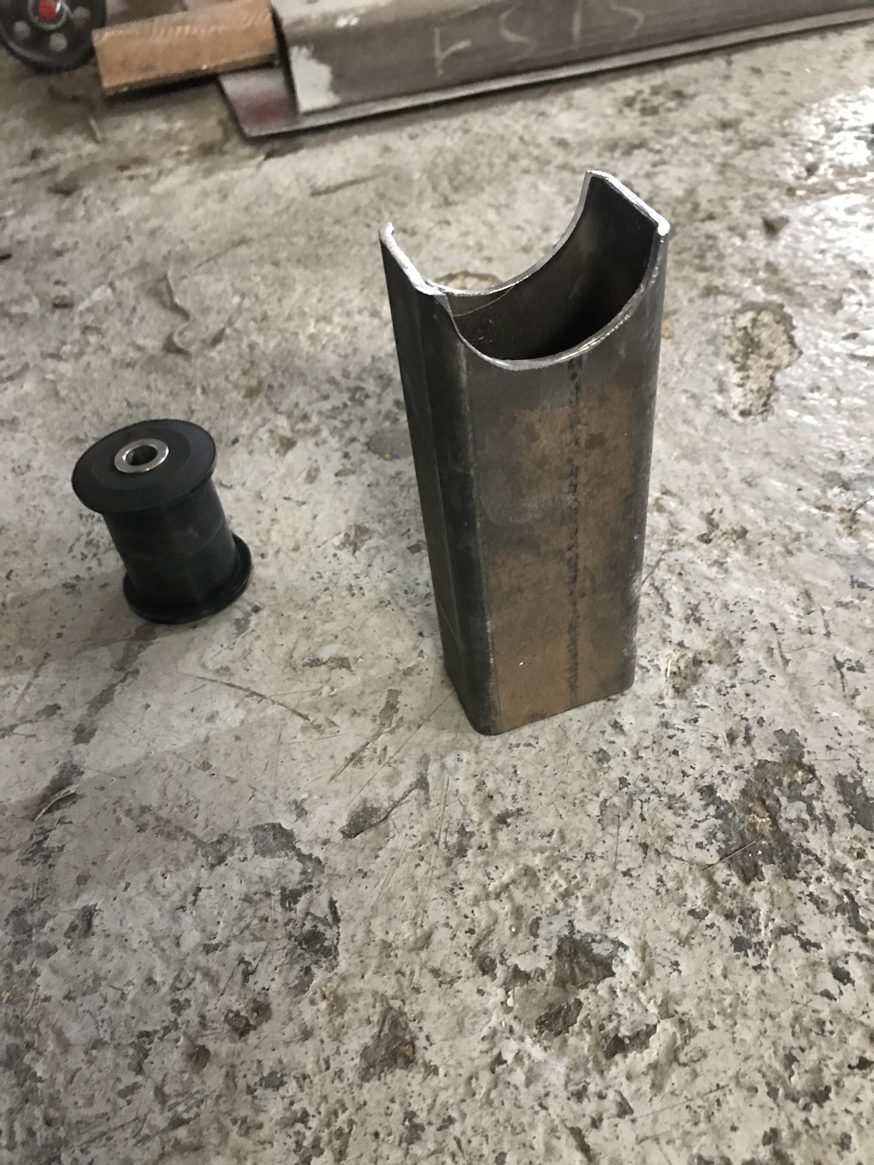

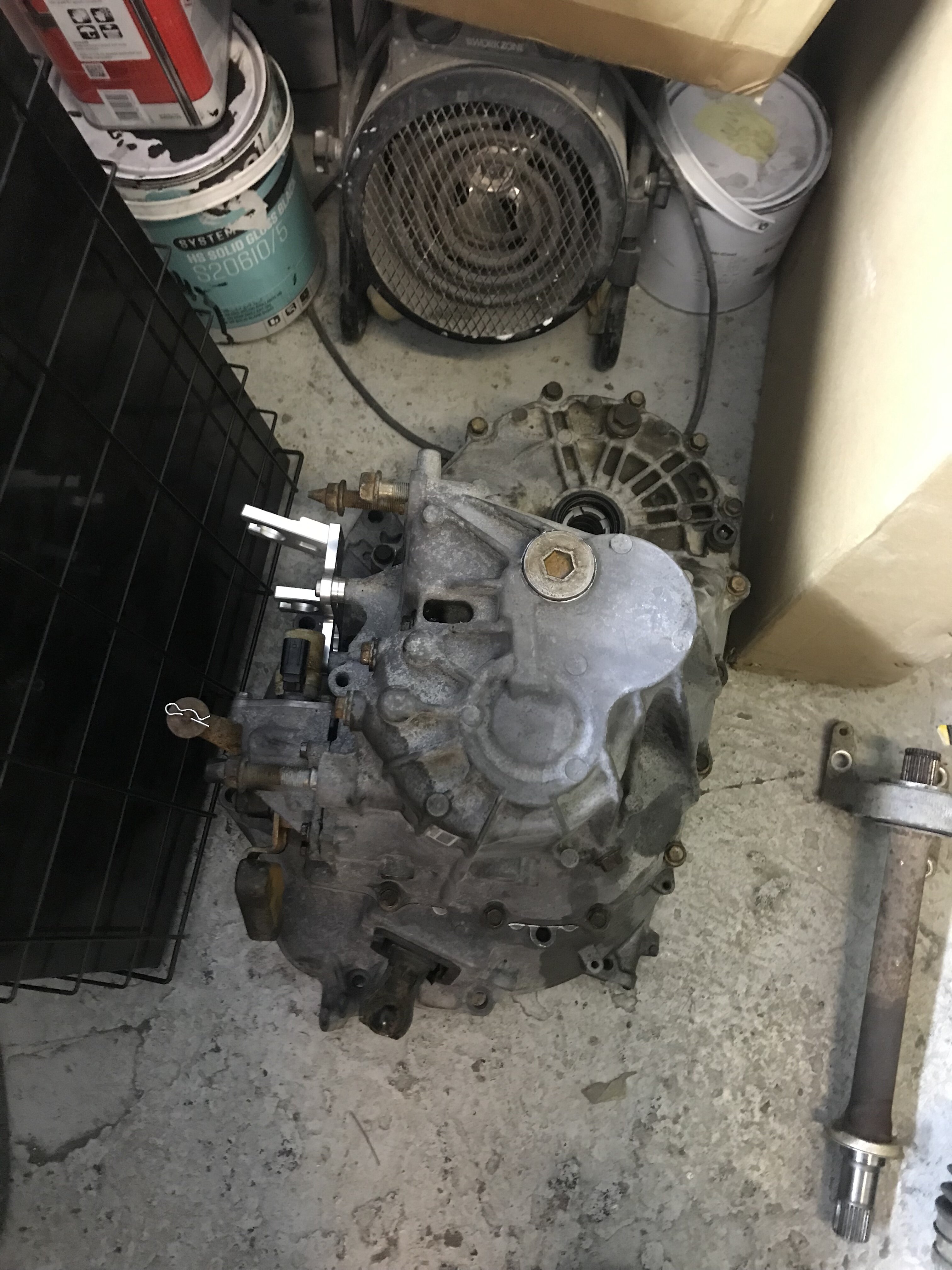

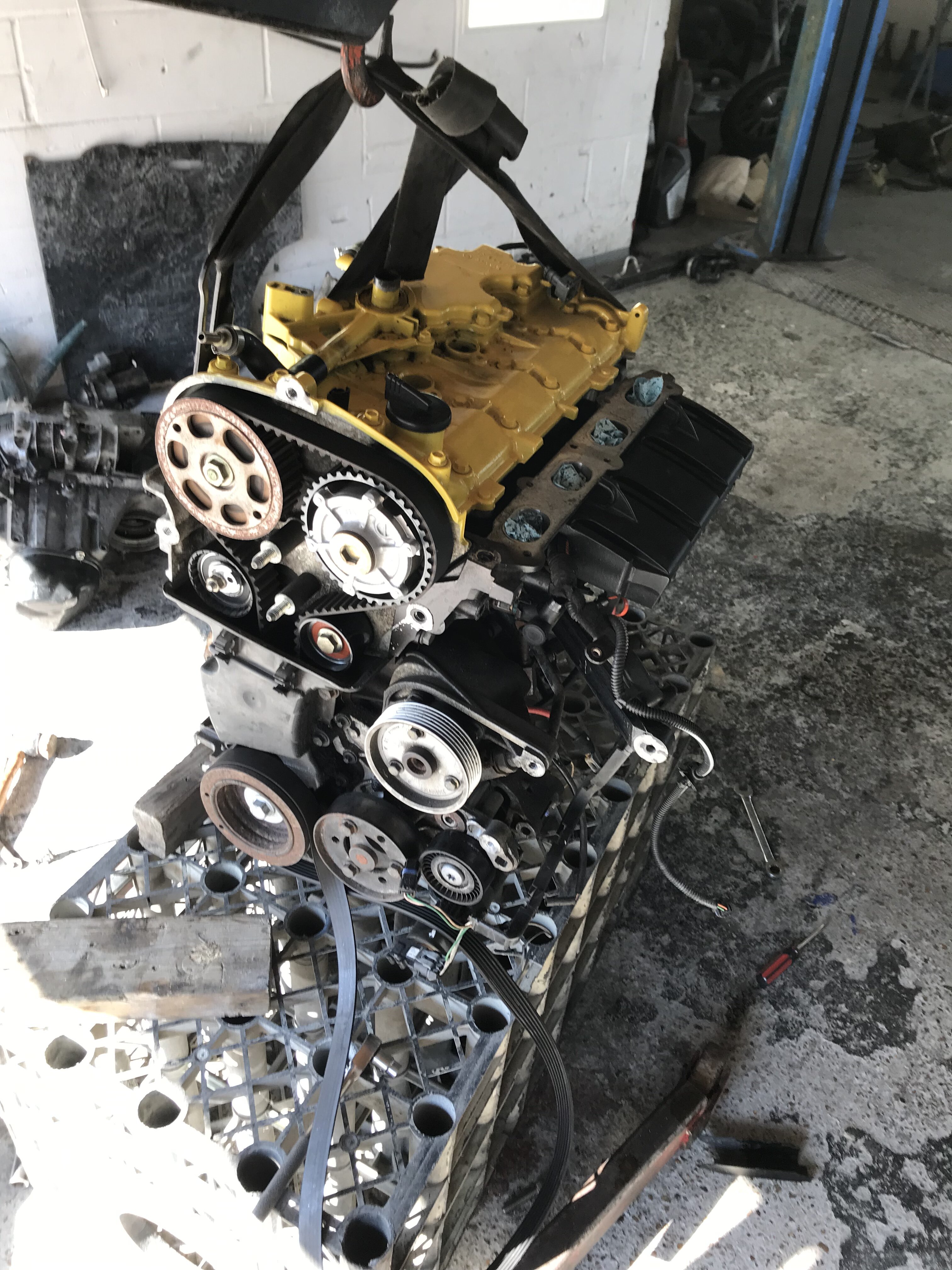

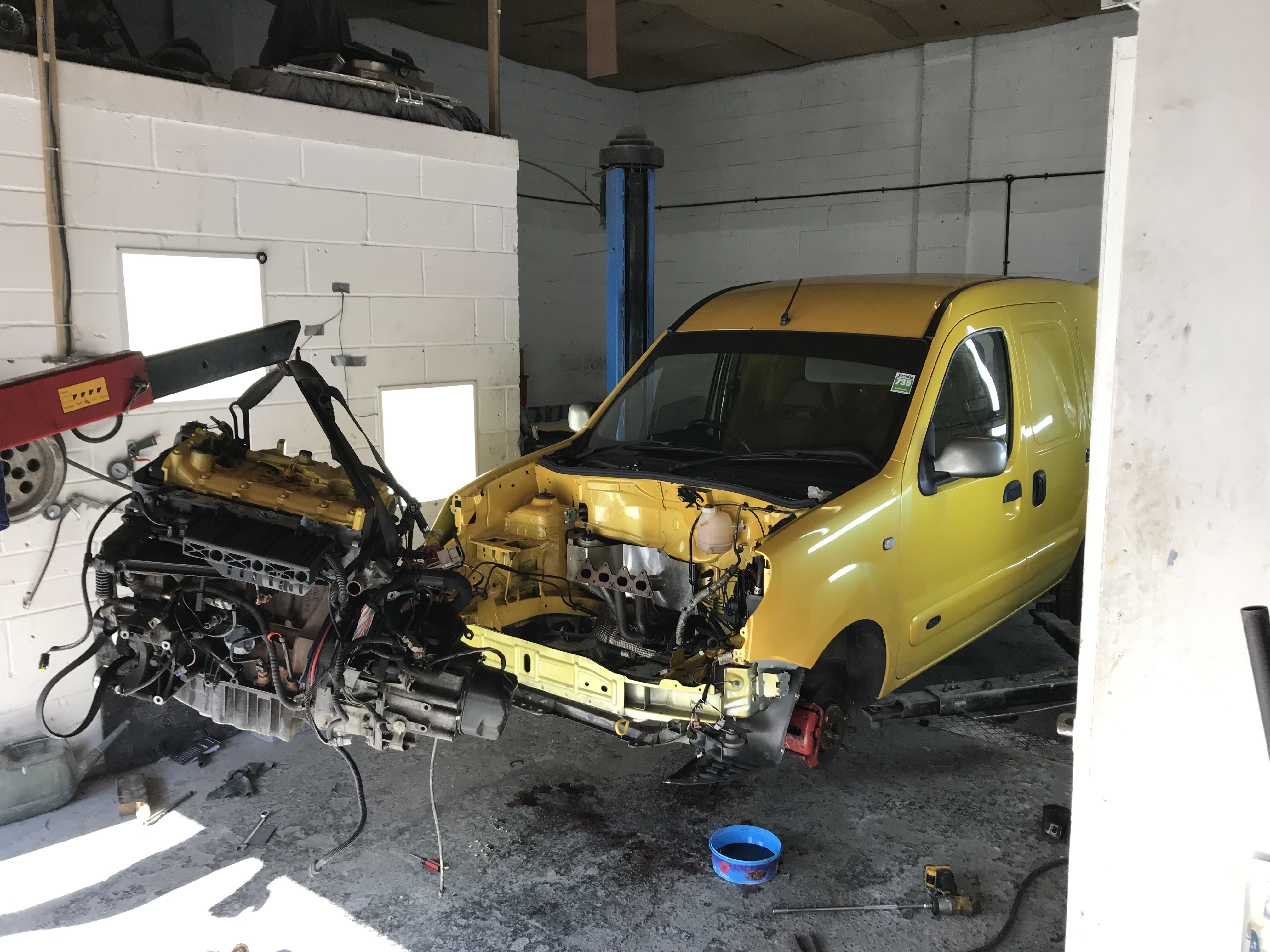

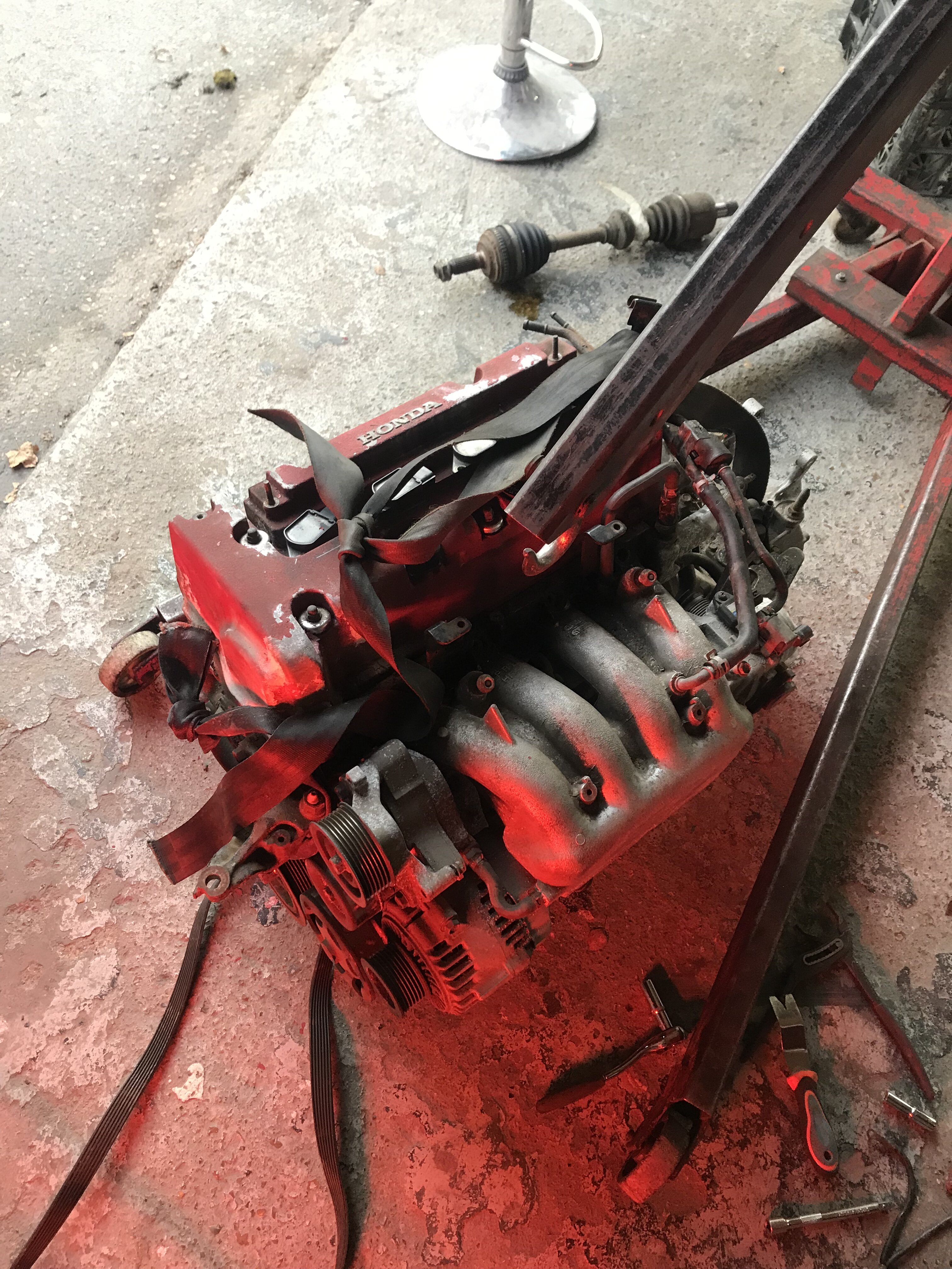

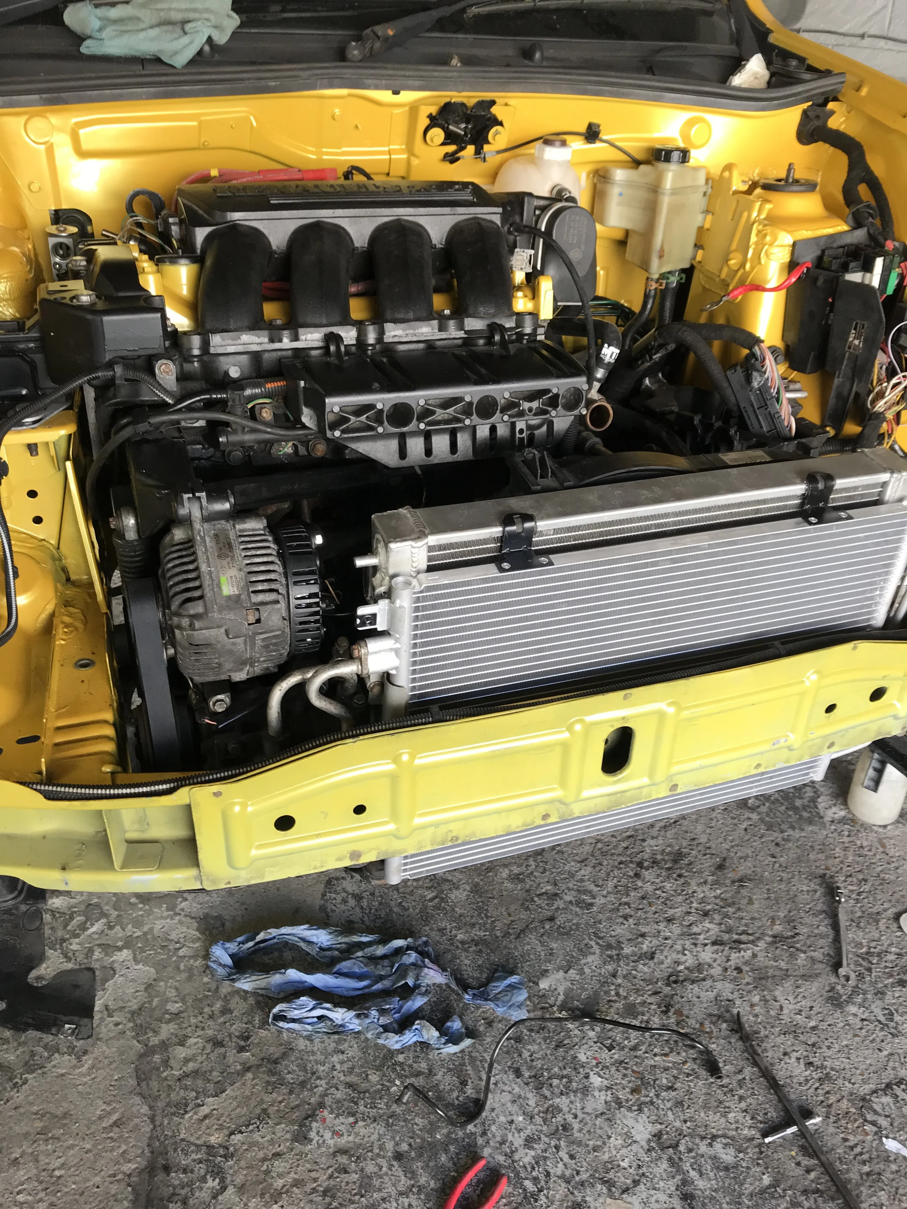

Sooo update…

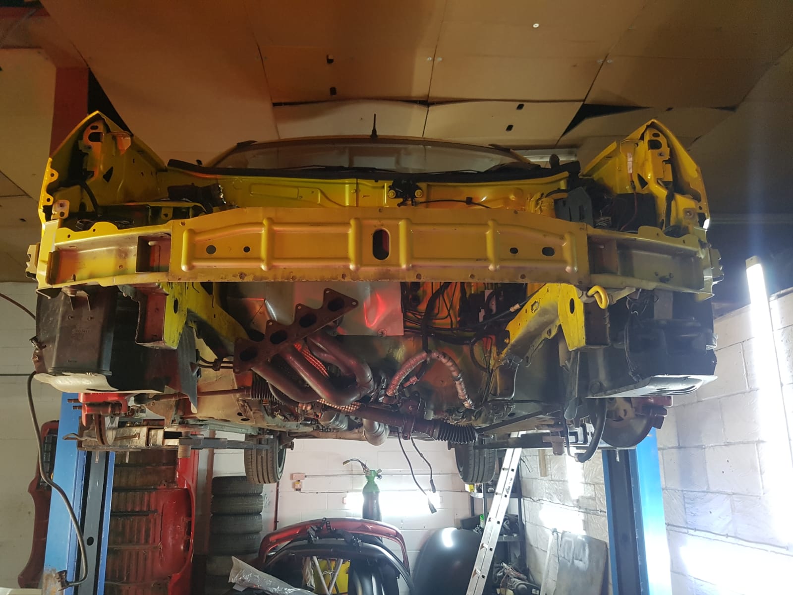

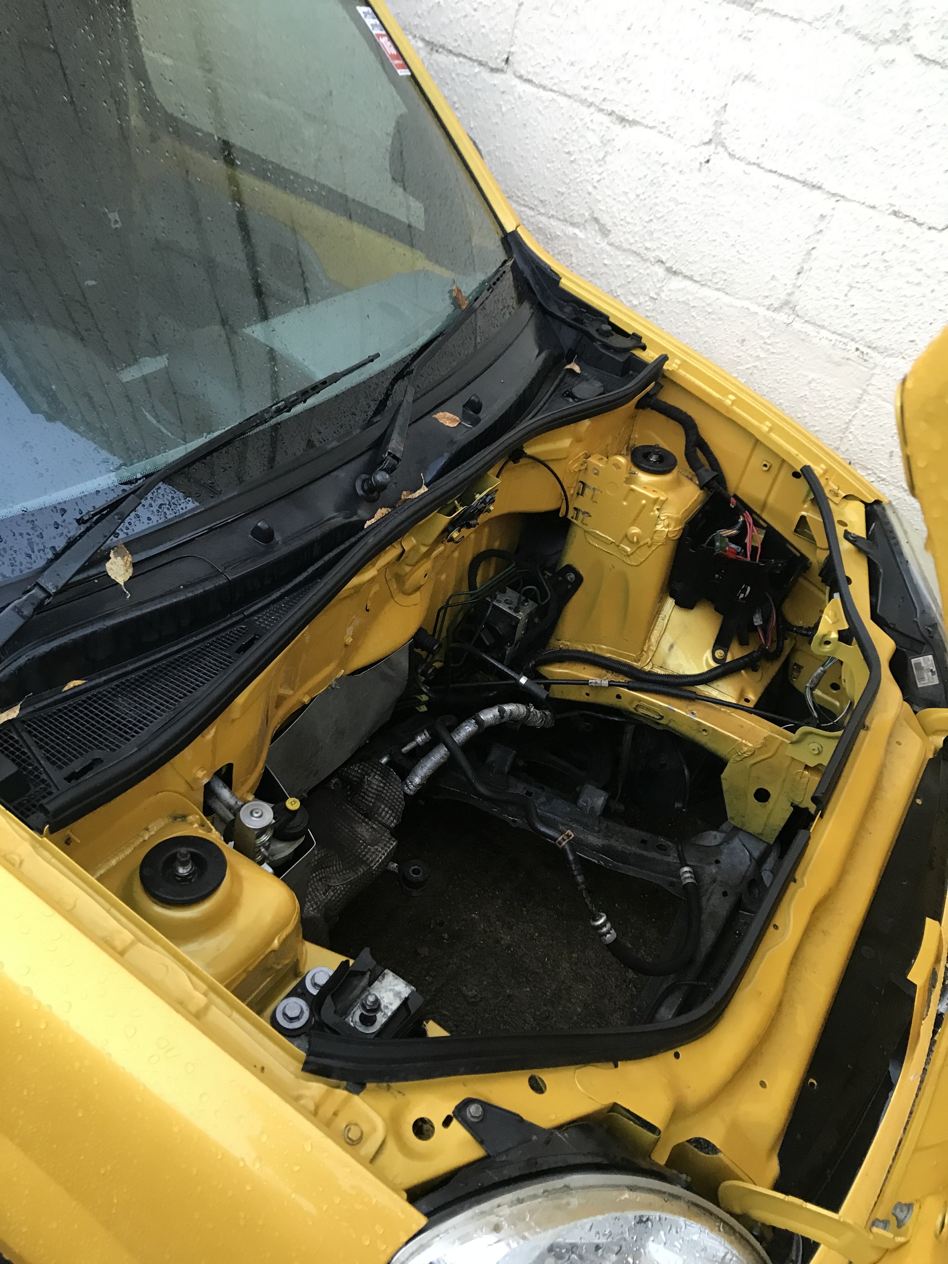

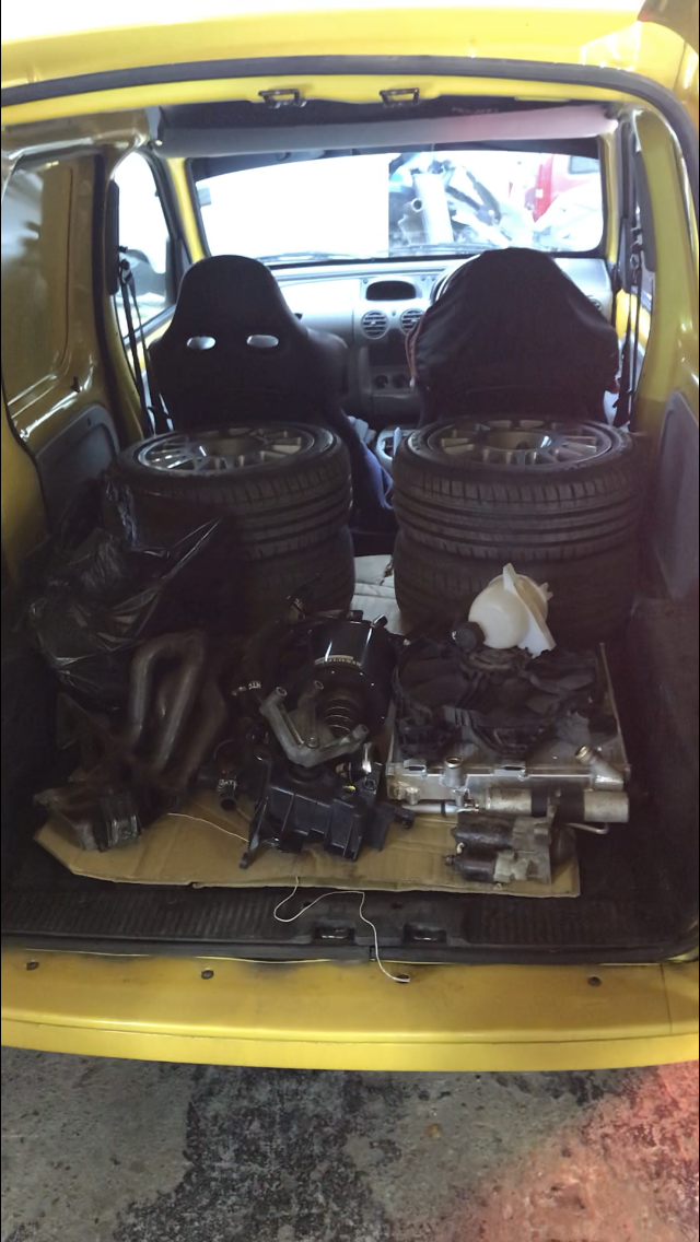

I fancy a mix up I dunno if people will be excited or not but after seeing @Chambers_RS project and driving my brothers integra and CTR it feel like the van need a k20!! So I sold the engine and box and bought a k20 engine box and shafts will be making most of the bits to convert so bare with..
I’m hoping to get to around 230+ Bhp gunner do standard bolt on mods like intake manifold Zorst mani blah blah also gunner put a new Honda chain and tensioner light flywheel and a lsd so yeh a few pics of how it currently sits nothing to excite yet
Cheers again

Wow I thought your van was super cool already!! will be very interested to see how this all fits in!? Good luck with it! Will the Honda engine and box fit in ok? Also what ECU will you use?? Should go really well once done though
Ben perry
  Clio 172 cup
Cheers mate yeh hopefully just need to cut a little out of the passenger chassis leg should fit ok 🤞🤞I’m gunner run stock Honda engine ecu with a stand alone loom conversion so I can keep the kangoo loom keep abs ect just need to find out tachometer input and speedo input for Renault cluster, I’m gunner go down Honda vert piggy back ecu for remapping ect as it’s half the price of a kpro fitted and live map

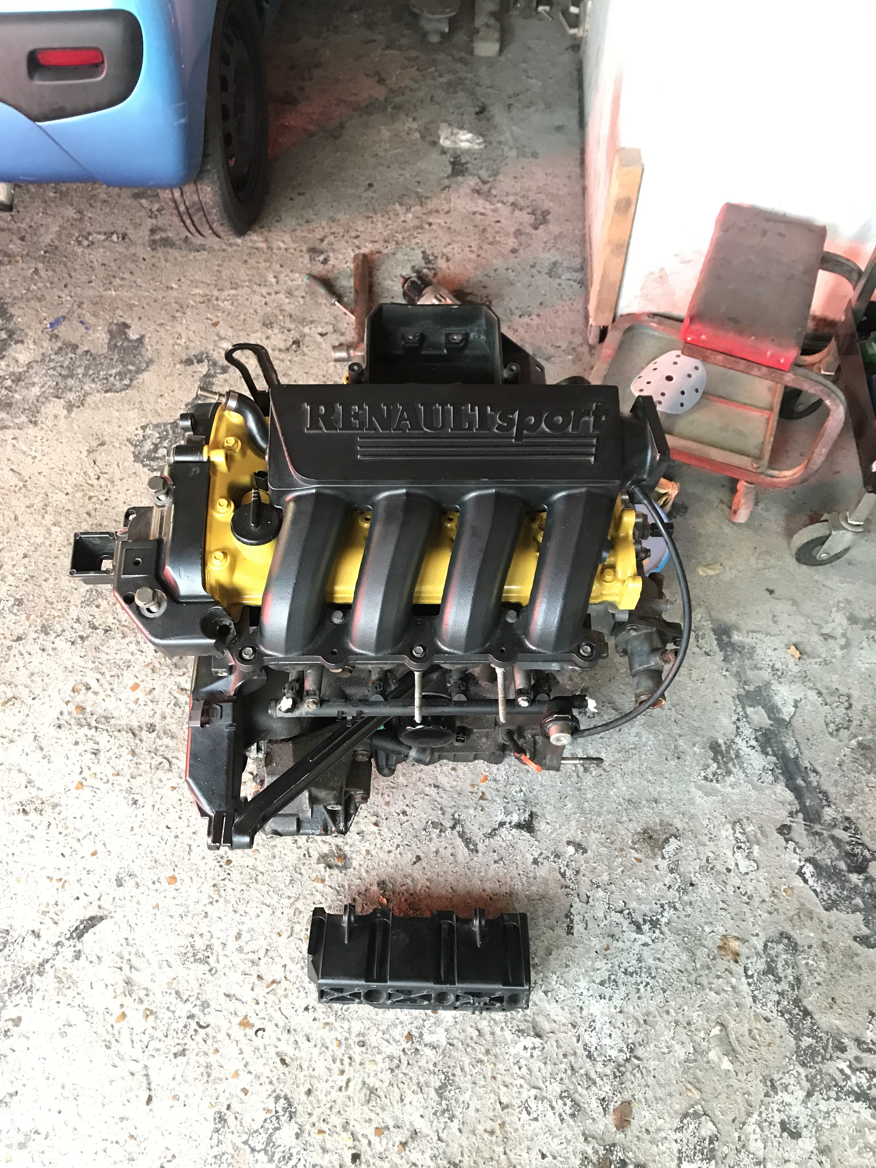

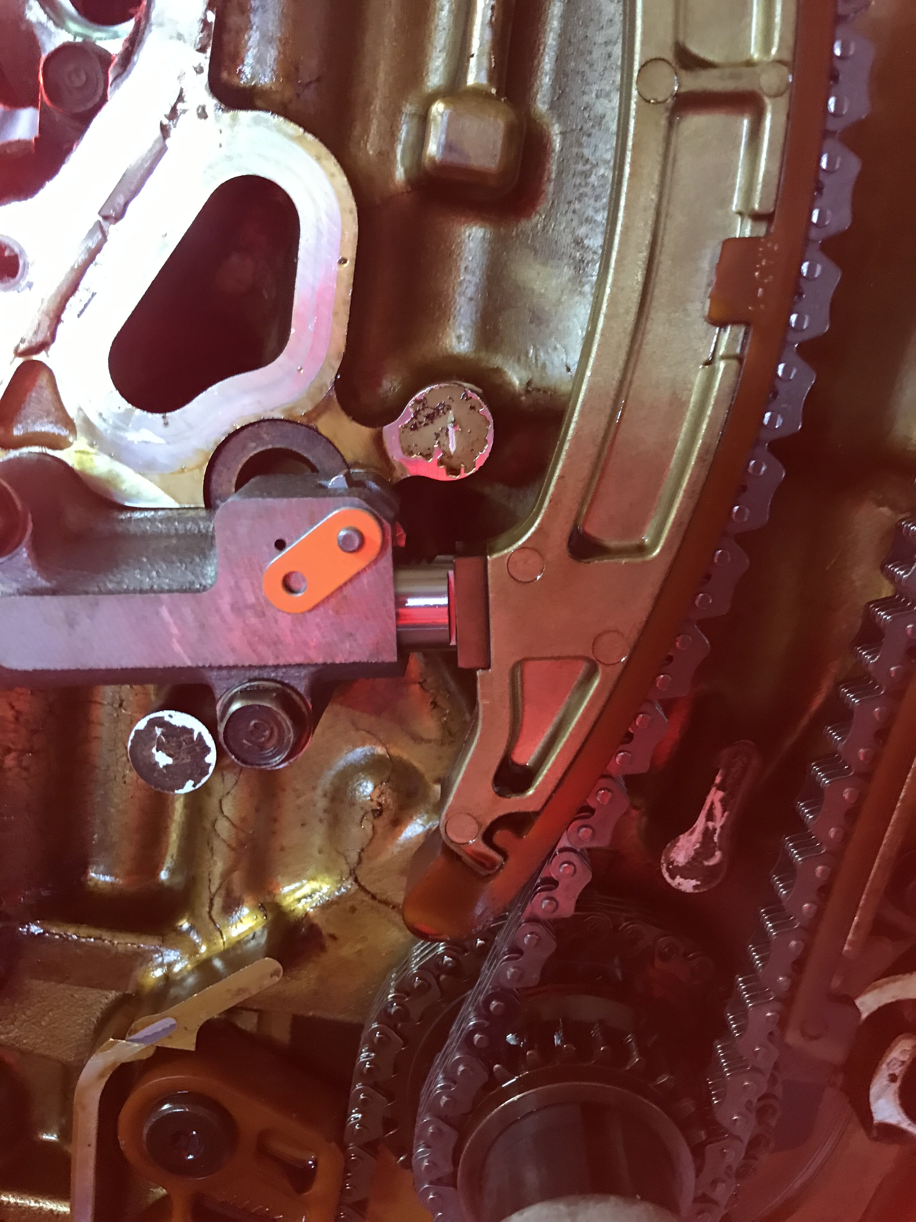

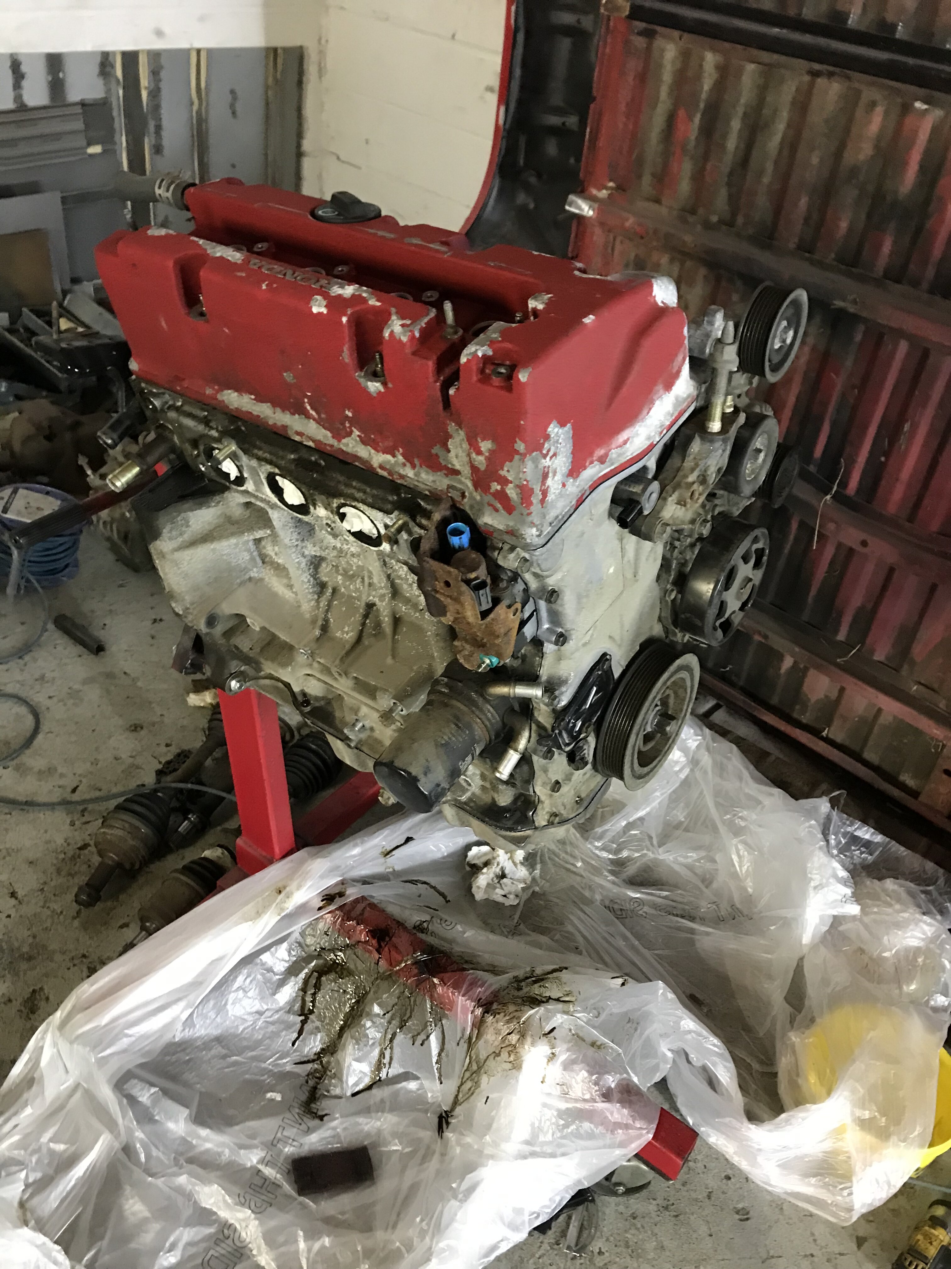

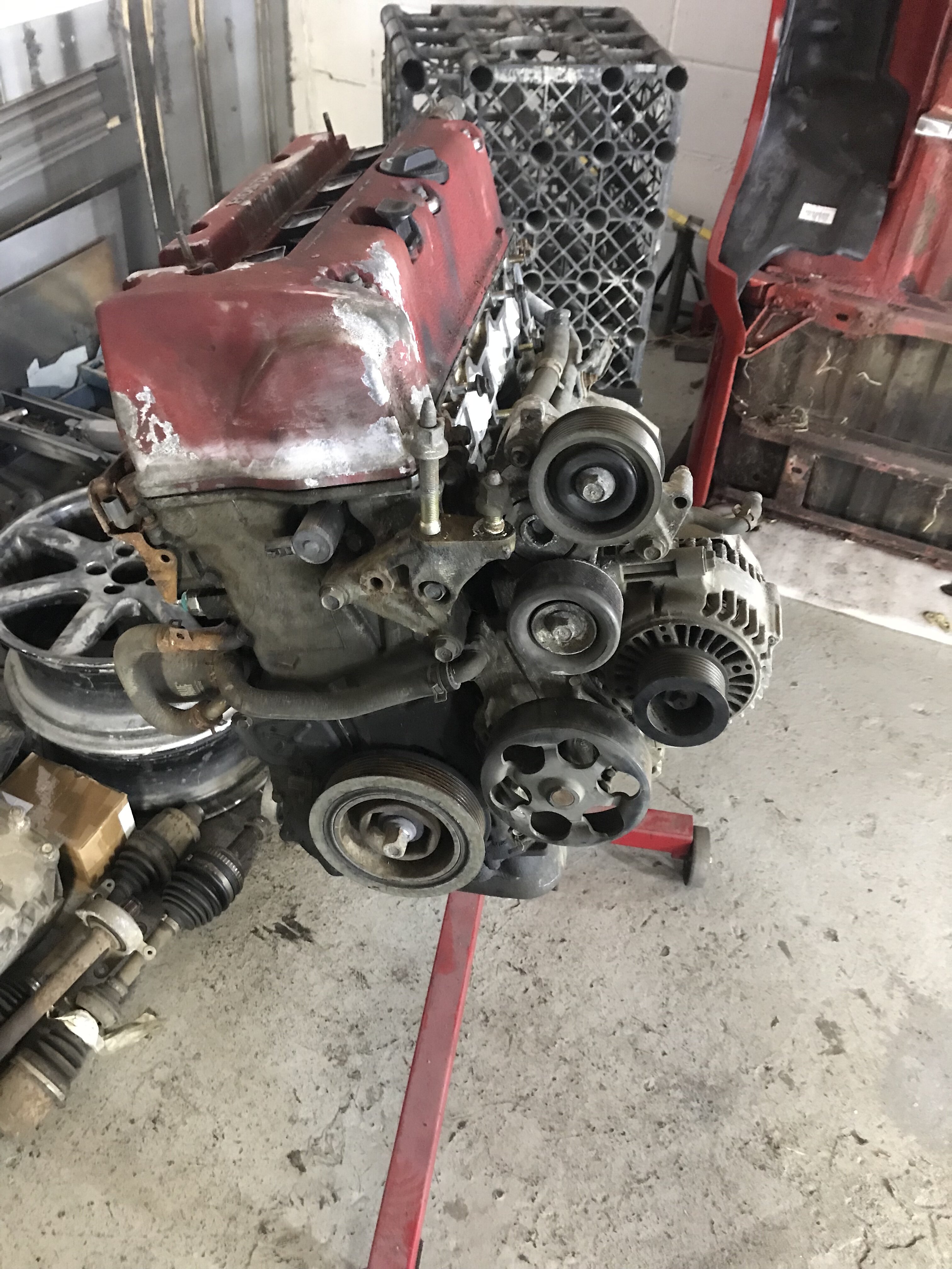

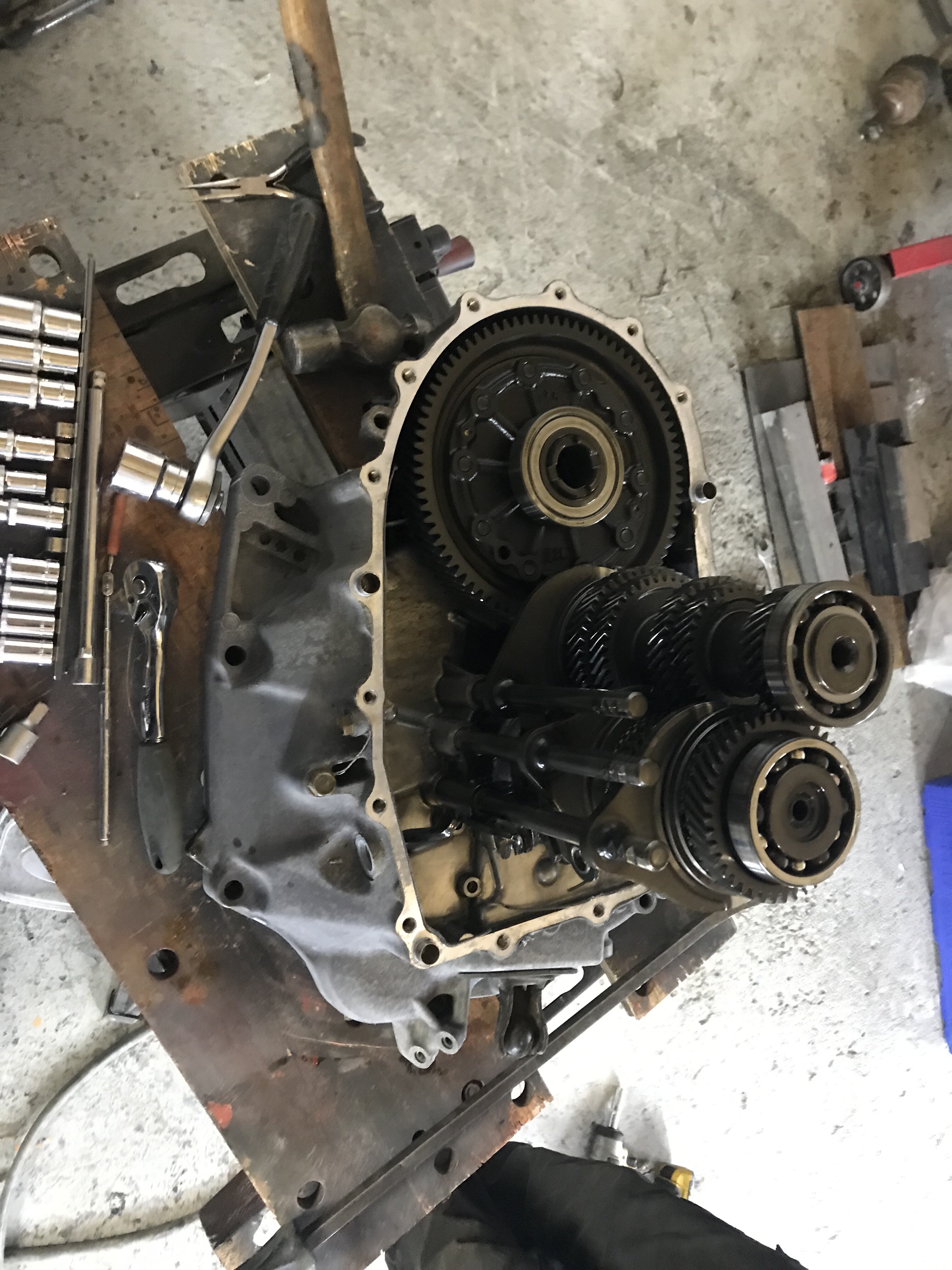

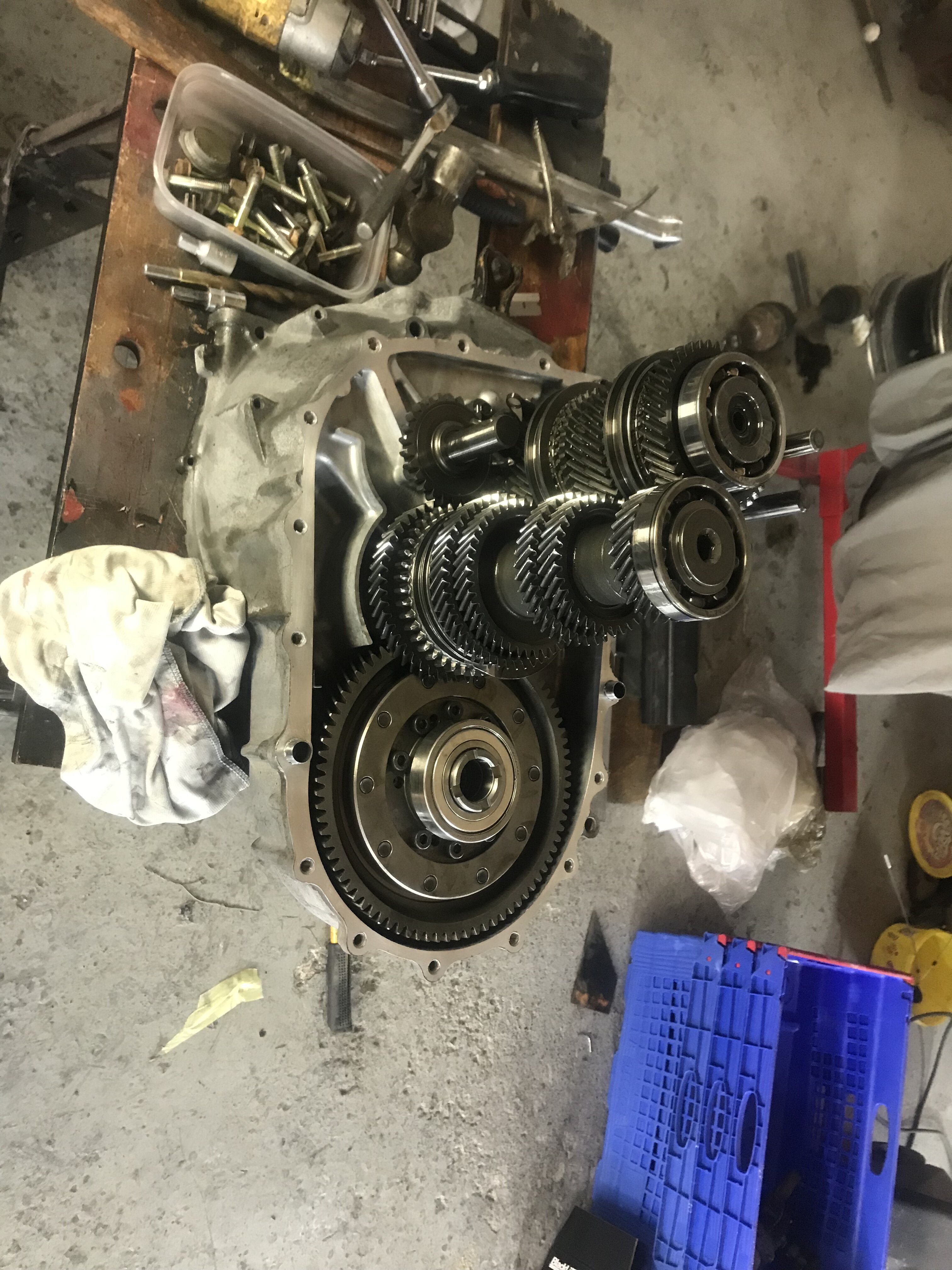

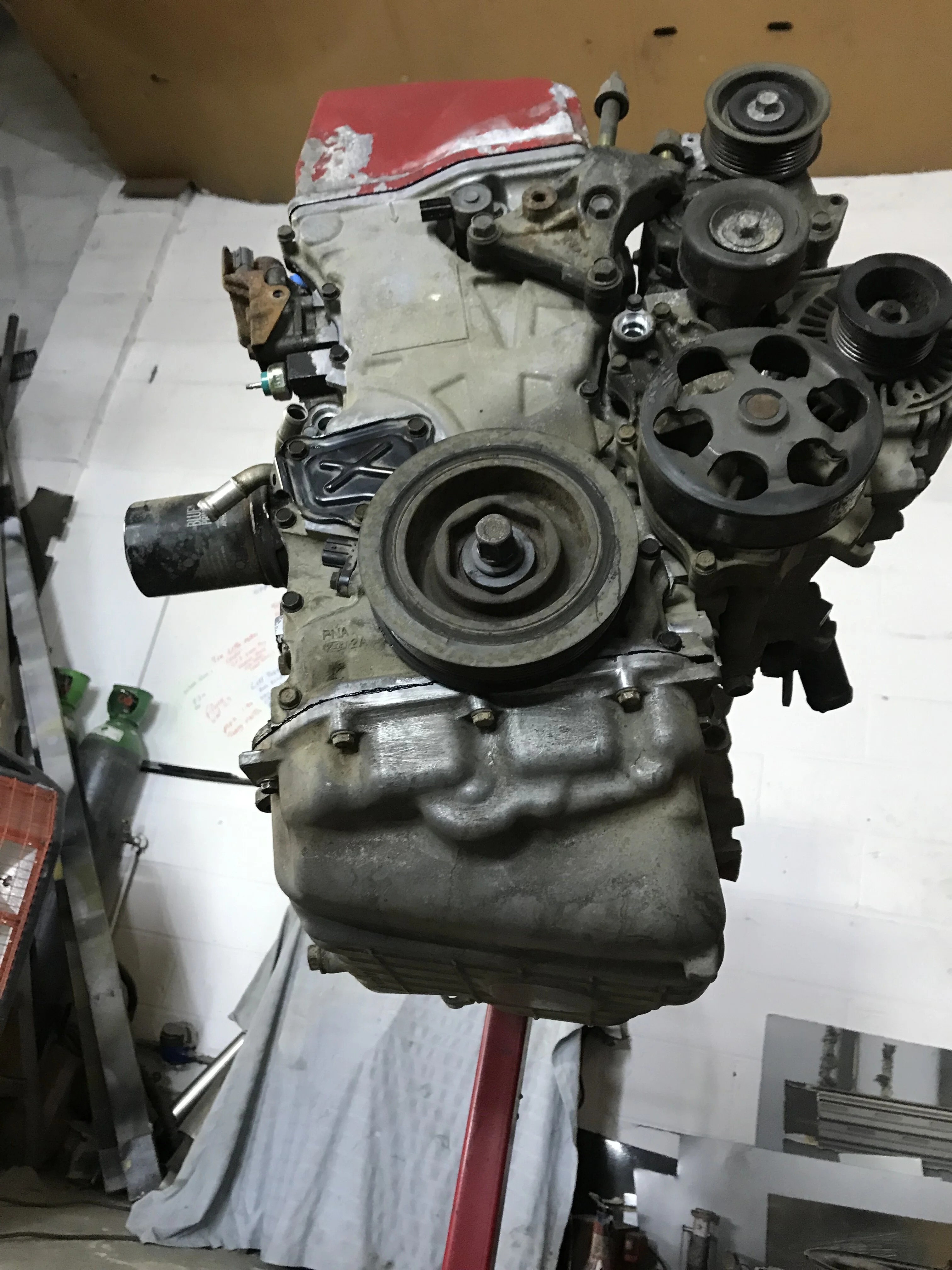

A little bit of a boring update..

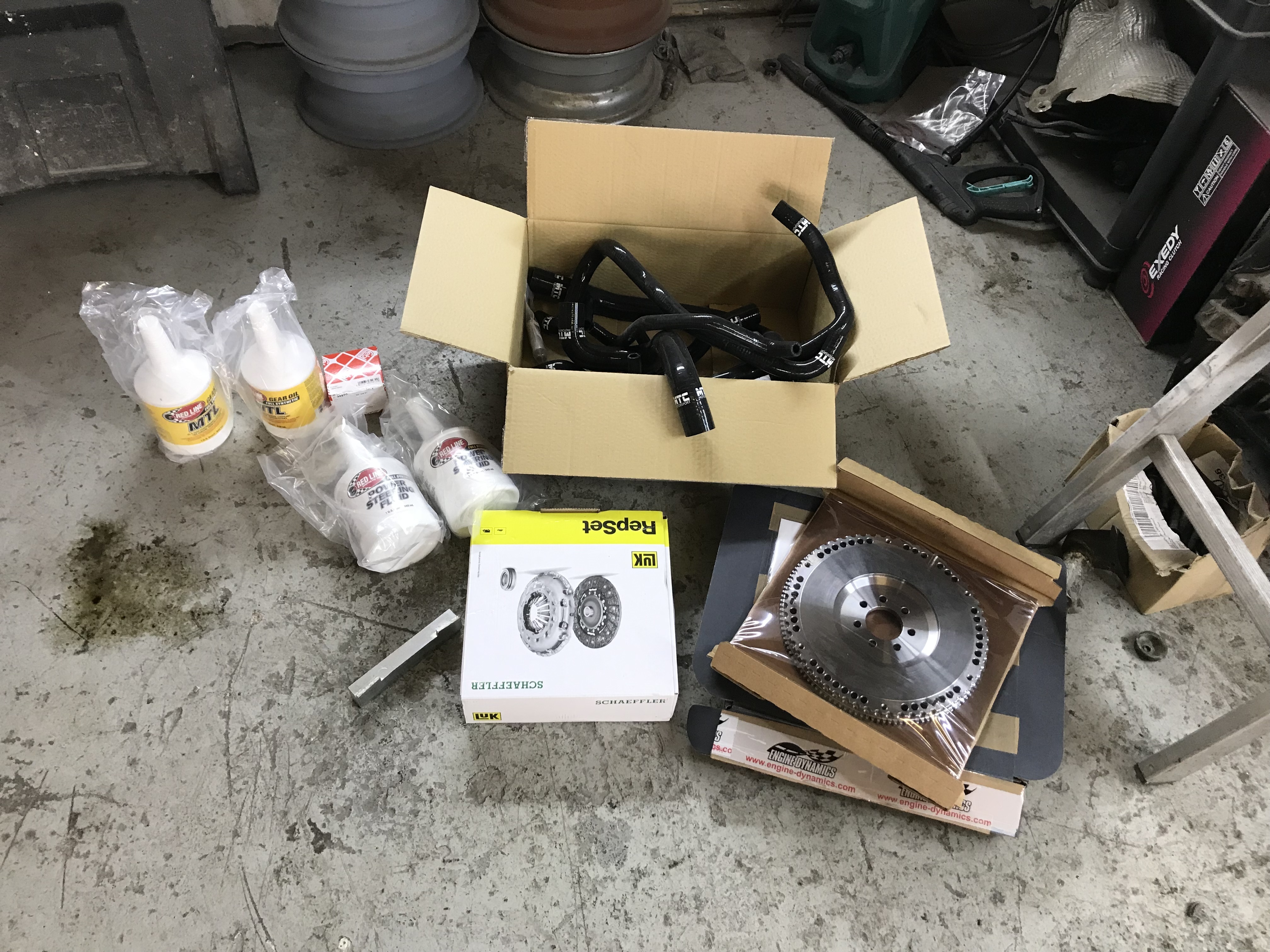

bought a lot of parts nearly everything I need!!
Got a new genuine chain and tensioner
Billet flywheel with oem clutch

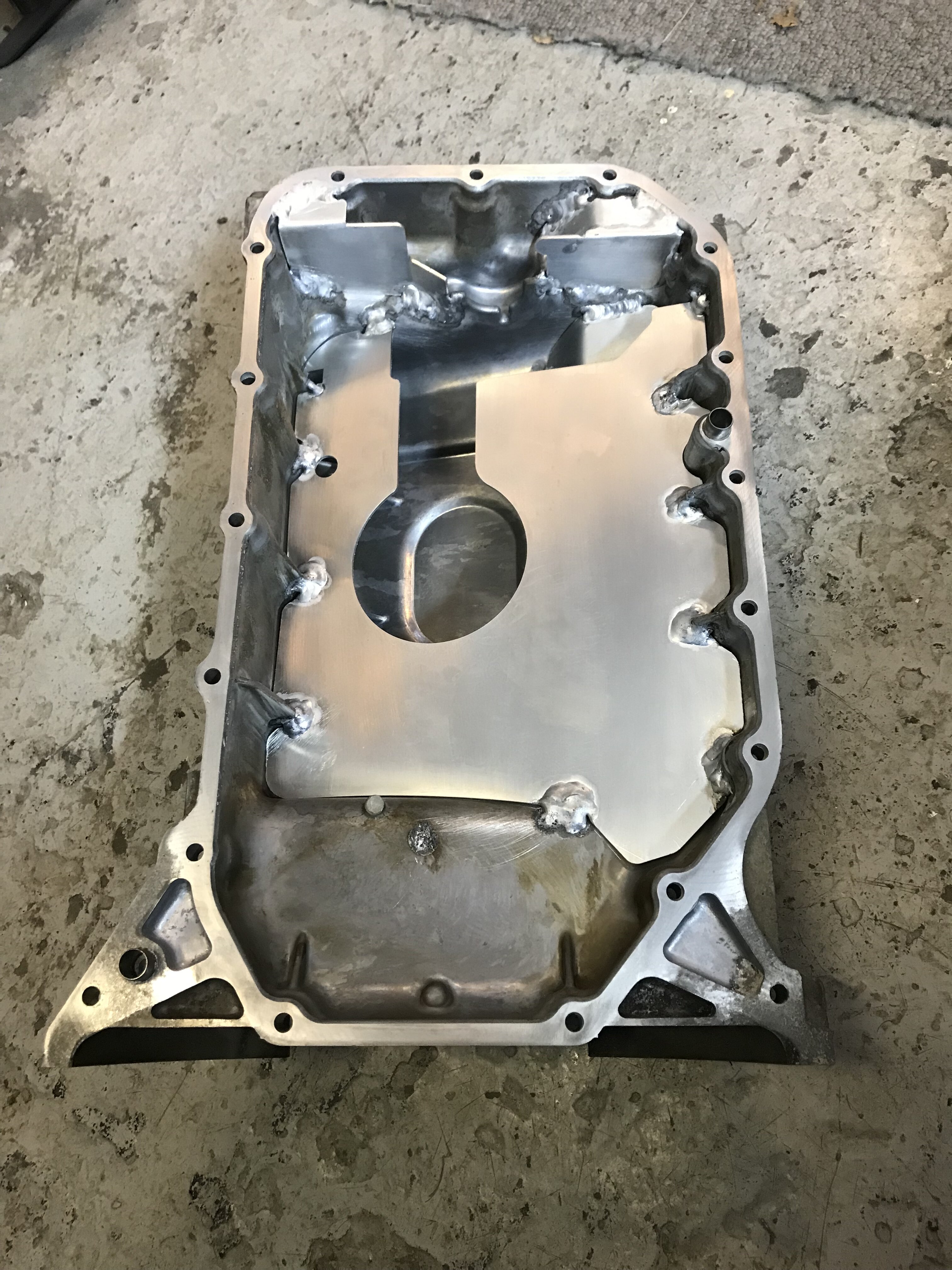

Weld in sump baffel
Rbc Un modified inlet with thermal gasket
Hybrid racing universal loom
Lots of other bits

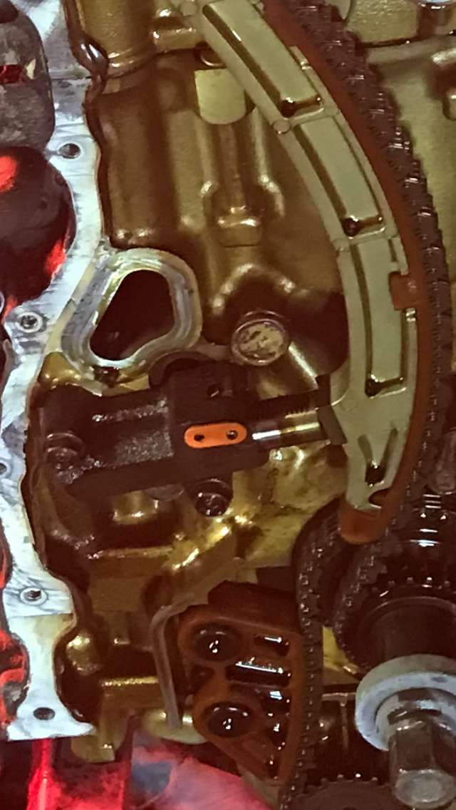

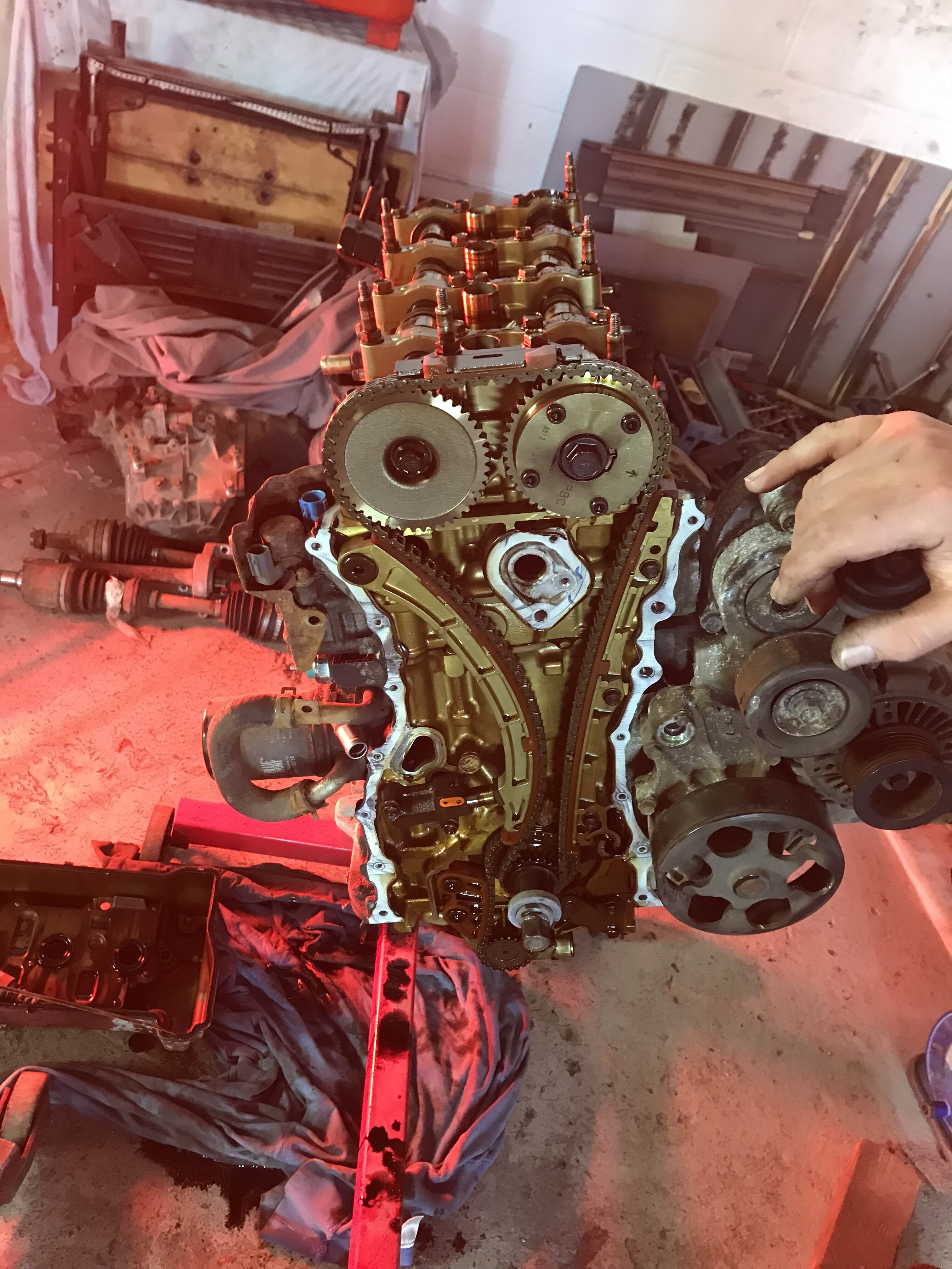

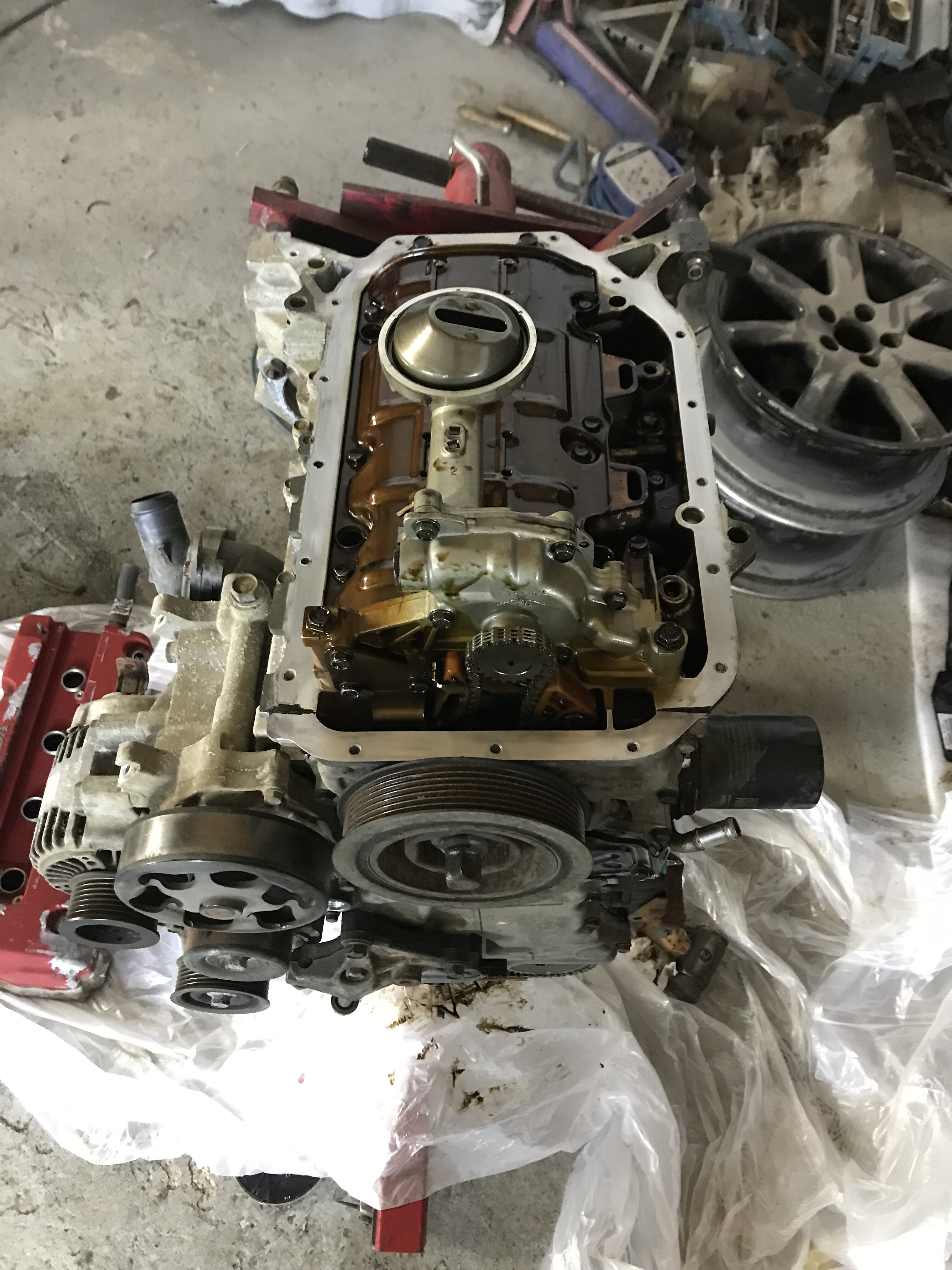

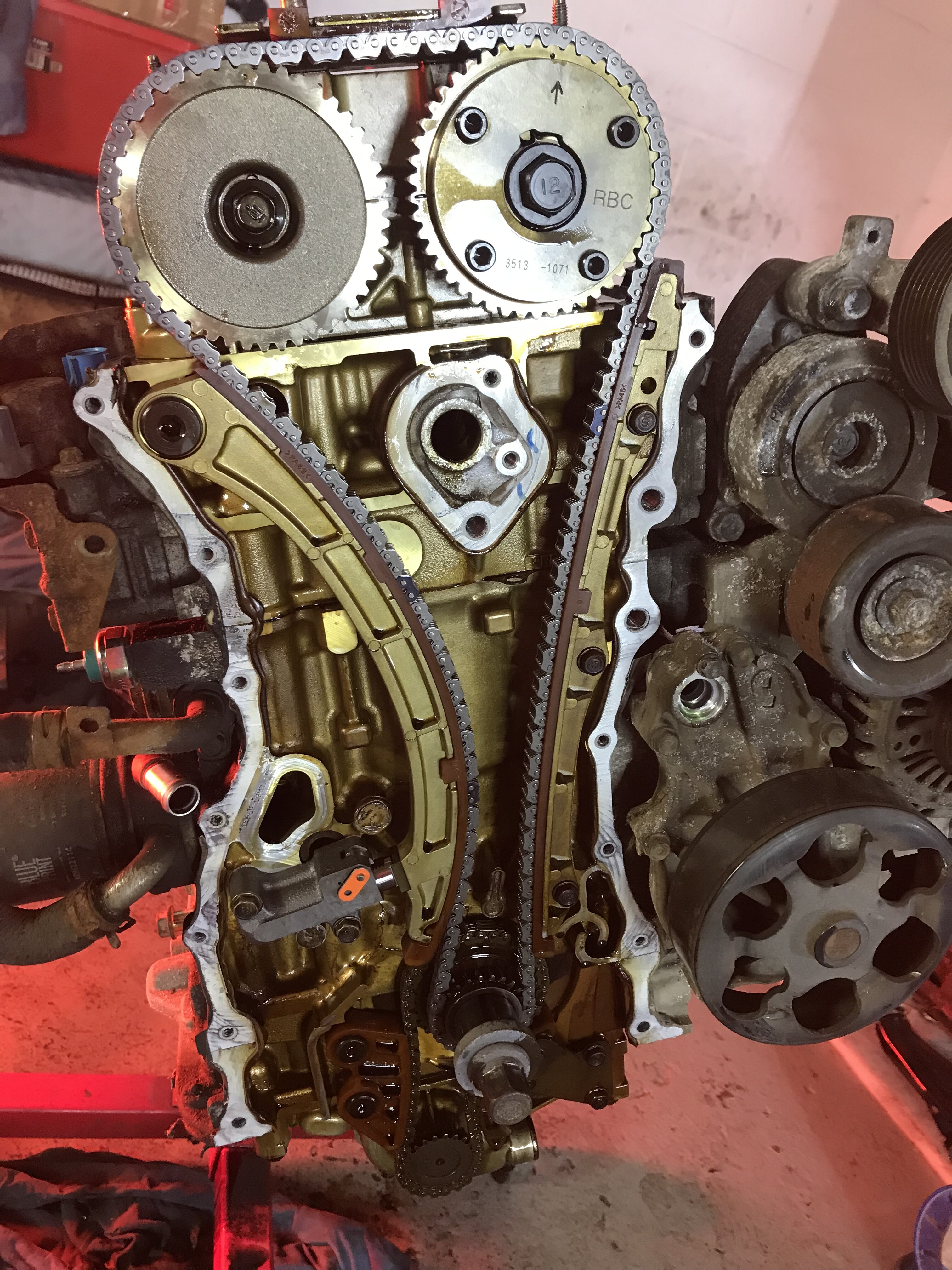

So made start on engine stripped down and fitted chain and tensioner guides were mint as was oil pump chain but the cam chain was stretched to F and the tensioner had failed.

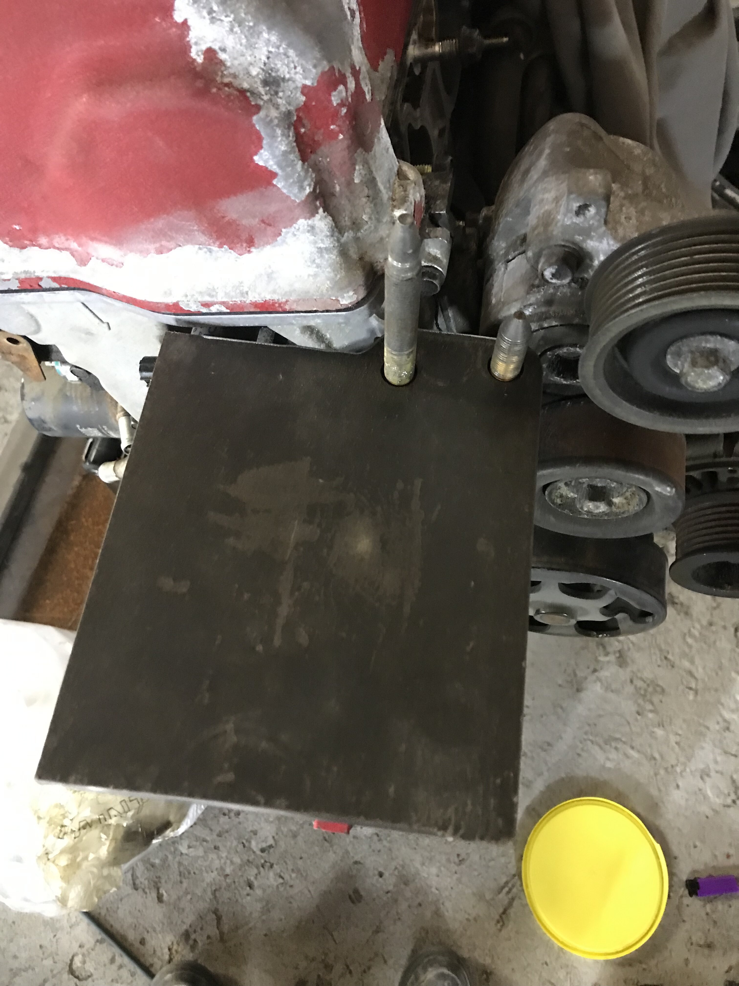

Also tigged the baffles in sump I’m learning to tig don’t judge!!! 😂😂
And all sealed up with Honda bond hopefully lsd next week and I’ll have a bash at fitting that !!
