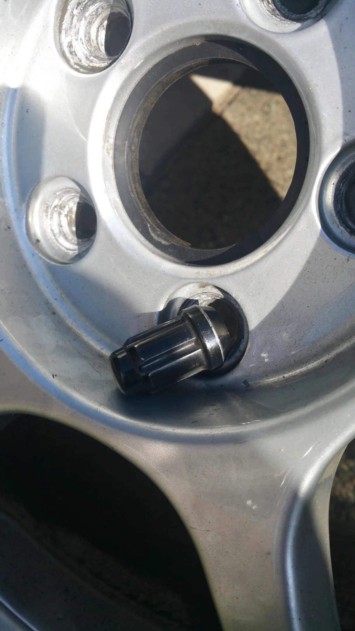

Assuming the wheel nuts have the same taper angle as the wheels,and there's no paint on the wheels stopping the nut mating up to the wheel 100%.

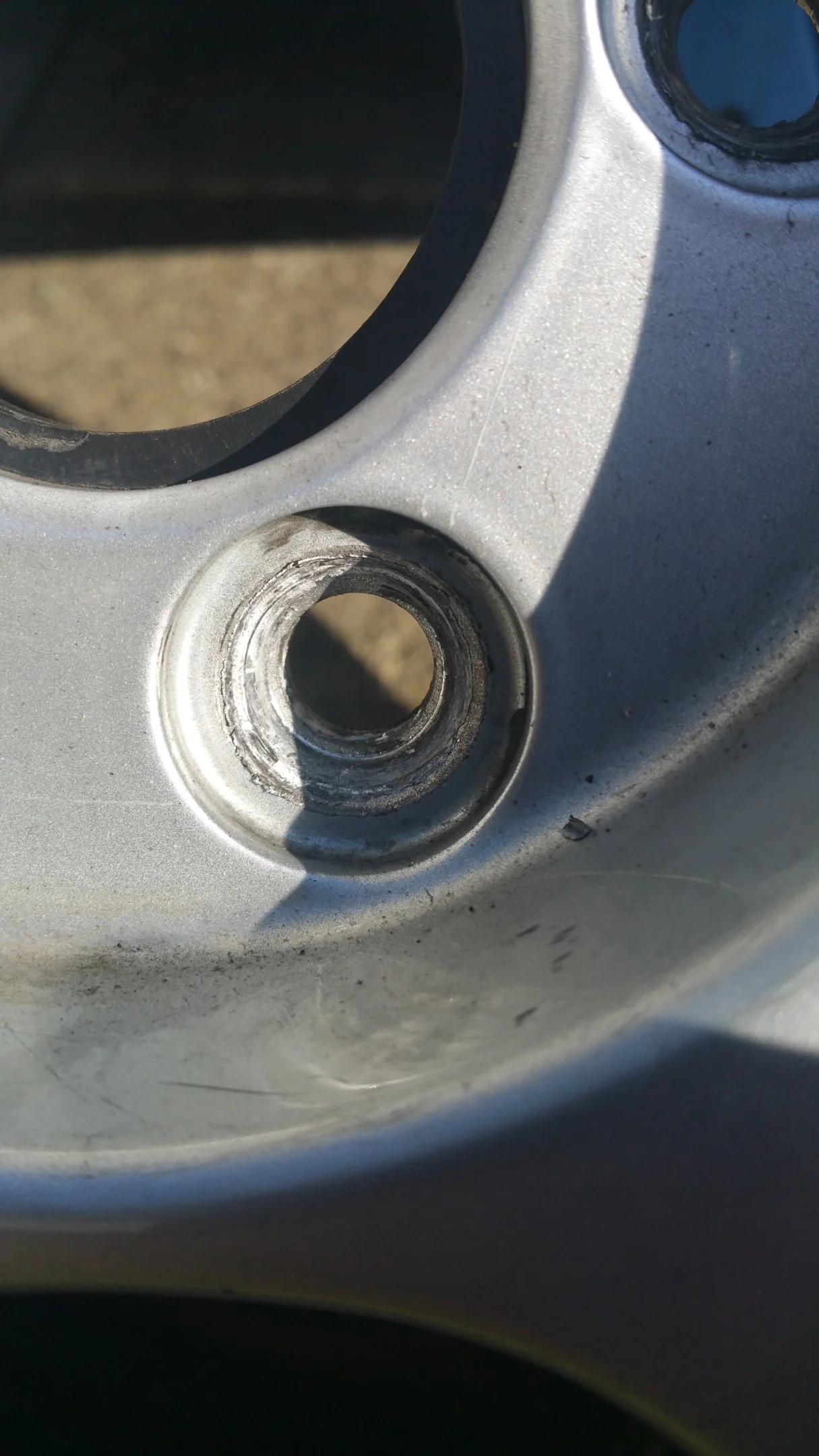

I would think the excessive build up of paint/powdercoat on the wheel has more to do with them coming loose than thread length, at 7 turns you should have fairly decent engagement.
You can see in the pic the way the nut has dug into the paint on the wheel, that should ideally be a metal to metal contact with the full tapered face contacting.

Yeah was thinking that, I'll get my dremmel on them to clean them all up. Thing is its hard to recreate track conditions on the road so wouldn't know it worked until on track.
